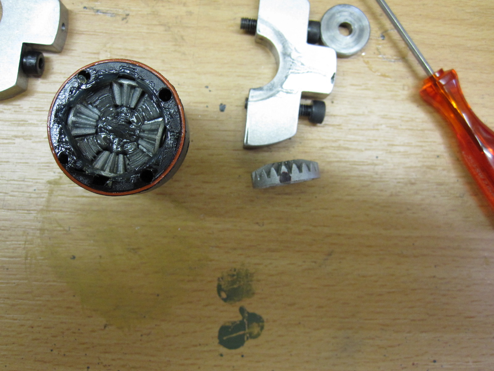

Hi Martin and all , thx for your comment but this screw stop the cog wheel only on the side ...
i think there is no risk to destroy the diff ( show the black point on the picture ...)

oh sorry , one info.. lube you must always fill in the diff bevor you close it... this little hole on this position is definitely not for fill the diff with lube ..

Hi all,
it is very easy to charge the diffs through the hole with grease. You only have to take a small grease gun.
Bodo
Bodo

Hello,
personally I completely disassembled the diff, cleaned it well with proper solvent, then filled it with 1.000.000 (yes 1 million) diff grease. it's pretty sticky, but leaves full function to the diff. If one wheel gets out of contact from the ground the others will receive a good amount of power anyway.

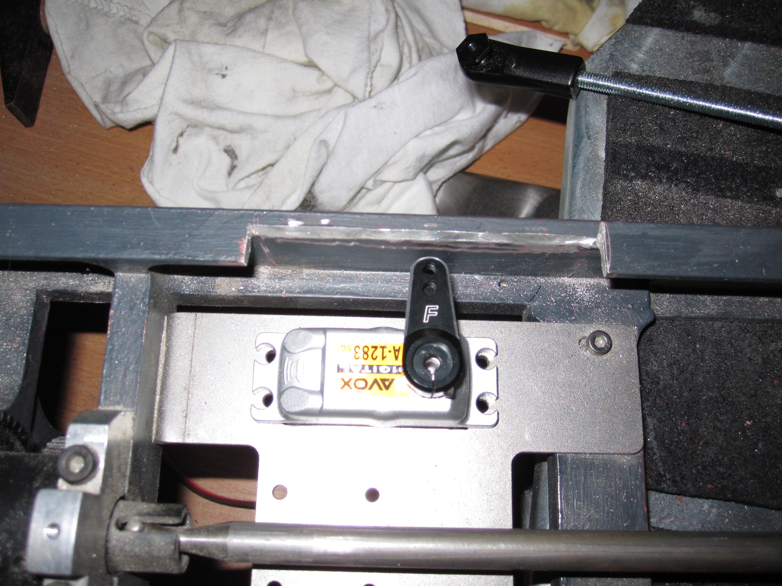

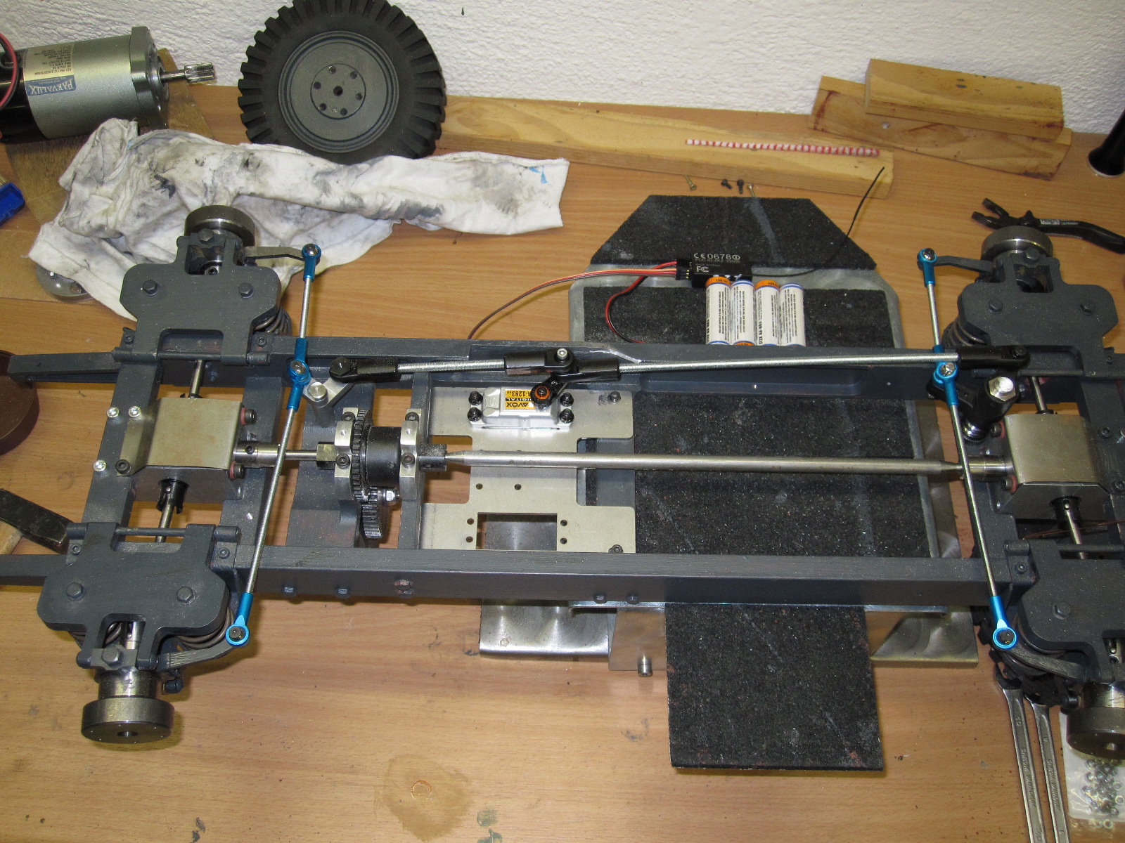

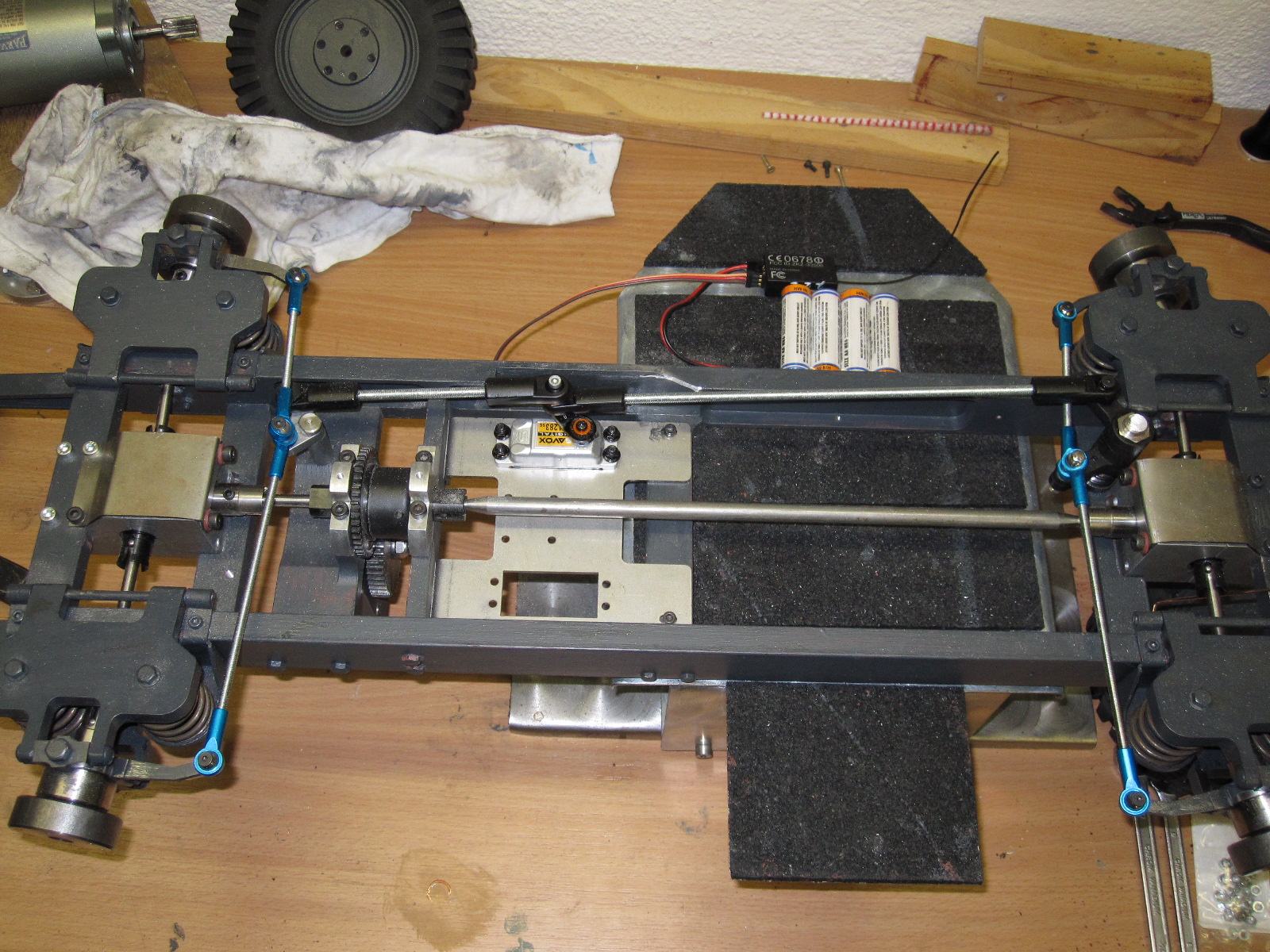

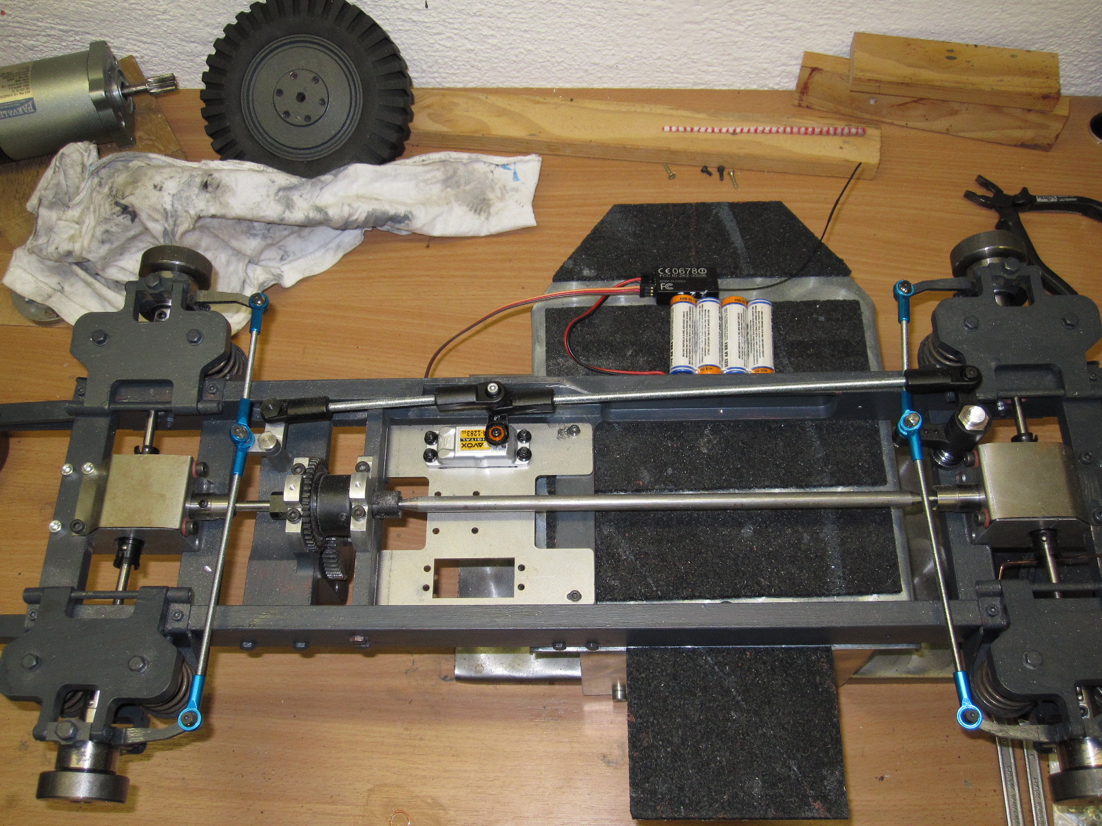

Hi,so now I start with the Section 3 (Fitting the Steering Servo Parts
Regards Andreas
Regards Andreas
