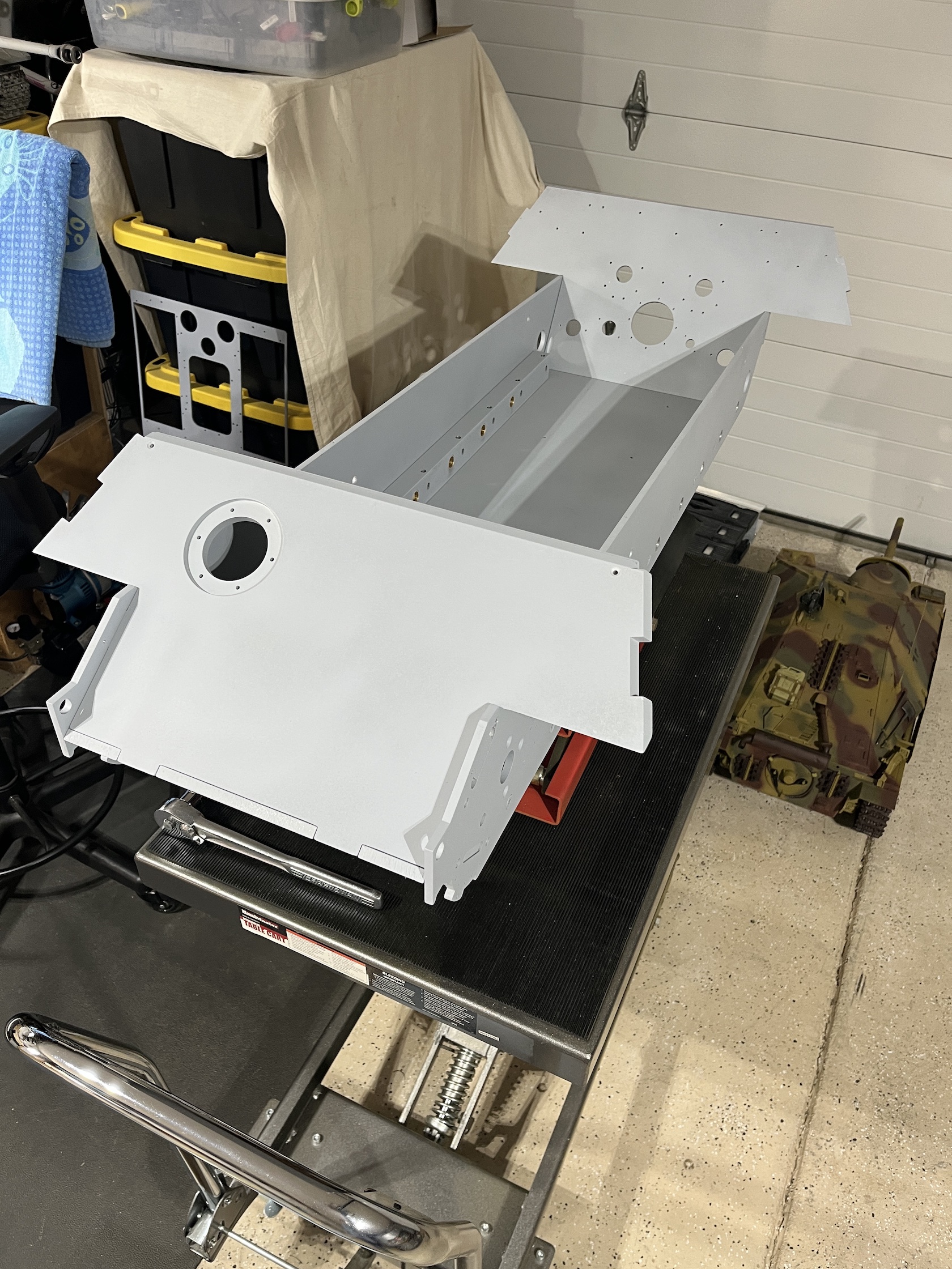

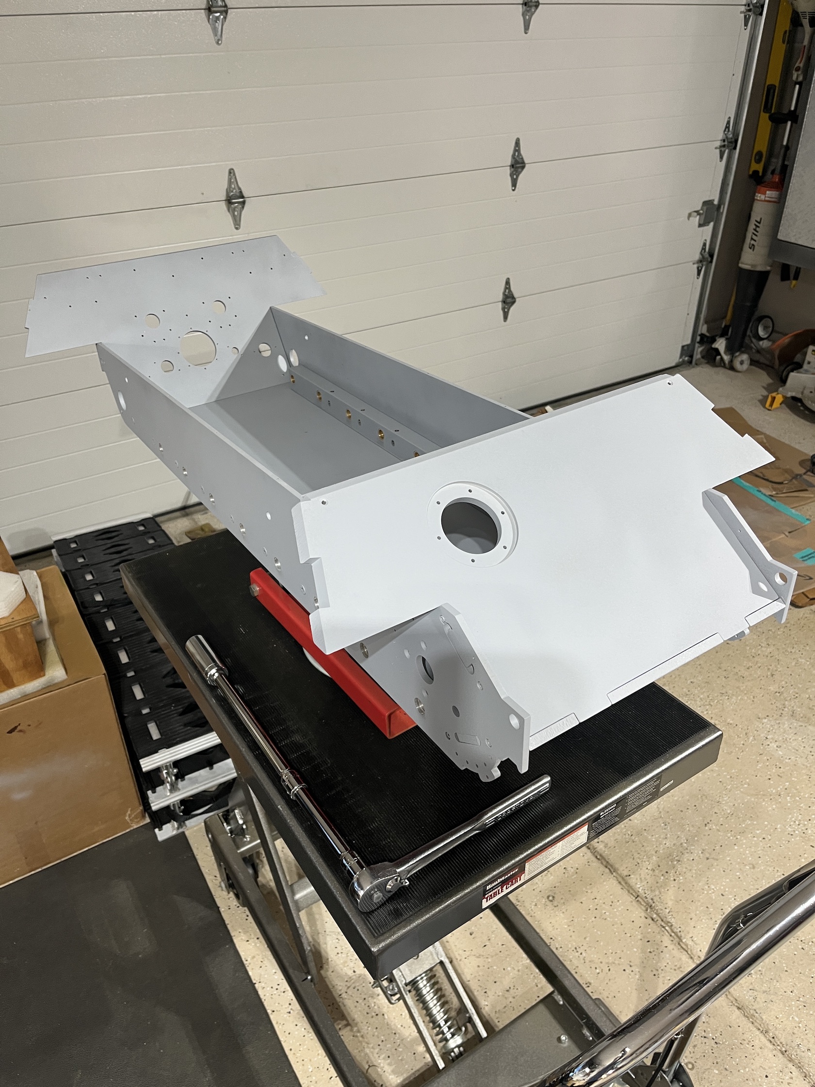

I have managed to get the Panther G out of storage and on the build table. It had been sitting for nearly 20 years in the previous owners estate collecting dust and mouse poo (yuck). I am happy to start this project and will occasionally post pictures as it progresses though the build factory.

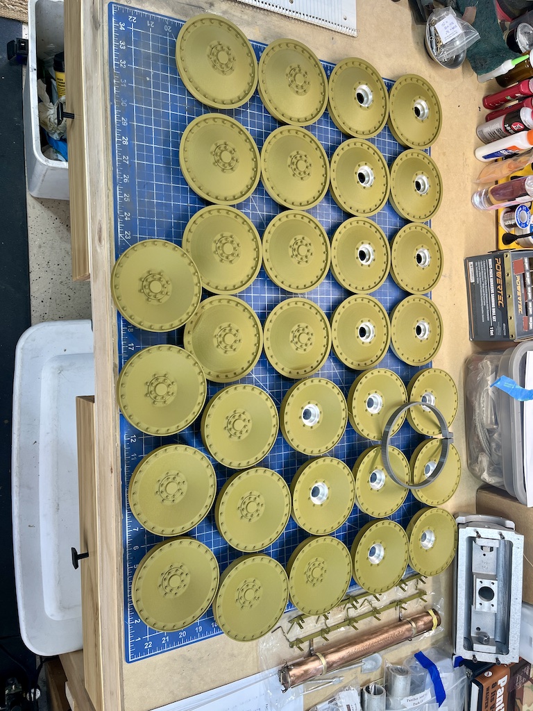

Not much progress that is picture worthy. I have finished the tracks and I am busy installing the 1400 dummy studs in the road wheels, labor intensive but good therapy.

Thank you for the information, I do in fact have a copy of the owners manual and the original single suspension bar set up and cast aluminum wheels. I like the older wheels but installing the 40 dummy studs per wheel was tedious work over the last week. My initial thought of newer AT parts include both the bump stops, the exhaust system and antenna base. I am sure I will find other parts that would be a cut above the 20+ year old model. I was lucky enough to have a number of 6th Scale Icon and Mike Stannard parts that were part of this Panther kit. I will keep looking for a newer version of the build manual for the 2022 version.

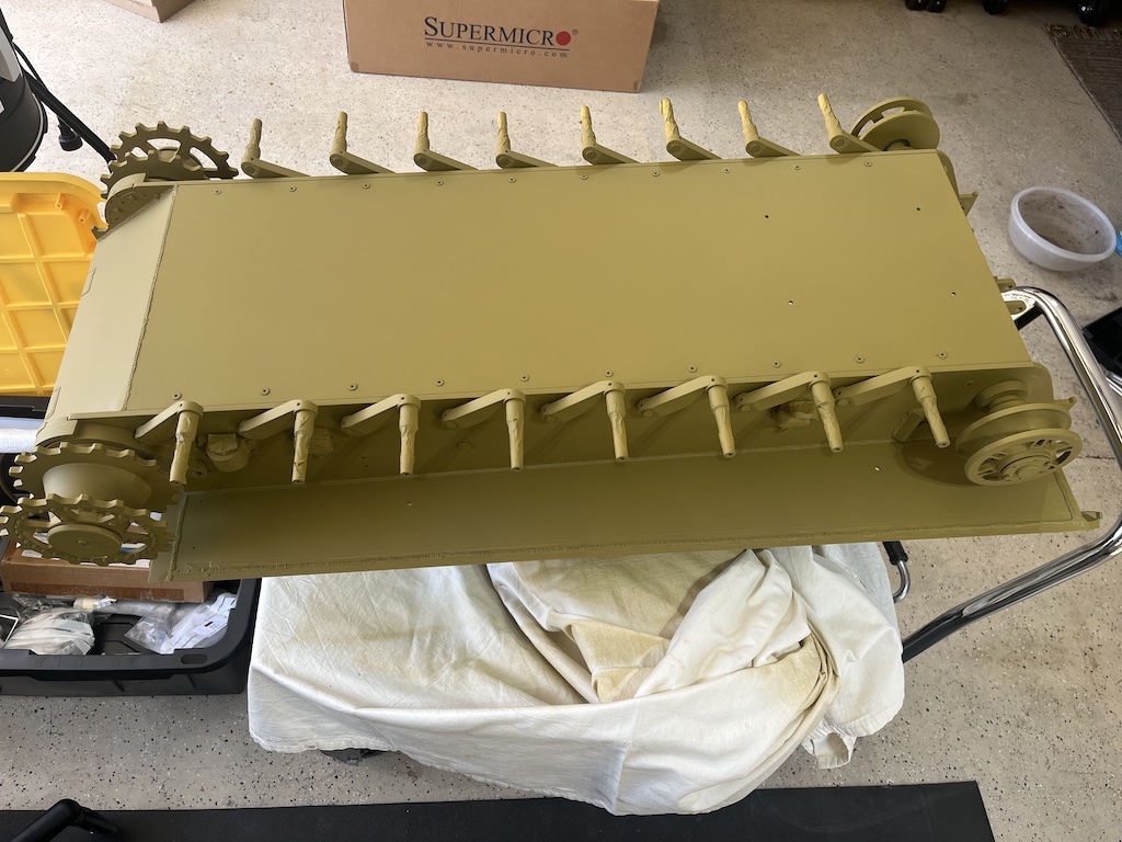

The sun was shining and the humidity was low today...painting was in order. A few snaps of the progress made this week. Torsion bars have been fitted but not fixed, a coat for the bottom, sides and road wheels.

Looks great Dan - good progress. Which yellow paint did you use?

I used a latex paint from the orange and white store box store (HD), it is a premium plus interior flat called African Plain (S320-7). It is not a perfect match for dunkelgelb but I like the way it looks with a matt sealer. I spray it on with a spray gun at ~ 30 psi and it is diluted 50/50. It goes on very light with multiple coats but drys extremely fast.
Hopefully I will not be castigated for this choice! I also used it on my beloved Early Tiger I.
Dan

I was going to say Tamiya TS-3 Dark Yellow. Looks pretty close to me.

That was my thought too - Tamiya TS3. I think it looks great! Latex is a great choice - durable and cheap. Lot cheaper than $7 per can!
