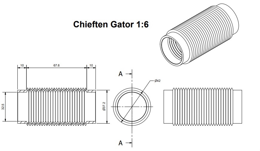

While discussing some 3D printed handles on my build topic, I mentioned that Mark Hawkins can print flexible prints with very high detail too. It got me thinking, could the MA bellows be printed in such away that it would flex look and move like the full size bellows?
With some guestimated wish dimensions I asked Mark to see what he could do.
The bellows came out really nice, flexis slightly but nowhere near enough, even though the wall thickness is only 1mm thick, the wall of the bellows is too ridged to compress. We may try again with different wall thicknesses to see if we can improve the flexibility.
The print as is, would make a perfect replacement for model supplied bellows for those not wanting recoil movement as with a static model.
If anyone's interested, let me or Mark know.
May also be suitable for a static Challenger2 :D
Remember.
If you need a fine detailed print of something, ask Mark, he maybe able to draw it up and print it for you. He drew the drawing in a few minutes which is faster than I could find a pencil. :D

Personally I would use them even if they don't flex that much. I would make the inside diameter slightly larger so that during recoil the bellows would just slide (and not compress) over the barrel. I would remove two bellow sections and make the outside diameter of the bellows slightly larger just for looks.

The idea to replace the supplied bellows (50mm diameter) add multiple ribs/corrugations and reduce the overall diameter to somewhere around 40mm, then it should look like the original and sit between the "horns"
Had the barrel not had a thermal sleeve it would have been so much easier. But the bellows sits in between the canvas cover and the thermal sleeve, one will crush on the recoil which ever end it grips to the barrel if left as a fixed length . We might get away with a little movement on the canvas cover, so we need to get a little more flex on the bellows and a possible reduction on the servo arm controlling the recoil.
The recoil on the real thing is very short when viewing film clips.
Marks going to have another go with a different resin, which is apparently more flexible. That and maybe thinning the print, then it may have enough flexibility to work..
It's all experimentation at the moment.
BTW, it take 5 hours to print and a bit more time to clean up.

It may not be as bad as first thought. The actual recoil is short, and the canvas cover could be made to cope with the compression and by extending the end of the bellows tube by say 20mm, 30mm total to pass through the canvas ring, there should be enough movement. 10mm outside compression 15mm on the canvas, you'd hardly notice.
The bellows needs to be anchored to the barrel next to the thermal sleeve otherwise it will crumple the thermal sleeve, not a good look.
I think I was a little naive thinking the flex of a print would as flexible as the full size Bellows and still have long term reliability. I even thought of gluing stitching 50 pieces of thin rubber together. Hummm, not really practical :(
I've been working on the original printed piece, cleaning out the internals as much as possible with a Dremel nylon brush attachment. It is now more flexible and compresses a little more, but it needs more effort than I would like to put on the servo.
So, when the new resin solution arrives (It ain't cheap) I'll ask Mark for an extended tube, going for the slide idea and we'll see how it goes.

The extended end tube was added which can be trimmed to suit if necessary and the number of ribs/corrugations was corrected to the number counted on the best photo I have 23, not 25 as originally printed. Oh yes and the wall thickness is down from 1.0mm to 0.8mm.
I can't guarantee that the flexibility of the print is as soft as the supplied Bellows, that has only 7 ribs/corrugations and is 10mm wider, but this is as good as it gets scale wise (Unless someone knows better :D ).
Printing time and clean up is around 9 hours now and of course more resin solution is used to support the larger print.
