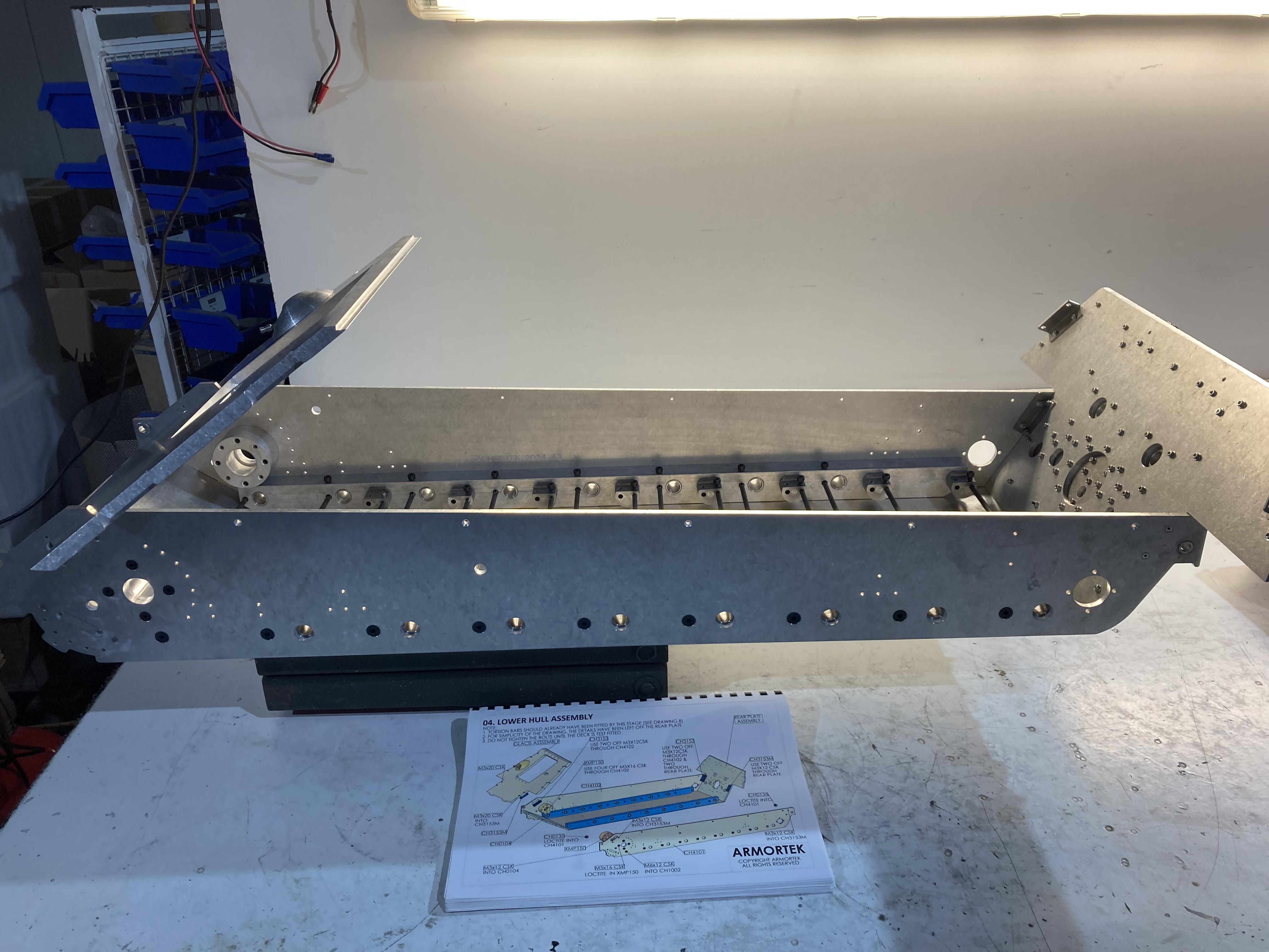

I am putting together Jagdpanther kit number 43 for an overseas client, So decided to put together a build log in pictures of the build from start to finish, This will be a standard build with all the option packs fitted and a high standard paint job, If there's any questions along the way please feel free to ask, For a lot of the builders on the forum it wont help but for new builders some of the pictures might help, I will keep adding the build stages as i go along,

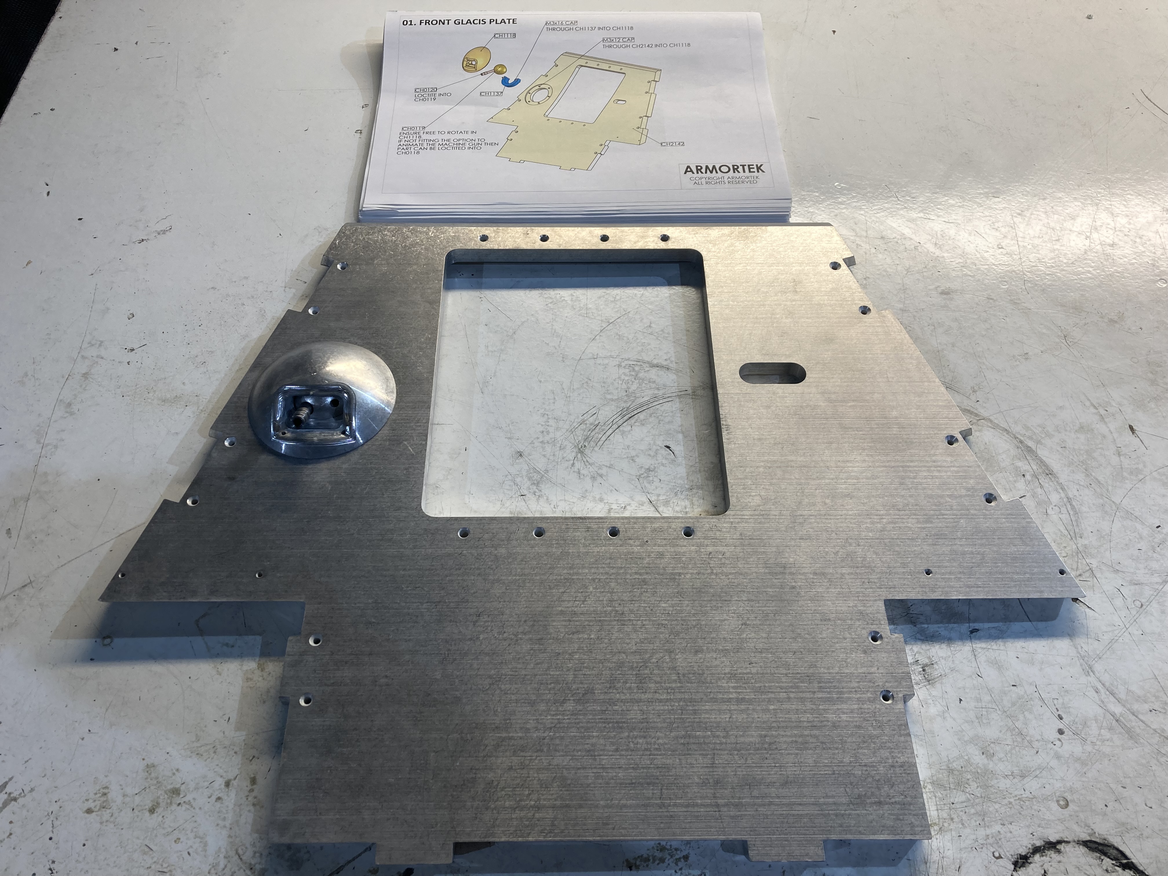

step 1 front glacis plate.

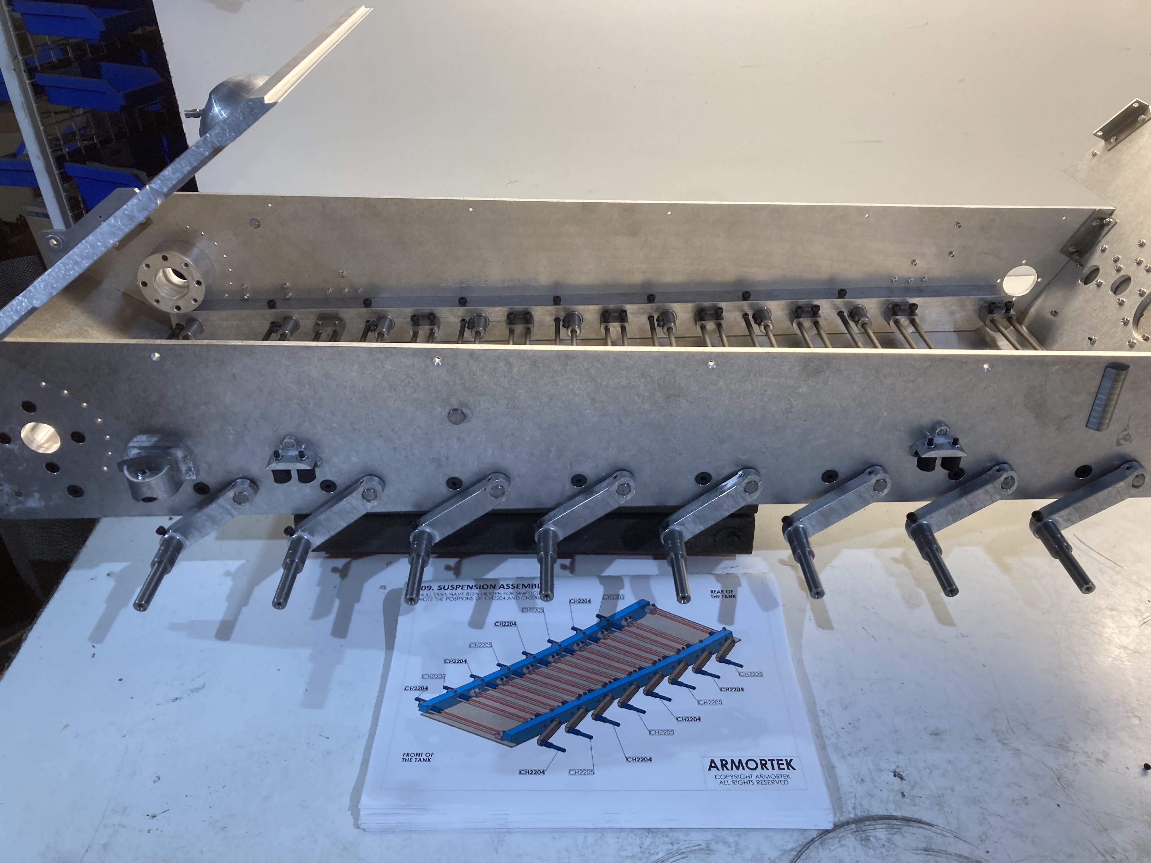

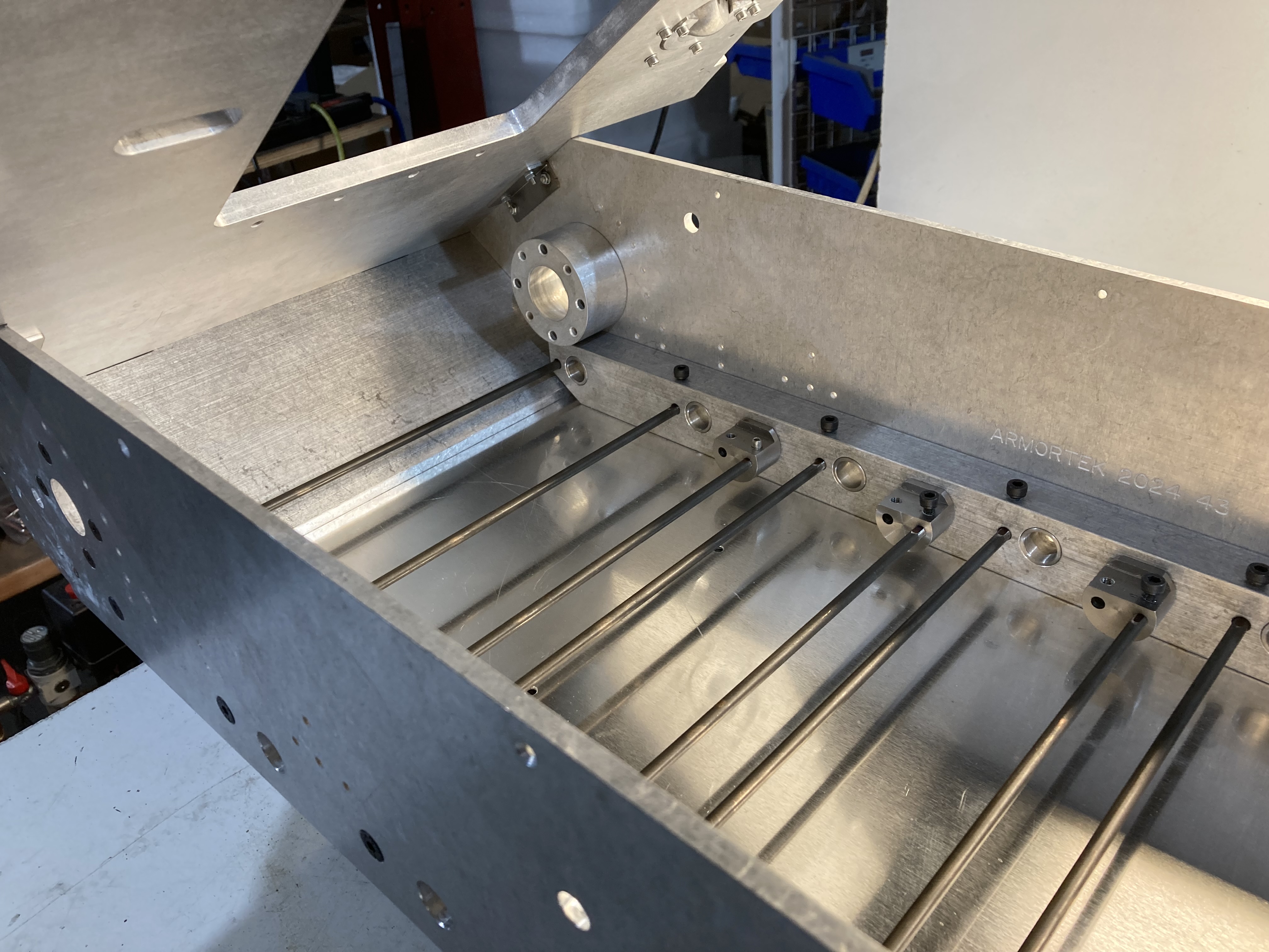

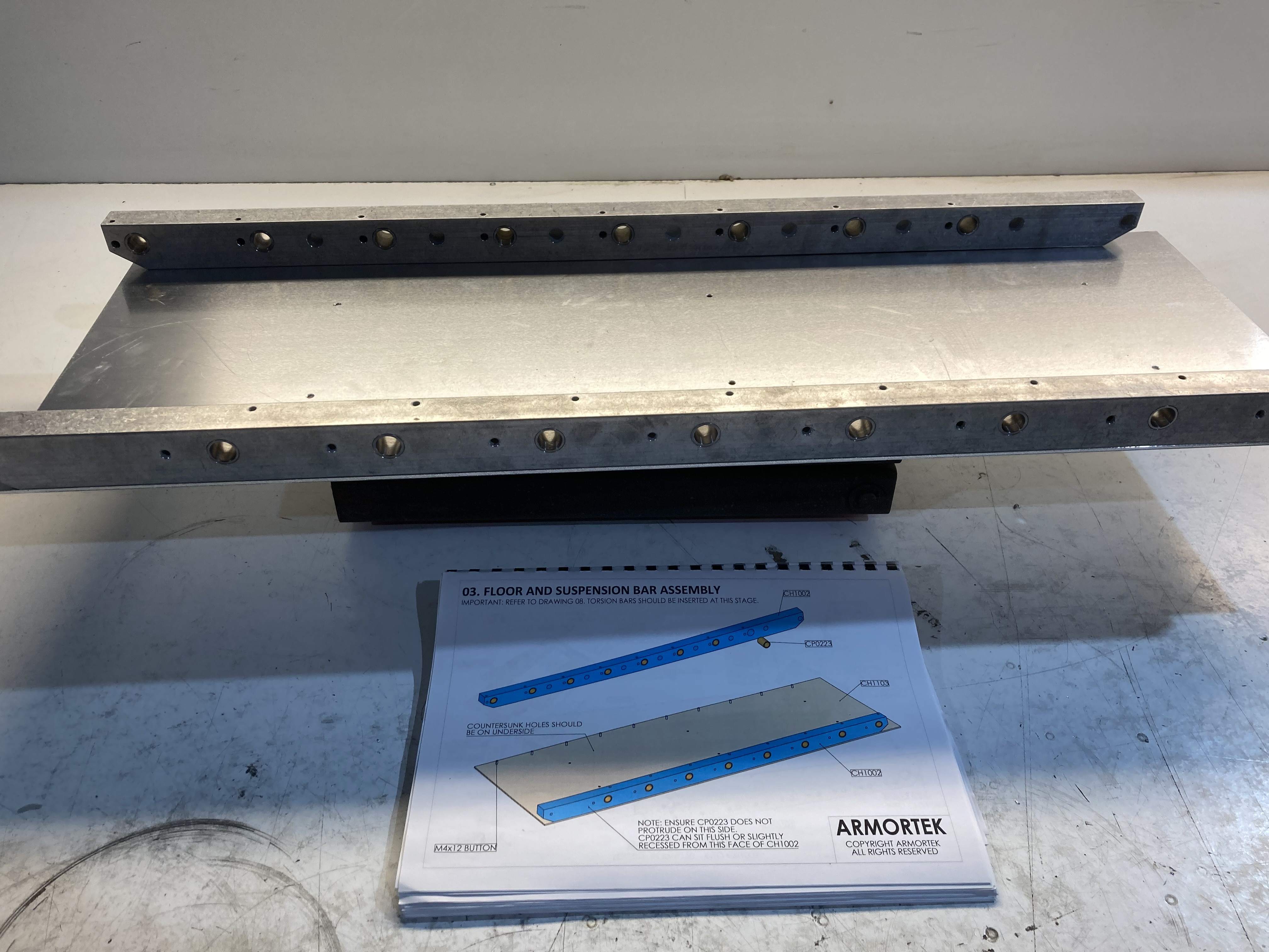

suspension bushes and bars fitted, follow the instructions with adding the torsion bars at this stage.
half of the torsion bars added,
hull sides and front & rear plates fitted.

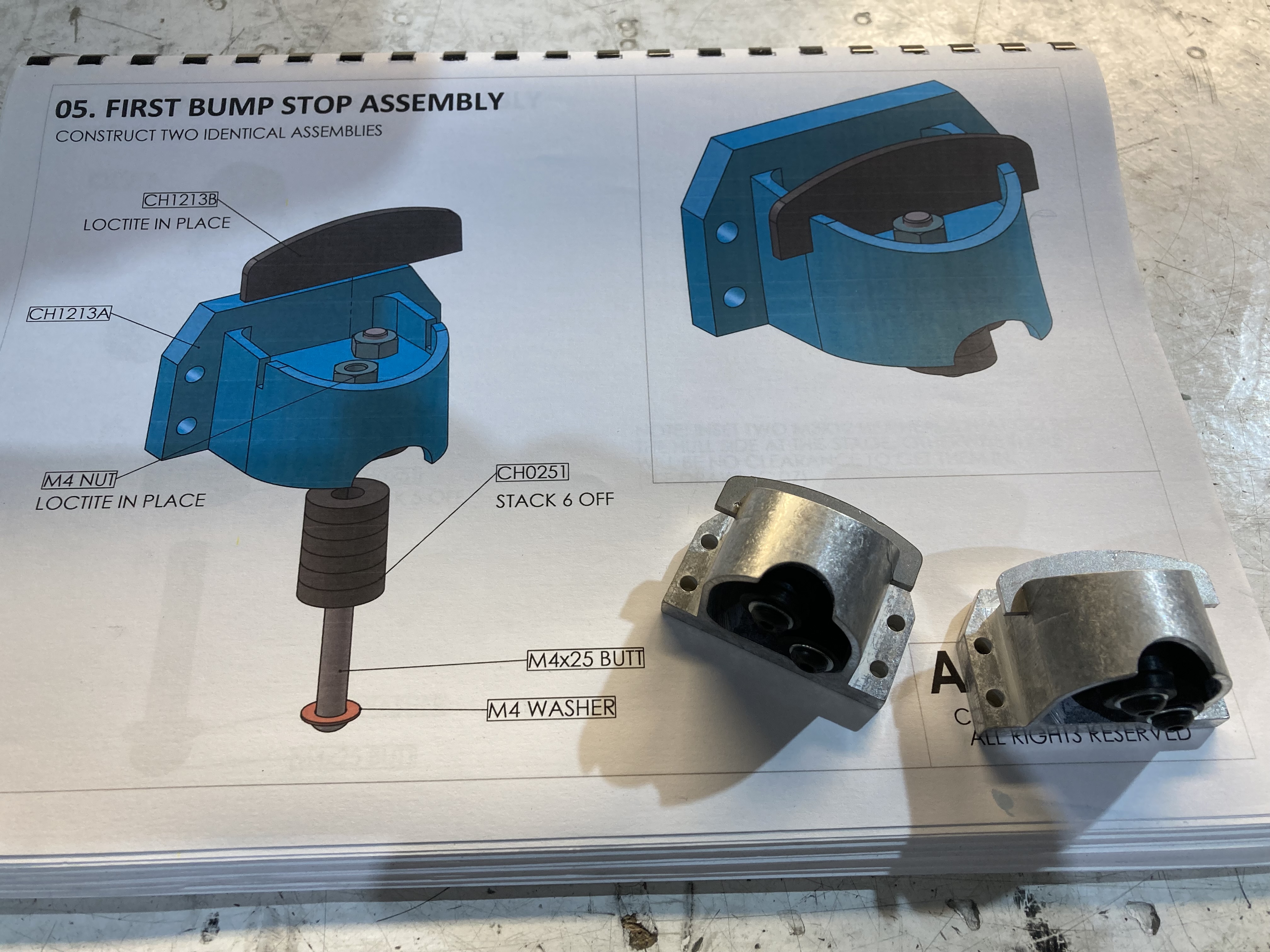

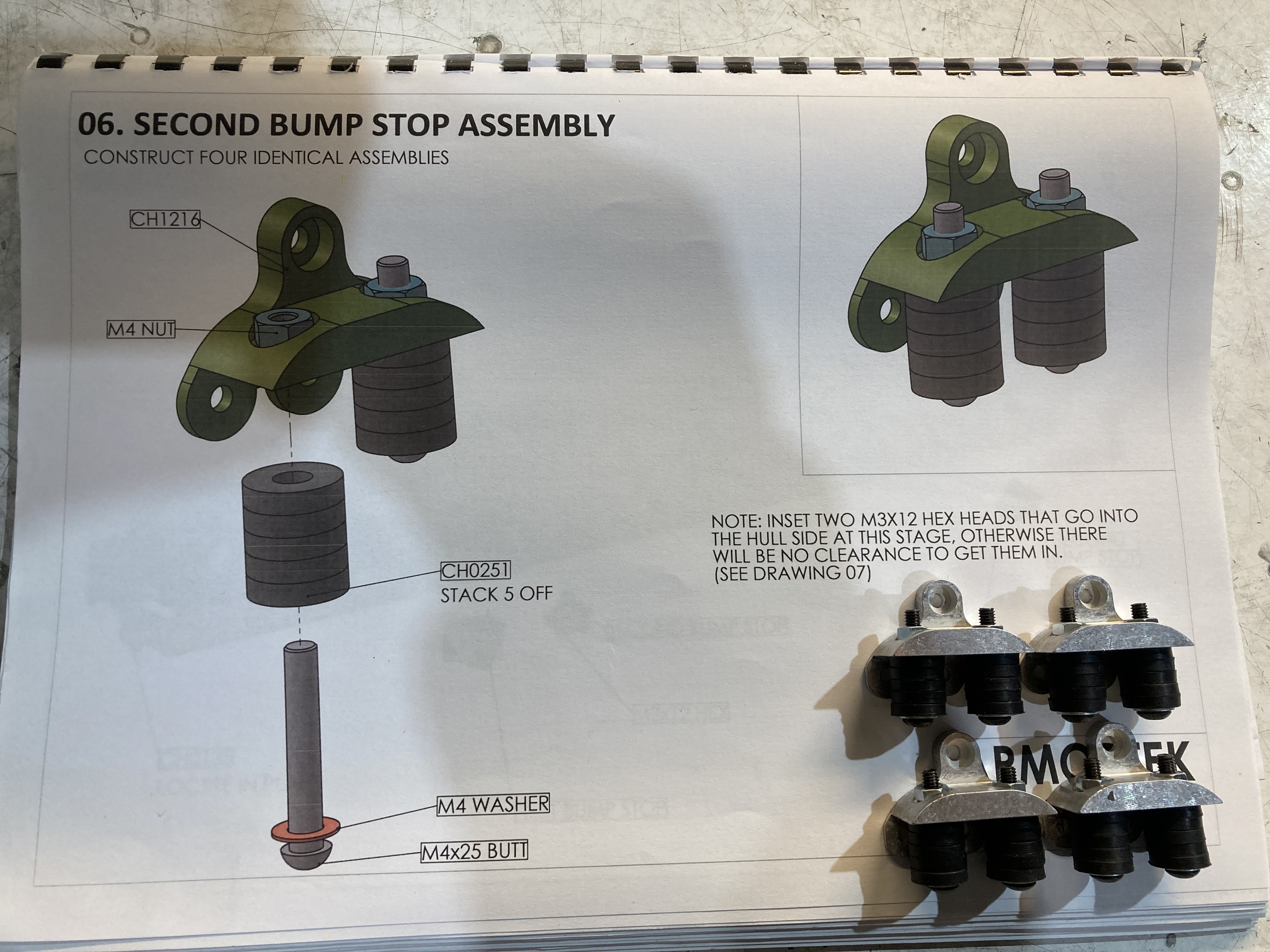

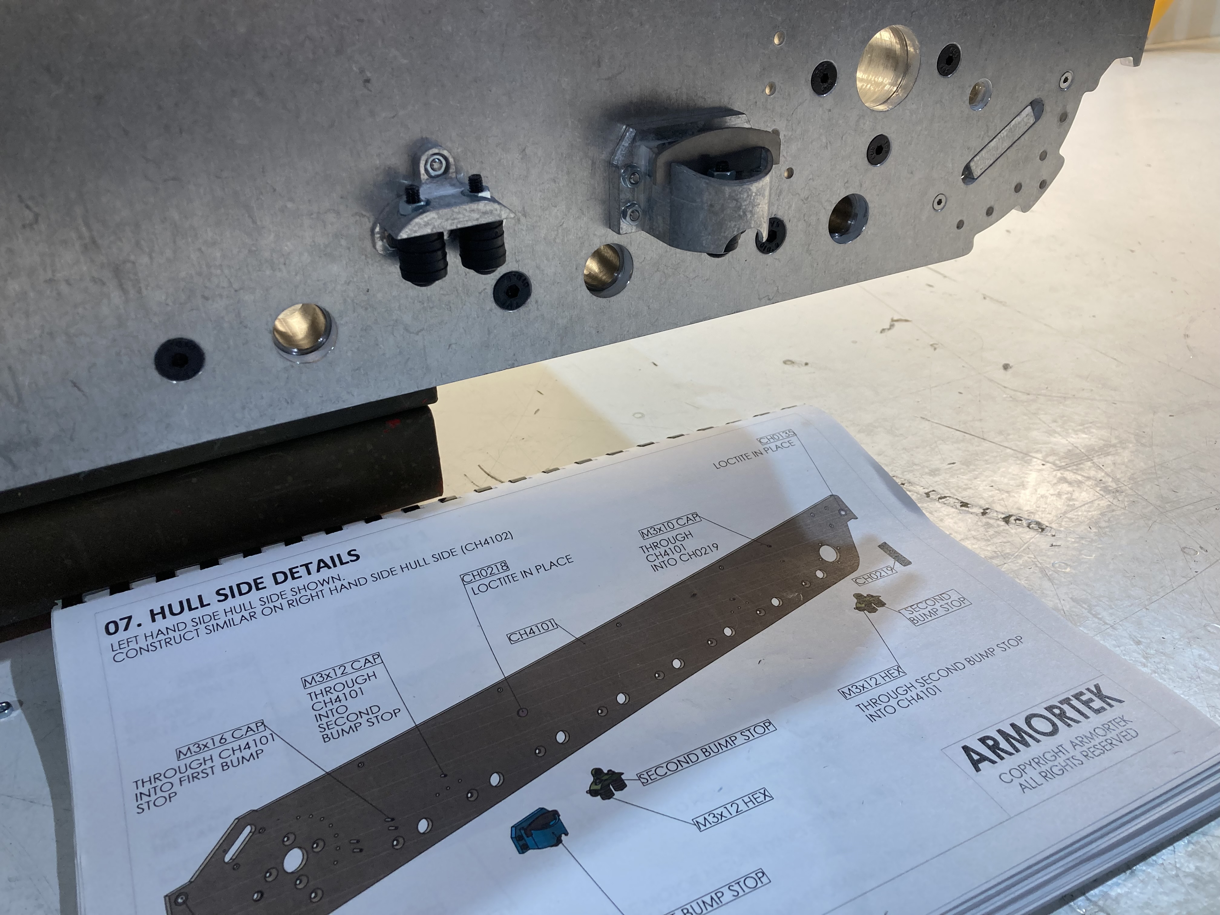

front bump stops
front bump stops
mid and rear bump stops.
r/h side bump stops fitted.

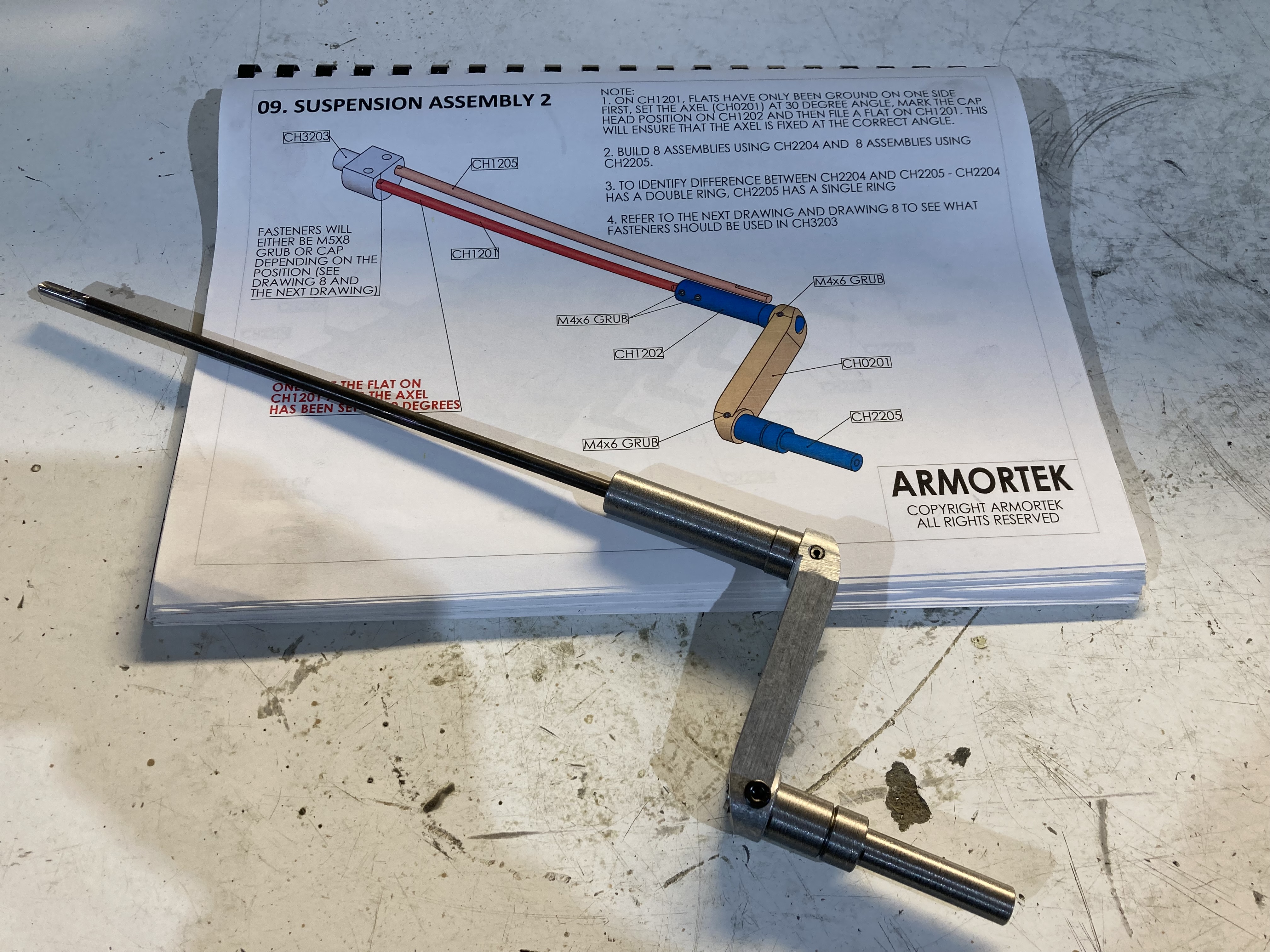

more build steps,

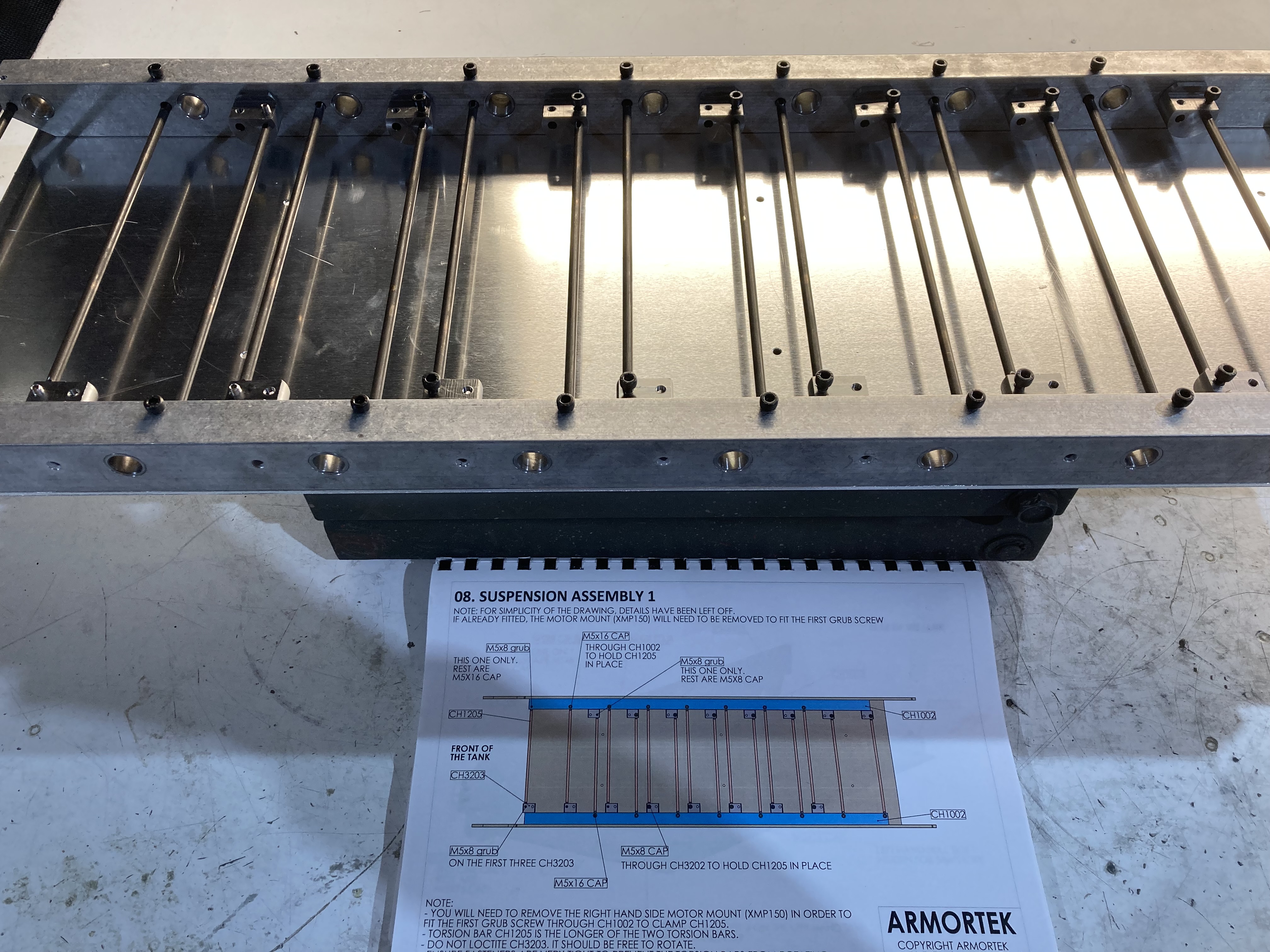

torsion bar and suspension shaft and suspension arm/axle  assembly

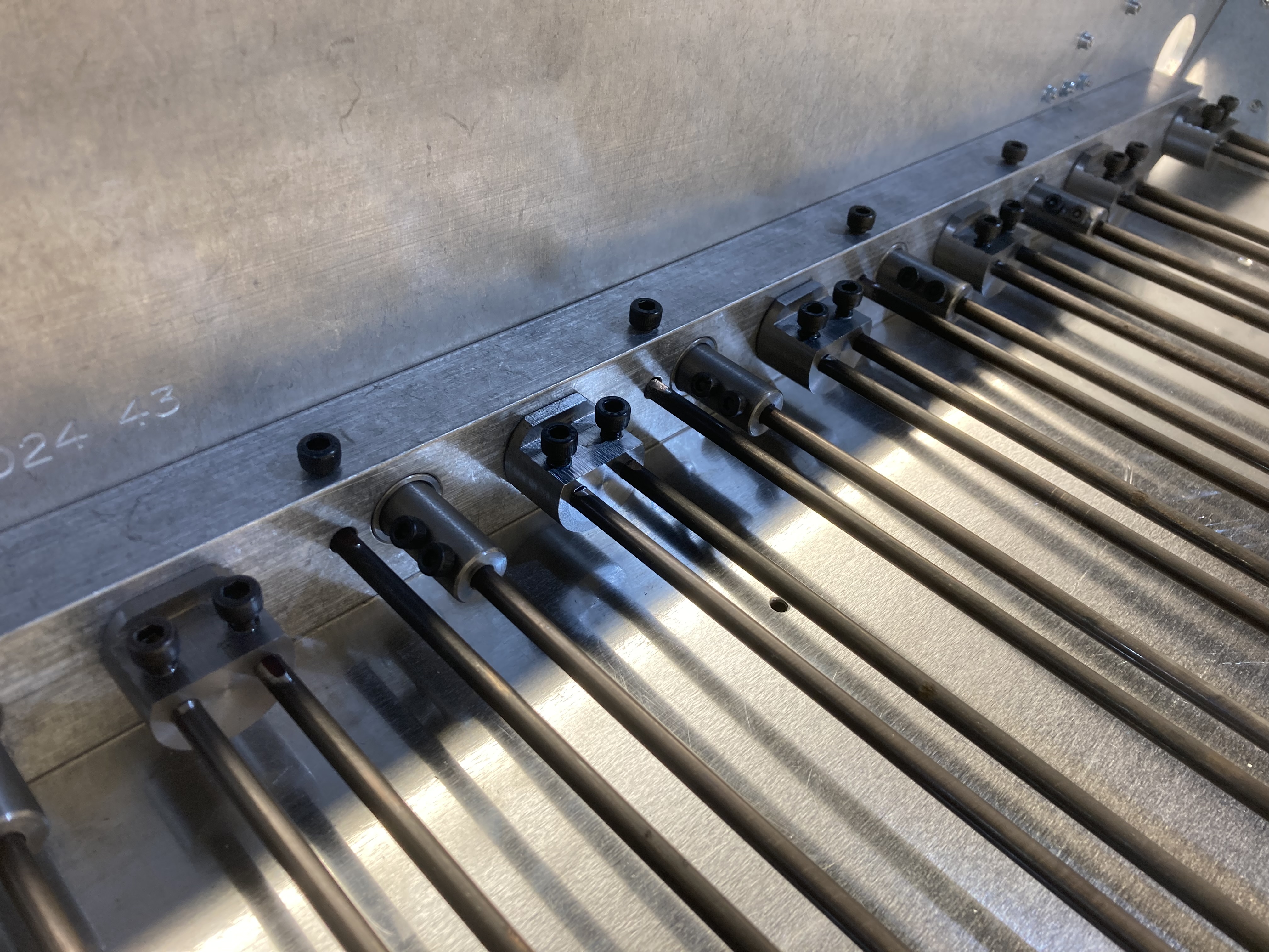

all torsion bars fitted and angles set.
torsion bar fasteners

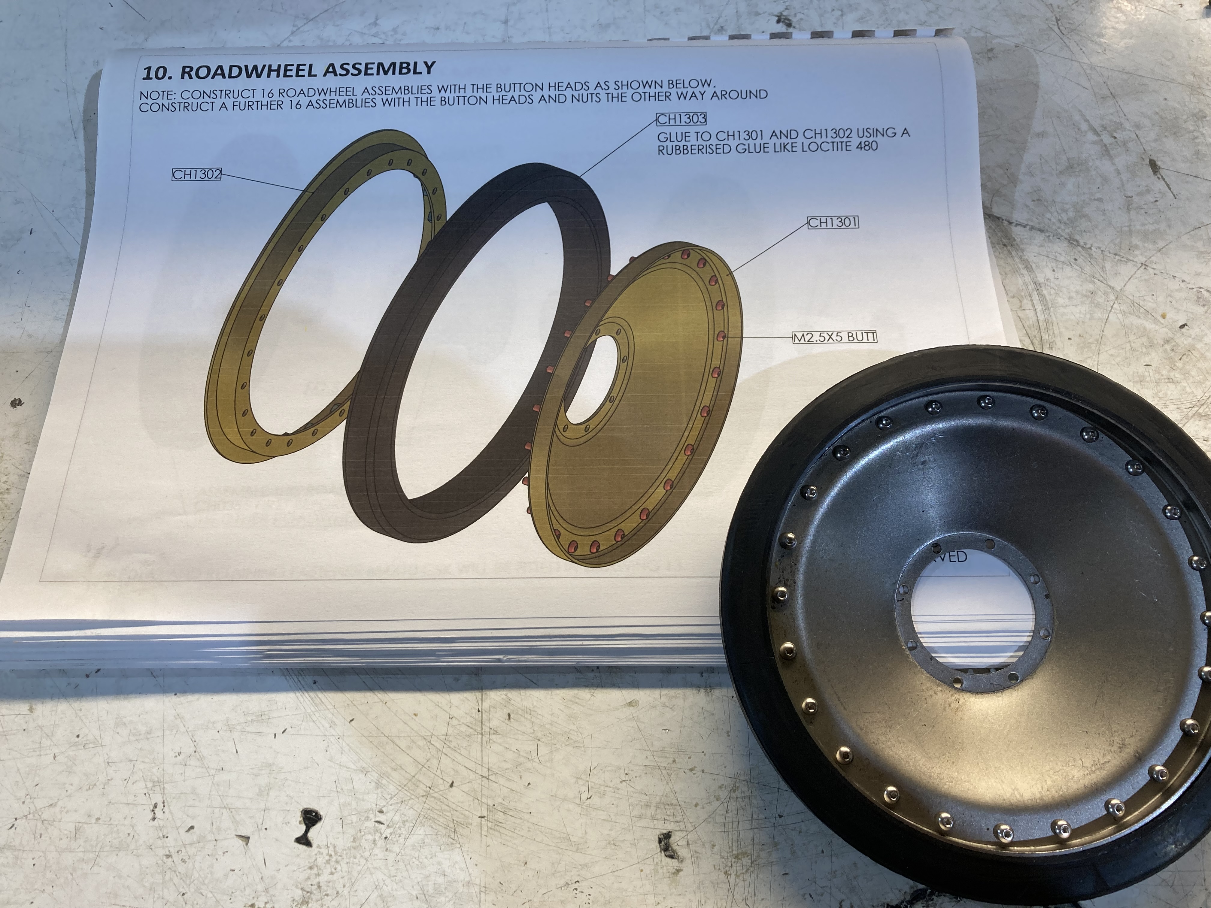

first stage of wheel assembly, all 32 !!!

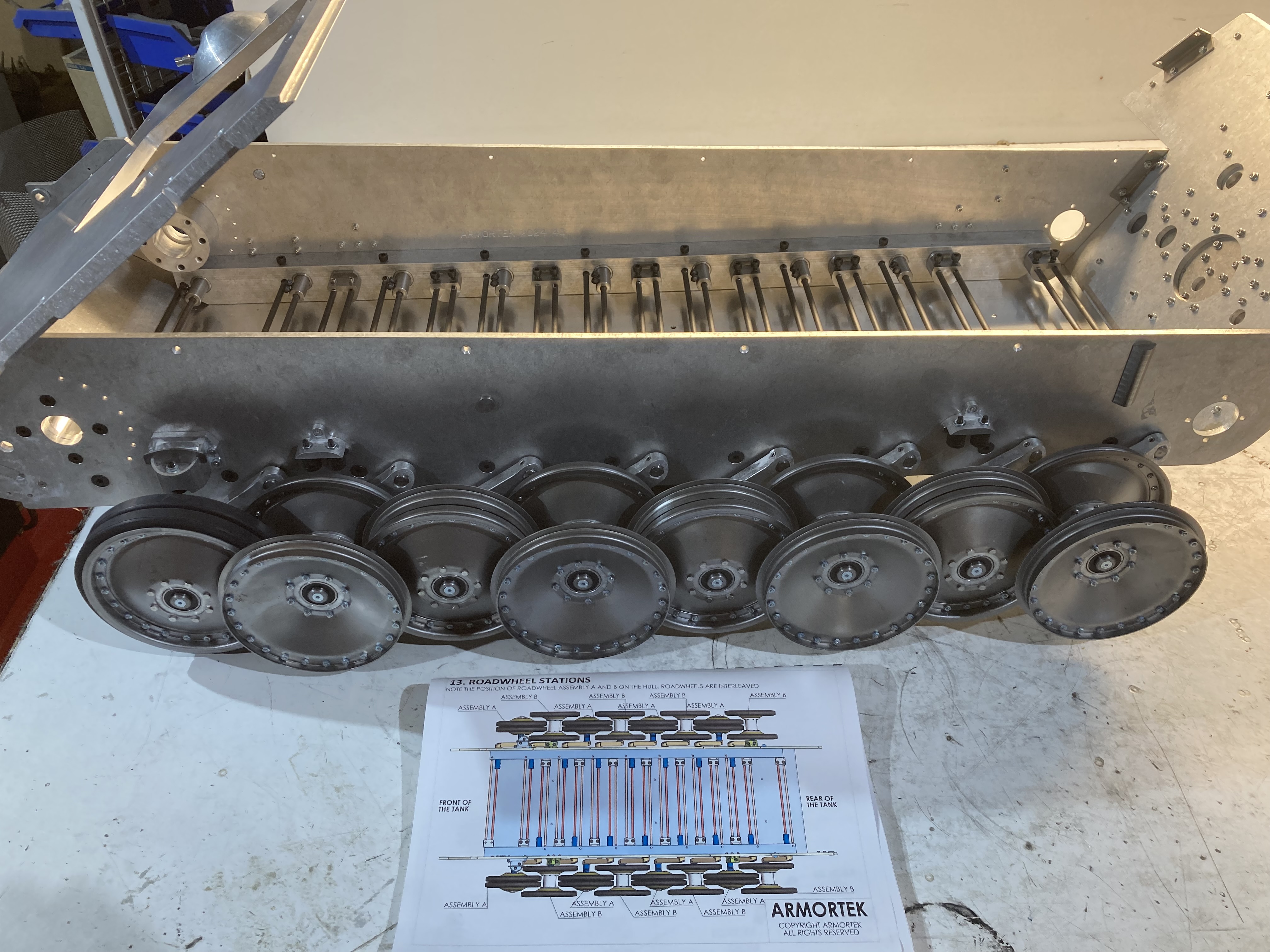

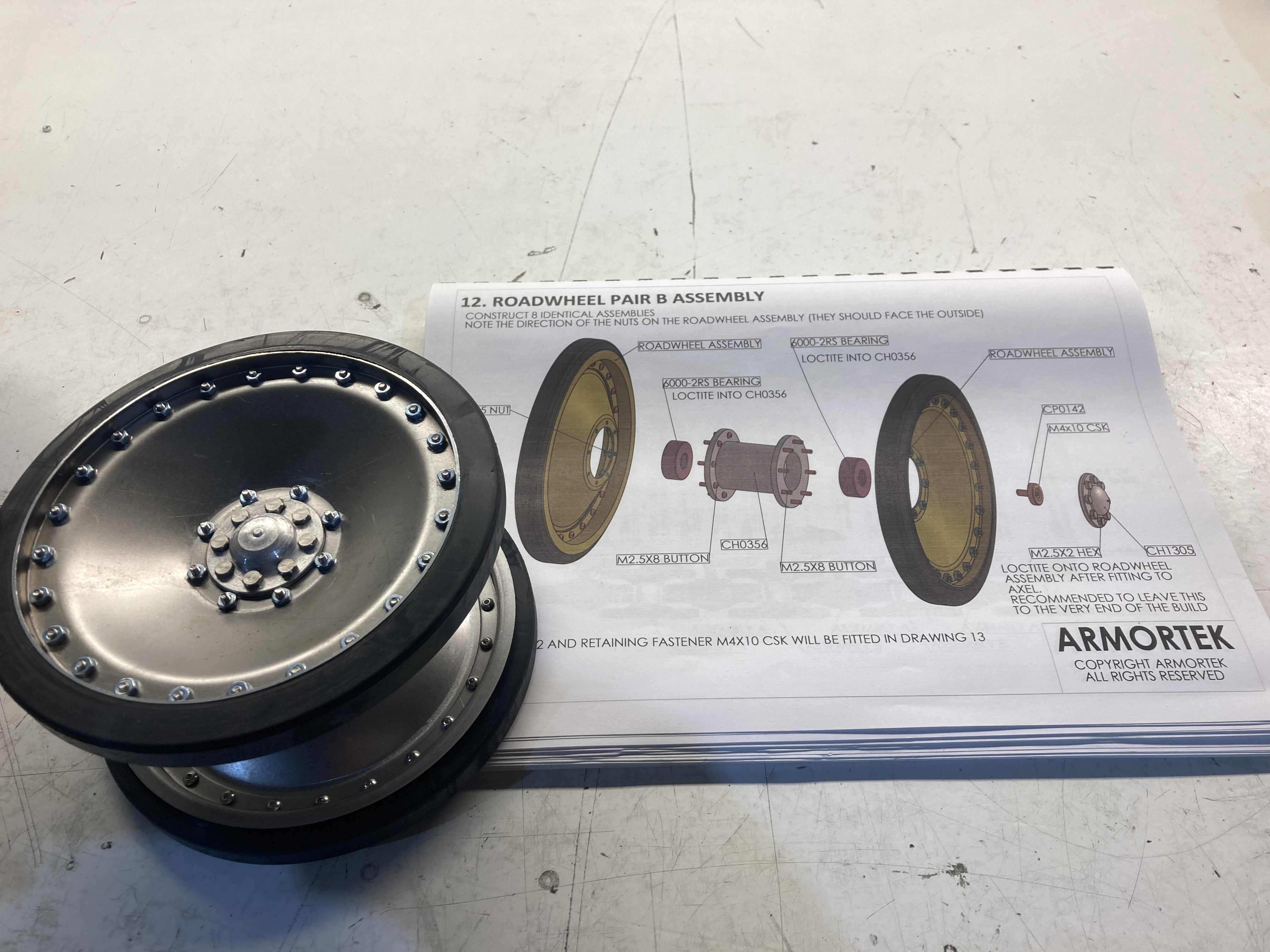

roadwheel b assembly.
roadwheel a & b assemblies fitted.

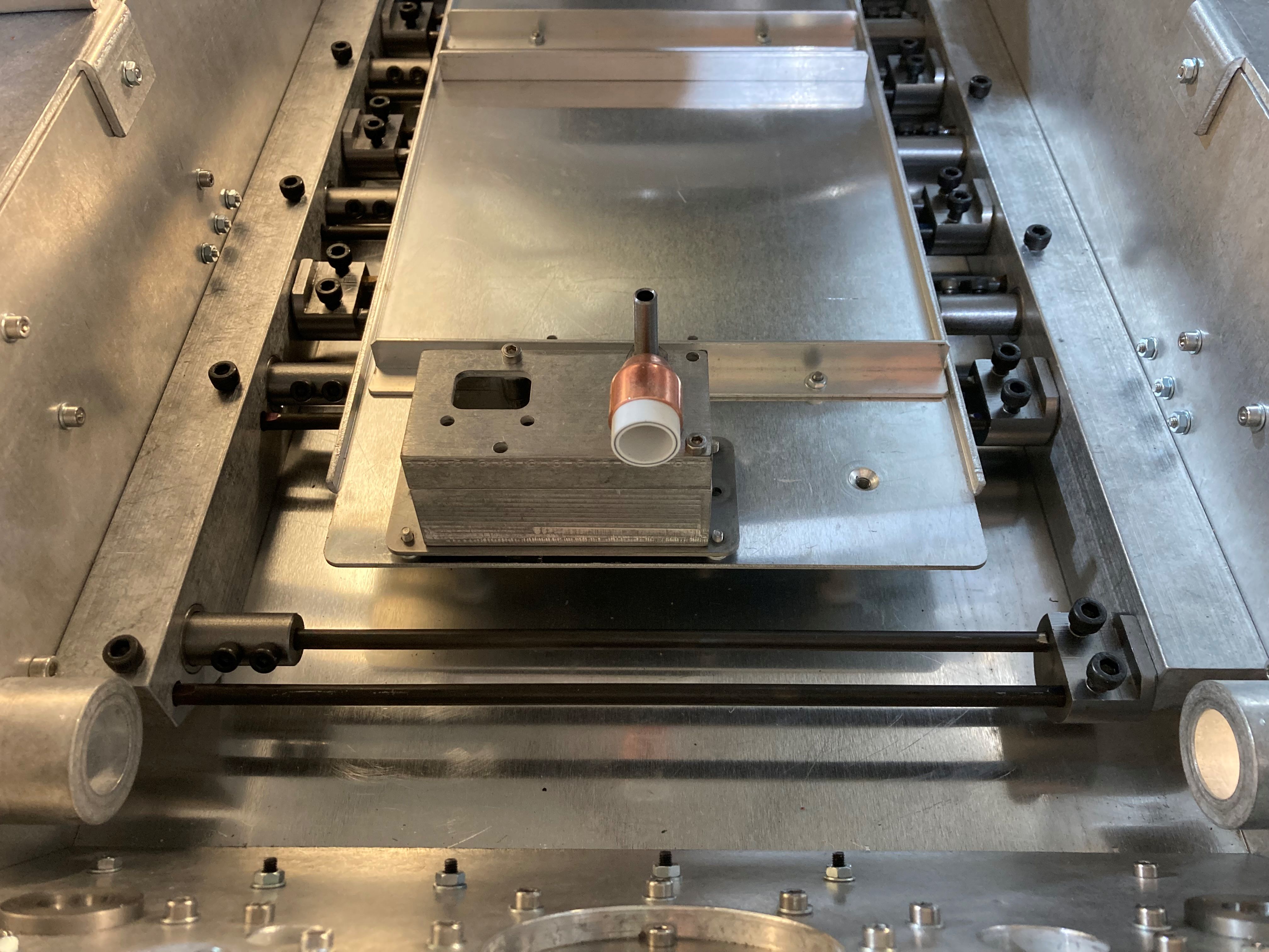

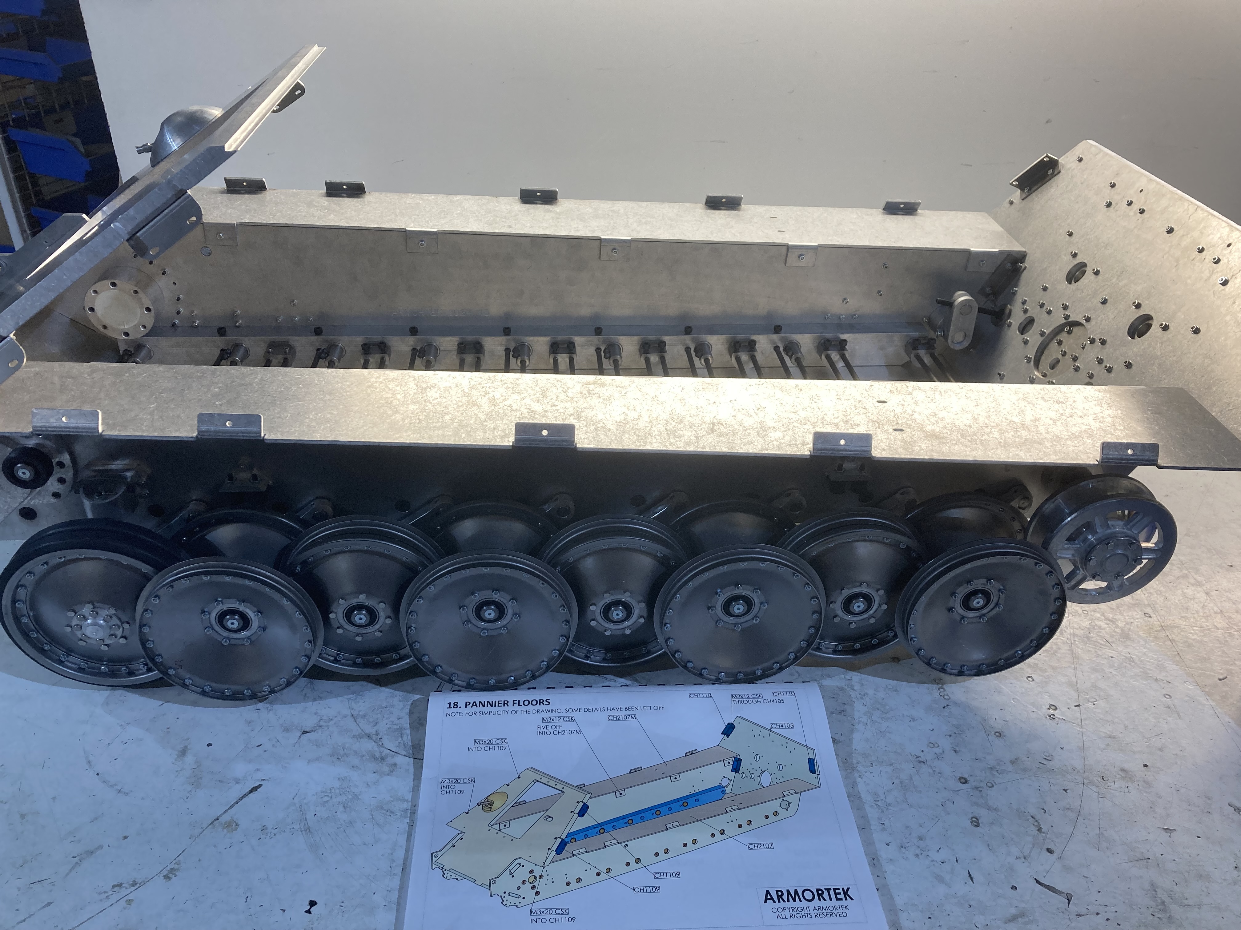

pannier floors fitted

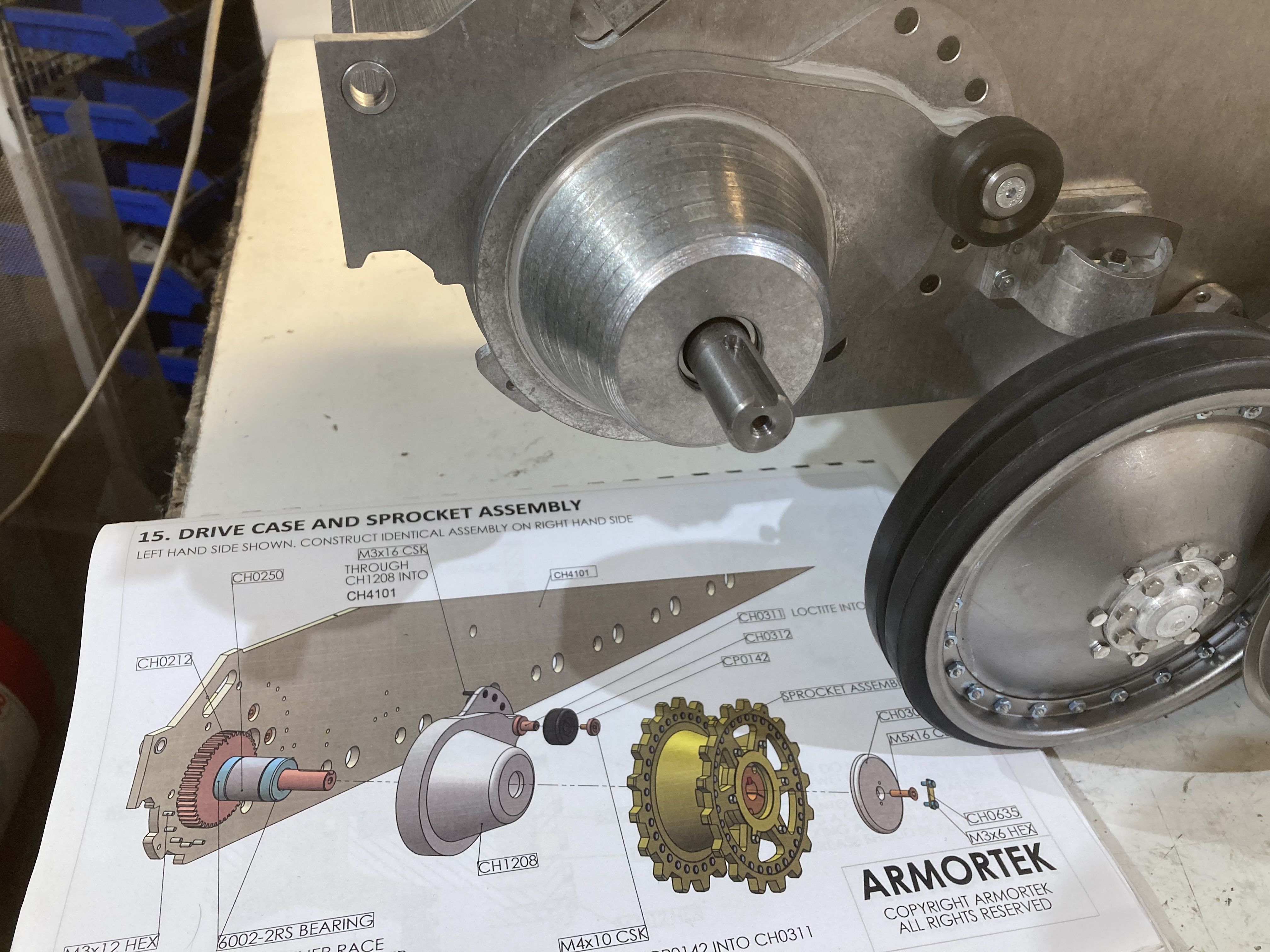

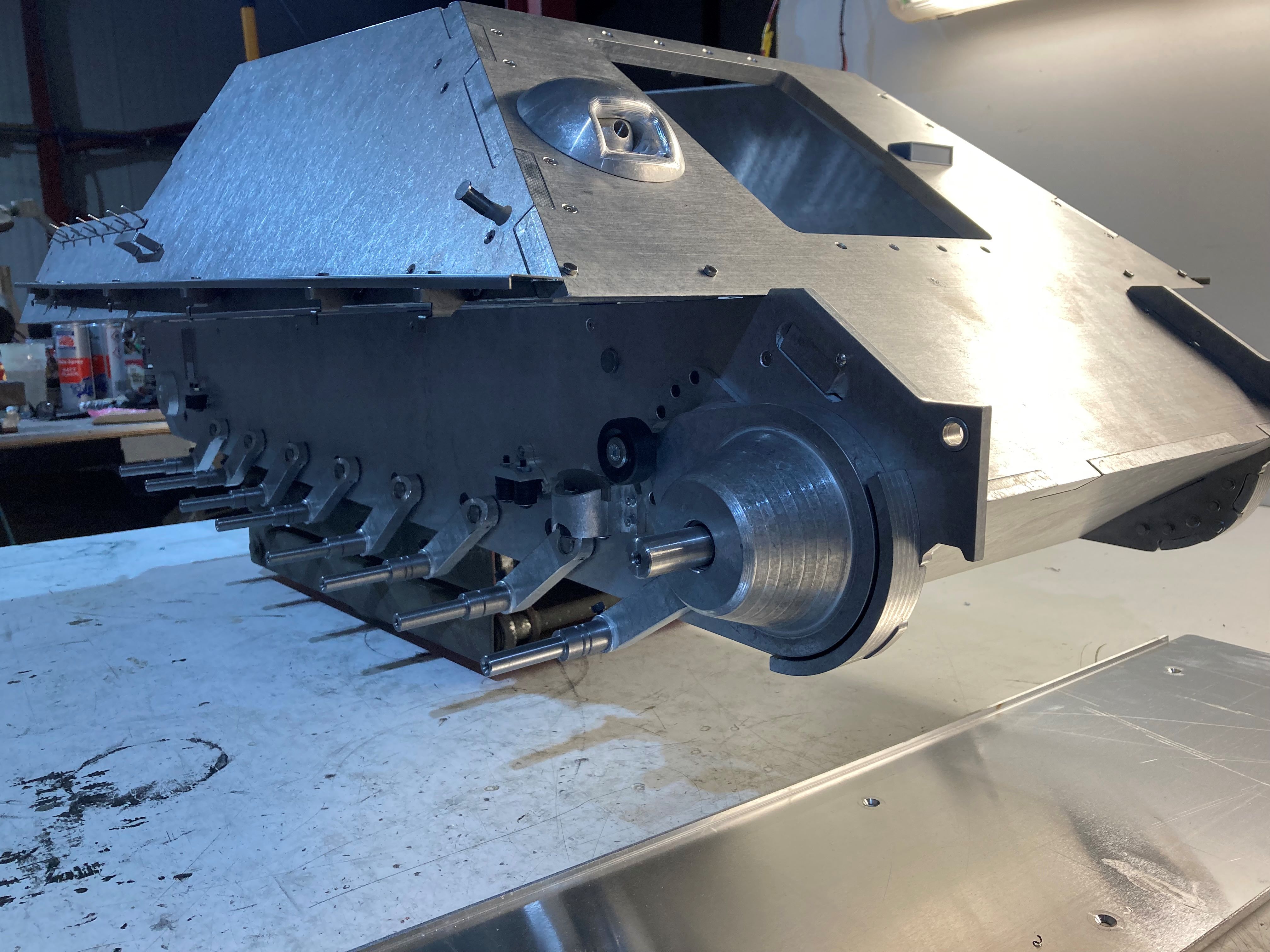

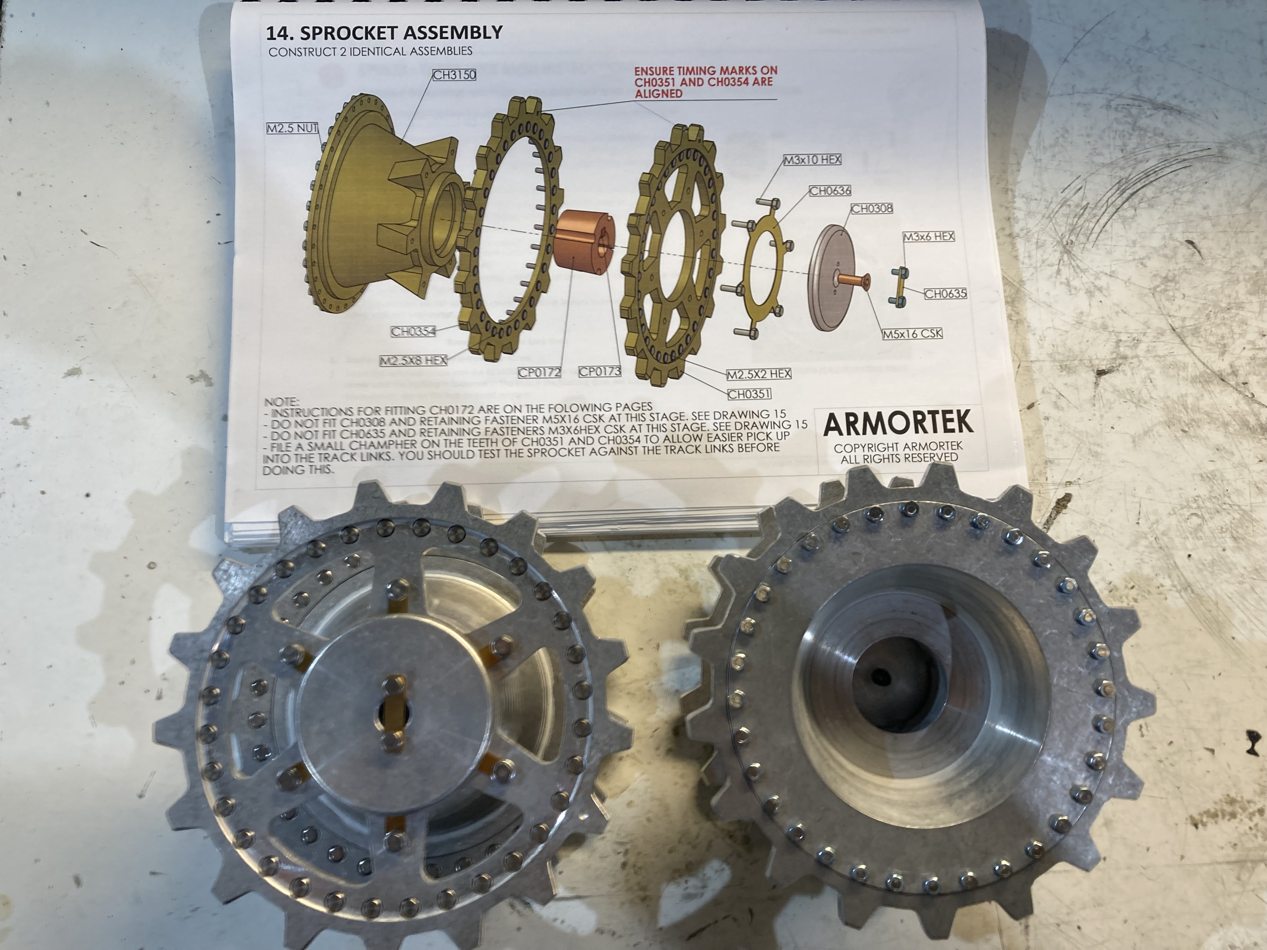

sprockets assembly, note timing marks on sprocket rings
drive case fitted.
drive case fitted.

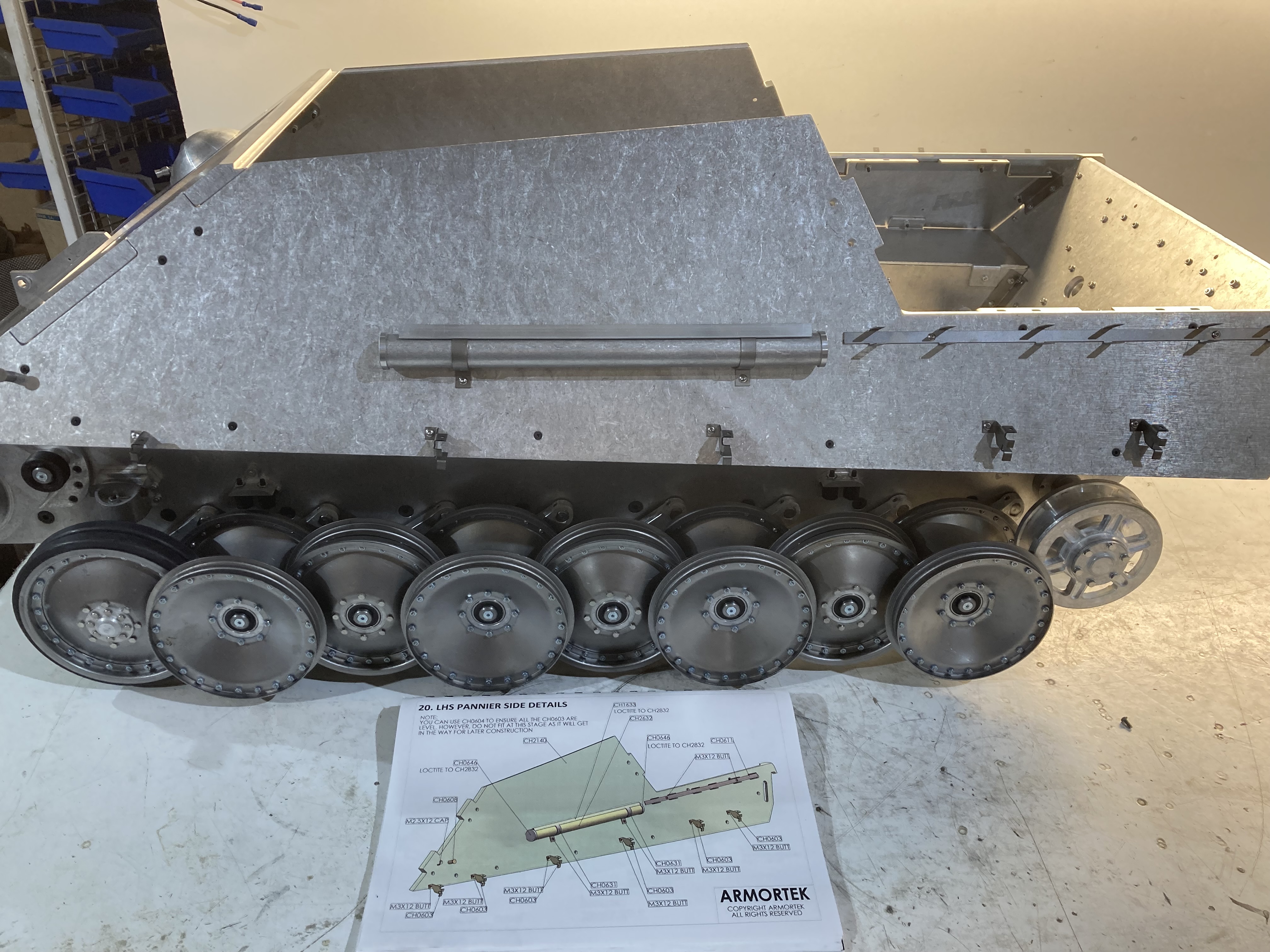

L/h side details added.

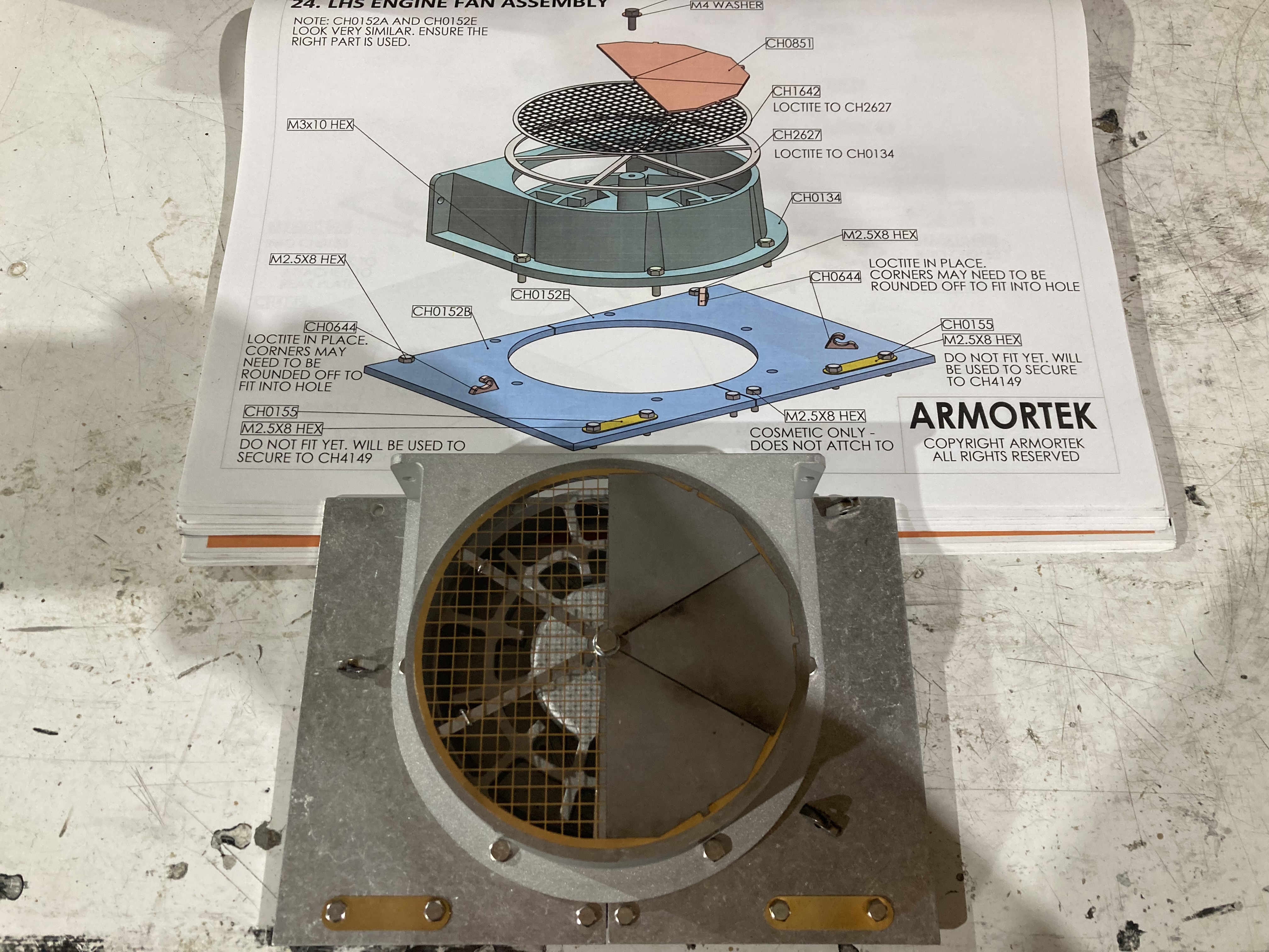

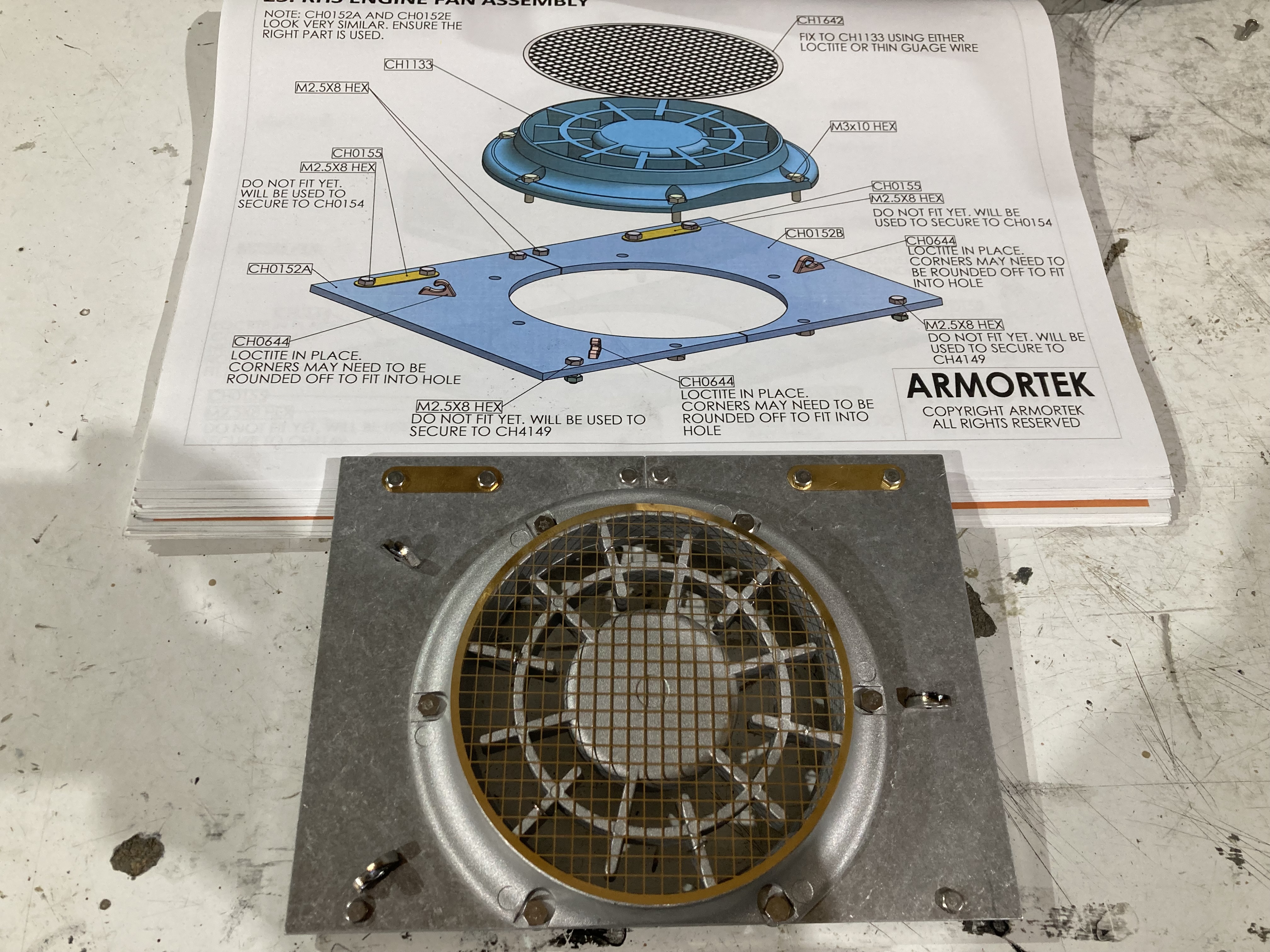

Lhs engine fan assembly
Rhs engine fan assembly

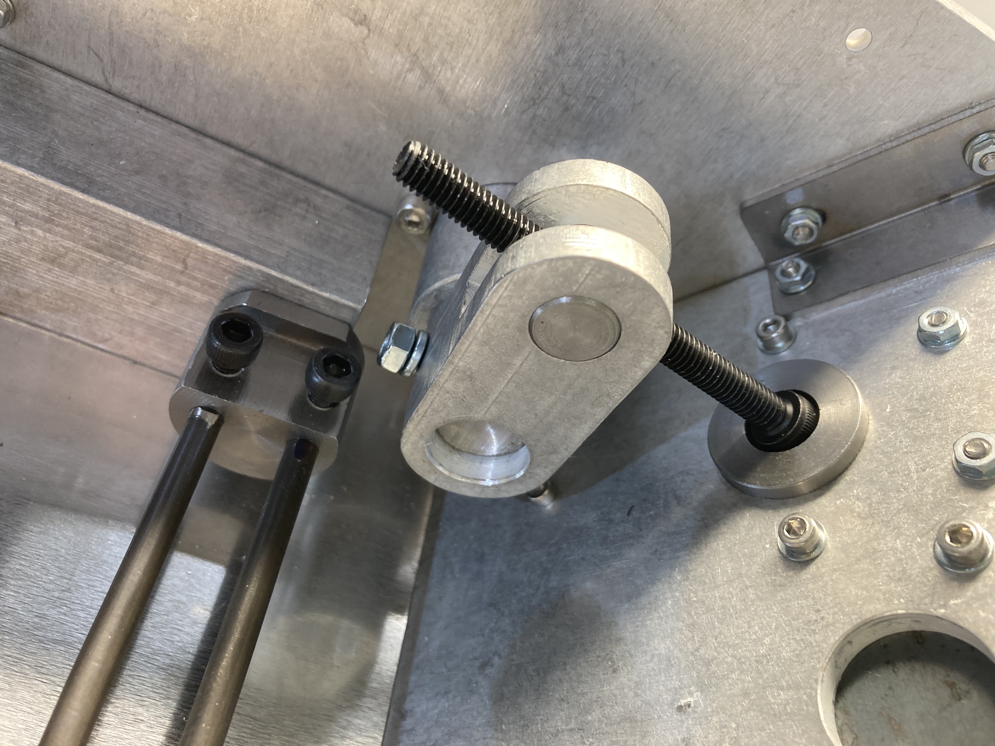

some of the parts that we have sujested to modify,

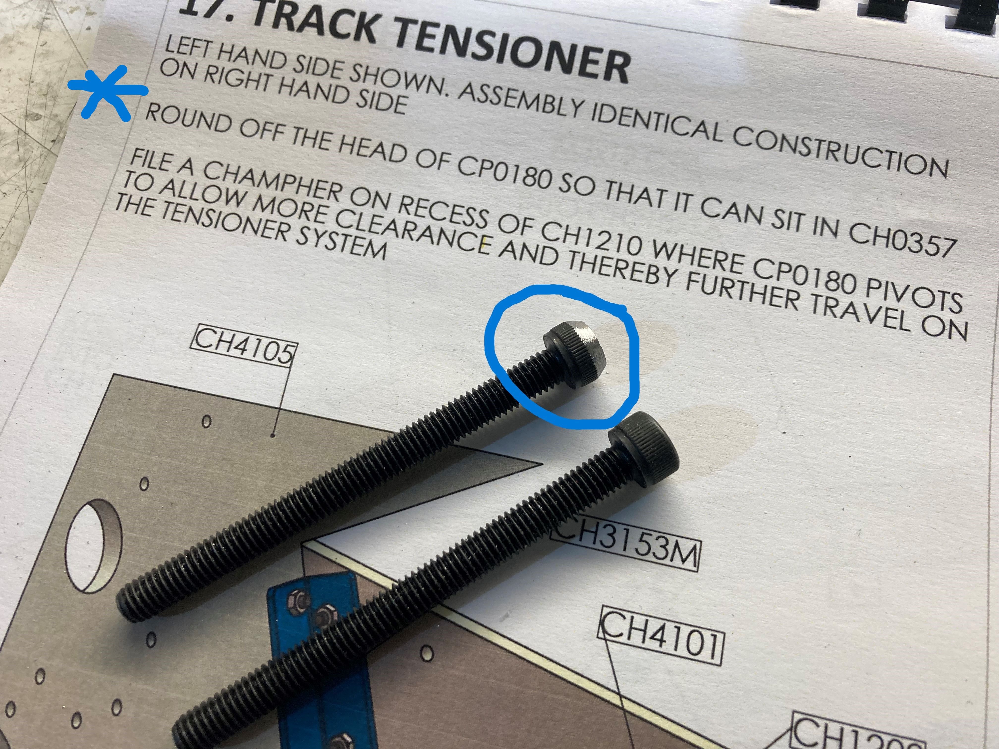

Track tensioner mod.
CP0180 mod.
CP0180 mod.

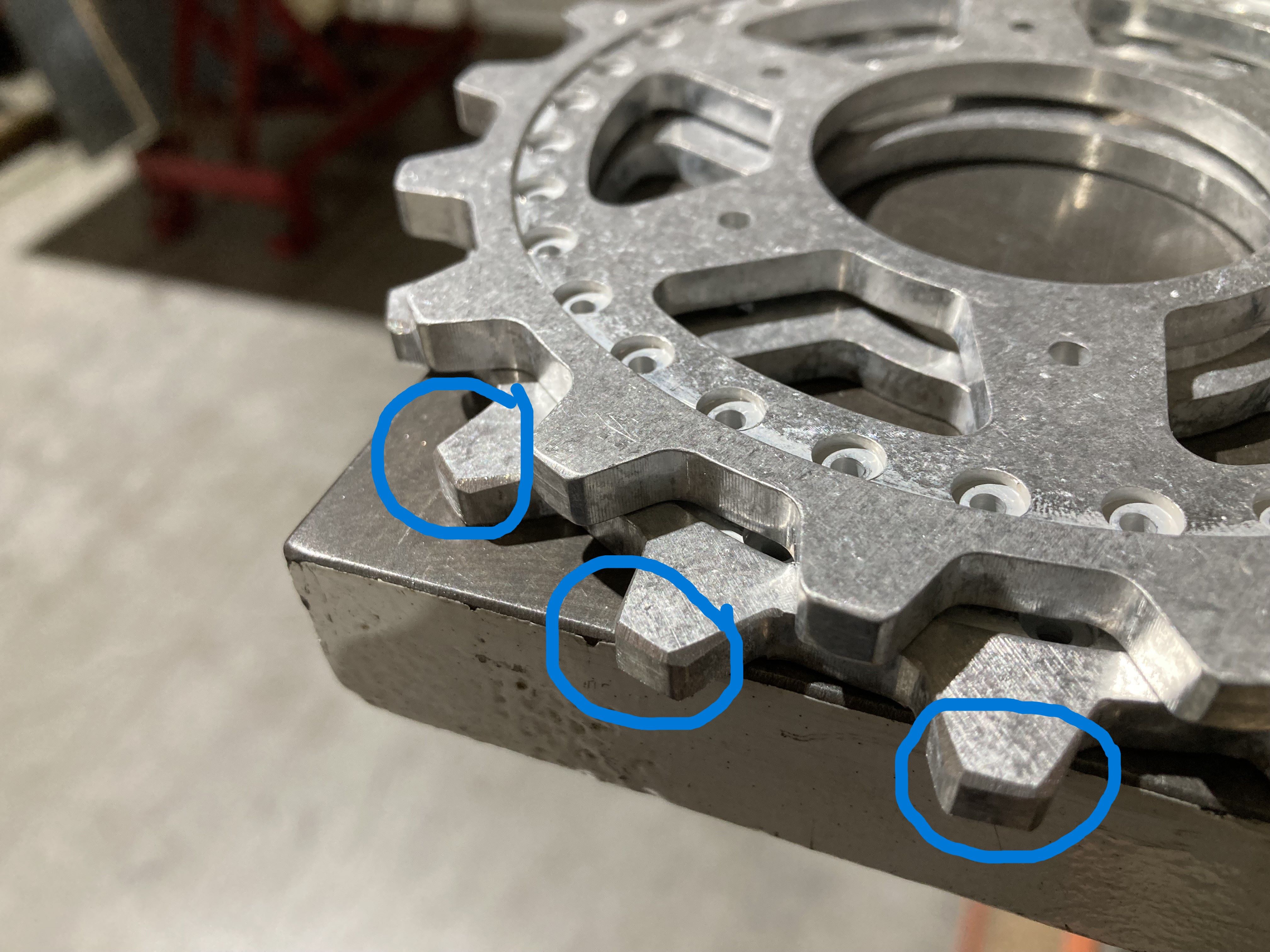

Sprocket ring chamfering. top one unmodified bottom one chamfered, helps with running in with tracks when new.

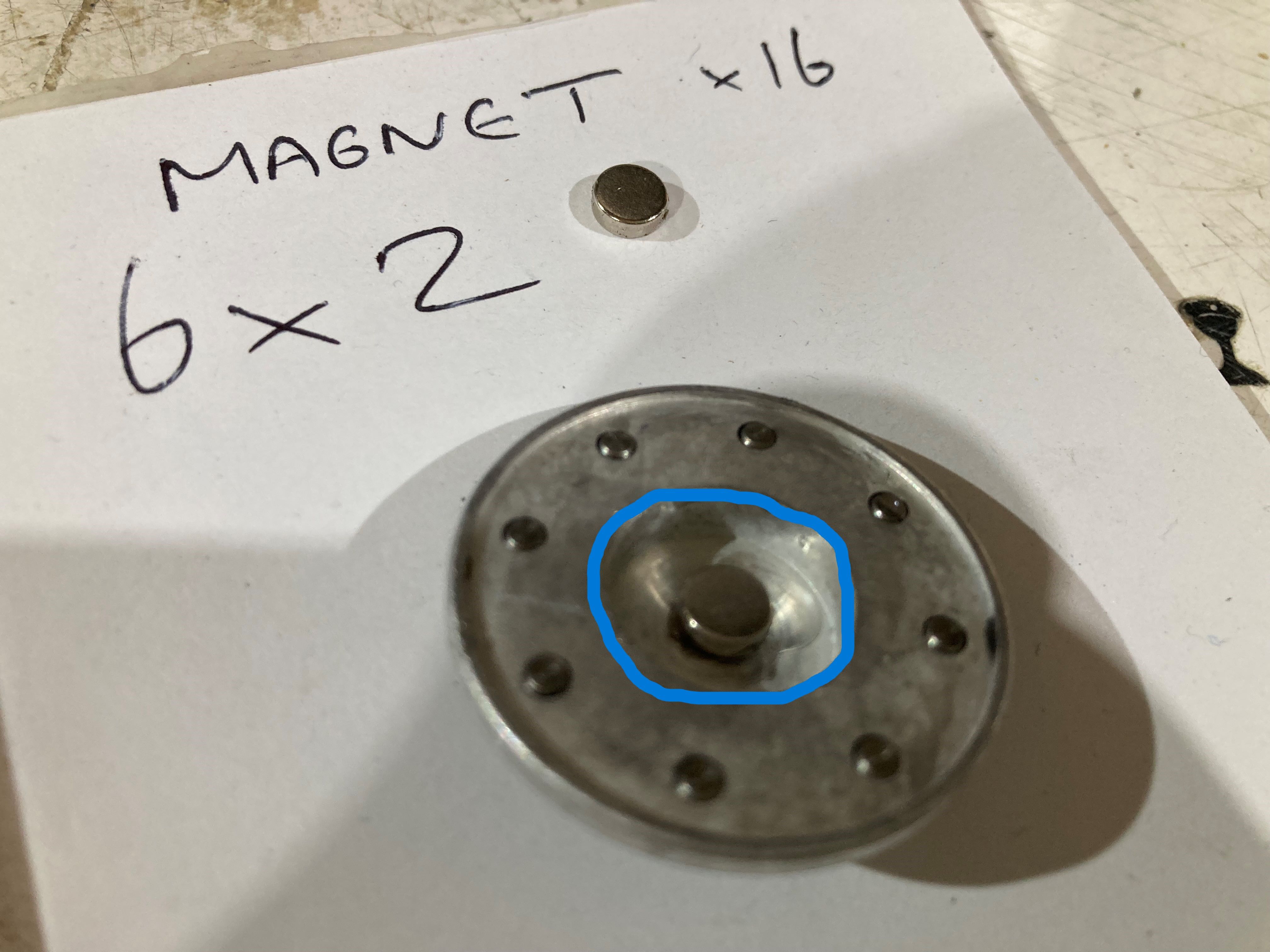

Wheel hub cap magnets, My mod, magnet glued in on inside of hub caps and will attaché to wheel retaining fastener, makes removing hub cap easier,

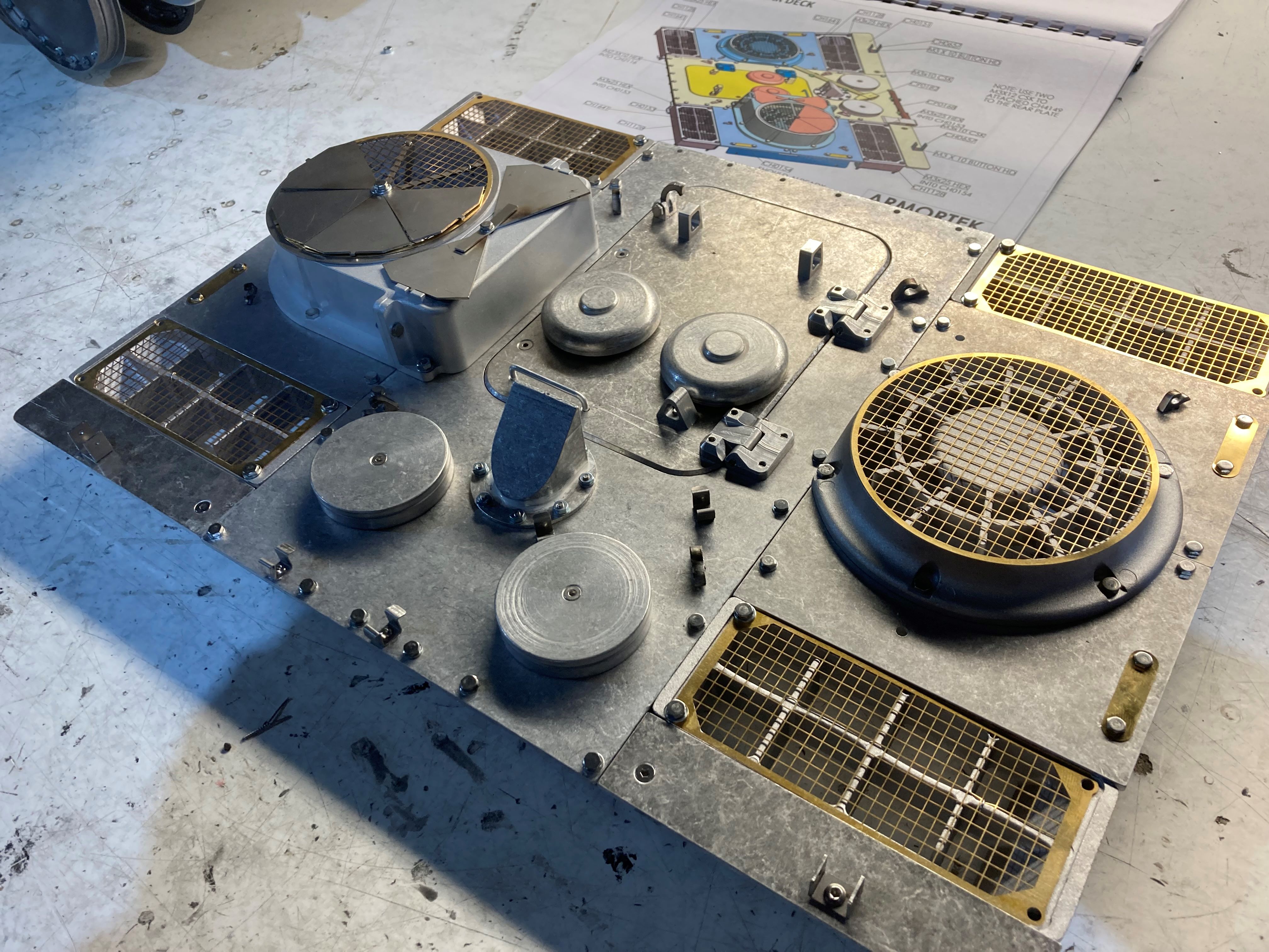

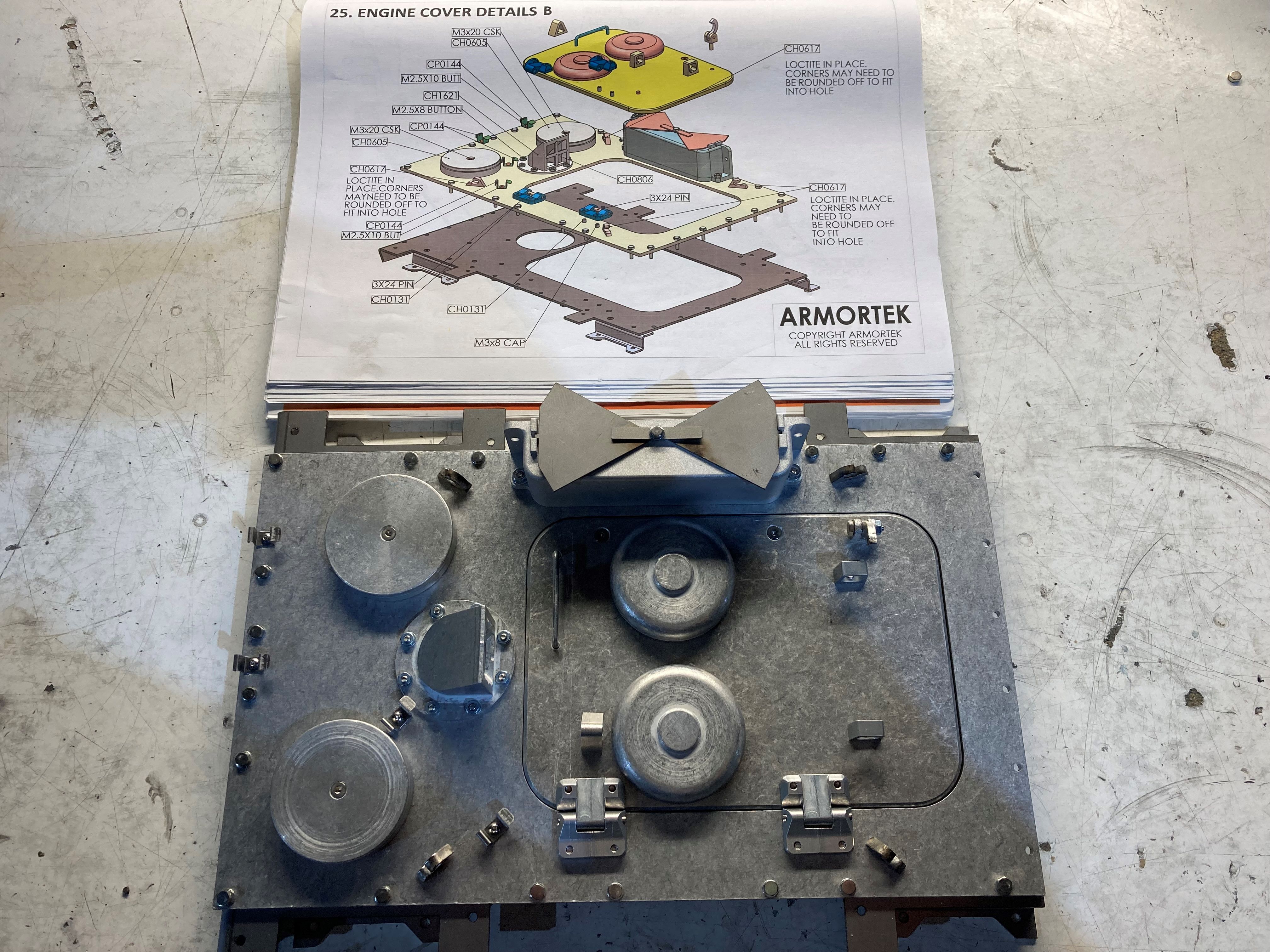

Thank you Robert and glad it may help builders, I started doing this build log as i recently talked to tony from Tonys workshop on youtube, and chatting to him and what questions he gets from his you tube channel viewers, What might stop someone new taking on an armortek kit build, and it was peoples perception on it might be to difficult to build, but these kits now are really easy to build, this jagdpanther really does go together very well and if you follow the manual or follow build logs etc they are a delight to put together,
Engine cover details.
Complete rear deck assembly, just tools to add.

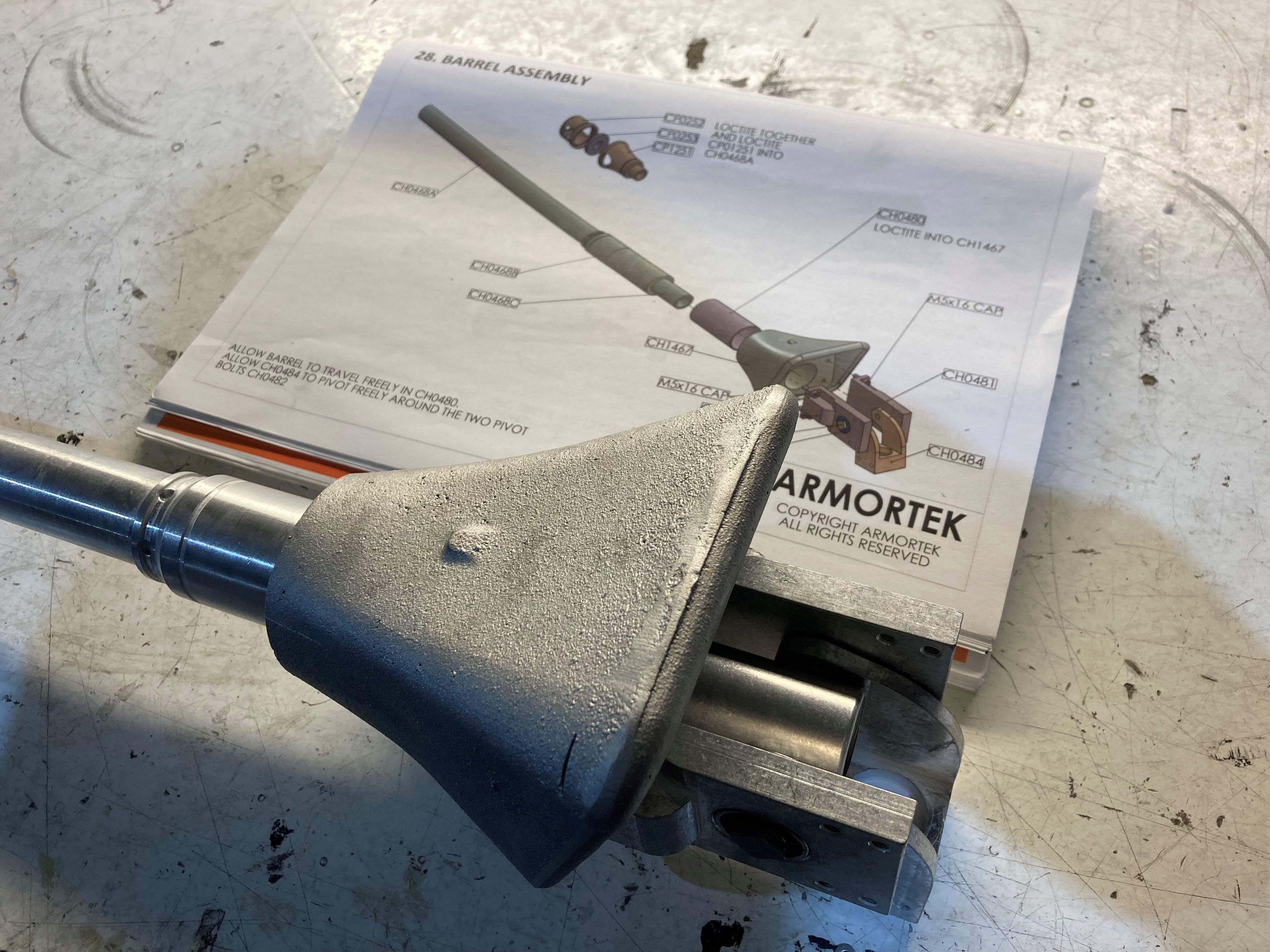

Barrel assembly, Insure barrel is free to slide through bush CH0480, bit of emery cloth will do, This will make the recoil motors job easier.

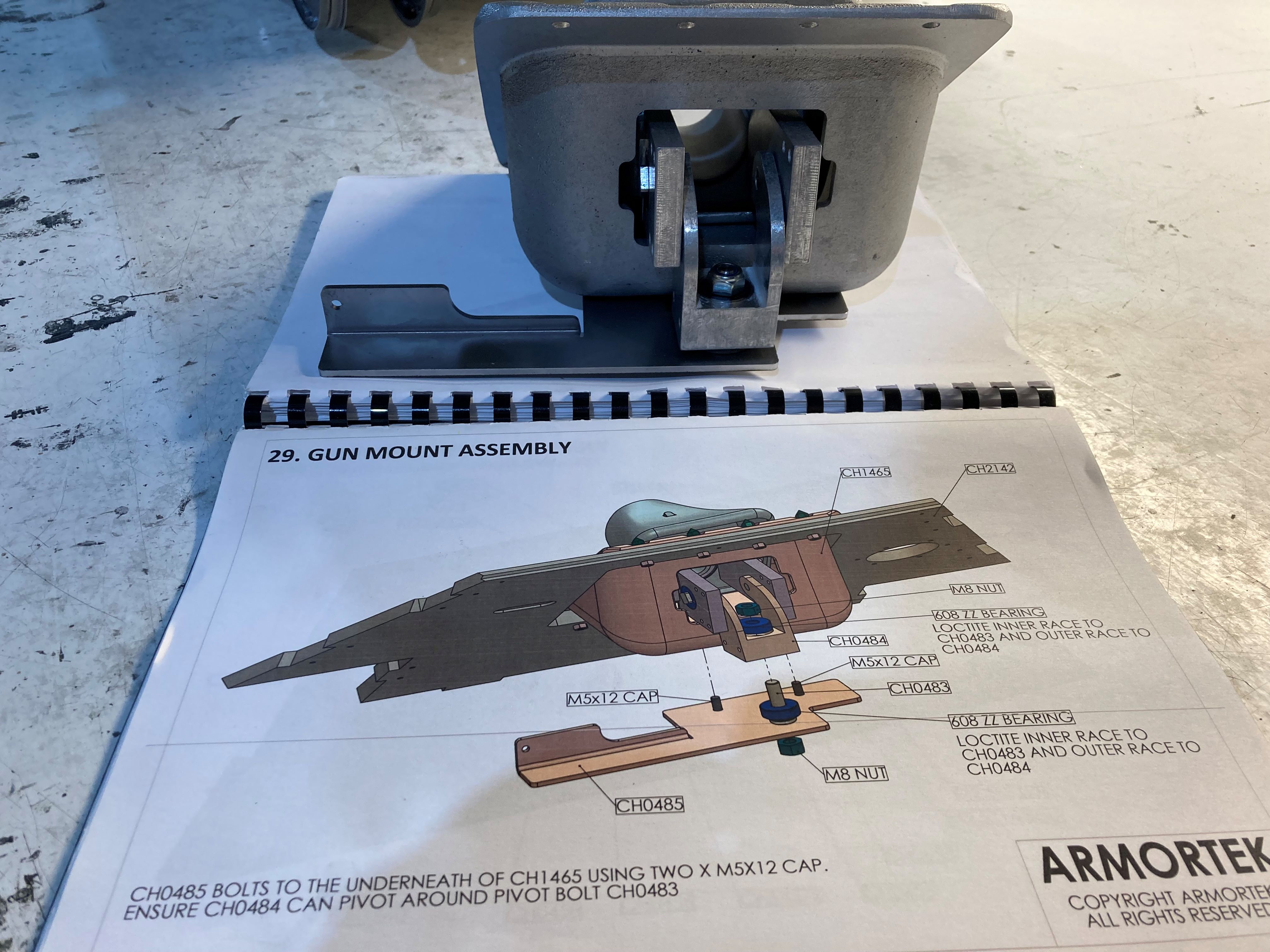

Gun mount assembly, CH0483 has been updated from this drawing, New part takes away the bottom bearing, This elevates some of the movement in the assembly,

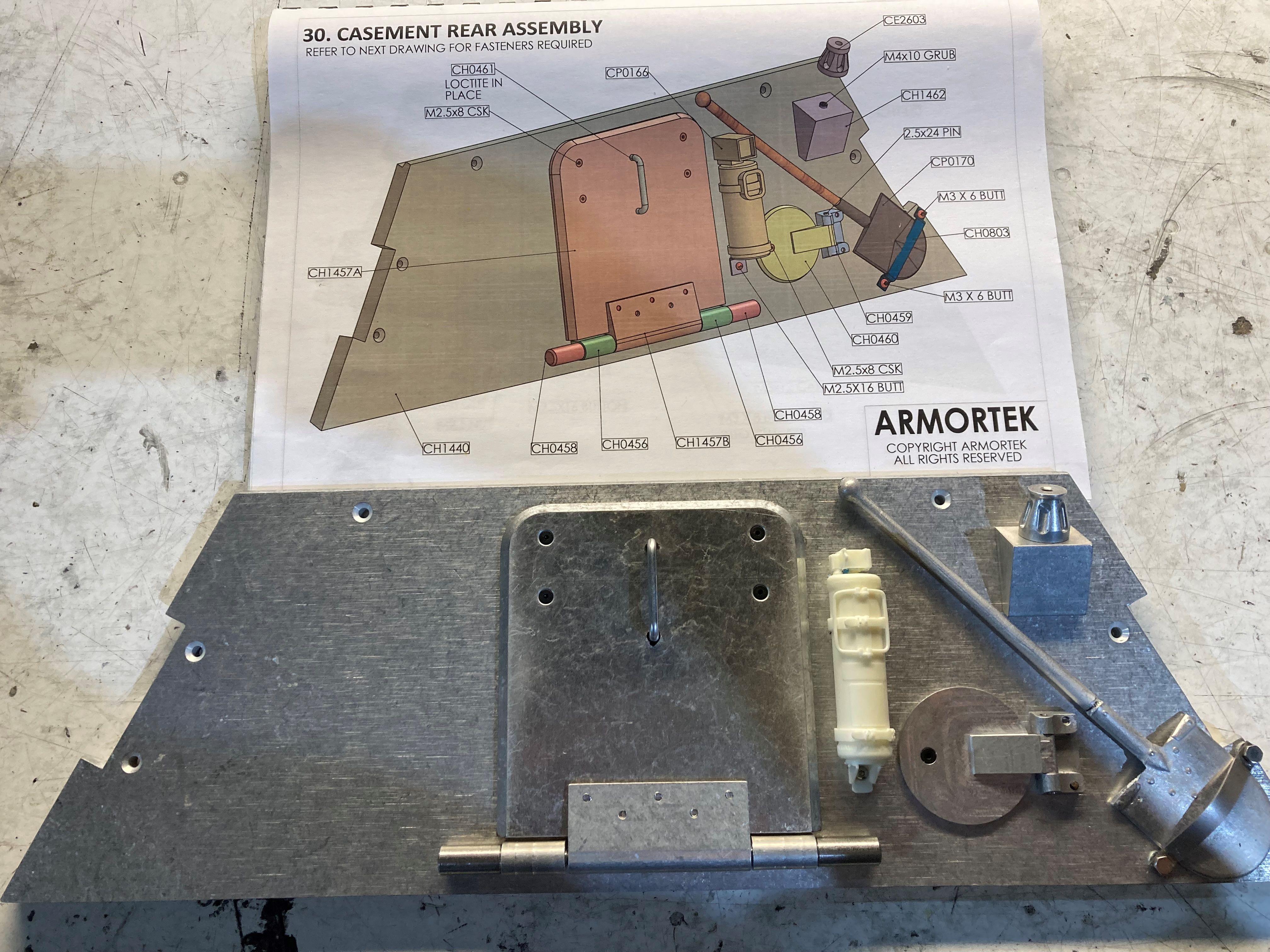

Casement rear assembly,
