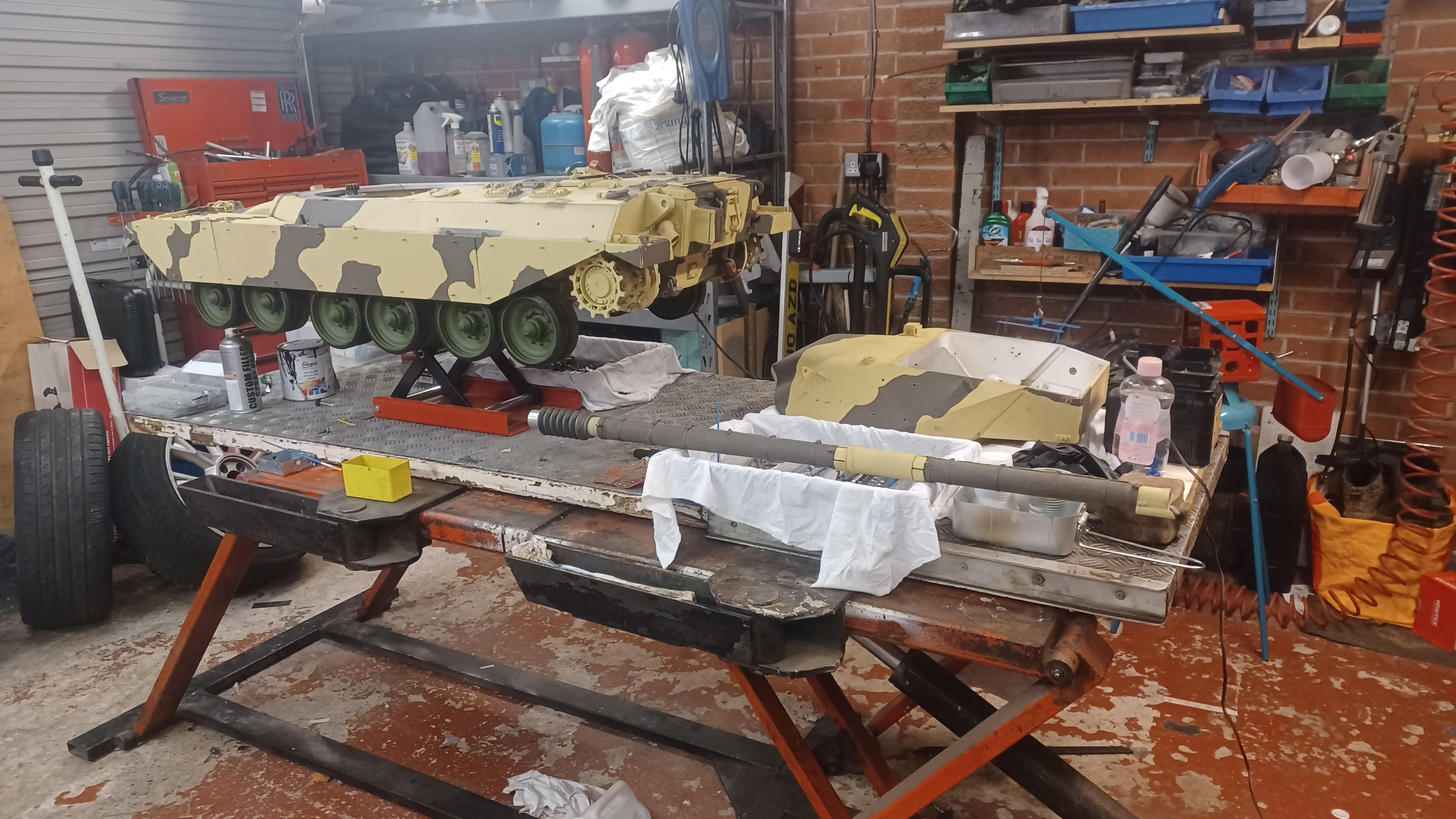

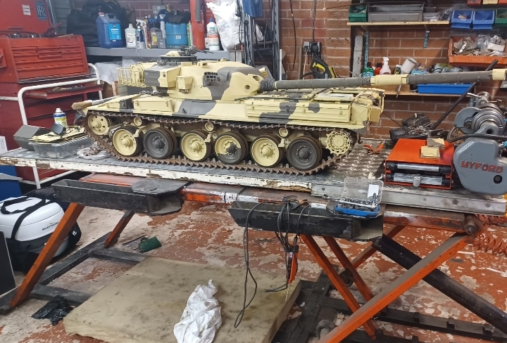

Photograph of the tank the day it Arrived , I have being stripping any parts I can In between reading all the posts on here , the quality of your workmanship is amazing.

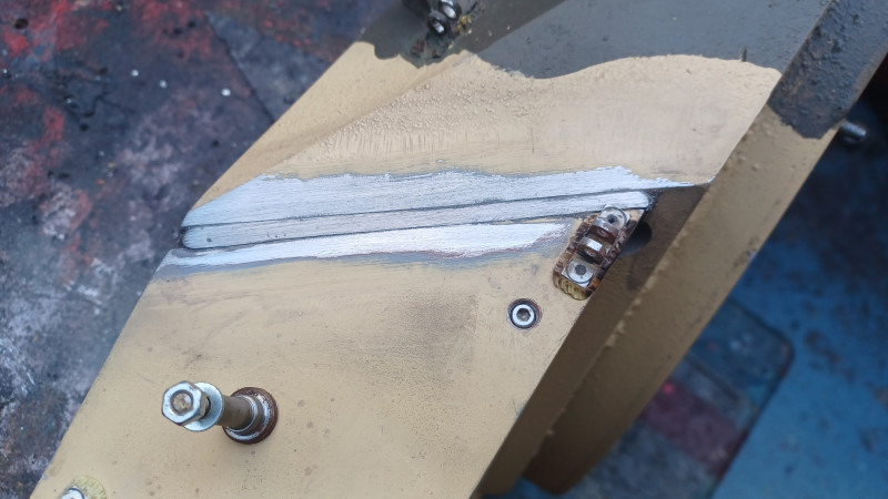

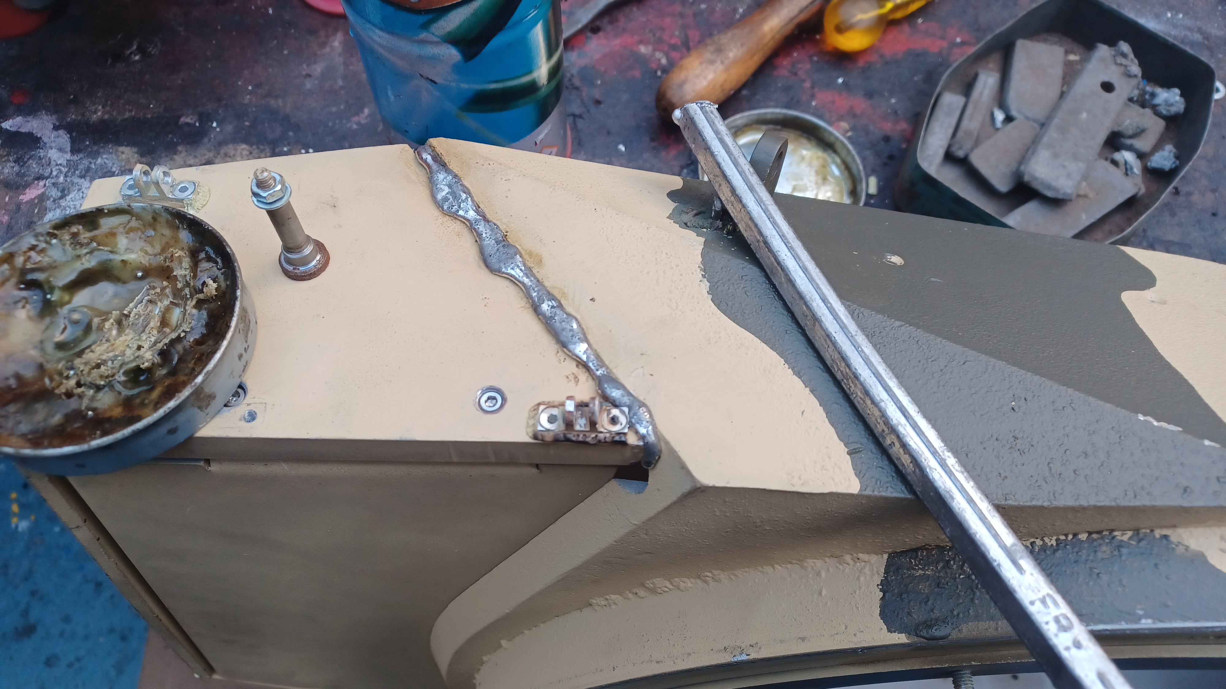

Reverse engineering the turret
After a considerable amount of reading And Advice from members I have started to deal with the problems on the turret it is machined off center and the rear assembly is hopelessly out of line I've corrected that however did not want to use filler so I reverted to a very old fashioned lead loading to fill the gaps.
Started with the hot air gun to get everything warm then used the gas blower lamp to run the bead. Appropriate mask and PPE was used. It has completely filled the gap and is now waiting for final finishing very pleased with the results
