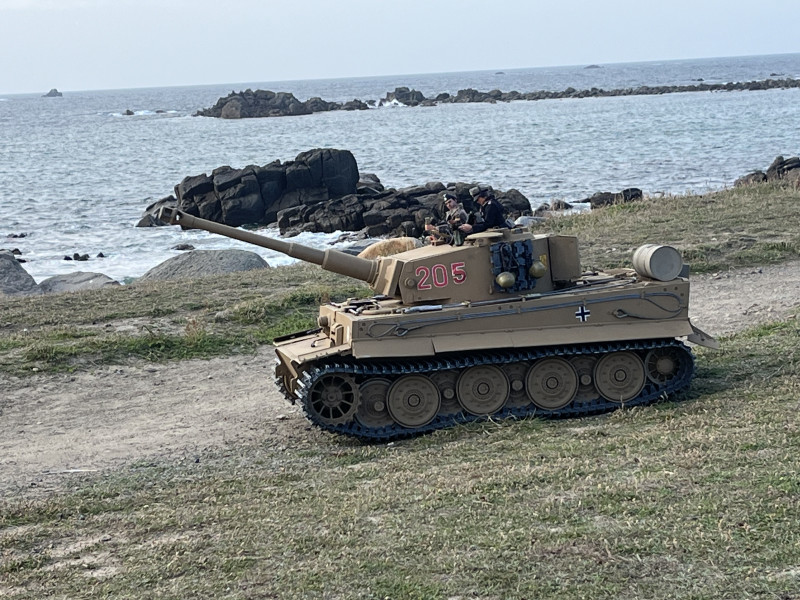

I took my tiger out for its first trip not on flat grass today. Developed a bit of a problem after running for a little while.
The turret suddenly rotated clockwise, and the gun barrel dropped down, it eventually came to rest pressing against the oil drum on the rear, having snapped off the catch on one of the engine hatches. It then wouldn’t move at all.
As an aside, I also lost the gun recoil a while ago.
I’m new to RC and got this tank ready built from tony so lack a bit of familiarization with the electronics.
Any tips on what the problem may be and how to fix it would be much appreciated.
