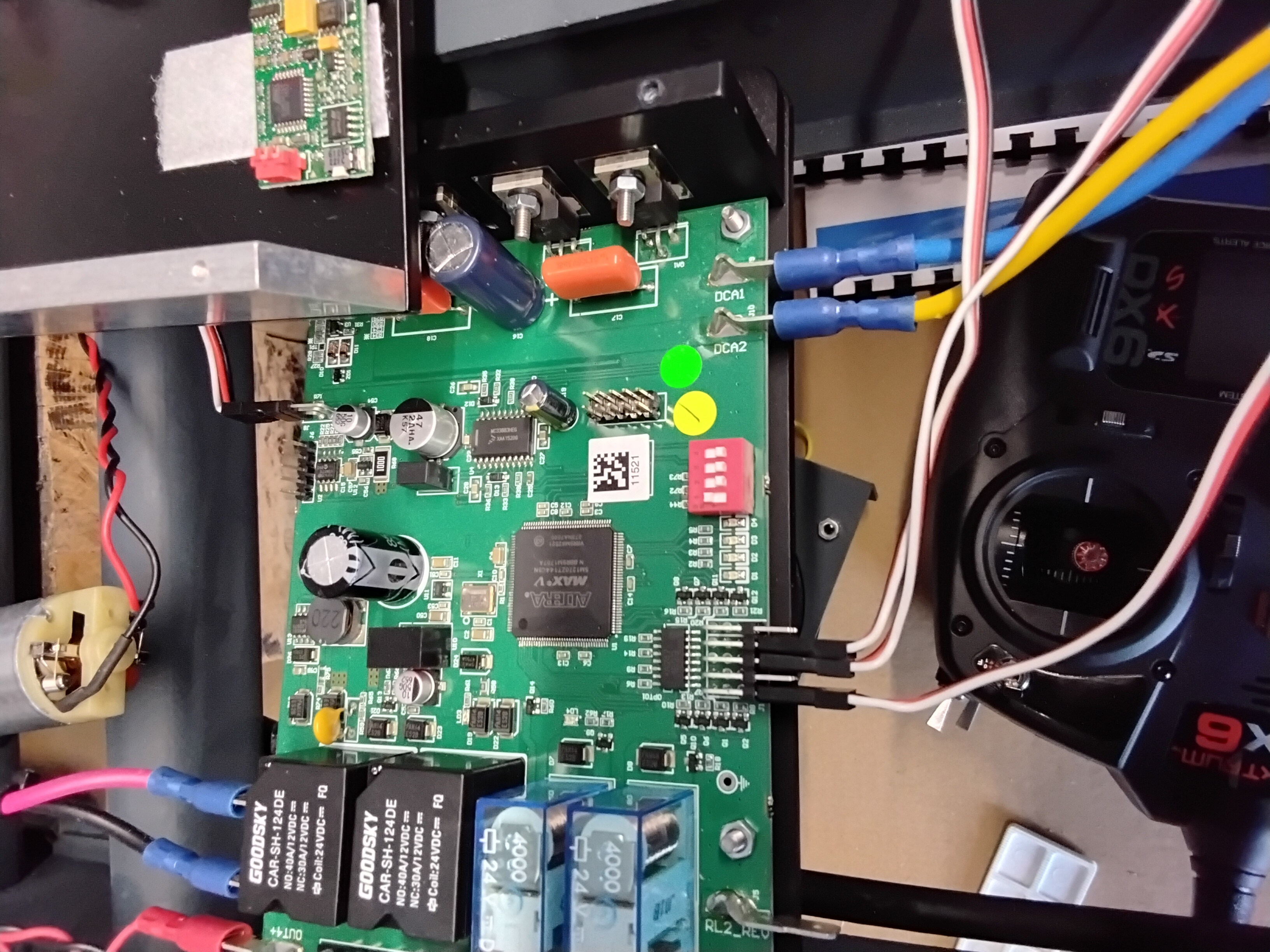

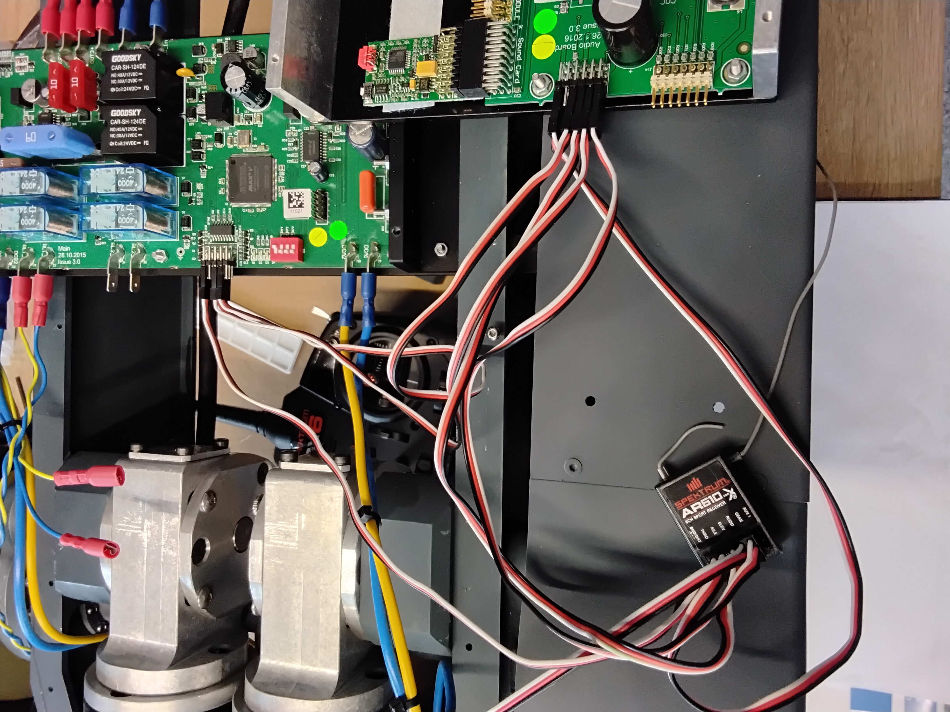

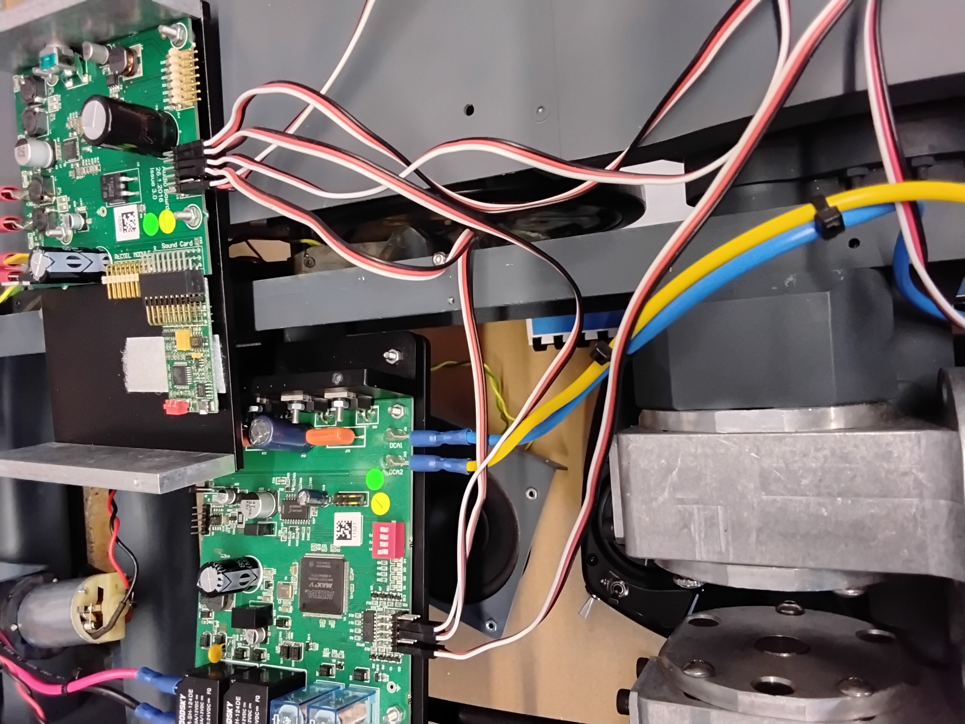

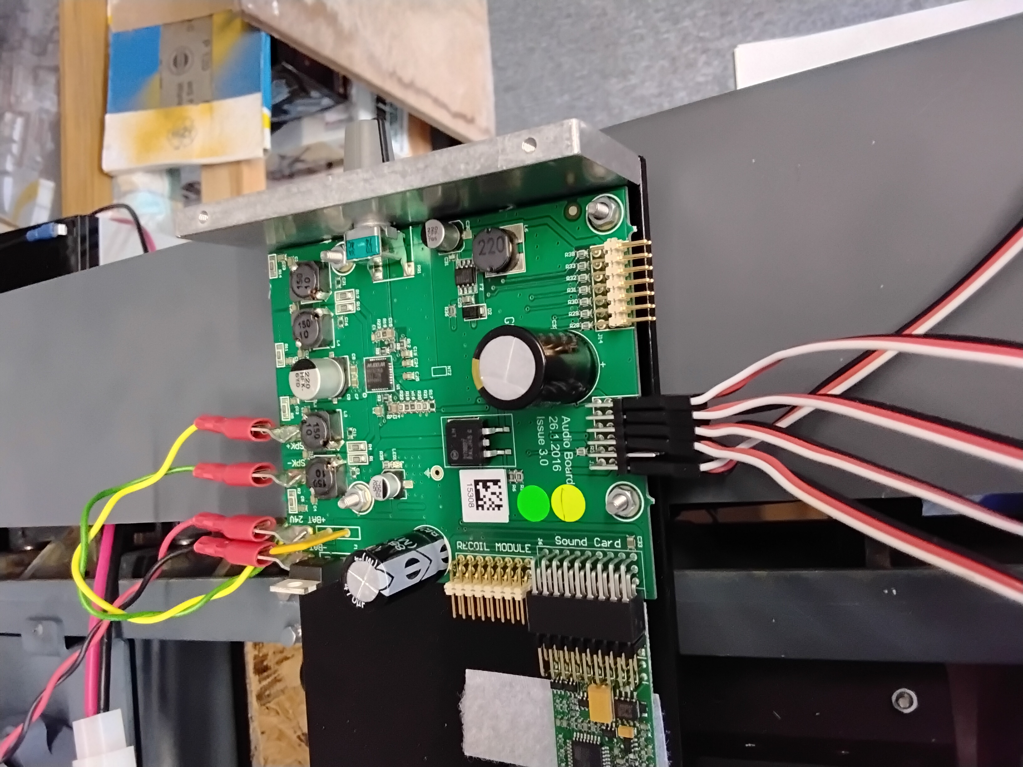

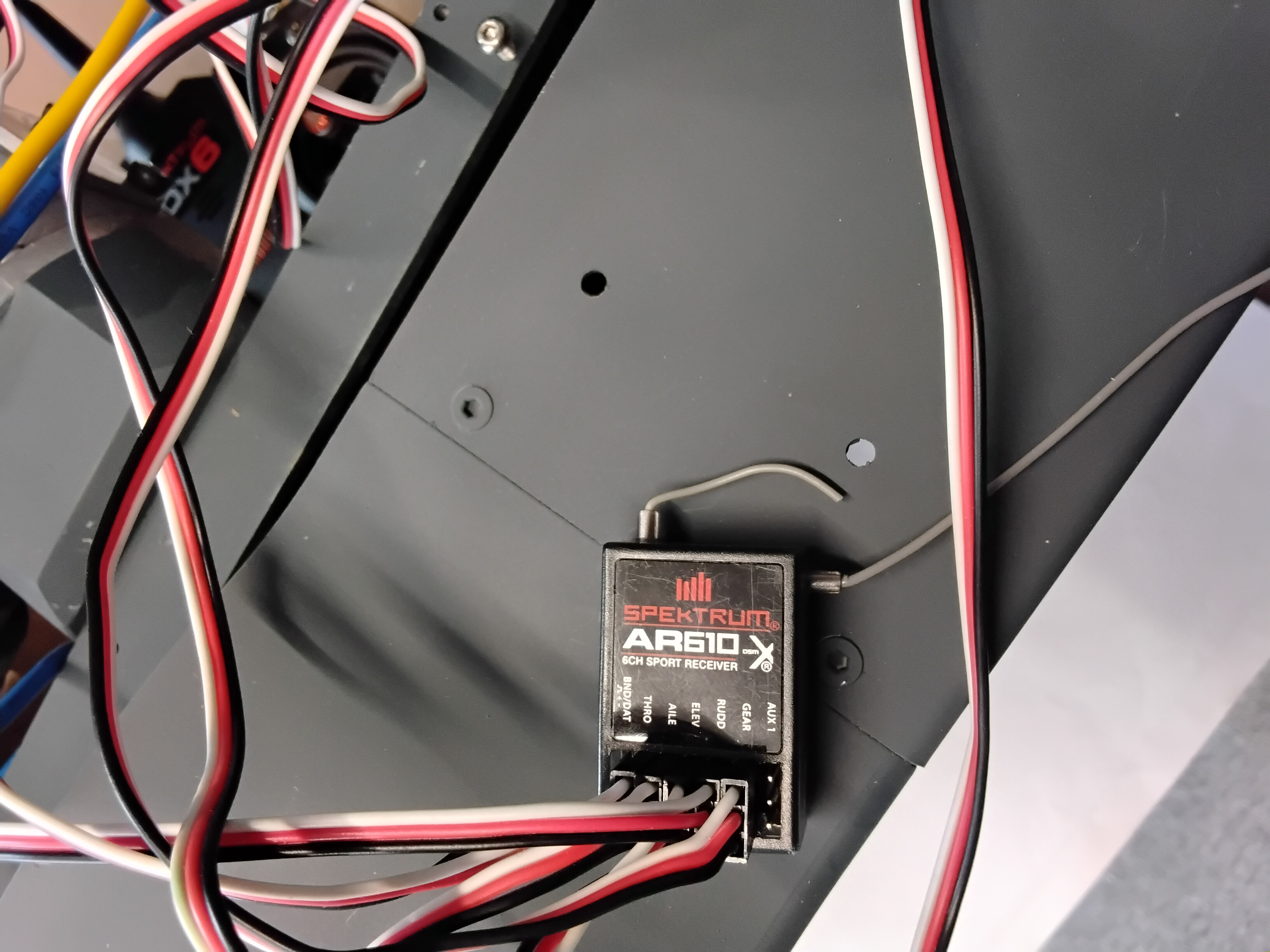

Thanks for everyone help and advice still no joy my son will be back tomorrow to have another go but thought i would post a few pictures to see if anyone can spot a mistake I am making.

Re: Help/advice setting up SD KFZ 9 famo audio option pack
Just a few pics to seeing anyone can spot a problem.
Hello Roy,
From looking at your photos and following the wires, you have your modules connected as per silver box.
Please confirm you have silver box and not red box.
Also the audio module is not plug & play, but once you have it correctly connected you then have to teach it to respond to your transmitter to play the pre-programmed sounds,whether you are are using a 3-position switch or a rotary one.
Also I see from the photo that the motion module has a 4-DIP switch. Could anyone provide me with info on what the different setting do ?
It could be enormously helpful to me in future fault-finding for you, and the solution may simply be switching one off & on because it failed to get electrical connetion the first time.
Hi mark they are the silver boxes and a three way stick on the transmitter and when we turn on we have a loud click from speaker but no other sounds when we try to set up. Not sure the wires are in the right place.

- Posts: 5110
- Has liked: 1470 times
- Been liked: 1648 times
The wiring looks correct to me.
You are using the Gear channel for the sound selection. If you put a servo in that channel, does it respond as expected when you move the switch back and forth ?
Have you been through the sound teaching process with the Benedini board ?
- Posts: 5110
When you power up, you should hear a thud from the speakers as the sound board powers up, then two clicks as it initialises:
