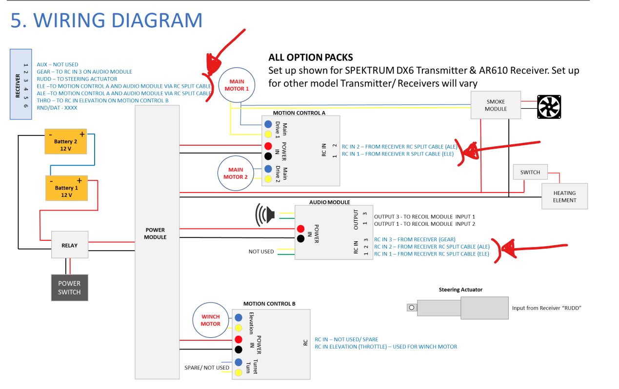

Hi. I am following the steps to set up the sound board for the first time, I have the motion control and audio boards wired as per the diagram in section 4 but then in section 5 step 2 it says to disconnect RC wires from the motion control board and connect them to the audio module but it doesn't say which wires. I have tried a few ways to no avail.
Any help would be greatly appreciated.

Re: Help/advice setting up SD KFZ 9 famo audio option pack
Which style of electronics do you have ?
For the Red Boxes:
The Motion Control Module needs two RC inputs from the receiver, to control each motor (RC IN 1 & 2).
The Audio Module needs three RC inputs from the receiver, one for each motor ( RC IN 1 & 2) so the engine sounds are proportional and one to select the different sounds (RC IN 3).
The usual way is to plug Y-leads into the two motor outputs on the receiver. One leg of each goes to the Motion Control Module inputs 1 & 2, the other leg of each goes to the Audio Module inputs 1 & 2. Then there is a single lead which goes from the receiver directly to the Audio Module input 3 for the sound selection.
If you have the older silver Audio Module, then it has loop backs built in, which you can use instead of Y-leads.
In this case, on the Audio Module:
RC Connections 1 and 4 go to the receiver motor drive channels.
RC Connections 3 and 5 go to the Motion Control Module inputs 3 & 4 for the motors.
RC Connection 6 goes to the receiver for the sound selection channel.
For the Red Boxes:

- Posts: 2926
- Been liked: 3670 times
Hi Yves - see the sections I have put arrows against in the manual.yves mouton wrote: ↑Wed Jul 10, 2024 7:08 amHi Mark,
Yes i know it is not a mechanical problem, something must be wrong in the transmitter or
the fact that i not use the y-leads between the motor mudule and the sound module. But there is nothing in the manuel that said
you have to use y-leads. The sound works fine on the famo when i start to drive it.
It will be more easy when i see a layout of the electronics ( not a expert on that )
Best regards Yves
PLEASE NOTE THAT THIS IS FOR THE RED BOX SYSTEM ONLY.
