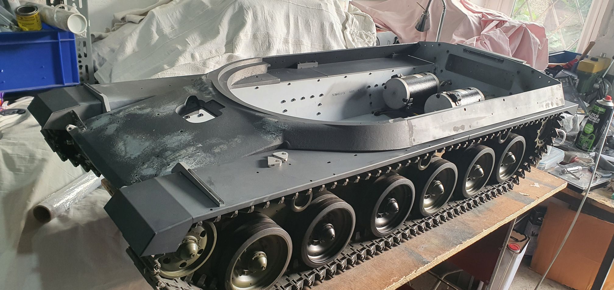

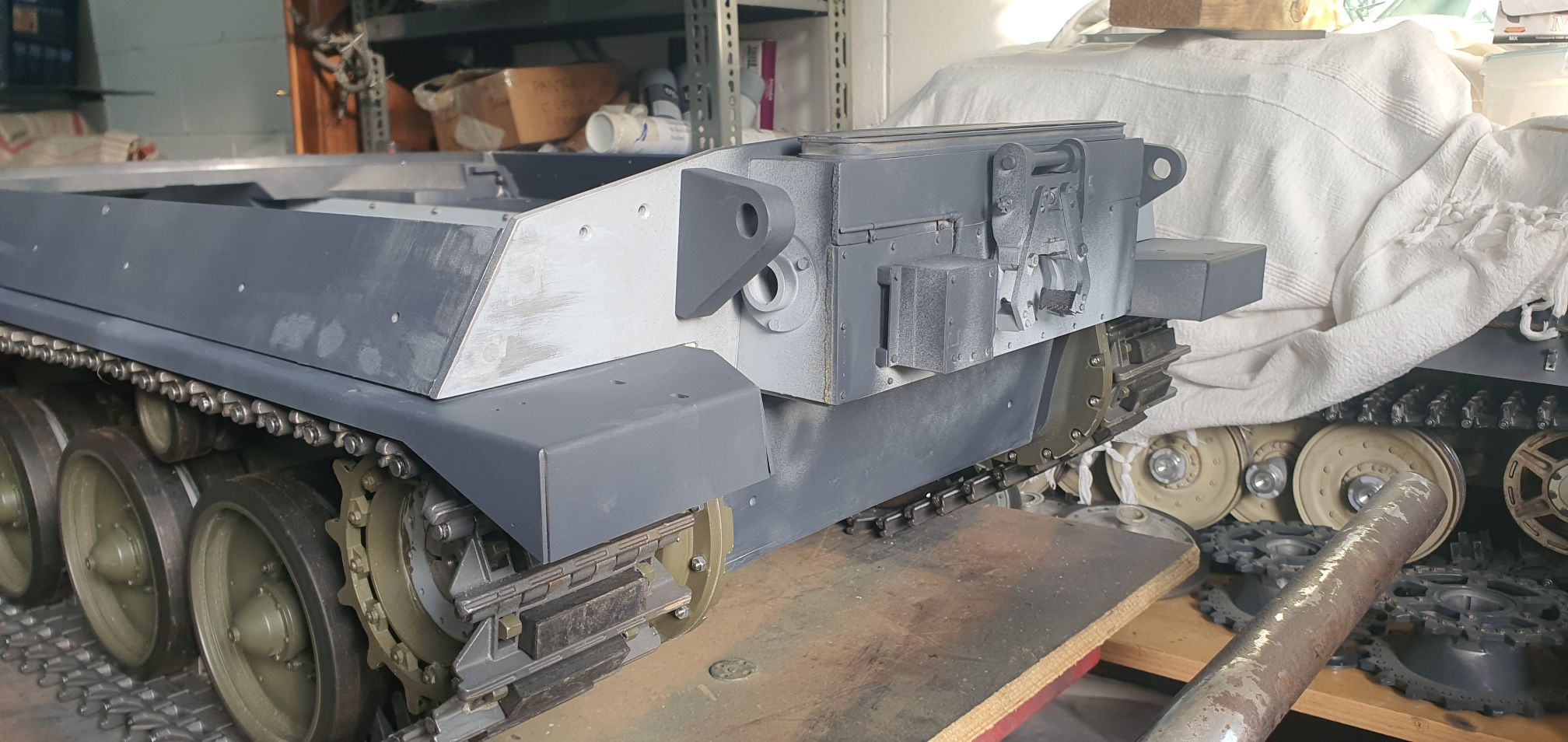

Cheftian build number 47 is comming along nicely, this was purchased with the lower chassis built to a good standard.
A model that i didn't have much interest in at first, but loved the steel tracks, large castings and a good amount of detail. I would say the most impressive kit to date.
If you can get hold of one, I highly recommend 👌
As purchased
As purchased

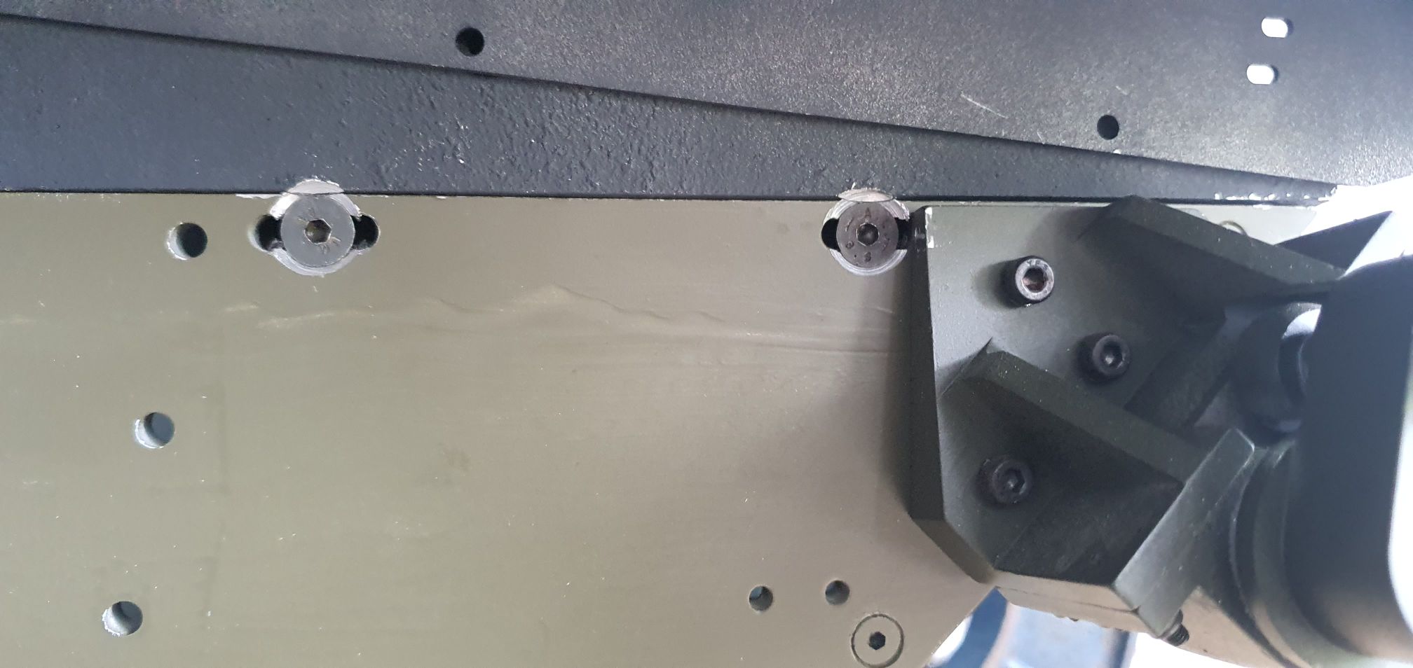

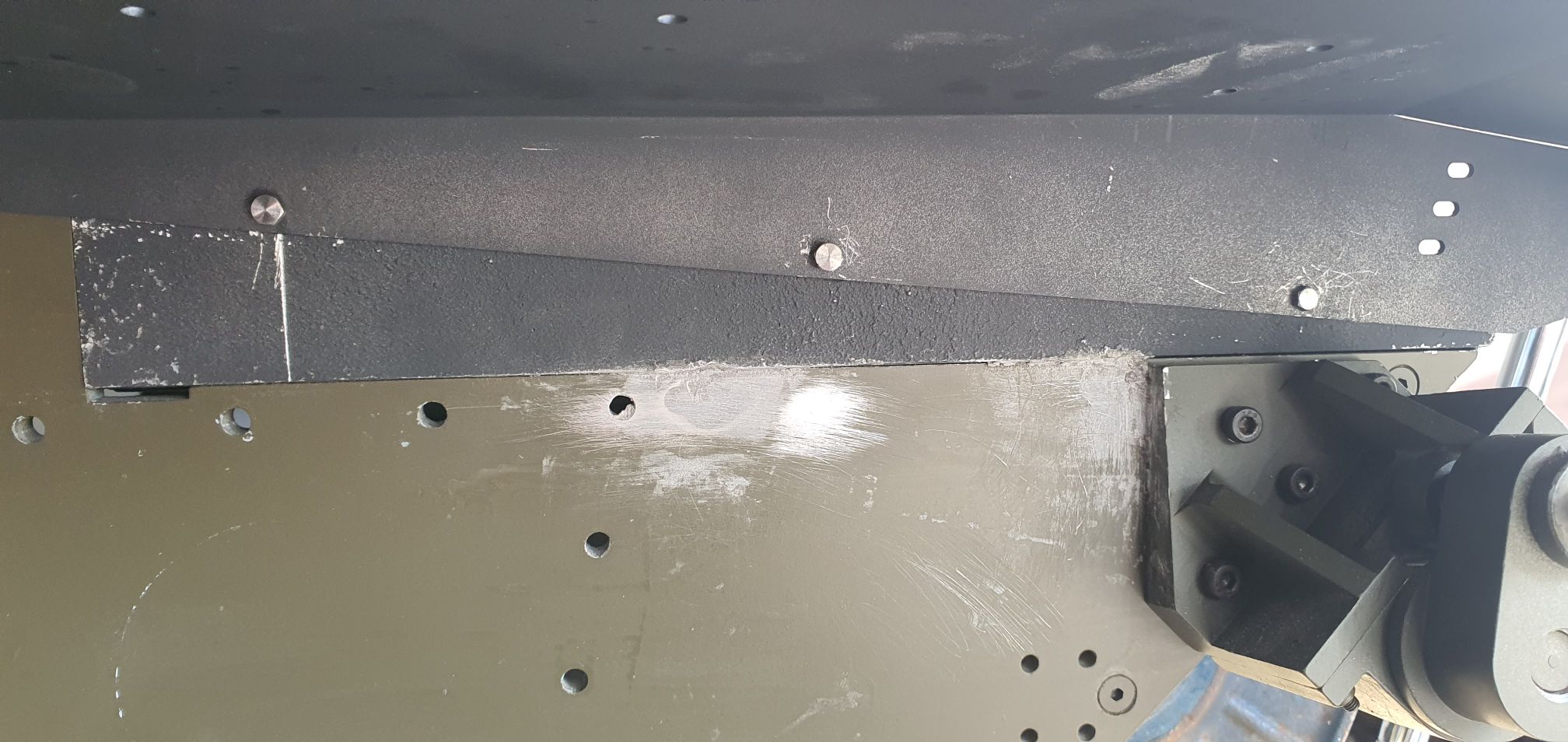

Fitting the front, larger fasteners used and filled with chemical metal - small amount of filing on the inner brackets(both sides fit with no overhang)
Mudguards fasteners added

Some of the fasteners on the front are awkward to either locate or attach a nut to secure.<br /><br />It's easier to use an alternative method- most of the visual bolts including under the mud guards are a BA fasteners

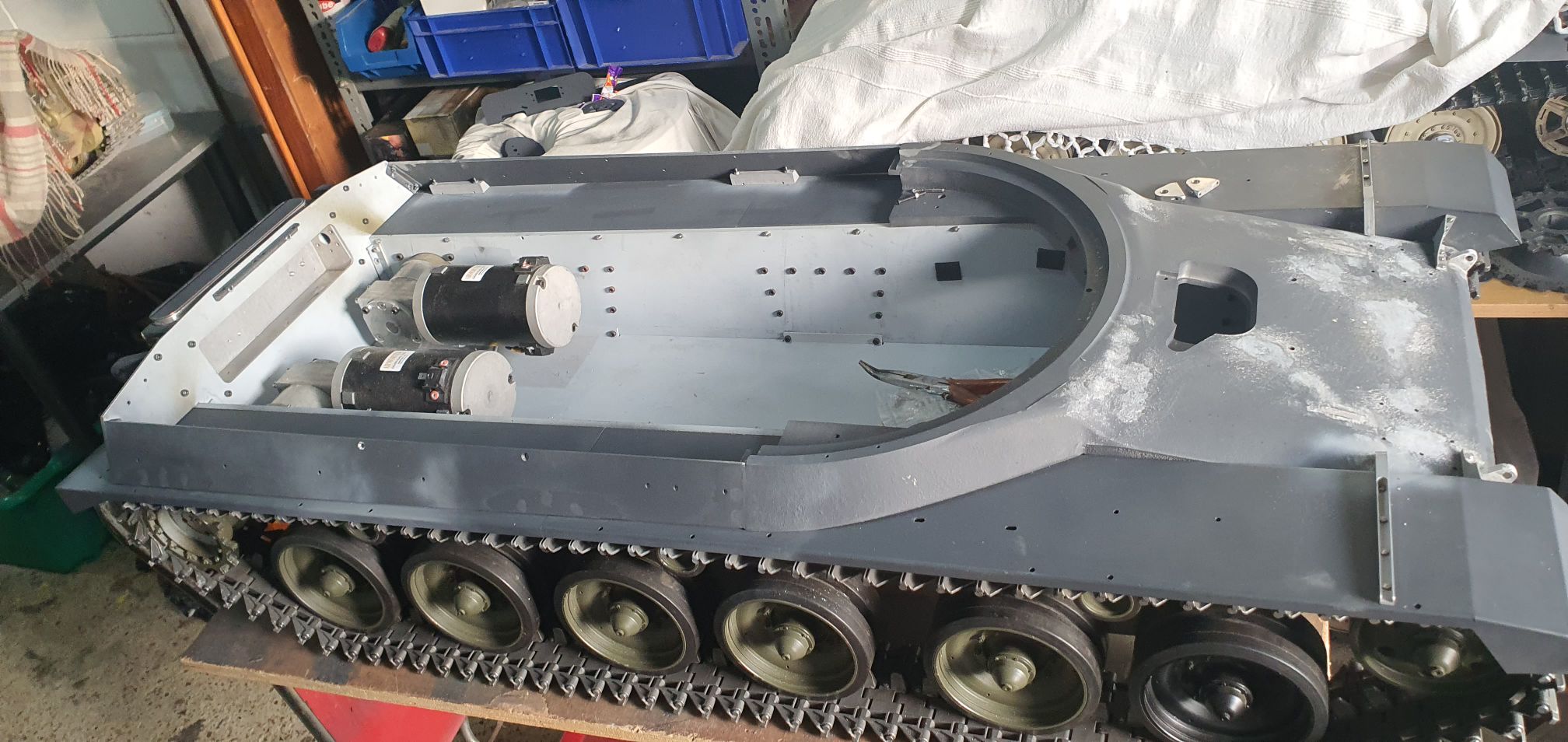

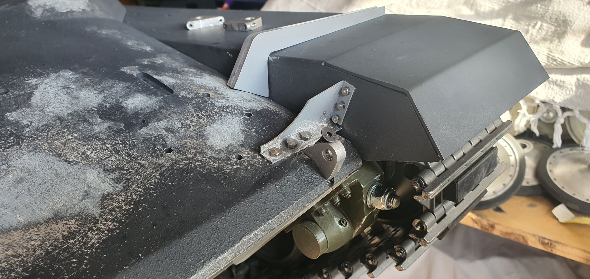

Started to lower the rear deck as others have - not the straightest of edges, but time was short.

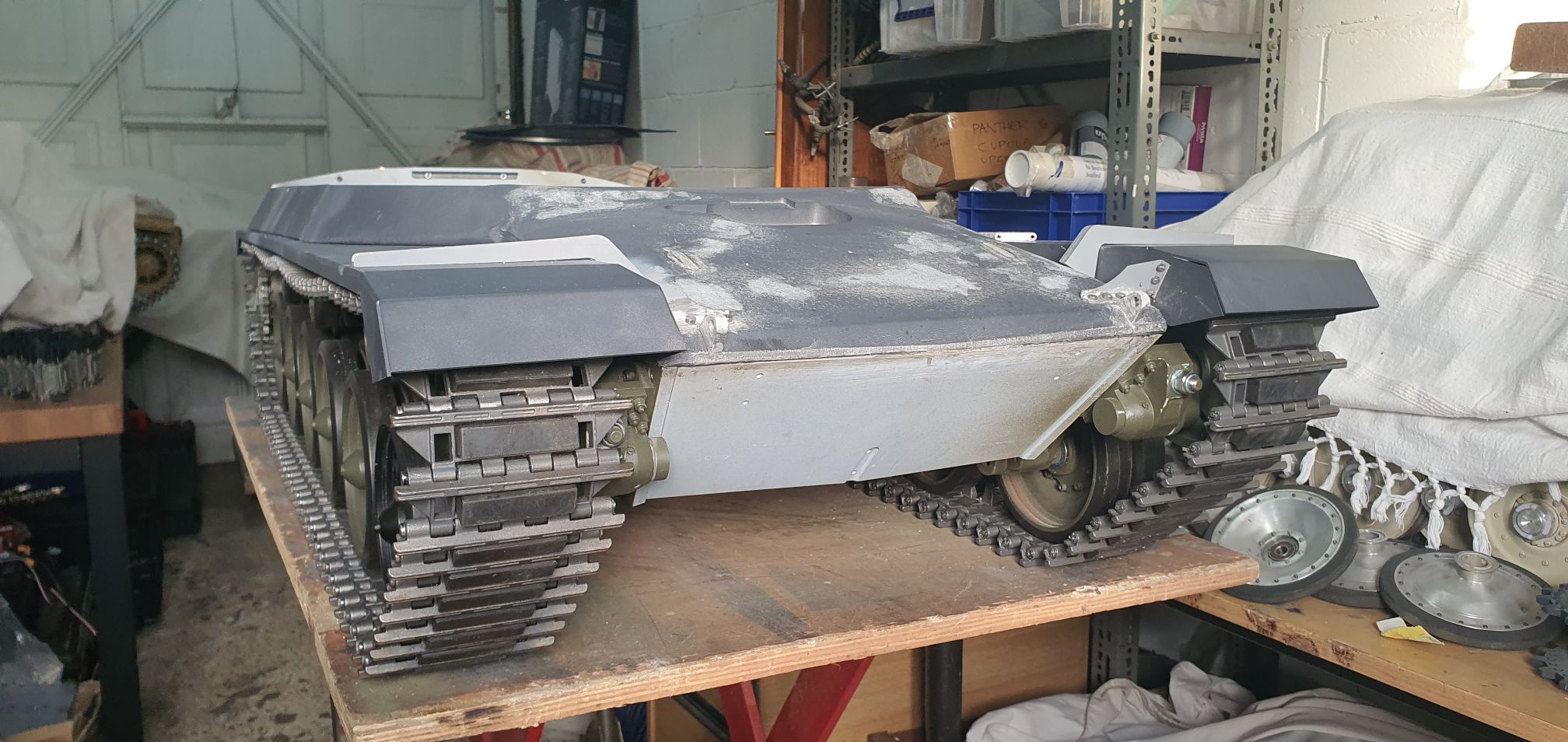

Side panels fitted
Side panels fitted

You'll have plenty of fun with Chieftain David, loads of scope for detailing, quite a bit done on the the bottom half already. You've got a good head start on the exhaust box too. Will you be doing more under the exhaust box? I really enjoyed making all the little boxes and convoy lamp housing. 8)
Chopping the rear deck for access is a must too in my mind. While raising the T cross, It defines the flatness of the recessed plate supporting the smaller engine deck hatches. A cross member supporting this deck plate forward also a must, You'll find it help's to support the turret ring too. :D

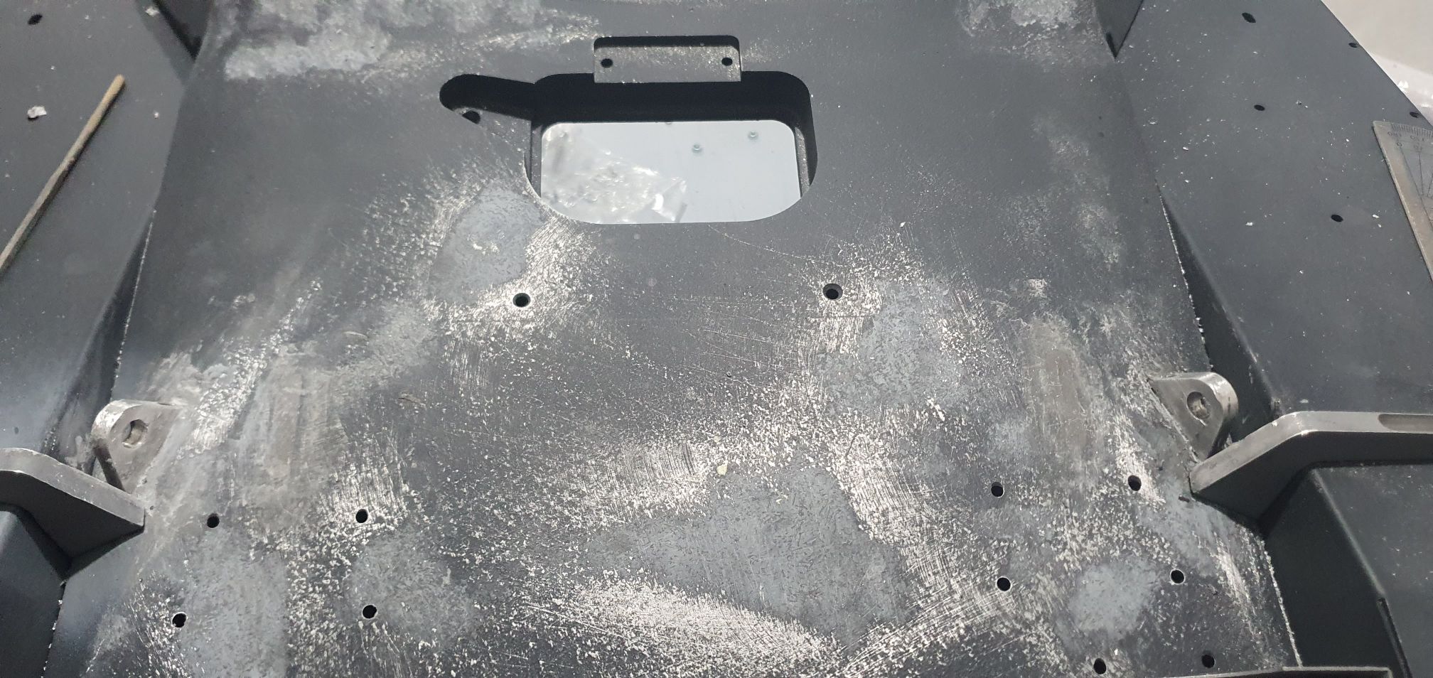

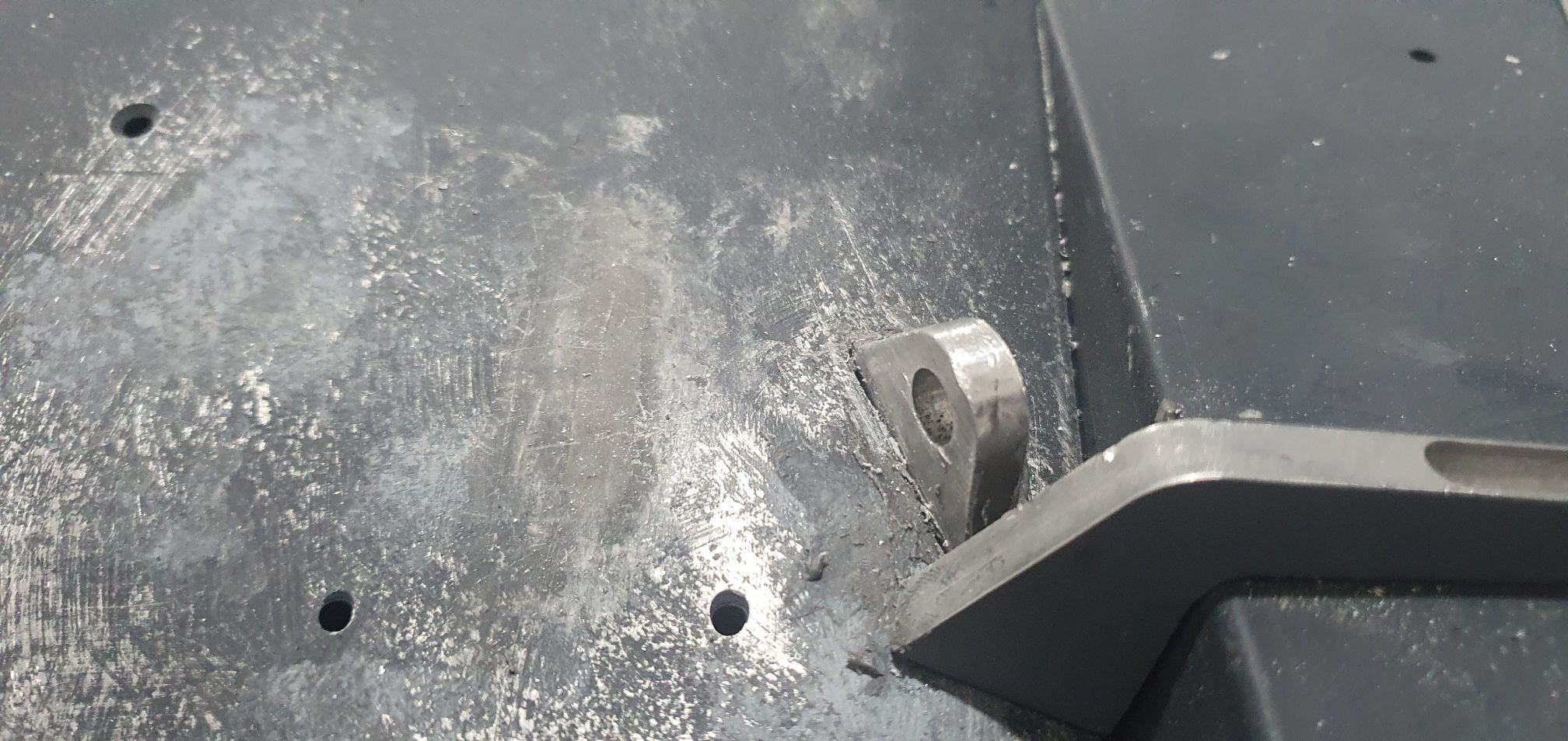

Moved the position of the lugs as below, this took a little longer as one of the lugs after repositioning was noticeable different to the other - no big drama just realigned and filled with chemical metal.

By coincidence I did exactly that same job on No. 34 this weekend.
Seem's silly to replicate the same topic. But it is a task that is worth doing and as you say it wasn’t too bad to do in the end.

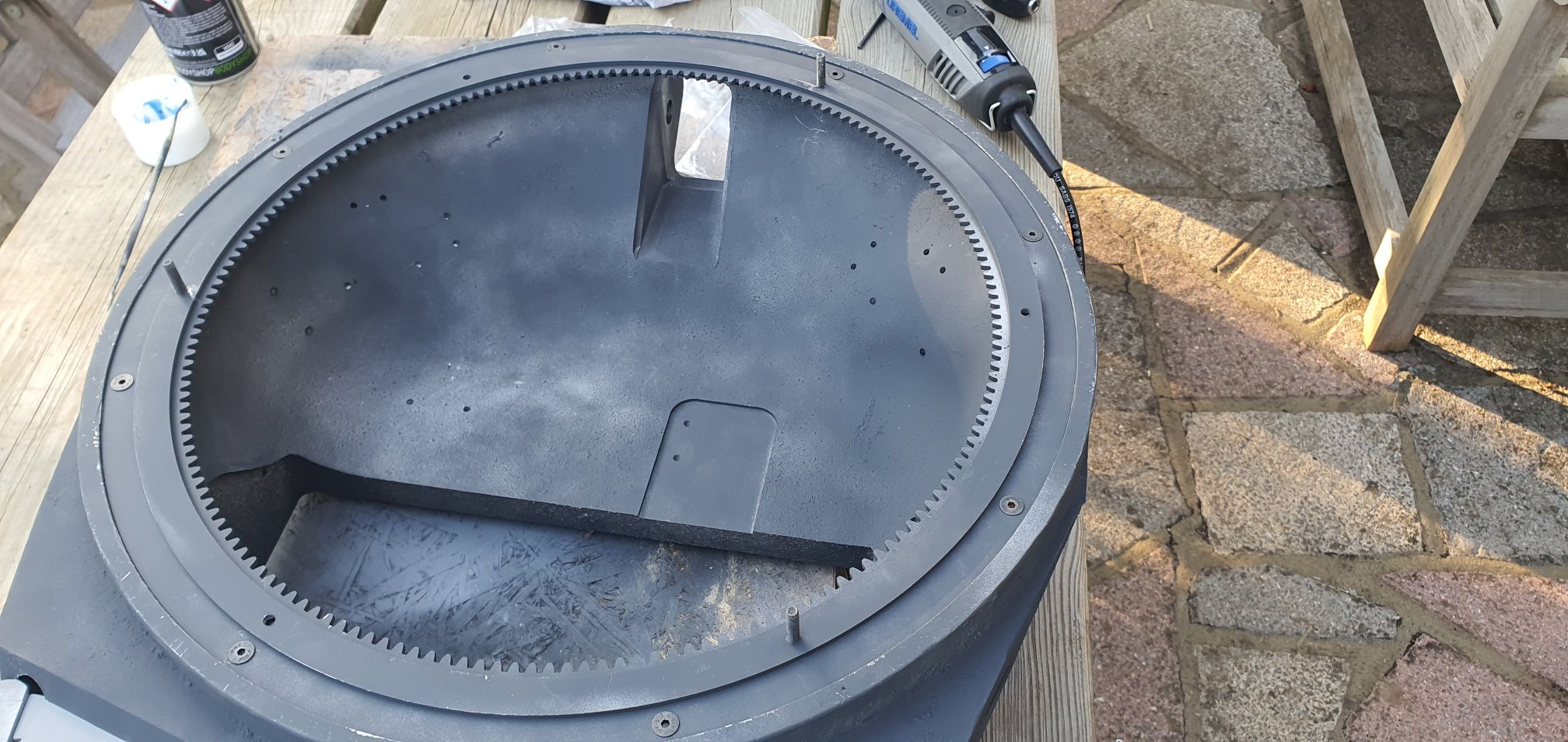

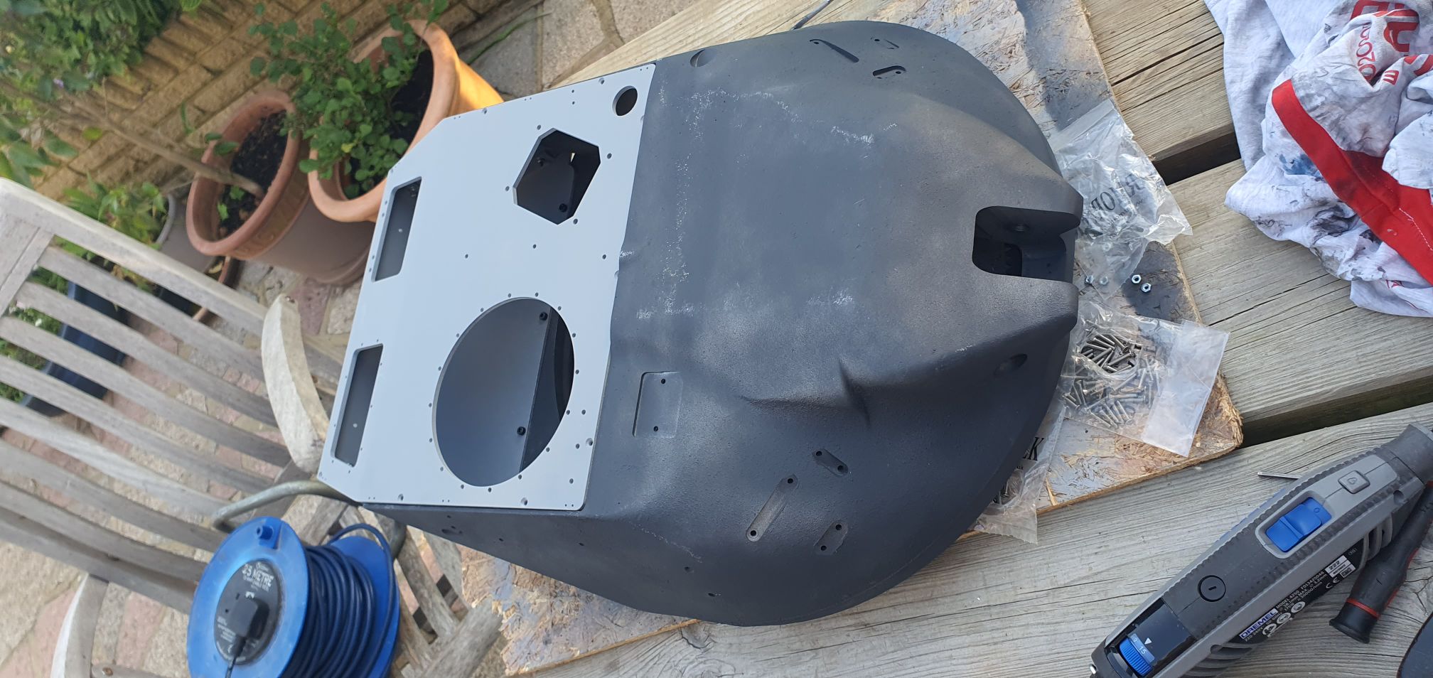

Some basic turret assembly this afternoon, I'm impressed how these newer kits go together.
A little filing to get the roof sitting as pictured

Some body work
Some body work
Moved the filler cap

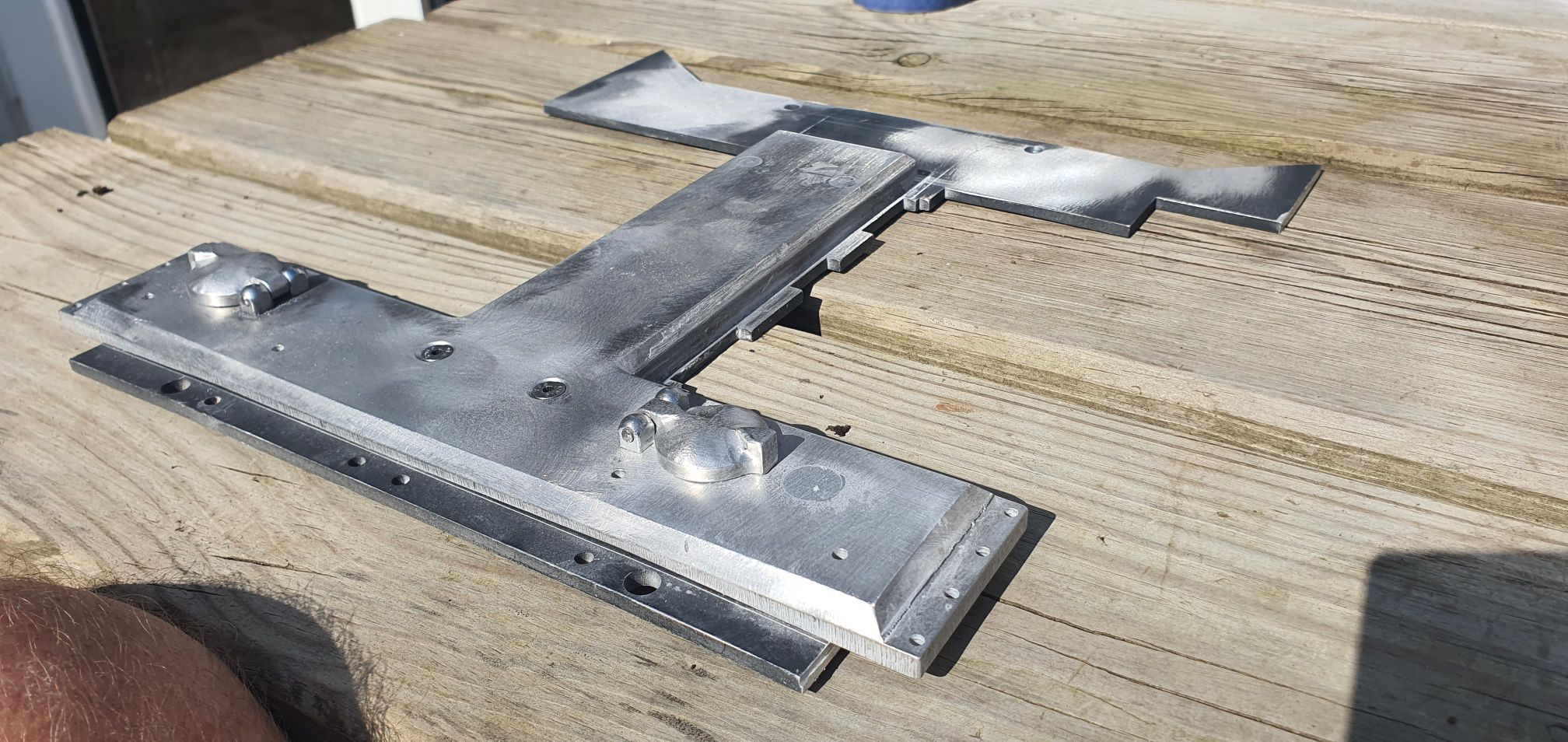

Assembled the T section (4mm insert added)

You certainly have the Mk5 fuel and hydraulic access cover flaps now, nice. It's nice to see the build moving along with these mods.
Is it great minds build a like, Deja vu or just glitch in the matrix :lol:
I'll be interested to see how you fill in the sawn slot, I think some used filler, some plastic strip. I just glued a thin pieces of alloy plate to the edge and polished out. My Tee deck panel now has the accurate fit of BL Marina bonnet. :shock:
