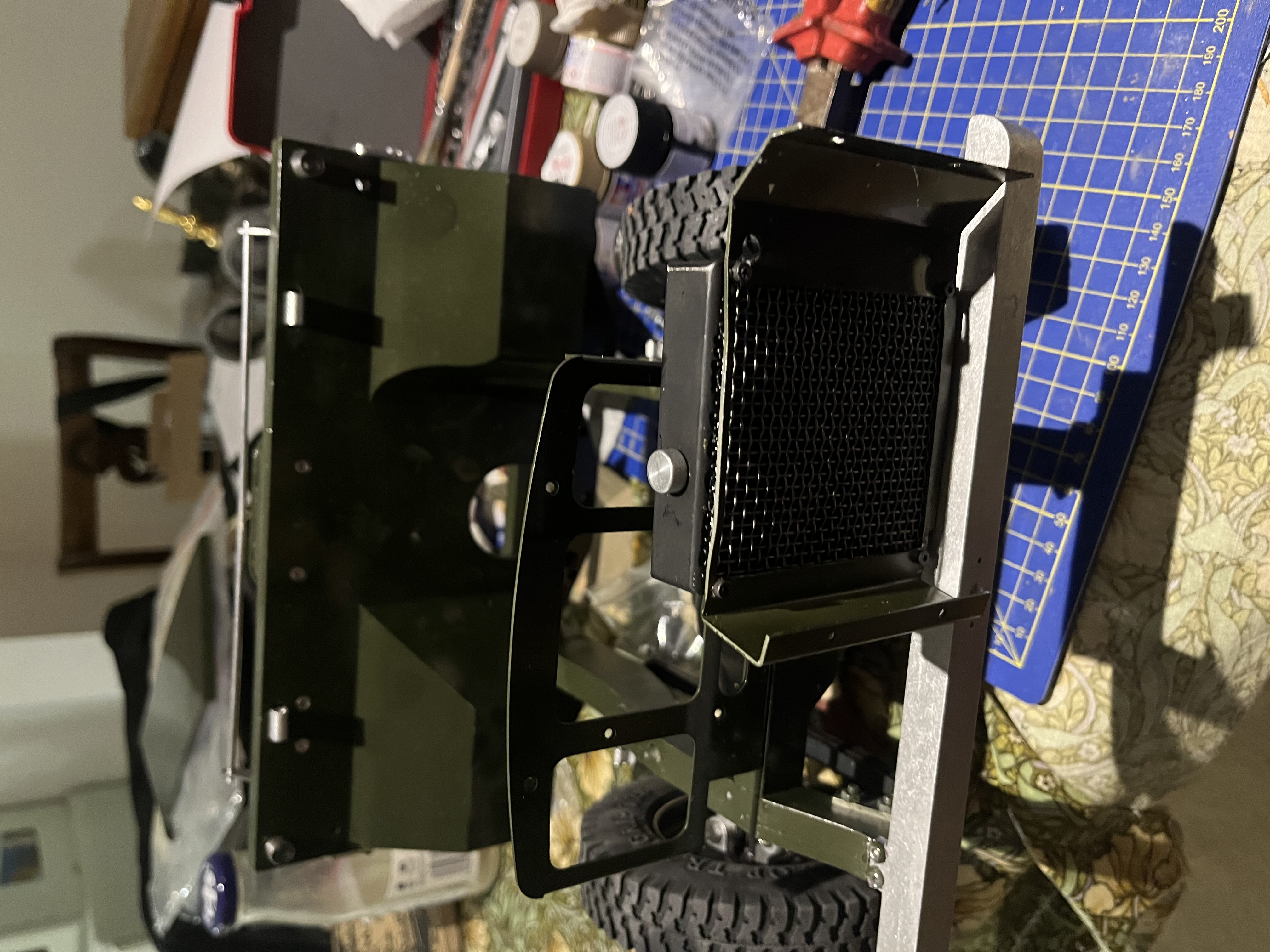

It appears my radiator surround is bent, please can someone help out by posting a pick of how it should be.
Tia

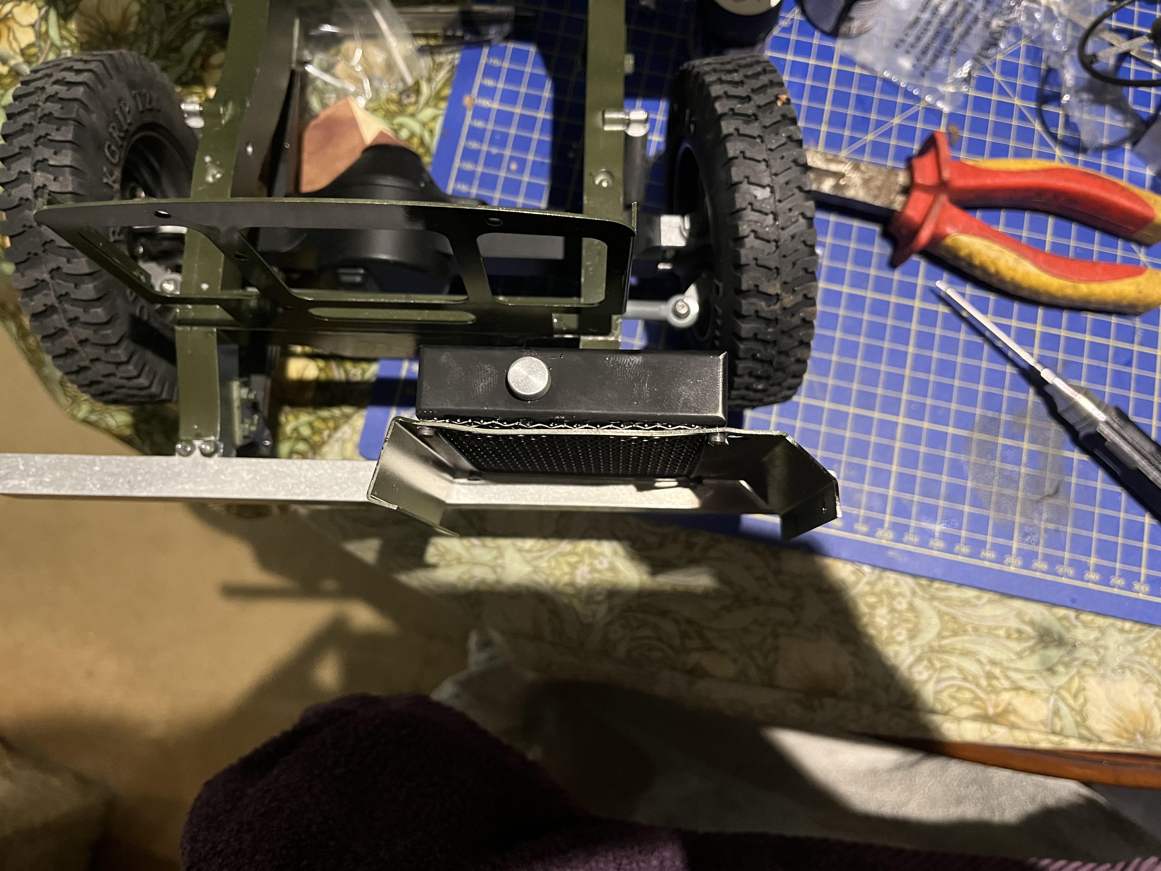

Hi the left hand angle should be 90 degrees, the right hand is 2x 45 degree angles.
You can check the angles against the top plate, part no ET0332.
Mine was bent too!
