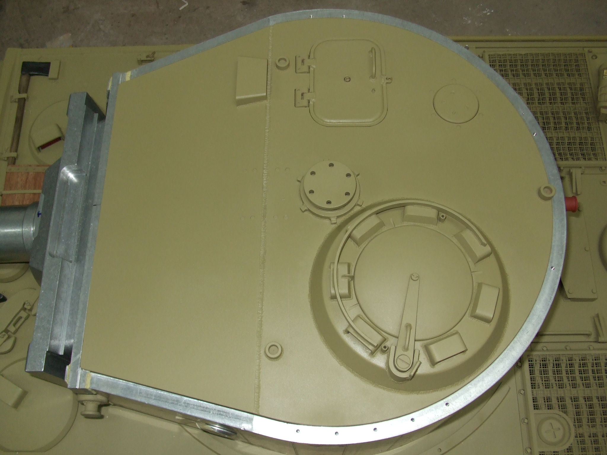

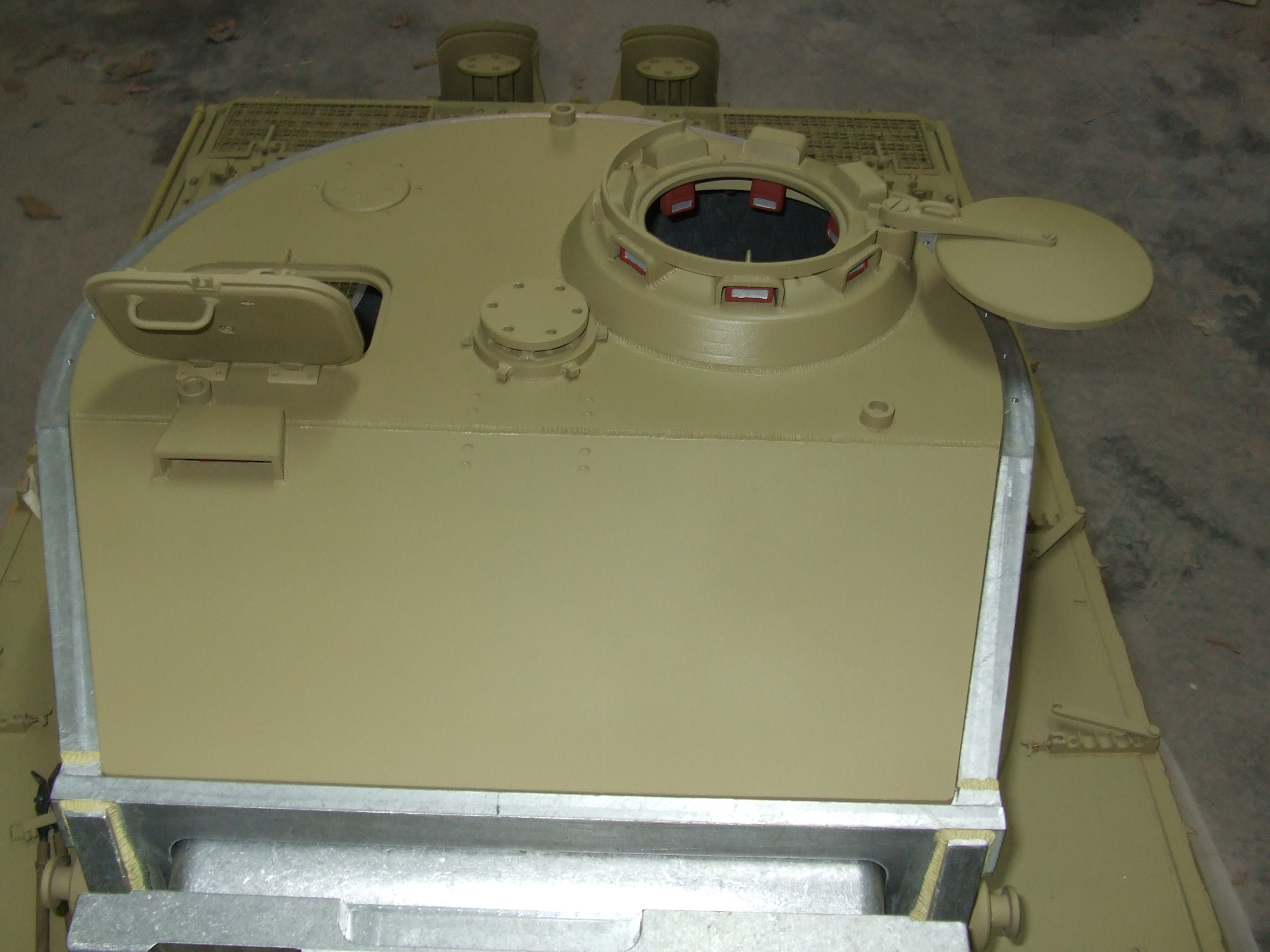

Finally finished the turret roof. Another item off the list. The list is getting smaller.
Added a "pull" cable to the Armorpax hatch.

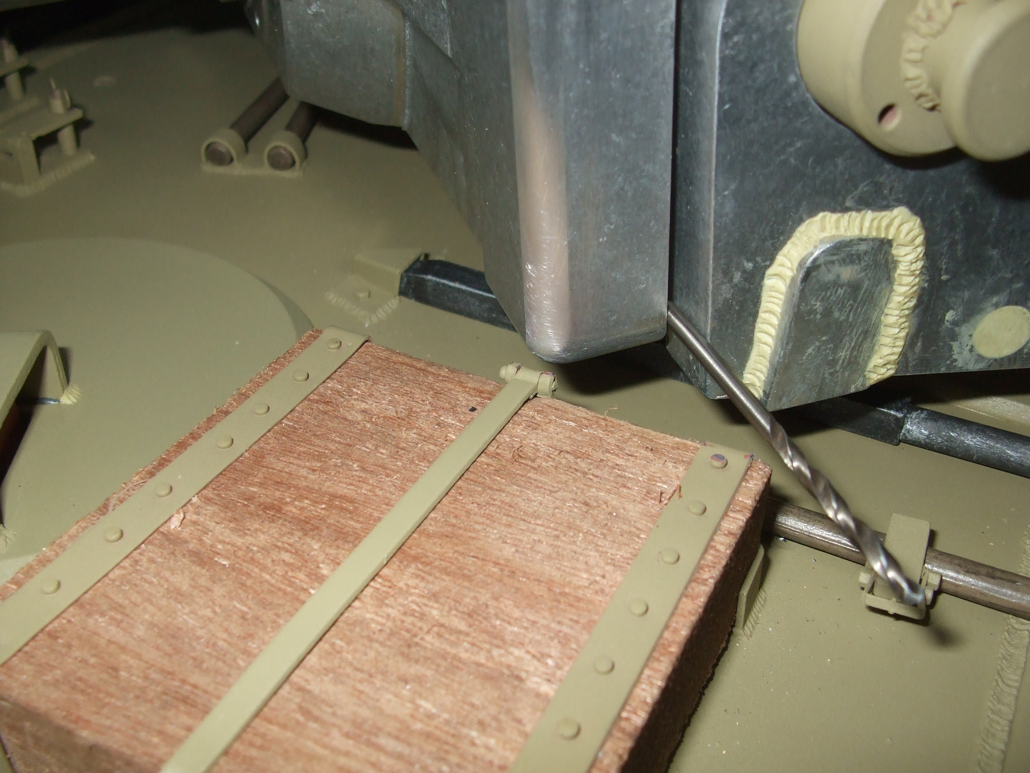

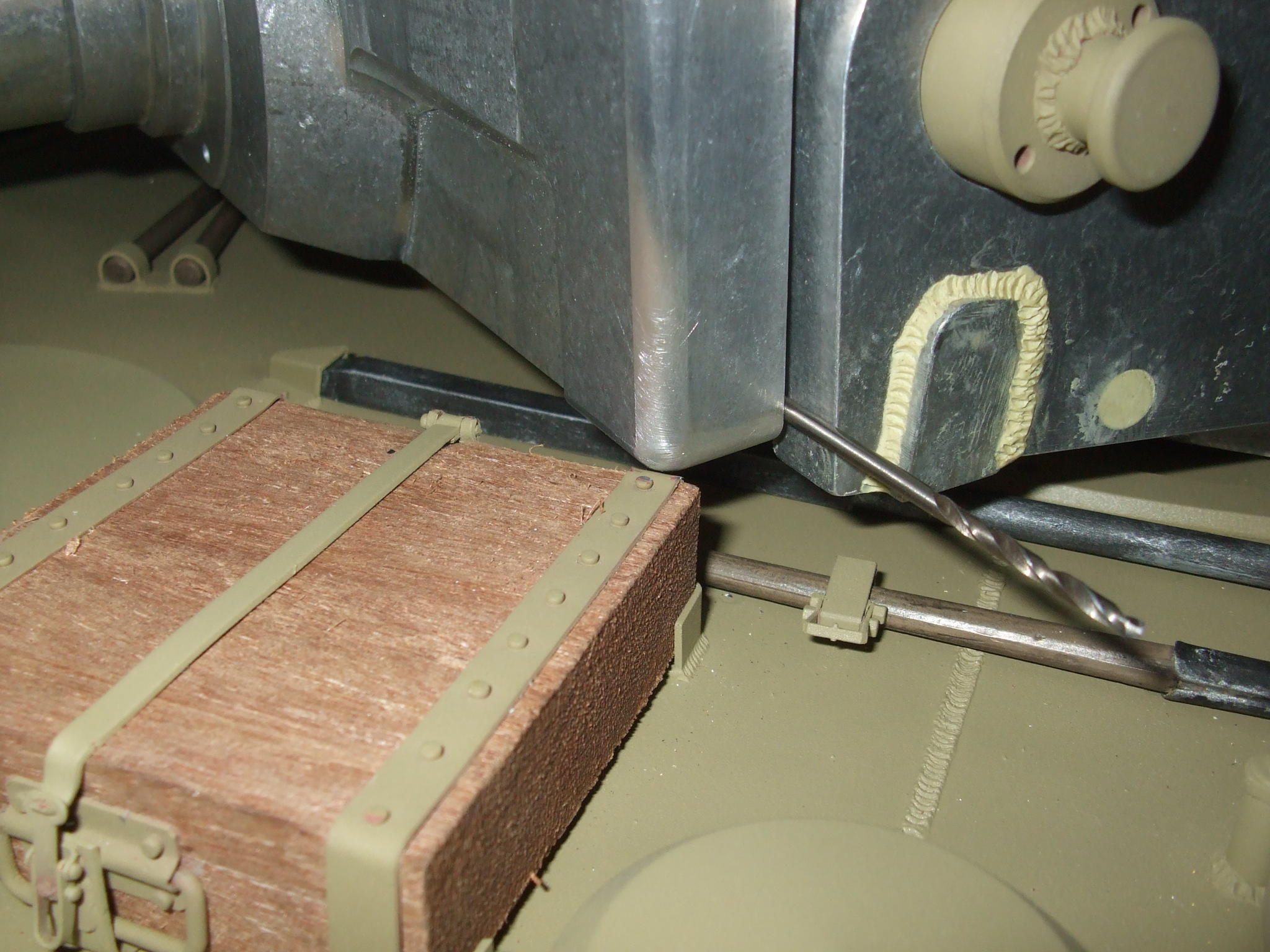

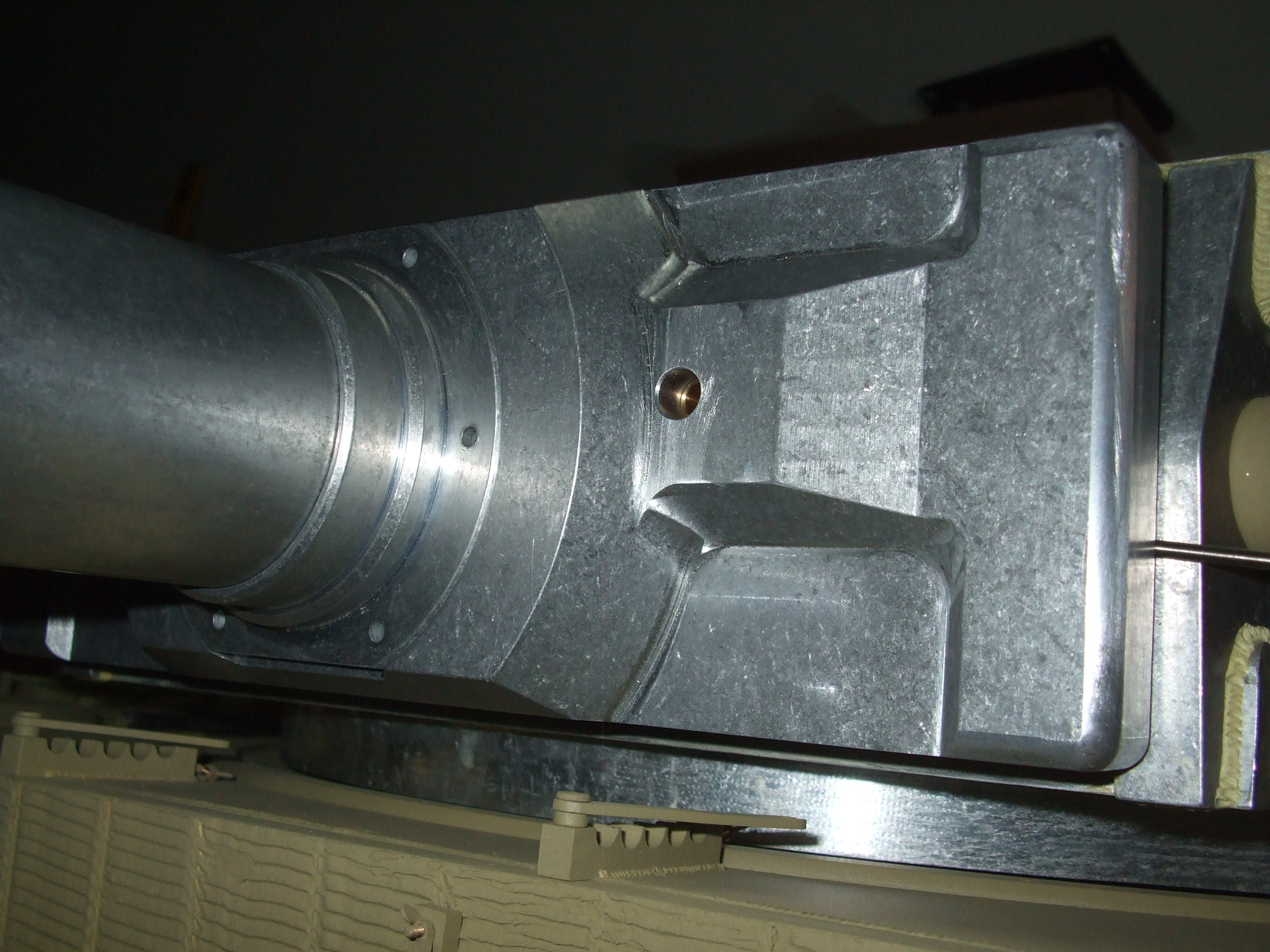

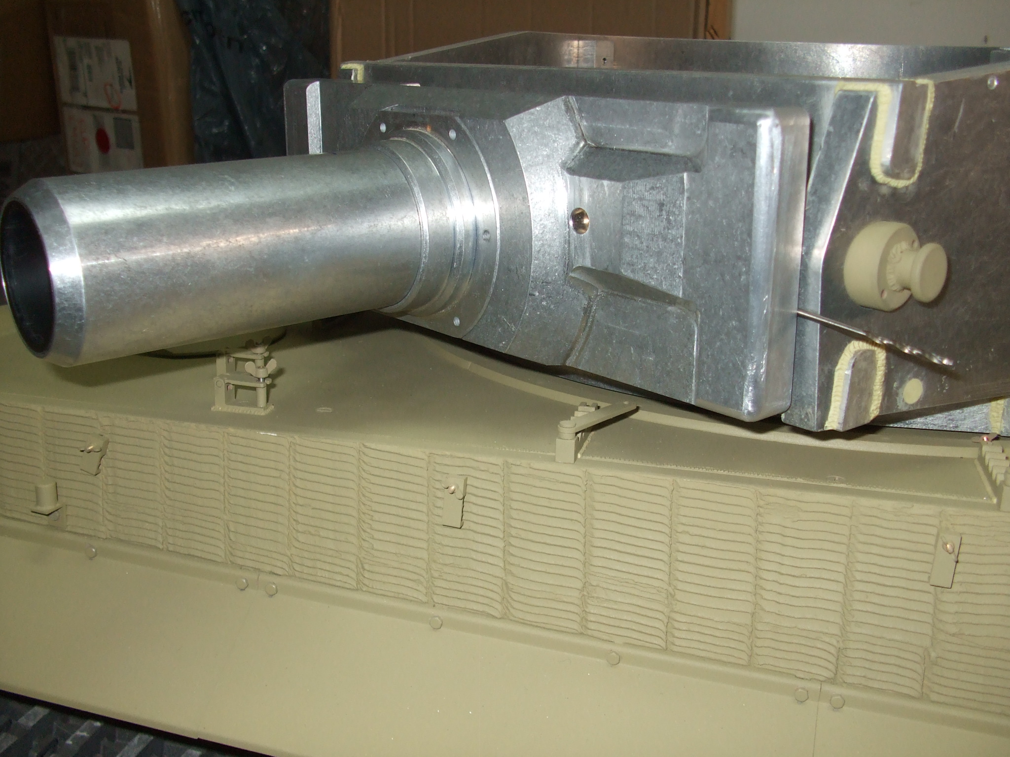

After sleeping on it, I decided that I did not want to risk the mantlet crashing in the jack block and damaging something. Machined some areas of the mantlet and now with the barrel fully depressed the mantlet does not hit the corner of the jack block and the hinge. With the barrel partially depressed (more critical) the mantlet just misses the corner of the jack block and misses the hinge.
A couple of photos of the machined mantlet:
I am quite happy with the result and it does not show that I removed some material from the bottom of the mantlet. At least now my mind is at rest that no damage will be done. I did not take it into account that there will be a layer of zimmerit. If anything the zimmerit will get chipped.
So what did I do?
1) Removed 2mm of material from the bottom of the mantlet.
2) The curved edges were remachined with a radius of 5mm
3) The four corners of the mantlet were machined with a radius of 5mm
So what did I do?

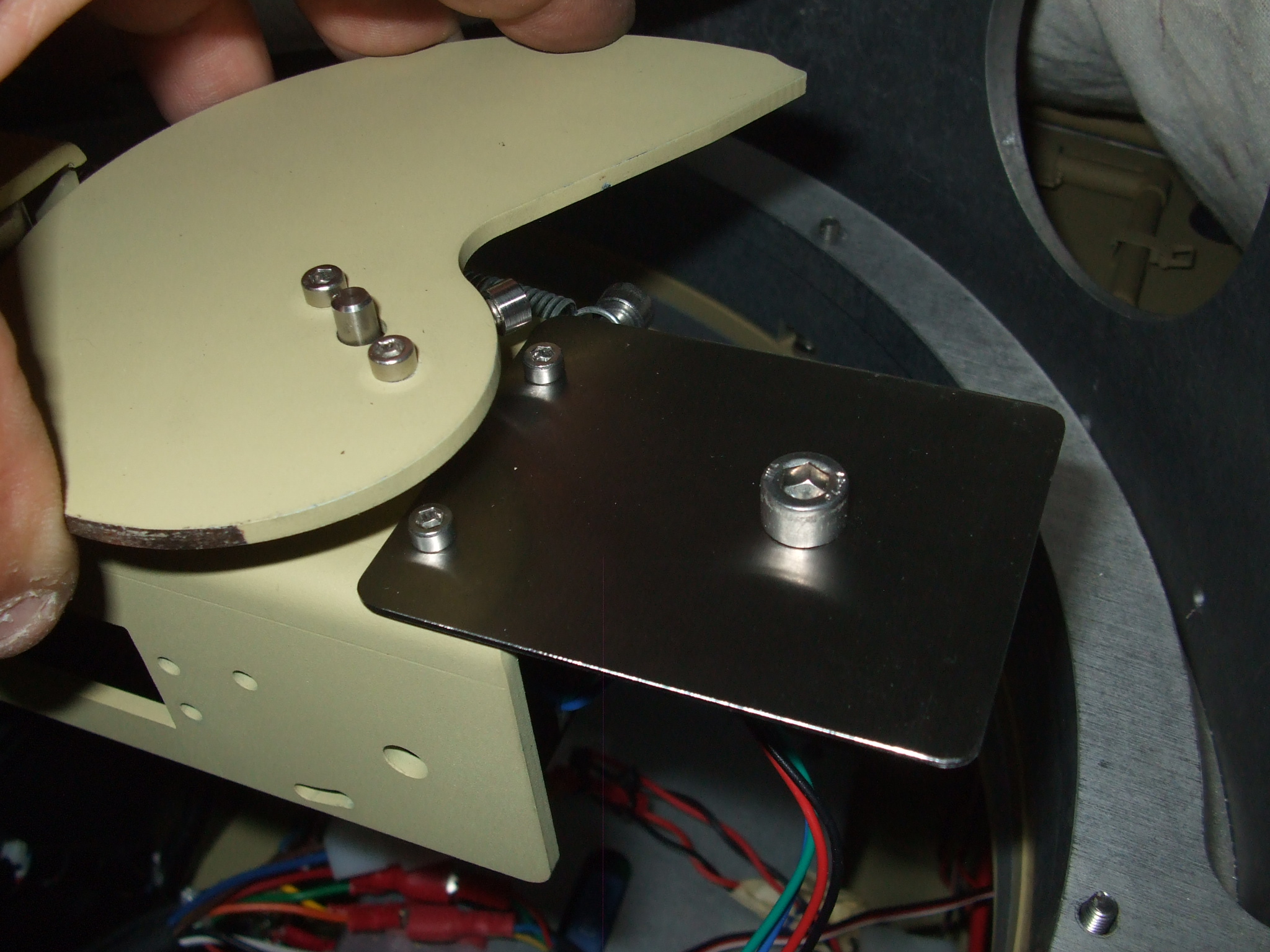

Added a stainless plate to the rear of the recoil bracket so that later on I will bolt a lump of metal below it to act as a counterweight to the barrel.
I guess now is a good time to start painting the turret and mantlet. I am going to leave the barrel components till last. I am thinking of adding a rifled barrel insert to the muzzle brake and asked FOI for the outside diameter of their insert but seems they are not interested as they have not reponded.
