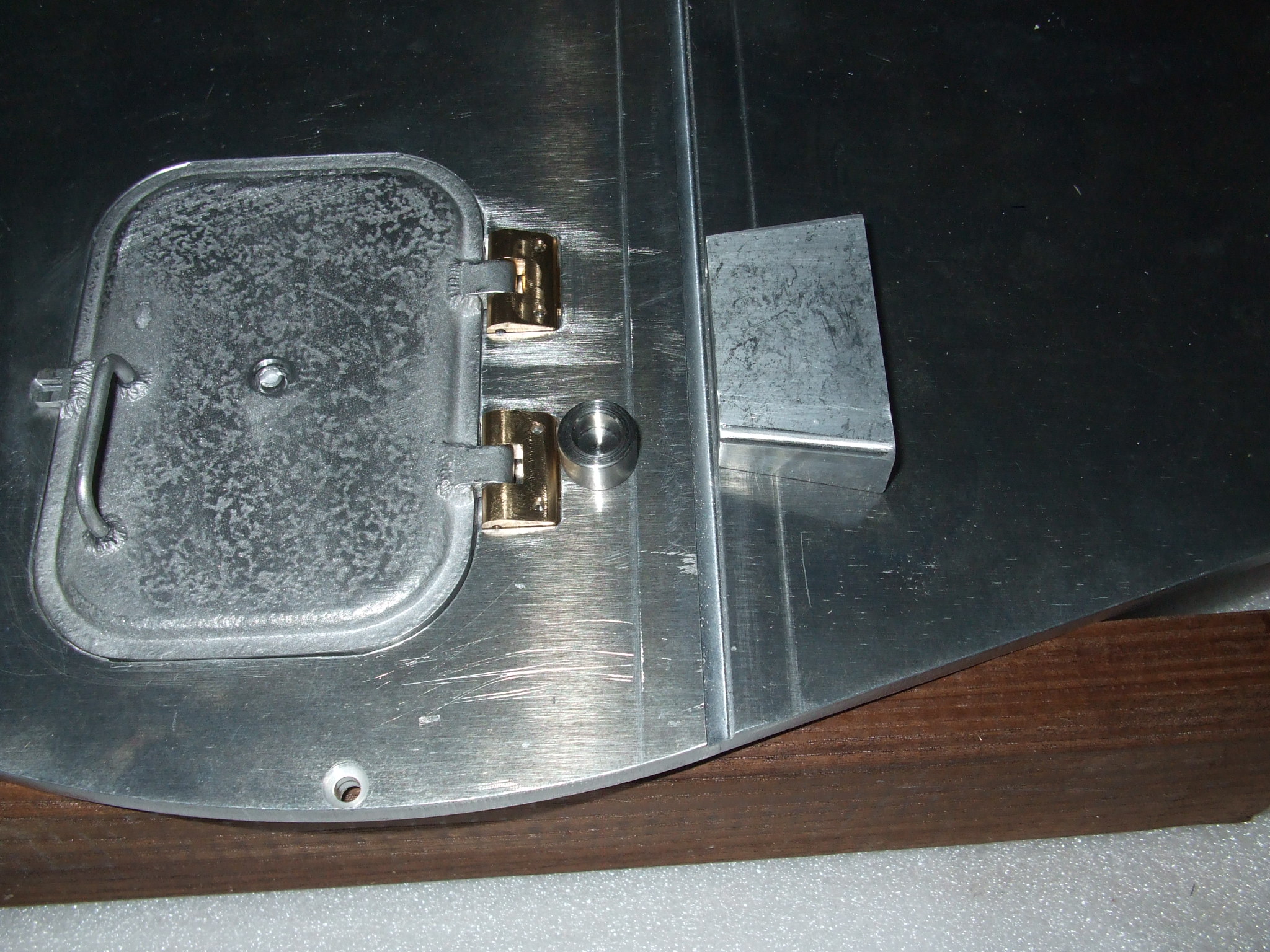

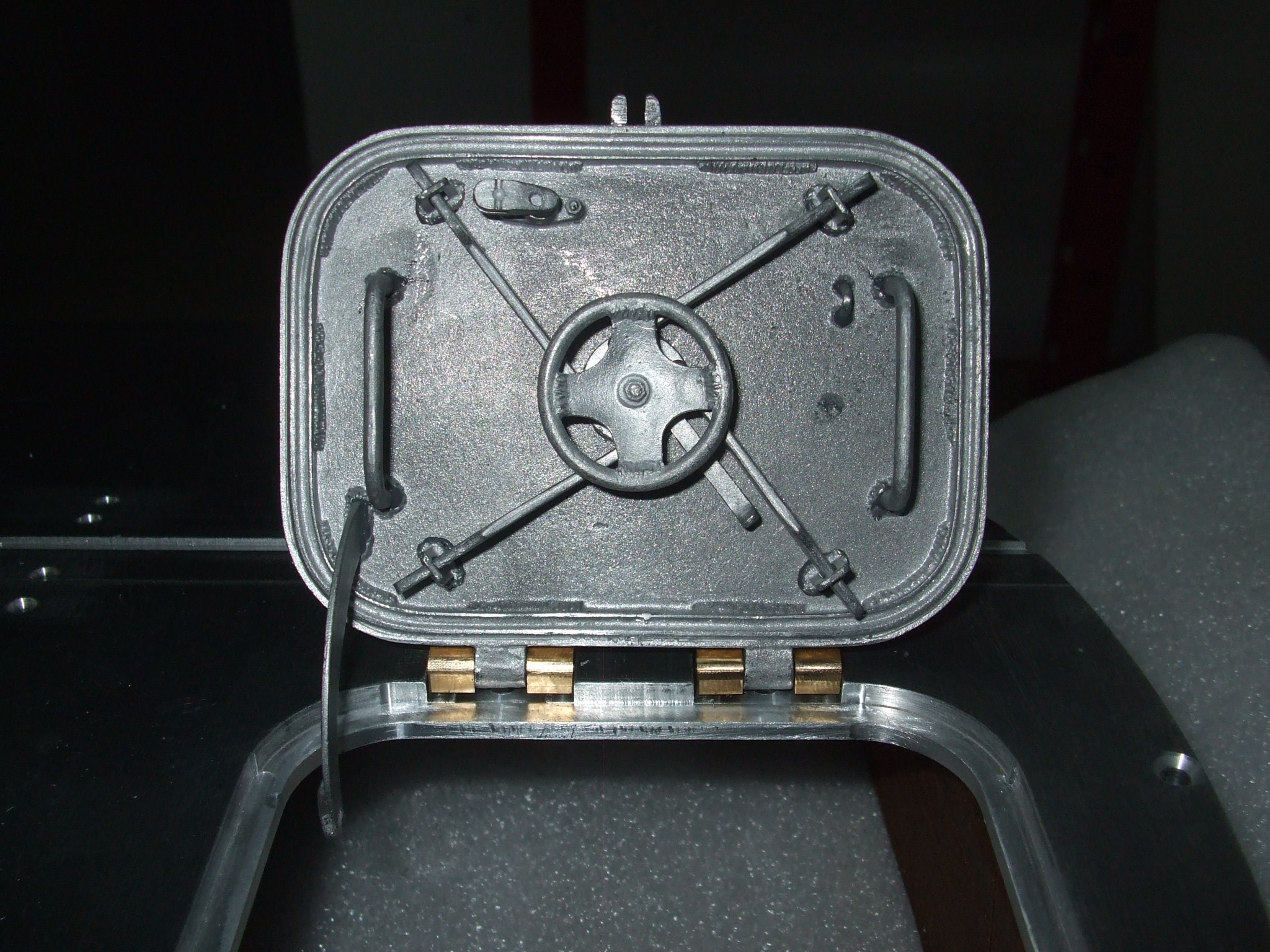

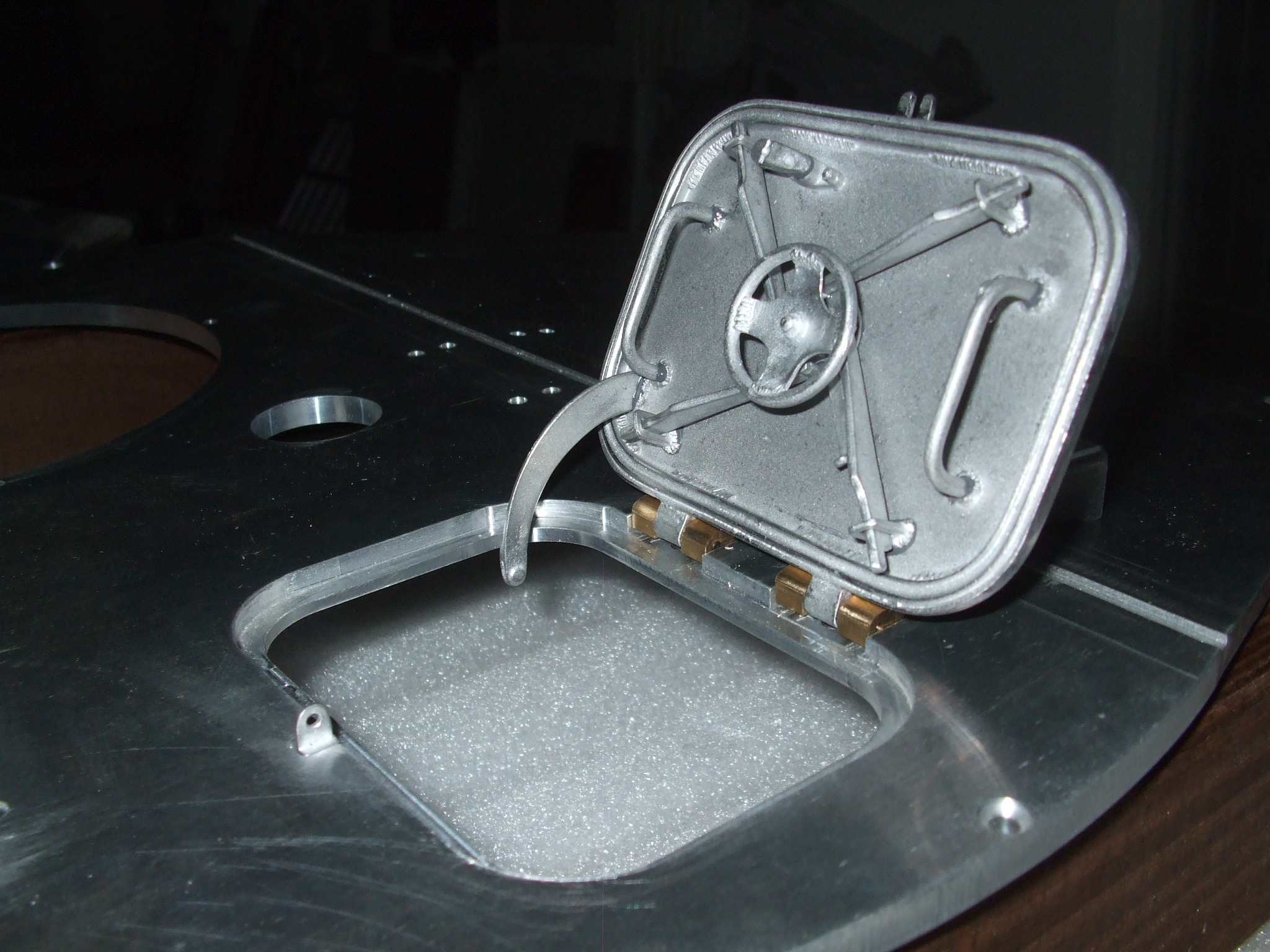

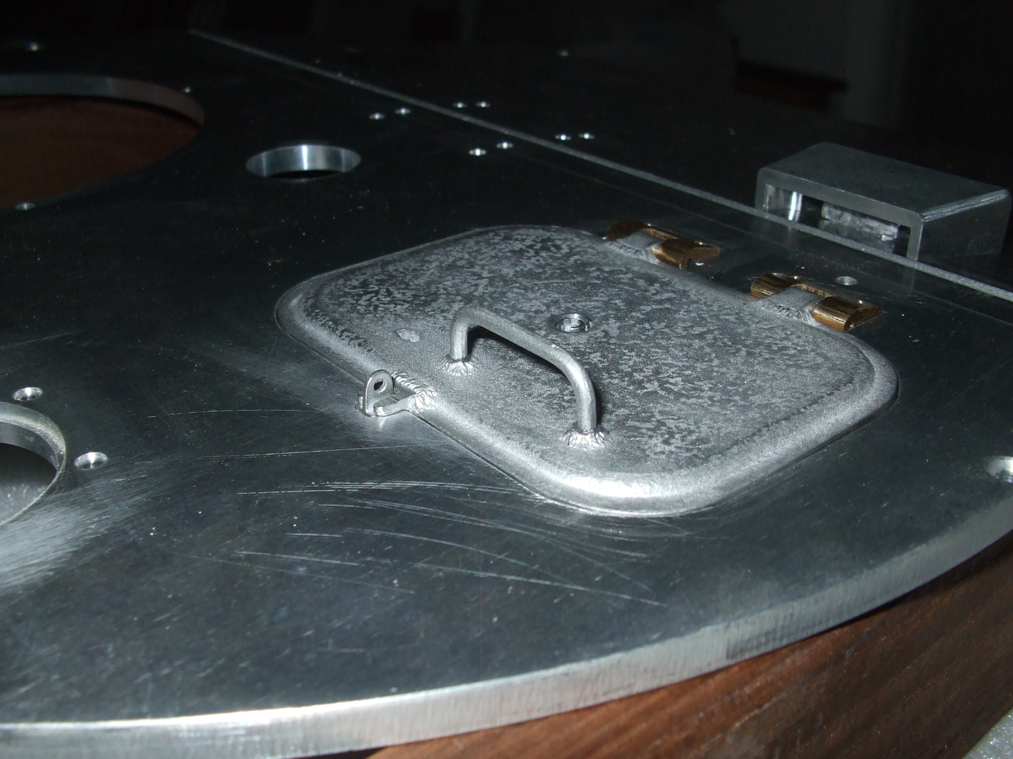

Finished the loader's hatch brass hinges. Also assembled the Armorpax loader's hatch. Cut a hole in the turret roof for the loader's periscope.
Trial fit of the loader's hatch and periscope:

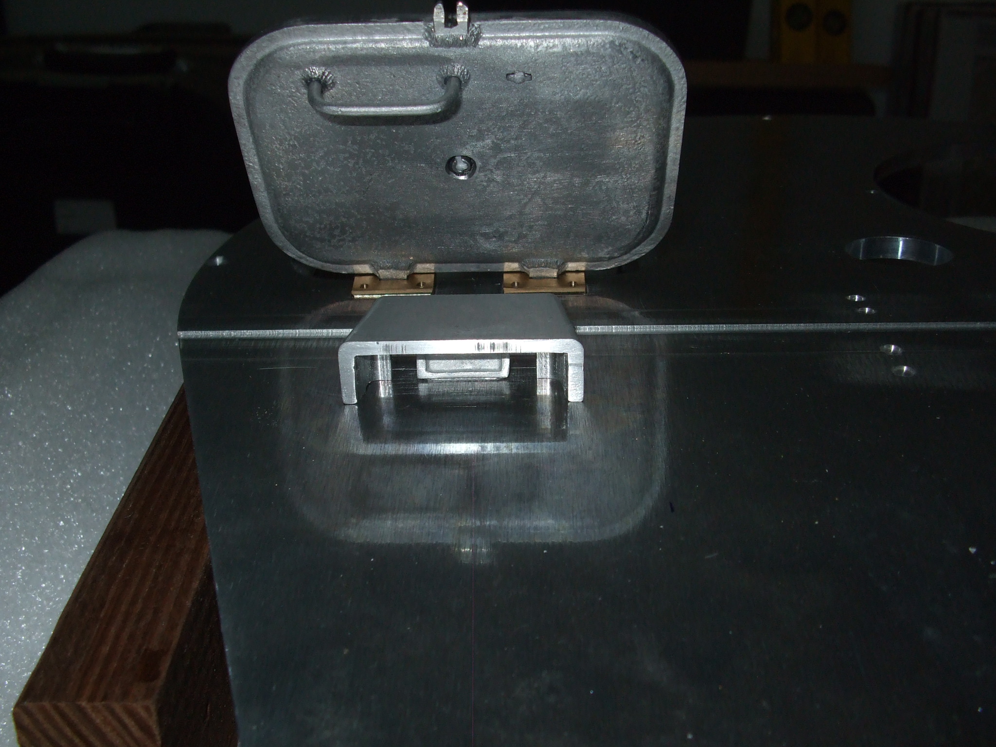

Now that both the hatch and periscope guard are in their final position, I added the turret crane boss between them to see how it looks. I think I need to move it a little forward as it's too close to the hinge.

I have moved the turret crane boss which is in front of the loader's hatch a bit forward. The one in front of the cupola backwards and sideways. In the process of painting the parts of the turret roof. I still need to figure out how to invisibly attach the turret roof to the turret. The rear turret crane boss will be one of the attachment points and was thinking of using magnets at the front but now having second thoughts about using magnets. I am assuming that when using magnets, one has to literally yank the roof off which could damage the turret roof weld seam. So at the moment I am at a standstill.

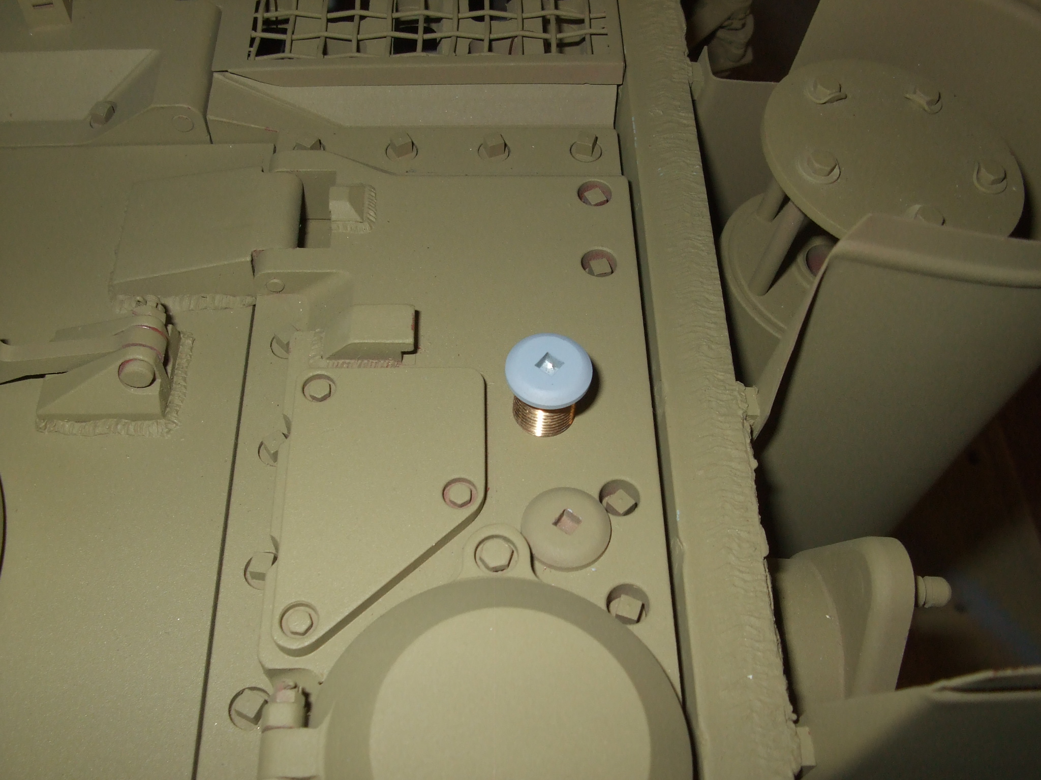

Came across all the parts that I haven't used. Someday after the build is finished I need to dispose of them. One of these parts was the small filler cap for the rear engine deck. I forgot I had it. I had bought one extra before I modified mine just in case the alteration did not work out. So to pass the time, whilst thinking of the turret roof problem, I modified this one also to have a square hole.
Larry, if you want it, send me a PM.

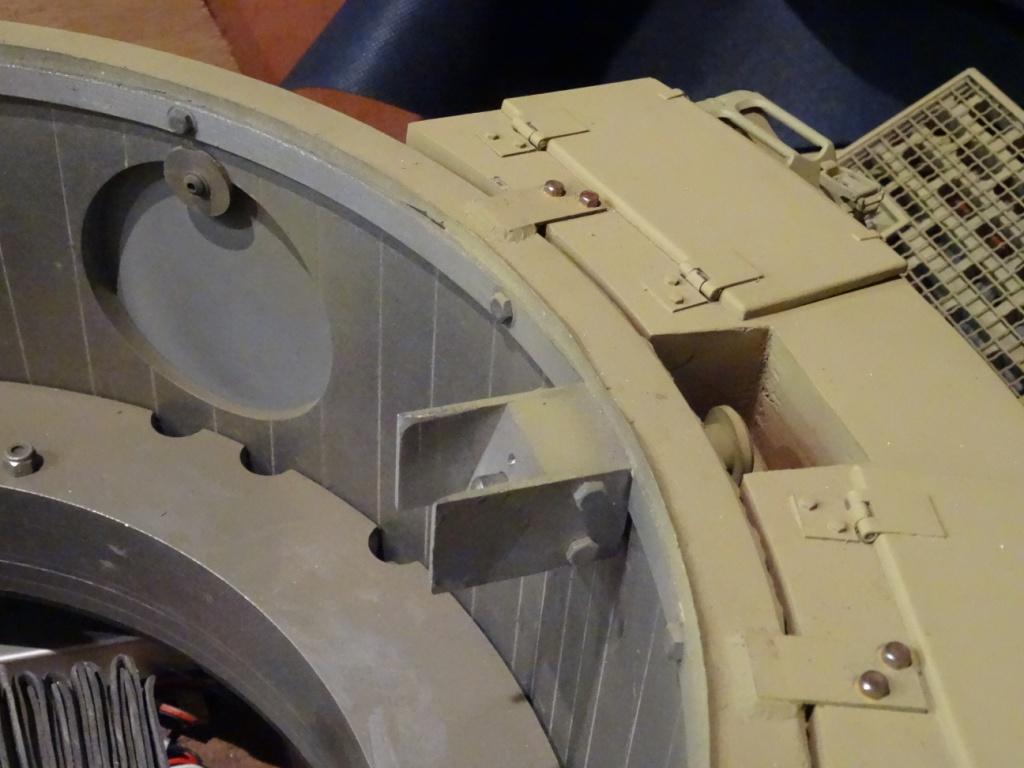

At the front edge of the turret I cut slots into the two kit supplied brackets. These engage with two flanged pins that are screwed to the underside of the roof. At the rear I added a wedge shaped block which is flanked on either side by strips of alloy. This aligns with a corresponding wedge shaped block fixed to the underside of the roof at the rear. When closed, the two wedge shaped blocks are locked together by a spring loaded plunger attached to the rear lifting boss. The two kit supplied central support block were also added to provide support to the middle of the roof, but weren't fixed to it.
To fit the roof the front end is angled in first so that the two front pins engage in the slots. The rear is then lowered down into position. The two strips either side of the rear block engage with the corresponding block on the roof and guides it into position. The combination of the slots at the front and the rear guide make sure that the roof comes down squarely with no chance of it moving sideways and damaging the delicate milliput welds around the edges. To make removal of the roof easier, before adding the fake welds I put a slight chamfer on the side edges of the roof. Also I temporarily added a strip of sellotape to the roof edge so the milliput weld would not stick to the roof and to give a little bit of clearance in use.

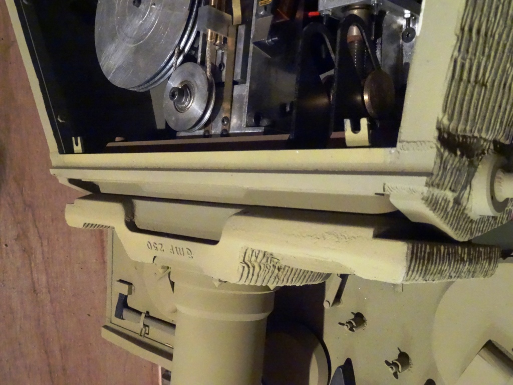

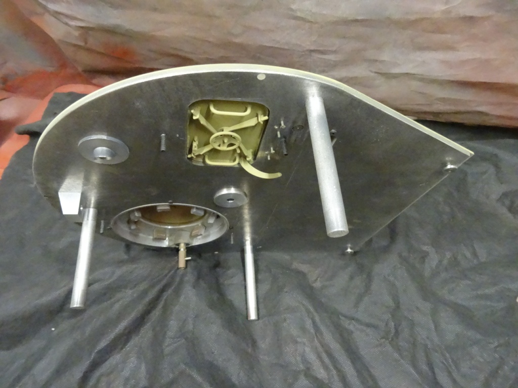

Some more progress on the turret roof. I decided to attempt using David's method to attach the roof to the turret and happy to say that it worked like a charm.

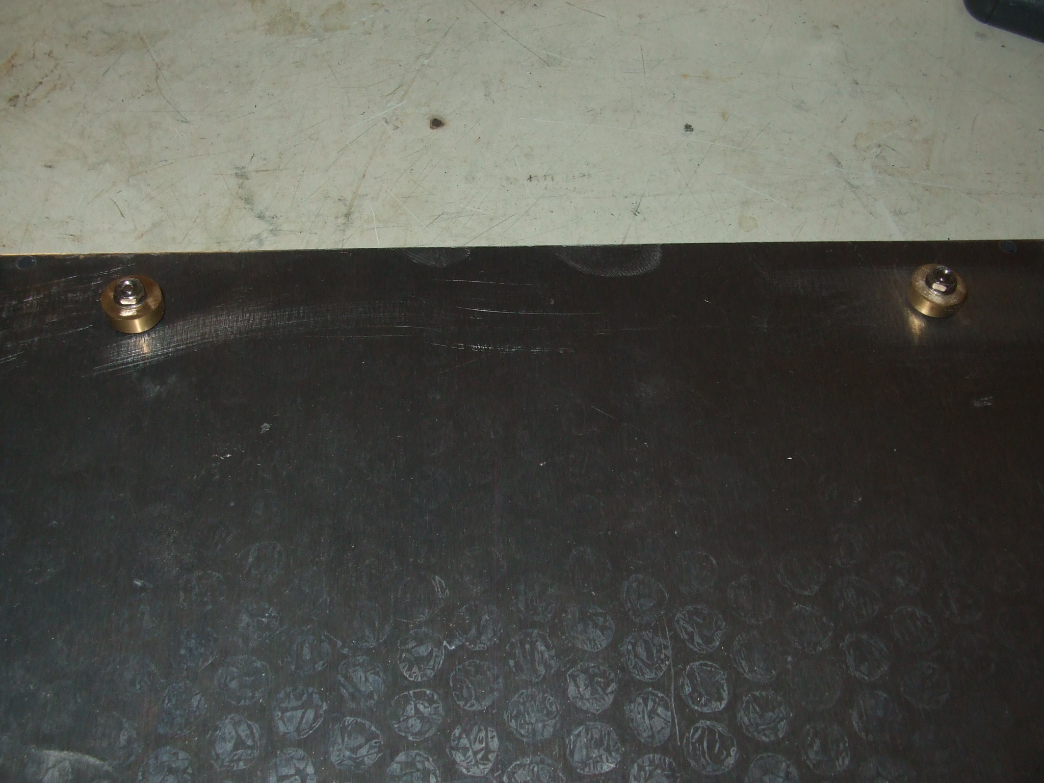

Made two brackets for the front of the turret,
and two brass "thingies" that are attached to the bottom of the roof.
Now the turret roof can be slid forward and held by the two brackets. At the back of the roof I am using the existing attachments for the turret roof crane socket.

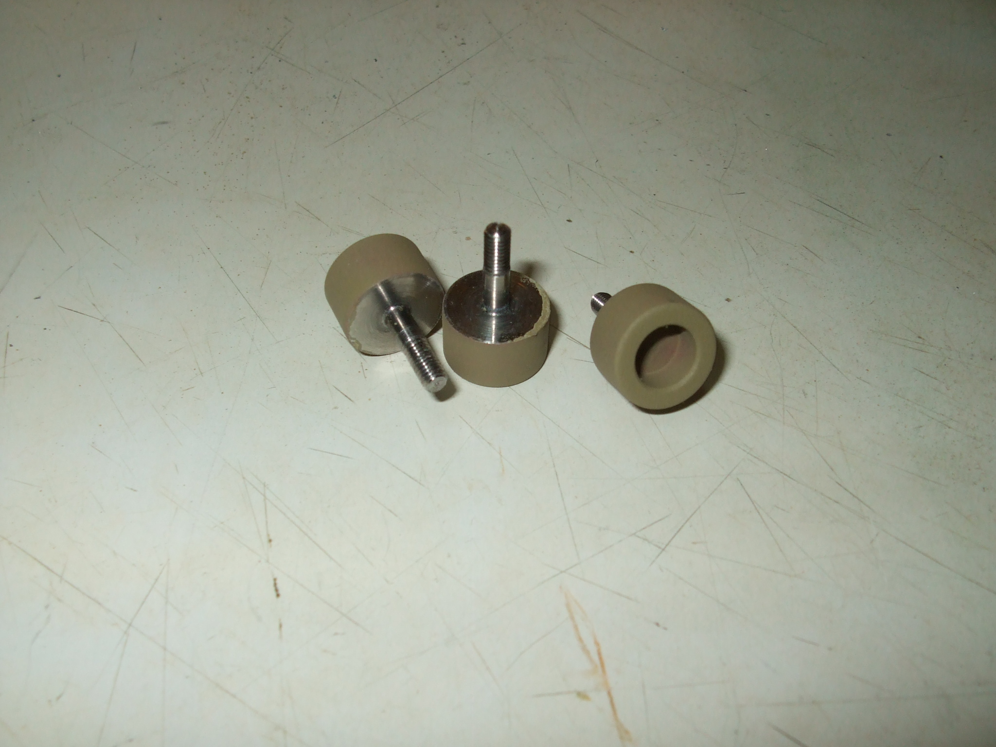

I also liked David's idea of using "legs" and made three up from brass rod.
Two of them are held by my custom made turret roof crane sockets which I made some time ago.
Nearly finished with the turret roof. At the moment applying some aluminium putty to the sheet metal bender marks in the hope that I can hide them and then painting.

Maybe this photo from below with the roof attached will make more sense.
