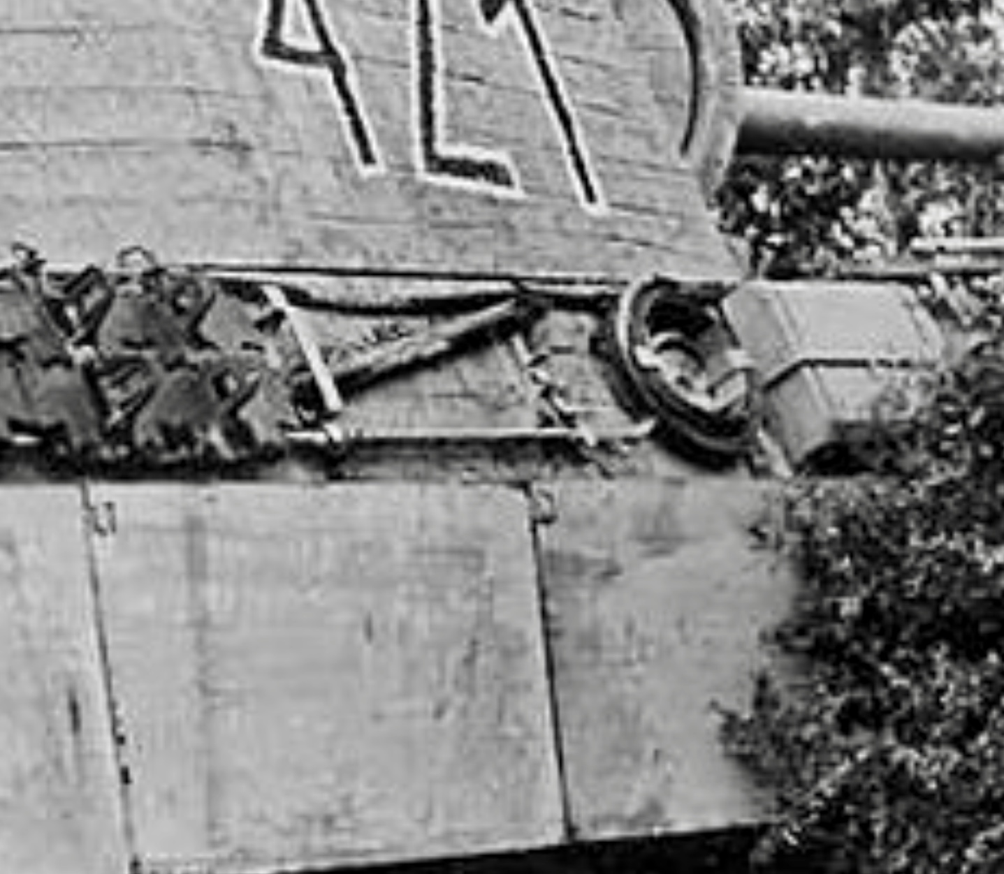

Sadly have none or has not seen any good photo of a confirmed Tiger1 crow bar.
Still an Enigma so thank God there is still something new to learn about our tanks... :D
Yours look a bit to short in my eyes.
6th Scale inc Mike got his Tiger2, JT and Sturmtiger pry bar correct but not his Panther one, photos confirm this.
The Panther one was more like his Sturmtiger one rounded with one flat/flippad end and the other as a sharp cone.
Well that was the Panther, another story but might give a hint....

Thanks Kent for your input. Much appreciated.
So decided for now to keep the current pry bar. I might for fun do the other type of pry bar from round brass or steel stock.
Has liked: 792 times
Spent the day painting some parts of the cupola. Noticed that after painting the cupola and the hatch with etch primer and red oxide, the hatch would not fit anymore in the cupola. I suspected this was going to happen as prior to painting the hatch fit snugly in the cupola. Reduced the diameter of the hatch slightly and am now repainting the edge of the hatch again. Will test again when basecoat applied.
I have also been researching the pry bar.
I have found a reference in the book "The Modeler's Guide to the Tiger Tank" on page 96 to three types of pry bars.
1) Early long
2) Late long (also called reinforced)
3) Early short
There is a photo of these three types (admittedly of Tamiya model parts) and the Late Long type is shown with the front part square and the rest round.

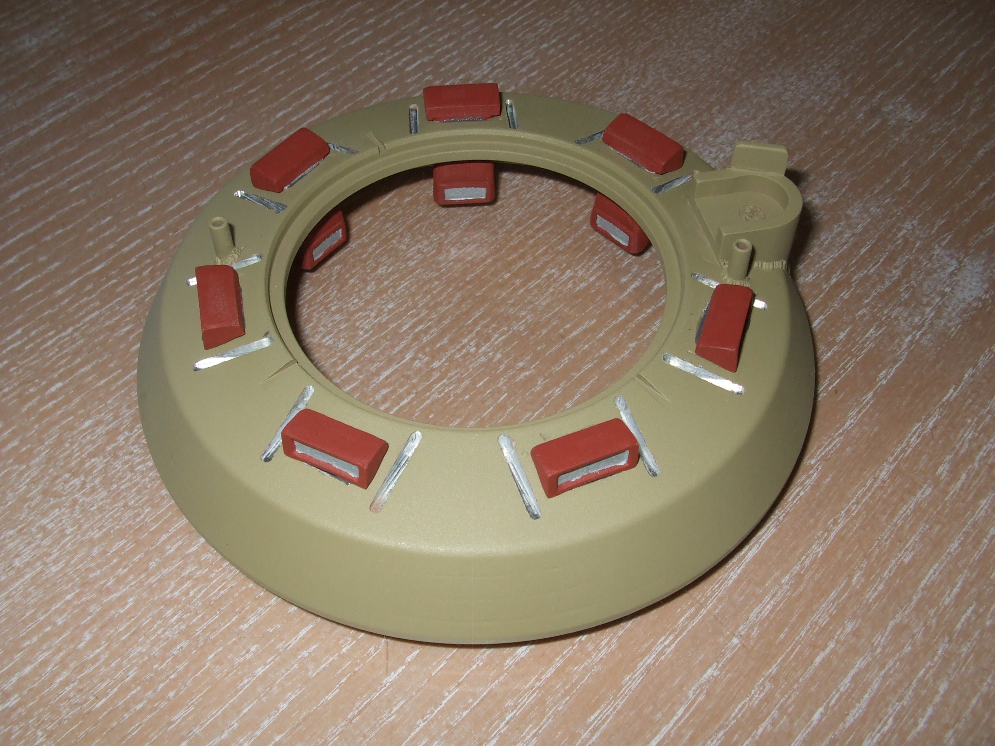

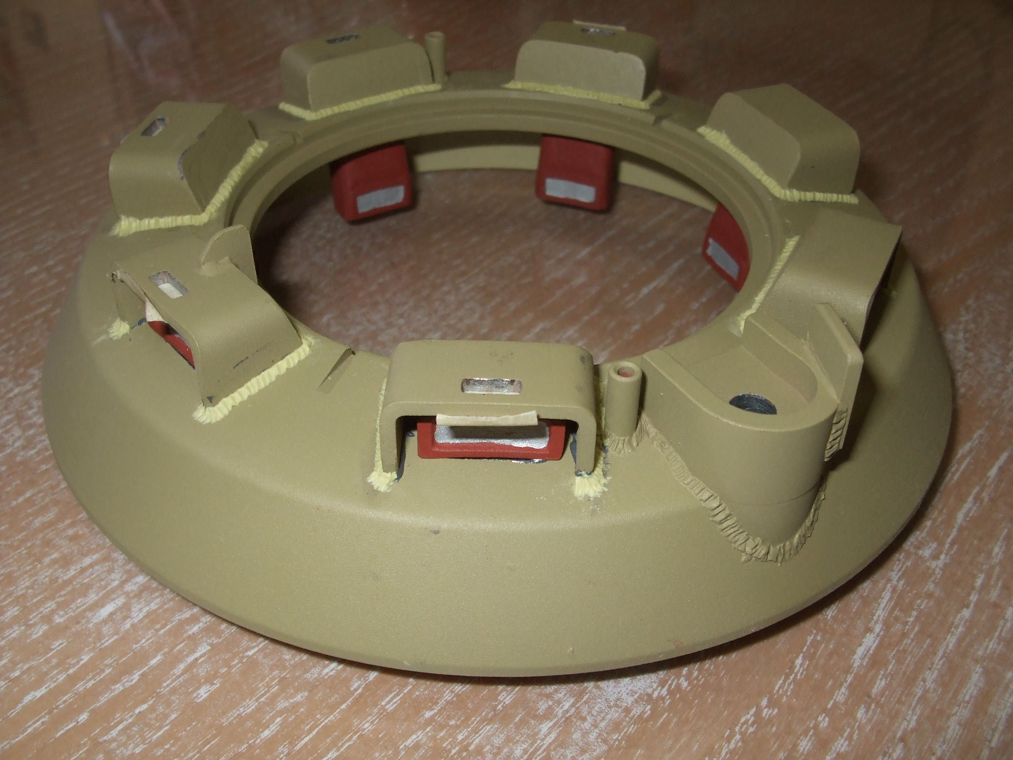

Glued in the periscope covers and thought it would be a good idea to apply some weld seems now before fitting the MG ring.

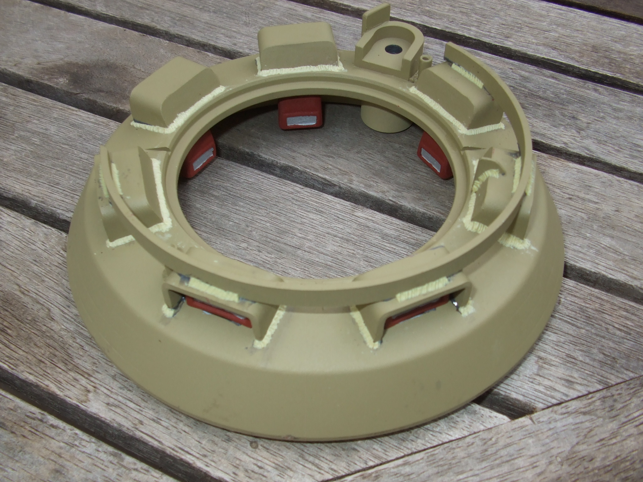

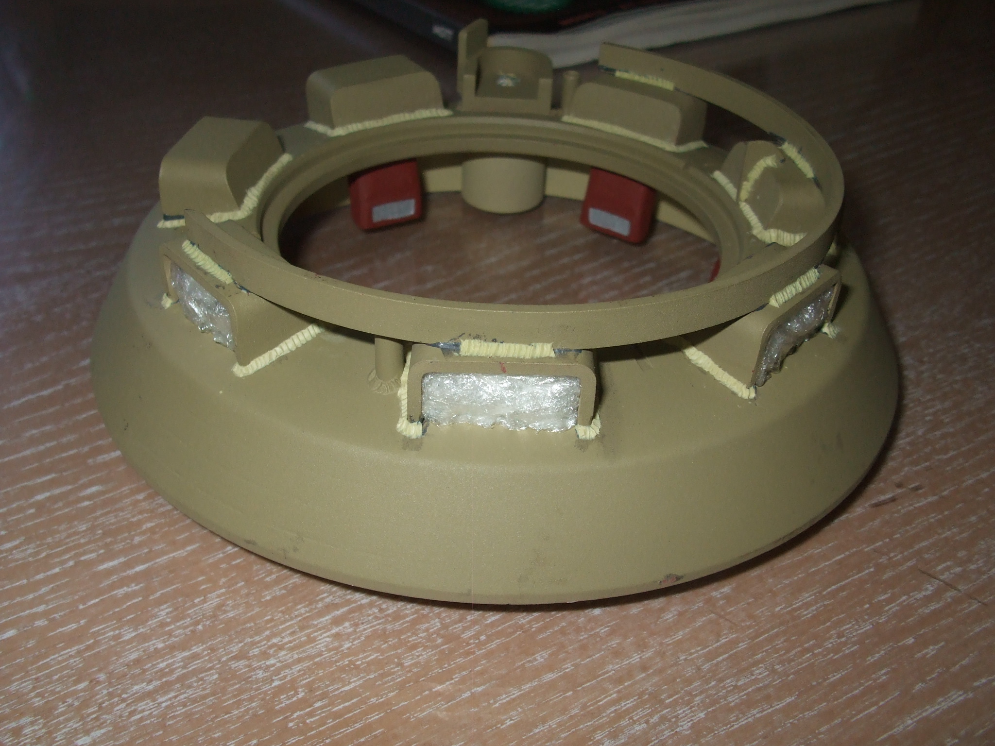

Glued in place the MG ring. I am using two-part epoxy. Used it also for the periscope guards.
Clamped between two pieces of wood
After 24 hours removed the clamp and added the weld seams.
Weld seams added to MG ring
Now to wait for the Milliput to dry and paint the seams. Before that I packed the periscopes with kitchen cling film to protect the periscopes from the paint.

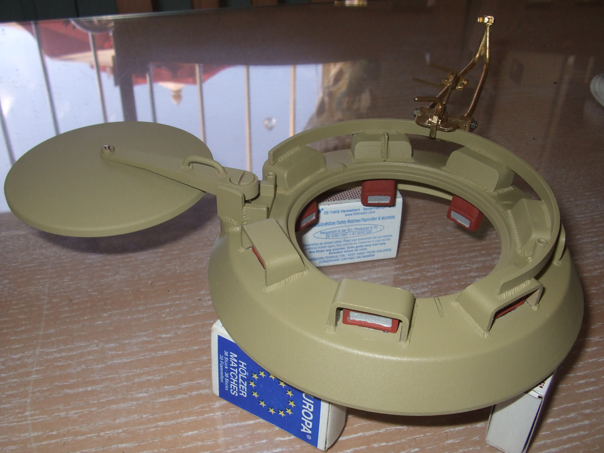

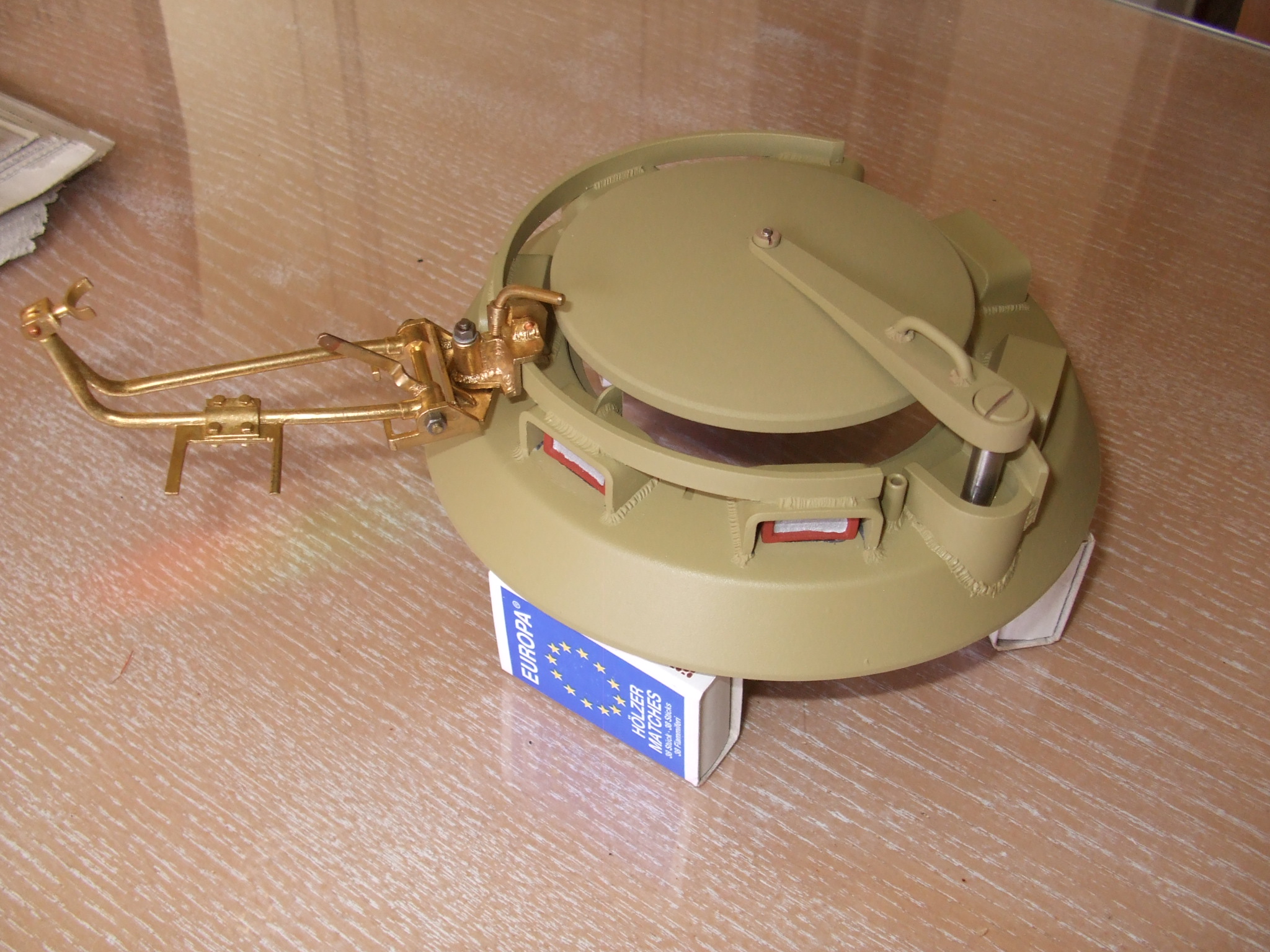

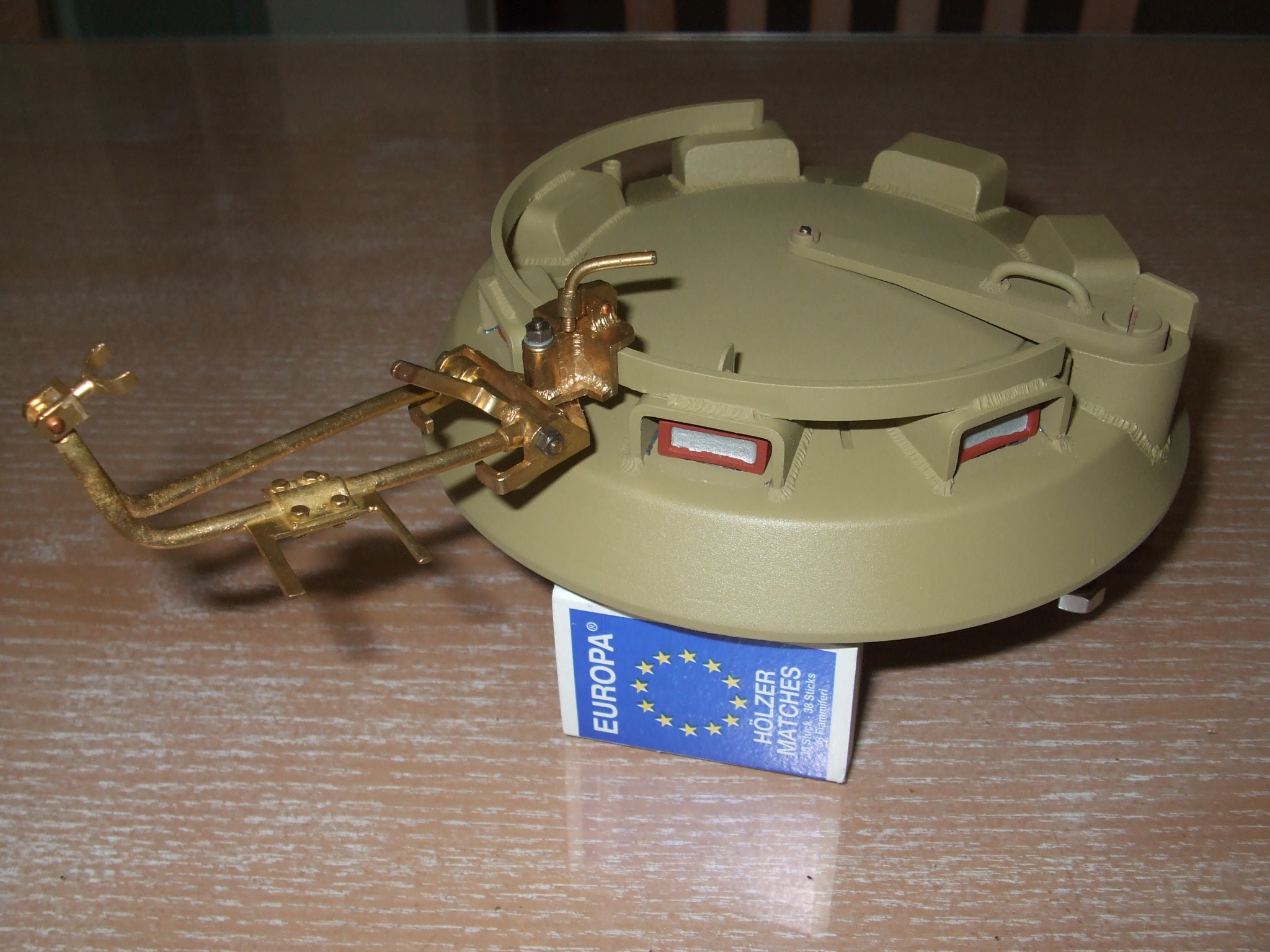

Ta-da. Cupola finally finished! Took some photos with Mark's excellent MG cradle. All it needs now is an MG34 but one from Armortek is winging it's way to me. In their latest newsletter they had some for sale.
Hatch closed
Hatch closed
Hatch fully open and held by stop
Hatch held ajar with other stop
