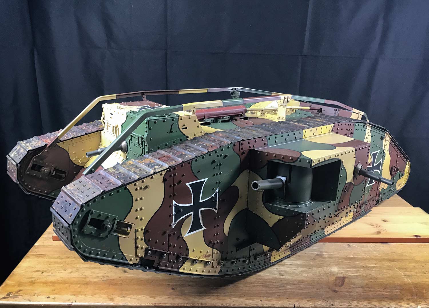

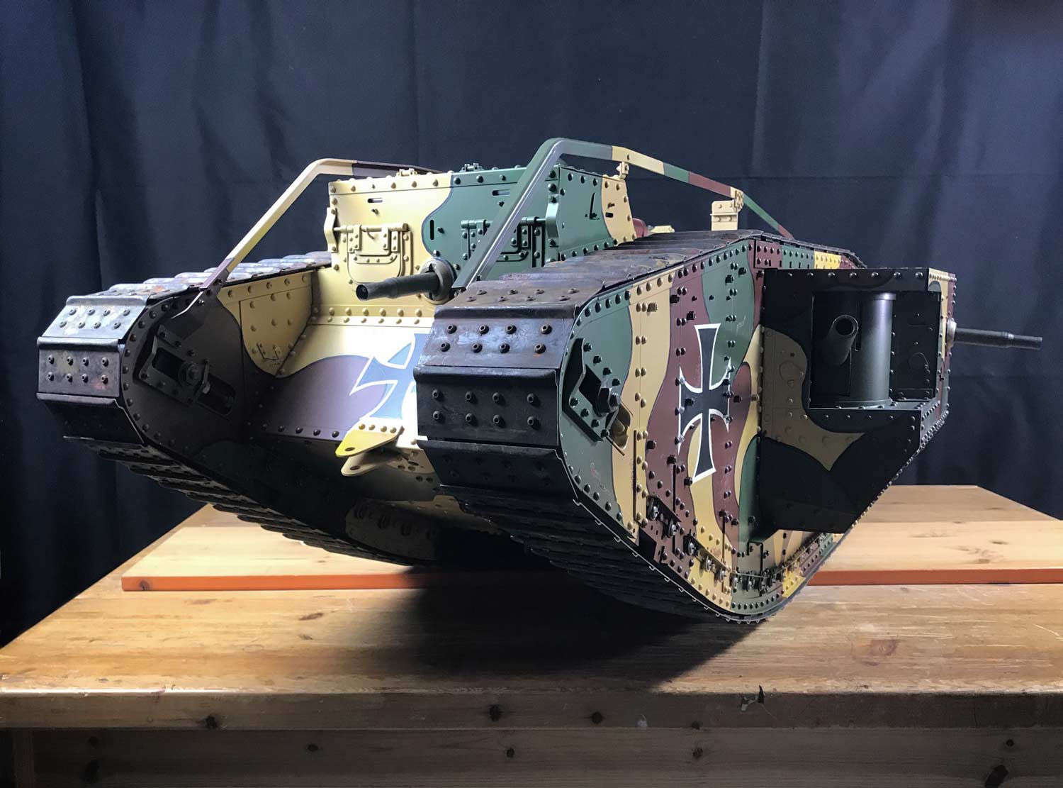

Very very nice indeed and probably one of the best I've seen.......now wether to weather, I think you should start with a wash?
- Posts: 223
- Has liked: 551 times
- Been liked: 409 times
Re: Schwerer Panzerkraftwagen
Thanks Phil for the very kind compliment.
The wash was the chosen solution but I combined it with a postshade to give the rivets an other details a very subtle accentuation.
You feel it more than you can see it.
Best wishes
Oliver

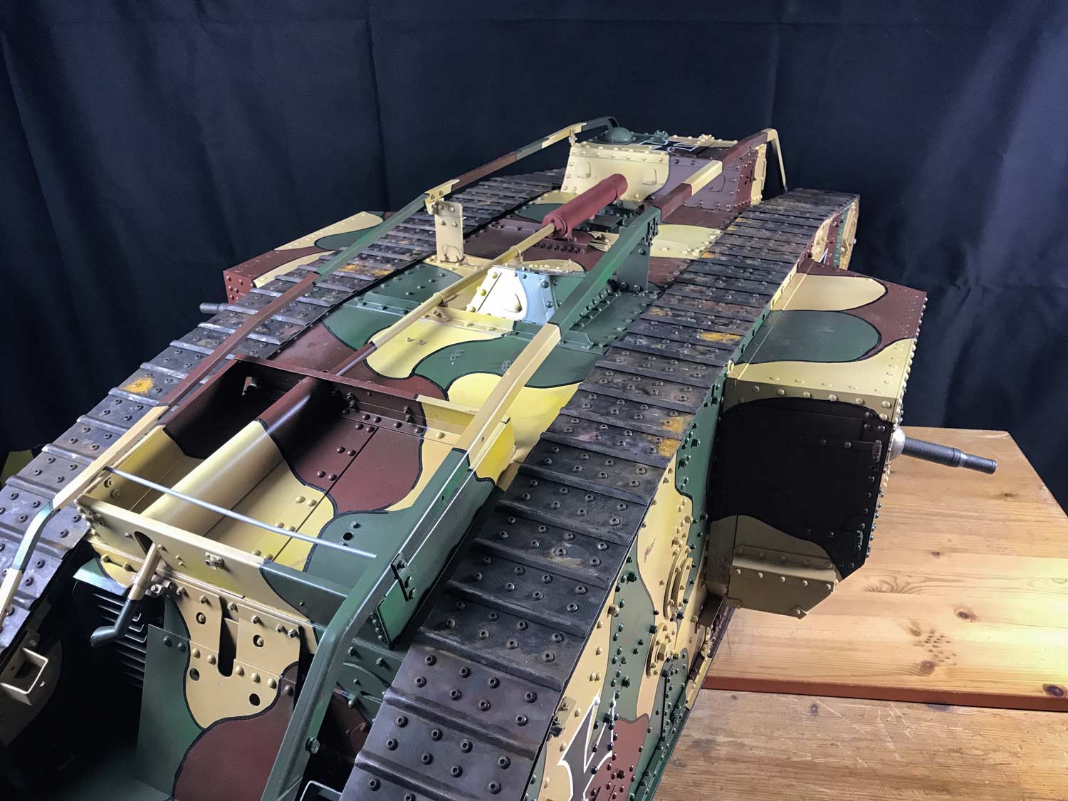

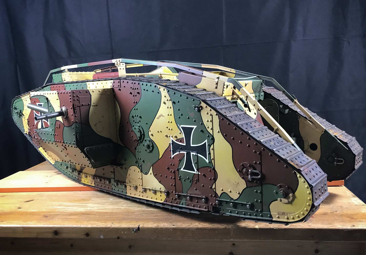

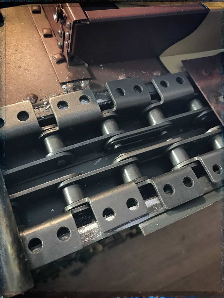

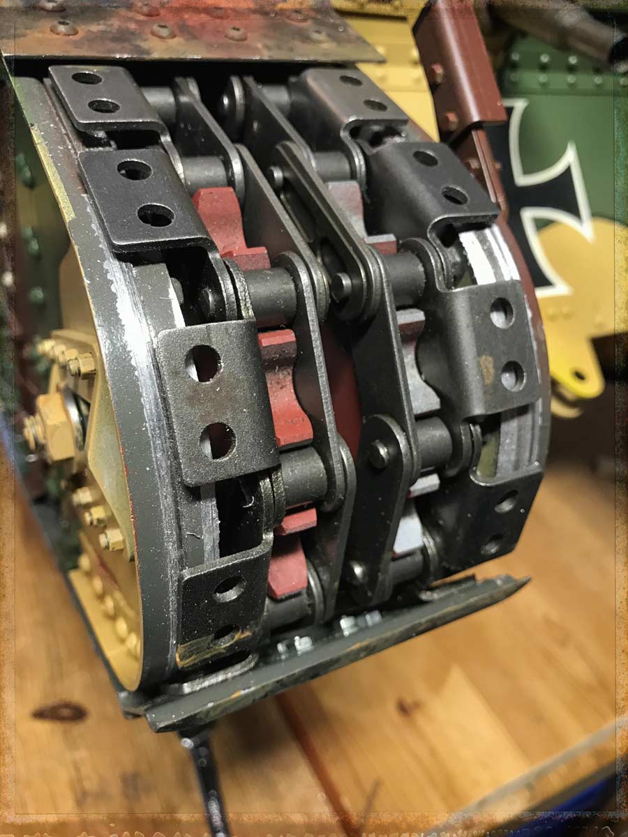

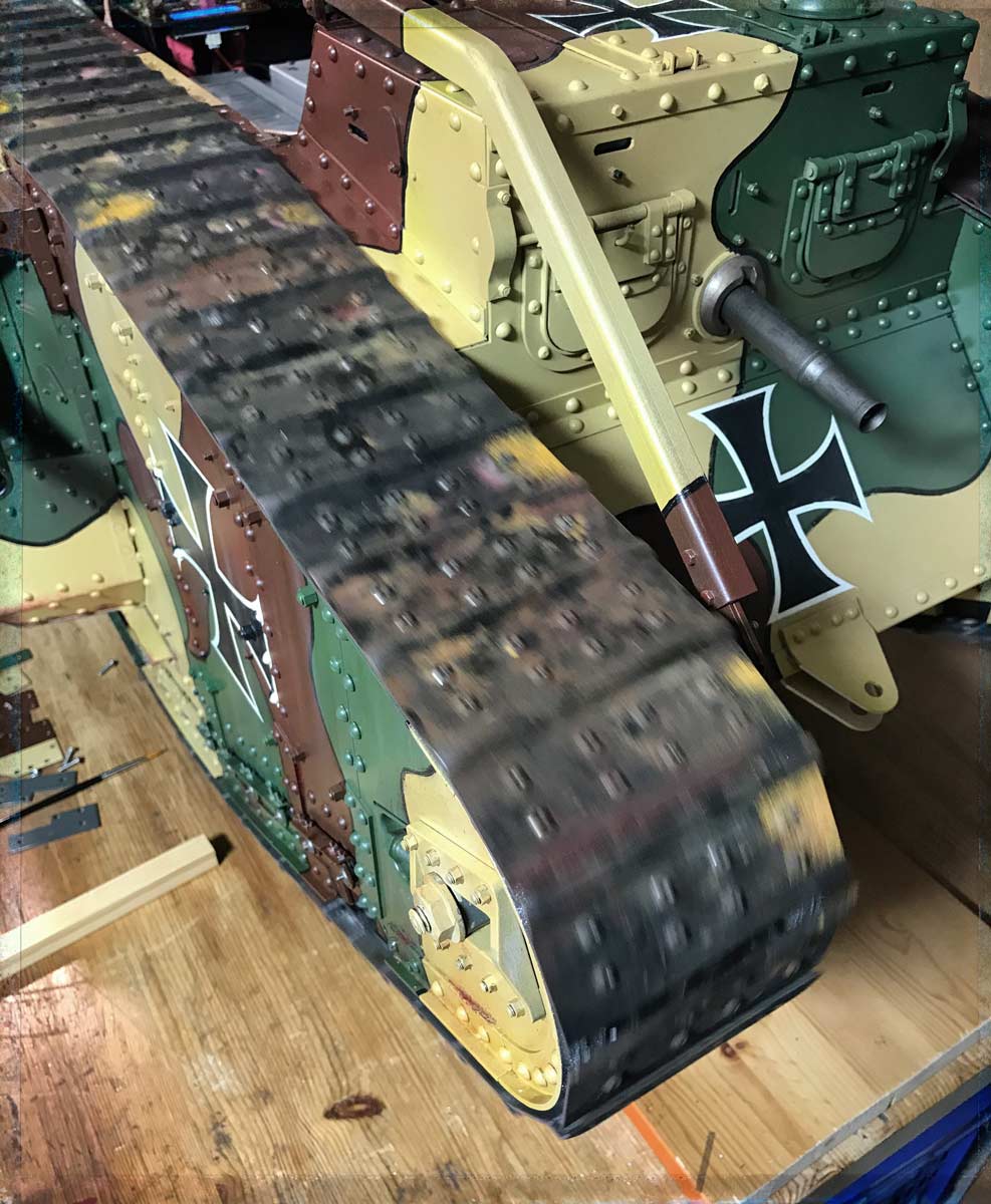

Finally, the time has come! I could put on the tracks.
As already described in the other construction reports here in the forum, this is a somewhat more complicated matter with this model.
The front chain tensioners have to be moved back to close the chains - in the end, every millimeter counts!
With the aged chains, the tank already gets a somewhat better look and gives an idea of the different ways of weathering.
Best wishes
Oliver

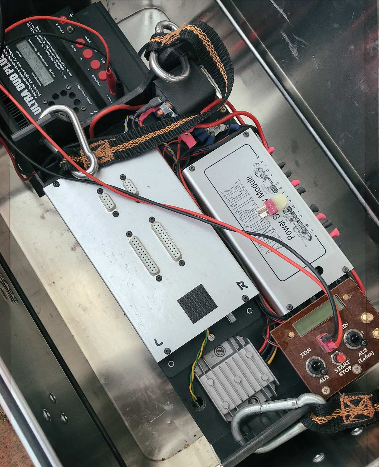

Spin me round – motion testing

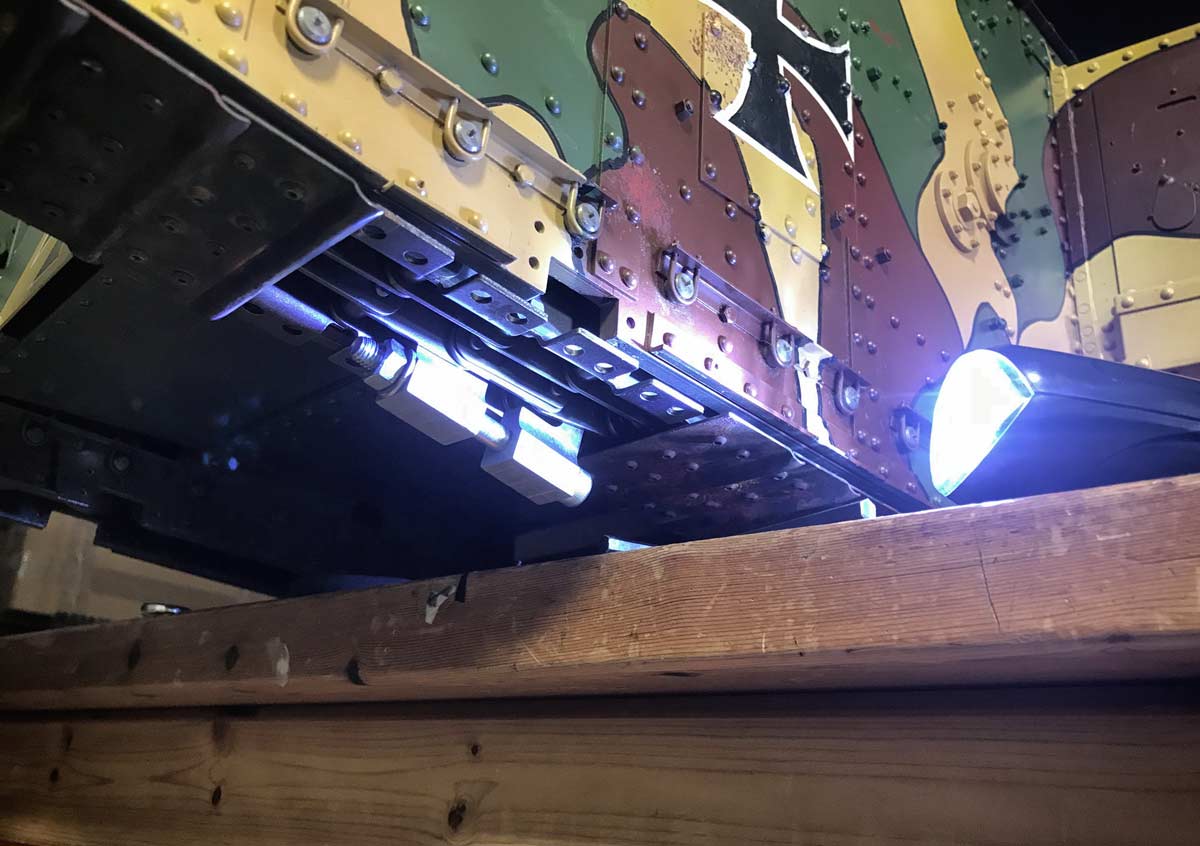

The TechRack was charged and used for the first time. Now, finally, the movement came into the tank. Not yet on the ground but still jacked up, I set the chains in motion. Apart from the usual wear and tear on this model, everything worked as planned. I would love to drive the tank in the wild now, but before that, some weathering should be done so that the chains fit the rest of the too-clean model. So a little patience is still required.
Best wishes
Oliver

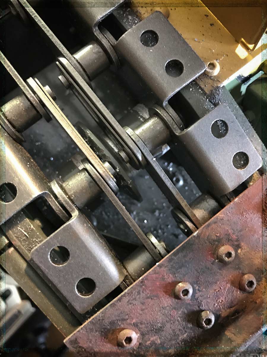

The witness marks. Initially I wouldn't worry to much as once run in a little oil on those areas will help, or you remove a little material with a file.
- Posts: 223
When jacked up, the abrasion caused by the chain is in different places than later when driving.
Then sand and mud will do the rest.

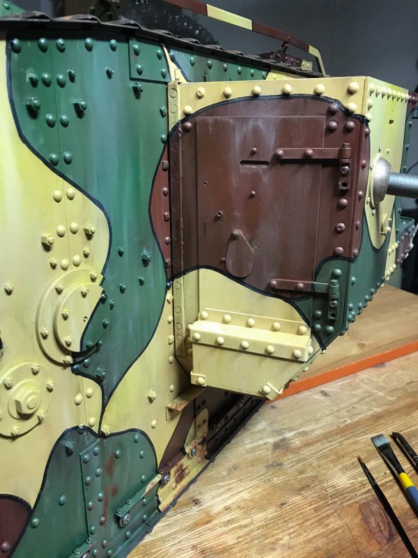

Weathering - my first wary steps of shading

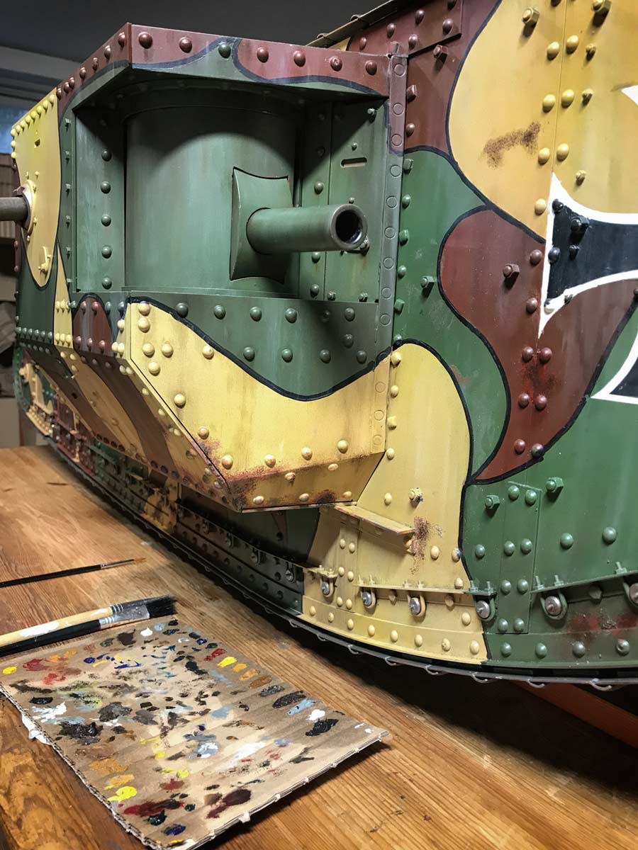

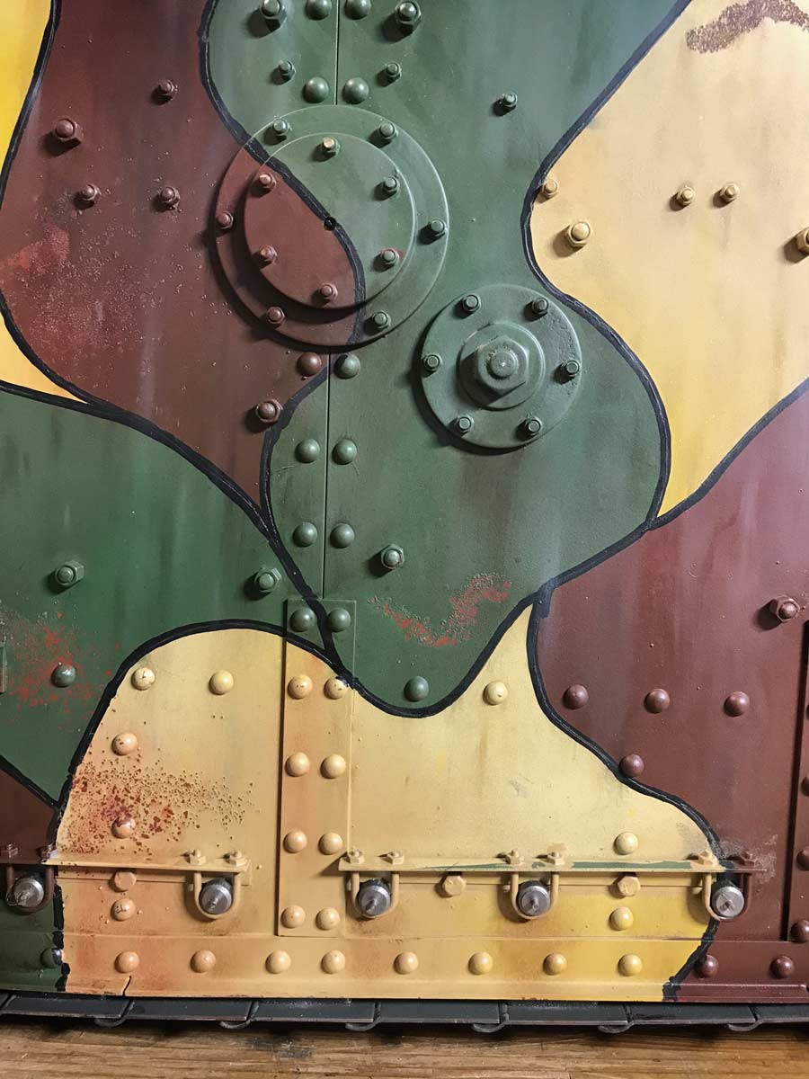

I had already had some experience with oil paints on the doors and decided to get out of my comfort zone and try the whole model.
The first step was careful shading.
Afterward, I applied a very subtle shading to the lower part of the tank and some of the rivet rows with an airbrush.
Oil paints and airbrushes don‘t go well together. But with a few tricks and experiments, they do. A combination of oil paint, a strong thinner of a little turpentine and a lot of isoIsopropanol alcohol and a suitable nozzle on the airbrush did the job.
Weathering the tank with oil paint was so fun that I couldn‘t stop. With the black and white picture, I wanted to check if the tonalities of the colours were going in the right direction.
Best wishes
Oliver

Love the period photo Oliver! A tip to help you with your excellent weathering....gravity will always pull the weathering lines straight down on vertical surfaces, much thought must go into the angle plates for those to be convincing. Wait till you get into " chipping" that's addictive .
Keep it up it looks great.
