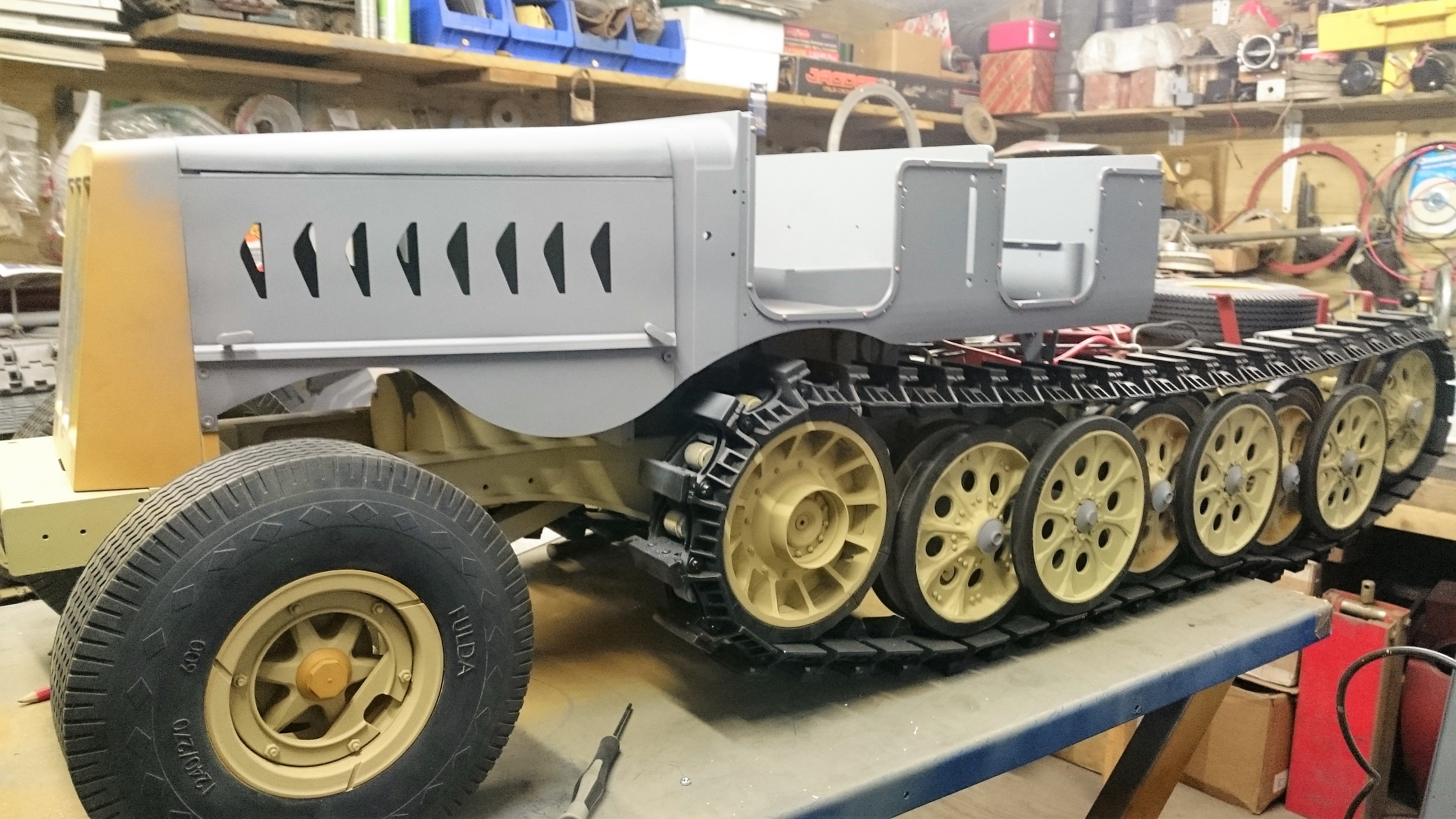

Todays exploits see photos below. Tomorrow the body work.

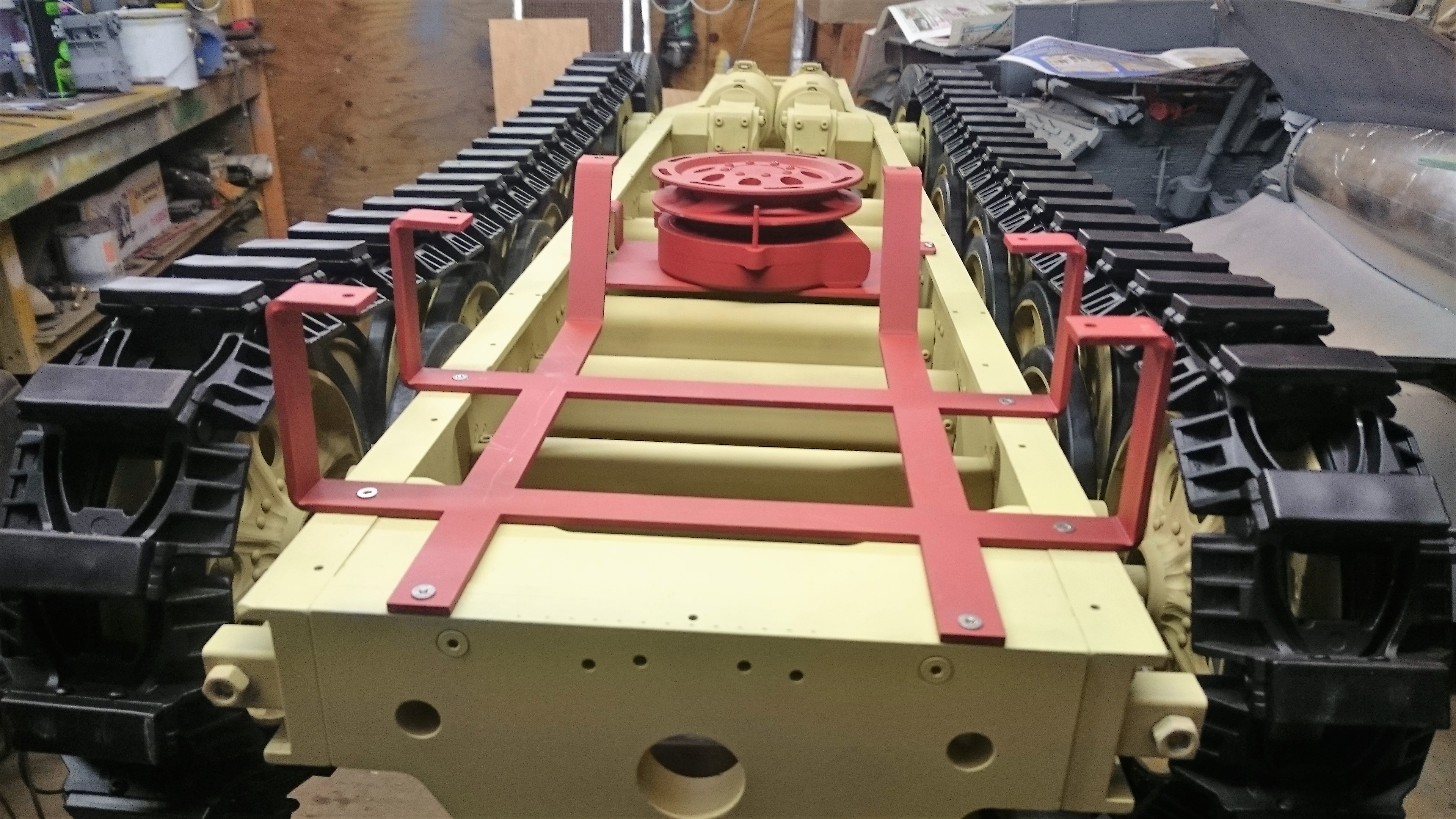

You guys will have to align the wheel nut or you can't screw the hub caps in tight.

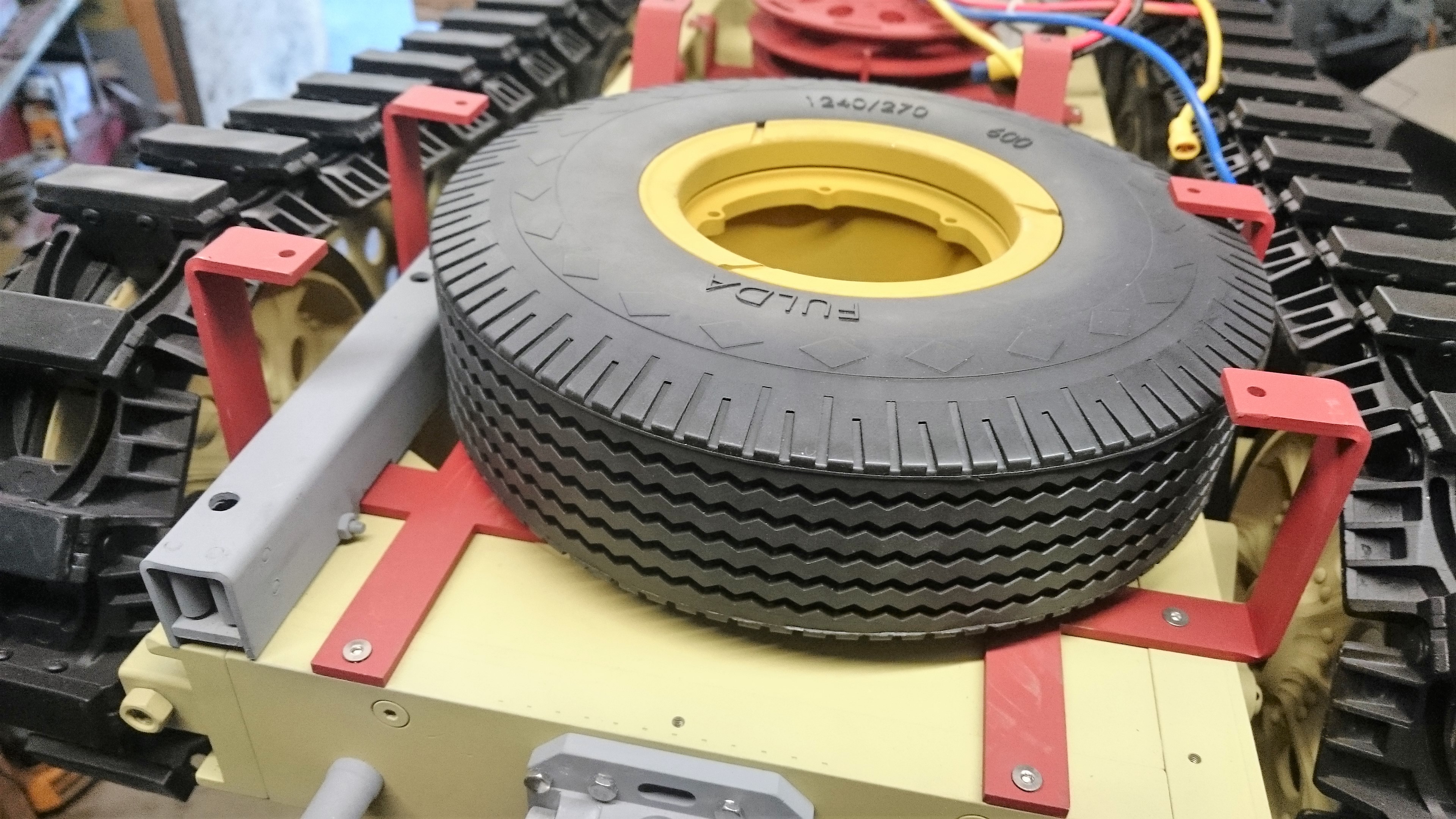

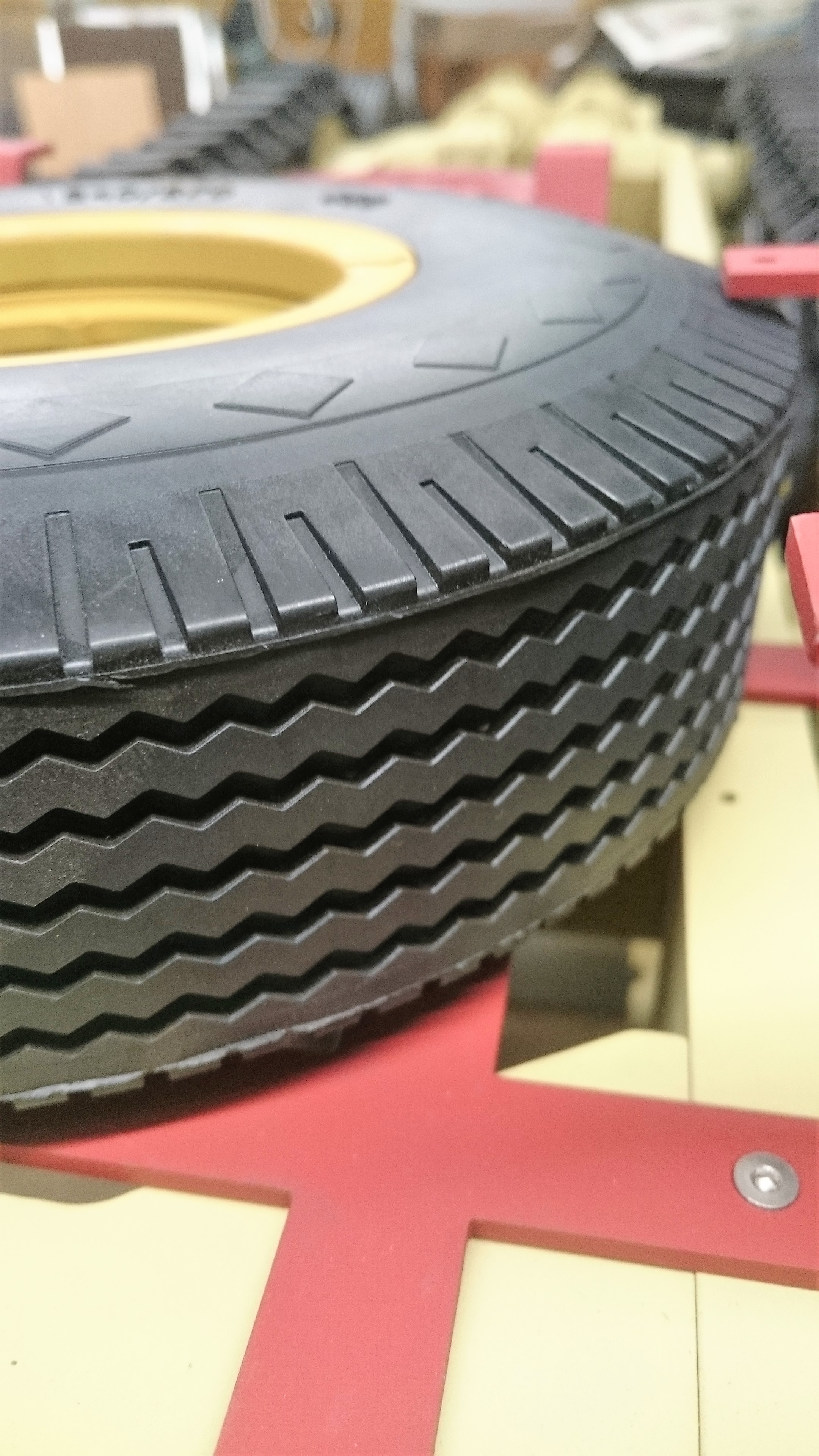

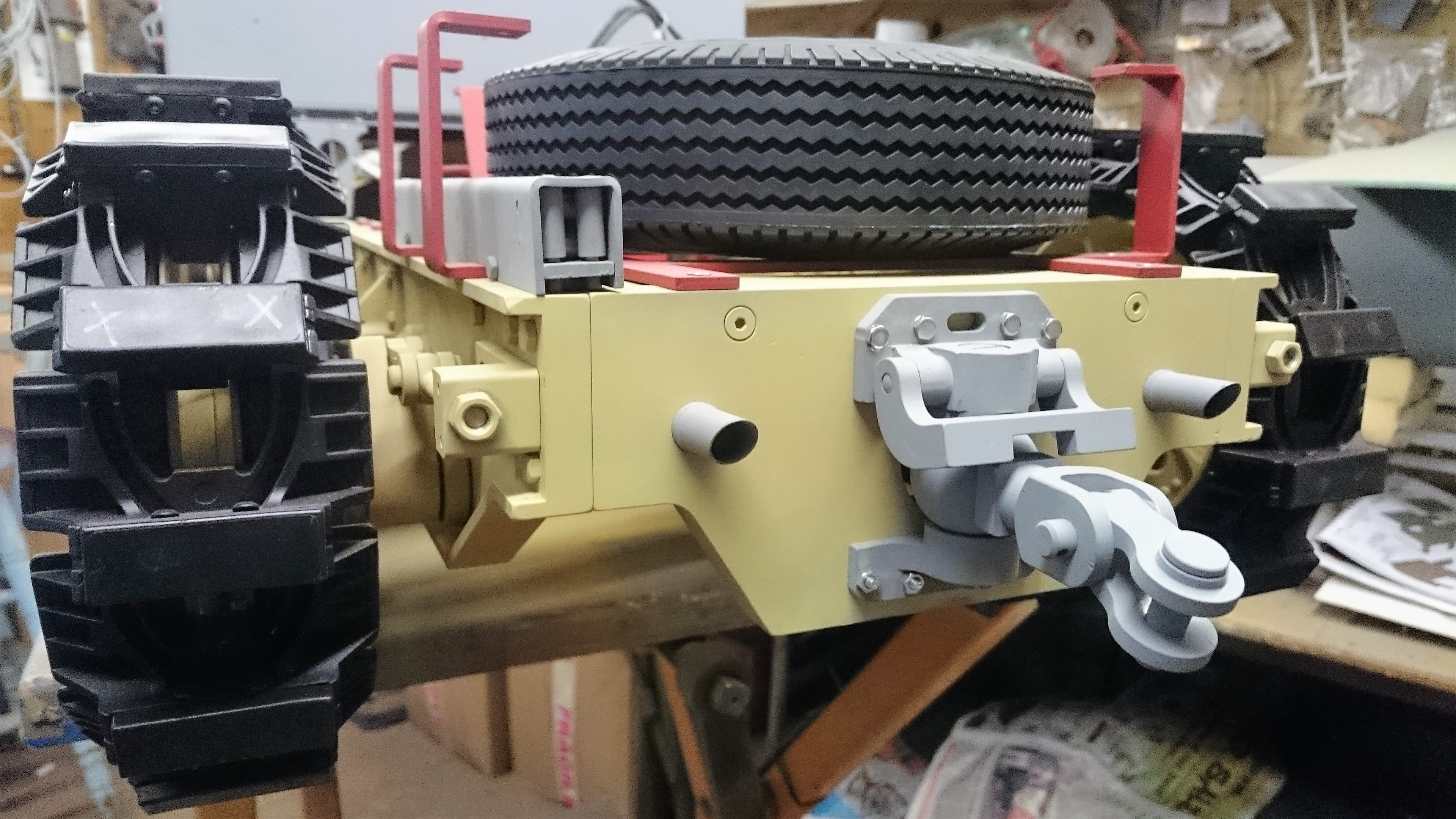

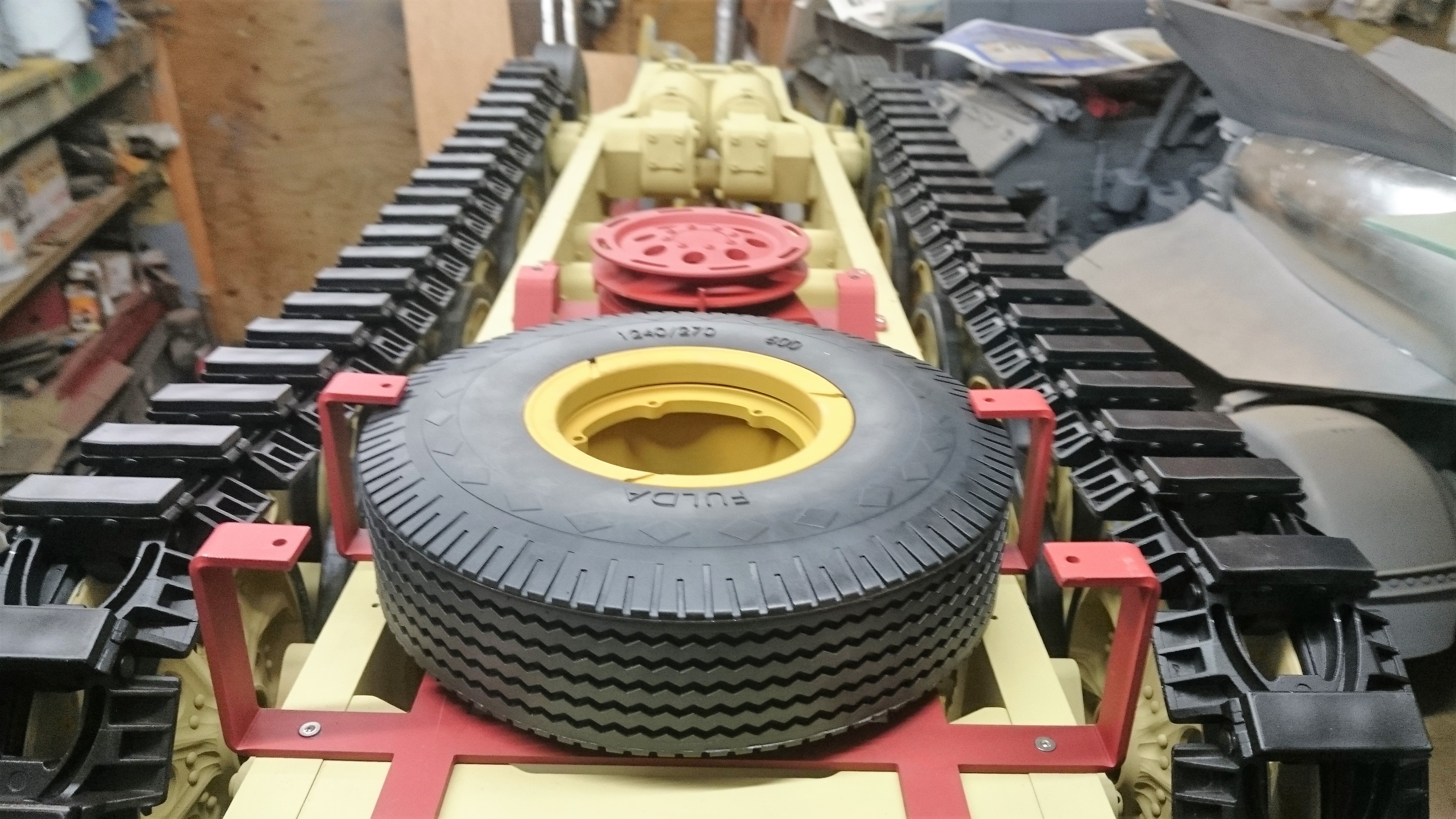

It does say in the build manual that if the spare wheel won't fit in its holder you can file the tyre down! Well happy to report it fits great at this stage.

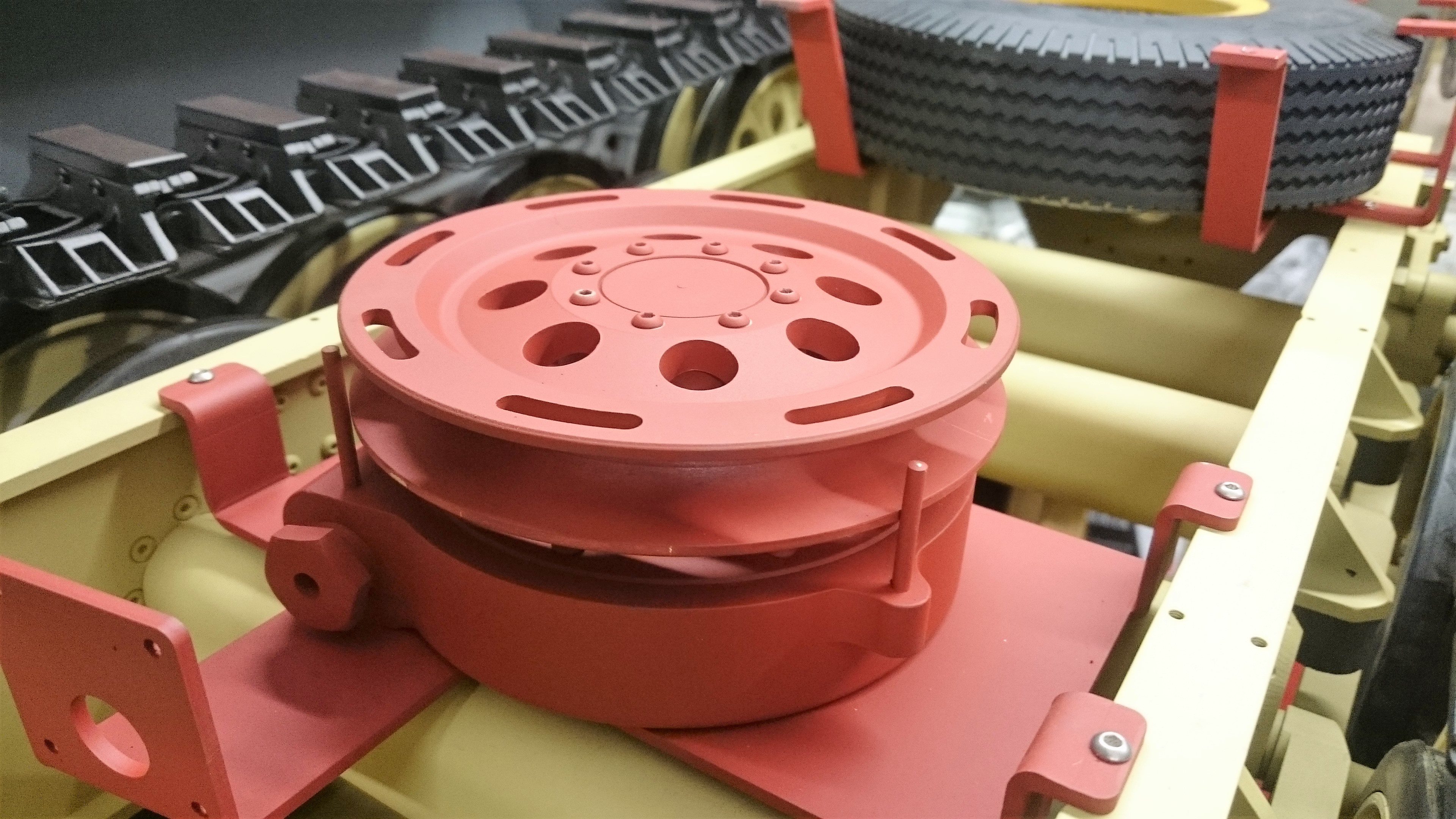

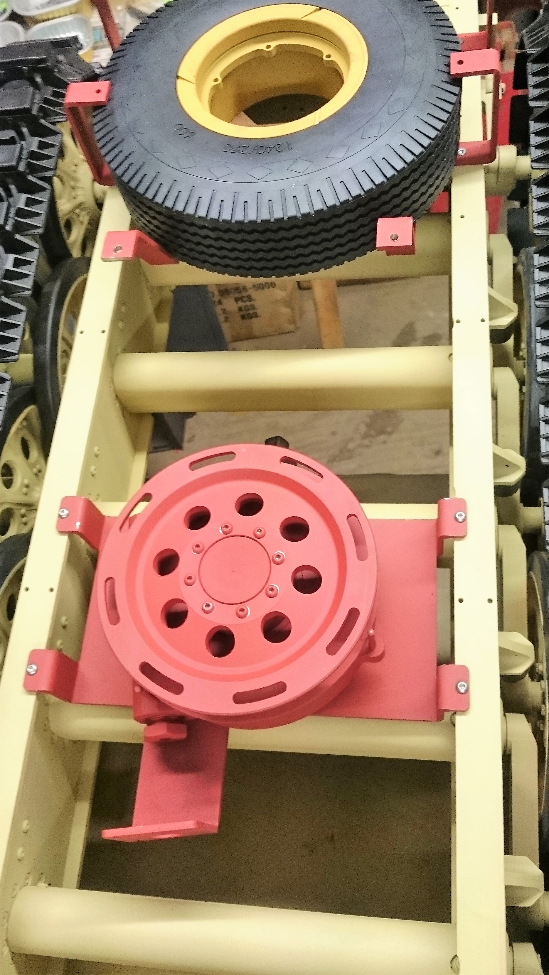

The winch sits nicely and awaits the motor and gearbox
The counter sink fixing holes for the spare wheel frame just need to be opened out .5 of a mm to get the screws to line up.

Logo on the rubber tires - that's a really nice detail! :D

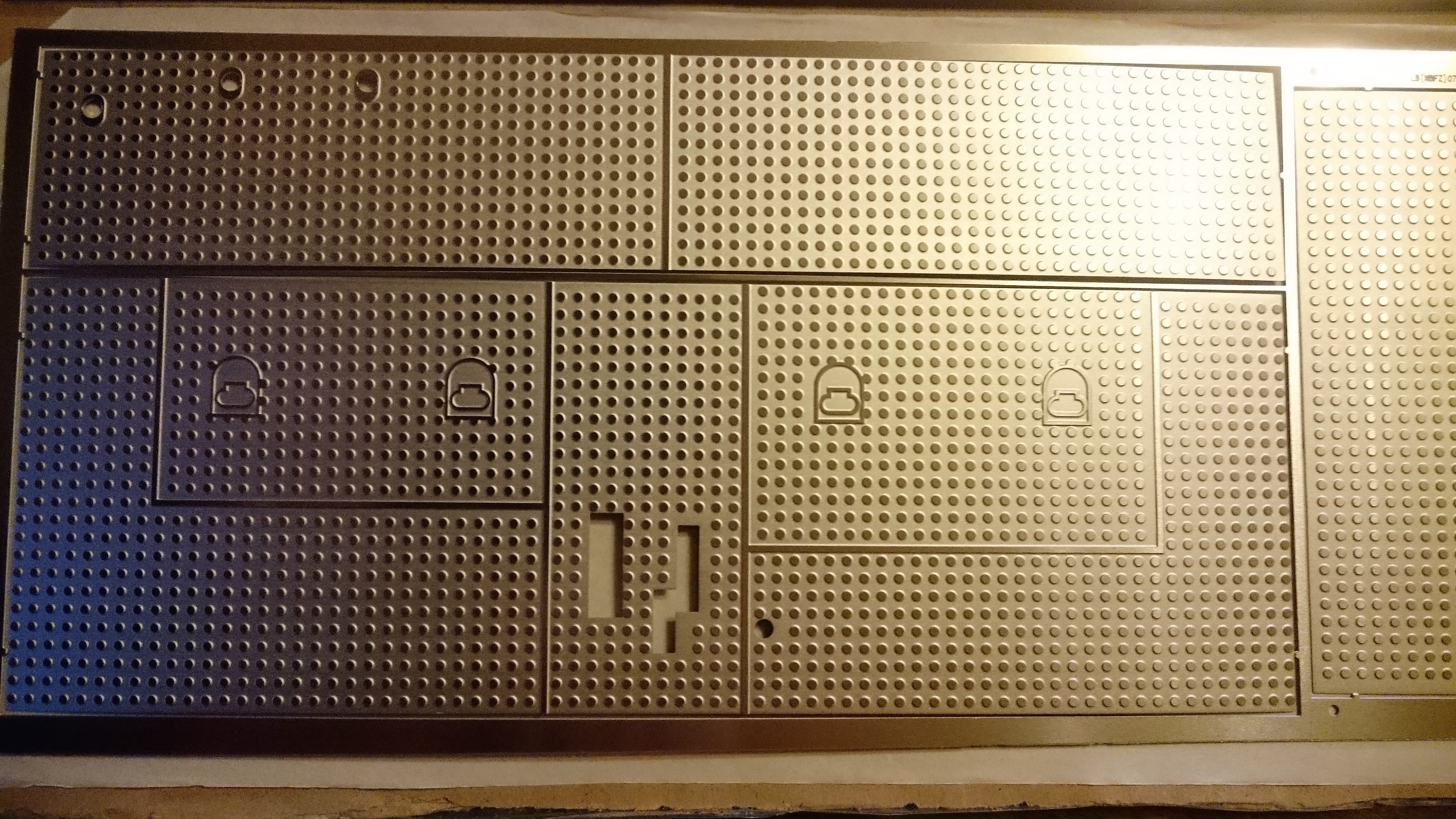

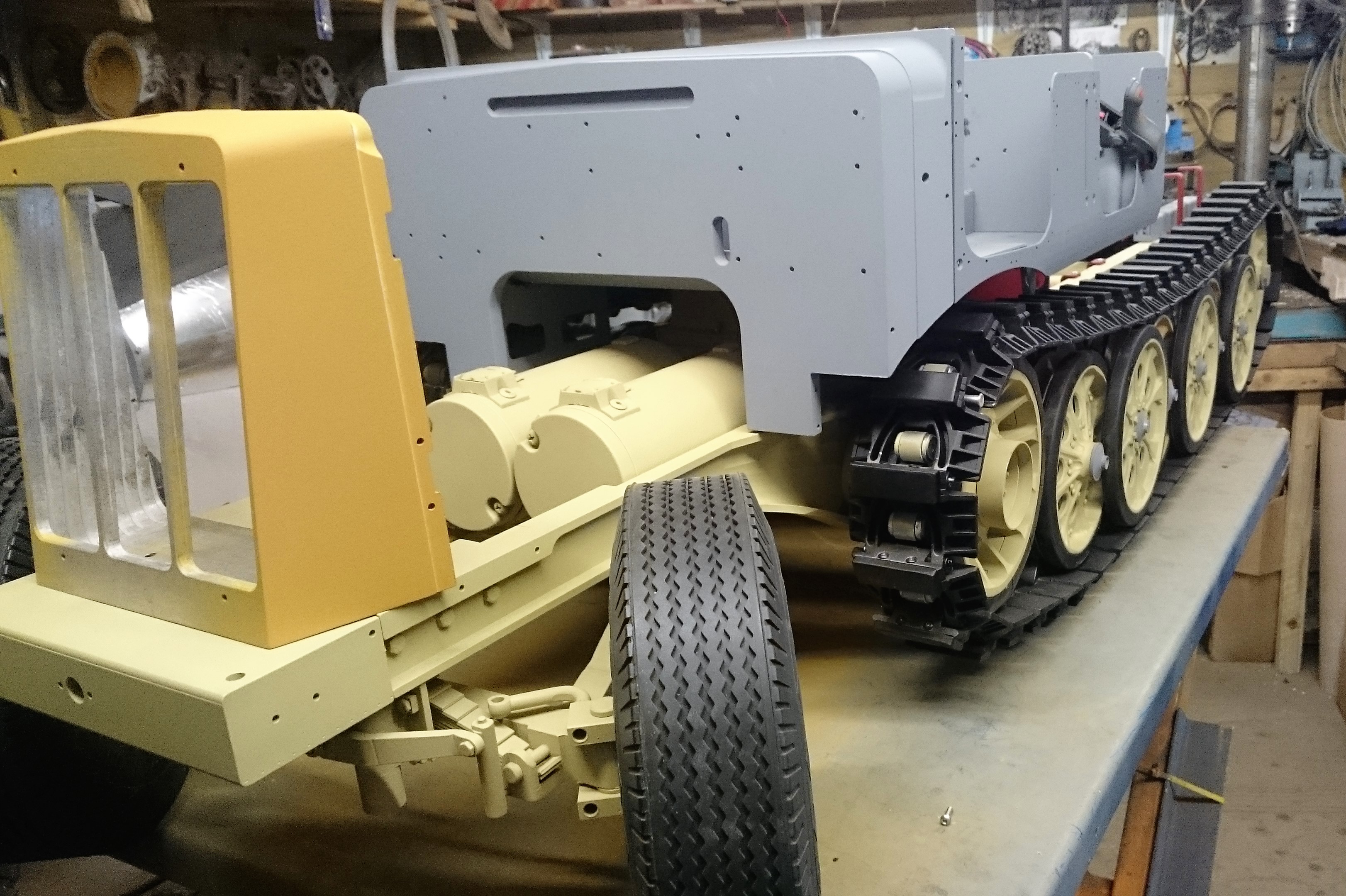

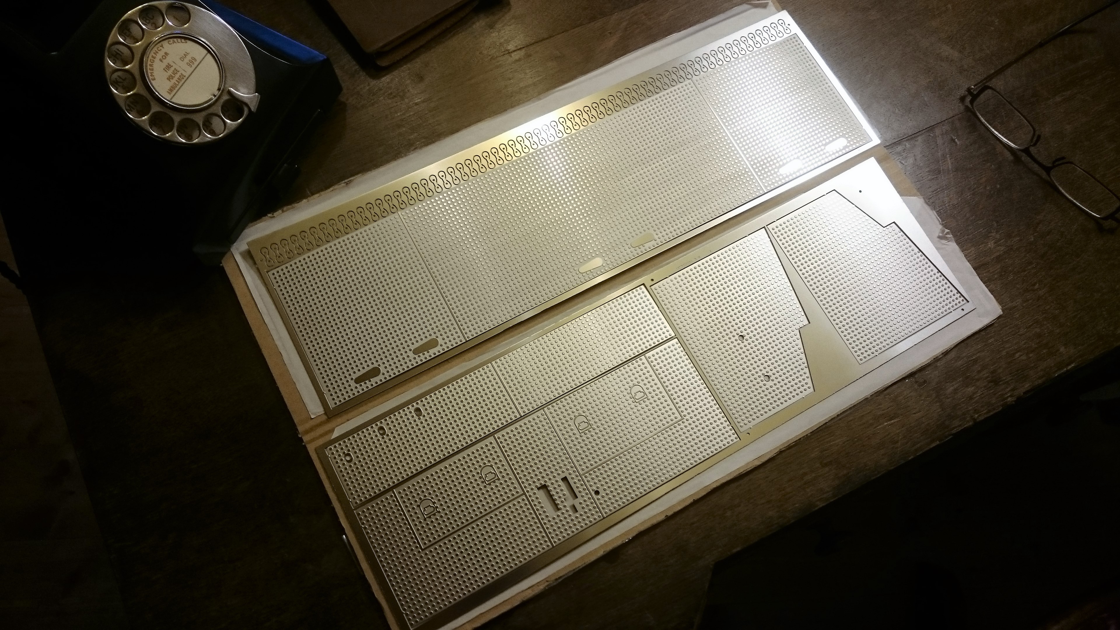

Yesterday the body work and in no particular order. the etched parts are really nice, some of the best I have ever seen!...

I have left my mobile phone in the shot for scale.

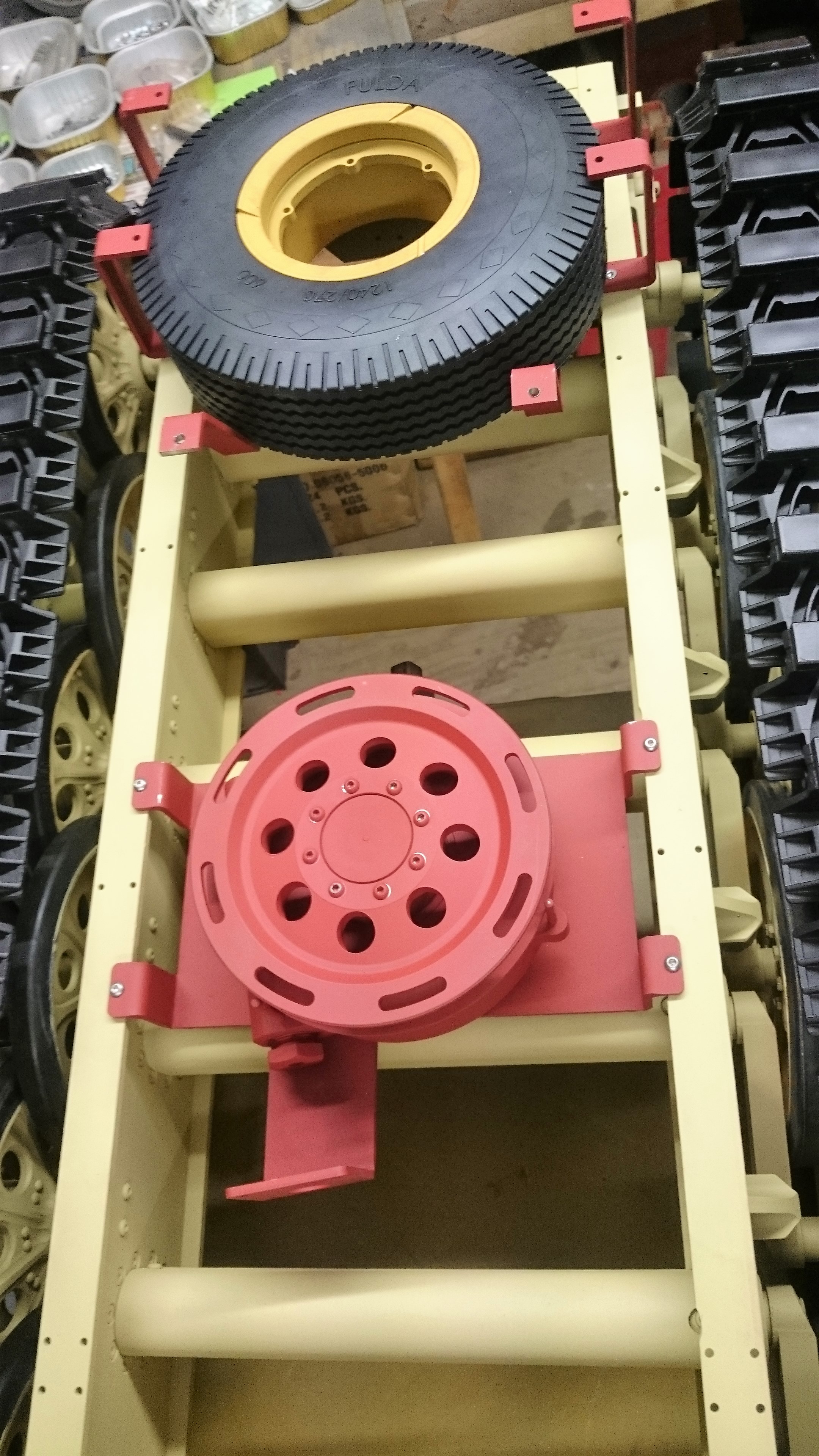

The winch cable tube roller thingy is the reason the spare wheel is a tight fit but I have a fix for that. note the two extra holes in the top, basically fix through from the top after drilling those 6mm holes to except the button heads, you can then loosen the rear and swing the unit to one side and fit the wheel that way.
Beautiful rear tow pintle

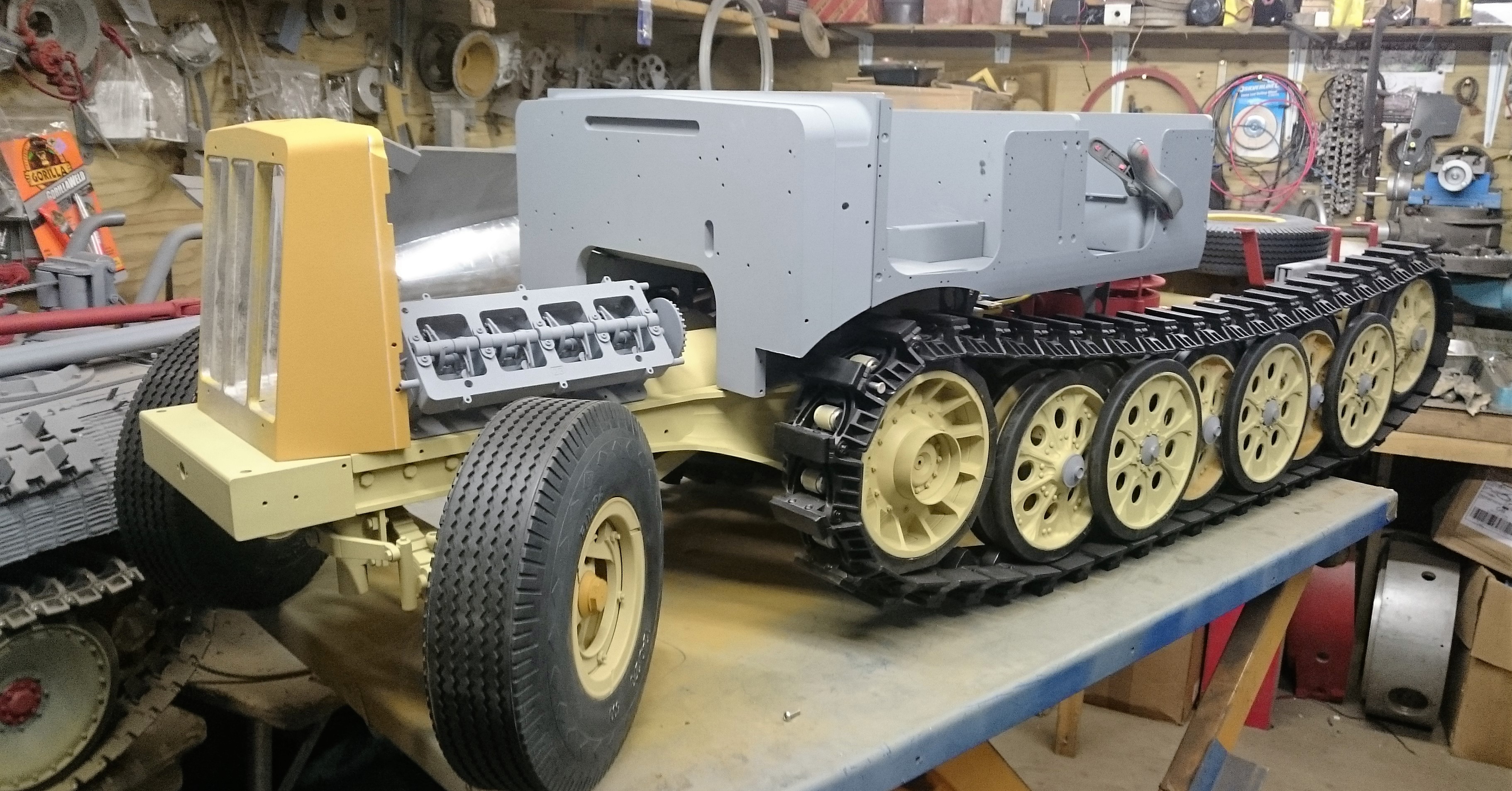

I have a plan for an engine and a gear box, the later using the speed controller disguised as the unit.
