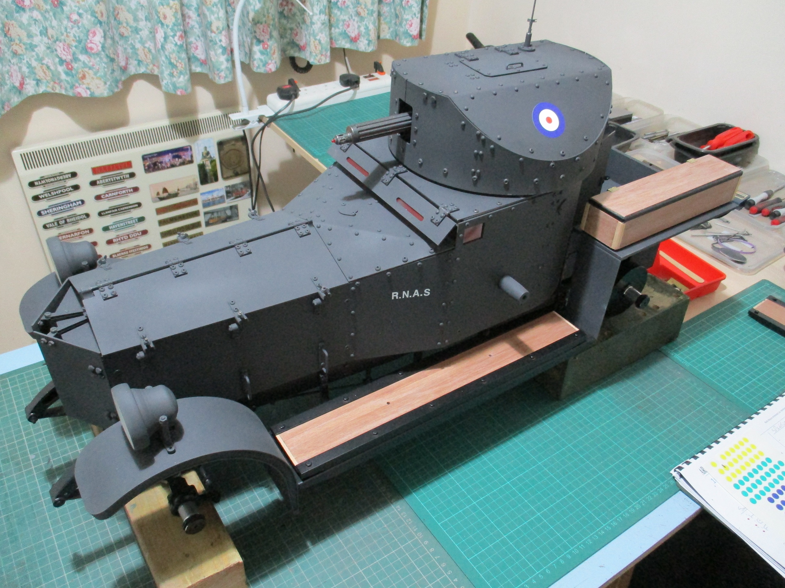

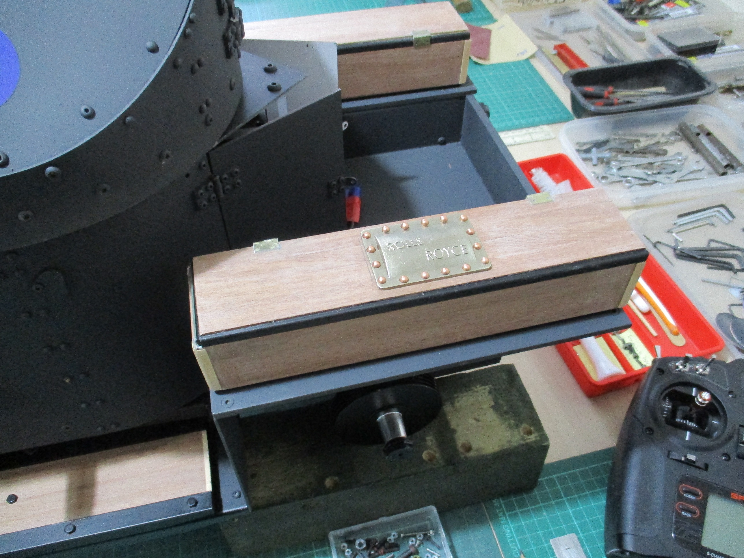

Couple of minor tweaks, not seen on the Rolls however, I like these items in the kit....just had to find a way to display them....Mick

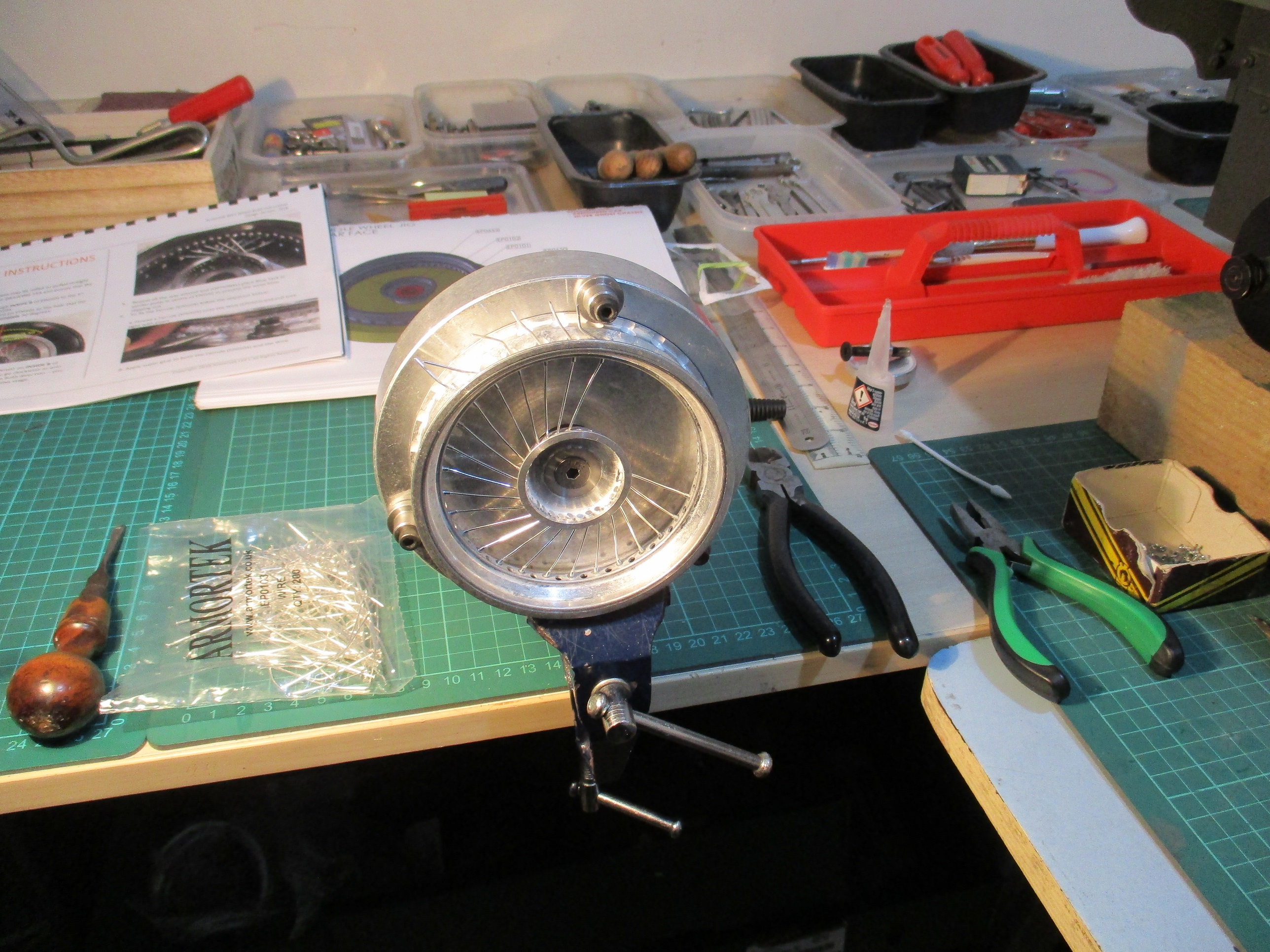

Thank you Ken and Robert, I have made a start building the wire wheels, with some trepidation I may add.....no problems however, get the first few wires in place and the rest will follow...as an insomniac, it whiles away the hours....Mick
