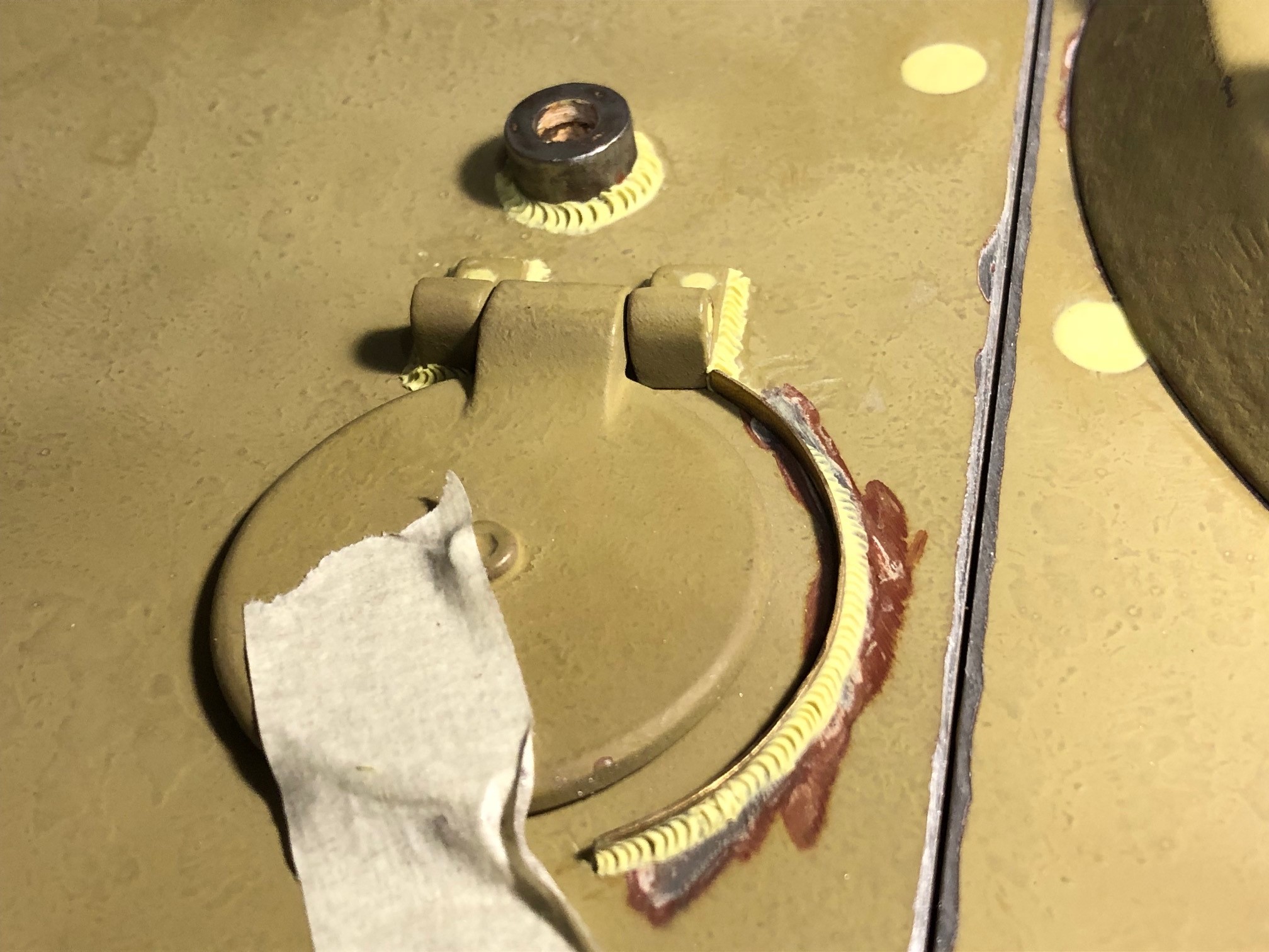

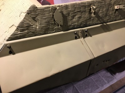

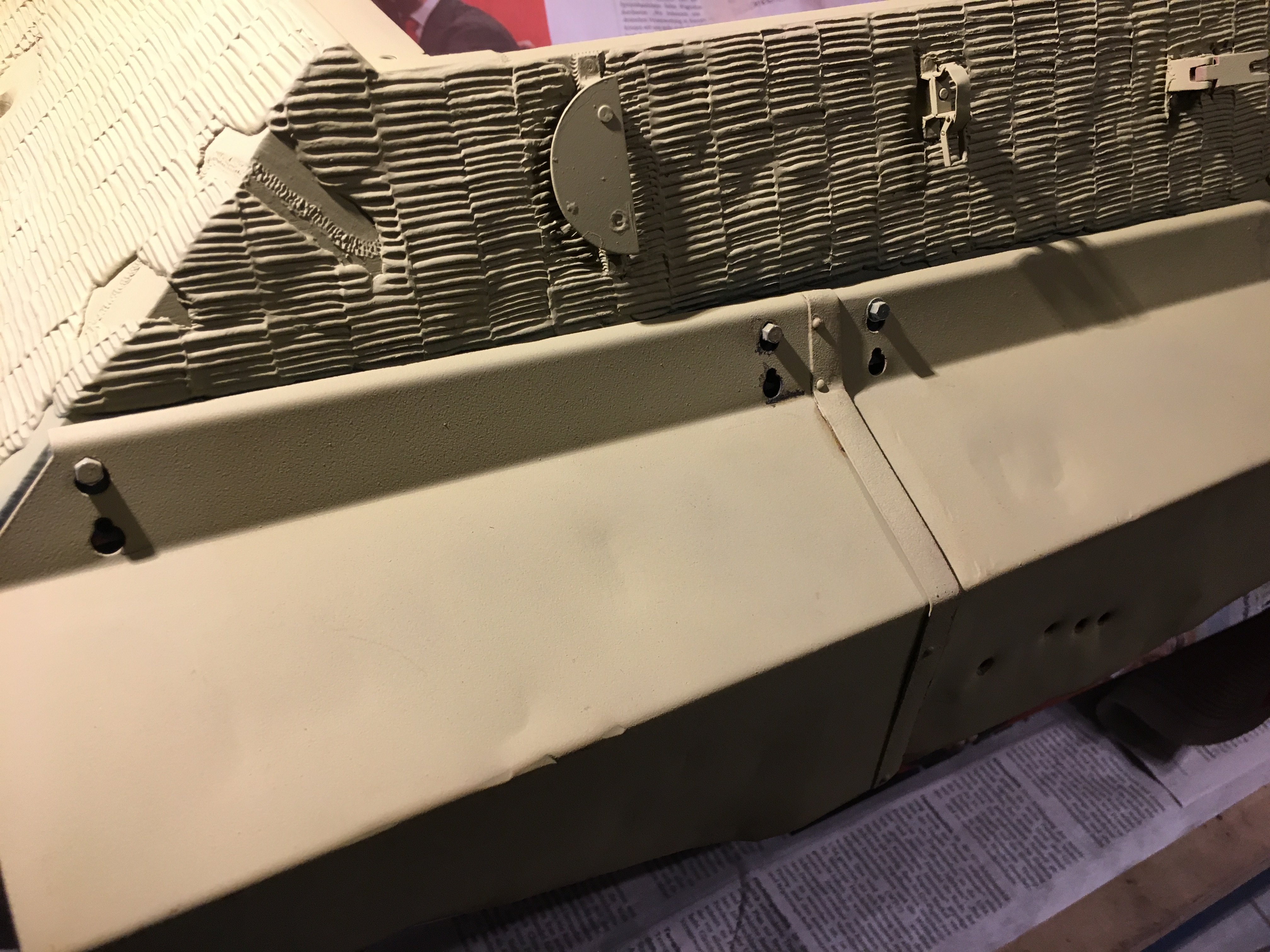

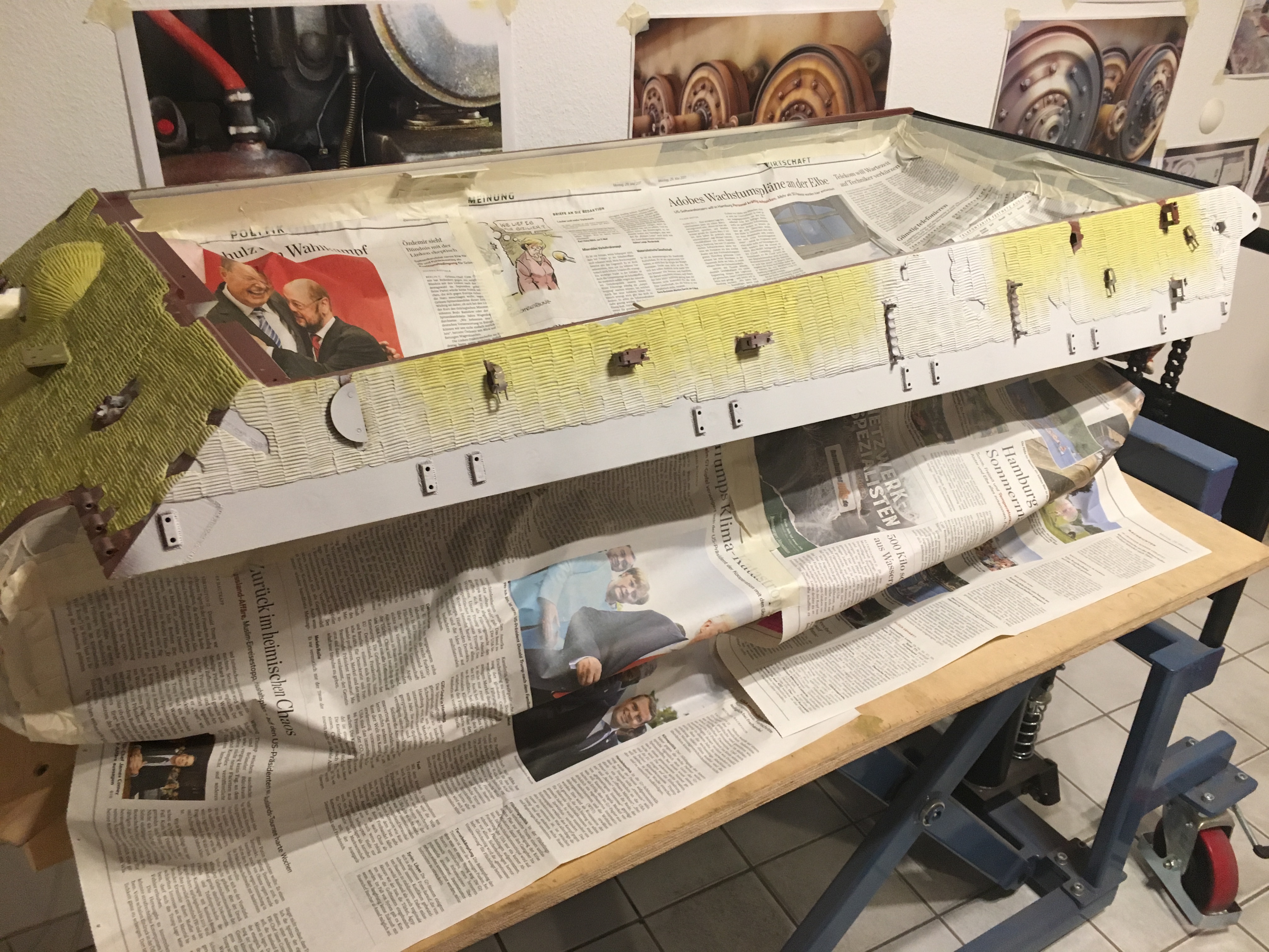

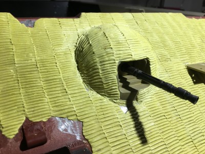

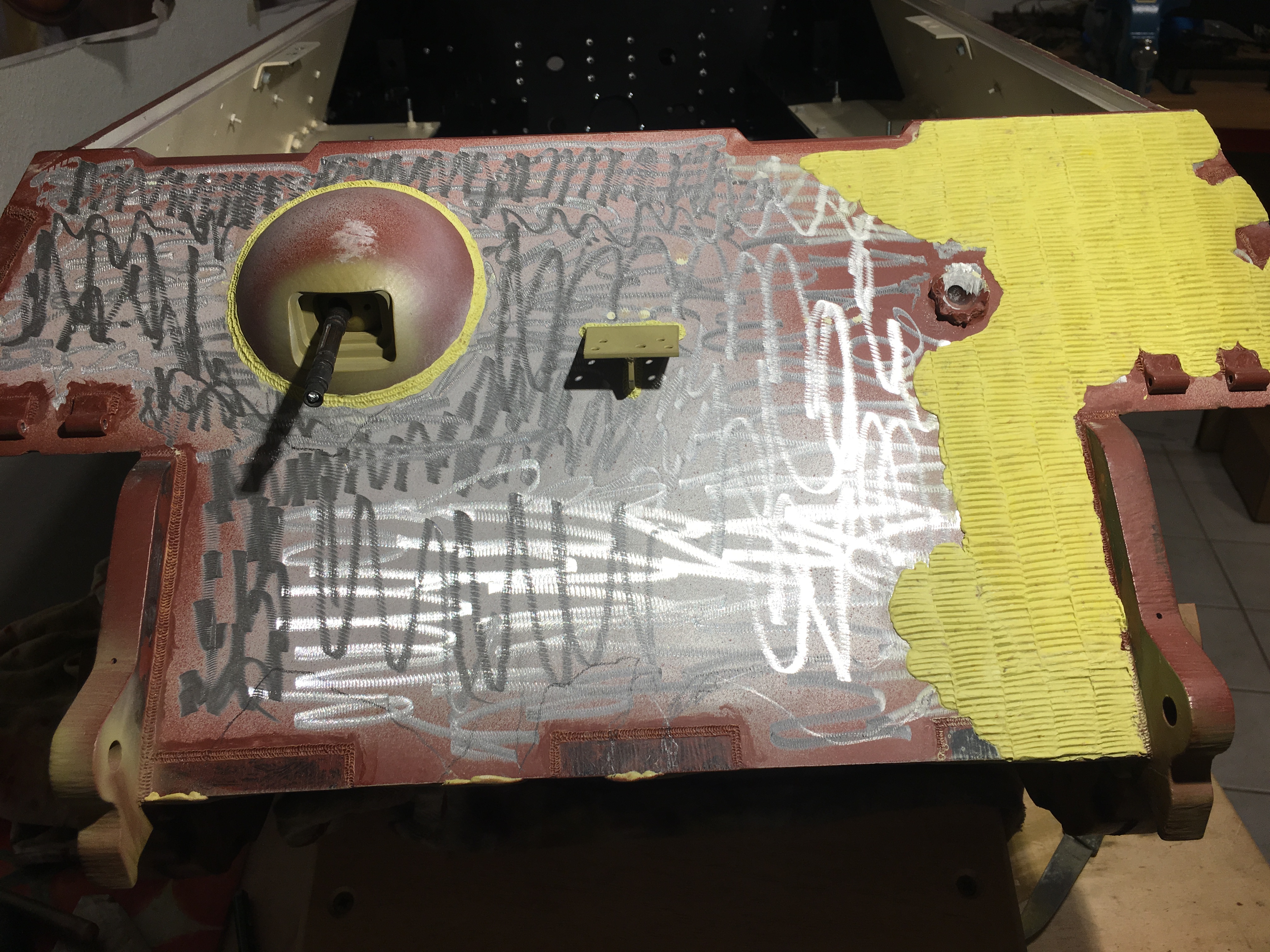

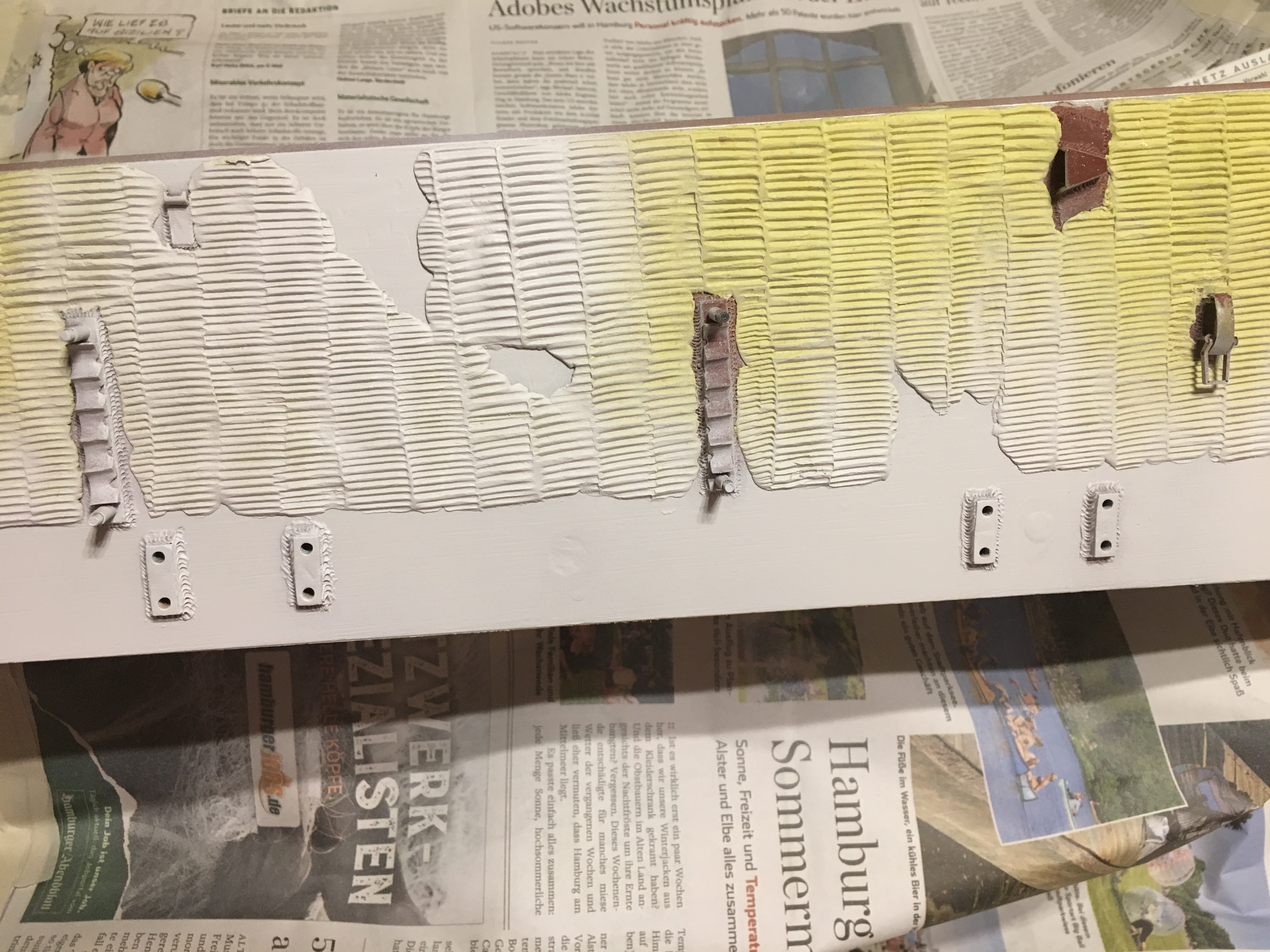

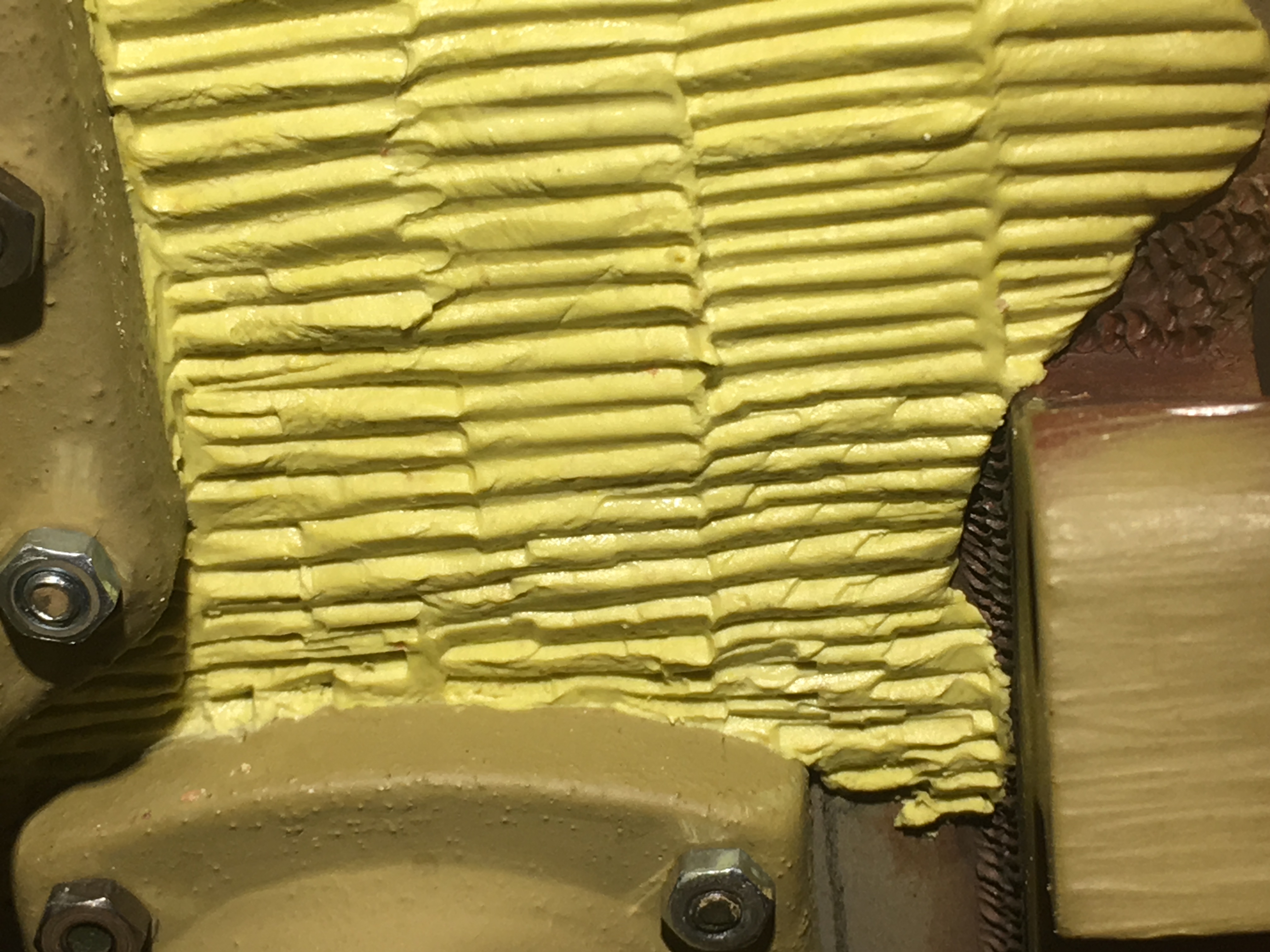

Hello Phil,

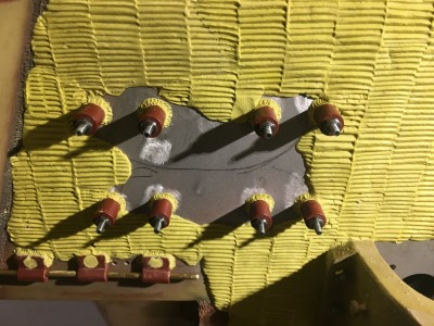

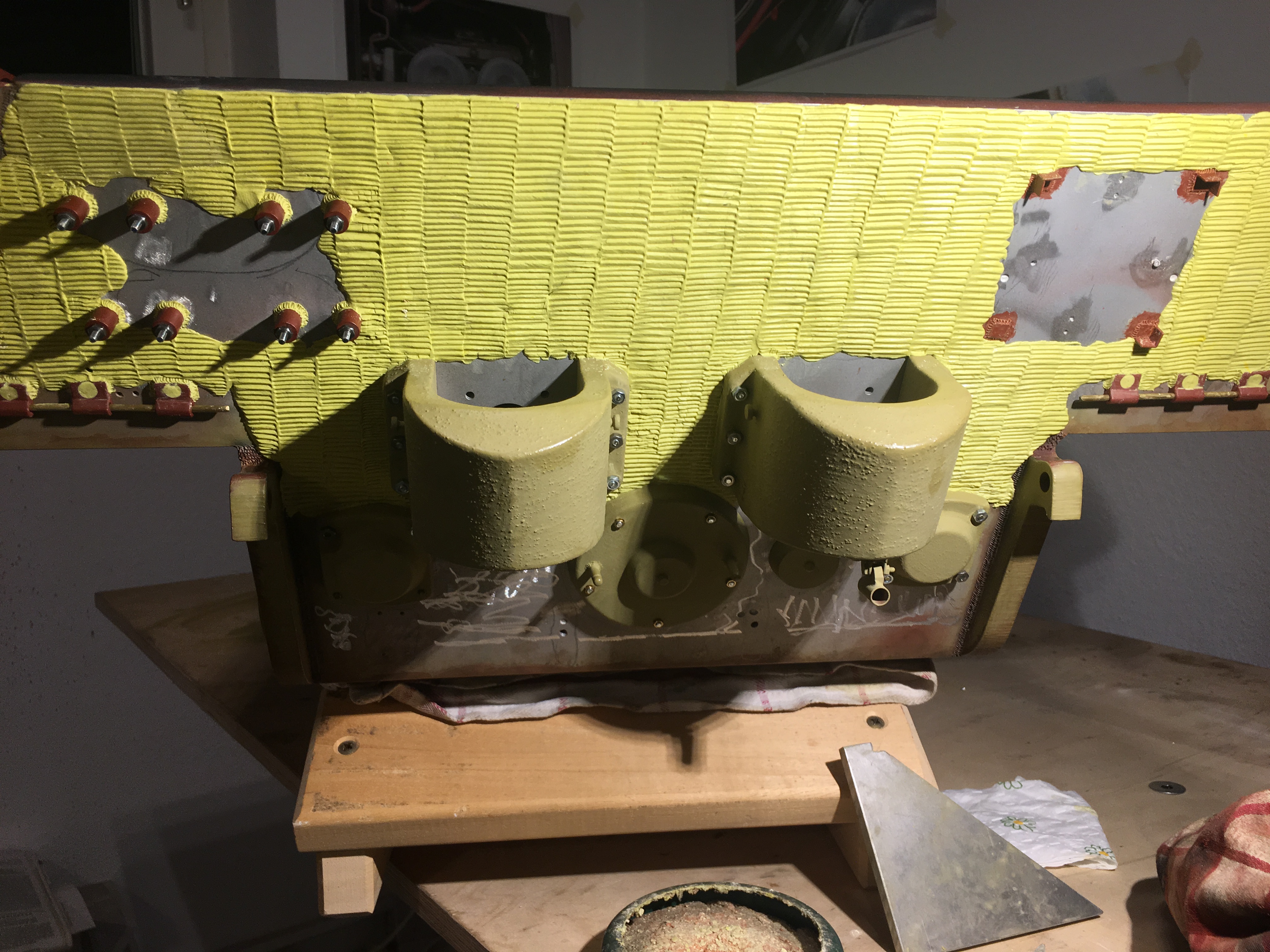

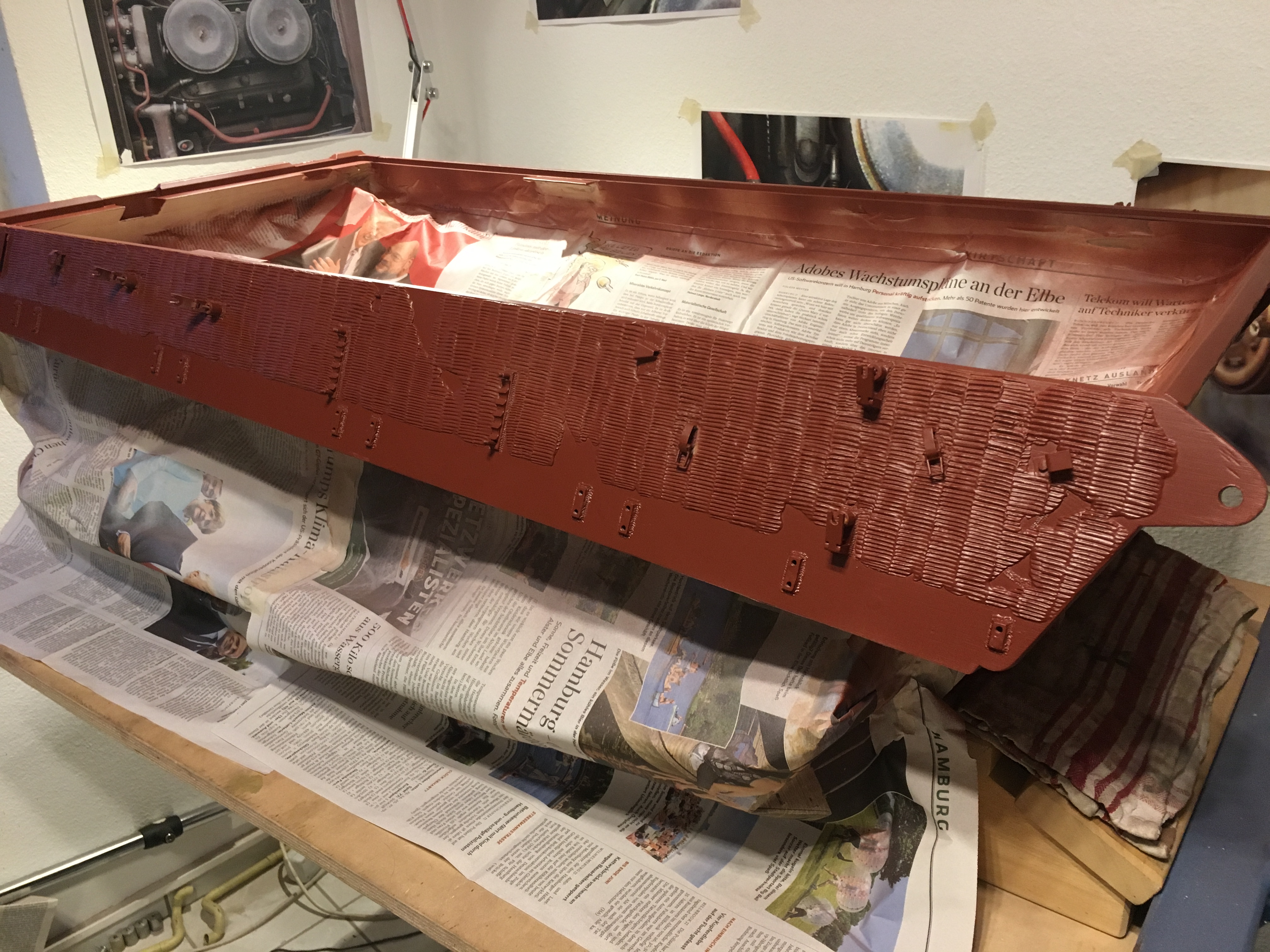

you are right, the edges doesn't look like this, but this is the start of the first part of Zimm. Have a look to the next photos - it's not finished now, but better than the last pictures?
Regards Martin

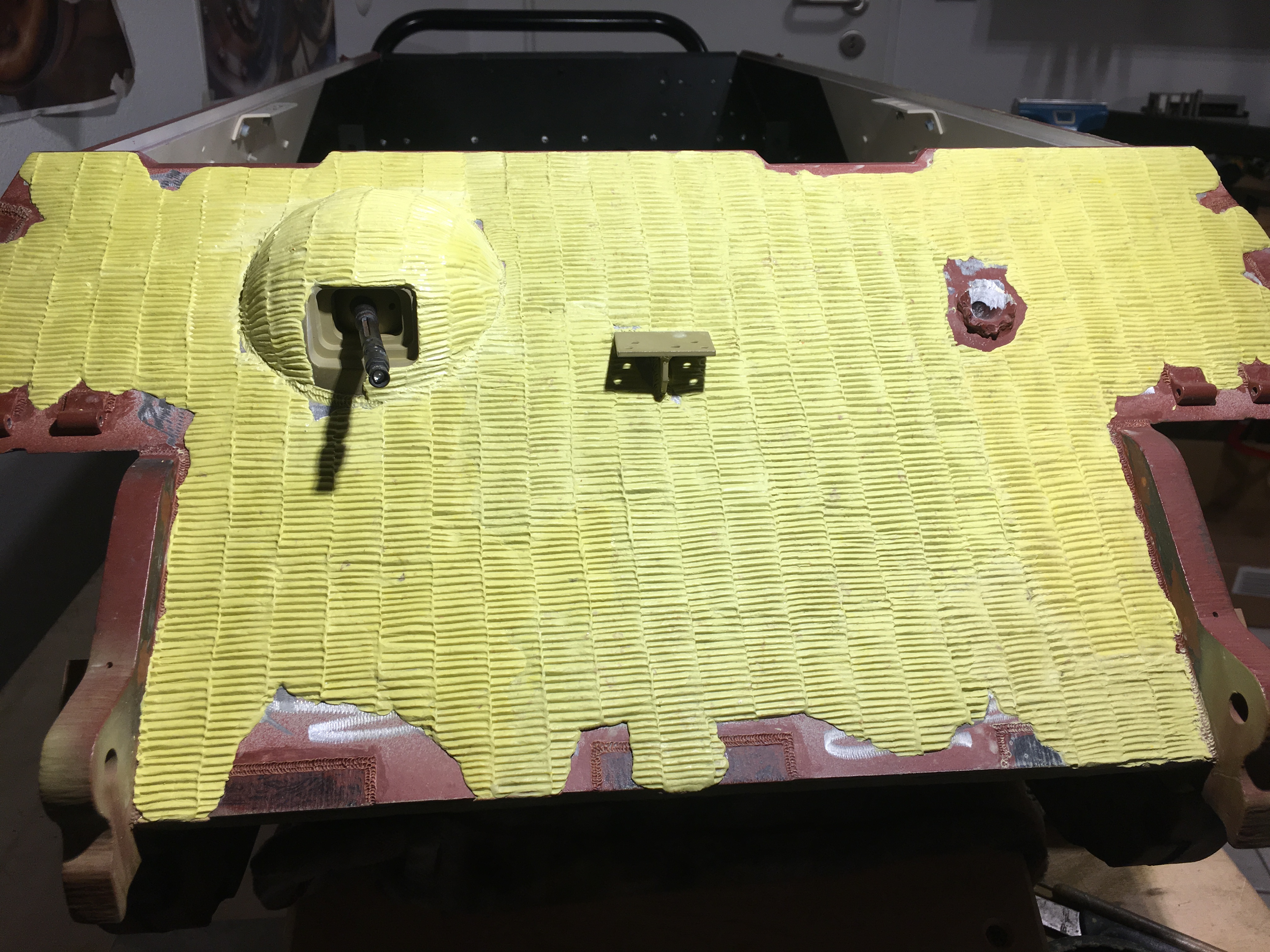

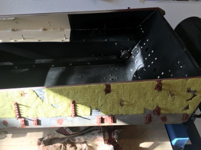

Post by Martin Hofmann »

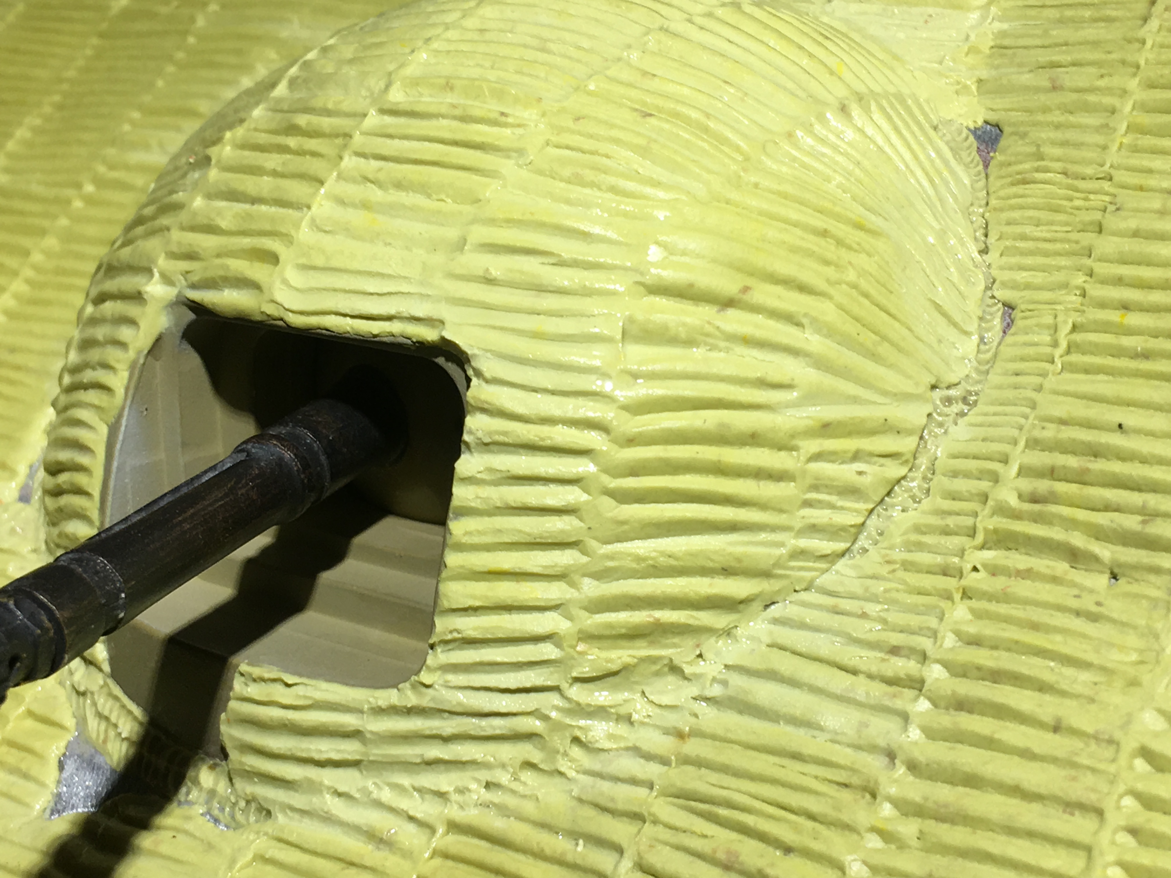

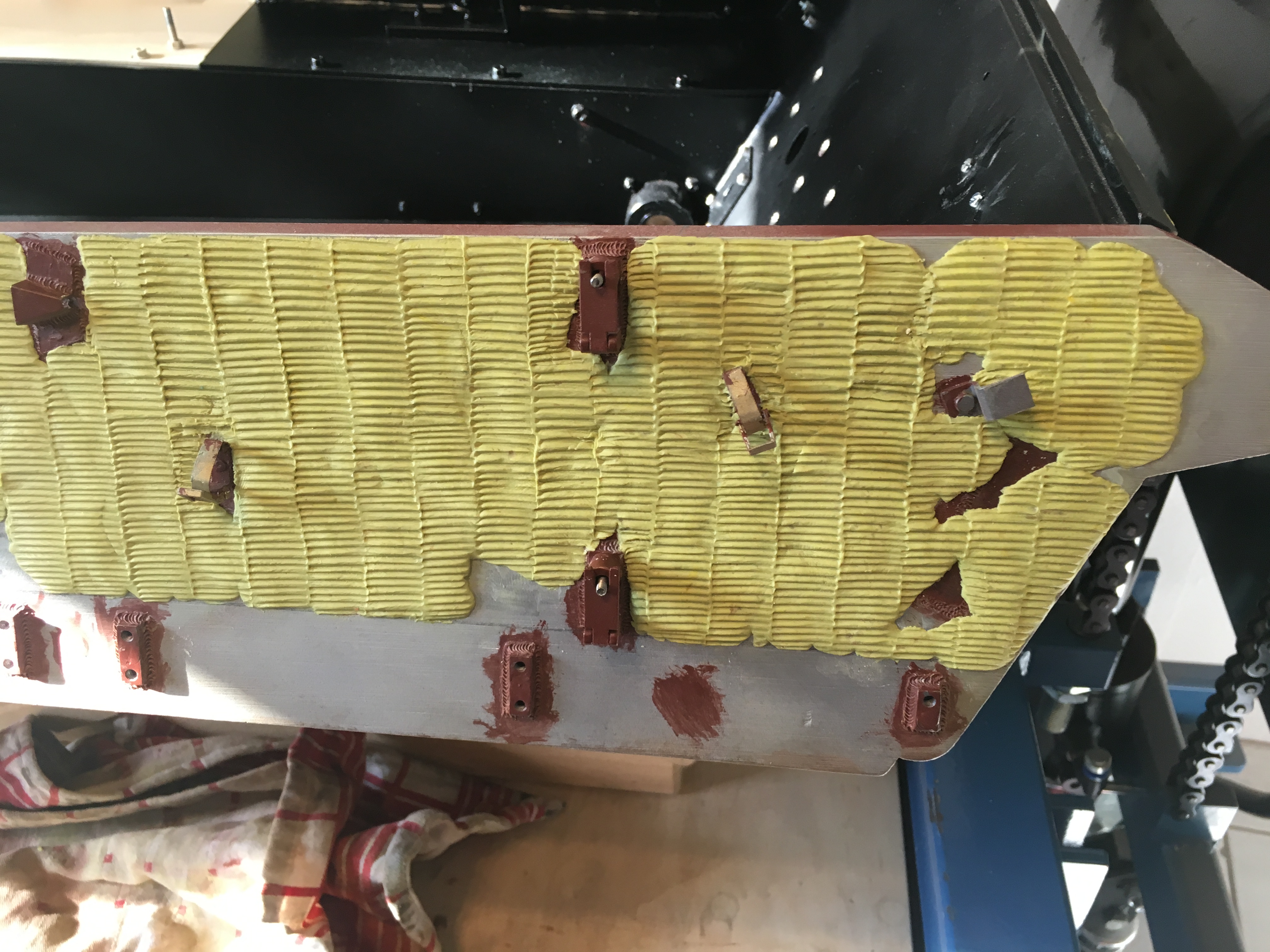

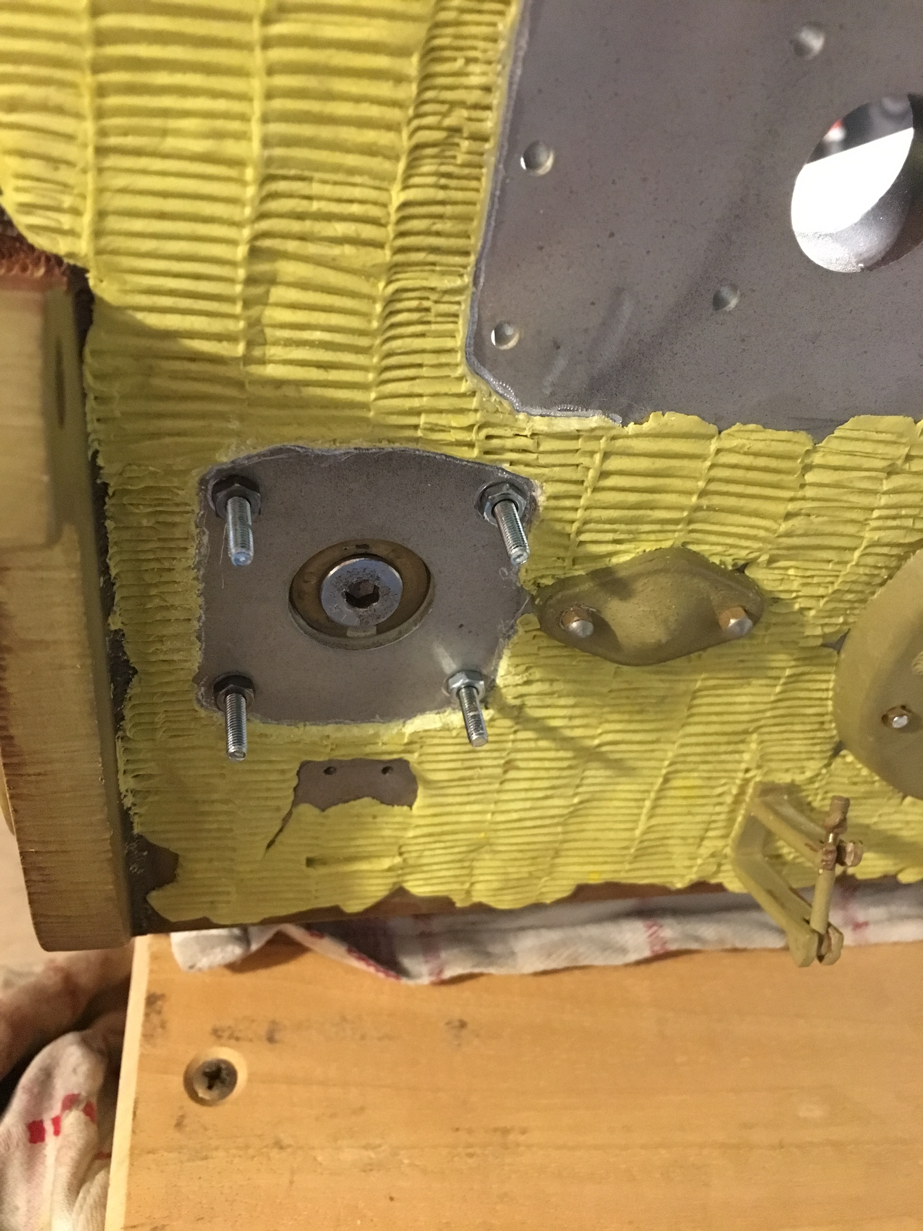

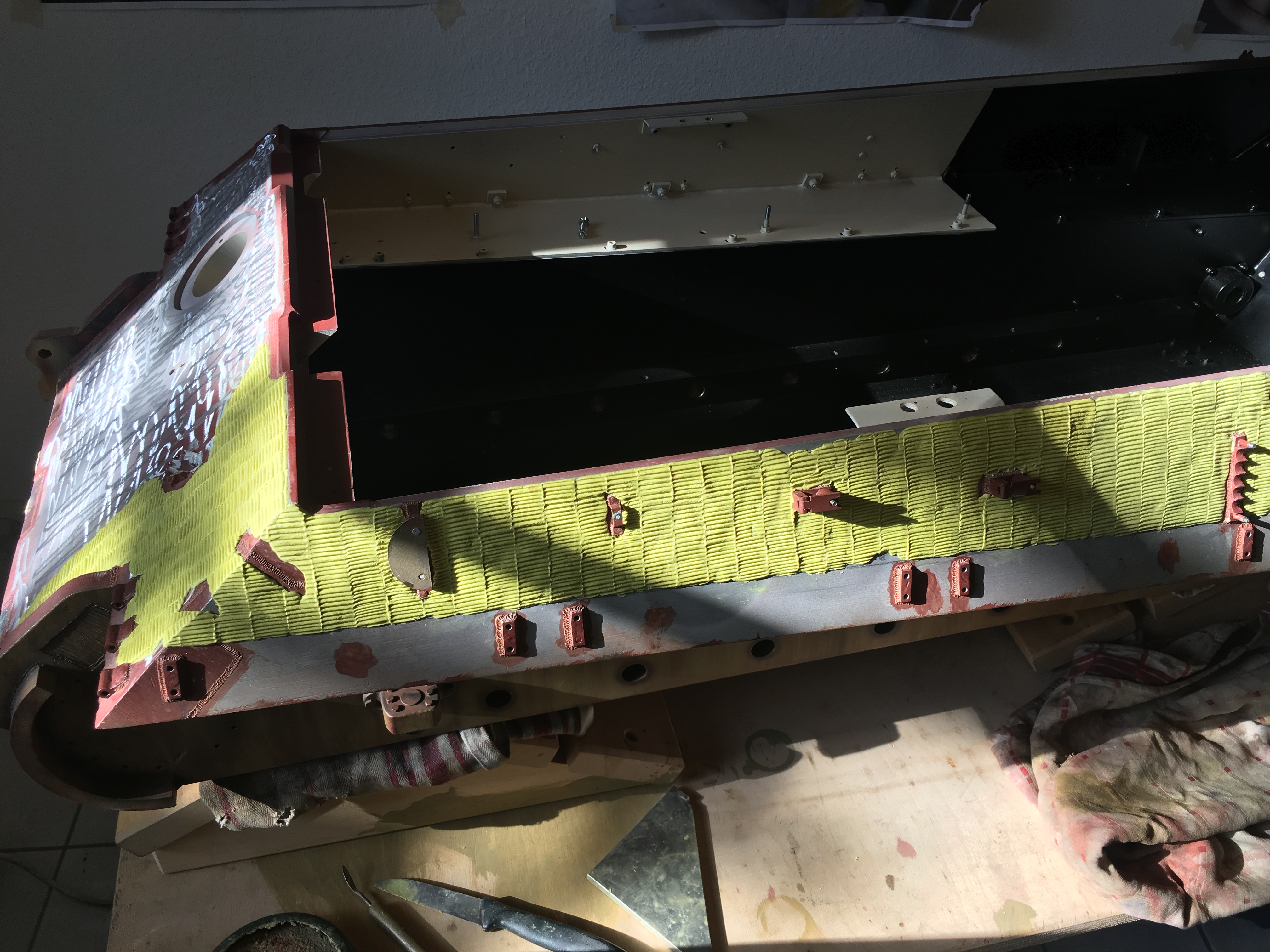

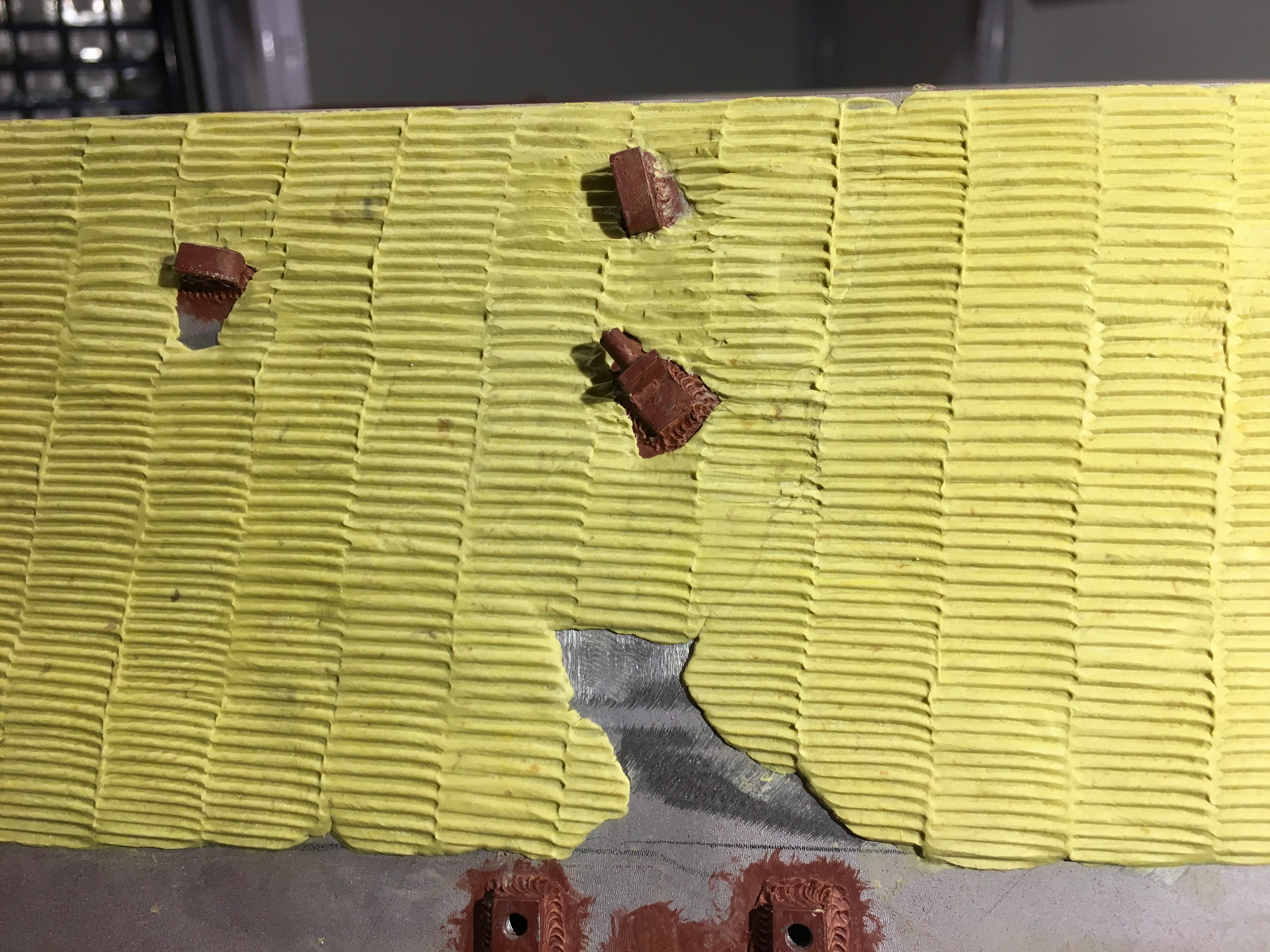

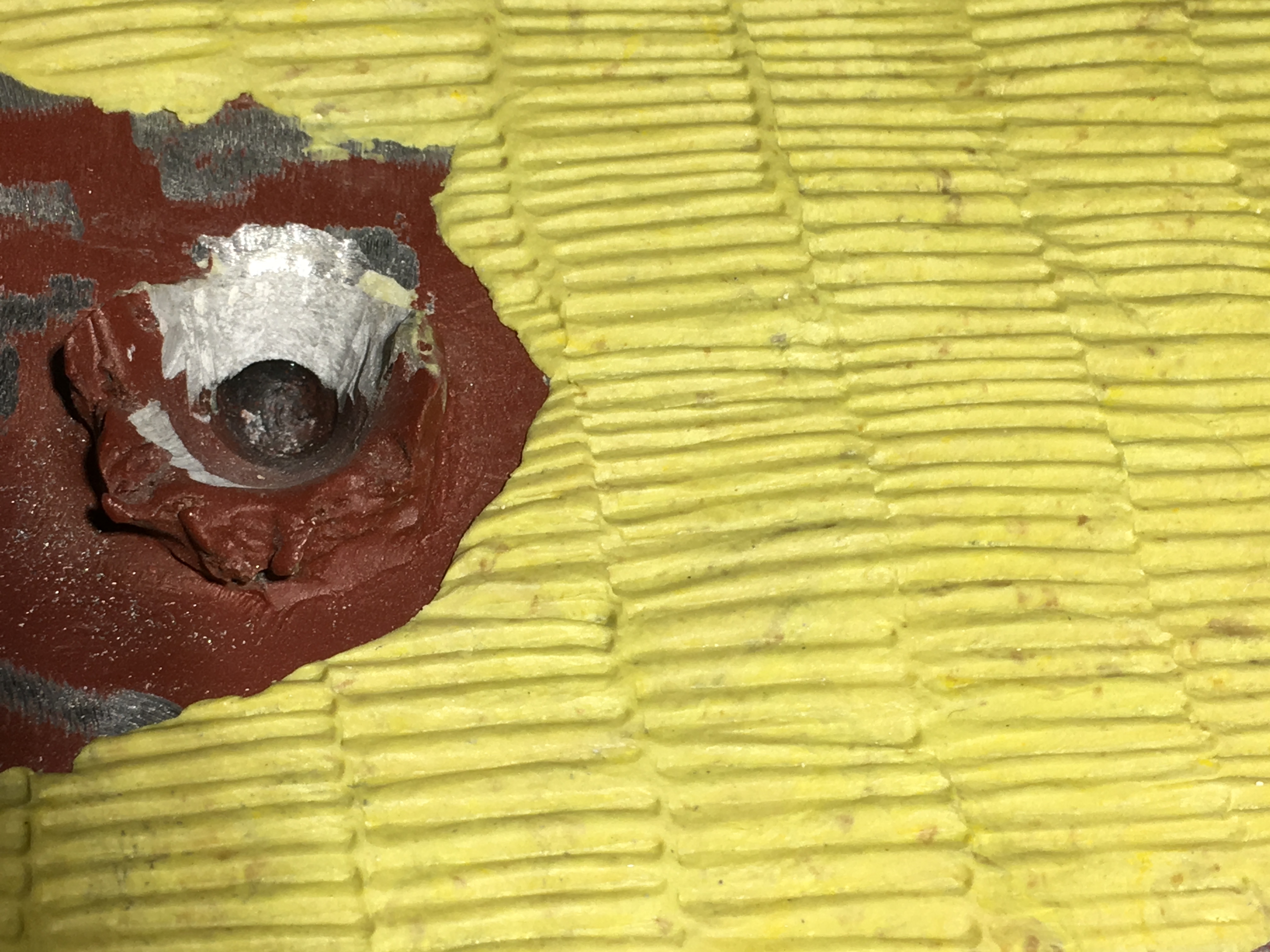

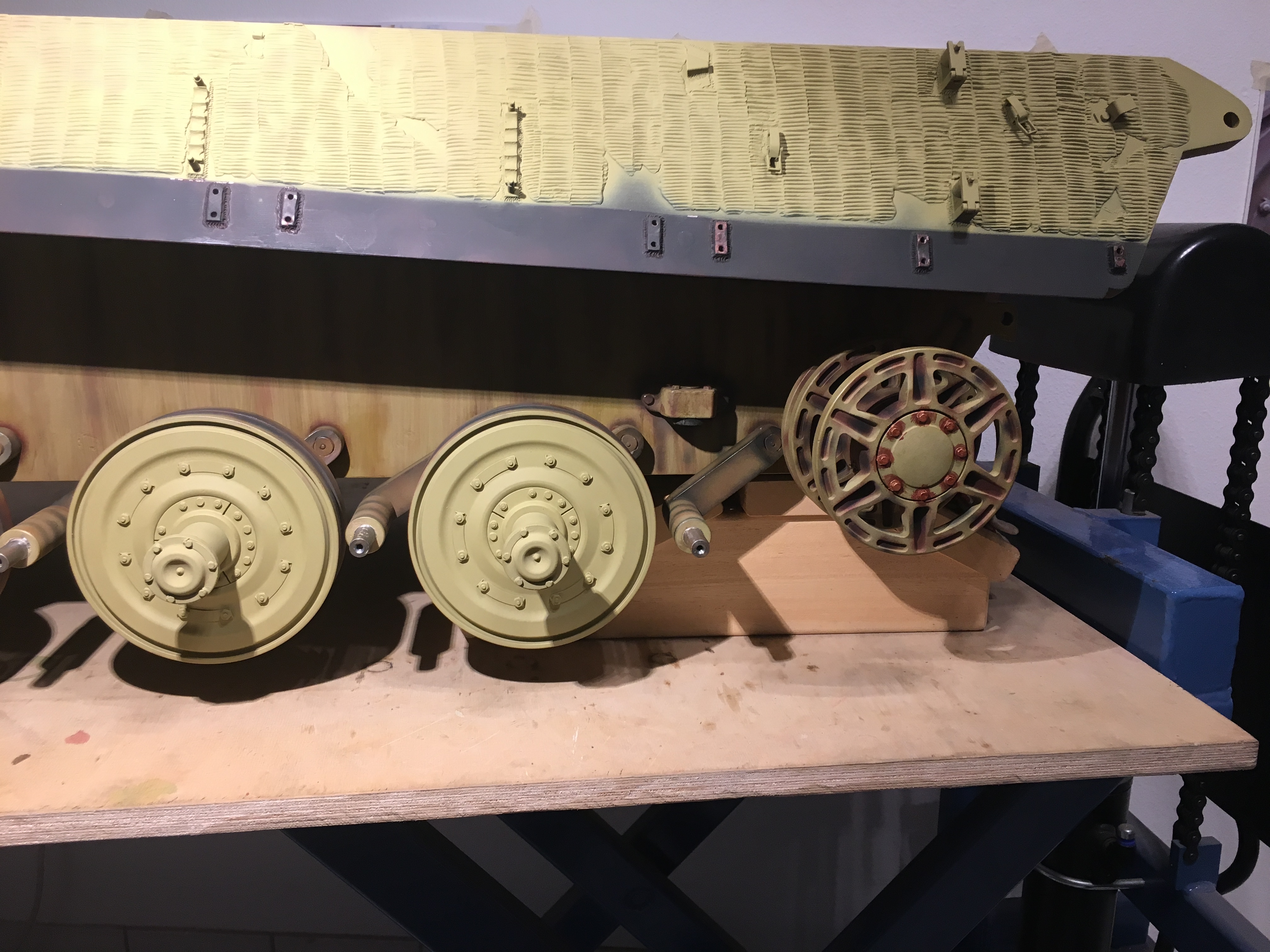

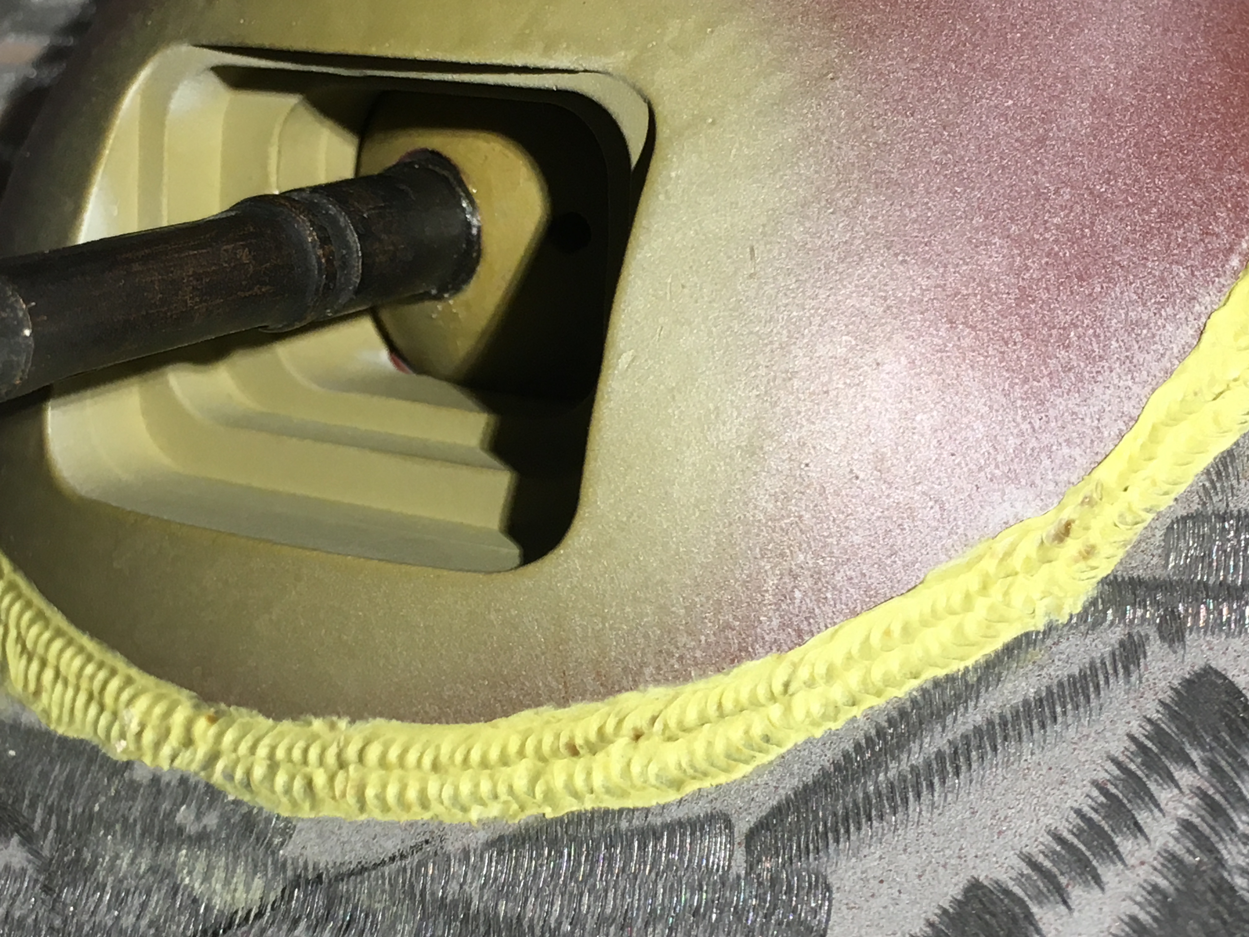

Here is the result of the hull with zimmerit.
Regards Martin

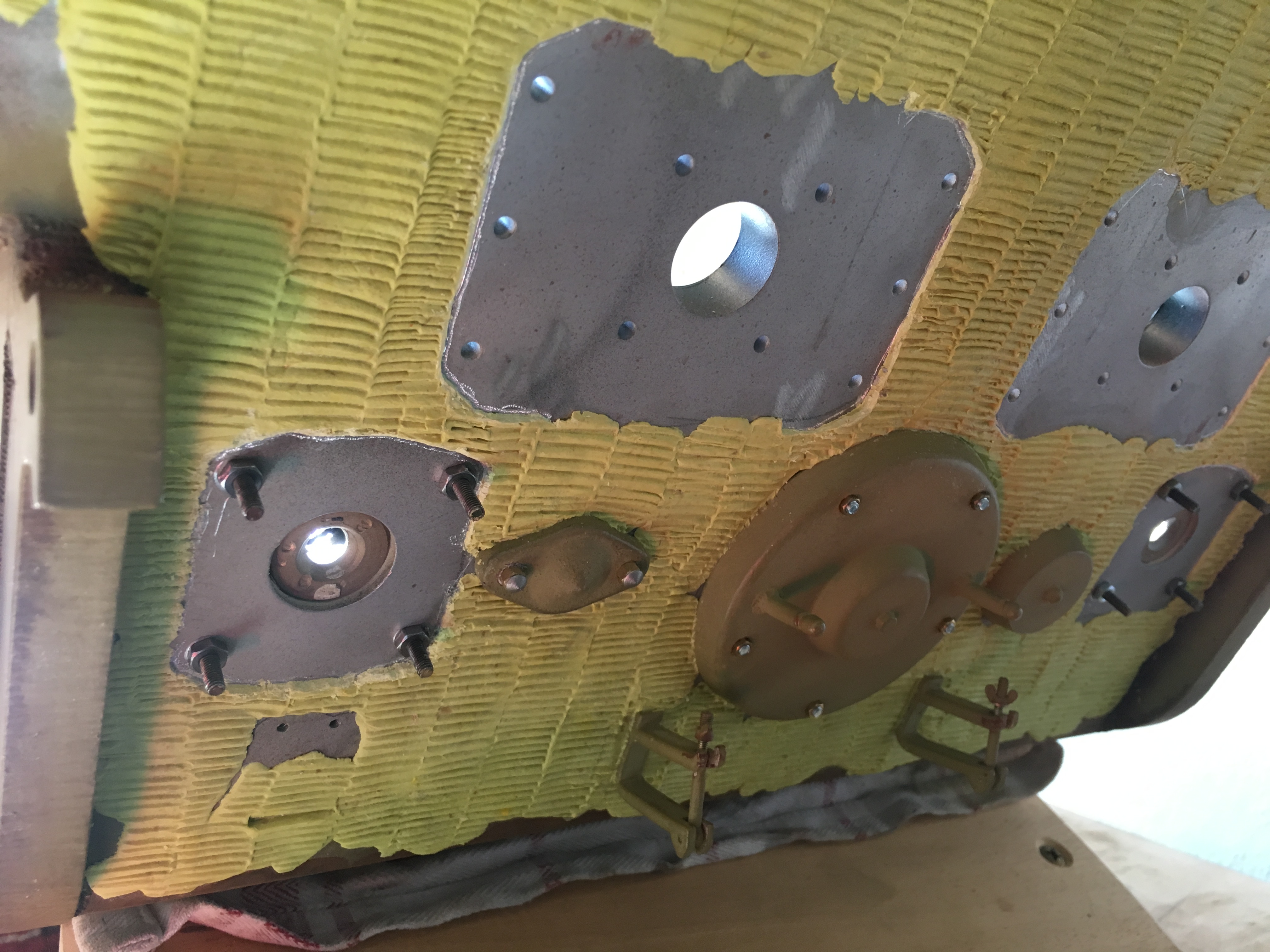

Re: Martin's King Tiger
Pretty good Martin, have you tried actually breaking or knocking areas away when it's nice and hard? It tends to leave a very nice pattern where the tool marks were.
It's looking good, I am doing the very same thing right now Regards Phil.
Hello Phil,
i brake the Zimmerit away if it was fresh and soft.
Fine that you like it.

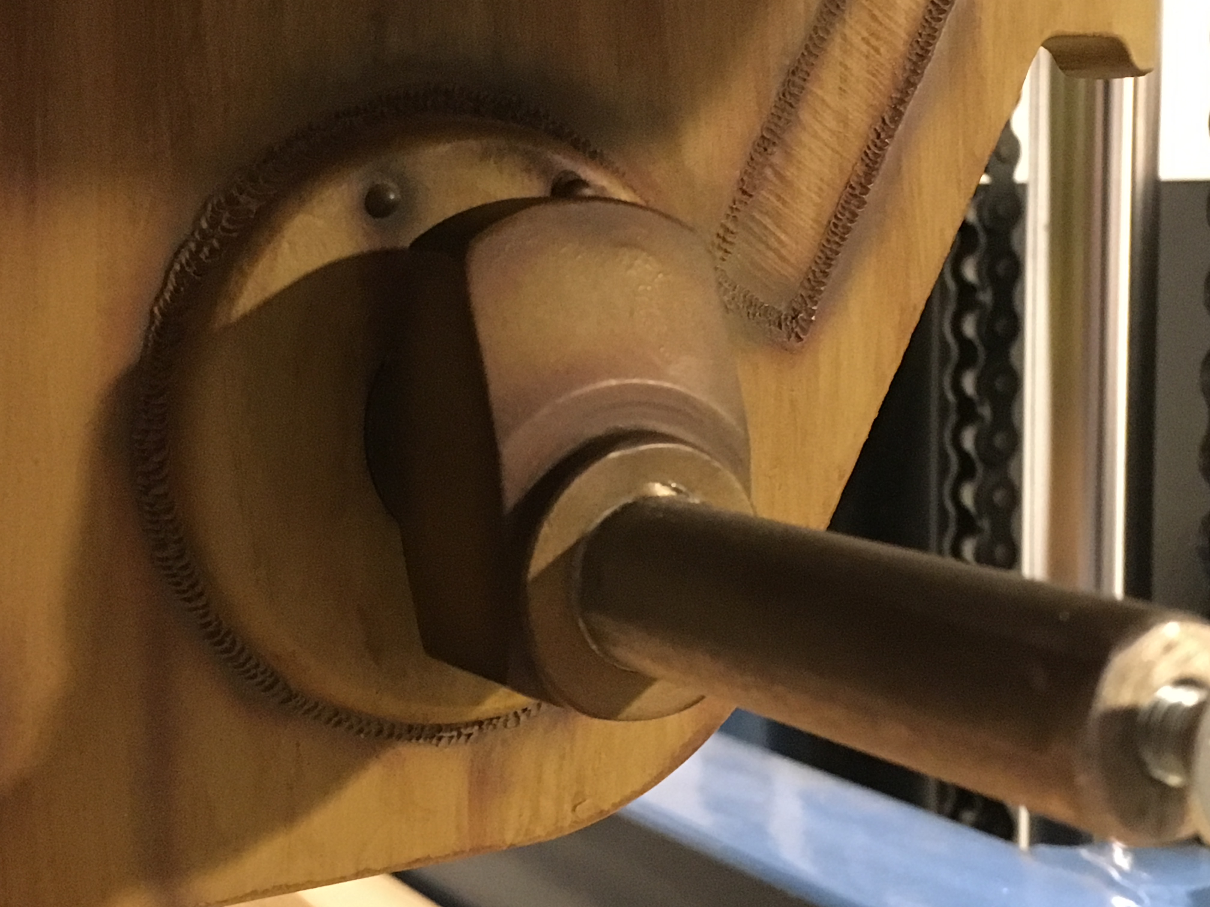

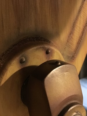

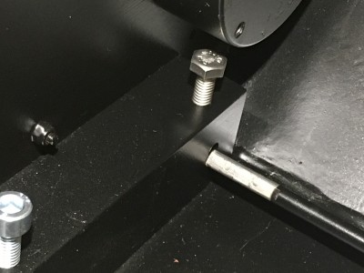

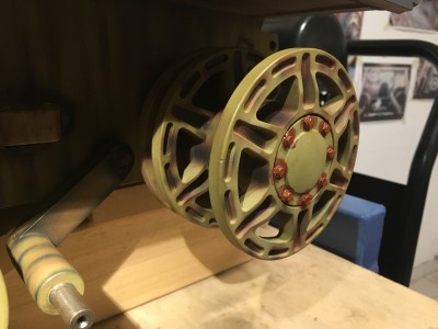

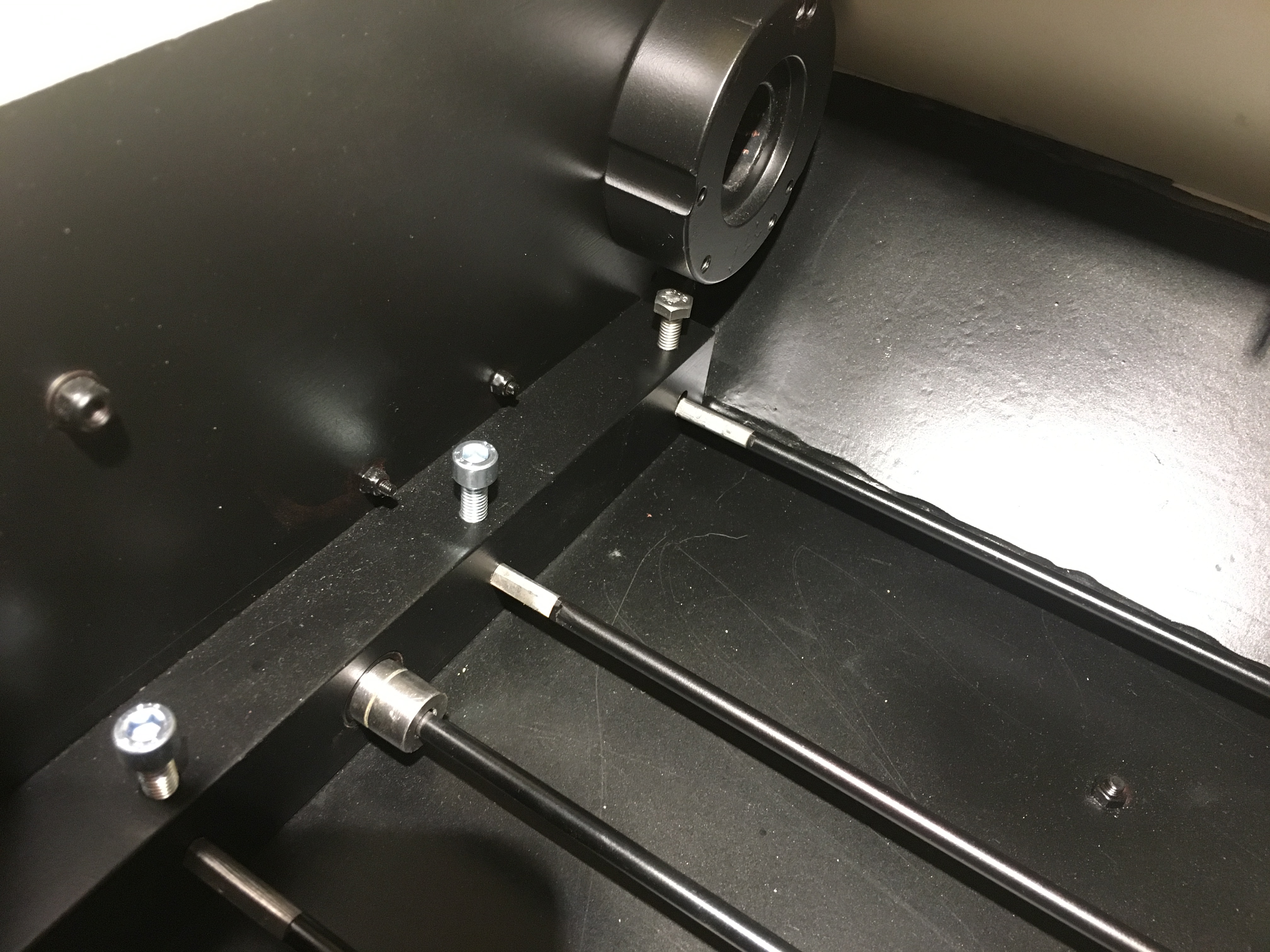

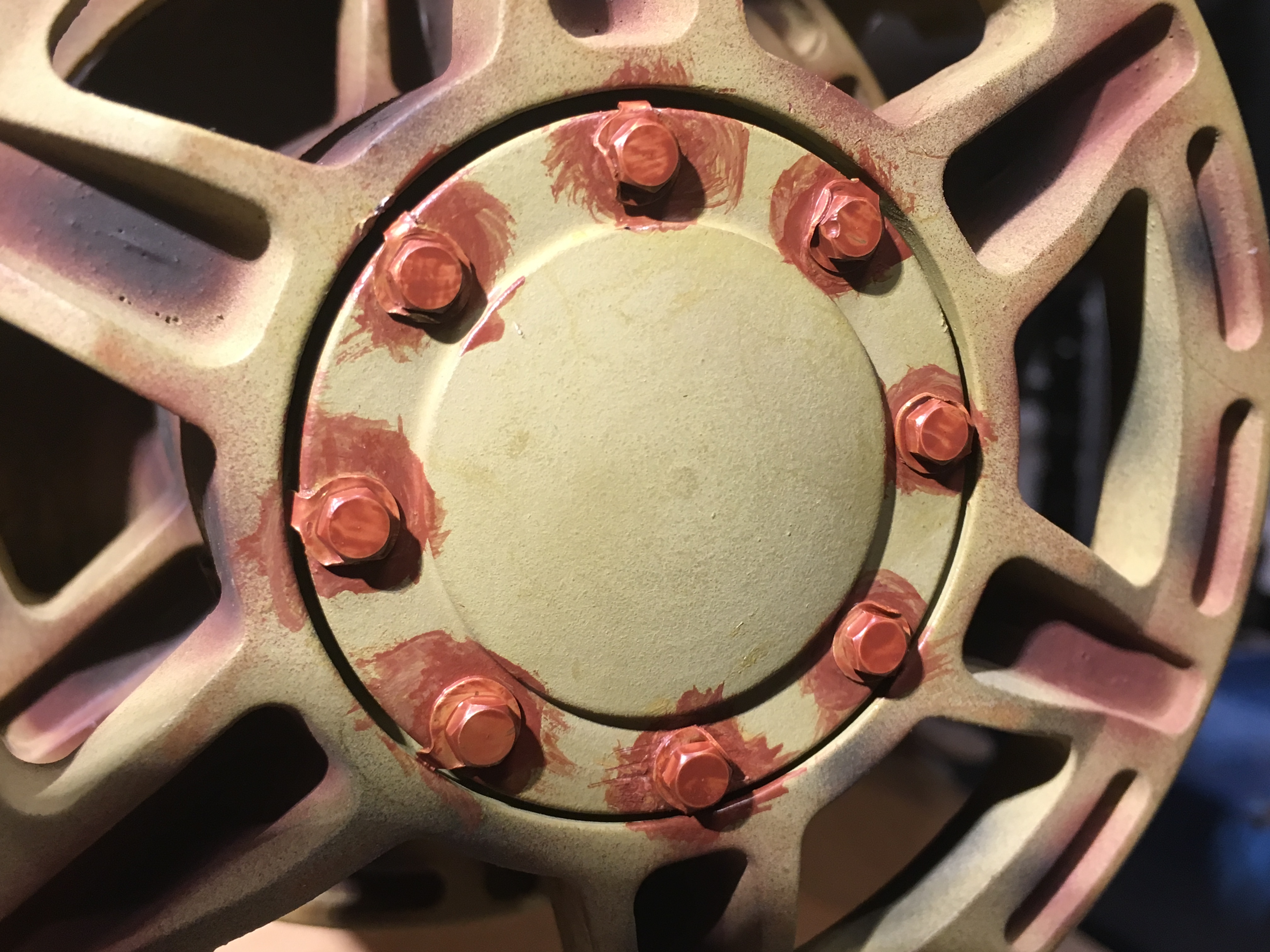

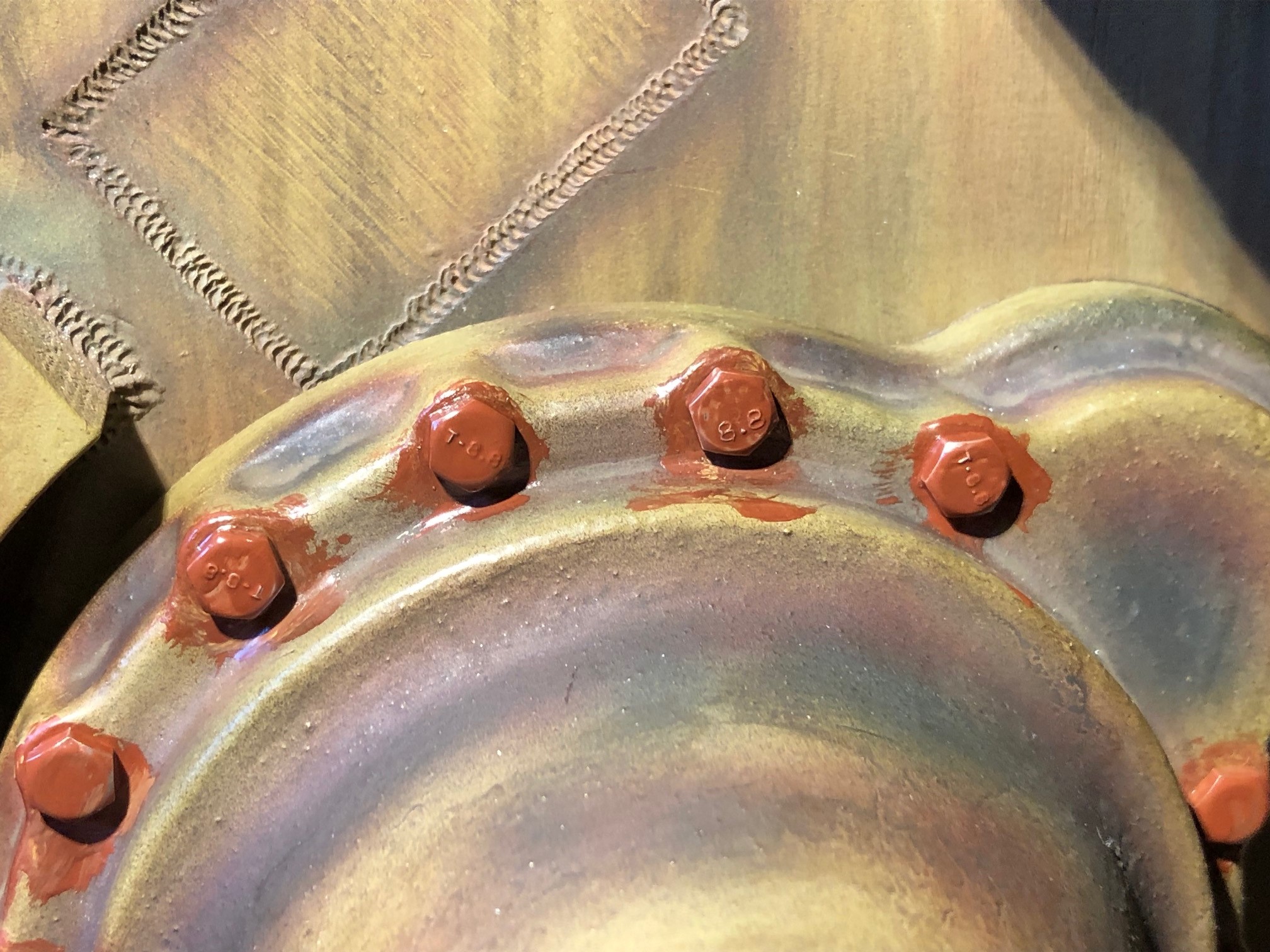

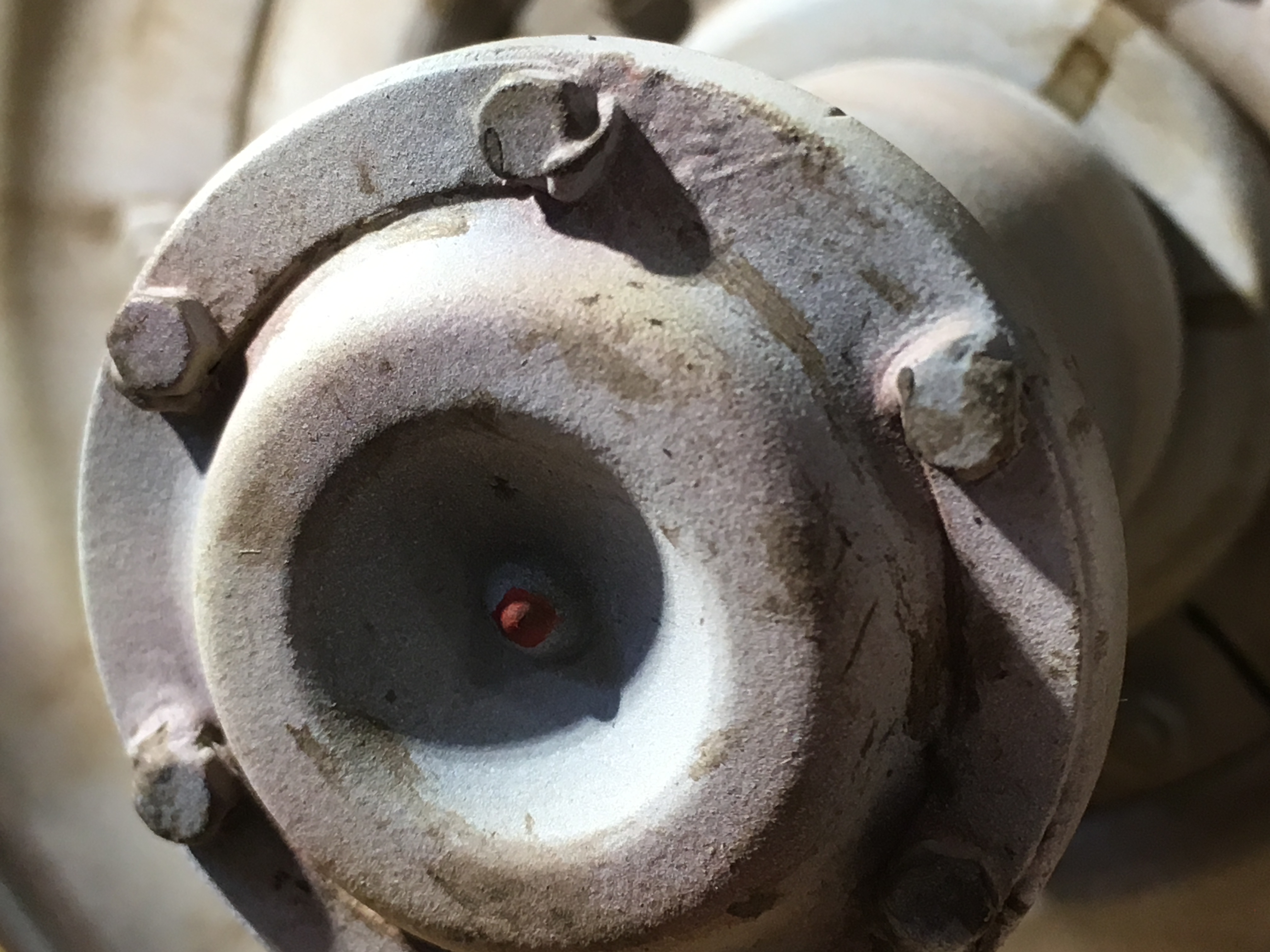

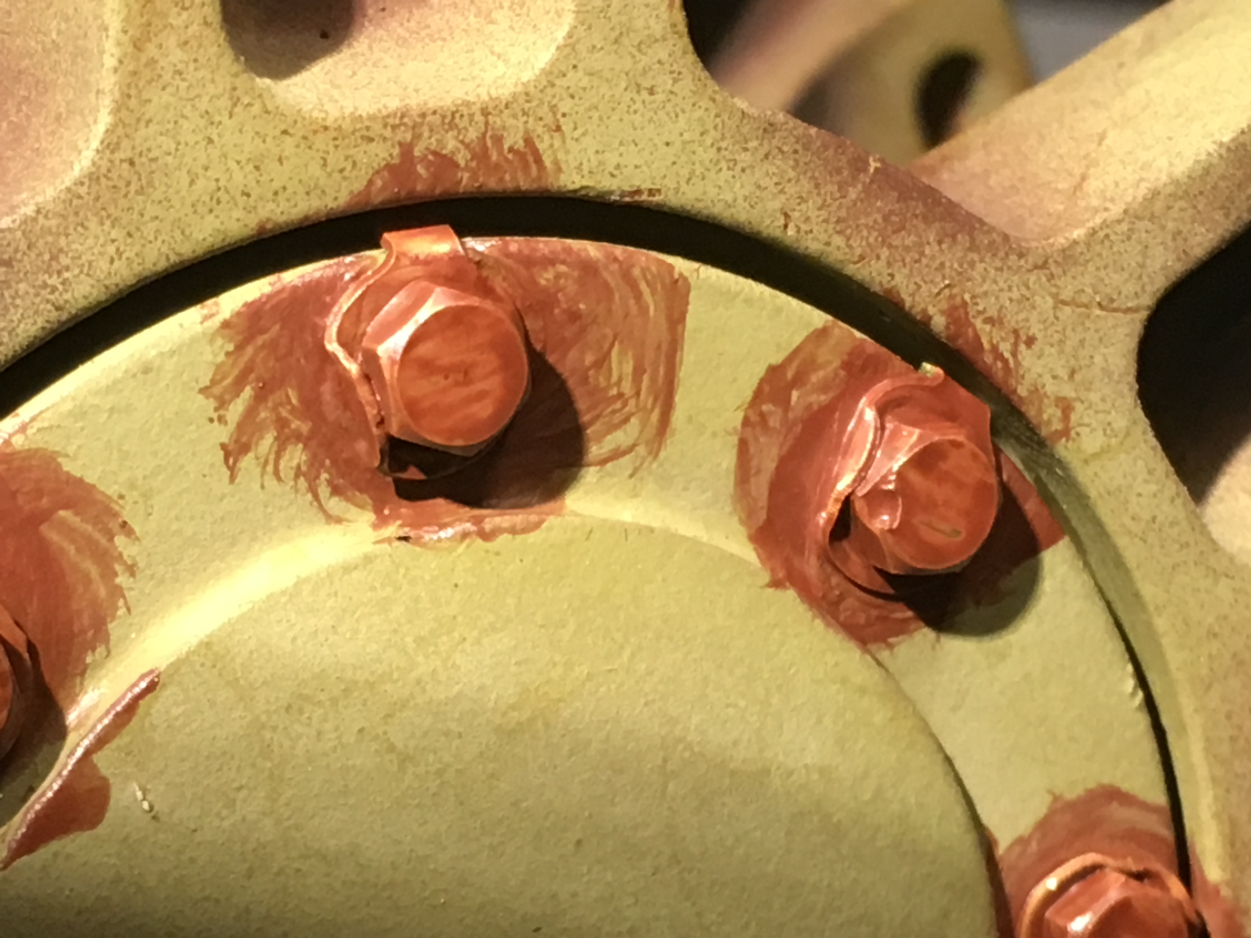

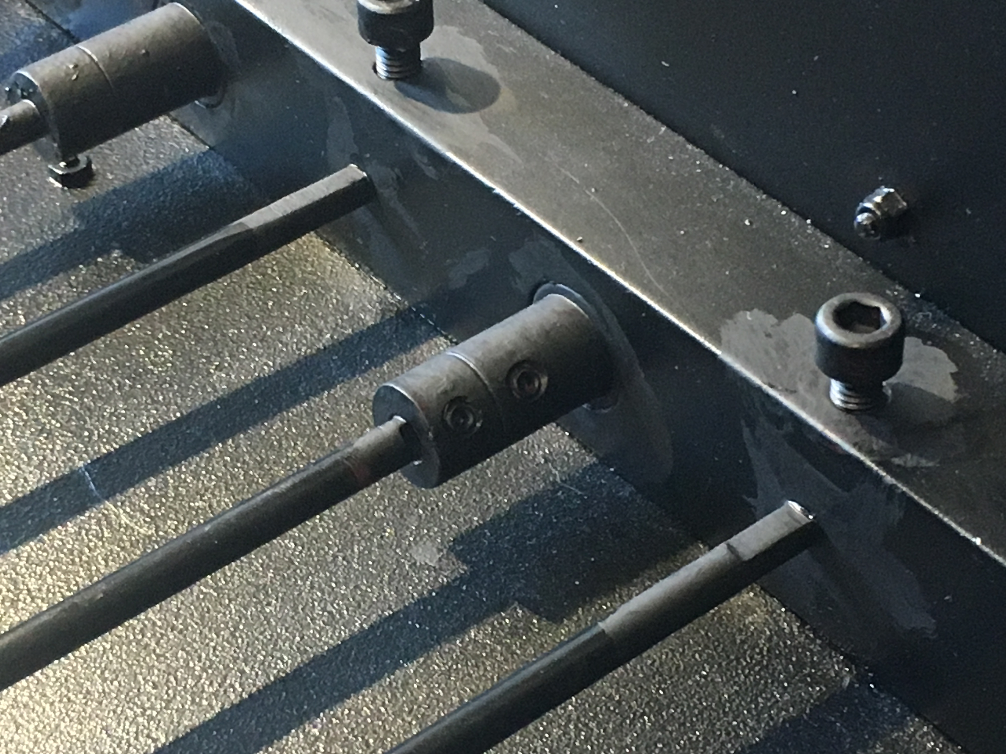

In the next photos i start with the mounting of the idler wheels and the swing arms.
the first screw is a hexagon head screw
Regards Martin

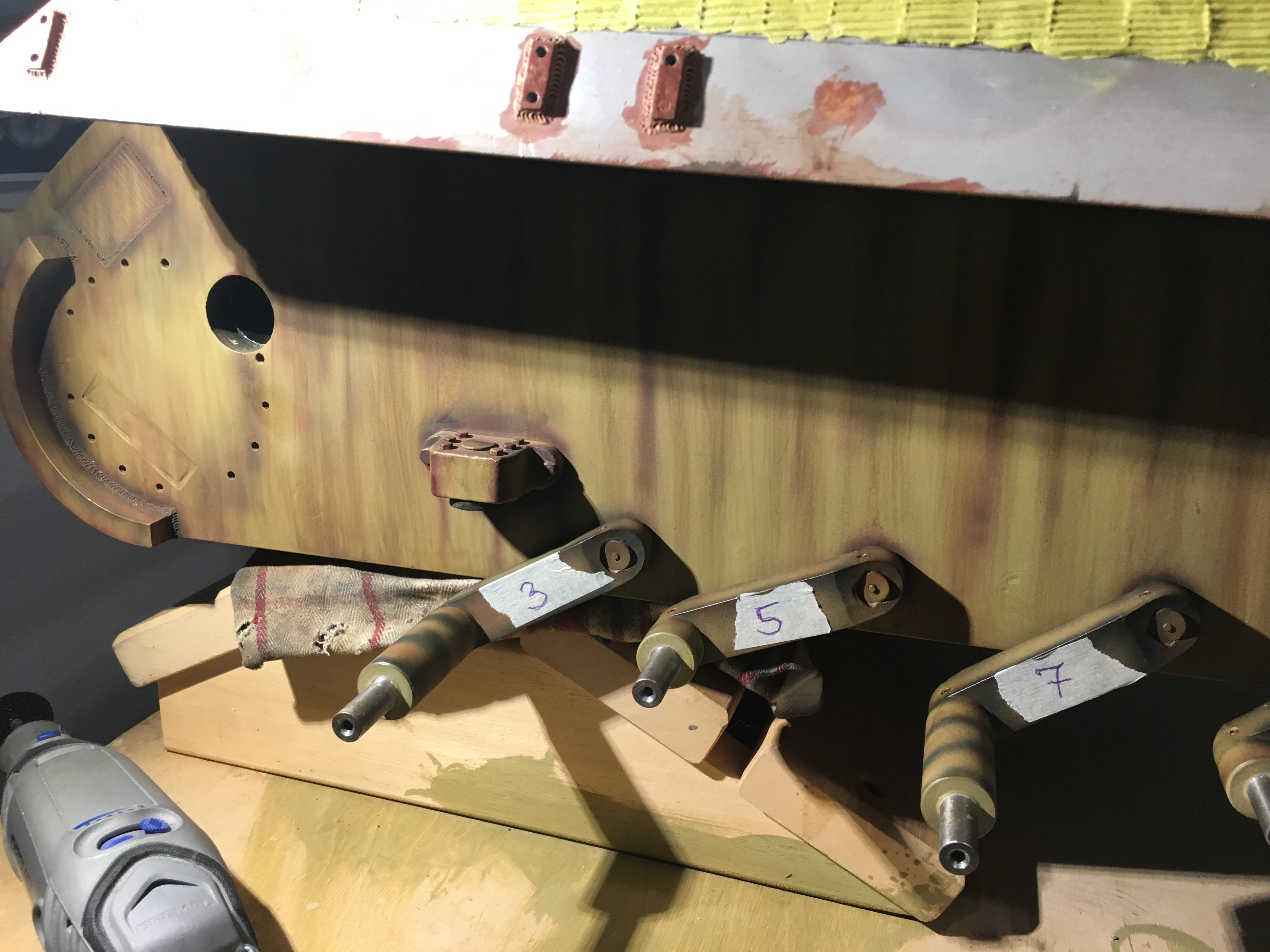

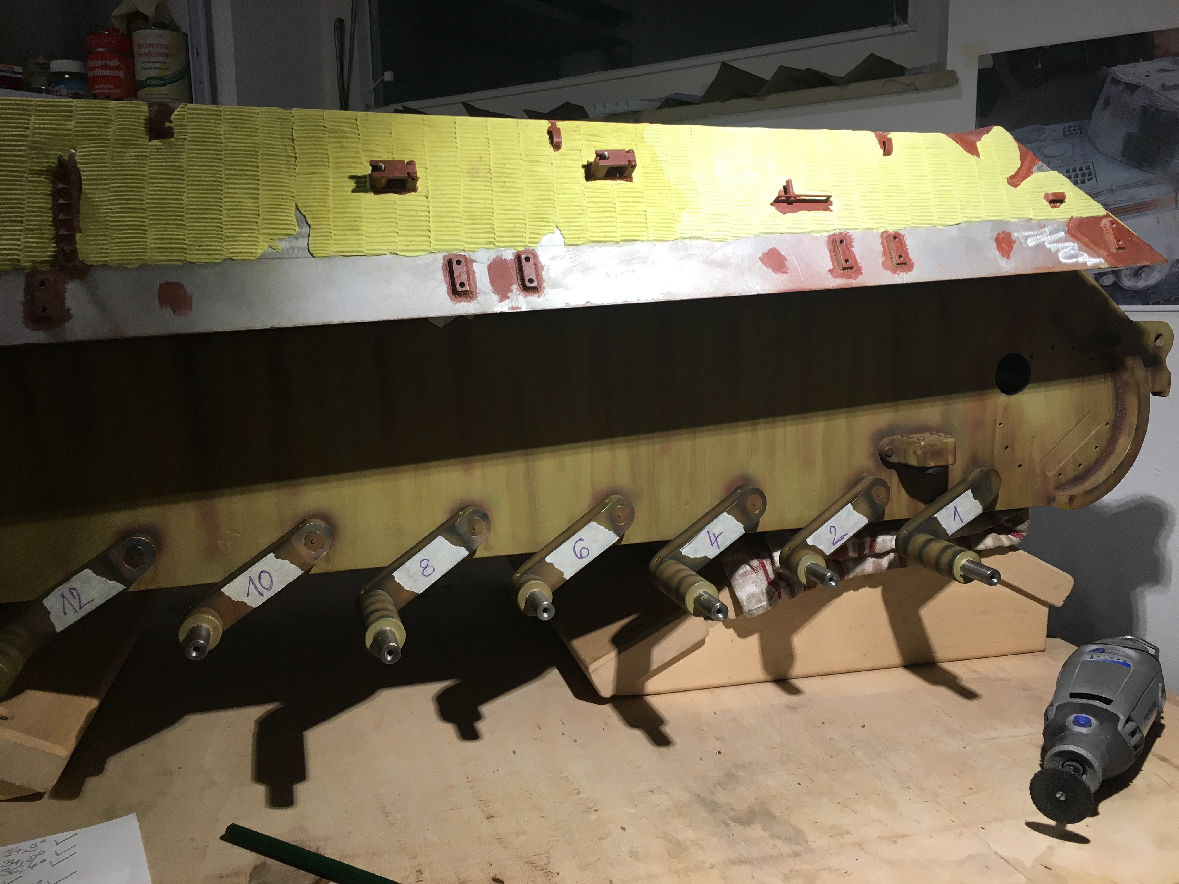

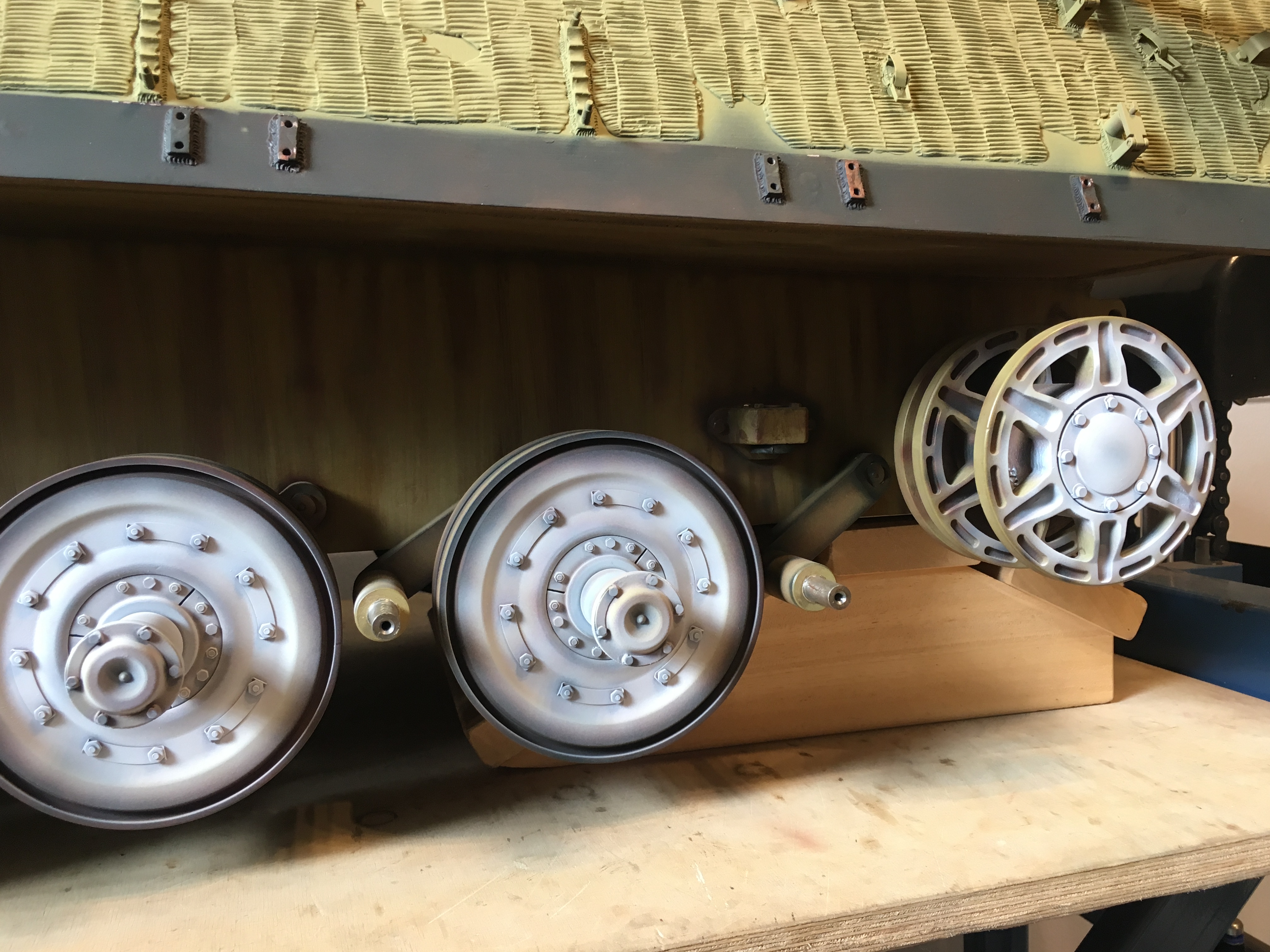

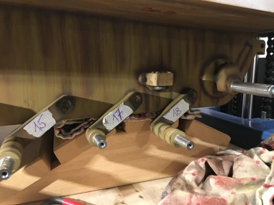

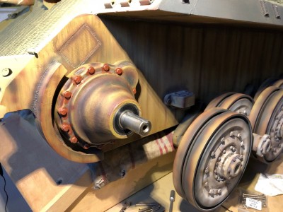

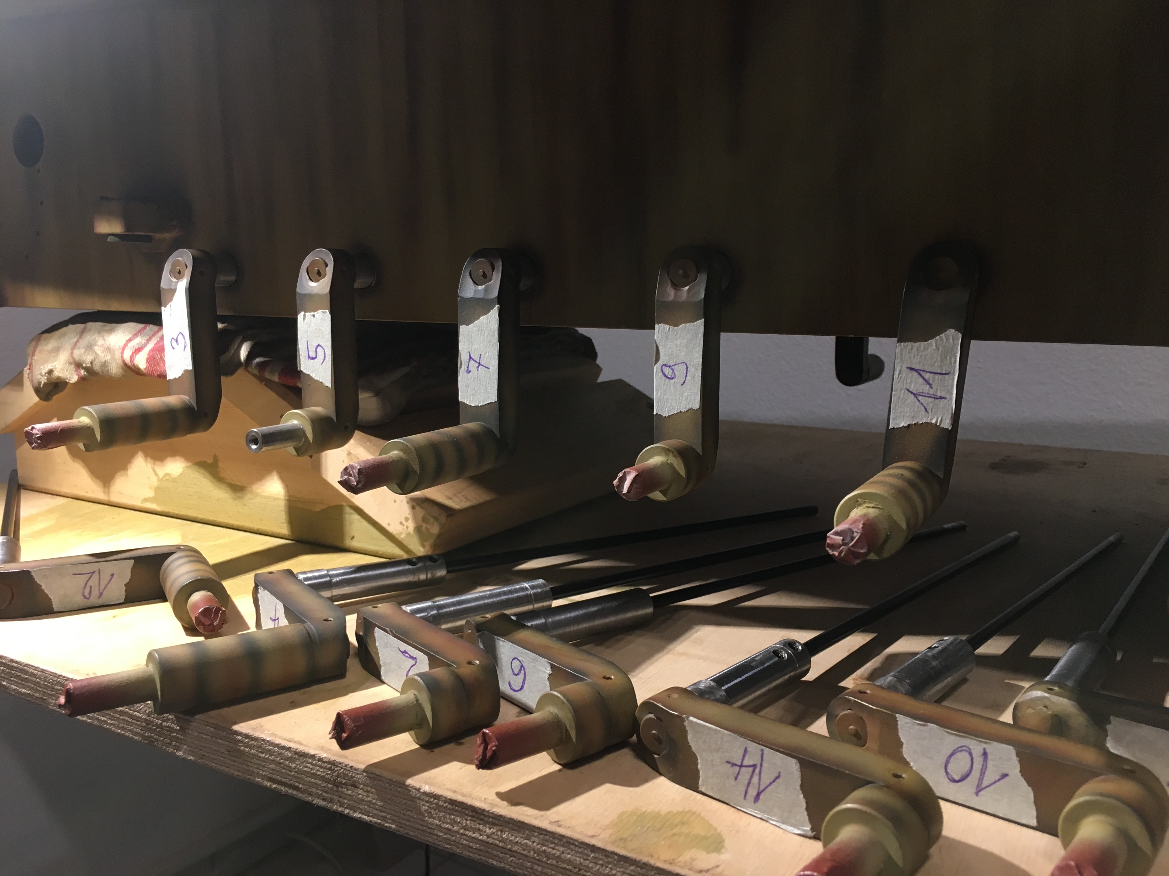

The swing arms are first mounted, now i start the adjustment of the correct angle at 35° and also the alignment of the steel track from the roadwheels to the idler wheel.
Slowly it looks like a king tiger again.
Regards Martin

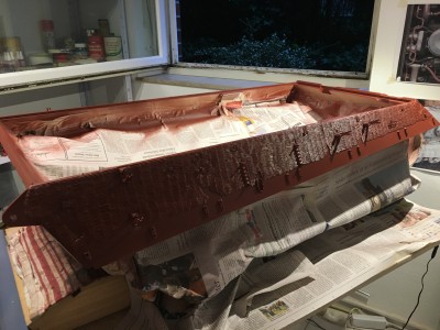

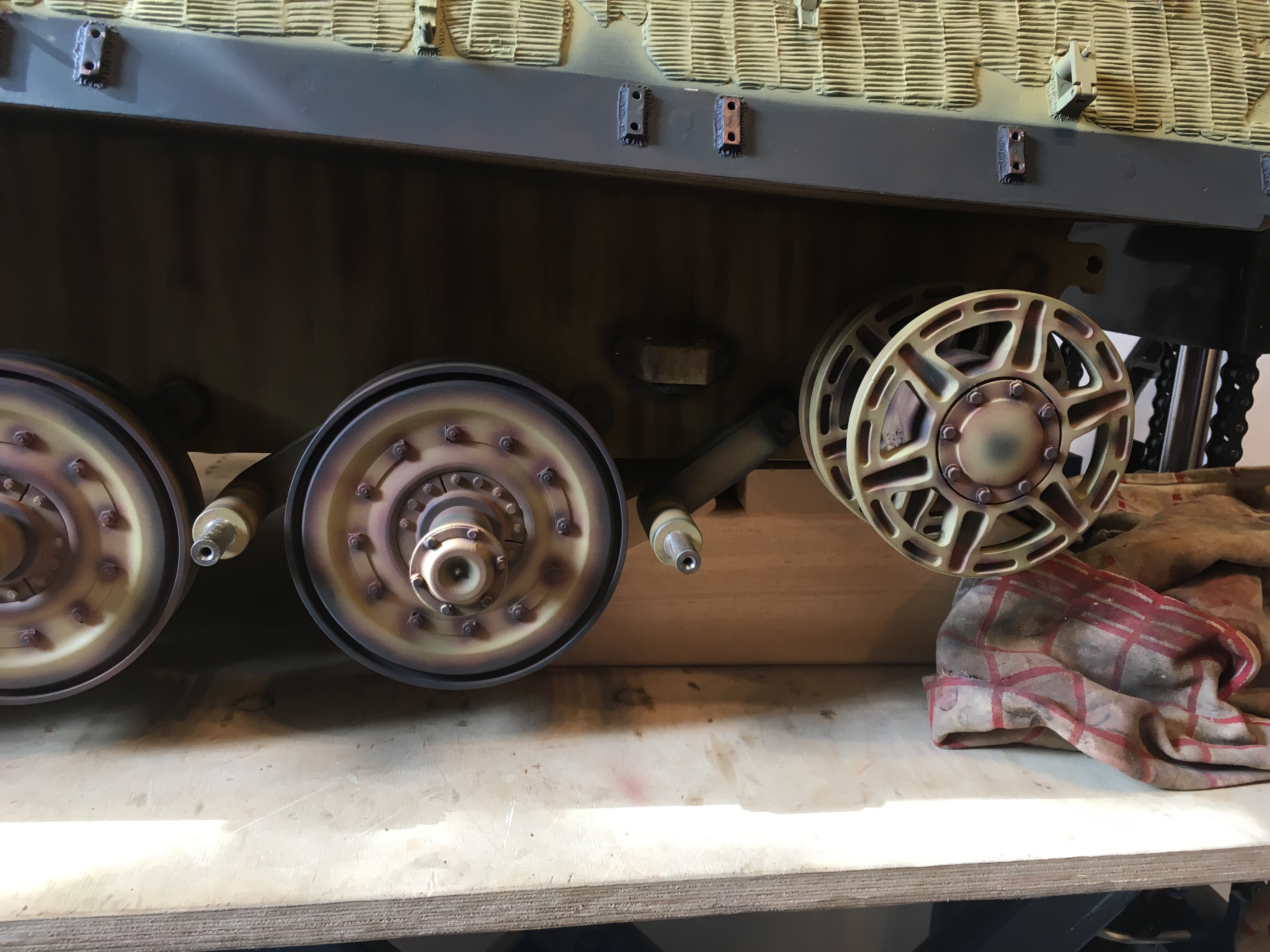

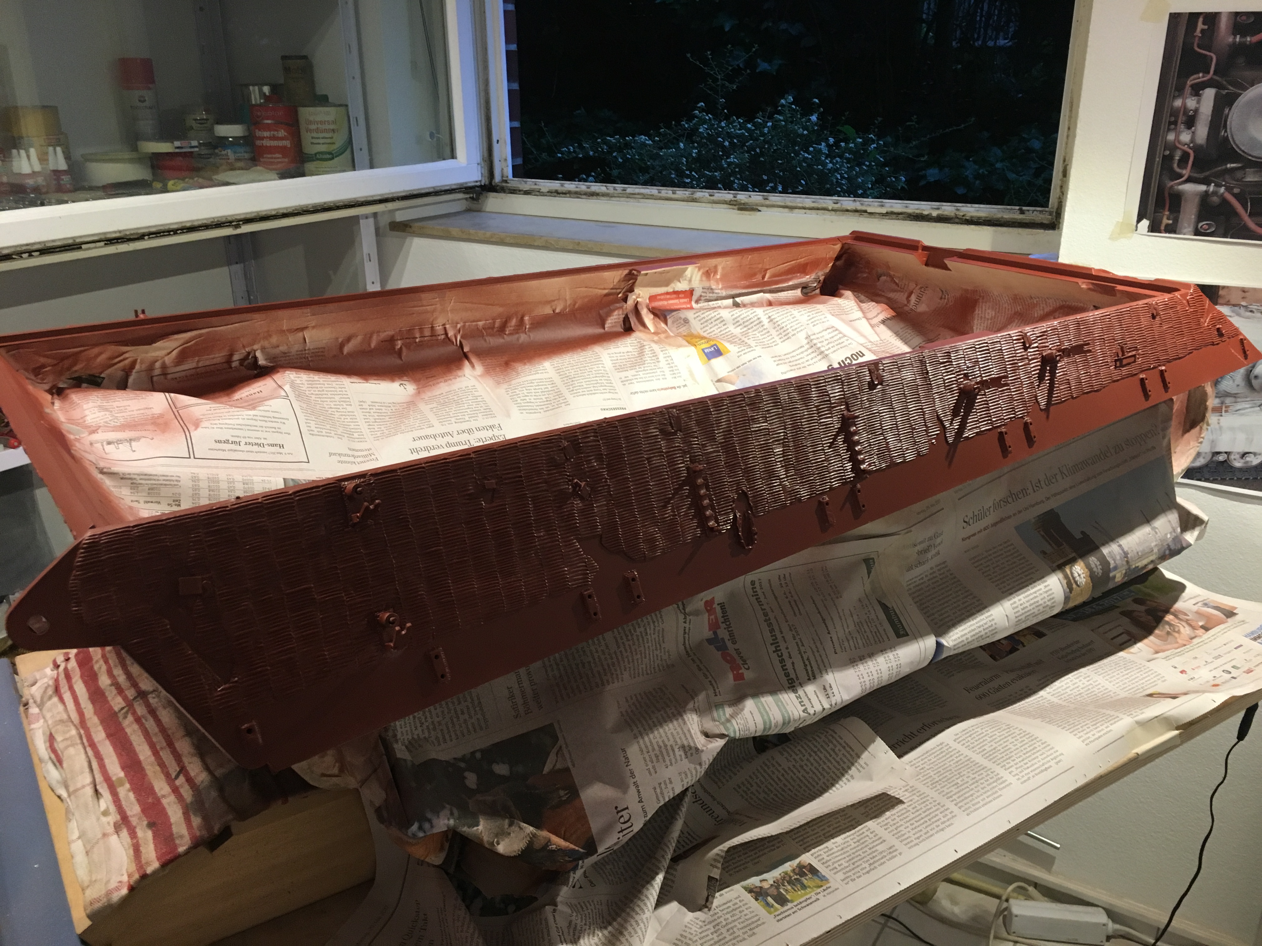

now the swing arms are glued and fixed in after adjustment and now i start with the etch primer for the hull.
The road wheels are ready for mountingon the swing arms. But first painting the hull!!
Regards Martin

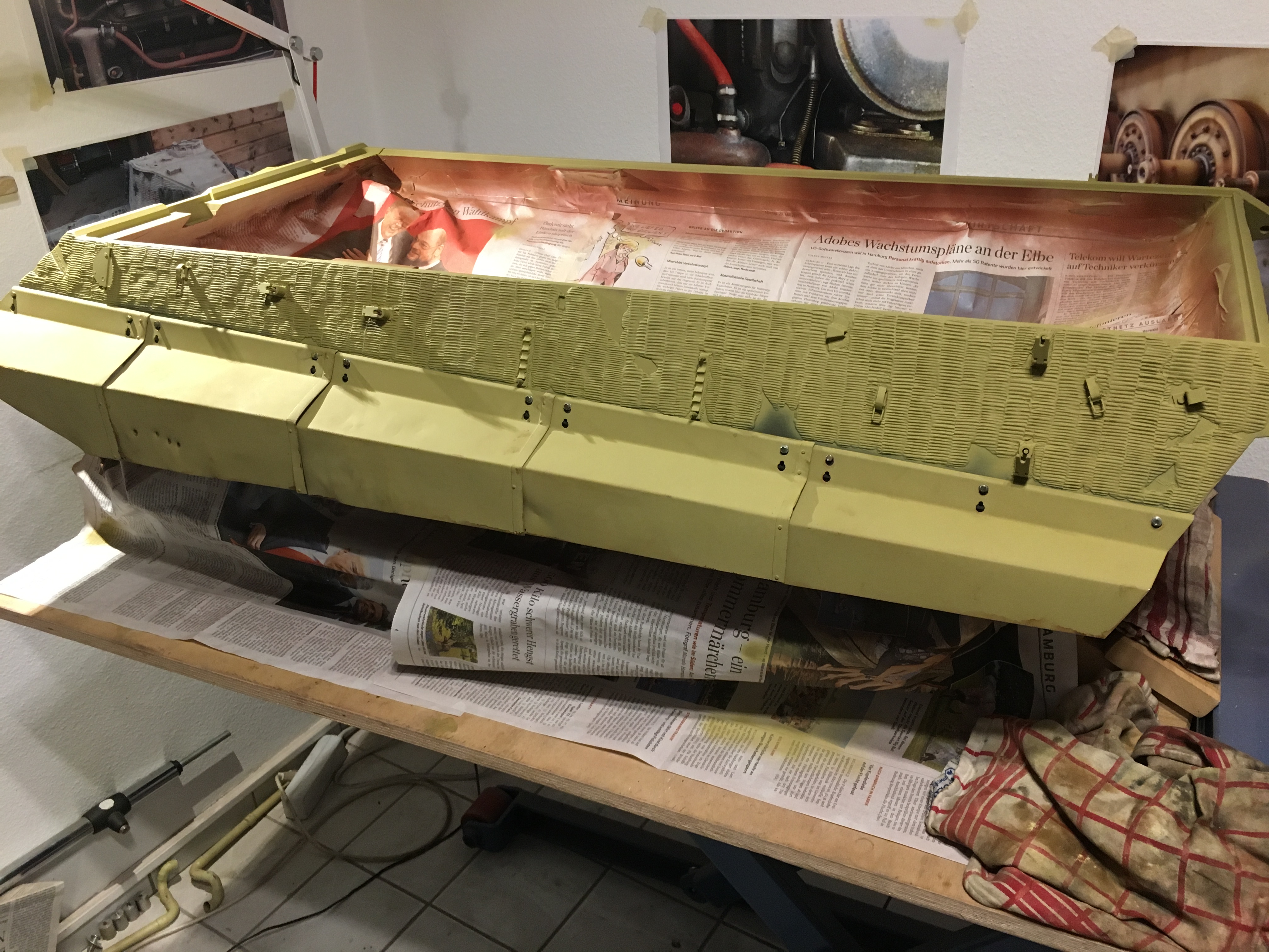

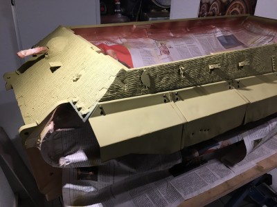

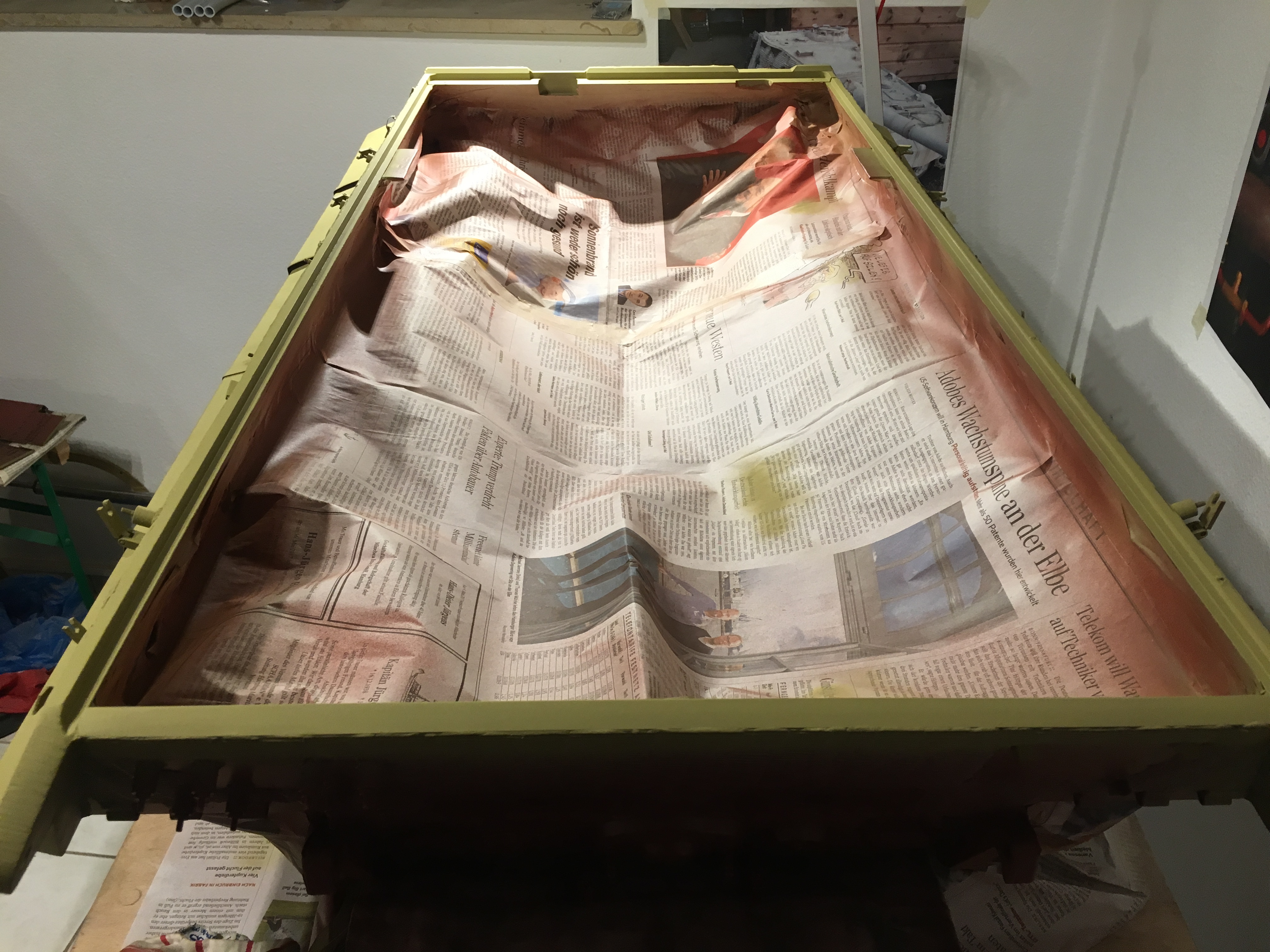

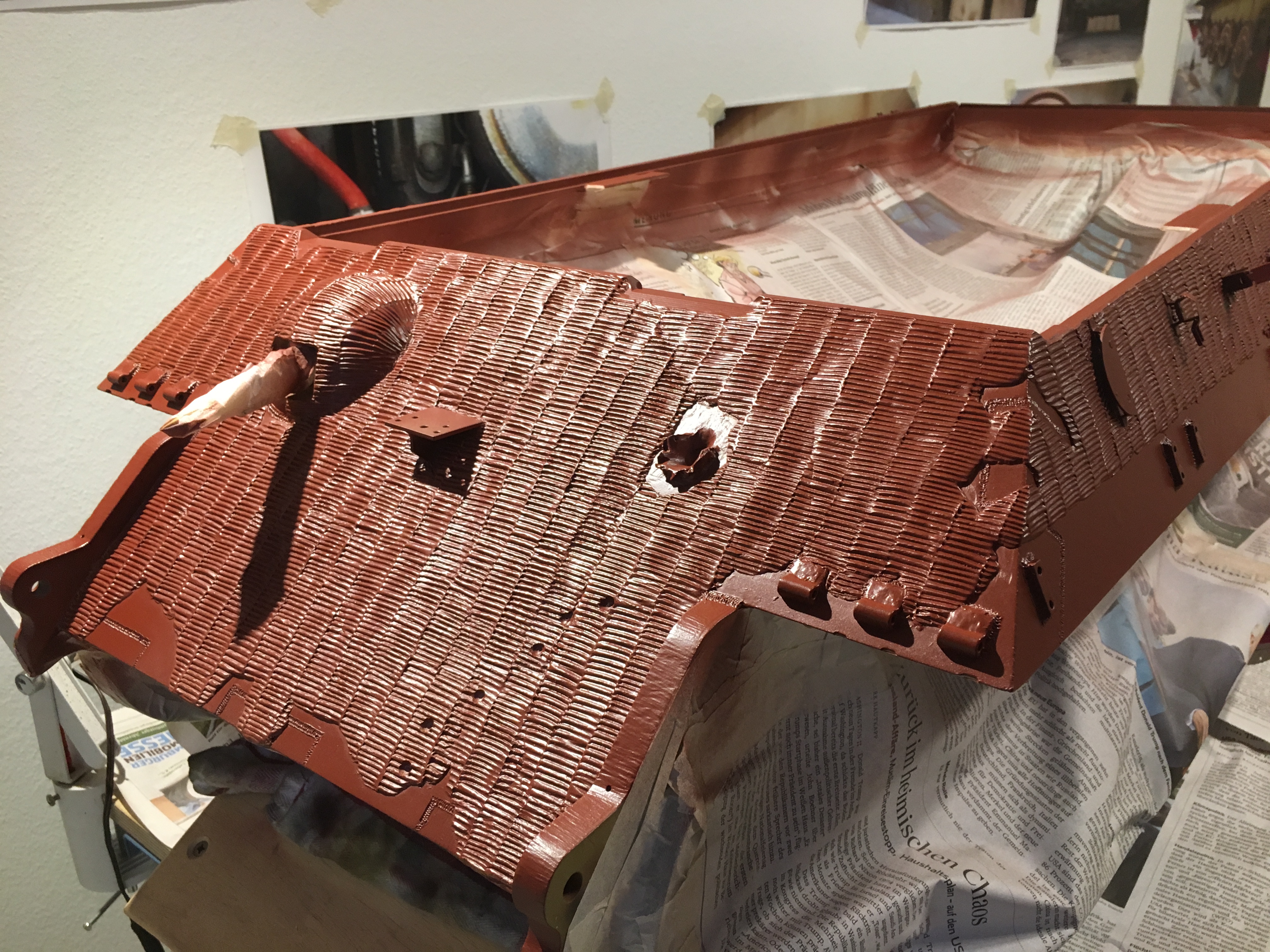

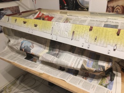

after the etch primer comes the primer and than the first colour: dunkelgelb.
Regards Martin

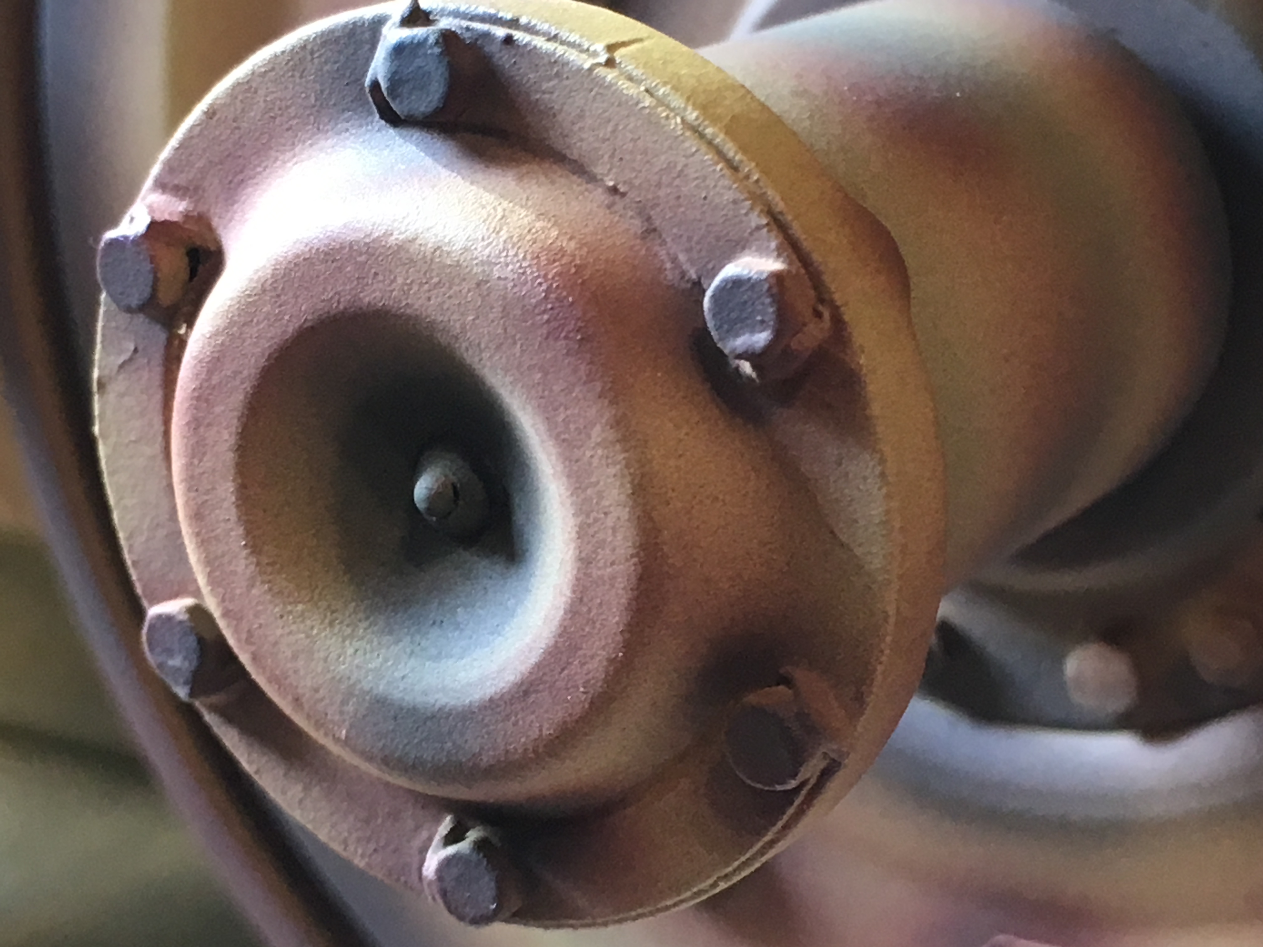

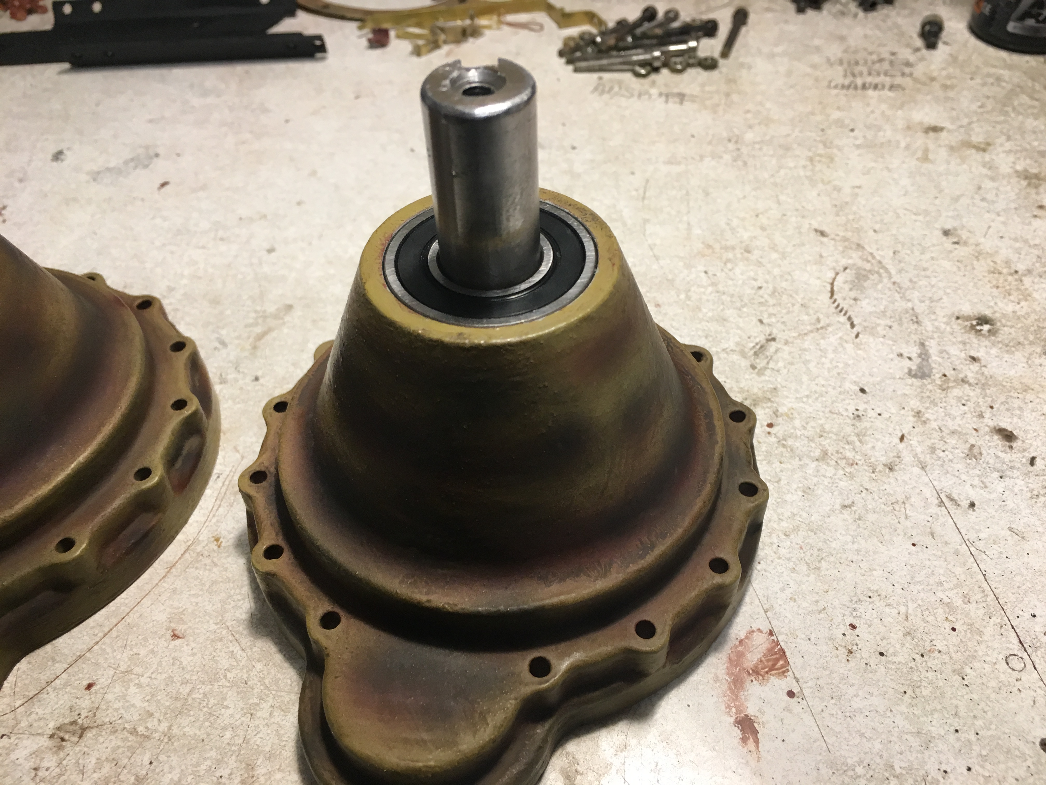

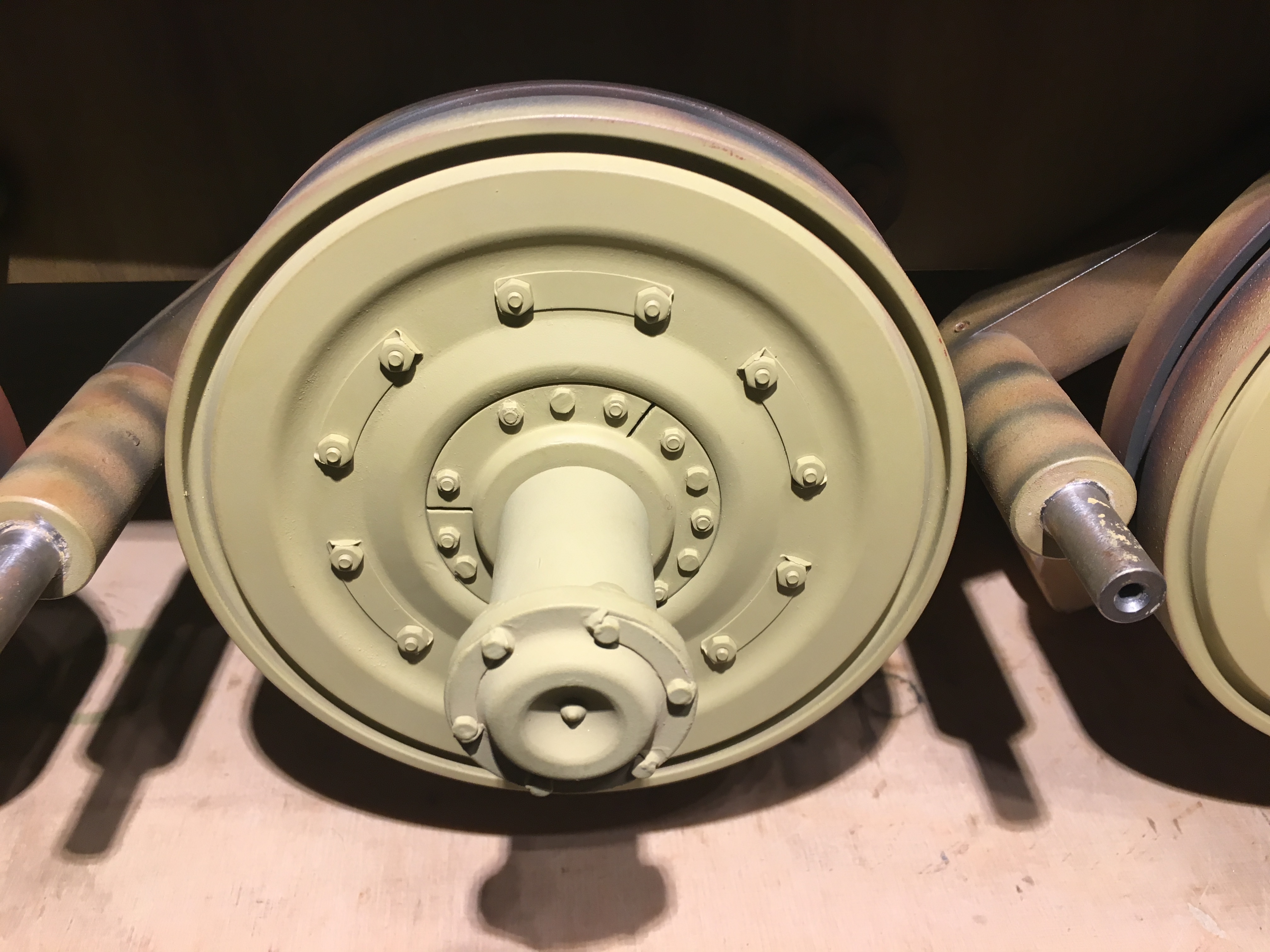

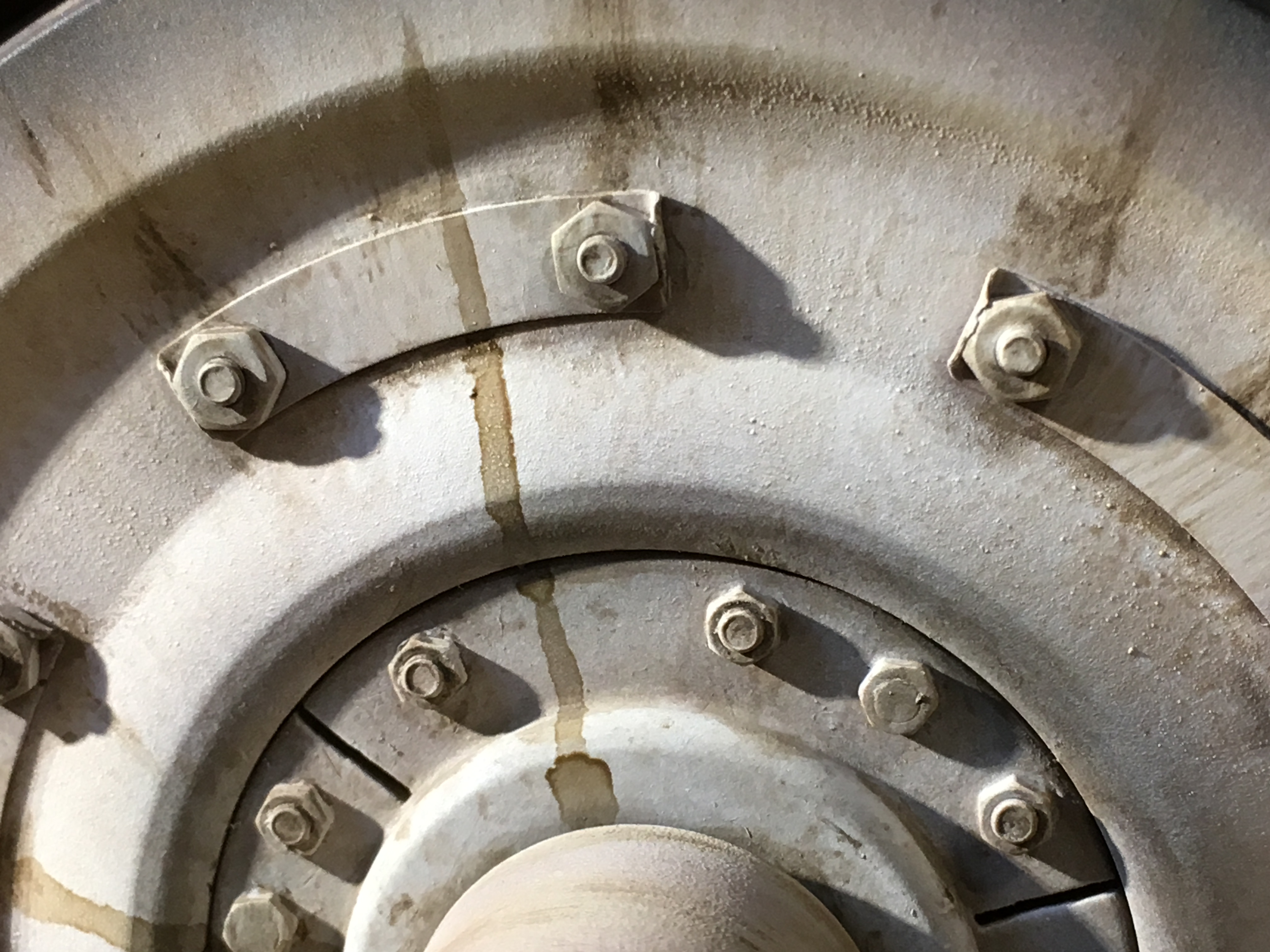

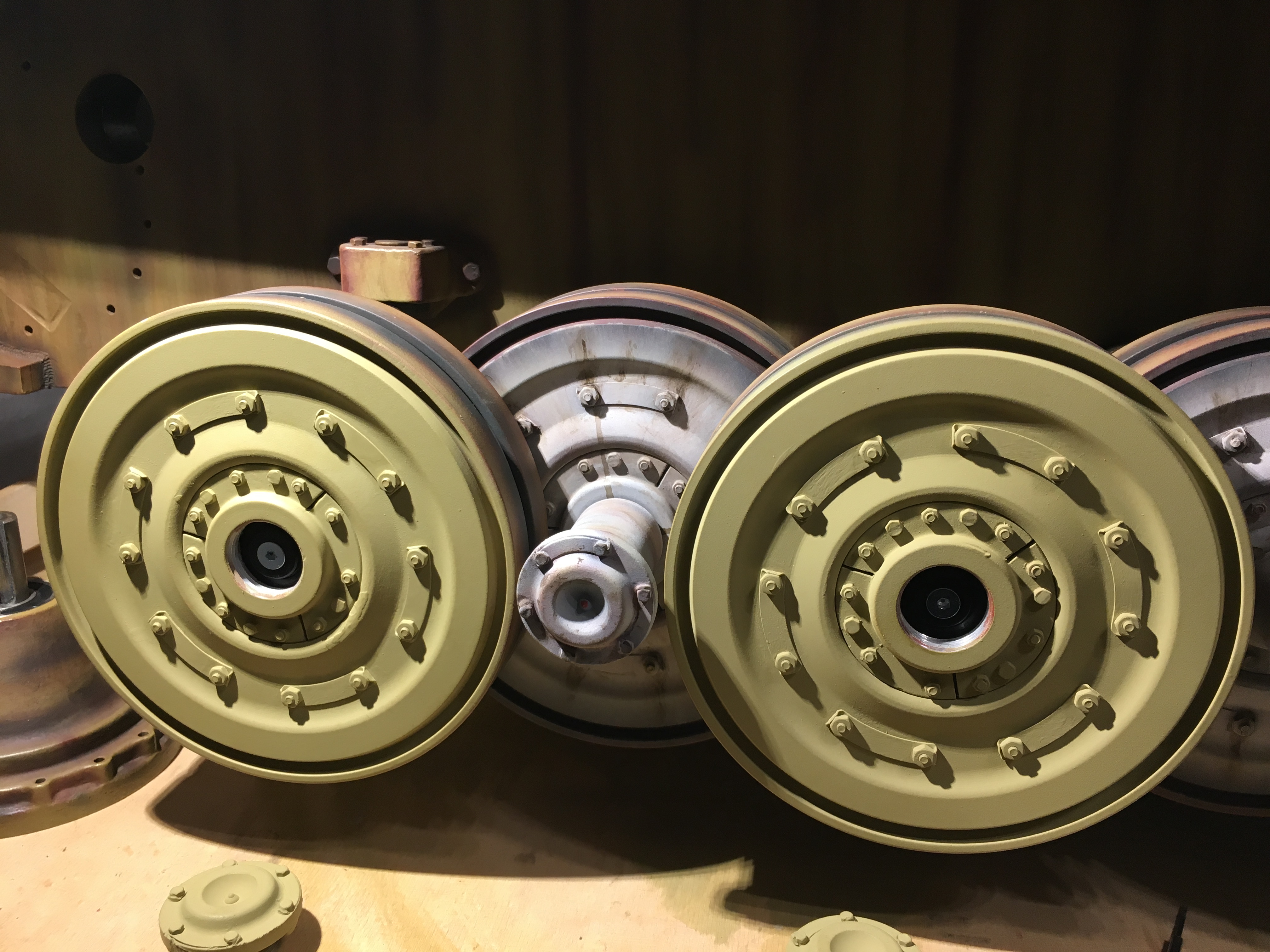

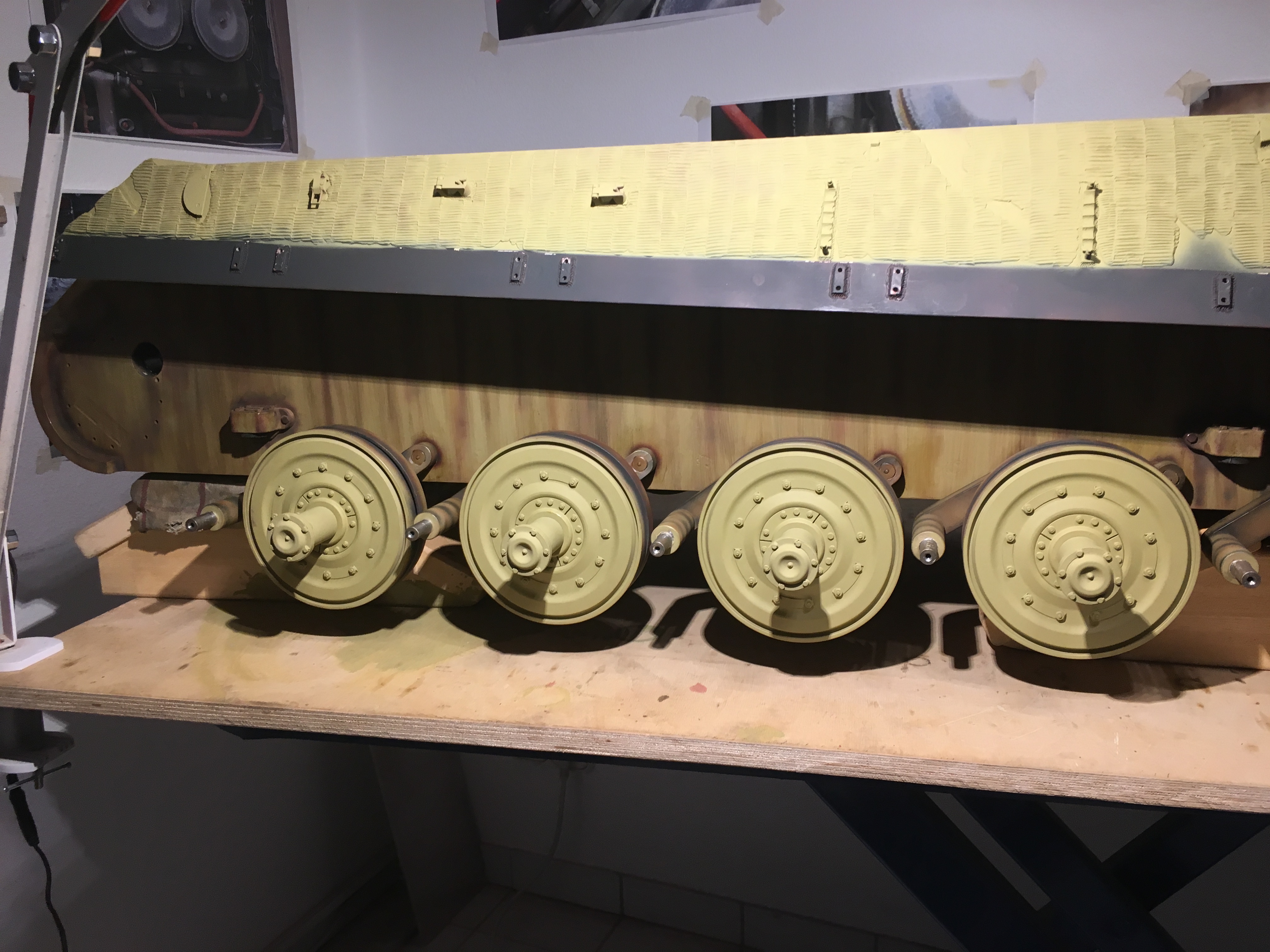

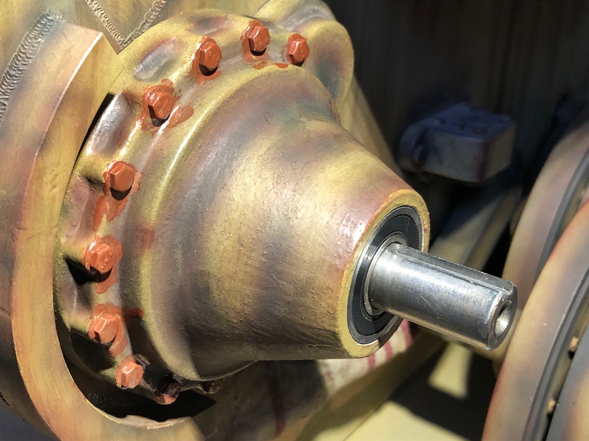

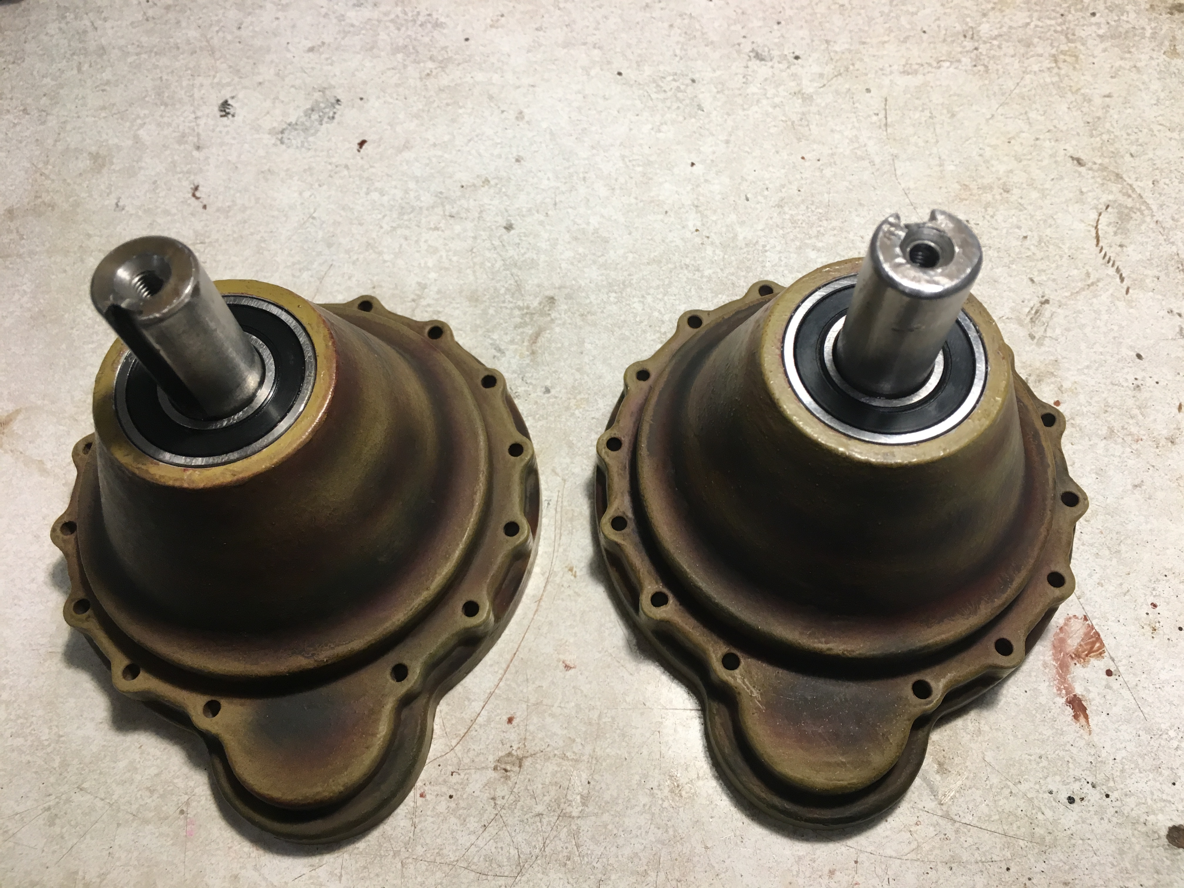

now comes the first road wheels and the final drive for mounting.
Regards Martin

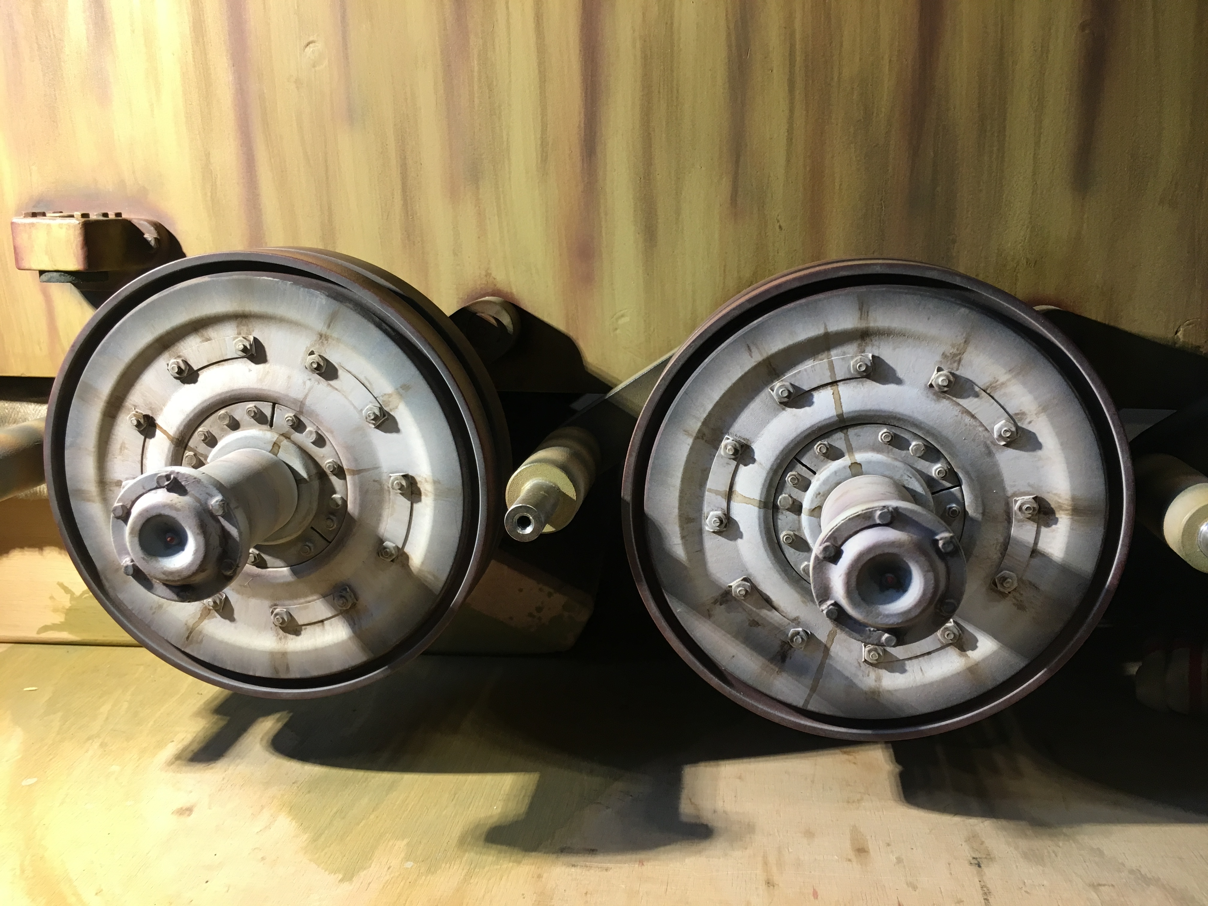

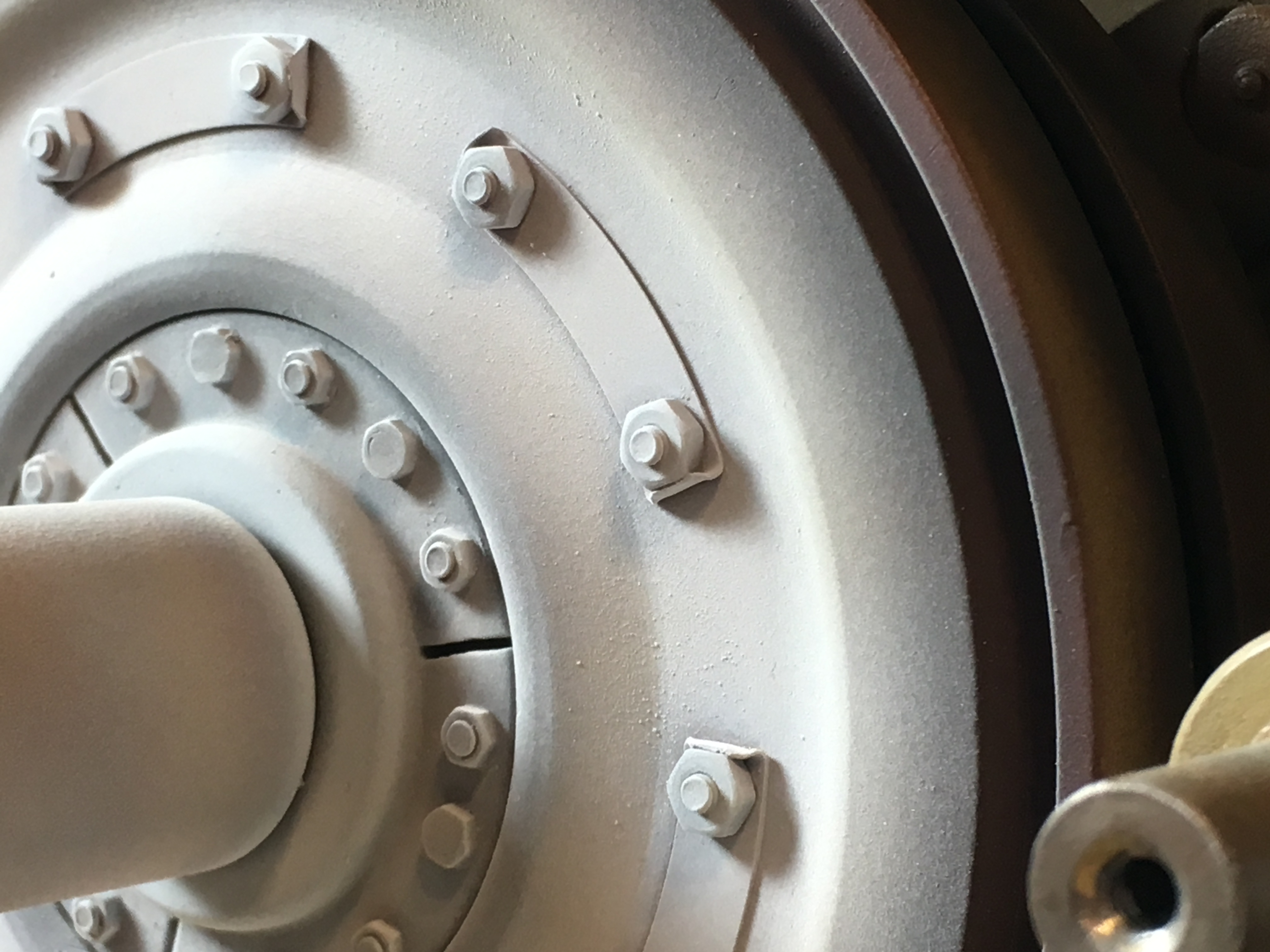

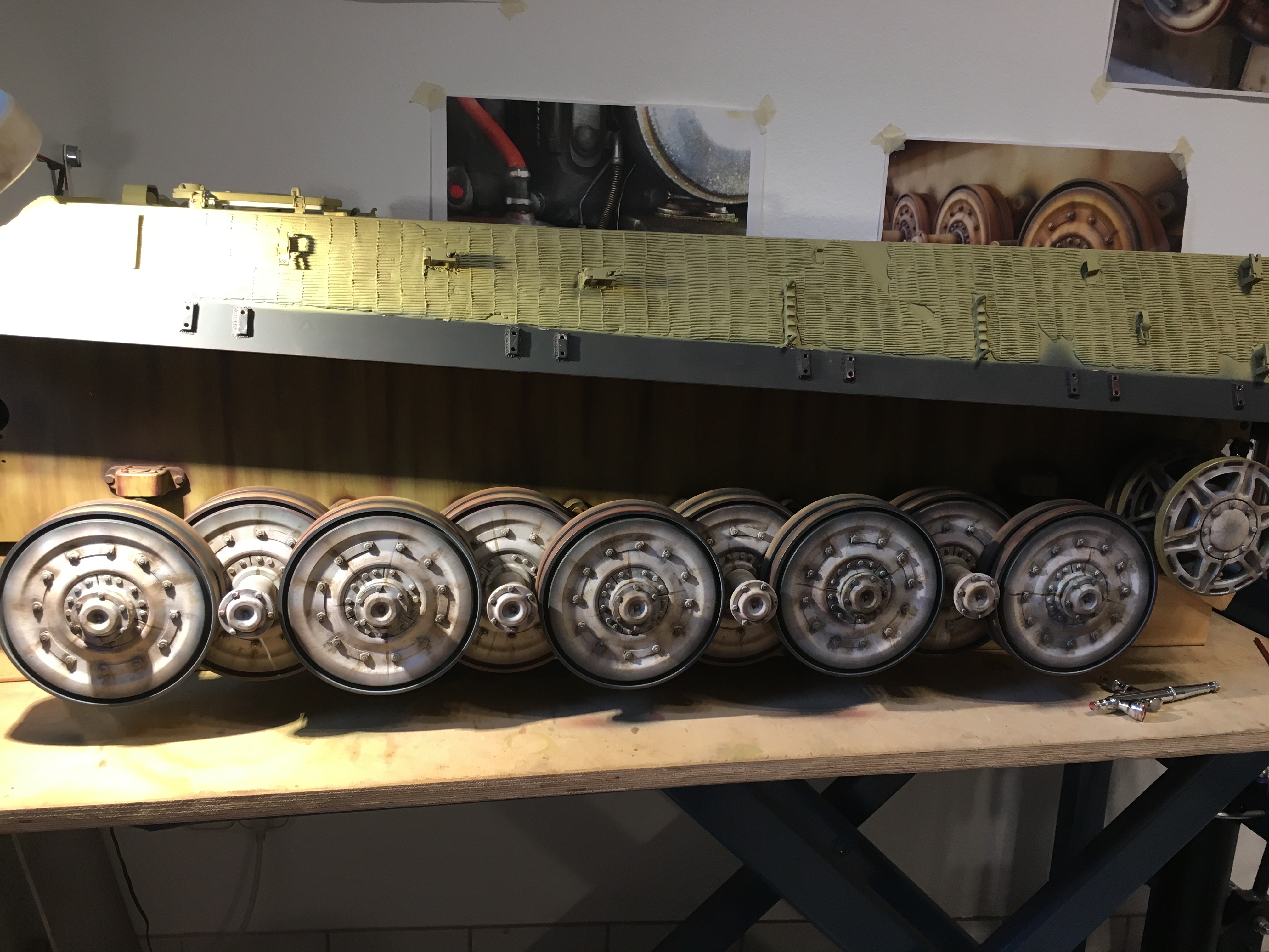

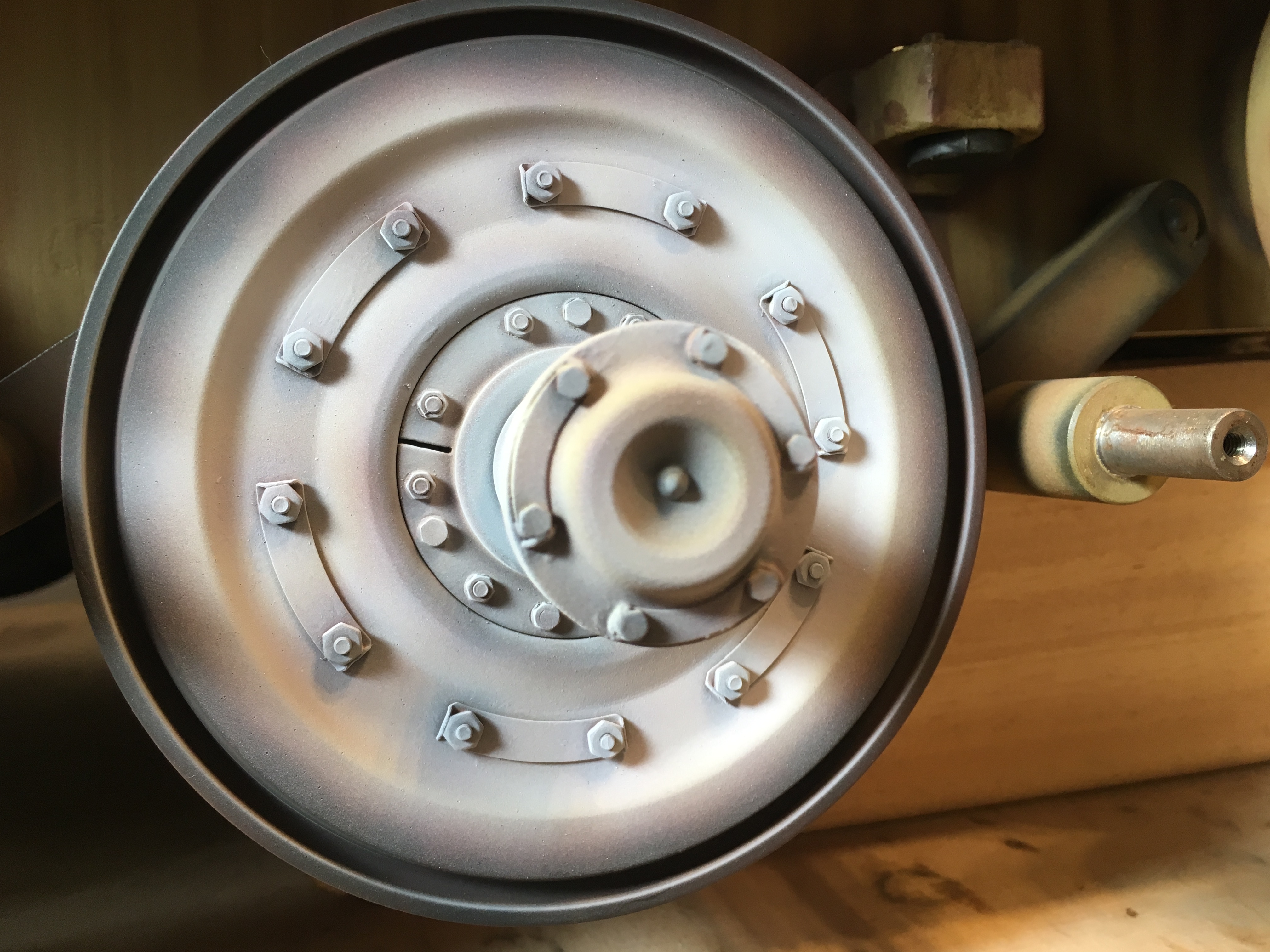

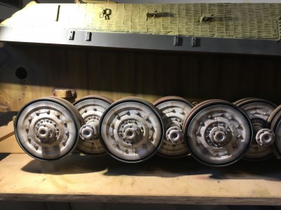

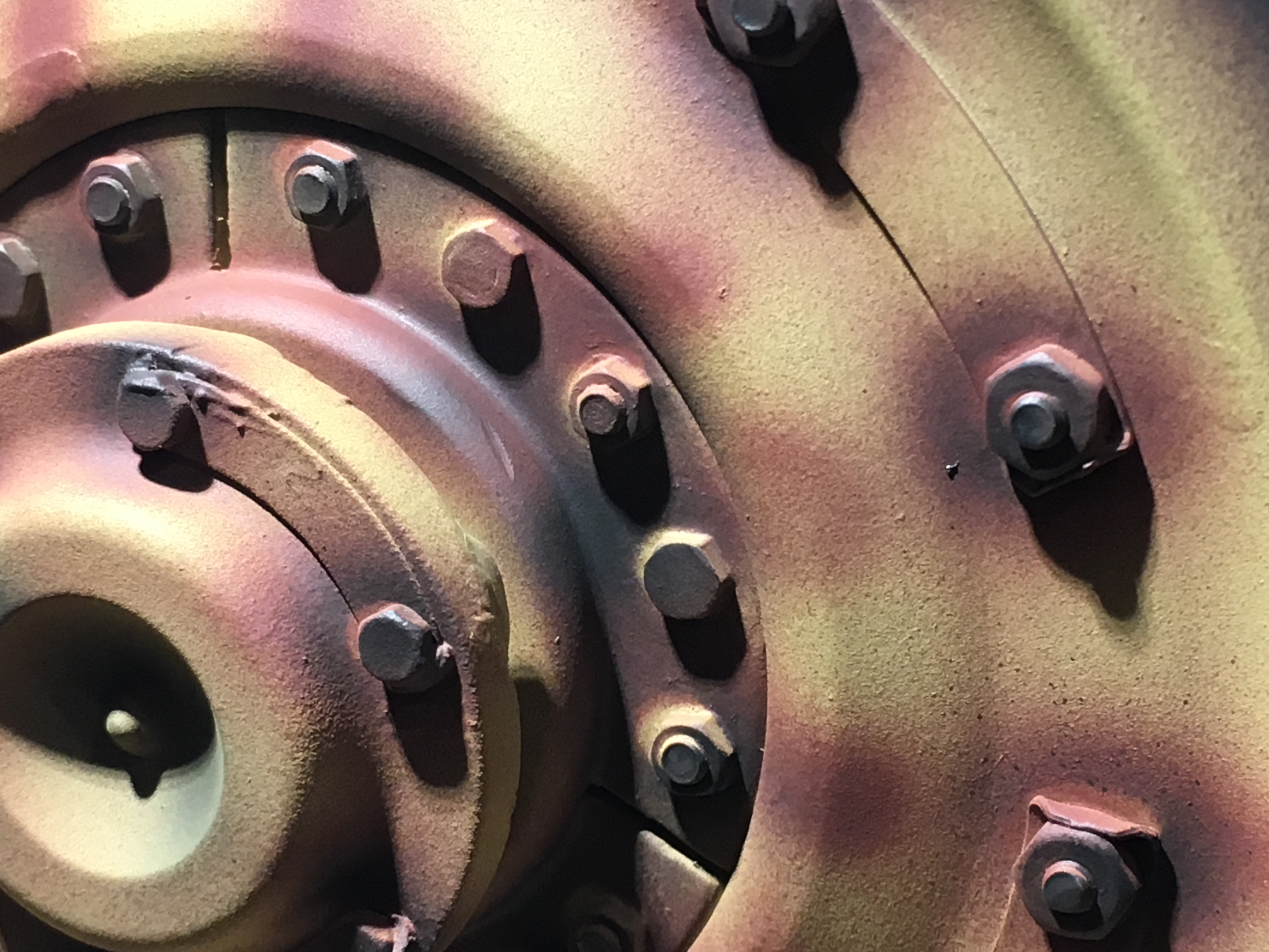

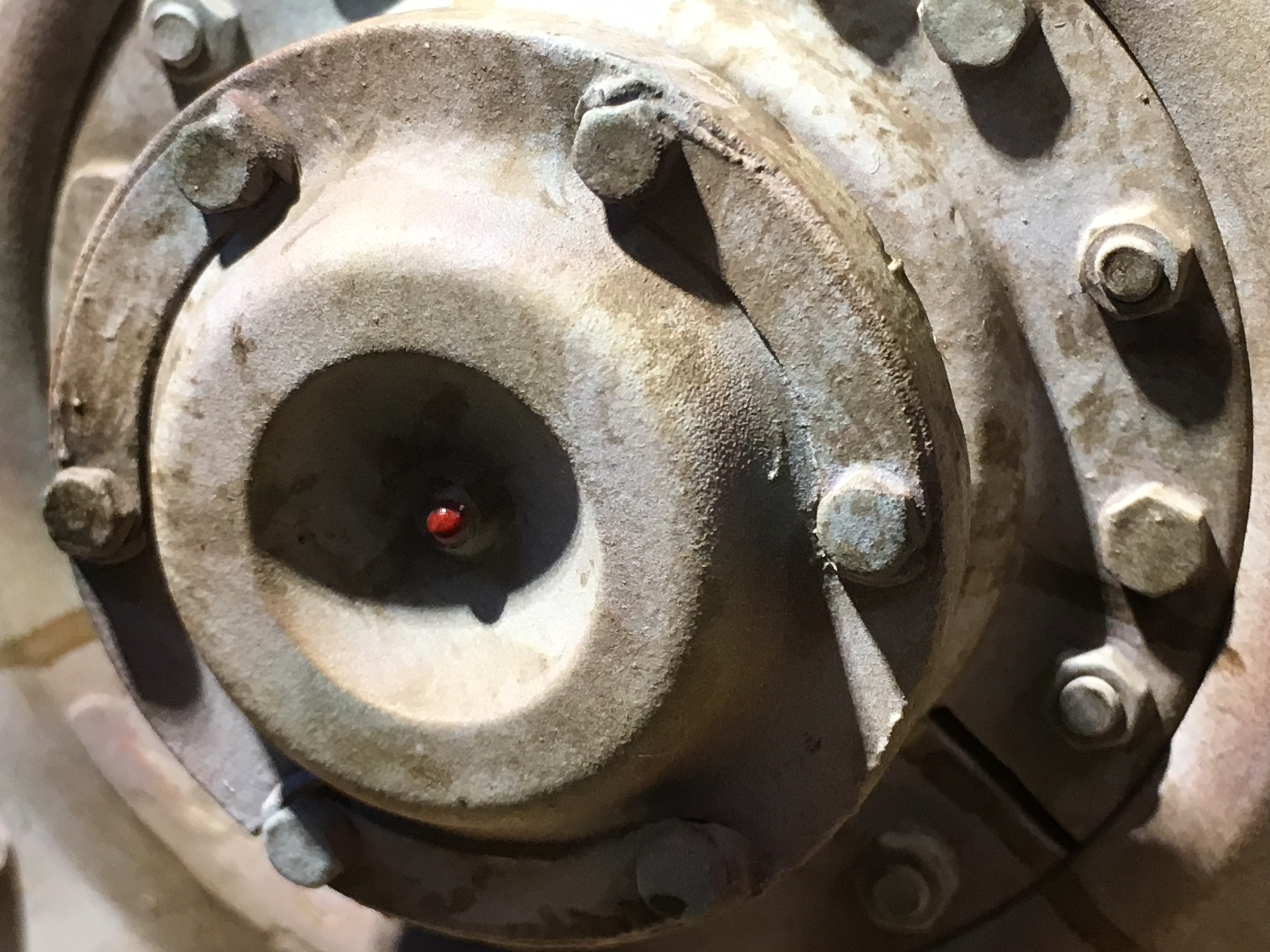

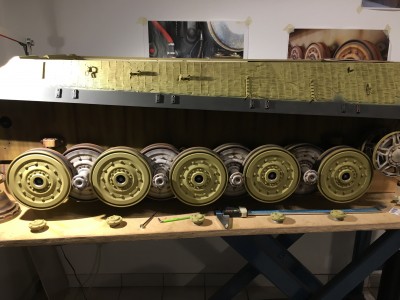

After the first row is mounted and weathered for the first time, i start with the painting in winter white.
Regards Martin

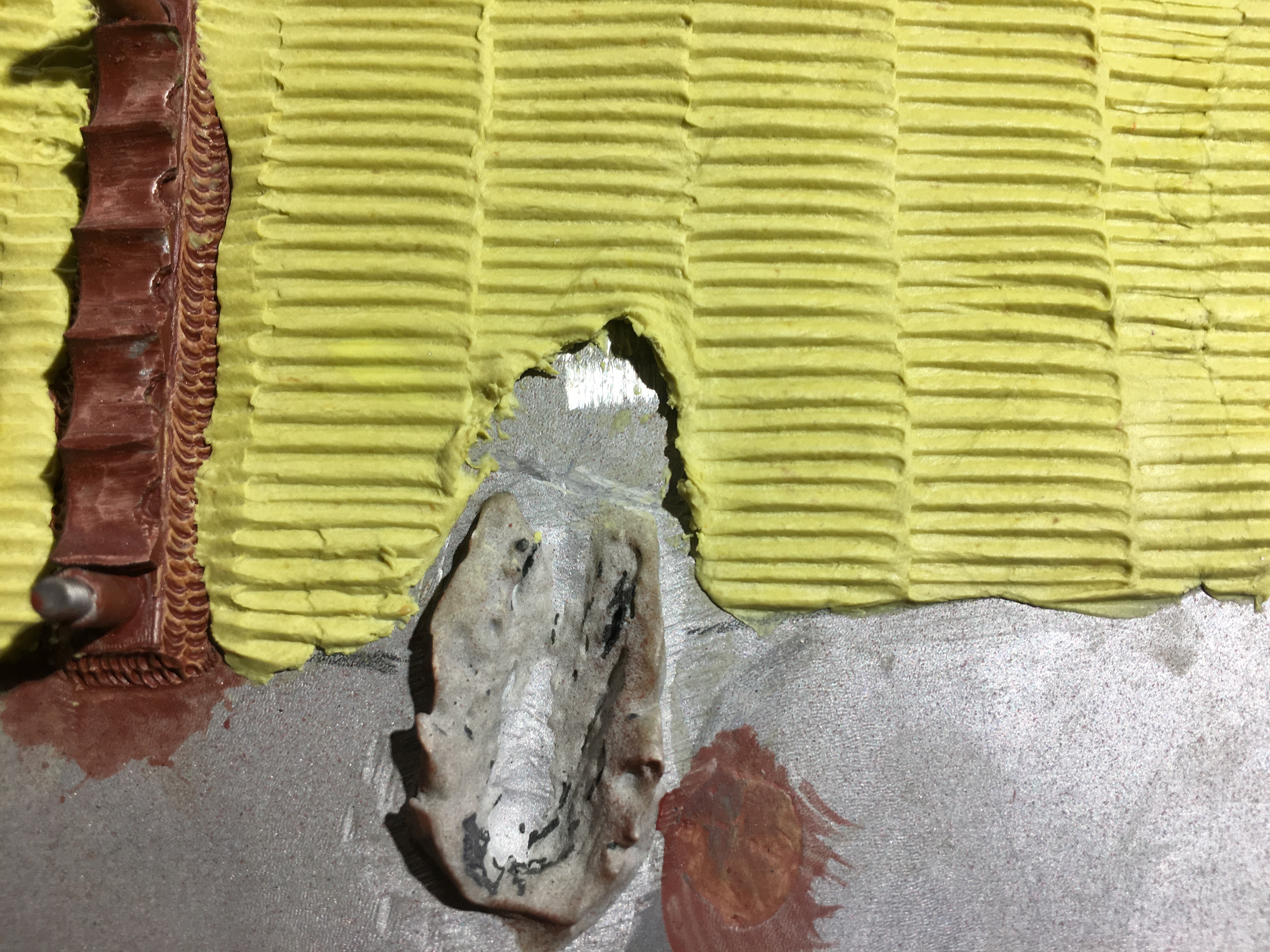

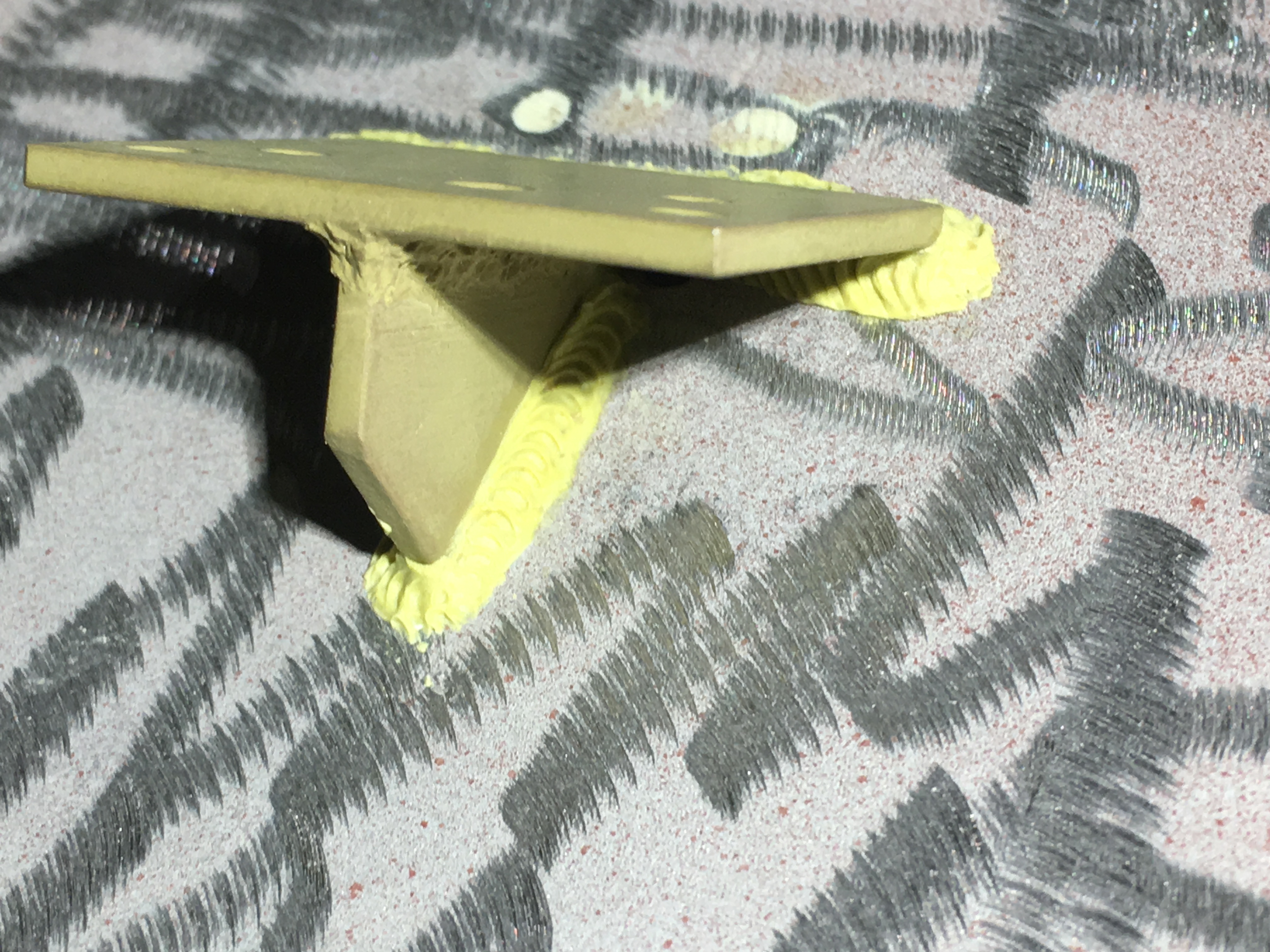

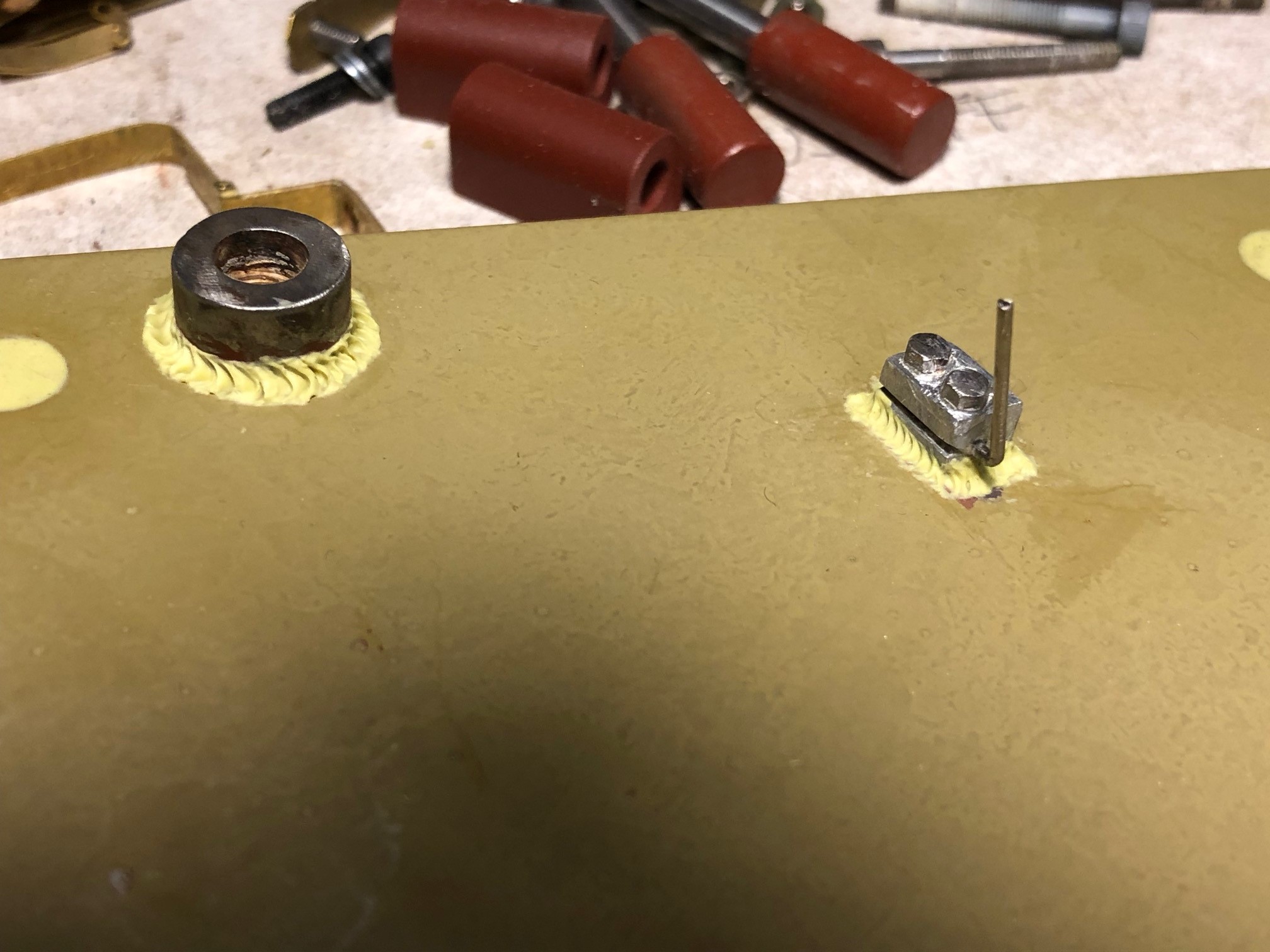

Lovely work Martin, your weathering and Zim look spot on. are you using Milliput for the Zim?
Paul. :wink:
Martin Hofmann
Posts: 486
Location: Hamburg, Germany
Has liked: 151 times
Been liked: 2010 times
Hi Paul,

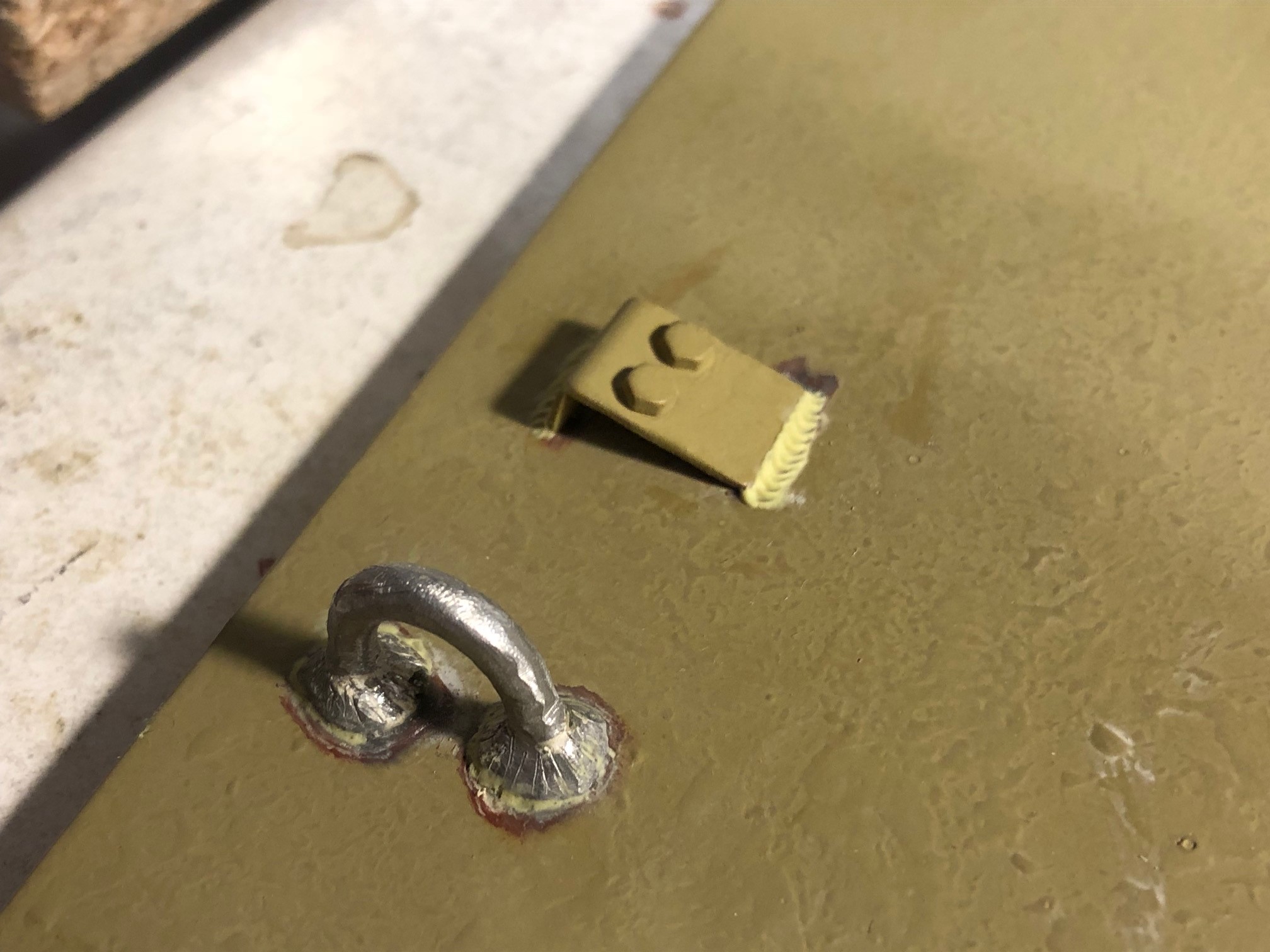

yes i use Milliput white/red for the Zimmerit and the weldings.

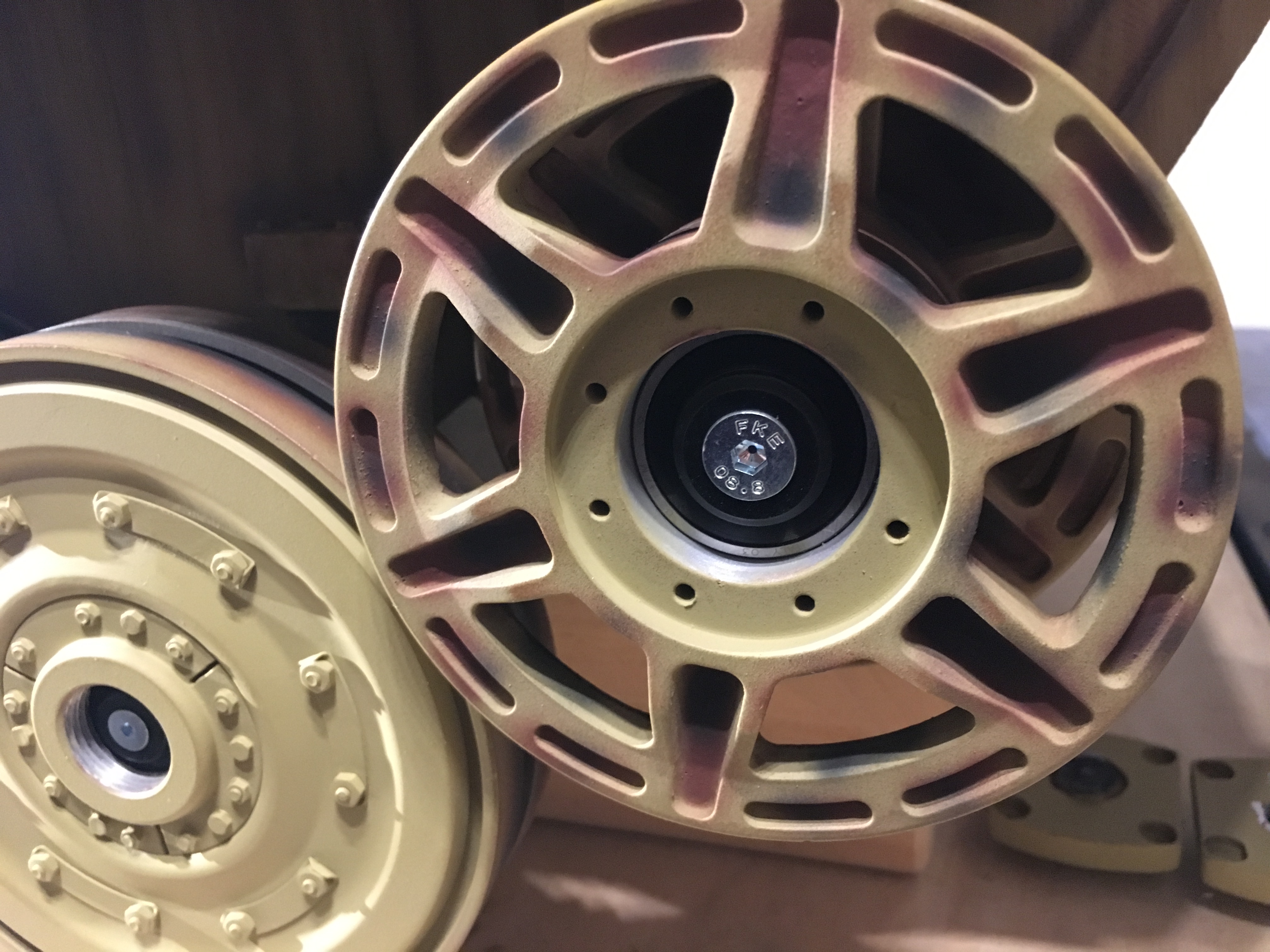

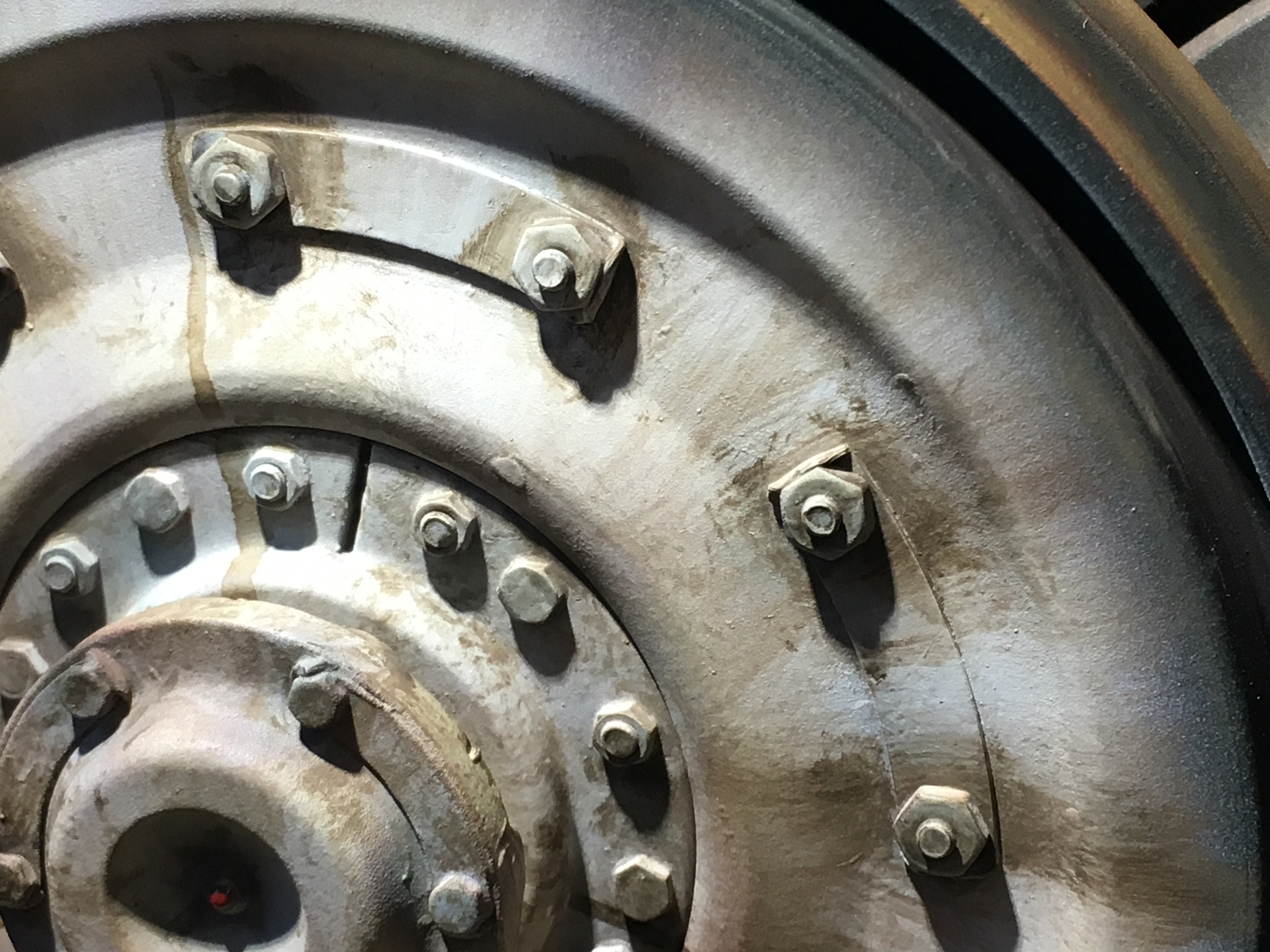

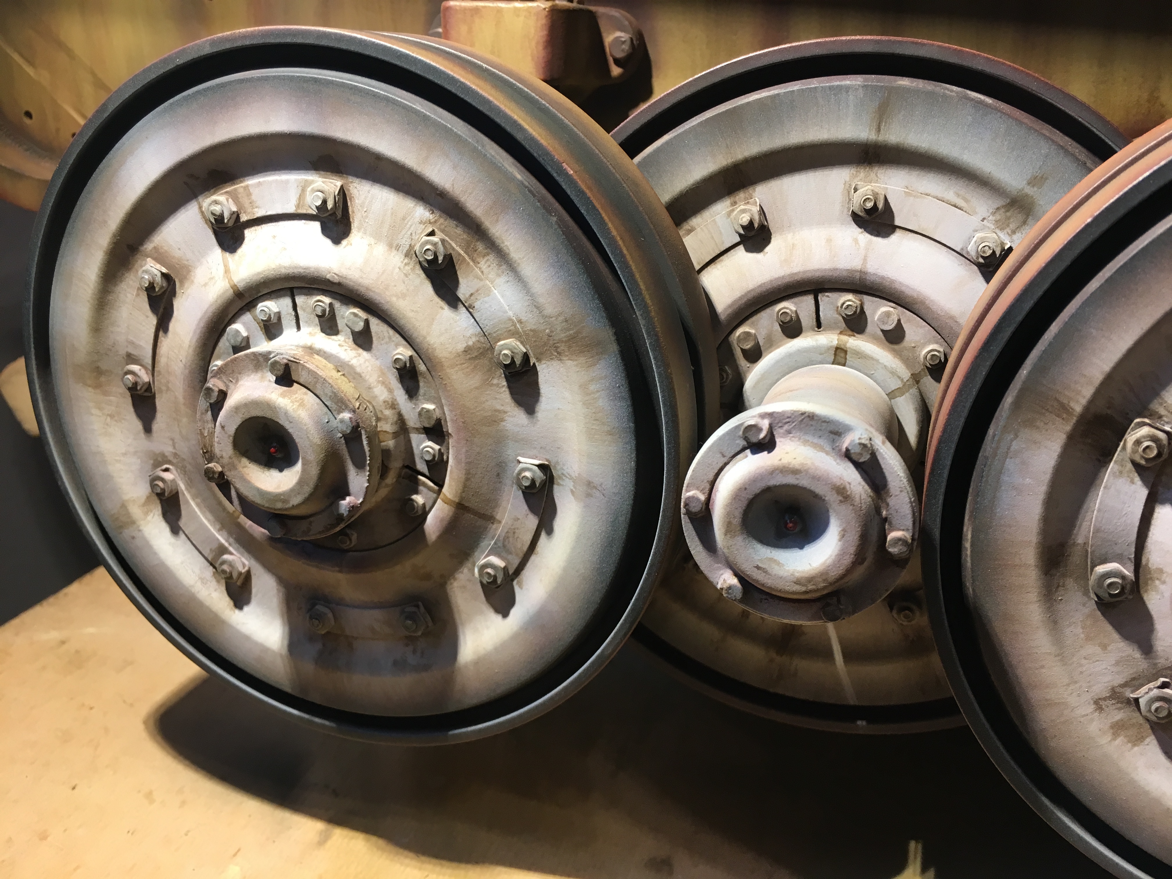

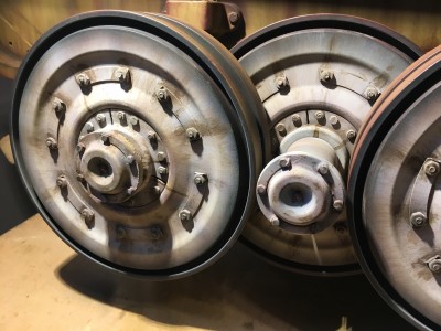

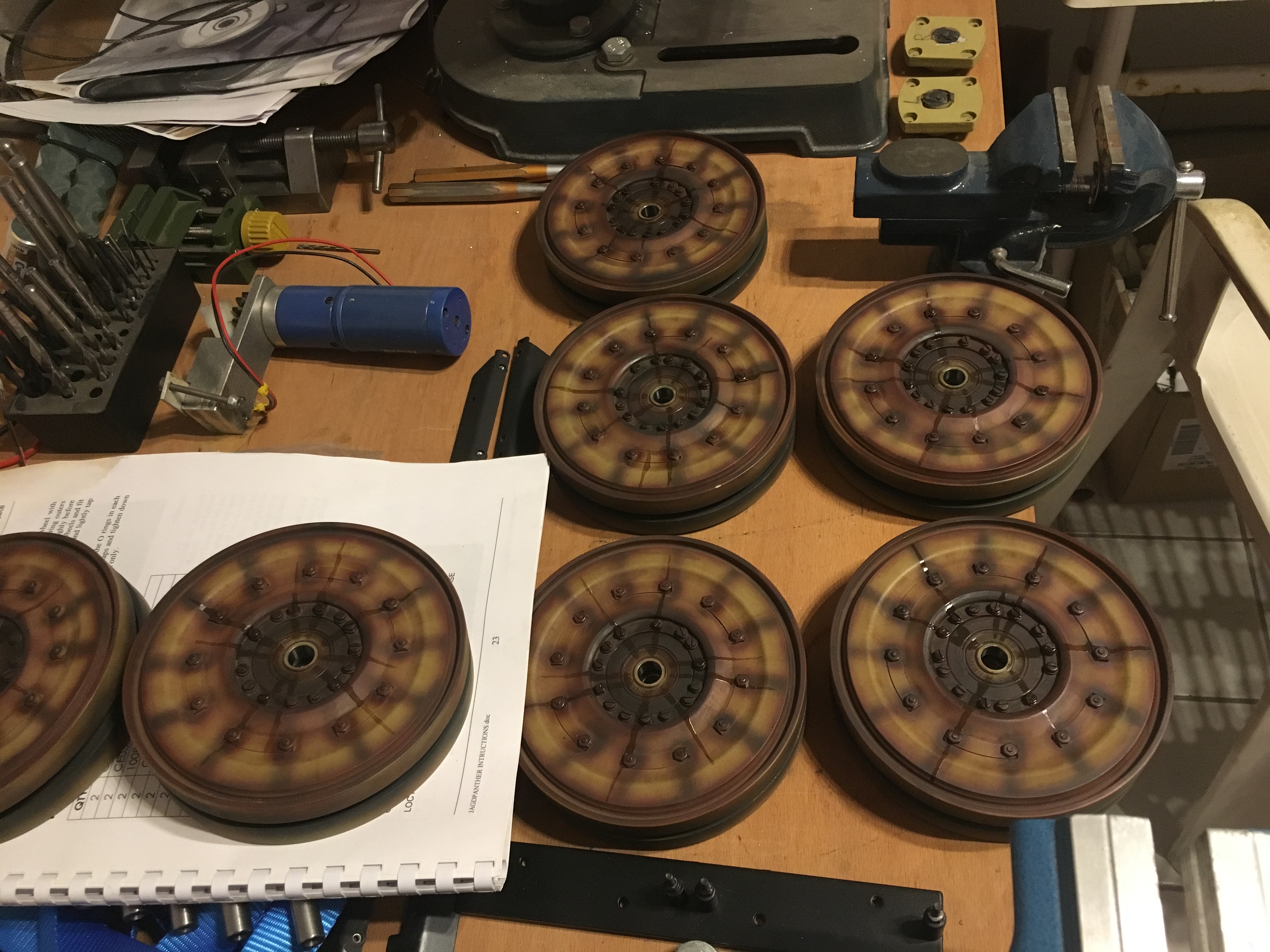

Here comes the road wheels after weathering again after the white painting and then the outer wheels are ready for mount.
Regards Martin

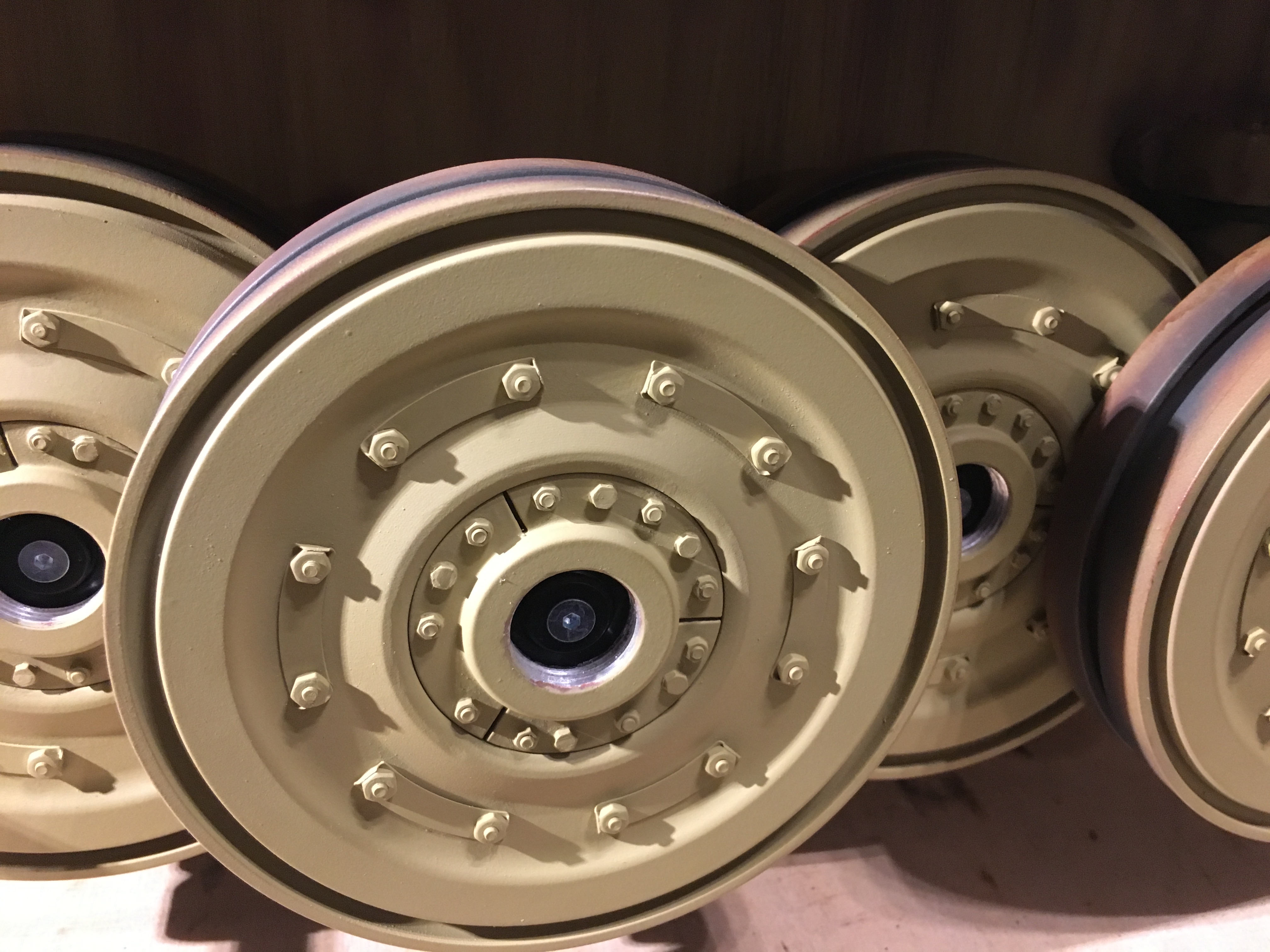

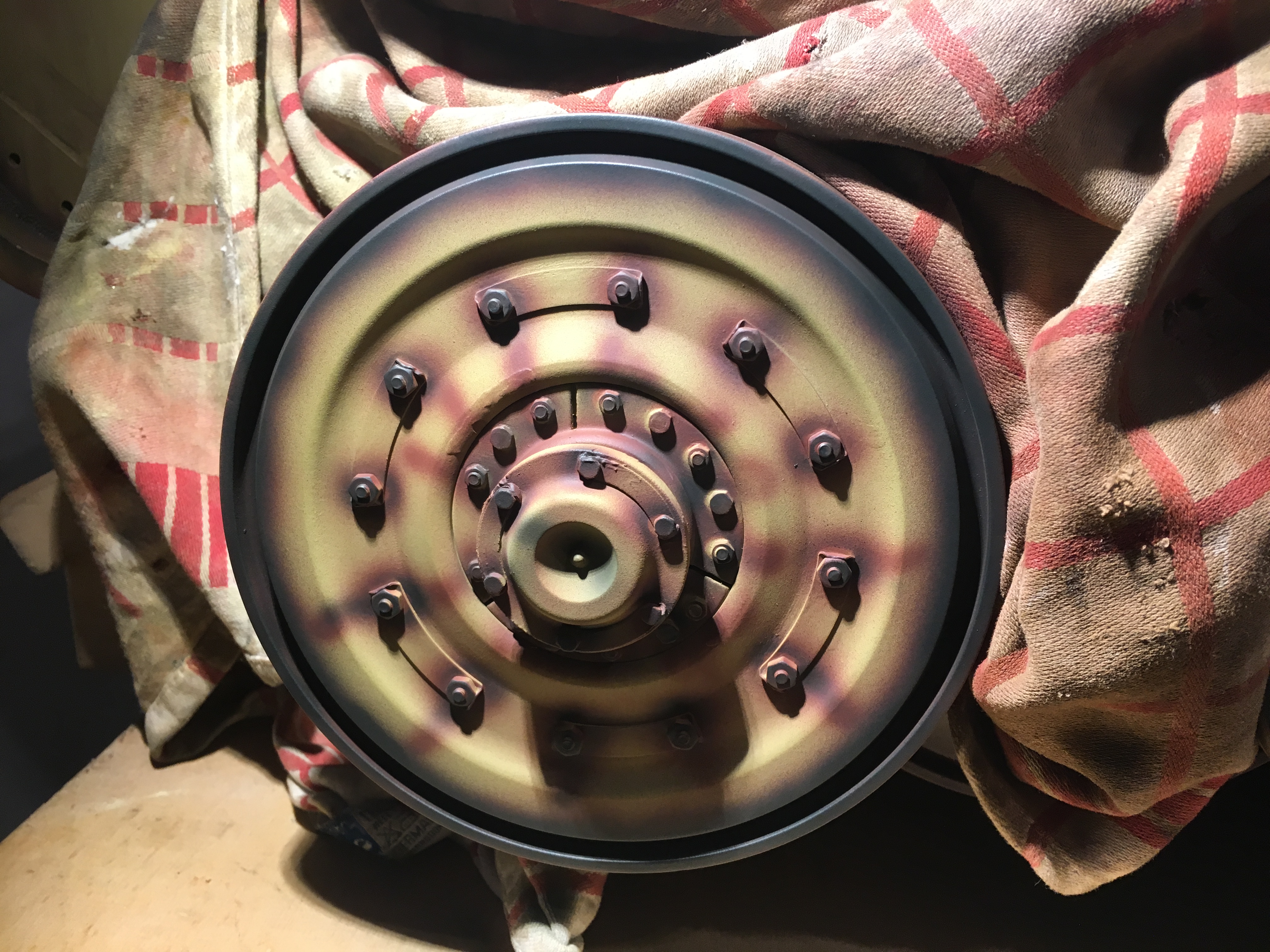

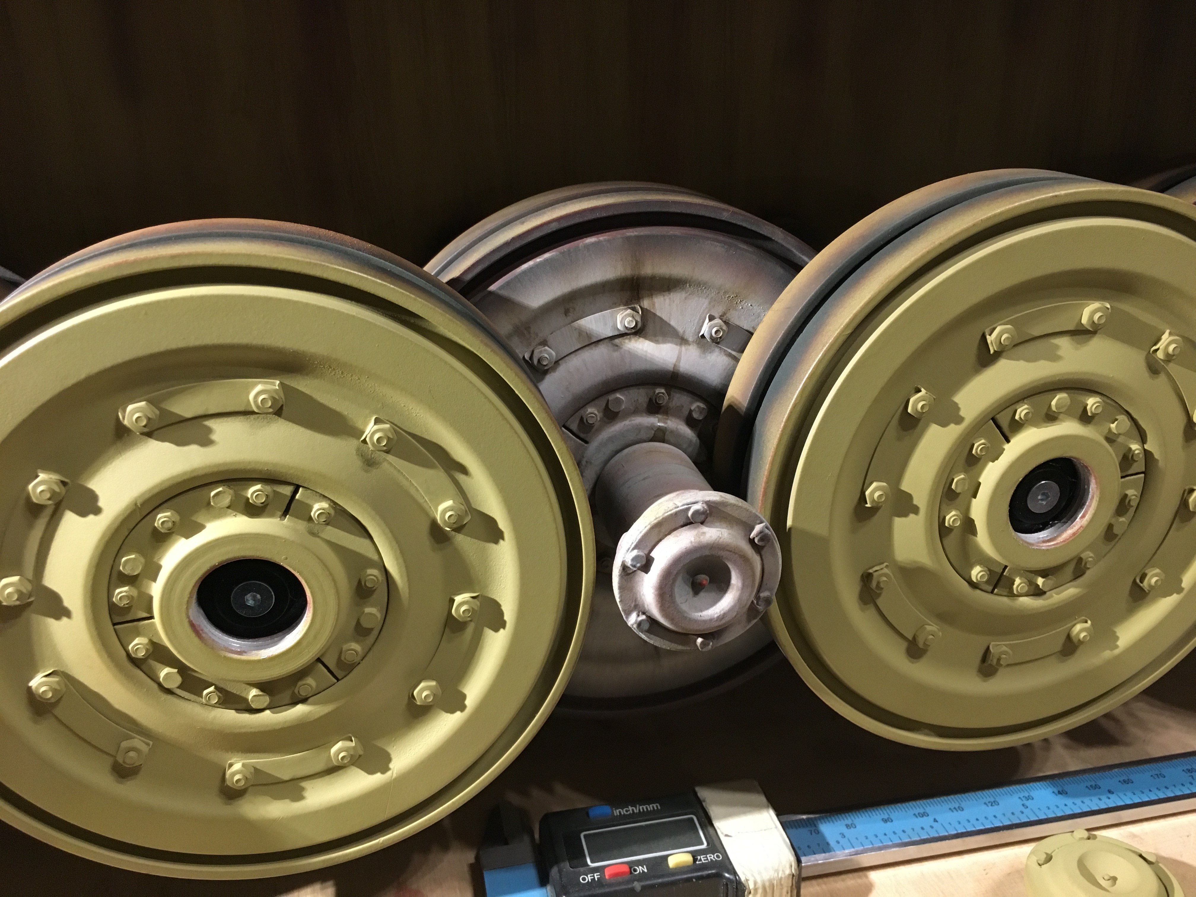

After some time the outer wheels are also painted in brown and black and than in white with weathering.
Regards Martin

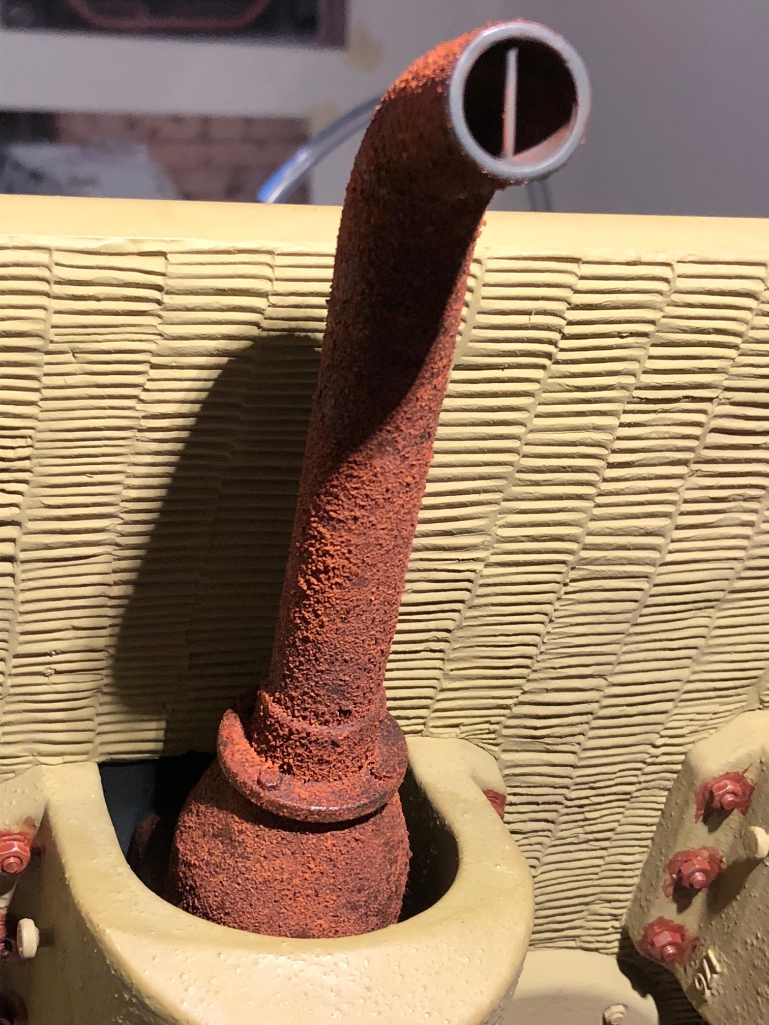

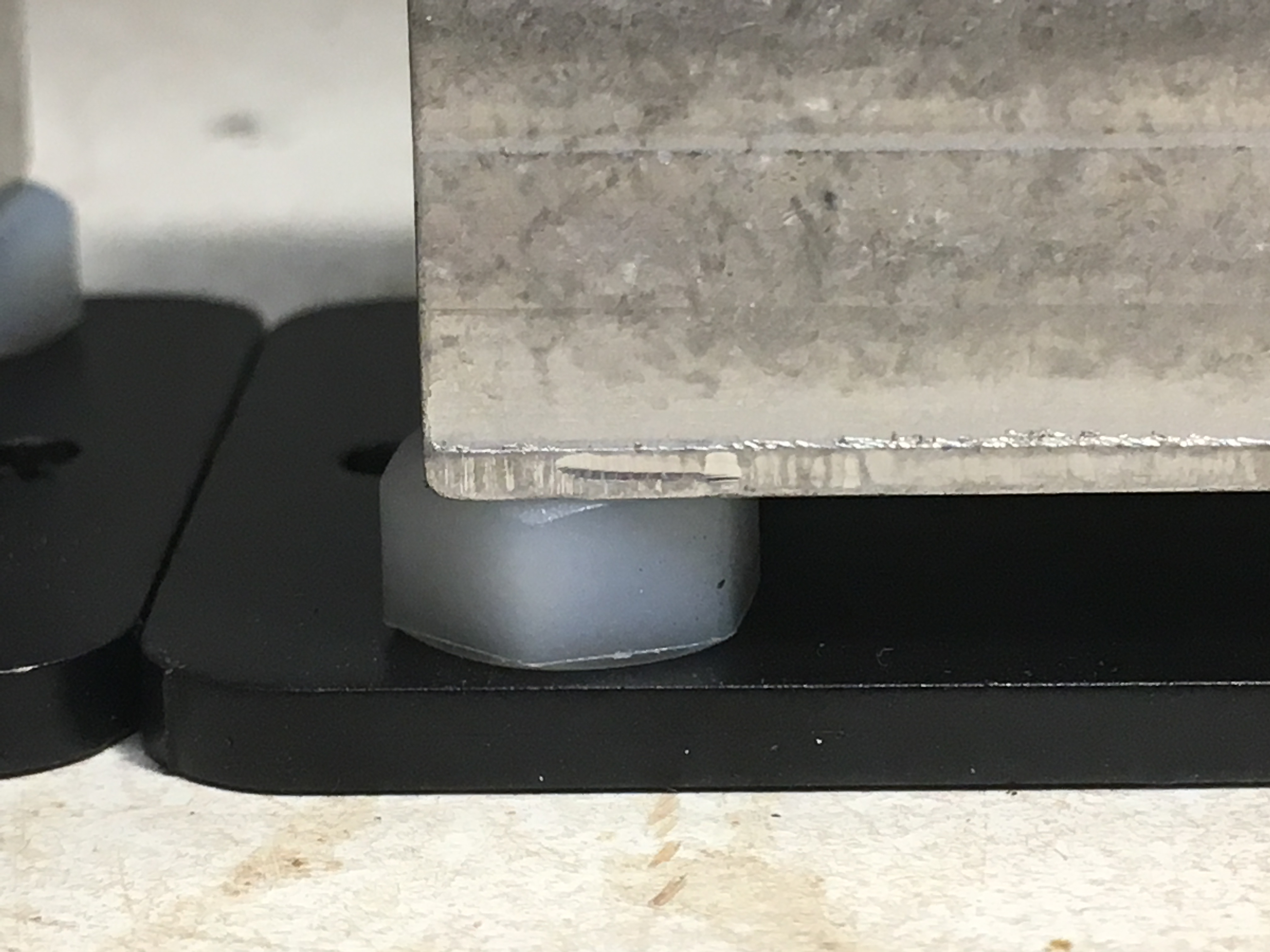

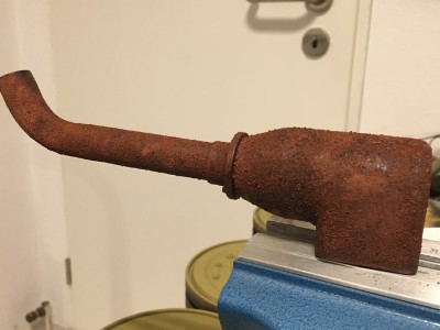

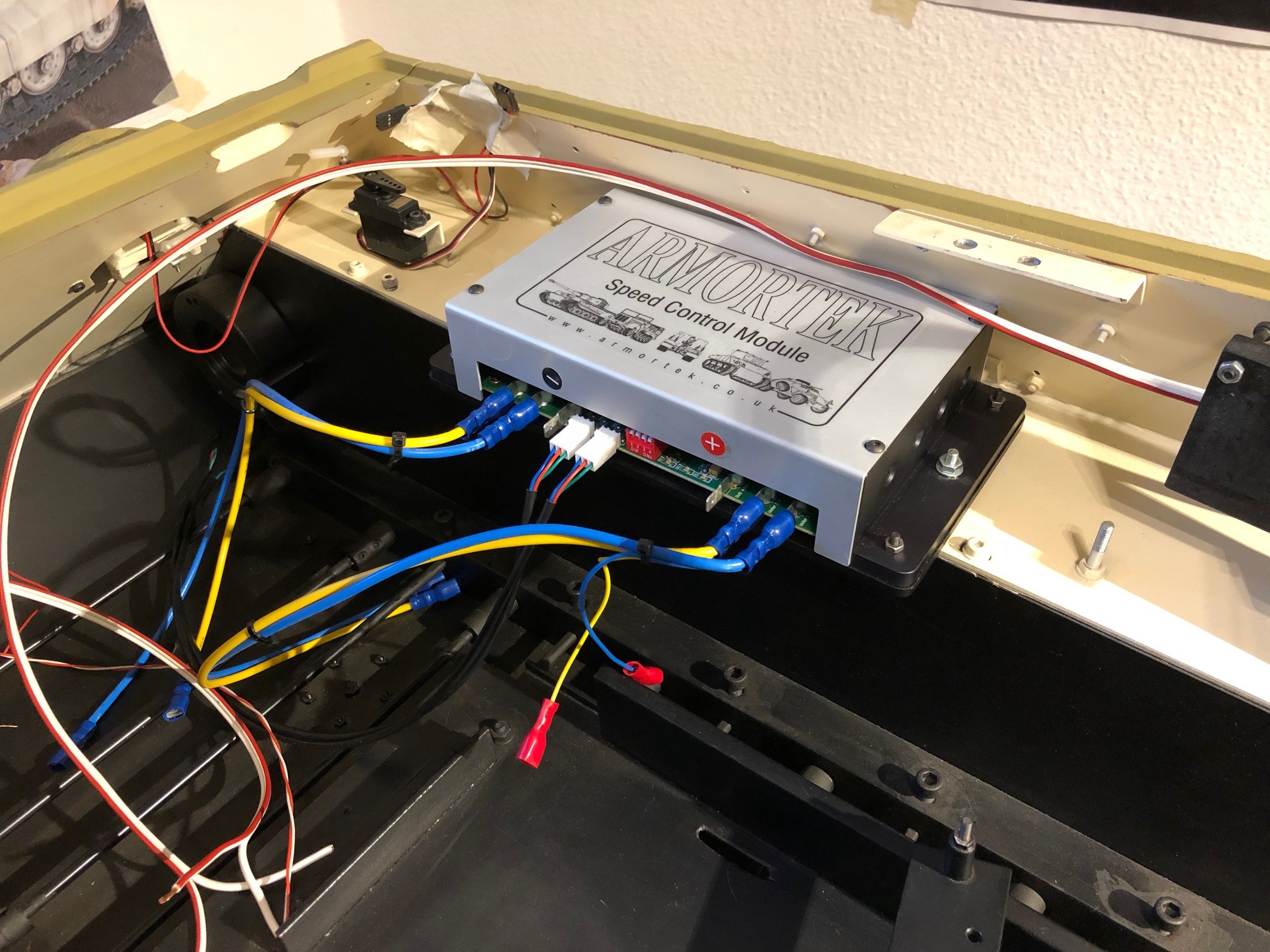

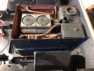

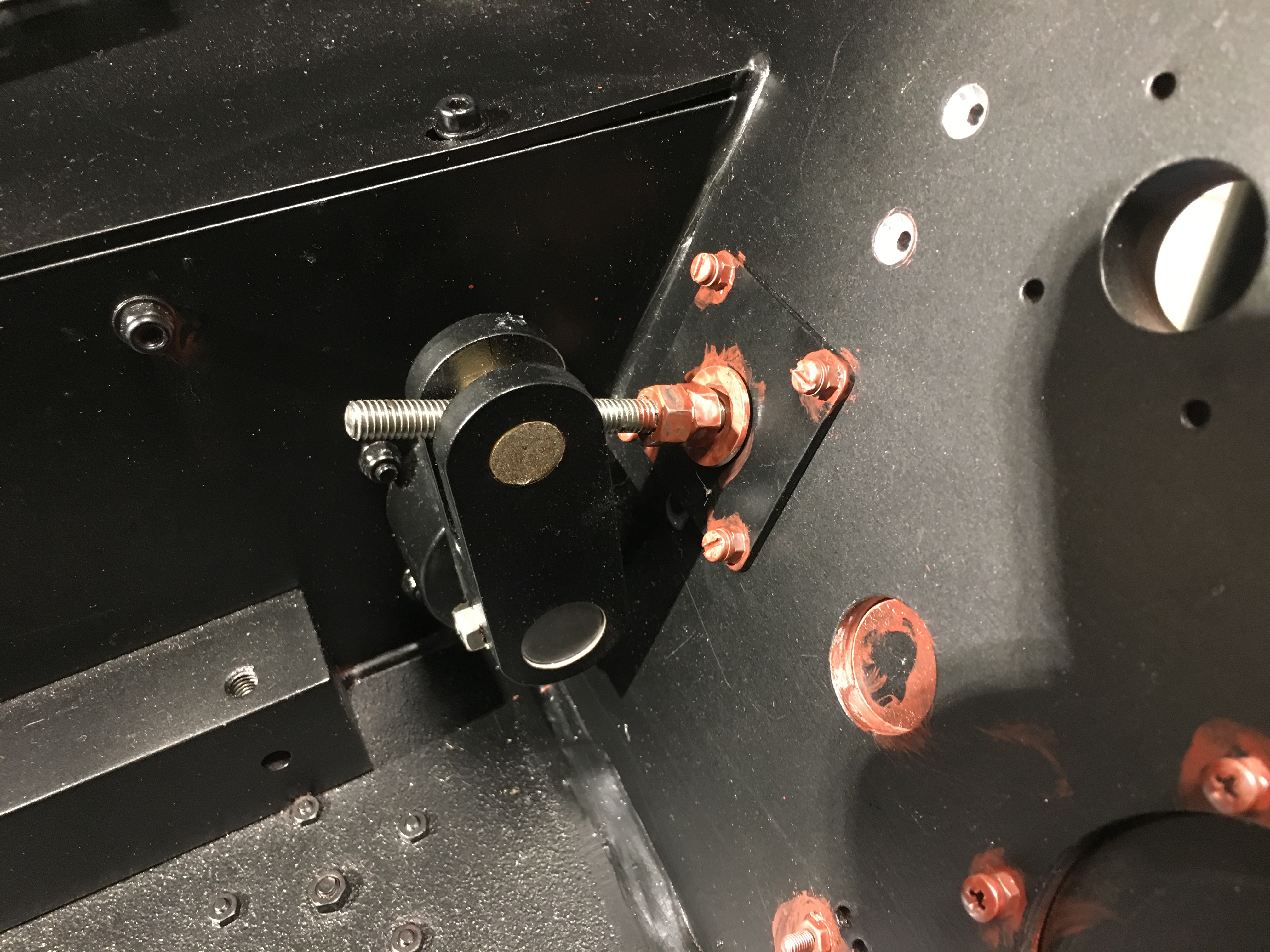

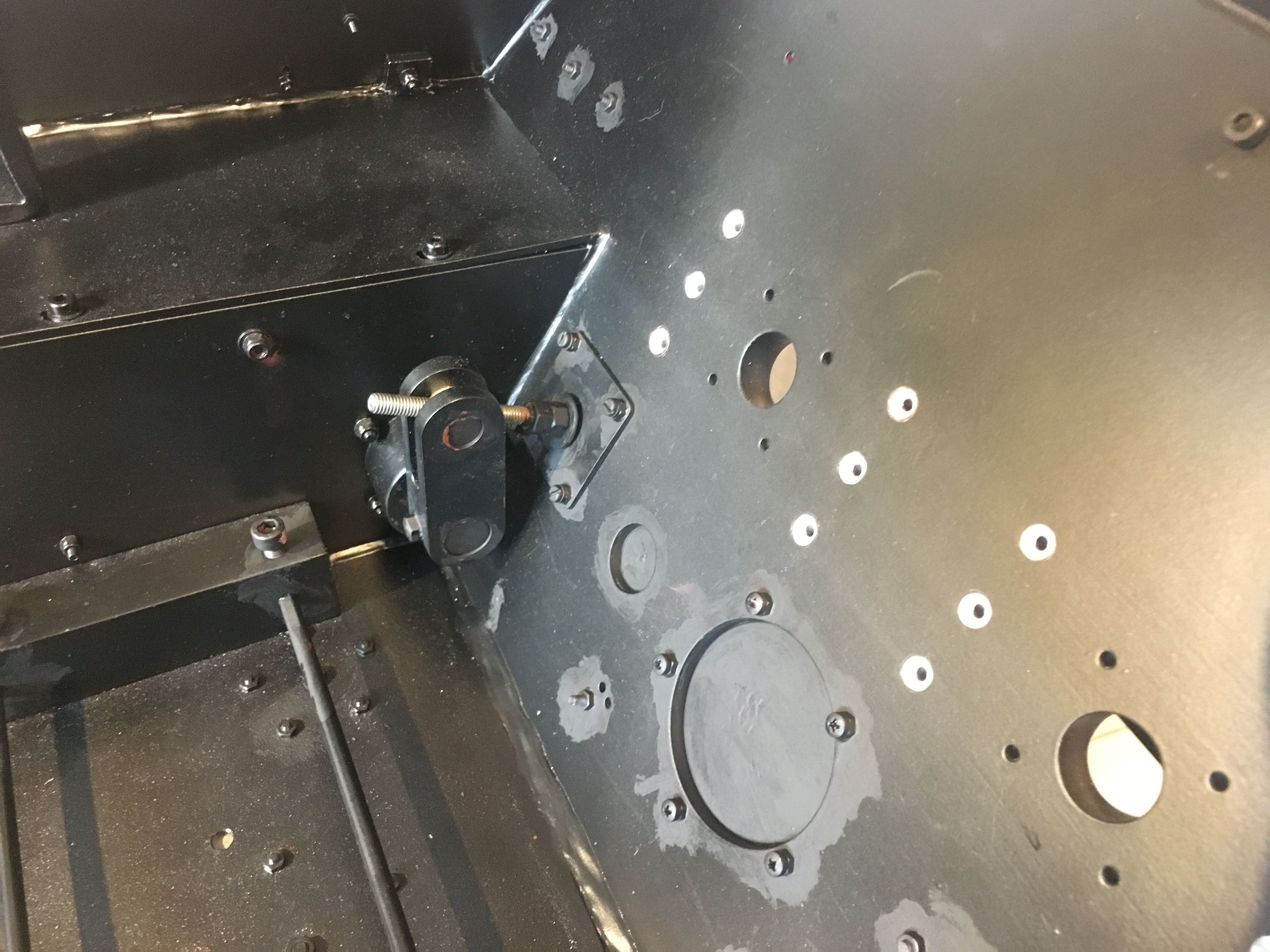

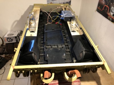

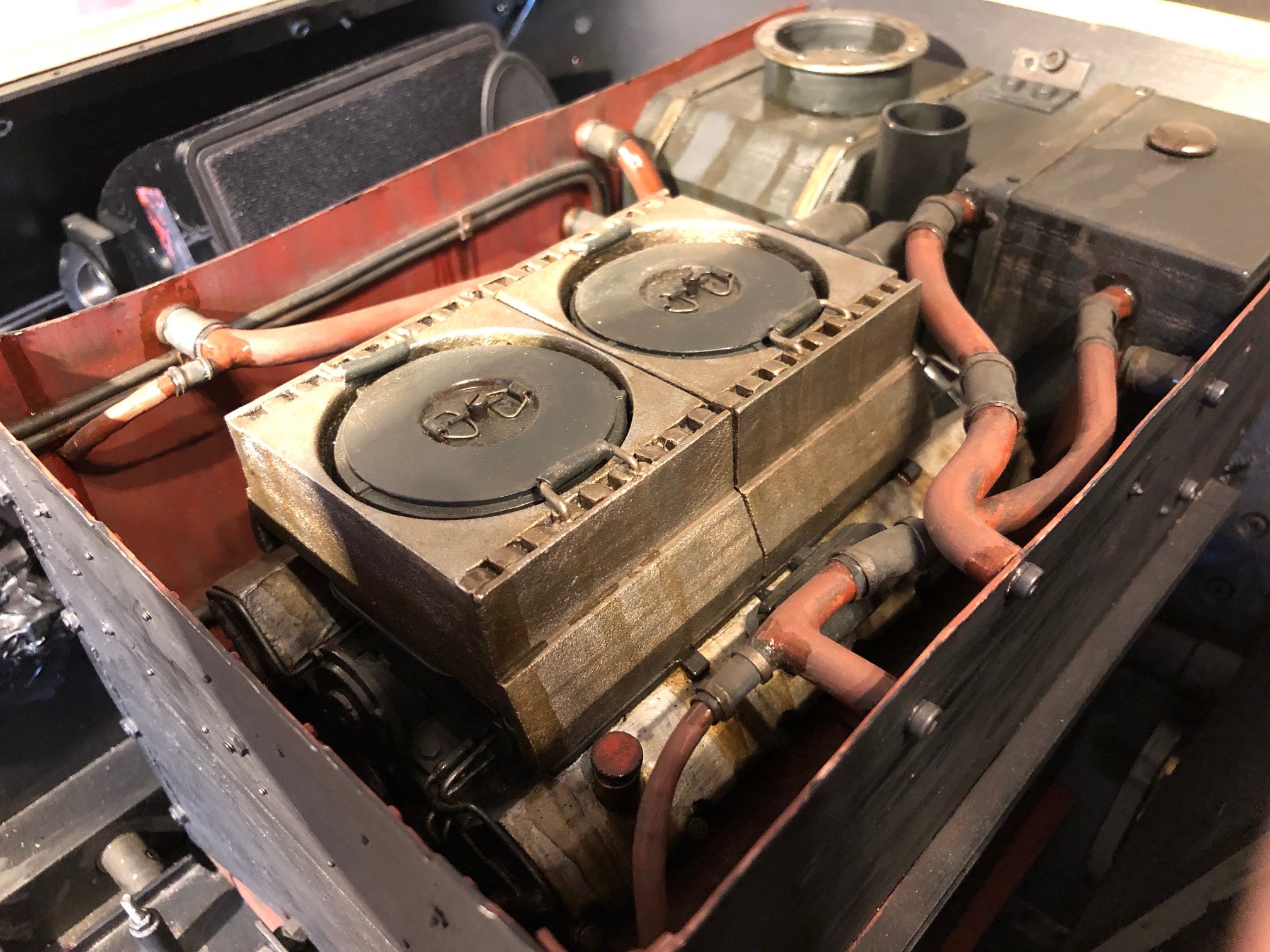

Here comes the next photos from the exhaust, the smokers which are thermic isolated from the ground plate and the hull with the first electric components.
Regards Martin

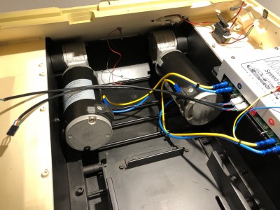

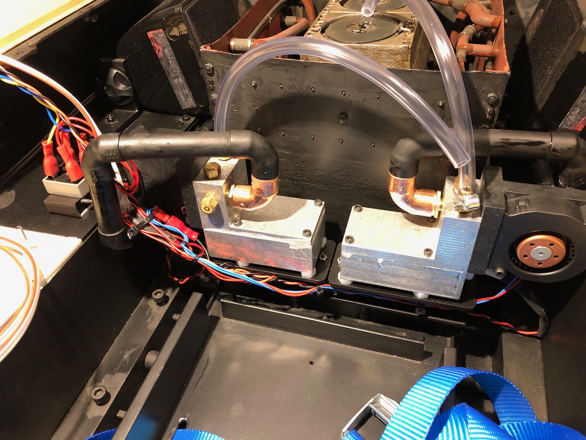

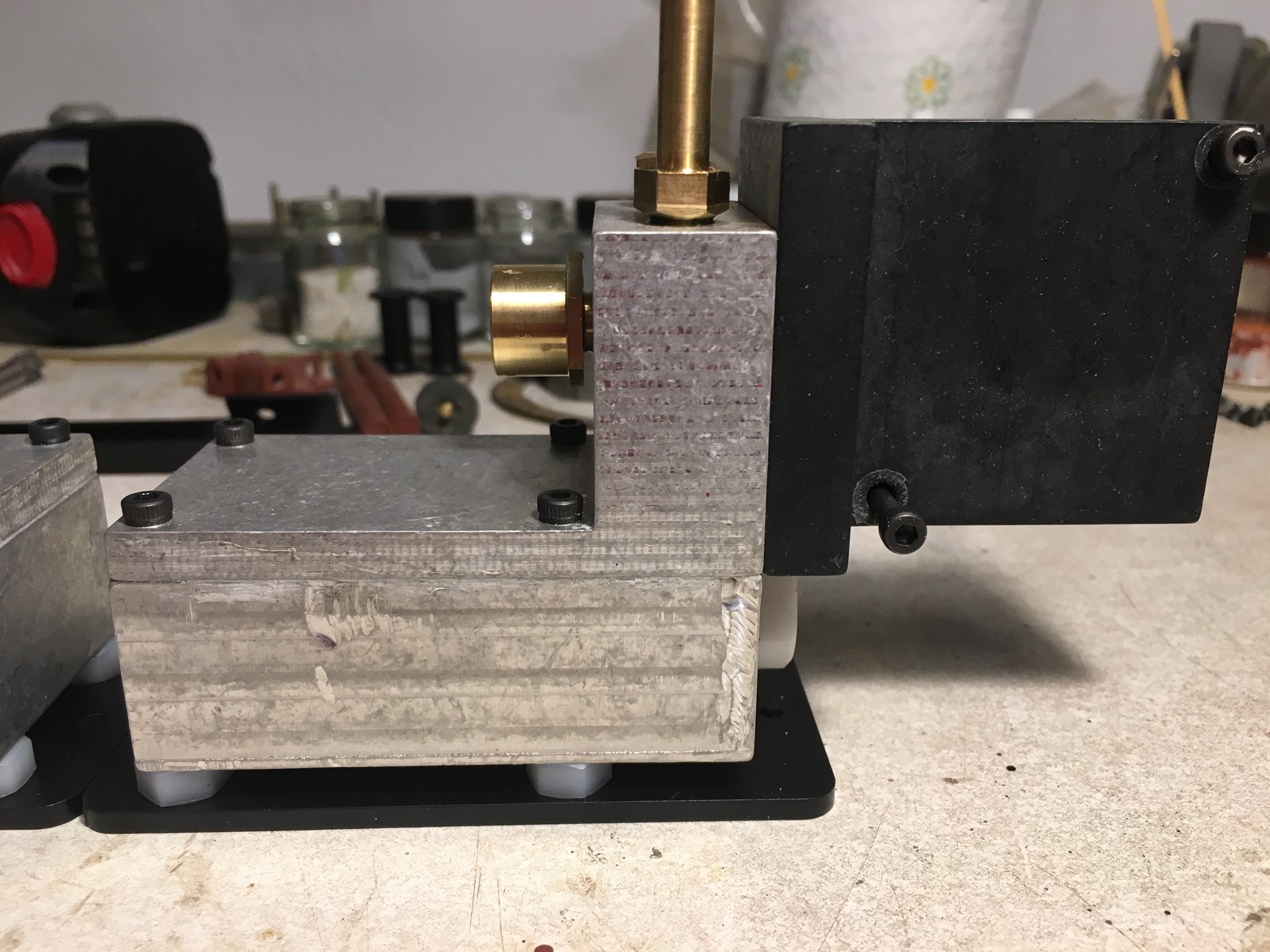

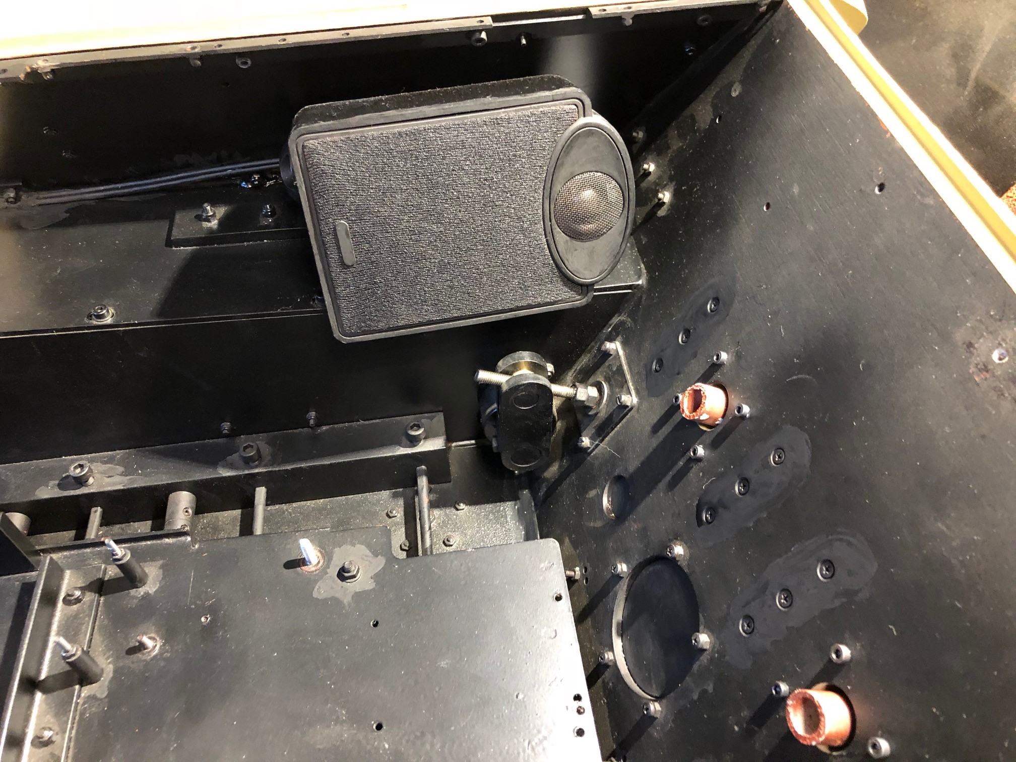

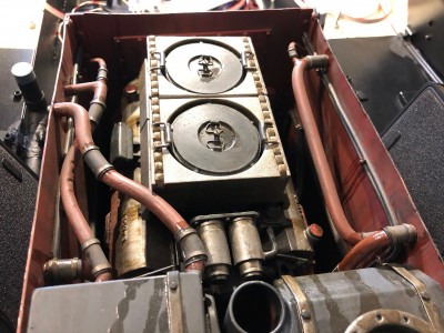

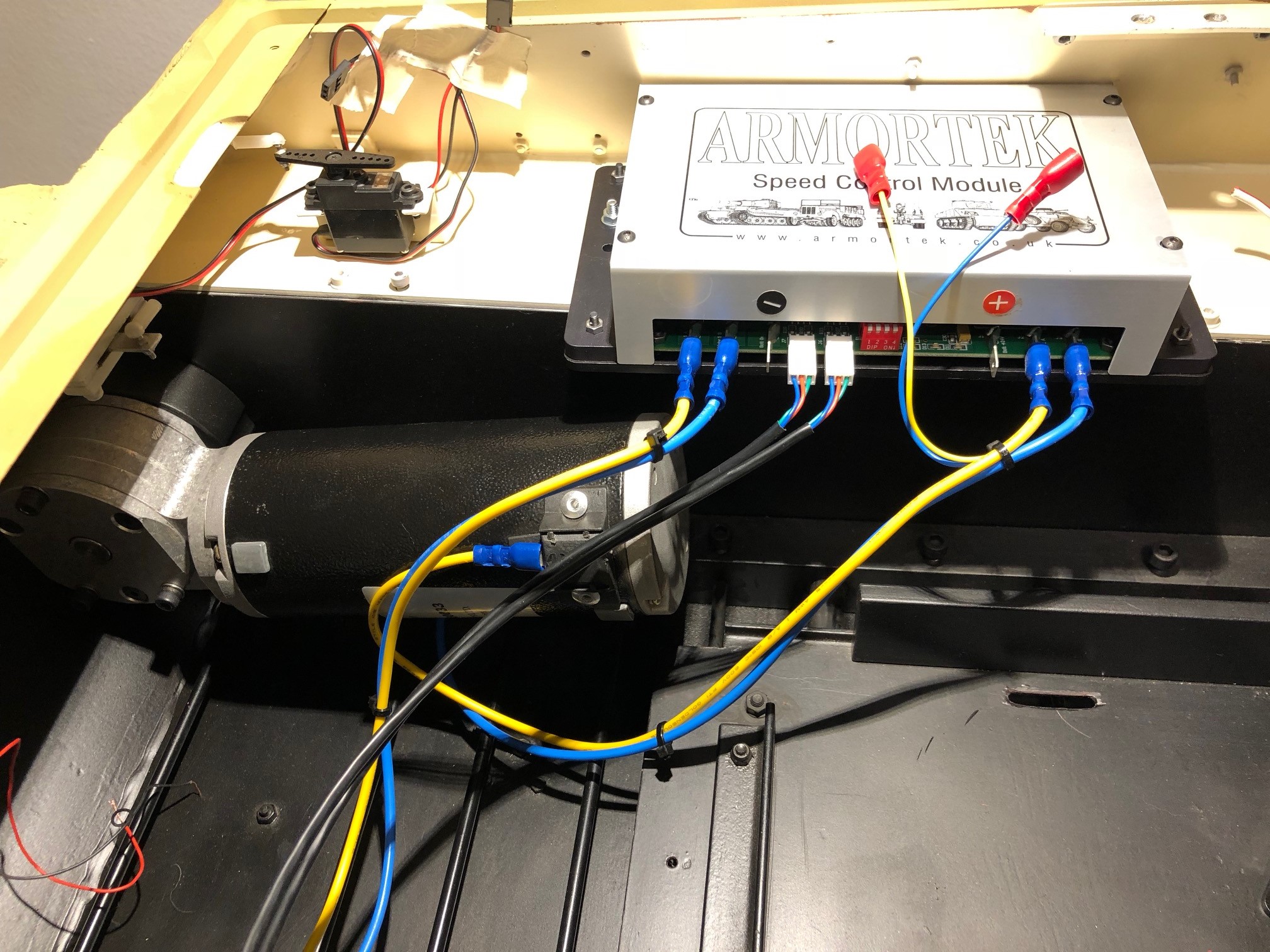

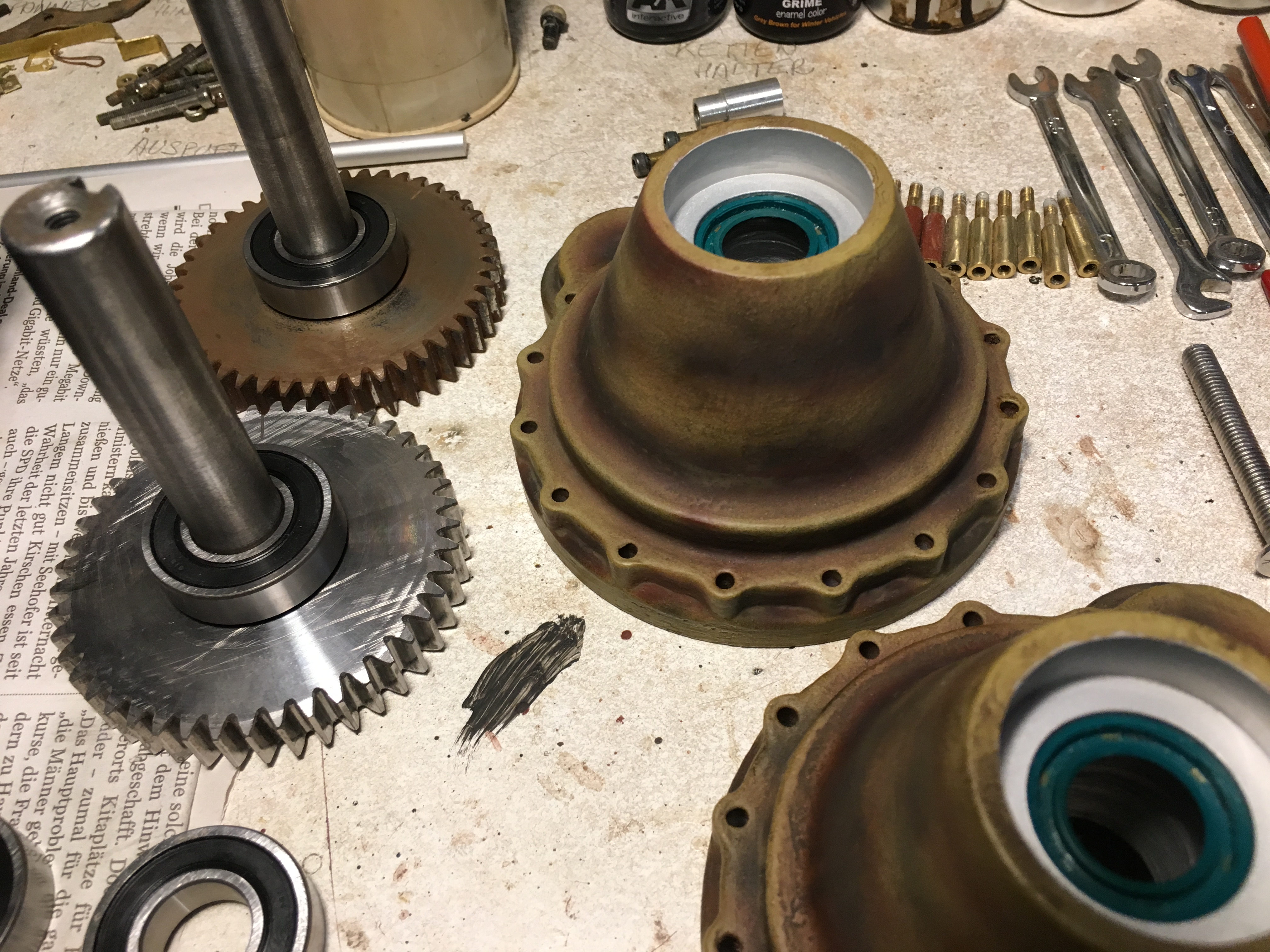

After the pipes for the smokers i mount the fake motor with his tanks and water pipes. Also the final drive is already mount - so i can position the e-motors.
Regards Martin
