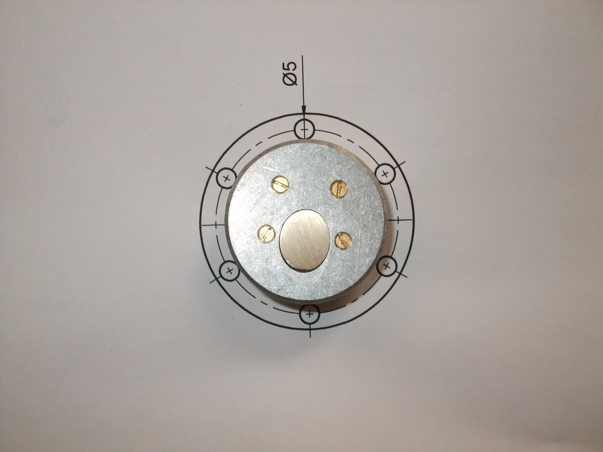

In photos it seems that this item is fixed to the turret roof with six flat headed bolts. So drew up the bolt circle so that at a later stage I will simulate the flat headed bolts in the turret roof.

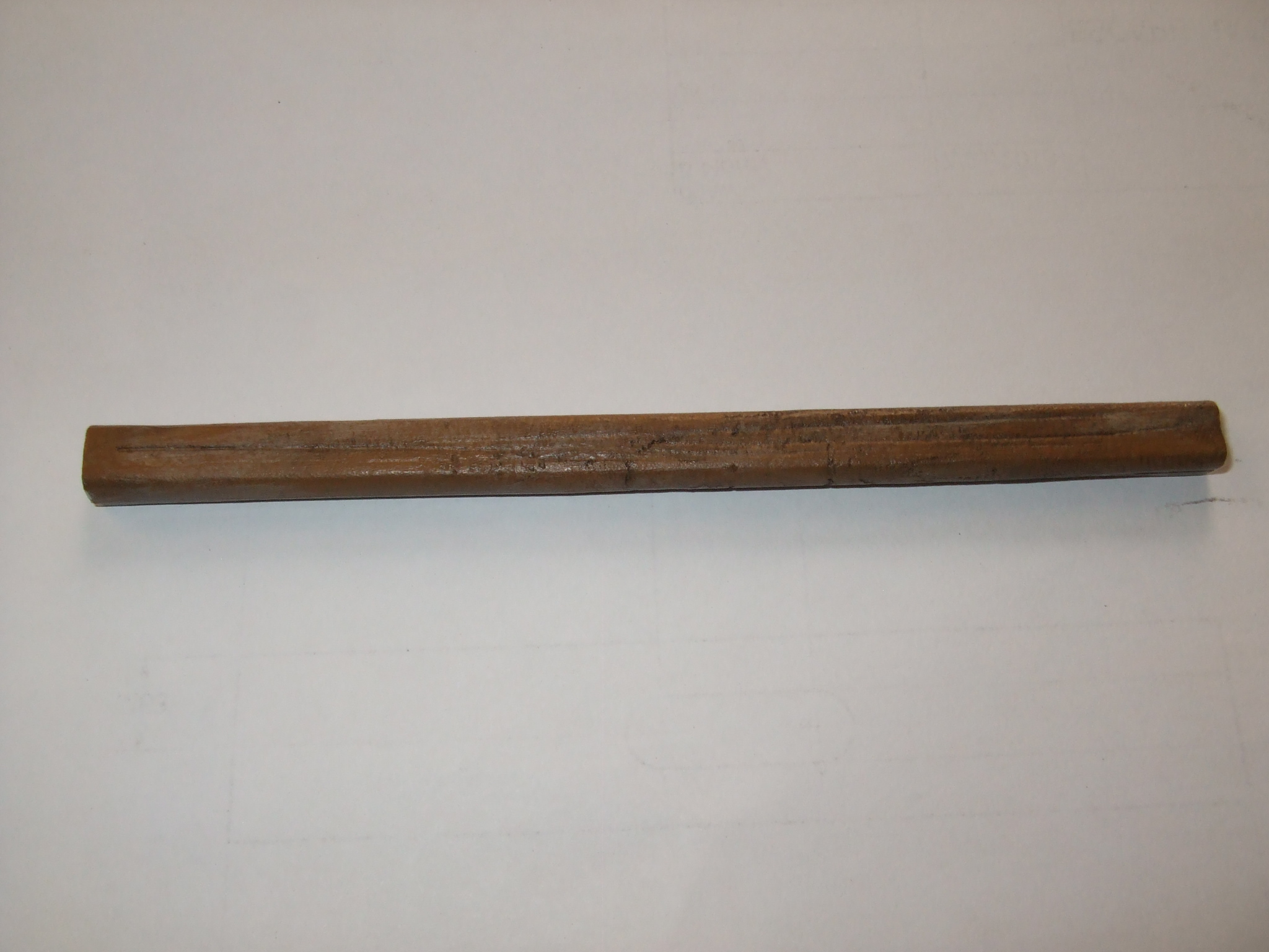

I also have been playing around with a spare white metal tool handle that I have. I am trying to paint it to simulate wood.
This is the result. What do you think? I think next time I will make it a lighter colour.
Looks good Vince, in service it could be that dark, maybe mix and match to add interest. Keep experimenting, remember it's all in reverse as the colours underneath are what give it depth.

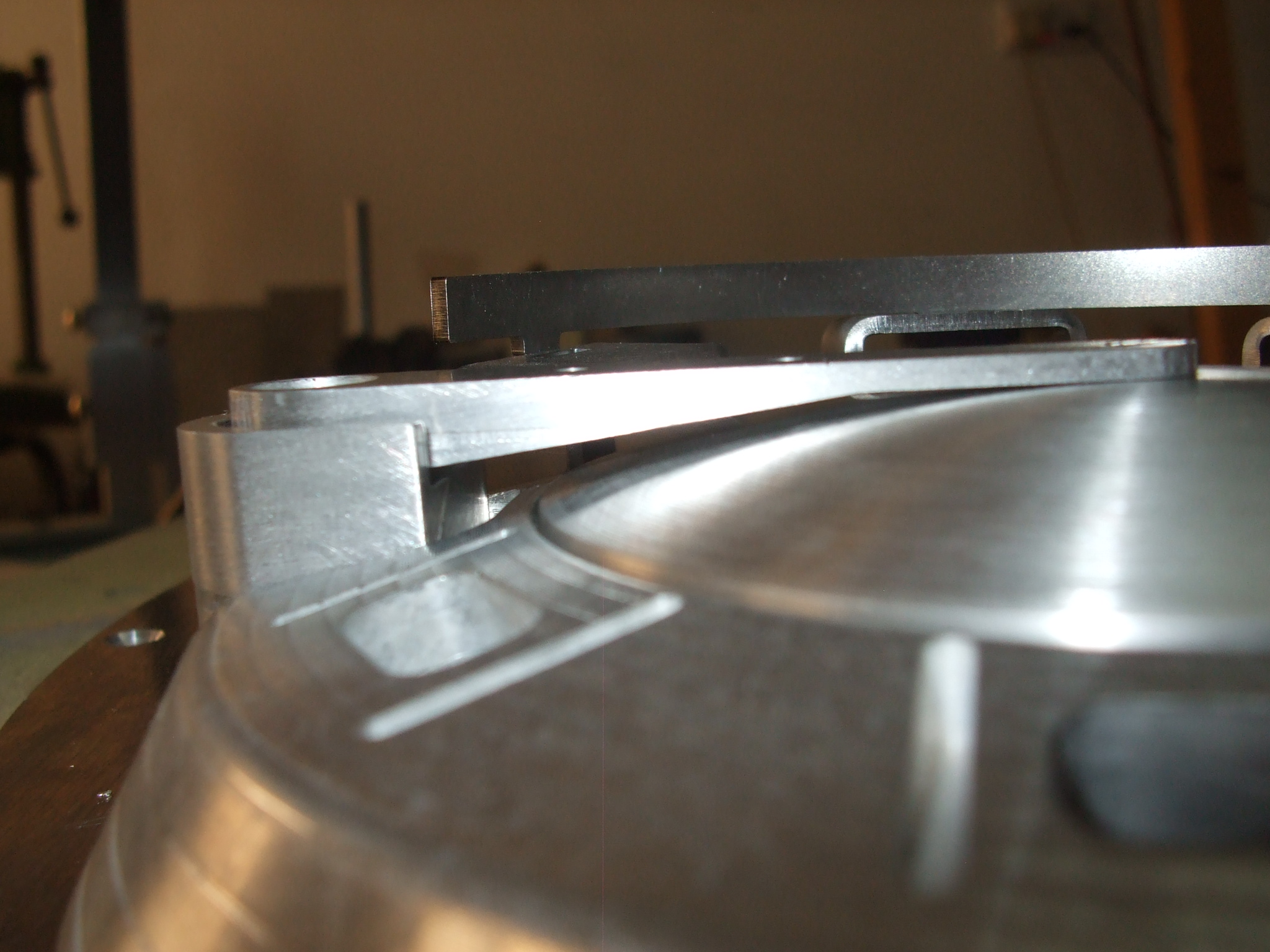

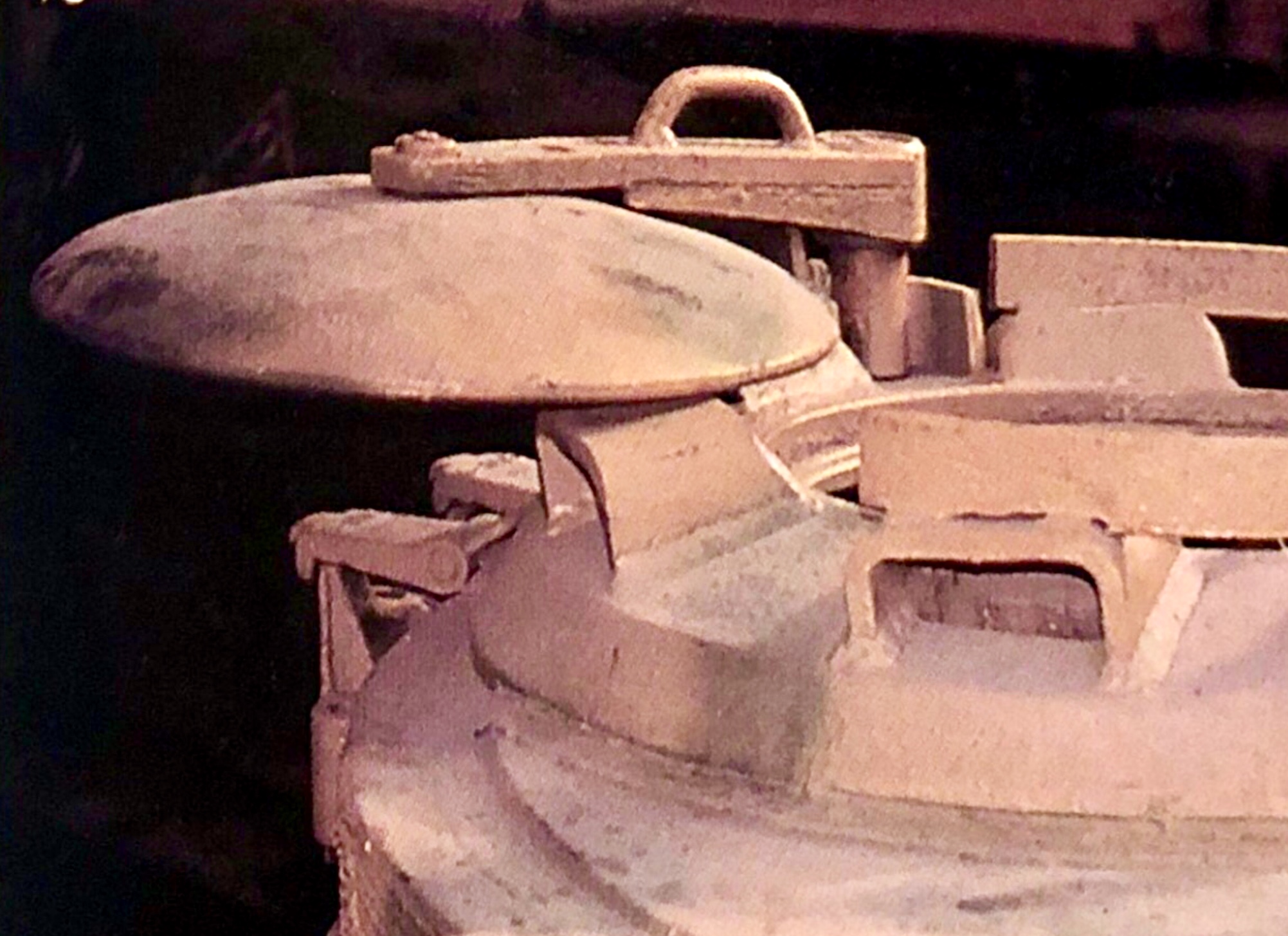

Is the space (in the above photo) between the hatch and hatch arm normal?
Are there any close-up photos of the late Tiger 1 cupola?
Yep, never looks right to me either Vince , some modellers try to fill it in but that's how it was.
- Has liked: 792 times
Thanks Phil. I was a bit worried about it as I could not find a photo at the correct angle to show that space between the hatch cover and the arm.

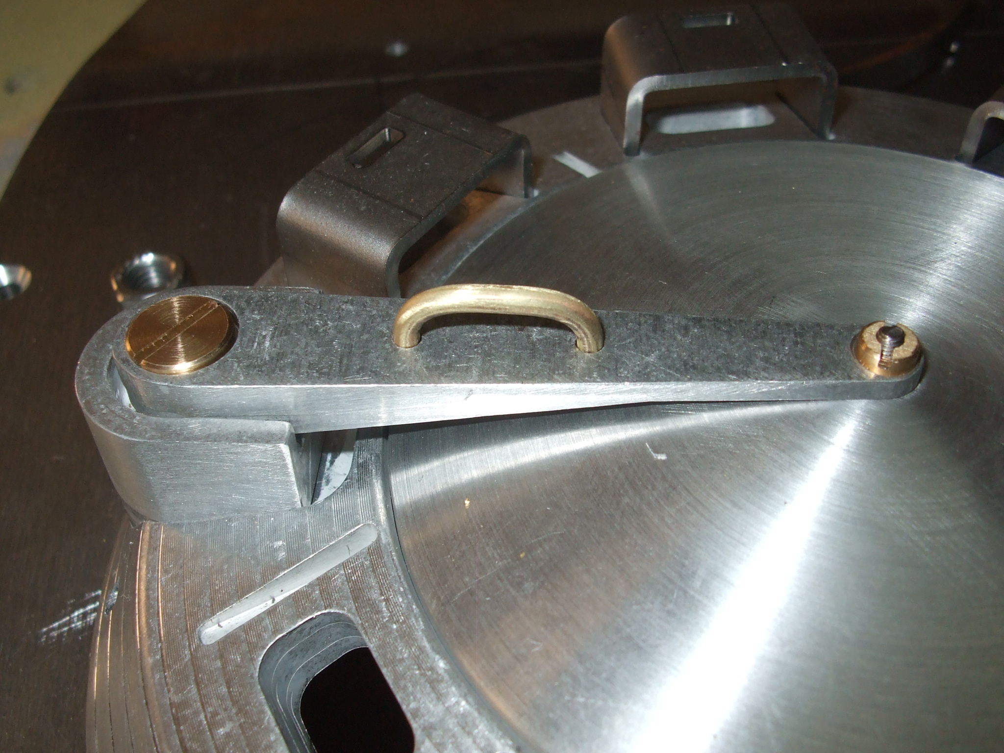

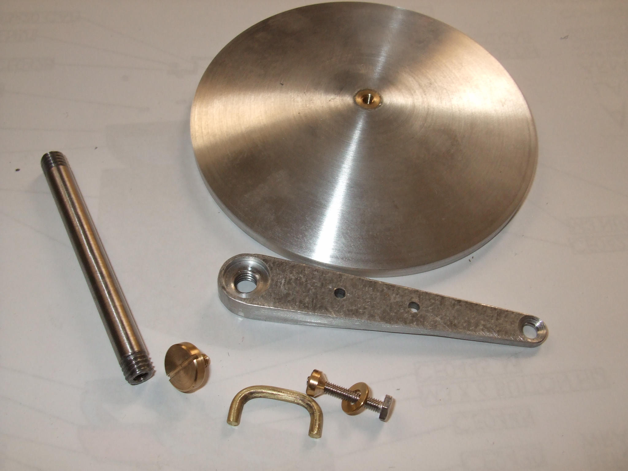

After seeing the photo that Kent posted I have decided to leave the hatch arm as is (at least for now). Did some work on the hatch arm. Could not find a shaft for the hatch arm and it's not shown on the diagram. So used a 6mm stainless steel rod and threaded it M6 so that it can be screwed in the big-end of the arm. Also made a brass slotted screw that goes in the big-end. For the small-end of the arm made up a slotted M2.5 round nut. Also made a brass U handle for the arm.
I am looking at cupola photos so often that I am getting cross-eyed.
One thing I noted is that the U handle on the hatch arm is located in the wrong place. It needs to be moved closer to the big-end of the arm.

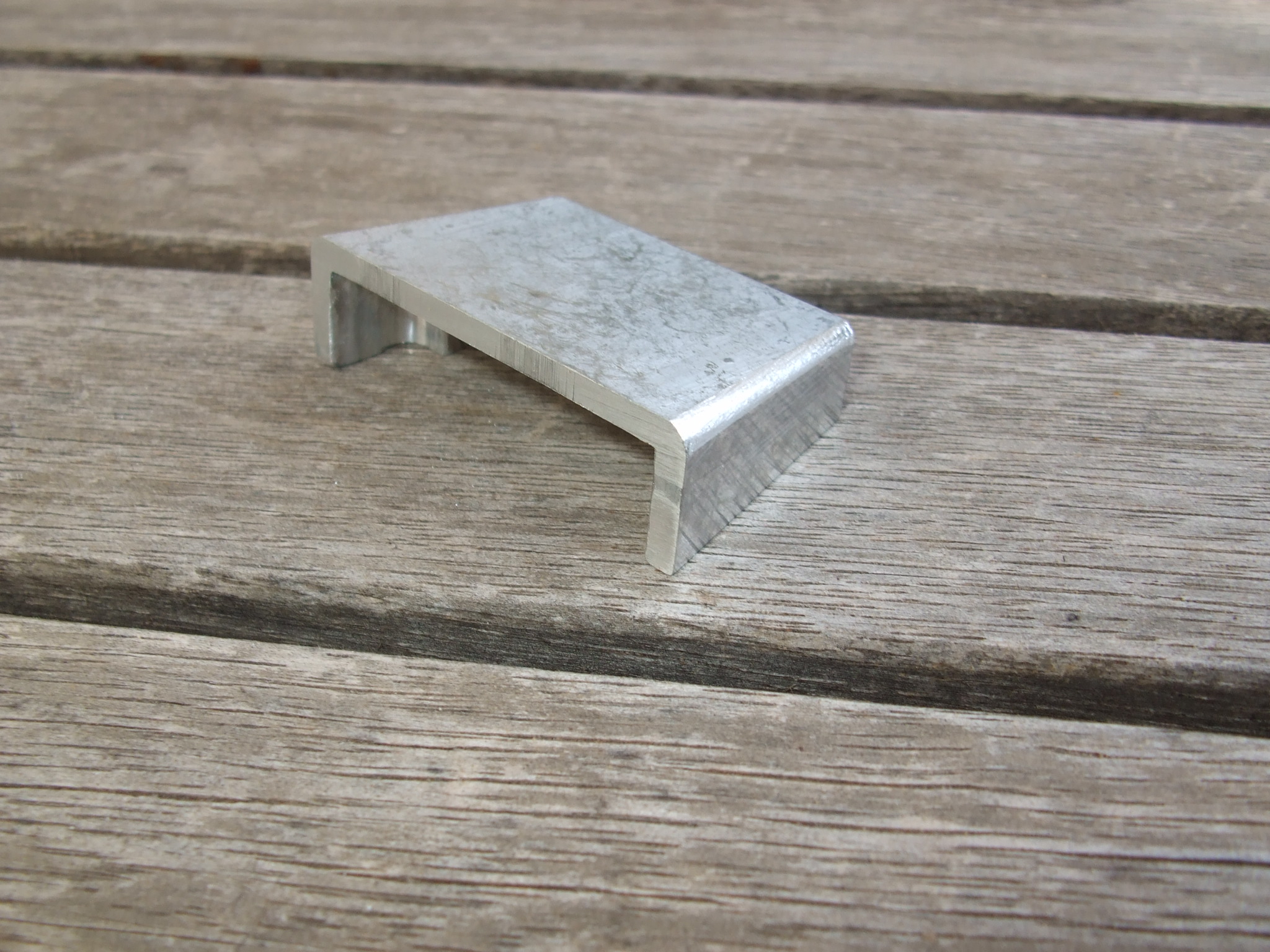

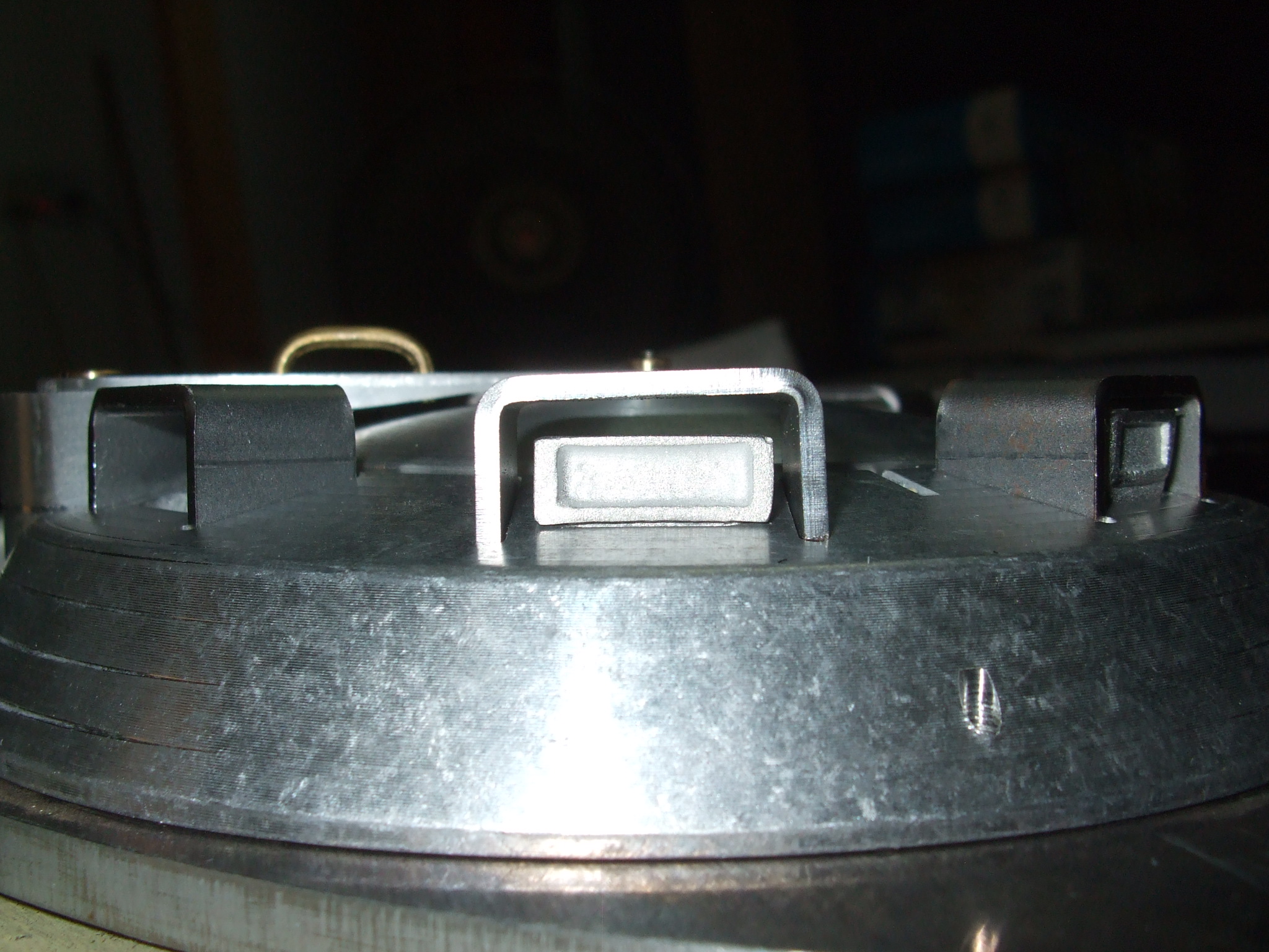

Had a look at the periscope guards and the first thing I did was to skim off the legs of these guards so that they all sit straight and at the same height.
One thing I am also planning to do to these guards is to give the back of the guards that "angled" look and also add a cover at the back of each guard.

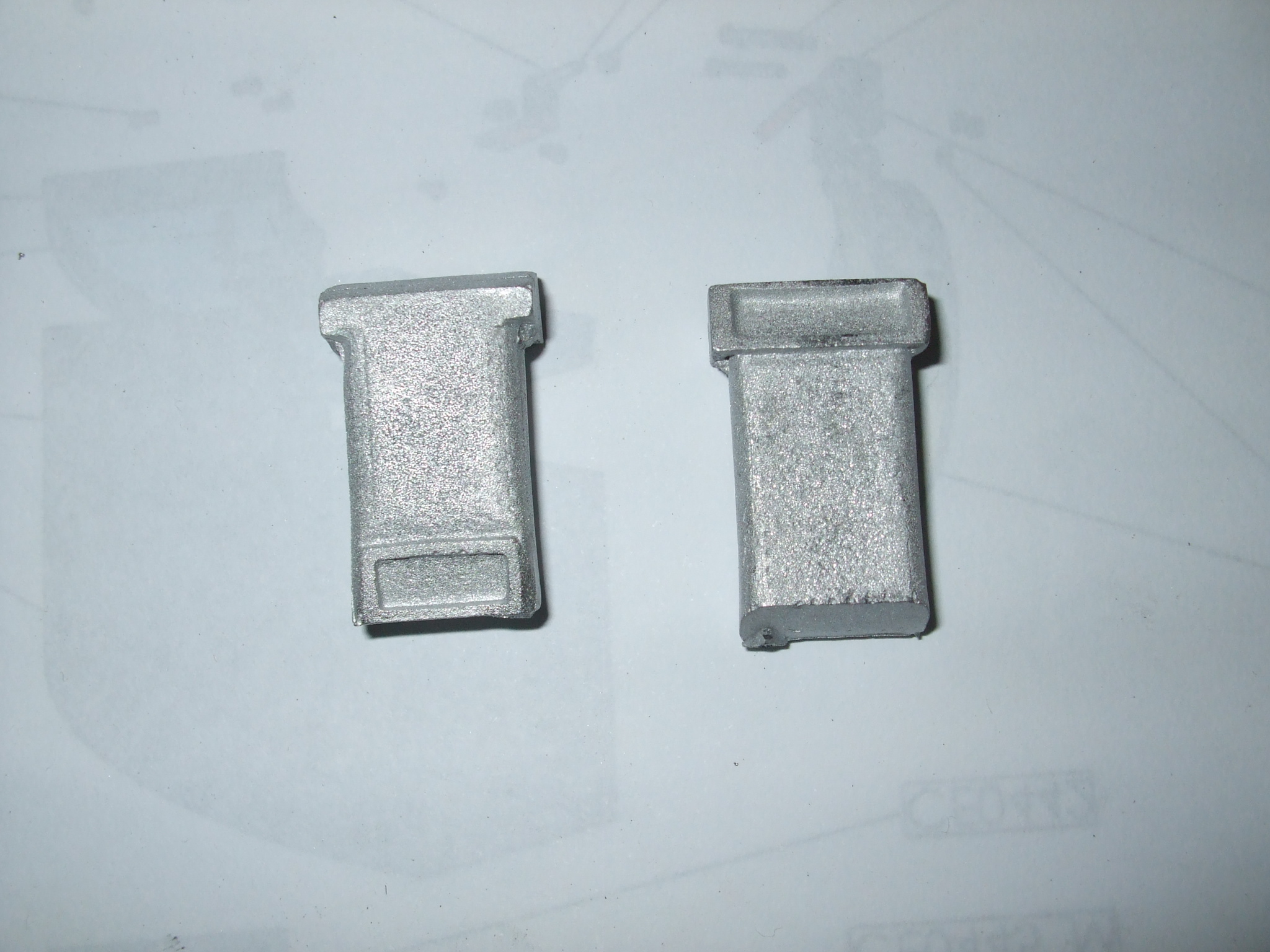

Also had a look at the white metal cupola periscopes.
Wasn't sure if the wide vision side should be at the top or bottom. Went on the Armorpax website and luckily Dave had a photo of these periscopes in a cupola. The wide part should be at the top under the armoured guard.
