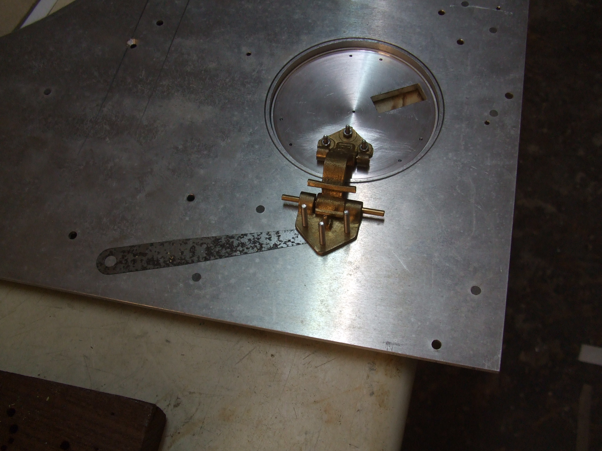

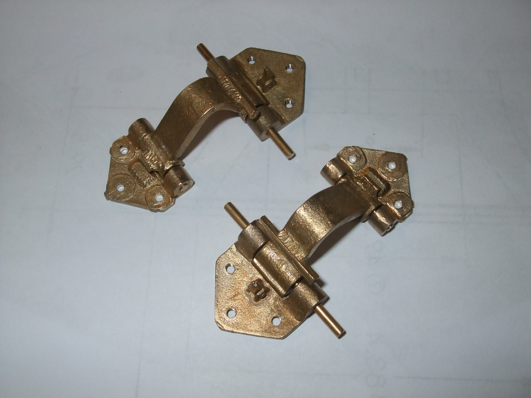

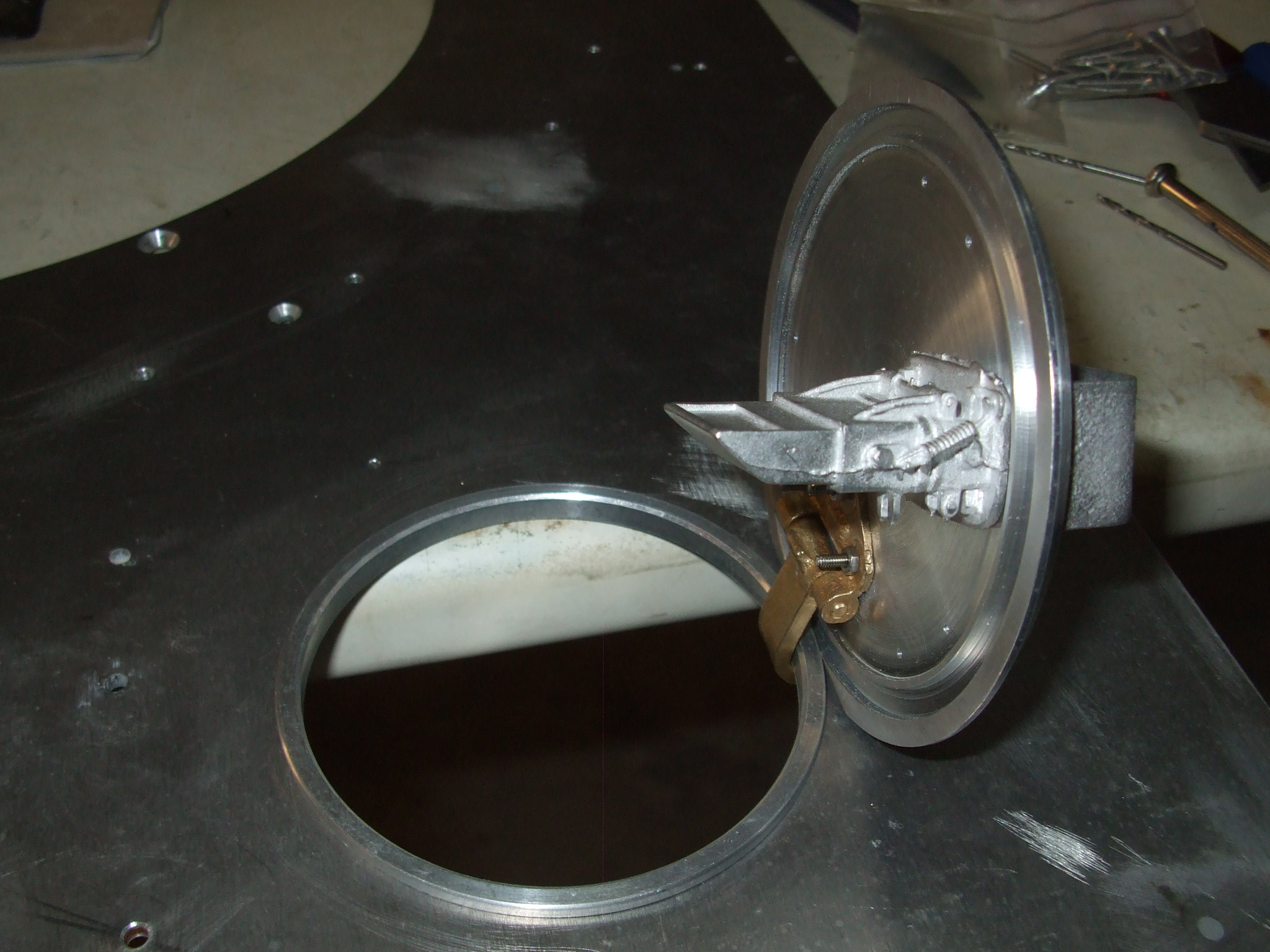

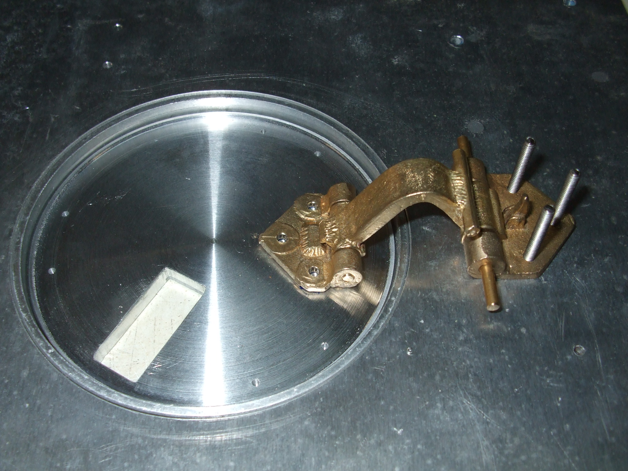

Some more work with the brass hinges. Drilled and tapped M2.5 the hinge plate that is fixed to the underside of the hull roof. I didn't use the cast pilot holes but measured the hole pattern in the hull roof and drilled and tapped accordingly the hinge plate. I found that on one of the hinge plates the pilot holes were spot on but on the other one were slightly offset.
Did roughly the same on the hinge plate that is bolted to the hatch. I drilled M2 through holes in these. The idea being that I will use M2 studs and M2 model nuts (with an AF of 3mm) to fix these hinge plates to the hatches. Also cut the M2.5 hinge pins to size.
- Has liked: 794 times

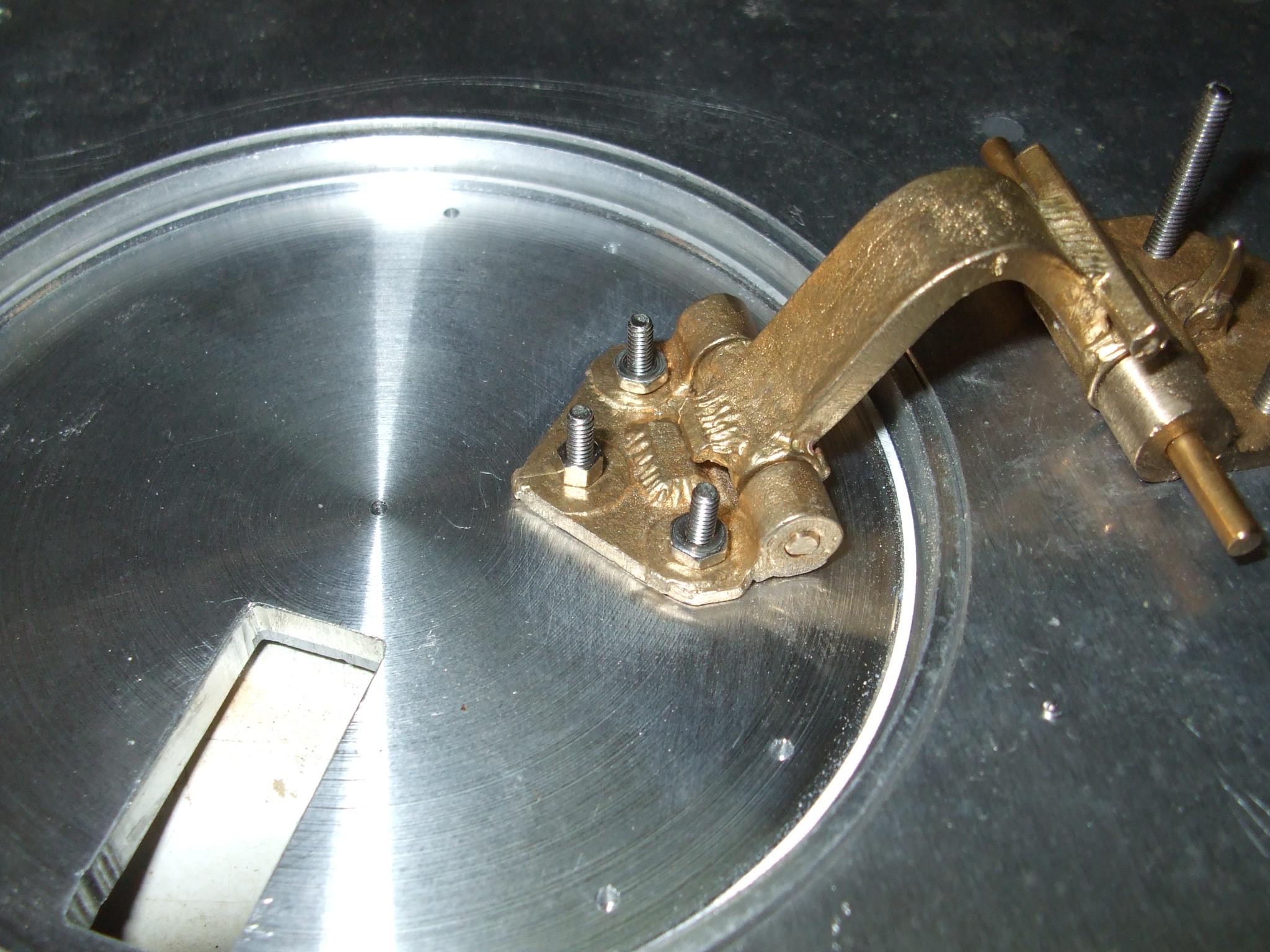

Last operation was to drill and tap M2 the hatches so that the brass hinge plate could be fixed to the hatch. Used the hinge plate as a template to mark the position of the holes.
Test fitting the hinge to the hatch. Used to types of nuts to see how they look. The one in the middle is an M2 model nut whilst the other two are standard M2 nuts. The model nut seems too small. Which one looks best? What do you think?
Some photos of both hatches fitted.
I had to use a thin shim under one of the hinge plates so that the hatch sits correctly in the hatch ring groove. I guess I did not correctly drill one of the holes for the hinge pins.
Well I guess that finishes the mechanical modifications to the hatches. All that remains is filling in unwanted holes, cleaning up the white metal parts and glueing them in and painting.
I am a bit relieved that I managed to reach this phase and it's looking good for now as I was not certain of the outcome.

Very nice work with the hatches! Don't hesitate to bend and adjust the hinges if necessary. Brass can handle that. Now go and get yourself a pair of Mike Stannard's periscopes with the glass lenses. Expensive, but after all the work you have put into perfecting your model, it deserves that.

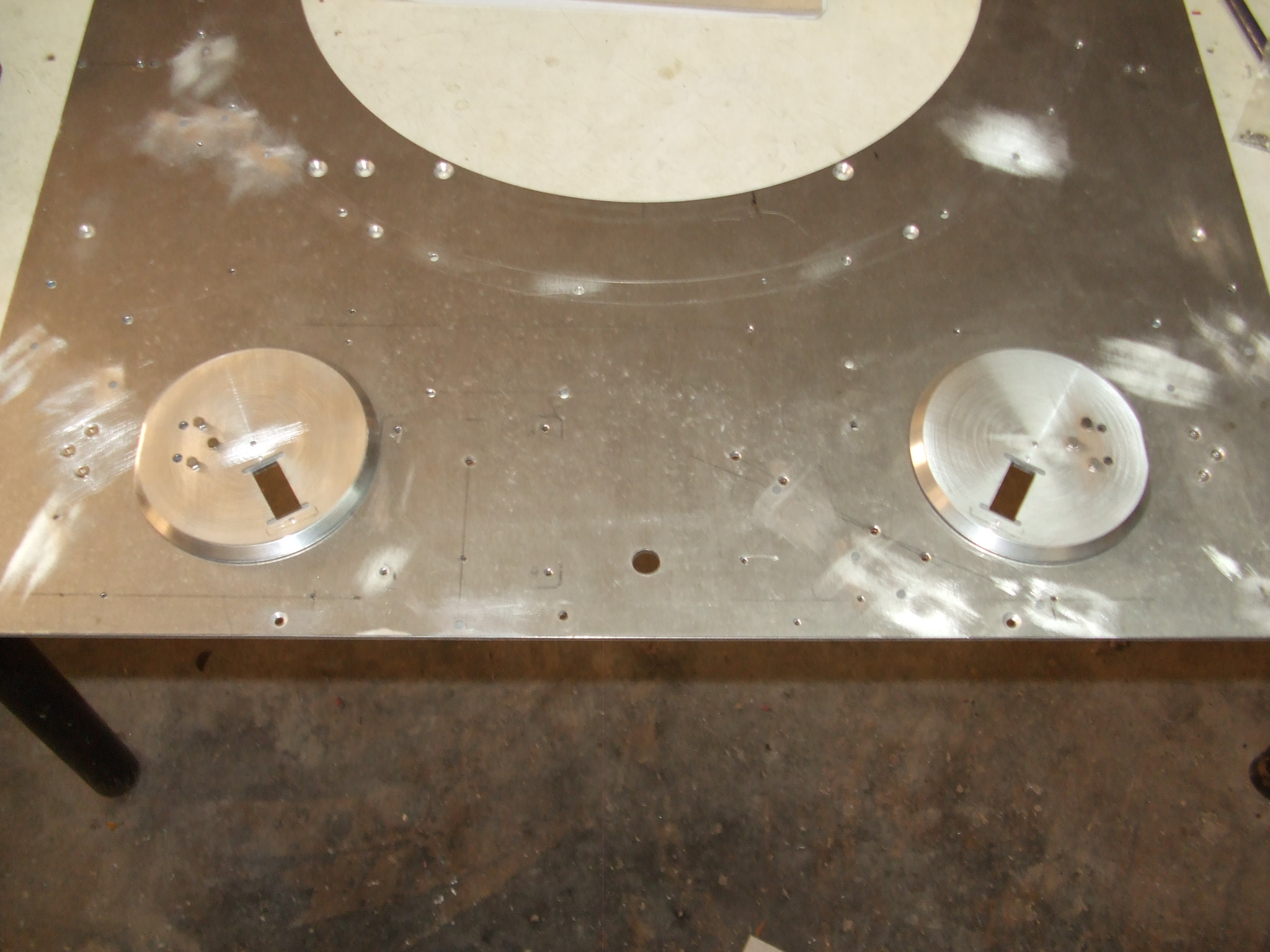

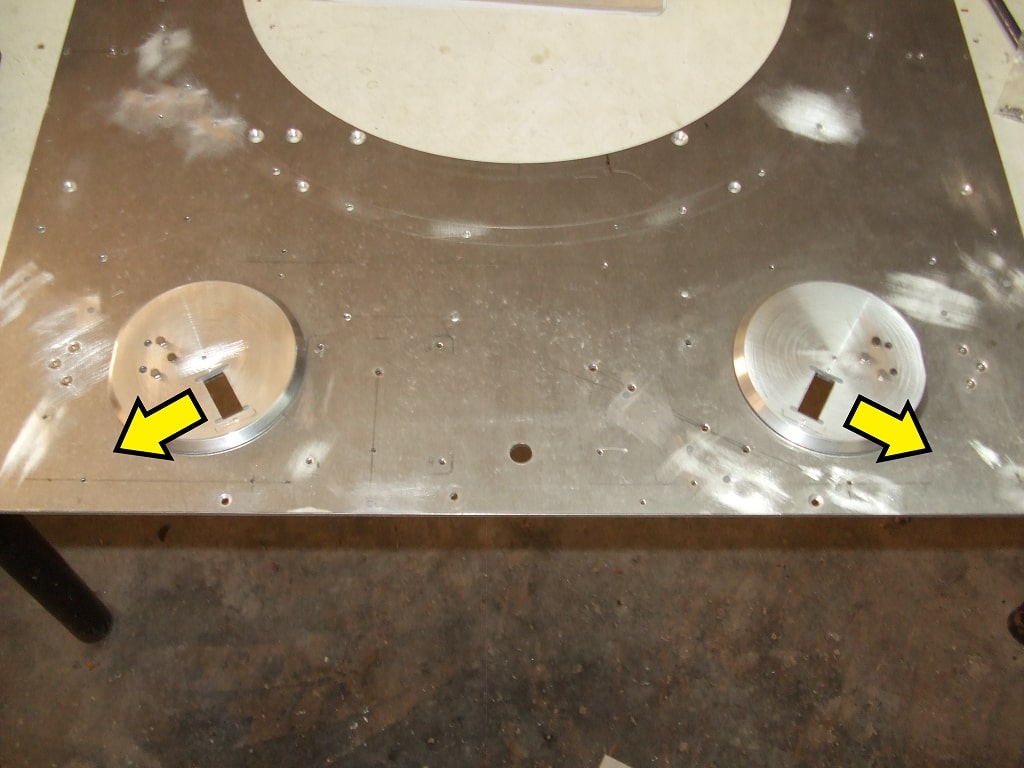

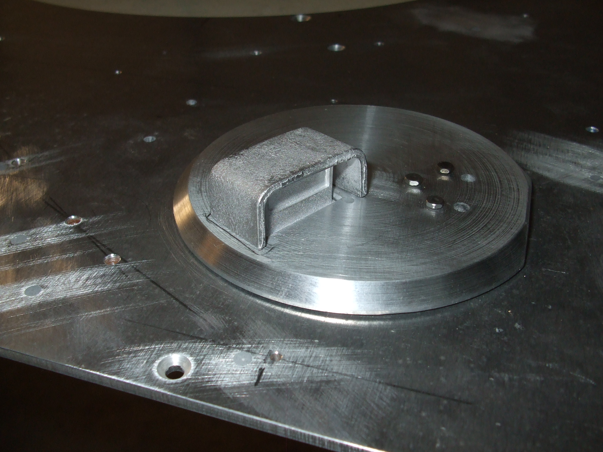

A quick question before I do something that I will regret. Is it correct to say that the hatch periscopes face in the direction of the arrows as shown in the photo below?
Thanks in advance
Thanks in advance

Thanks Kent. I saw that page but unfortunately it does not show how the actual periscopes were fitted.
Actually I am going to answer that question myself. I was looking again at the photo and common sense tells me that the actual periscopes have to look in the direction of the arrows, otherwise if I flip them around, the driver and the radio operator would be looking at the turret.

Very nice Vince,I so wish I had your skills and patience.I spent a whole day right next to Tiger 131 last year taking photos and measurements of the Elefant which is parked next to the tiger.I hardly noticed anything on the Tiger which would be useful to me when I started building mine.
I had the same thoughts as you when I put one of my hatches together.Commos sense should have them pointing outwards.but you never really know..I looked at lots of pictures just to make sure.
Glen
