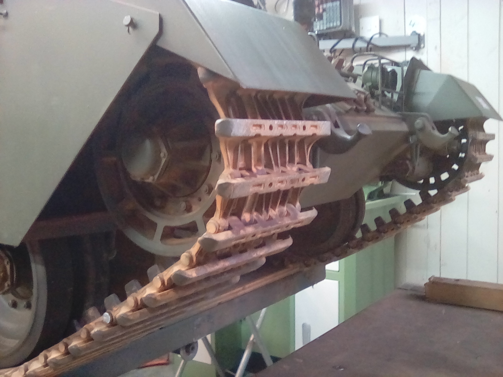

Nothing like a bit of dirt on your pride and joy! :D
Re: Mr Dawe's Centurion.

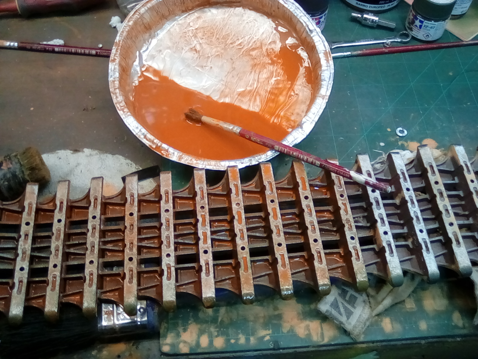

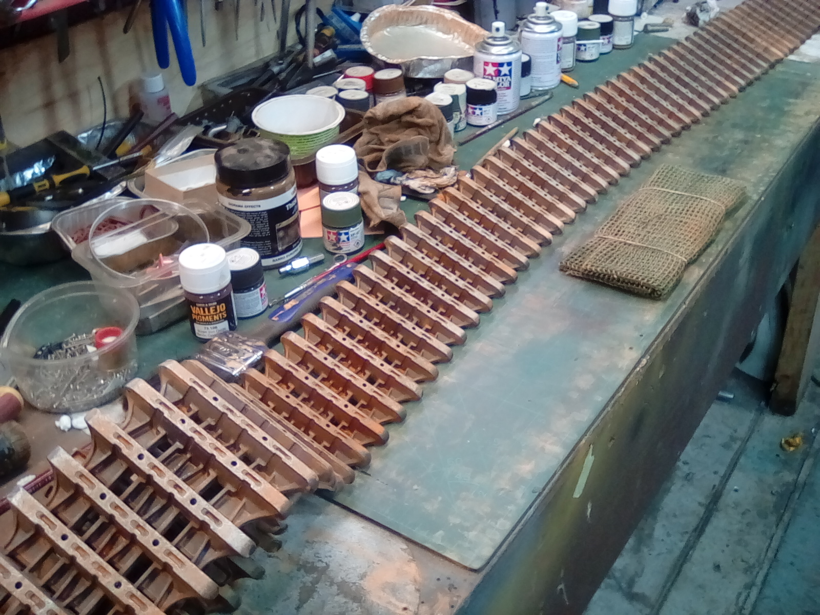

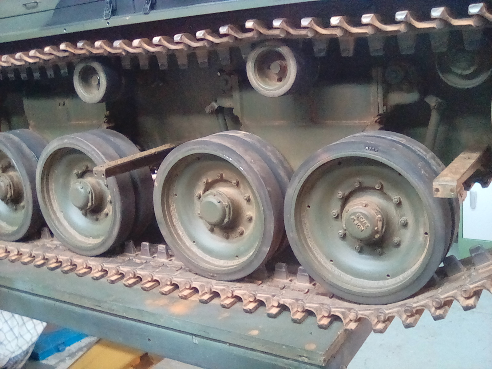

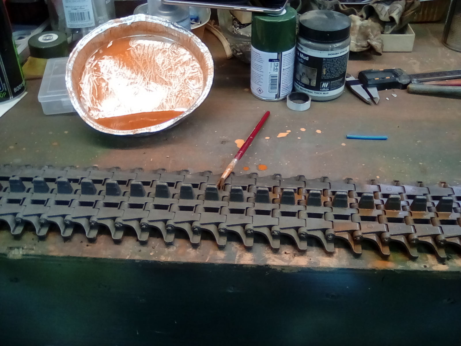

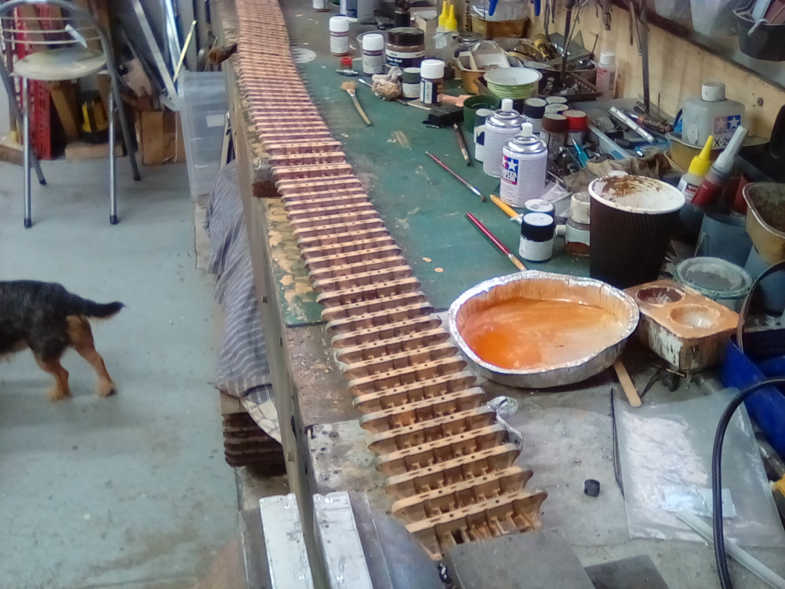

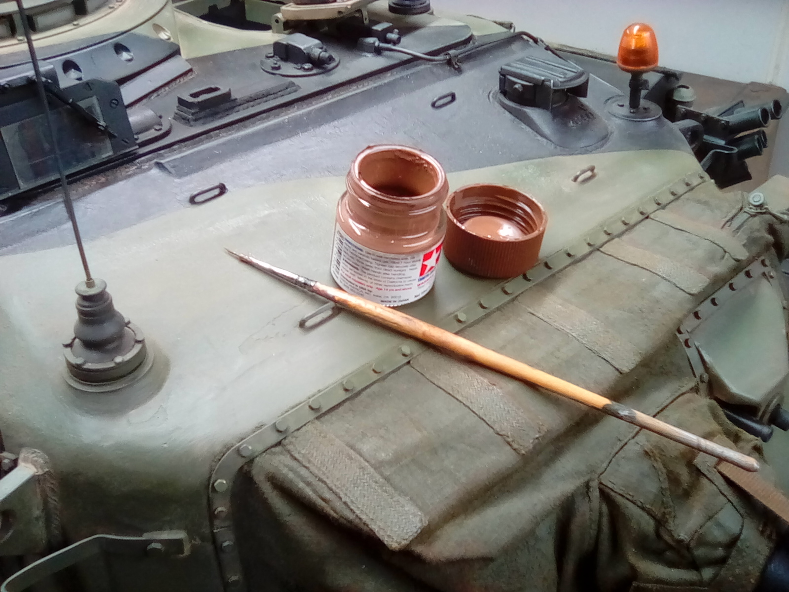

That's one track weathered, that's a lot of work
What a mess but it's worth it
The business side of the track to cover now

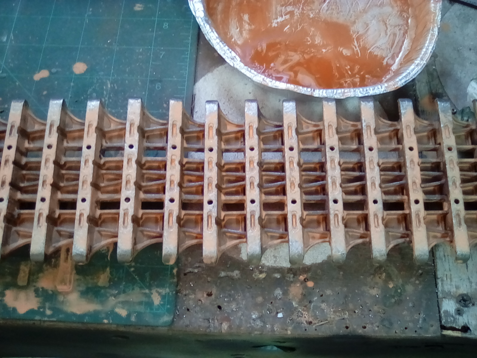

Every divet is filled
Some run time will wear away the pigment around the contact areas
Well I like it
Well I like it
Just needs some run time to bed it all in

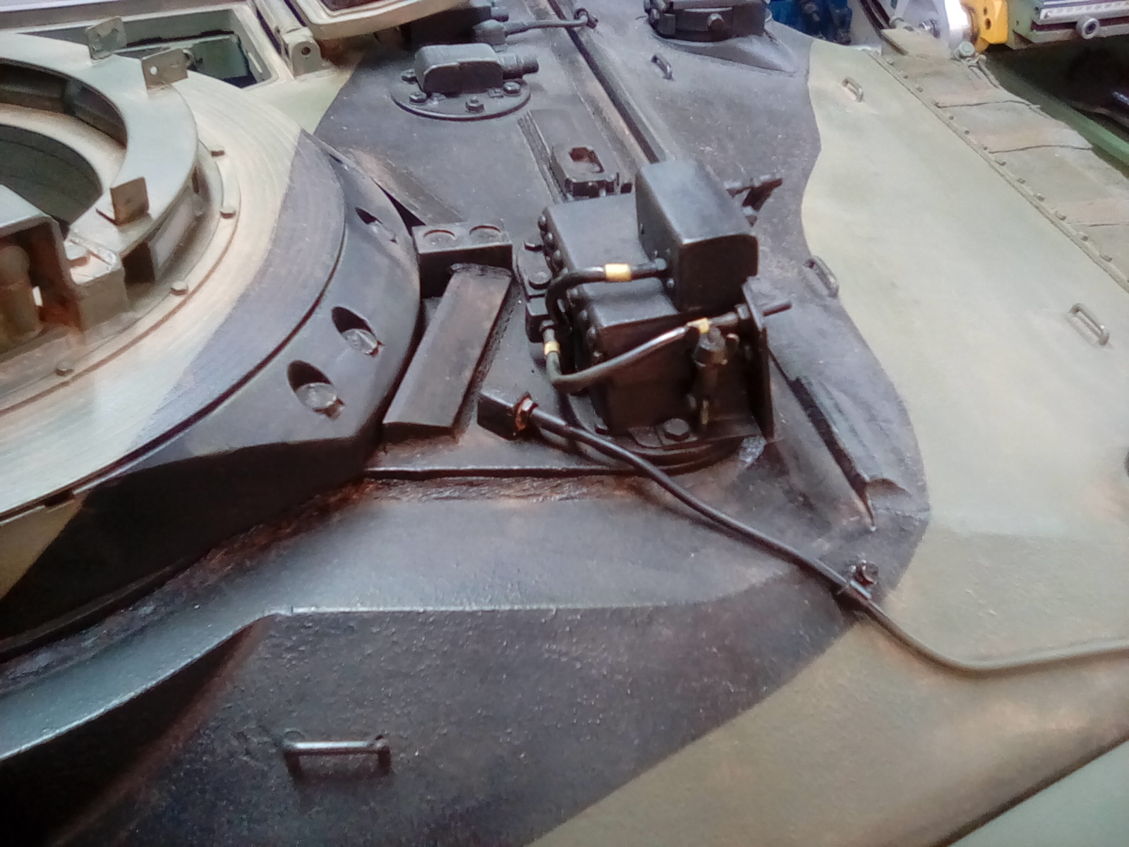

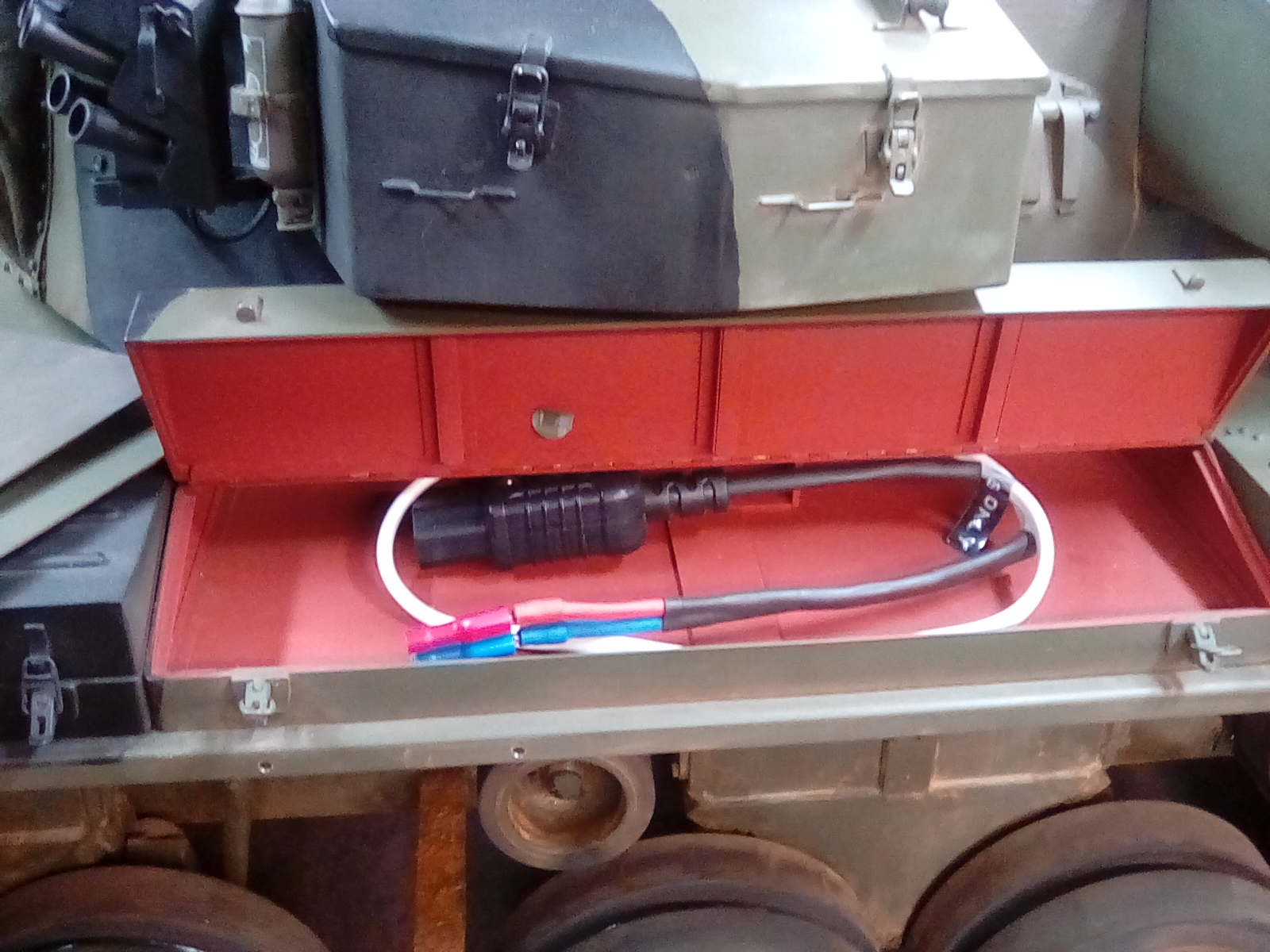

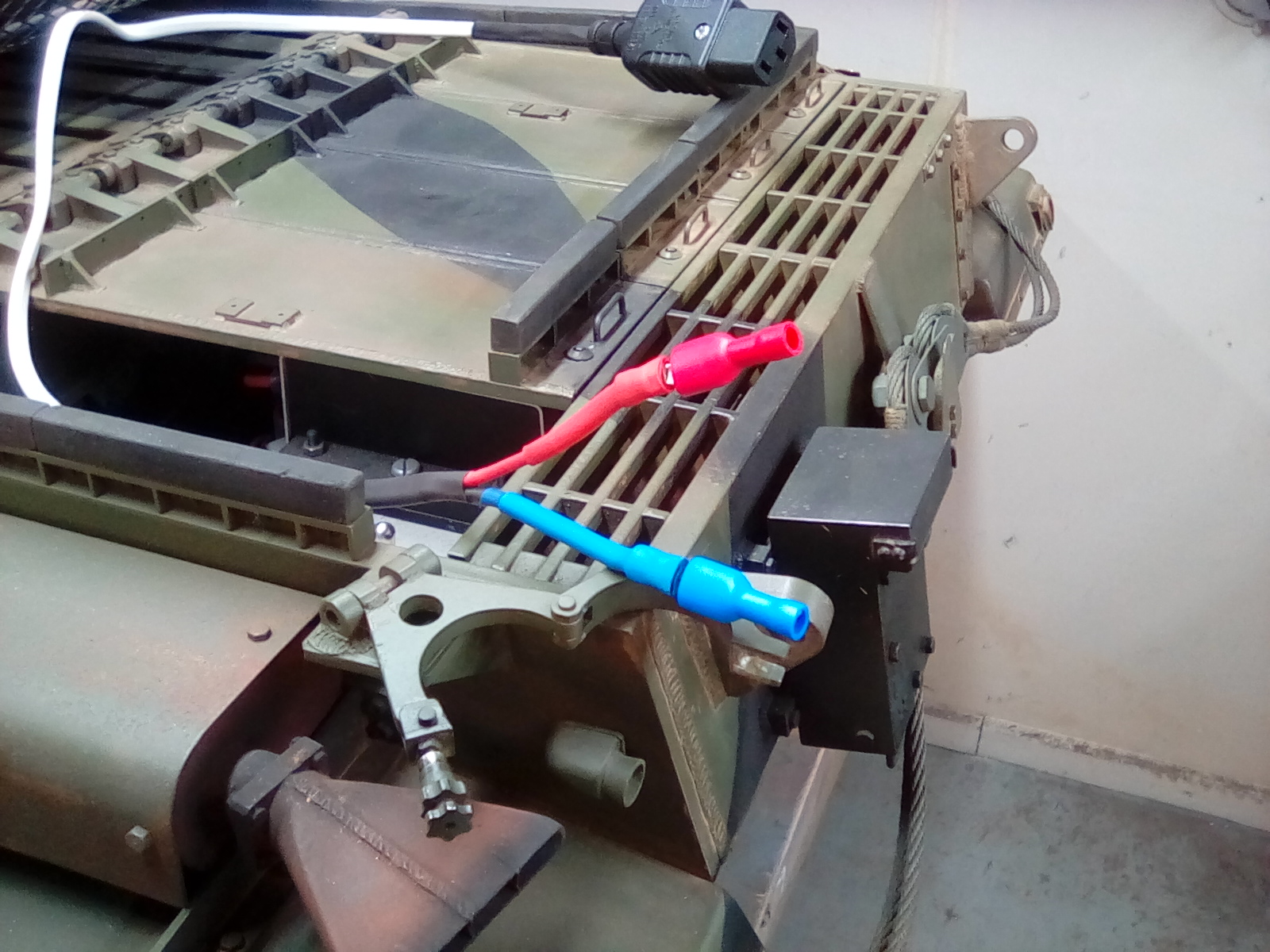

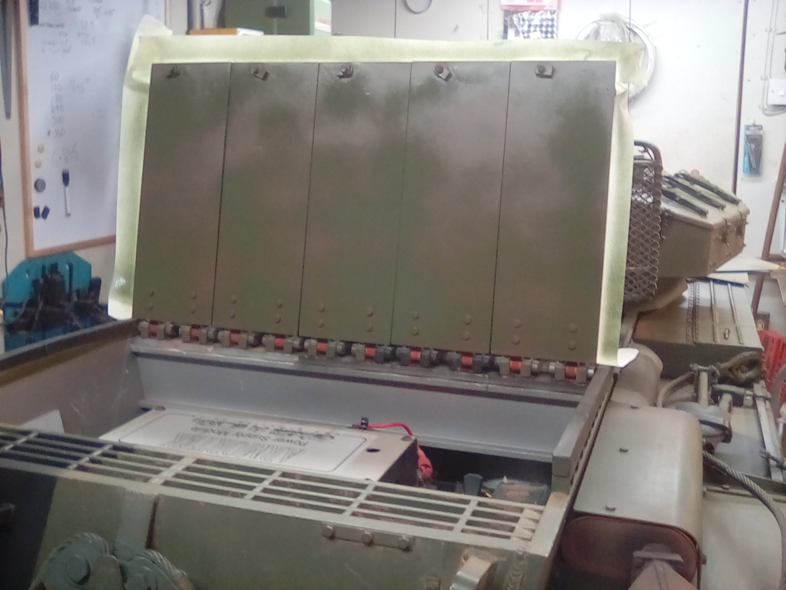

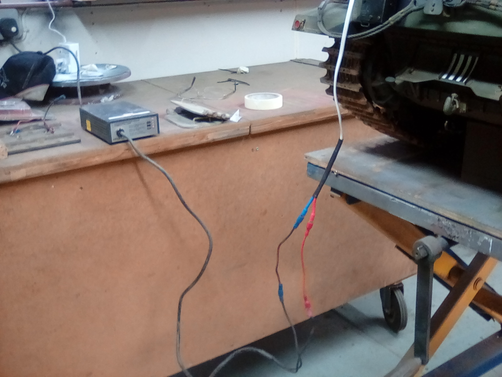

Remaining weathering is now done, also put together the charging socket and flying lead.
Really just the vin plates and the camo net to do, oh and the union flag needs replacing for a good one.
Last one
Last one

Charging lead and plug stowage

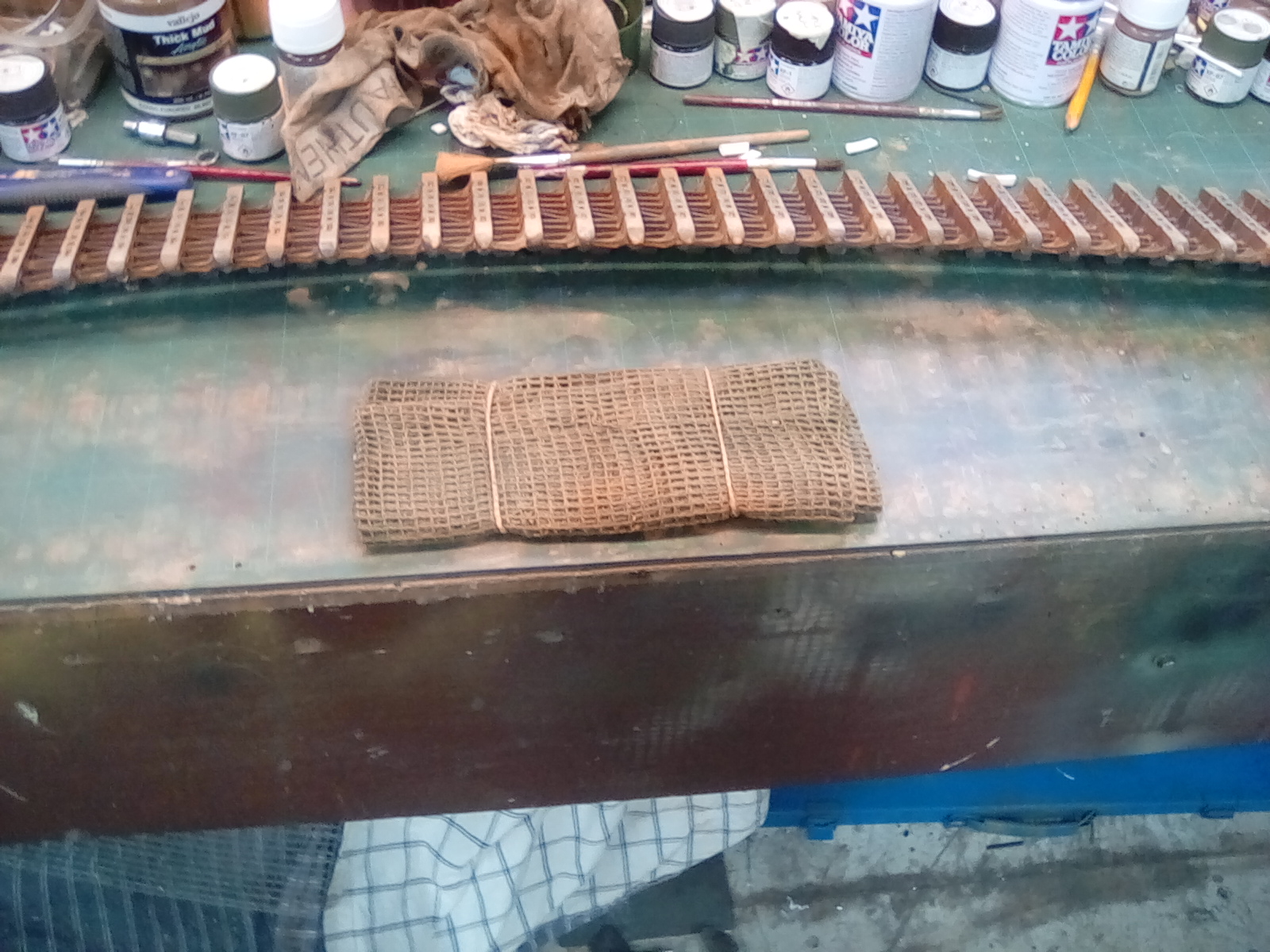

That camo net to finish

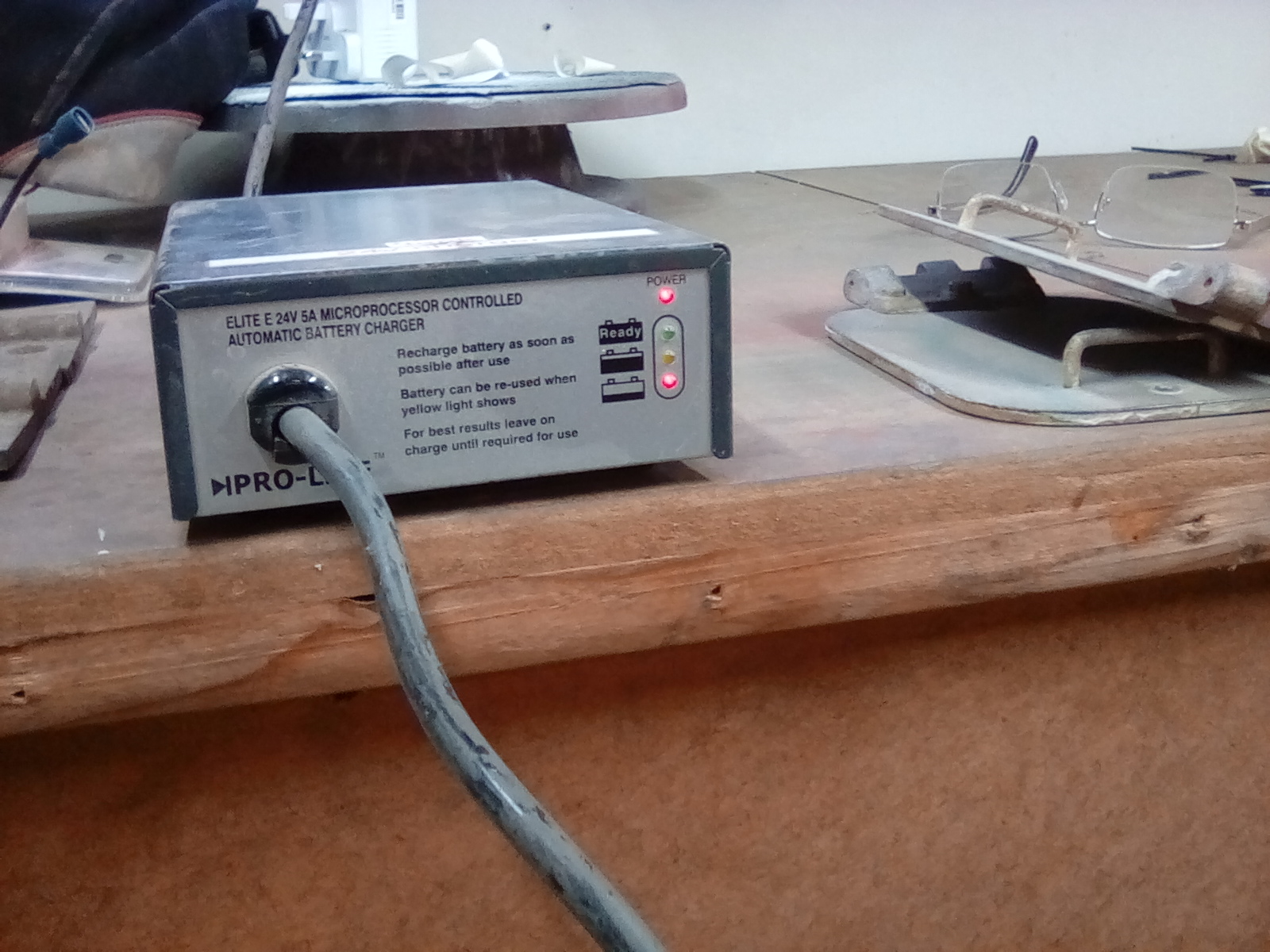

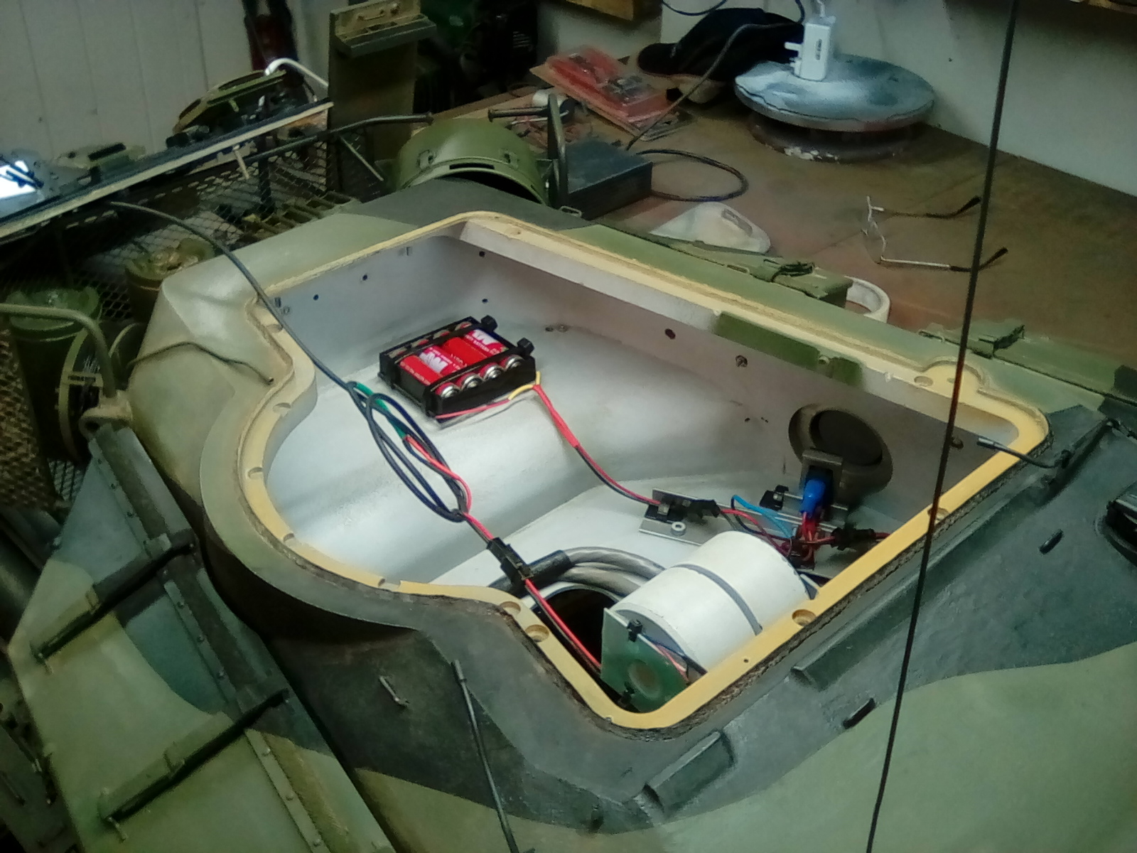

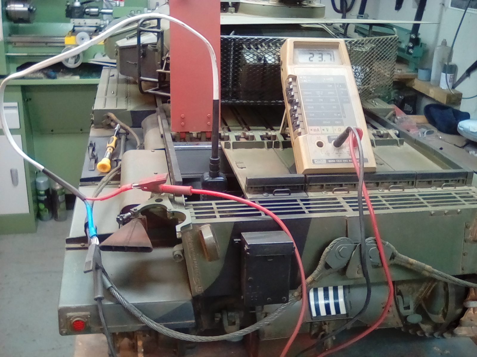

The batteries were fairly low
This can now be buttoned up for the last time

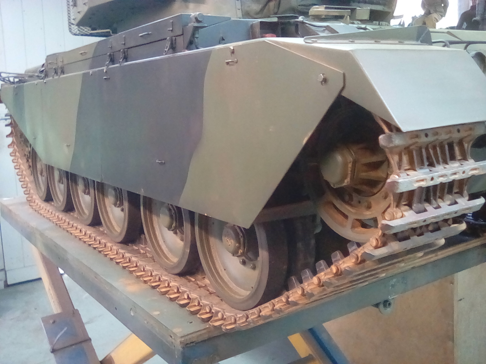

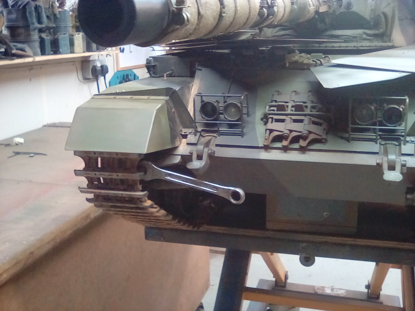

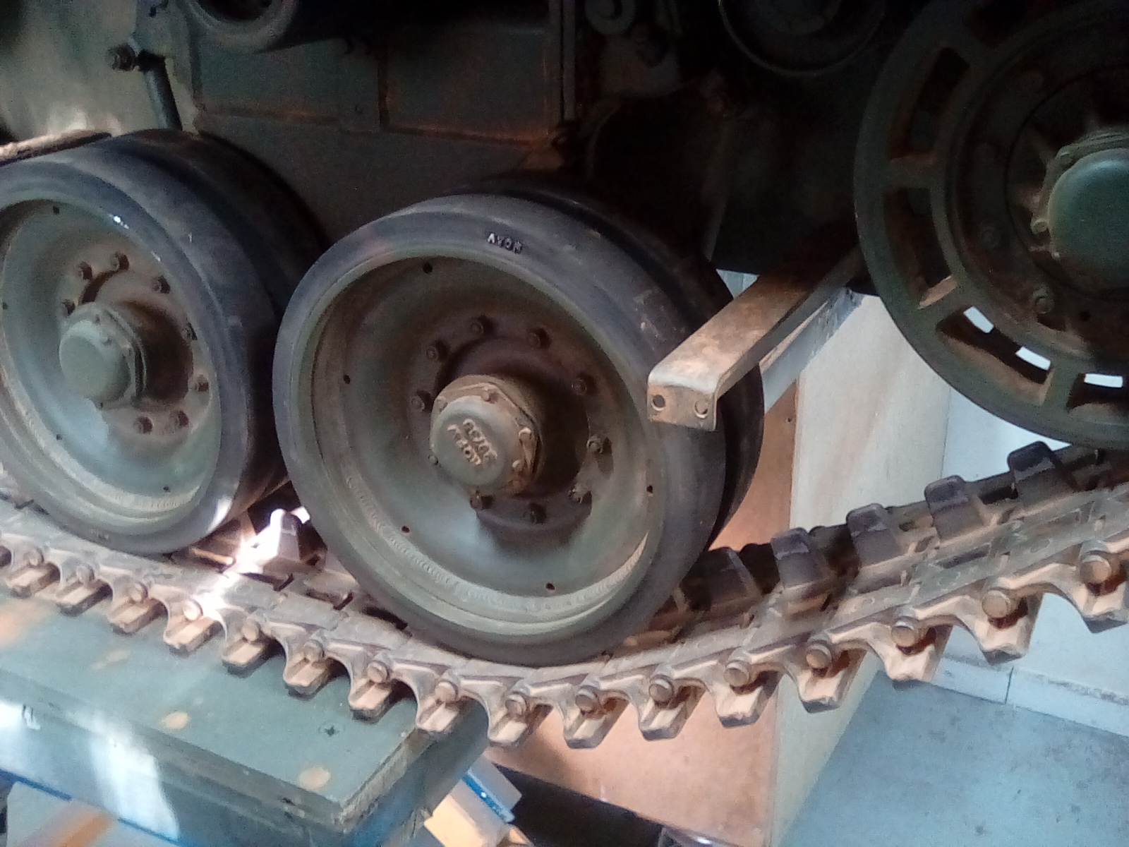

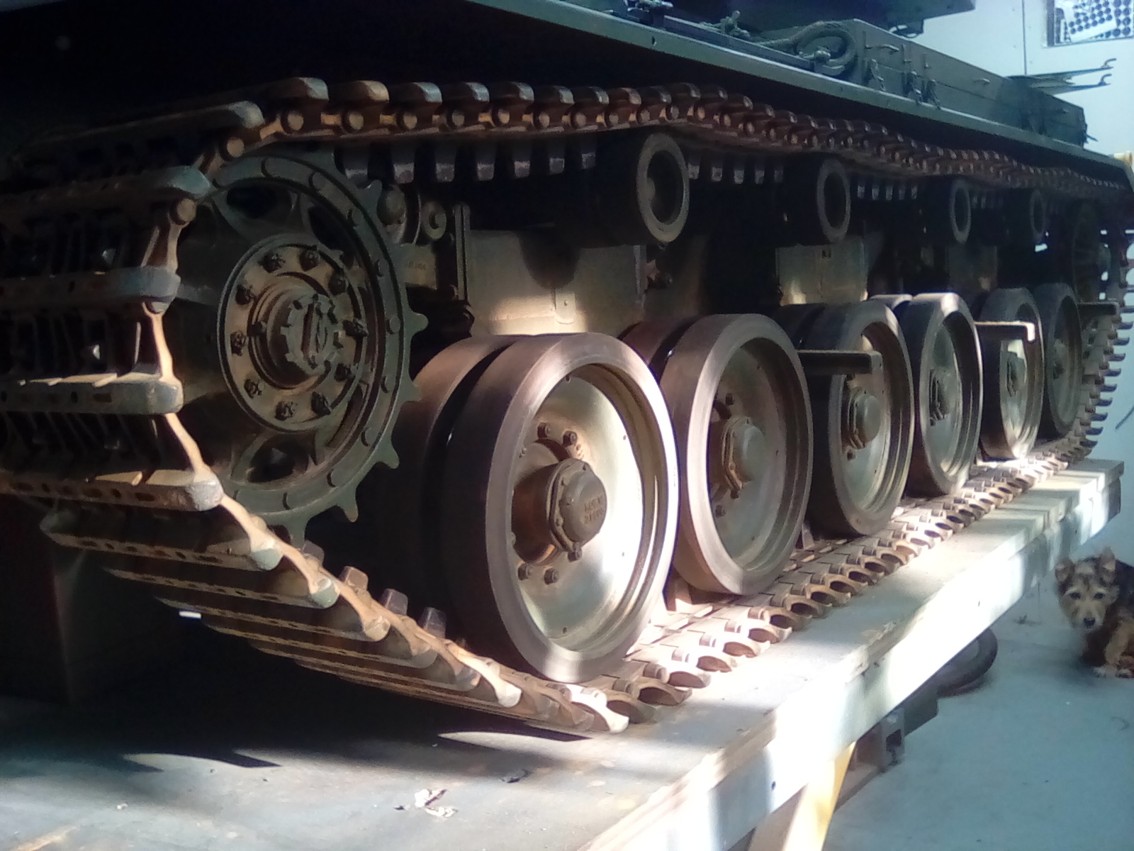

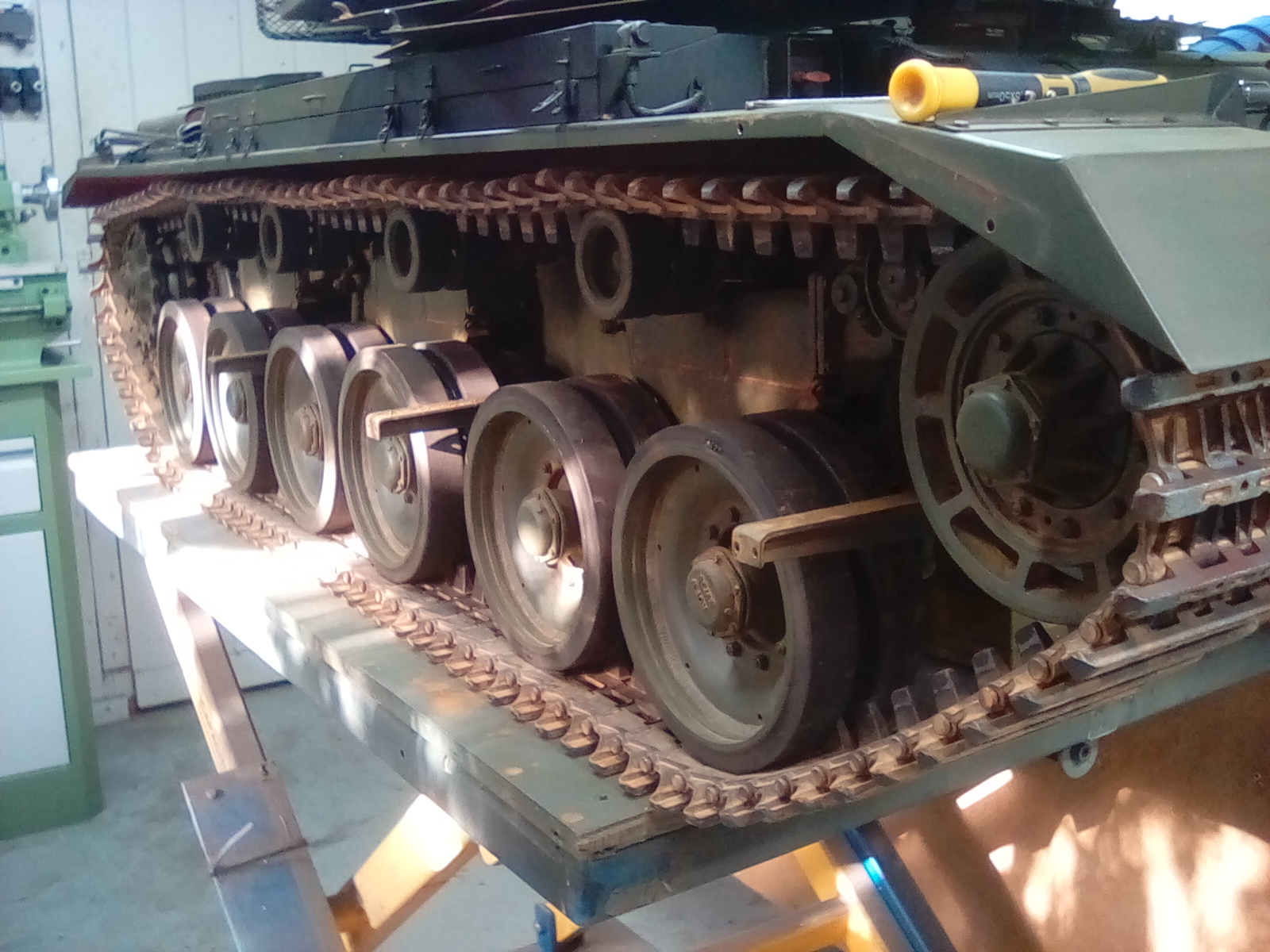

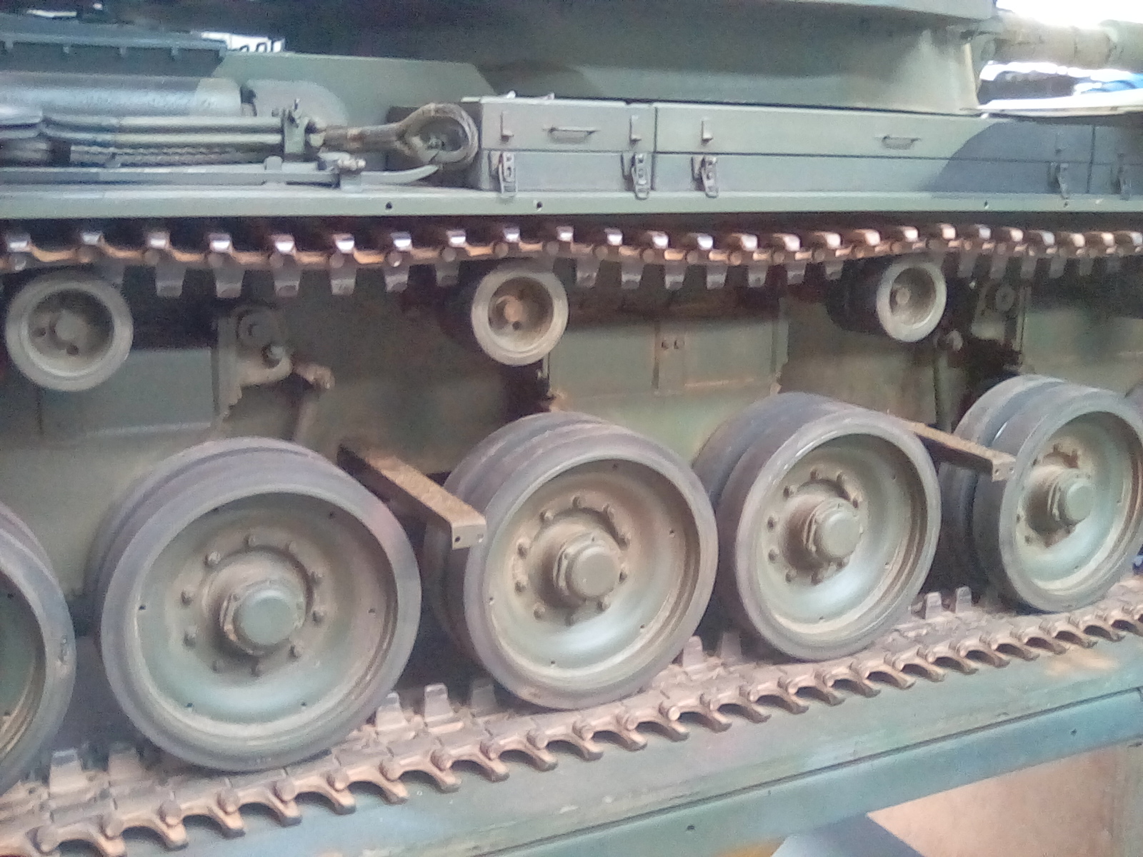

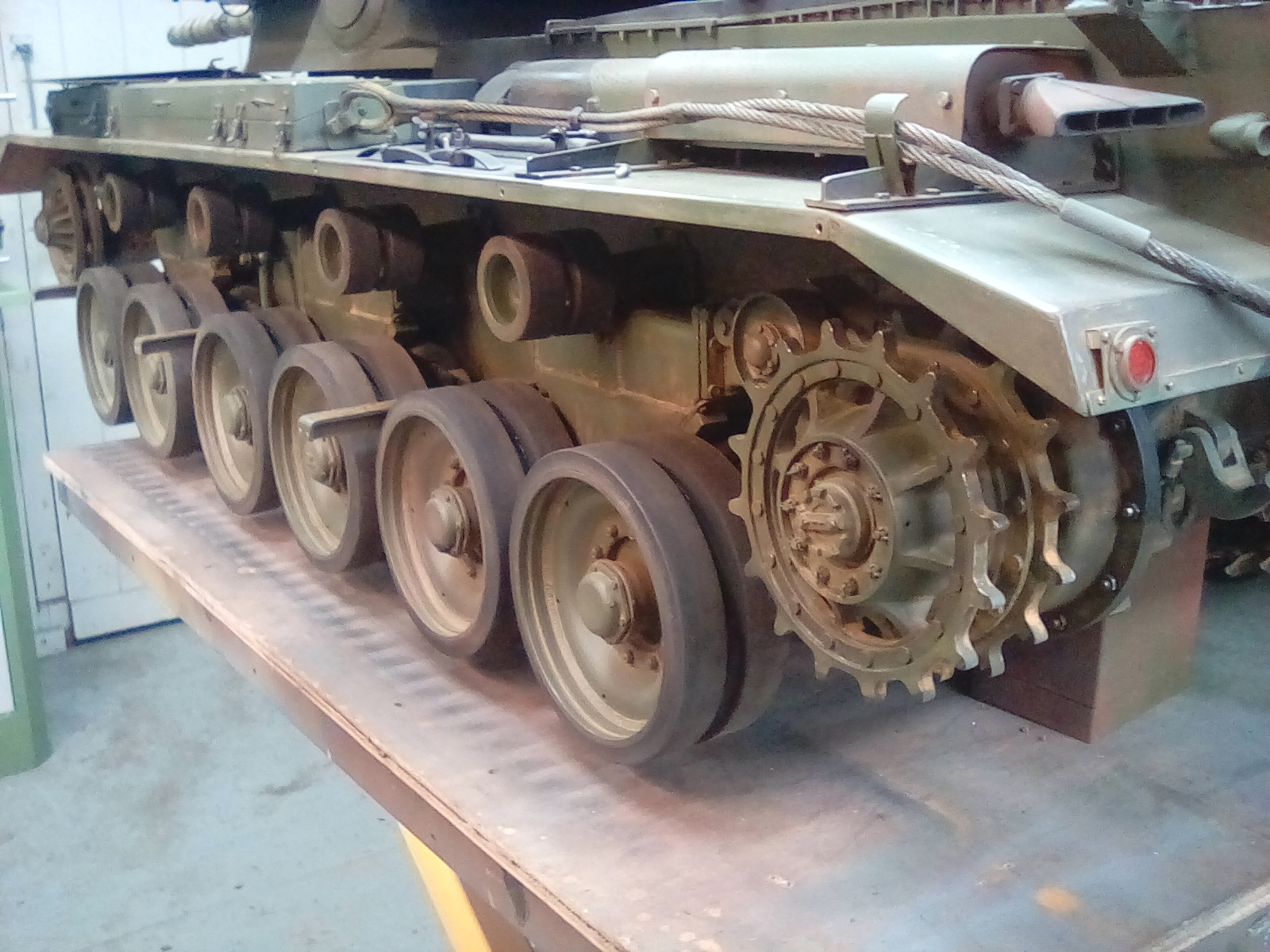

Now for something different, I'm using a small amount of thread lock at just one end of the release pin for each track, in an emergency this pin can quickly and easily be removed, if after running for a while the pins starts to drift I will poke a split pin in but we will see.

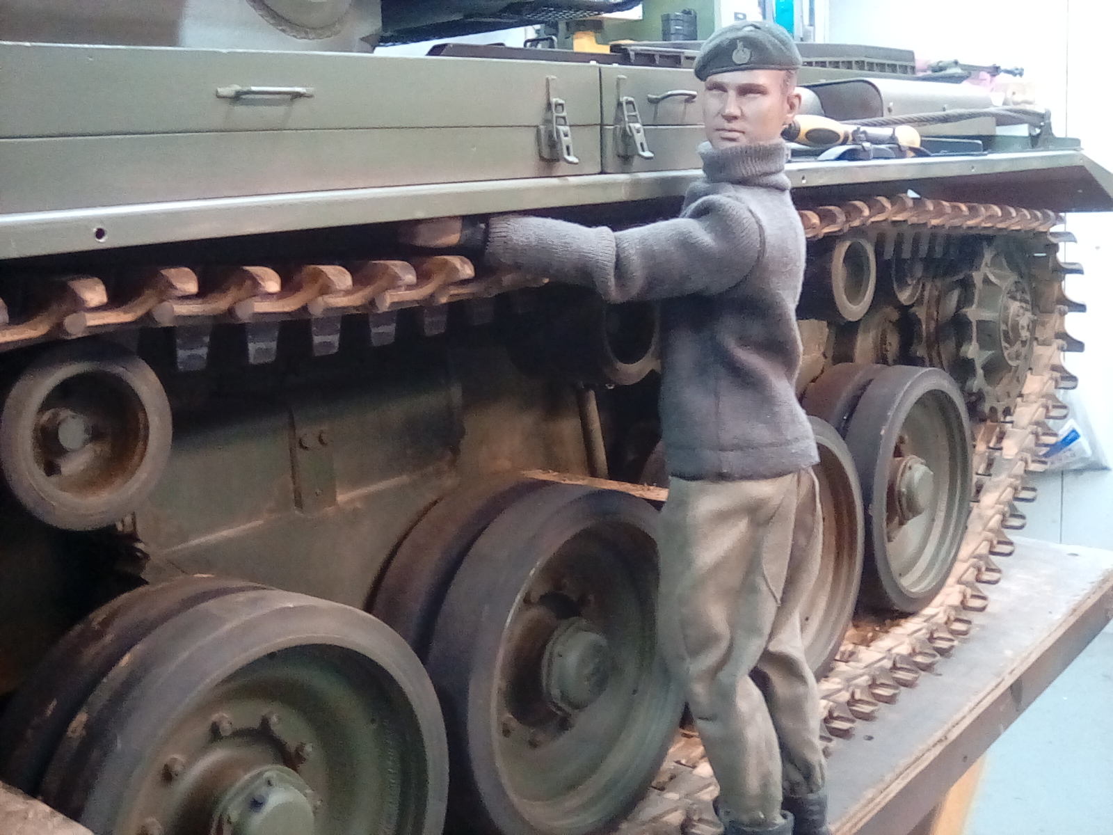

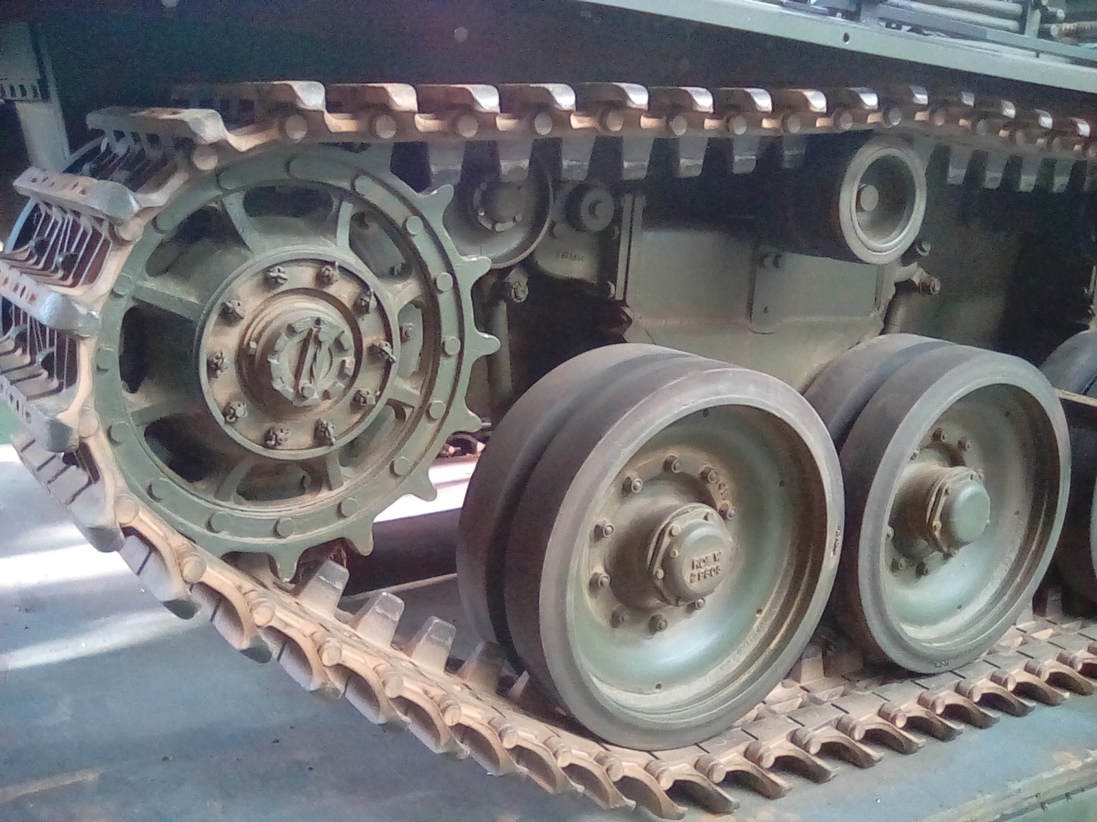

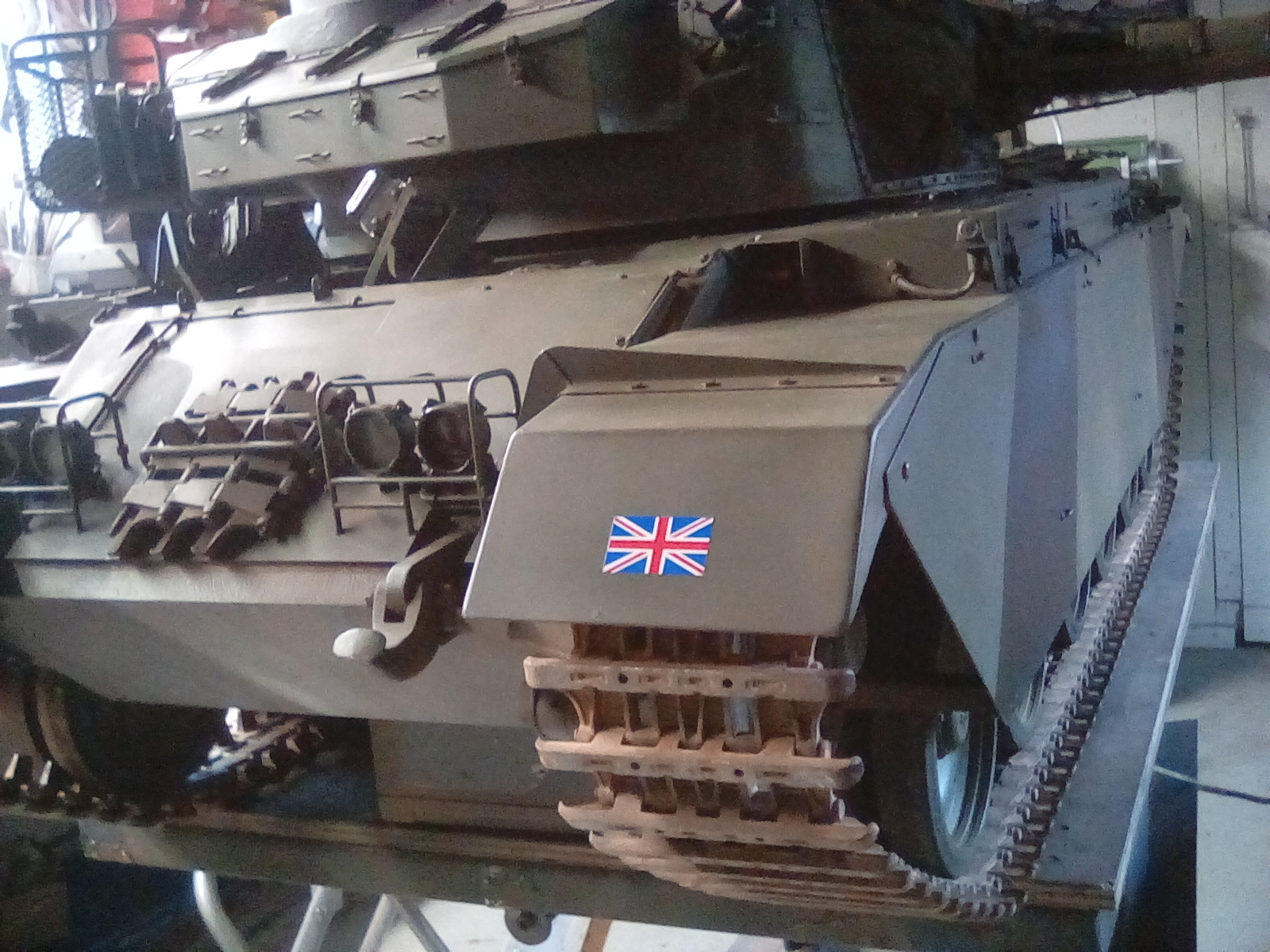

The Centurion must be the easiest model for track tension adjustment
Track tension a fists width
Turning the bazooka plate fixings back a little so there's no chance of the track " wipping" them

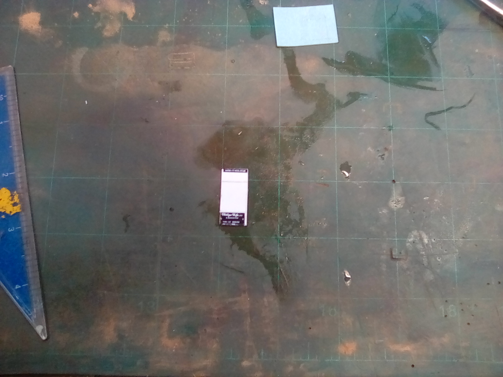

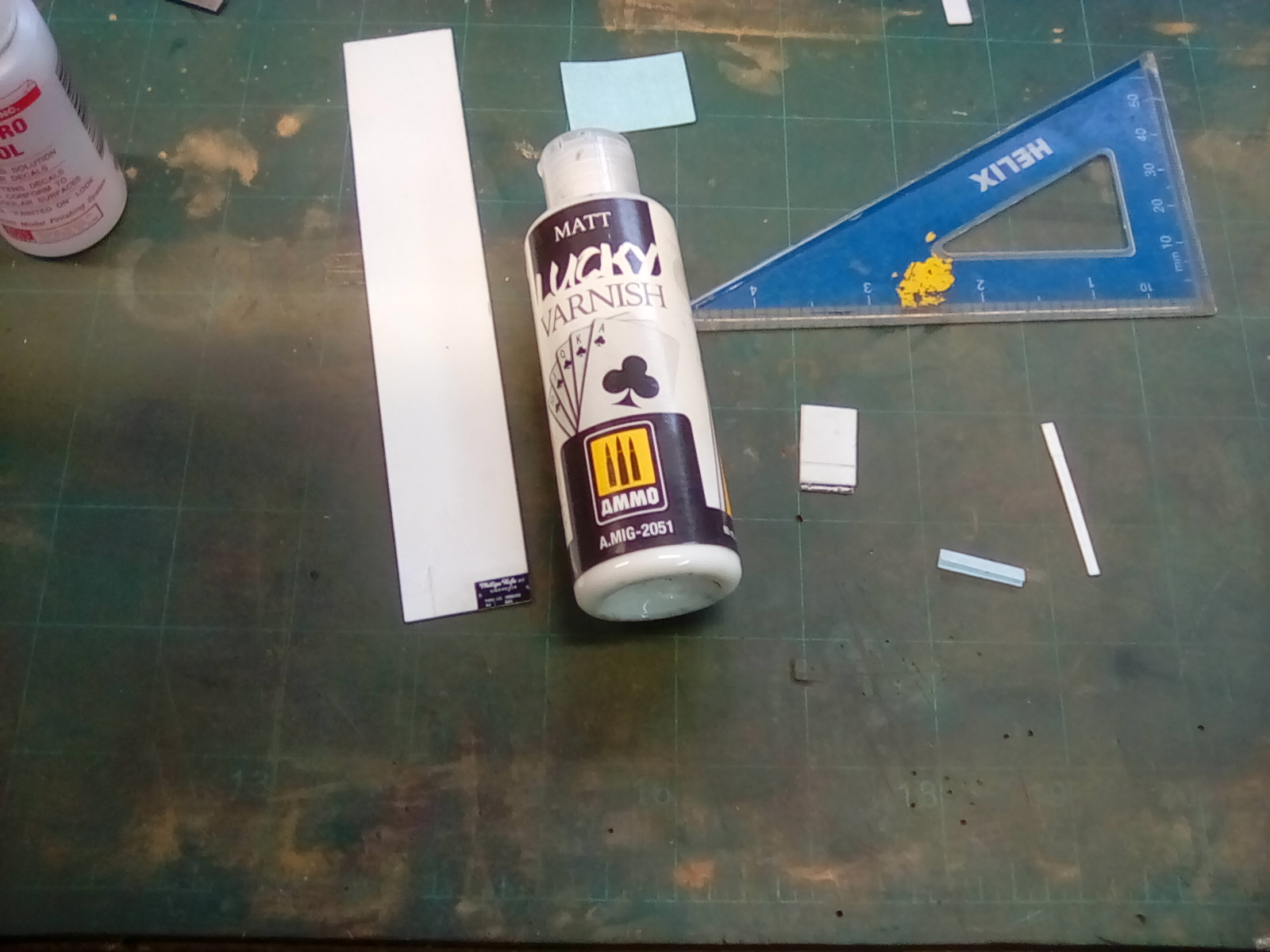

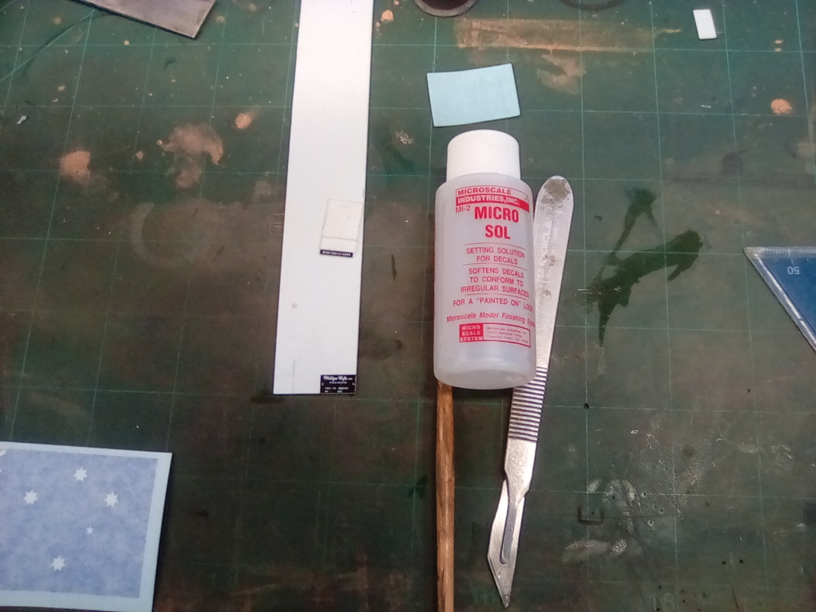

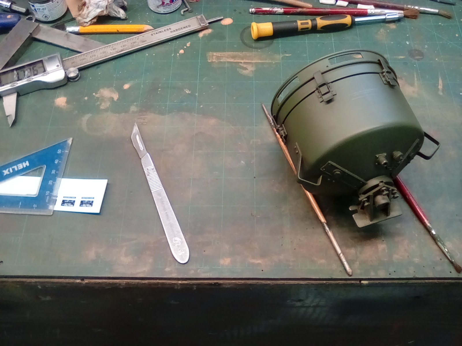

Decals

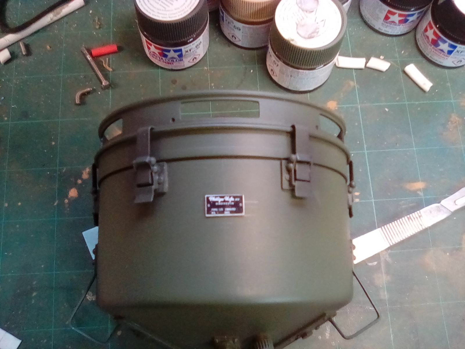

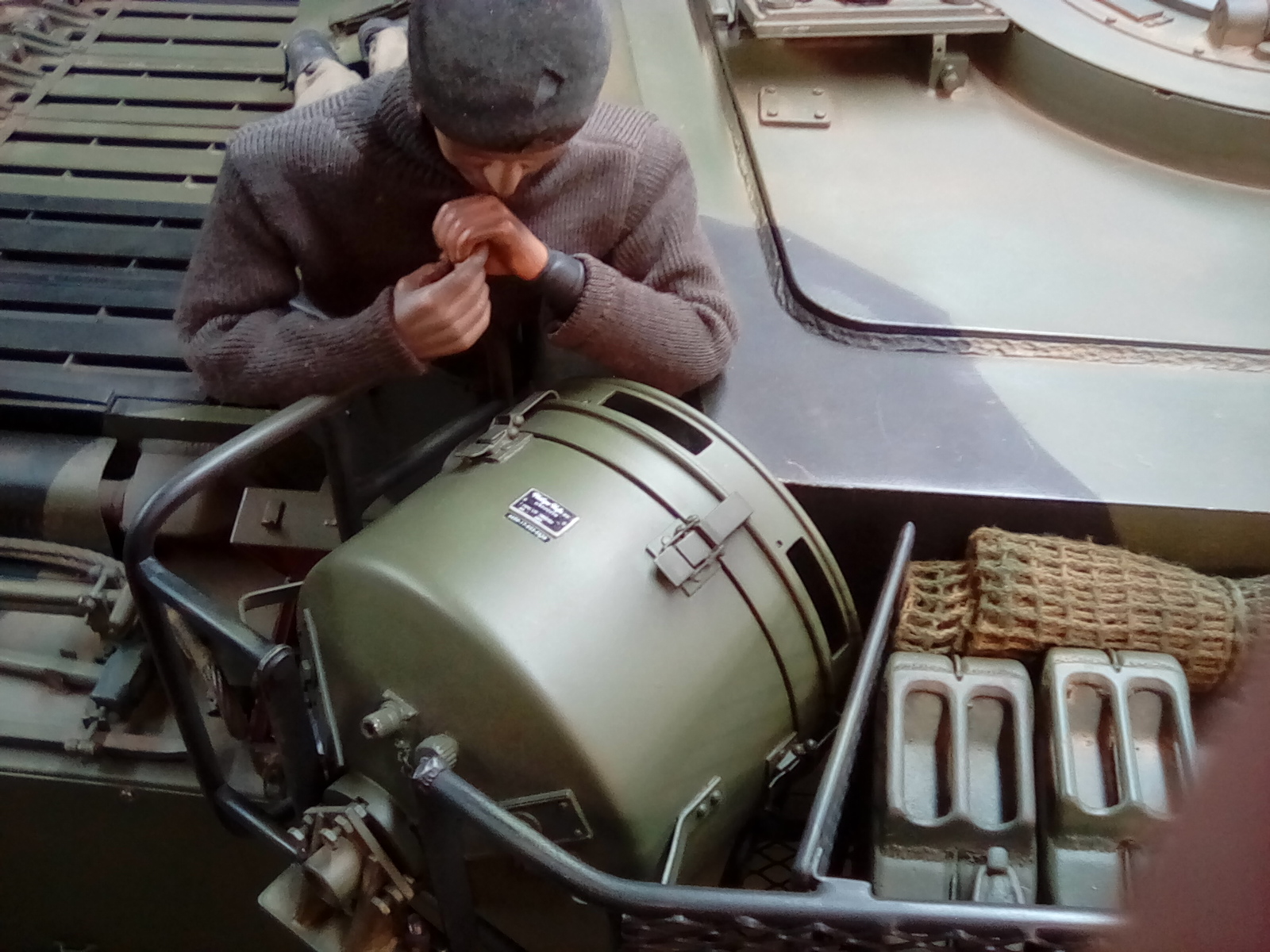

The Phillips logo to mount and a question for Mr Dawe, where does the stock number decal go, I can't find a photo of that anywhere?
So awkward to mount, I did bugger up the first decal as it dissolved when I used wicking cyno to fix it.
Good ol microsol
Good ol microsol
The new replacement union flag is nice
Just a little trimming required to the top edge
Better if a bit to clean
This stuff is just PVA but I didn't know that when I ordered it
Always some fitting to be done
These can hang under the front bollards to add a little more interest
I haven't fixed it in place , the decal needs to be totally dry before I attempt the bending process

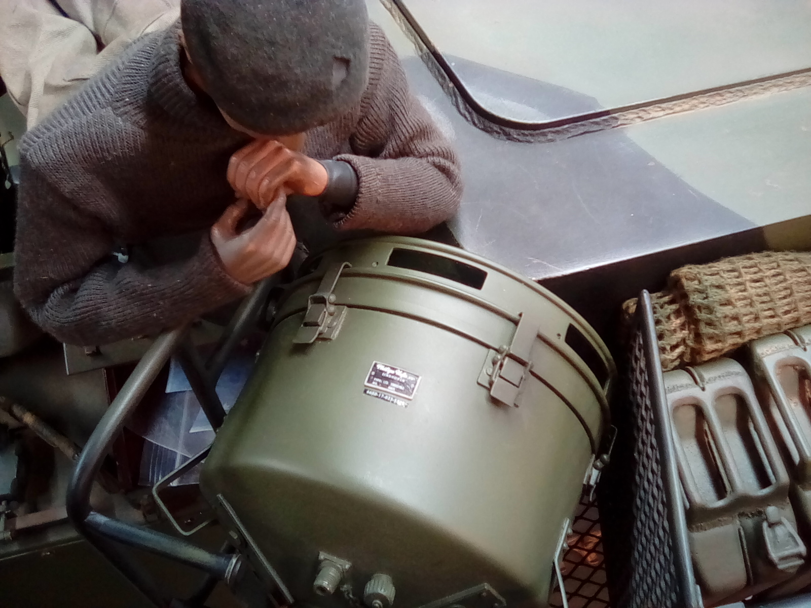

The bonding of the two searchlight decals and the extra shackles are hung
Well he looks pleased
The NATO stock number is mounted flush whereas the makers plate is proud

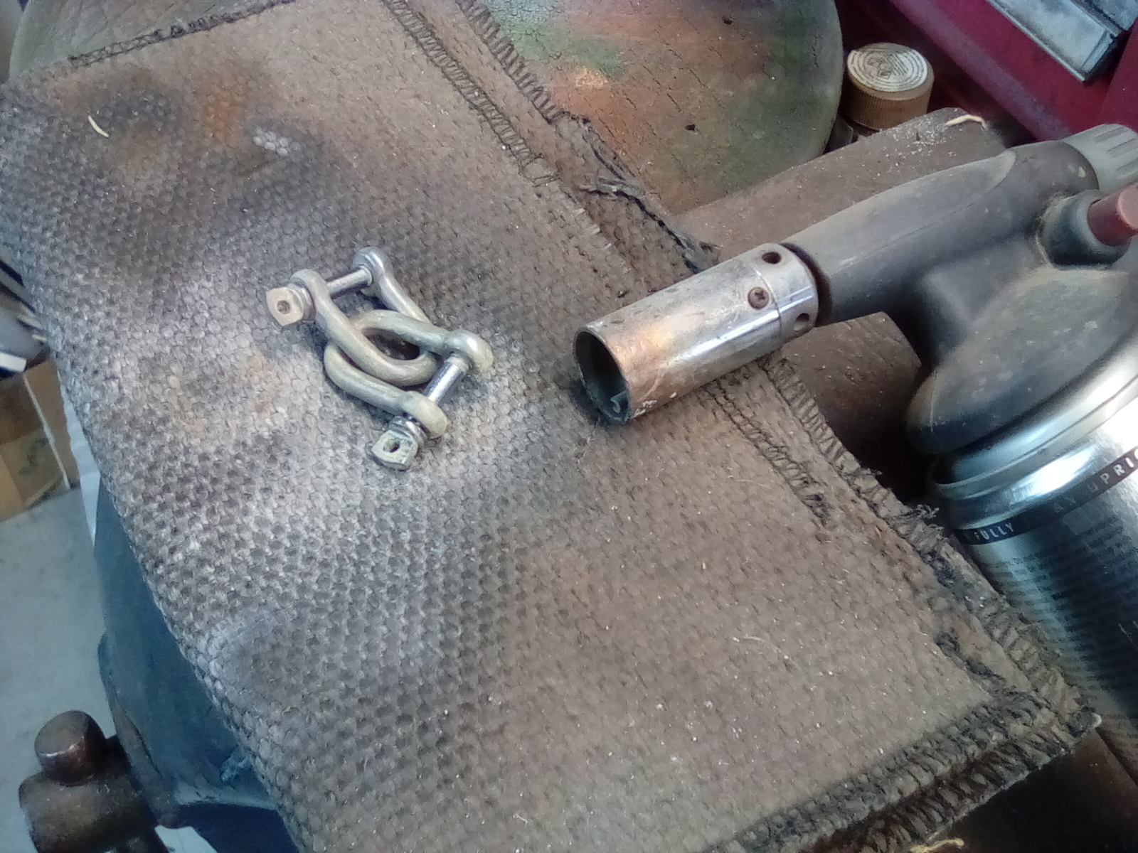

The extra towing shackles are tucked away
Phil Dawe
Posts: 295
Has liked: 757 times
Been liked: 300 times
Post by Phil Dawe »
It was worth the time and effort in having the plates made. Huge thanks to Dave Dibbs who helped getting the decals made in Germany and to Adrian Clayton in Australia who owns a number of real ex Aussie Army Cents and has a brand new Searchlight with pristine ID plates that he kindly photographed.

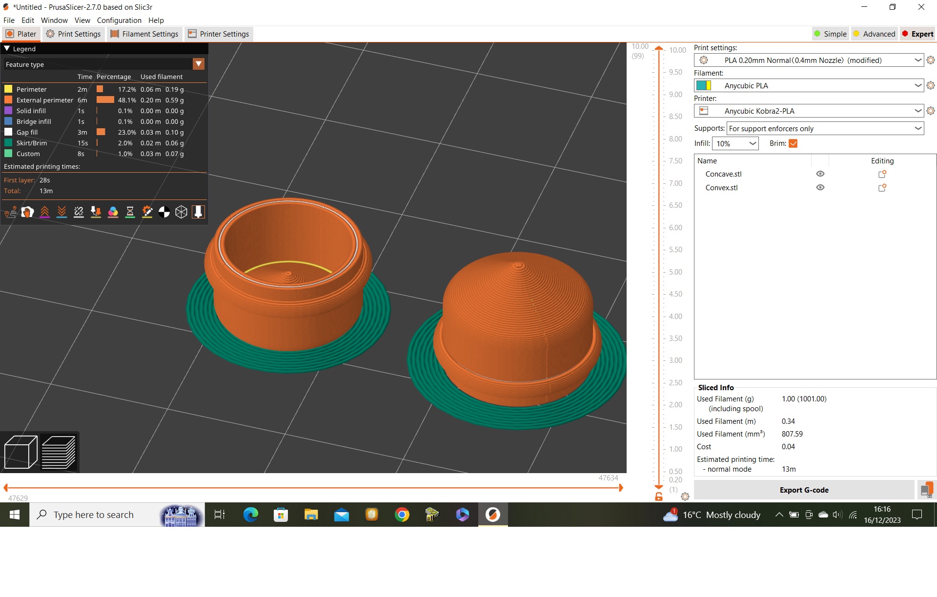

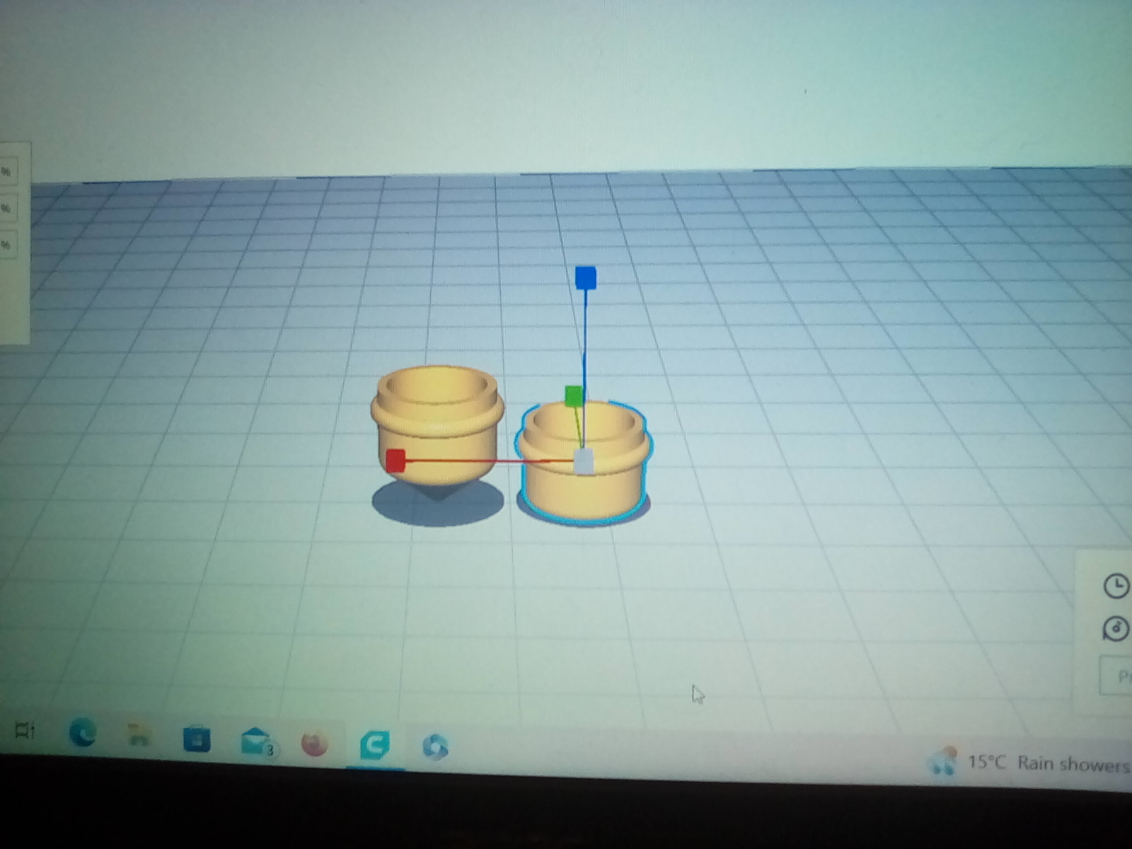

Just when you thought that it was all over......guess what we are printing? With help from Vince of course.
Two versions, concave and convex and I may make some inbetween

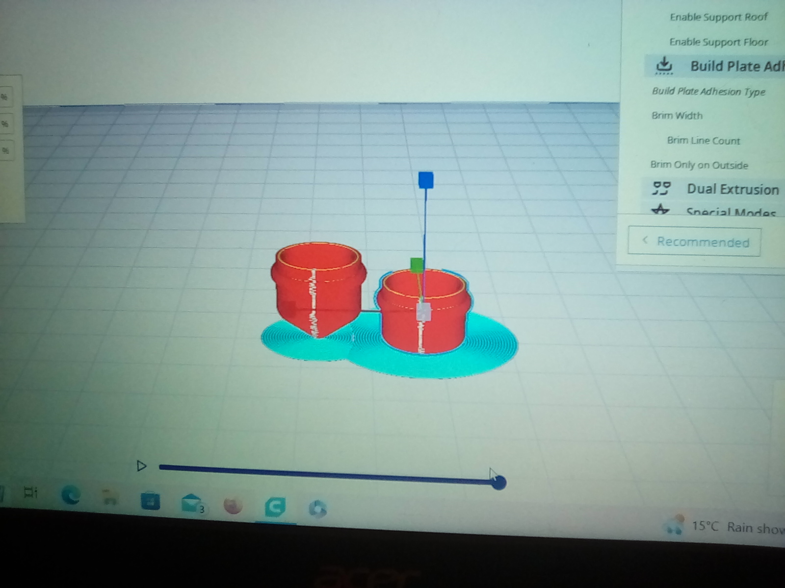

As they are so small build plate adhesion is a little problematic
Has liked: 792 times
Did you try it like this?
No supports needed.
Nice! Even the inverted cone prints upside down.

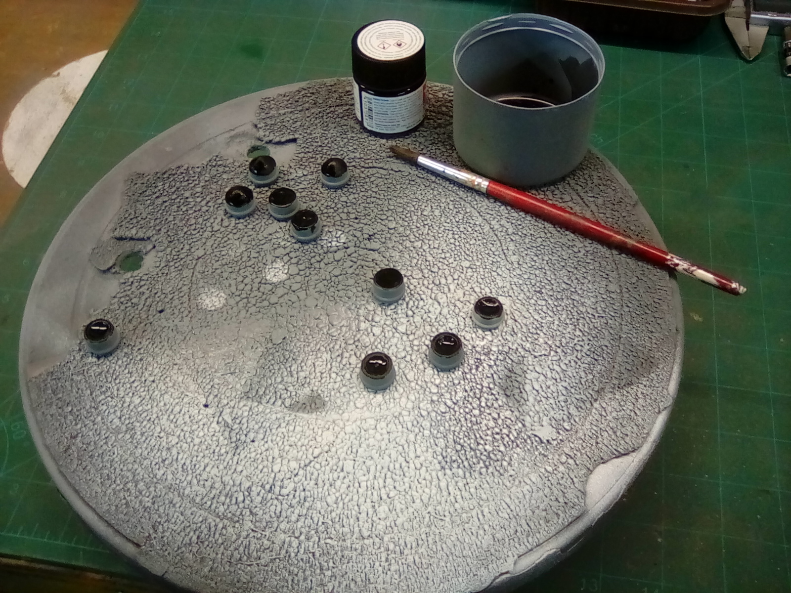

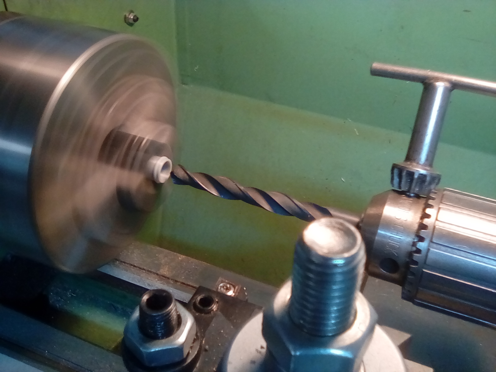

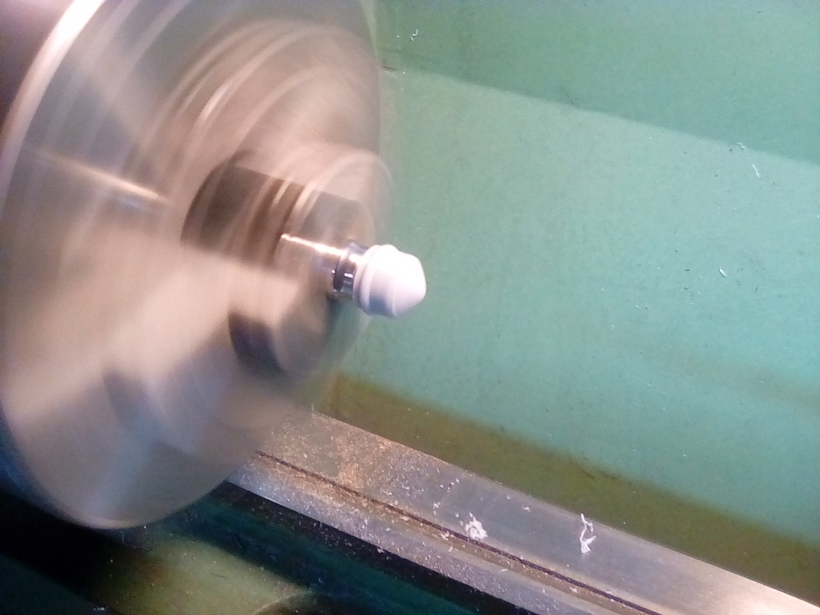

The smoke discharger rubber caps have a little tlc.
I needed a couple of thou clearance from somewhere
Good old milliput
Good old milliput
I'm attempting to add the mold flashing
