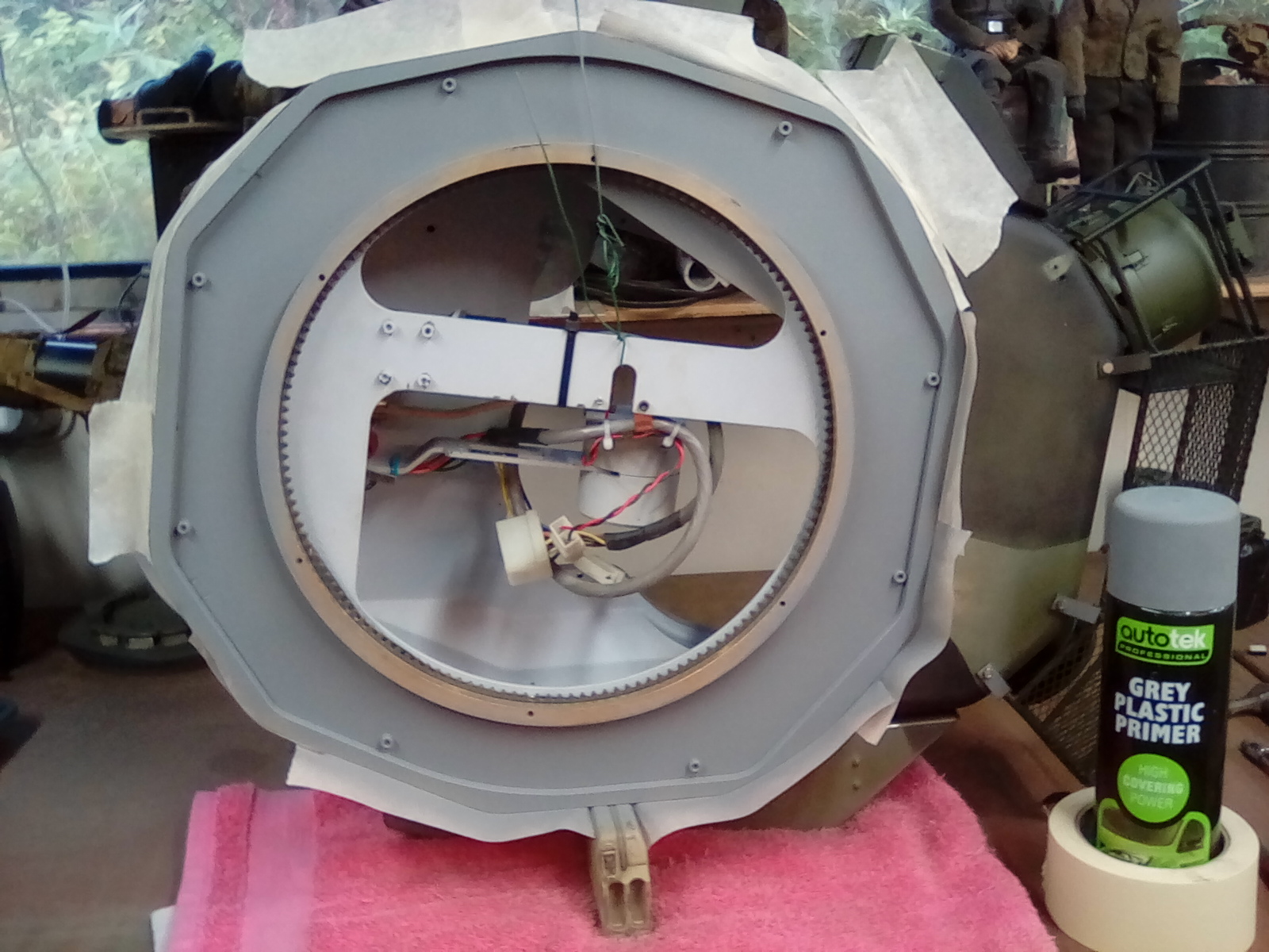

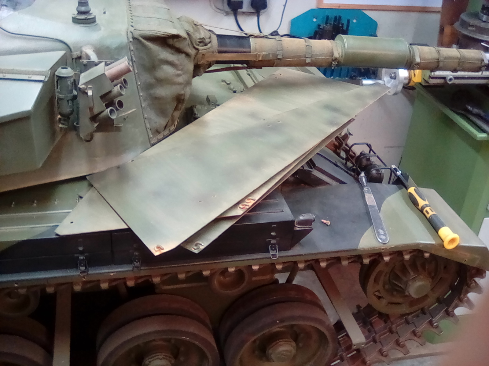

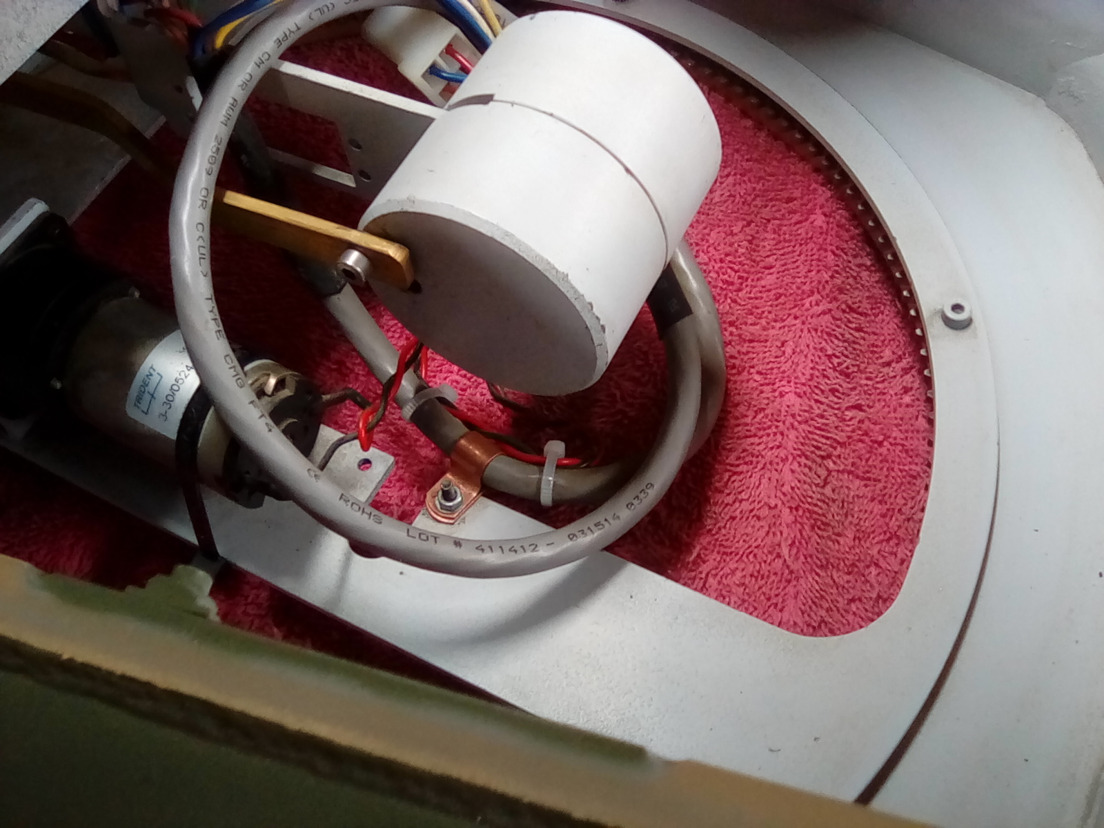

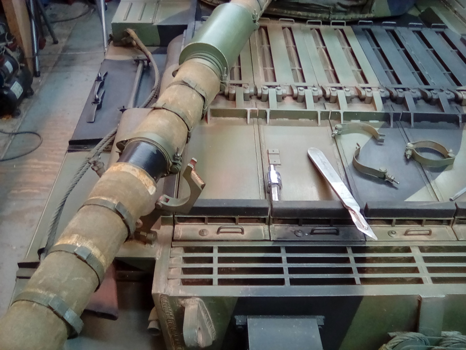

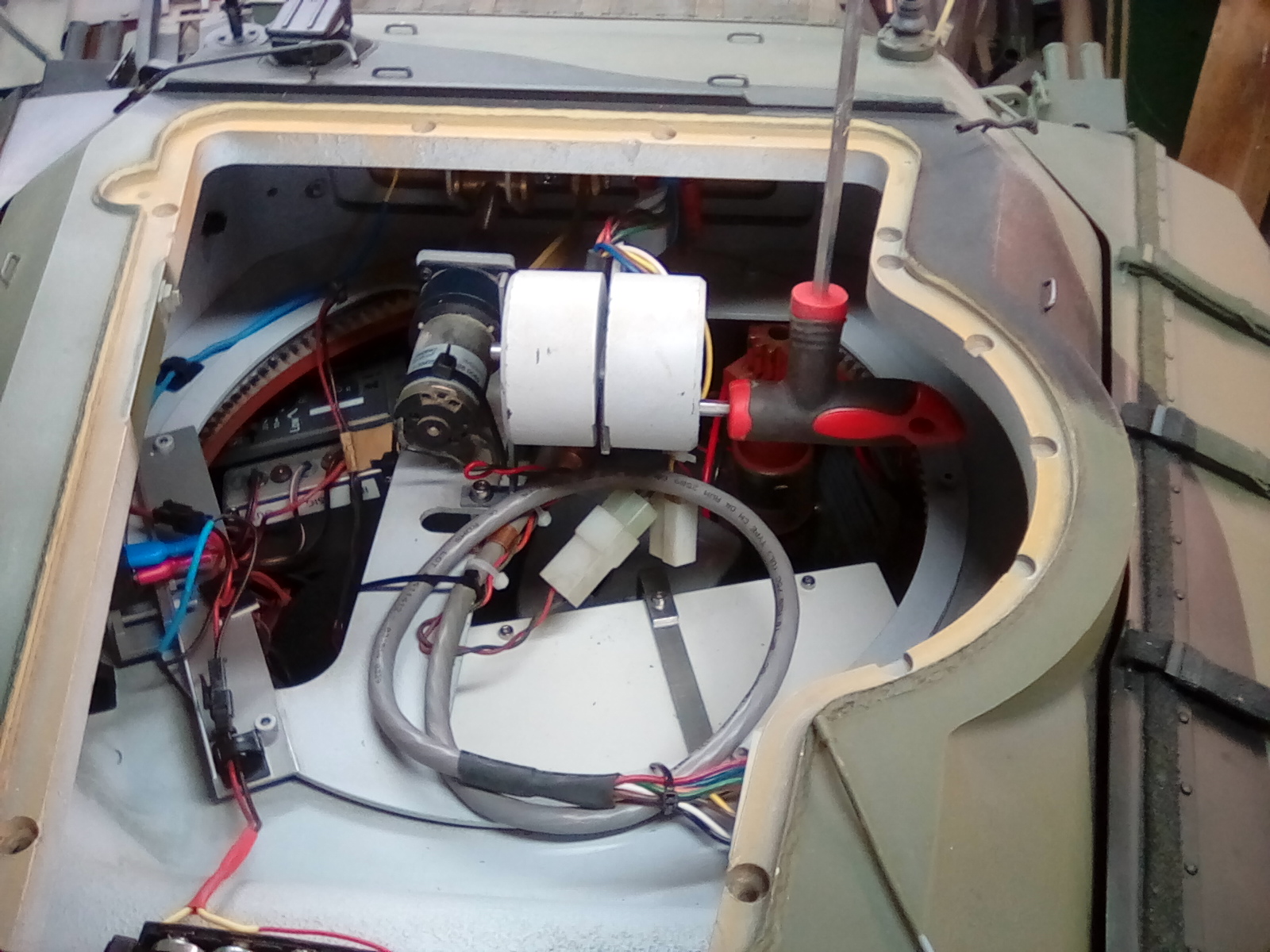

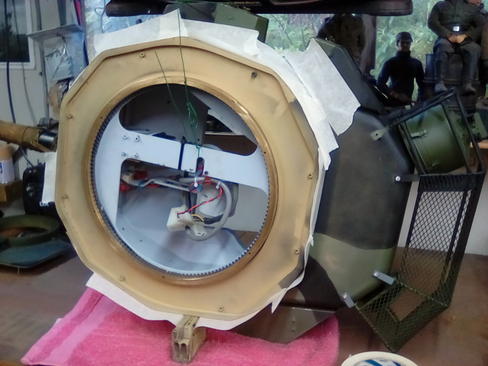

Resting the turret on the rear deck

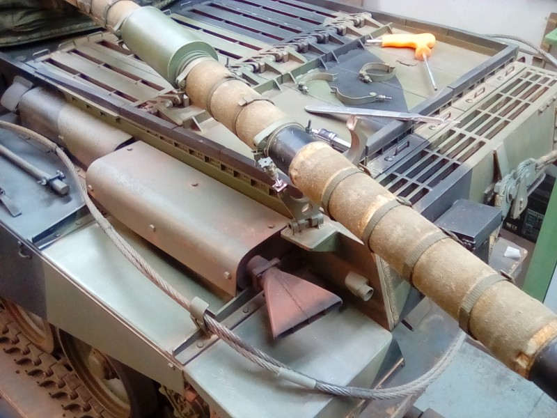

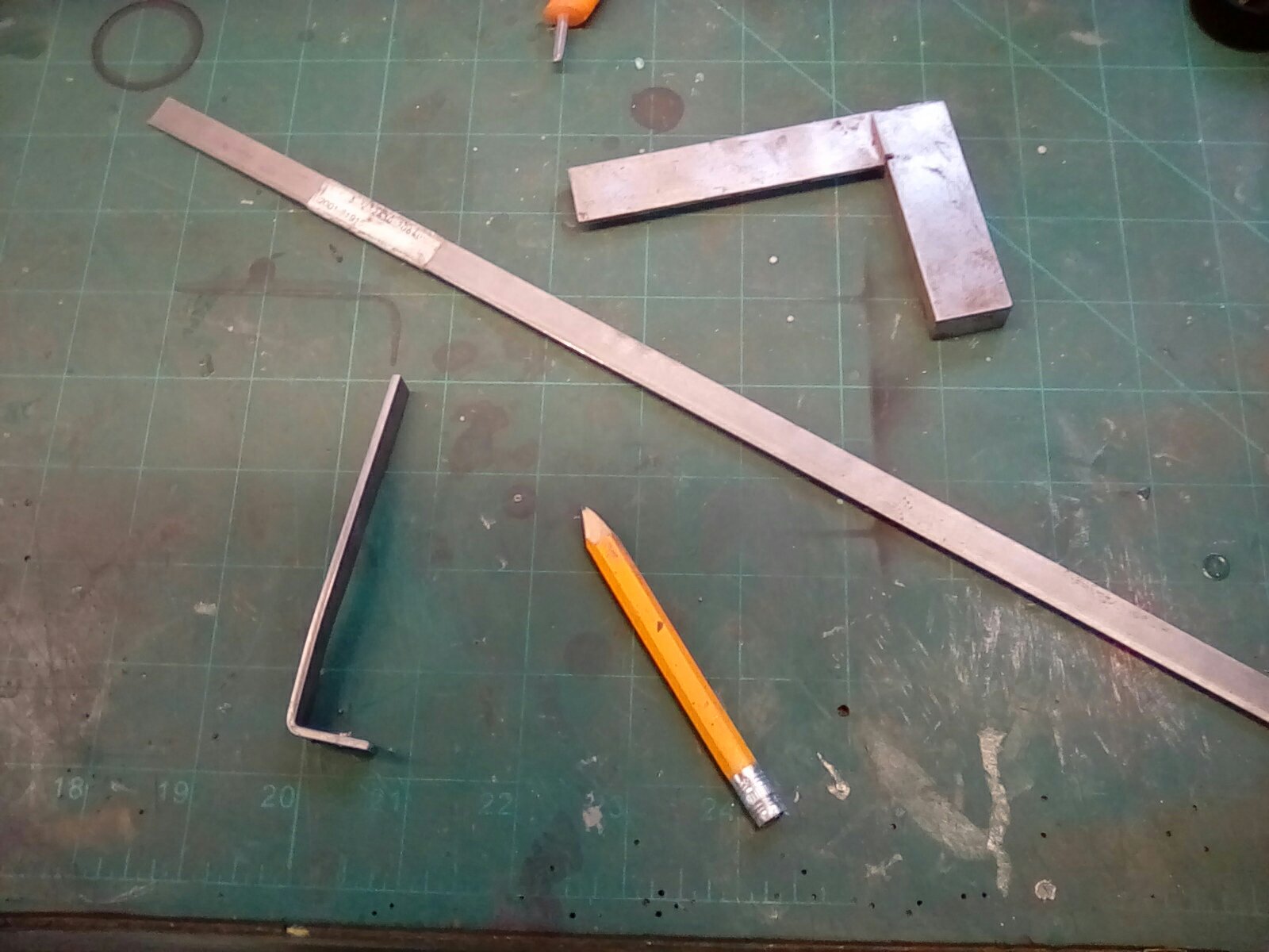

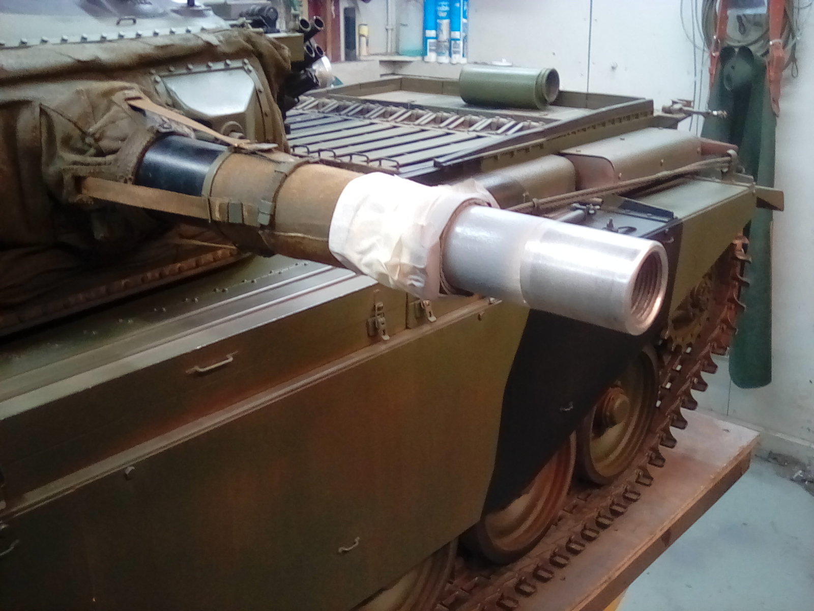

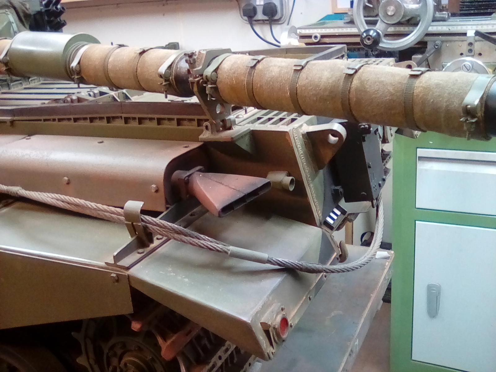

Barrel bracket
Barrel bracket
I shall fix a bracket to the counter weight

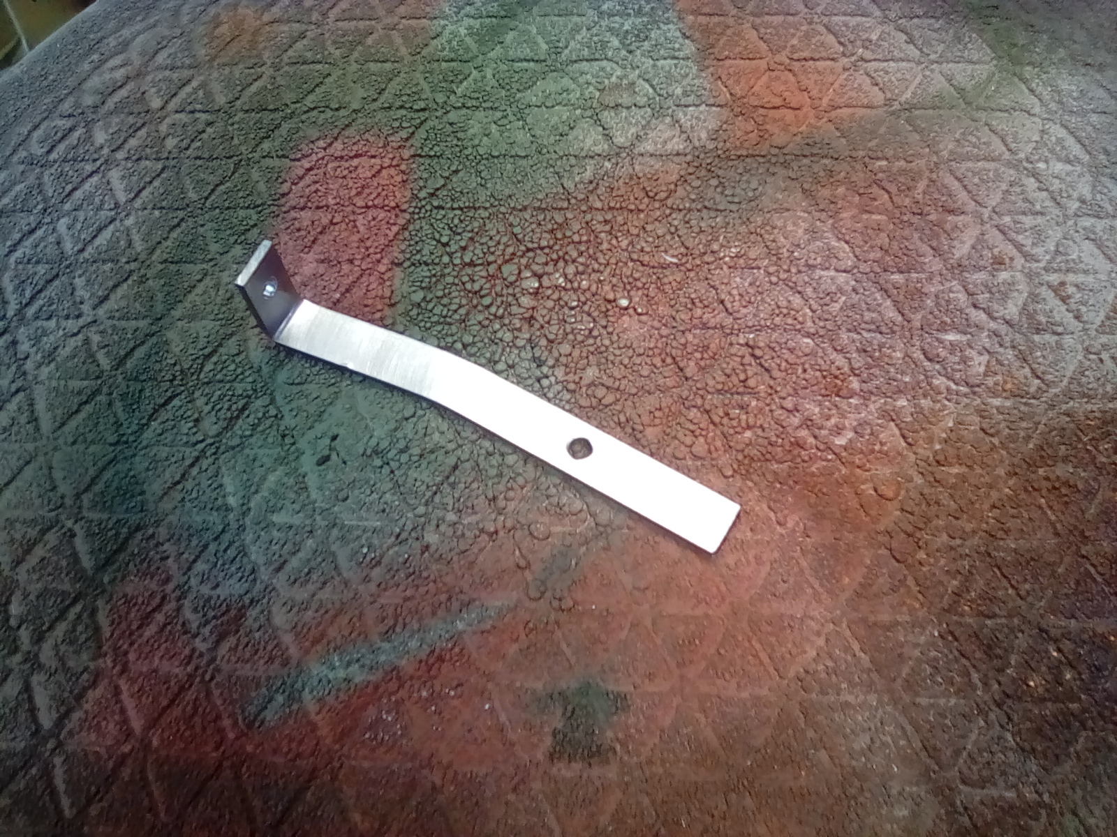

Nice simple barrel retaining bracket in steel

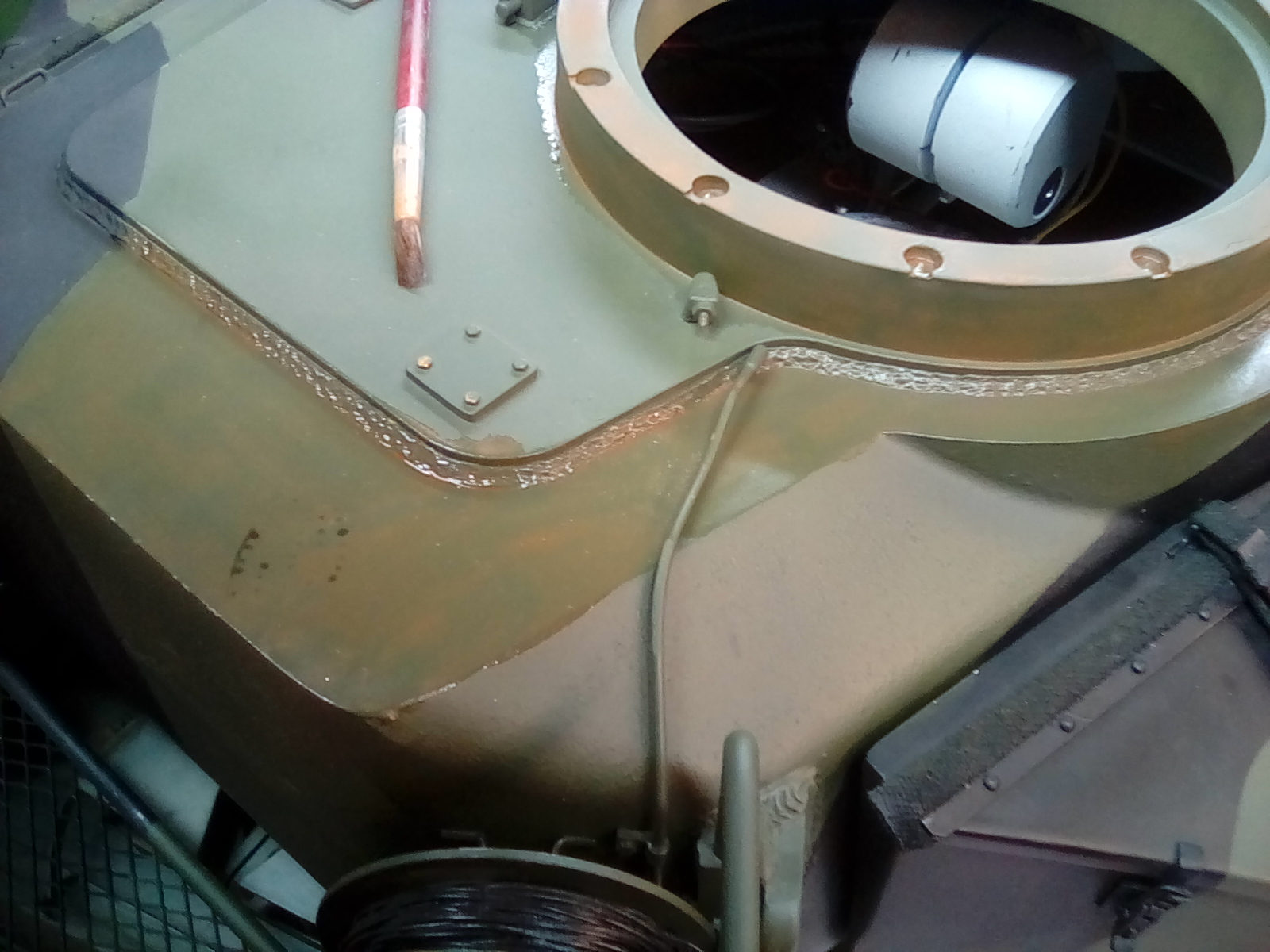

This area needs addressing
Counter sinking the fixings as the bolts may catch the open drivers hatches

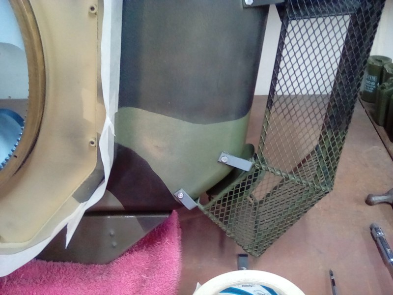

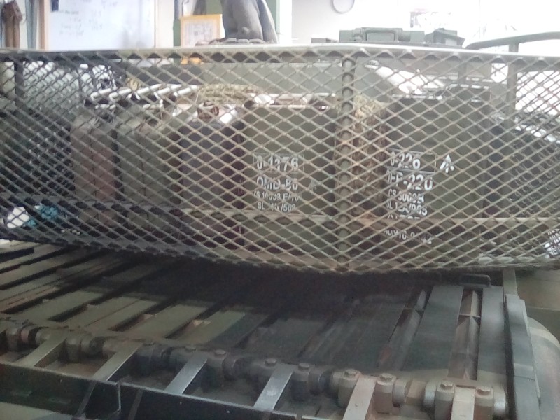

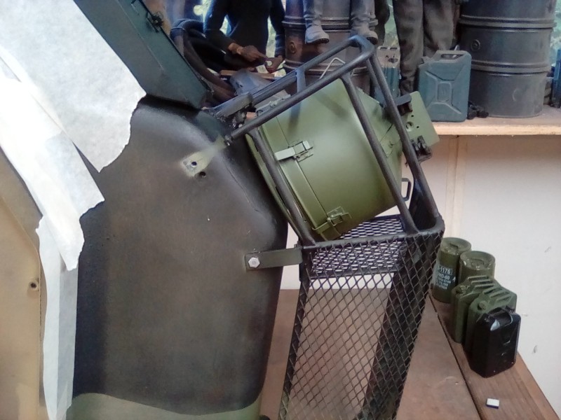

These basket brackets are lower than I would like them to be but they are very robust

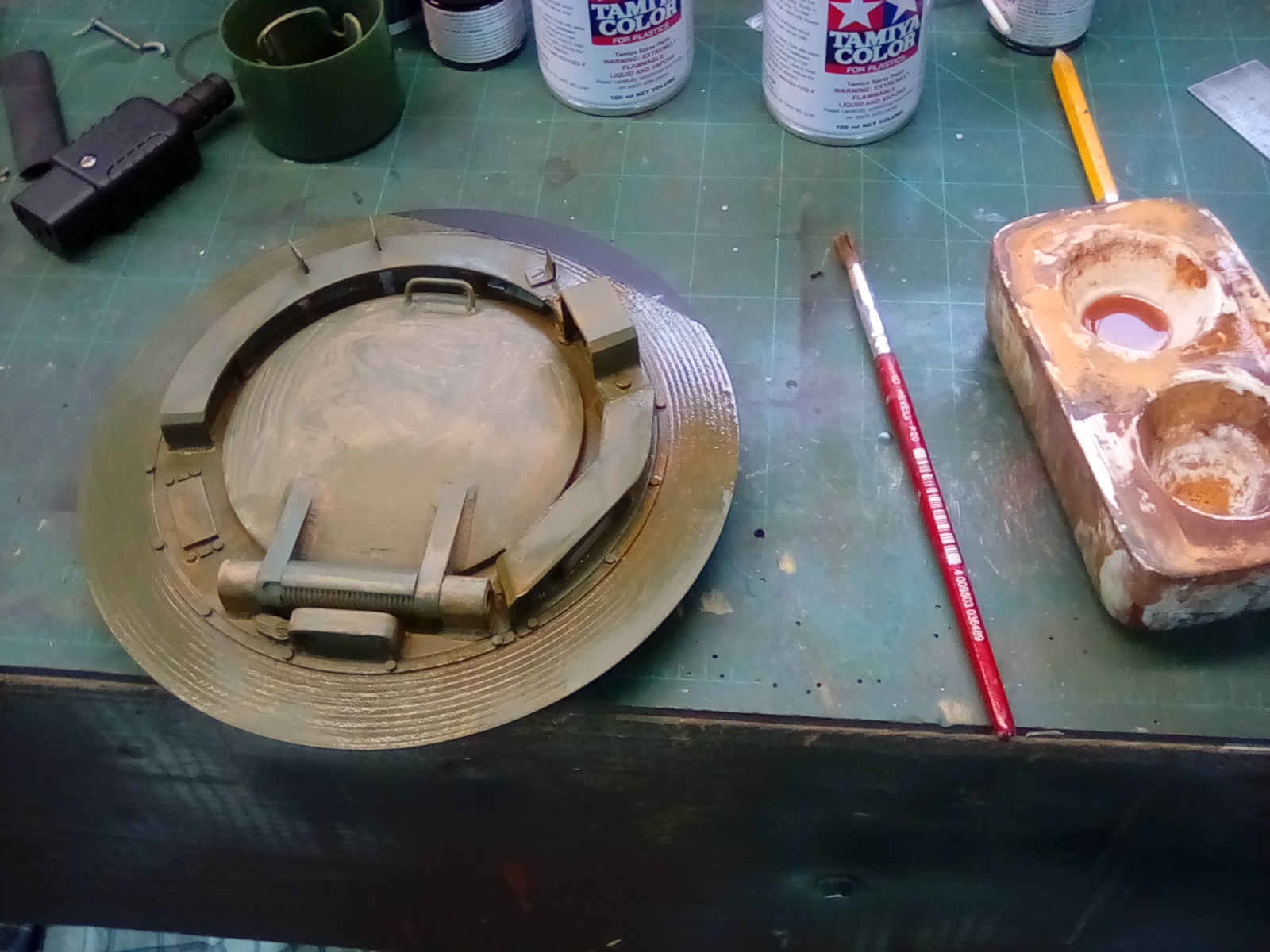

Primer of course
Primer of course
Top coat on the bottom

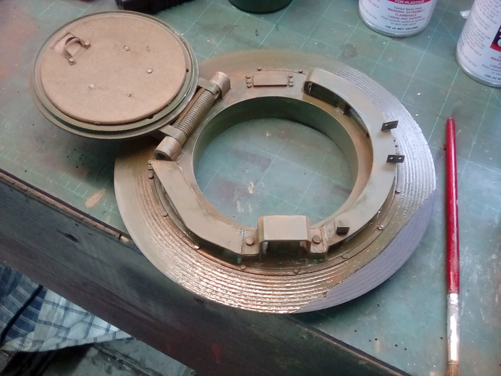

Yet another coat of paint on the reworked hatches

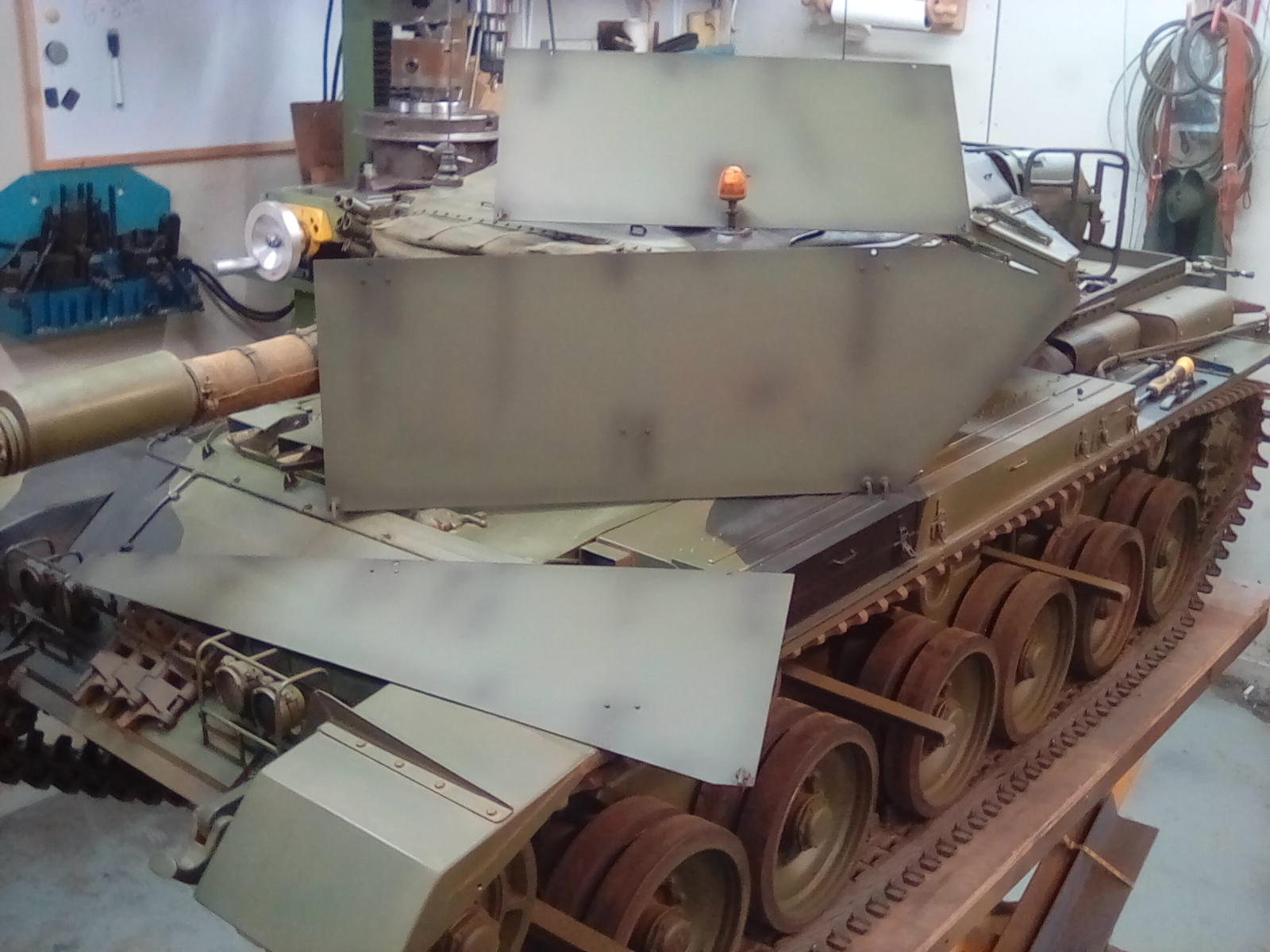

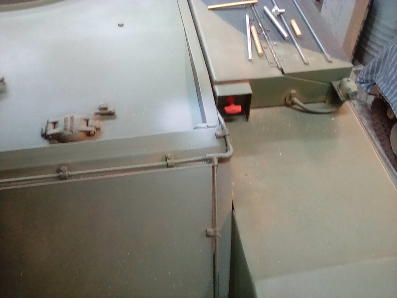

Last bit of deck weathering rubbed back before the turret is fitted

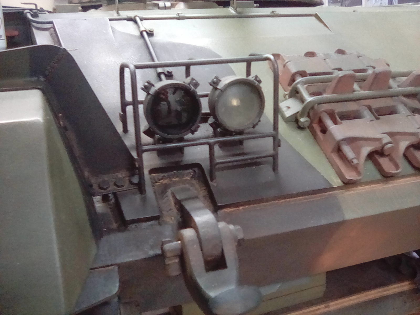

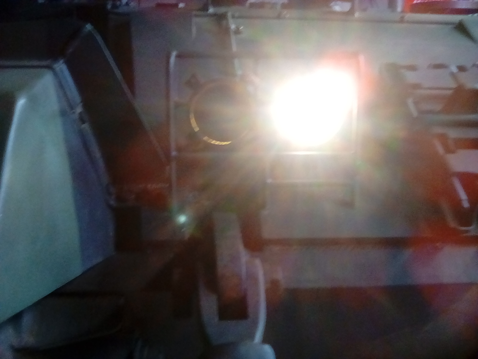

IR lamps blacked out with just a chink of light showing for a bit of theatre
Dark shades for the underside of the turret
How crappy in there !

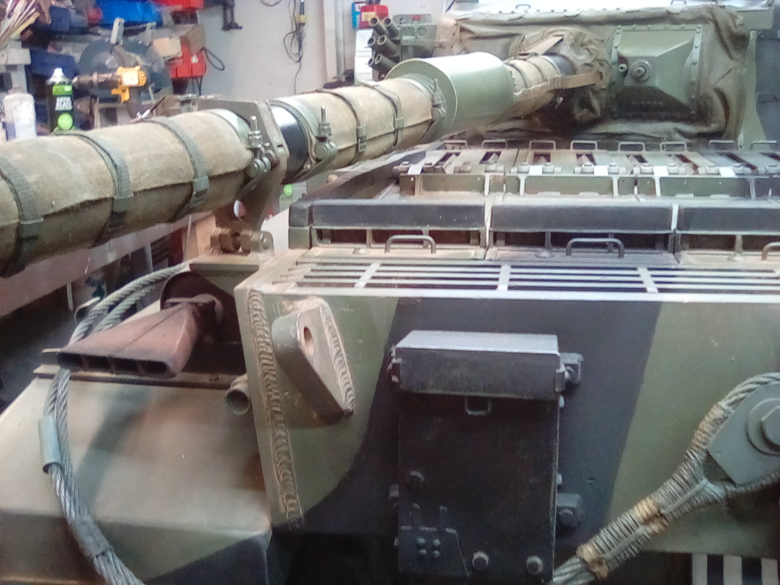

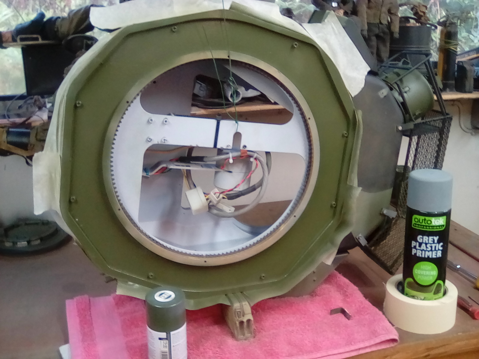

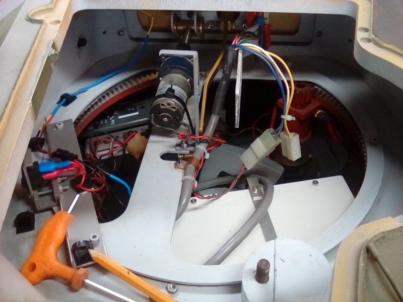

Some adjustments needed to get the crutch to line up
Getting there
Getting there

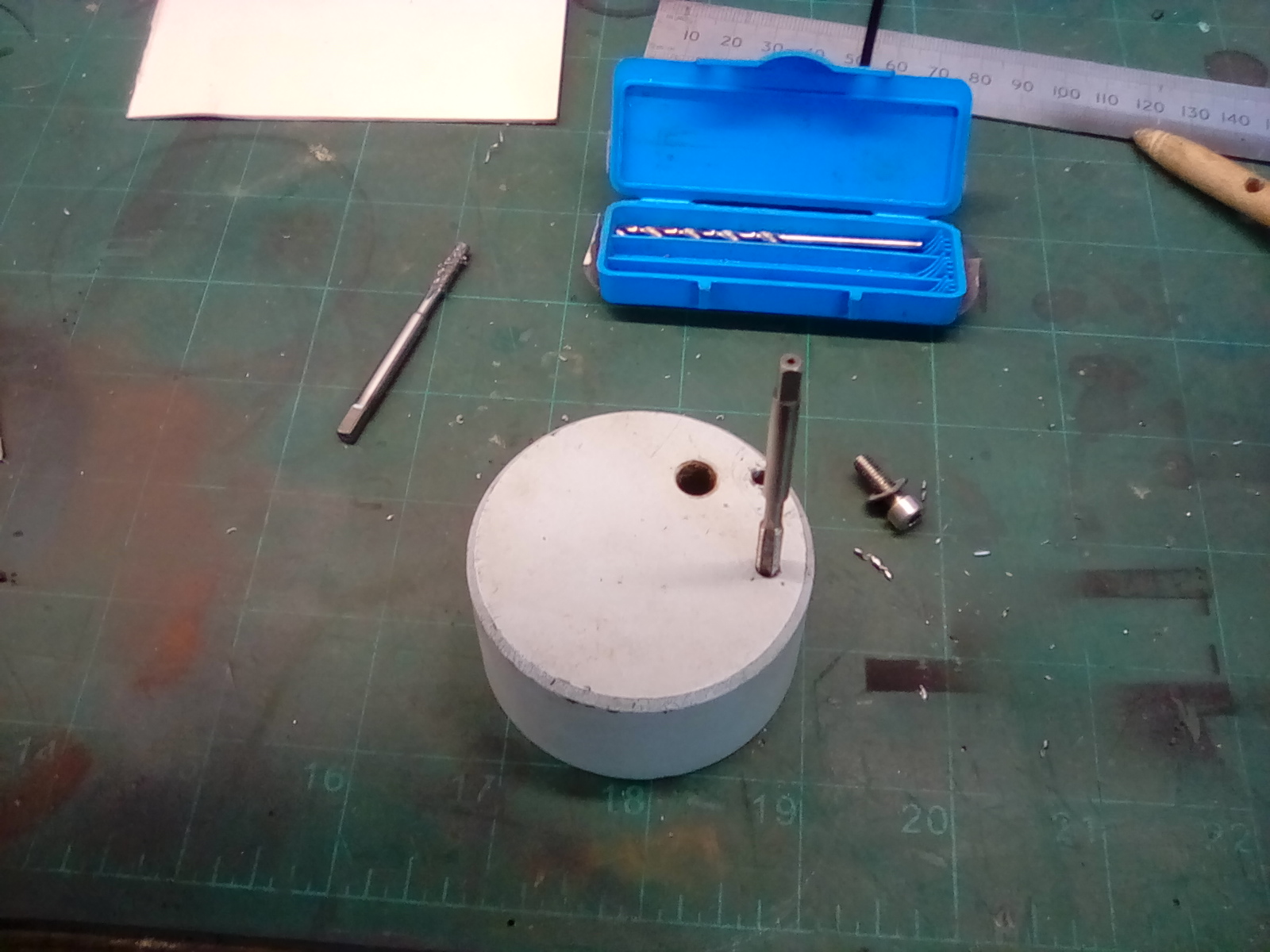

Another m4 tapped hole required
Adjustment time as the barrel must be able to be crutched, don't know if that is even a word.
Although it's a big kit it's still tight with both your hands in there but the bracket is now fully home and tight
Tidying up this end
Tidying up this end
Tidying up the reveal
That's a relief to get that little job done and it's totally functional

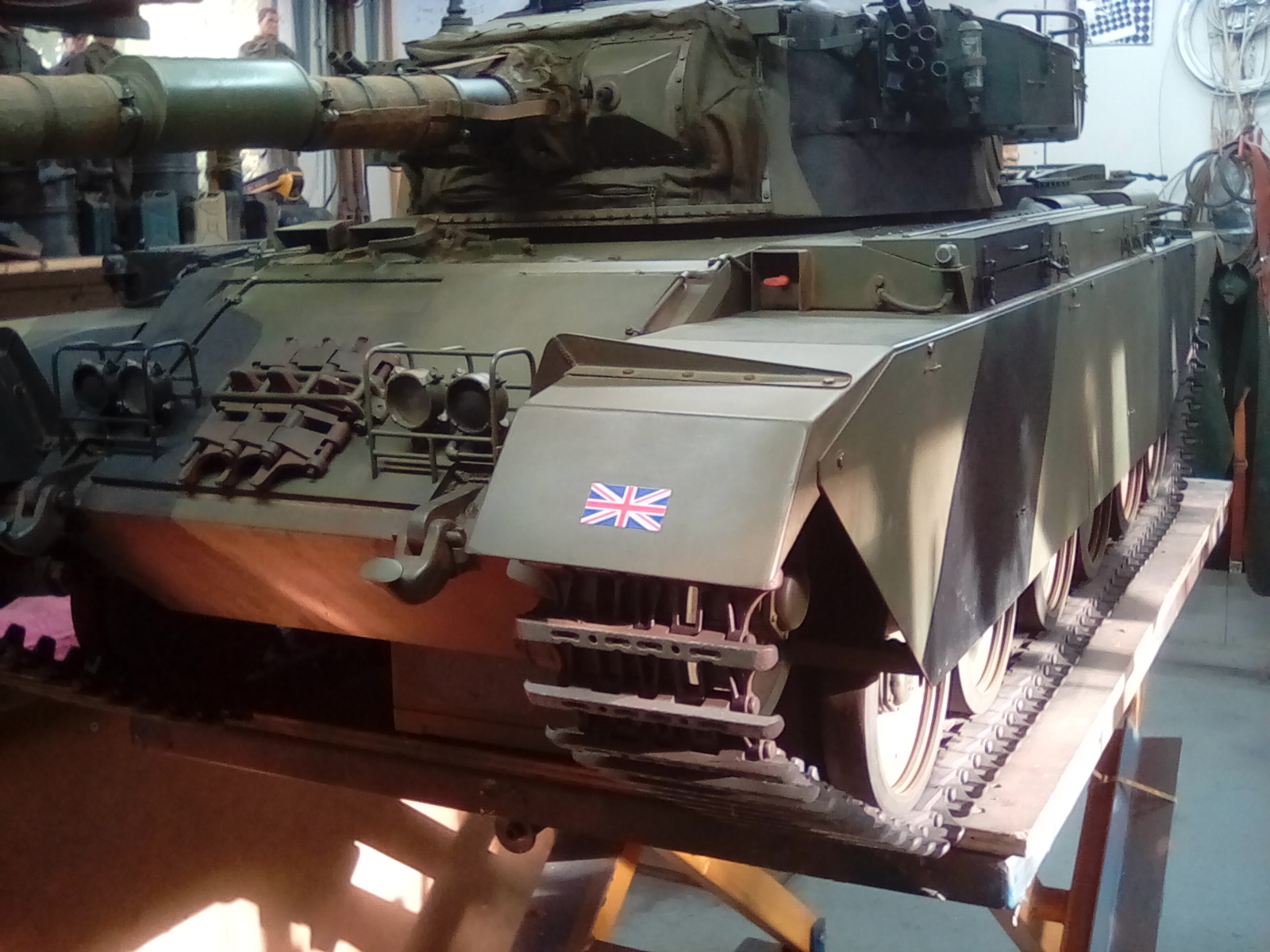

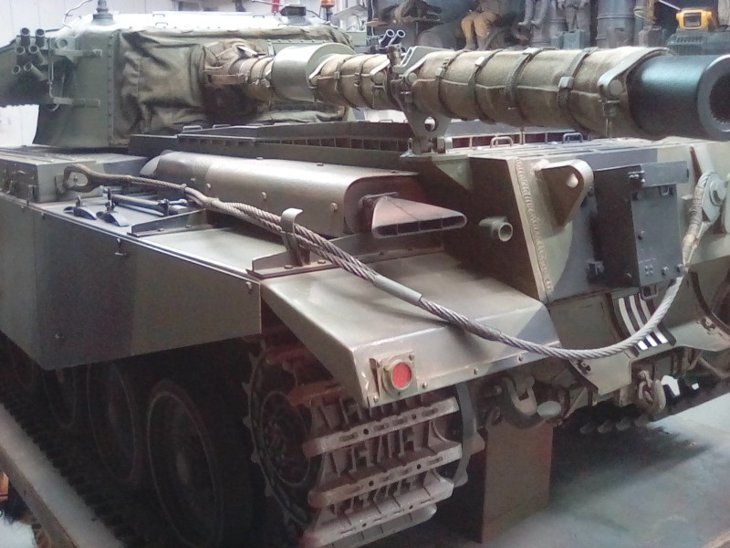

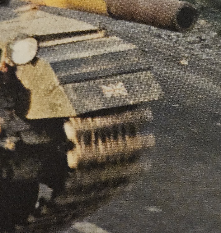

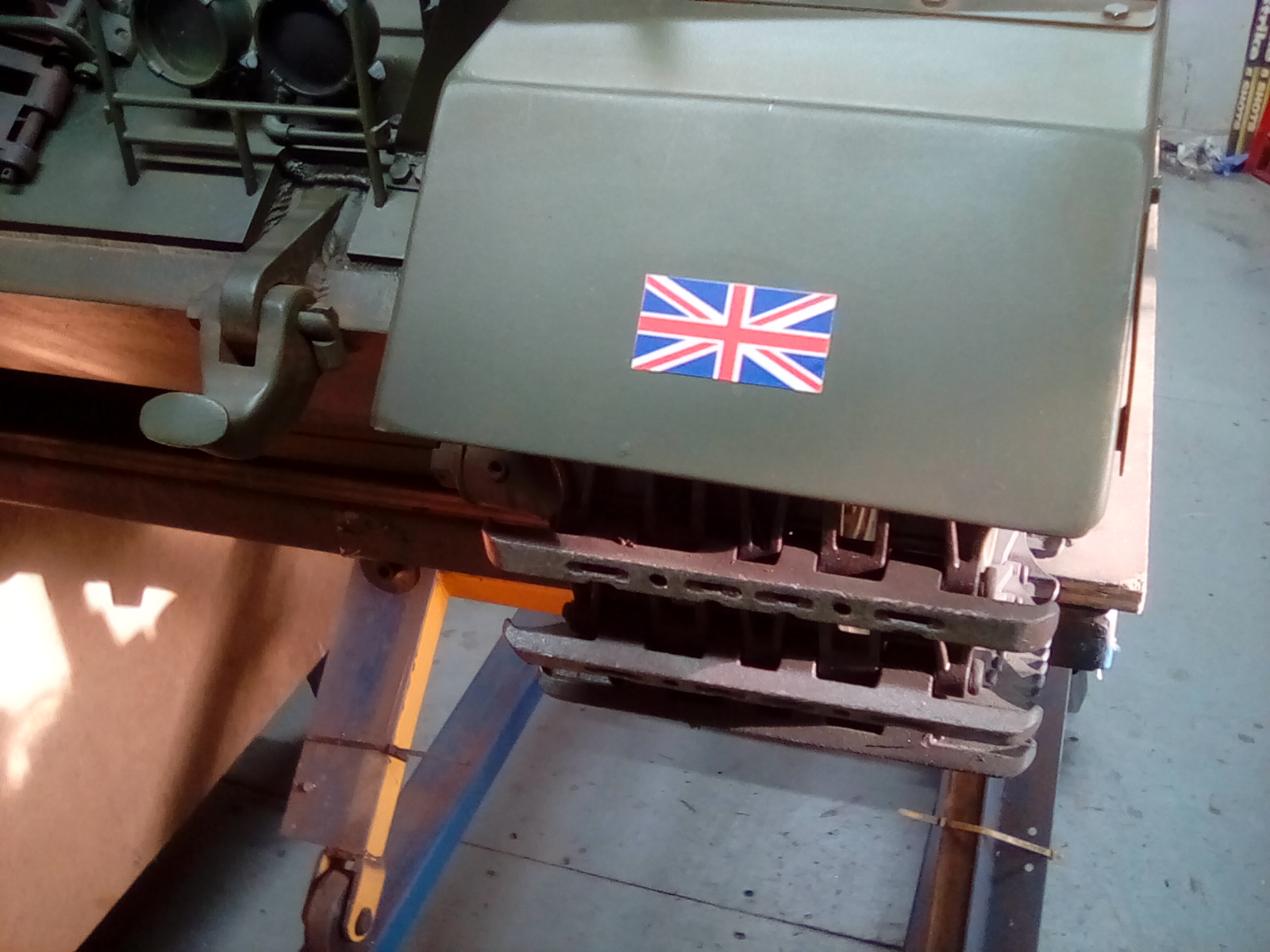

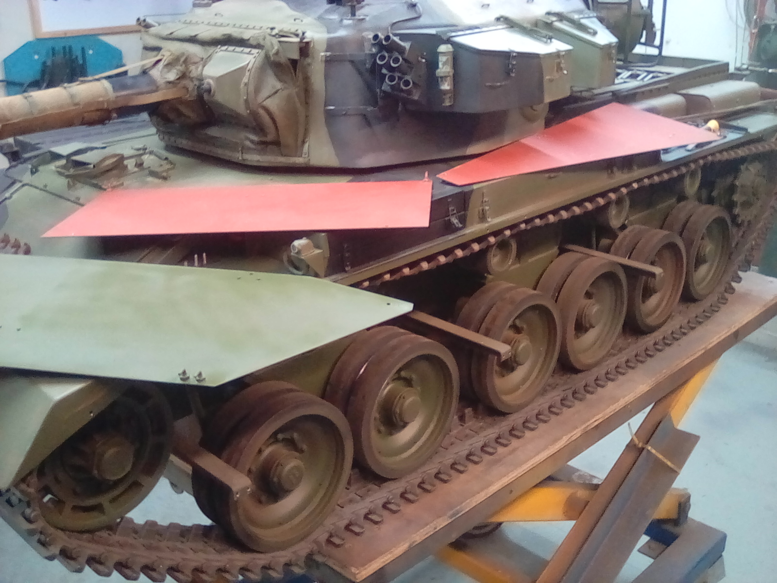

Phil, what size union jack do we need for the front mudguard?
Re: Mr Dawe's Centurion.
We will first need a reference photo to scale it from
Kevin Hunter
Posts: 564
Has liked: 605 times
Been liked: 147 times
Post by Kevin Hunter »
The Union Flags weren’t exactly overt……
(Photo credit : Tankograd - British Special 9003 “ Vehicles Of BAOR 1945-1979”)
Kevin
Thanks Kevin, it's going to be quite small. I wonder if anyone still stocks our Union flag as it may upset some no doubt!
Those photos show the level of weathering I like on a Cent.
I'm really looking forward to adding some environment to the running gear area.

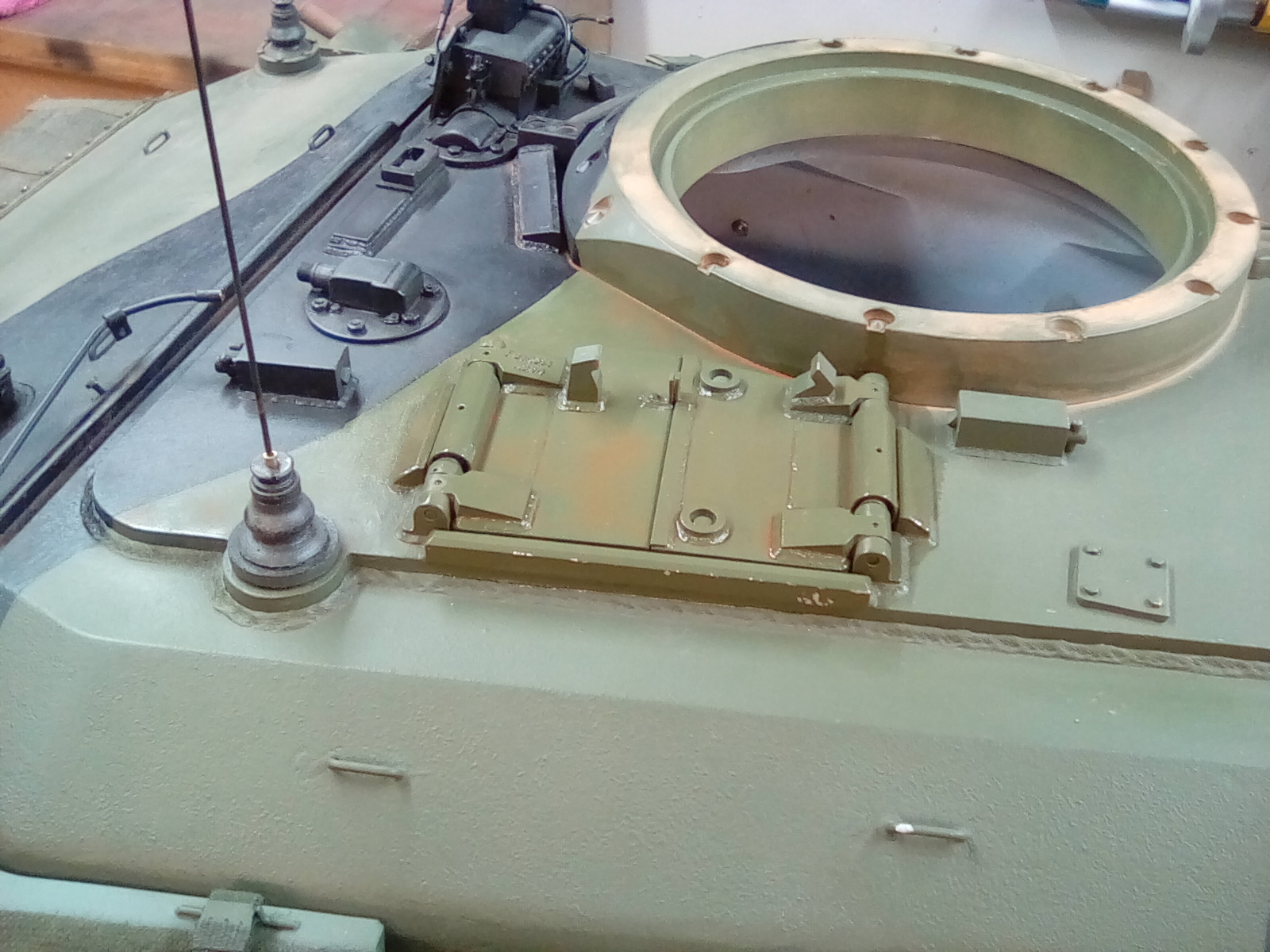

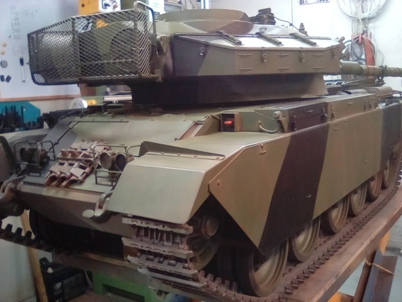

The weathering top side is just about done although I shall fiddle with it untill it leaves me

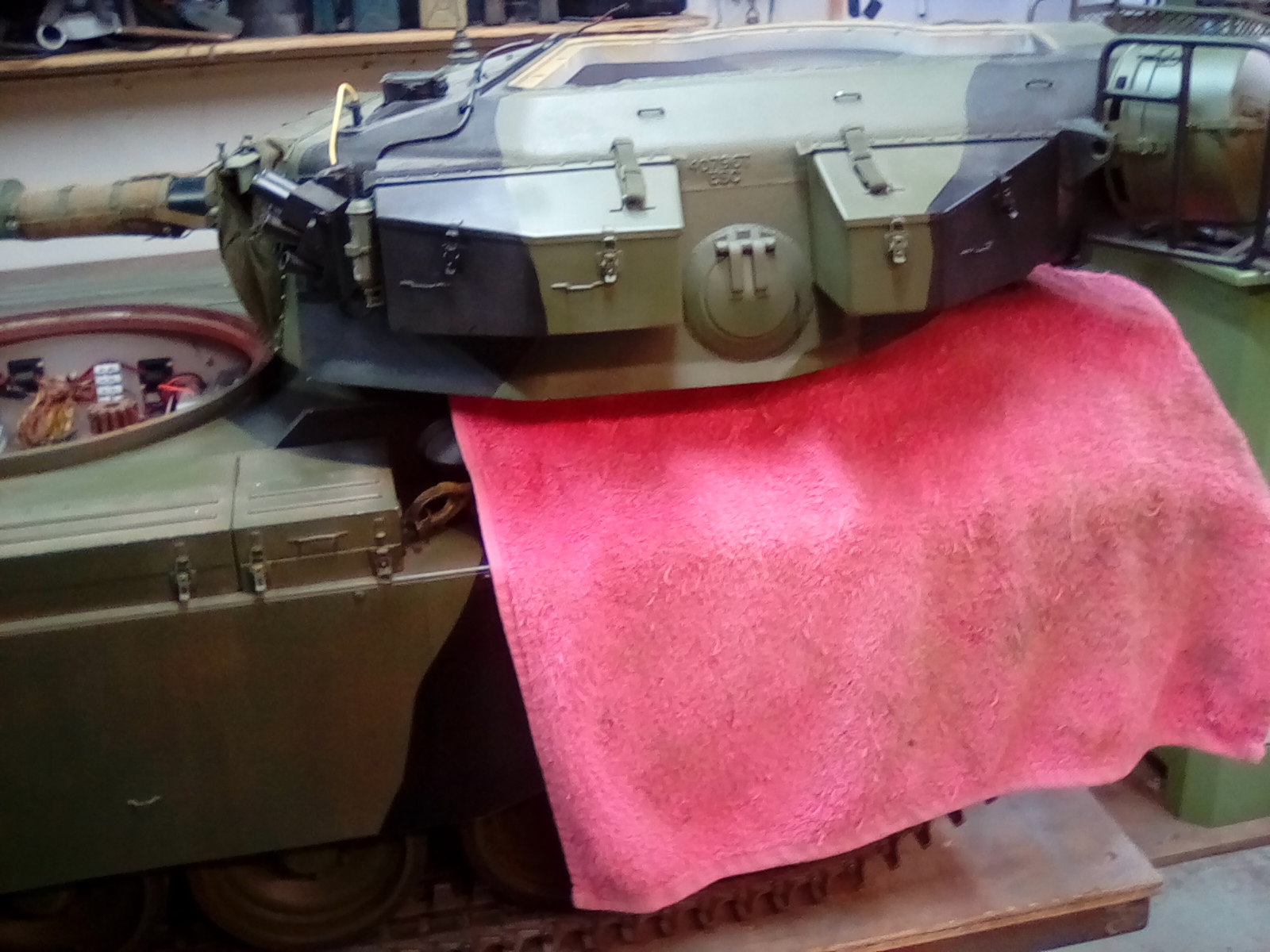

The turrets turn now

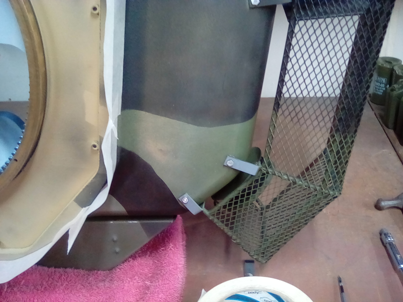

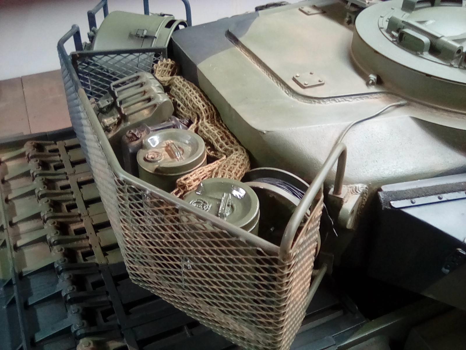

Even the turret basket gets weathered
A DMS boot mark here and there
I'm keeping the light fairly clean in contrast

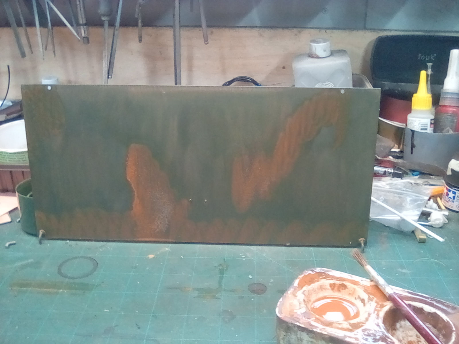

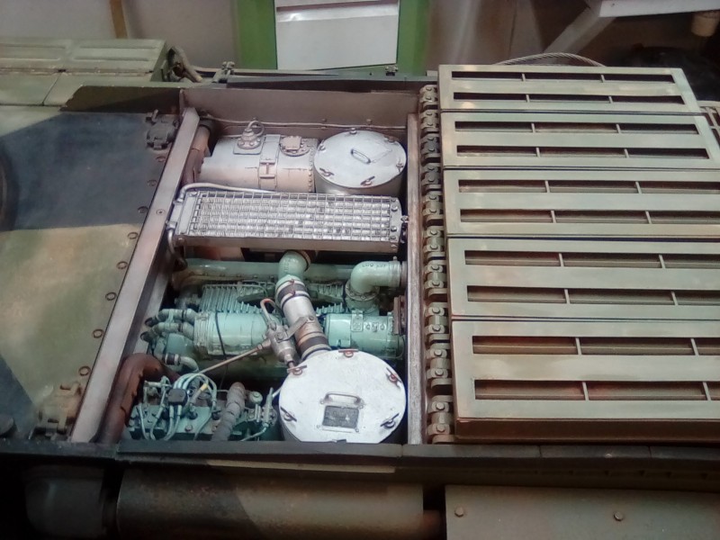

Same process
Same process

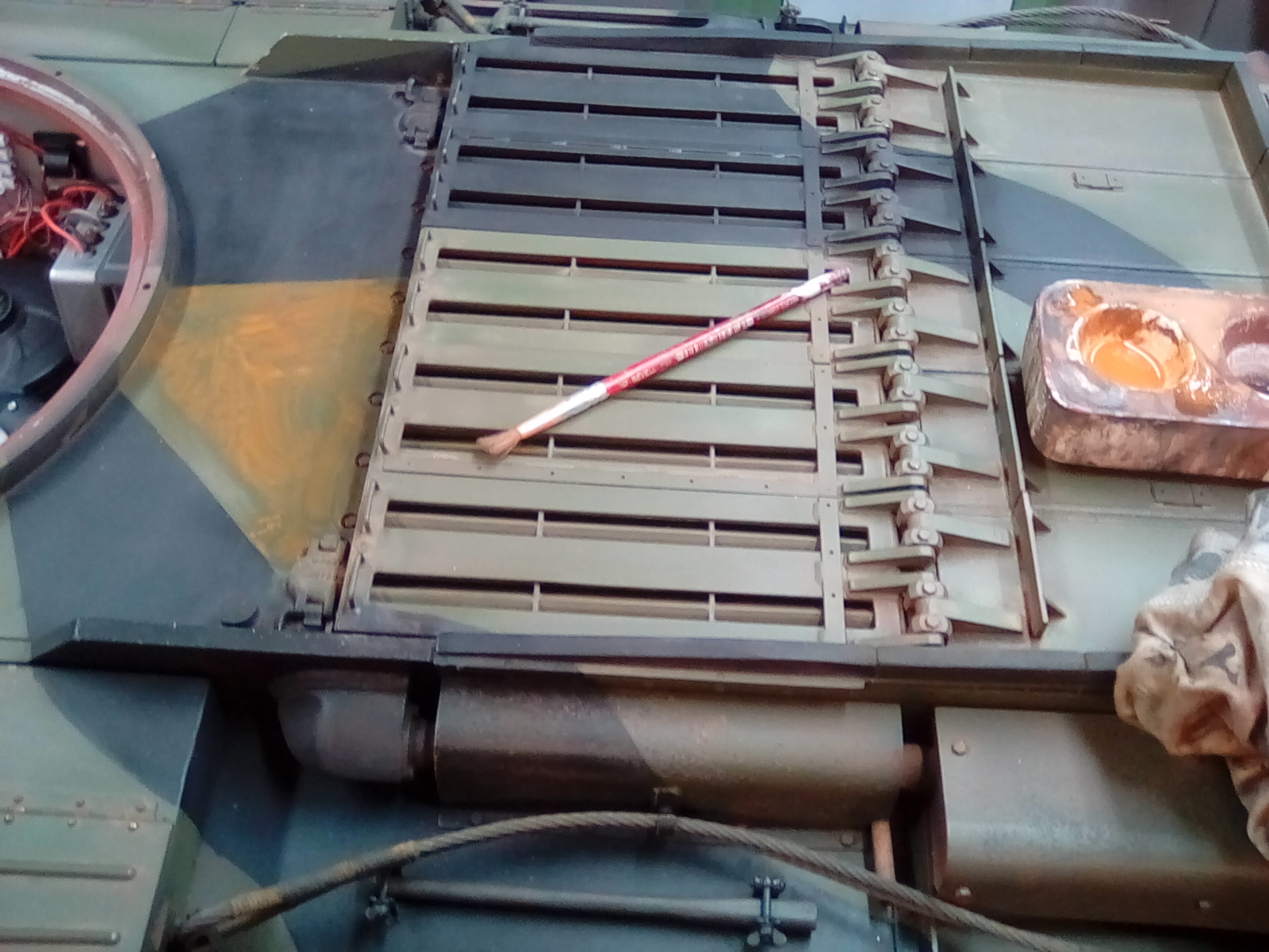

One of the drums will be like new
Cleaning back ready to make the area dirty again

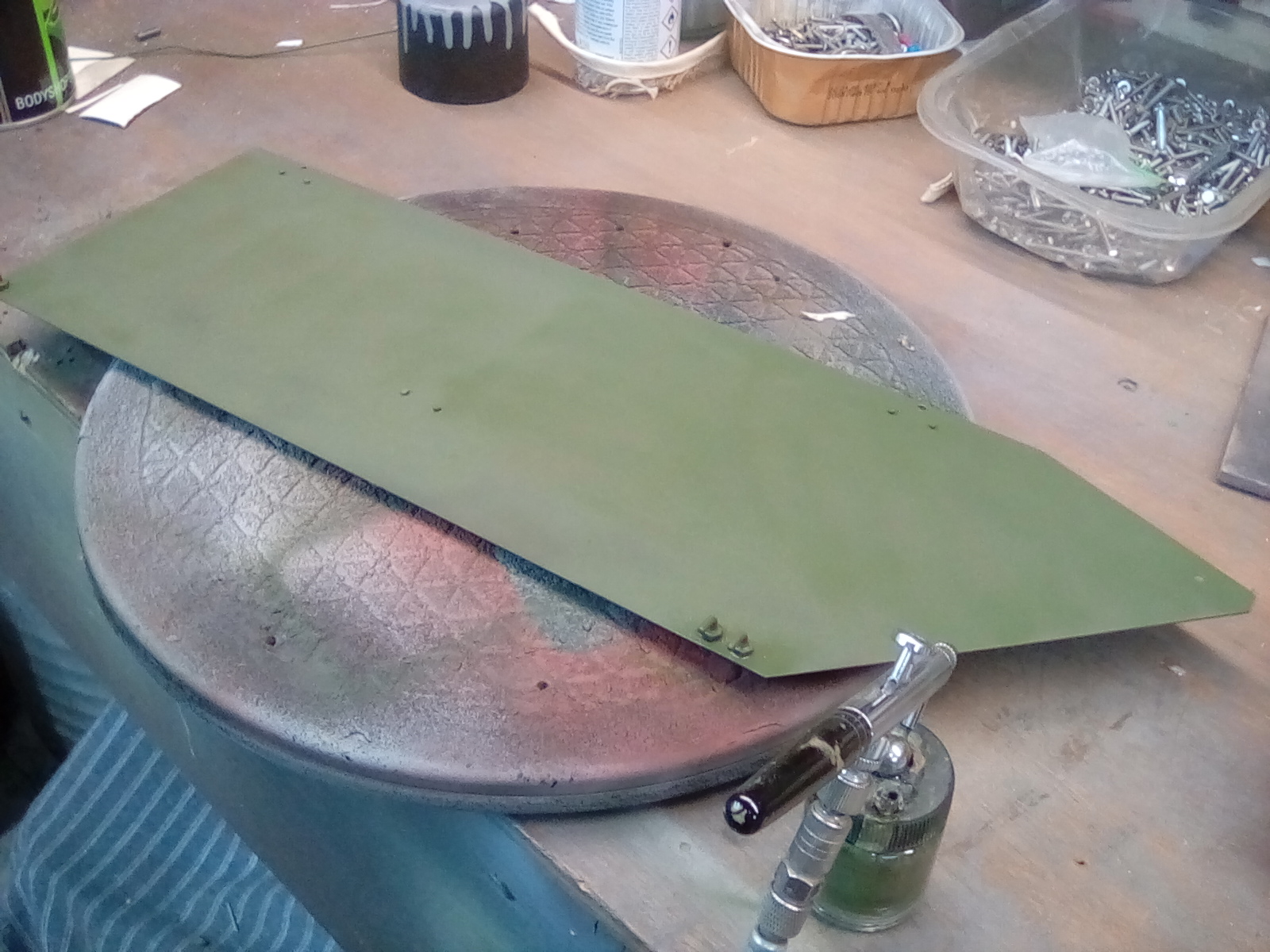

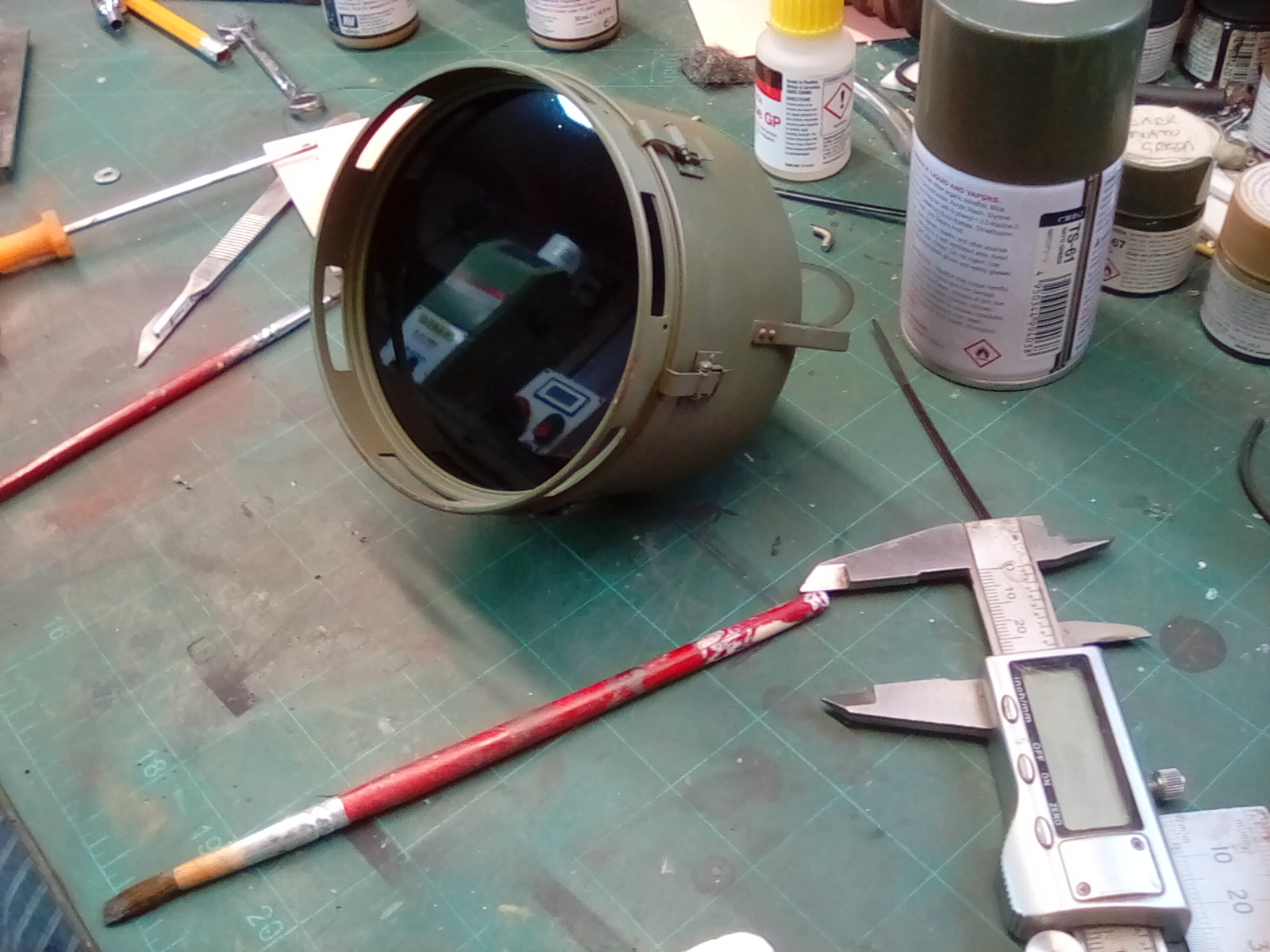

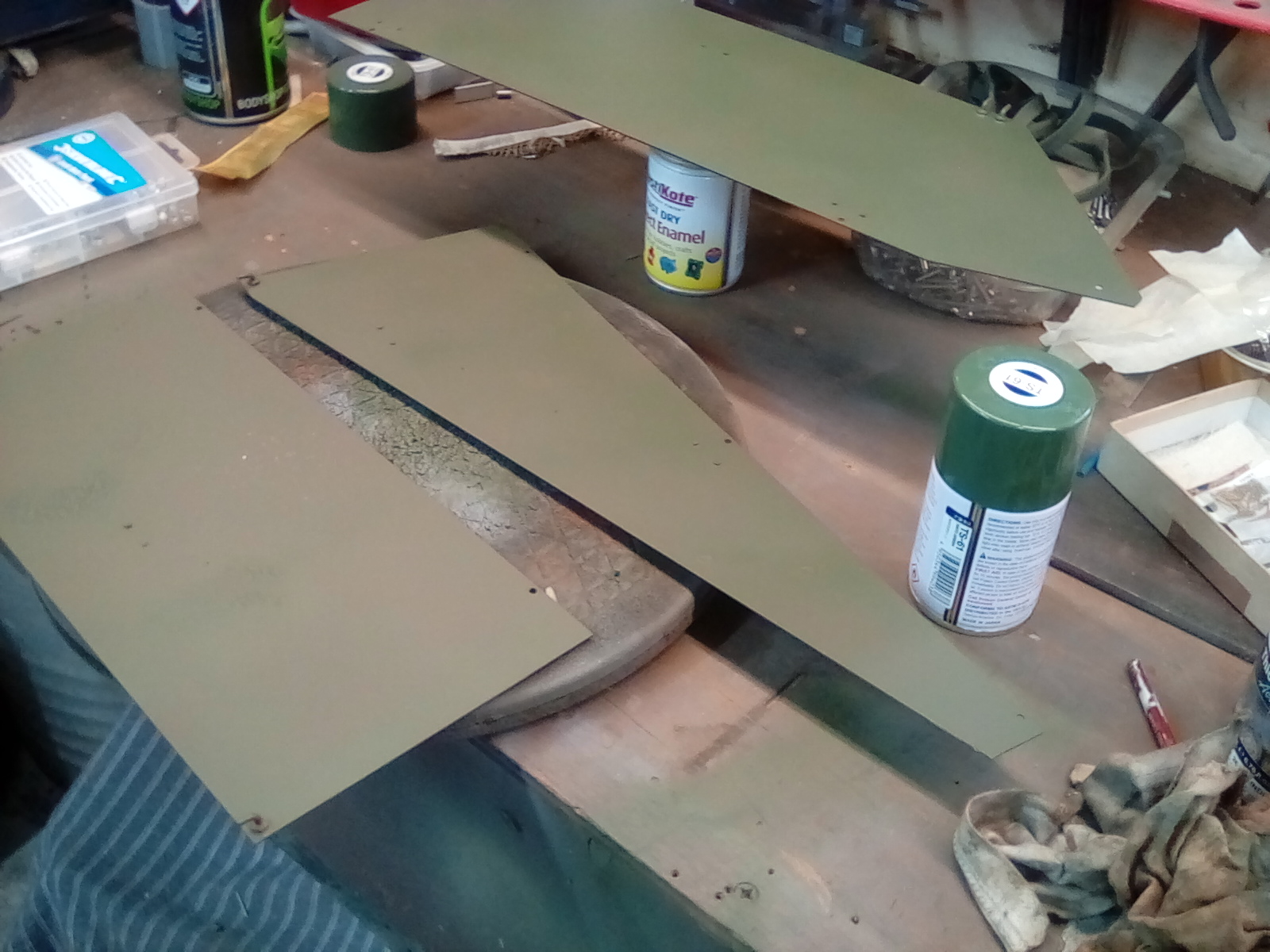

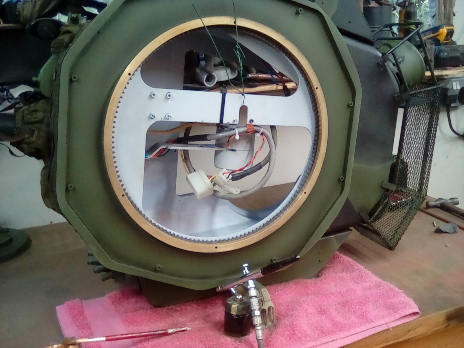

Only one part can of NATO green left so I shall paint the inside this way, they will be fairly heavily mud spattered
I did think about leaving the inside of the bazooka plates red oxide

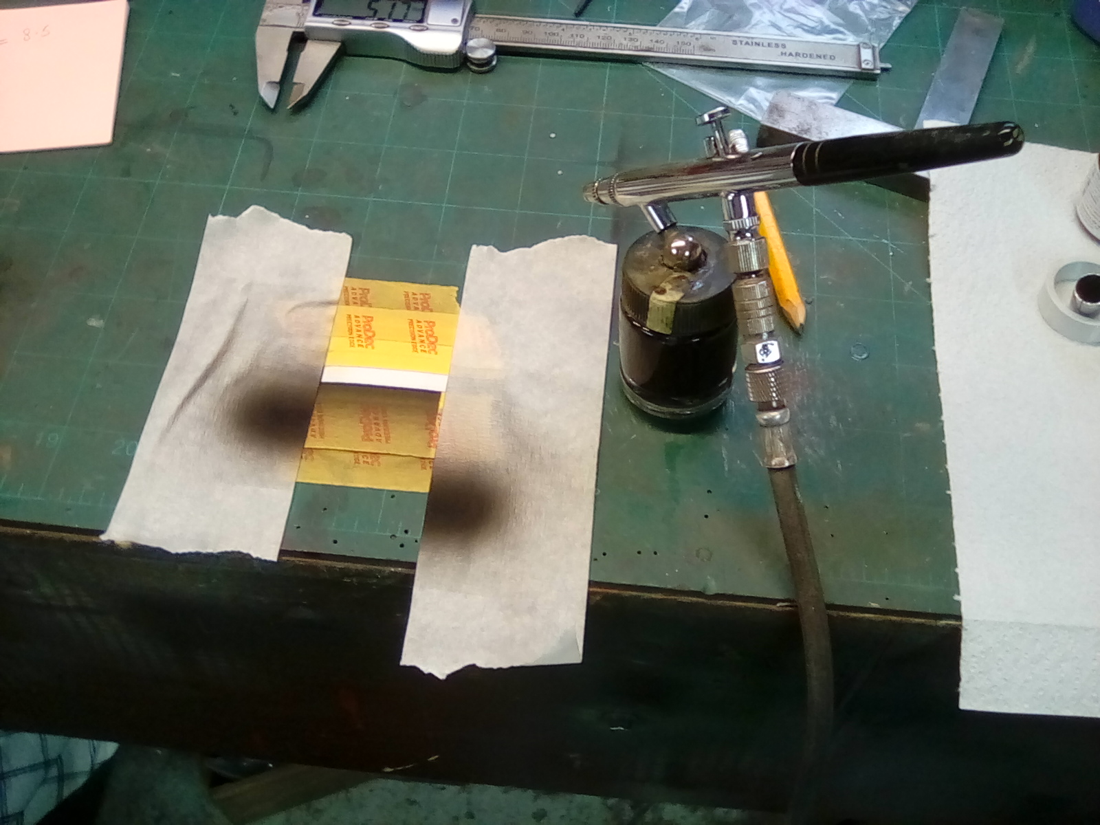

There's a lot of paint in the air so this photo is not so good

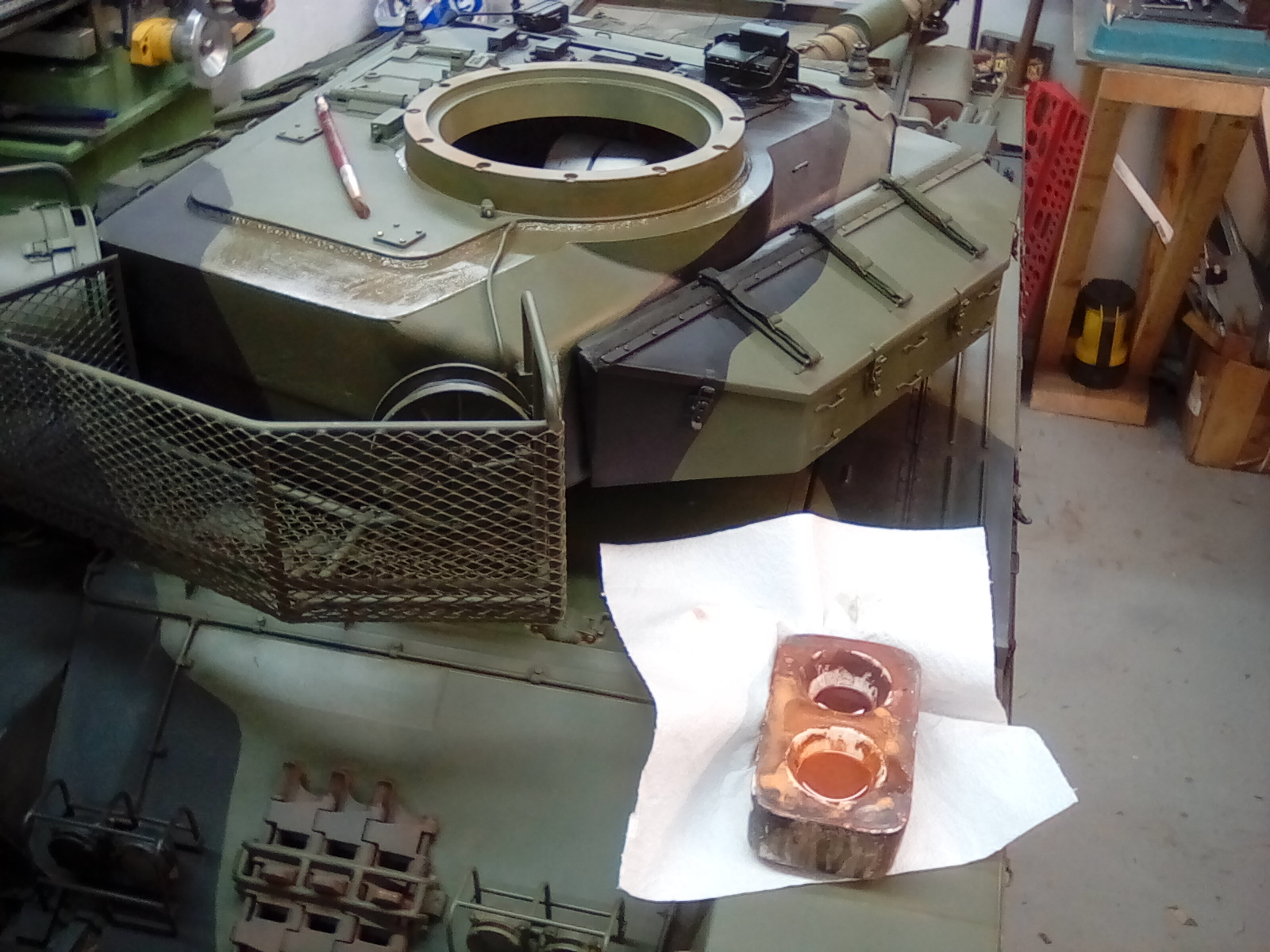

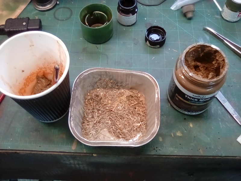

Mixing mud with chopped dead grass

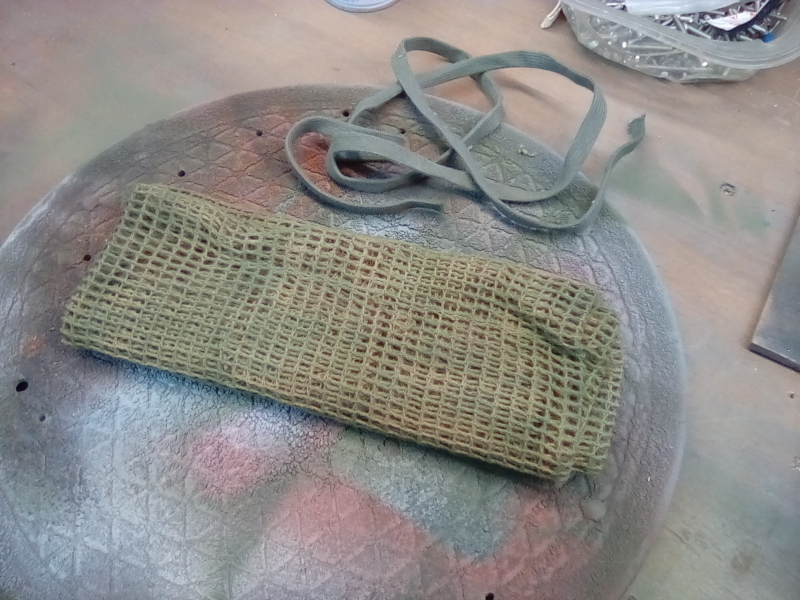

That scarf will require some thought before I'm happy

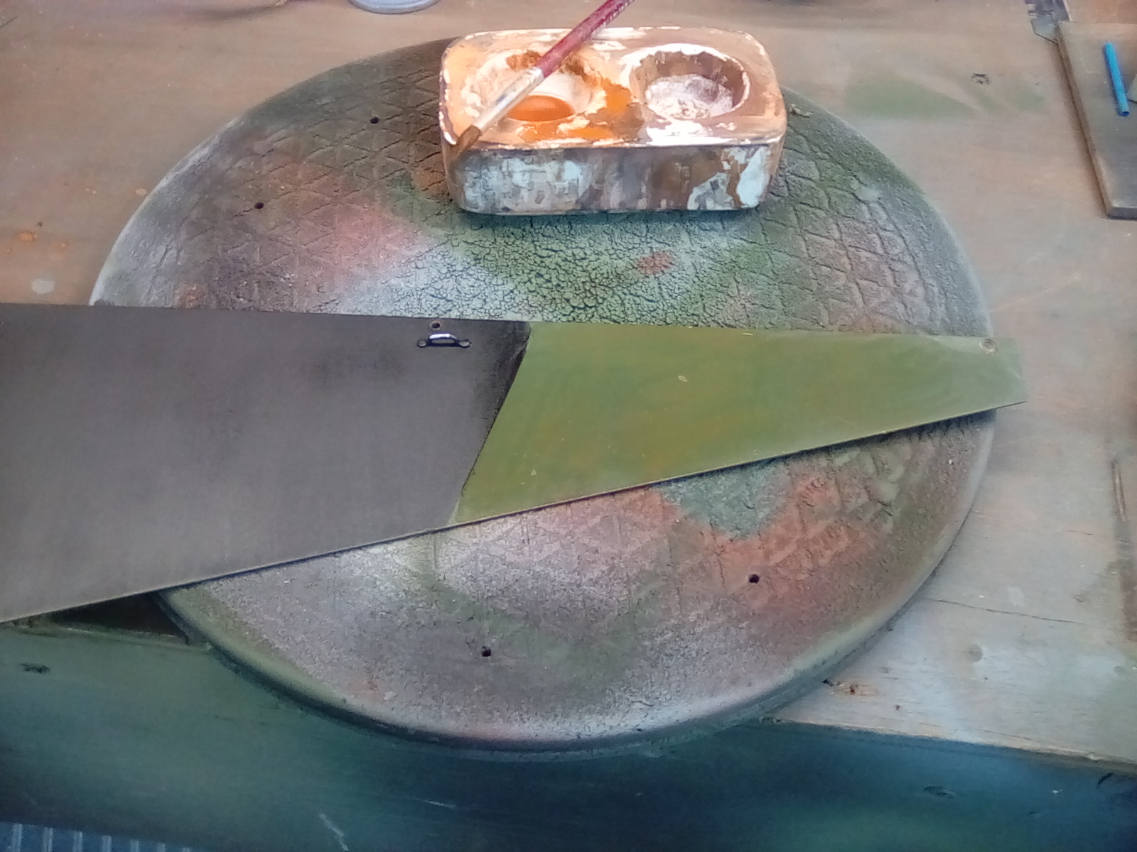

Sadly these are printed on paper and are not really of suitable quality as we have found out having bought a set. The photo Phil W has posted shows this.

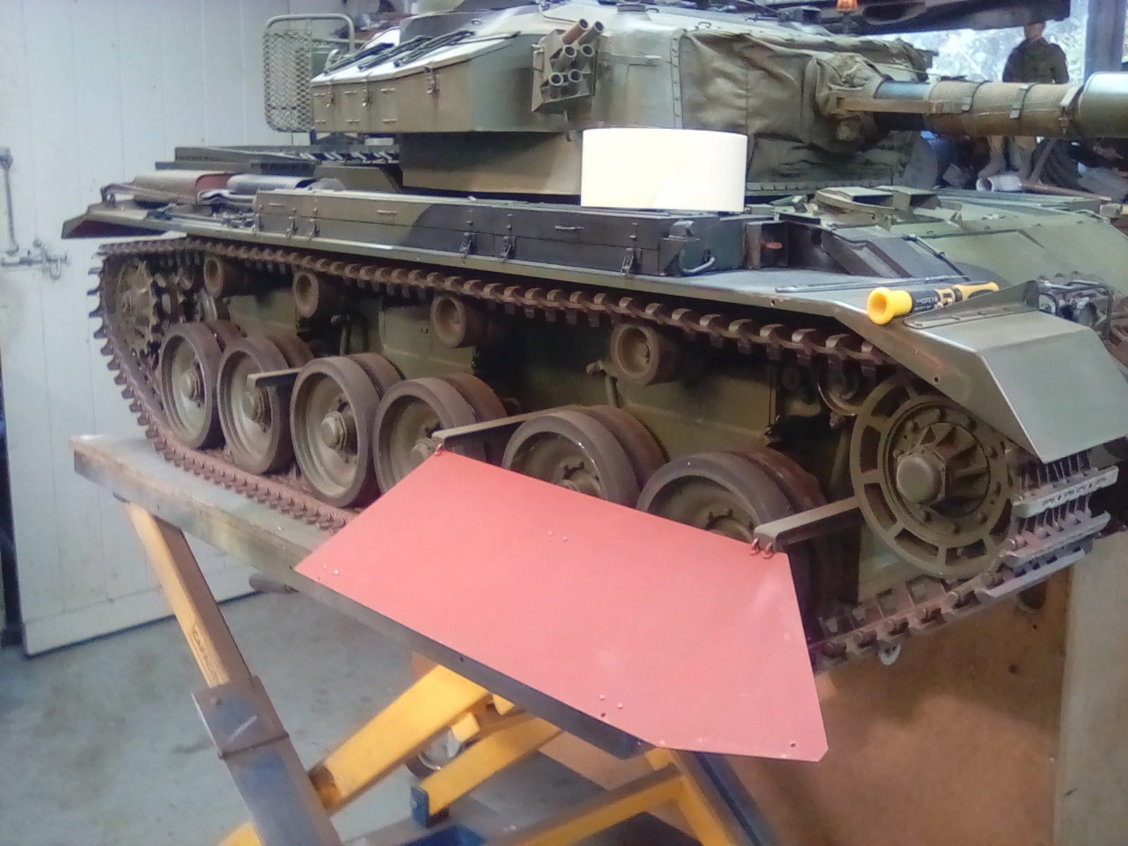

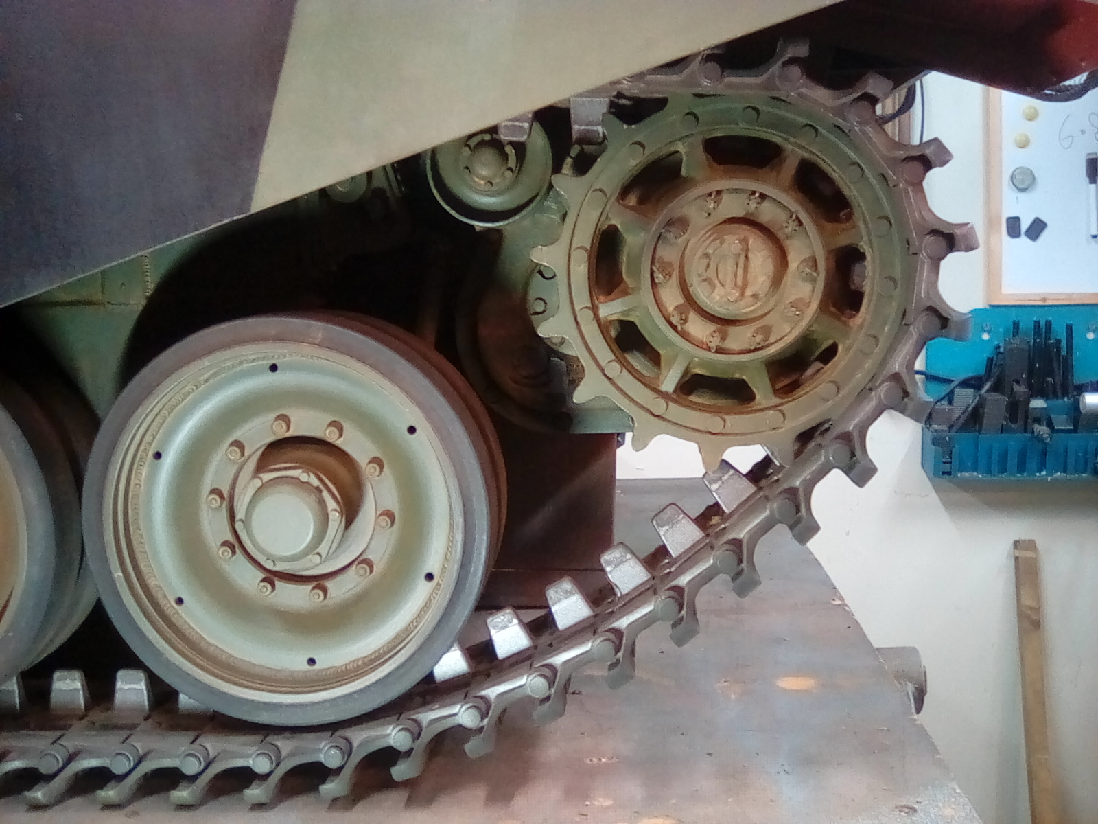

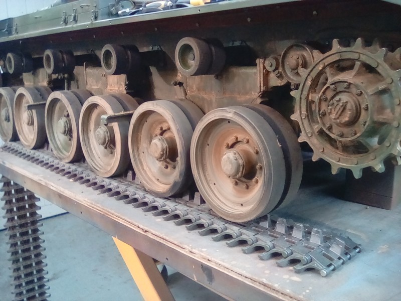

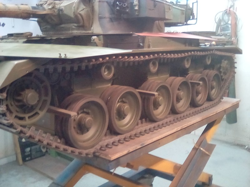

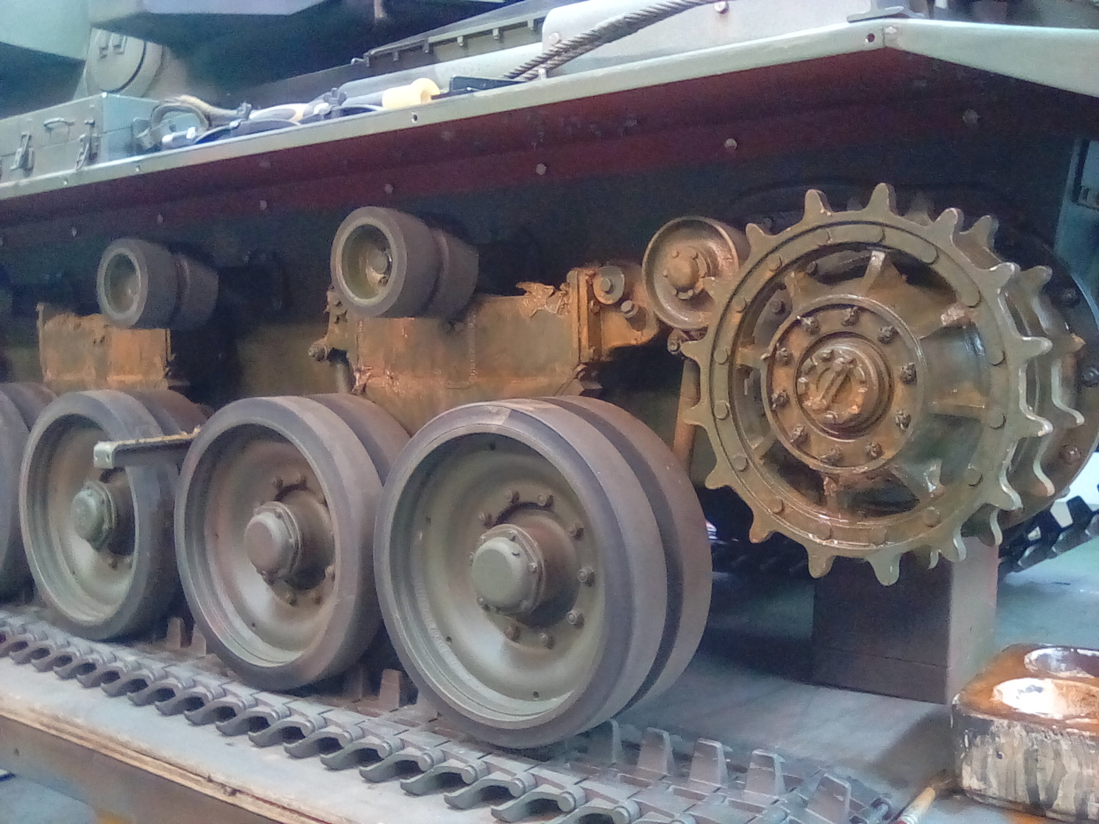

Tuther side running gear including the tracks
We are weathering this am, and the Cent pm.
Must not forget this piece

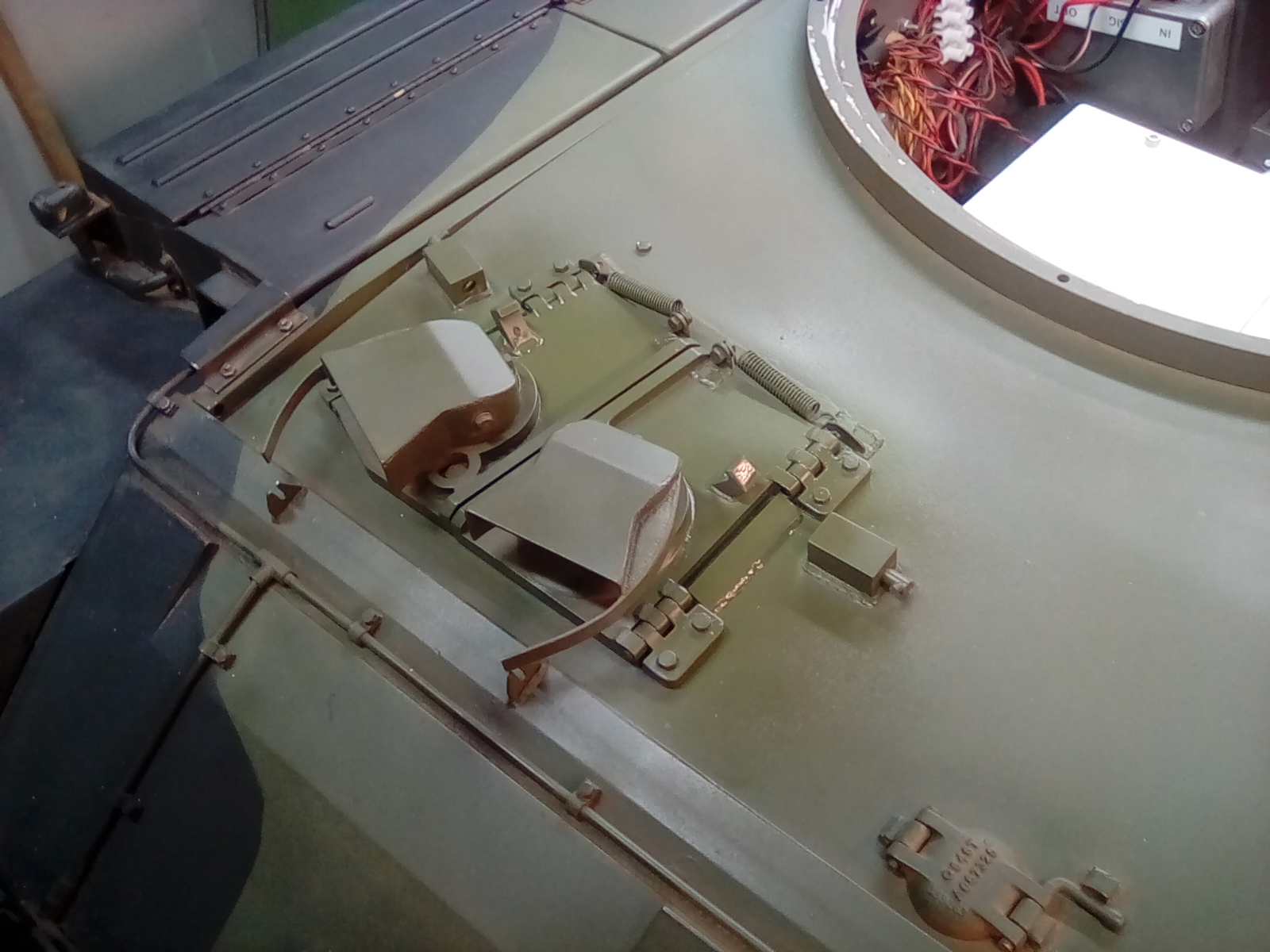

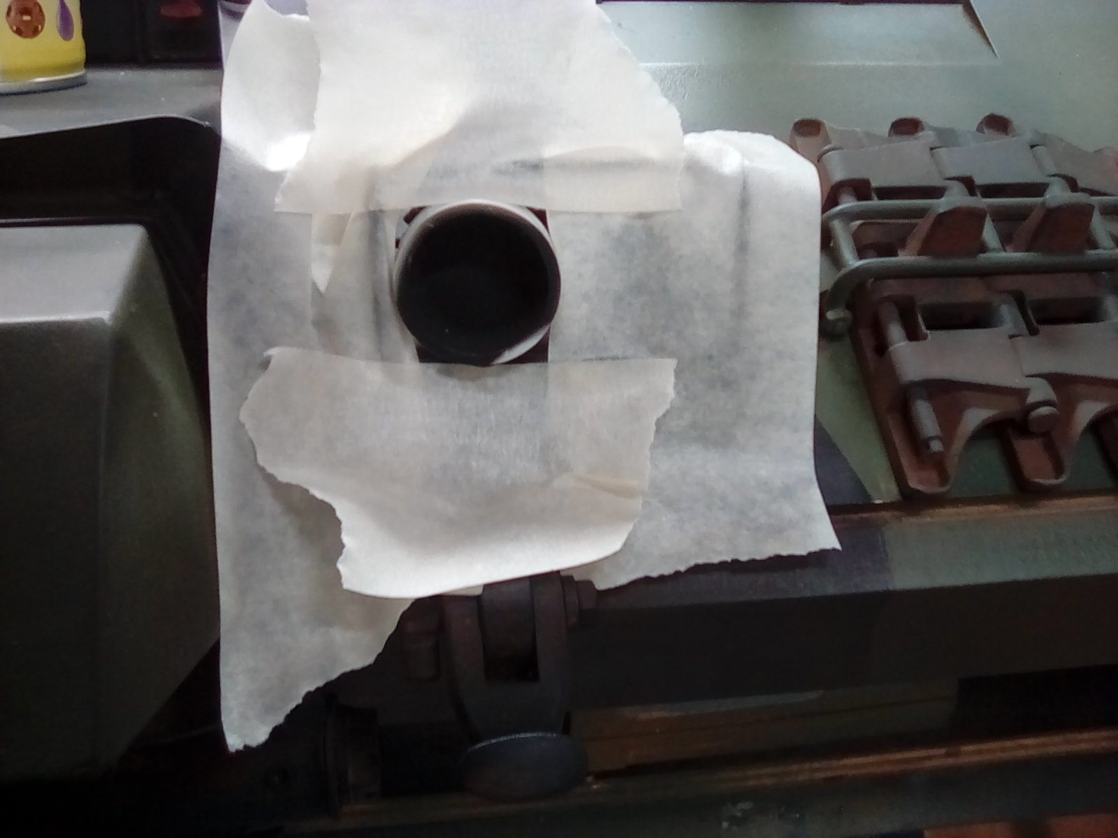

Carefully does it around the cupola

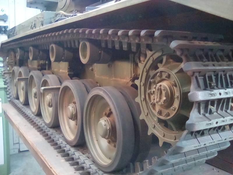

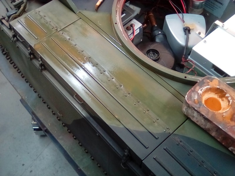

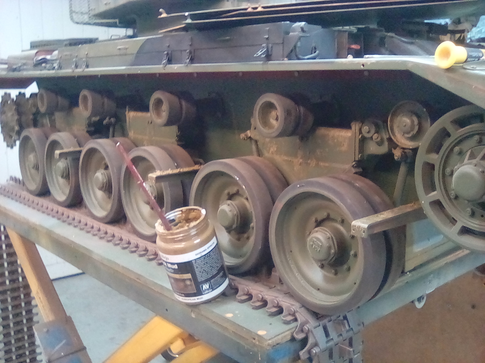

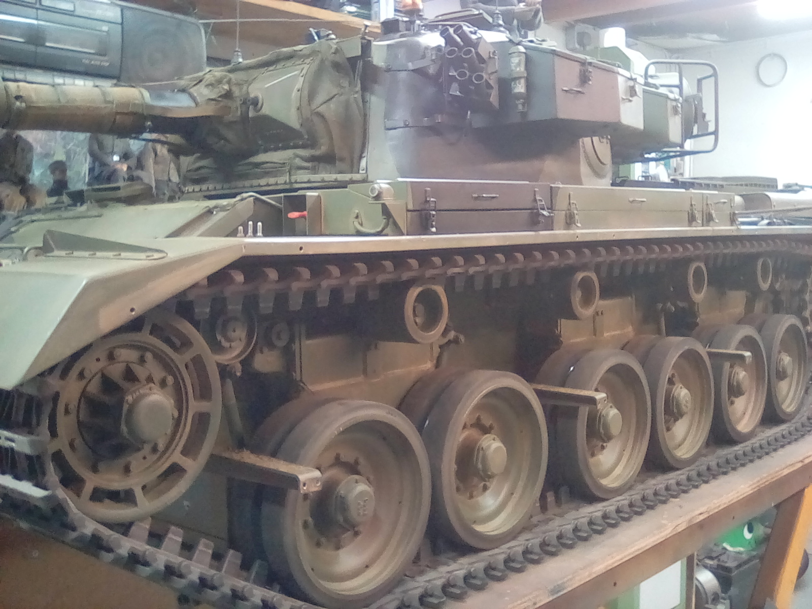

Experiment with different amounts of wash intensity , these concentrations of colour add interest
Letting gravity pull the wash down in the correct direction
After rubbing back using vertical strokes I'm happy

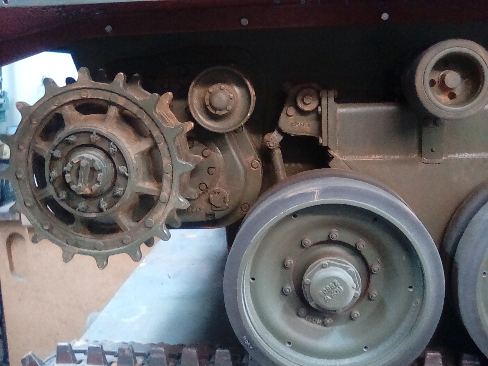

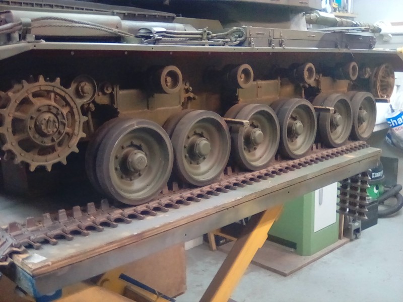

A little mud to the surfaces that would attract it

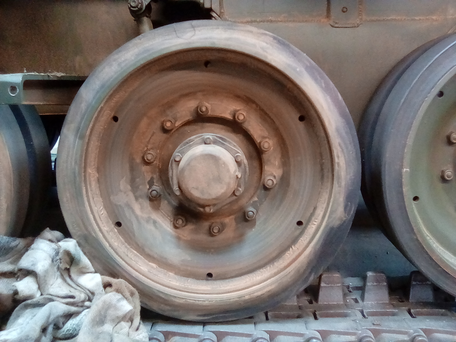

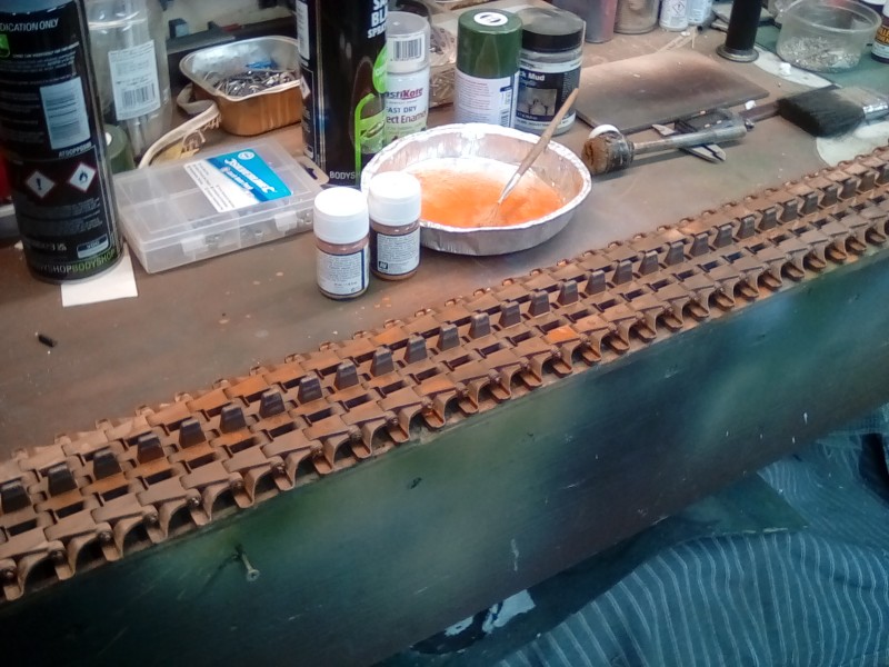

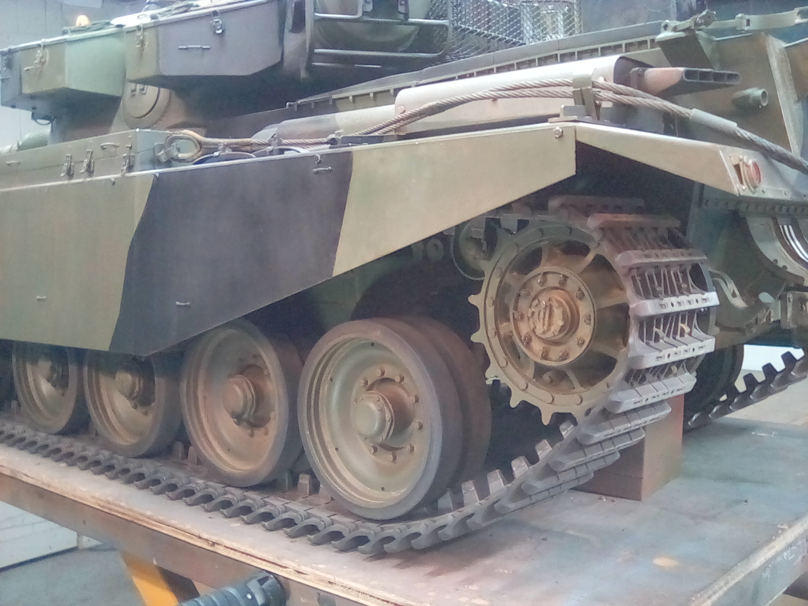

I'm impatient for the wash to dry but you can wipe off as you go, a rag or a brush, dry or wet gives totally different results

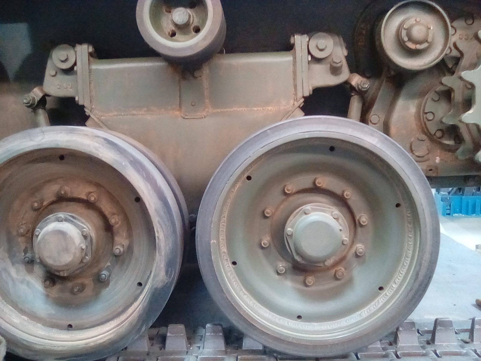

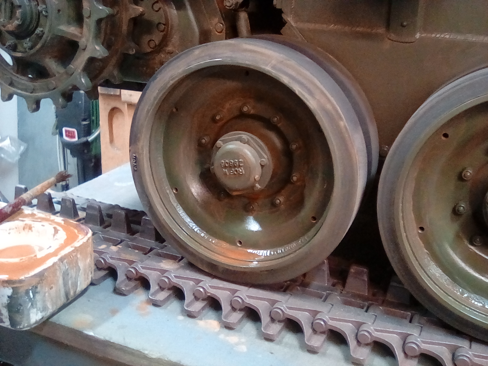

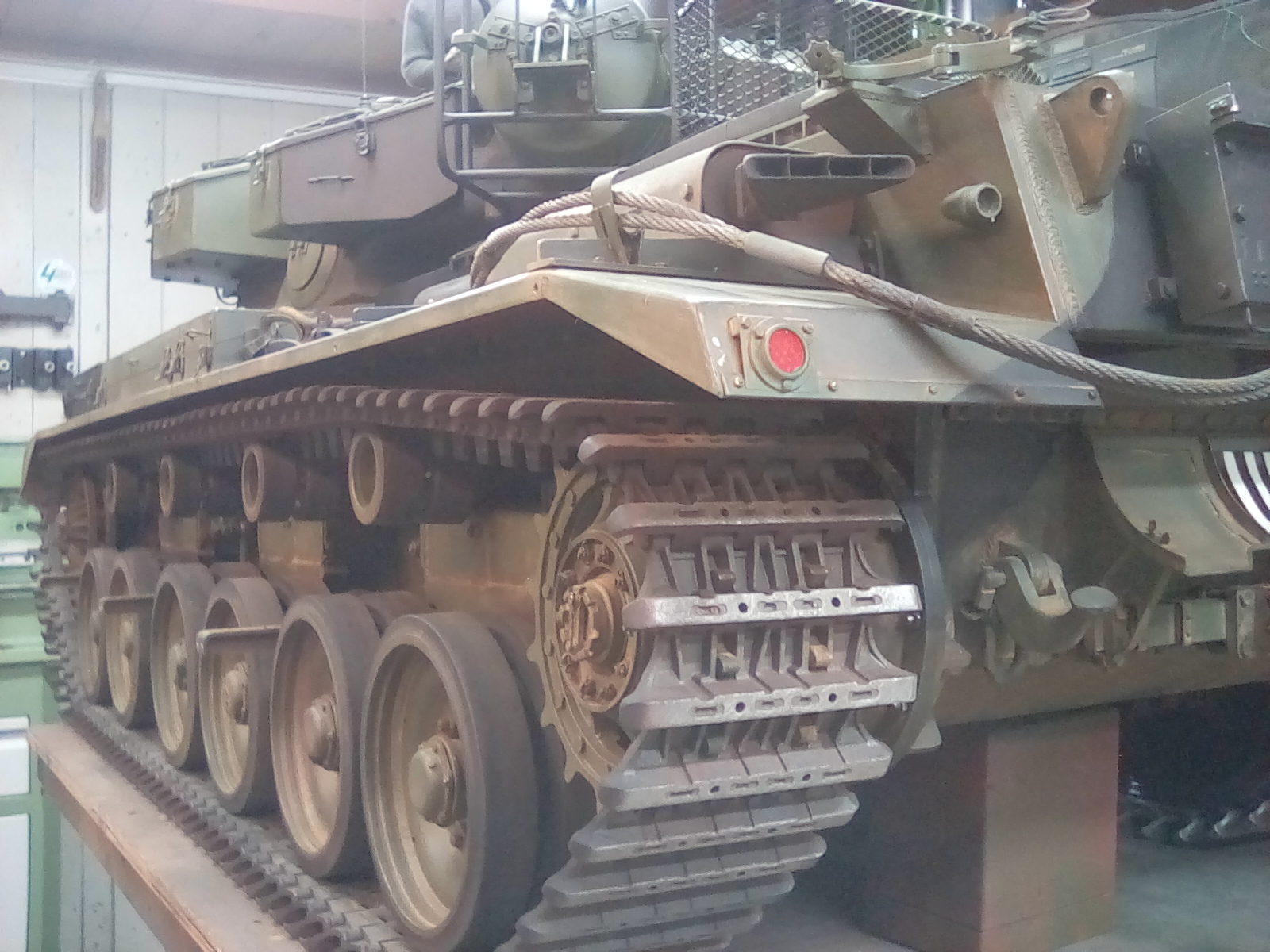

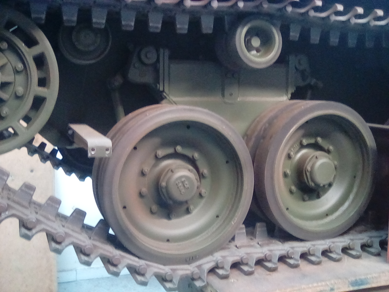

If you go down this route don't worry about the puddling at the bottom of areas like the wheels, these areas would collect crud when the vehicle came to rest just like this

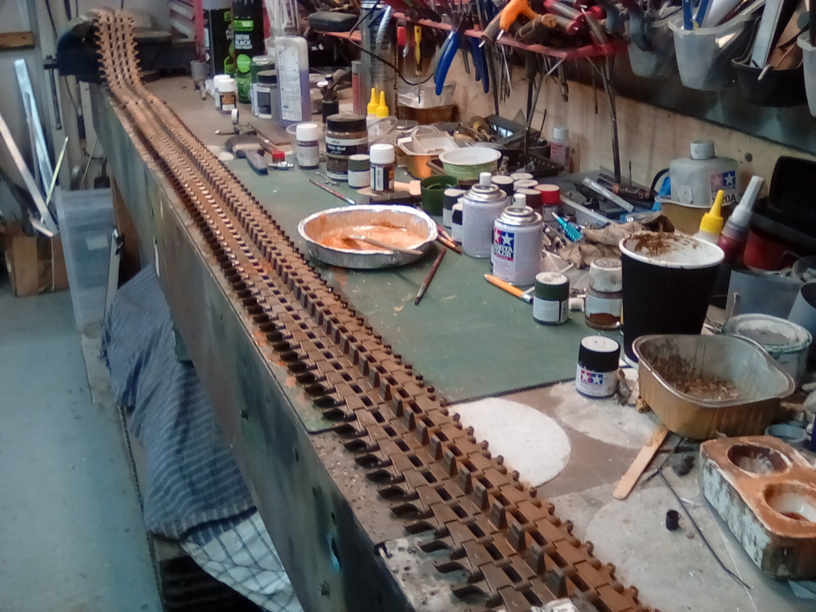

Just the other side of this track to do, then onto the off side track

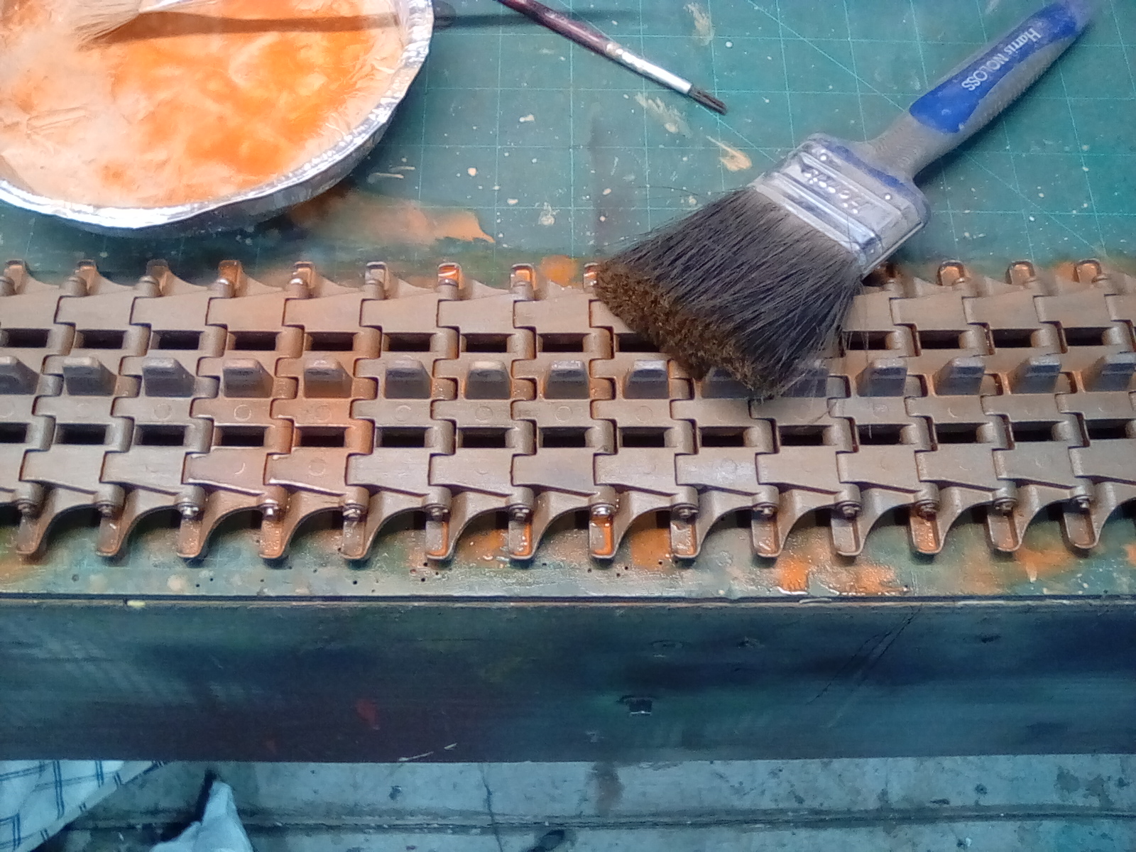

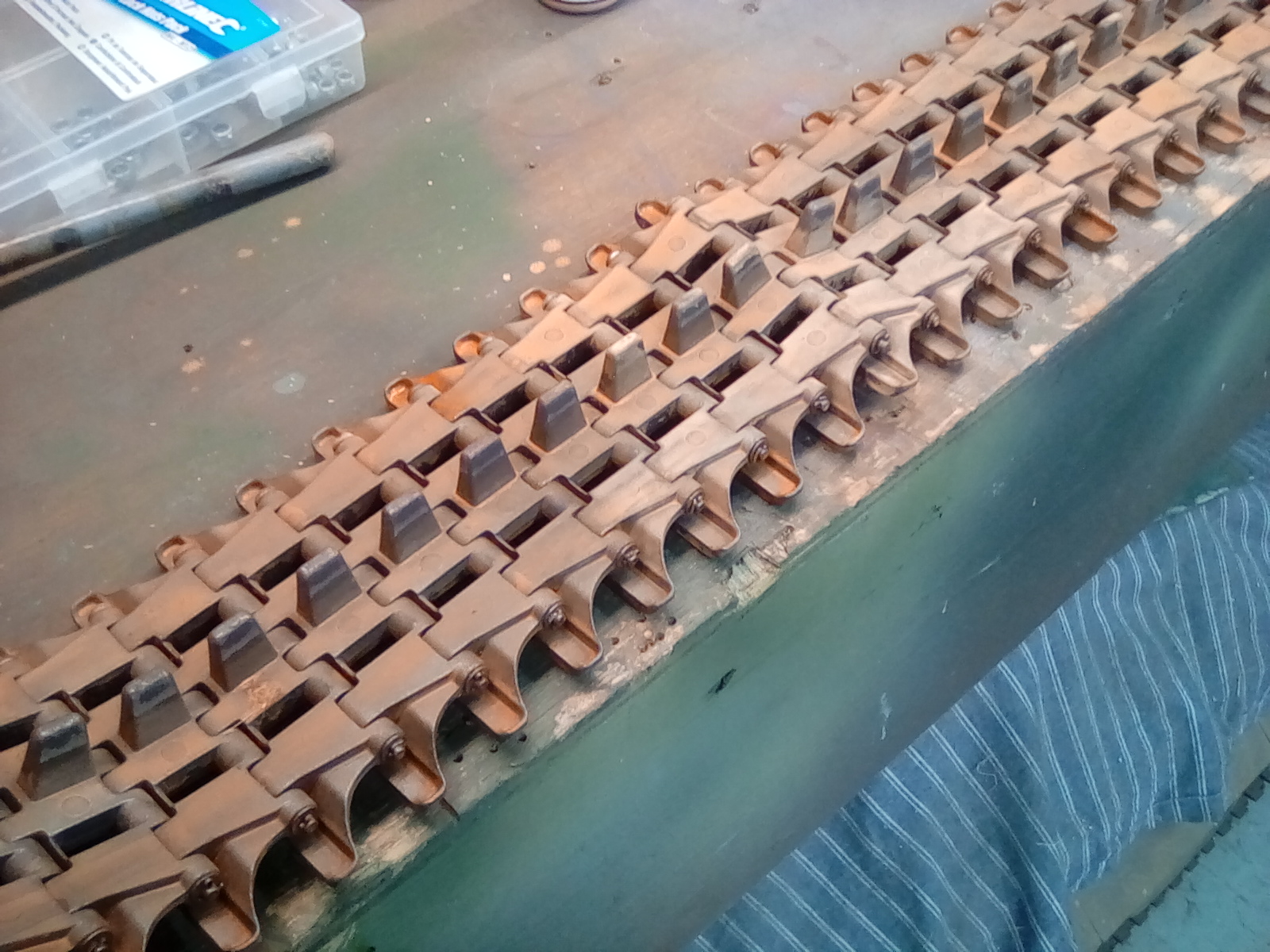

The cent tracks are huge, these will require most of my expensive pigment pots to complete
As the wash dries the colour jumps out, it's up to you then how much you keep and how much is rubbed back
You've really got to get the colour into the crevices, these need doing again, it's all theatre
