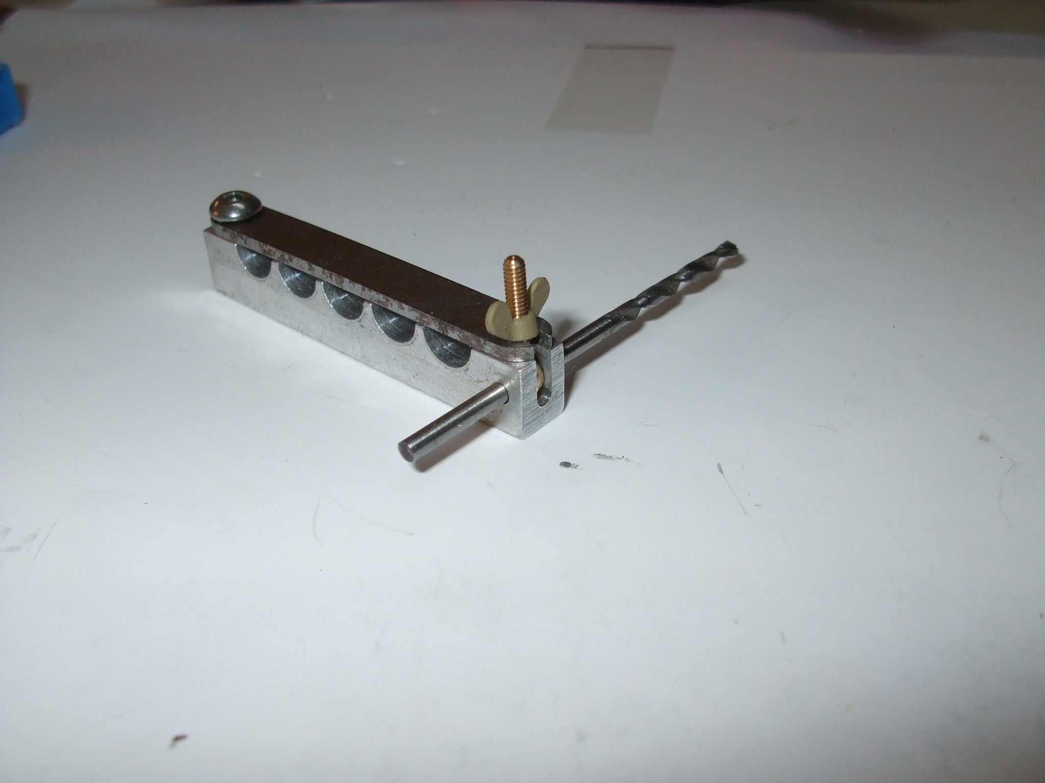

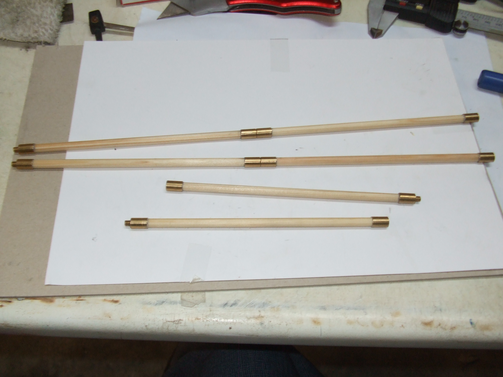

I have just now finished gluing the rod ends with JBweld.

Barrel cleaning rods finished. That's another one off the list.

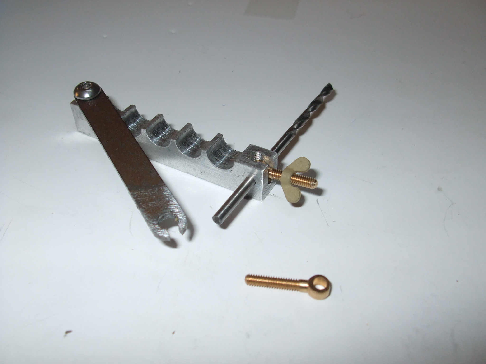

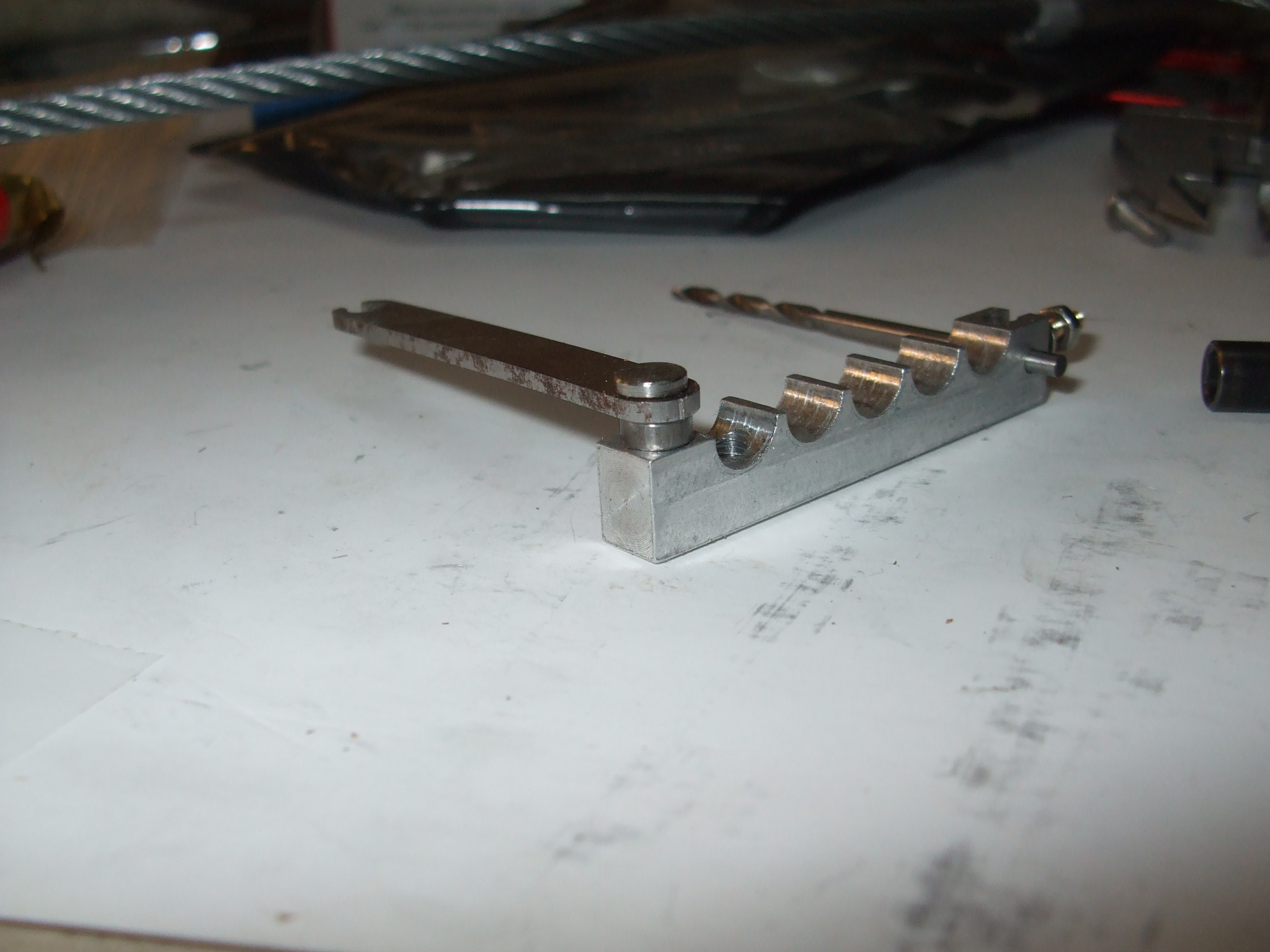

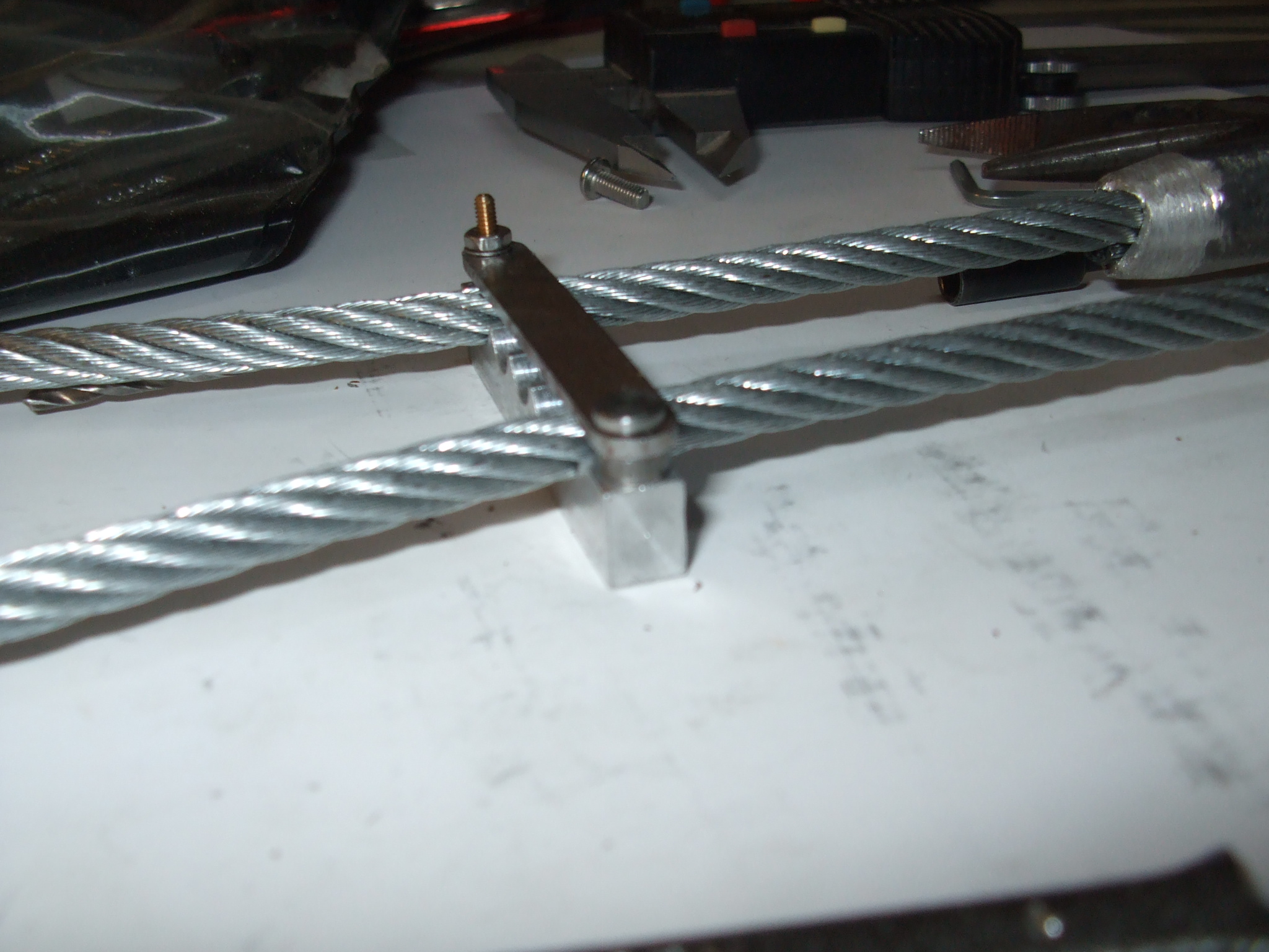

Next started work on the tow rope and cleaning rod clamps. This is a bit more involved so I worked on just one of them to see how it looks. Used a 2mm eye bolt on one side which can be swung outwards to open the clamp.
Re-worked the hardware on the other side. Instead of the 3mm button head screw I used a 3mm hex head screw. I machined the head down to a 5mm diameter and reduced the height to 1mm. I also made a thick washer which goes under it.
If I decide that I like the end result I will do the other three during the weekend.

Finished work on the tow rope and cleaning rod clamps. At the moment applying paint to them. Have to remember to get some 2mm flynuts for them.

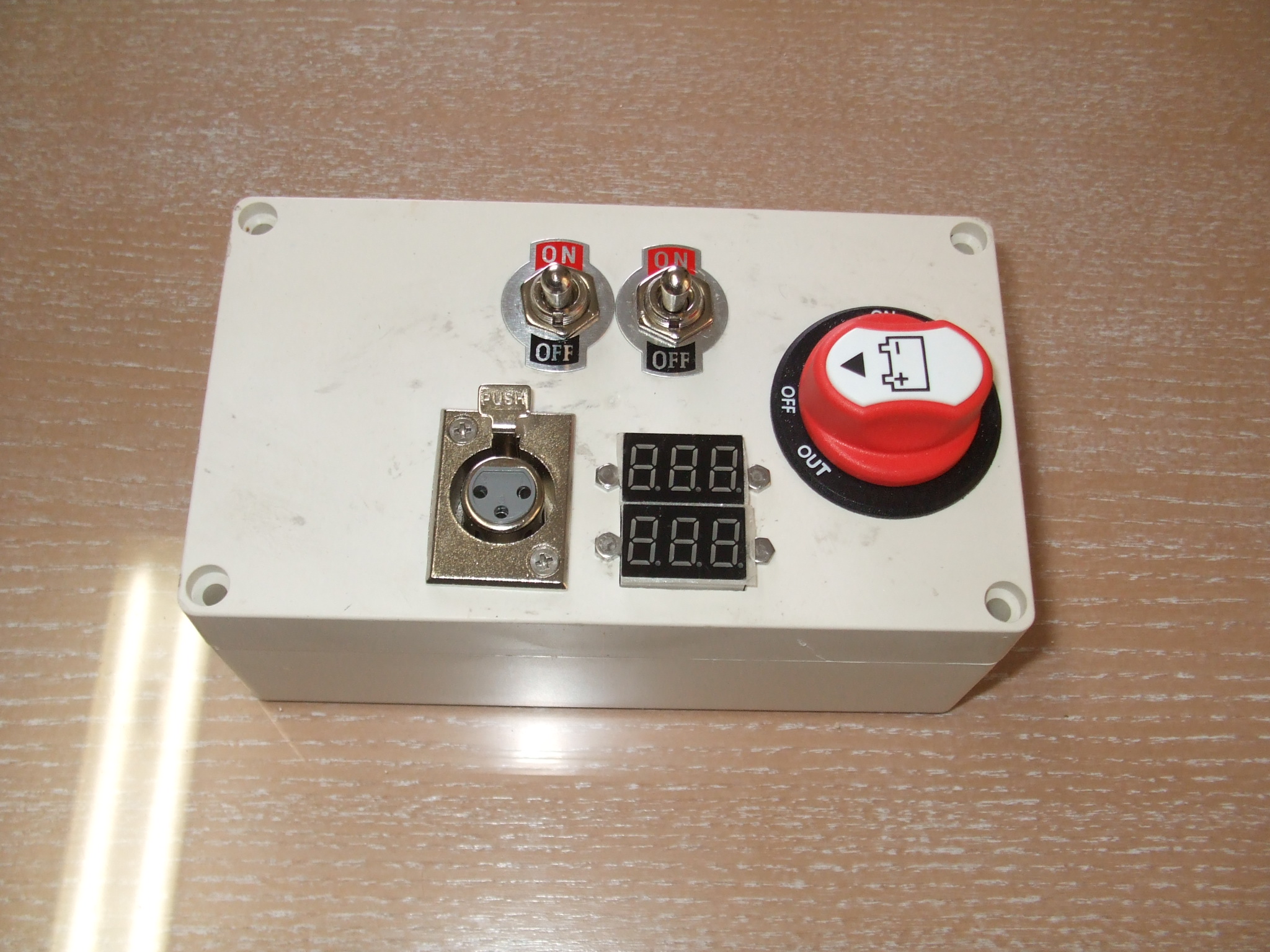

Made a tentative attempt at a control box. Only thing to add is a smoke fluid filler port but to see where best to place it I have to wait until the workshop curfew ends and I have access to the Tiger.

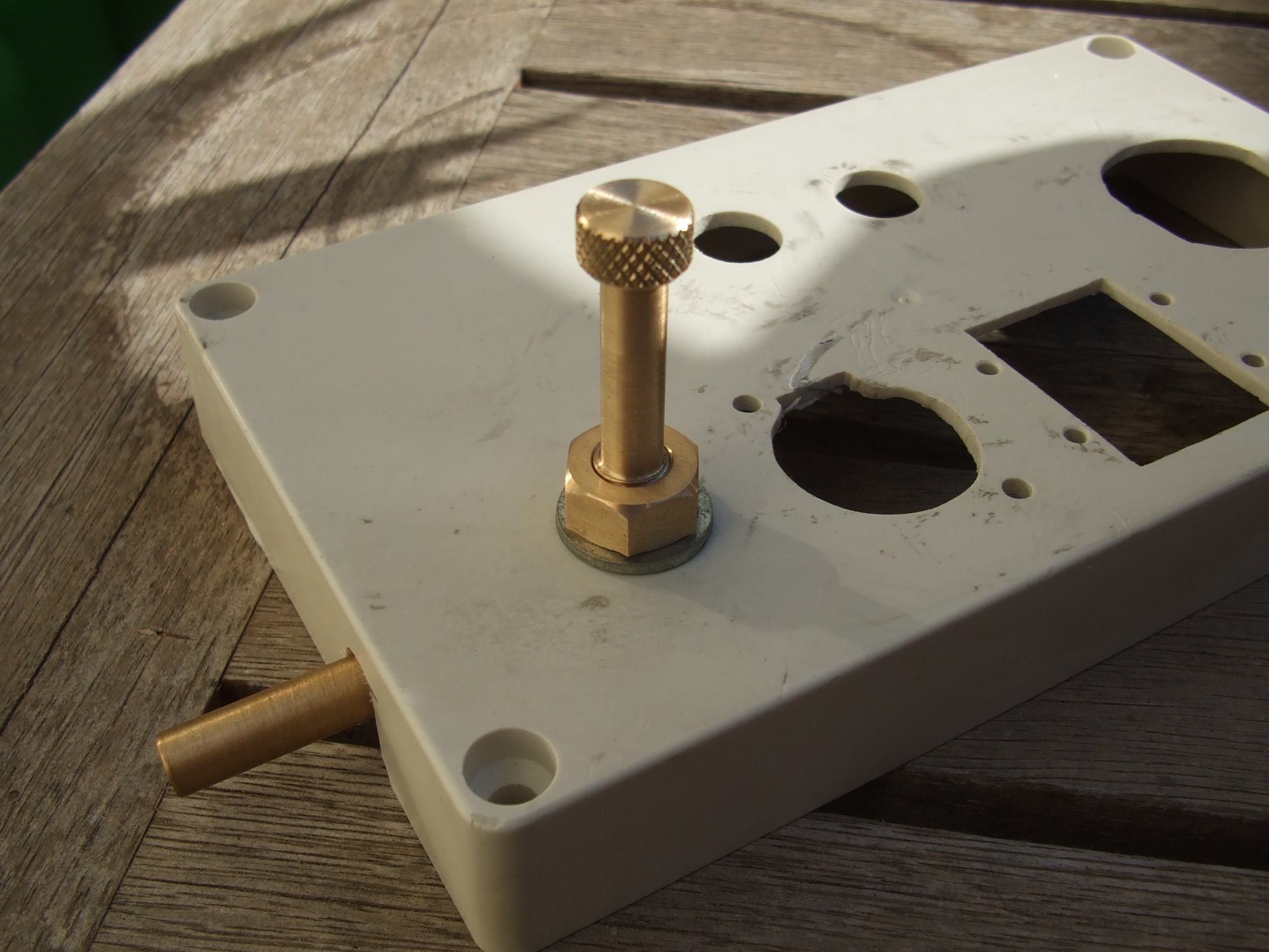

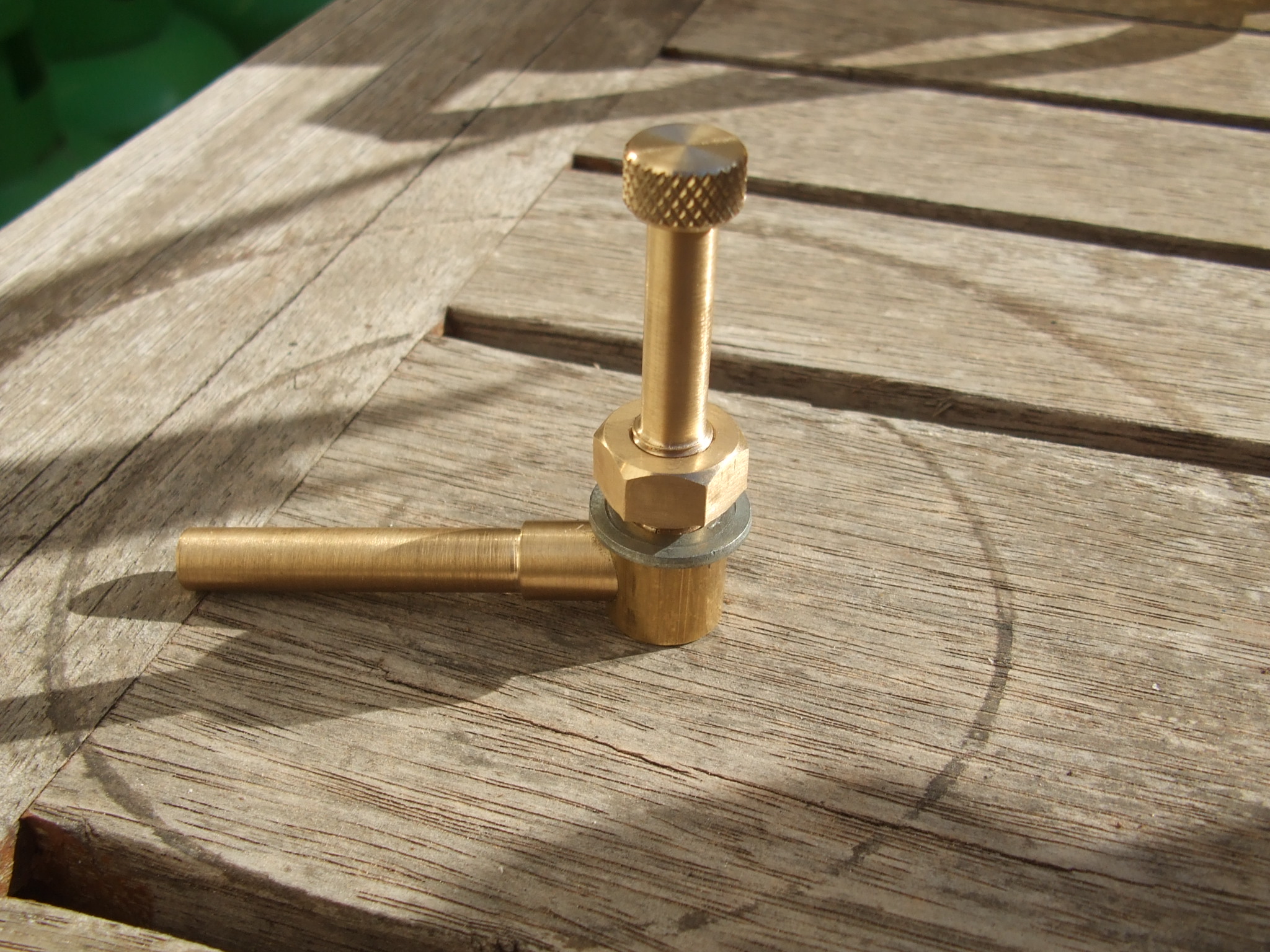

I haven't been idle but it's one of those phases where one does a lot of minor things and there is nothing to show for it. Today I finished a custom made filler port for the smoke unit that goes with the control box.

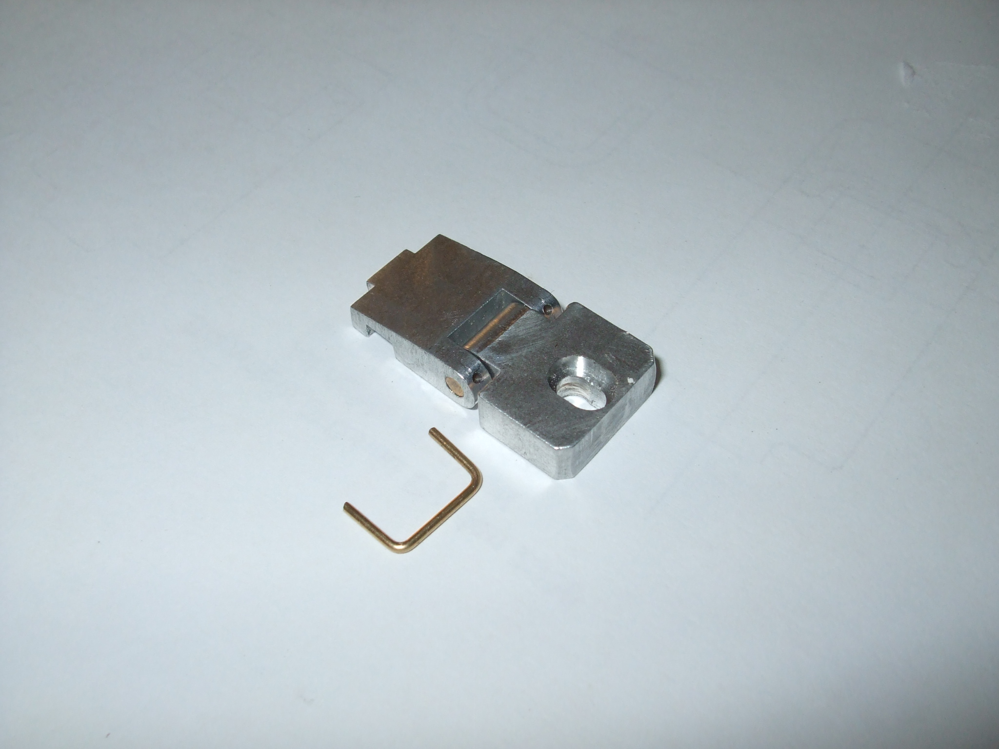

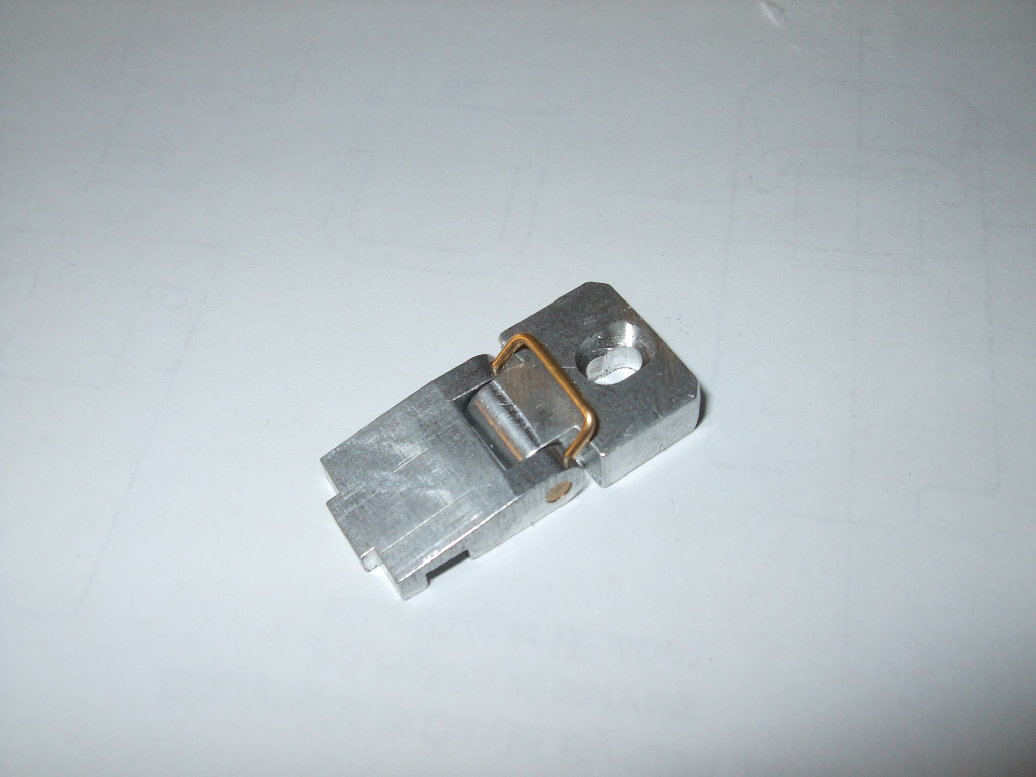

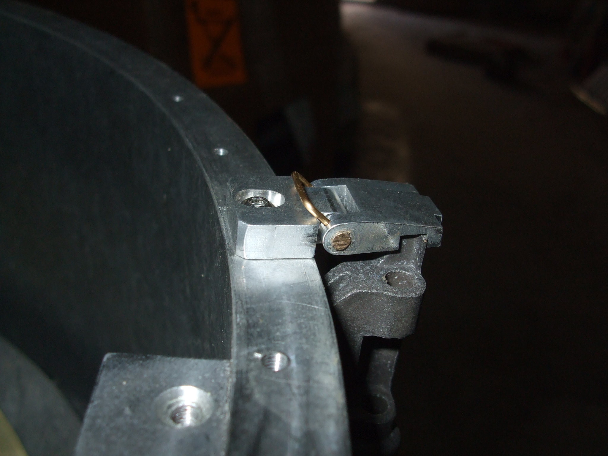

So instead I cleaned up the work table from all the mess in preparation to playing with the round hatches. During this clean-up process I came across the turret spare track top catches. Finally did something about them. Used a 2.5mm brass pin and glued it in. Drilled a couple of 1mm holes going through the brass pin and made a U handle from 1mm brass rod and this is the result.
This modification seems to work. It holds the track in place and the clip does not spring upwards releasing the track.

Those look great Vince. Mine are the white metal version - I need to put the handles in them in same way. I screwed the track link to the turret so as not to rely on the clip to hold the link. The white metal ones are not quite long enough or strong enough to hold the link by themselves. Looks like the machined clips are an improvement.

Thanks Bob. The machined clips are part of the 2017 Tiger 1 kit.

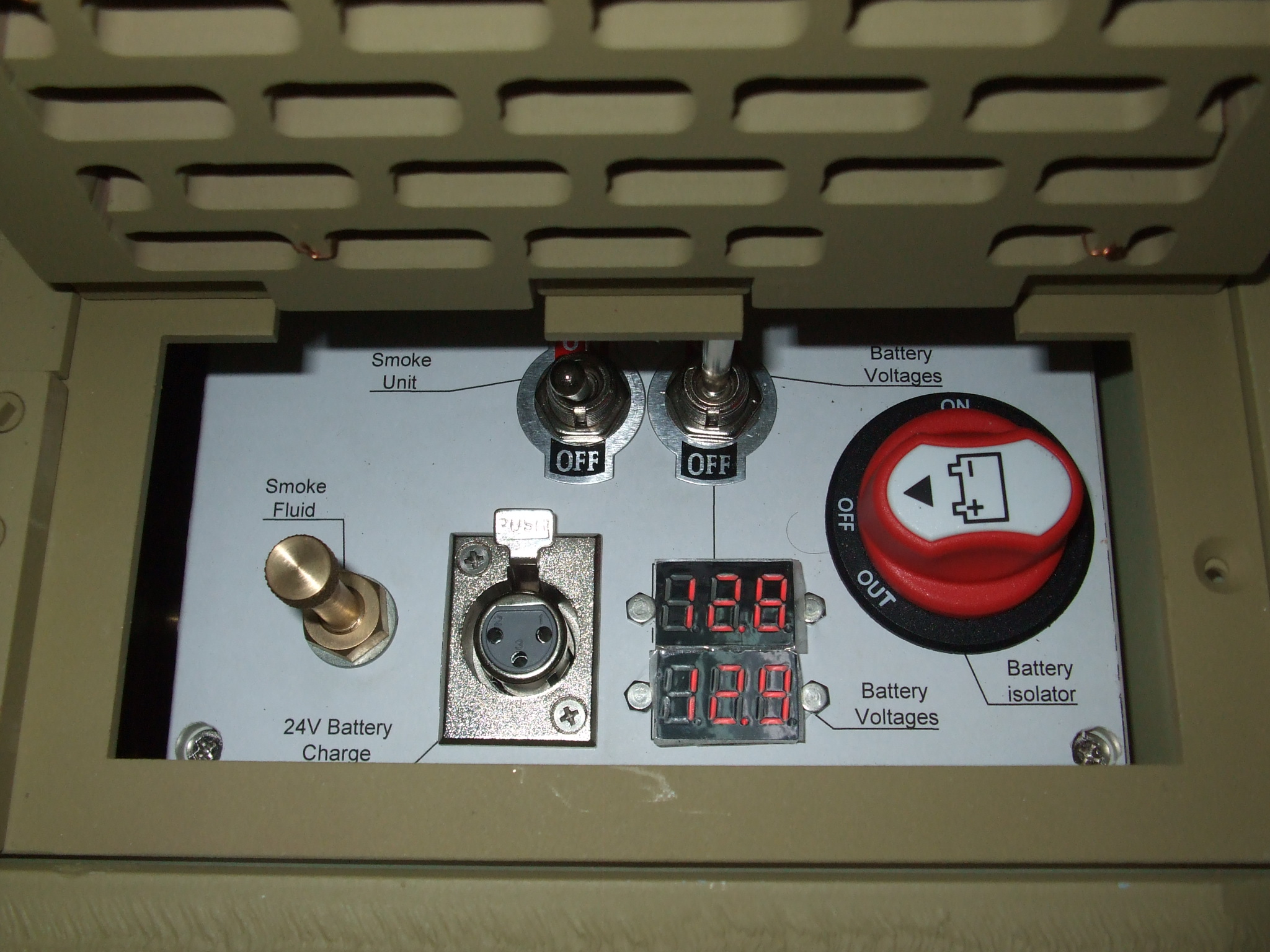

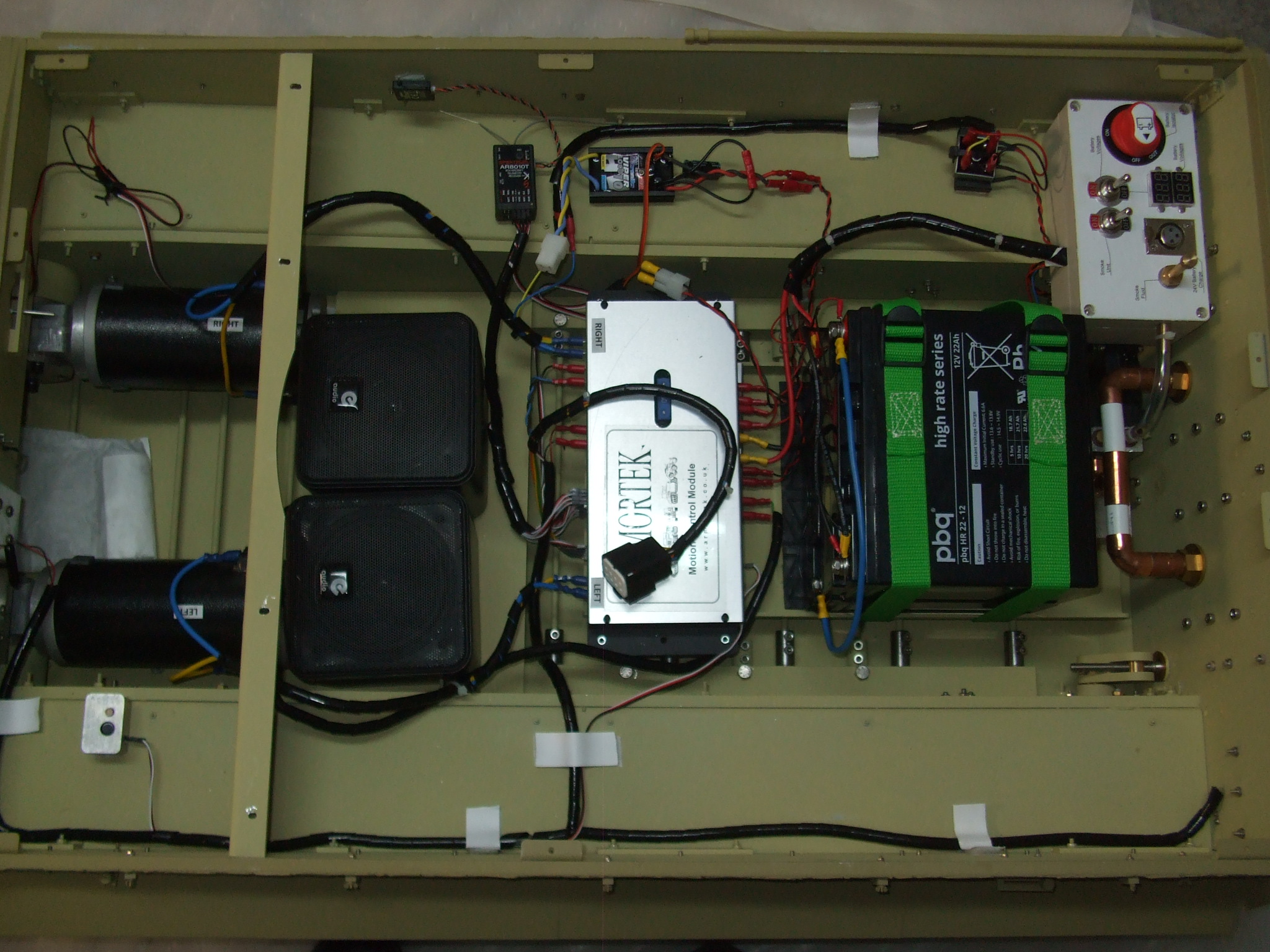

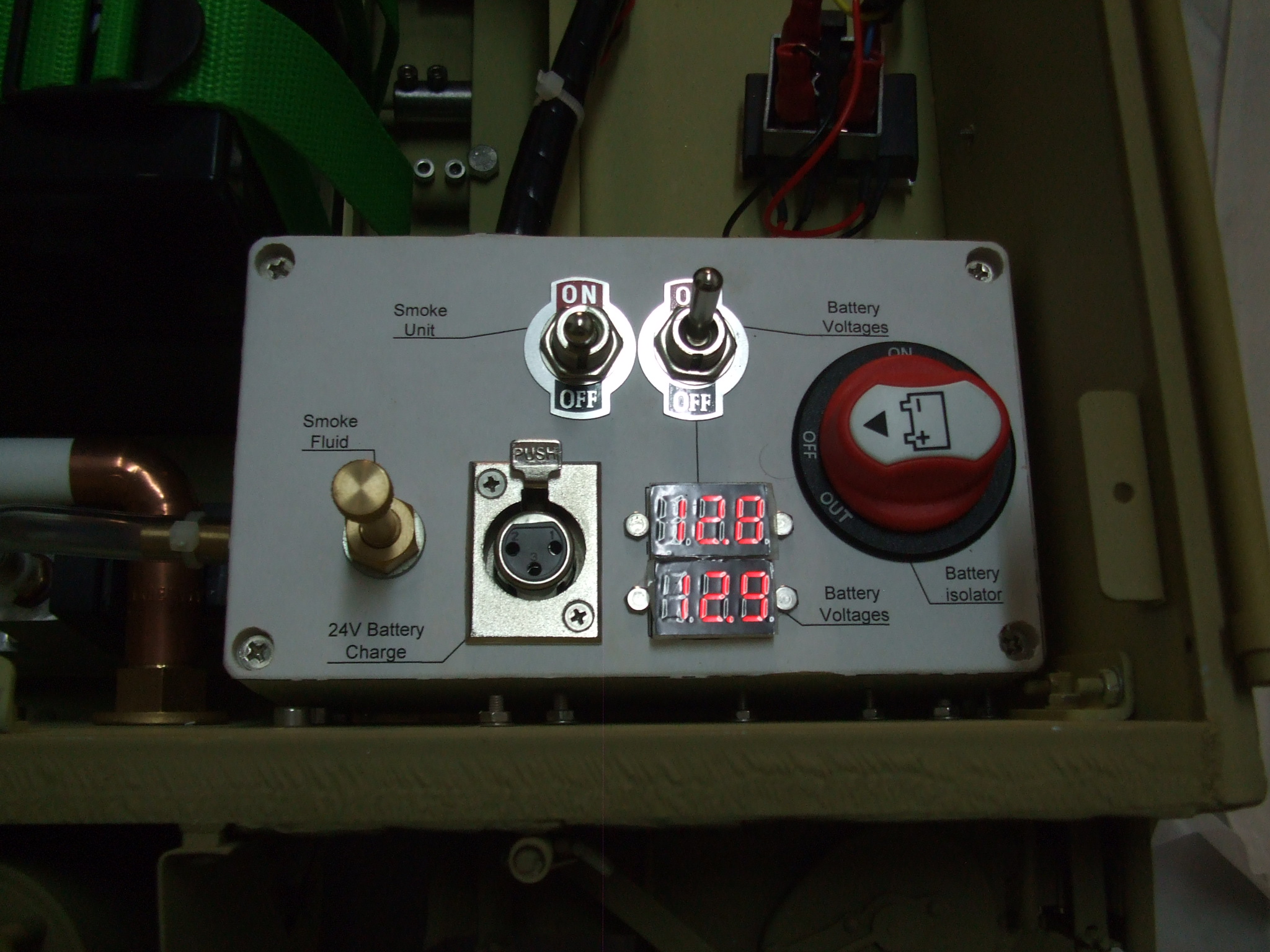

Today I received the CTEK XLR plug that I want to use and found which pin is positive and which is negative. With this information I could wire it in the control box to finish all the wiring of the control box. Did a bit more tidying of the wiring and now I can say that all the electrics is finished.

That’s a very neat electronics control box you have got there.
Can you tell me where you got the battery isolation switch from ?

Hi Steve
Thanks for the compliment. I got it from eBay:
