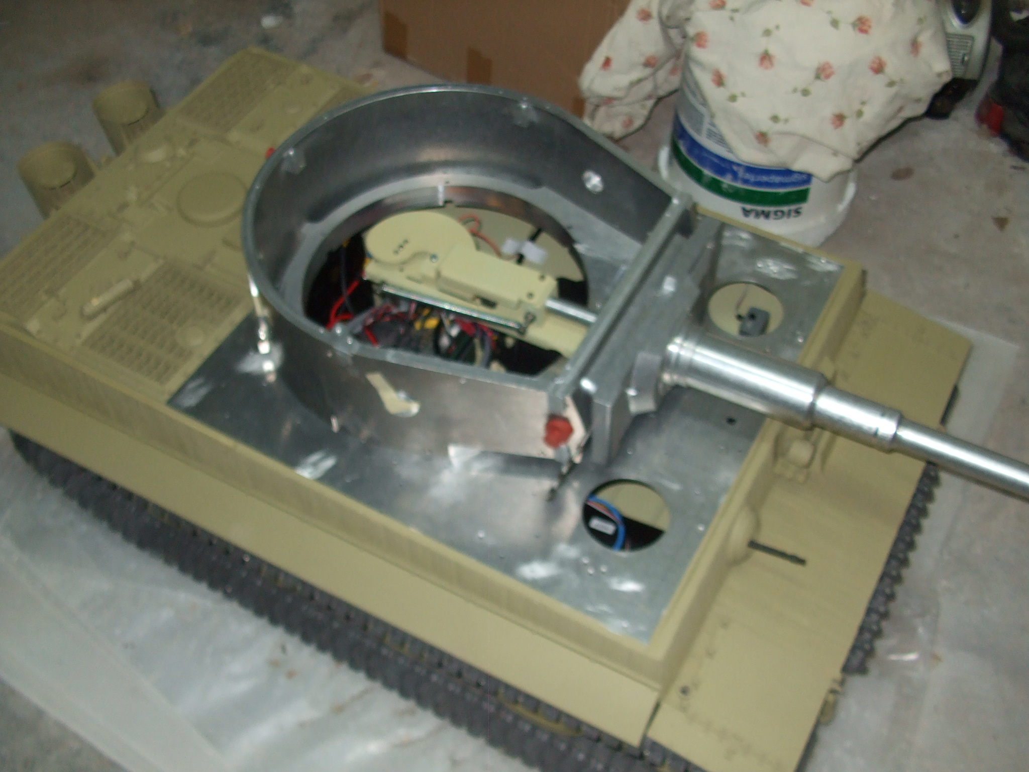

Hi Vince

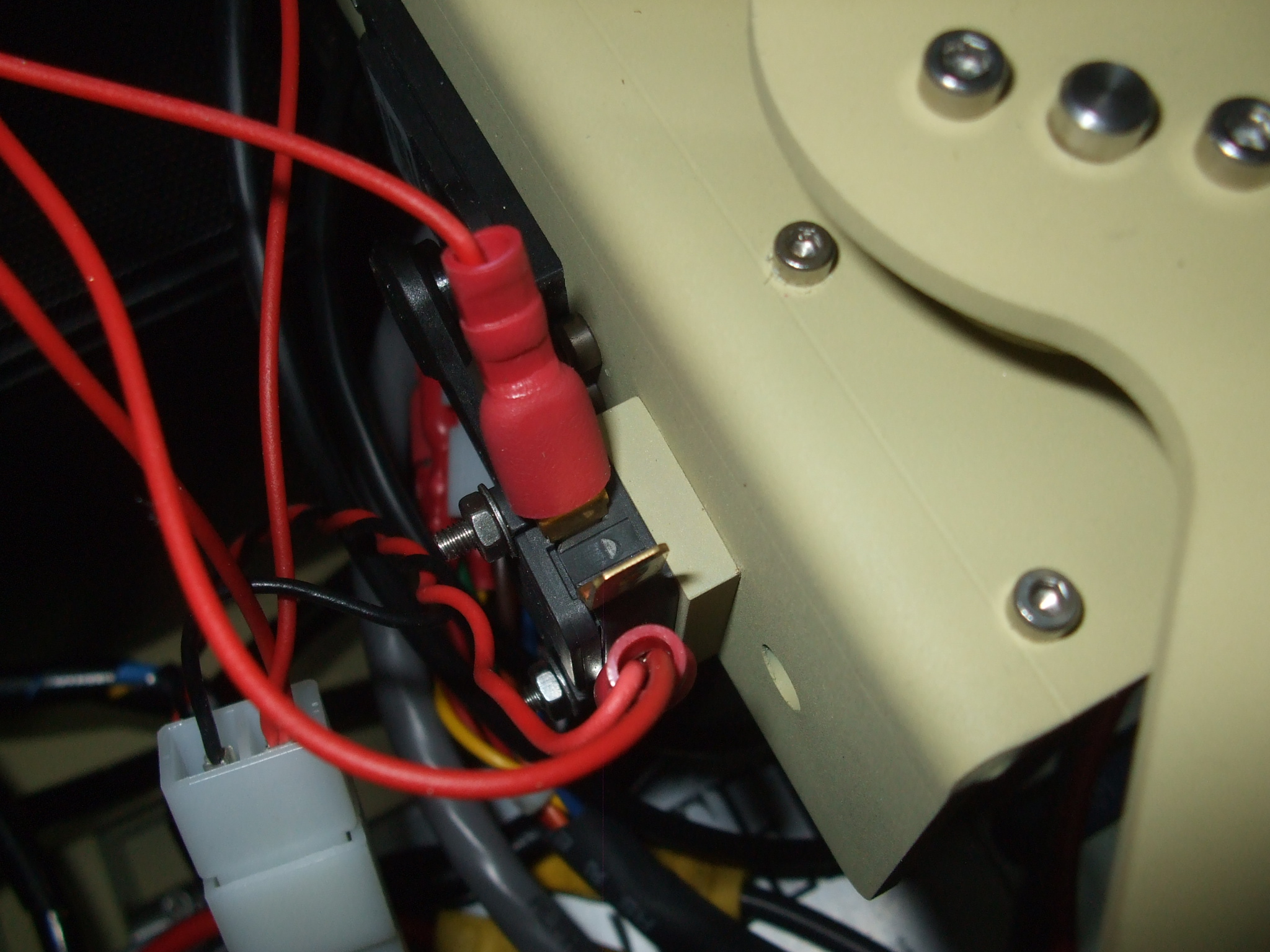

Well I tried adjusting the spring tension, as in your video, but mine still continued to complete 2 revolutions before stopping, whatever the spring tension. So I tried operating it by hand, as you did and it stopped every time! But, on closer examination I had my own “eureka” moment..... It’s the micro switch that’s operated by the servo that’s causing the problem. The servo arm rotates to open the micro switch, but doesn’t return fast enough to close the switch, allowing the cam to carry on? It’s only a fraction of a second, but enough to cause the cam to keep turning? So I just need to adjust either the position of the servo arm or micro switch. I hope this helps you.

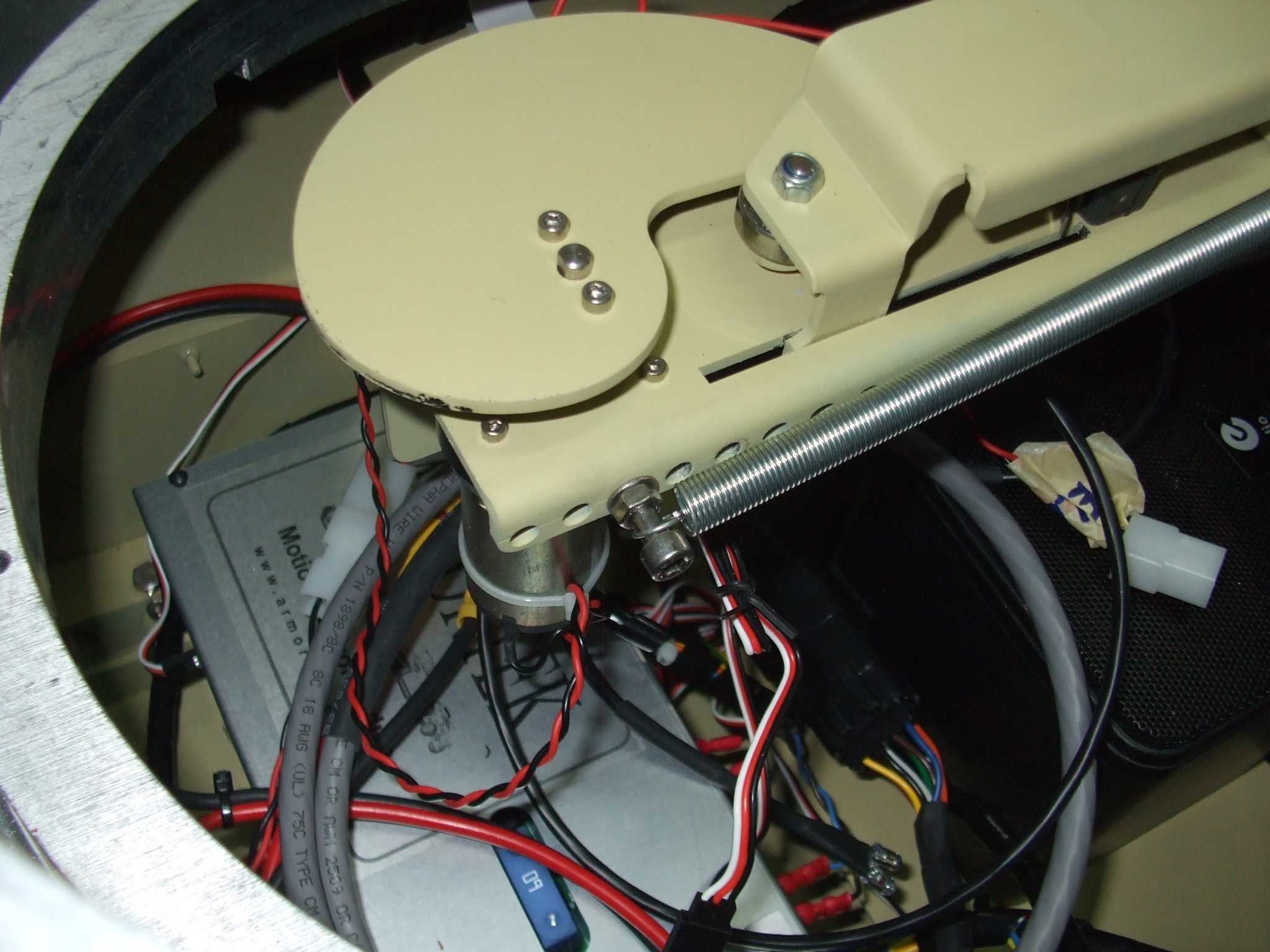

Today after playing with it further and still getting repeatable results, I dismantled the recoil mechanism and drilled a series of holes so that I can adjust the spring tension as required. Cleaned up all the parts and started etch priming them to stop the dreaded rust problem on the steel parts.
- Has liked: 794 times
Re-assembled the painted recoil mechanism. Took me quite a while to get it re-calibrated again. Installed it in the turret and put it on the hull deck to check if it is still working with R/C. I also checked if there is enough clearance with the barrel at full elevation.

Thanks Phil. I have experimented with various spring tensions until I found one that gives the best results. I was looking mostly at repeatability. This does not mean that this will work for everybody. I think that how easily the barrel slides in the two plastic bushes will affect it. I suspect that when I eventually paint the barrel I will have to re-calibrate it again.

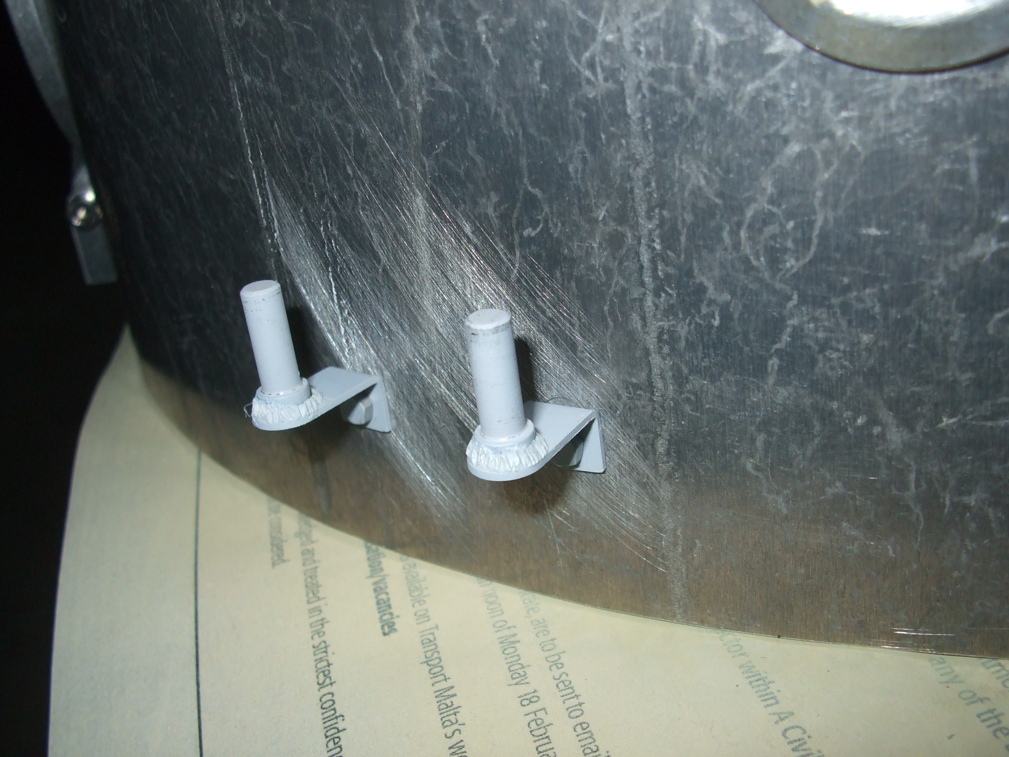

Finished work on the turret spare track lower holders at least.

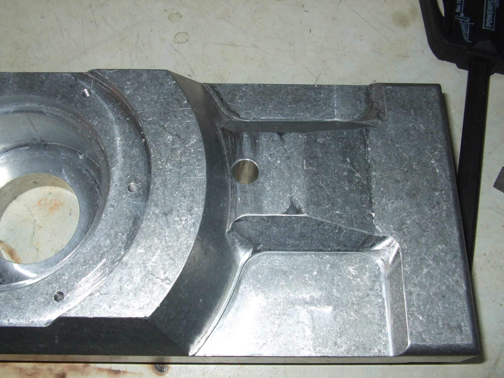

Did something simple today so did some modification on the mantlet gun sight.
On the later tigers the diameter of the sight is 50mm and also it is a stepped hole. So drilled and reamed 8mm the mantlet hole.
Next made a brass insert with three stepped holes.
Checked for fit in mantlet.

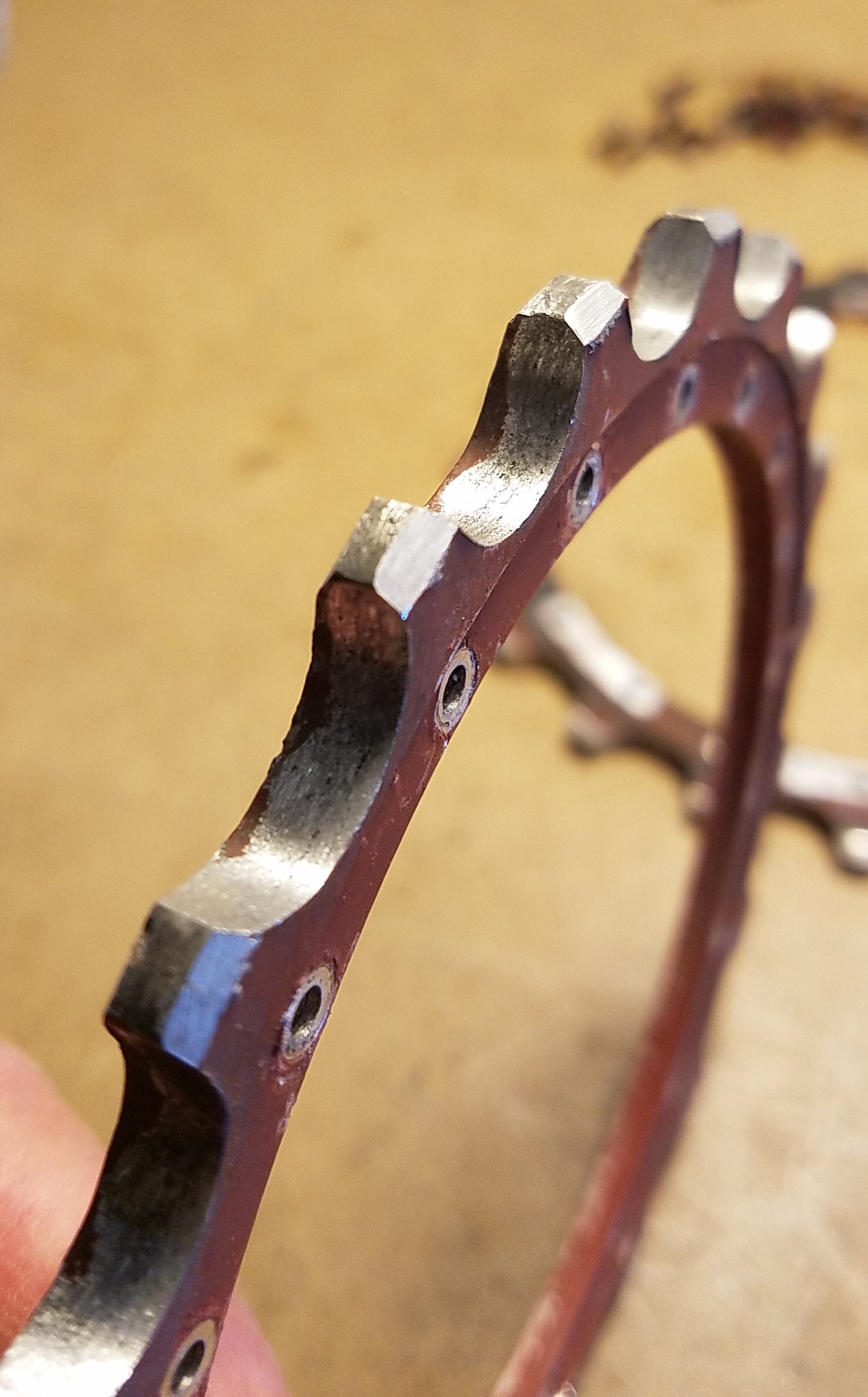

For now, I'm focused on addressing the issue with the tracks -- that is, they keep coming off the drive sprocket. I checked track alignment, which appears good.
I think I might have over-chamfered the teeth, not to the extent Brian did earlier in his build, but enough maybe to cause the slippage problem. I ordered a new set of sprocket rings from Armortek and hope to see those soon. My next attempt at chamfering will be much lighter and more uniform.

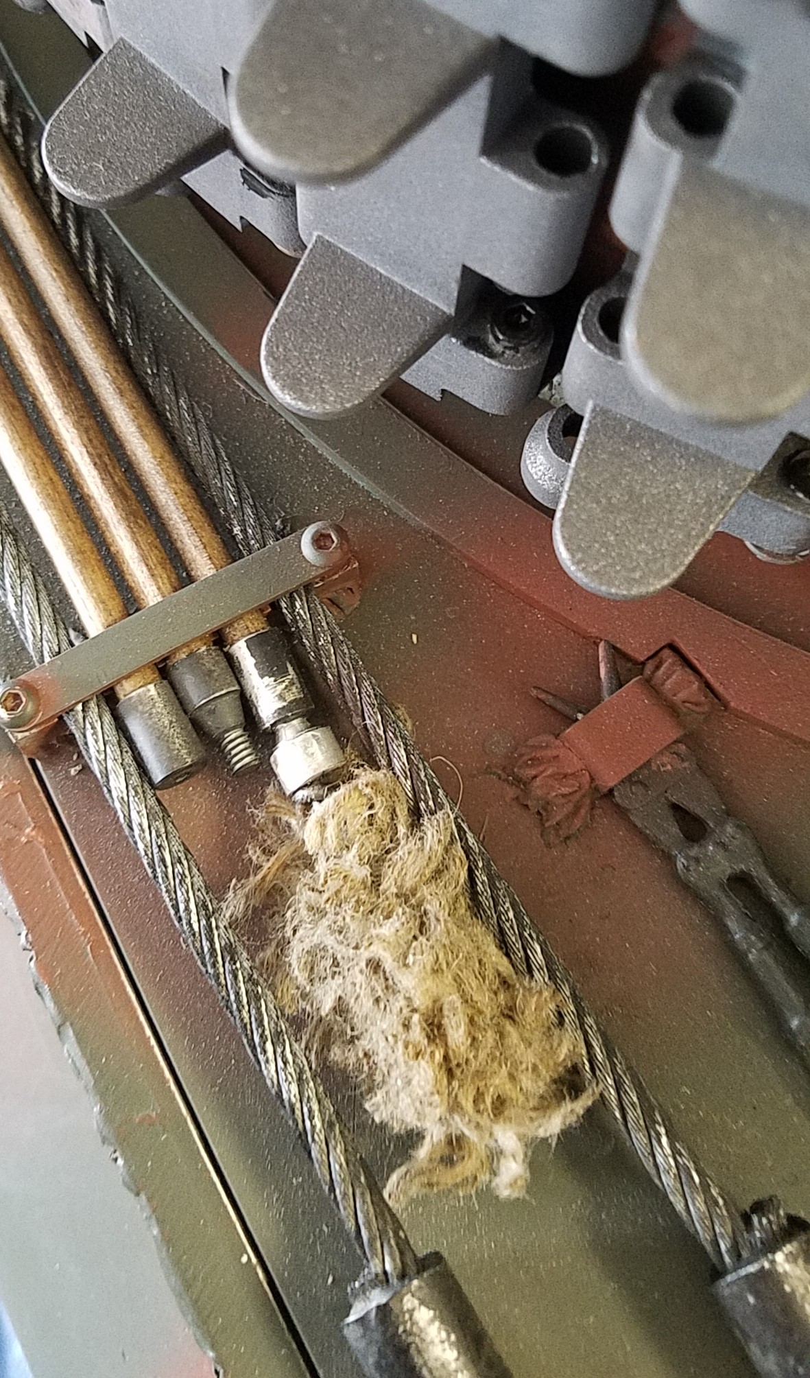

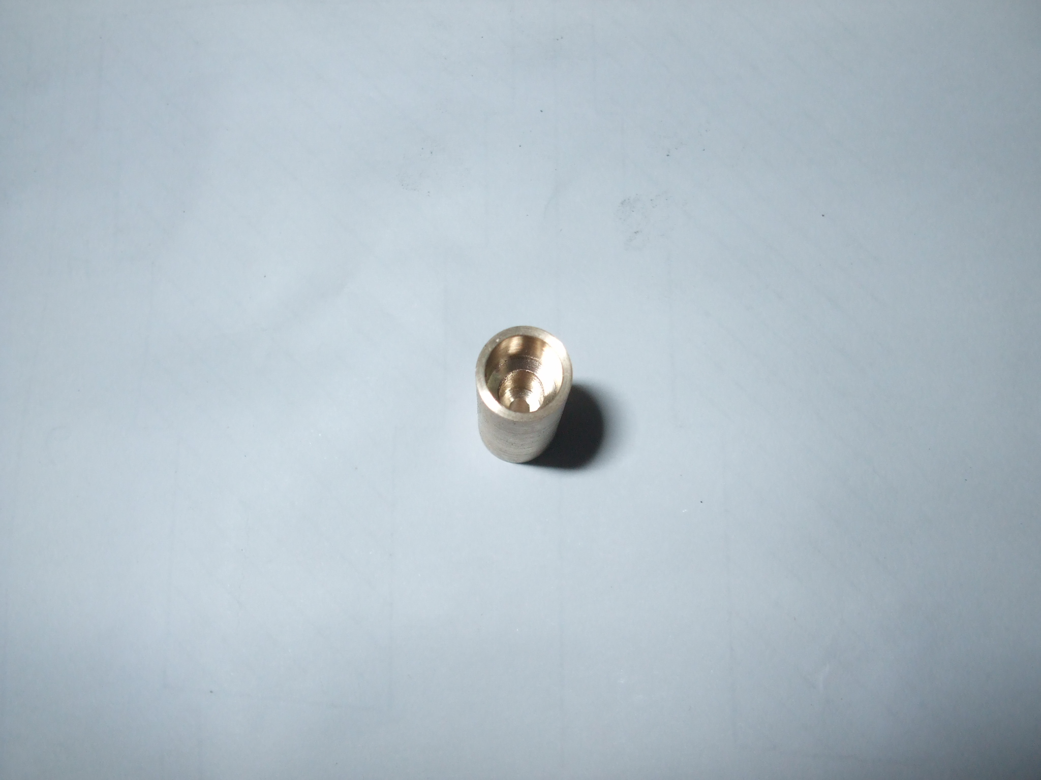

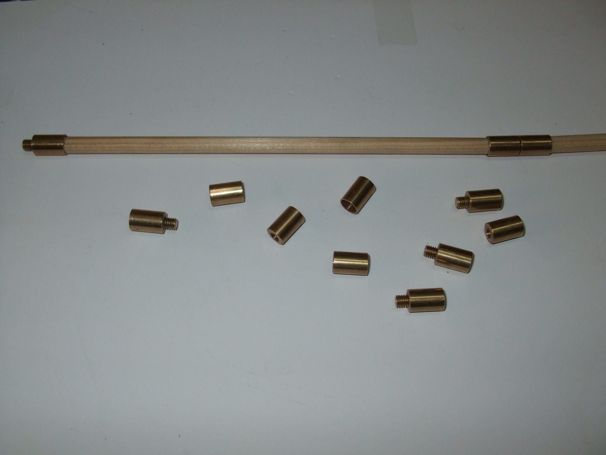

Last Monday received the material I had re-ordered and immediately started work on the cleaning rod ends. I re-made them as I wanted them to screw into each other. I made them out of brass as I won't be painting them but let them tarnish naturally.
All that remains is to glue them to the wooden rods. I have never glued wood to metal. I guess two part epoxy is better than liquid superglue or Loctite.

Vince,
Most adhesives should work fine with the metal ends-to-wood.
I used a silicon sealant, so if I have to remove the metal ends later, it shouldn't be too difficult.
The cleaning swab fits the tube very well, but it's mostly for show -- I don't plan to remove it from its rack.
