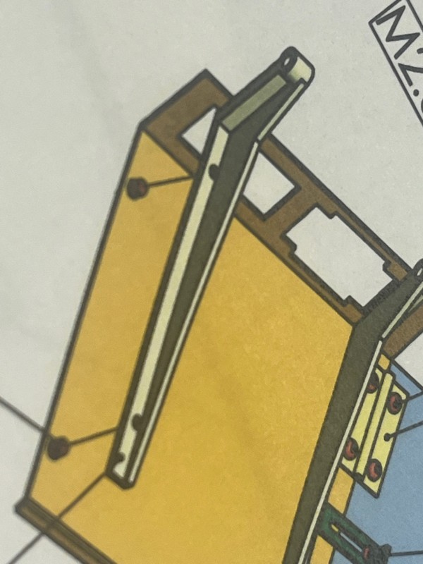

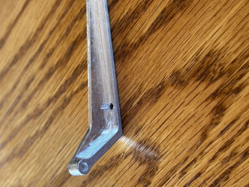

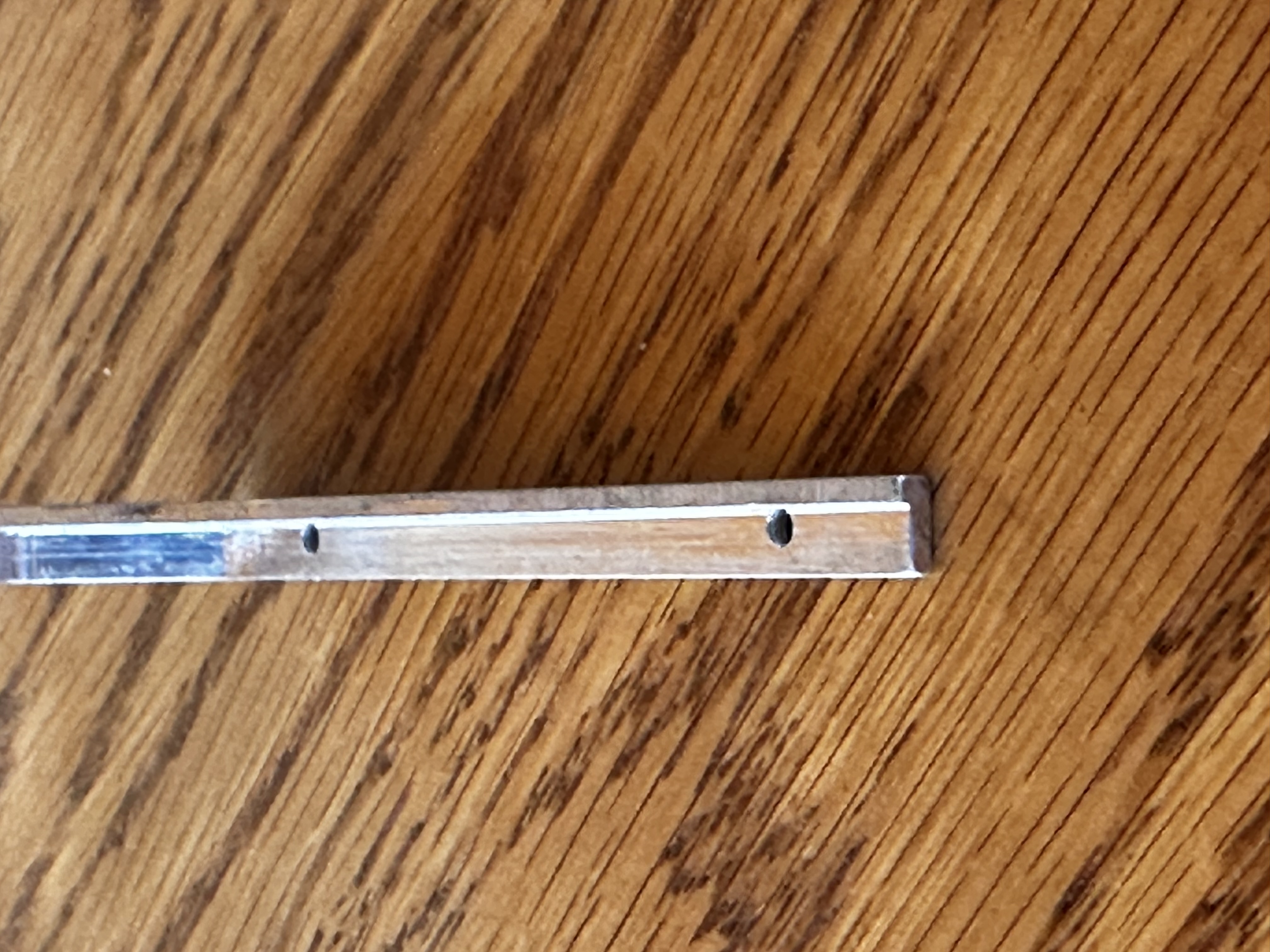

Re: Dave's Tiger I (Early) Kit Build Thread

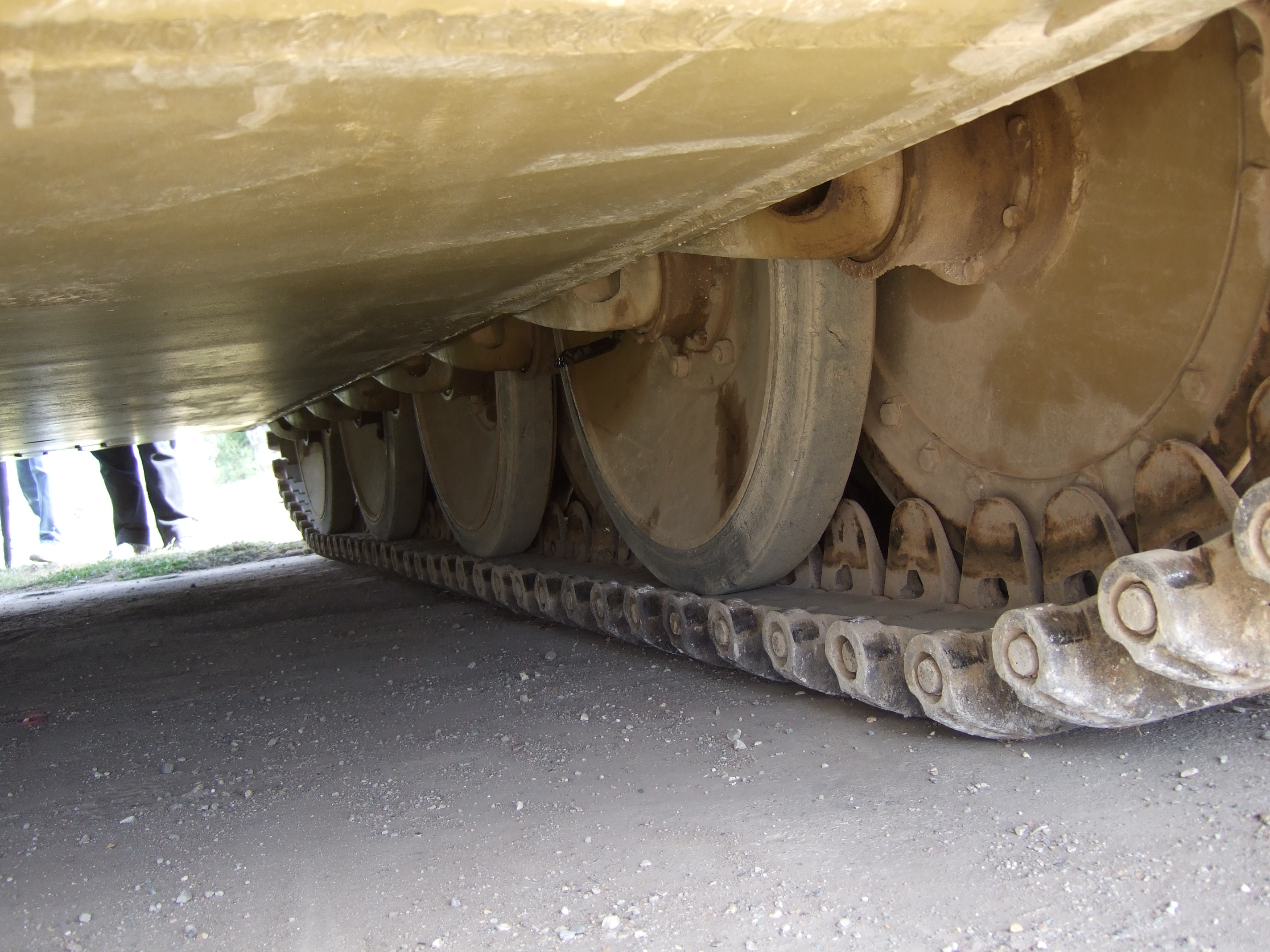

It's probably not recommended for the kit but there's quite a big hole in the back of the swing arms on Tiger 131
Surprising how small the contact area is between the swing arms and the axles.

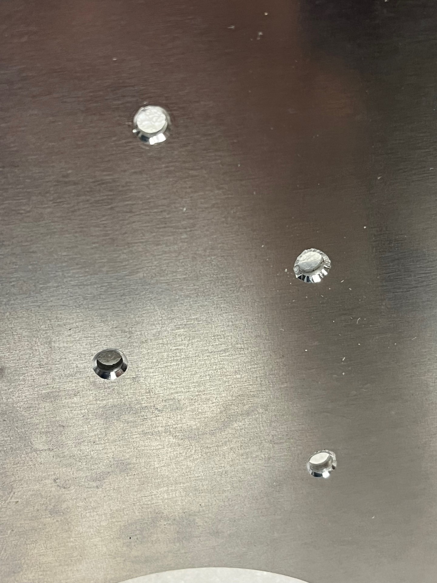

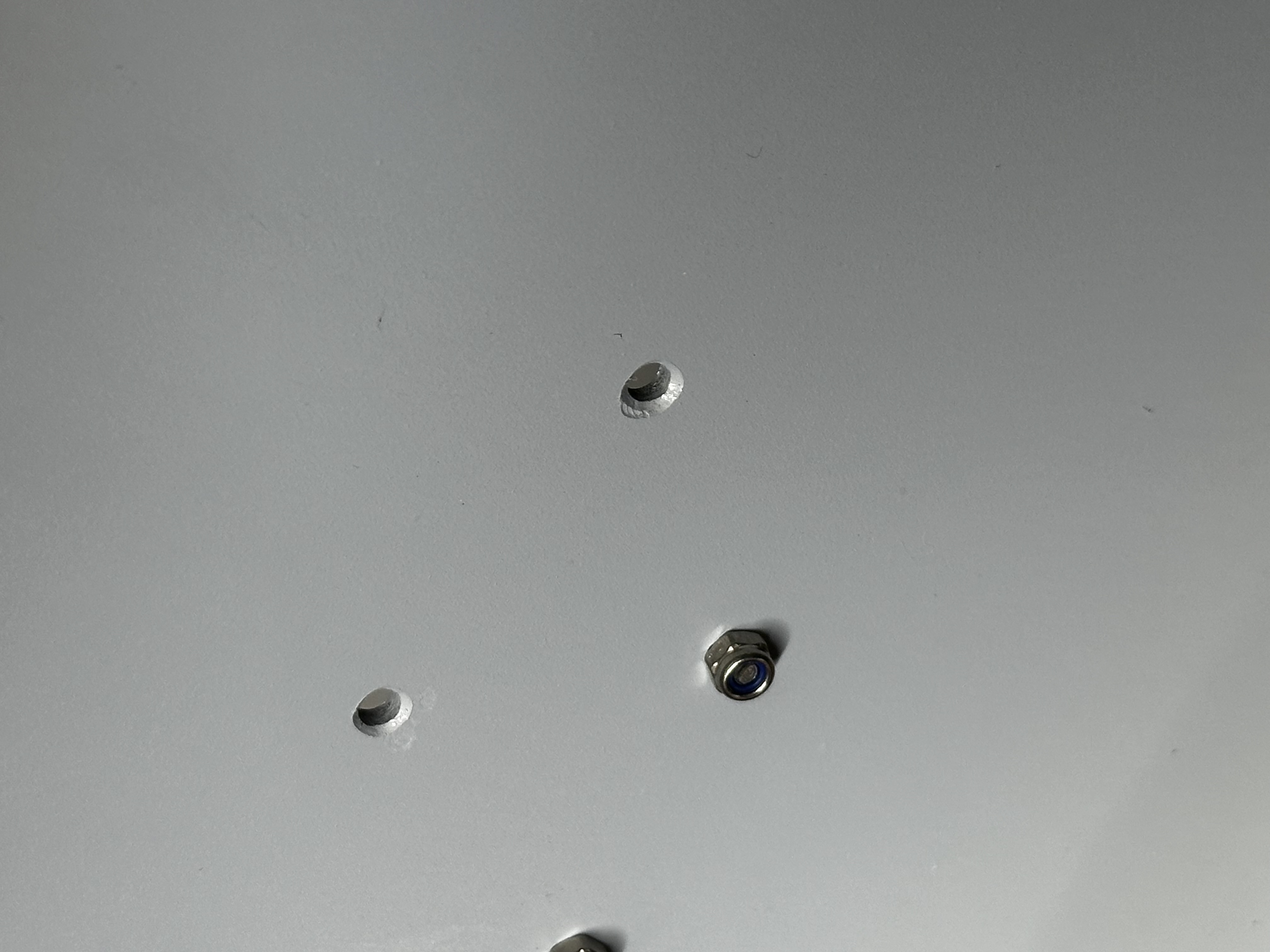

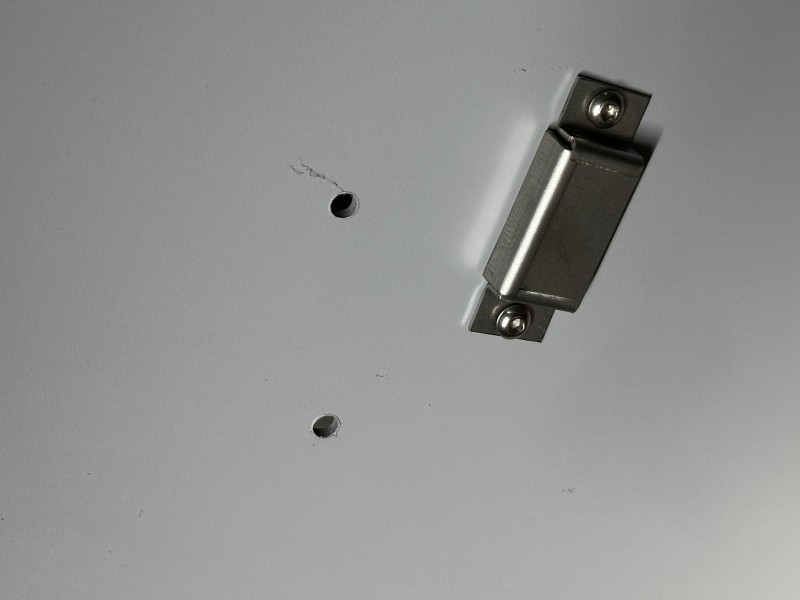

I'd be interested to know if anyone else who has one of the current batch of Early Tigers has a turret deck that looks like this.
From the top side, the holes all look fine: On the underside, nearly all of the holes are washed out. It looks like there may have been some tool wobble or something. These are not supposed to be countersunk holes. Most of them use button head screws. Is this expected?
As requested, here is mine. Took me a minute to find the same four holes.
Some of the holes look pretty rough I agree.... I don't even know what this holds down yet.
Mechanical deburring settings a mm or two off?
Thanks Neil! Most of these are the holes for tool clamps, etc. It's very strange as none of the other parts in the kit exhibit that kind of roughness. I have to admit I'm not really happy with it, but it seems to work OK, albeit with the fasteners digging in a little more than they probably should. If it had to bear any kind of load, I'd be more concerned but it certainly doesn't seem to be up to the quality standard of the rest of the parts.

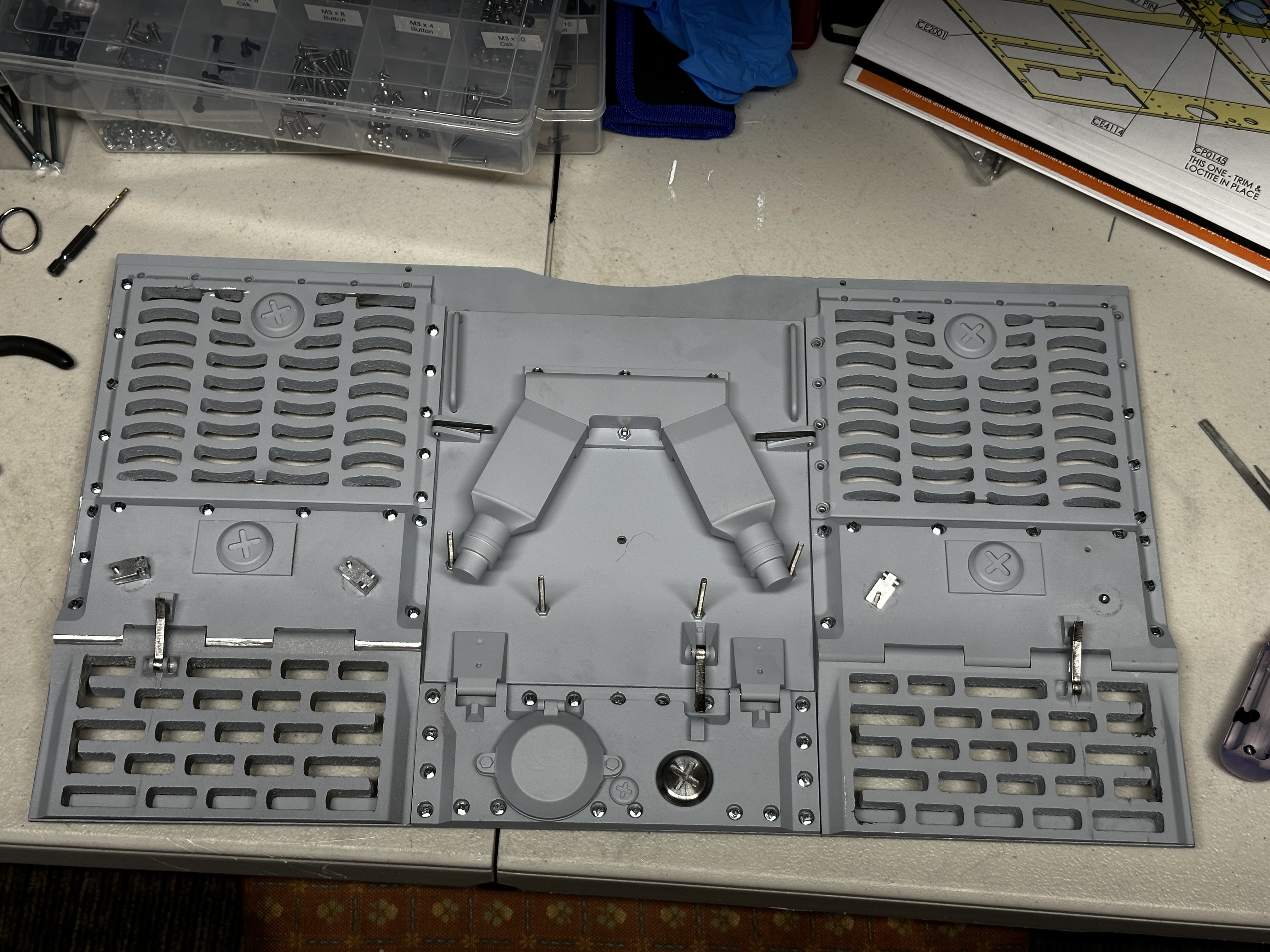

Been plugging away on my engine deck the last couple days. I have a few more screws to put in, and a few to change over to the nylon locknuts I bought, but this bit is just about done for now. I'll get a good final primer coat on it, then put it aside for color until Spring rolls around.
I decided to superglue the vertical studs on the tow rope clamps. They are free to just spin if assembled as per the build guide, and I didn't see how you'd ever tighten the wingnuts. I'm testing one at the moment and will do the rest if it works out well. I also didn't like how tight the fit was on the clamp top plate where it had to close over the screw. The provided hole is a really tight fit over the stud. Looking at the real Tiger, it appeared that those clamp tops were slotted, so I did that on mine. Might end up being a mistake but I'll just buy new ones if it turns out to be a problem.

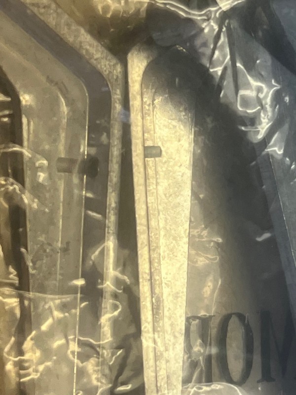

I'm going to try 3D printing a longer hatch support arm for the center hatch, as the one provided just seems to be way too short. I also decided to cut down the excessively long square headed screws where they stuck out too far. Makes things look better, I think.

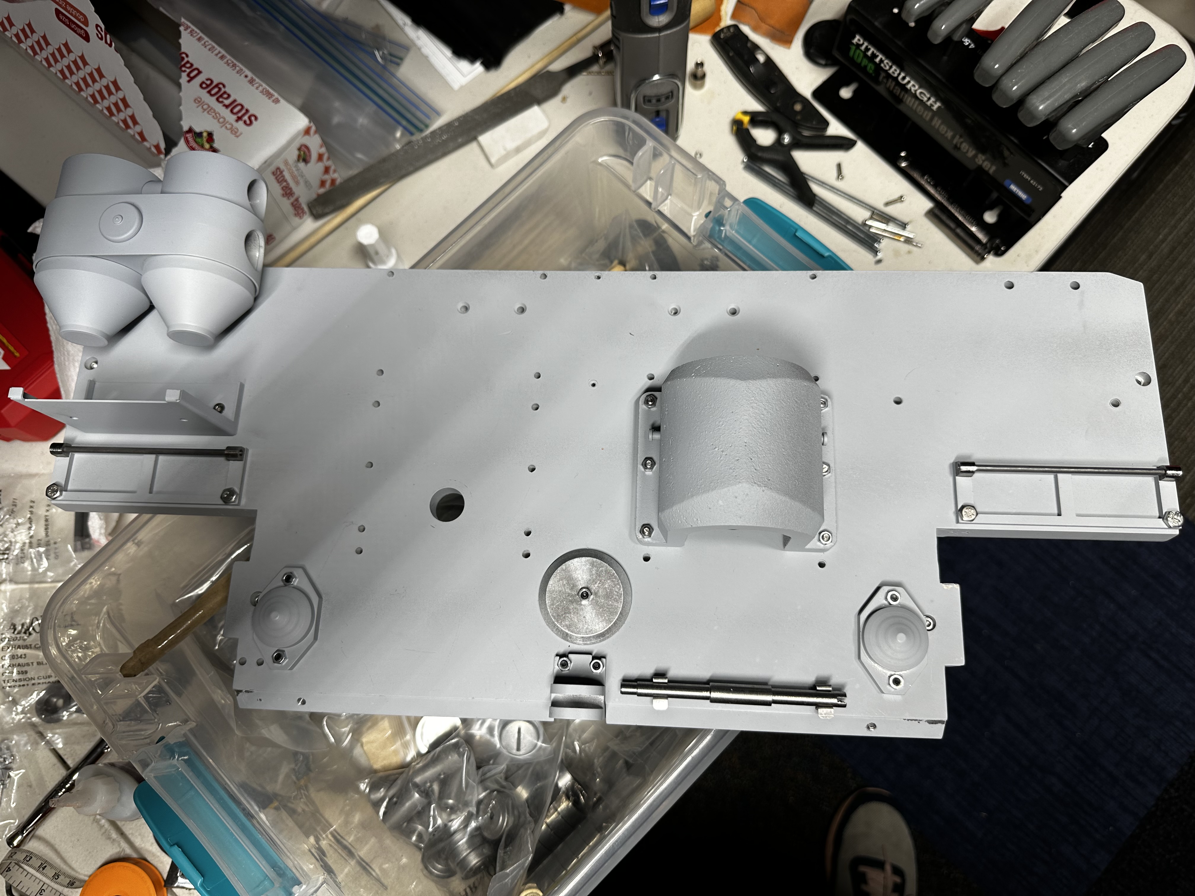

Little to report this time around. I'm pressing on as weather and time permits. 7 of the 8 long axle wheel stacks are now done and I'm working on number 8. All of the long axle hubs are painted so I'm starting on the short axle hubs and caps now.
Along with the ongoing small-part painting, I'll be removing the rear hull plate from my mocked-up hull and will start on the detail bits back there. Front panel details are already done, so once the back is complete, I will do a final fit and assembly on the hull and decks in preparation for a final prime and color coats in the Spring. I also need to look into doing the weld beads, as that will be a new thing to me. I've taken some advice on the forum here and am ordering a cake frosting syringe to squeeze out the bead putty in strings.
Currently waiting on a paint shipment to come in. I've ordered some cream white for the interior to evaluate and picked up some anthracite gray which I will use to dust the tracks. I'll then try some weathering ideas on the spare track links and see if I like the results before doing the running tracks.

Work is puttering along slowly as it's still winter here, though beginning to show some signs of turning. Snow in April is absolutely not out of the question though.
I'm still working on the short-axle wheel stacks and have added most of the detail parts that can be added at this stage onto the rear hull plate. The Fielfel cans on the right, the outer exhaust covers and left-side armor cover are currently in priming and will be temporarily added once they are dry. The mufflers are assembled and primed but not installed as they'll need a different color coat than the other parts. I'm now working on the rear fenders and wanted to get some feedback on these brackets: Would you consider these brackets to be mis-drilled? From the rear, the holes are centered in the flange but from the top, they clearly cut into the sides of the brackets. Is this normally how they would be made? Neil, if you're reading this I'd be interested to know if yours are this way too.
Once the rest of these details are mounted, I'll give the rear panel a primer coat to tie it all together and remount it onto the hull. In the meantime, back to painting wheels and hubs and mounting tires!
