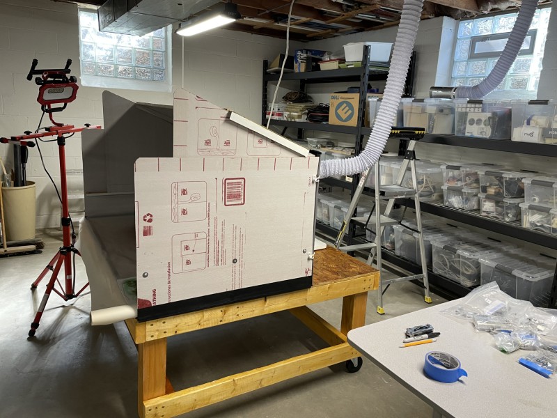

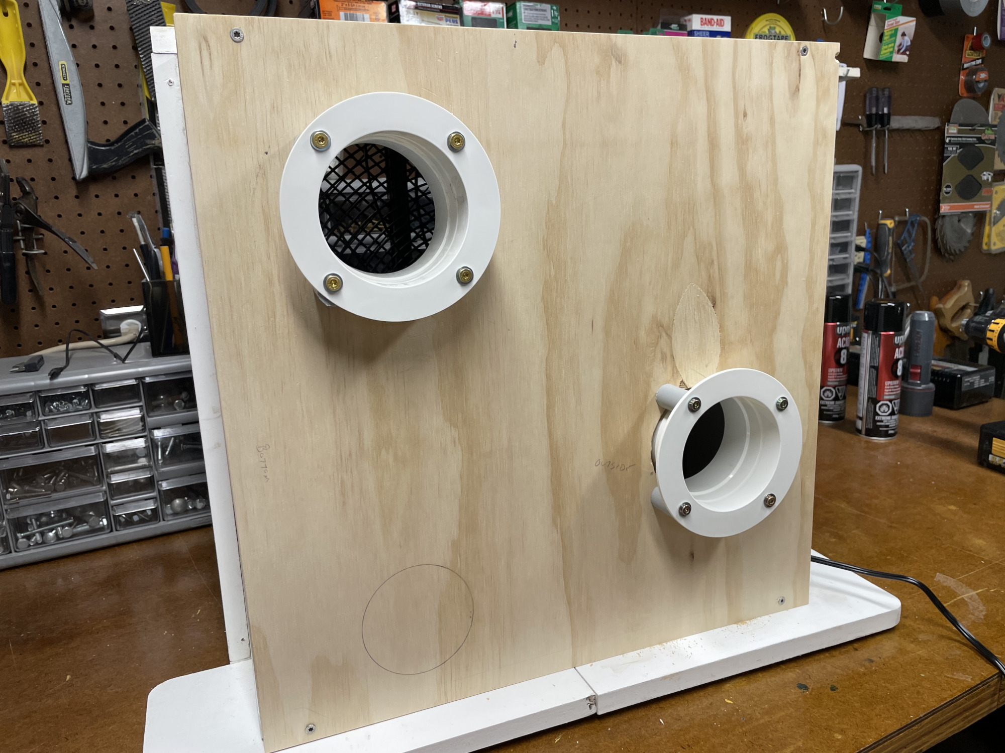

Here are a few pics of the spray booth I fabricated out of heavy-duty coated cardboard (the kind used to protect floors when doing construction).

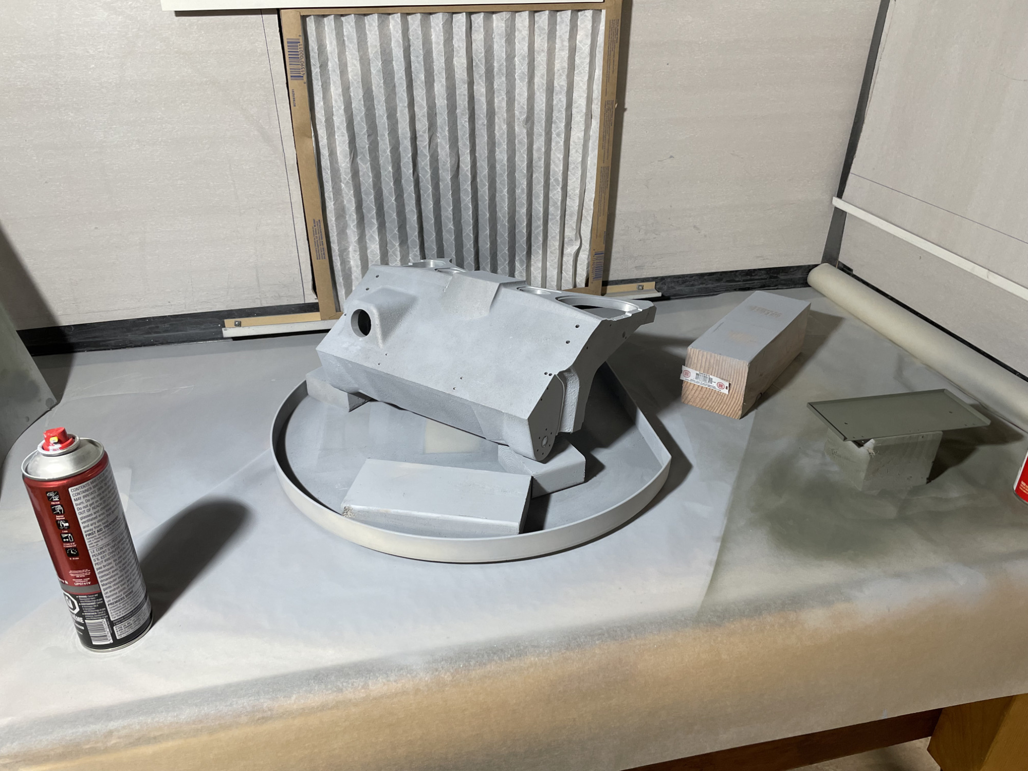

Then I encapsulated a standard window box fan in a wood housing and ported air out the back using standard 4" dryer vent hose and out my basement window. I put a 20 x 20 furnace filter on the input side to filter the paint before it leaves the paint booth. I later modified it by adding a second port for better air movement. The white circular ports are vent disconnects so that I can remove the hose easily from the main booth. This is all standard stuff from big box home improvement centers. I have sprayed almost all the aluminum parts with UPOL etch primer using about six cans so far and there is very little dust in the room. Make sure you get a good respirator, the UPOL stuff is pungent.

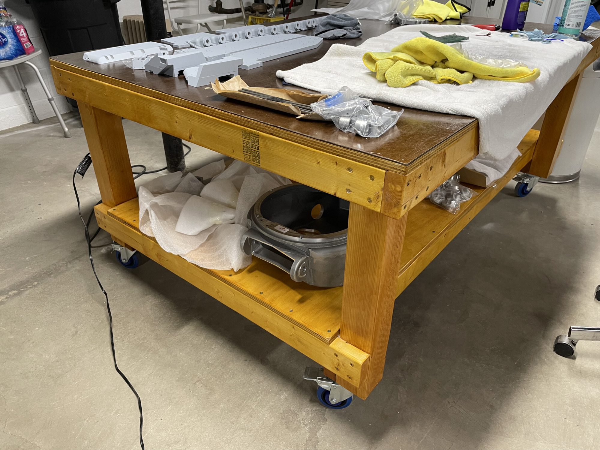

Also a couple pics of the bench I made just for my M26 (my first tank as well). It will have no problem support 200 pounds or more. Good luck with your build. I spent many hours just taking inventory!

Nice job on the spray booth, I must say that's a great workshop you have there. Just a little bit jealous :mrgreen:

We moved into a ranch home a few years ago and it has a full basement. I have a lot of elbow room! And with a walkout set of stairs to the patio my plan is to drive the tank up the stairs on a ramp to the backyard. This is a retirement project for me, so I am taking my time, but it is addictive.

Ray that's a great spray booth! Nice workshop too!
I was going to hang some plastic tarp from the ceiling and make a tunnel to the window fan. I guess I should use a filter so I don't pollute my back yard. I do have some wood from when the house was built. I have a ranch too with a full basement. When they were setting up the foundation forms they said I could get eight foot ceiling and the only added cost would be the extra cement (as opposed to six foot ceiling). Makes a big difference in the workplace.

The only reason I used a filter was so that the fan did not get clogged up with paint. And that filter gets dirty real fast. Your method will probably be just fine. I agree, a six foot ceiling would feel very confined, and I am not a tall person.
Amazing amount of hardware, and taking inventory is a great way of getting familiar with the parts in addition to not being disappointed later if something is missing. I am starting with week 2 of the process and have not connected one part yet. Almost done priming all the aluminum parts, but have also spent time deburring and taking off sharp edges that I think would look better with a small rounded edge.

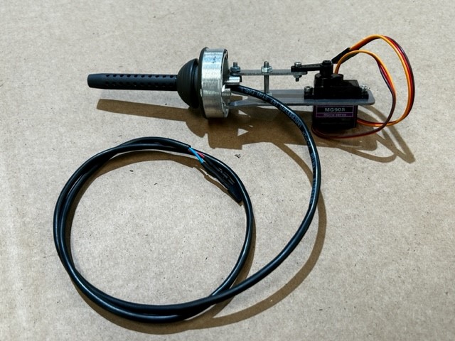

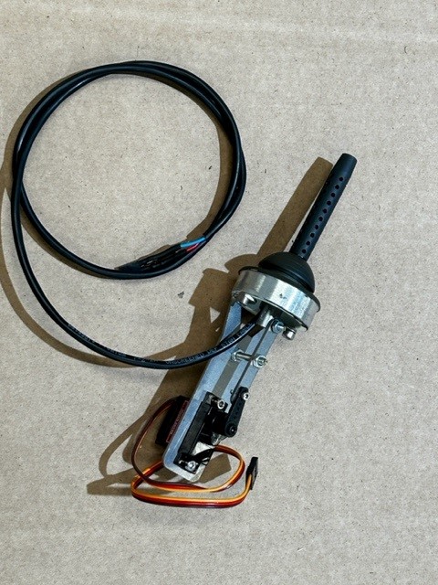

We are getting close to finalising the Pershing option packs - the images below show the mechanism for animating and adding an LED for the hull mounted machine gun.
It has been designed to make assembly easy even after the hull of the tank has been built.
Pershing Machine Gun Unit.jpg (91.59 KiB) Viewed 3280 times
Pershing Machine Gun Unit2.jpg (114.11 KiB) Viewed 3280 times
