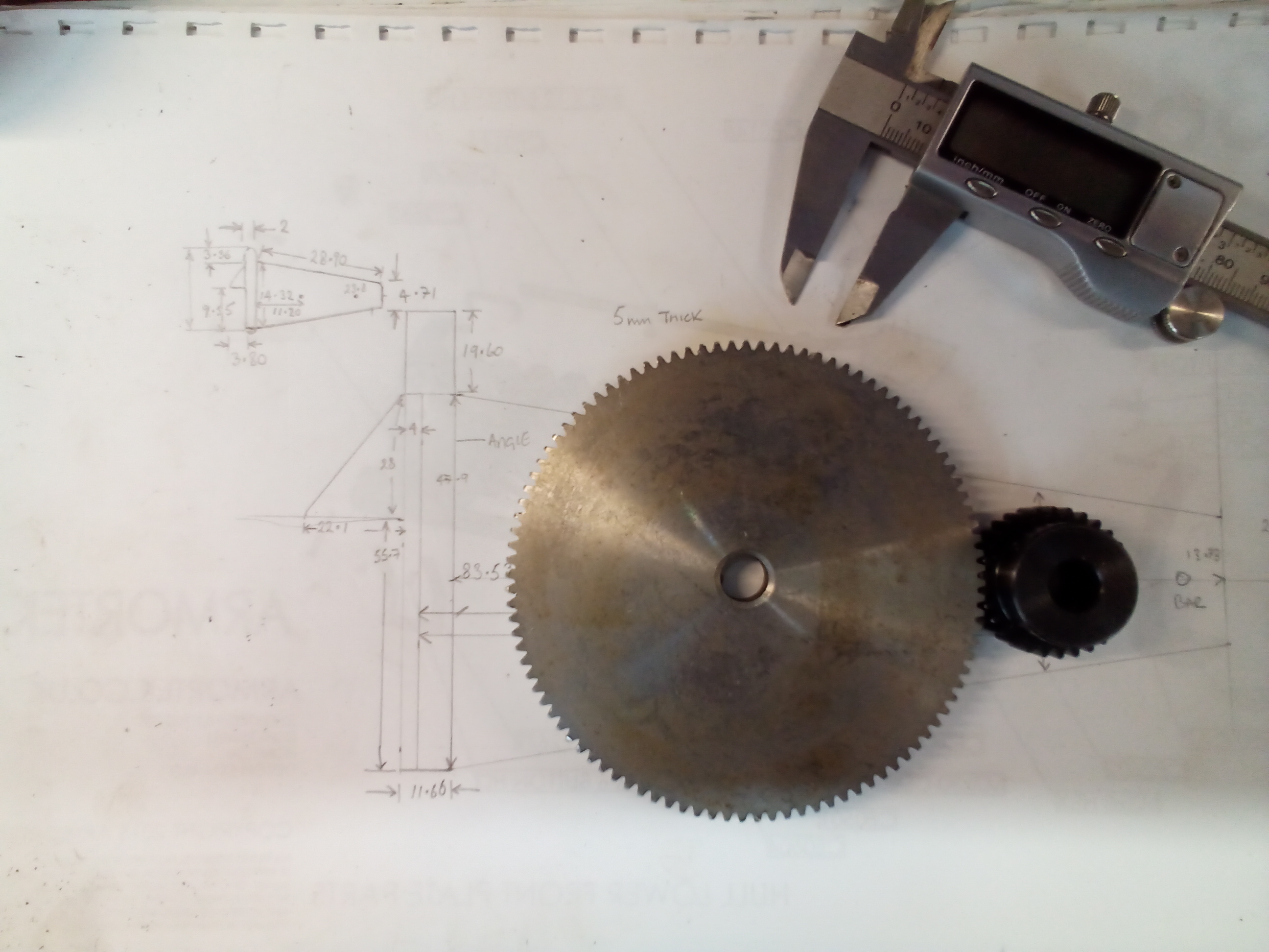

The gears have arrived for the winch, these need milling to create spokes like the original. I've produced the scale drawings for the winch frame, it's fairly straightforward, now do I include a hidden motor and have the two figures cranking away like crazy?

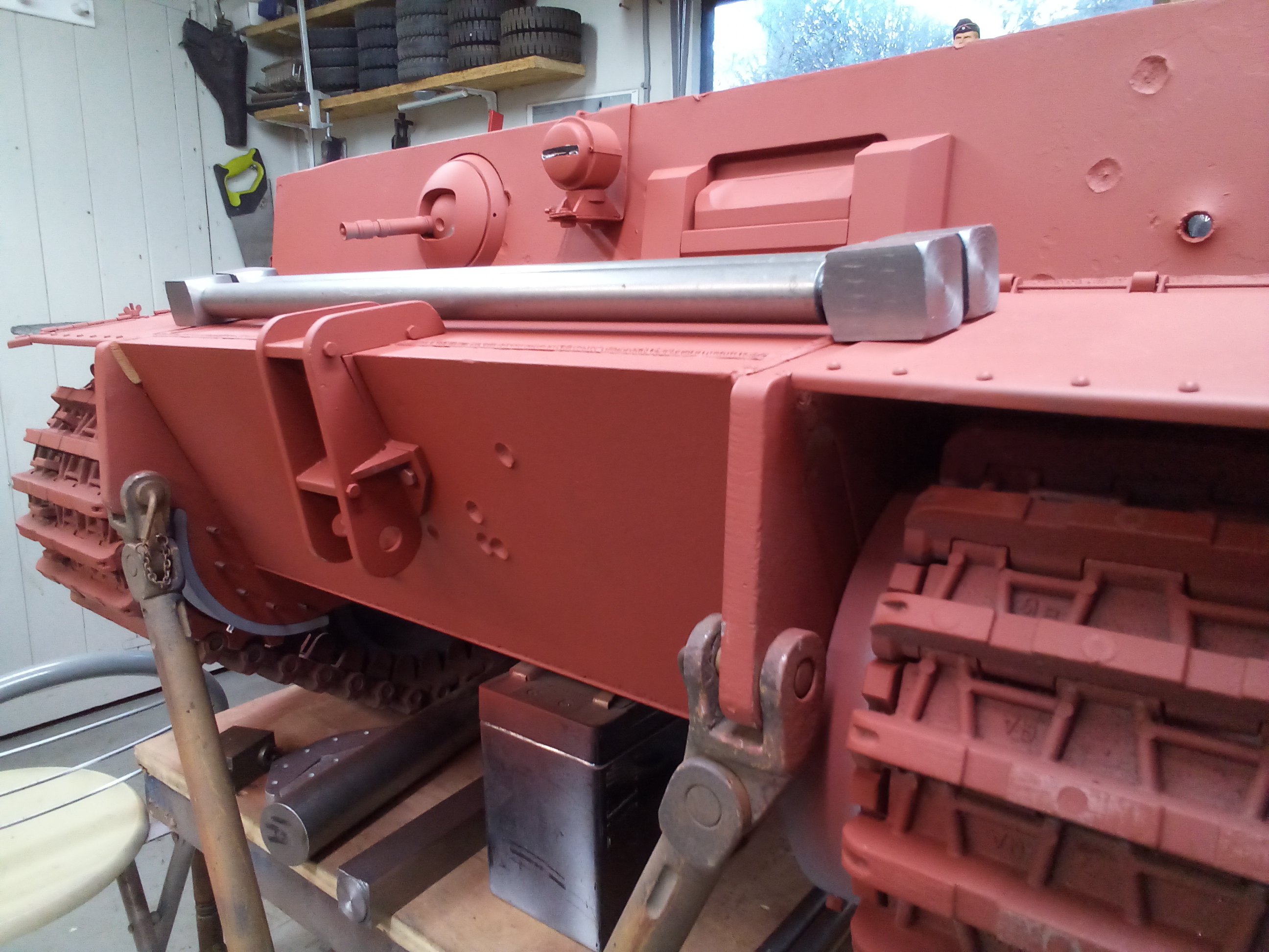

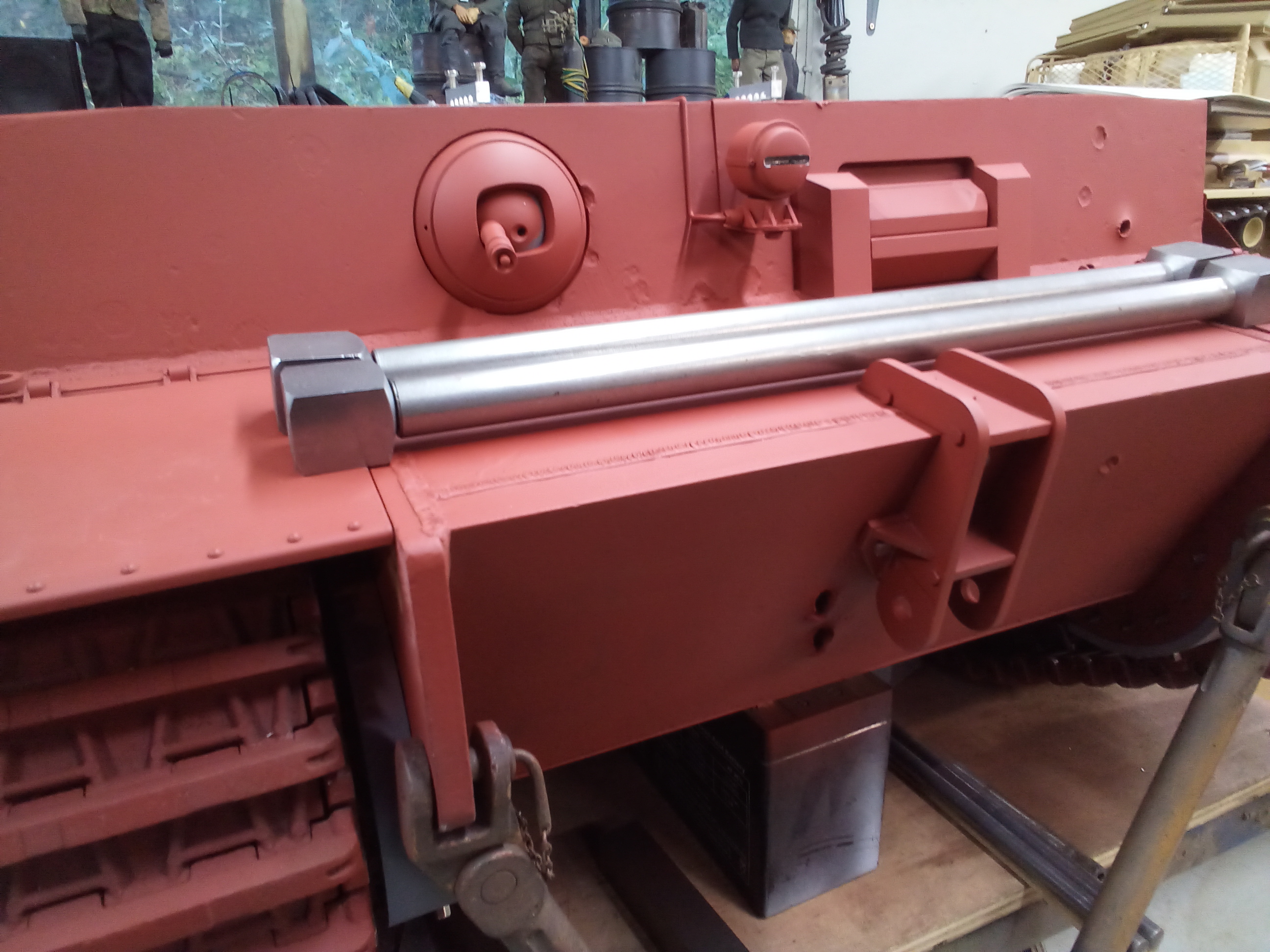

Setting out the tow bars and mounts.
I will use these spare barrel cleaning rod holders for mounts.

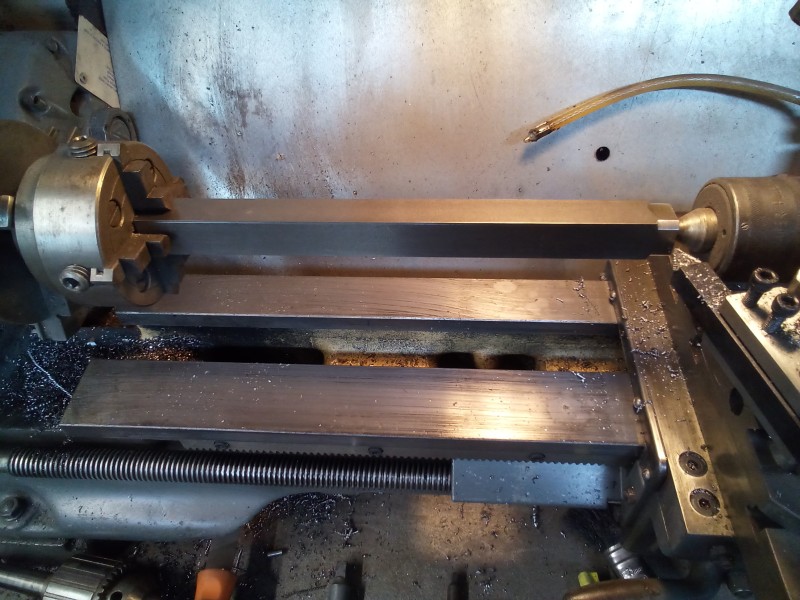

Stock mounted in the 4 jaw chuck.
Cutting the straight tow bar end blanks, two female two male.

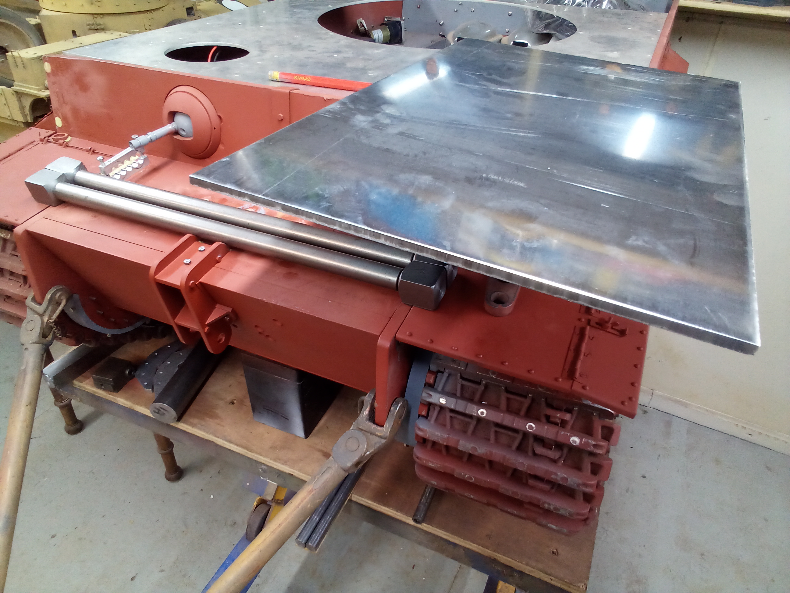

The plate aluminium has arrived for the winch frame, it's scratched to buggery but the company that supplied it have said they will replace it.

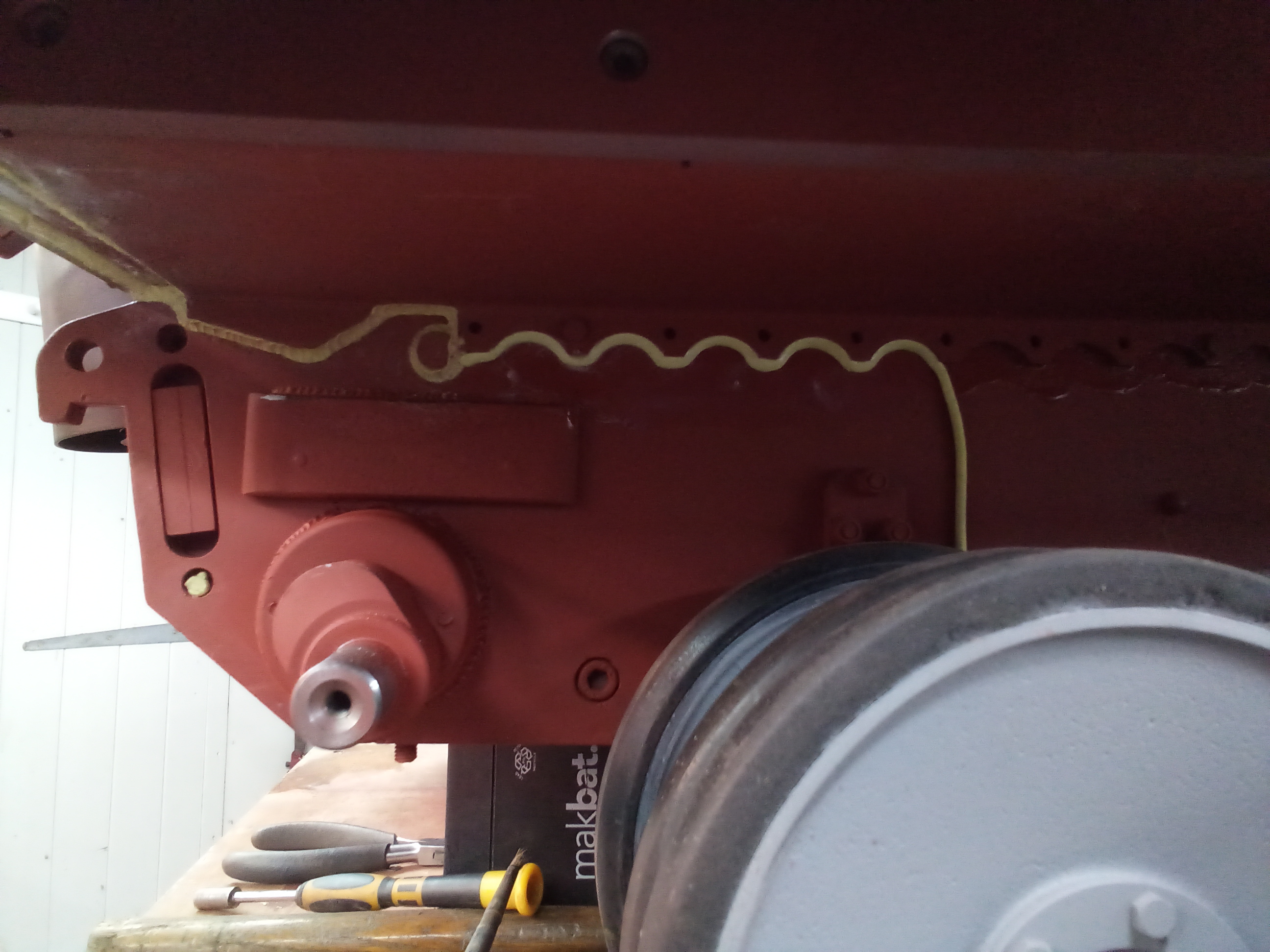

I think all the milliput welds are done, again I'm waiting for the mill to arrive before I can fit the final drive armour fillet pieces.

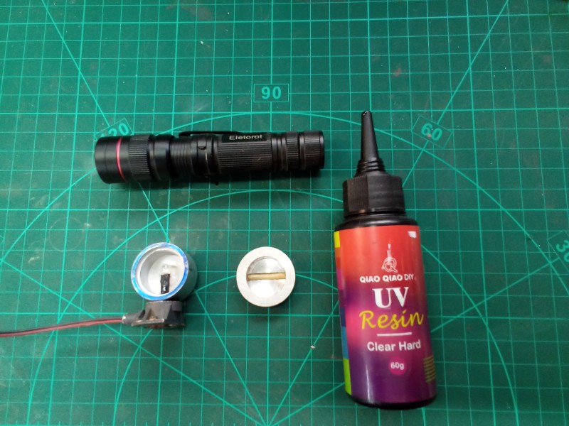

Casting the lens
Casting the lens
The straight tow bars ready for machining on the mill.

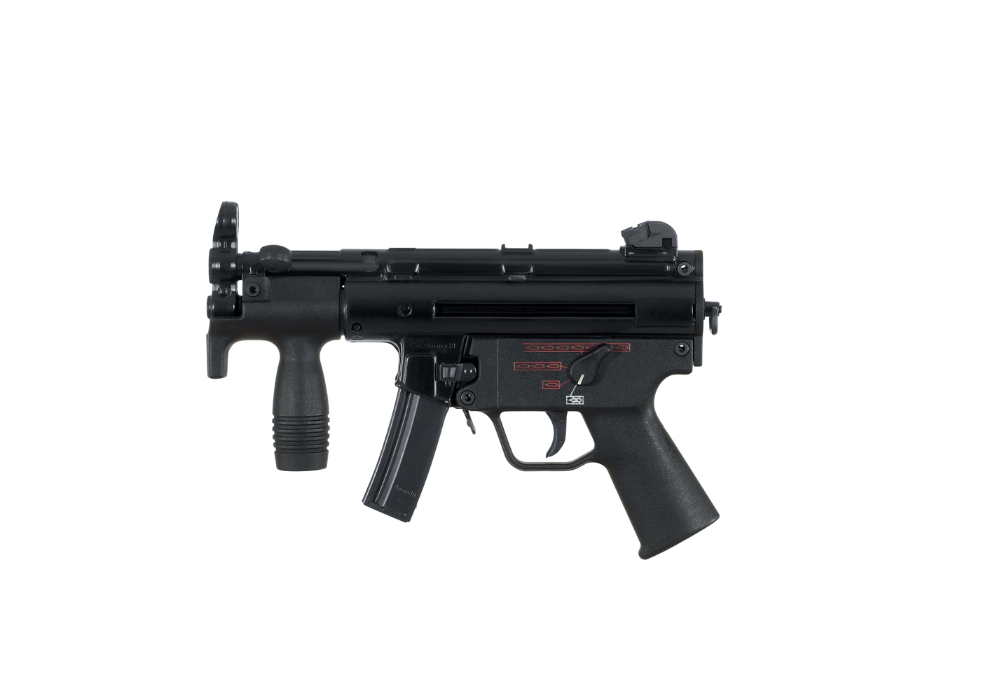

Heckler and Koch MP5K by chance? 8)

Hi JC, yes HKMP5K 9mm. The example I was using allowed the brief case to be discarded, you carried it in the left hand with the barrel facing to the rear, it was pre cocked, set to fully automatic with the safety off! When a threat was identified, you dump the case by squeezing the handle, lift and rotate your arm so the rear of the weapon rests against your sternum, at the same time your right hand grabs the pistol grip and away you go with 2 short bursts. To begin with it feels awkward but you got used to it.

This brief case was one example, it could be fired from the case but was awkward and needed to be held against the stomach using 2 hands as the top handle recoil would rotate the weapon downwards.

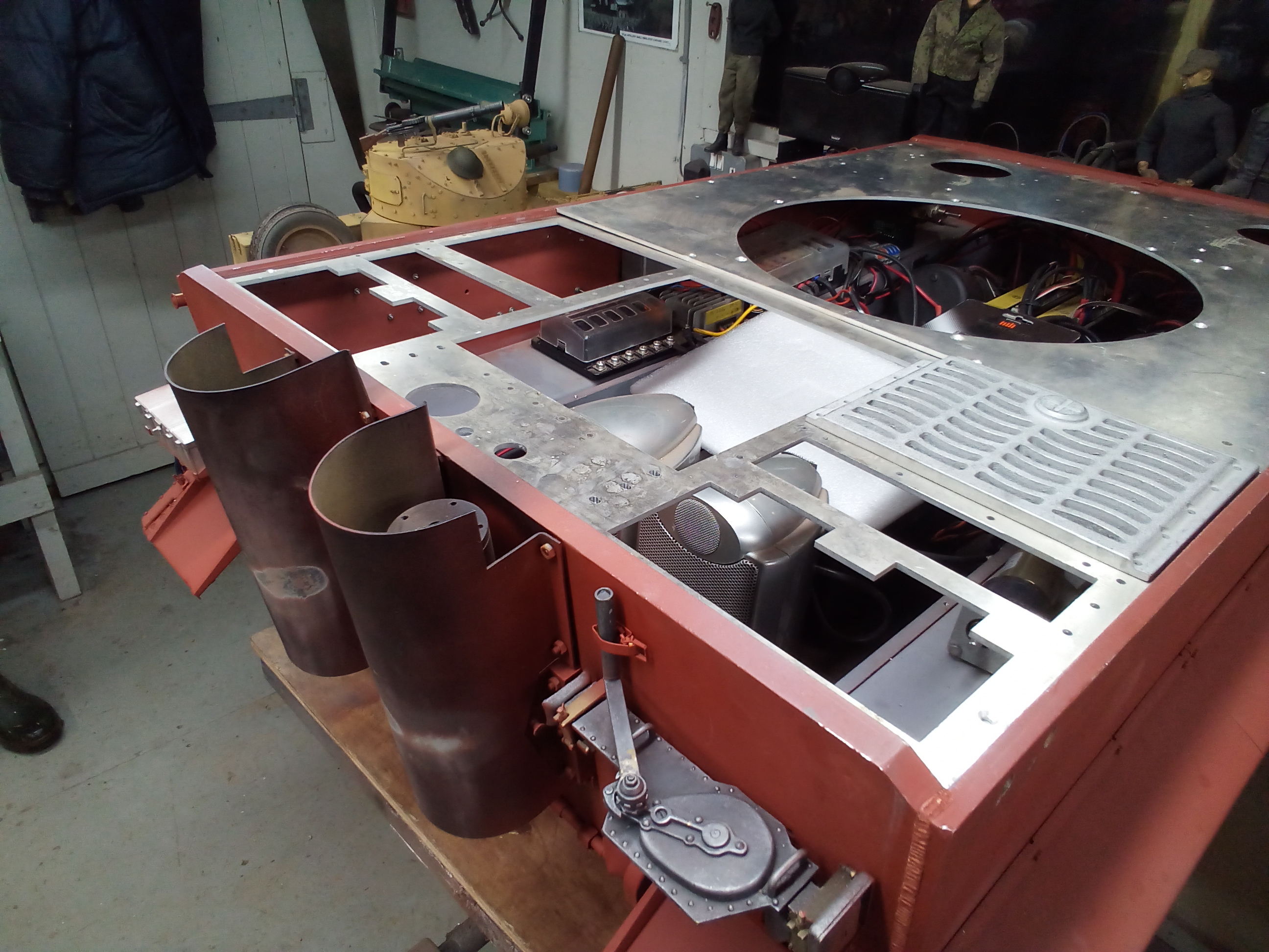

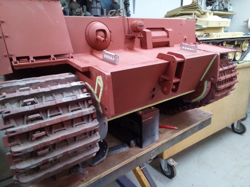

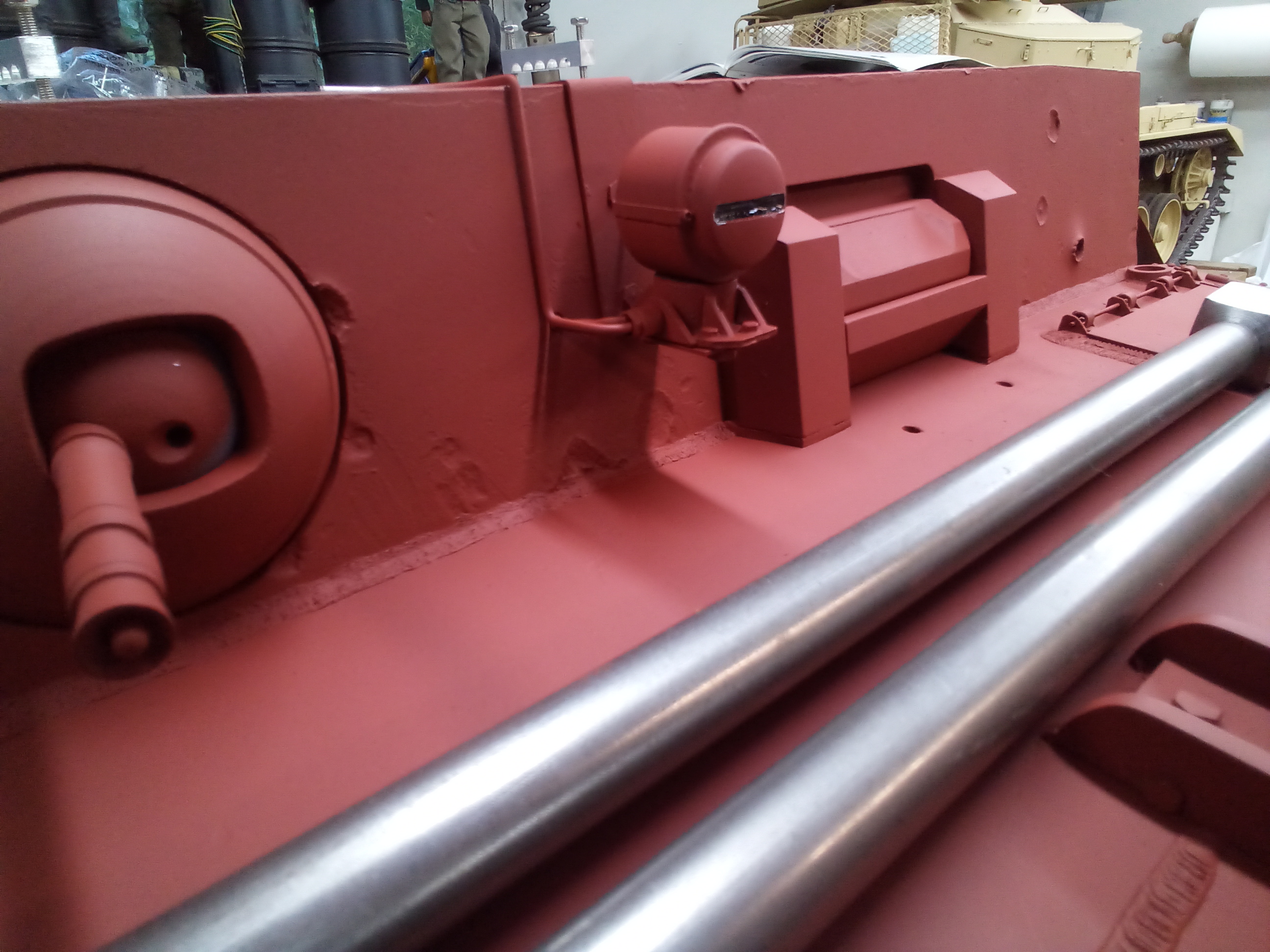

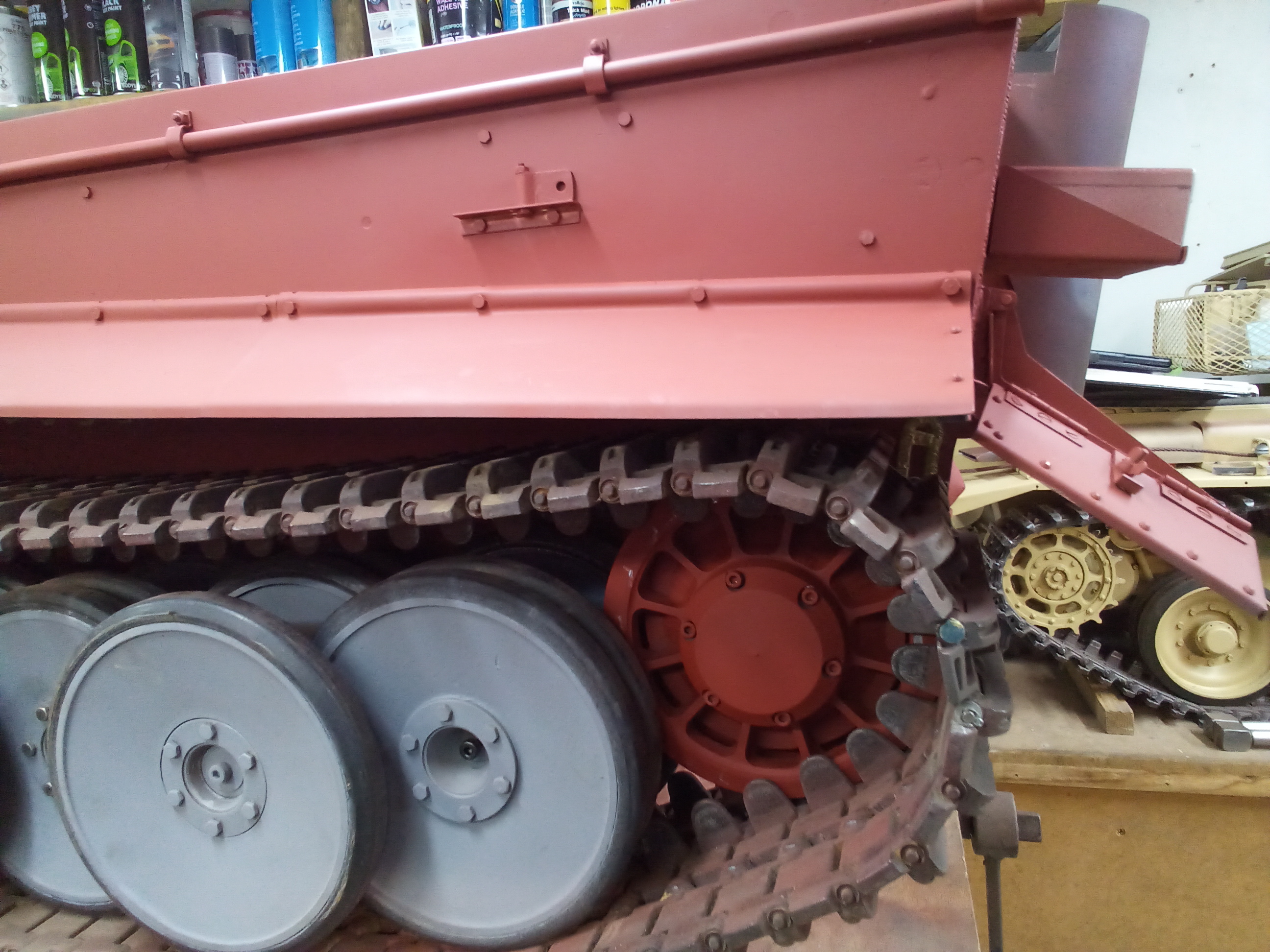

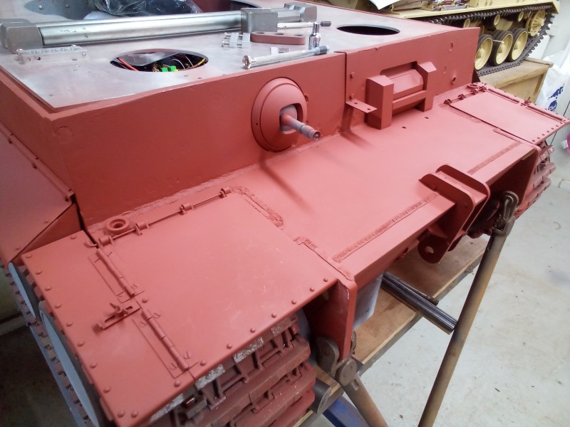

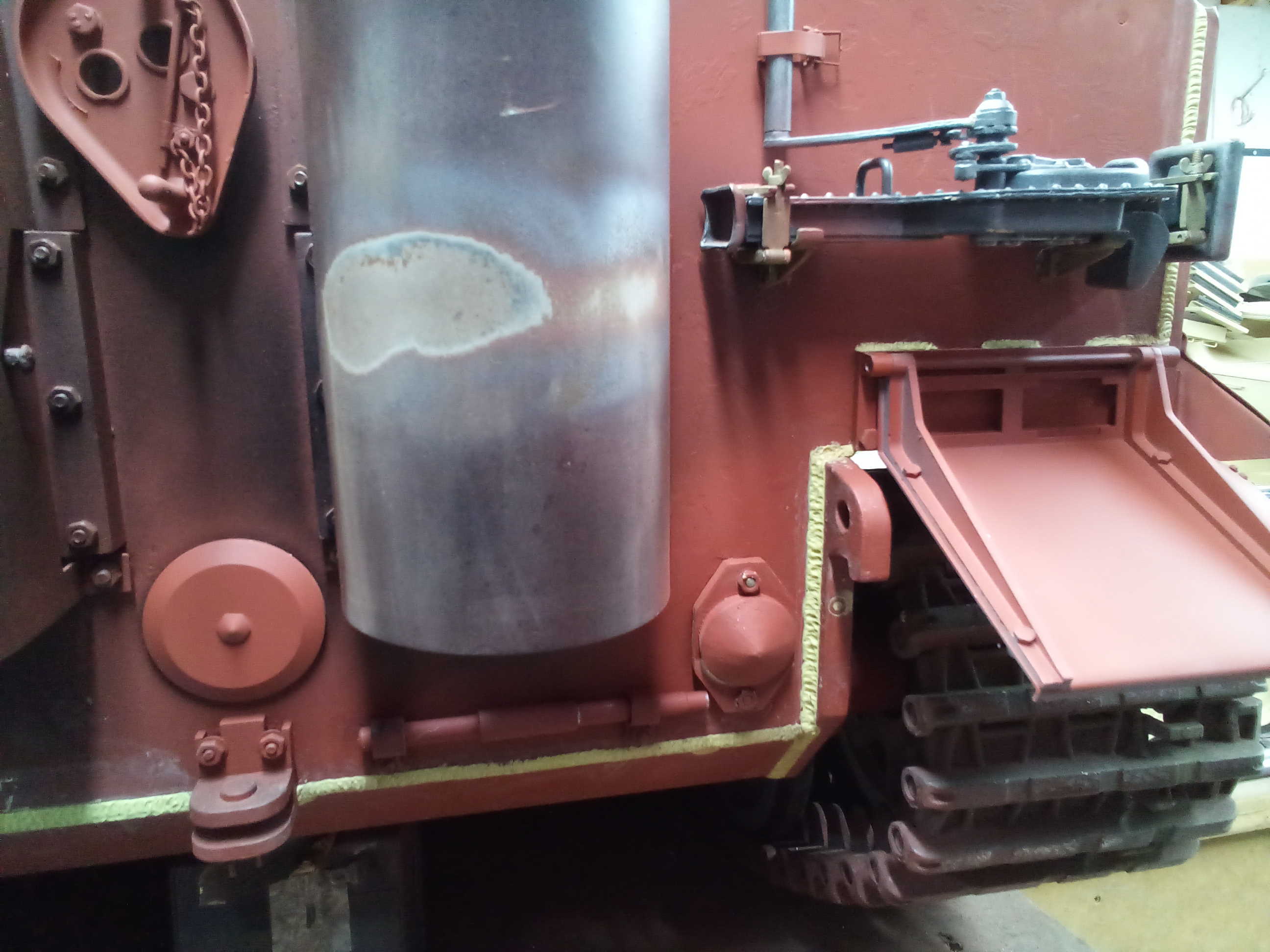

More weld seams to the rear and the pannier fillets, I love this work.
Thought of the day, "I really don't want to buy a mattress topper, with octasprings or without bl..dy octasprings!"
Spot the tip, it's very small but very necessary.
When the mill arrives! I shall spend some time improving the tool box, like removing the lid, making a new lid, machining out the solid box, fitting working hinges, locks and straps and filling with useful tools.

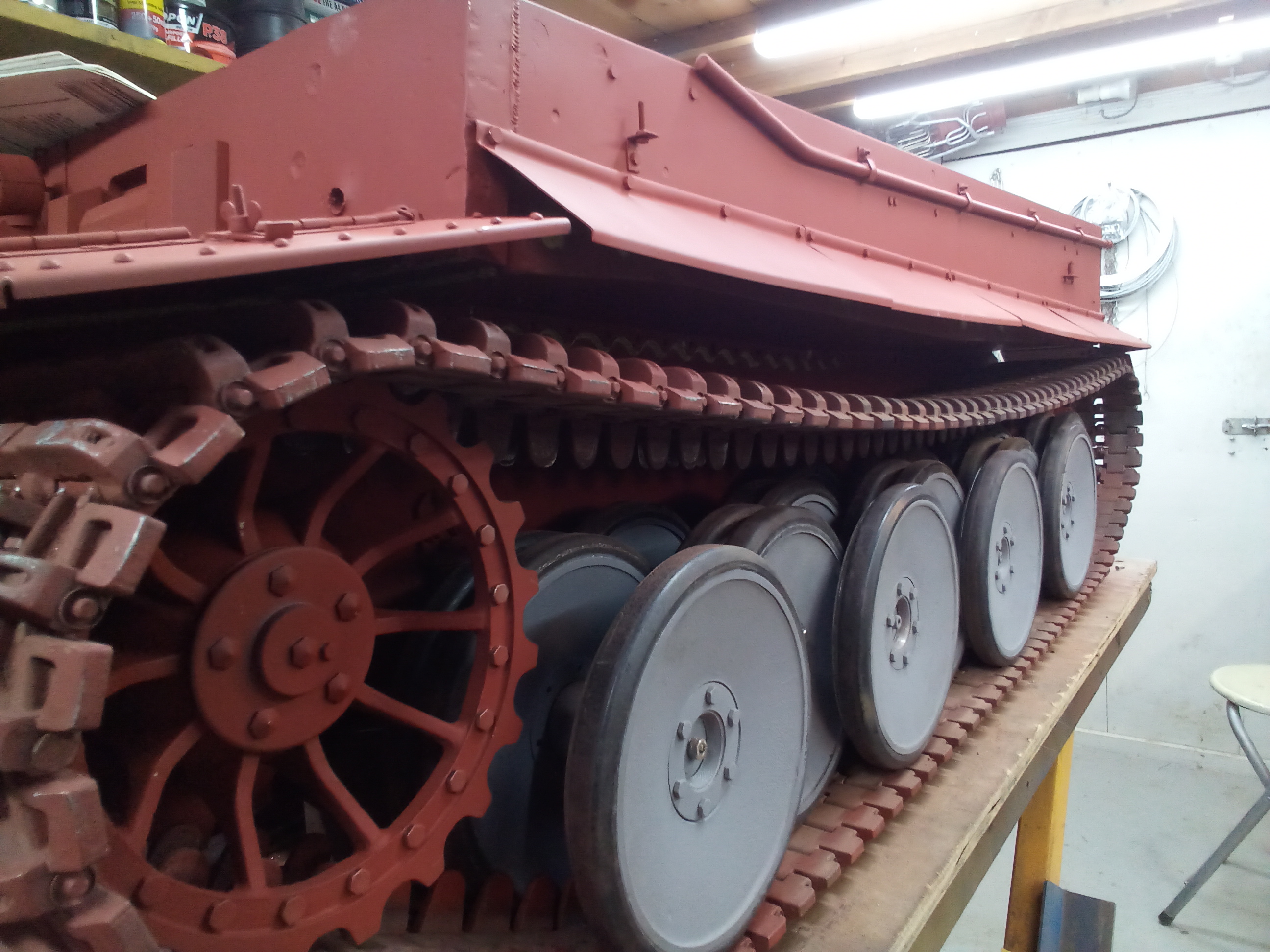

Awkward work this, really should be done before the wheels go on and the motion packs are fitted, that way you can easily flip it over.
I've printed the top fillet sections, which I shall fit sometime.

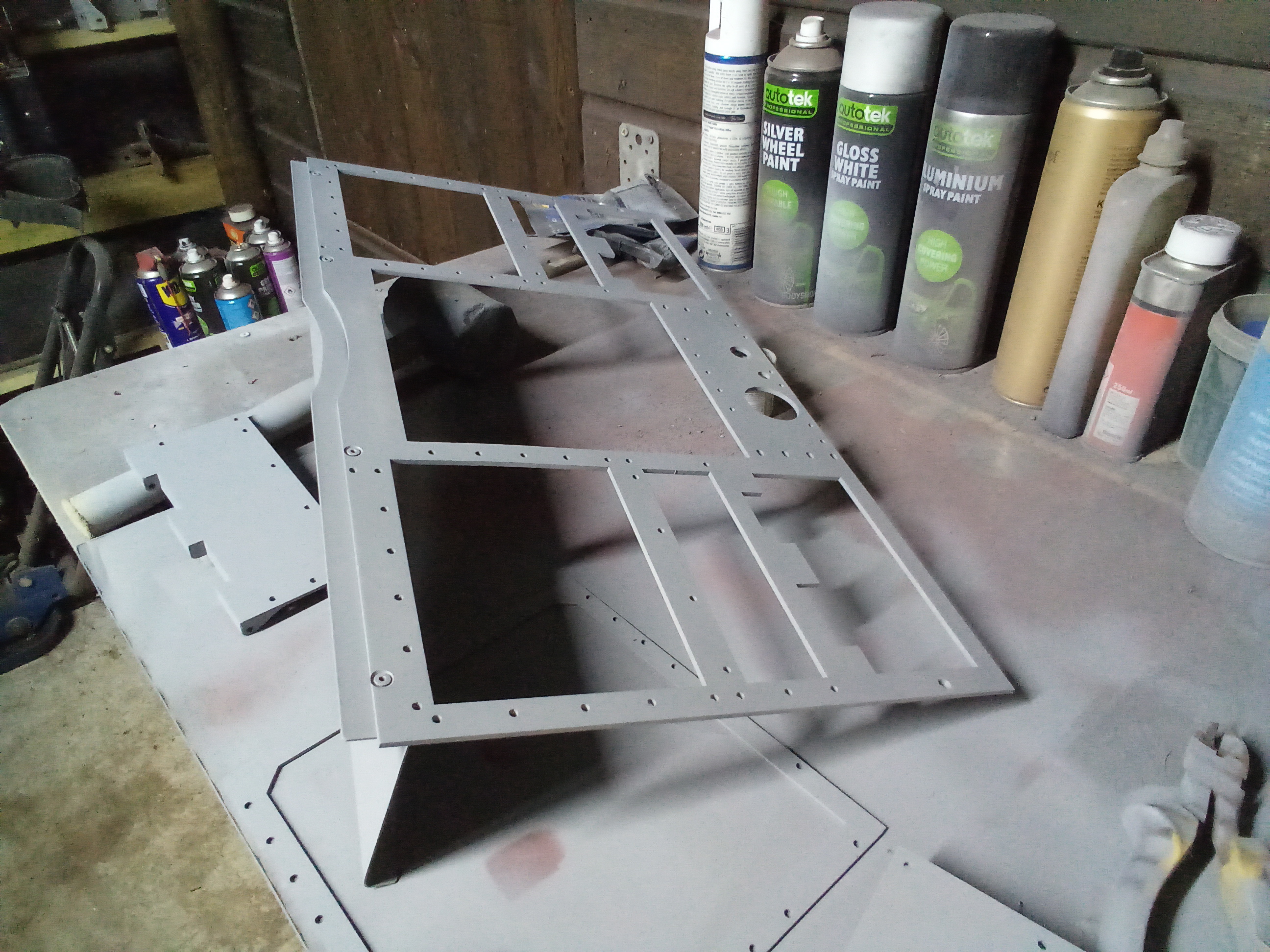

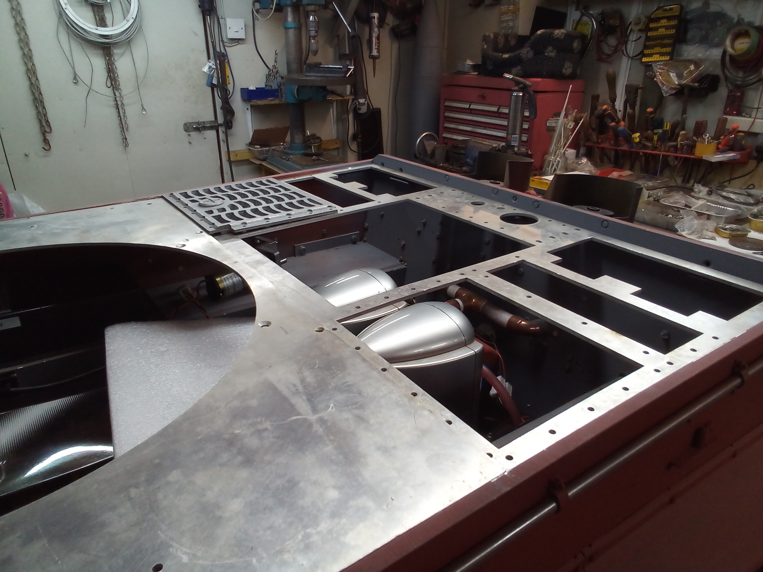

Lowering the rear deck.

The rear deck continued.

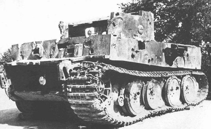

A range target! I reckon I could restore it.

The rear bulk head made from 1mm sheet steel, I don't plan to fit a "half maybach" just yet.

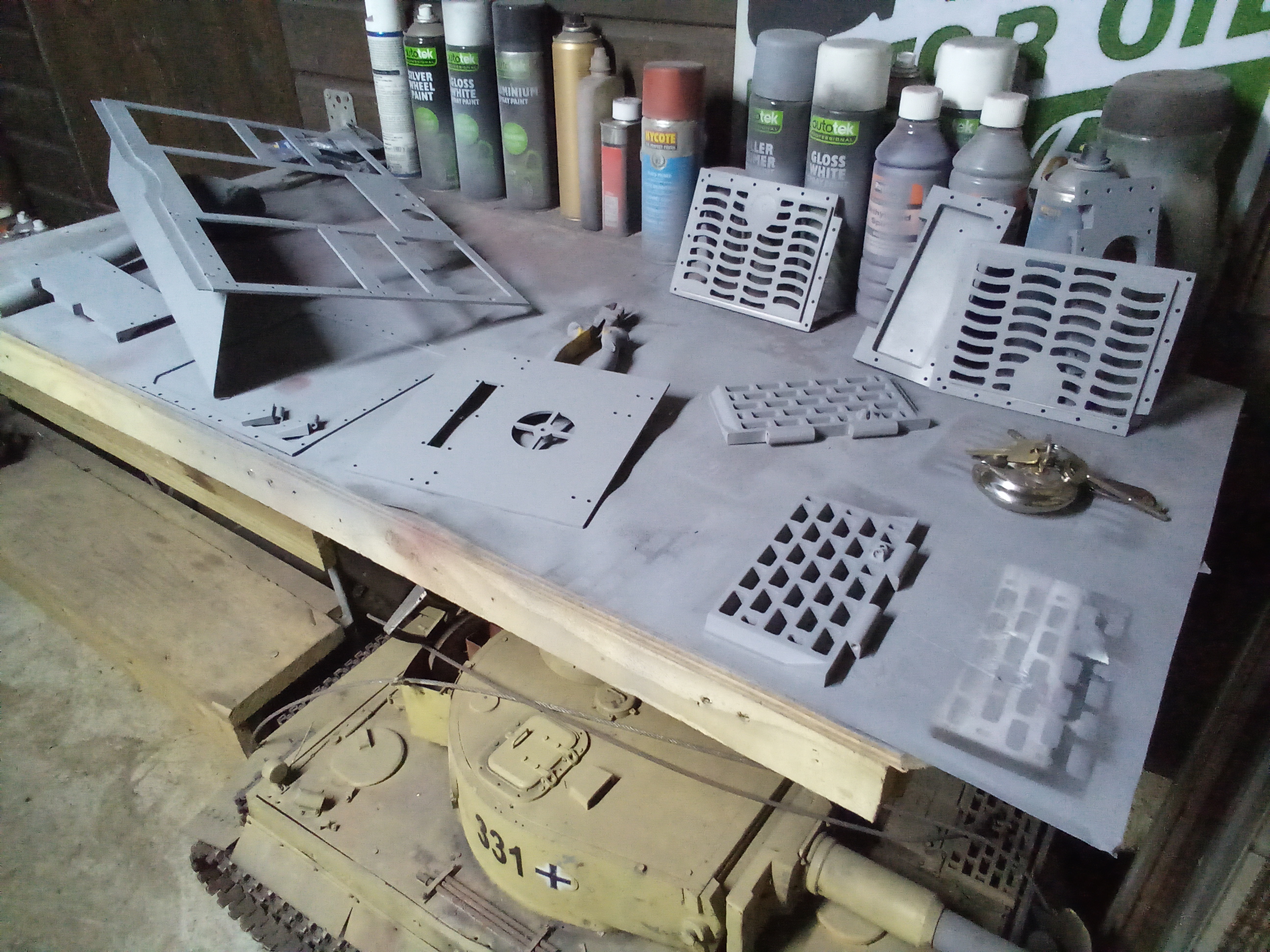

Painting the parts at this time of the year is fine so long as your not in a hurry, you get a good "flow out" of the paint but it takes yonks to cure.

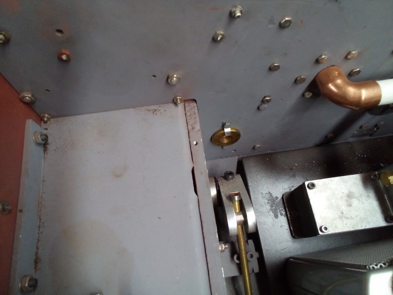

I like to make this assembly easily removable for obvious reasons.

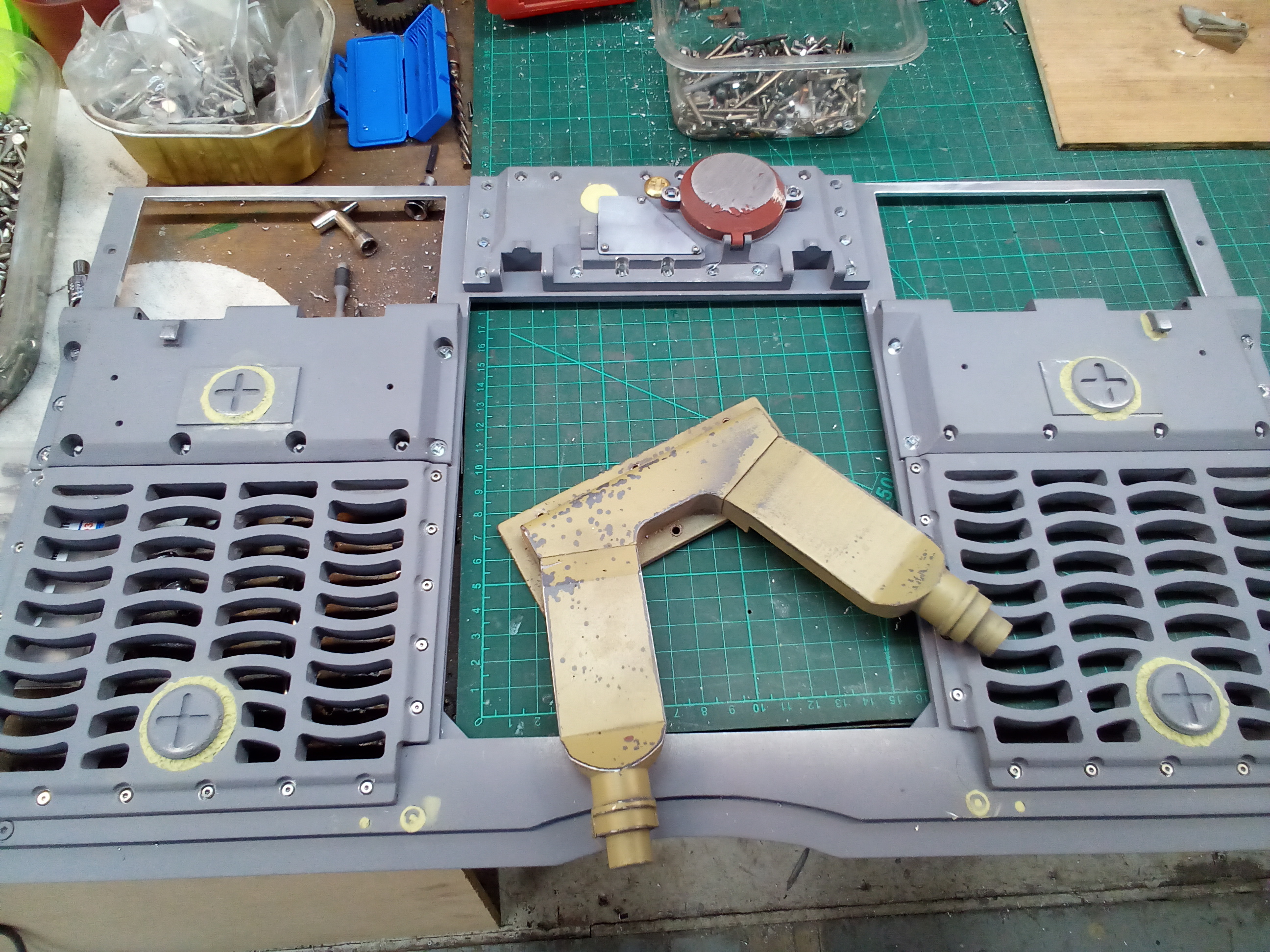

Printing the rear radiator hatch detail pieces.

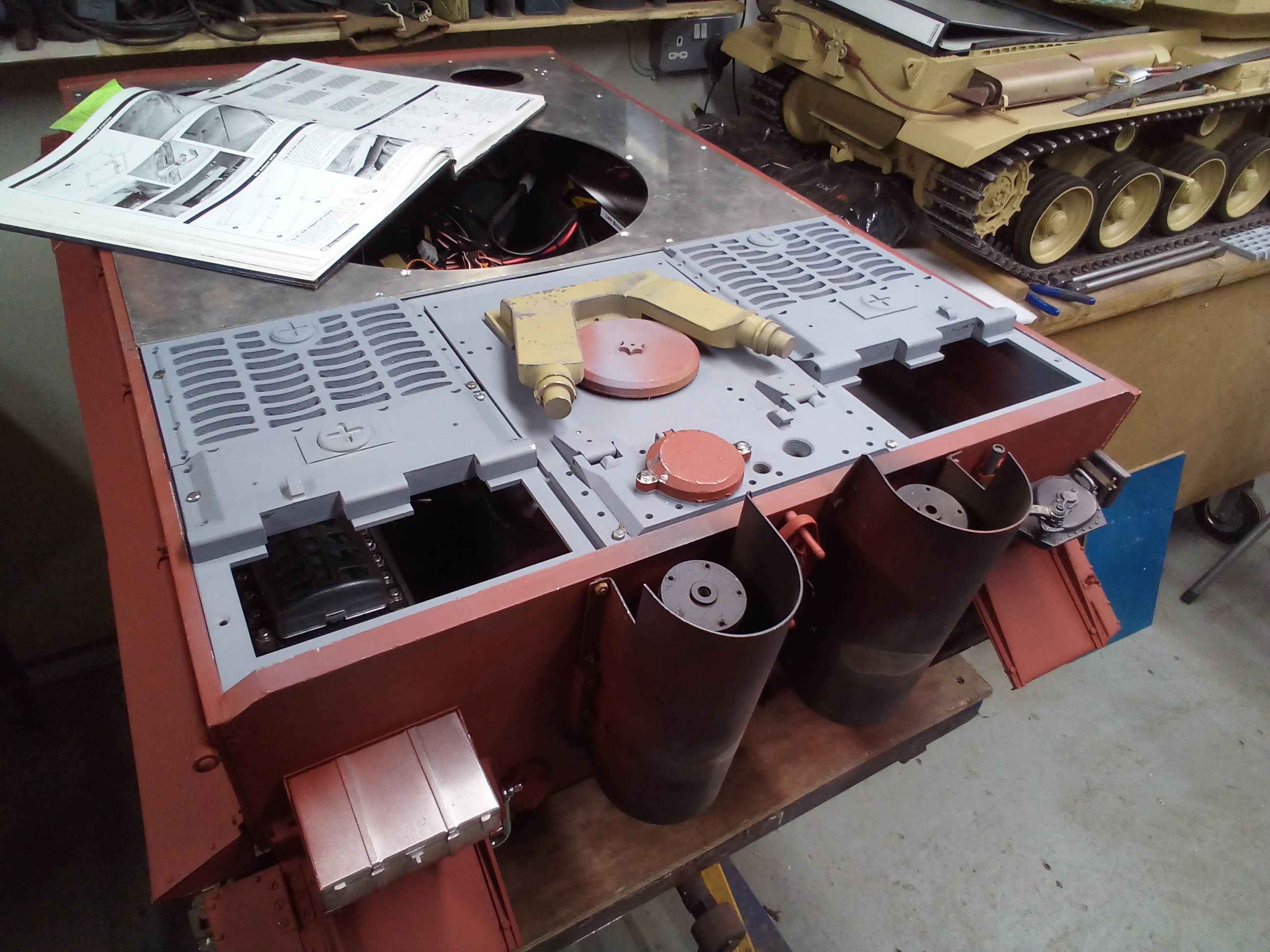

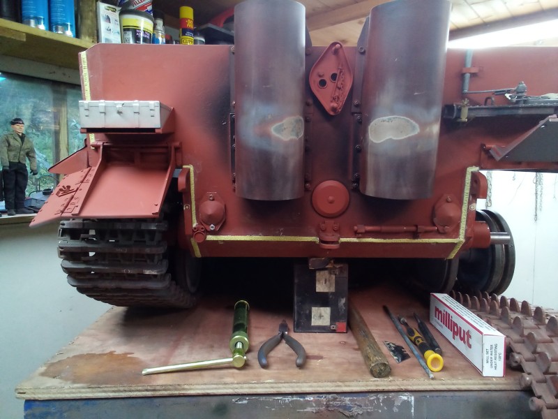

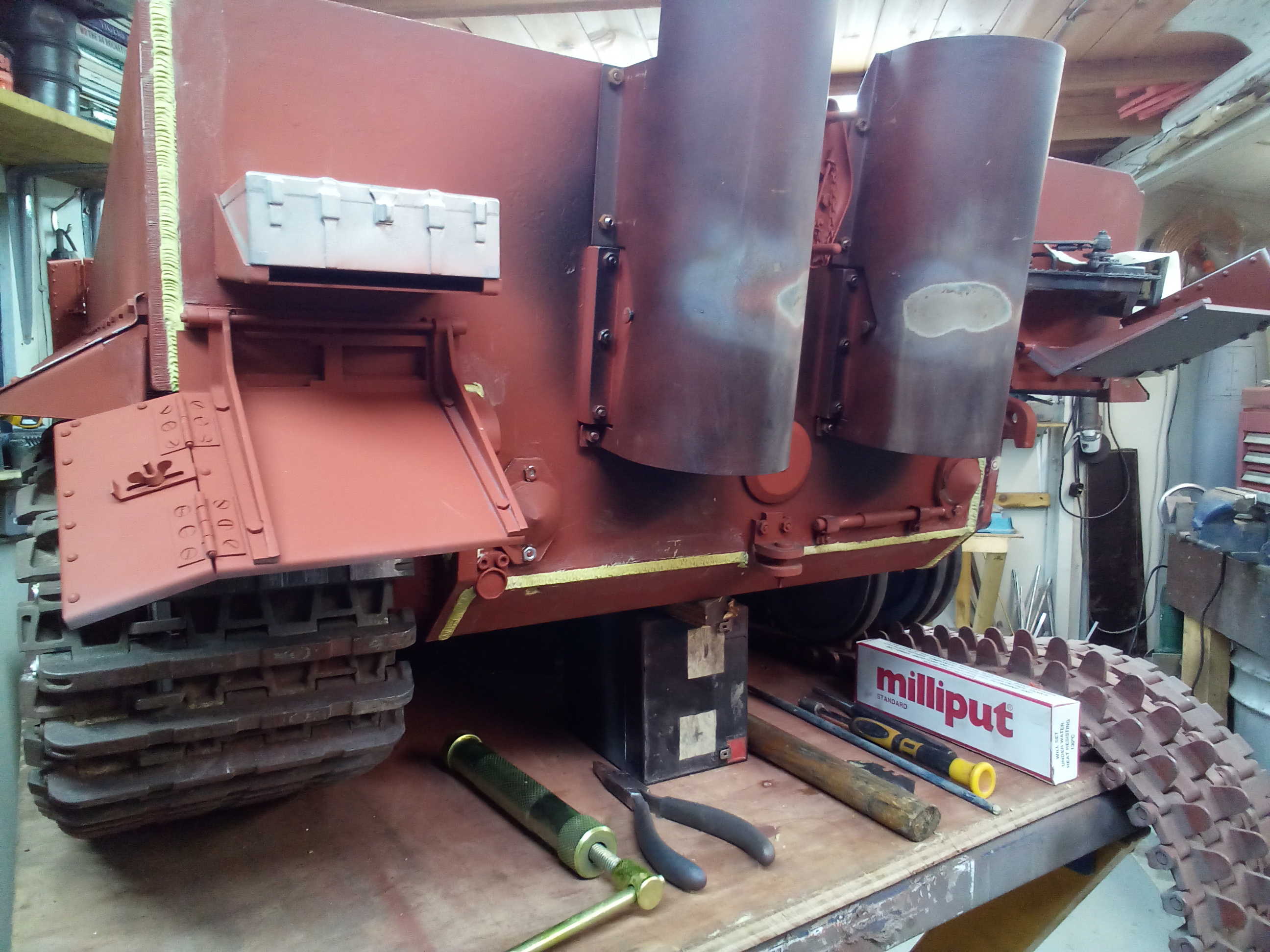

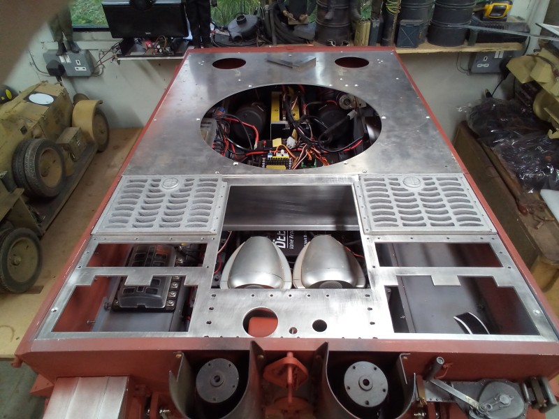

Louver hatch add on. You have to cut a fair bit away from the rear deck frame to get these to fit.
Milliput you can't beat it you just need patience.
I think I'm going to use this old early air intake to add some interest.
Nice Gucci tetra extinguisher.
Spot the incorrect hatch.

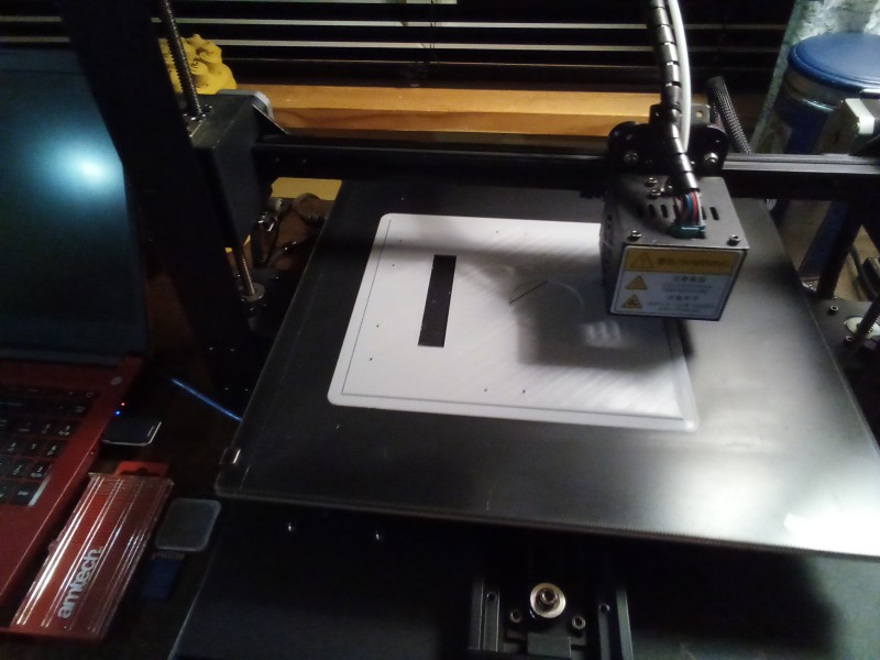

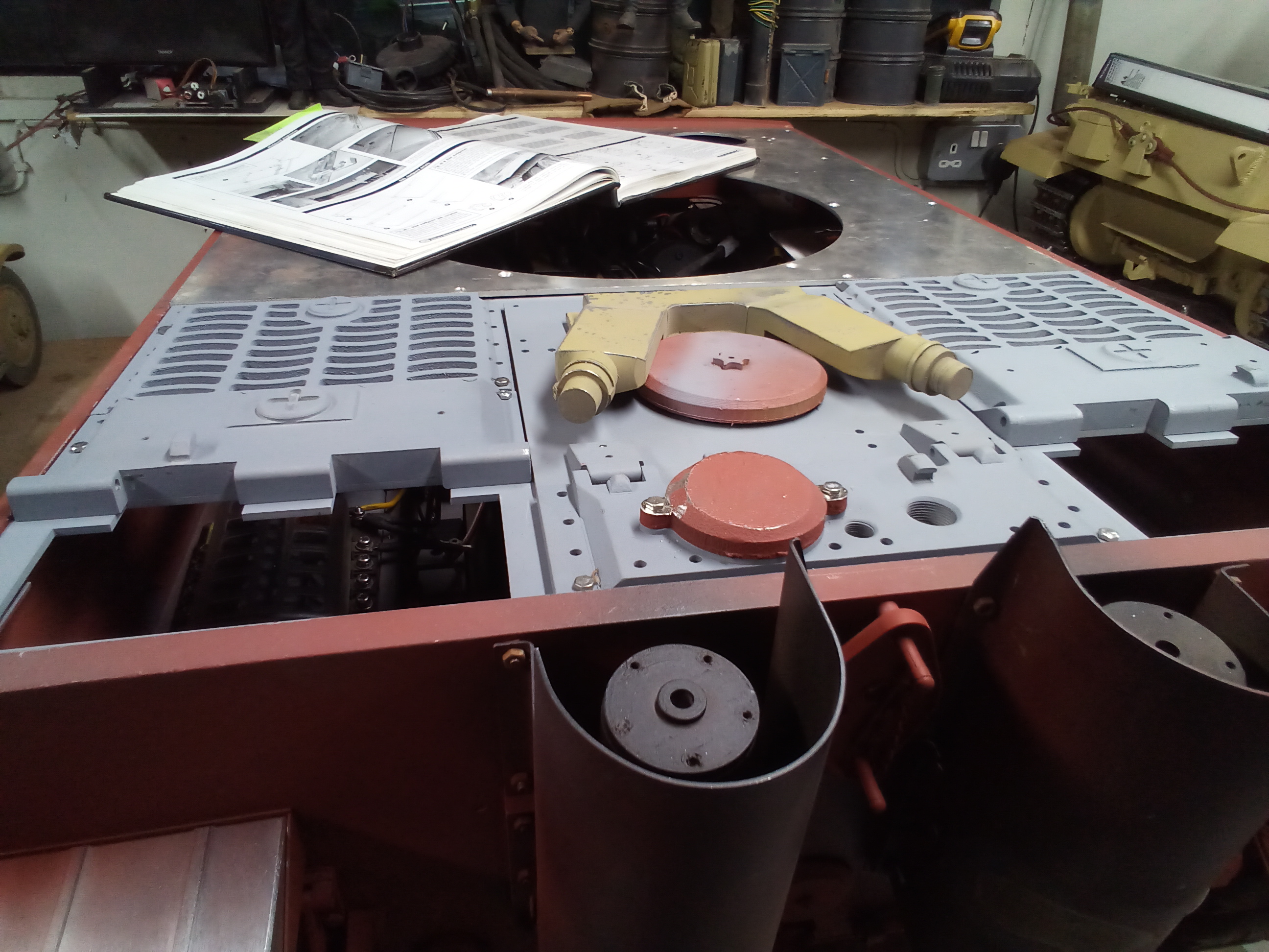

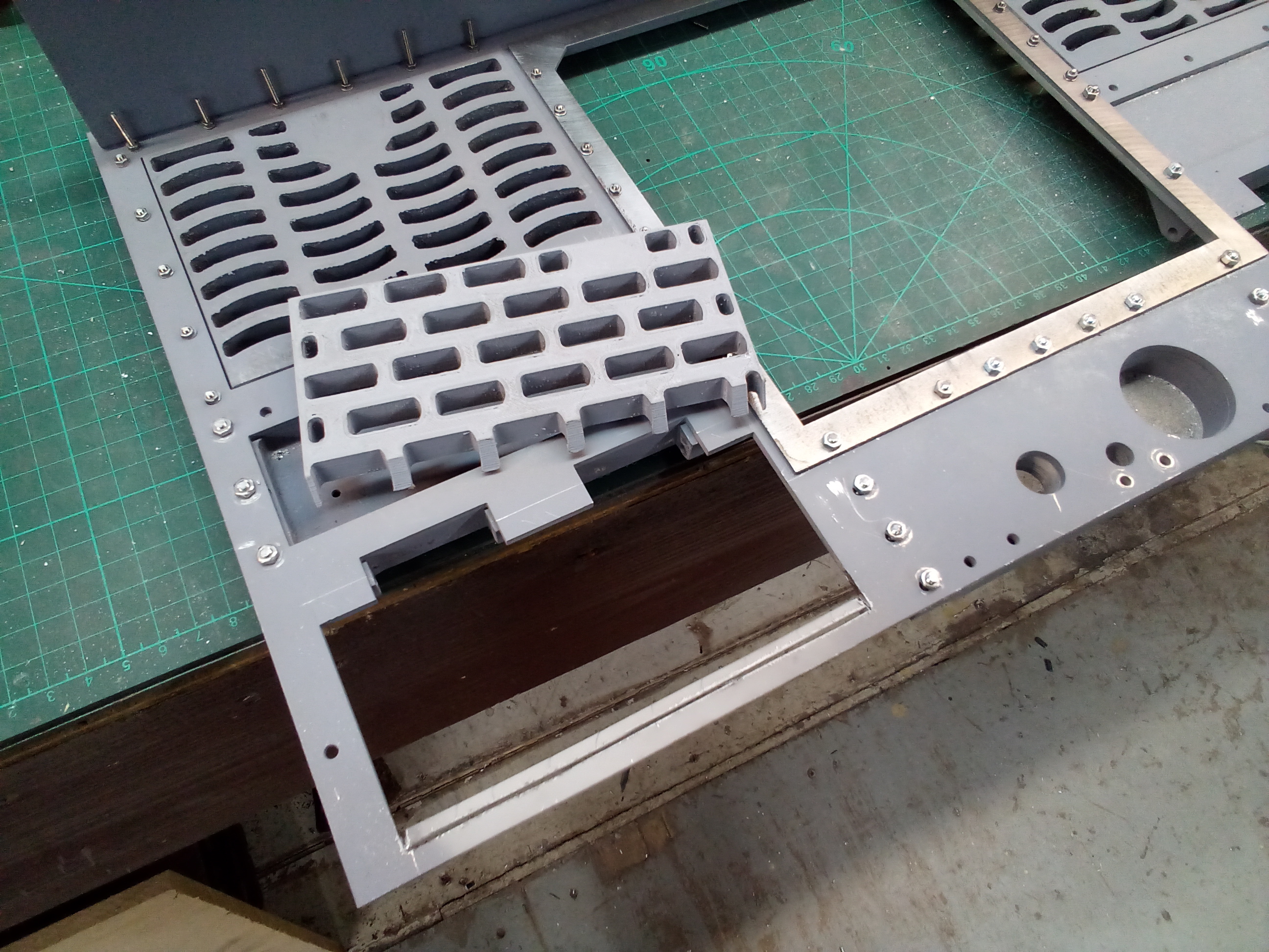

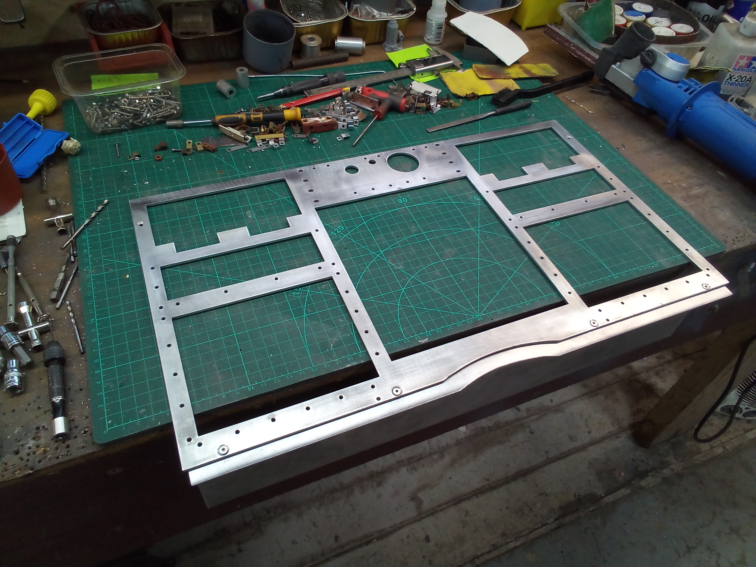

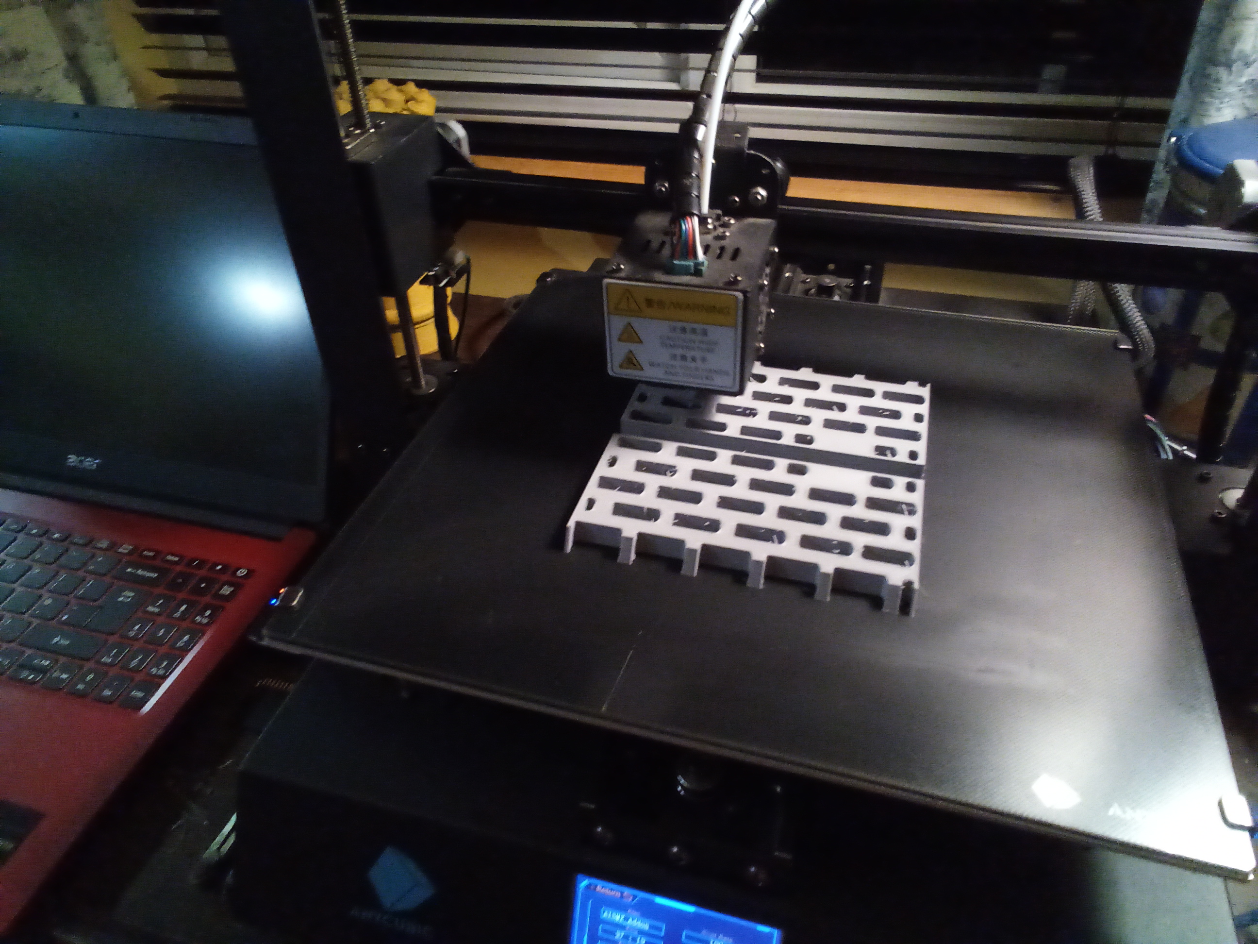

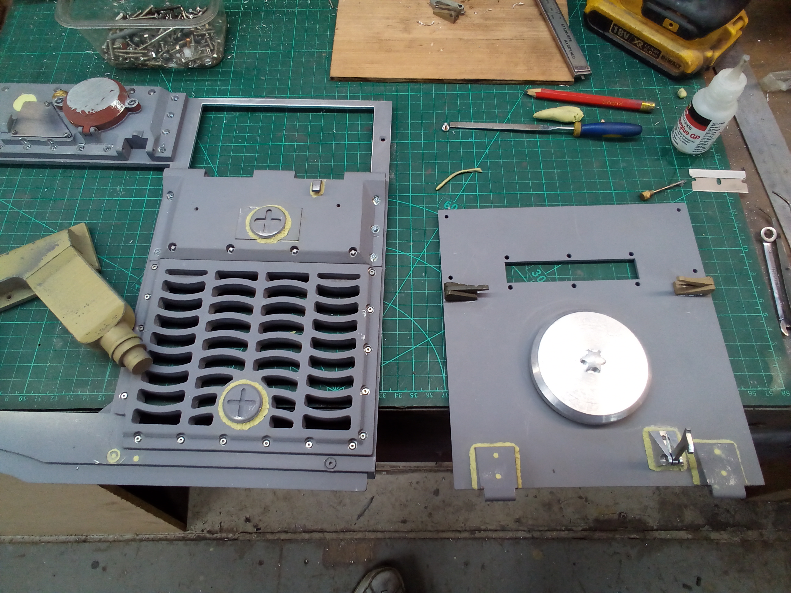

Printing the inner engine hatch detail, now I could cut this in ali but the file has all the hinge lock positions which is convenient.

I remember making this part, it looks so much easier on these printers, Thanks for posting this Phil, regards simon.

On the top left side of the first two photos of 05:28AM, what book is it? Always found something new and interesting .... :D

It's the Tiger bible Chang the book that you just can't buy!
Simon the printed inner engine hatch detail in pla may not suit some but as it's fully supported by the steel hatch it's great , it does take 15hrs to print though!
