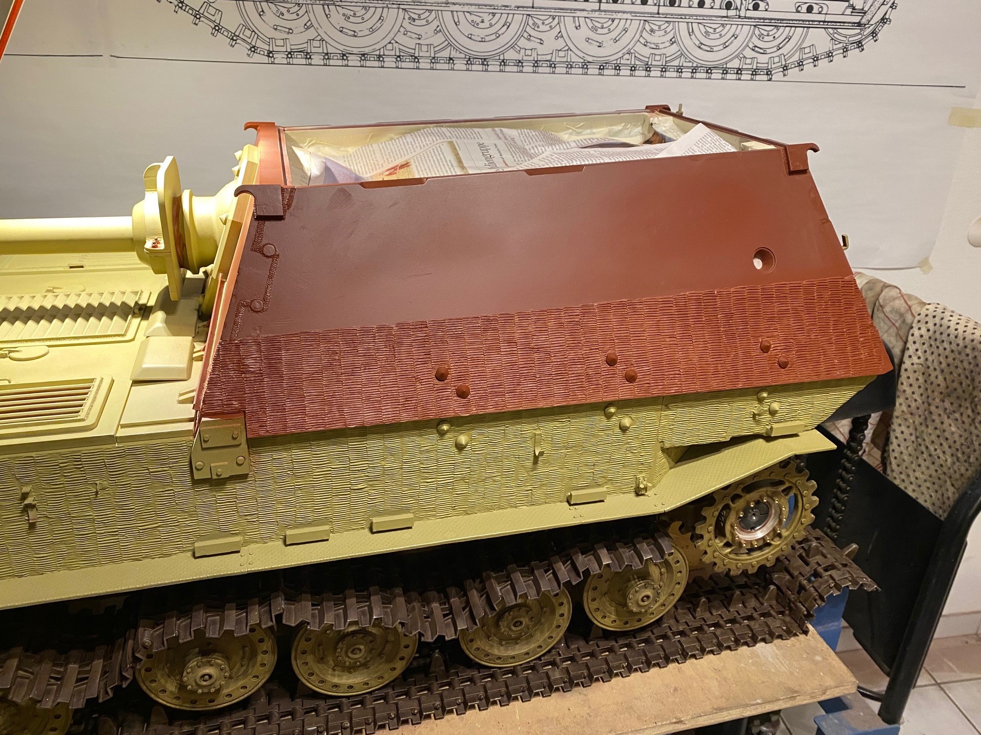

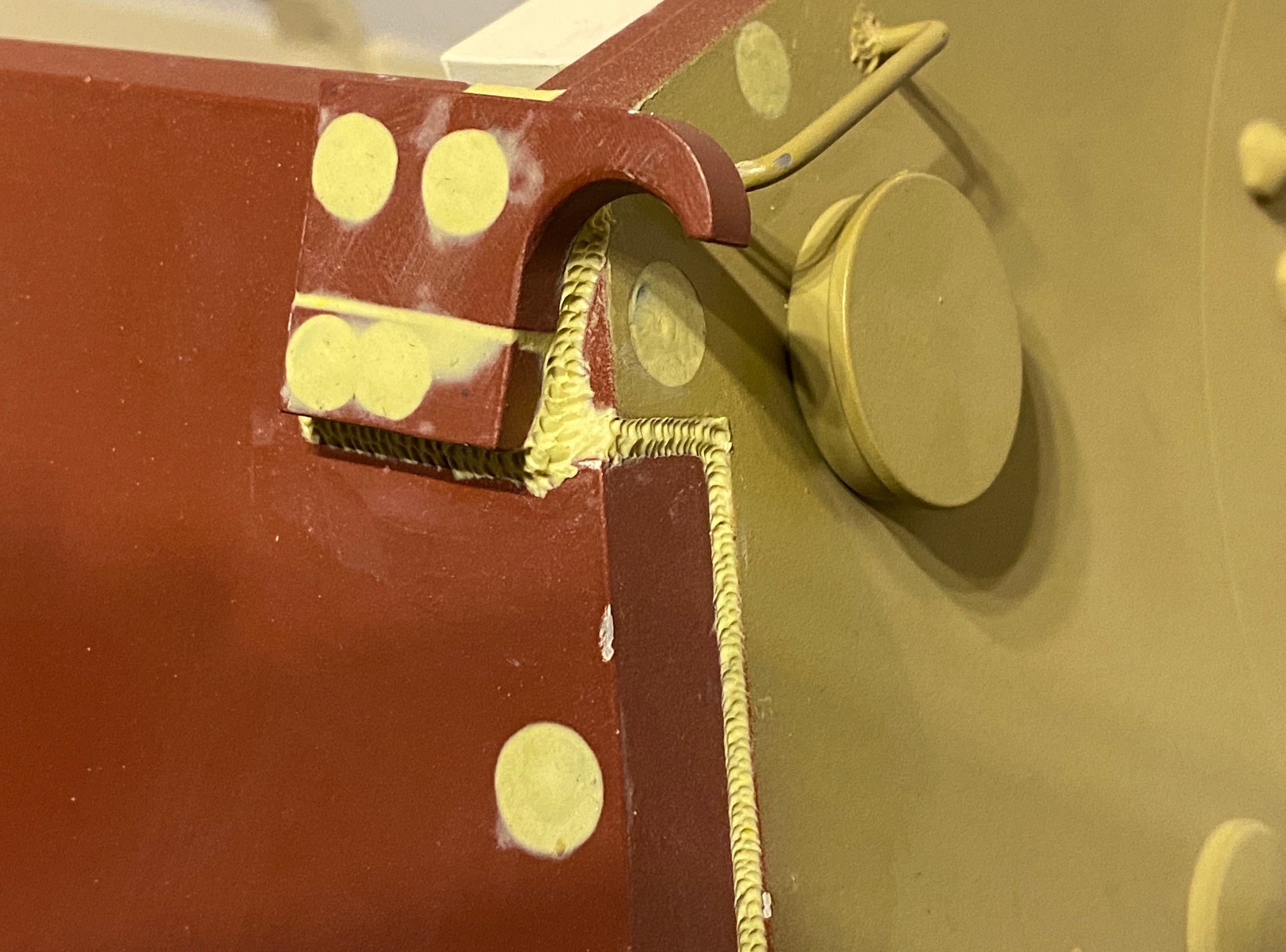

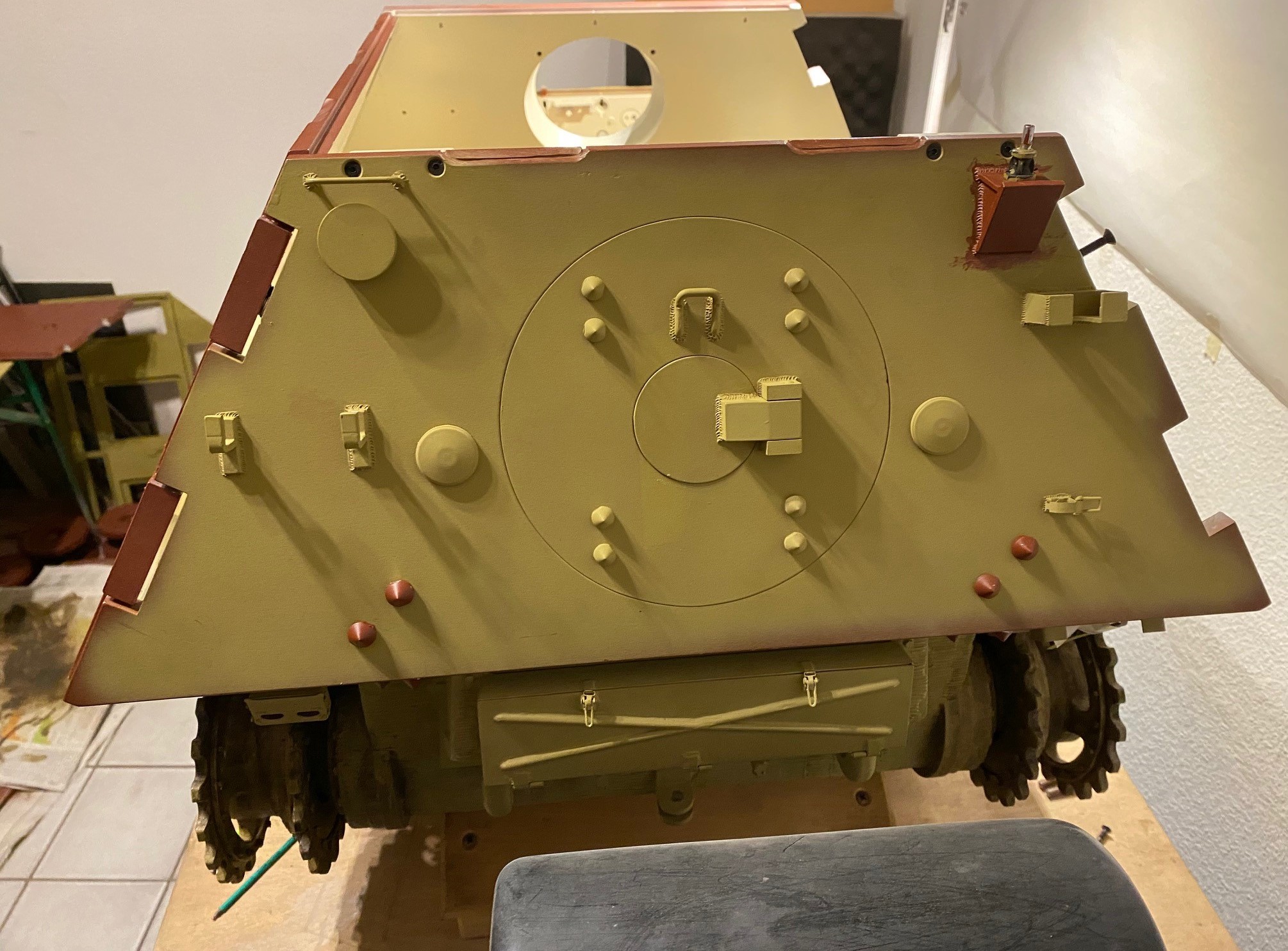

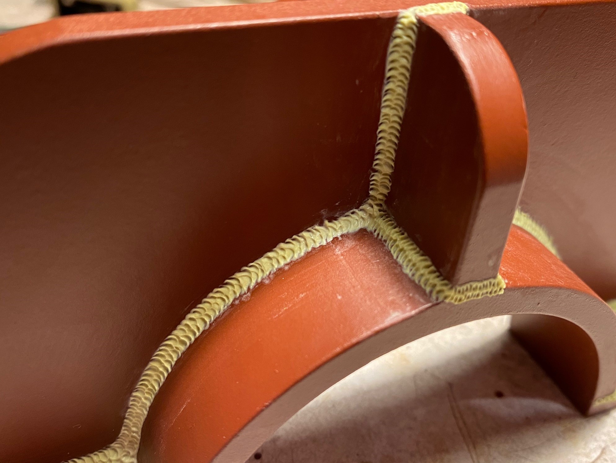

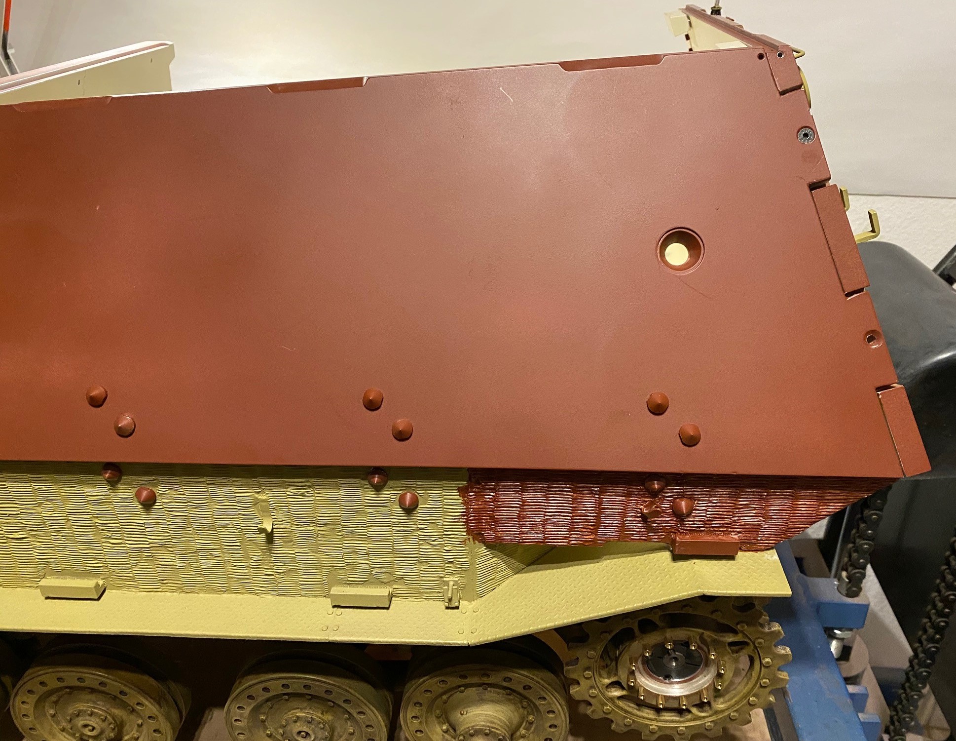

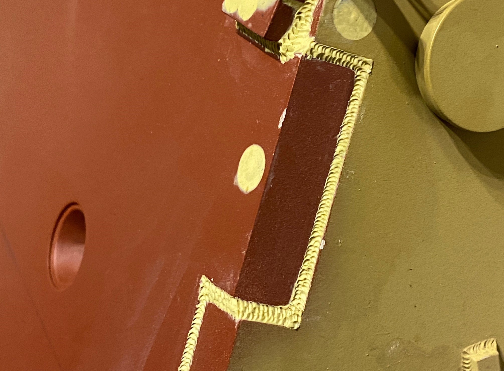

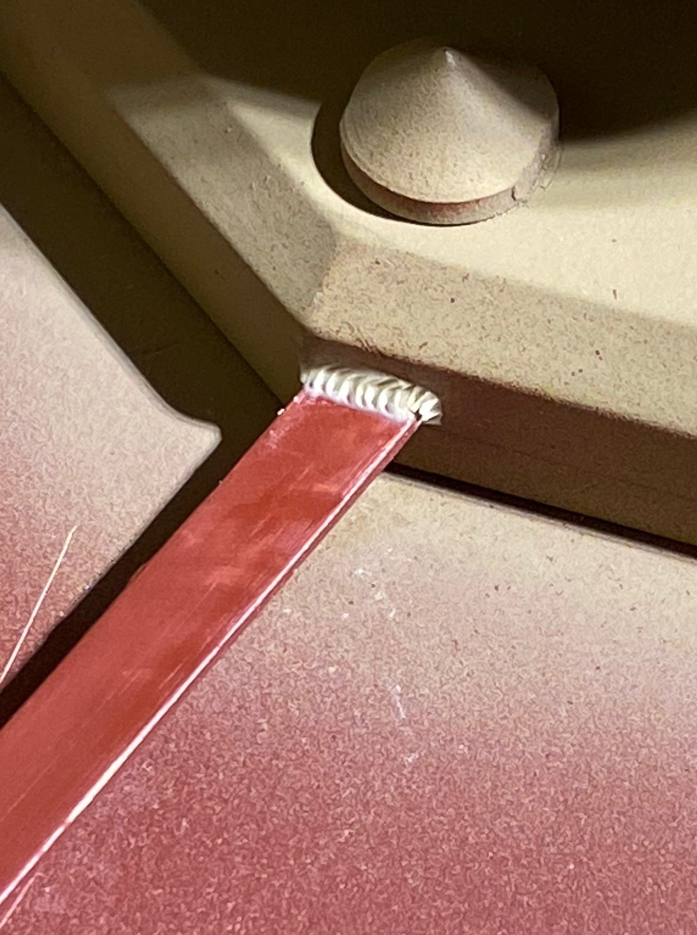

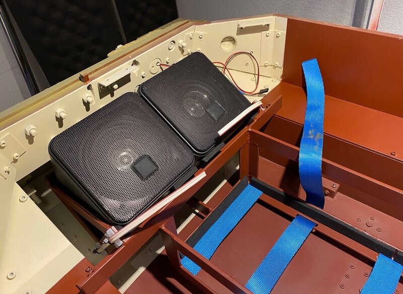

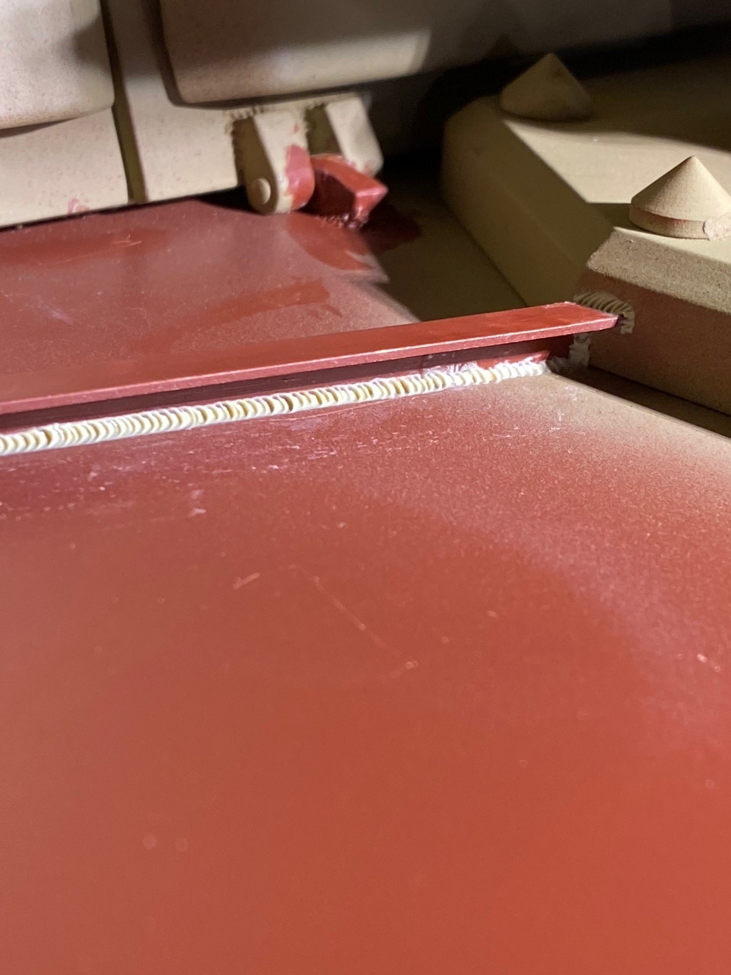

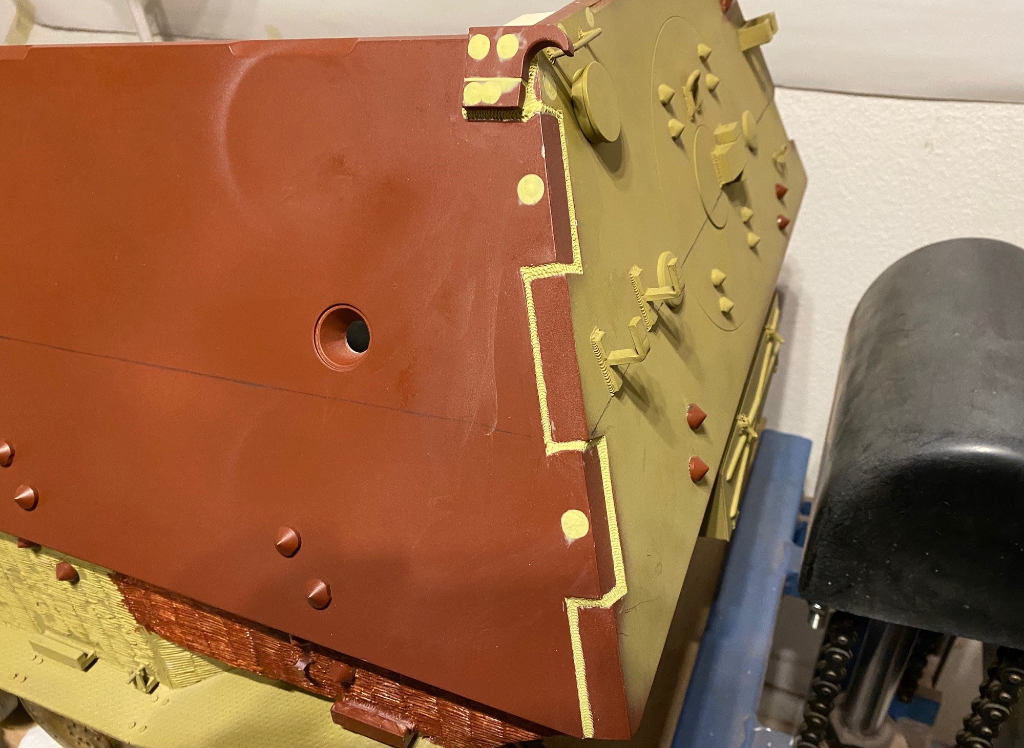

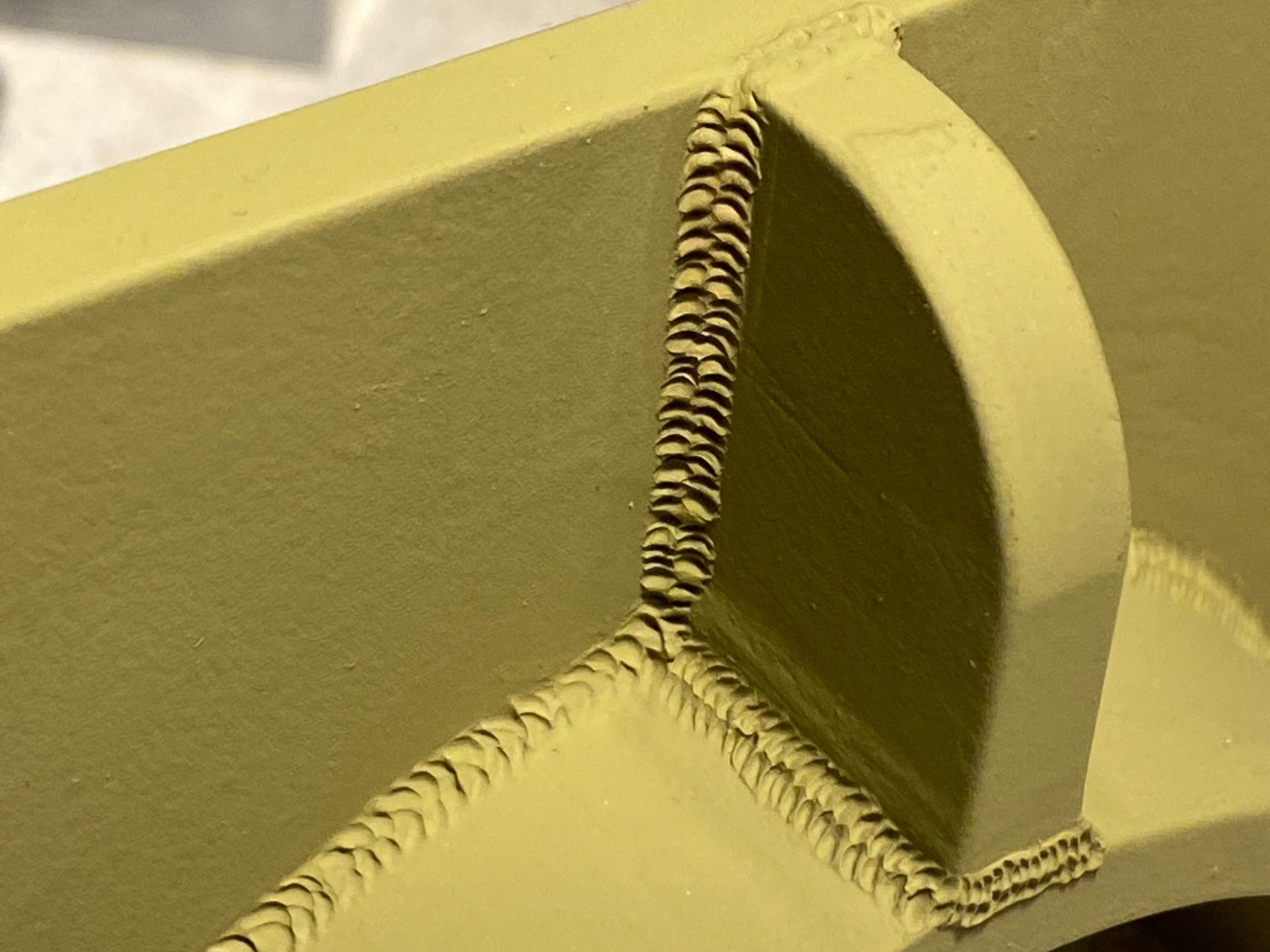

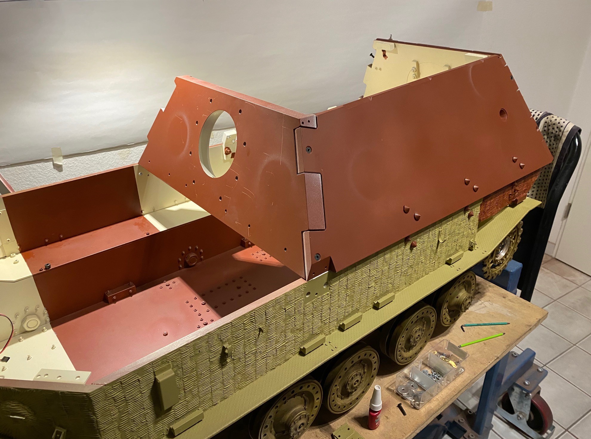

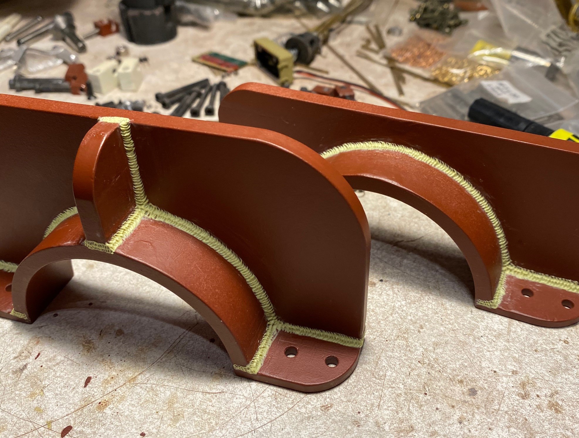

Here comes the next update with the first side walls and the welds.
Also the battery tray is mounted for first loud speaker mount.
Regards Martin

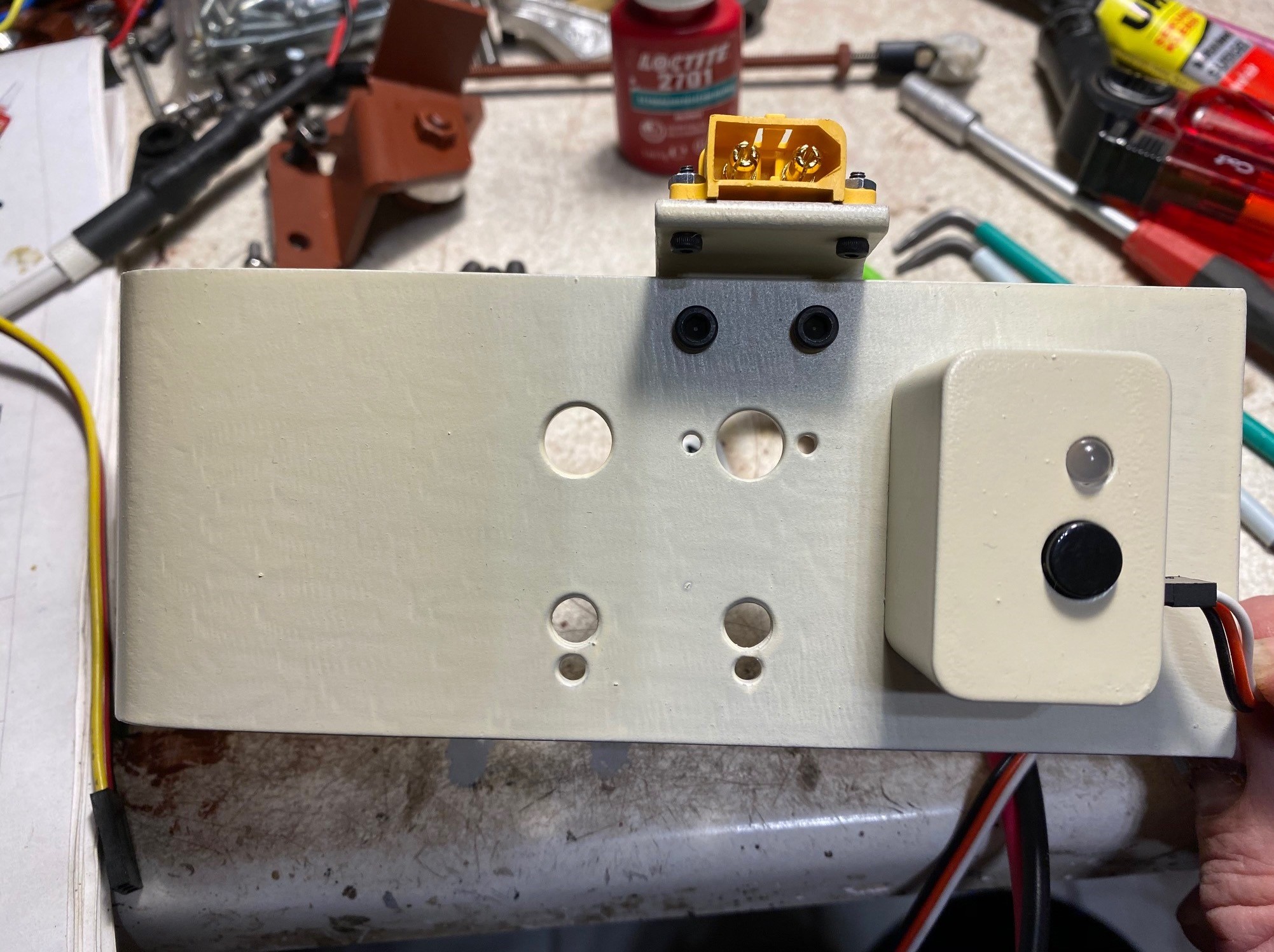

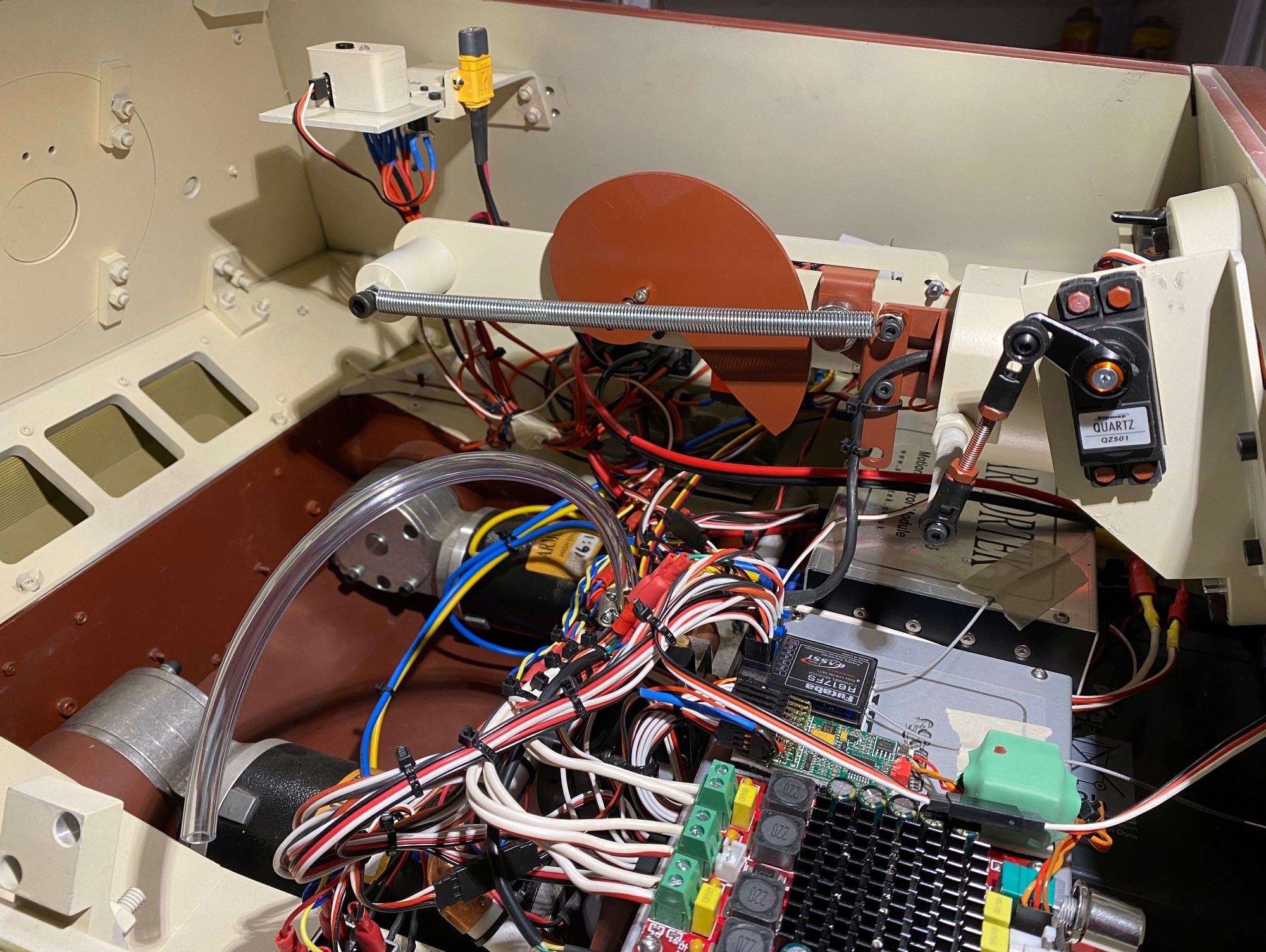

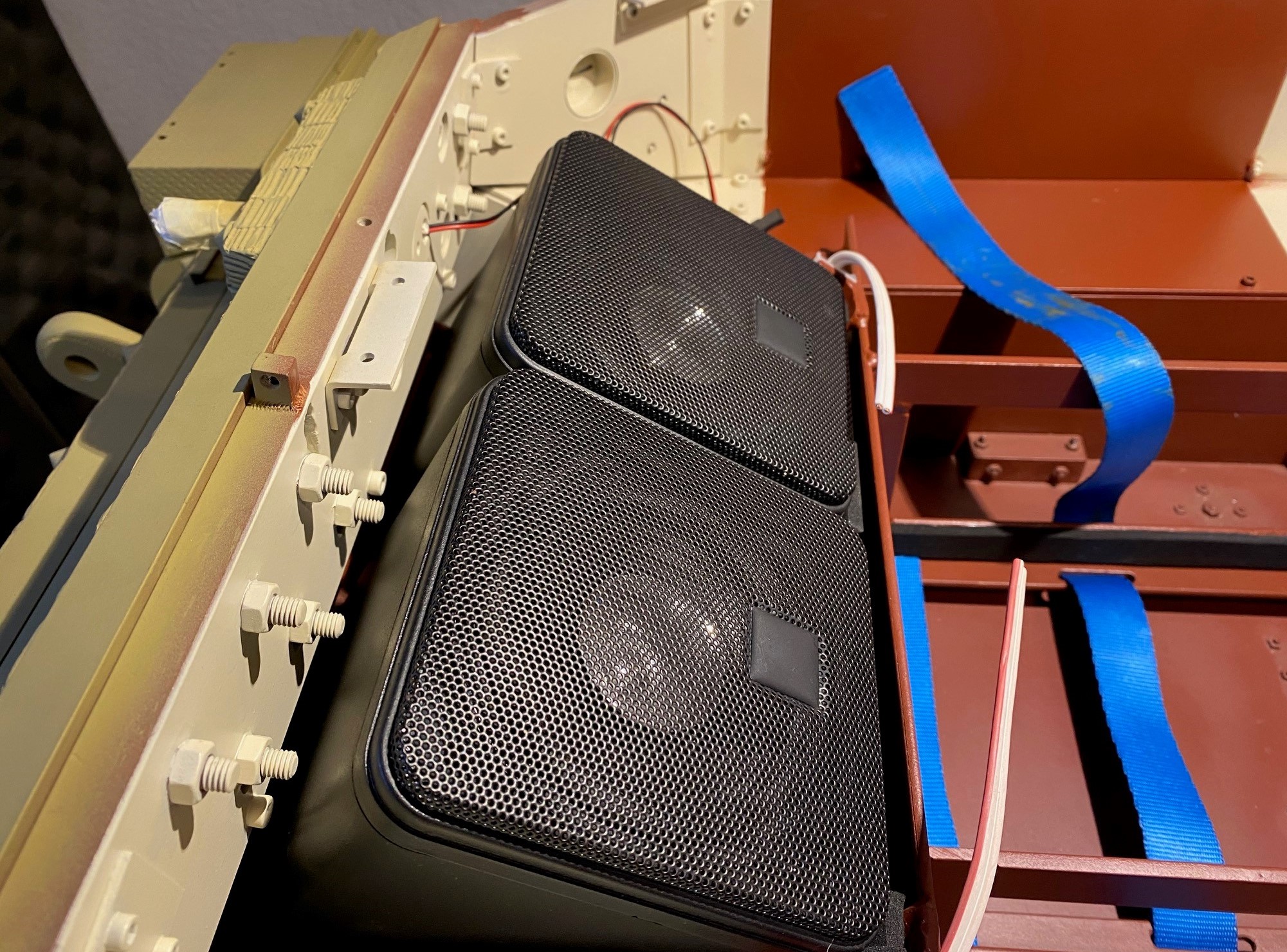

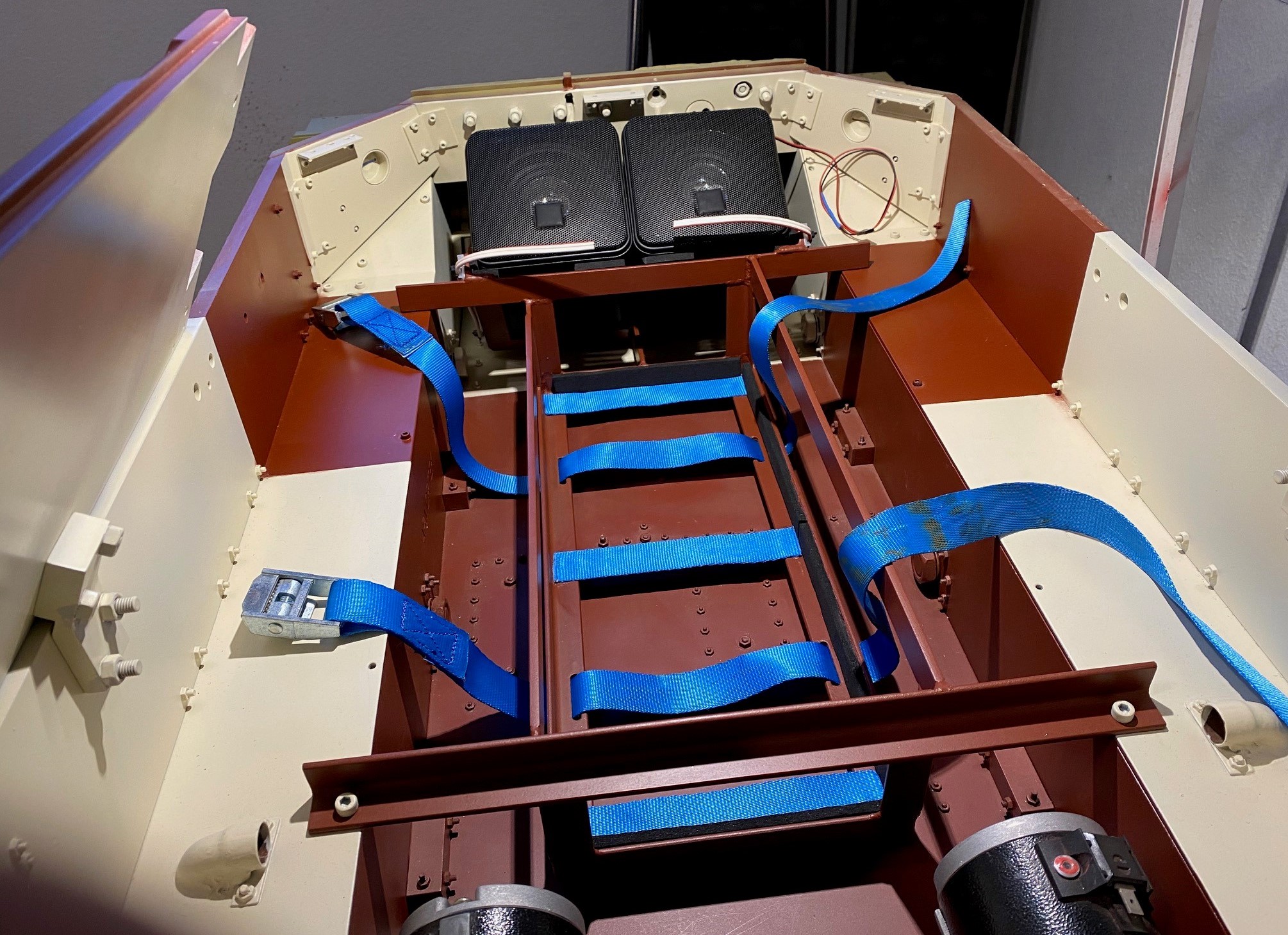

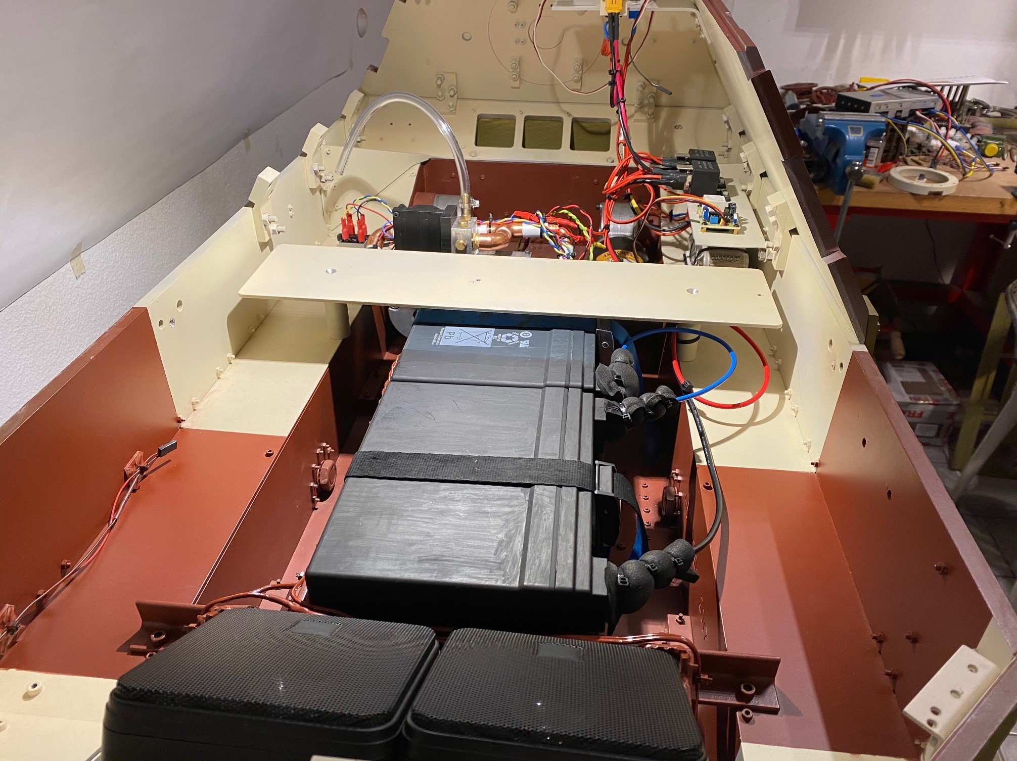

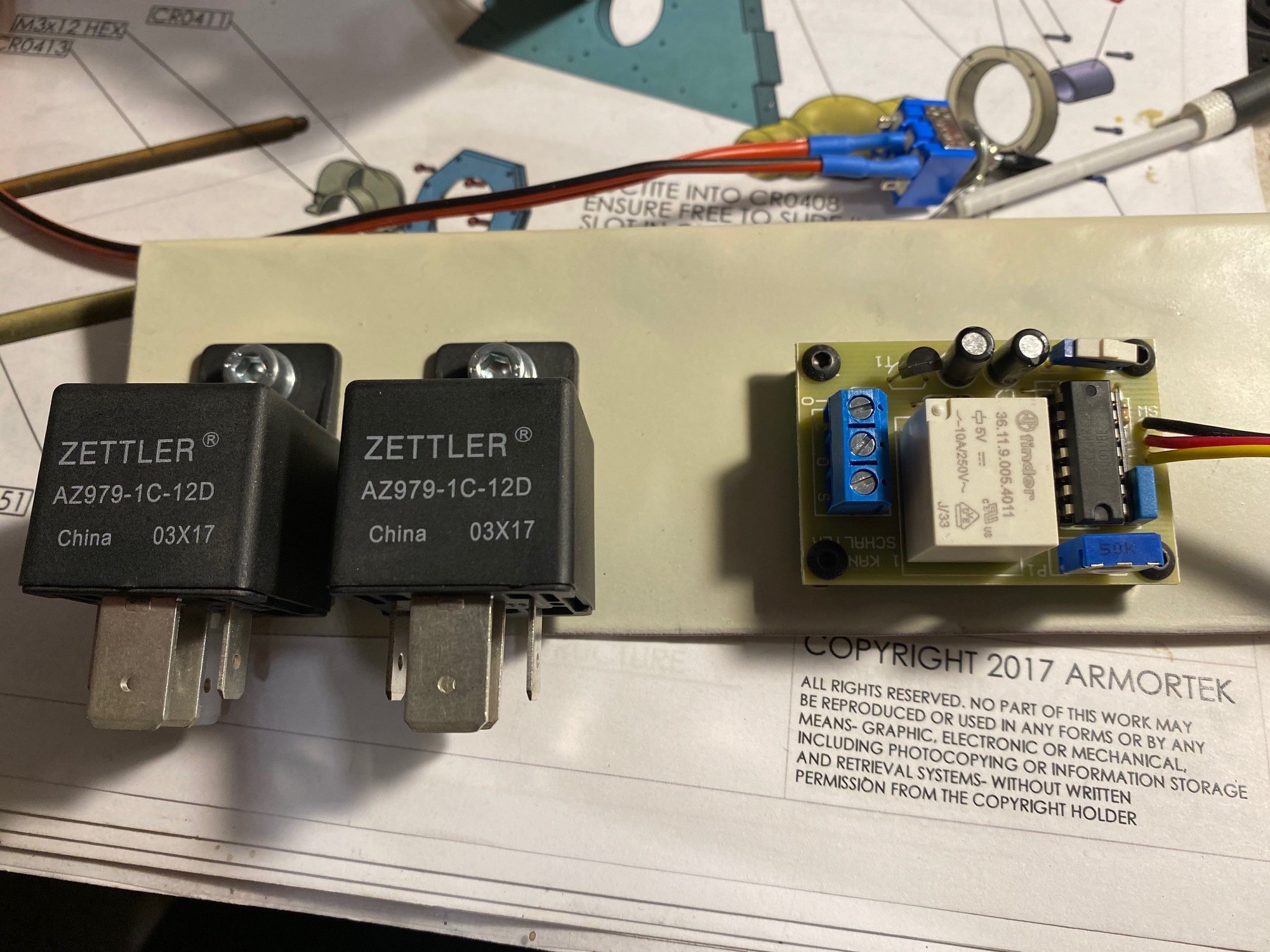

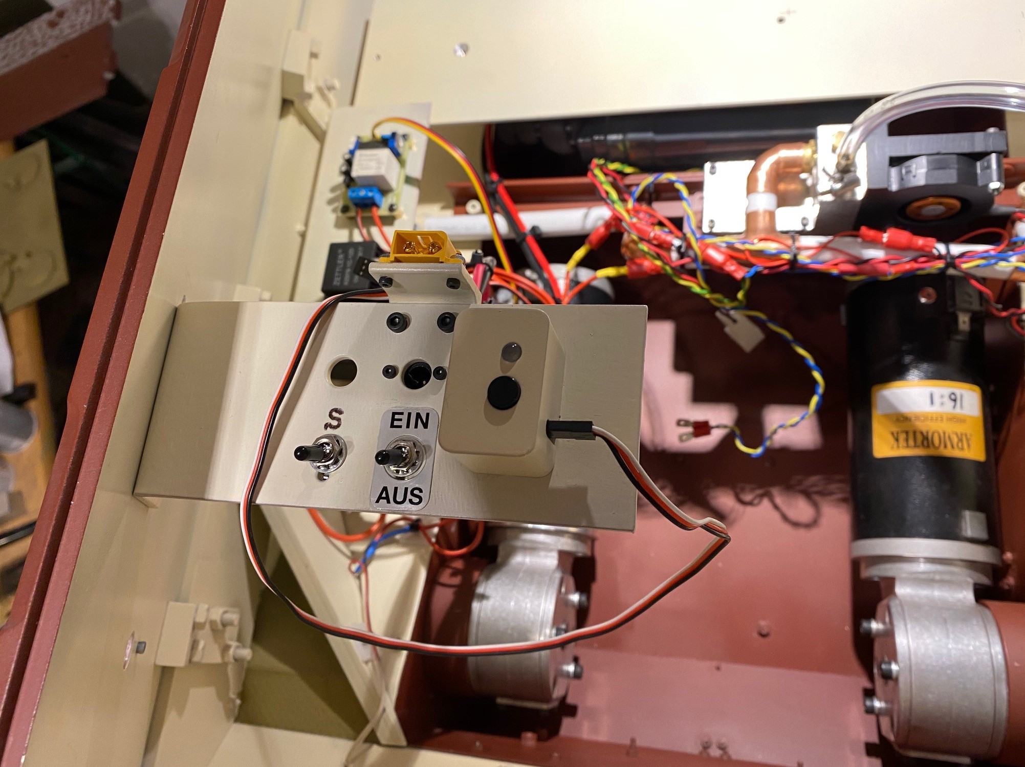

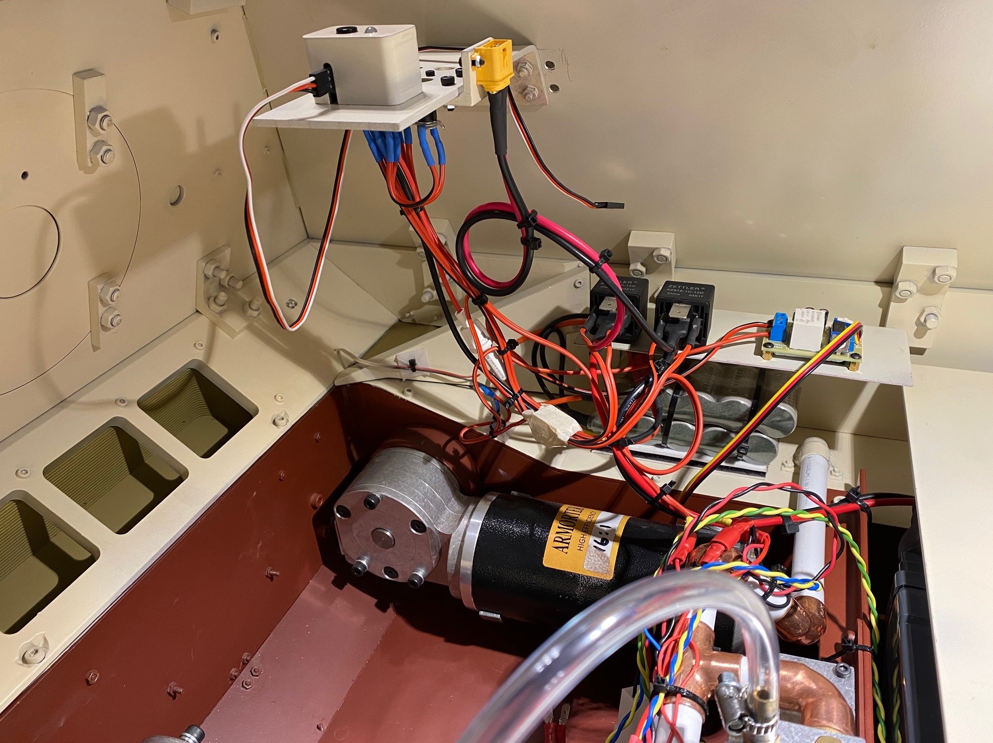

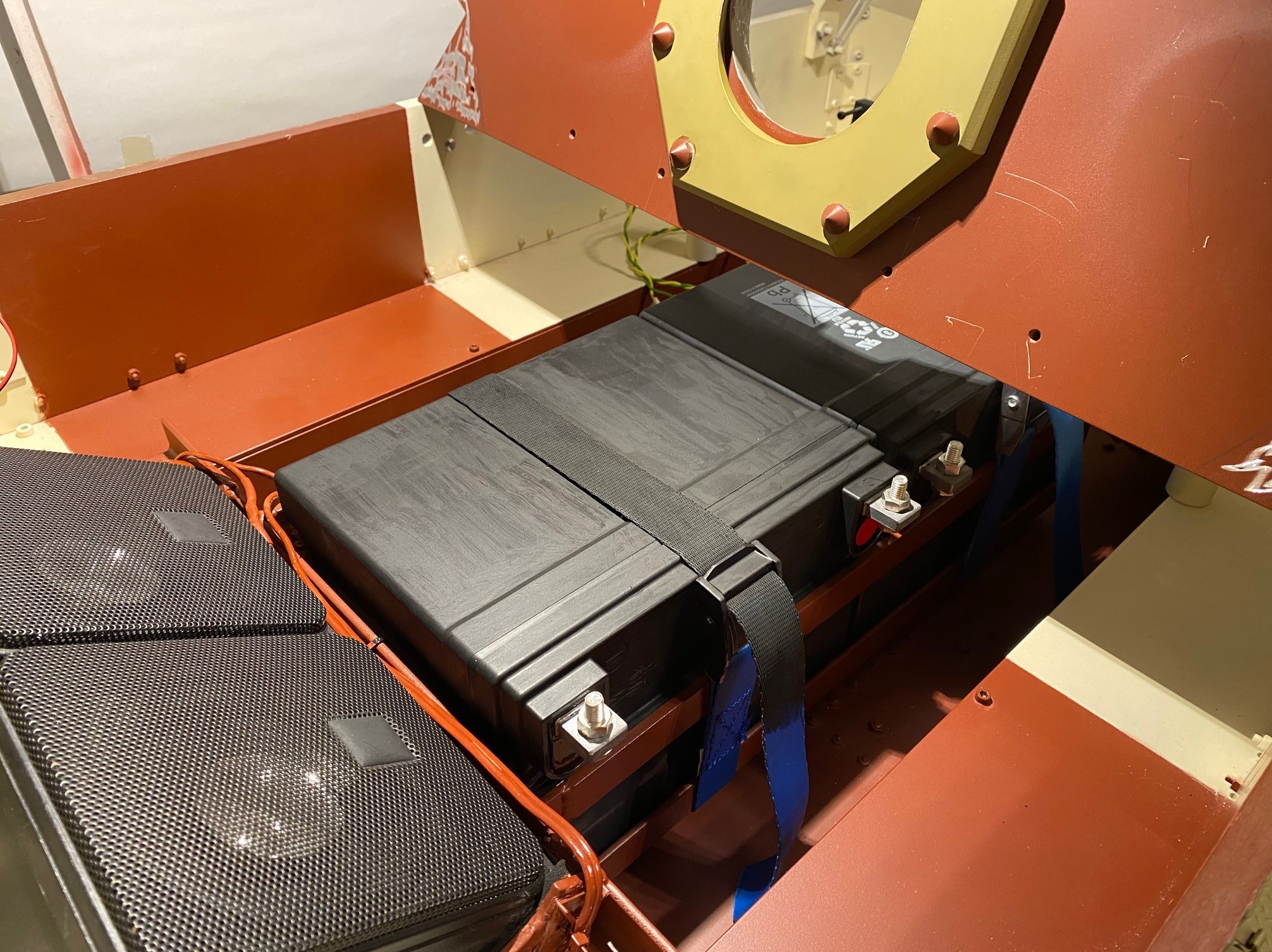

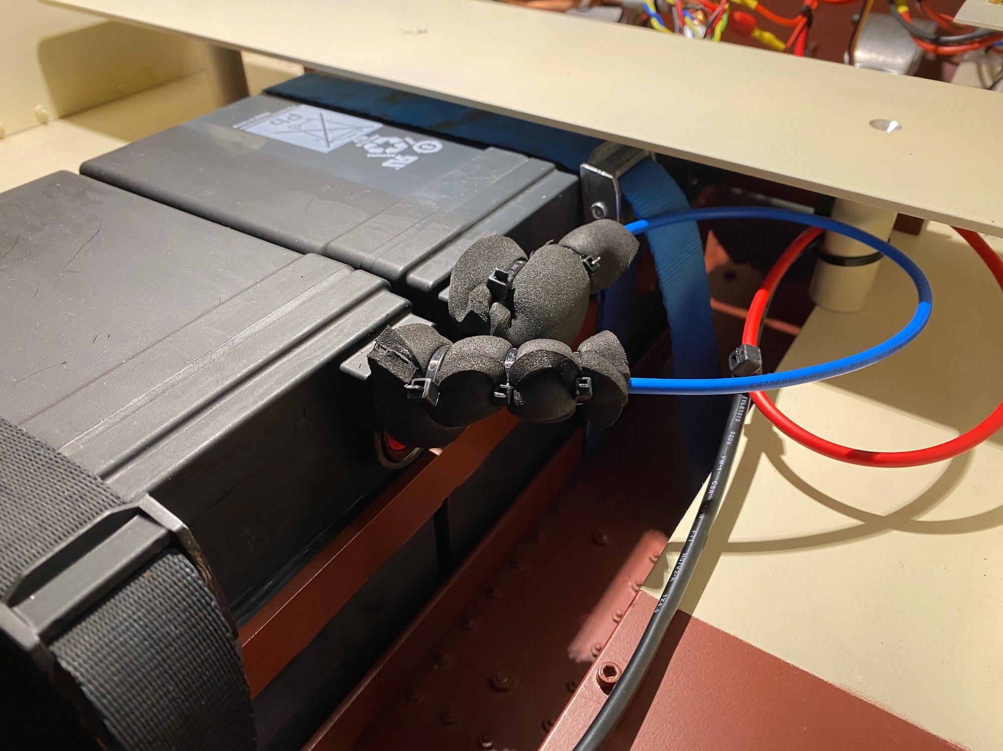

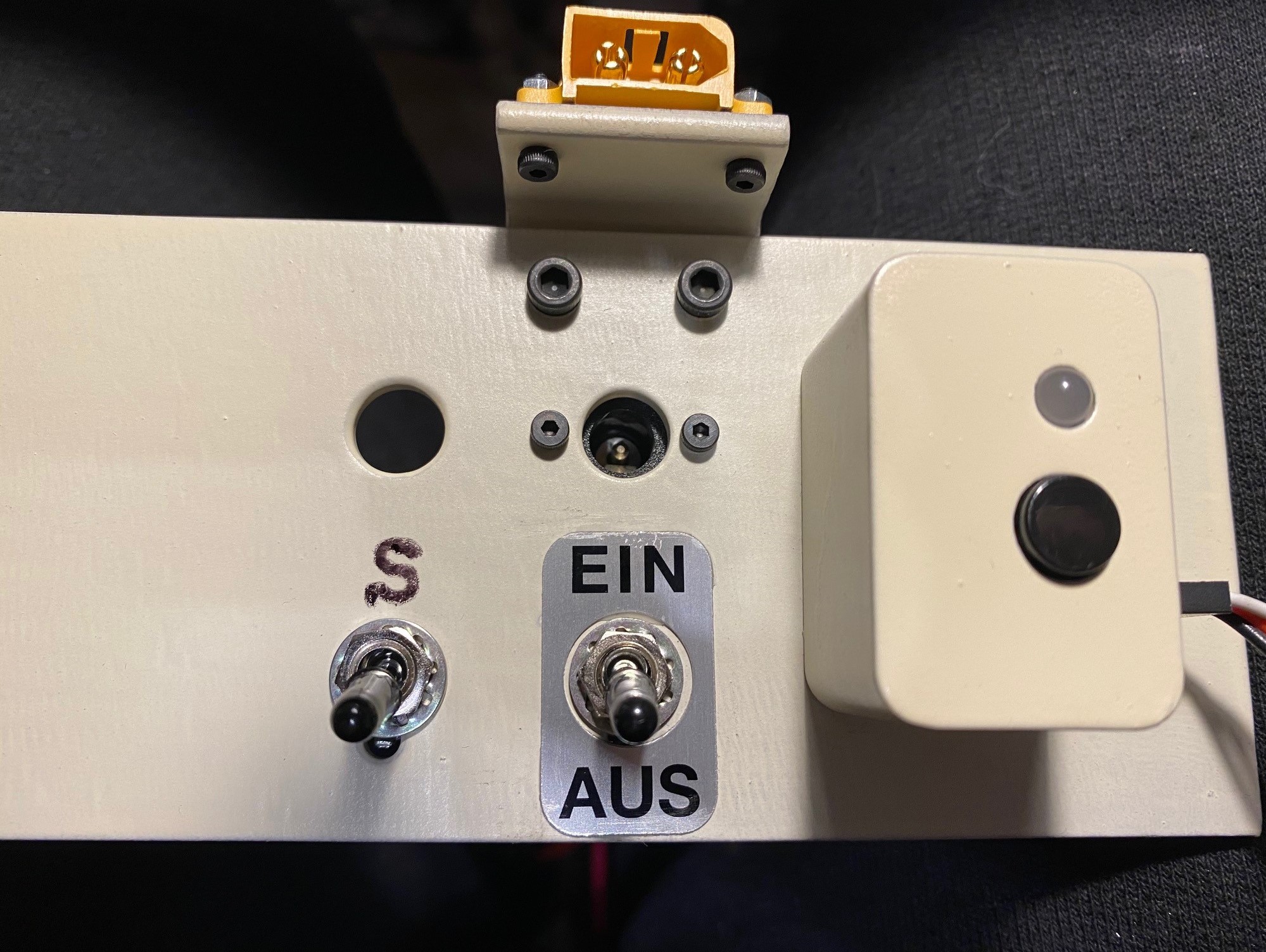

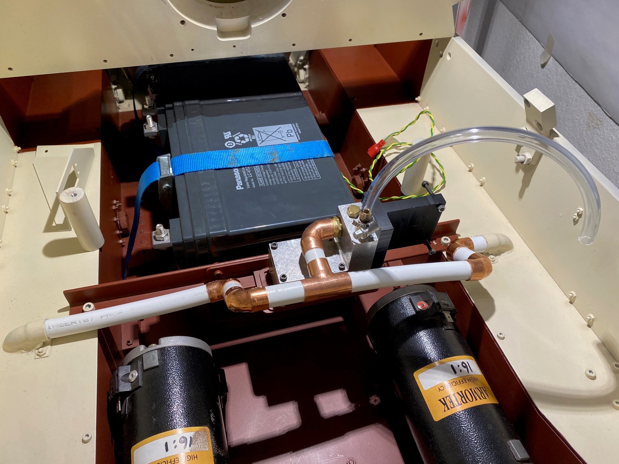

It is time for a little update with the first electric components like loud speaker, battery tray, some relais, smoker and batteries - painted to see only a black surface from outside through the gratings.
mounted from the under side
Regards Martin

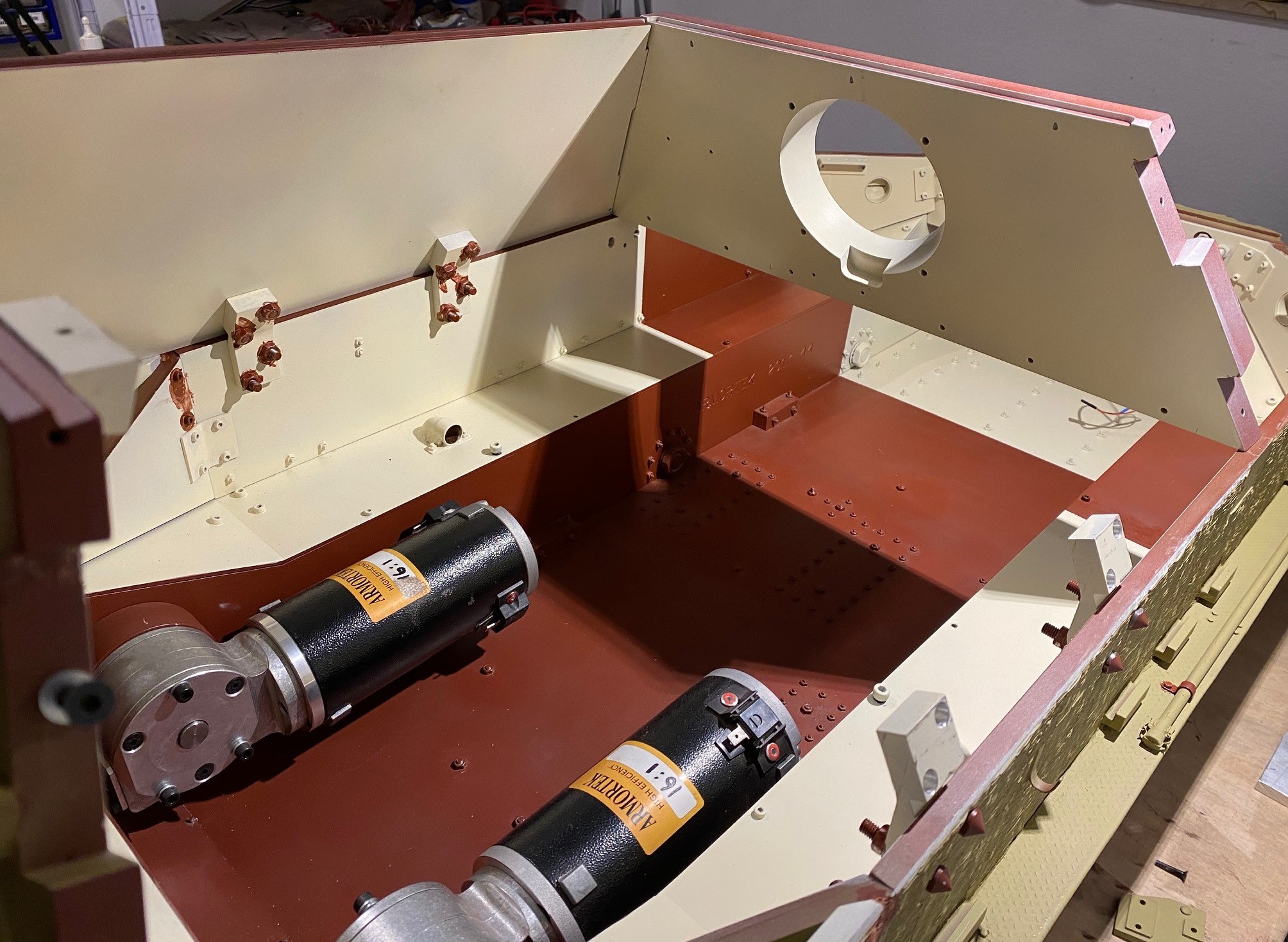

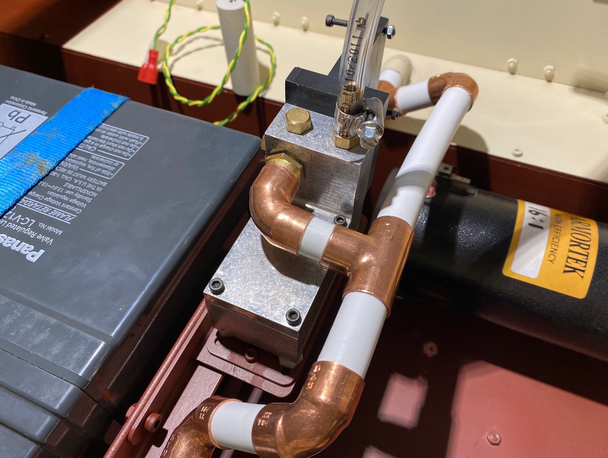

Hi Martin,

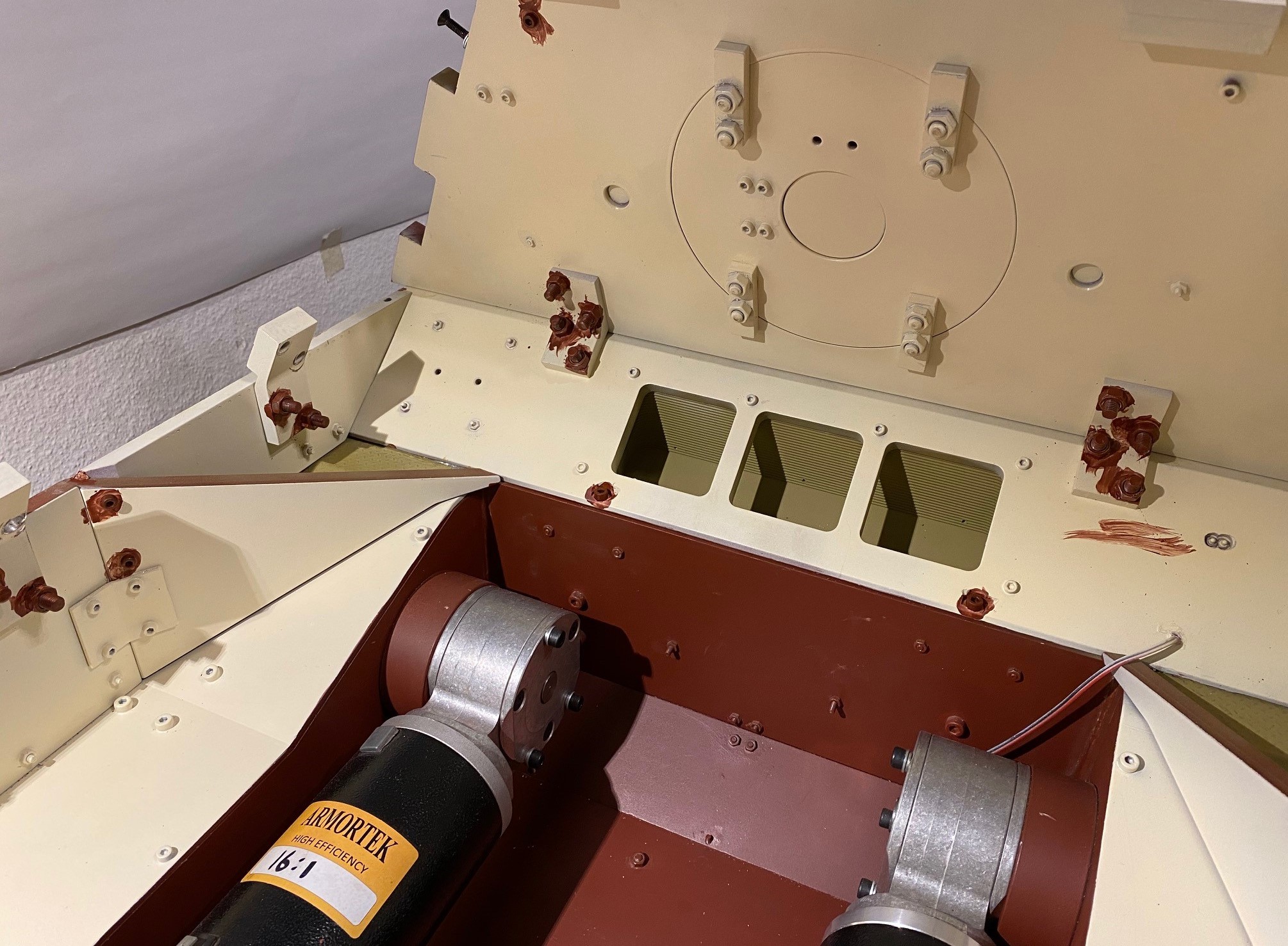

This Elefant is one of the kind. Watching your photos is an enjoyment.

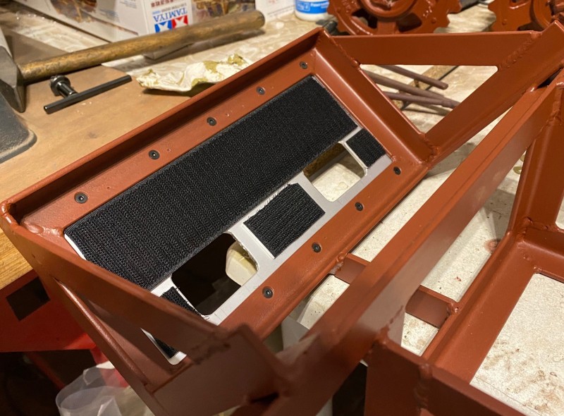

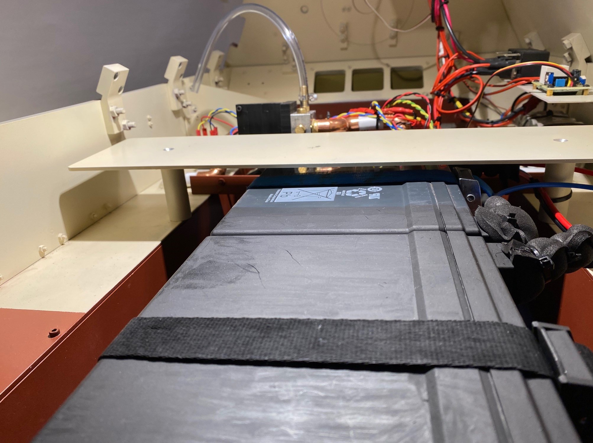

Found in this photo there are two cylinders (circled). What are their purpose ?

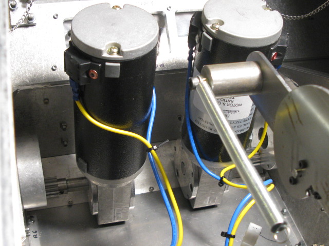

In my Elefant, I turn two drive motors & mounts 90° in upright direction. No problem at all (only possible in Elefant). I think this will save more interior space for other usage.
Testing before final locking photo
Just my two cent. Nobody else have done this, yet I don't think it's a bad idea.

Hi Chang,
thank you for the compliments.
The two cylinders are the new feet of the bridge for the electronic devices above the big batteries.
Regards Martin

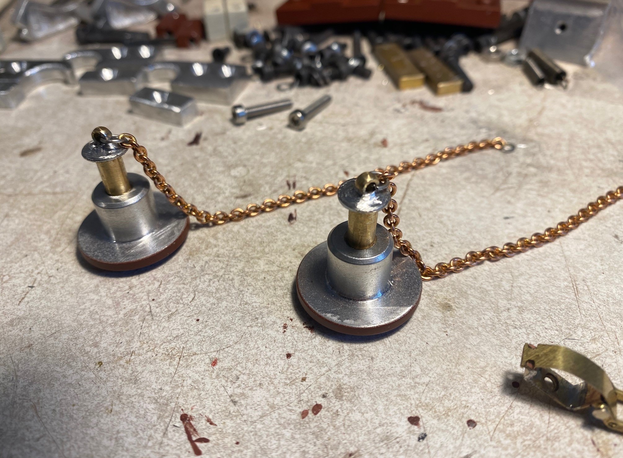

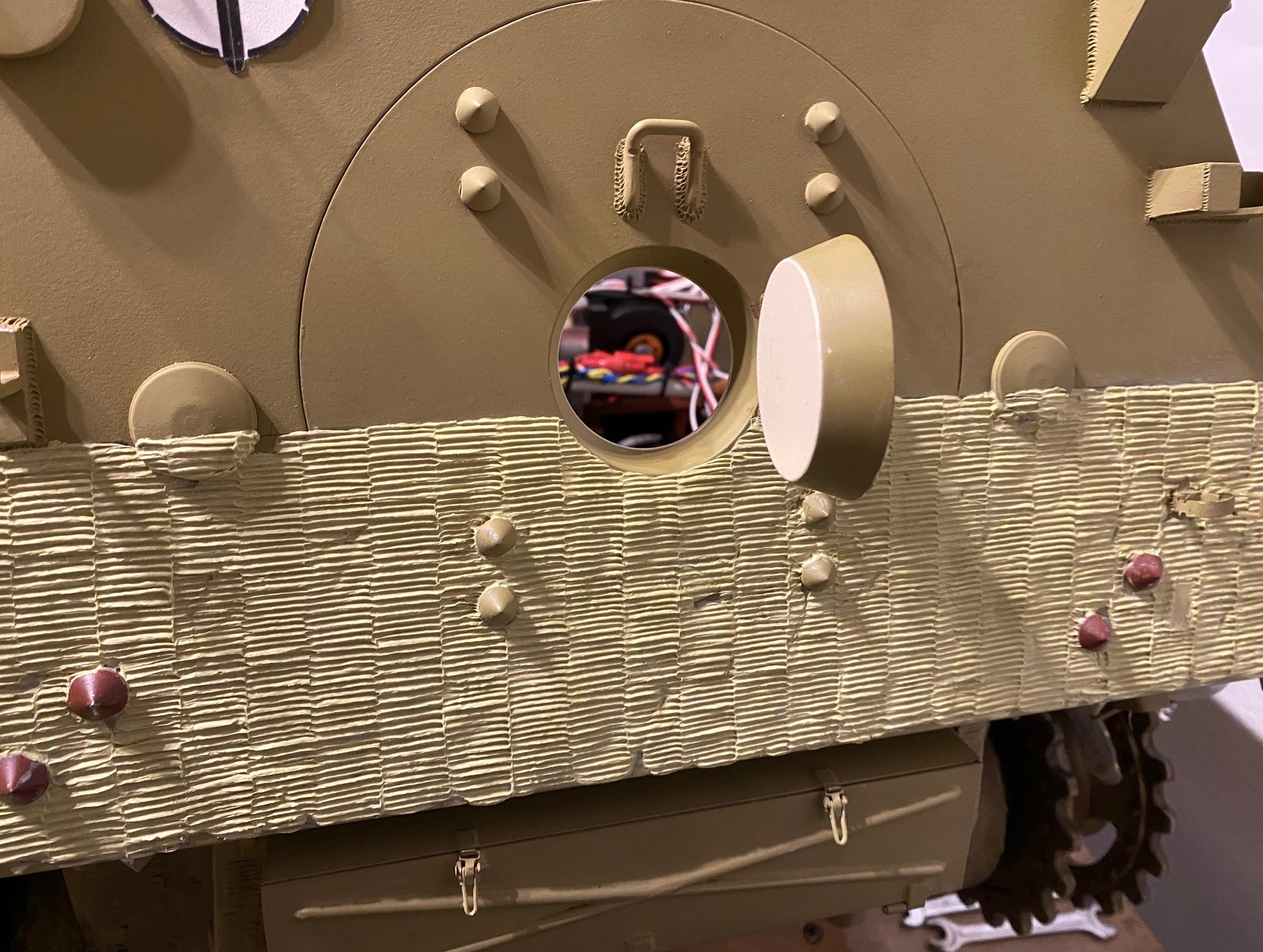

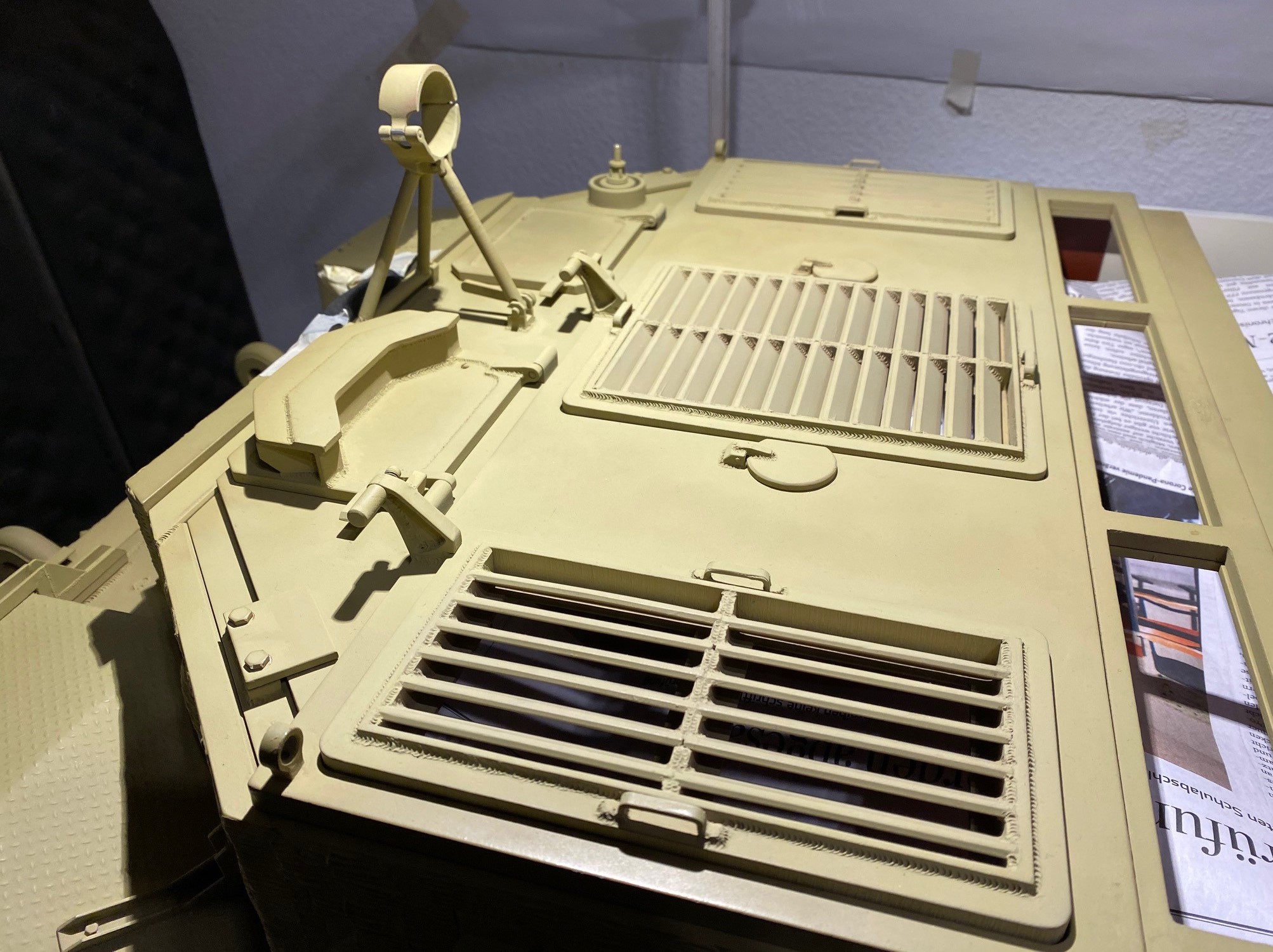

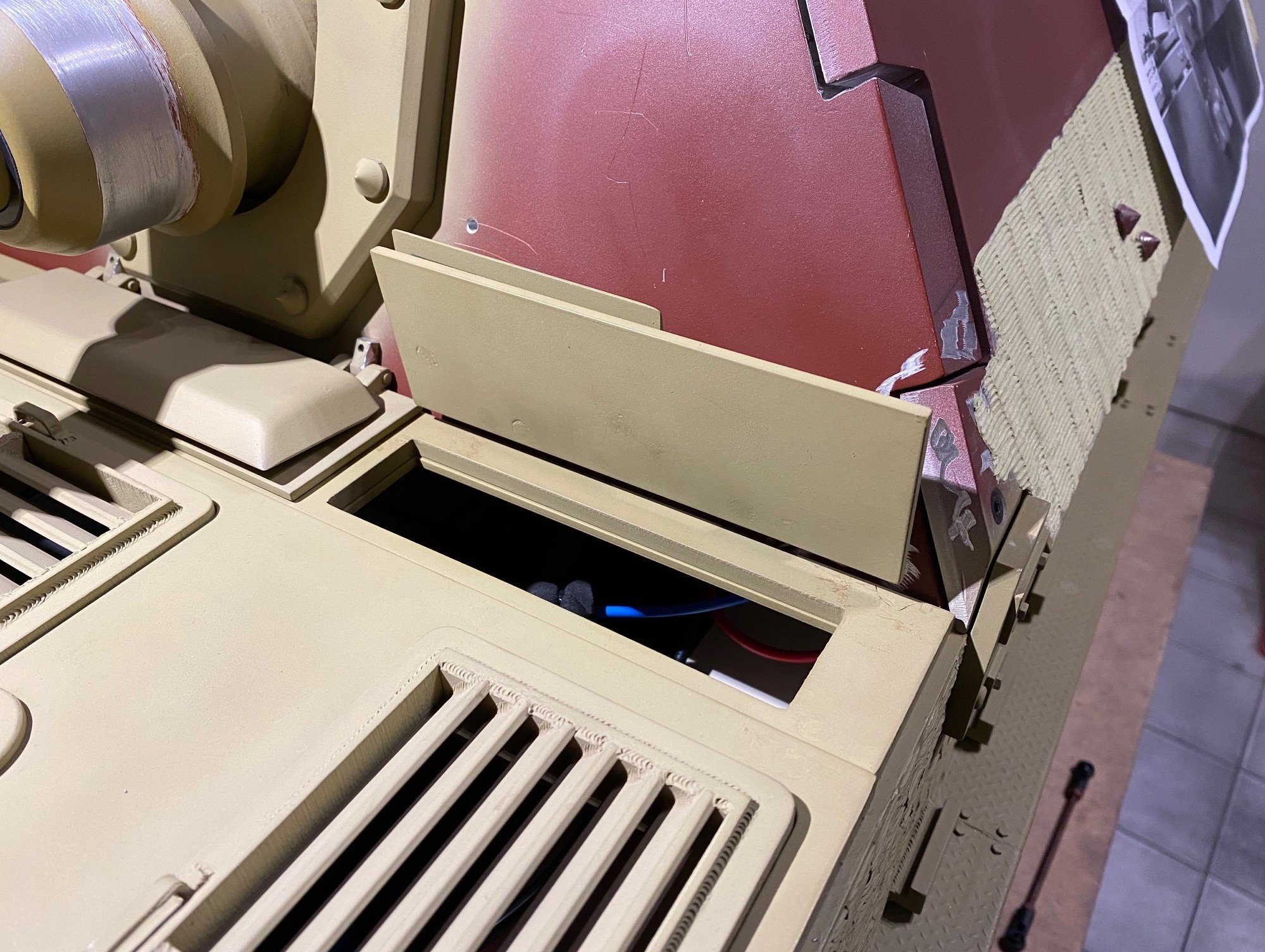

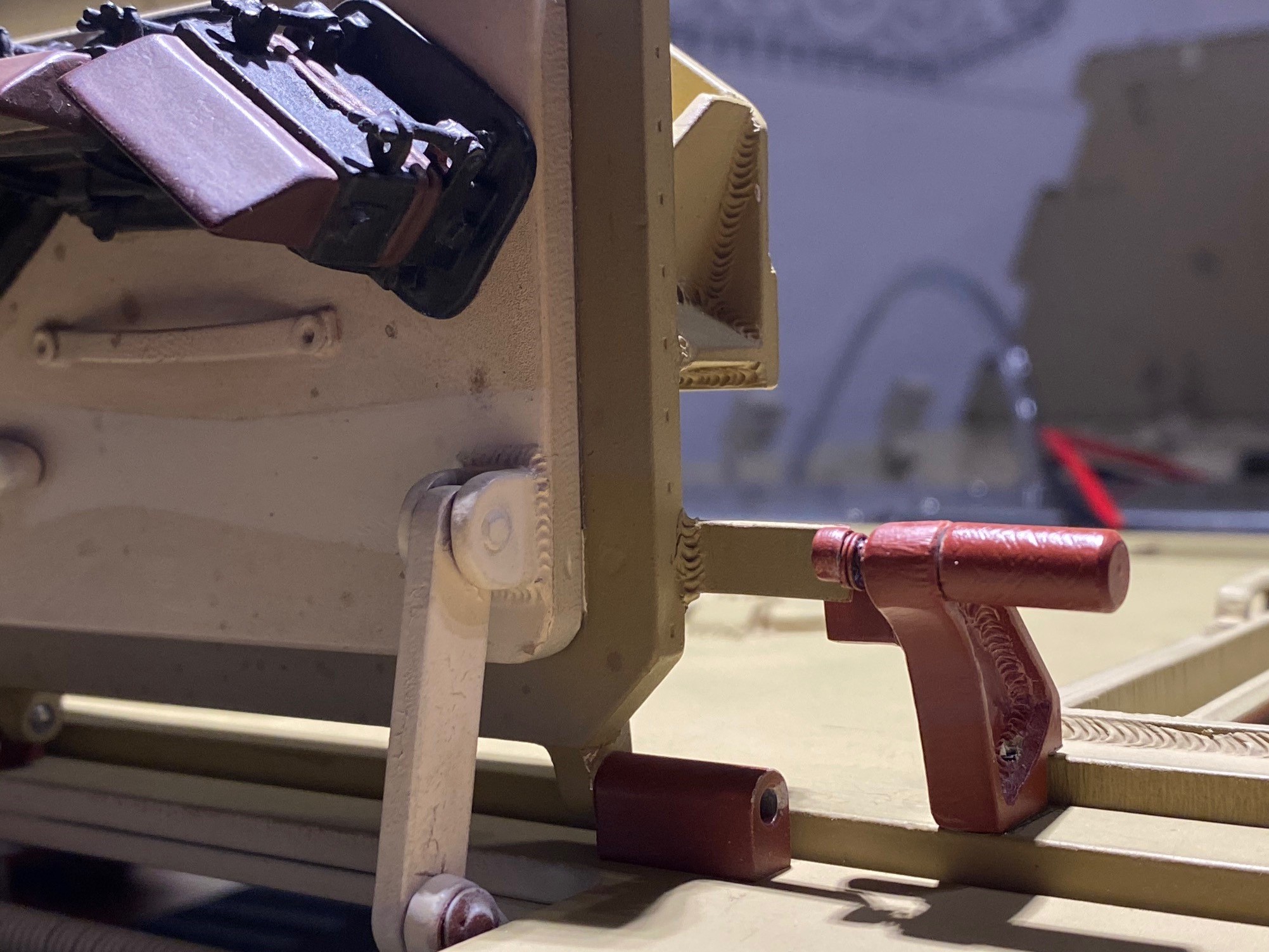

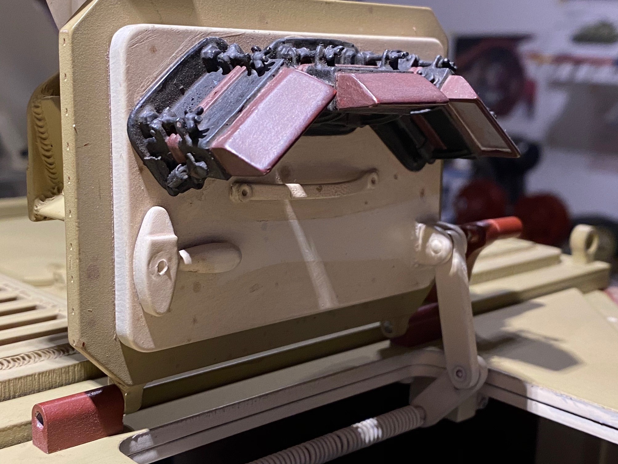

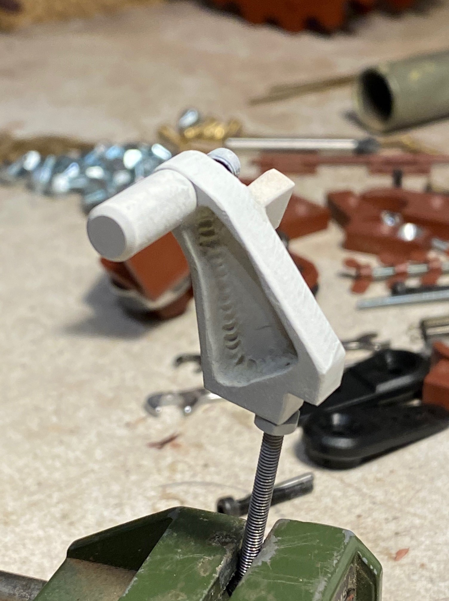

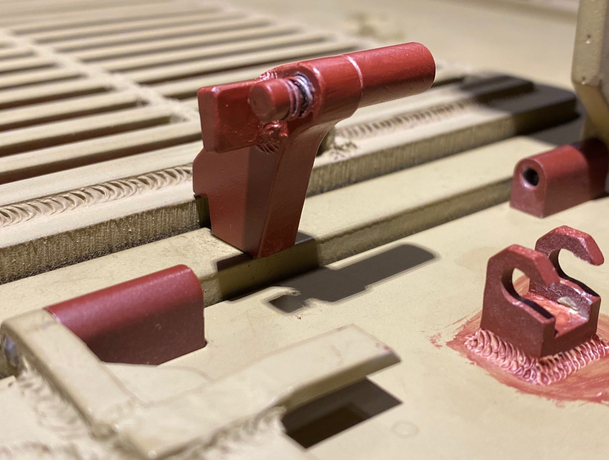

Now i come to the driver and radio operator hatches and the scratch built holders - full functional.
Regards Martin

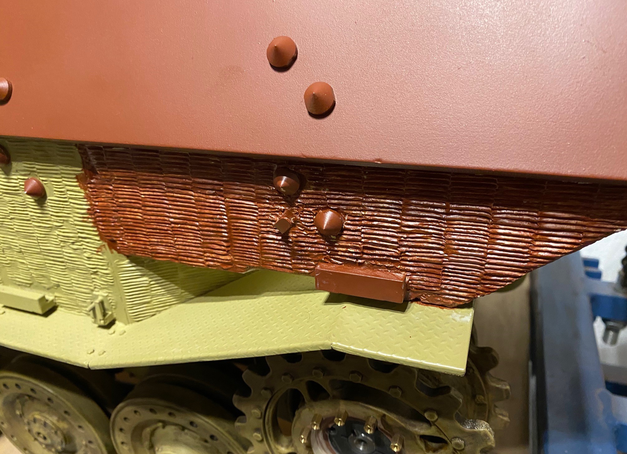

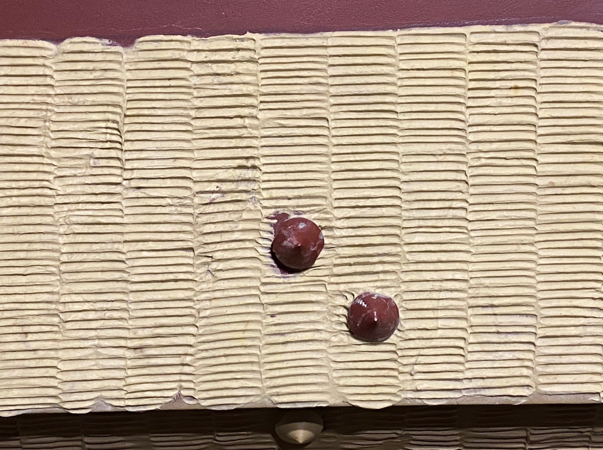

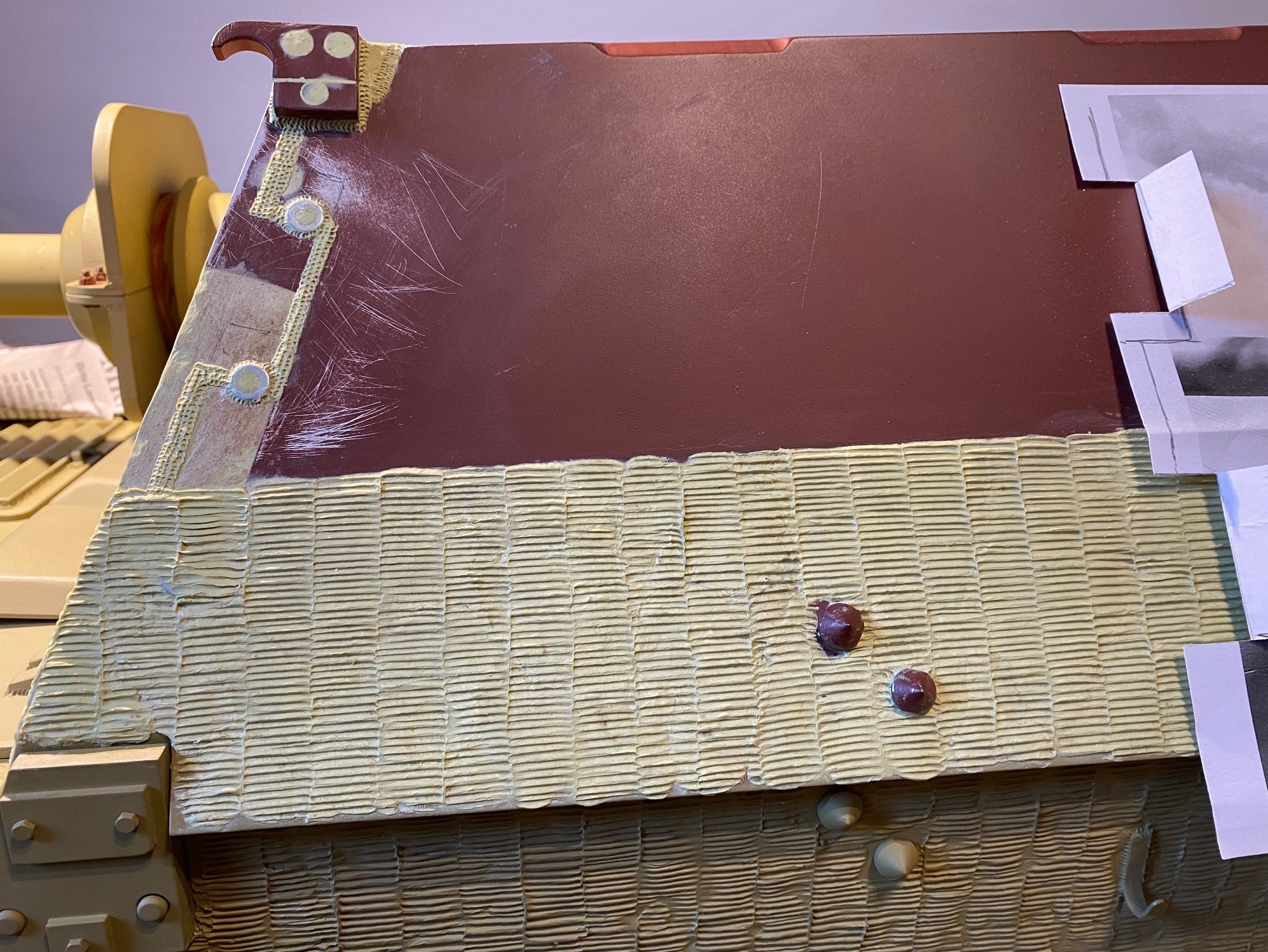

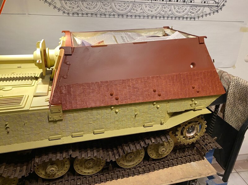

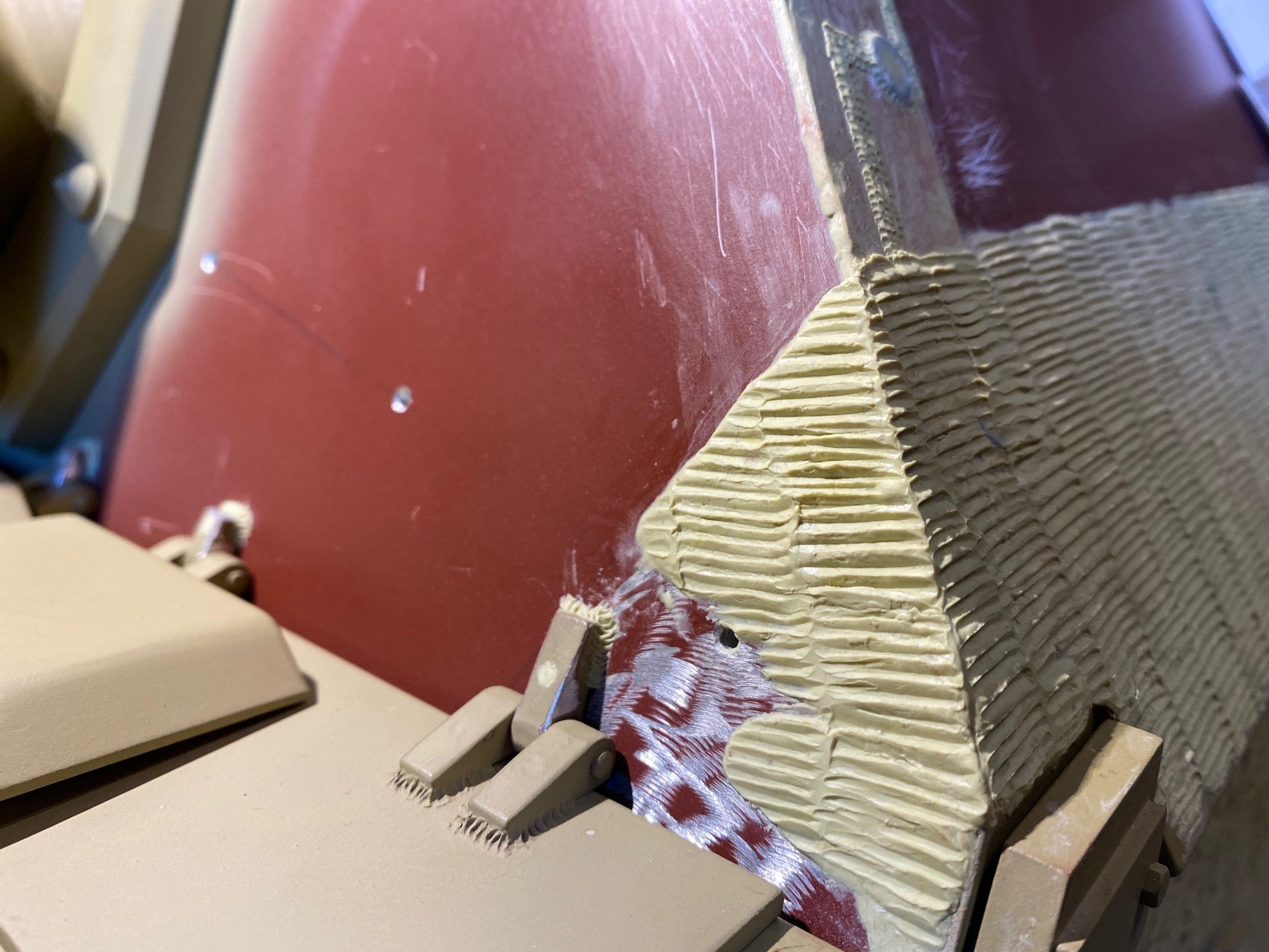

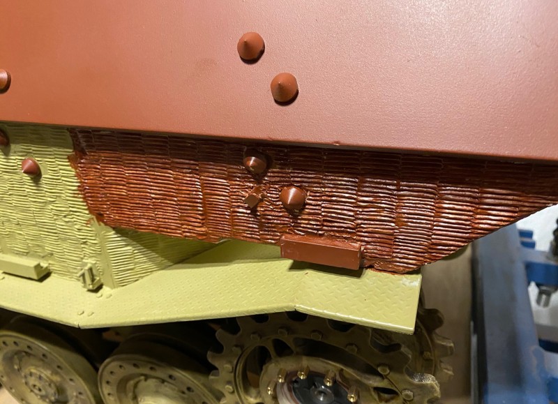

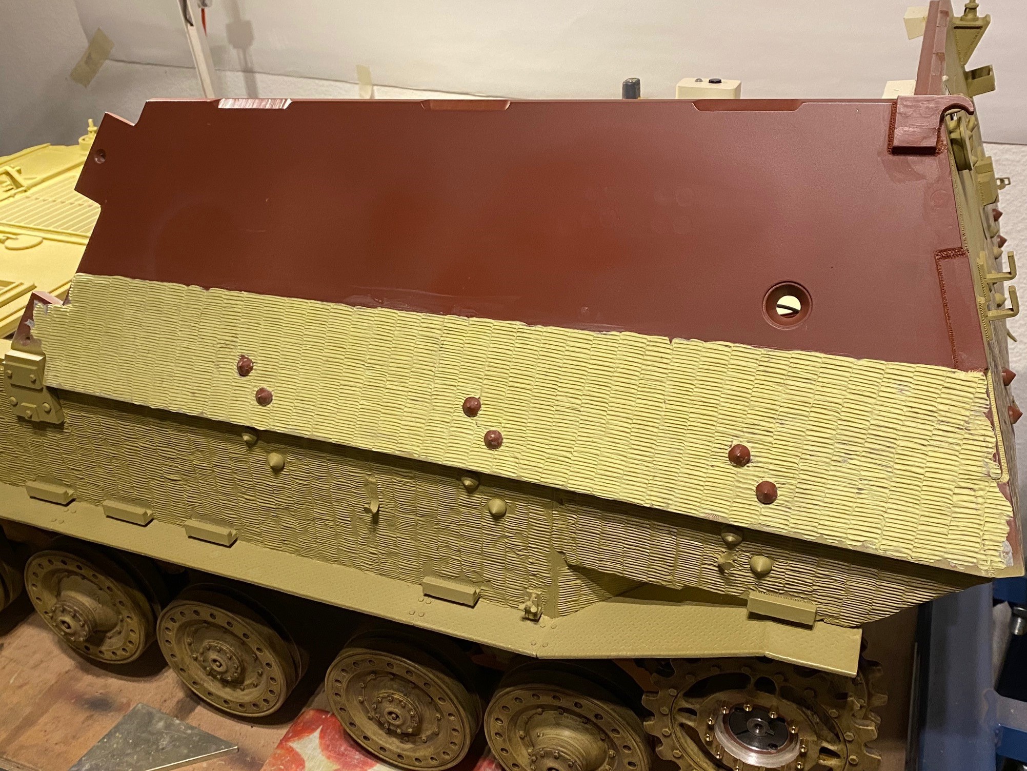

The cover plate is mounted, the barrel travel lock too and the next Zimmerit is done onto the side walls.
Regards Martin

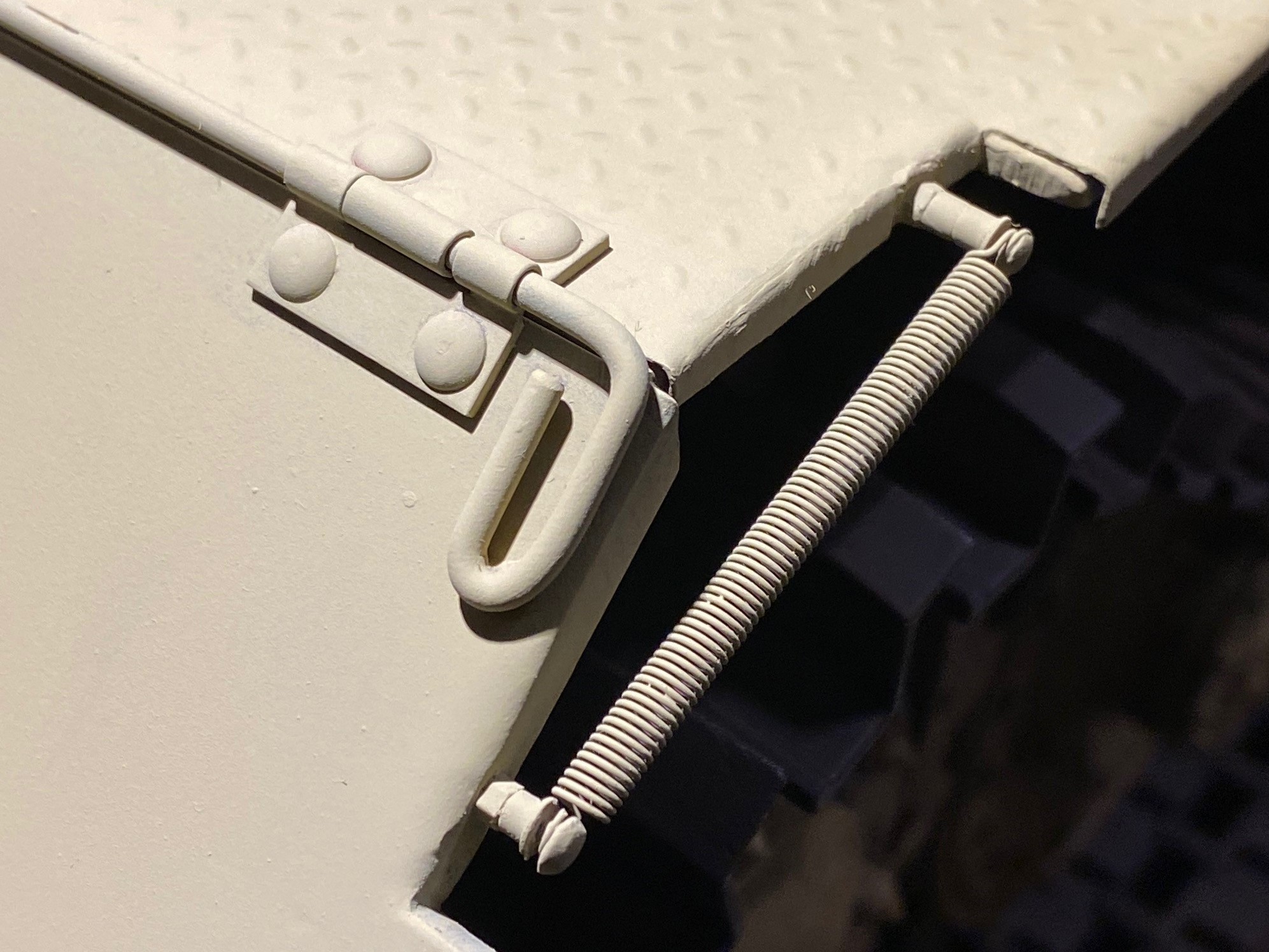

Post by Martin Hofmann »

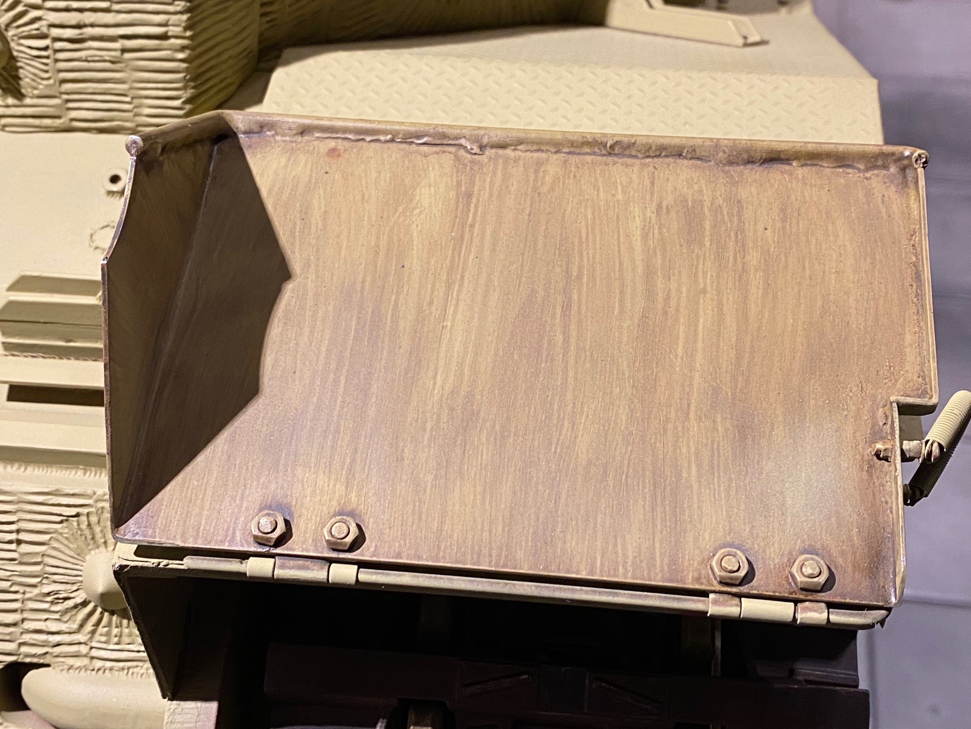

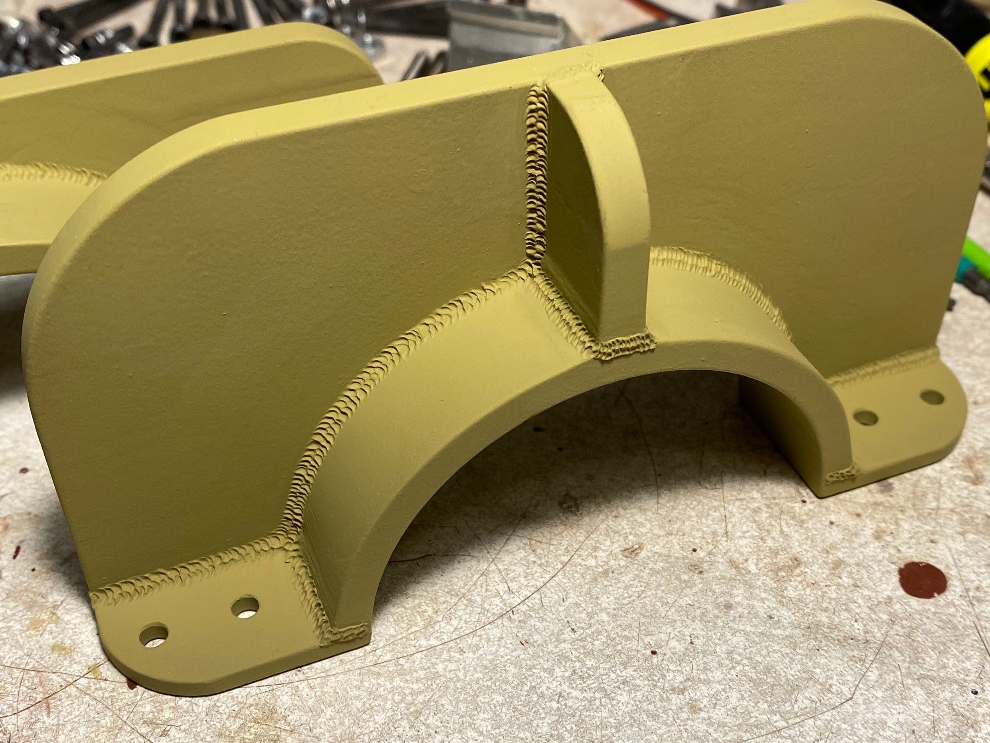

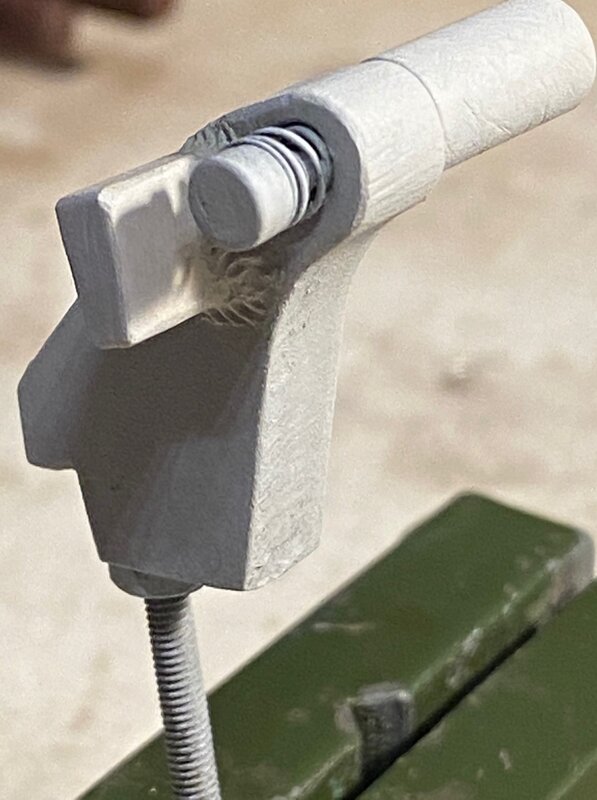

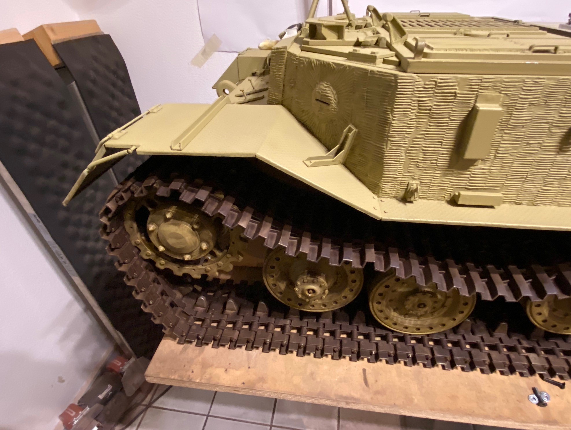

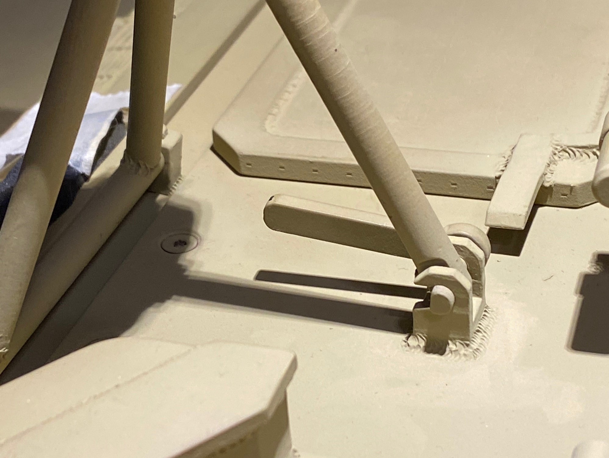

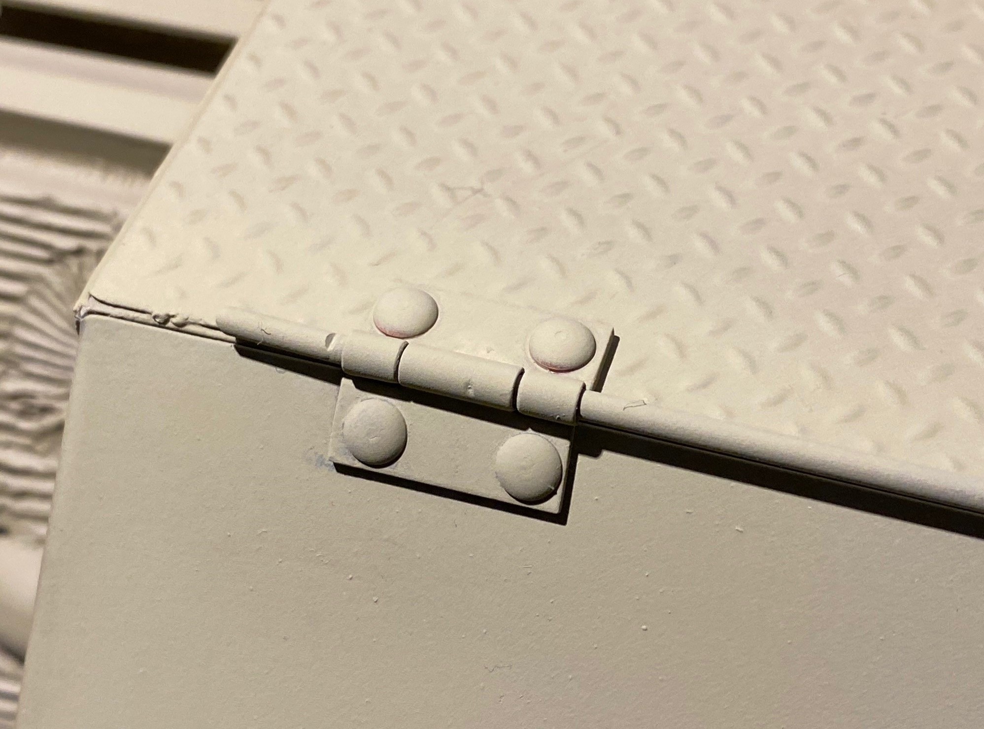

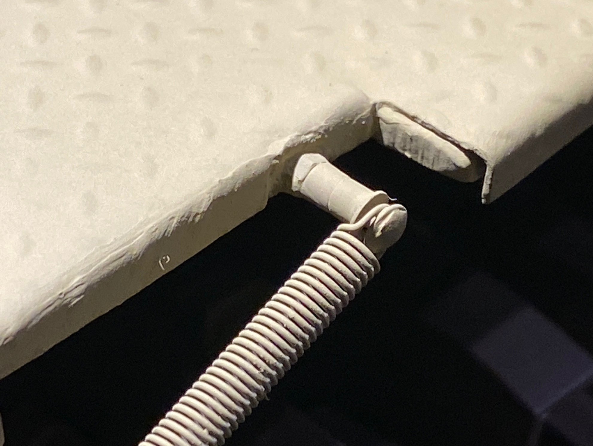

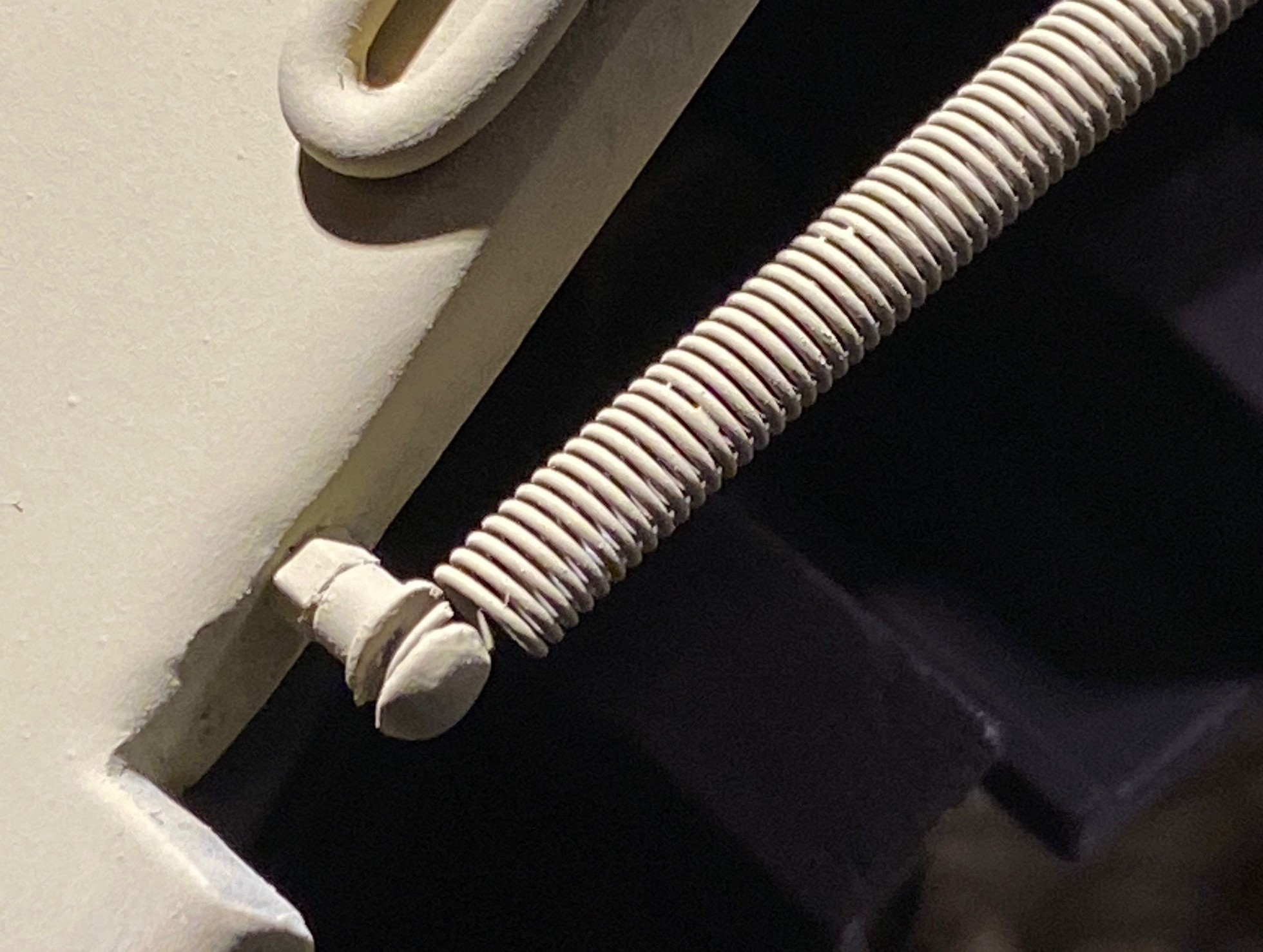

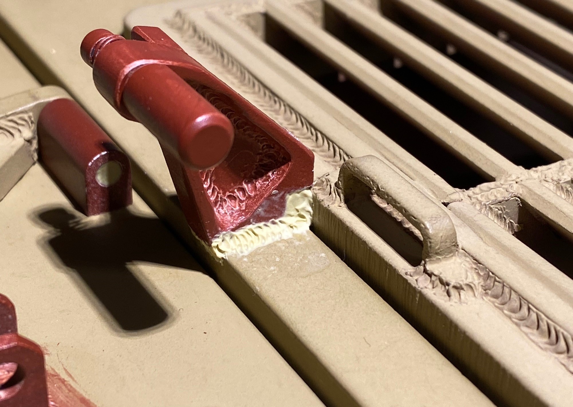

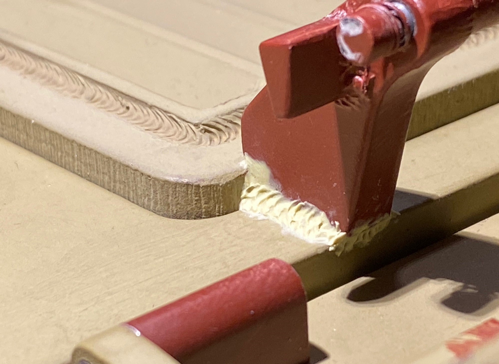

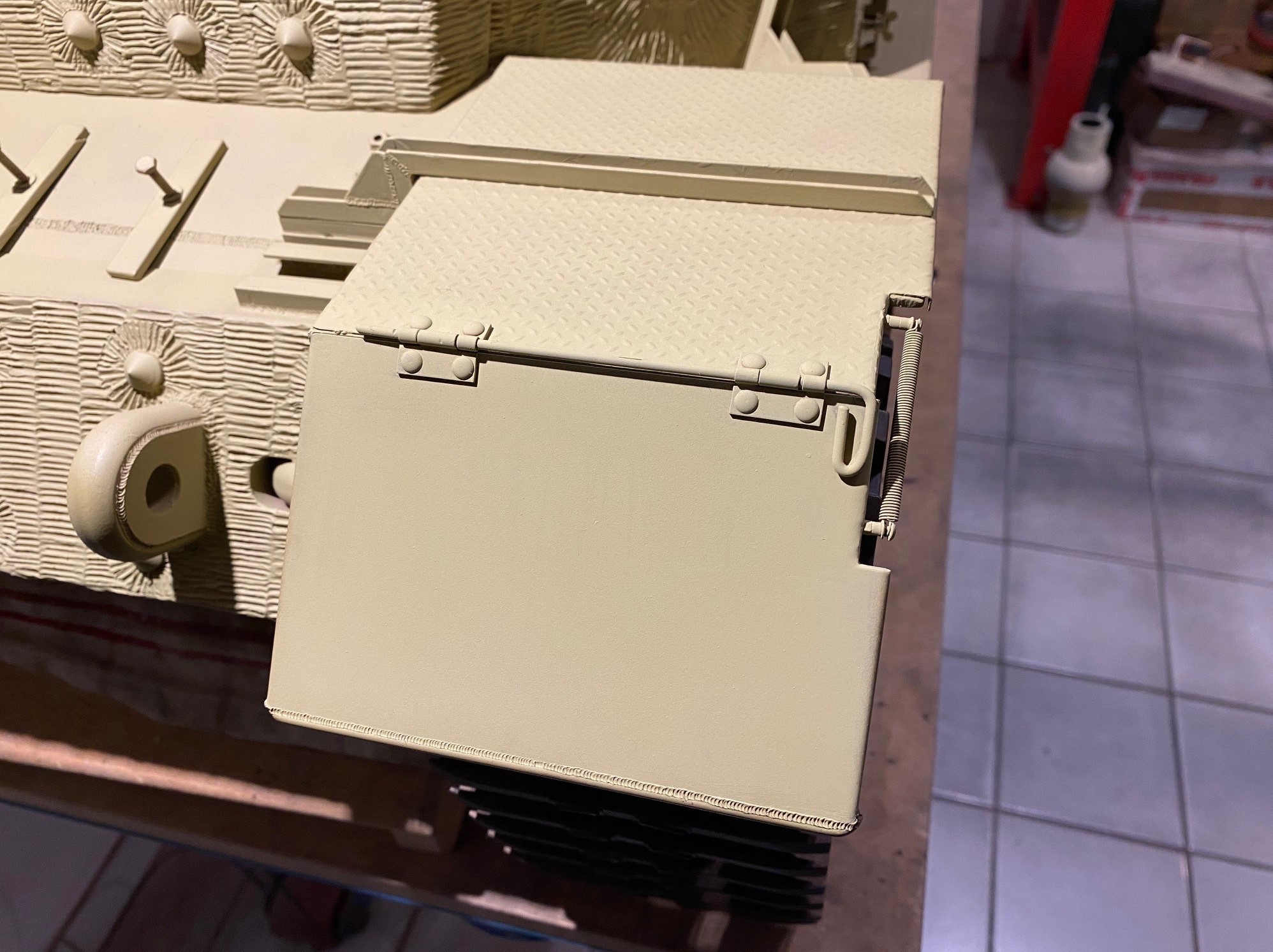

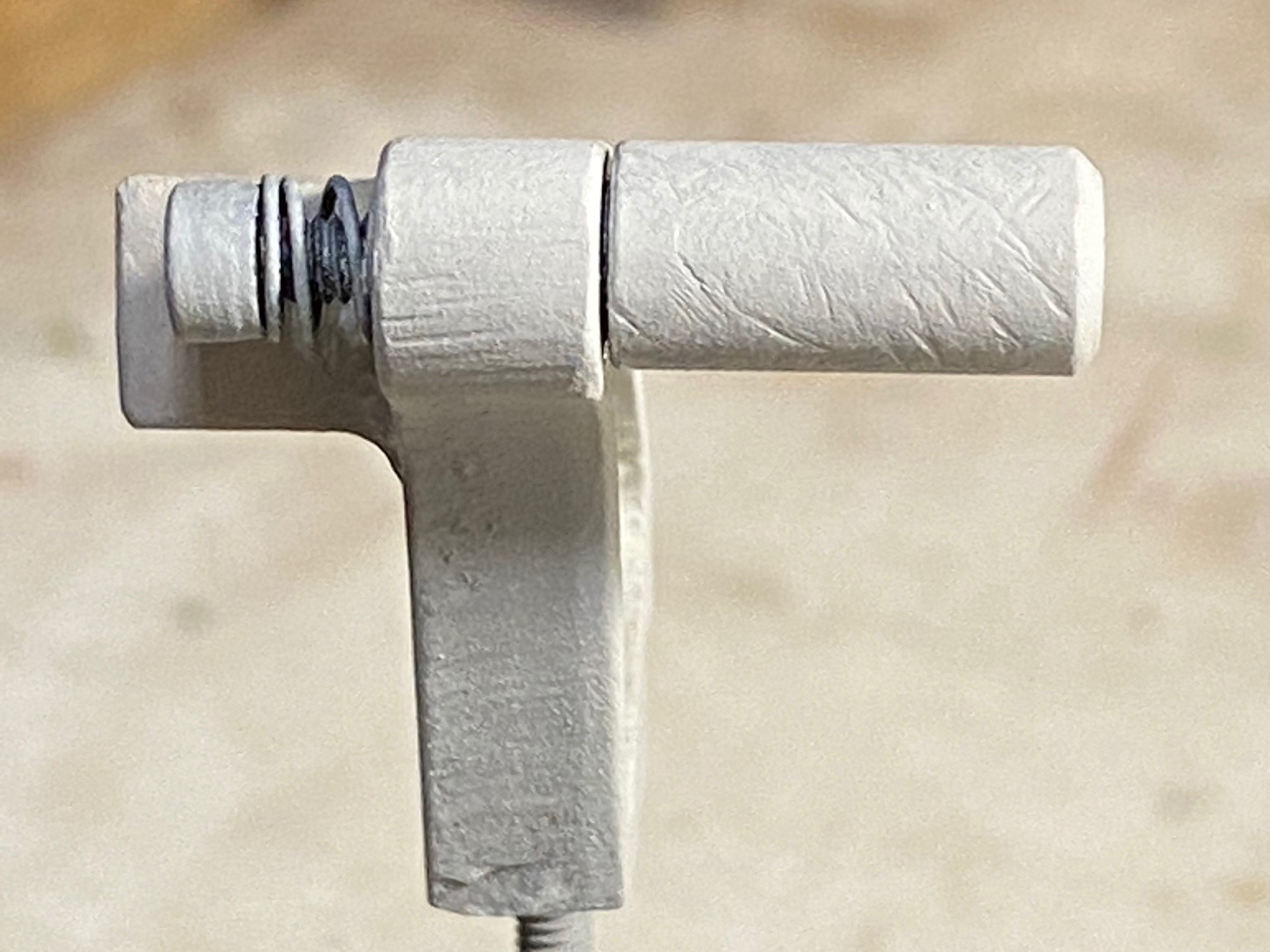

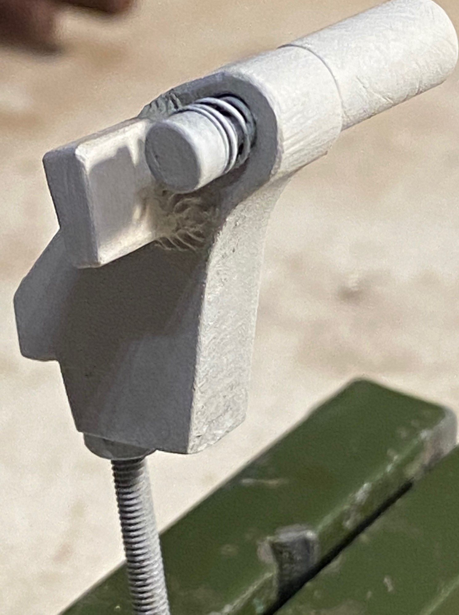

Now it is time to mount the mud guards with the self made hinges and the spring with holders.
Regards Martin

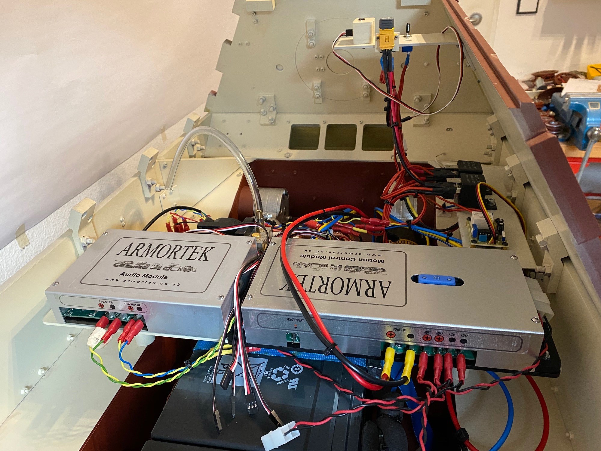

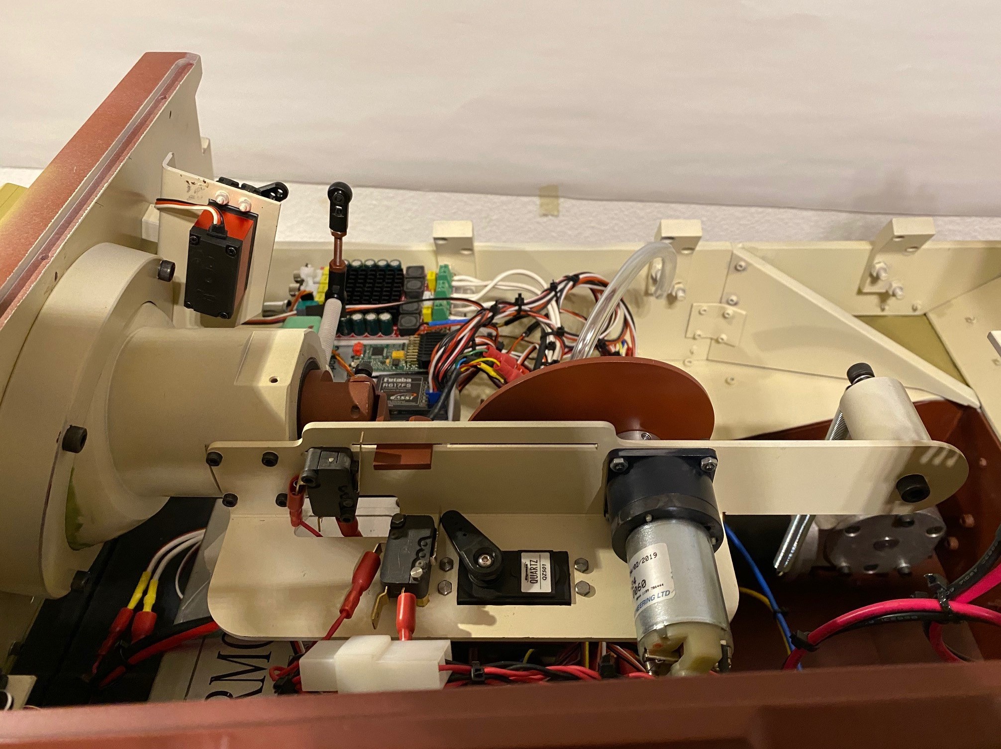

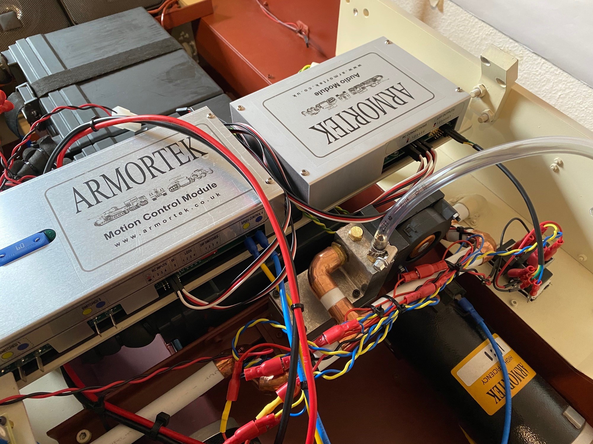

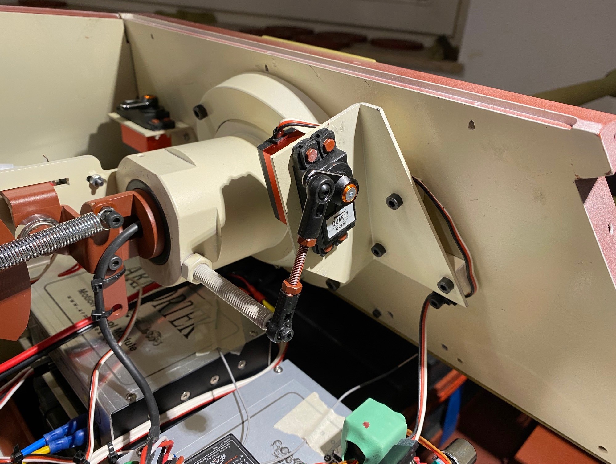

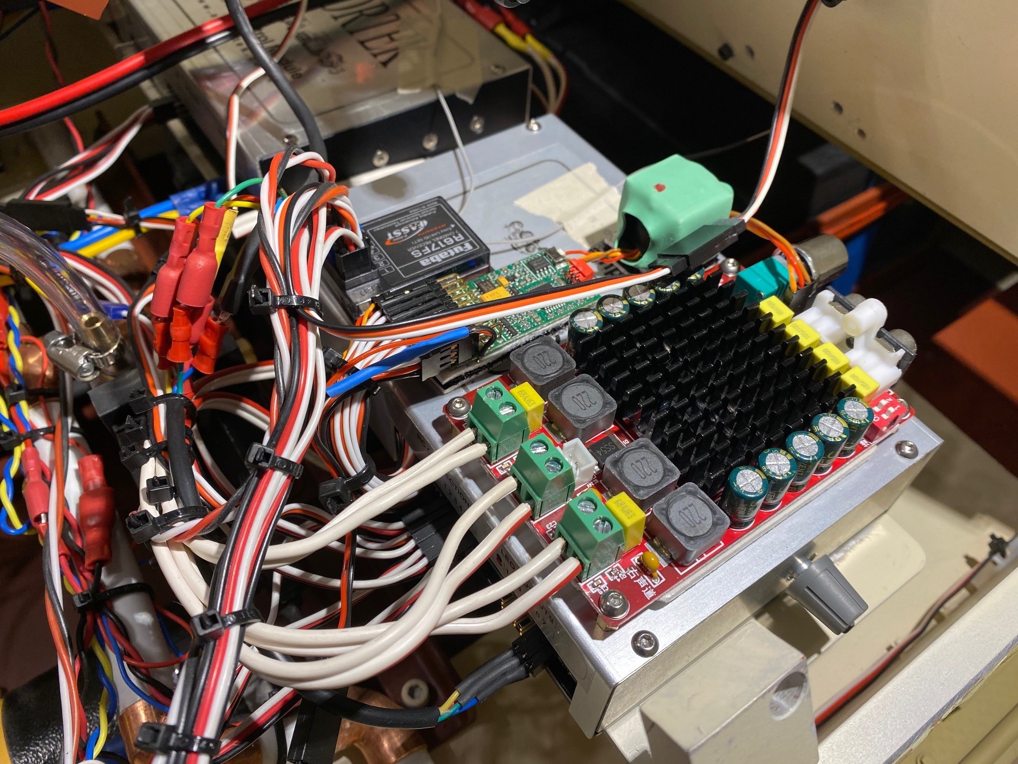

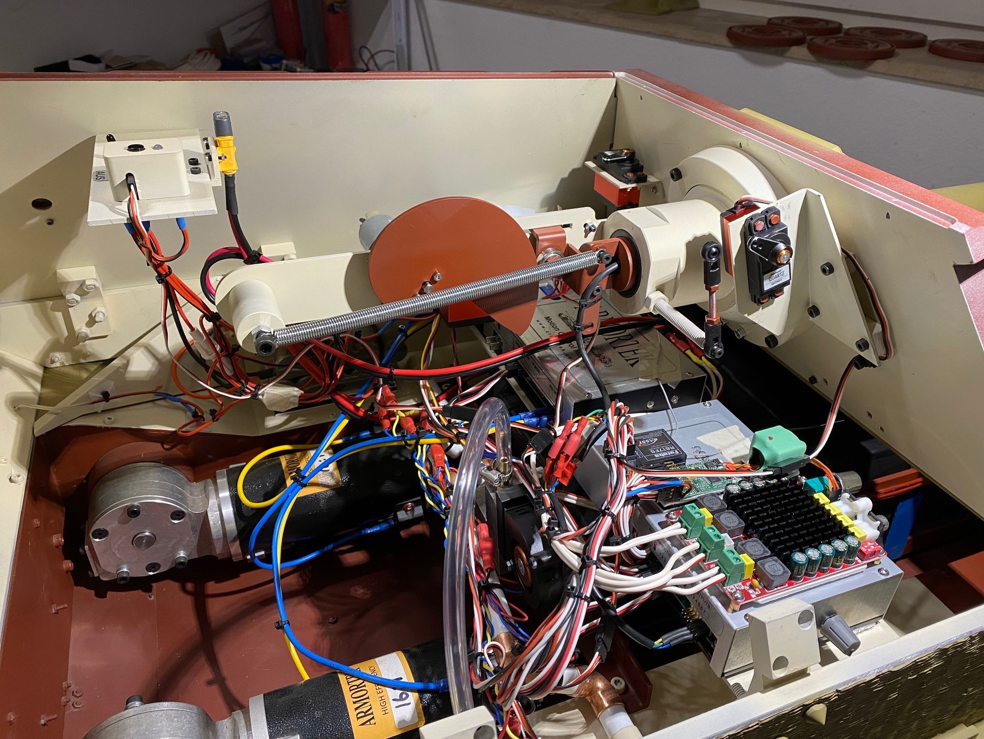

In the meantime i mounted the barrel, the recoil and all the electric components including the 60 Watt amplifier from Benedini.
I moved the servo for making the hight of the barrel above the bearing of the barrel because in the underground was no more place for it.
Regards Martin

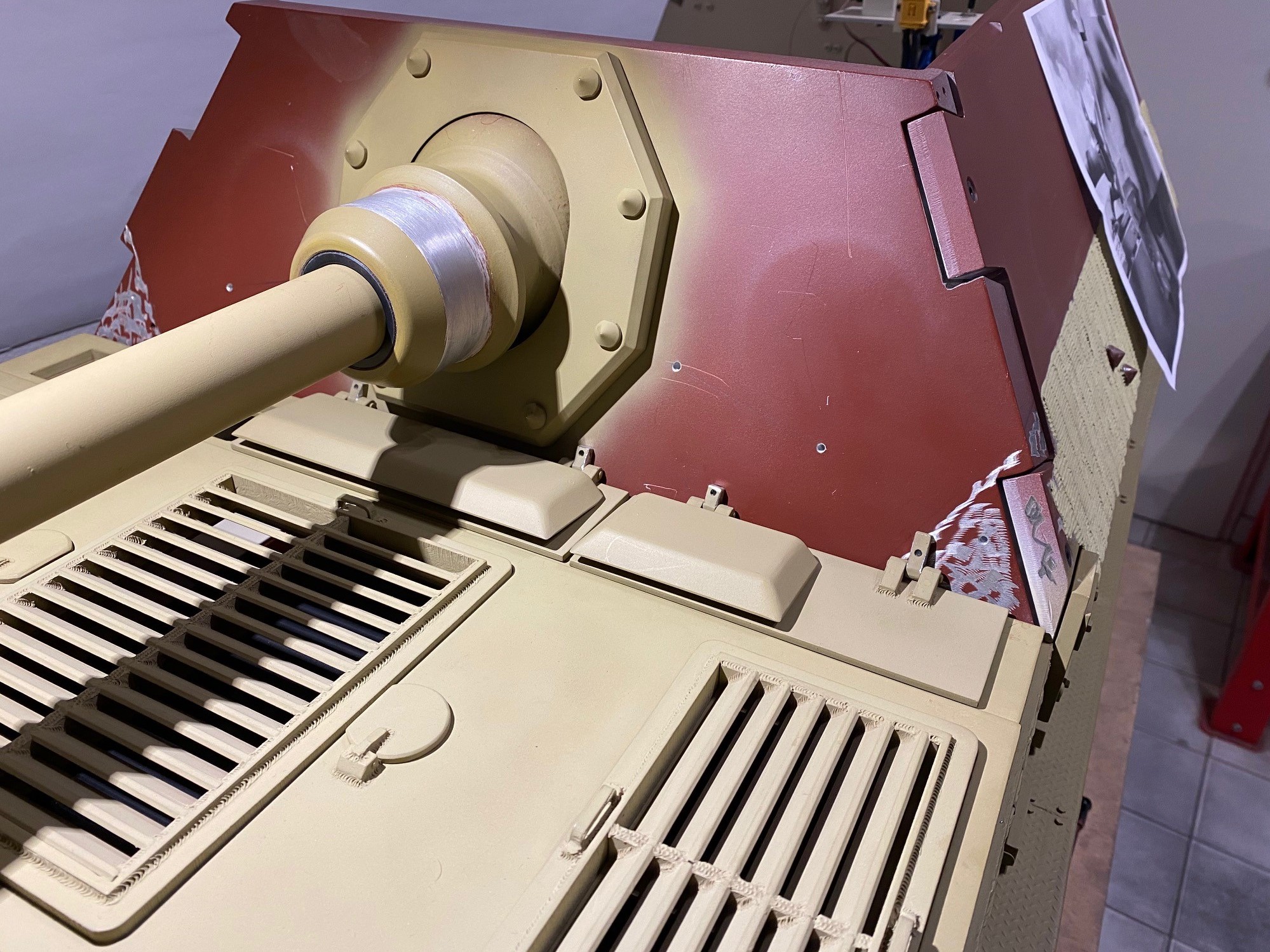

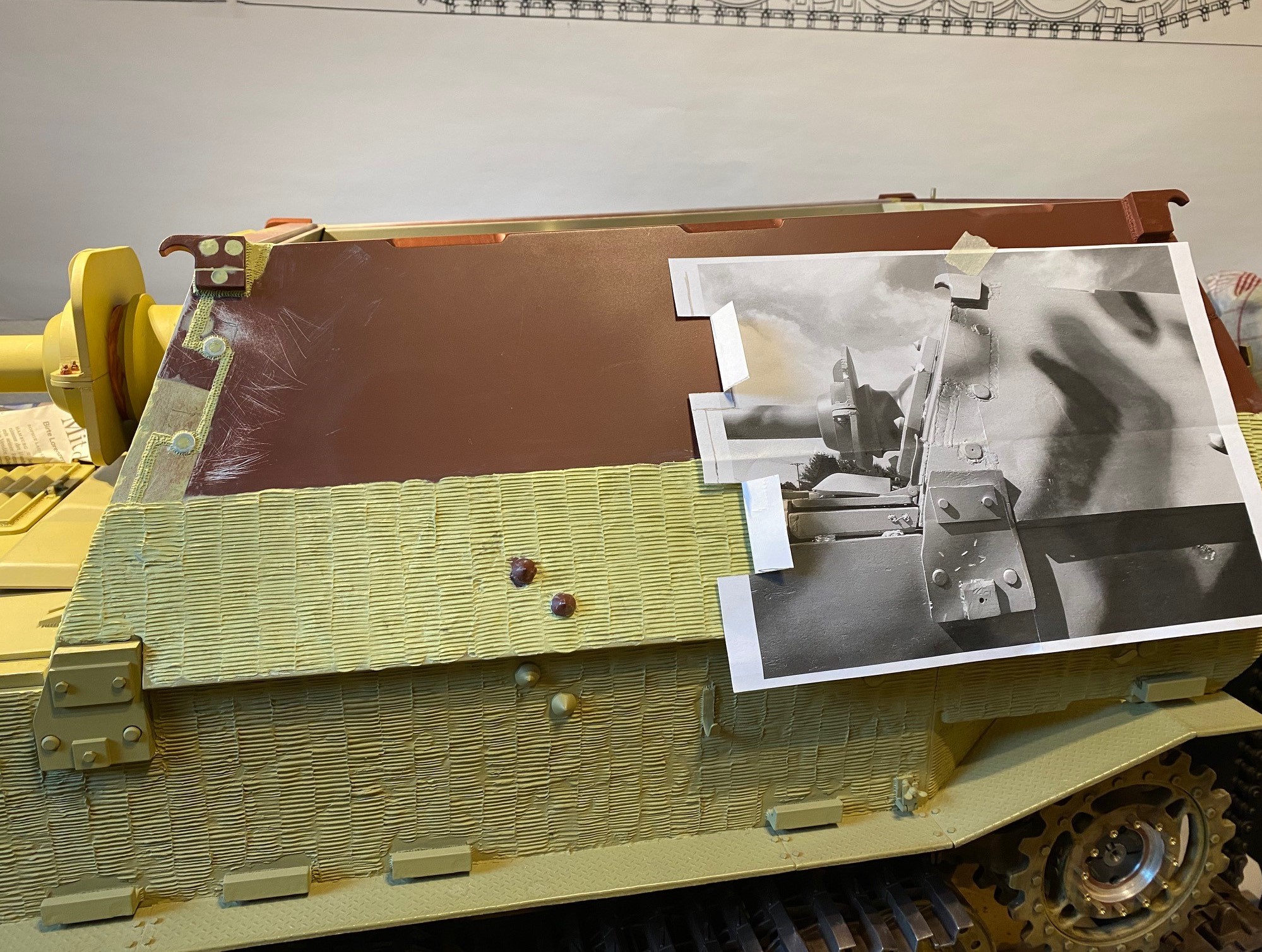

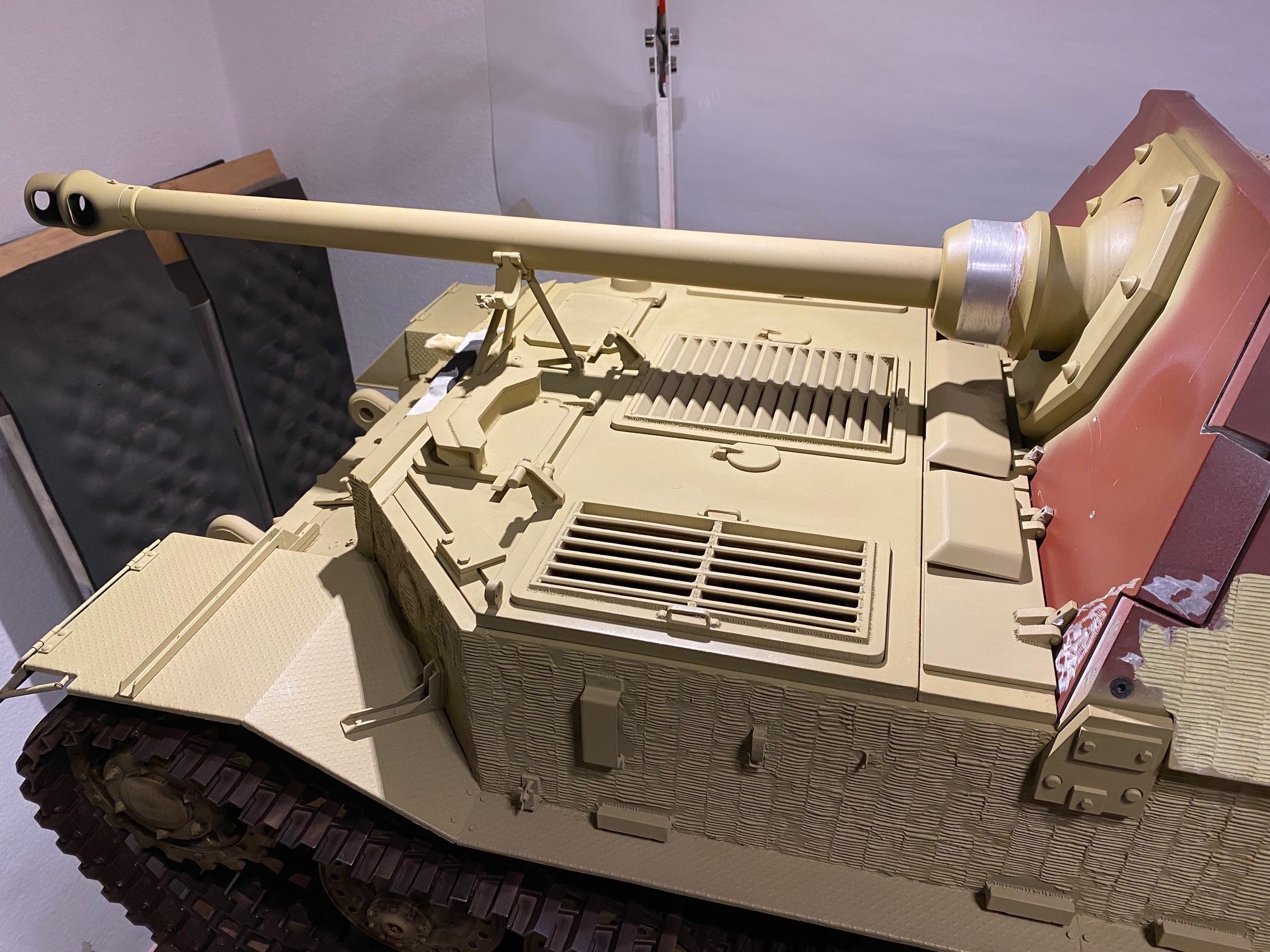

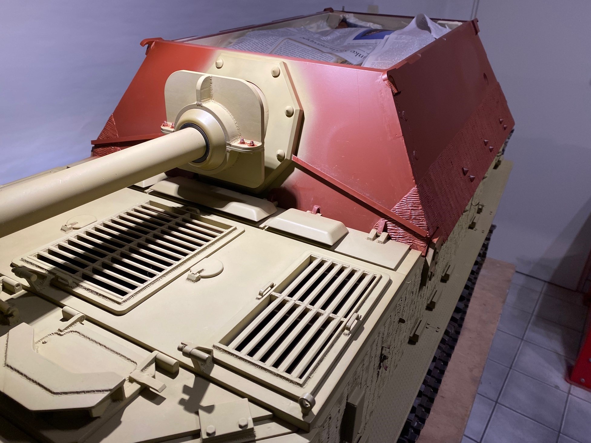

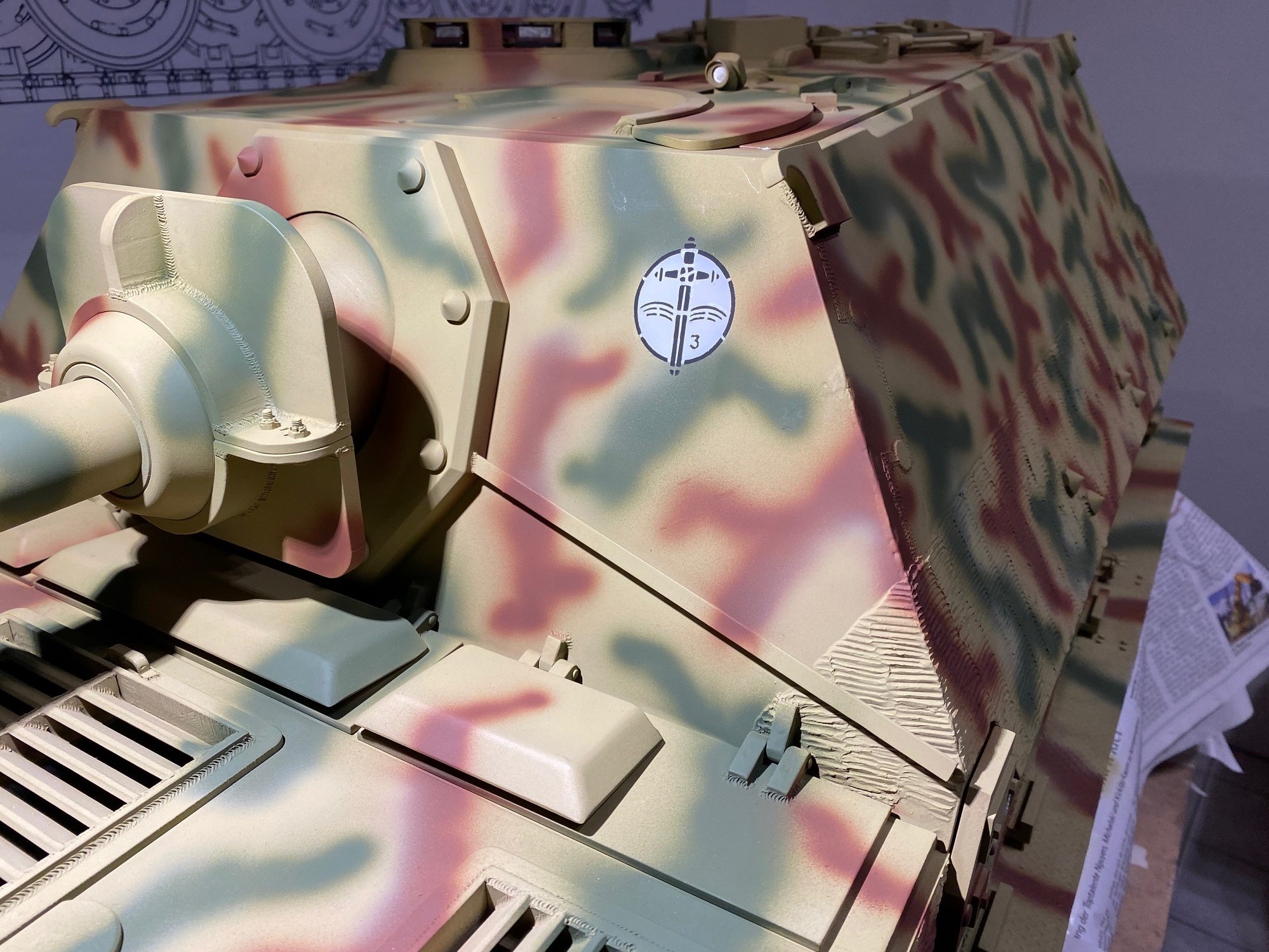

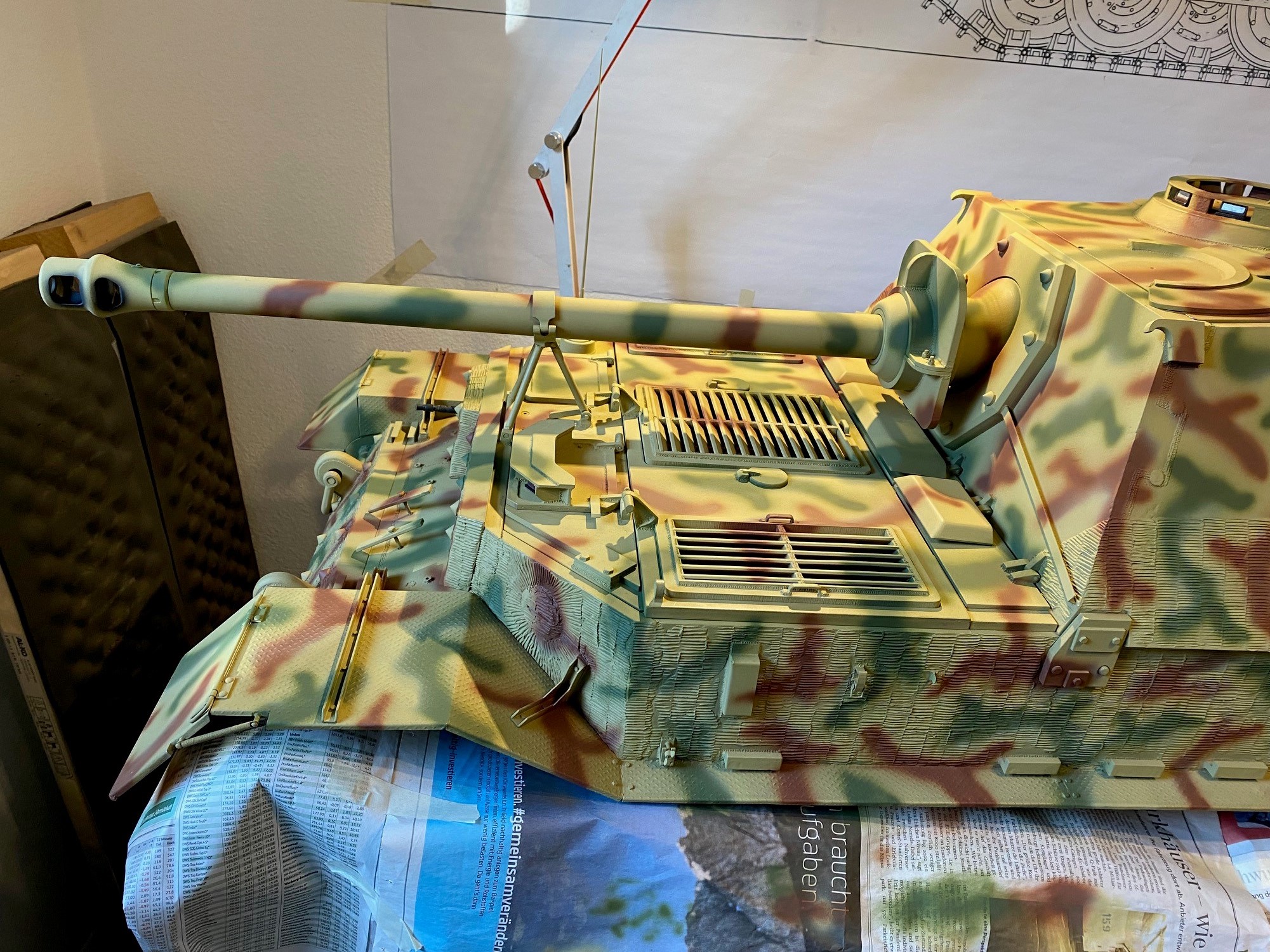

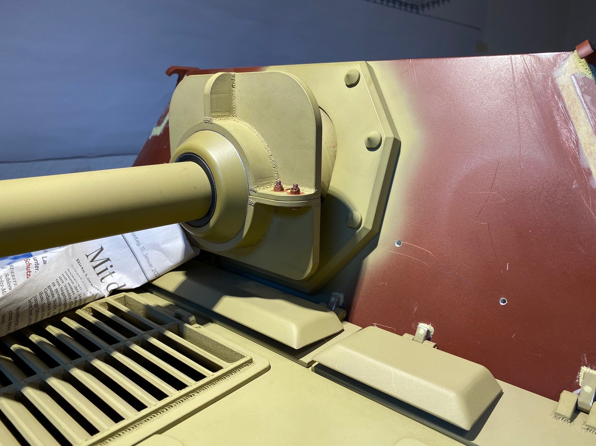

Now the mantlet is welded and the side plates are modified like the Bovi Elefant.
All Zimmerit is done - only missing the rain gatter - this will follow soon
Regards Martin

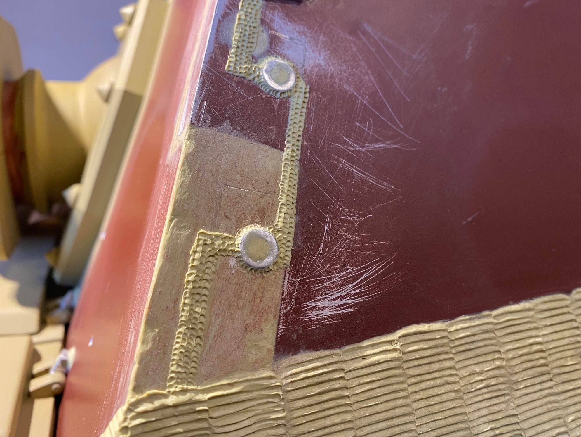

Here are the first photos of the modified pistol ports and the welded rain gutter.
Regards Martin

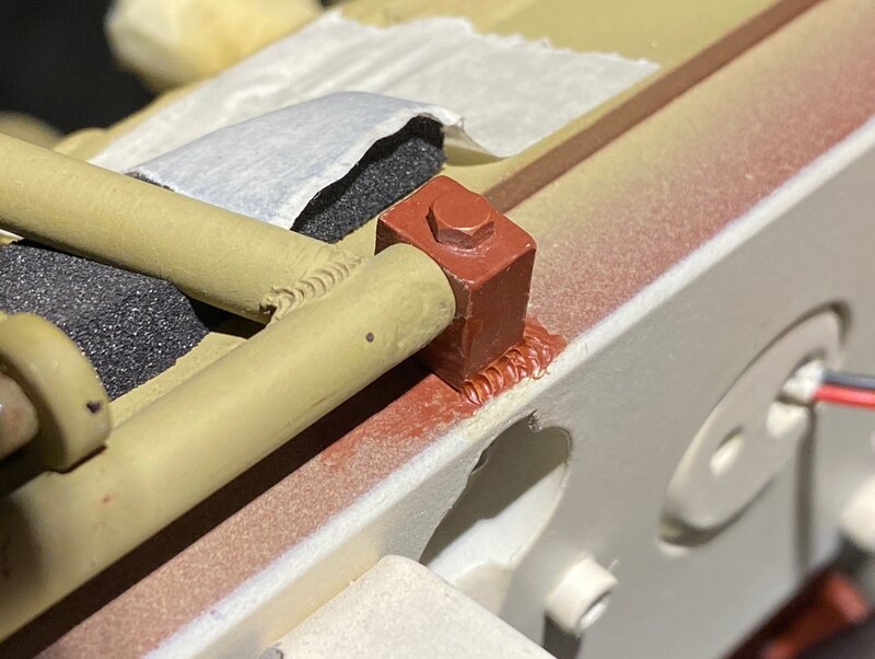

Martin Hofmann
Posts: 486
Location: Hamburg, Germany
Has liked: 151 times
Been liked: 2014 times
Re: Martin's Elefant
Hi Simon,
thank you for your comment. Your 7 is also absolutely outstanding :!: :!:

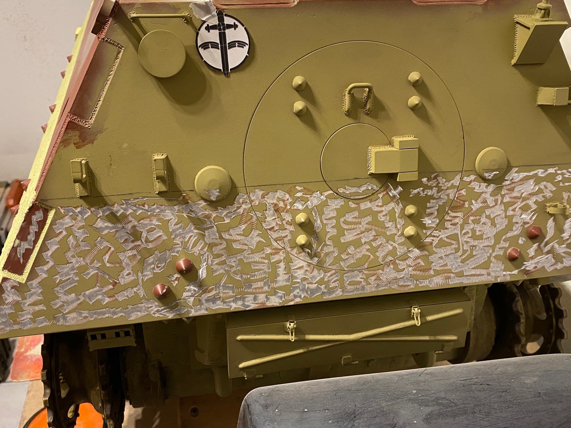

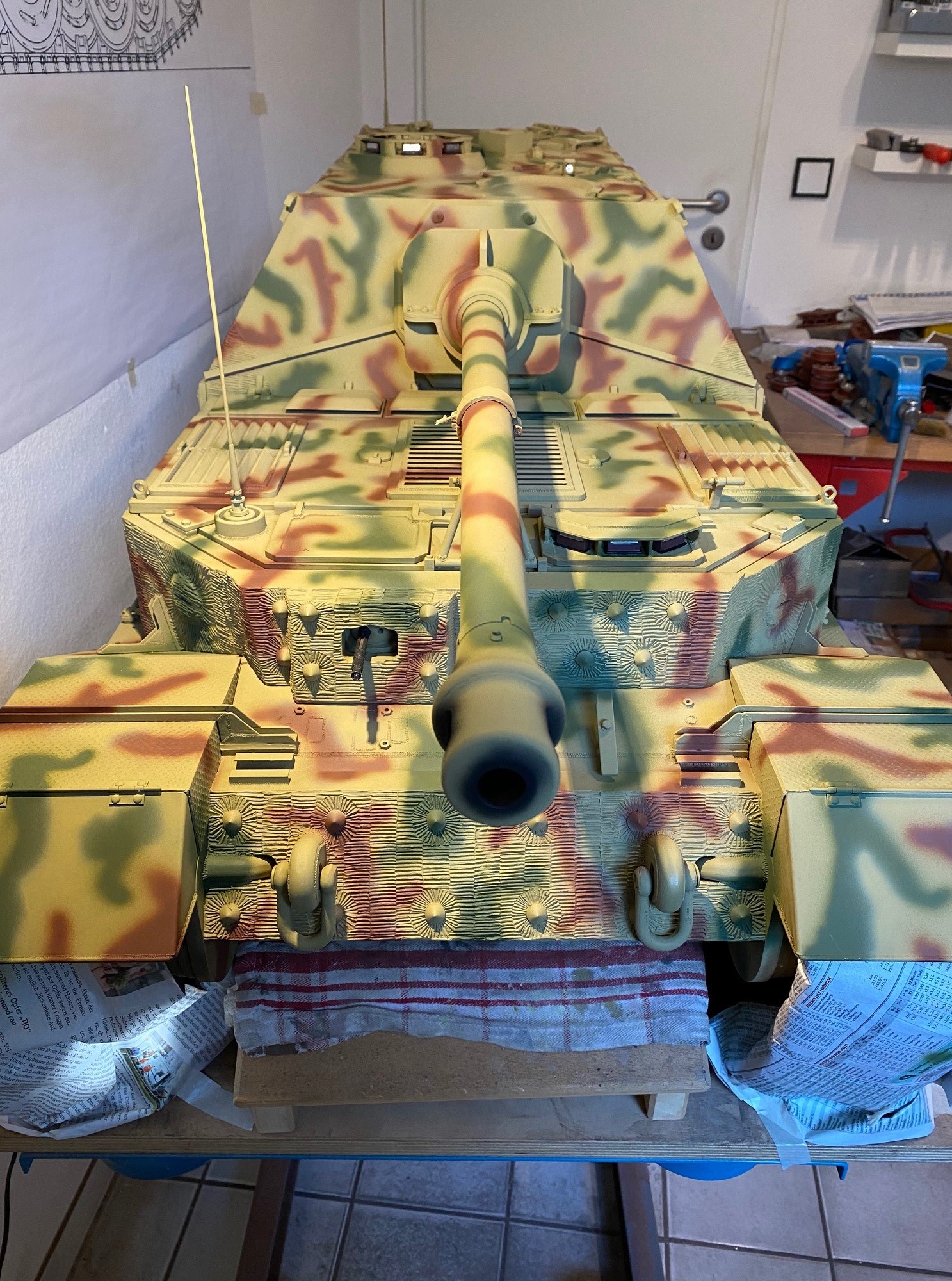

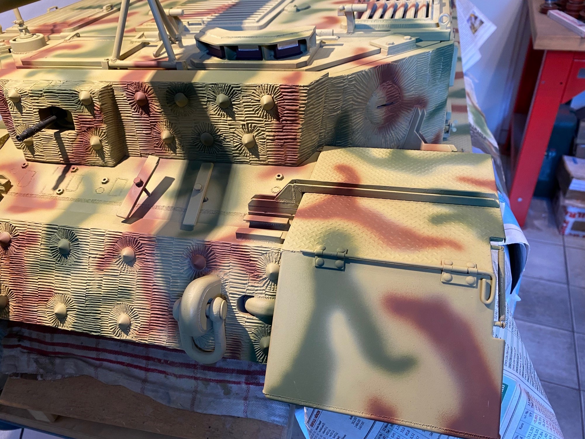

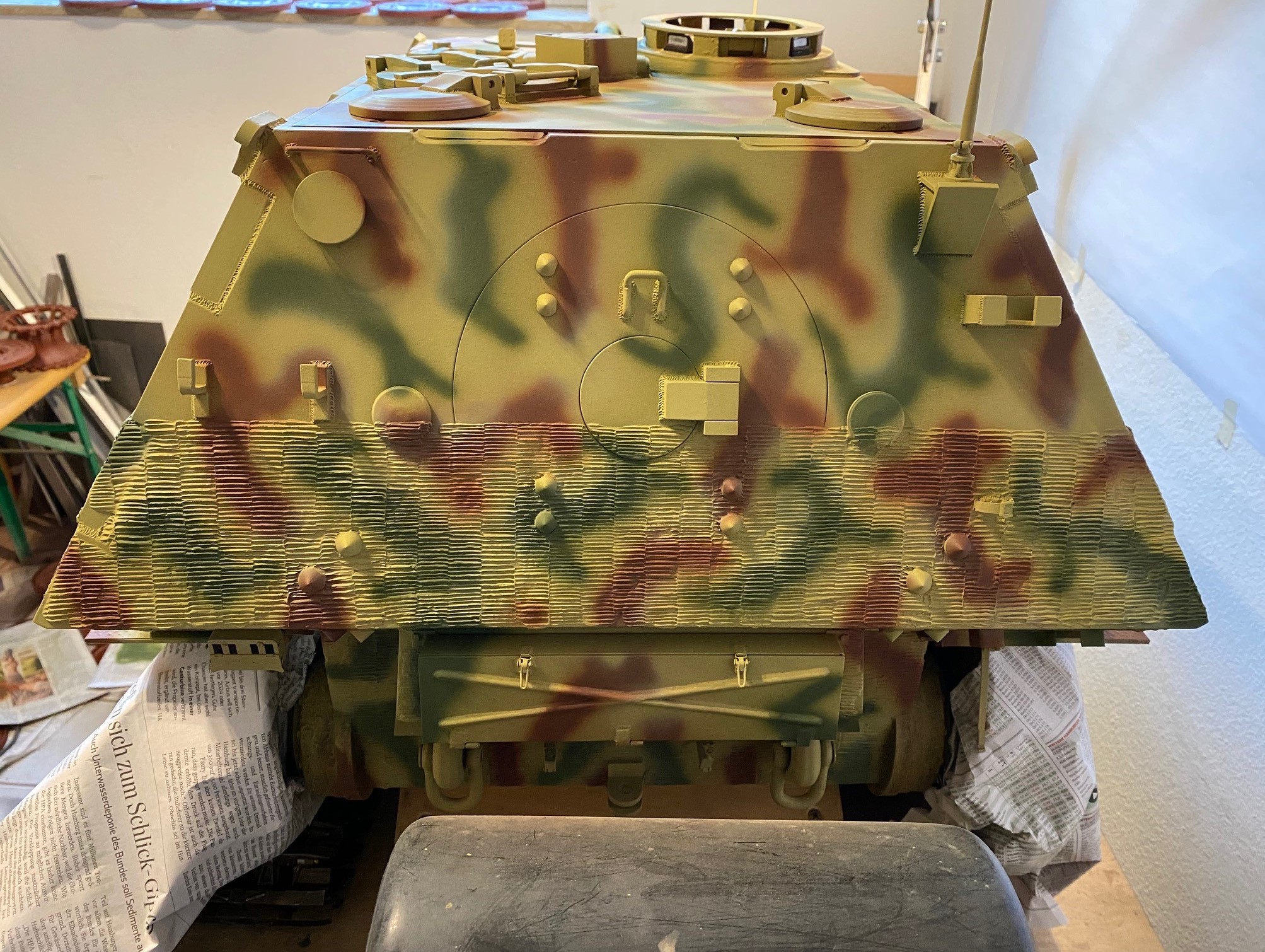

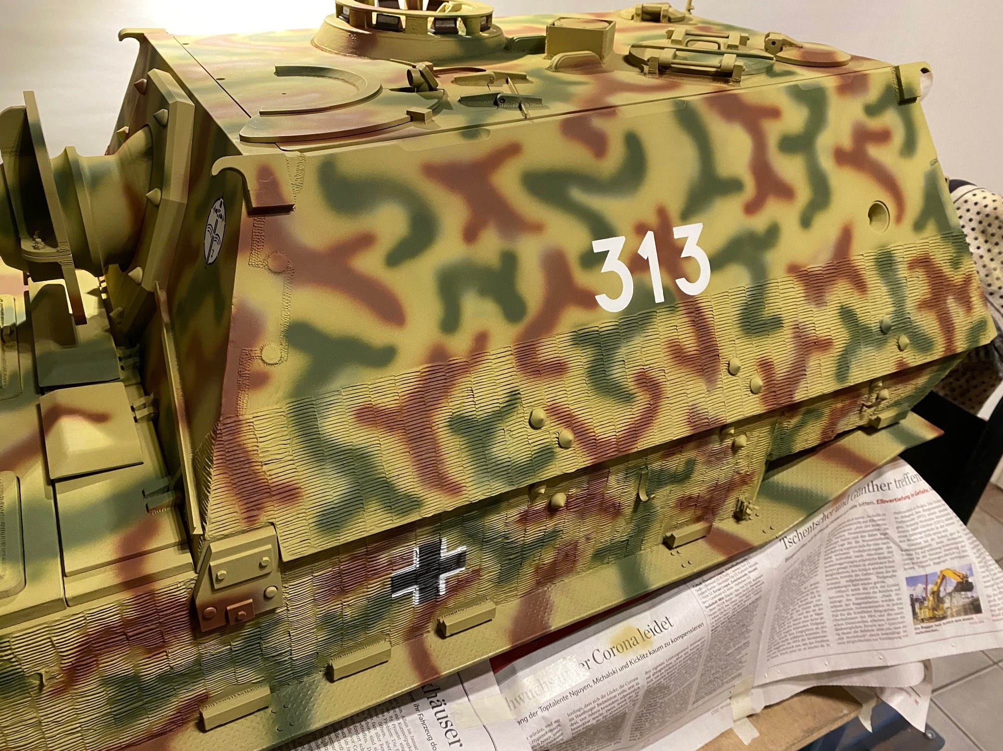

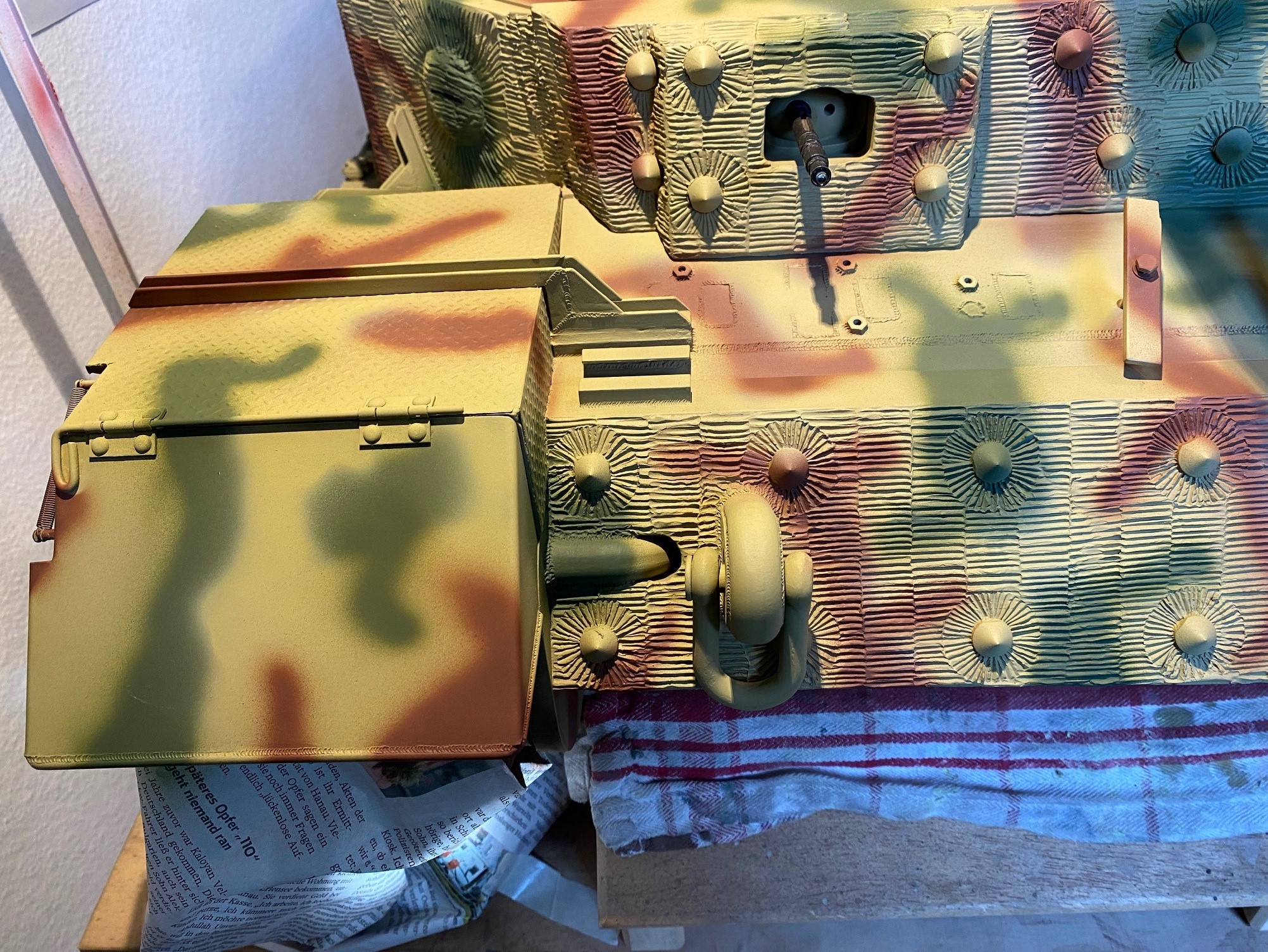

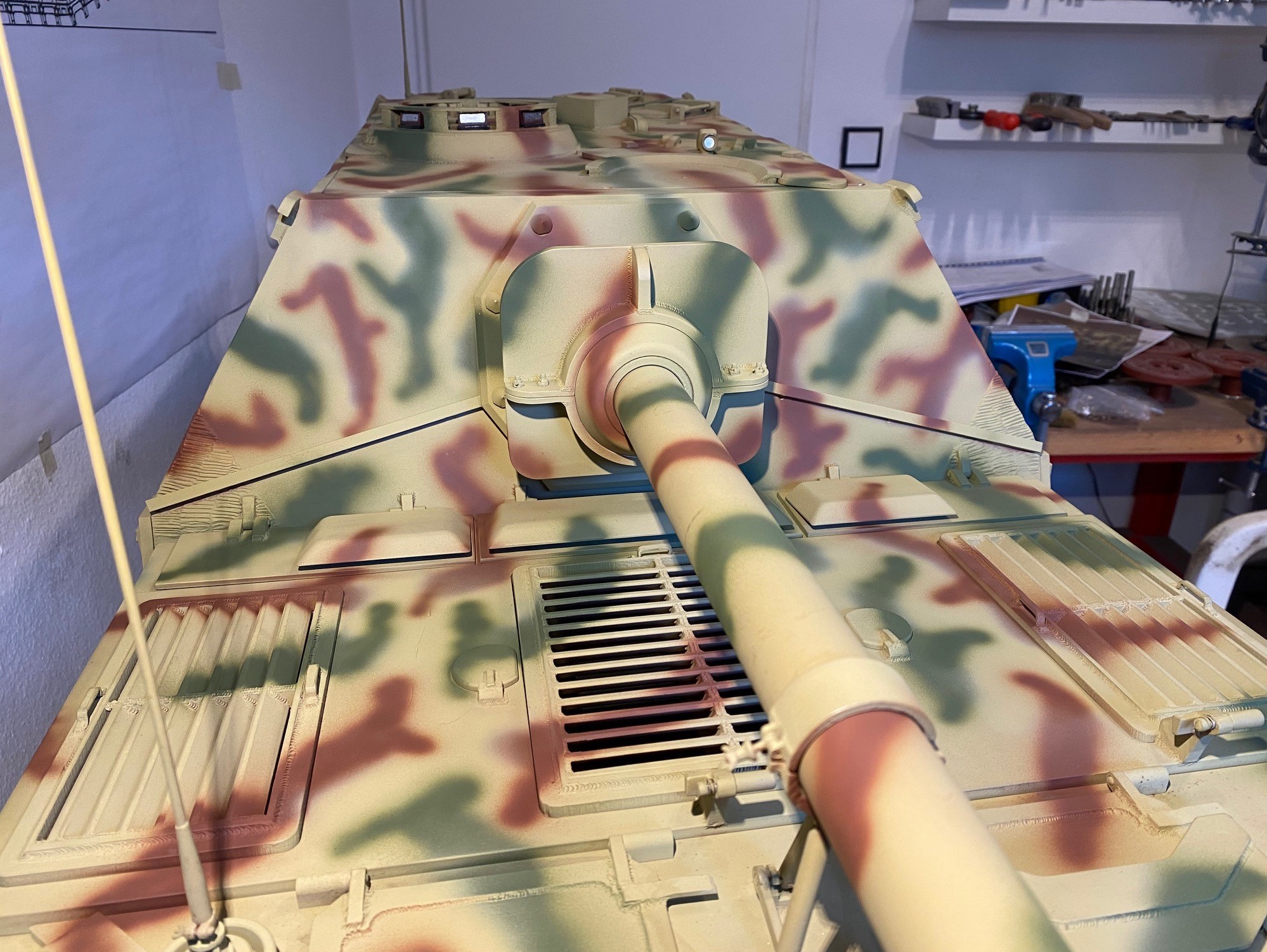

Here are the first impressions of camo. The field markings and weathering will follow soon.
Regards Martin
Posts: 2062
This deserves another post Martin, otherwise what's a Forum for, get the weathering right and the tank will look outstanding, i like that camo pattern and the detail, no pressure, excellent, regards simon.

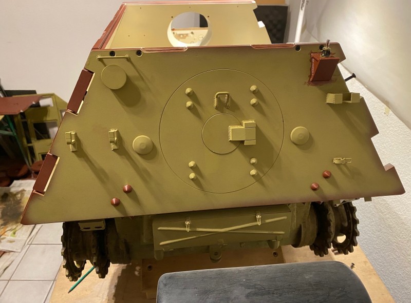

Martin Hofmann
Posts: 486

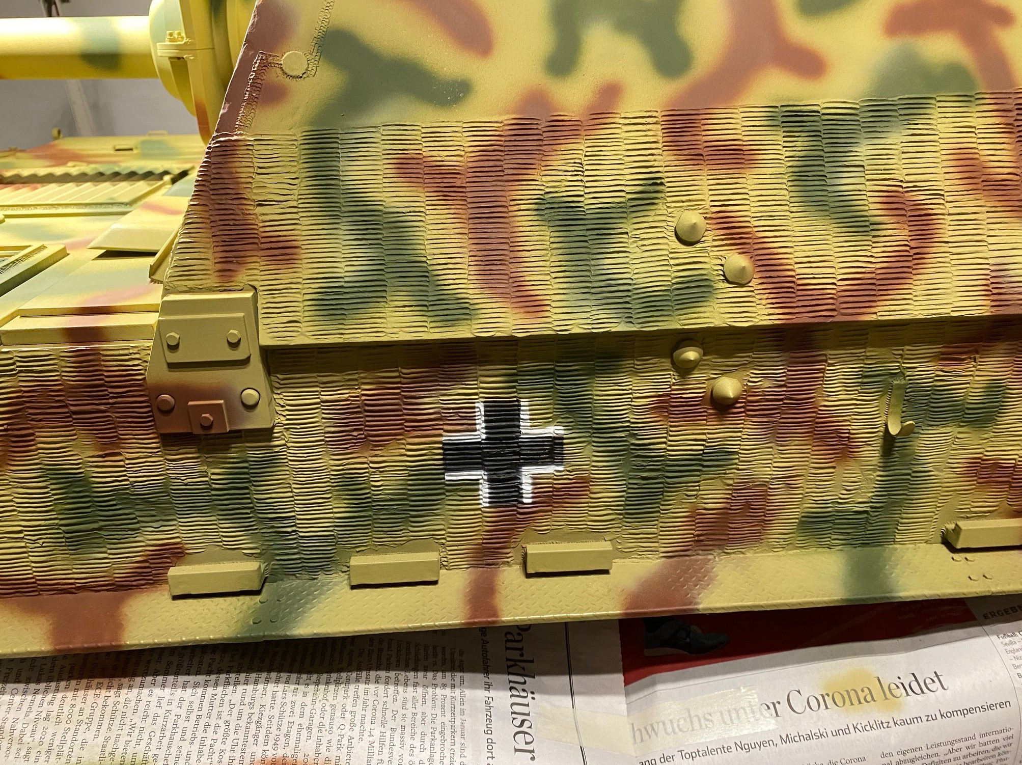

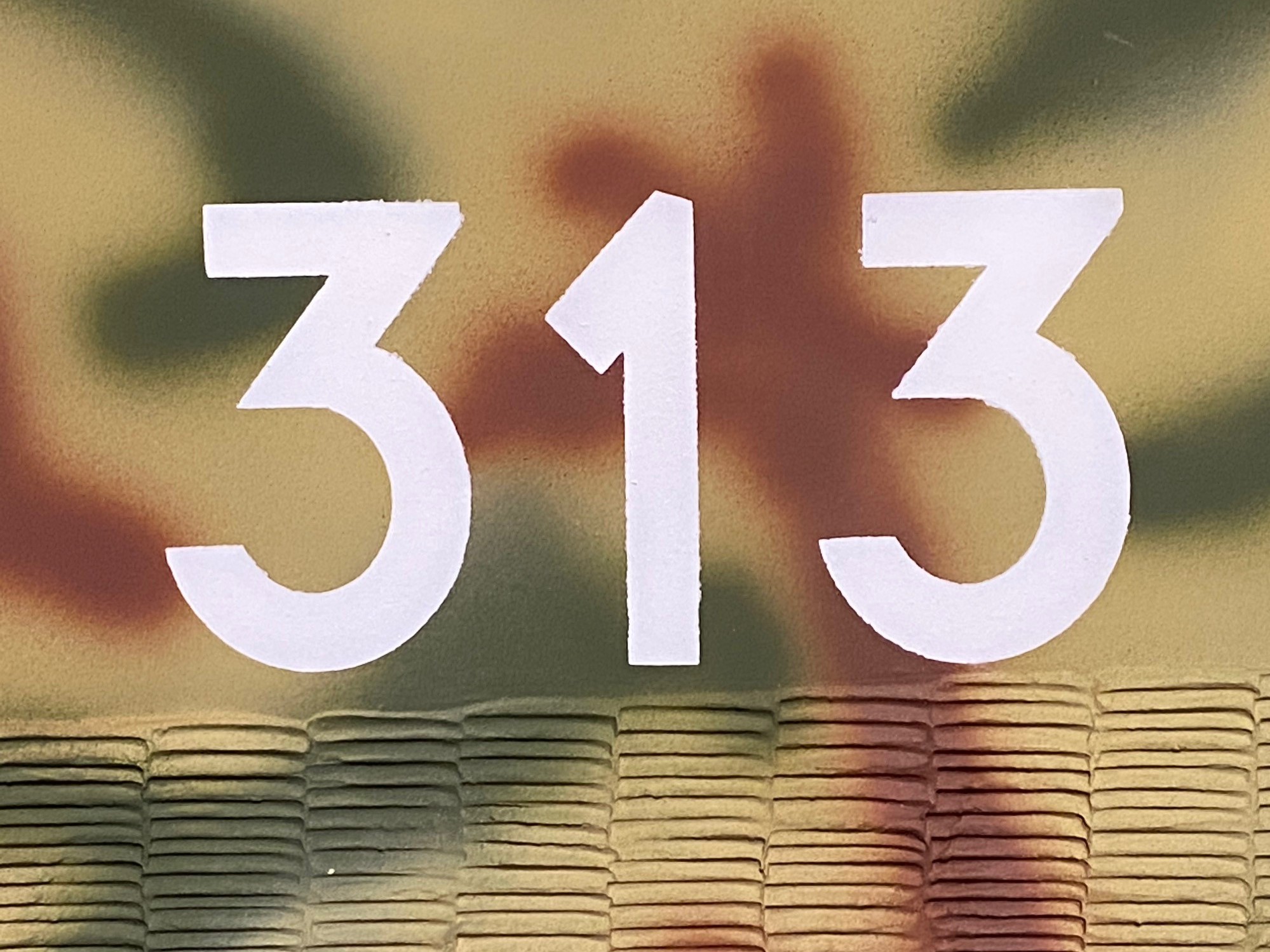

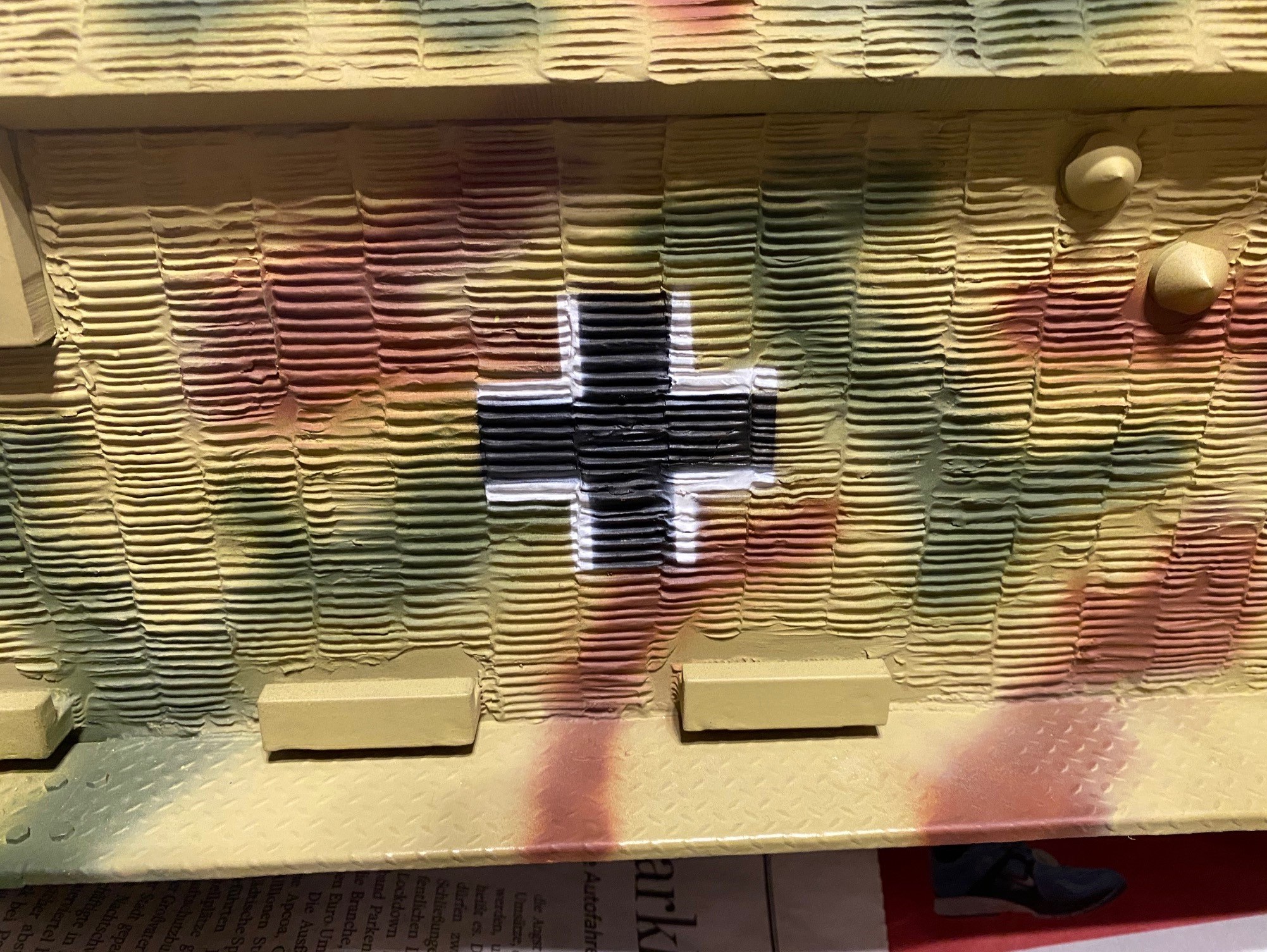

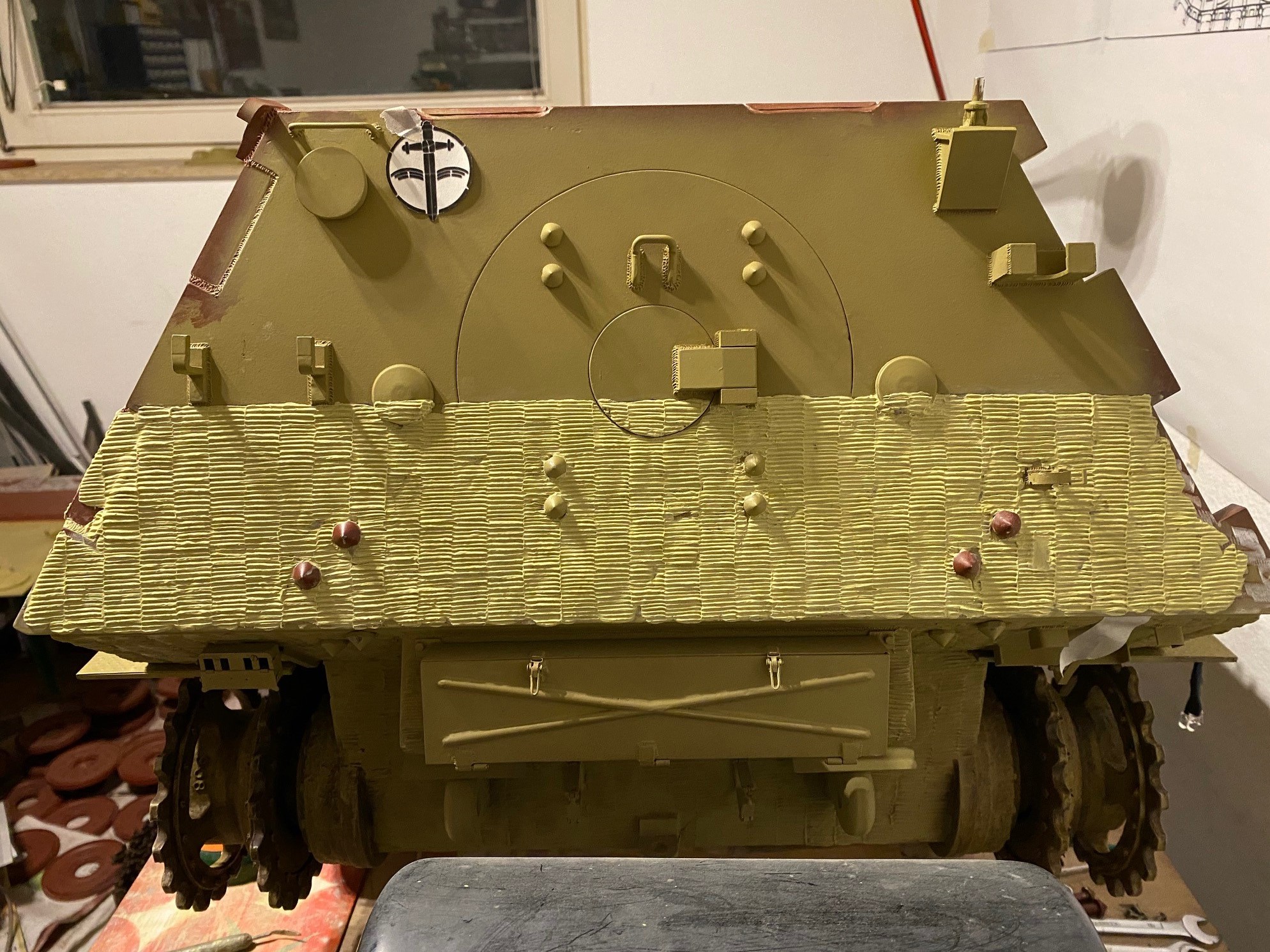

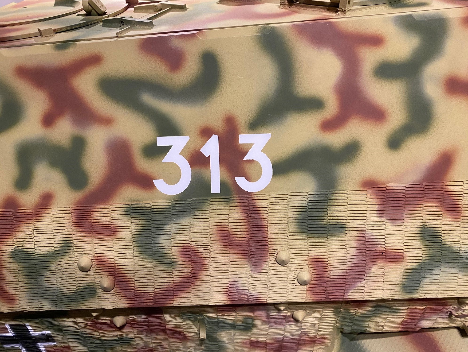

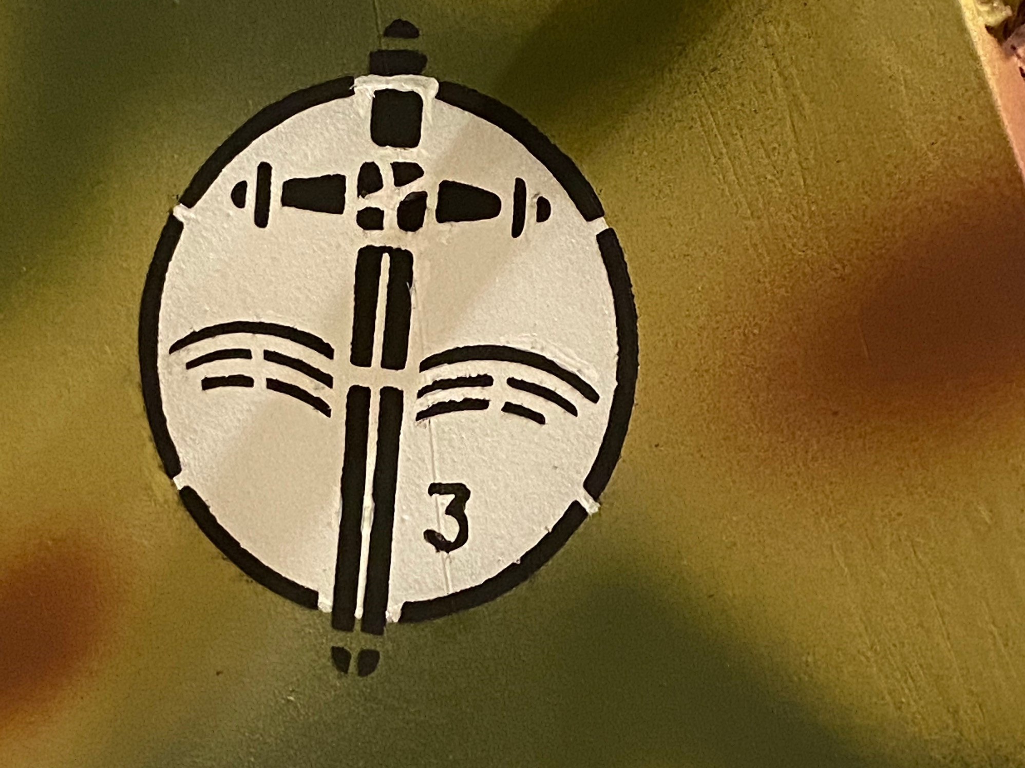

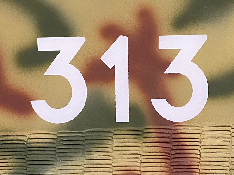

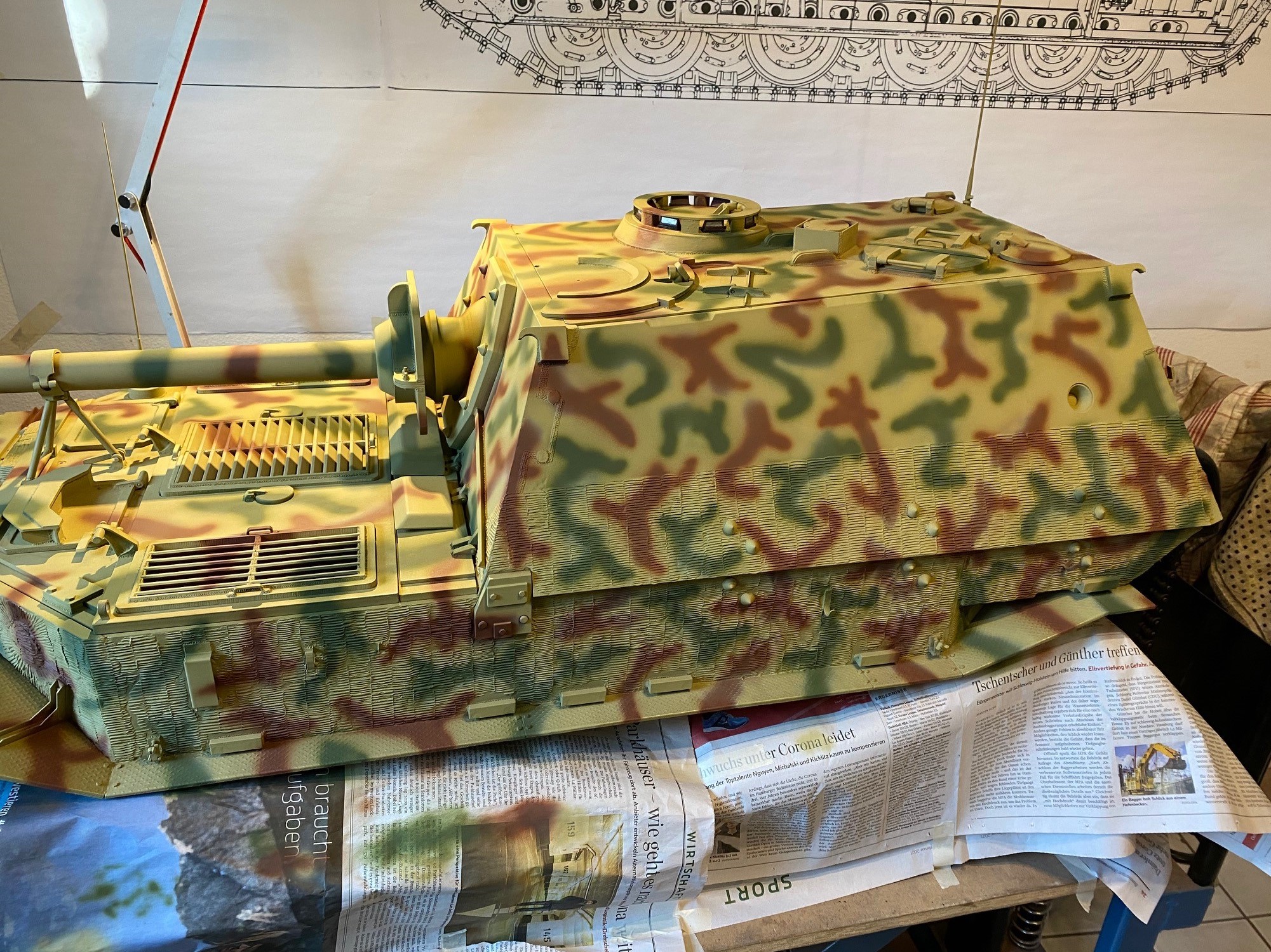

Here comes the first photos with the new field markings from the 653 schwere Panzerjäger-Abteilung
Regards Martin
