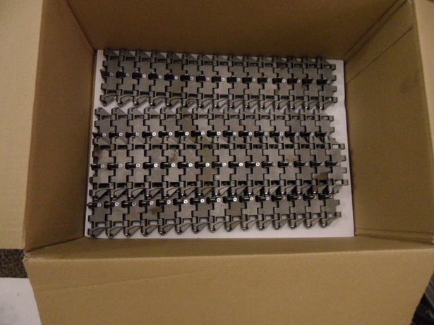

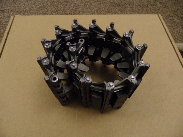

Had another Track day today. Starting to put them together in sections of 15, so they can be stored handled easily until needed. I'm doing 15 at a time so I don't get too bored, at the same time watch the goggle box.
There's some needle filing to do on a few of the outer edges so the pins fit snugly, with the stainless steel washers, I've used 6mm x 1mm Stainless split pins which won't rot away over time.
I might be poo poo'd, but I'm still putting a small amount of grease on each pin so that it slides in sweetly and reduces the possibility of scratching the fresh dry lub while pushing the pins into the track.
This lot should keep me going until Xmas.

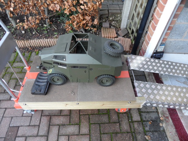

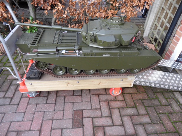

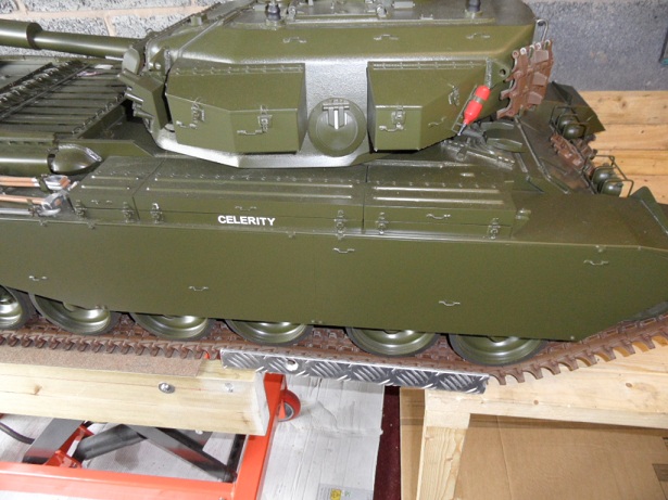

A few month ago I brought very fine Centurion by David Wilkins, It is this model quality that I hope to achieve with the Chieftain.
I was struck during pick up by the difficulty and accuracy the driving needed to be when using the lift table. The tracks over hung David's lift table by a few millimeters.
Twitching at the thought of a nasty slip and disaster and the new Chieftain model arriving soon.
I thought I must do something to avert any dreadful occurrences.
So I added wooden battens to the sides of the lift table to gain extra width, extending the same battens so that long ramps can be attached for an easy drive on or off and short ramps onto the work bench. Looks so much safer. :)

She has been hiding under the bench since she arrived, but now with the lift table mod, I can get her out easily and enjoy the detail and time you put into her.
A reference for Chieftain if I start to slack. I do want to make a couple of items for her. Otherwise she'll stay as she is.

So I've completed 75 track links, it's been very therapeutic, treating each link like a jigsaw piece. Some links fit together very nicely, some a little tight. So it's a question of getting the right fit. Mix and Match, There's no rush.

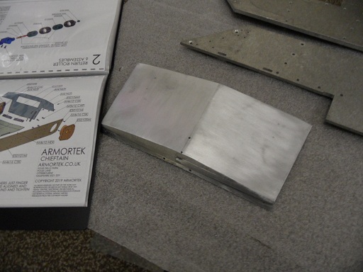

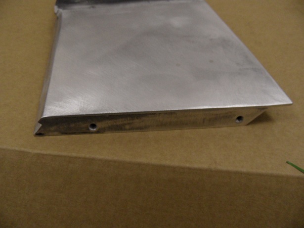

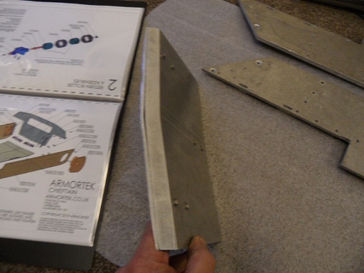

In the mean time I've been wondering about how I'm going to get the Hull front plate angle correct. I think it could look better.
The original model front plate is about 4 degree's inclusive, by my reckoning it should be double that at about 8 degree's or more inclusive. It would be too difficult to bend the model front plate (12mm+) and what you may add in the middle you will surely take away from the sides.
So while thinking about it in the bath, I had a eureka moment, add more armor, (shaped applique armor!). Chieftain has the thickest armor anyway, a little more won't hurt.
I've bent a 5mm plate to fit the original front plate, attached it though the towing lug plate holes, and shaped it for several hours. 8 degree's now, looks pretty good,
I'll glue the two pieces together then I can use the original towing lug plate holes for their original purpose. It even matches the side plates better as there's not so much over hang to trim off now.

A good solution John for those that don't have access to a mill albeit one with a lot of filing so not surprised it took a few hours but it does look good! :mrgreen:

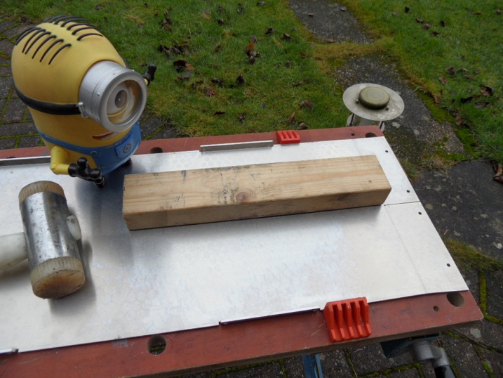

I've had a look at the Chieftain builds with motors fitted and feel a bit more comfortable and positive about the next step.

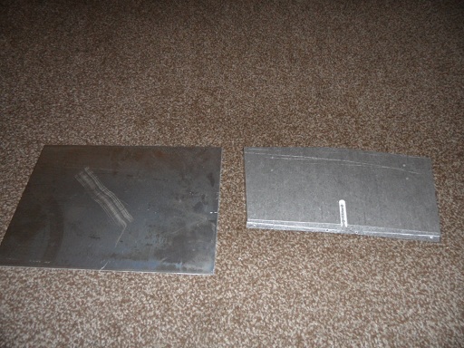

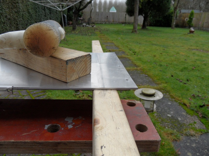

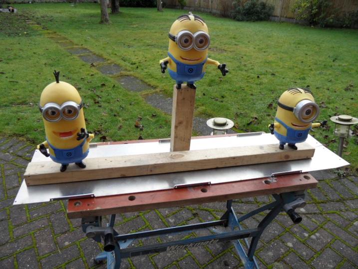

Weathers warmer and the B&D workmate's up and out the shed. And together with my glamorous assistants, I thought I'd follow Stephen Whites lead and sort out the "Famous rear end".

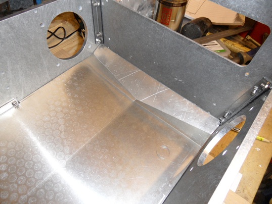

First flattened out the rear of the belly plate with a mallet and a block of wood. Squared off the "fish taiL" edge.
Then put the not so sharp vee bend back in the belly plate, mallet and wood again.

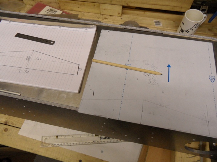

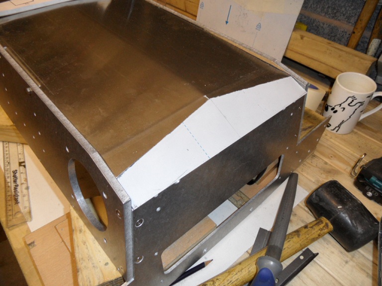

Now on to checking on Stephen's belly plate and rear plate mod from forum, Using my Mr Magoo eye for detail, made the appropriate cuts with a jig saw.
After cleaning up some of the dings in the side plates, screwed hull together, measured up for the missing rear plate.
Cut a new piece of 3mm aluminum plate. waiting till the new year for welding up.
Should be ok and the build can commence.
Richard Goodwin
Posts: 434
Has liked: 294 times
Been liked: 291 times
Post by Richard Goodwin »
Nice one John! Glad to see that welding is taking off a little :D
Can't quite see from the pictures but remember this:
Where the new part added sits on top of the floor such that you can see the floor edge and the back plate sits on top of the new part such that you can see the new part edge if you get my drift? Knowing your attention to detail, I'm sure you have done it this way :lol:
