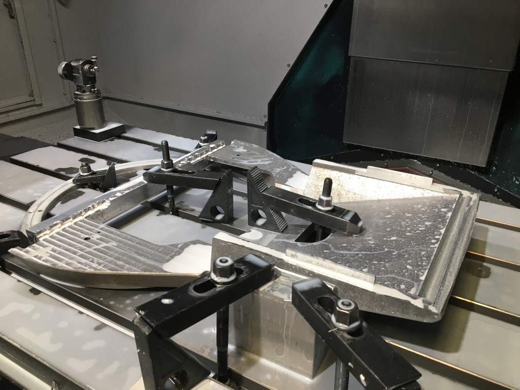

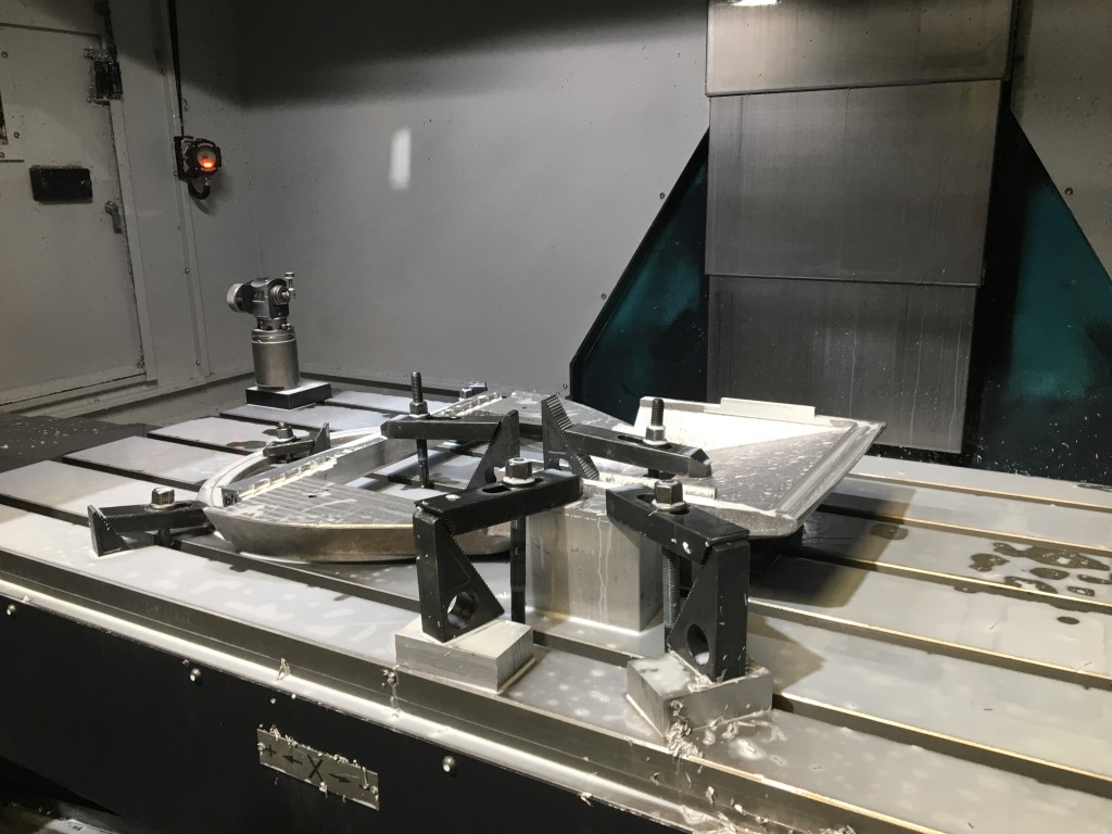

Yesterday we started with the Front Armour plate - the pictures below show the first operation - which is skimming the underside to get a datum as well as adding some features to allow us to hold the piece the other way up on a 5 axis machine to put in all the features needed.
First completed Front Armour piece should be off the machines by Friday. Once they are done, which should take about 40 hours then it is on to tackling the turret .. and then its packing up for shipment !

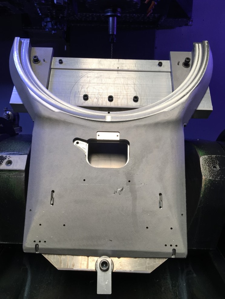

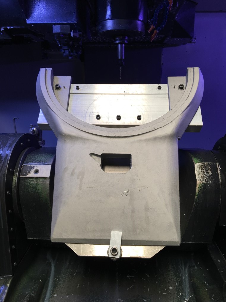

Machining of the hull front armour well underway now & opened the factory on Saturday to get through as much as possible.
Pictures below show before and after. The second picture is the finished hull front. Does not look like much difference, but the second op involved drilling and tapping holes for all the details as well as boring out the drivers hatch cutout and the turret bearing slot.
With castings every piece is different to some degree, so this is a slow process wit lots of checks.
Turrets casting machining planned to start Tues/ Wed.

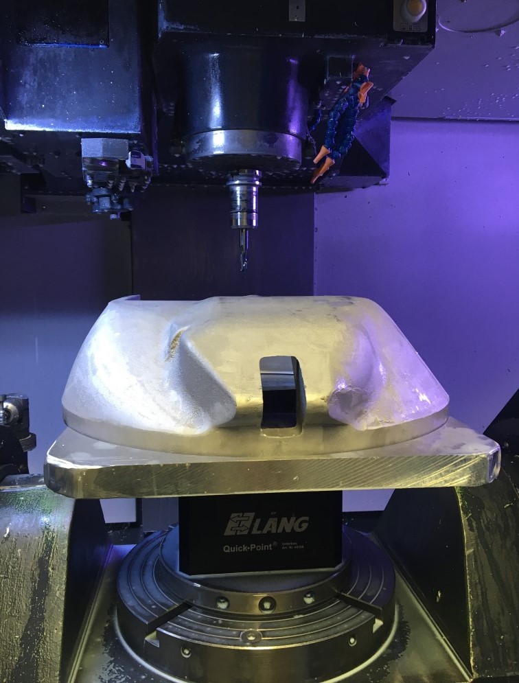

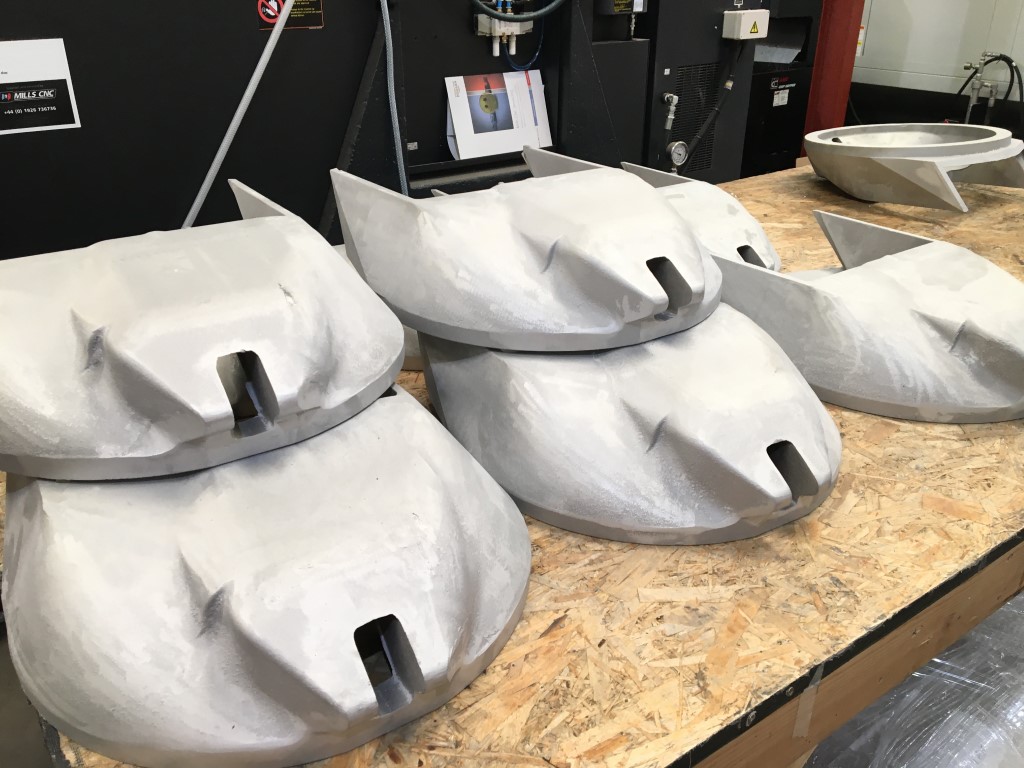

Machining of the turret has started.
Gaggle of turrets waiting for the first op.
Turret waiting to start second op

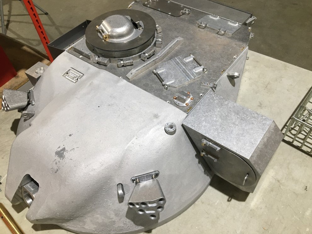

First production turret going through test fit on our validation build.
