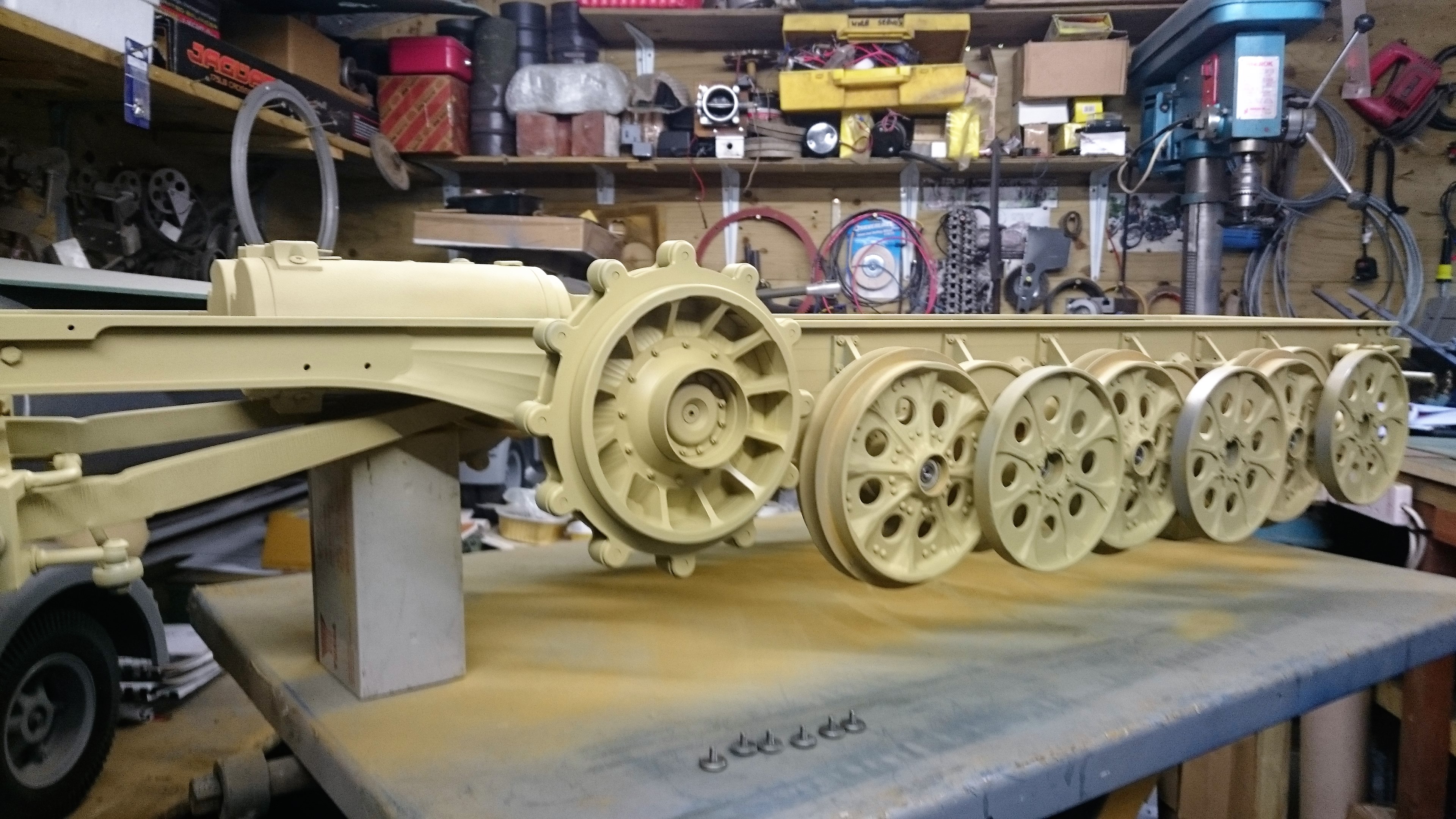

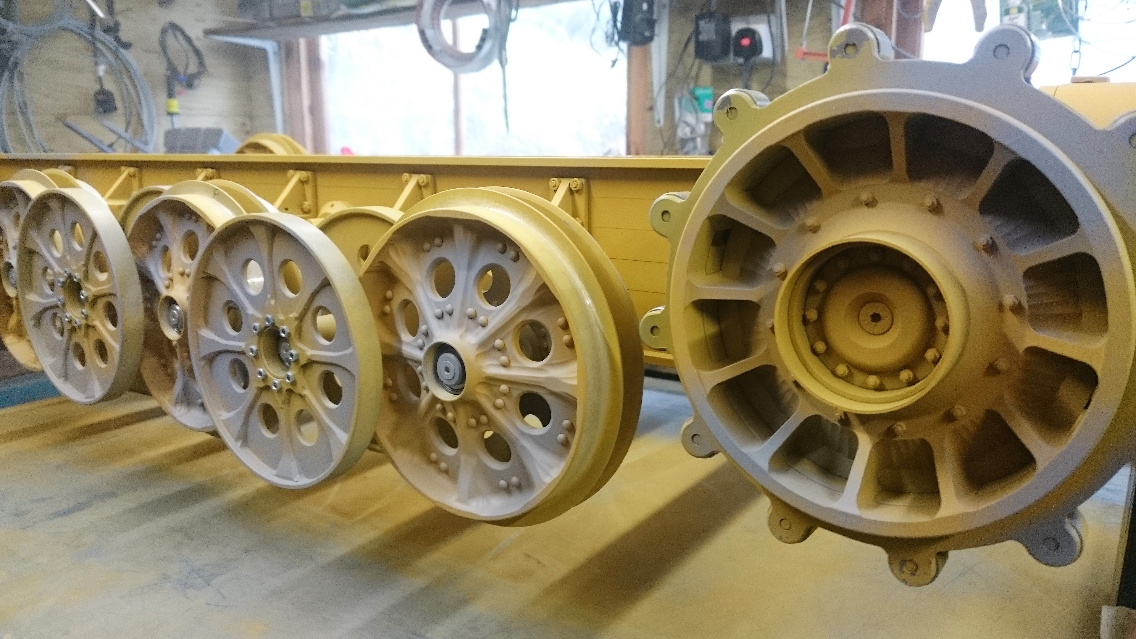

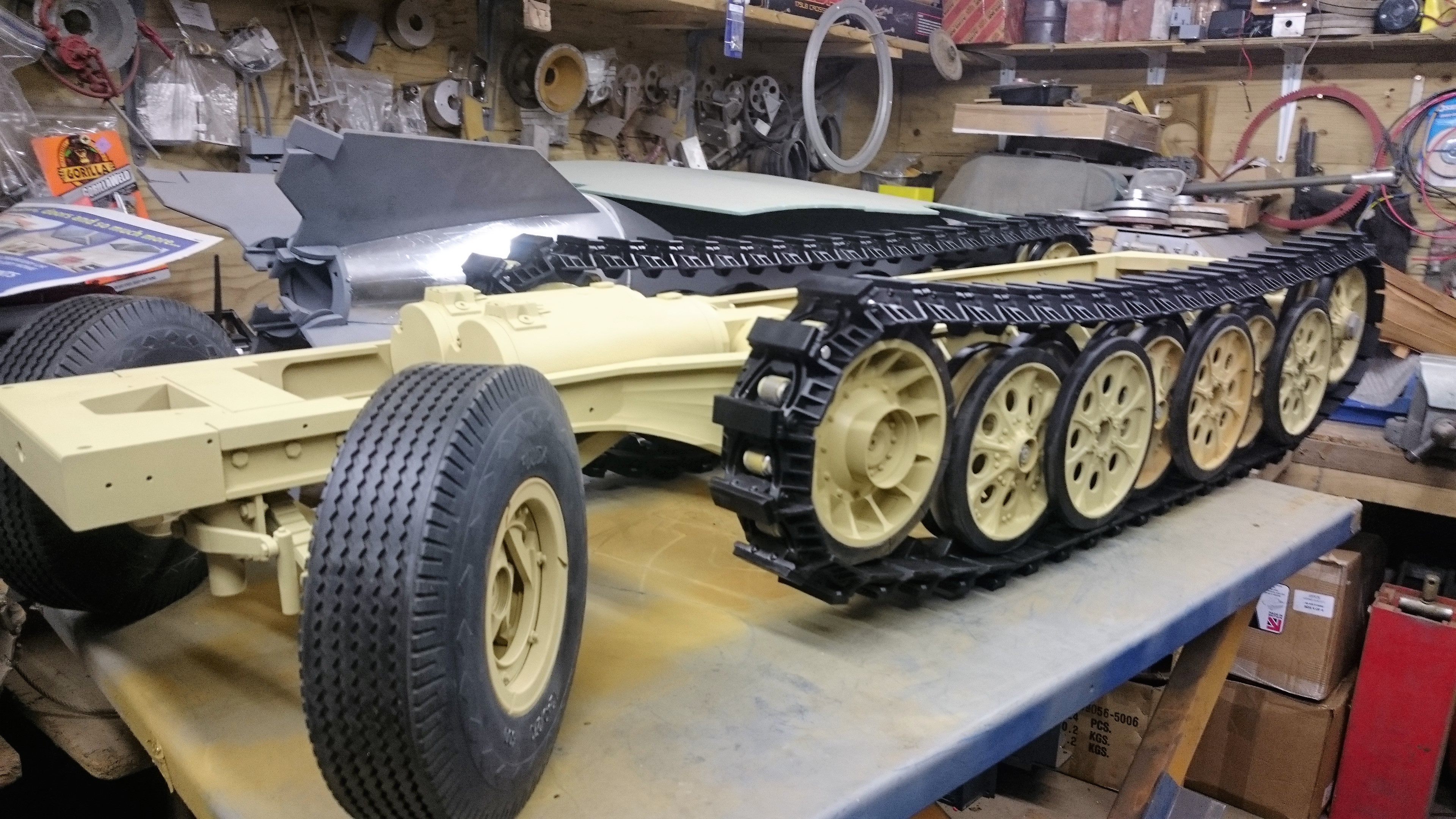

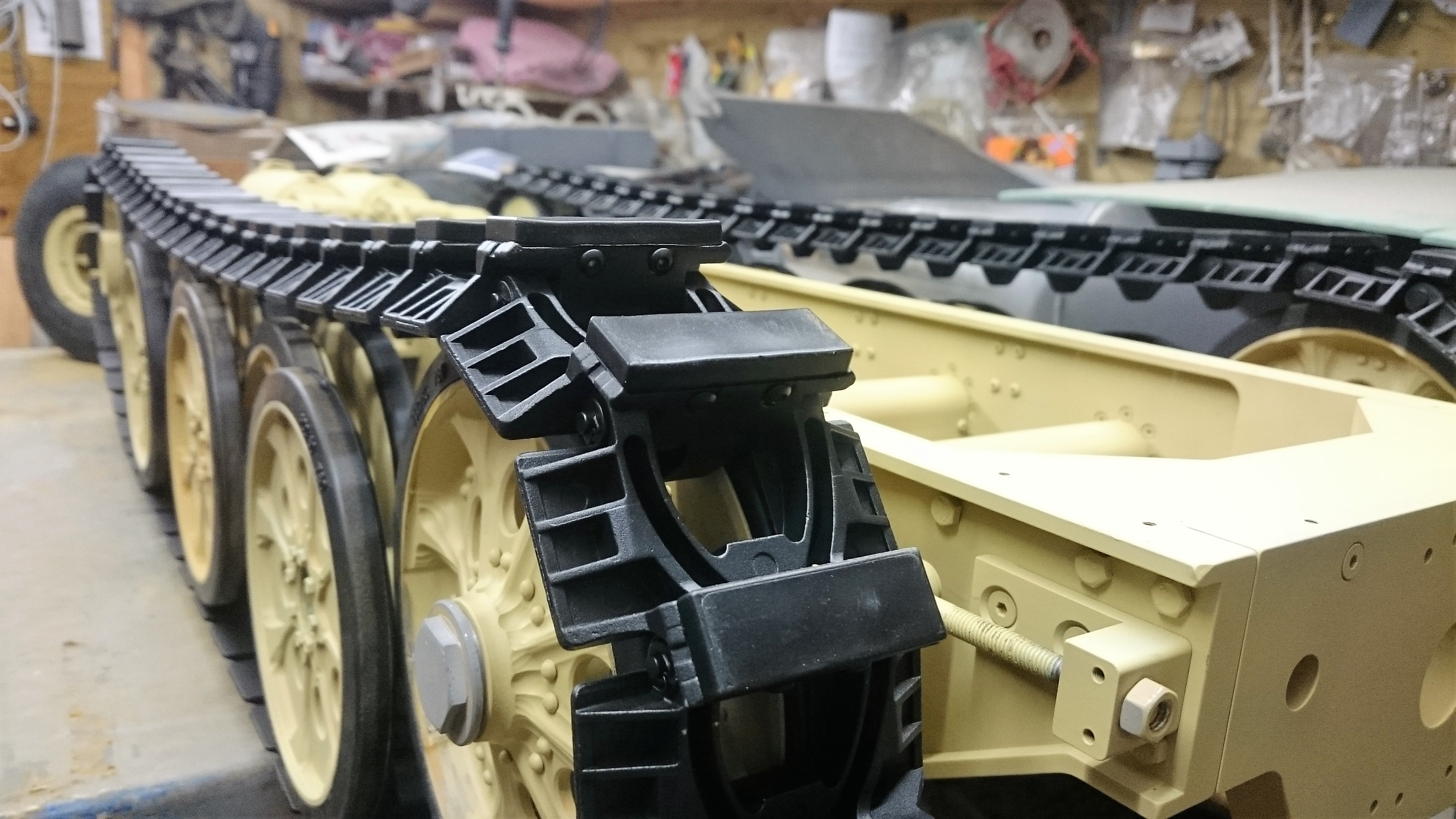

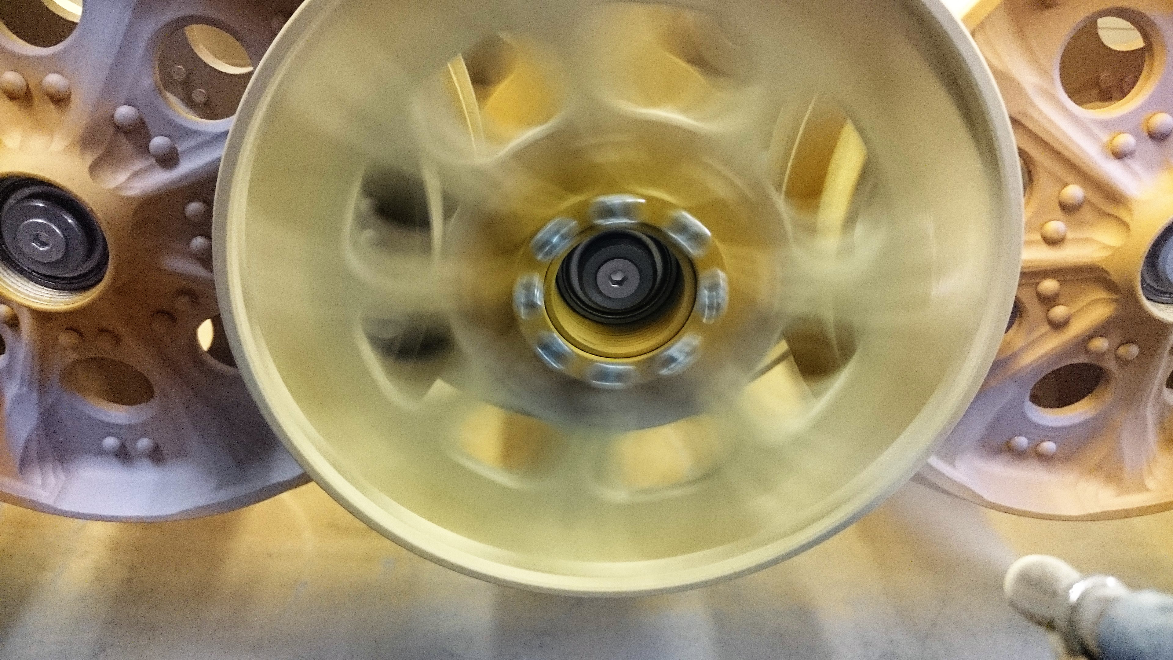

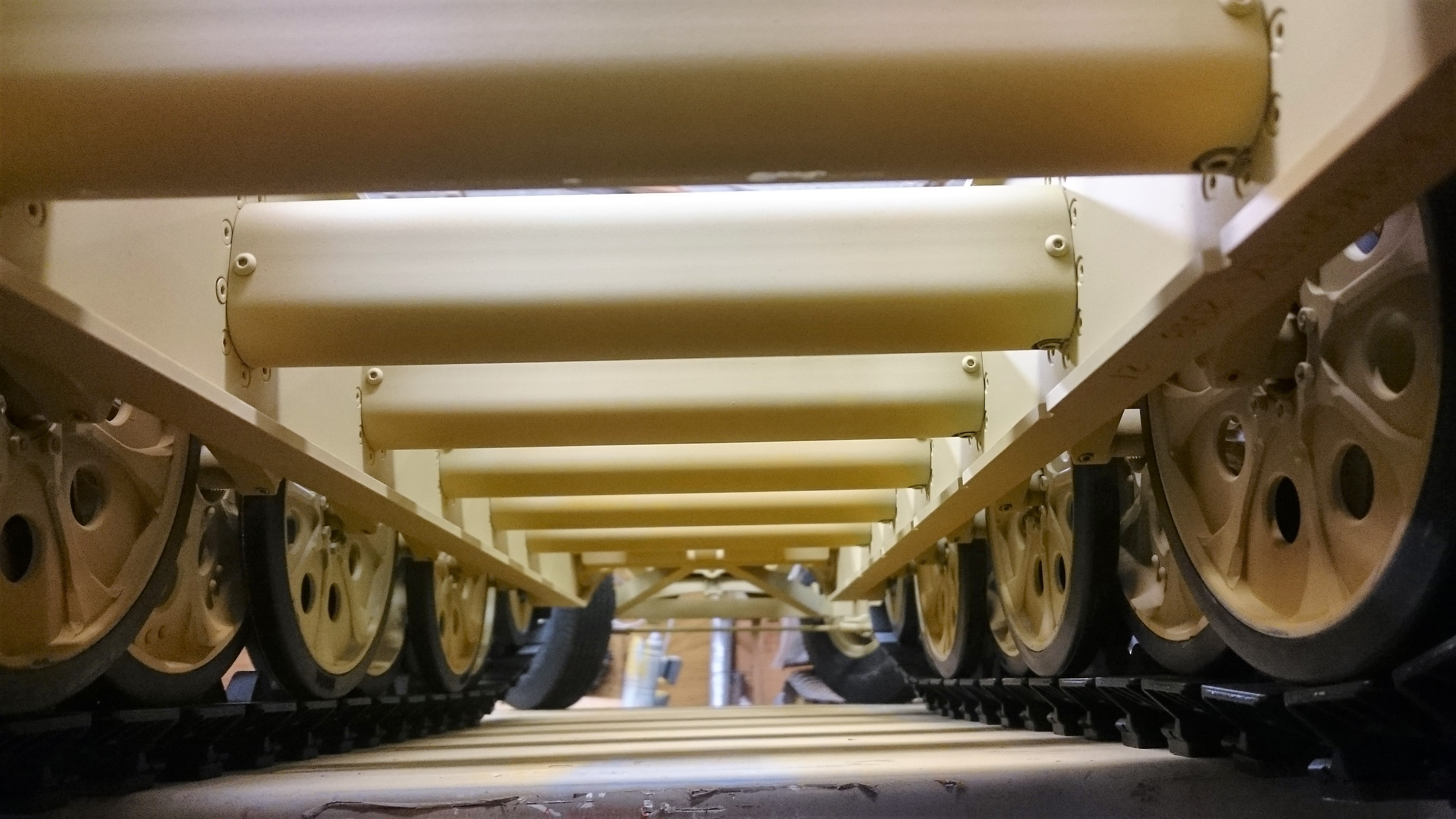

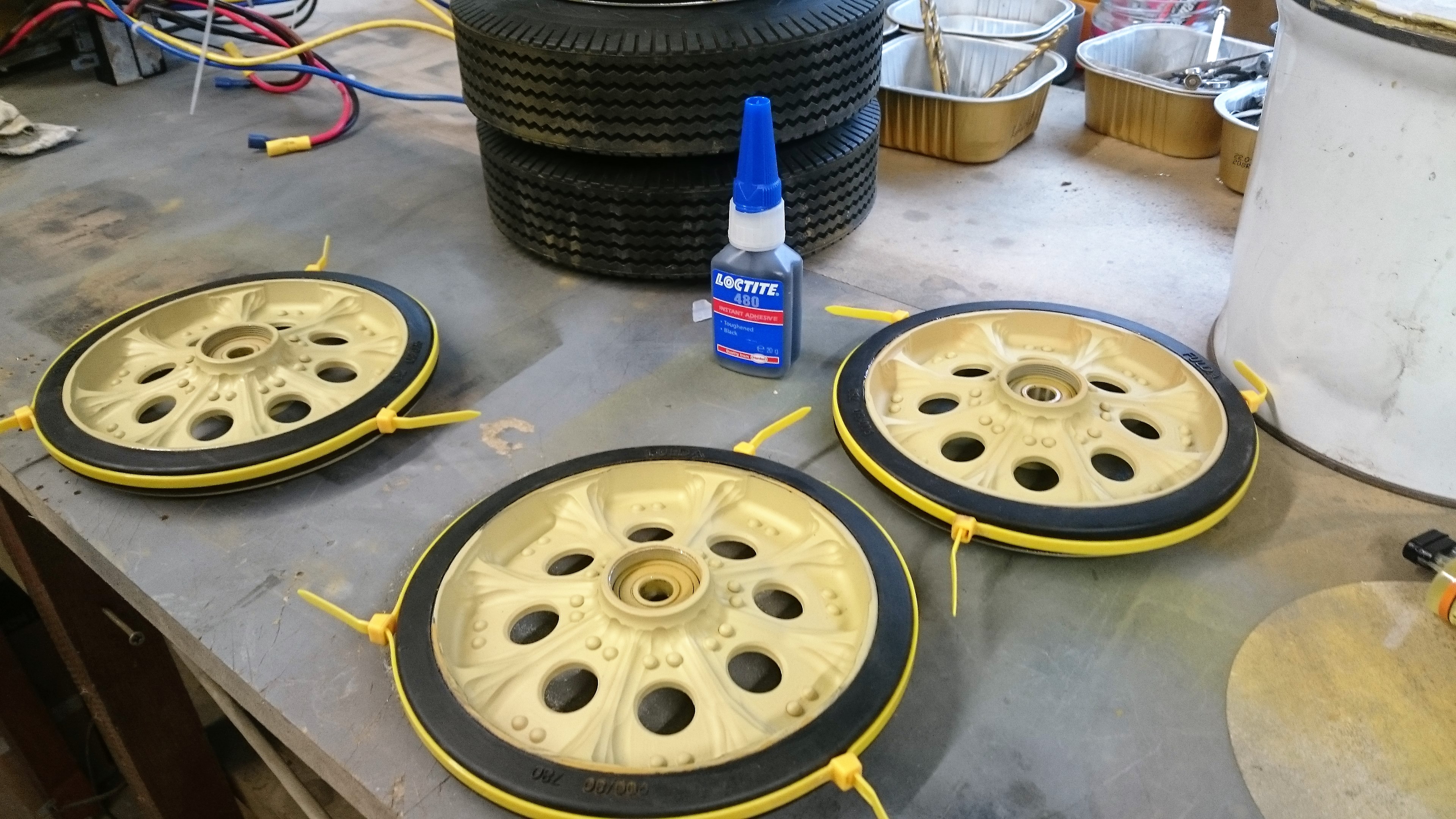

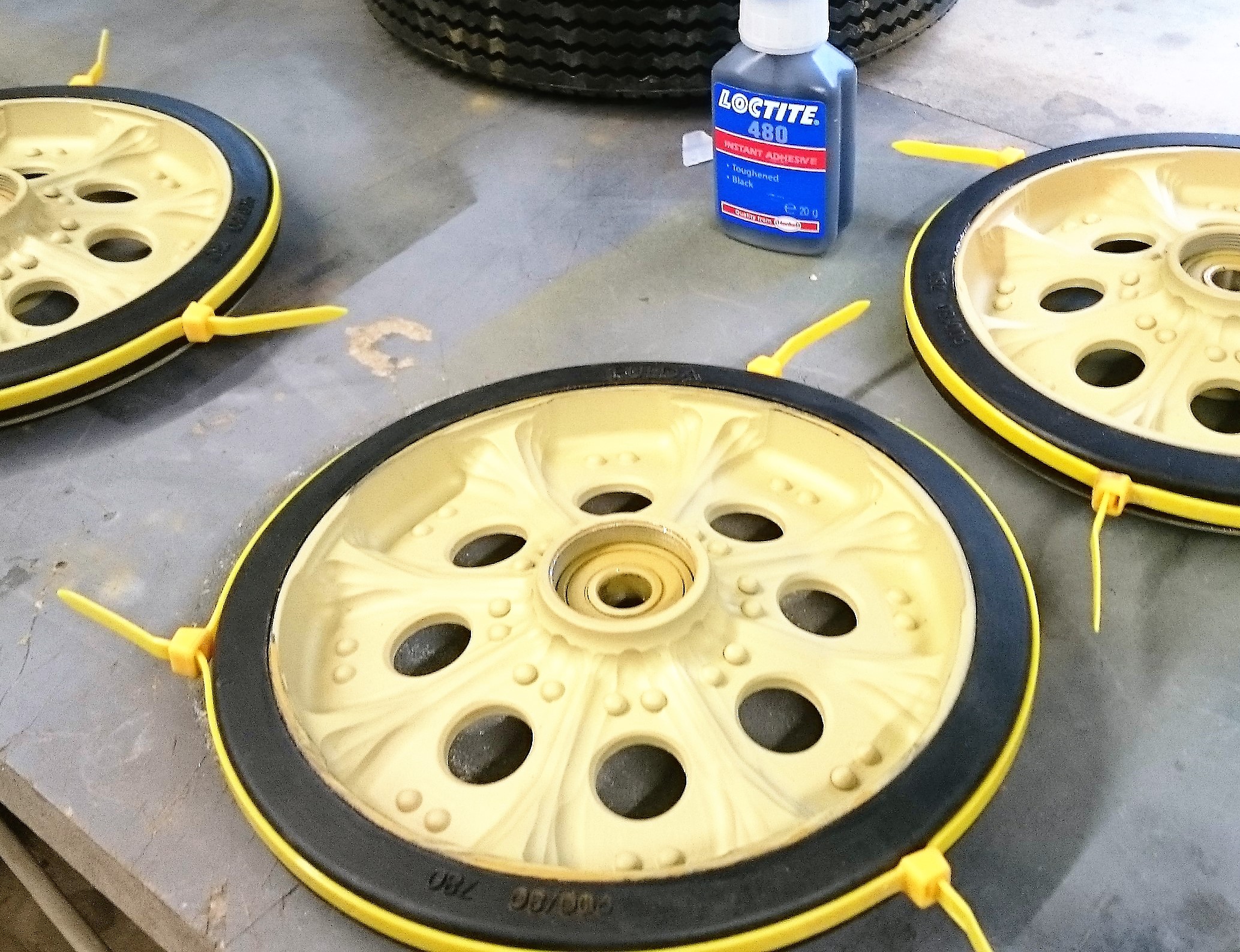

Re: Phils Famo build
Todays exploits.
- Posts: 678
- Has liked: 297 times
- Been liked: 645 times
Good morning Phil,
looks great your chassis. I thought also about the rubber tires, why they are so loose... Your idea wiht the cable ties is great, I'll do it the same way.
Florian
Florian
Hi Florian, if you are using the Loctite 480 make sure you have a dress rehearsal and get everything ready, that 480 could catch you out. use too much and it contaminates everything with black goo, to little and it won't do the job, just enough ie a 4mm bead all the way around the wheel, then place the tyre on with the logo facing the way you want it (logo on one side only) rotate the tyre against the wheel for an even coverage of 480, then centre, then fix the cable ties and pull tight and check for alignment again before it cures..... depending on the adhesives contact area about 20 seconds , longer if theres a gap!
If your a newbie then I might suggest epoxy as it is more forgiving and theres more time to get it right....Phil.
Thanks Phil,
I know about the strength from the 480. Its an awesome glue, but you have be verry carefull with that.
