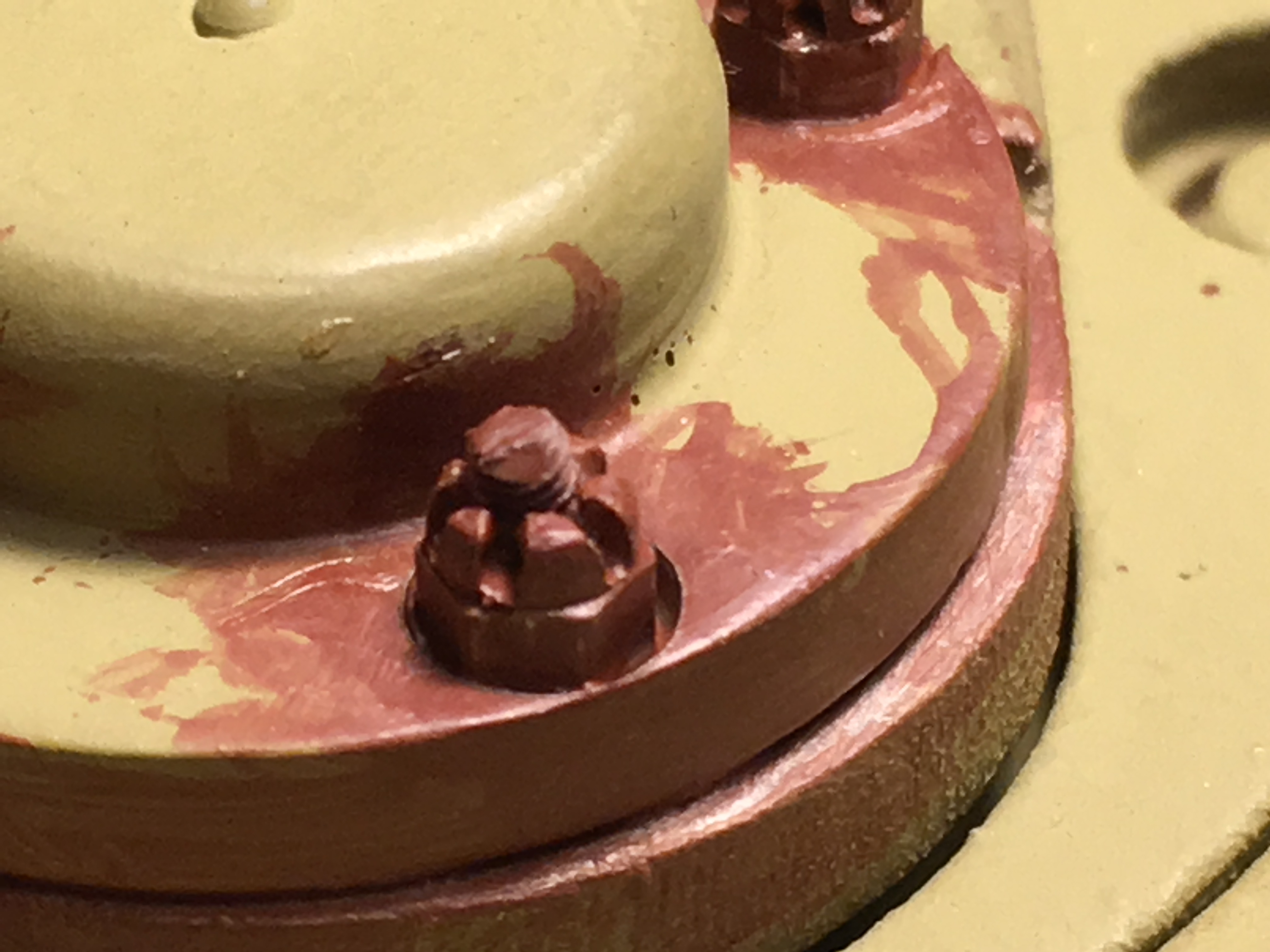

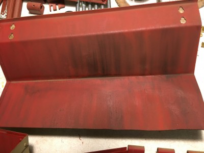

thank you for your nice compliments. The weathering is a very time consuming process, but it is worth to do it. So take much time to do it!!!!!
Here are some more photos of weathering parts ( side skirts and engine room ).
Regards Martin

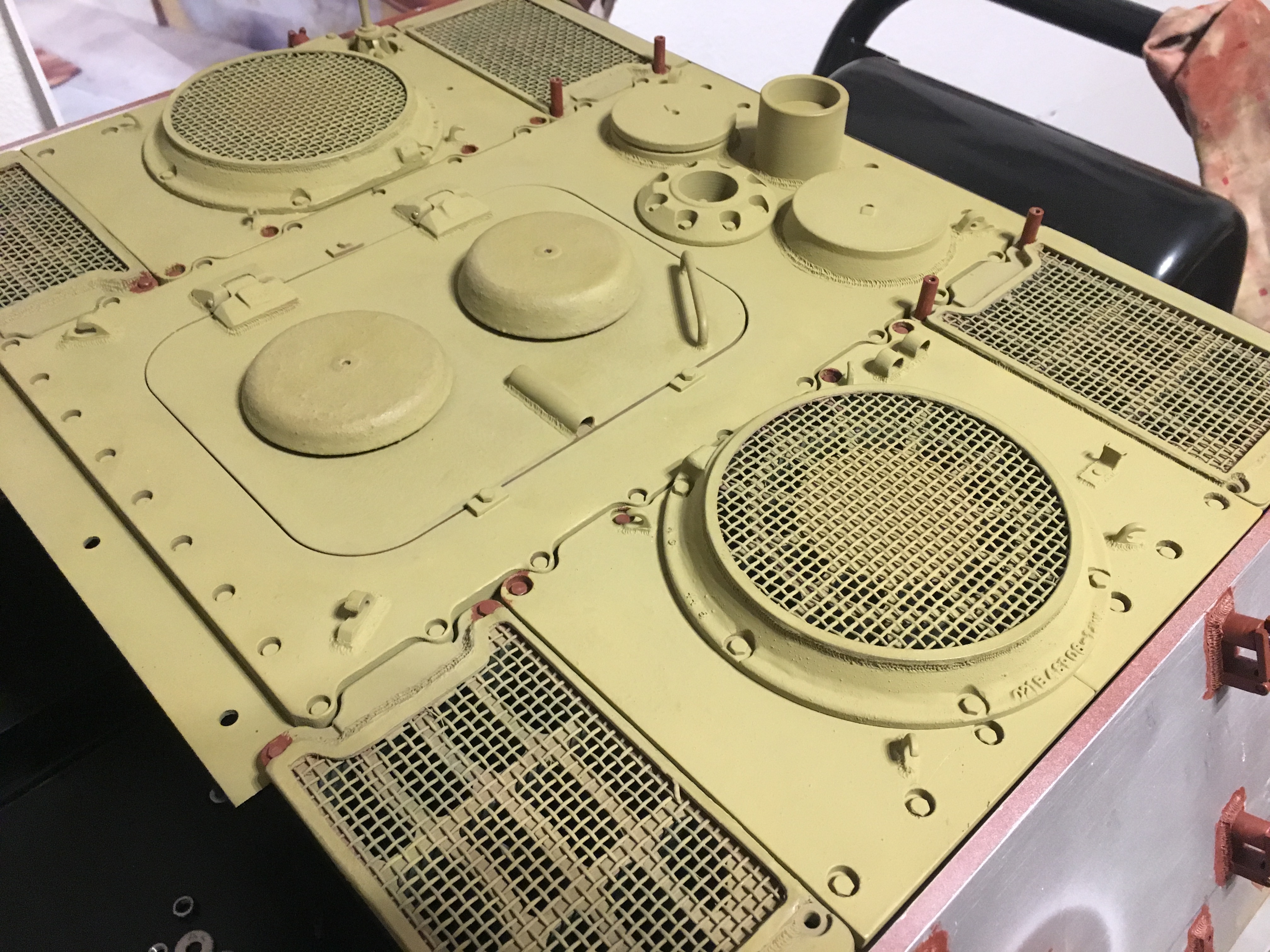

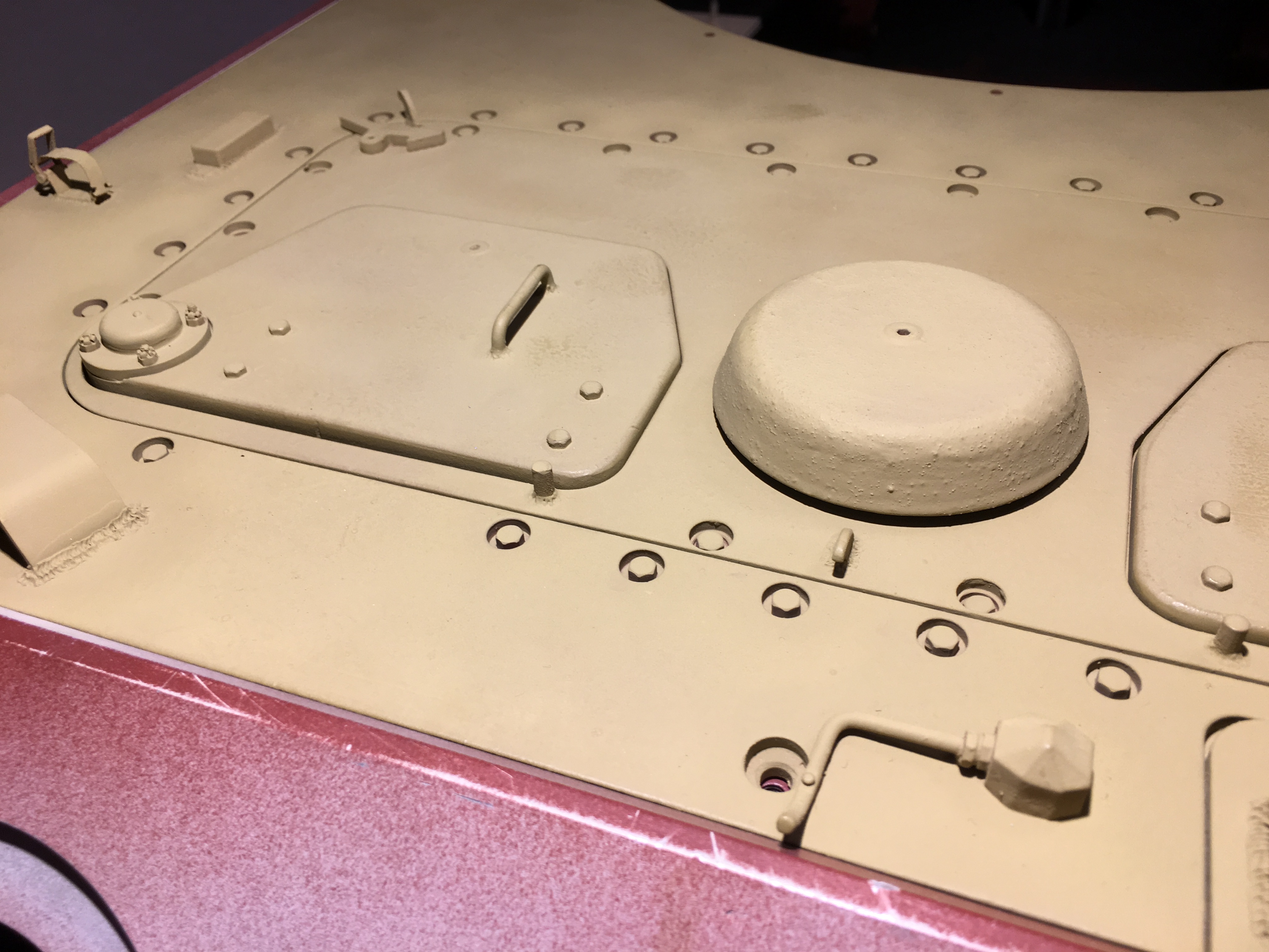

here comes some more photos of the rear deck.
Regards Martin

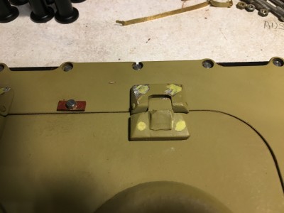

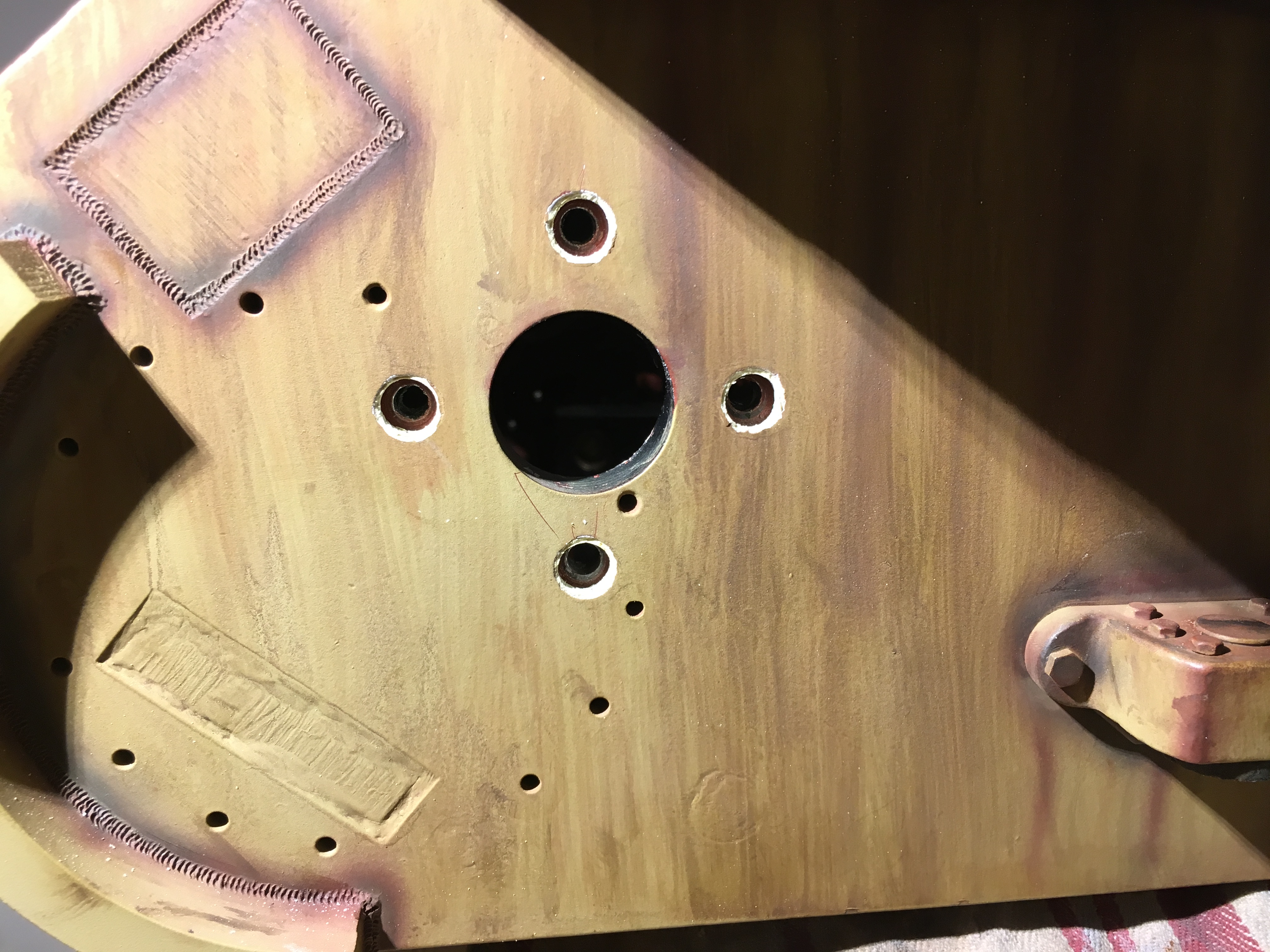

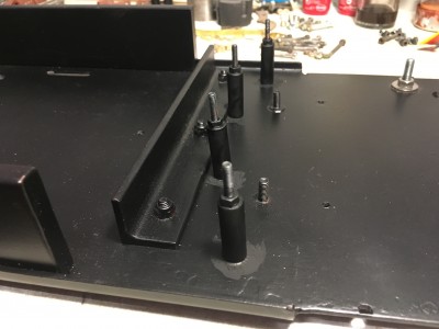

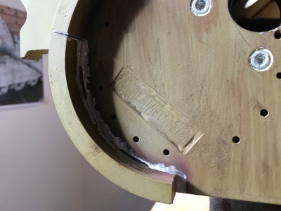

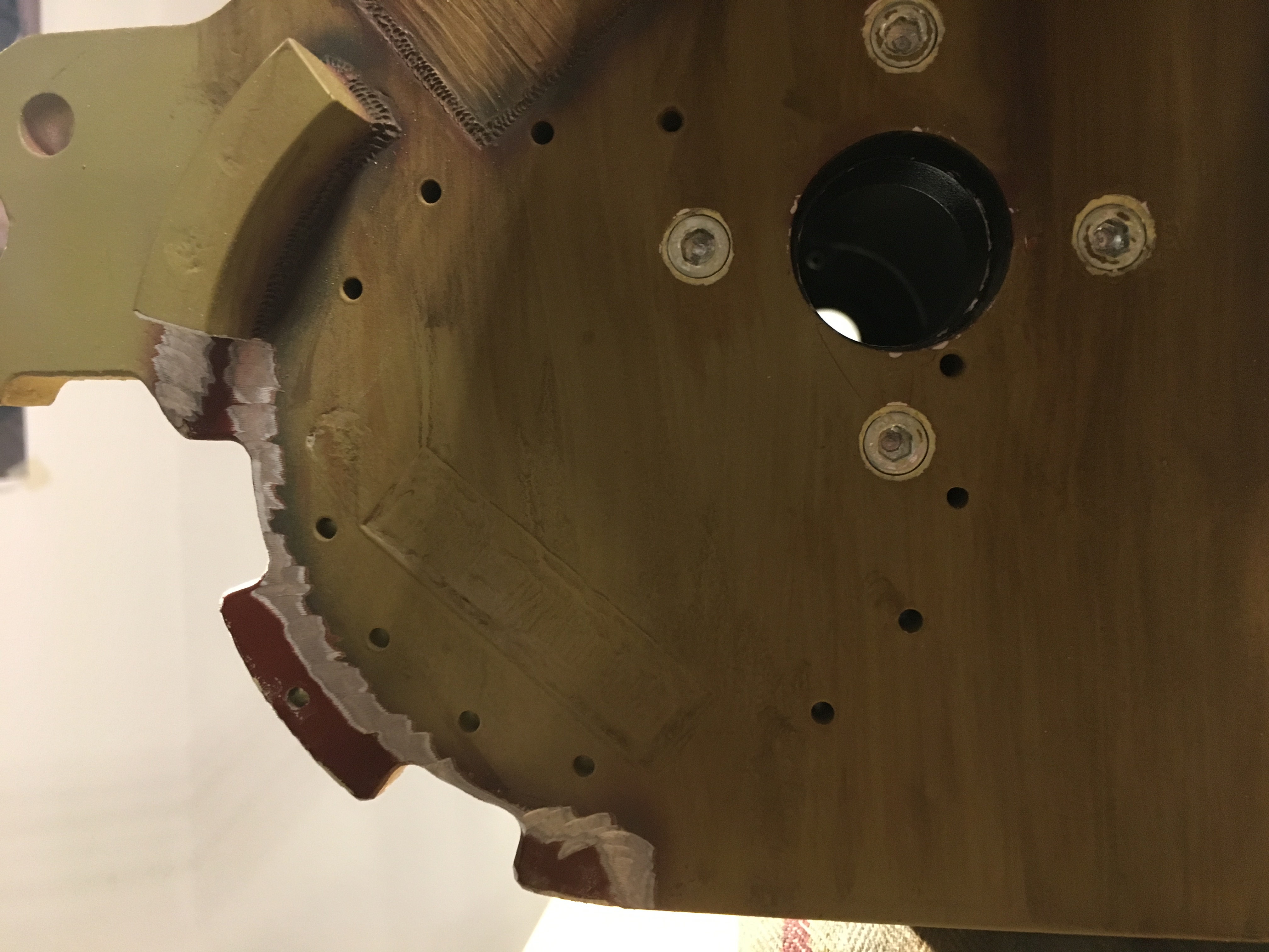

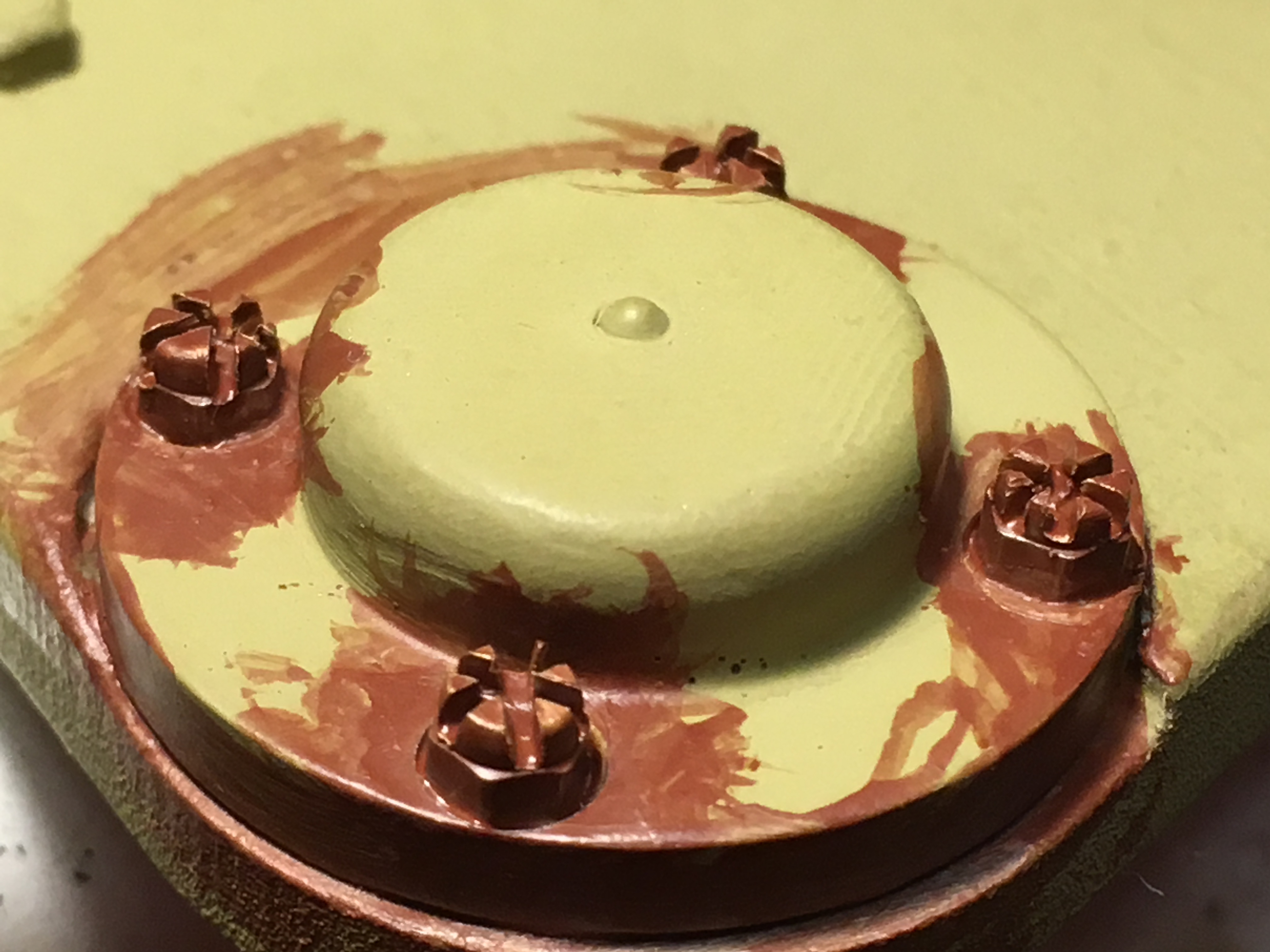

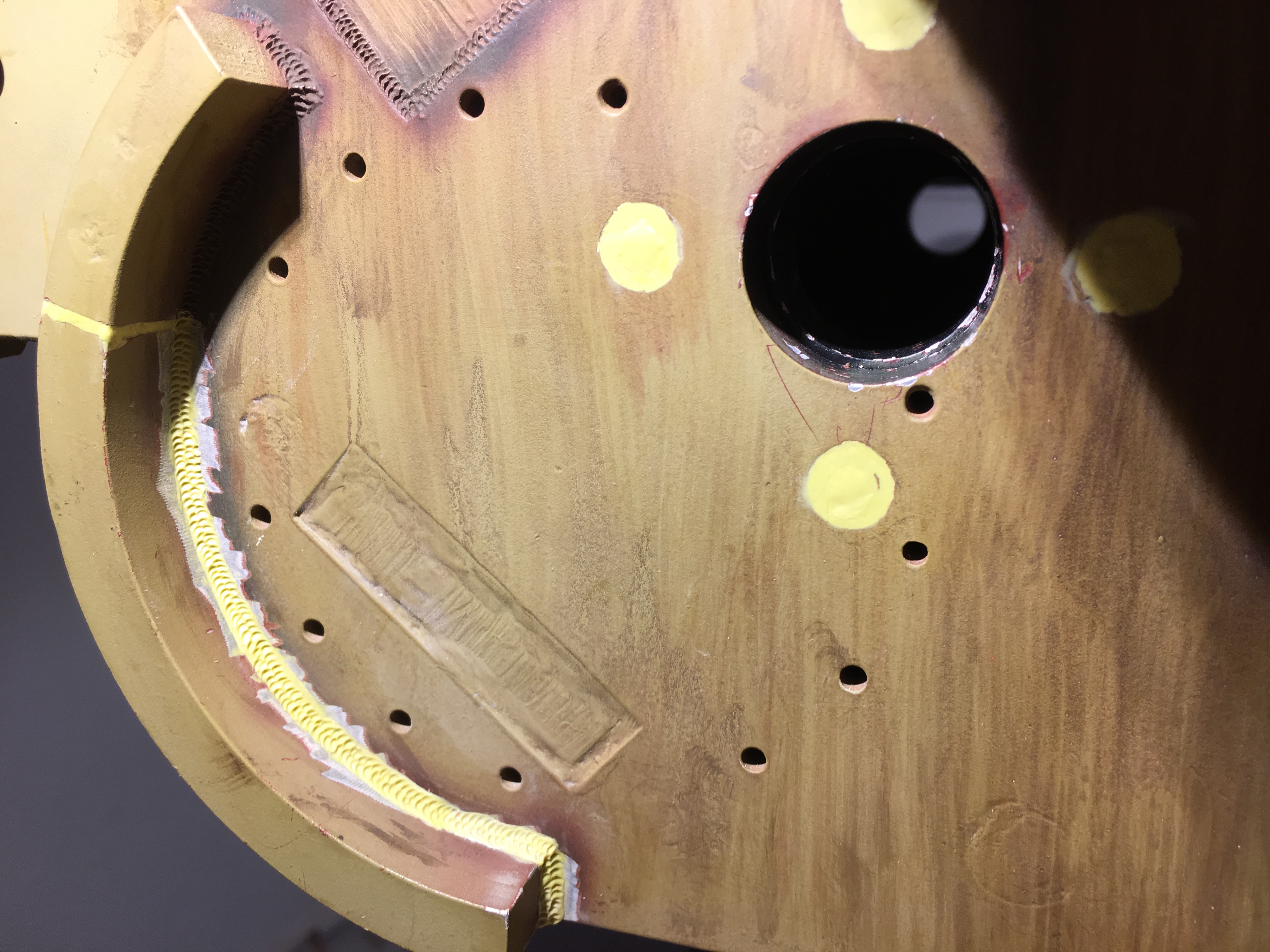

After weathering the bottom plate and the side plates i turn the hull for mounting the new motors into place for the room management of the new electric components. But here the shock: the new motors have another pattern of holes, so i have to dismount the adapter rings to drill new threads. At this point of destroing the ready weathering side i will correct the wrong armored rings in front of the hull.
Regards Martin

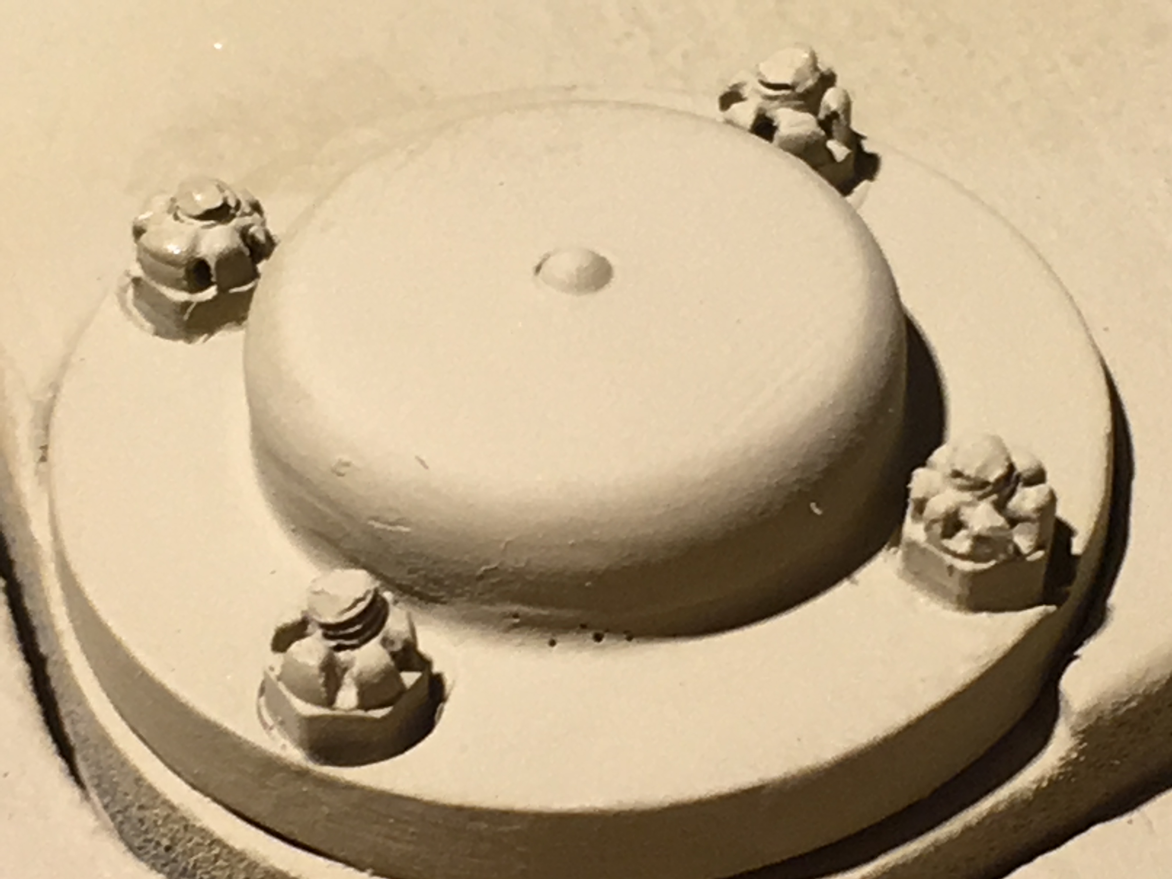

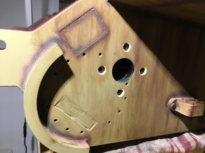

Here is the solution to this problem:
Regards Martin

Re: Martin's King Tiger
Post by Martin Hofmann »
Here everything is ok again. The armored rings are in the correct position with the origin dimensions.
Regards Martin

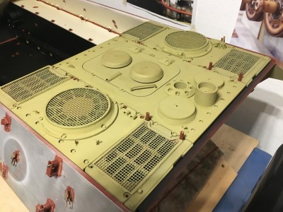

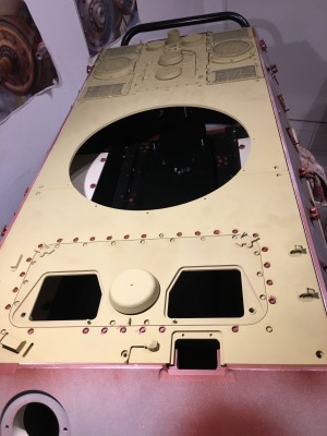

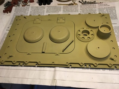

Here are some photos from more progress of the cover plates of the hull.
Regards Martin

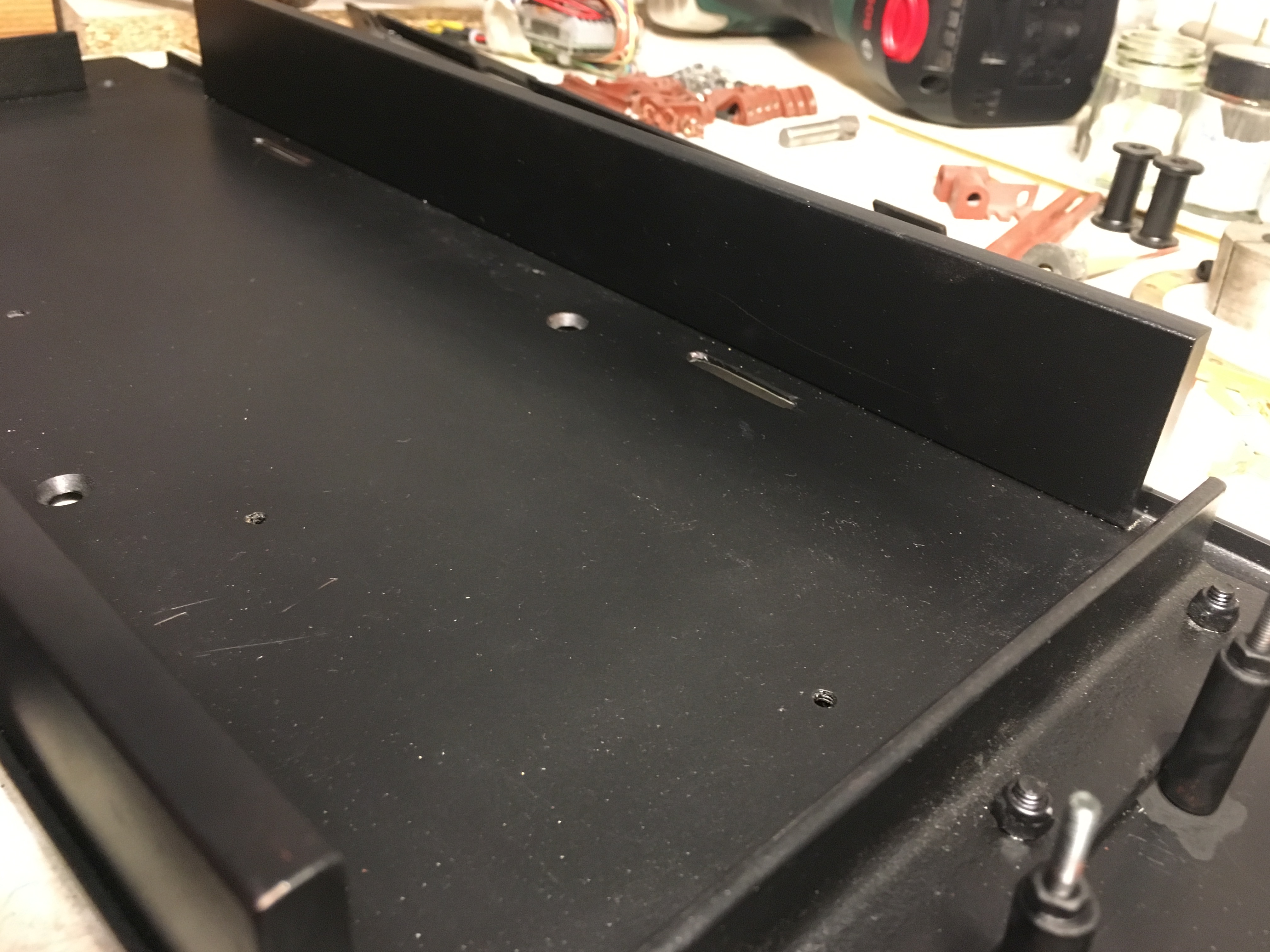

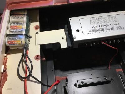

in the meantime i modified the batterie tray, because the batteries are very heavy ( 14,2 kg - each! ). Also the loud speakers gets some holders for better integration under the hull plates.
Regards Martin

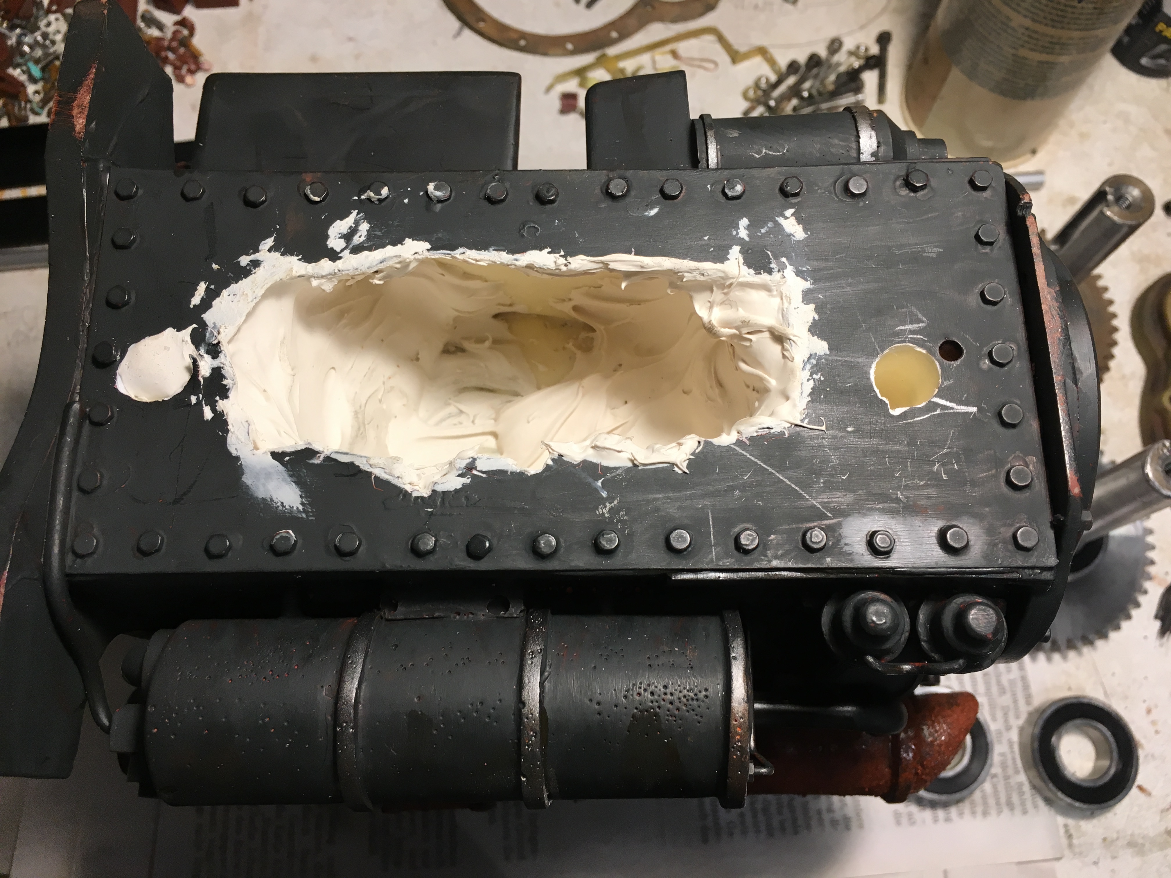

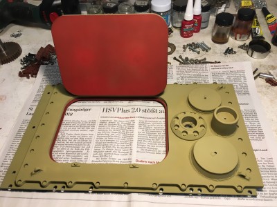

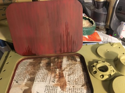

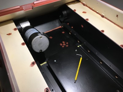

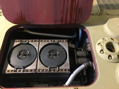

now i start the integration of the mechanical parts and the motor with the motor room plates. But first i have to fill the motor at the underside for the Ensat bushes, because it was hollow!!!
Regards Martin

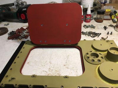

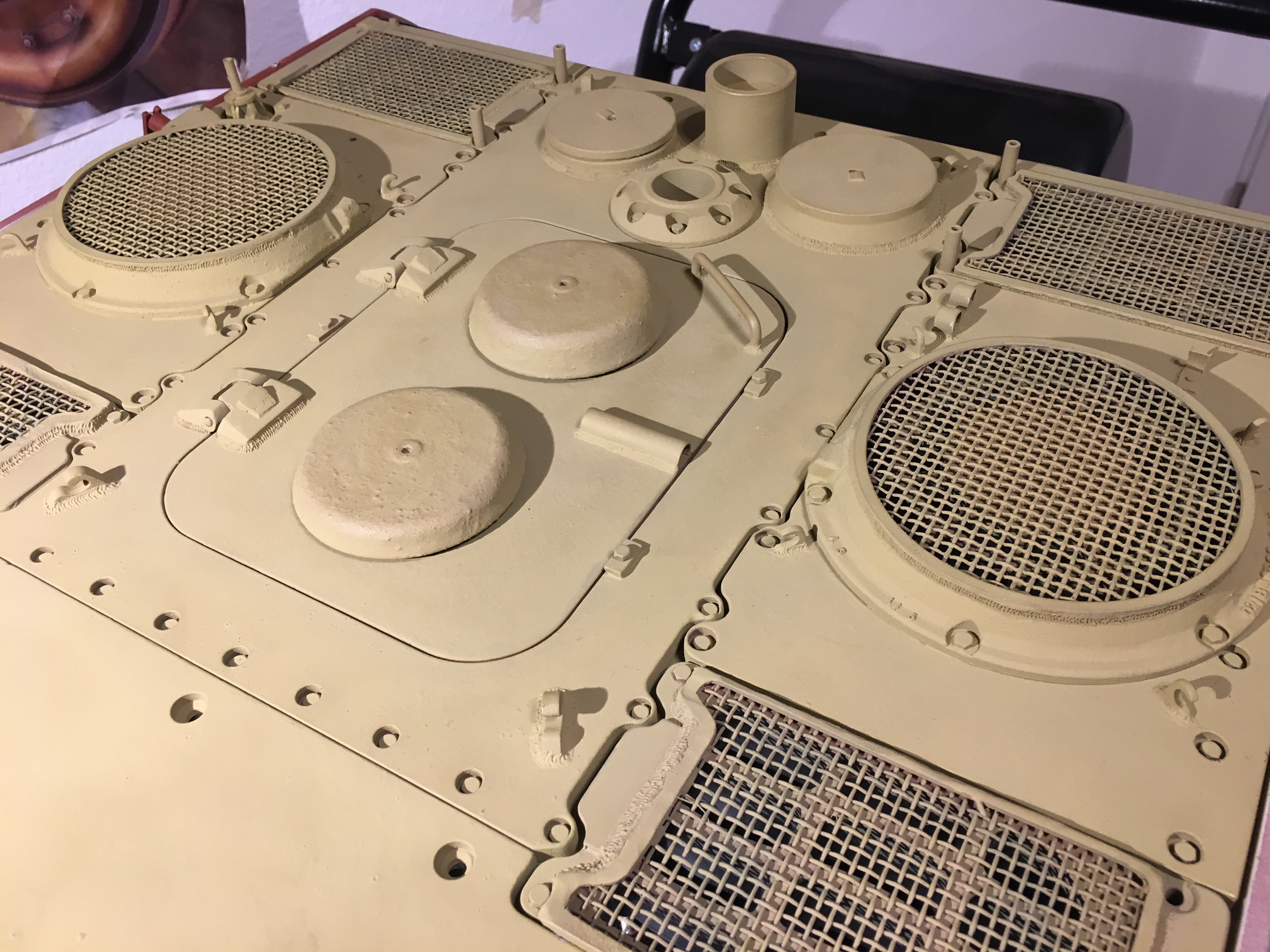

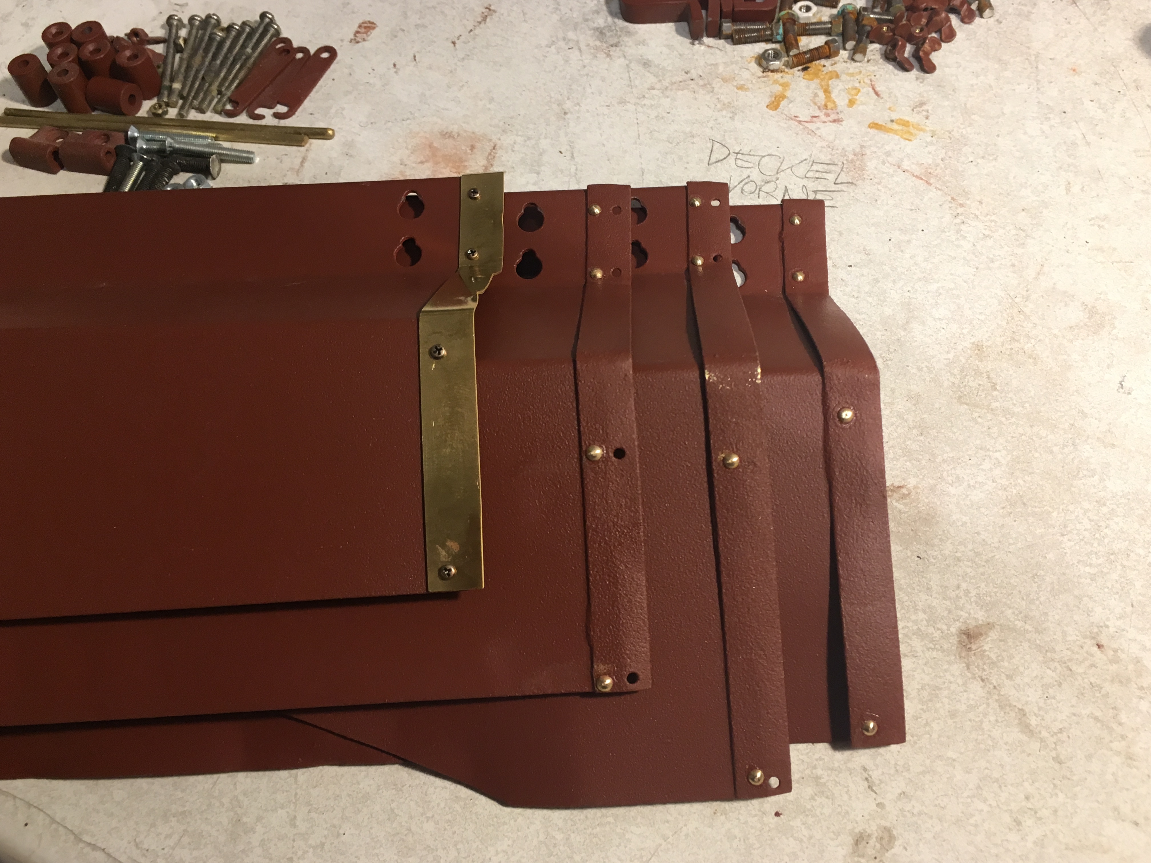

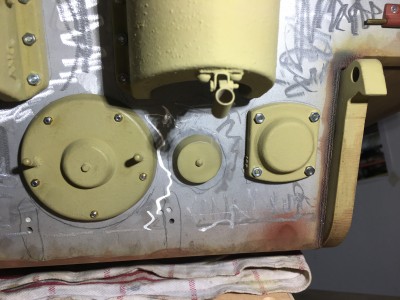

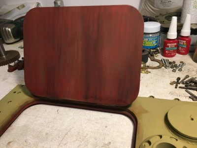

here comes more details of the driver and the radio operator hatches.
Regards Martin

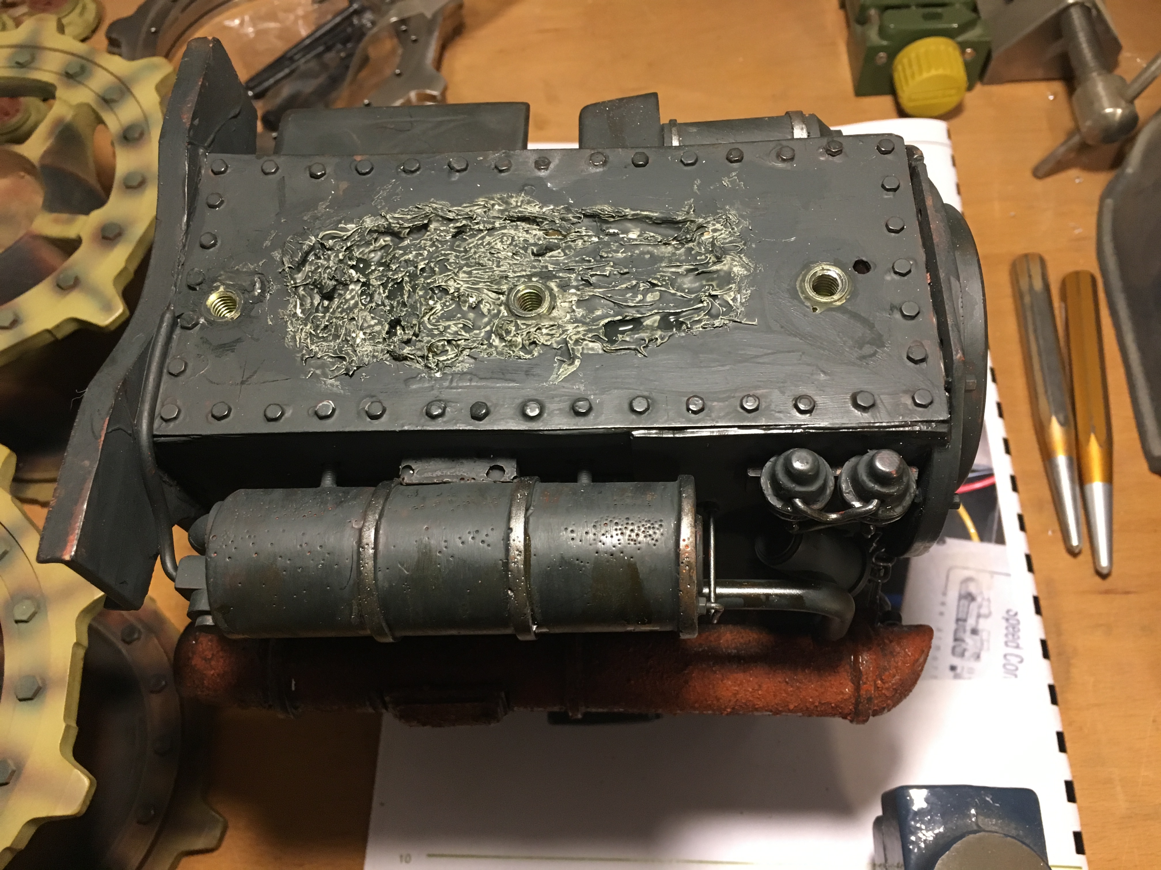

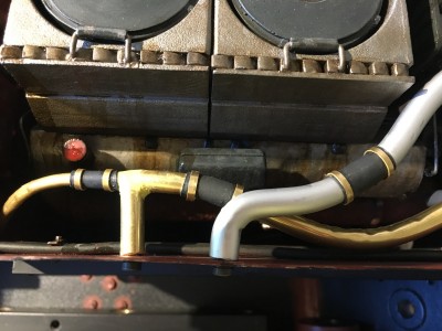

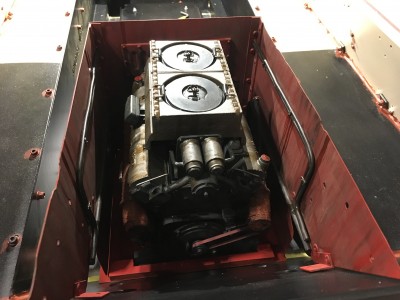

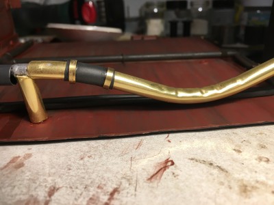

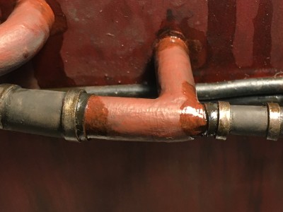

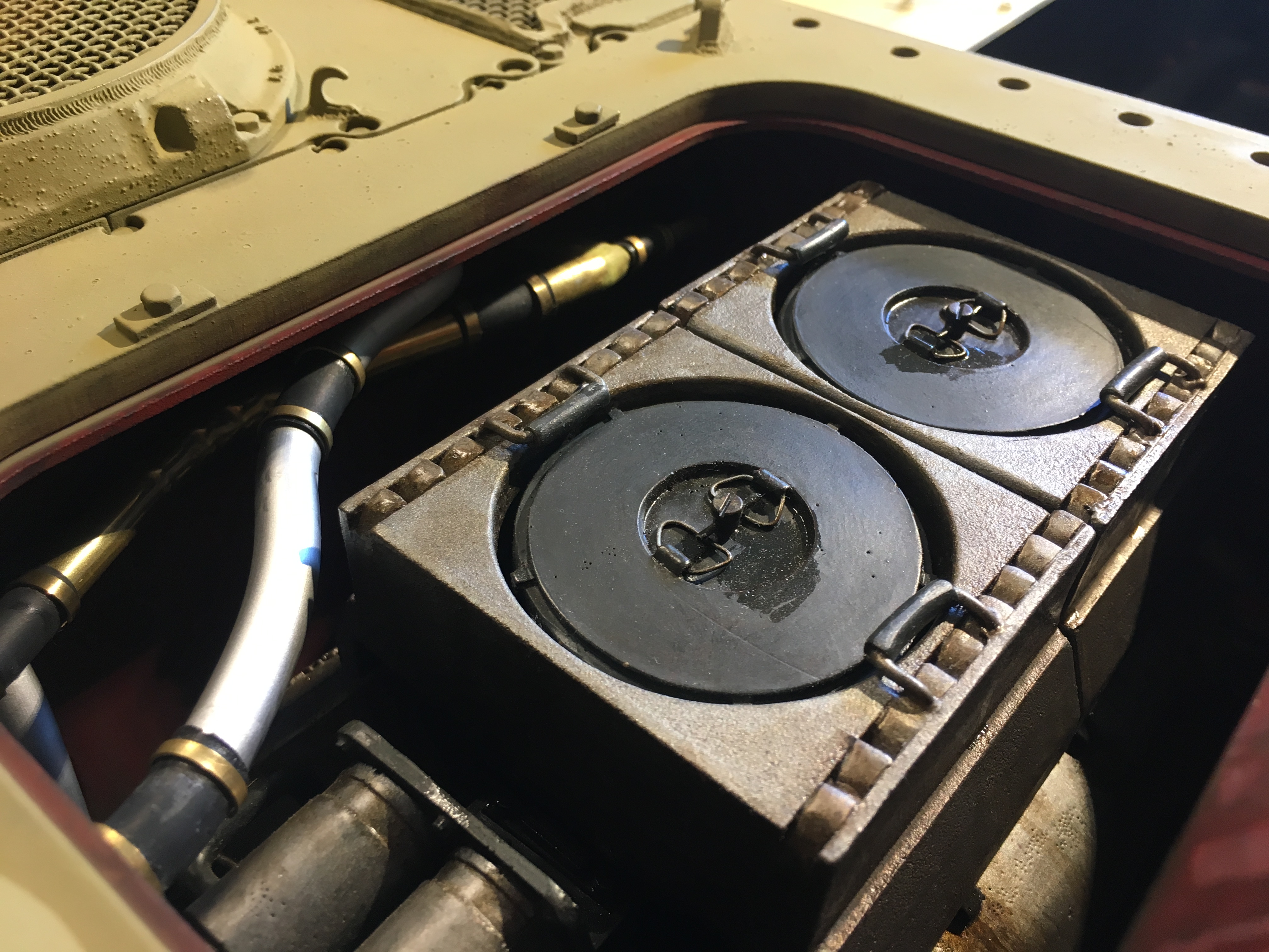

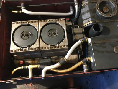

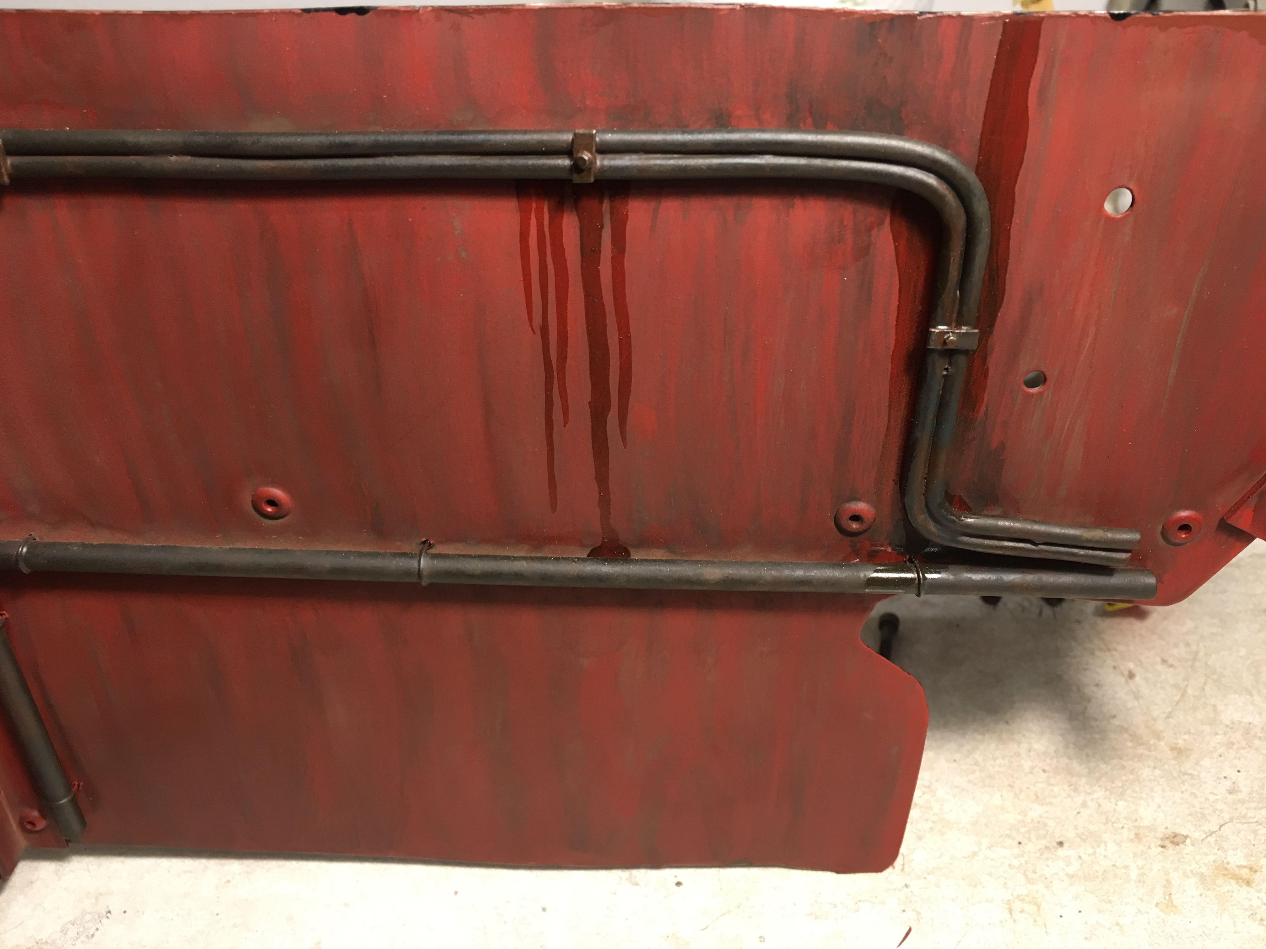

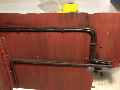

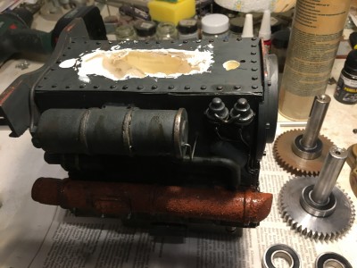

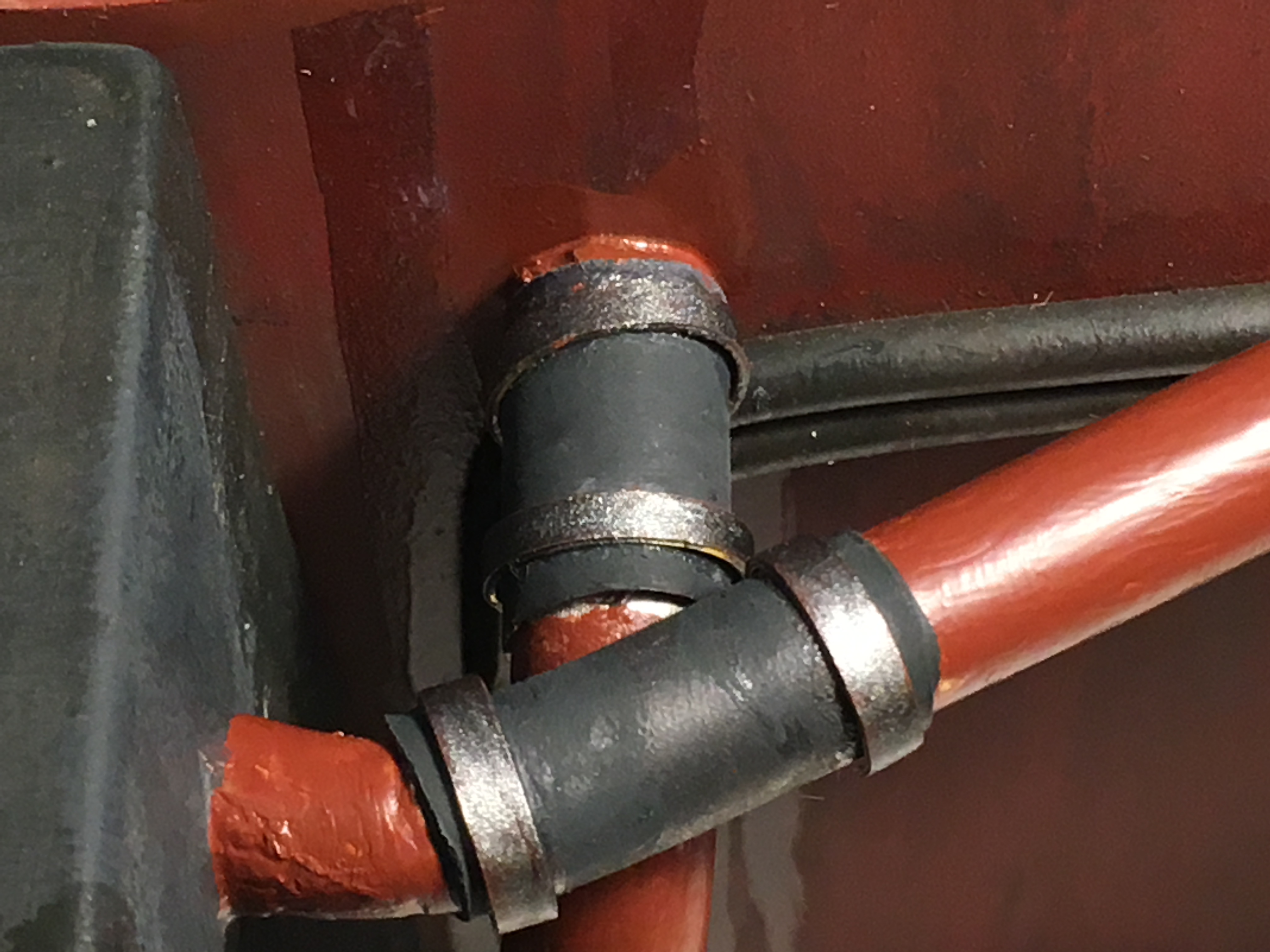

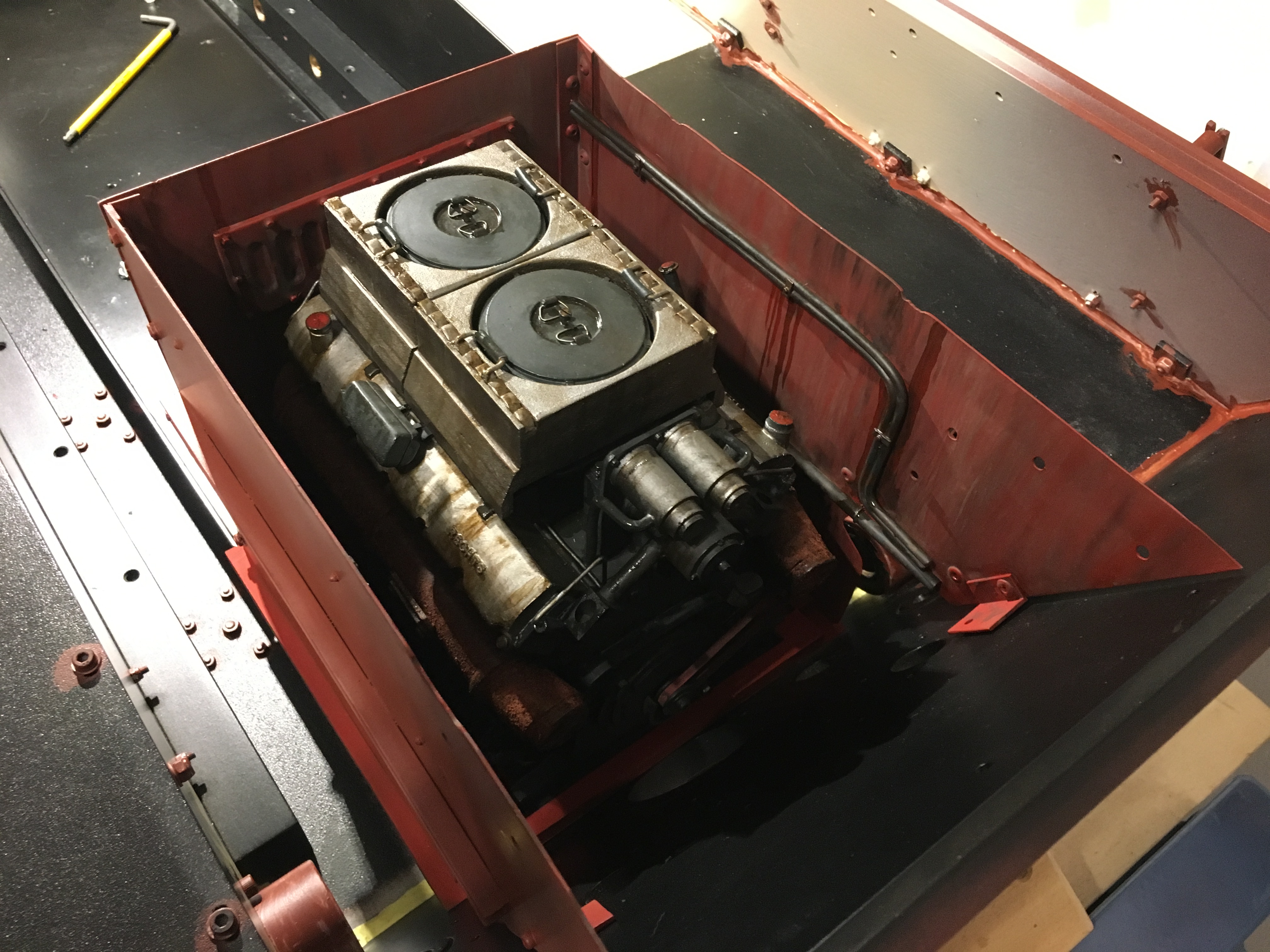

In the meantime i made some pipes for the motor room according to some photos - so maybe it has not exactly the correct dimensions.......
Regards Martin
Martin Hofmann
Posts: 486
Location: Hamburg, Germany
Has liked: 151 times
Been liked: 2014 times

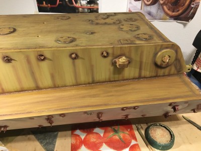

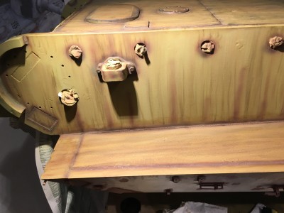

and here is the result
some weathering started
also some water leaks
Regards Martin

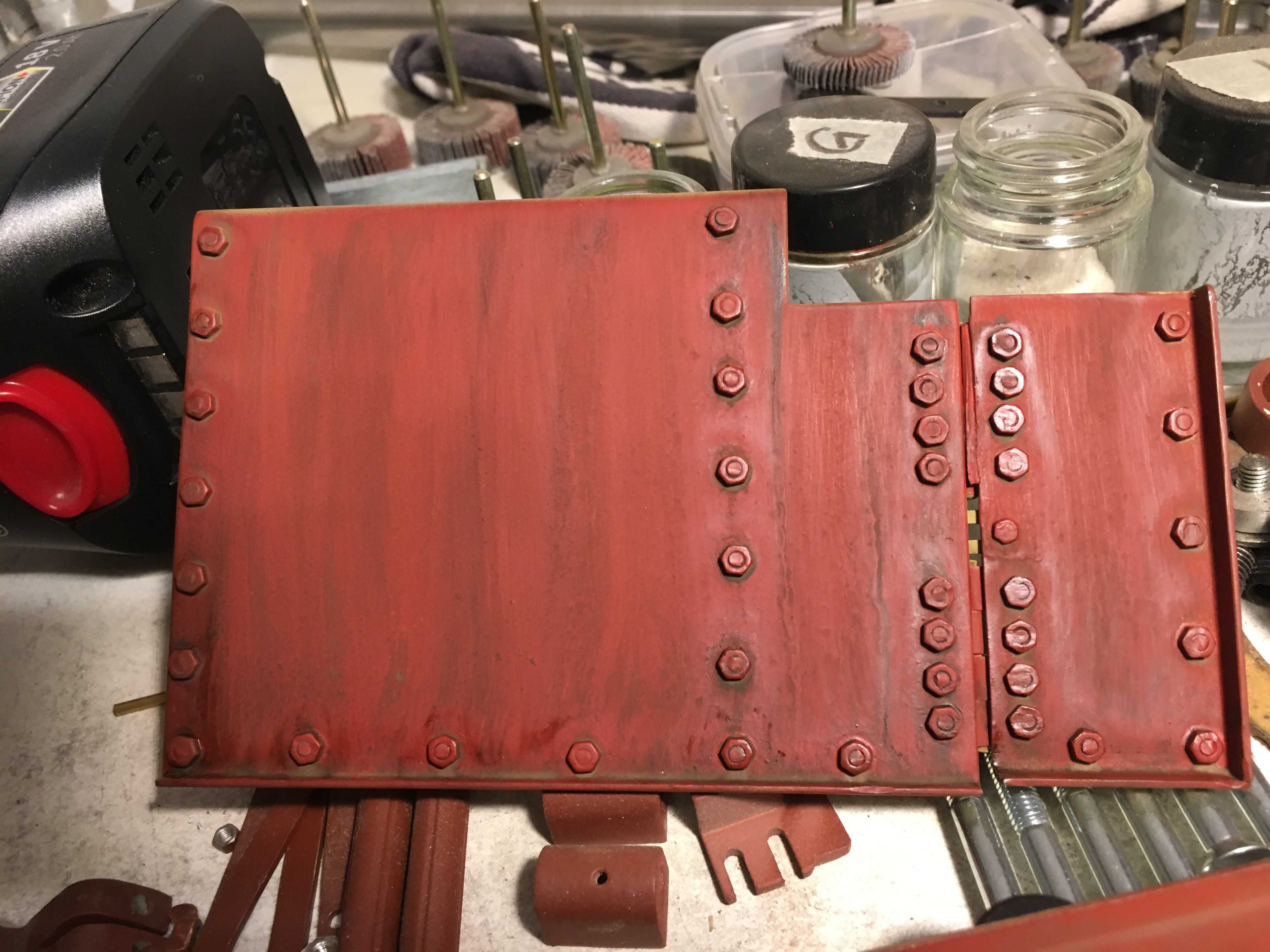

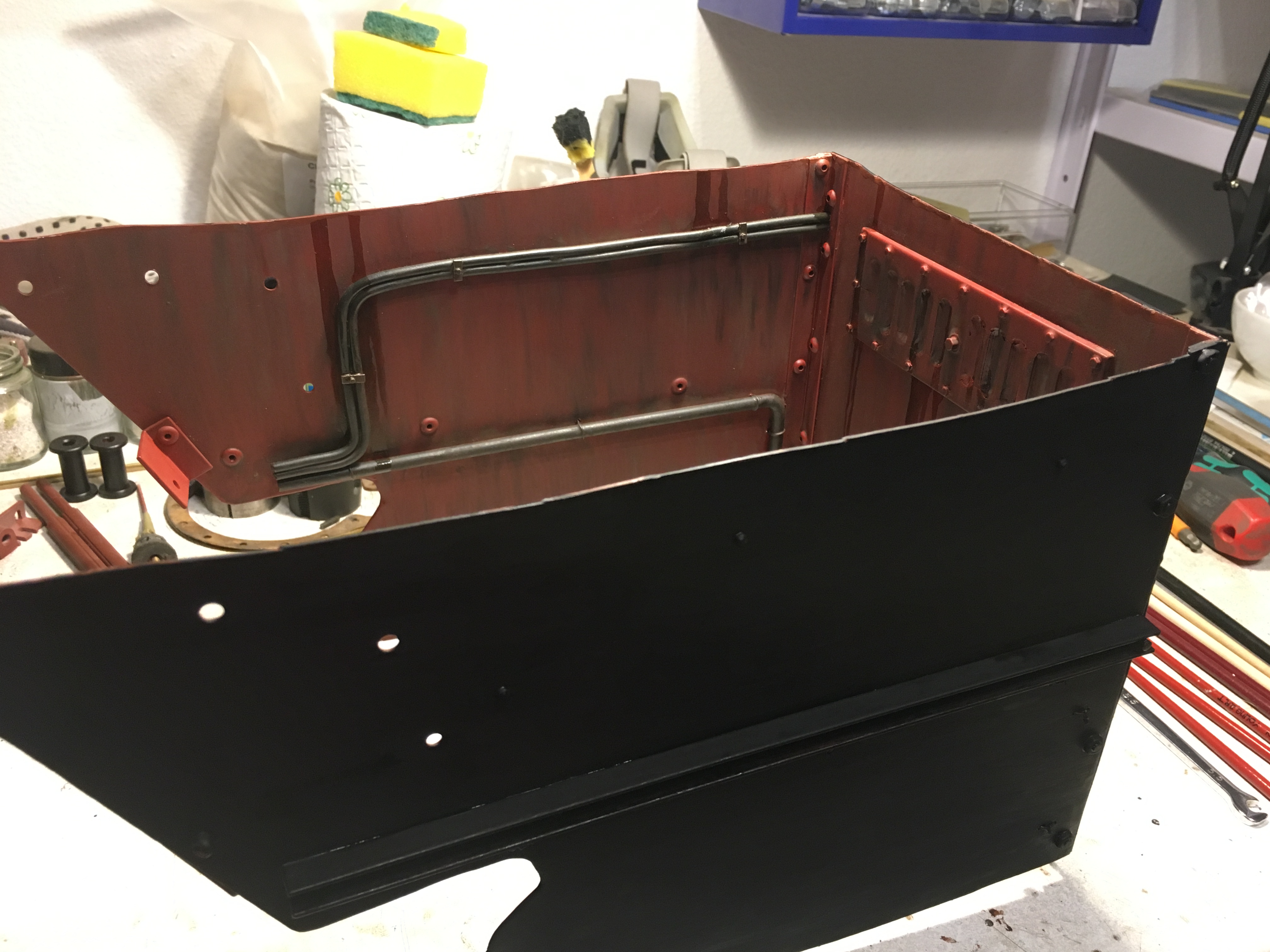

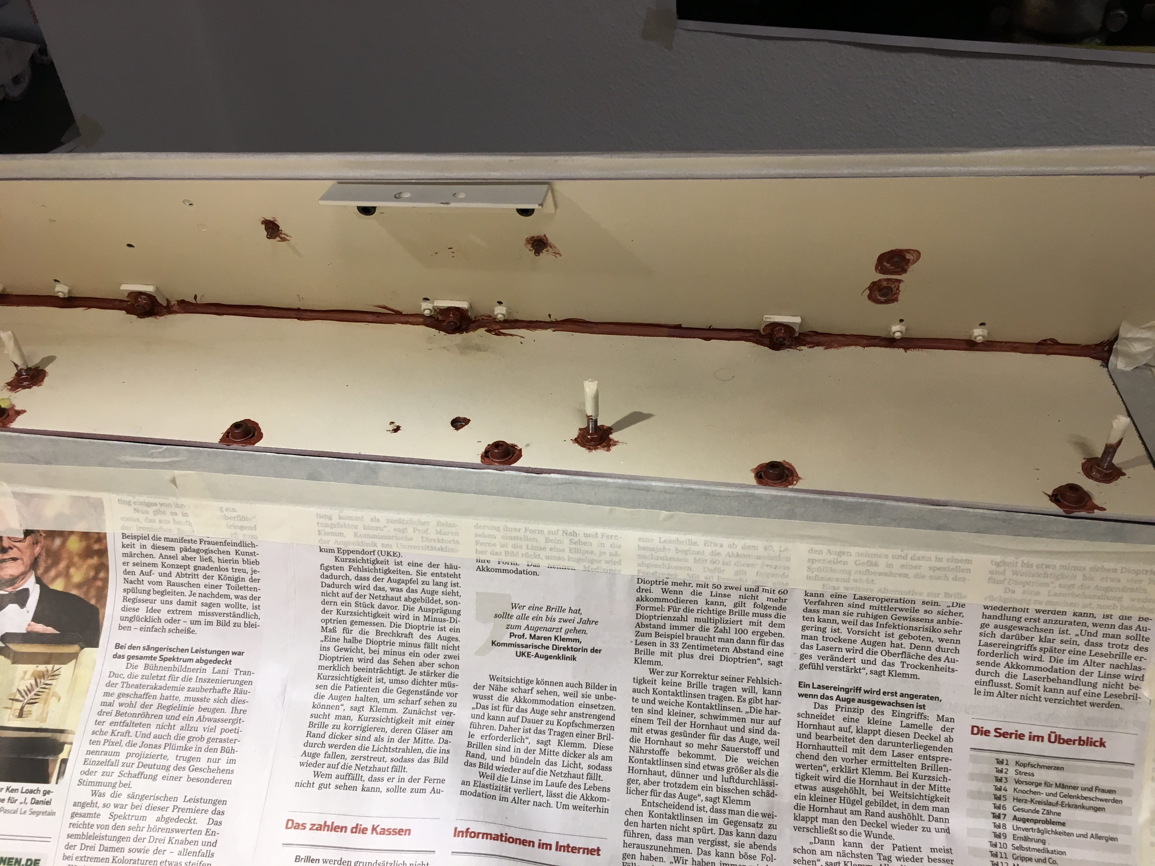

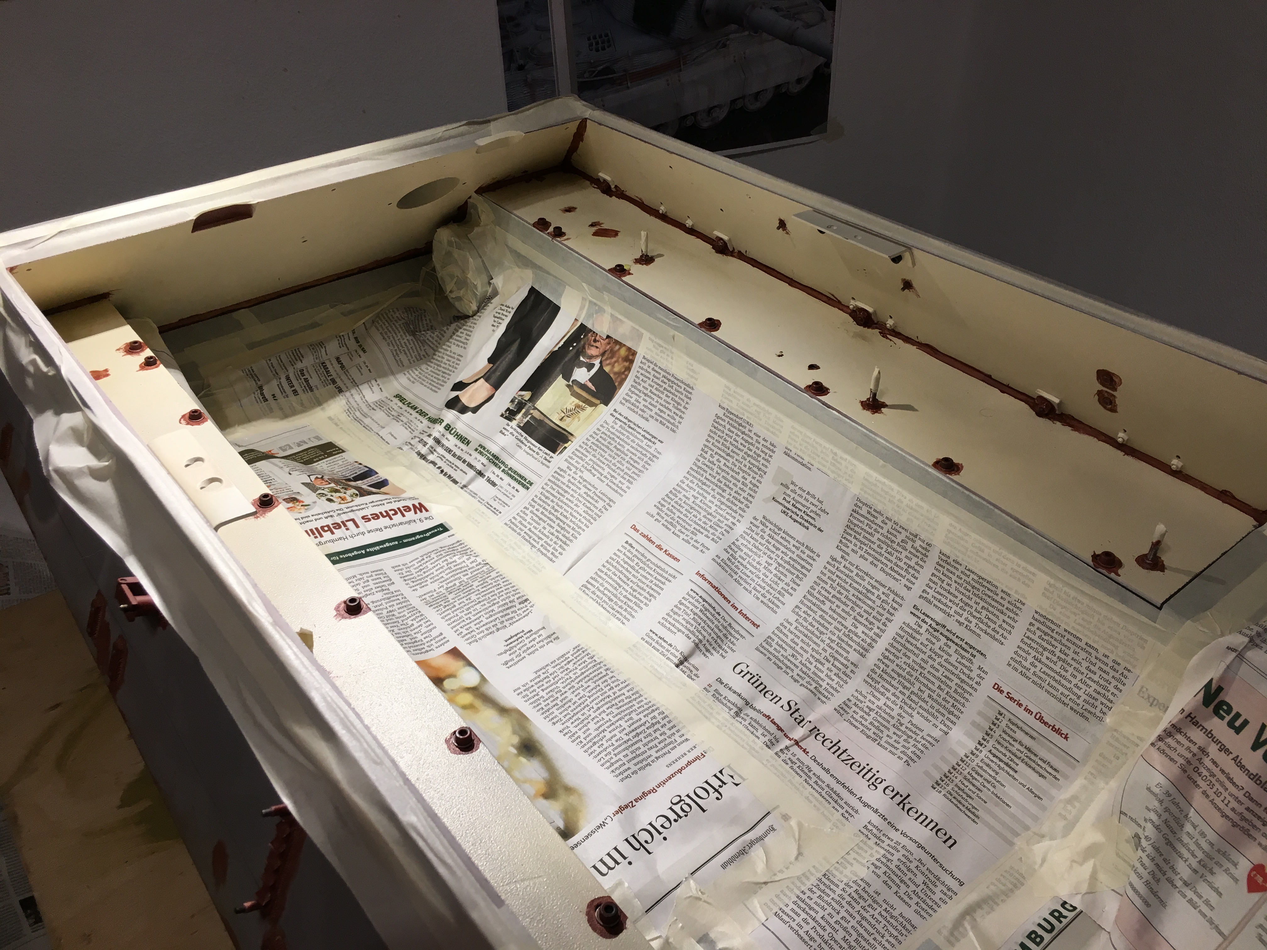

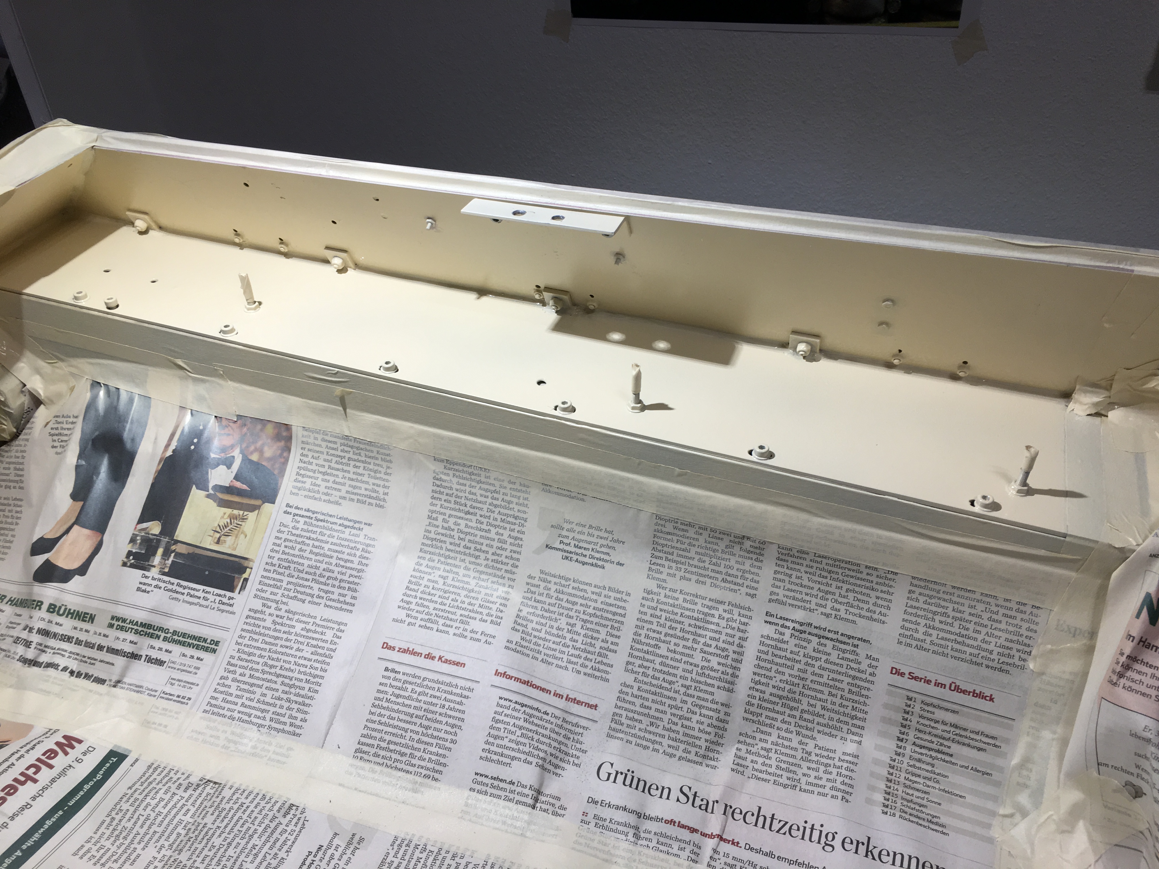

now i start with the inside of the hull with the first electric components and paint the elfenbein-white and black color new again.
Regards Martin

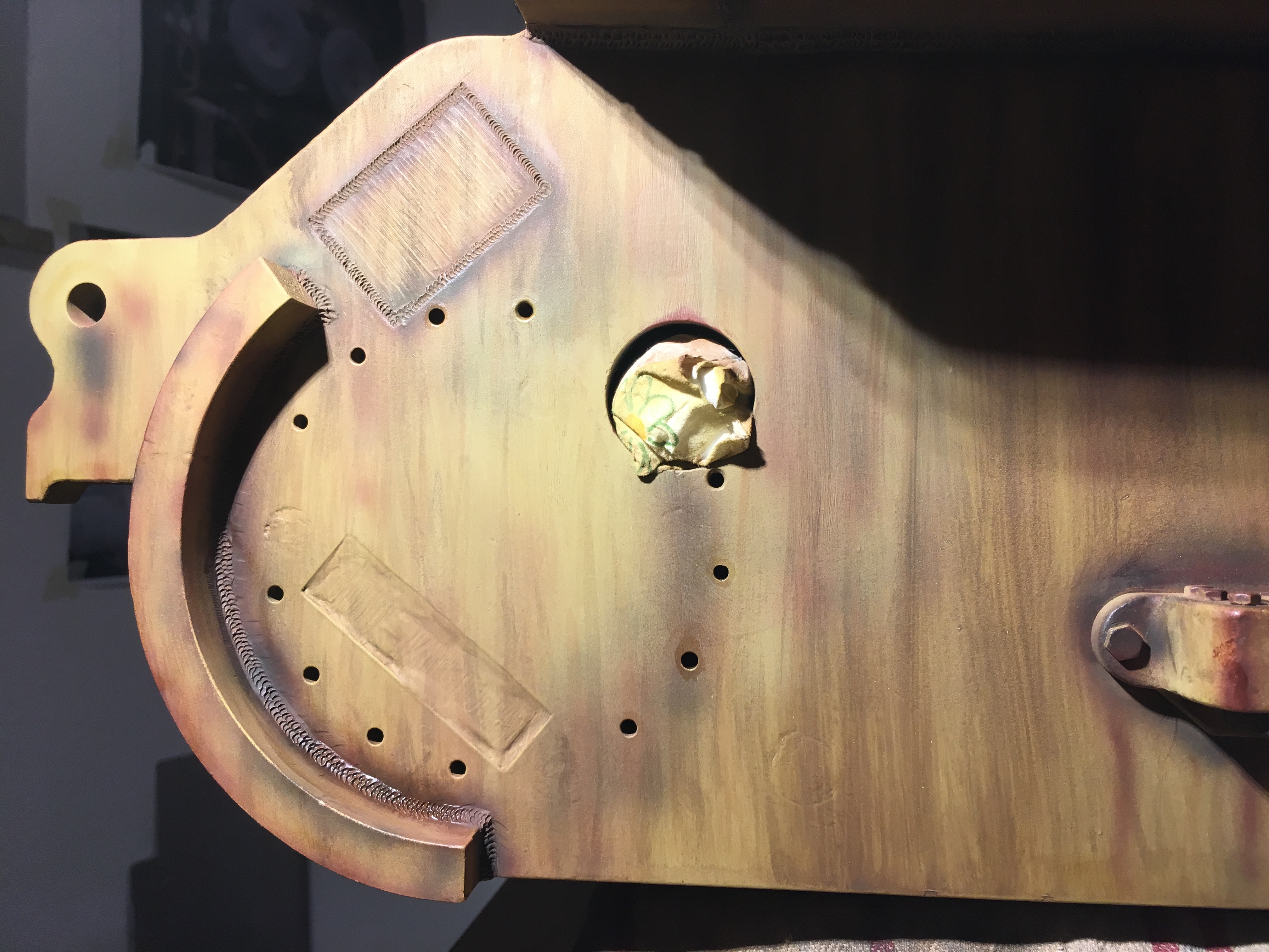

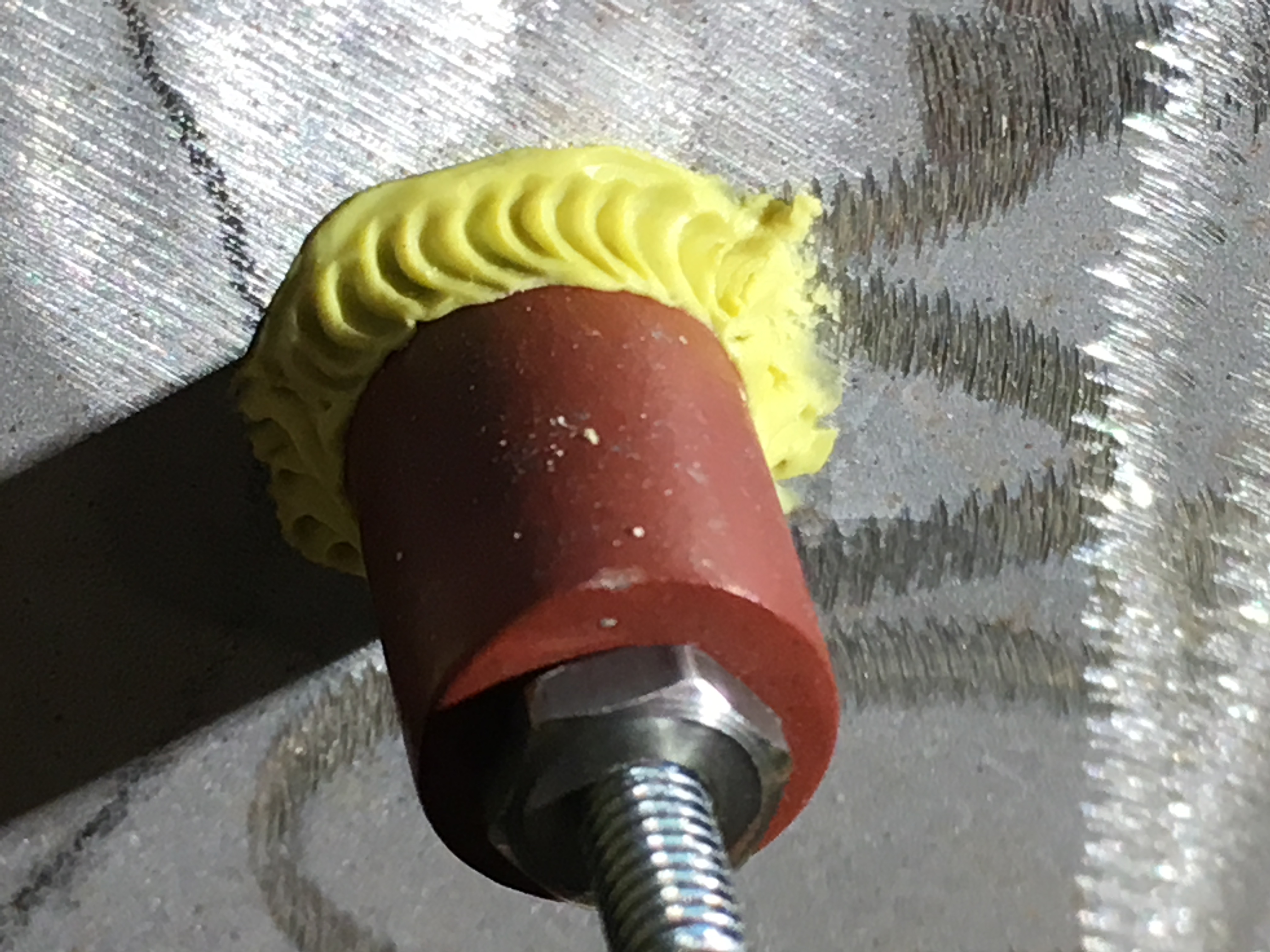

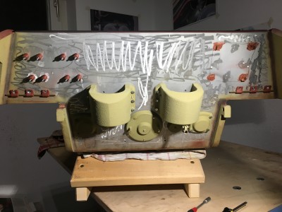

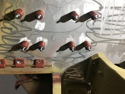

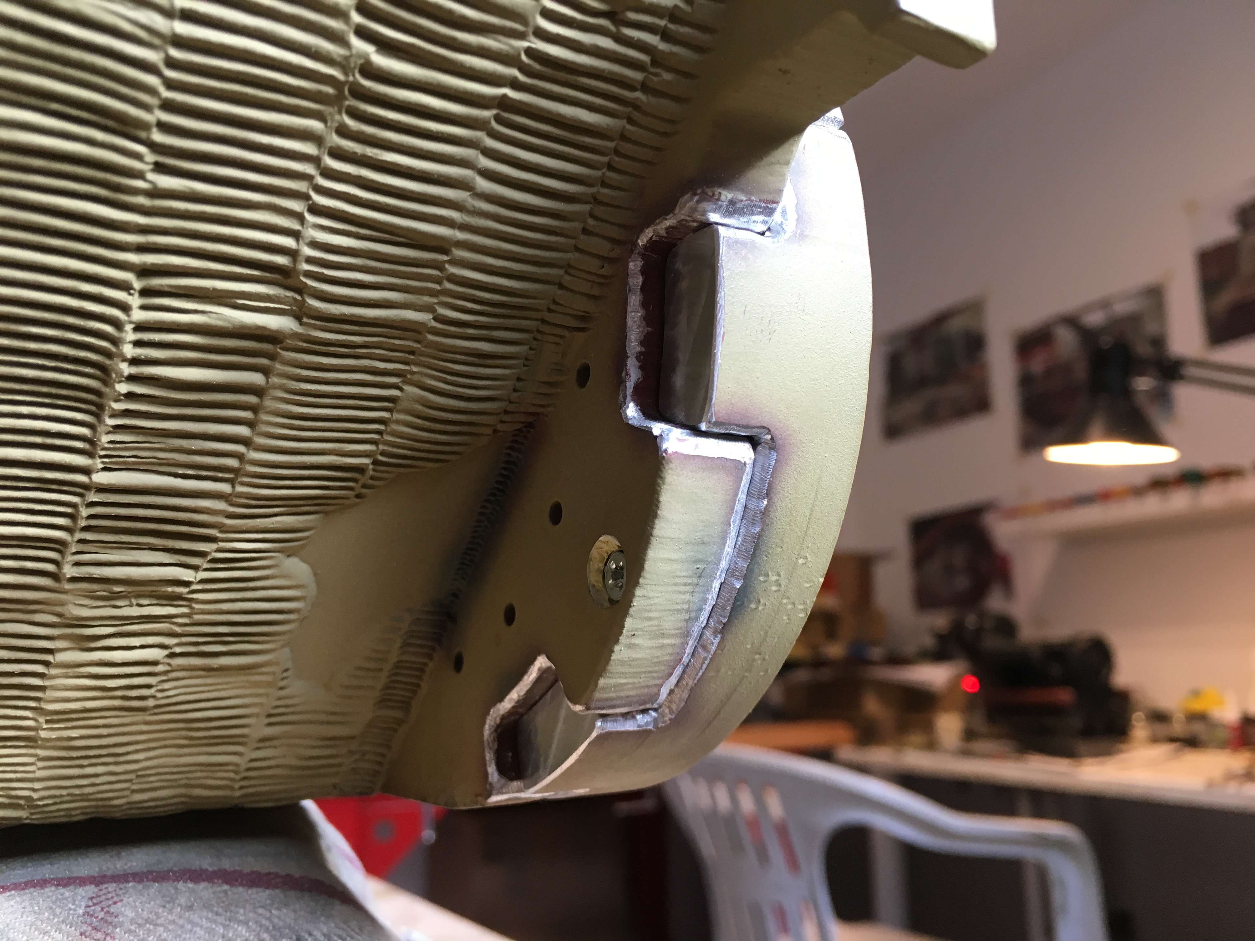

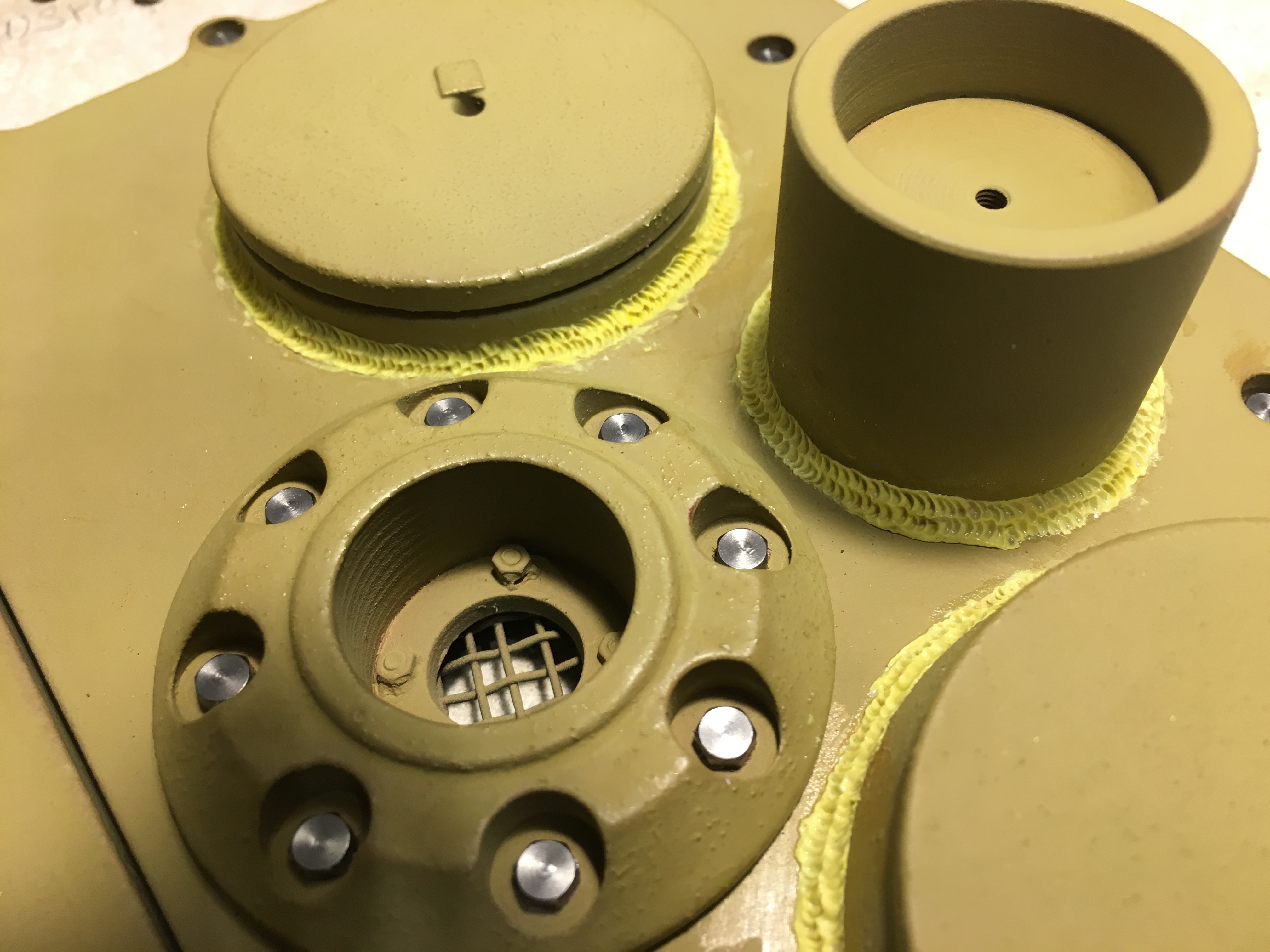

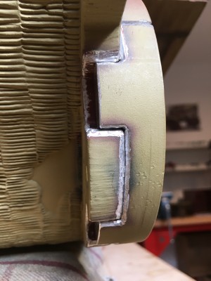

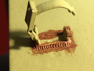

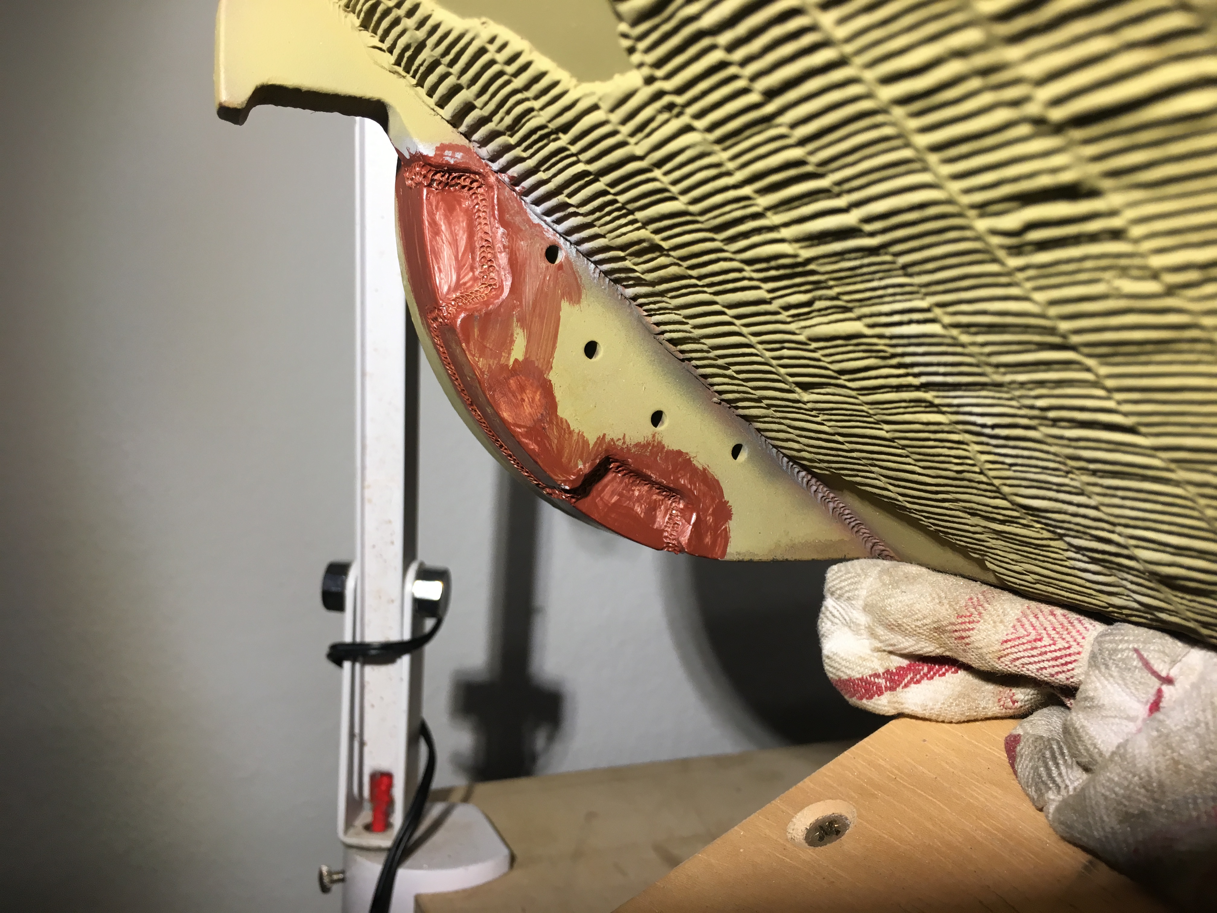

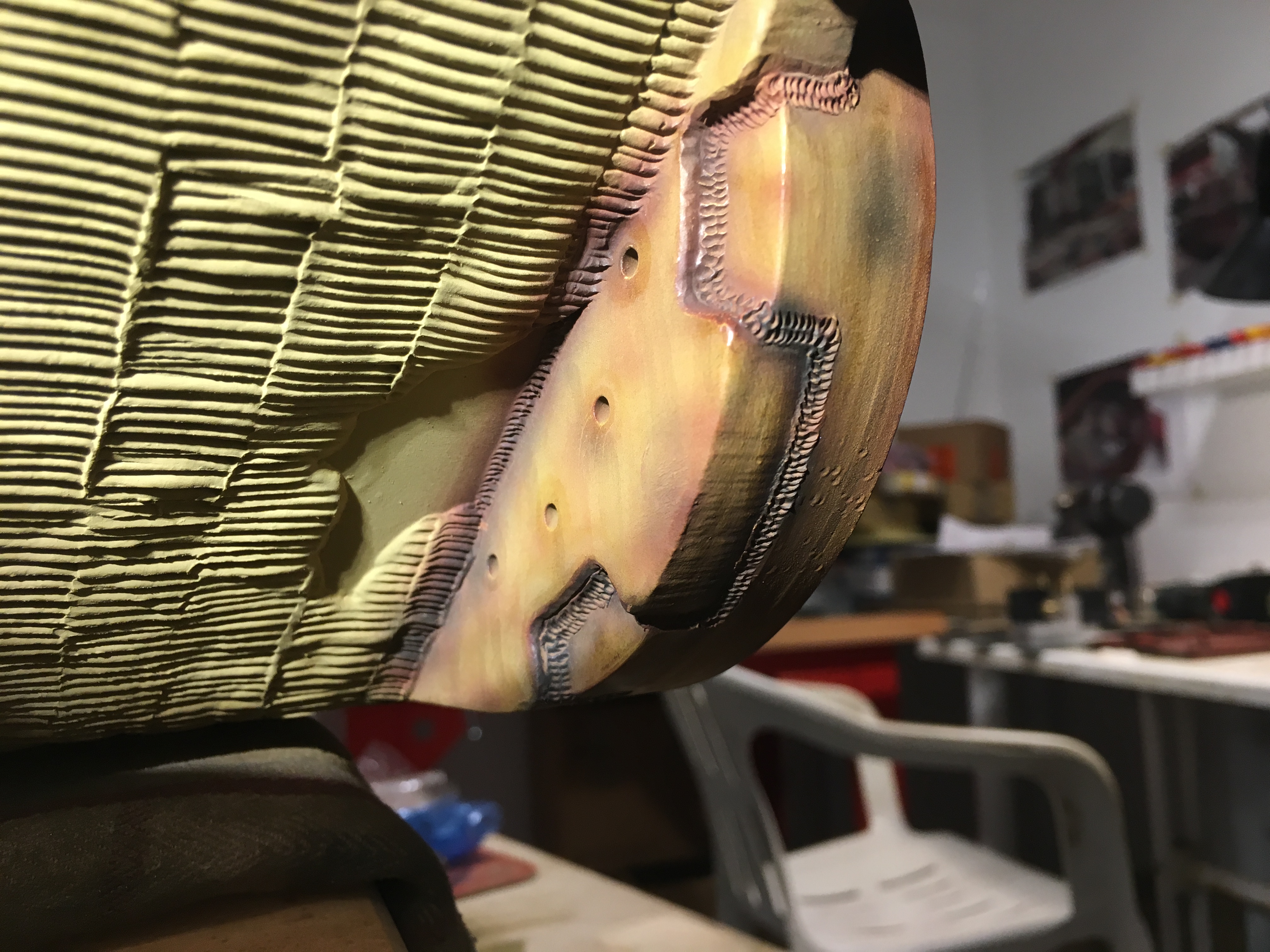

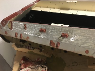

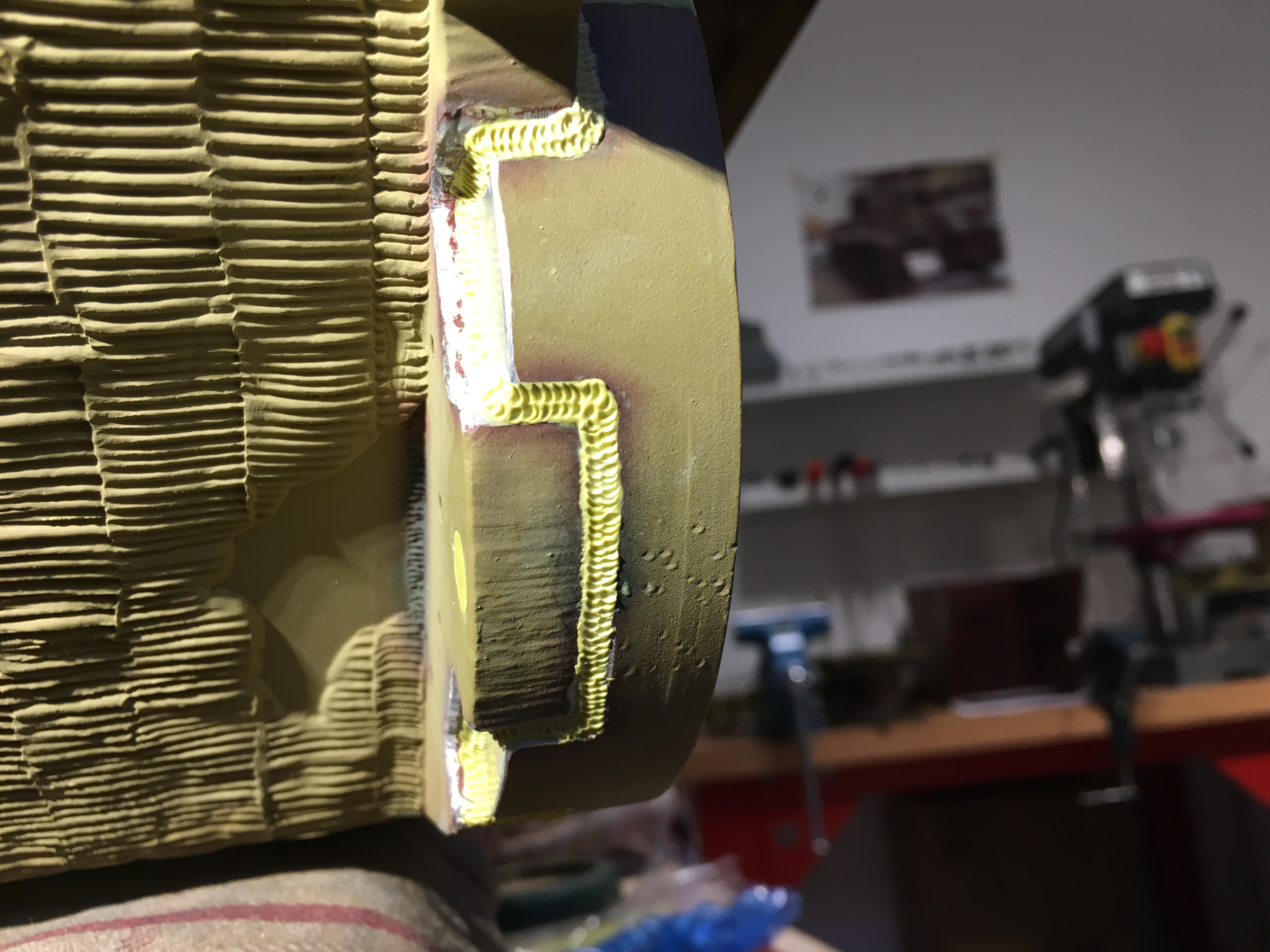

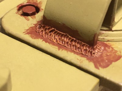

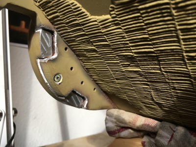

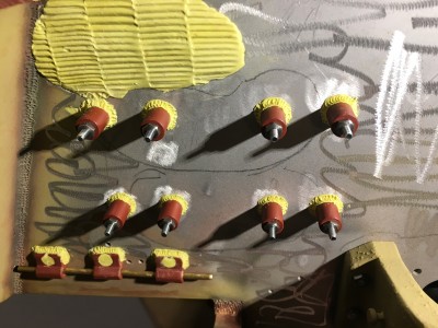

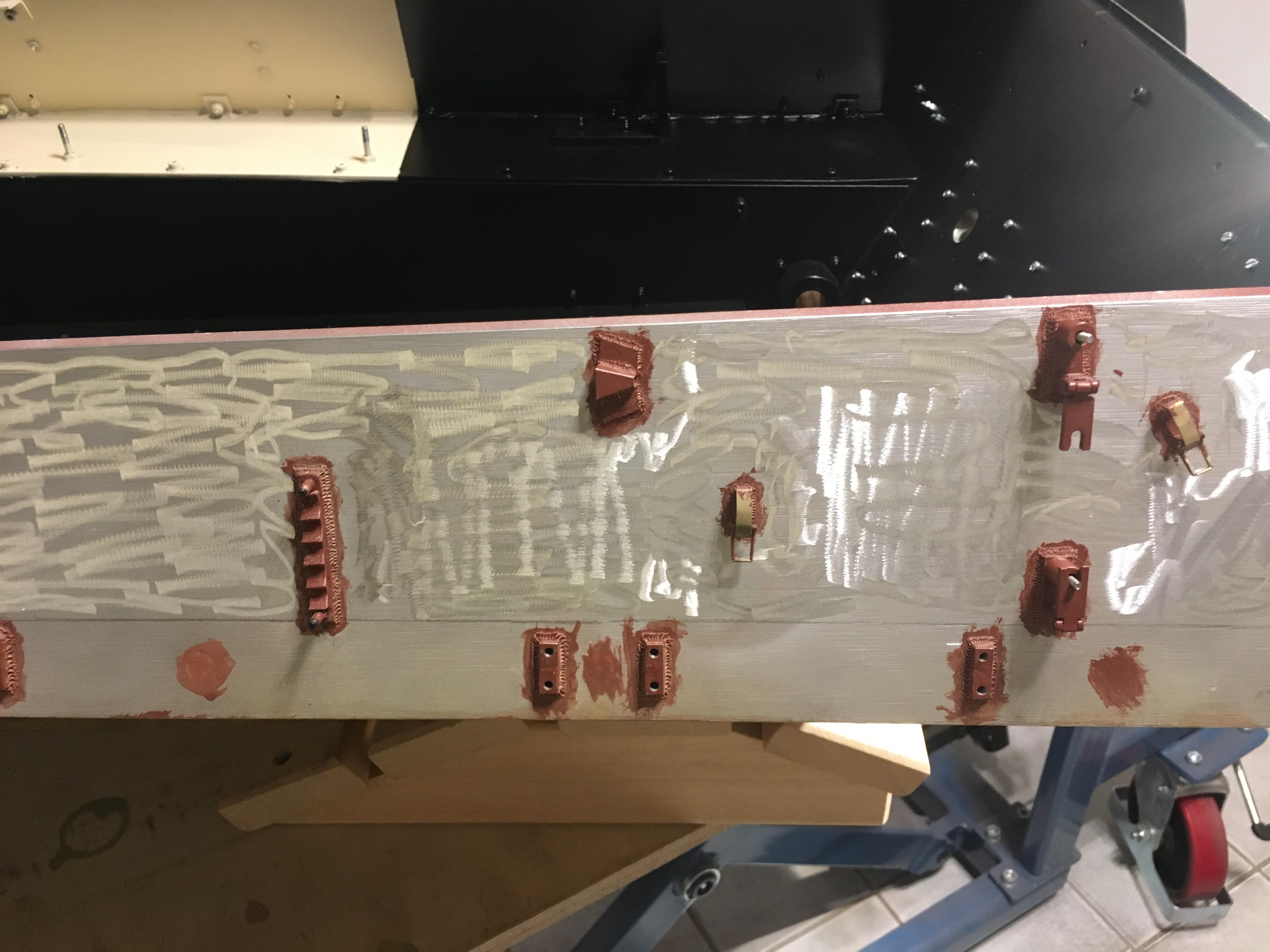

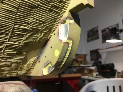

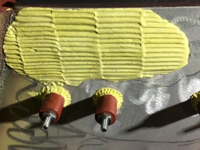

after painting i start with the zimmerit, but first i scratch the metal surface to give a better hold for the Milliput and make some welds again.
Regards Martin
Hi Martin, lovely work and lots of attention to detail as unusual, The only thing I have just got to mention is the zim, the pattern and thickness are very good, its the edges that don't look quite right, you have smoothed the edge to finish the section neatly, but in reality the the coating either had flaked off or has been dislodged due to small arms and shells breaking large pieces away leaving a torn edge.
You can achieve the torn edge by using a blunt tool to break the edge whilst the filler is in the process of hardening, or if it's set then a gentle heat to soften and then break away the edge, just my technique ....keep up the excellent work regards Phil.
