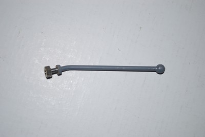

I have made a couple of modifications but I hasten to add these are not in conflict to the manual. It is entirely up to you the builder if you adopt these mods.
I tapped the bottom of the wing post to 4BA as M3 was too small and M4 too large. Loctited a 4BA nut on to the top of the thread and filed off the corners to make it round.
Also made up an angle bracket to hold the silencer in place. Filed a flat on the silencer and drilled and tapped at M3. It is at the back of the silencer so can't be seen.
Dennis.

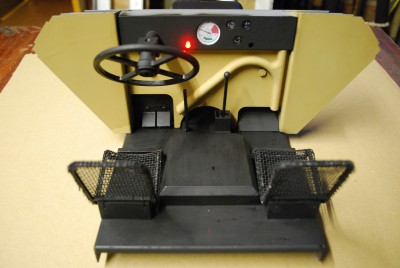

Cabin area finished. Fixed the seats in place with wire through holes. Printout of instruments
downloaded from panzerwerk's site free. Ignition light will be power light on/off.

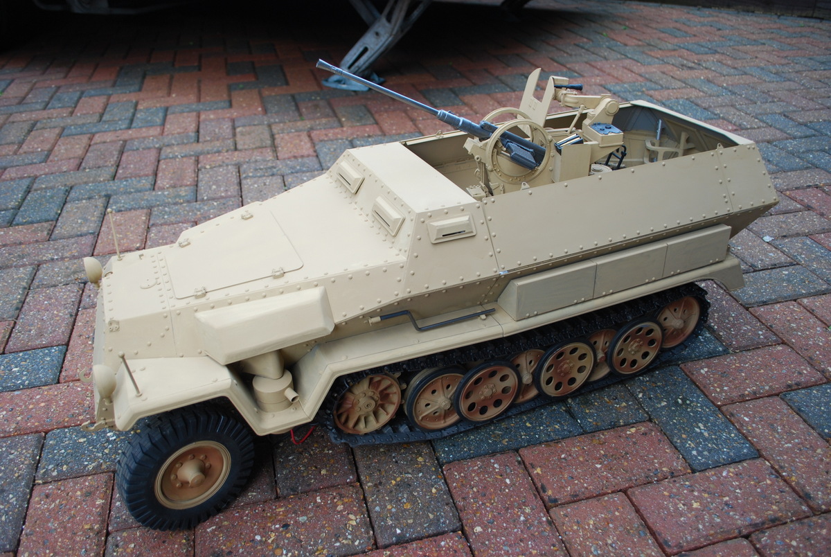

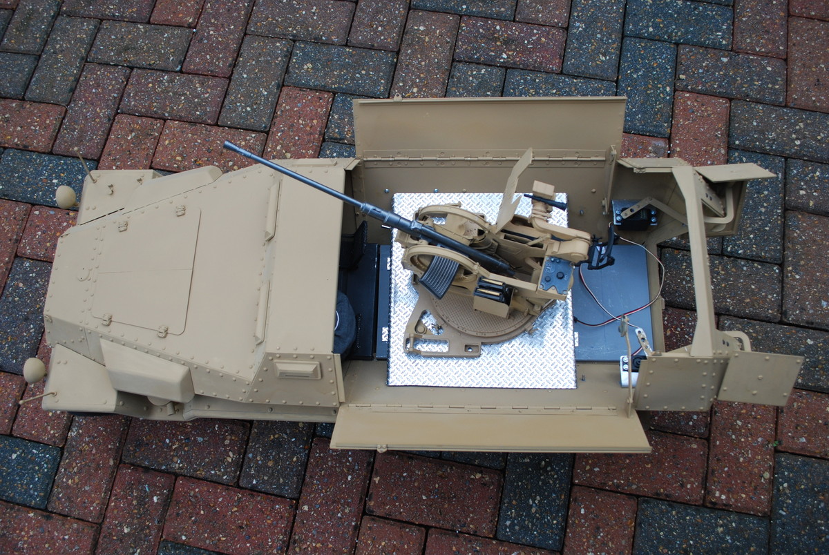

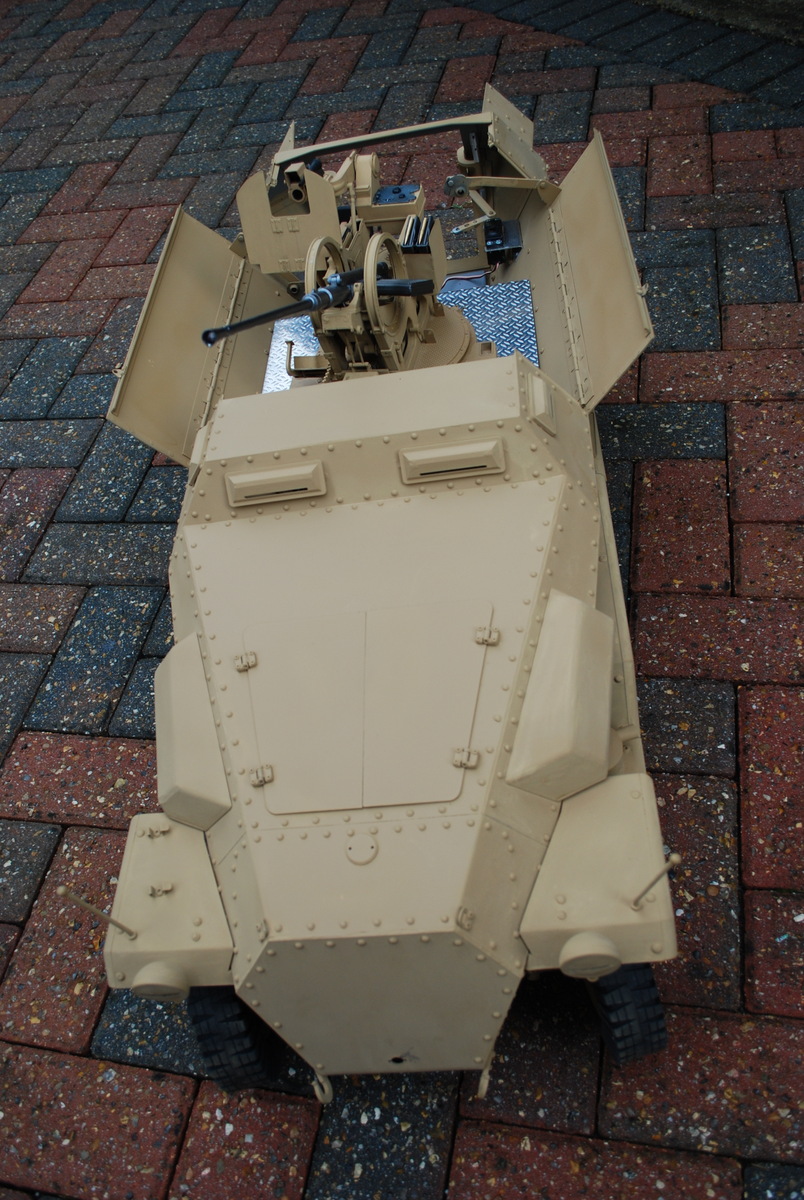

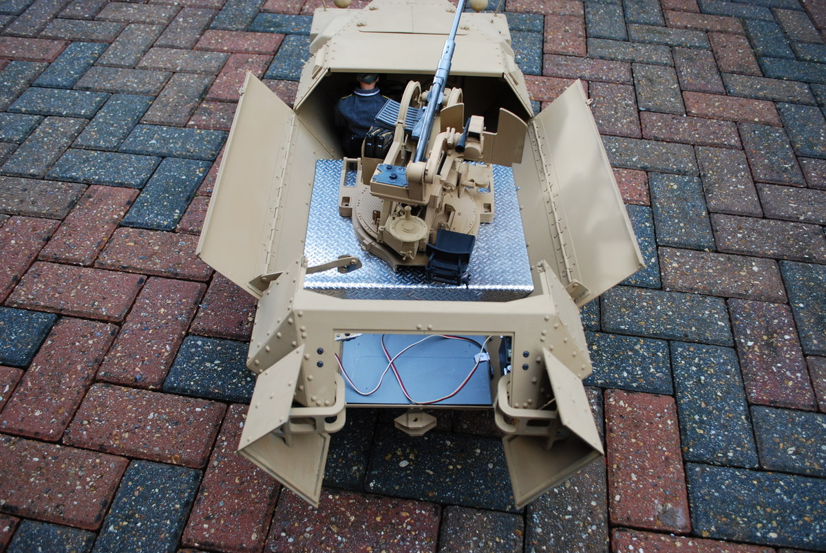

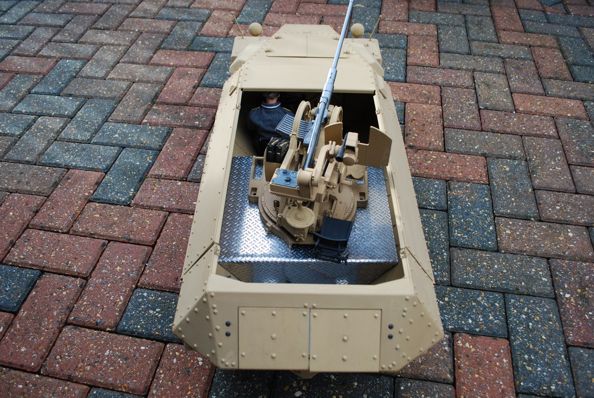

A bit more done but still more to do. I decided to put one battery in the front where the smoker is supposed to go as I have the speaker bolted to the back of the dashboard/bulkhead, the other battery will be under the gun platform together with the radio gear, sound unit and speed controller. will have to make up some aluminium covers to hide the door servos. A bit of brown/green camouflage to spray on yet.
Dennis.

Re: My 251 build.
Hi Tom,
Yes everything will be under r/c including :- gun rotate and elevation, side doors opening and closing, rear doors opening and closing, sounds including 22 mm gun sounds synchronized with led in end of barrel, running lights and possibly dual searchlights. I am using my own electronic control system.

Re: My 251 build.
Hello Dennis, that's one smart looking model. I like the Flak gun option, there are plenty of ideas when fitting these 251's out. It would be interesting to see what other builders of 251's are intending to 'finish' with. Thank you for posting the photographs they are an inspiration......Mick

I have a question where did you get the Checker plate from that is under the gun ?
Looking good like the doors and drop sides.

Hi Derek,
B&Q but not cheap though. 250 x 500 about £20 and 500 x 500 £36. I had to get the latter but will have some left over. Used my OAP's Diamond card for 10% discount. The desert yellow looks paler on the photo than it actually is. Some brown and green to go on eventually.
