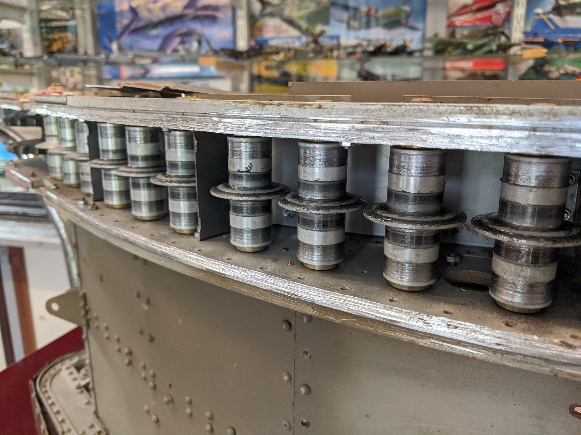

Well I finally bit the bullet and stripped down my Mark IV prior to it's long planned overhaul and the installation of the 'wiggly gun' pack. Fair to say it's taken a beating with metal filings and dirt everywhere. Having removed the tracks, side and top plates and all the electronics and motors it looks a sad empty shell but hopefully this time I can rebuild and correct all the mistakes I made the first time around..

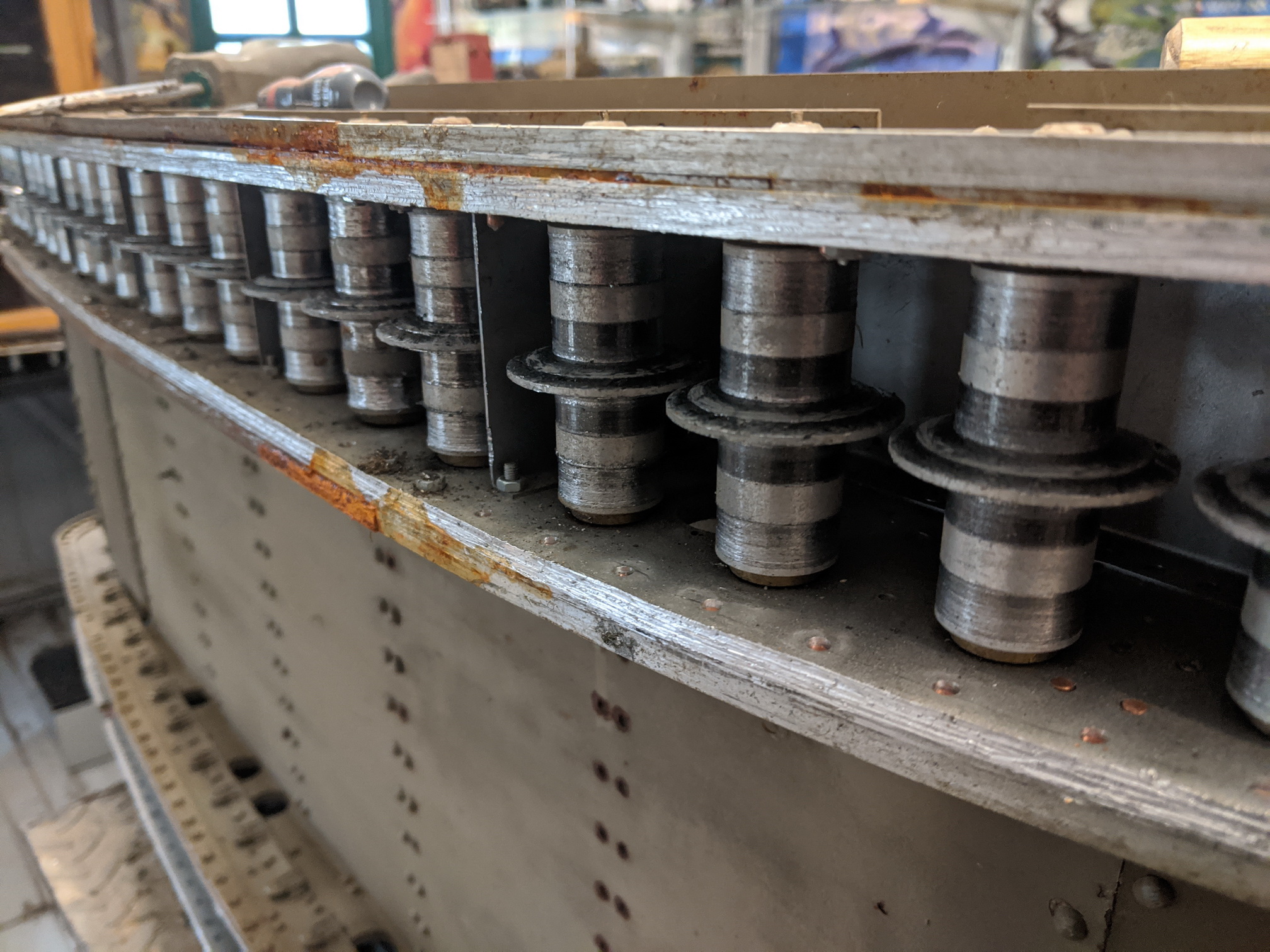

Tracks off so I could see the wear patterns on the frame and rollers

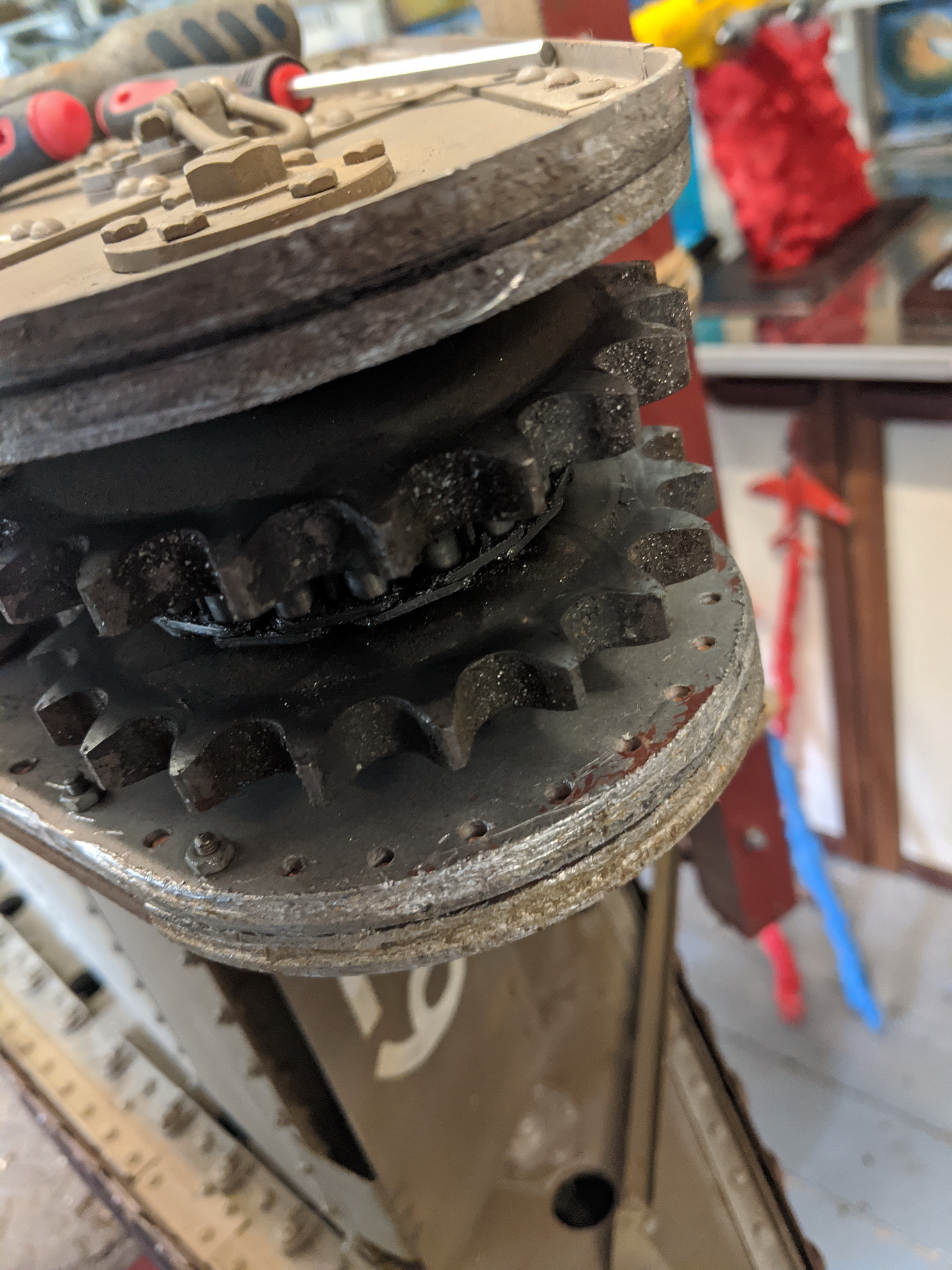

And around the sprockets

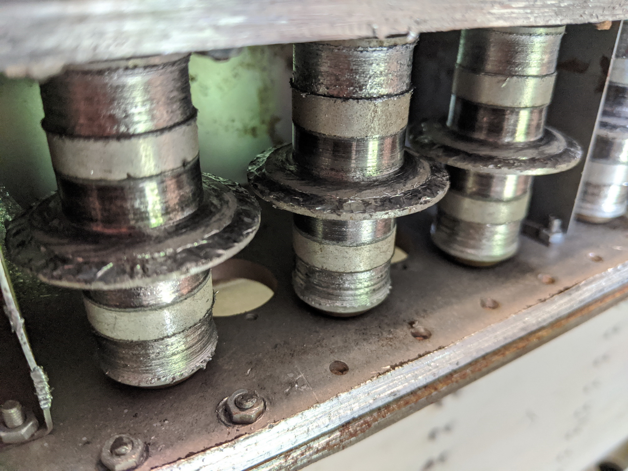

Some of the rollers, particularly where the hull contacts the ground are well worn, I did find a few that had siezed and were not moving. A generous application of WD-40 frred them up but I may well swap them with less worn ones from eslewhere on the run.

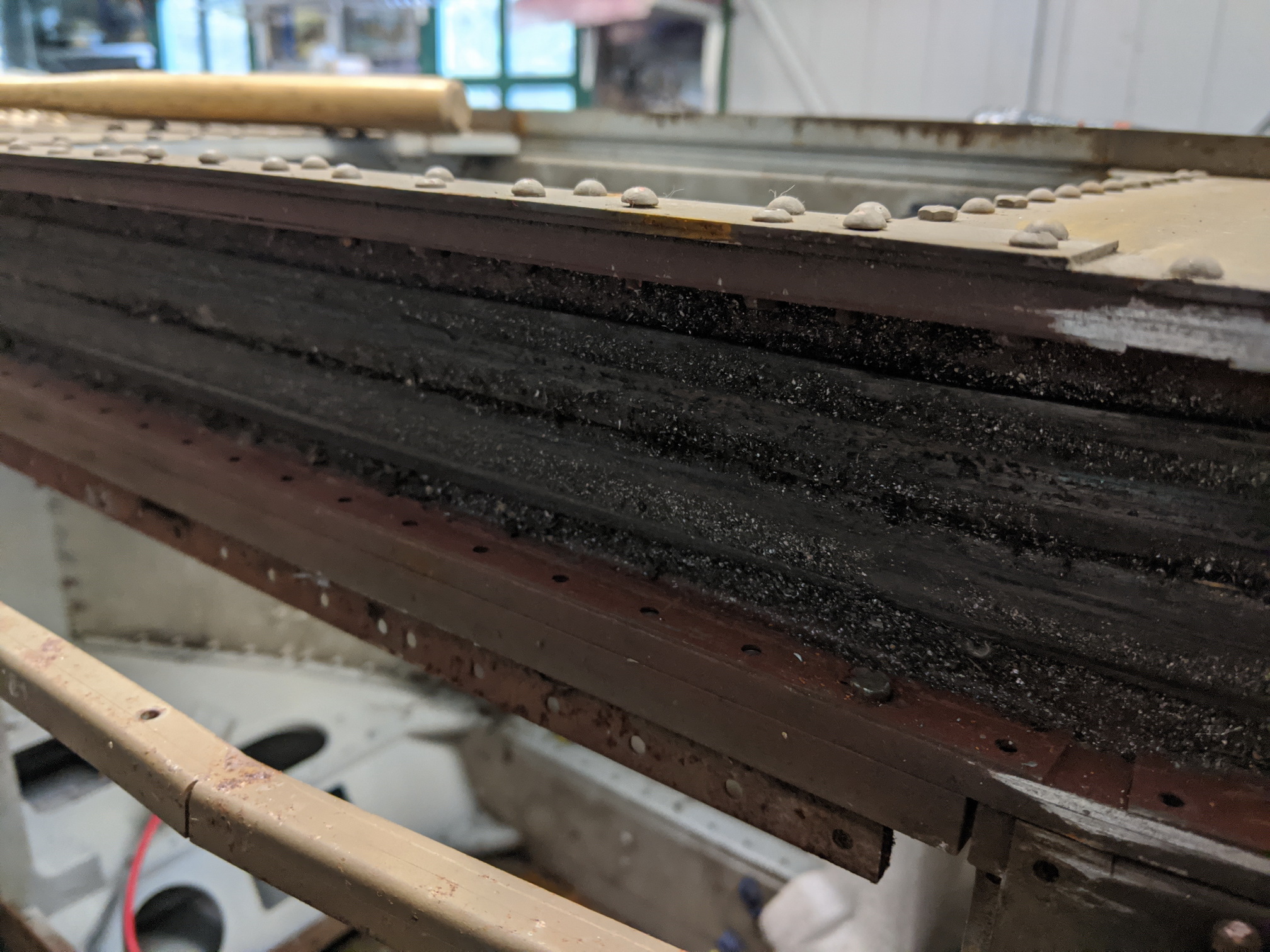

Top run slip strips are still ok, but I may replace them with PTFE

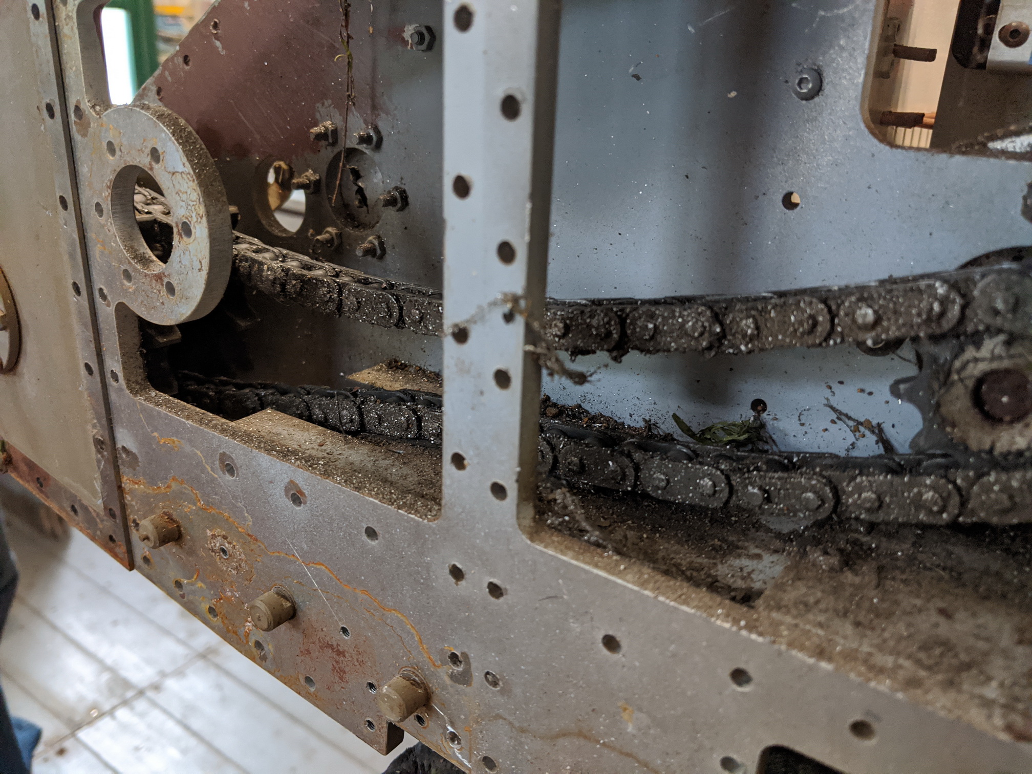

Drive chains need cleaning and seem rather slack, not sure if I should do anything as the tank was running fine with no slippage since I last tensioned it two years ago...

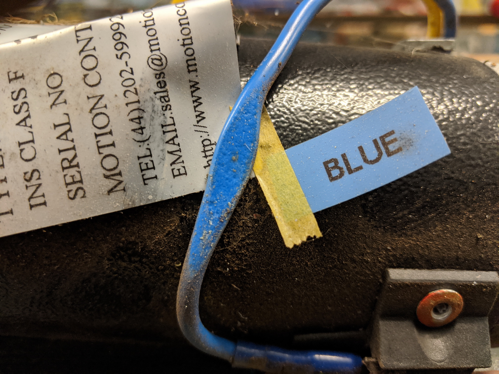

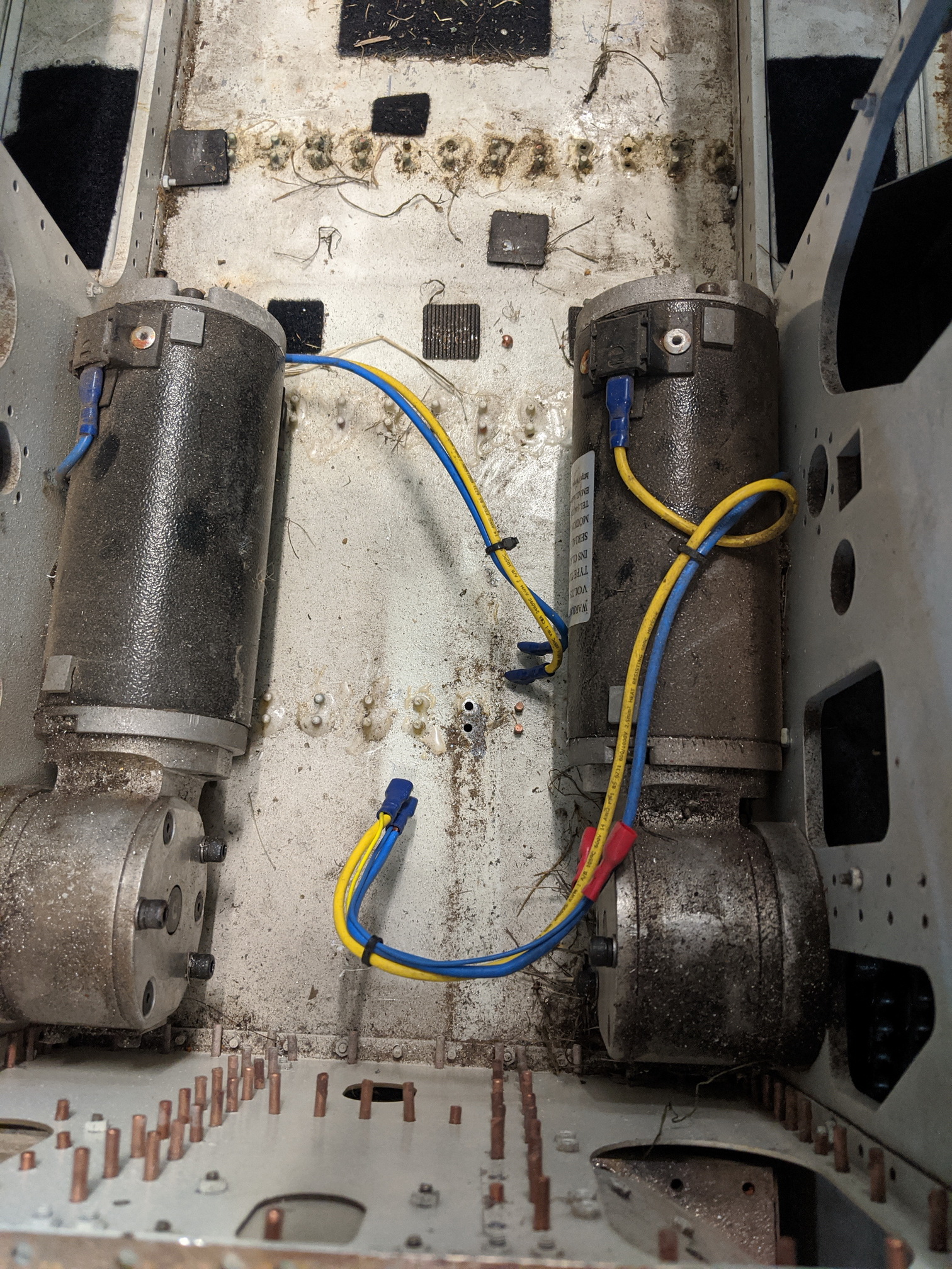

Just the motors to go...and maybe why I have had opower issues since day one?
Well that doesn't look good....managed to do the same thing on both sides. I really hope that is the root cause as it would make life so much better.

I hate to say, but I think if your performance issues were related to those cables, the squashed insulation would be noticeably discoloured.

That is some serious galling and wear! Aluminum on aluminum is a tough combo!
Wonder if you've figured out how many 'scale' miles that your track has travelled?
The originals were carried to the front on trains and were not exactly long-distance travellers. Even the scale ones apparently are wear-prone in the dirt.
Most of that is steel on aluminium. Either steel chains on the aluminium rollers or steel track plates on the hull sides.
