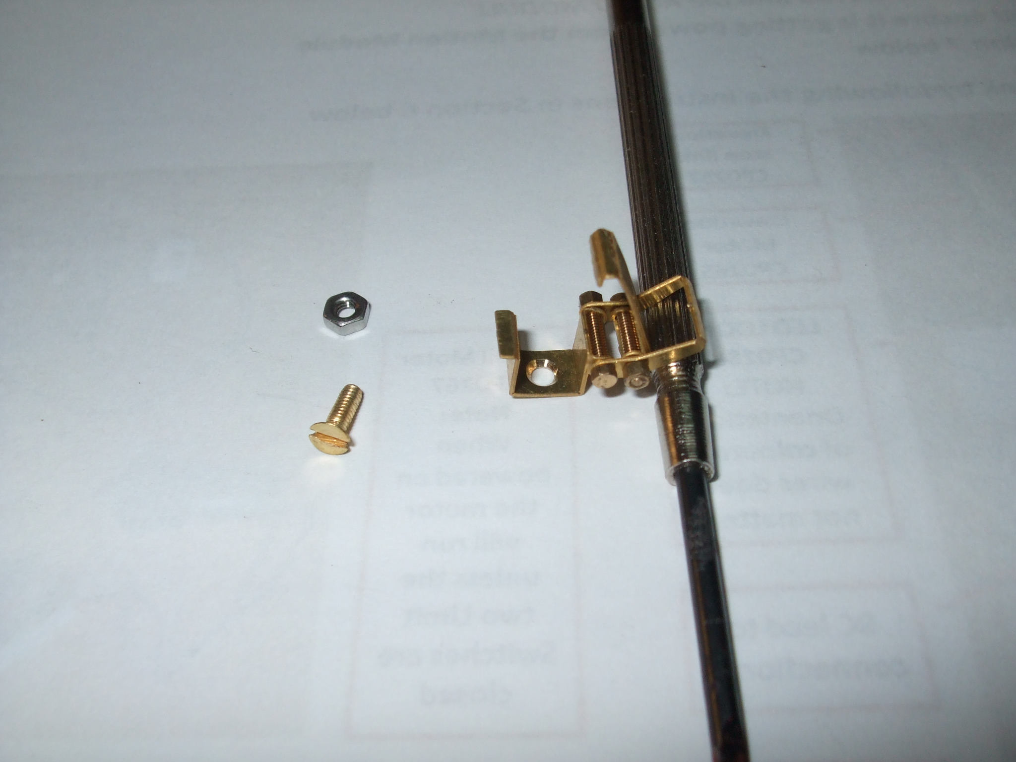

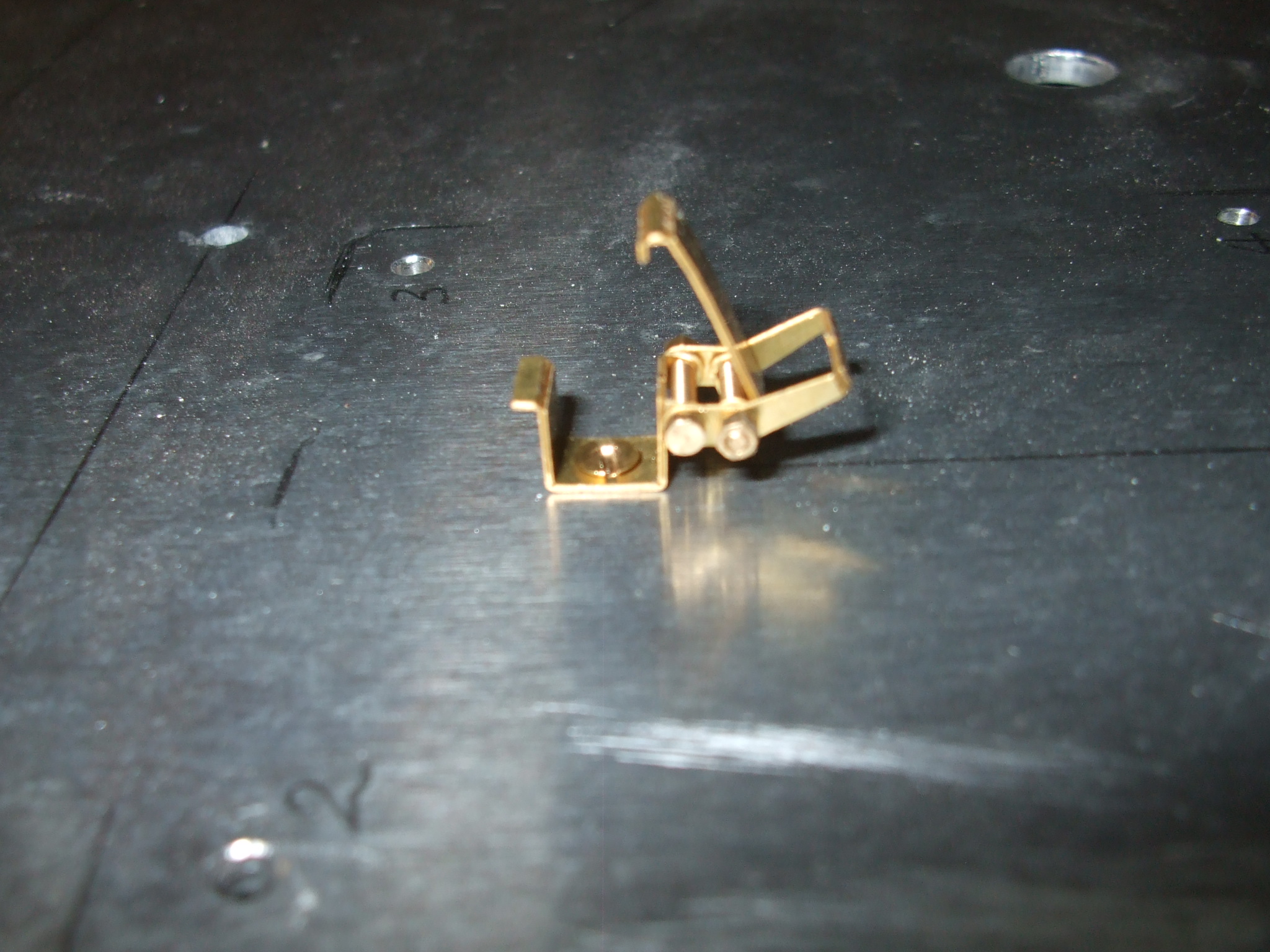

Allan, as promised a couple of photos of the tool clamps.
I opened up the mounting hole with a 2mm drill and used a 2mm slotted CSK screw (because that's what I had) and a standard 2mm nut. You may notice that I slightly countersunk the mounting hole. Like this you can use the original holes in the hull roof or you can drill 2mm holes if you intend to shift things around.
You can also use 1.6mm CSK screws and avoid drilling the clamps to 2mm but then if you use the original holes you may need to use a spacer under the nut.
Hope this helps.

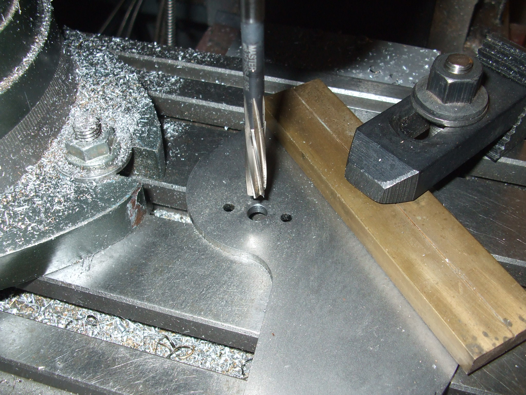

I have been slowly assembling the recoil mechanism to see how it goes together. Had a little problem with the mounting of the cam to the motor. The hole in the cam where the motor shaft passes through was under-size. Opened up the hole and reamed it 6mm.
Then noticed that the hole for the grub screw in the bush that attaches the cam to the motor was only partially tapped. Quickly fixed that also.
Otherwise it all came together nicely and it seems that one can assemble it out of the turret and then when tested and calibrated fit it in the turret with four bolts which is a good thing.

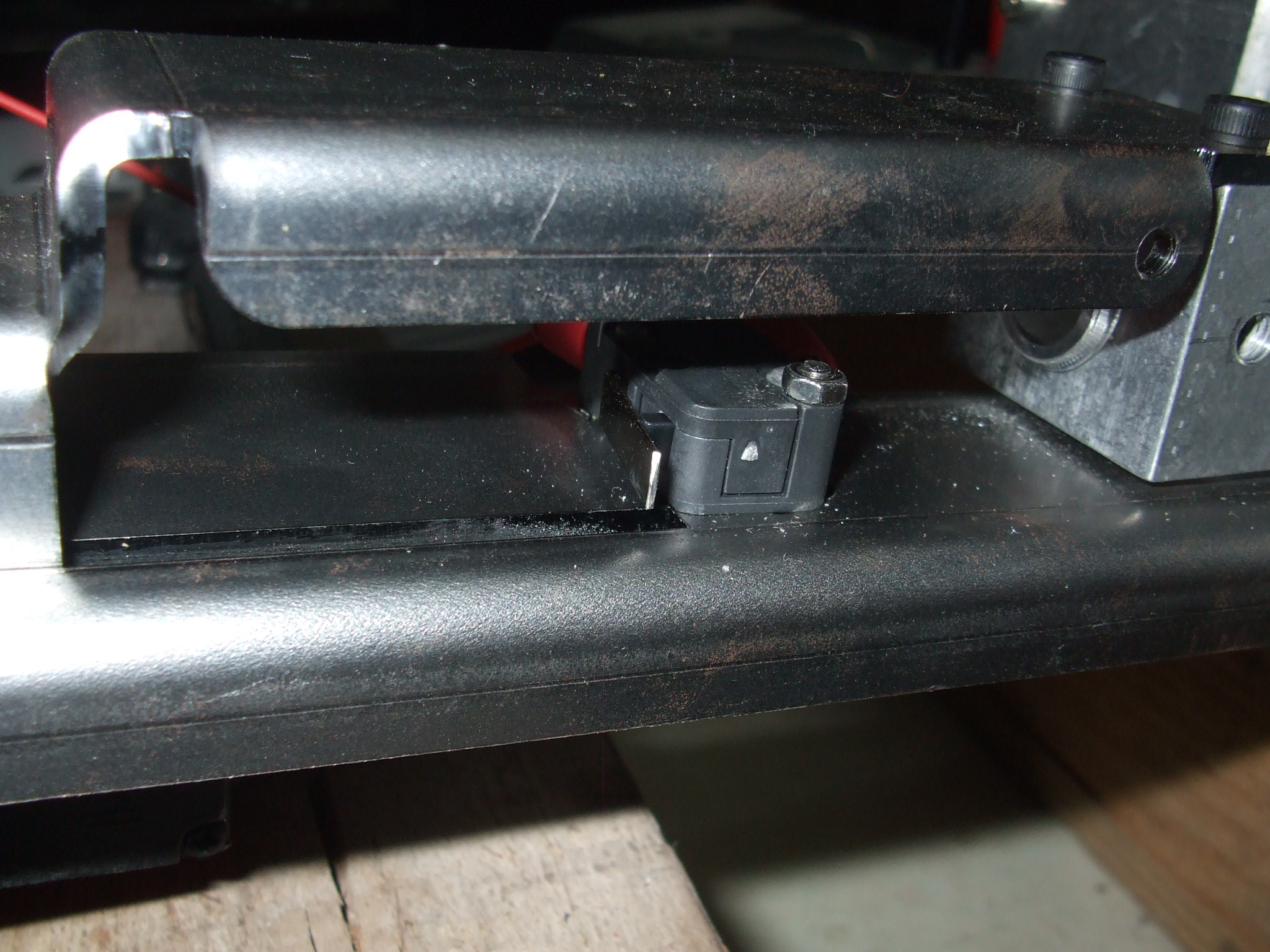

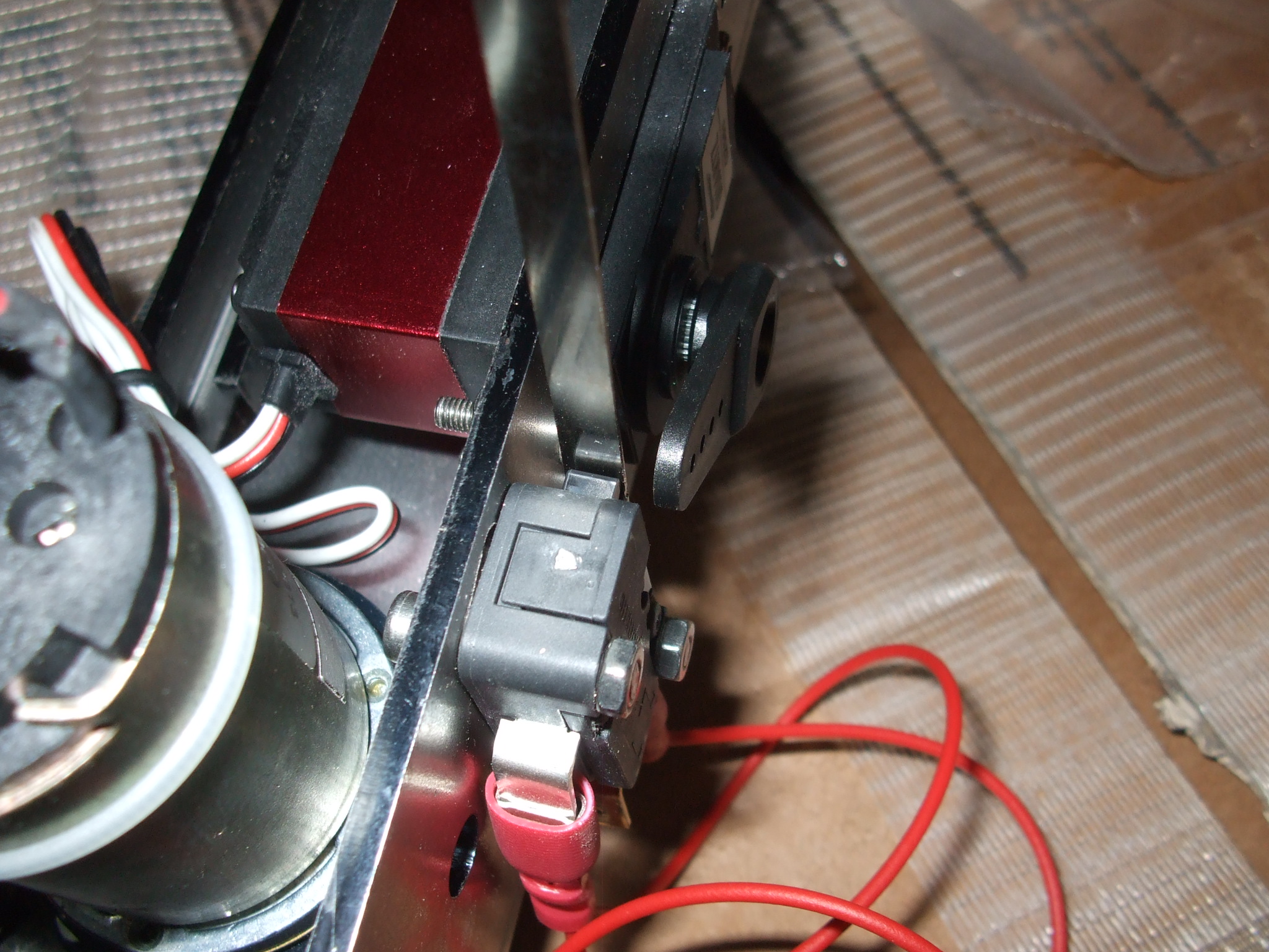

Well, after sleeping on it, I figured out the micro-switch logic and went to the workshop to test my theory.
I still had to fit the micro-switches and soon encountered a snag when trying to do that. The micro-switch close to the servo is sitting too low. The servo arm cannot activate the micro-switch.
Temporarily fixed that by stacking nuts on the screw. Later on I will make proper spacers instead.
Eventually I got things working -- sort off. At least the theory of how the micro-switches work was correct but the problem is I can't get the motor to stop where I want it. Spent the whole day adjusting the micro-switch which stops the motor but always seems to overshoot. I have tested both micro-switches with a multimeter and they work perfectly when you hear the "click".
I don't know what else to do. I am really frustrated. Has anybody actually made this recoil unit work??

Would the servo arm and switch align if the servo was installed from the rear, rather than fed through the hole ?
I don't have one of these new recoils, so can't comment, but on the animatronics for the Mark IV< some servos were installed through the holes from the front and some were bolted to the back of the plate. You do need to shave off the central buttress so that the servo sits flat against the plate.

Adrian, it is installed from the rear.Would the servo arm and switch align if the servo was installed from the rear, rather than fed through the hole ?
Done that as it is also mentioned in the manual.You do need to shave off the central buttress so that the servo sits flat against the plate.

Could you post a picture of the troublesome switch please ?
- Has liked: 794 times
Adrian, it's not much to see as the switch is covered by another part of the mechanism.

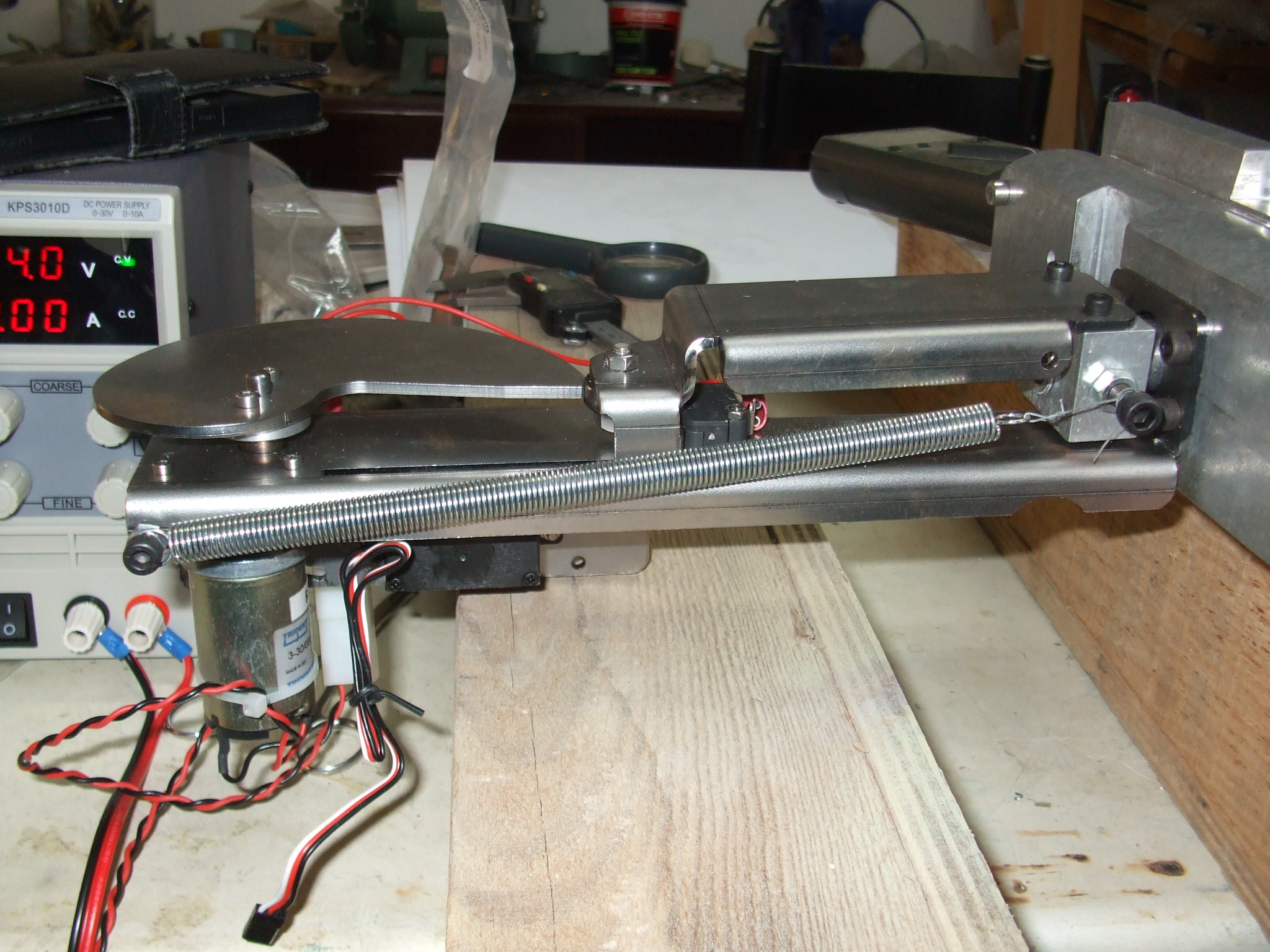

Yesterday spent another whole day playing with the recoil mechanism with no success. Noticed also that the voltage between a fully charged battery and a half discharged battery changes the place where the cam stops. Basically at the end of the day I gave up and started thinking of Plan B.
Today I had some spare time and half-heartedly I gave it another try with the same results. Then I had one of those moments
(a rare occurrence). What if I reduce the tension of the spring? Added a piece of wire to the spring to reduce the tension.
OMG! Started getting repeatable successes. It's starting to look promising.
[youtube][/youtube]
I will continue testing it for the next couple of days to make sure it is not a fluke. After that I can drill a line of holes close to the spring rear anchor point so that I can get various spring tension settings.
[youtube][/youtube]
I will still continue working on Plan B though as a backup. It is a strong Nema 17 stepper motor controlled by an Arduino and programmed to turn one revolution at a time. Problem is that I'm no Arduino expert.
