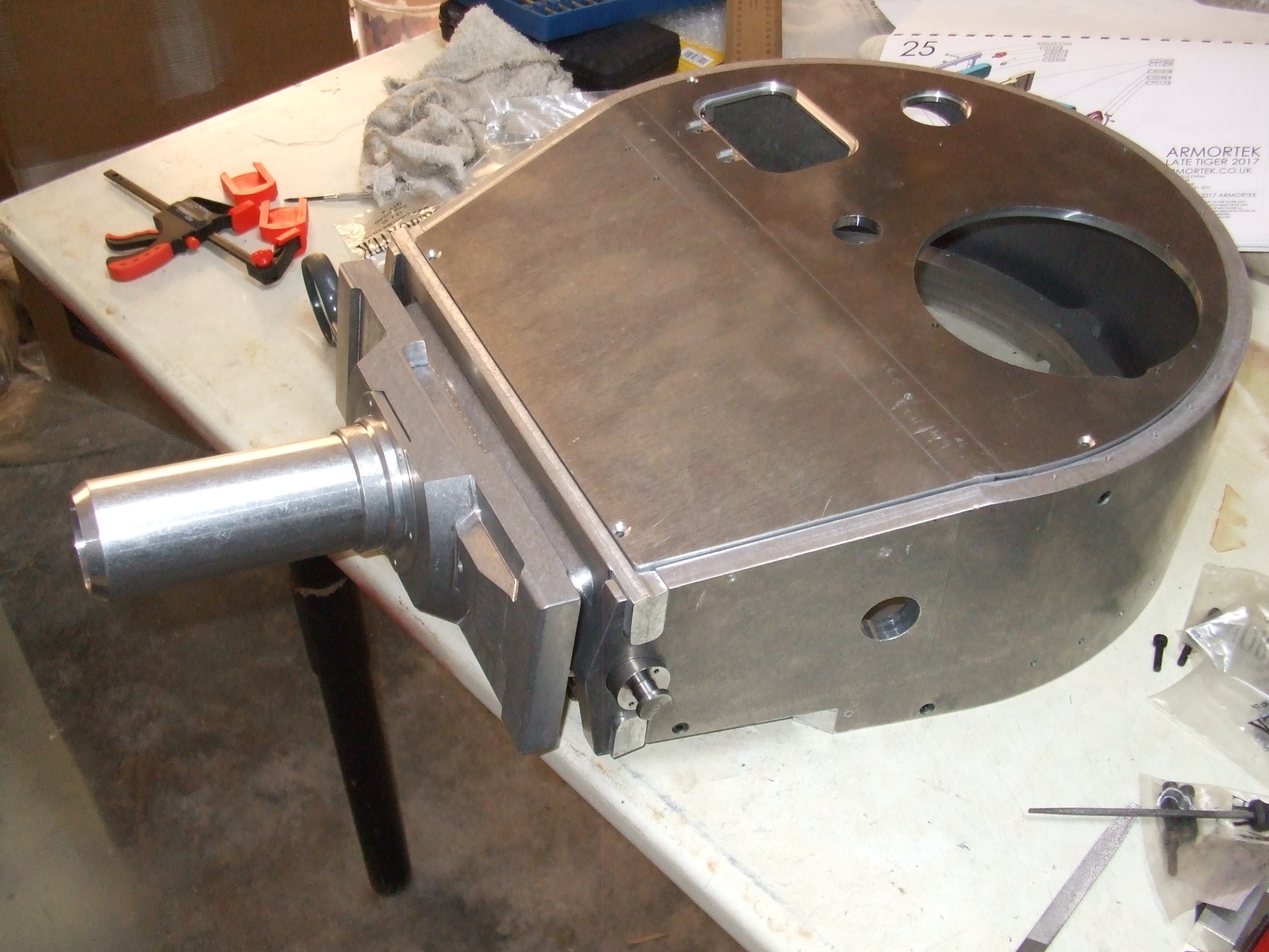

Last week I started taking out of the boxes some turret components for deburring, cleaning and checking for fit. I immediately encountered a minor problem were the tongues of the turret front (CE1473) do not fit in the slots of the turret wrap (CE3470). The width of the slots and the thickness of the tongues measure 16.3mm which is the reason why they don't fit. This means that I have to remove some material from either the tongues or the slots. I haven't decided from were to skim off the metal although the way the tongues of turret front were machined is hinting that the tongues could be the culprit.

During the last couple of days I have been working on the test assembly of the turret. Lots of hand fitting required plus a good dose of patience. I have to admit it was frustrating at times. I align it on one side and lose alignment somewhere else :evil: . During those times I would drop everything and come back after a couple of hours which seemed to help.
Finally, after some compromises, I managed to assemble it to my satisfaction.
Removing material from the tongues.  Removed 0.3mm on one side and 0.4mm on the other side.
Gently opening the turret wrap to fit the turret front.
Compressing the turret wrap
After I inserted the turret base I found that compressing the turret wrap was the best solution so that the screws would align with the holes.
Some of the holes in the turret roof do not align with the tapped holes. I am not really worried at this stage because I was thinking of using magnets to hold the turret roof in place.
I think I will put the turret aside for a couple of days before disassembling it again.

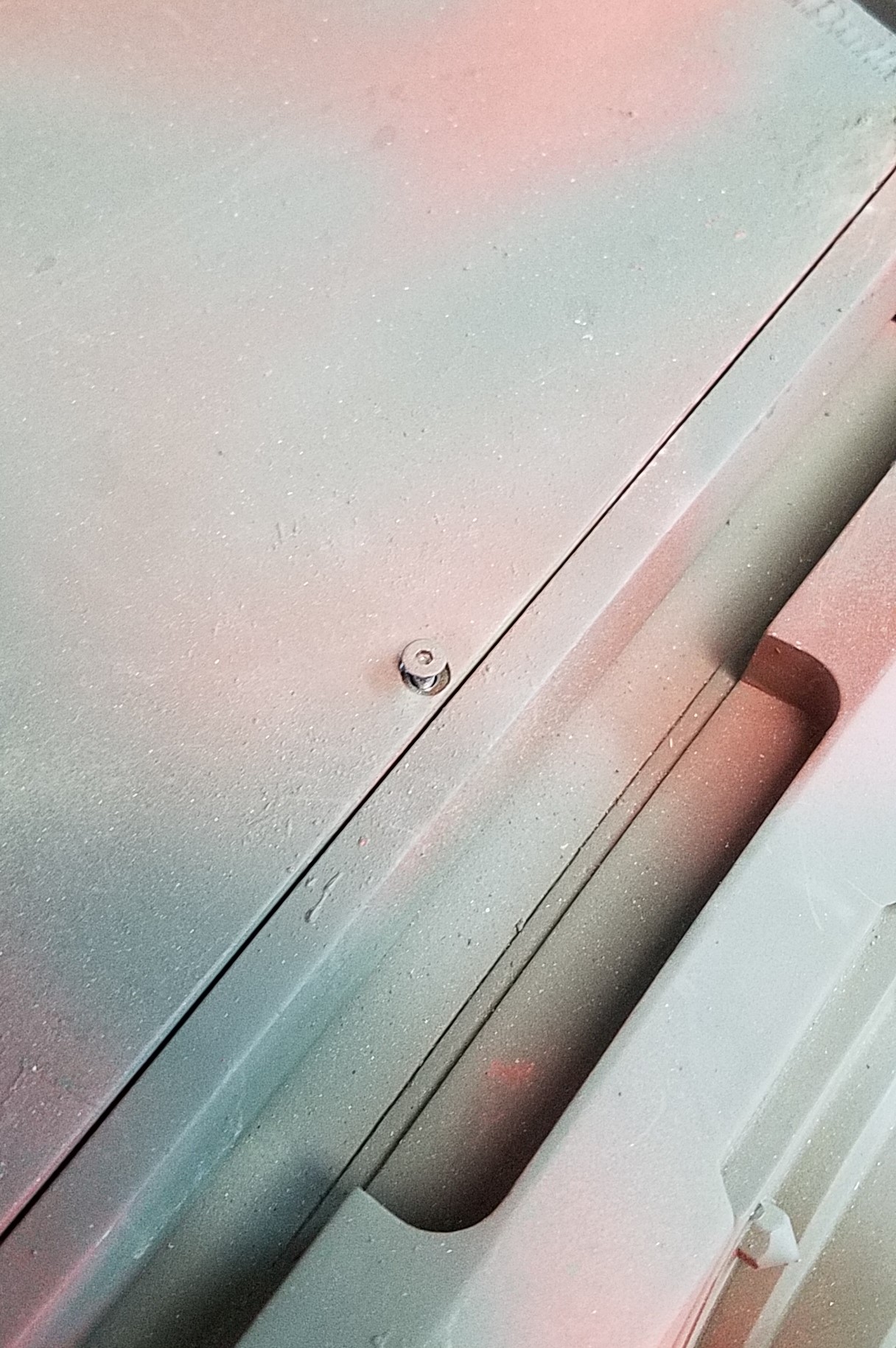

Regarding the roof and securing it, instead of using magnates, I opted to use the two side screws, which aligned OK with their block mounts at the hull, and a third screw at the front above the main gun.
I filled in the two outer holes provided in the roof front. Then, I drilled and tapped for a 3mm flat head fastener into the thicker front mantle (the part where the roof front rests). The weight of the roof keeps it in place, so there really isn't much worry about fastening it with more than one machine screw in the center.
Drilled and tapped for 3mm machine screw in front roof center.
The reason I didn't use magnets, I was afraid that magnets might not keep the roof secure over very rough terrain. I supposed strong magnets might be OK. I found that I don't have to remove the roof so frequently that the three 3mm machine screws are much of a bother, and they positively keep the roof from any movement over rough terrain.
