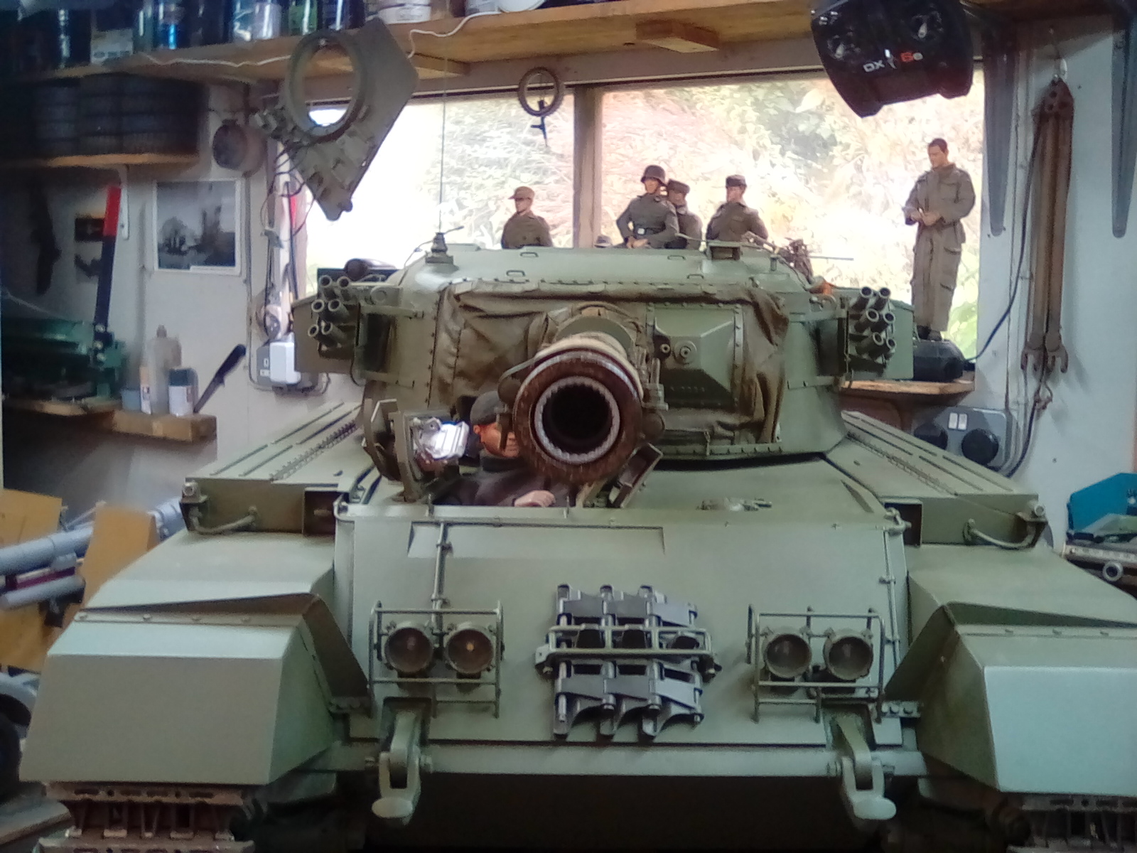

In fact this week I was wondering if you were going to do a rifling insert to that barrel.
Posts: 4268
Has liked: 2259 times
Been liked: 7147 times
Re: Mr Dawe's Centurion.
I had left it for quite some time I know Vince but it's done now thanks to you, you are another craftsman that helps us all out with your unique talent , particularly me!
I now have the very difficult task of making the remaining meteors engine parts along with the myriad of engine bay fittings, most will have to be milled and turned by hand.
Phil Dawe

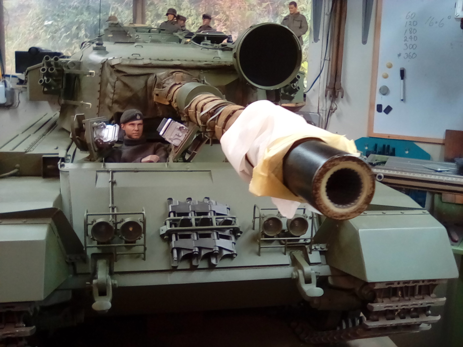

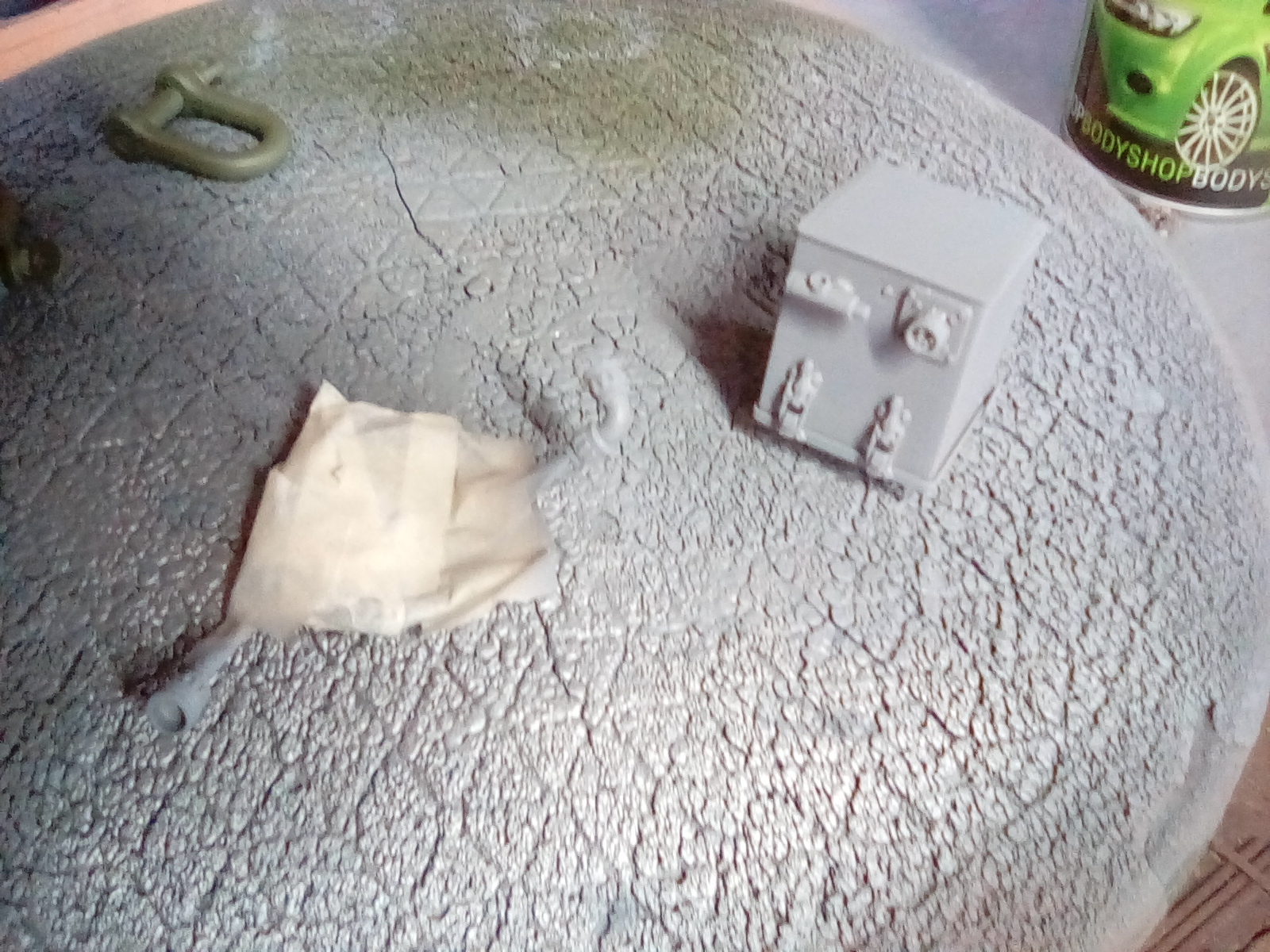

Rifeling insert bonded in, just need to blend with milliput

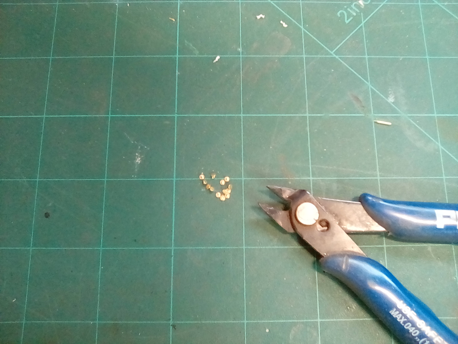

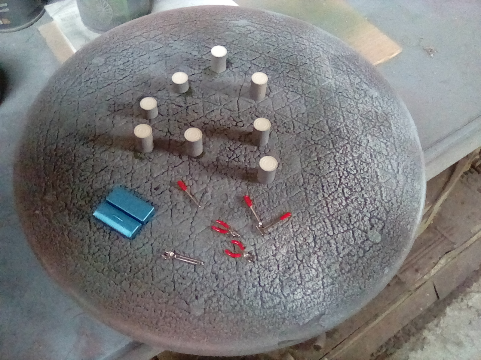

Tiny fixings ready to be placed

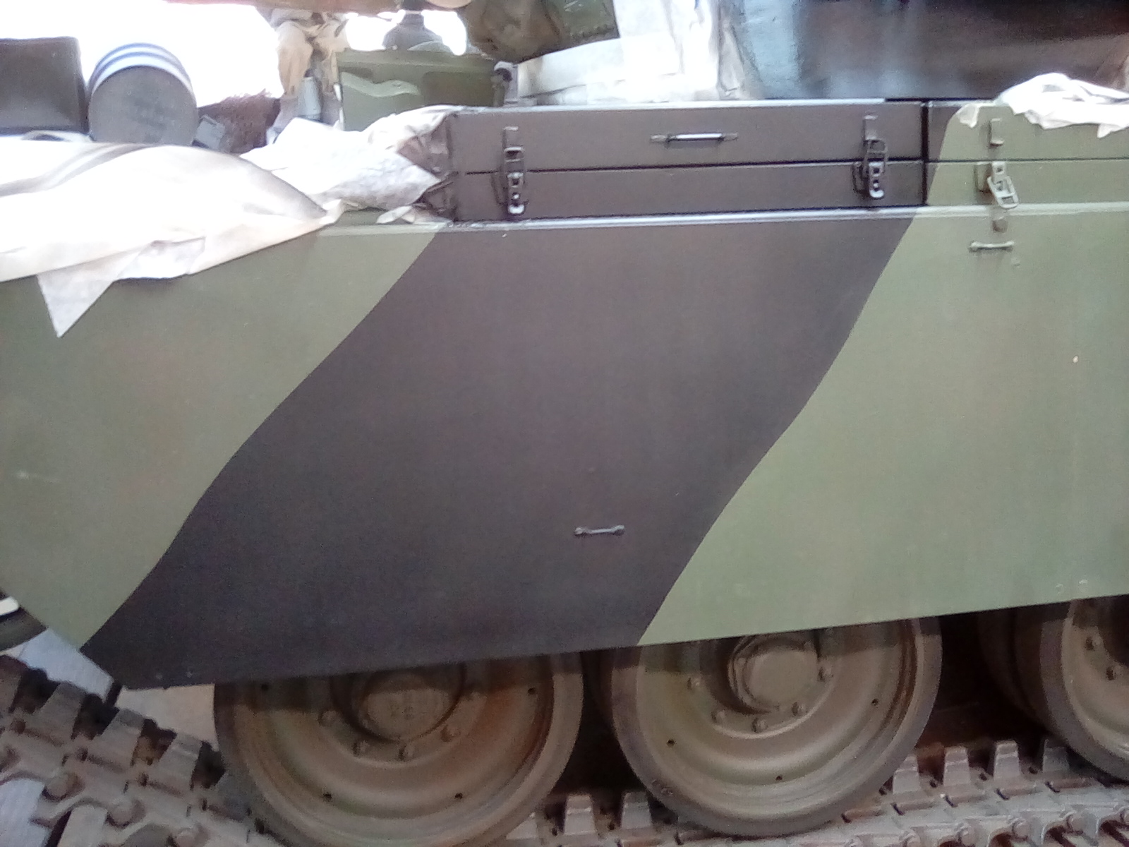

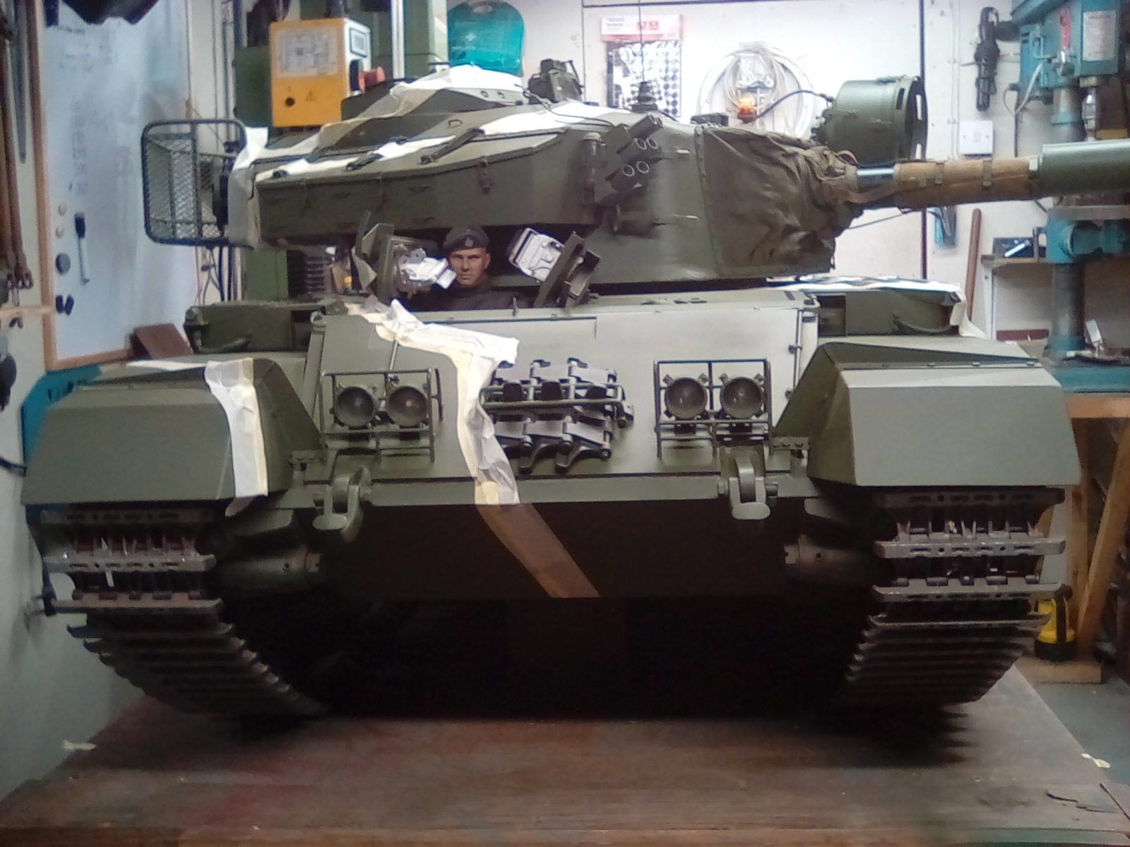

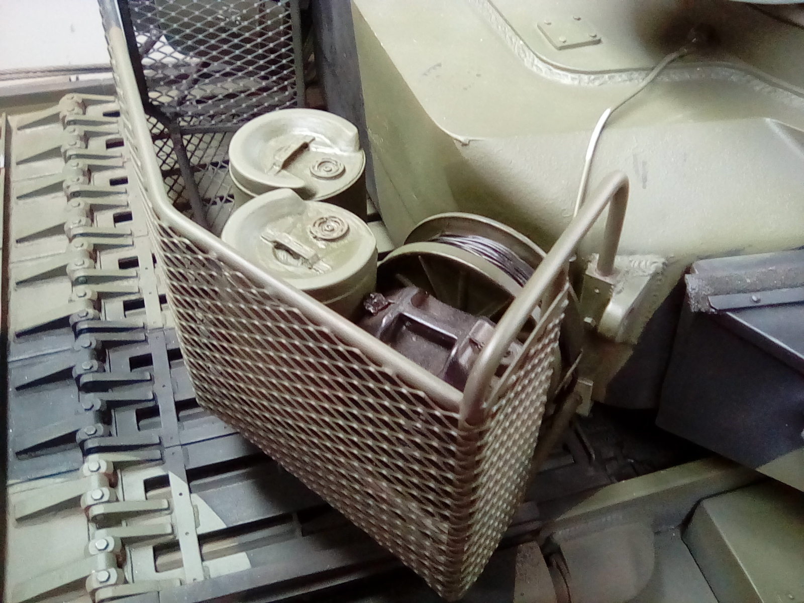

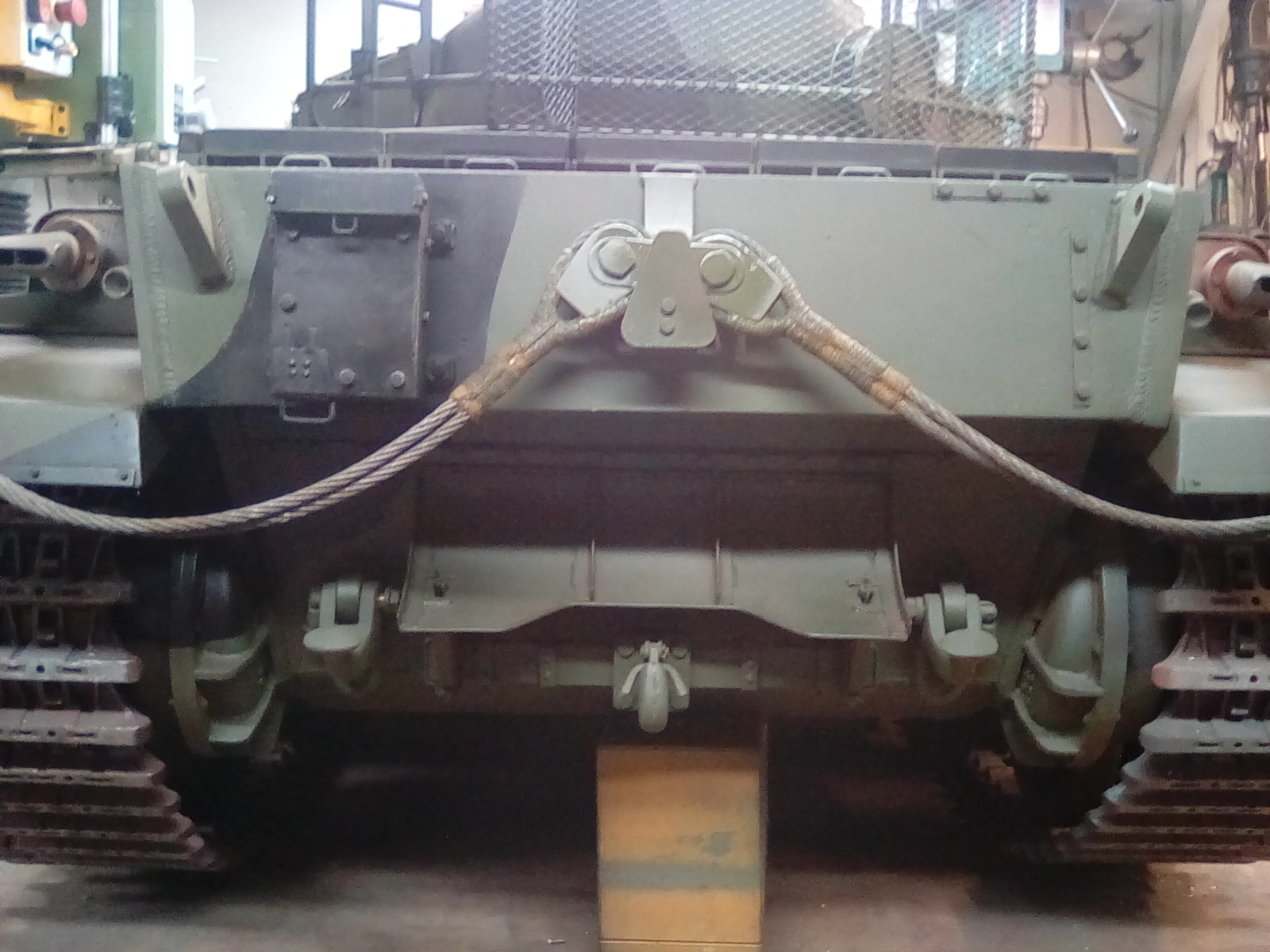

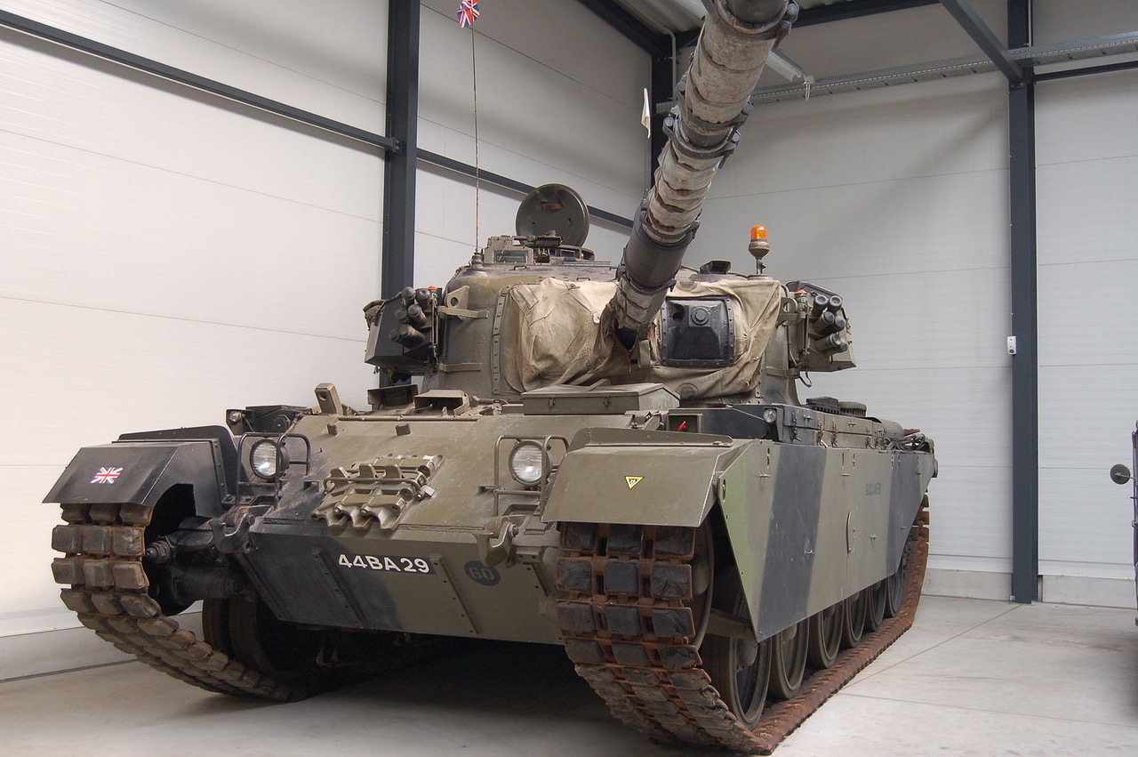

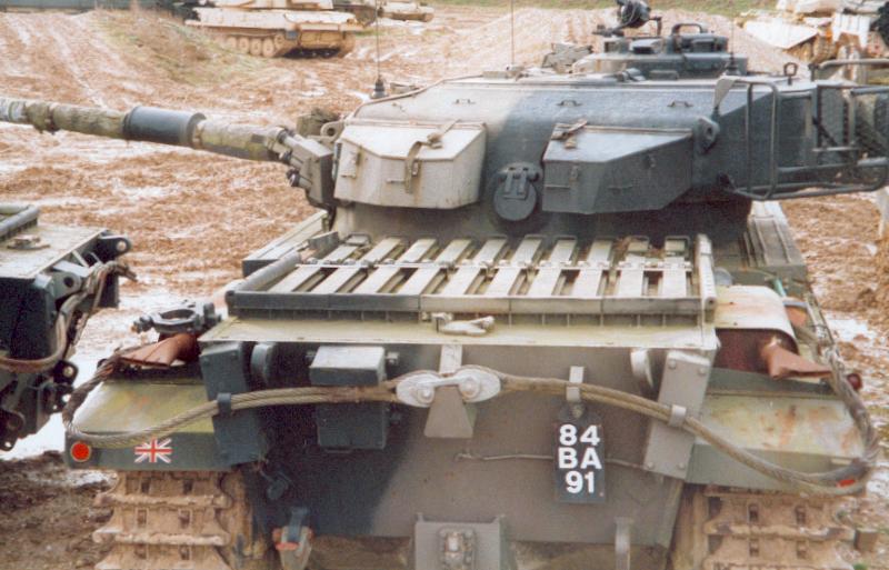

If anyone can help with details of the British Cent camouflage examples particularly a view in plan, ie looking down from above I would be very grateful

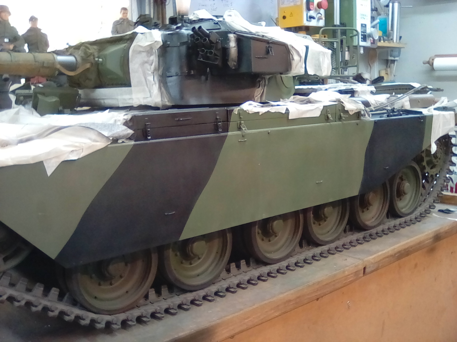

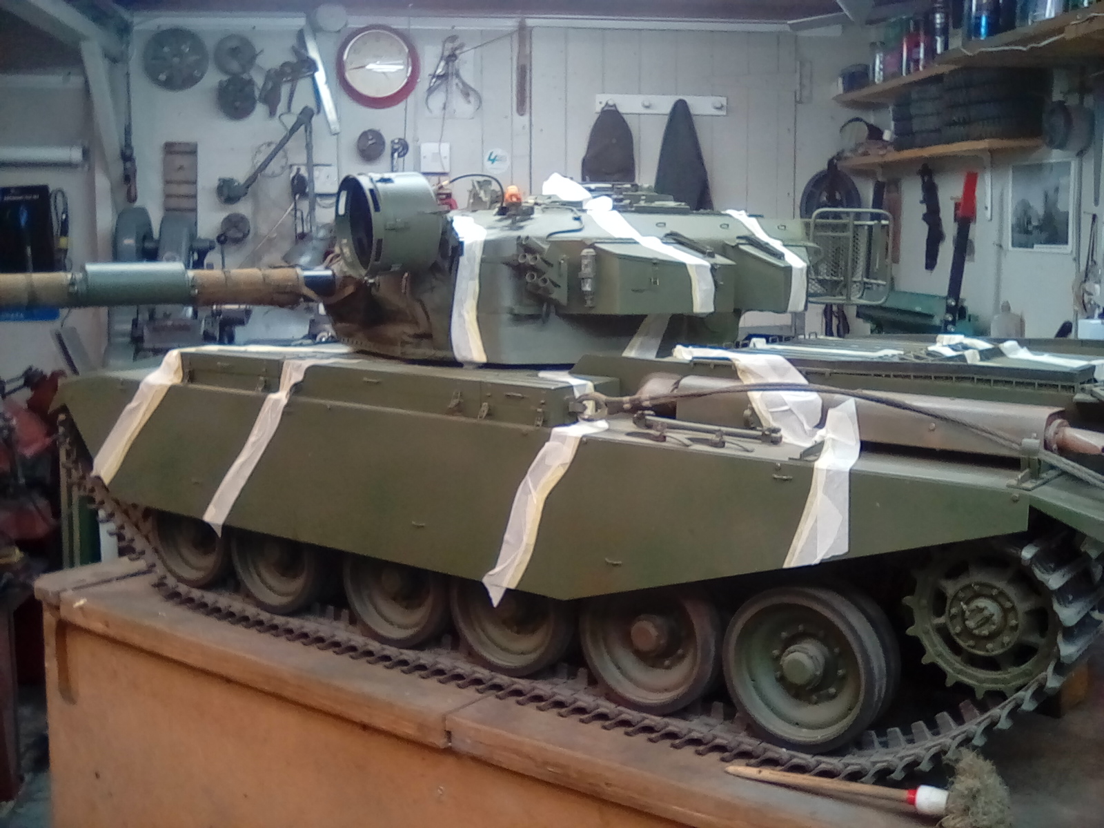

You probably can't see the pencil lines but I am starting to think about the black camo

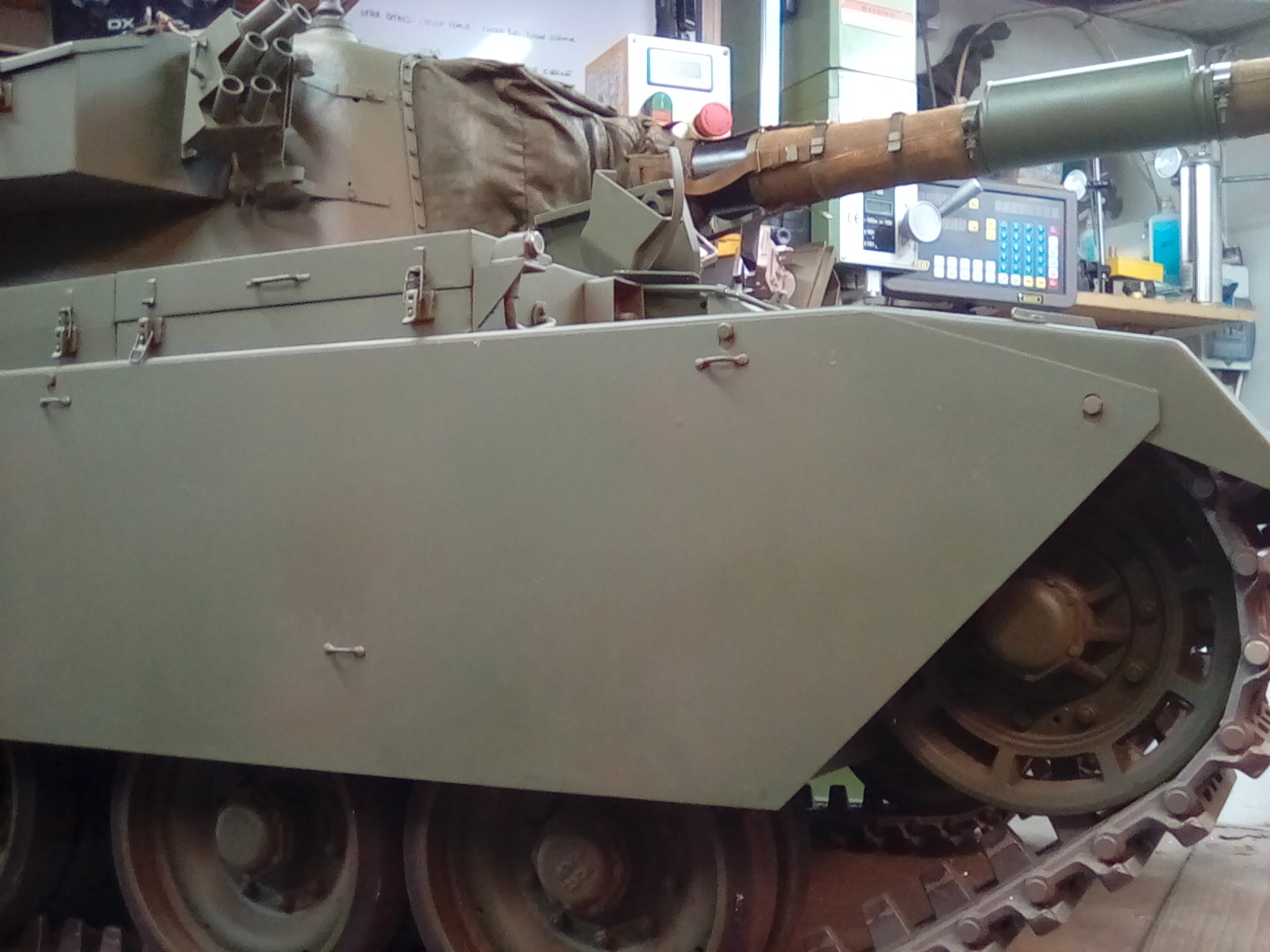

Steve Norris
Posts: 1225
Location: Manchester
Has liked: 8 times
Been liked: 688 times
Post by Steve Norris »

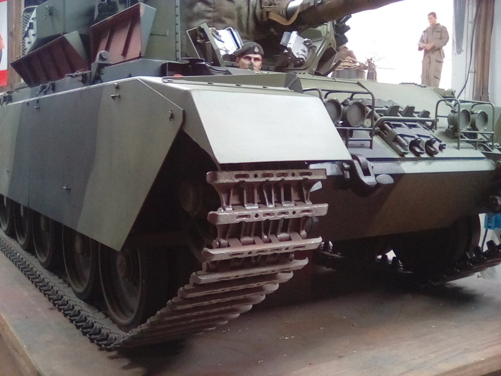

Hi Phil.
Great build of the Cent you’re doing, the best build I have seen.
As for the camo, I guess 1/3 black, 2/3 green any patter you like (within reason).
The photo shows what I think is a Danish Cent but the pattern of the camo would be very similar.
I know that’s not a great help but I am sure you will ace it.

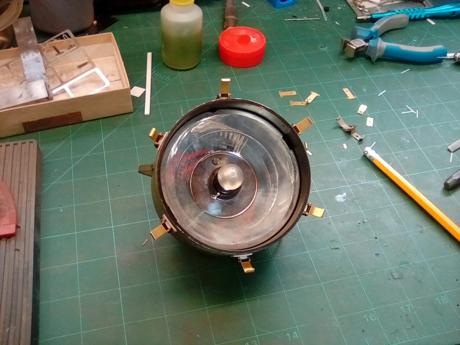

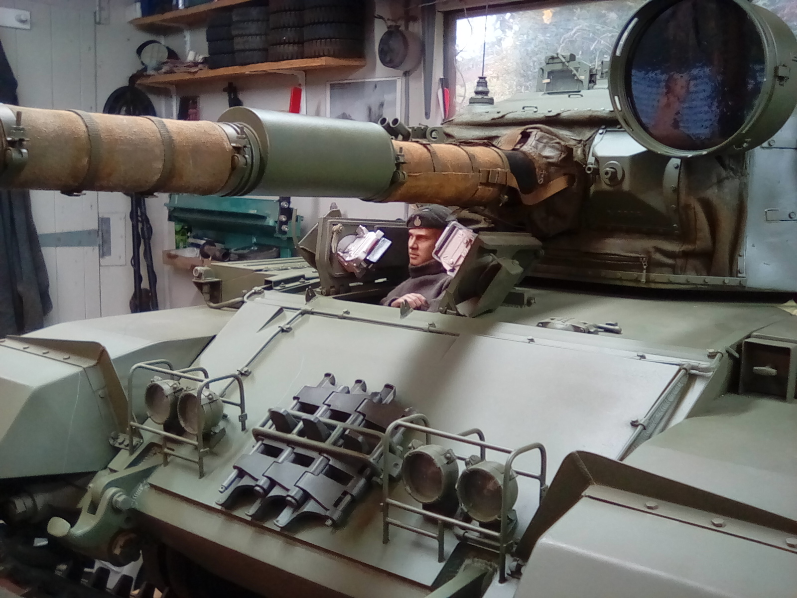

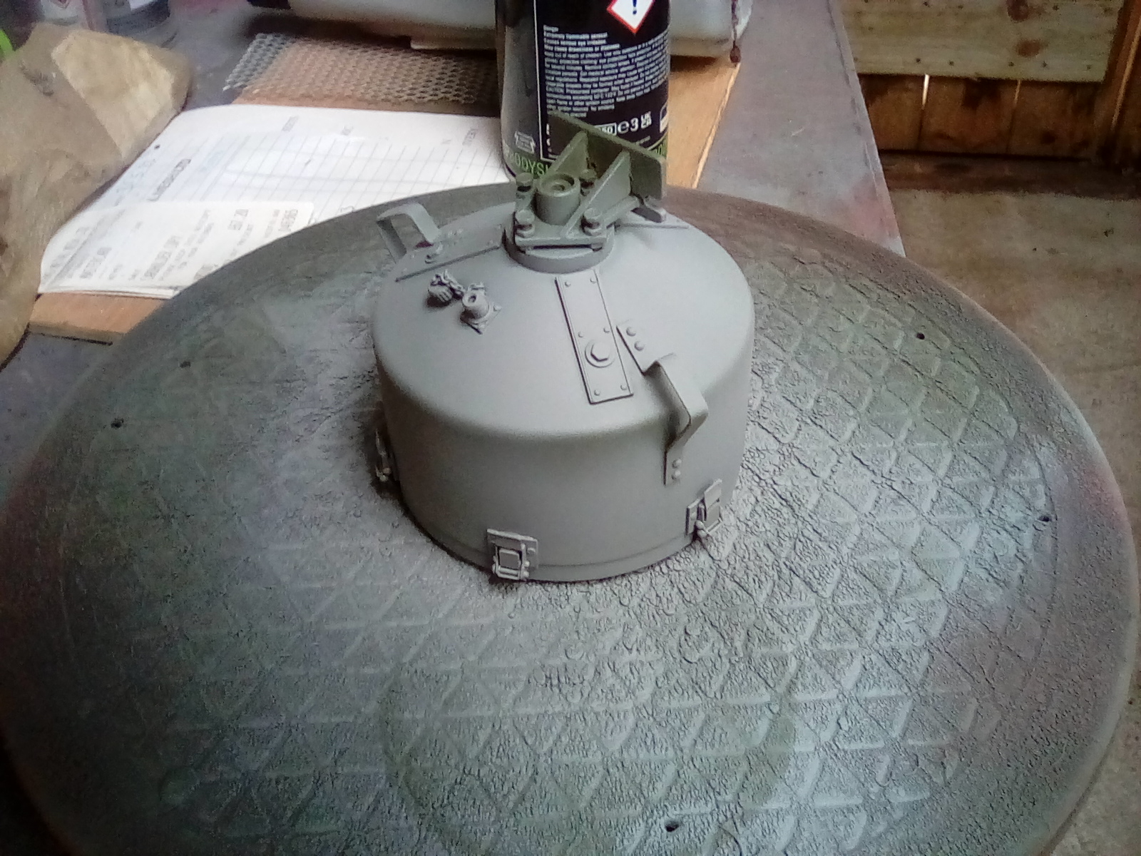

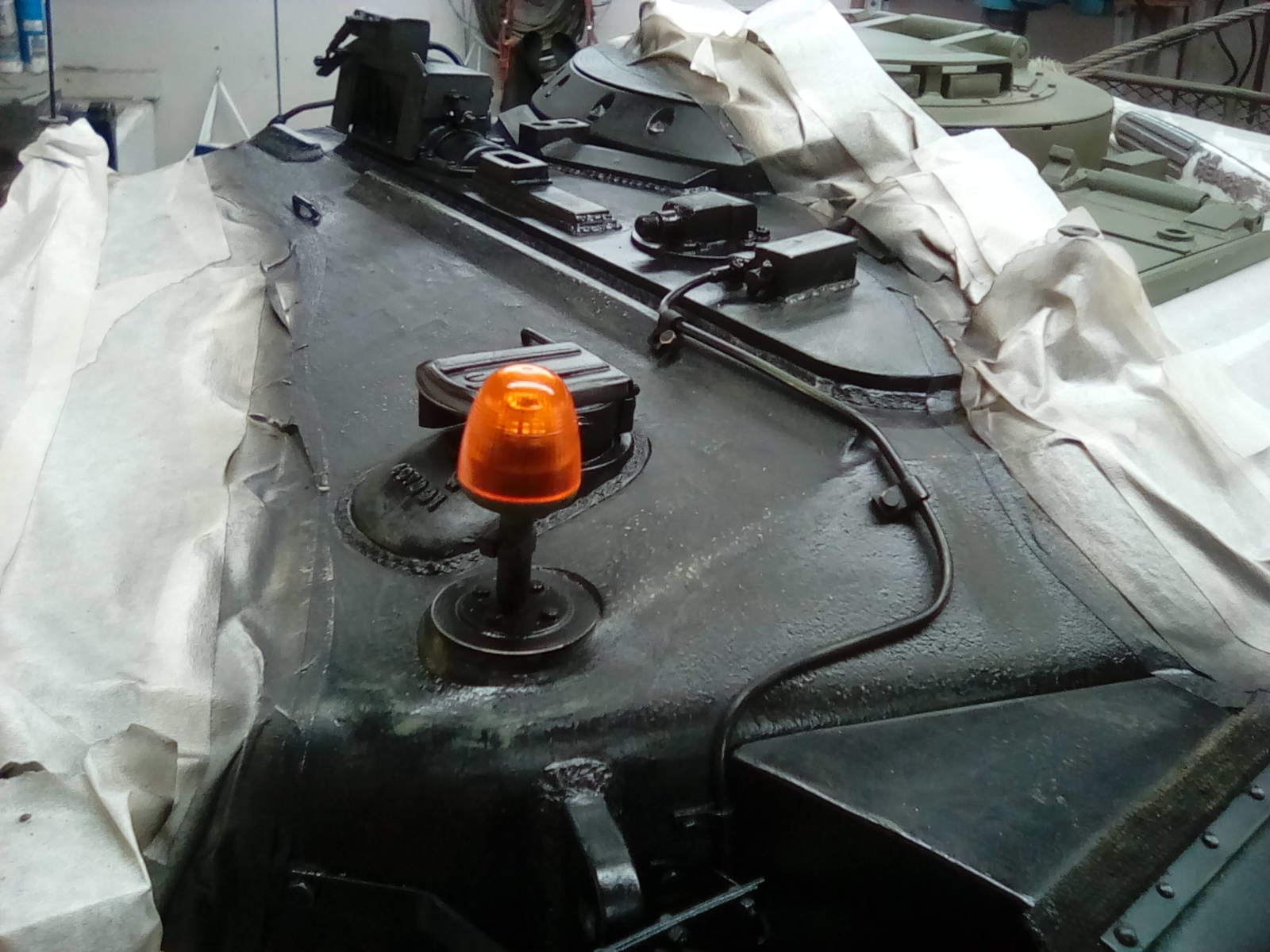

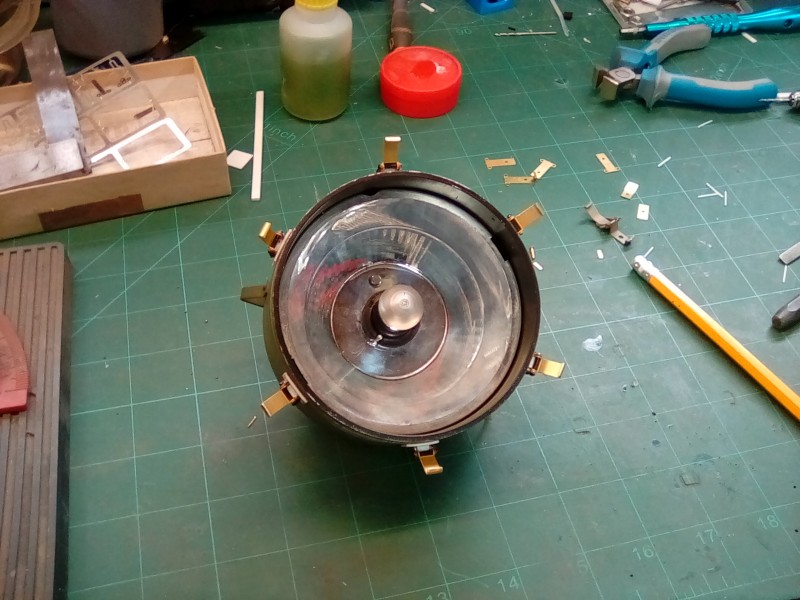

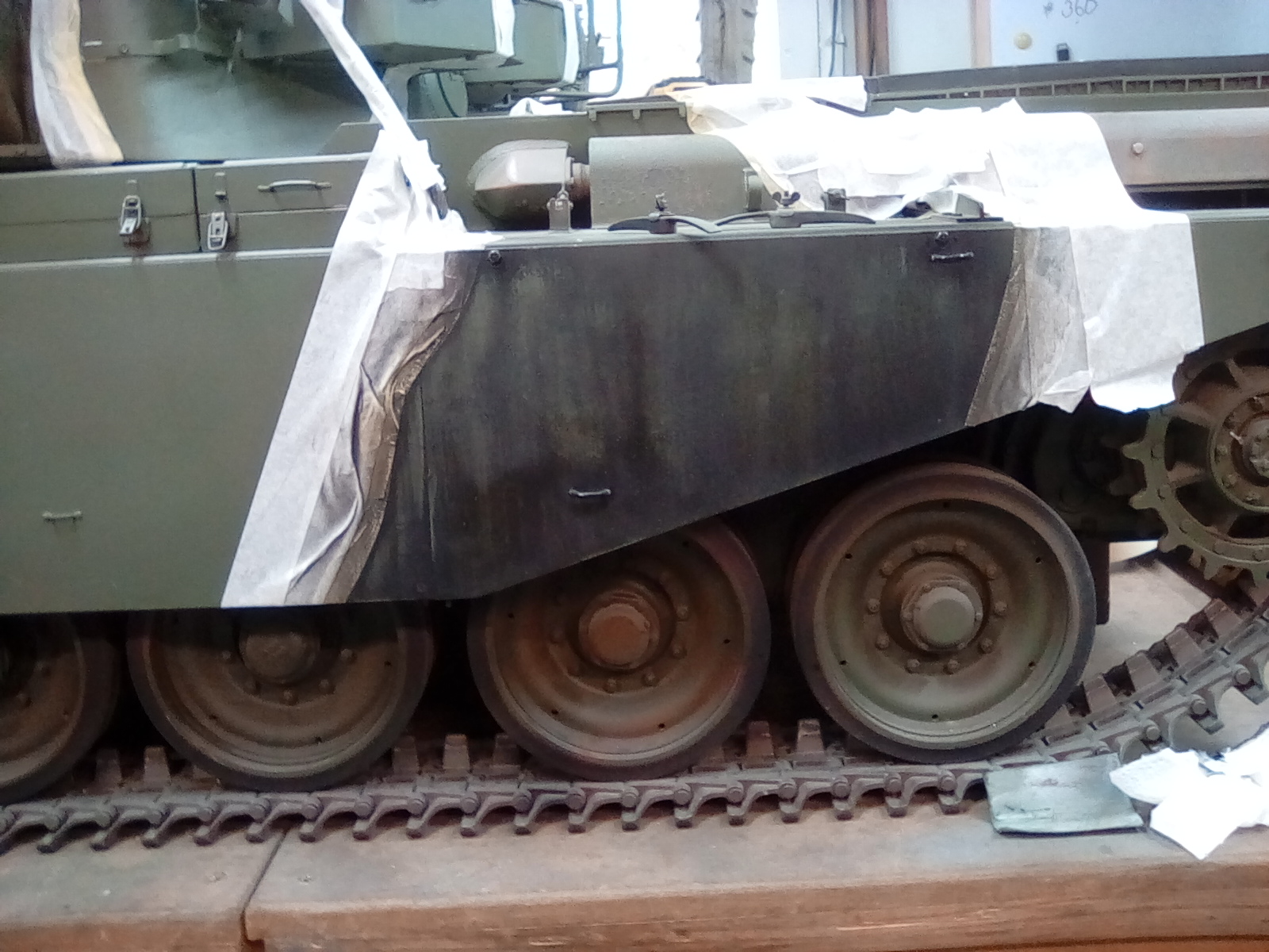

Thanks for the positive input Steve. Moving on and getting closer to the black part of the BAOR colour scheme, so I've just ordered the Tamiya NATO black xf 69, I hope 10 pots will be enough.

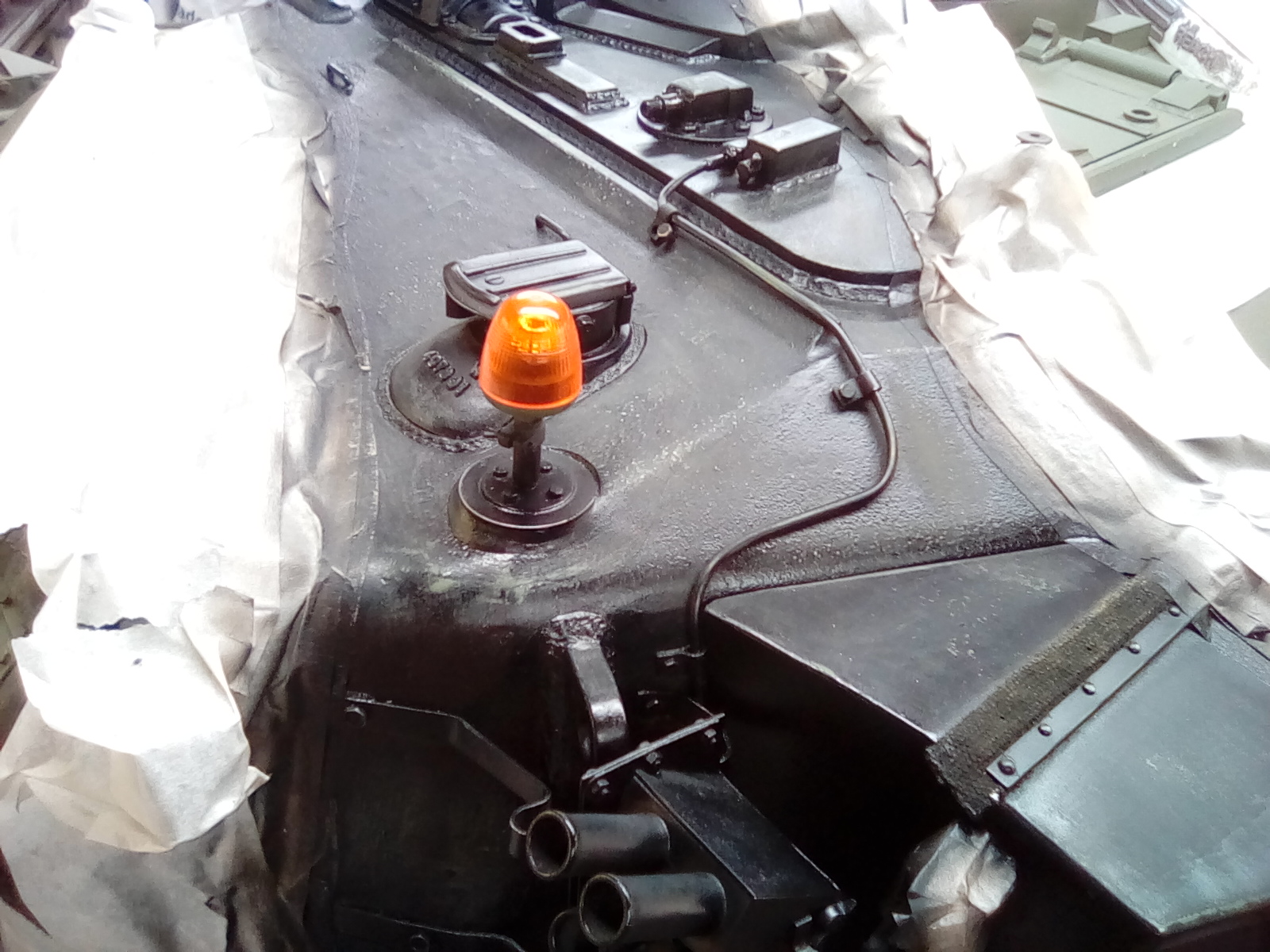

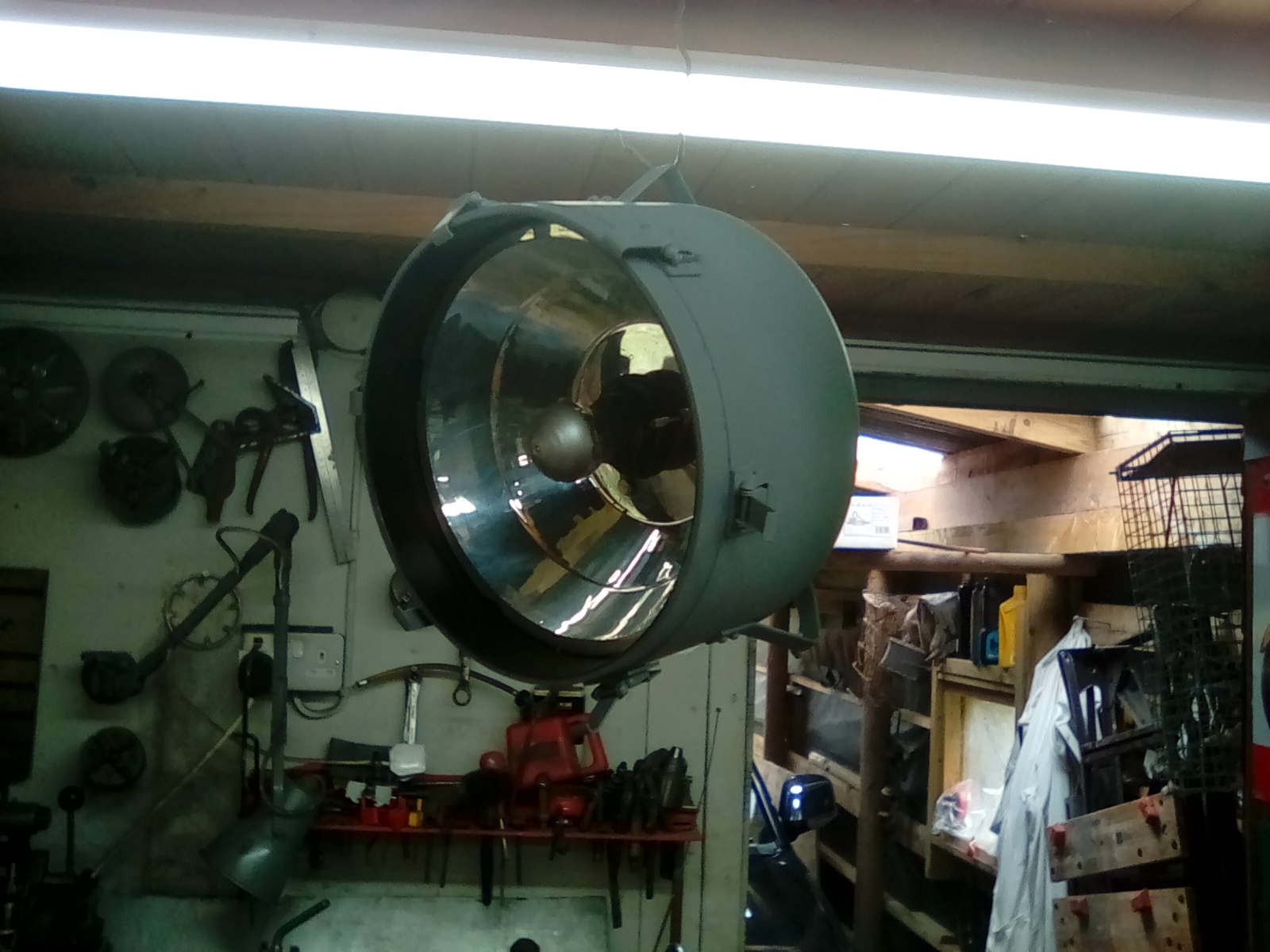

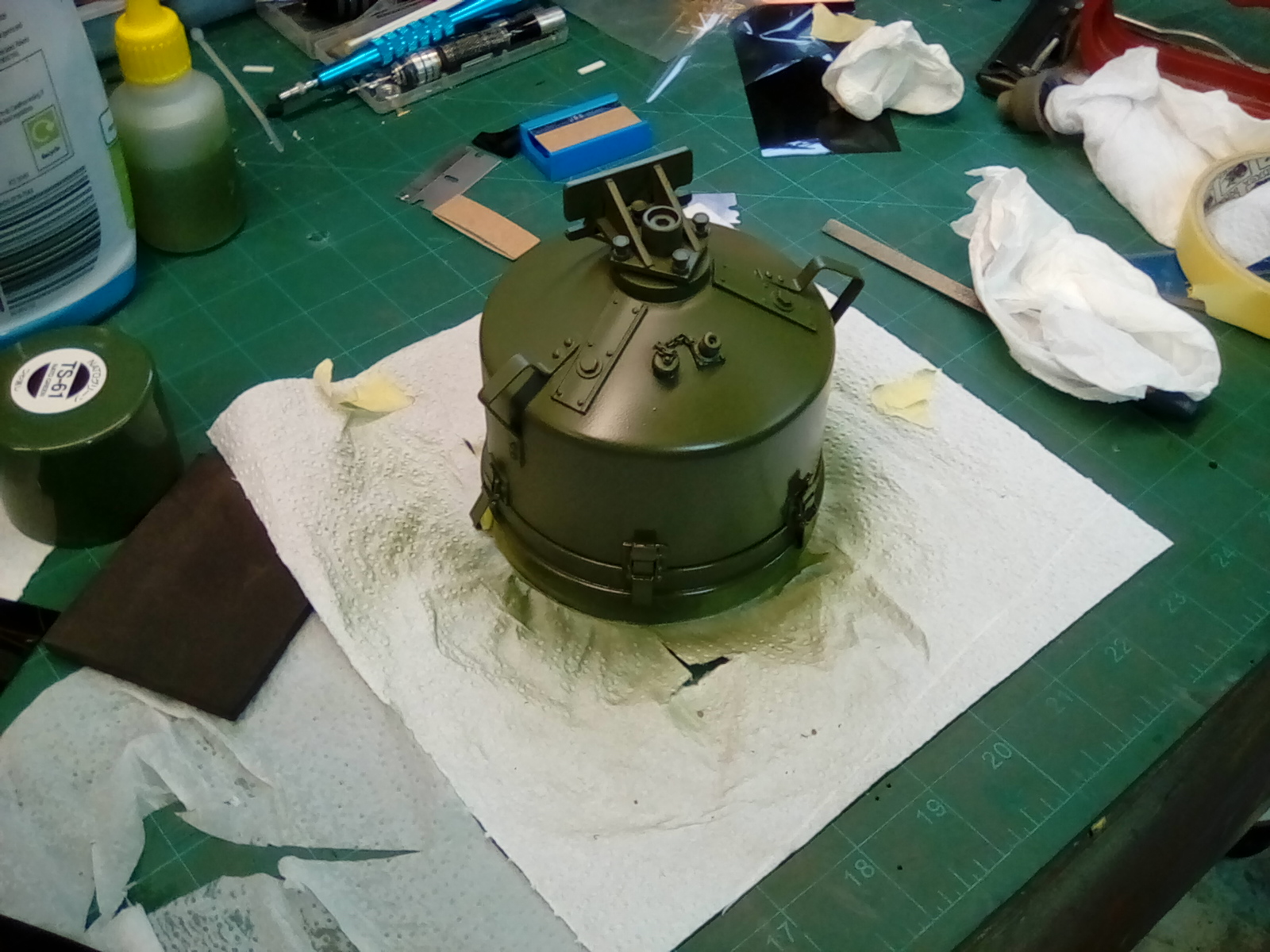

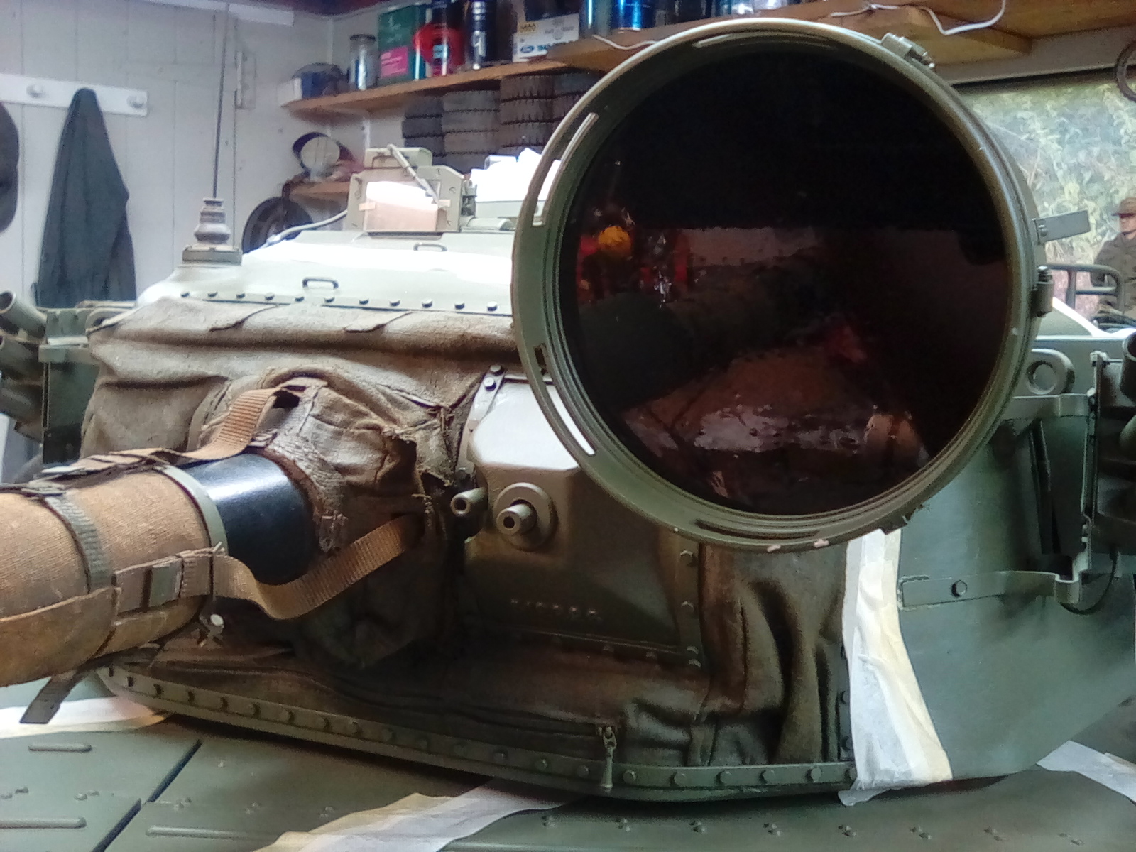

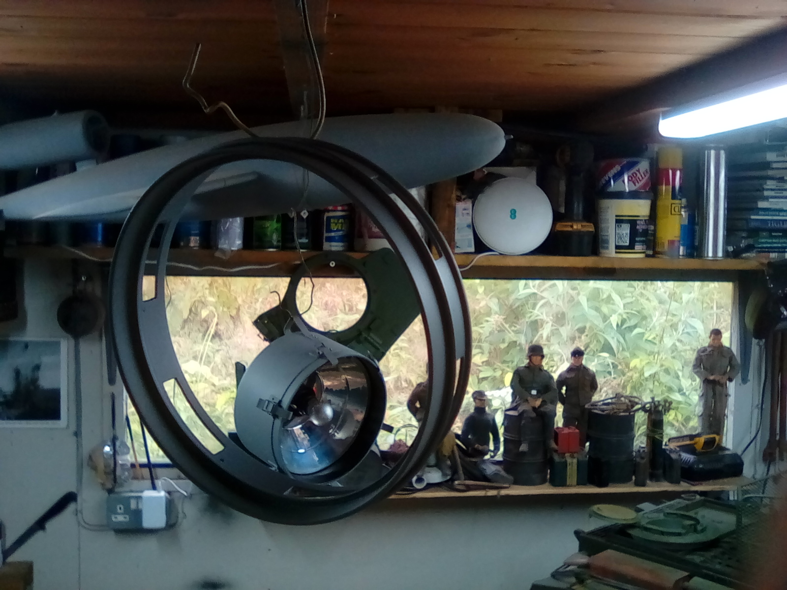

Yet more paint on the searchlight

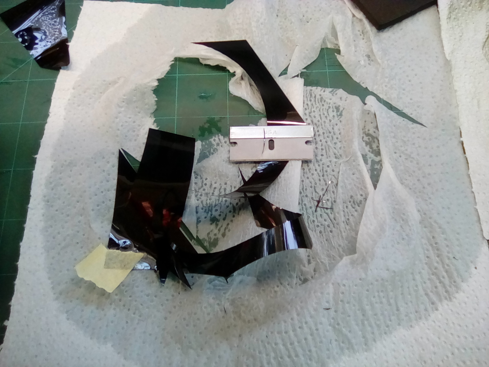

The IR tint is tricky to apply
Rifeling blended in
Rifeling blended in

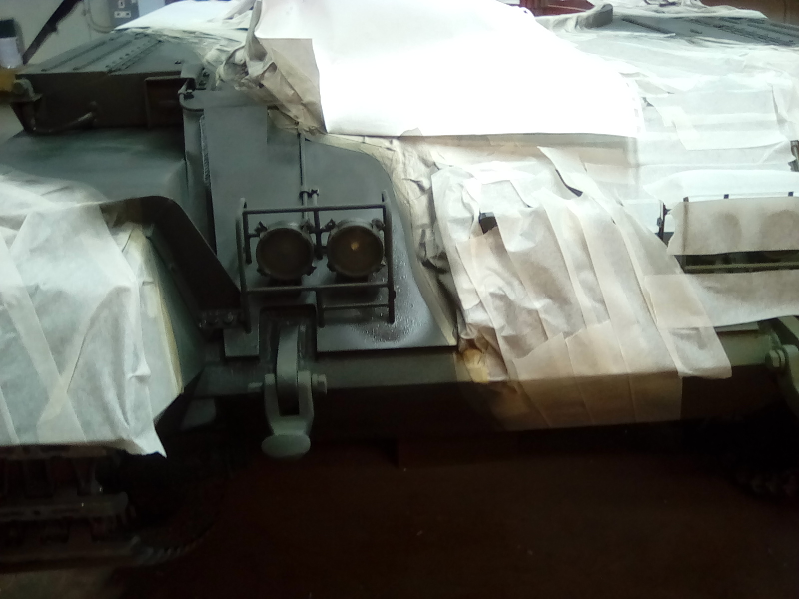

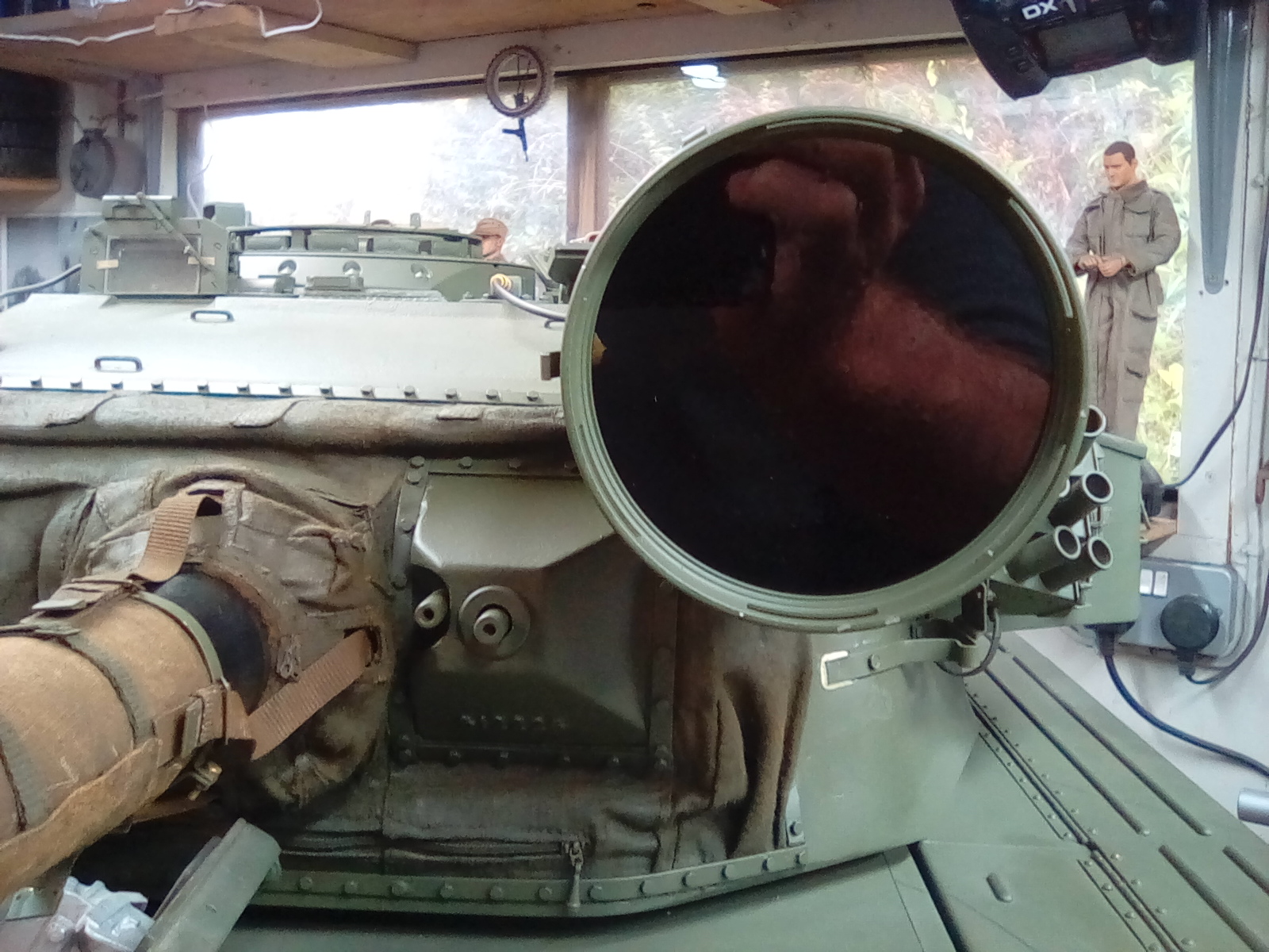

The IR filter
The IR filter

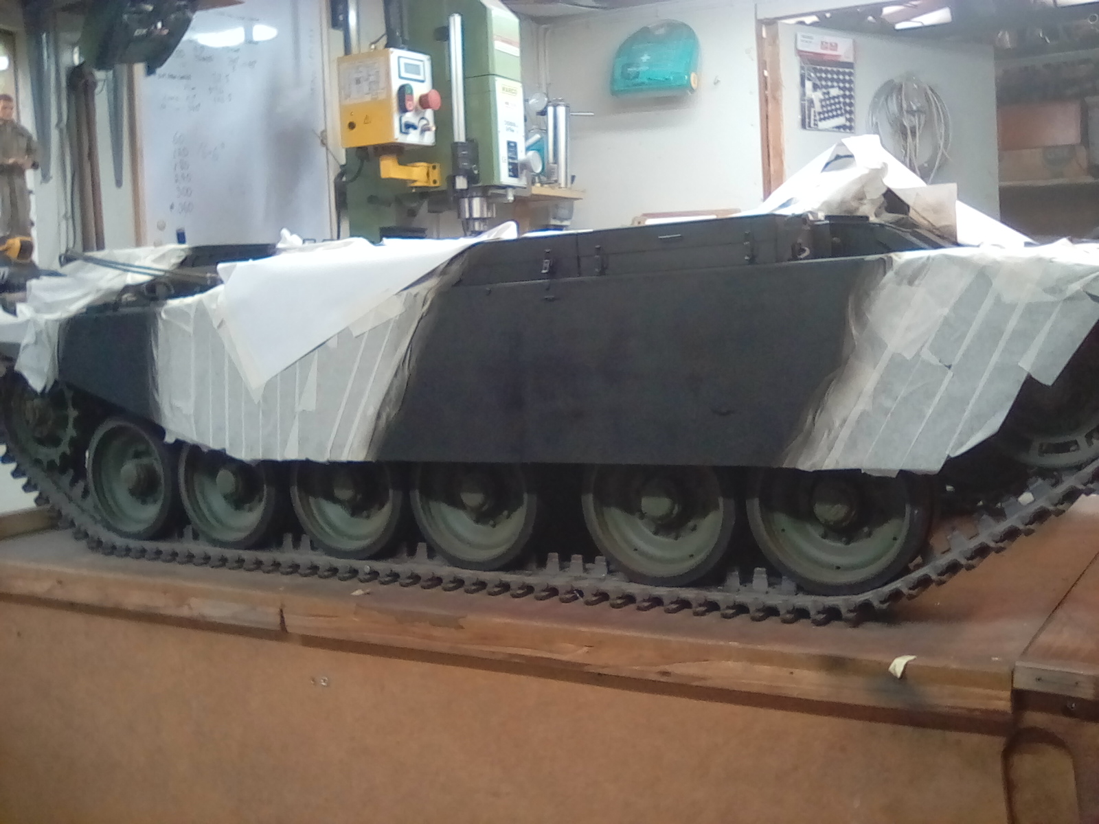

Fine line masking going on
You can still see the bulb and even more when the power is on

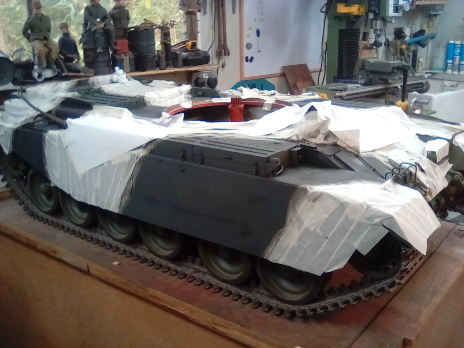

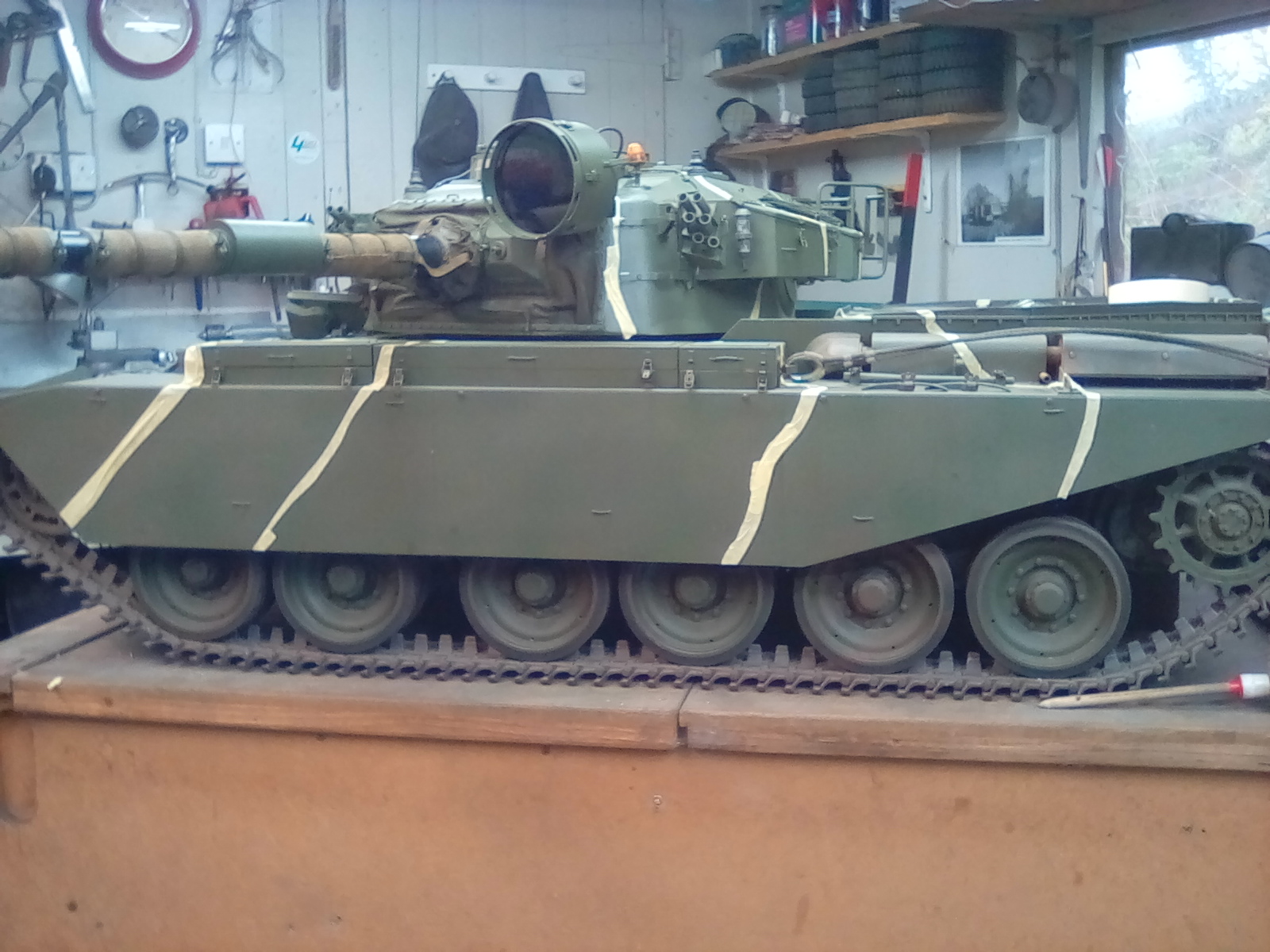

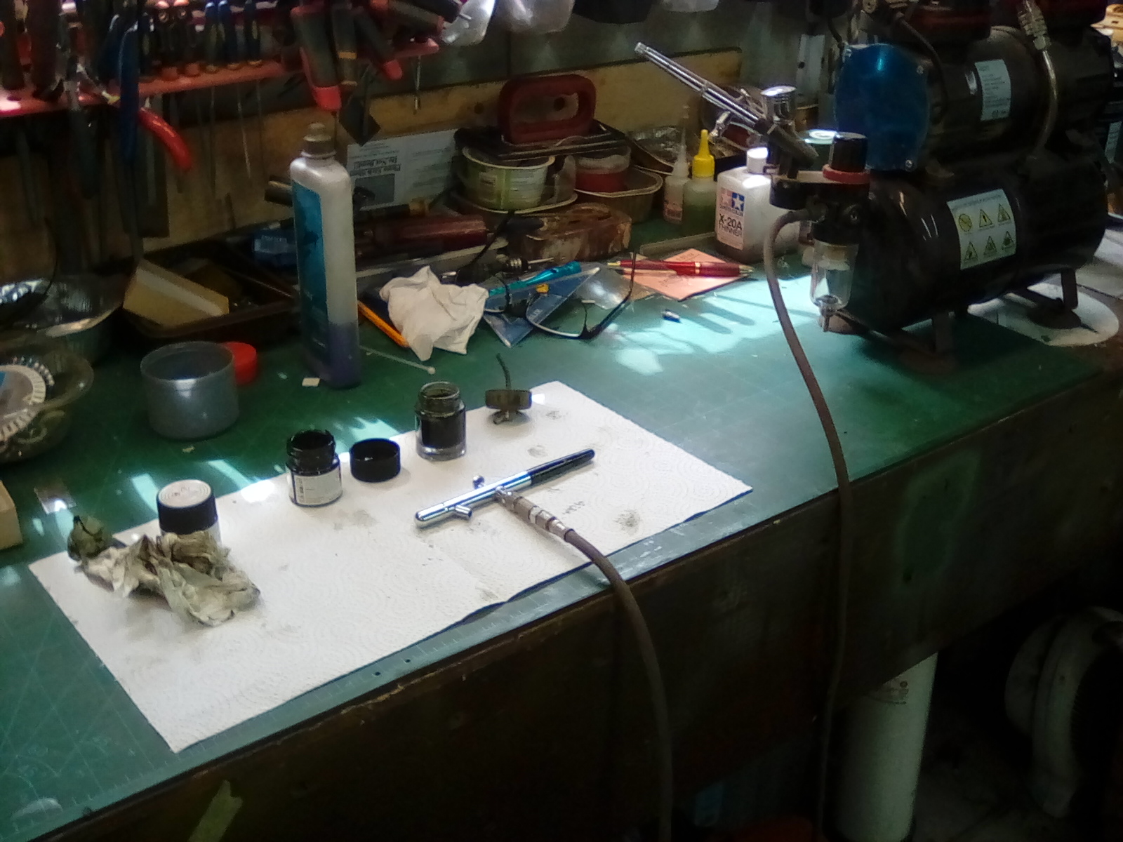

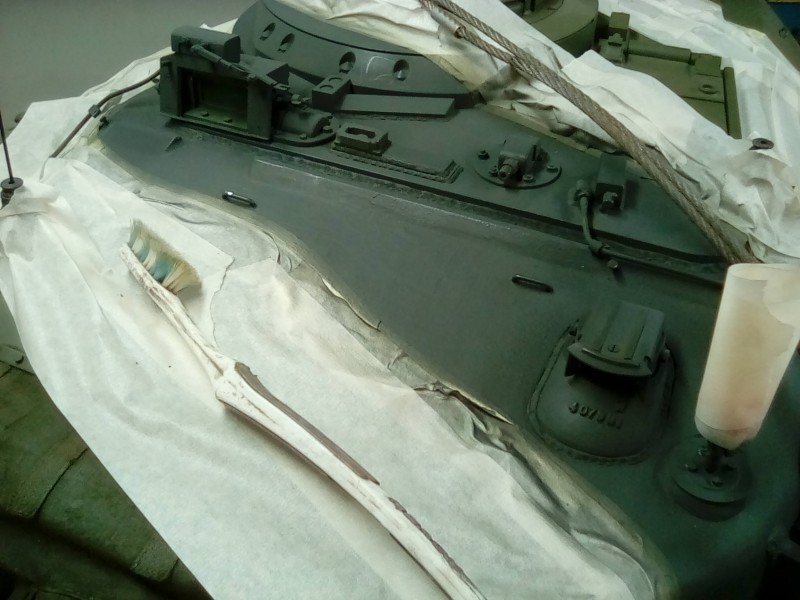

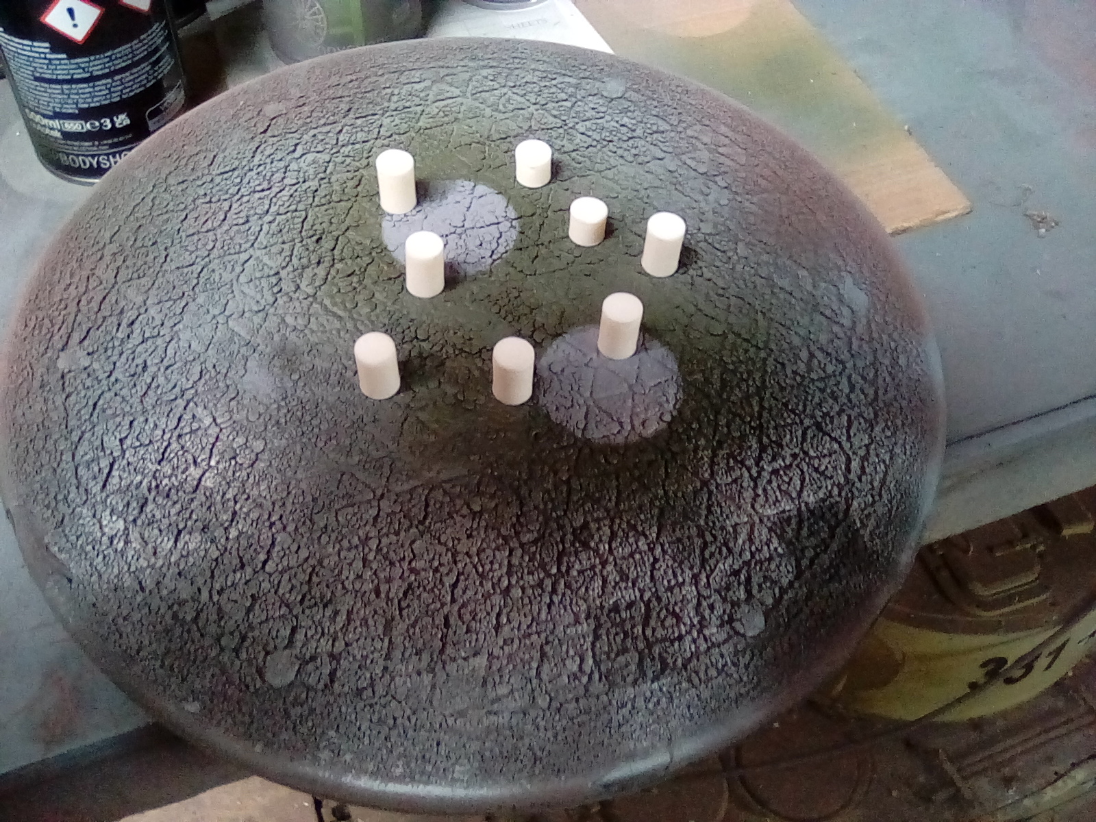

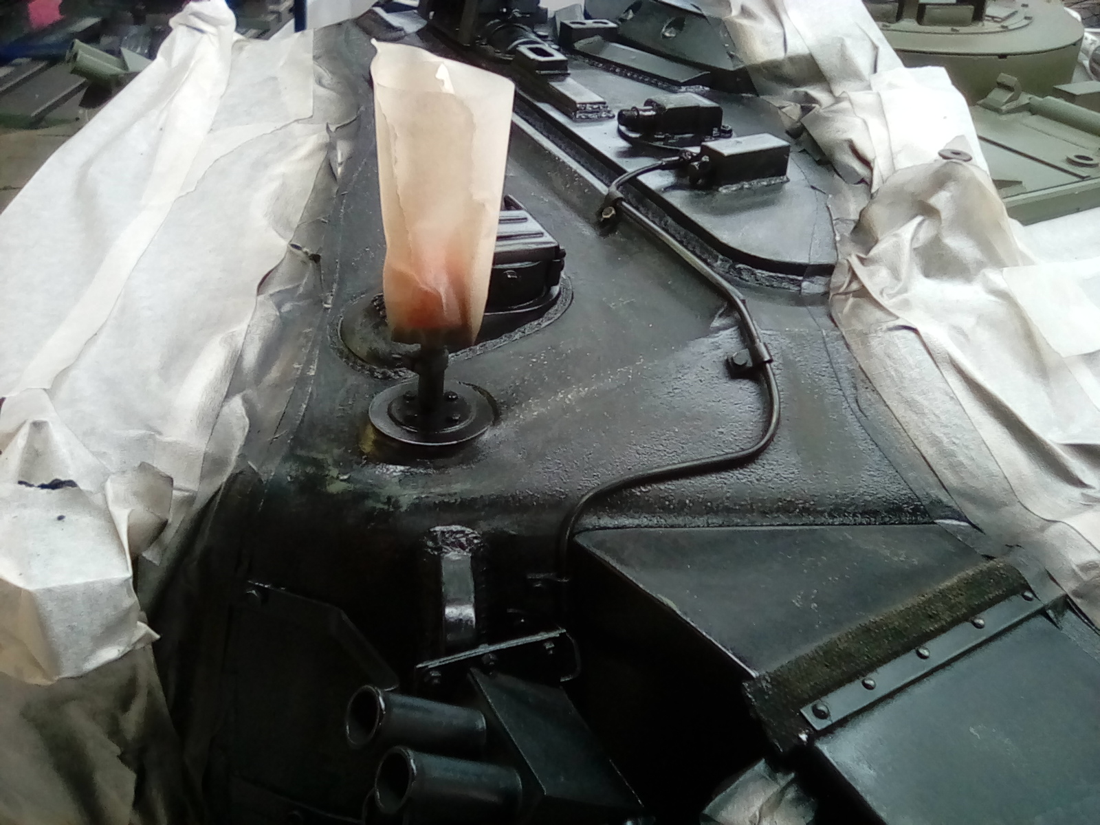

Whilst waiting for the fresh paint to arrive I have made a start with old paint , the subtle weathering pre stage of "what's underneath" has begun.
I had left the airbrush uncleaned and still full of paint for at least 6 months but some thinners and a strip down and it's working better than ever!

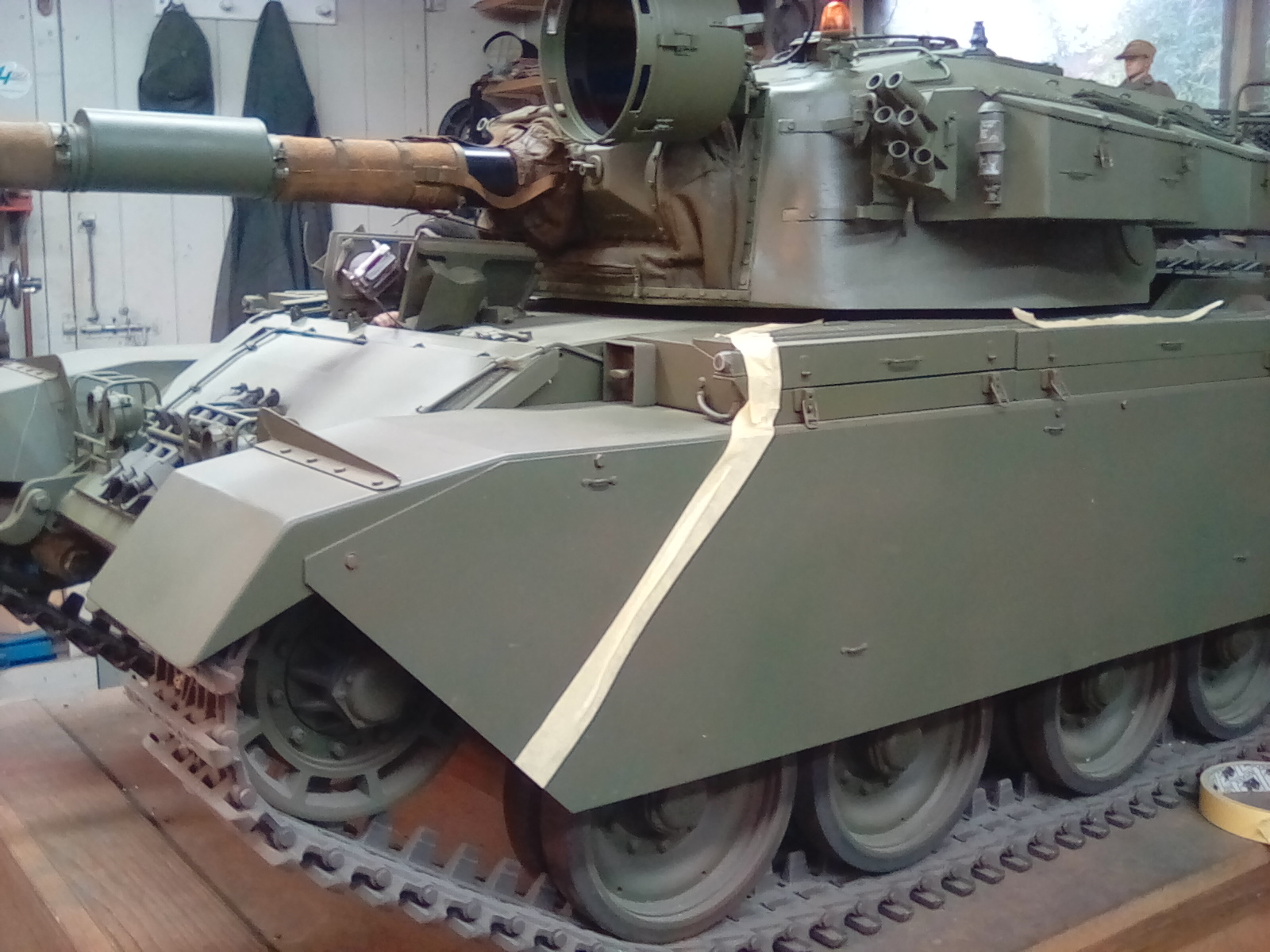

Flattening off
Flattening off
First stage undercoat
The NATO black looks blue grey in this photo
Second stage
Second stage
I like the NATO black, amongst other things it can be burnished
My exhaust shield weathering is still there under the new black, it just needs exposing

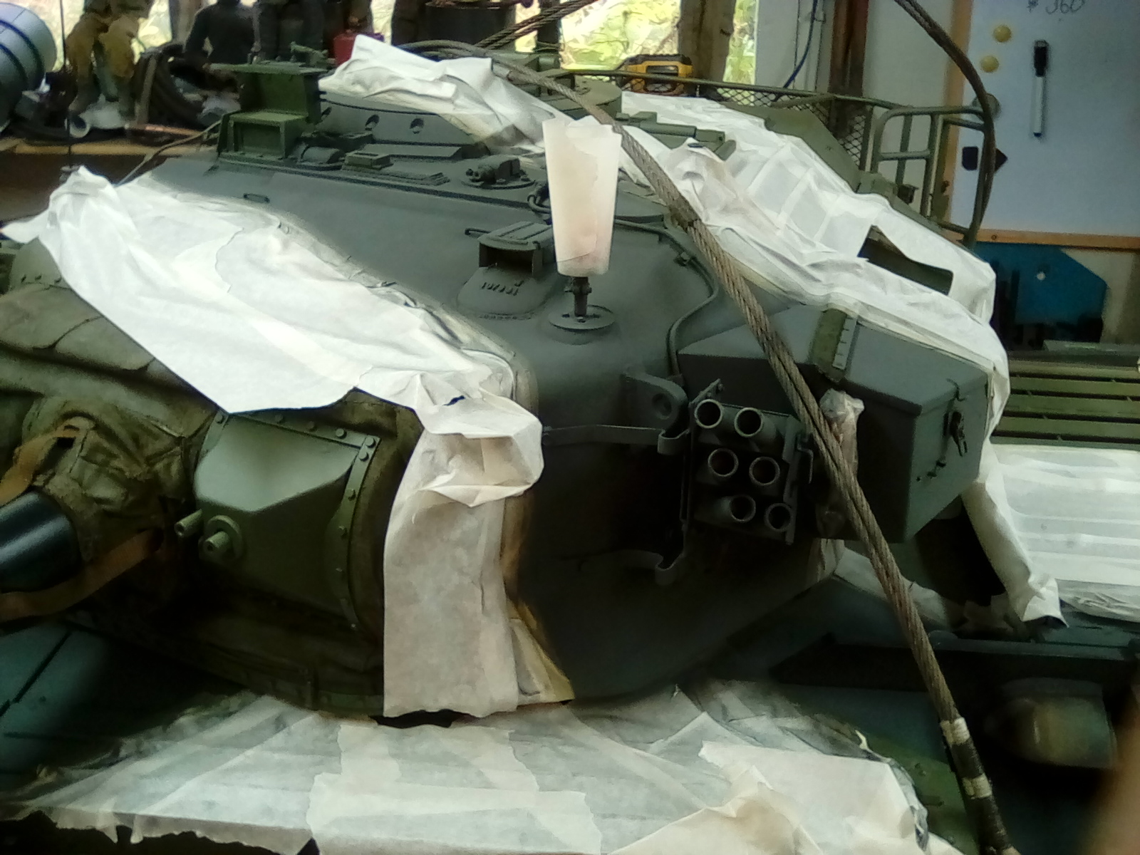

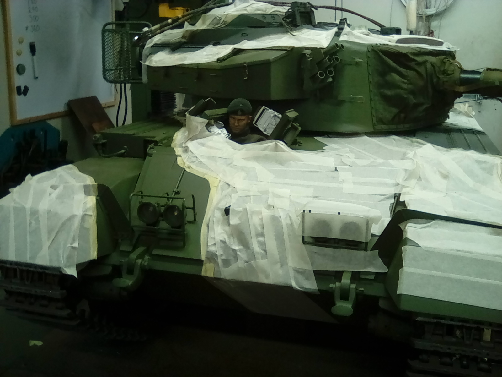

The poor driver is lost under a sea of tape

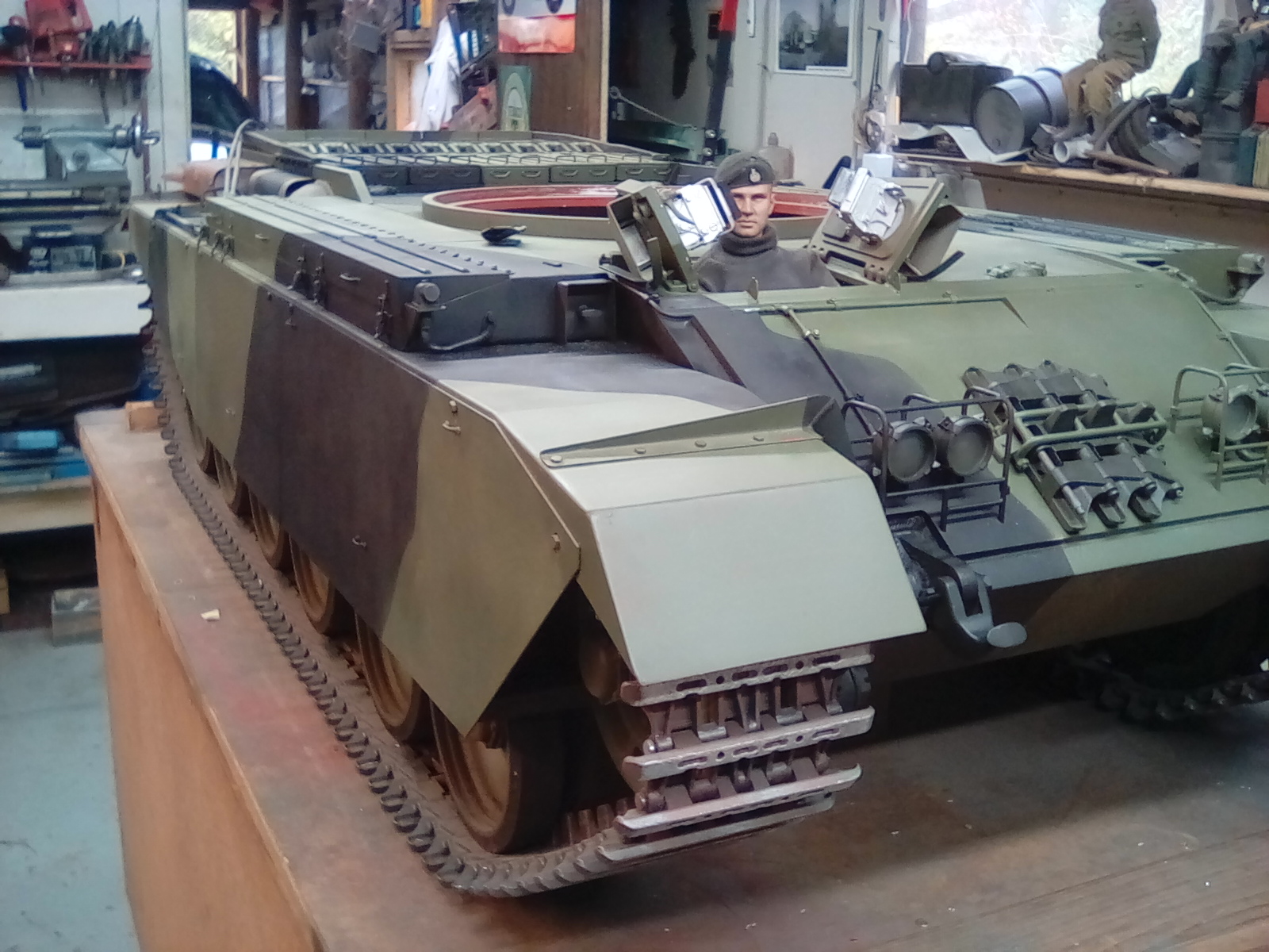

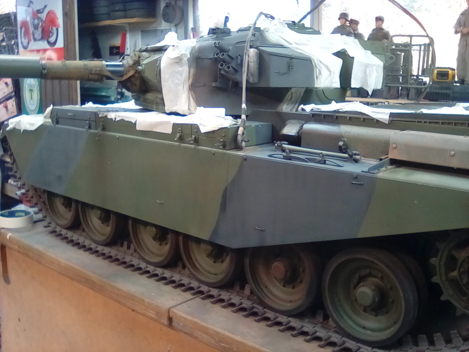

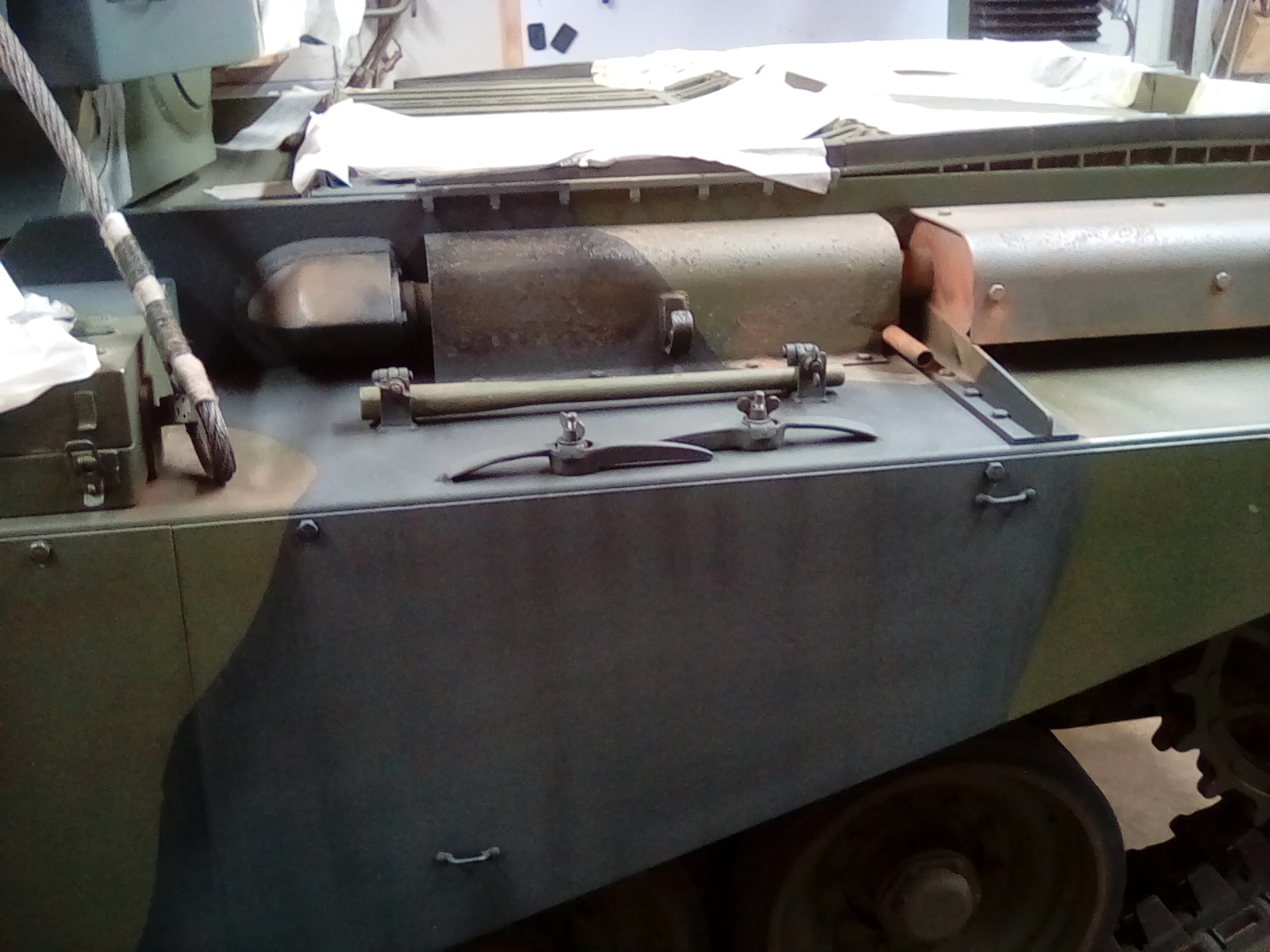

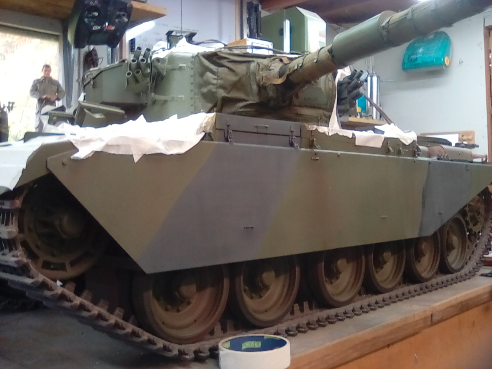

Quick chronological update with the various colours/shades.
Wrong theatre nice shades
God knows
God knows
Looks more Matt black this one
dot 2665.jpg (58.92 KiB) Viewed 2434 times
Quite blue/grey this one
dot 568.jpg (77.52 KiB) Viewed 2434 times
Quite blue this one.

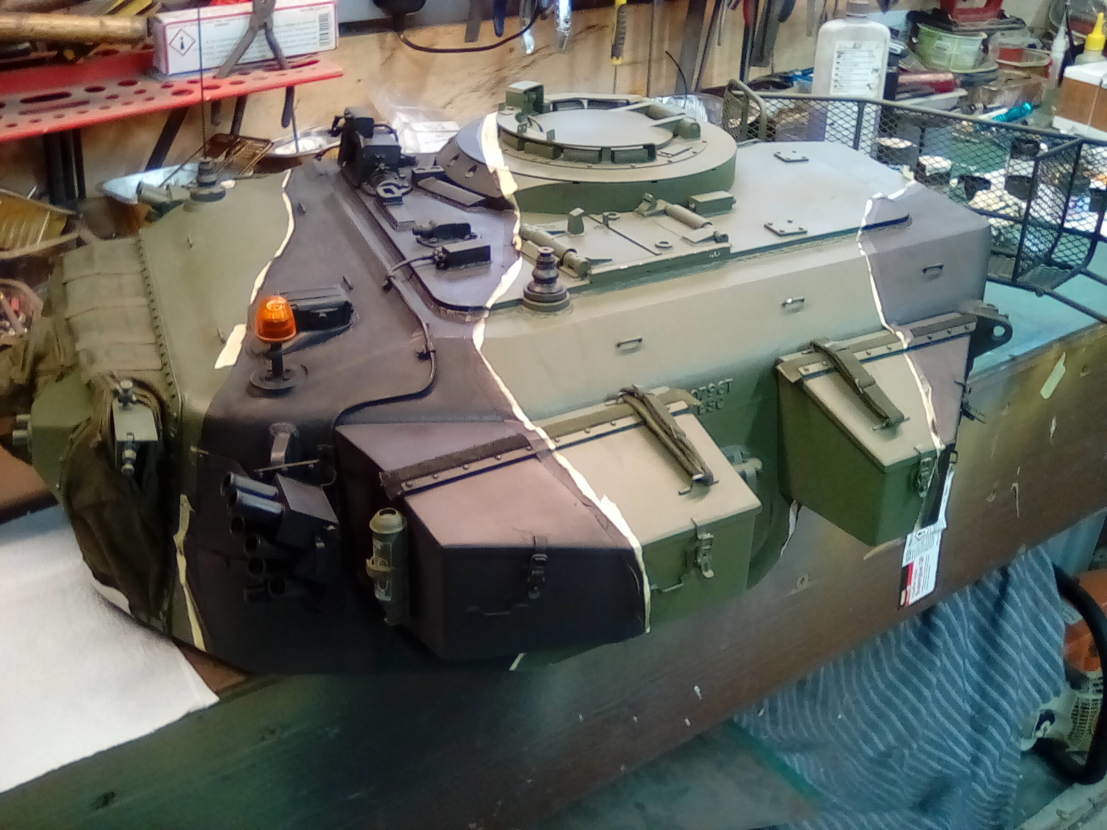

Top coat of a blended black combination and we are nearly there.
The black is nearly there it just needs flattening back untill it looks ok
Some weathering to varying depths
I will stop when I think it looks right
Sometimes you need to add a little more colour

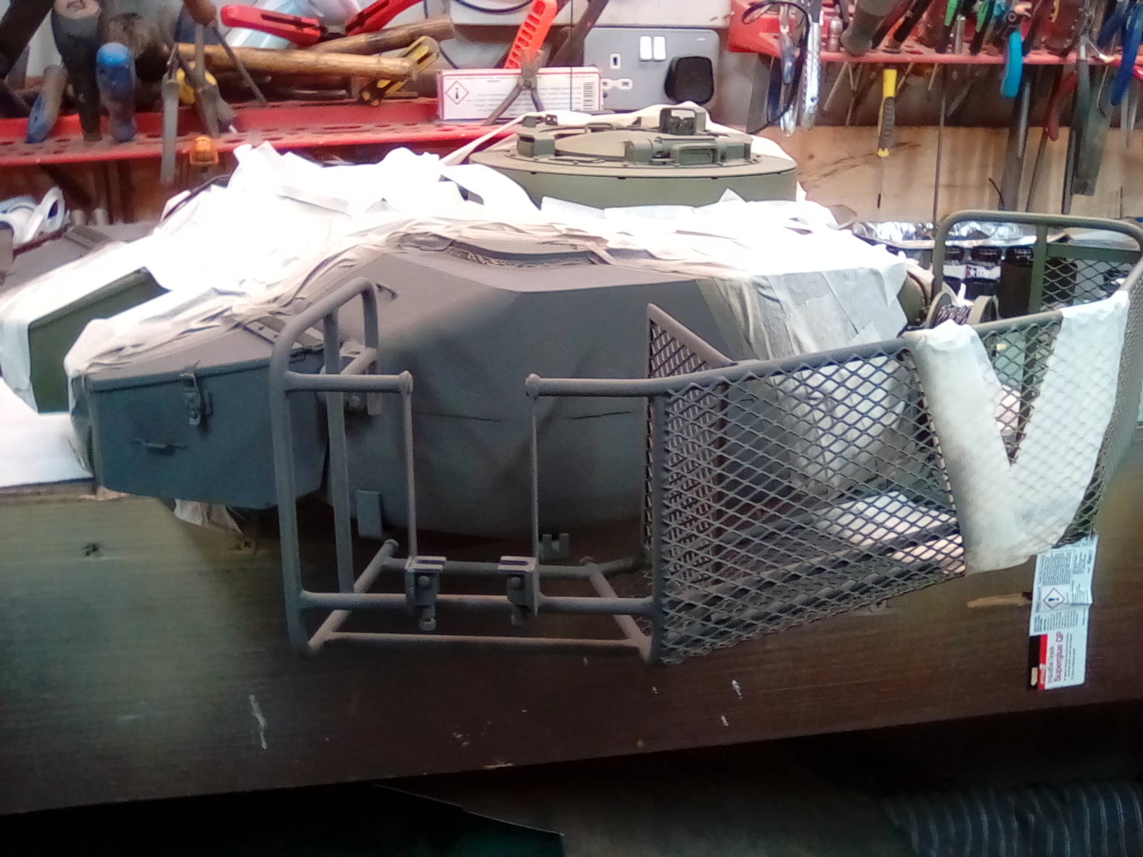

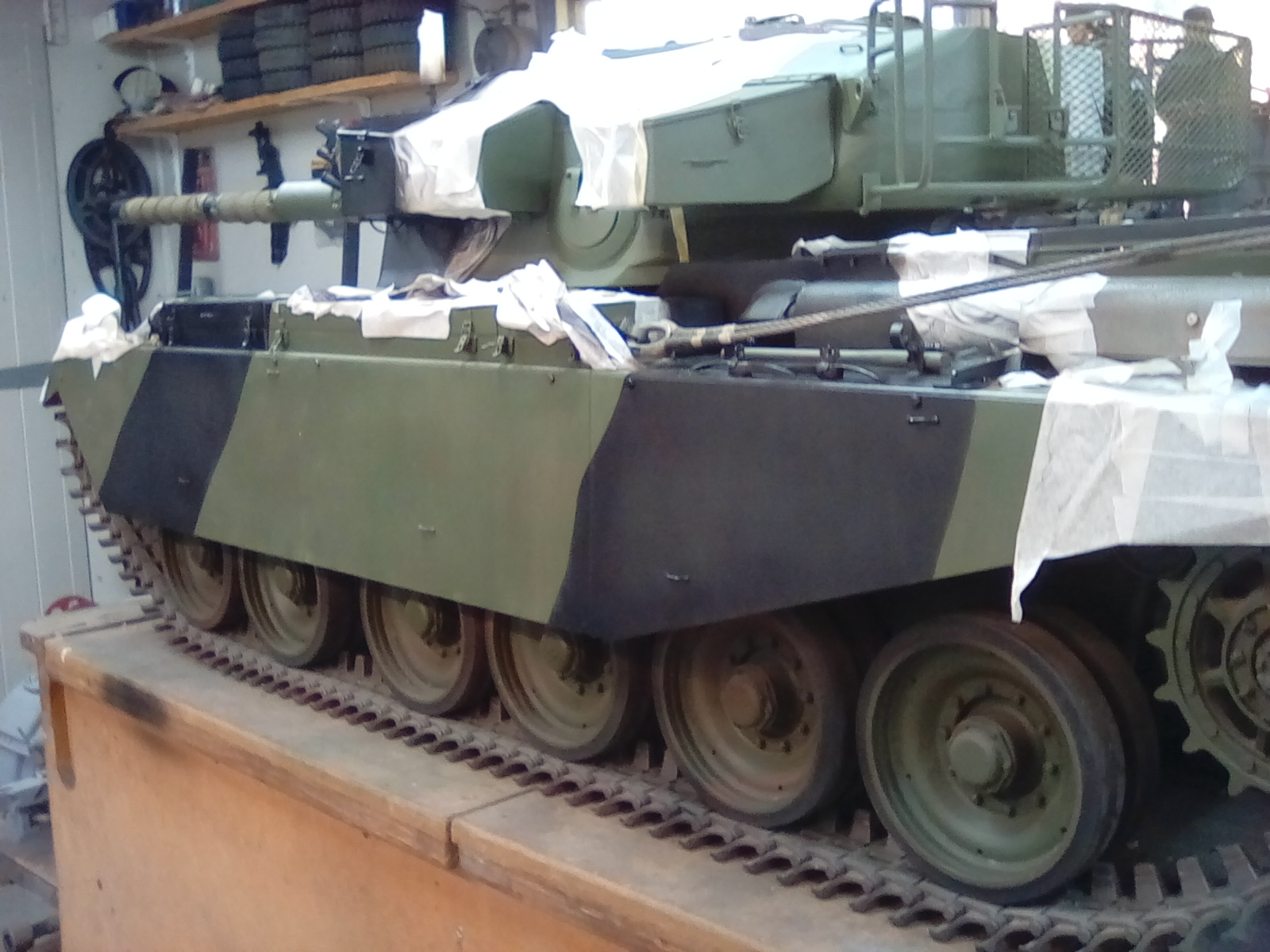

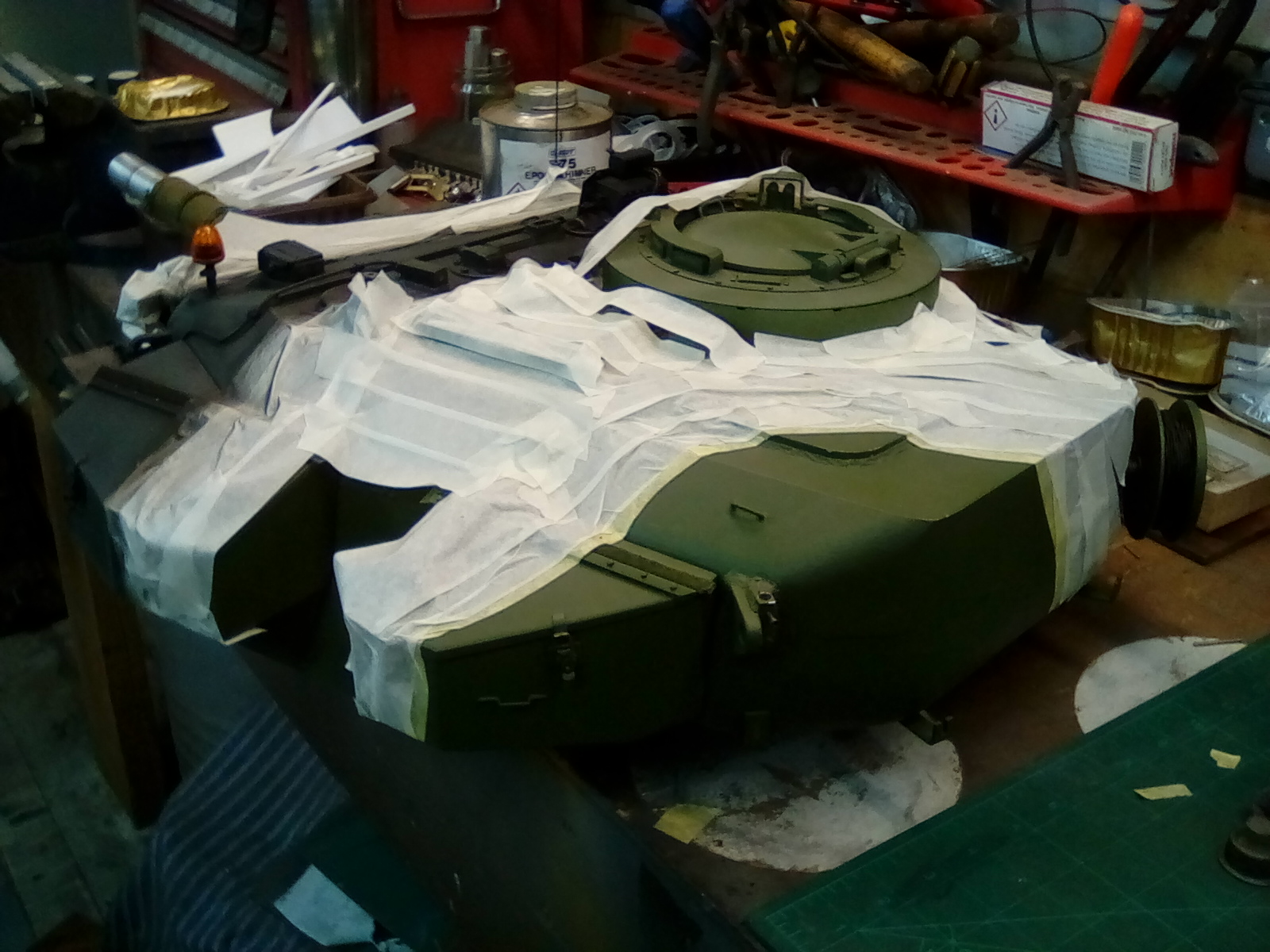

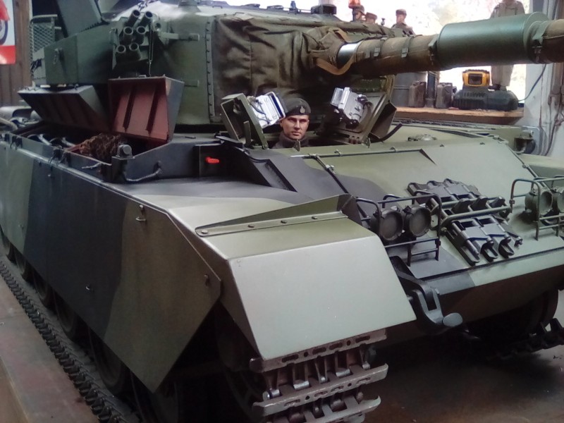

It's a big model!
That's a big area of black paint
That's what "cotton buds" are for......removing the overspray from the headlight glass

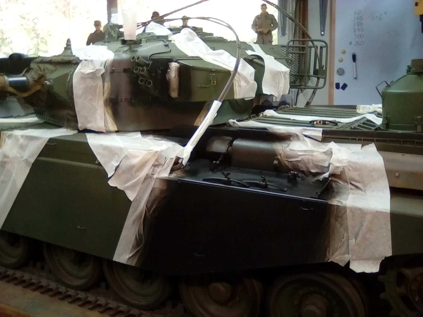

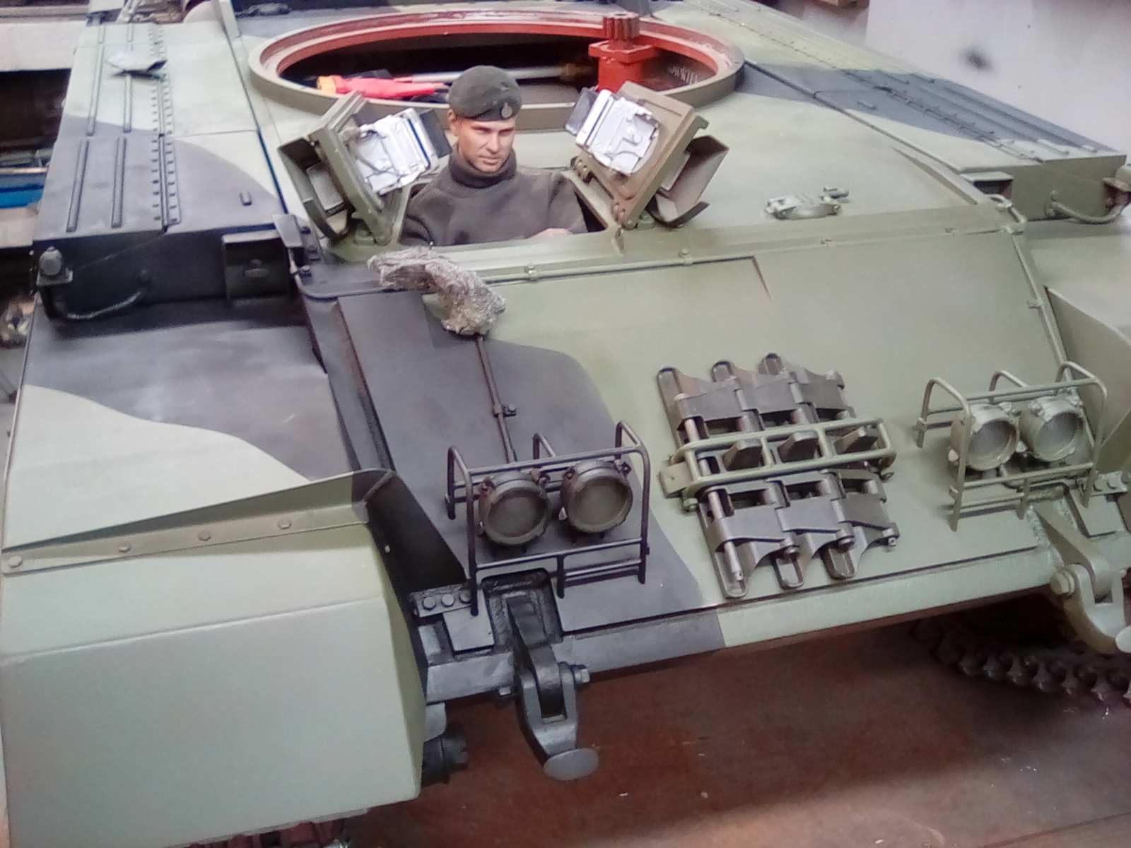

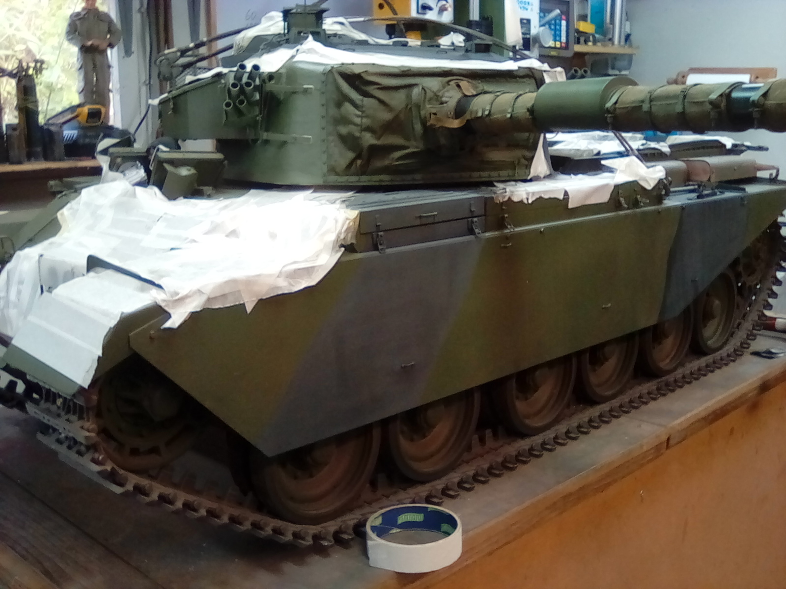

Undercoat applied
Undercoat applied

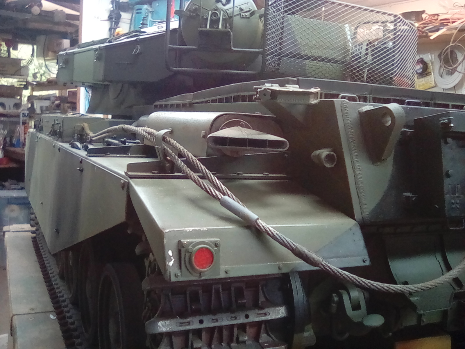

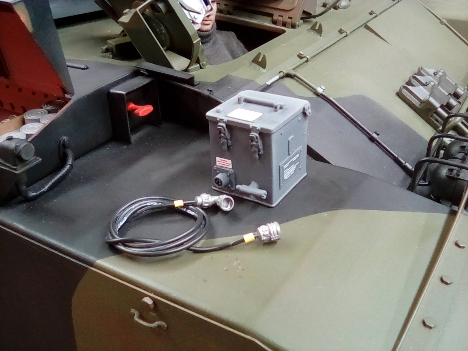

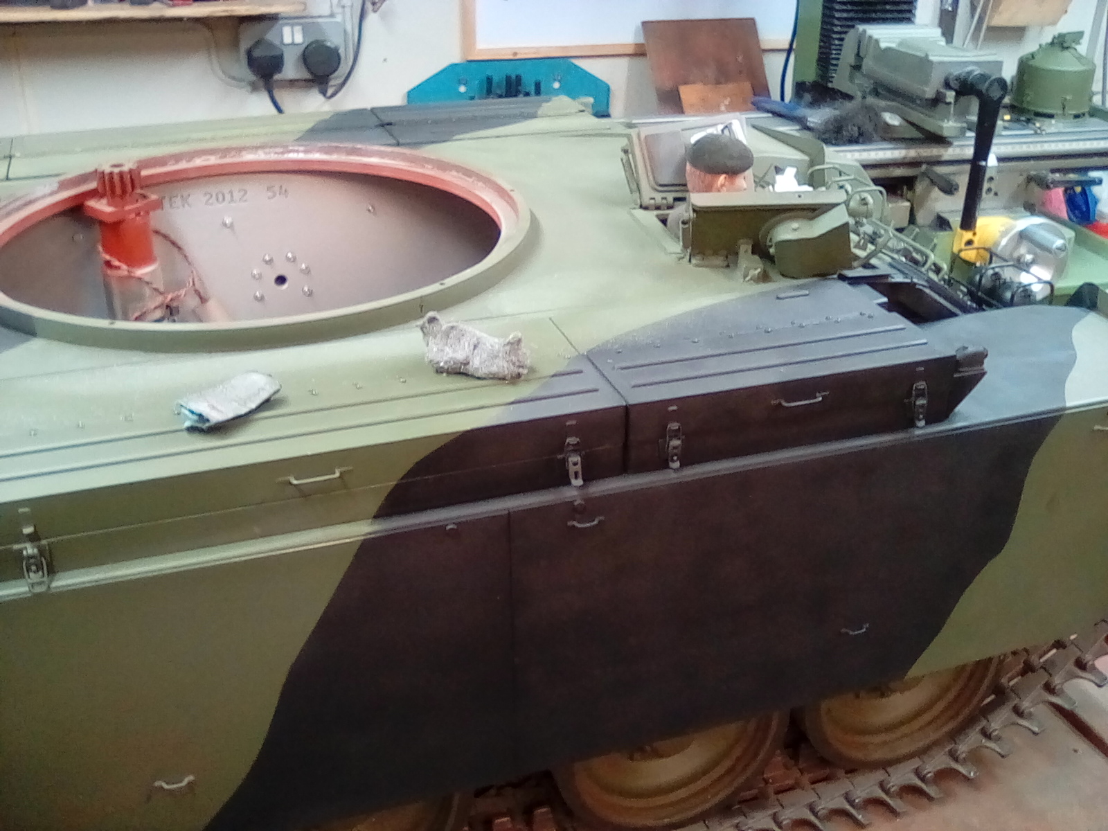

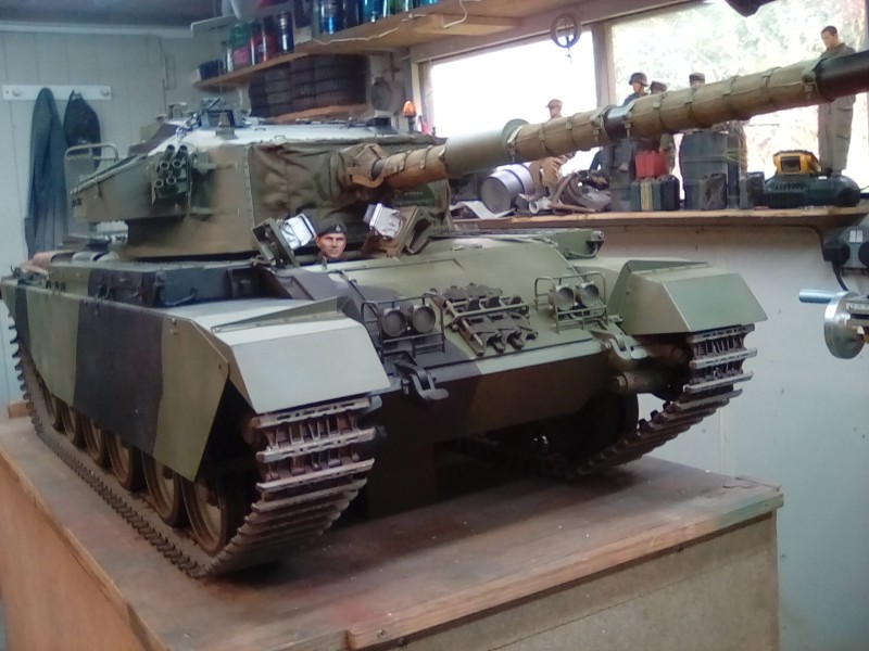

That's a lot of black paint, as Steve  pointed out it's 1/3 black and 2/3 green

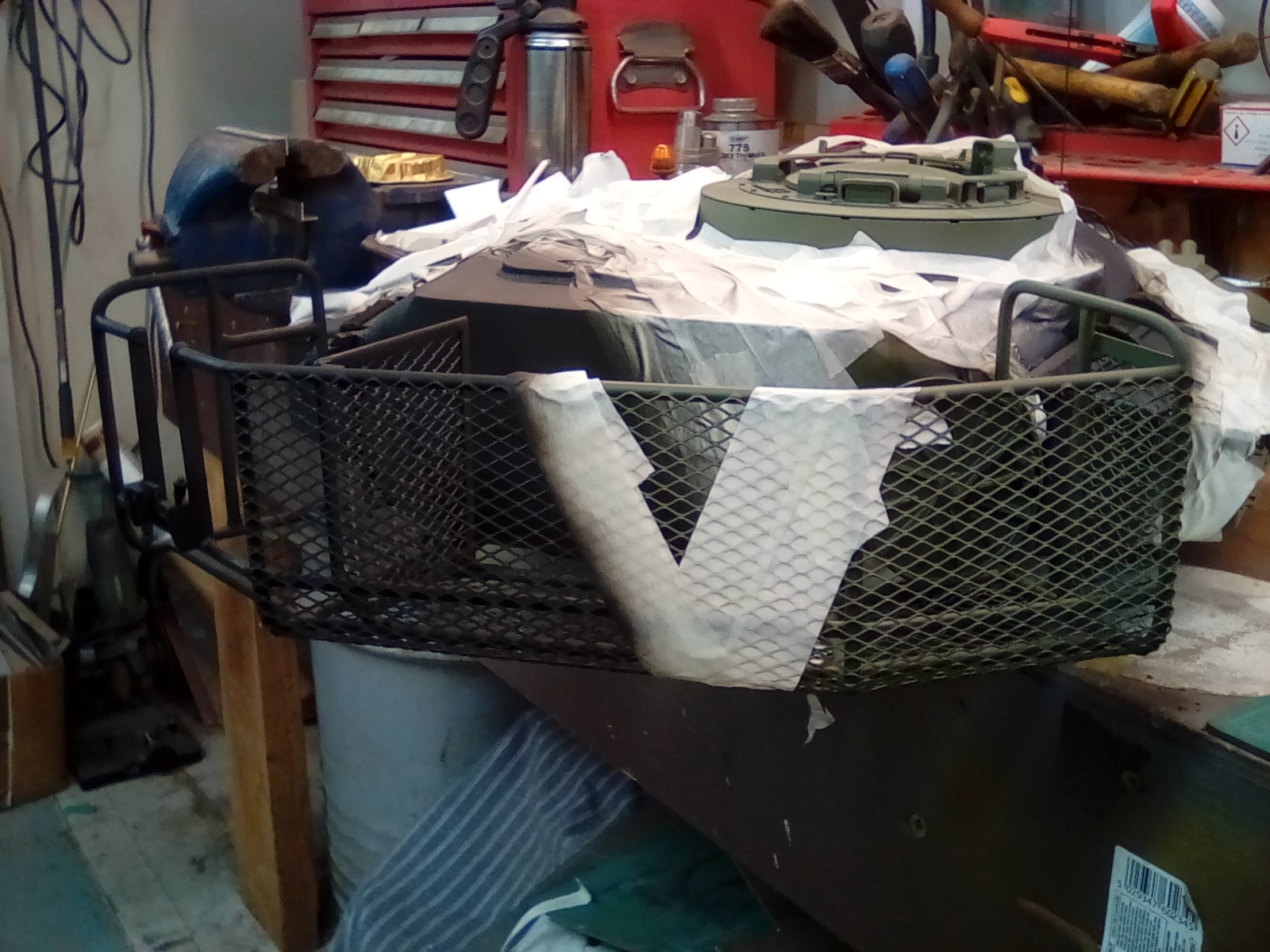

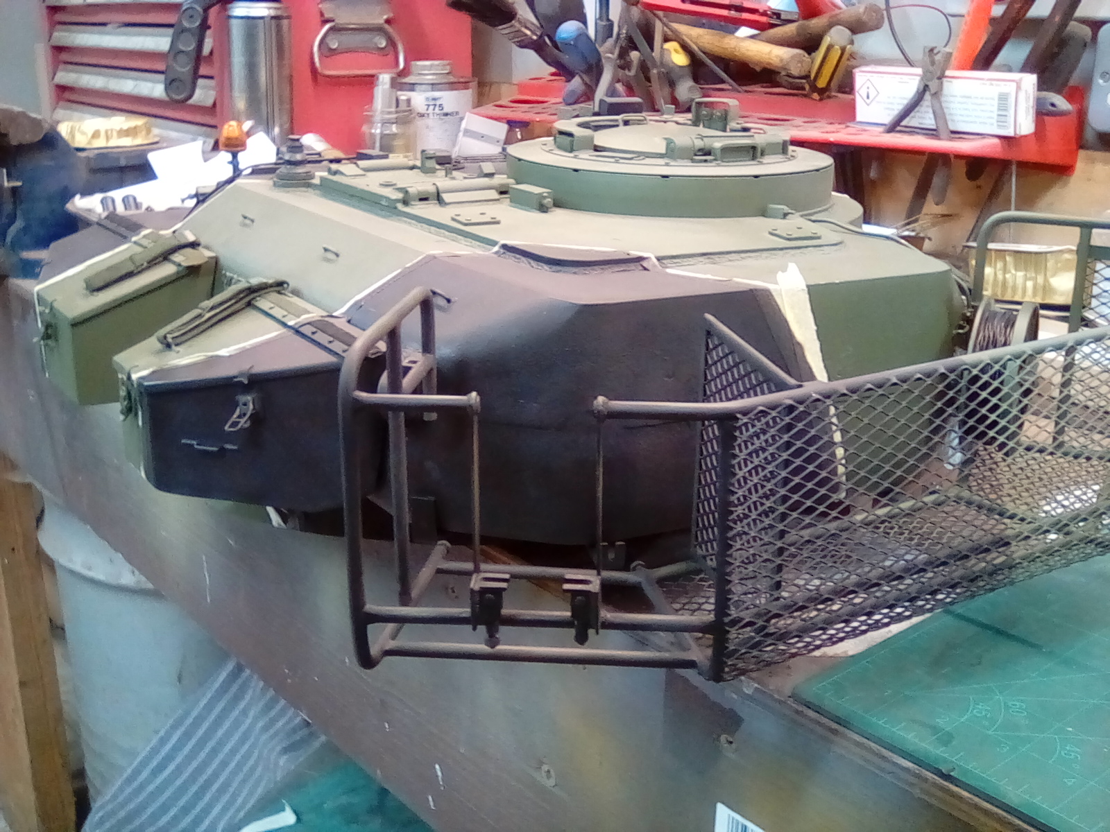

Very awkward painting the camouflage pattern on the turret basket

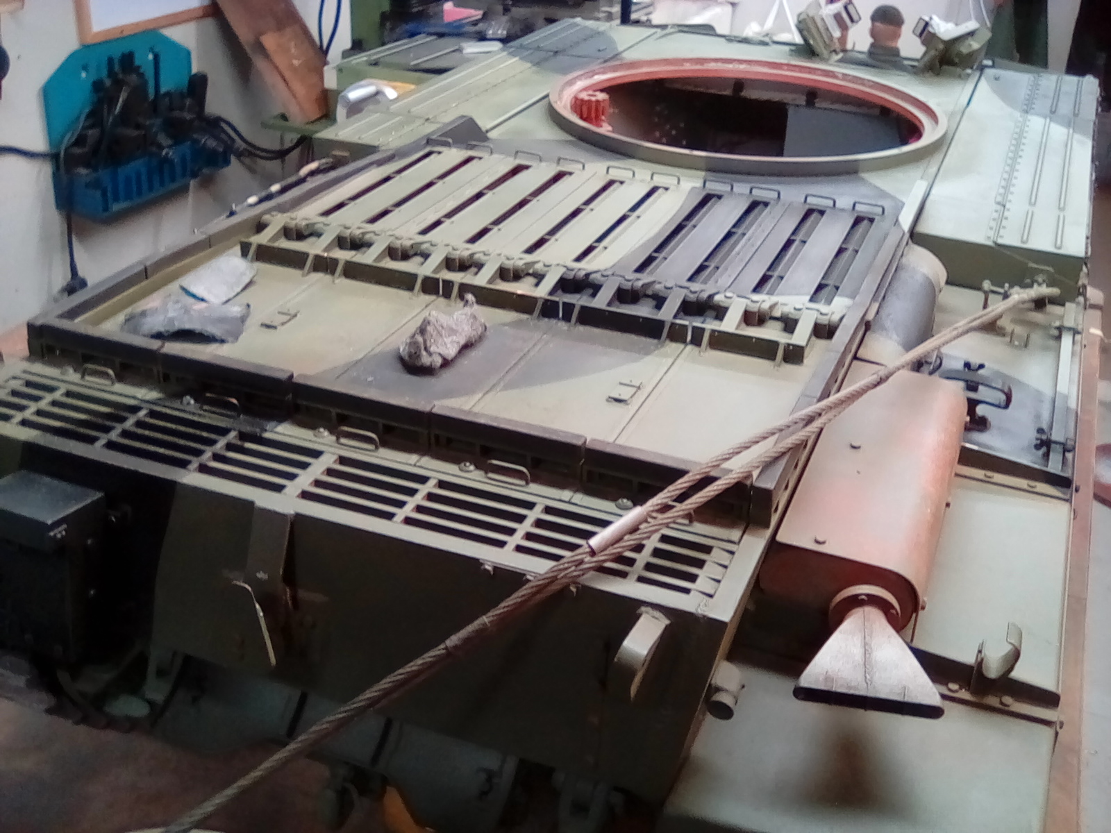

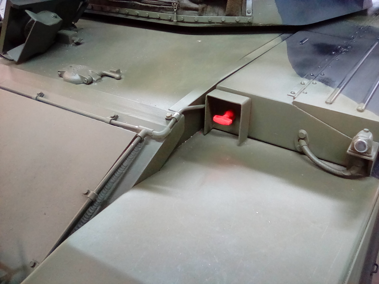

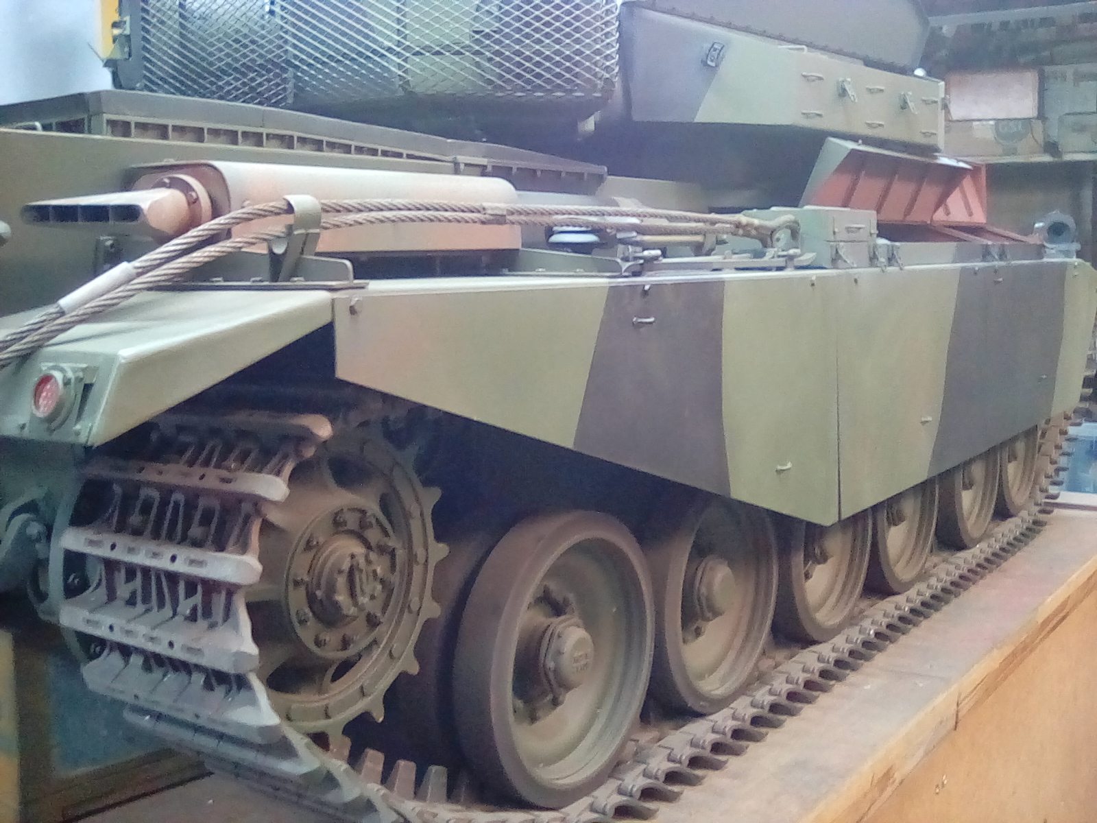

Although I've painted the horizontal rear deck surface many vehicles were not painted with the matt black, maybe a threat from the air was not expected?
This might need another coat. The whole vehicle will need gentle scrubbing with very fine wire wool, and the pads of wire wool will need replacing with new regularly or it will leave marks

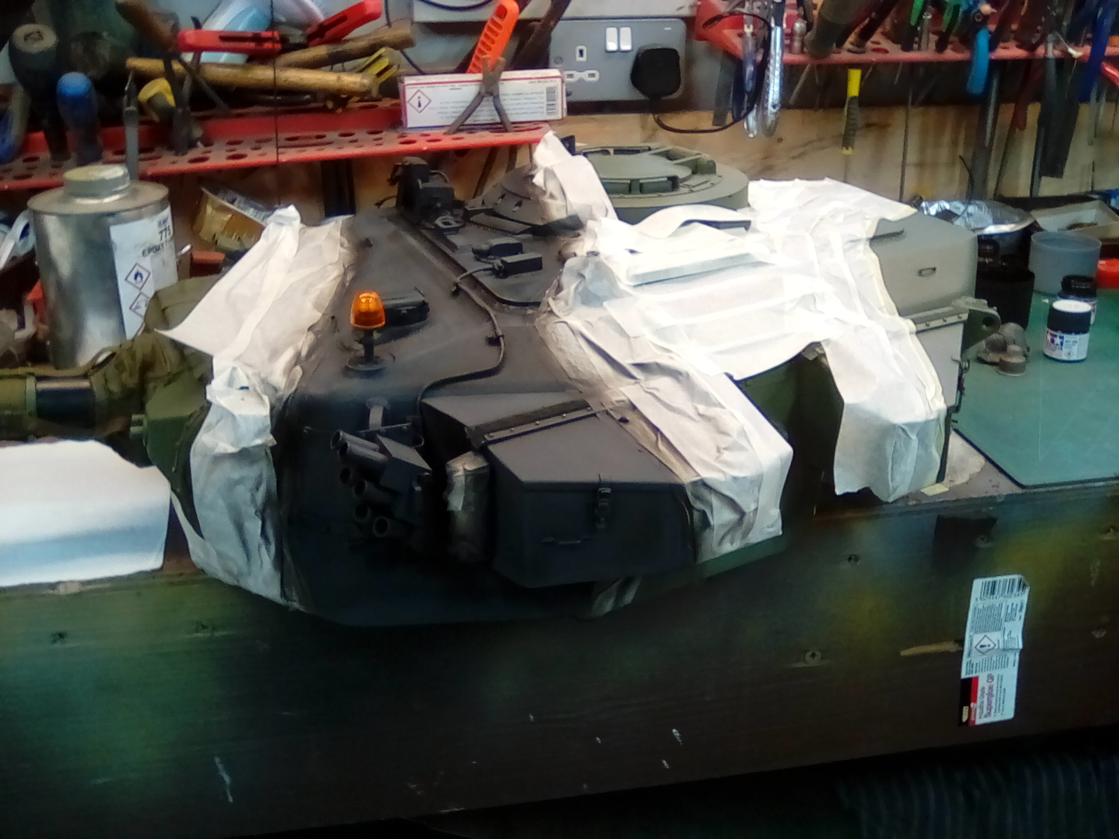

Even the turret is huge

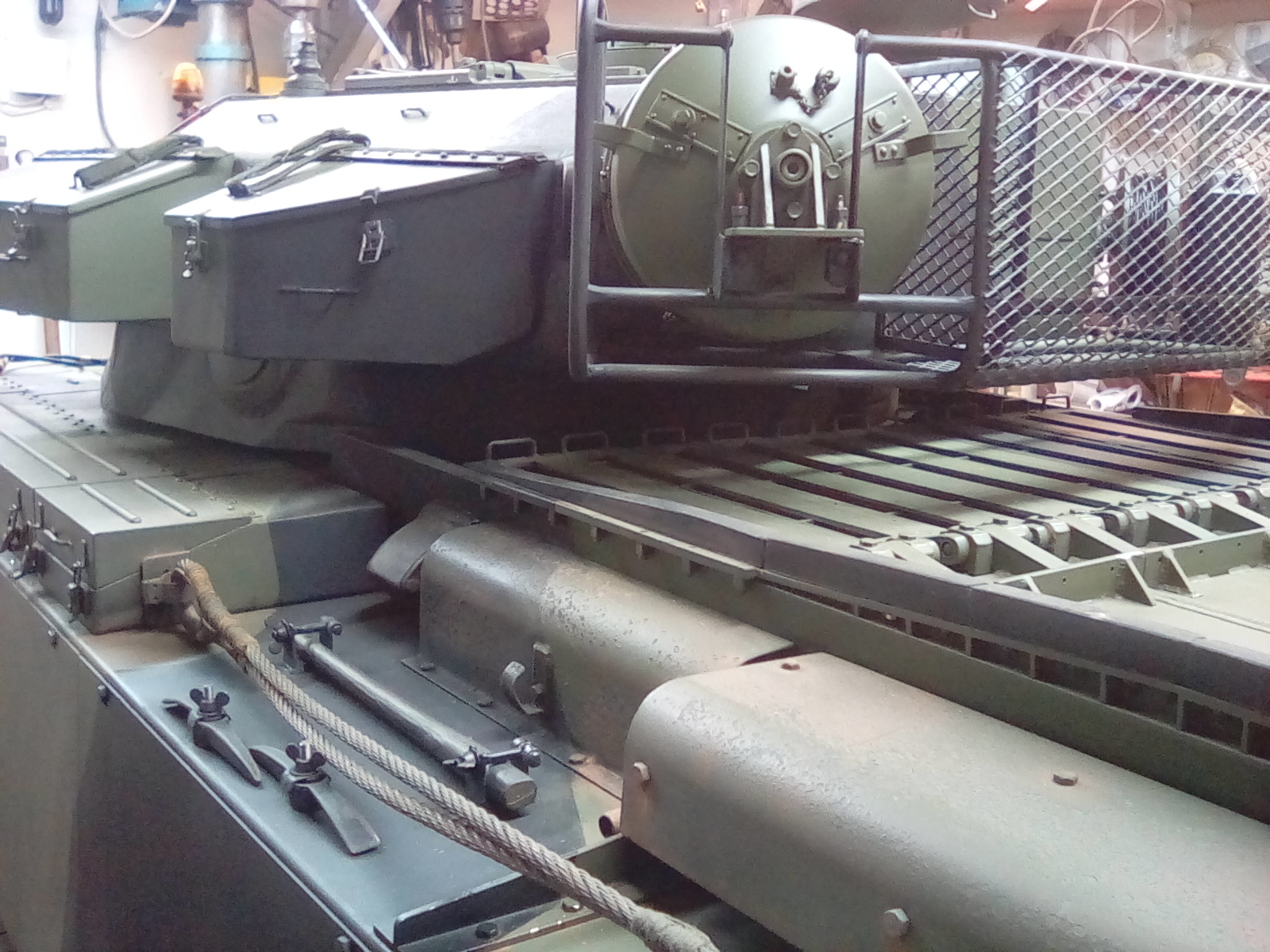

A long day in the workshop getting through all those little jobs
It's all together for a little while

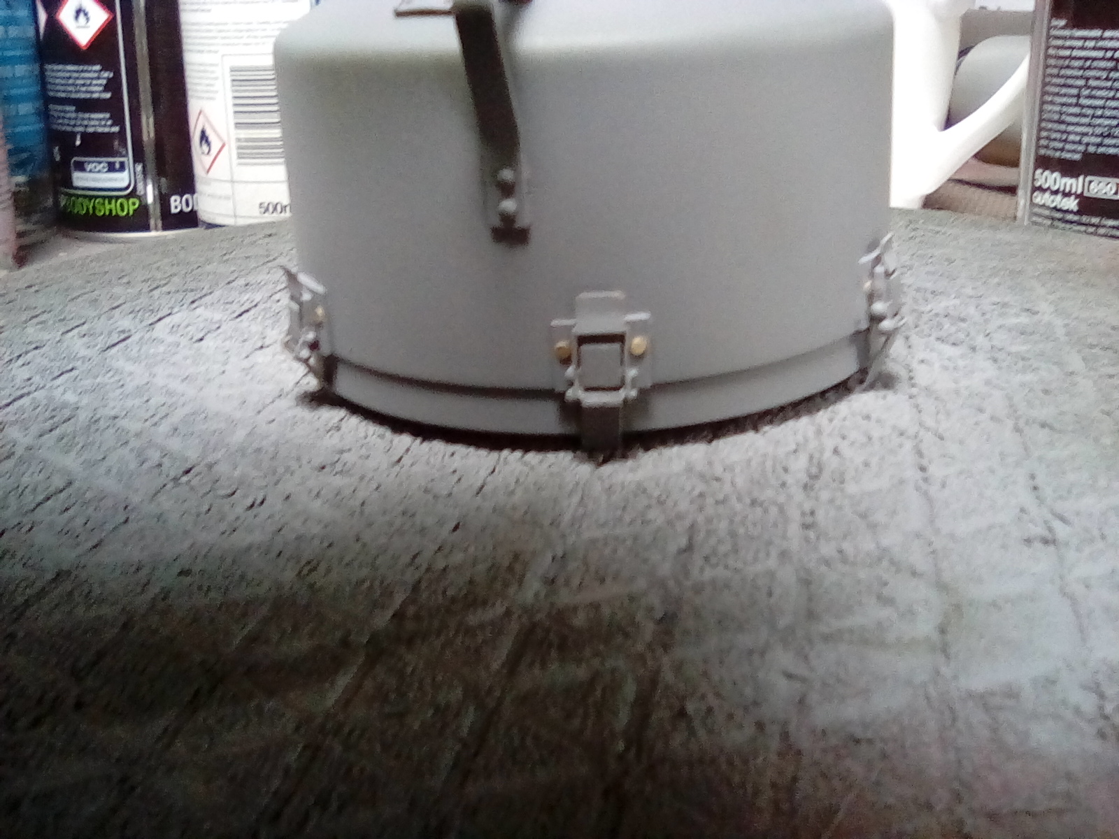

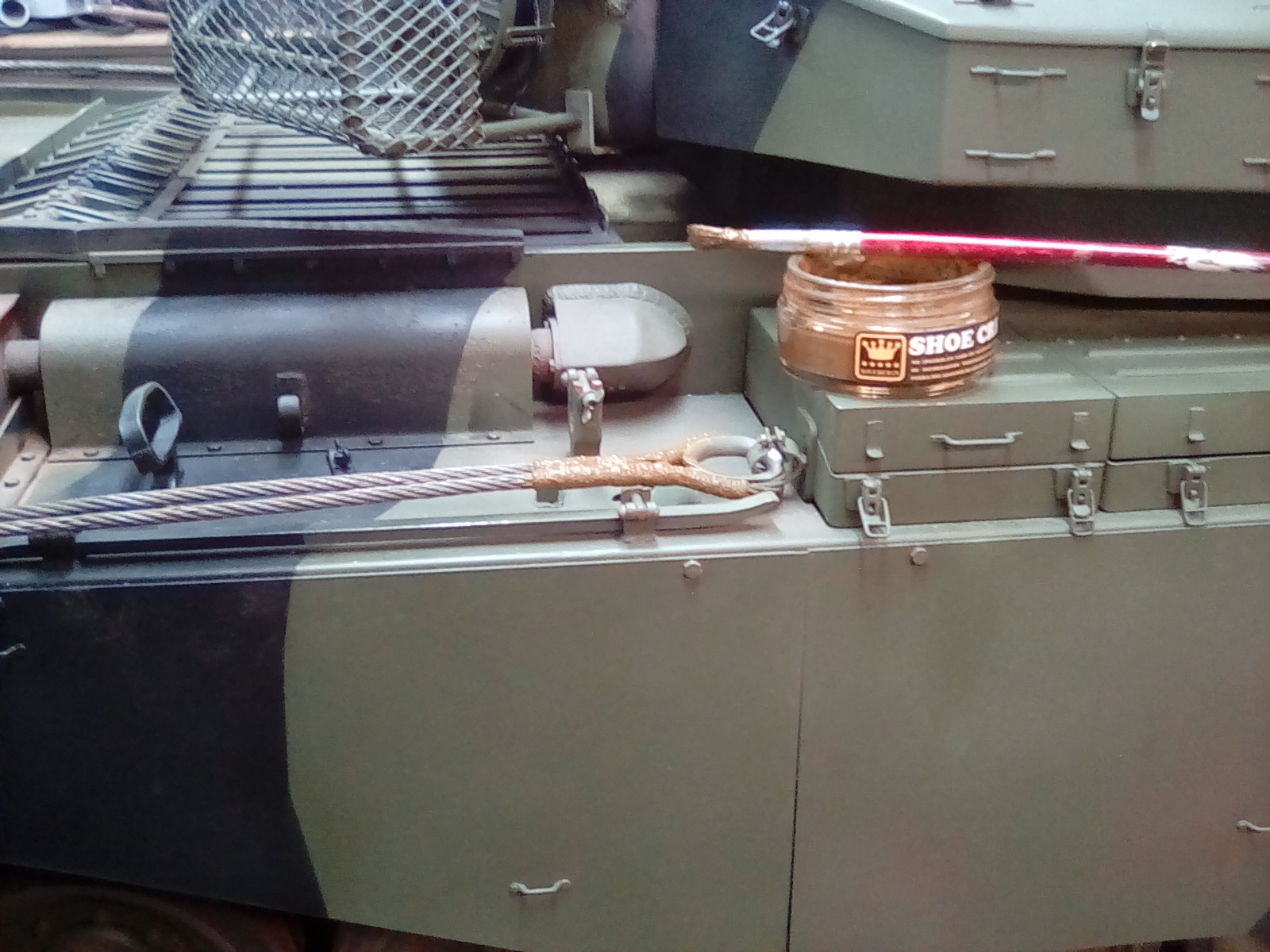

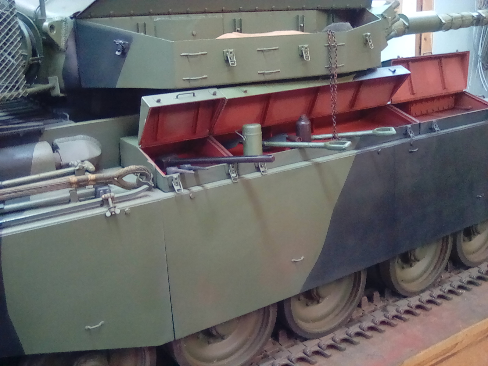

Staining the lashings

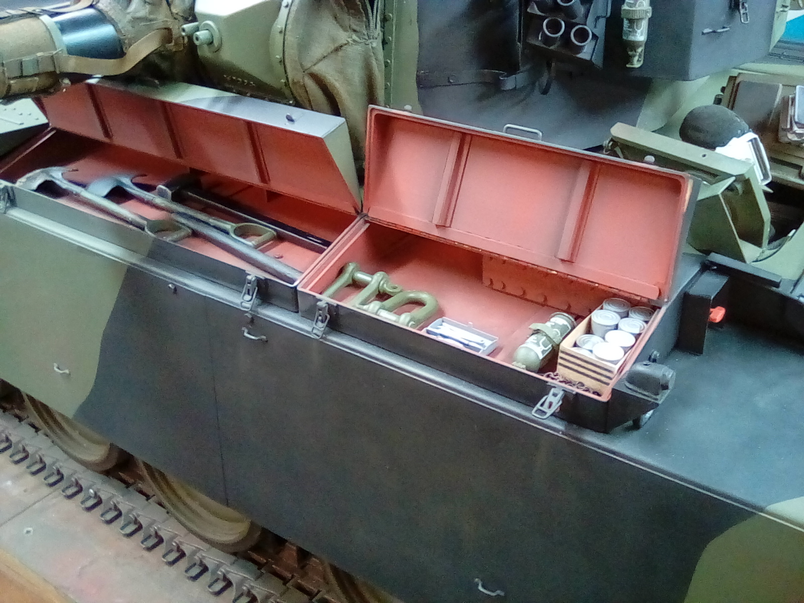

Weathering the inside of the kit boxes with washes is very important
More fiddly work but very necessary

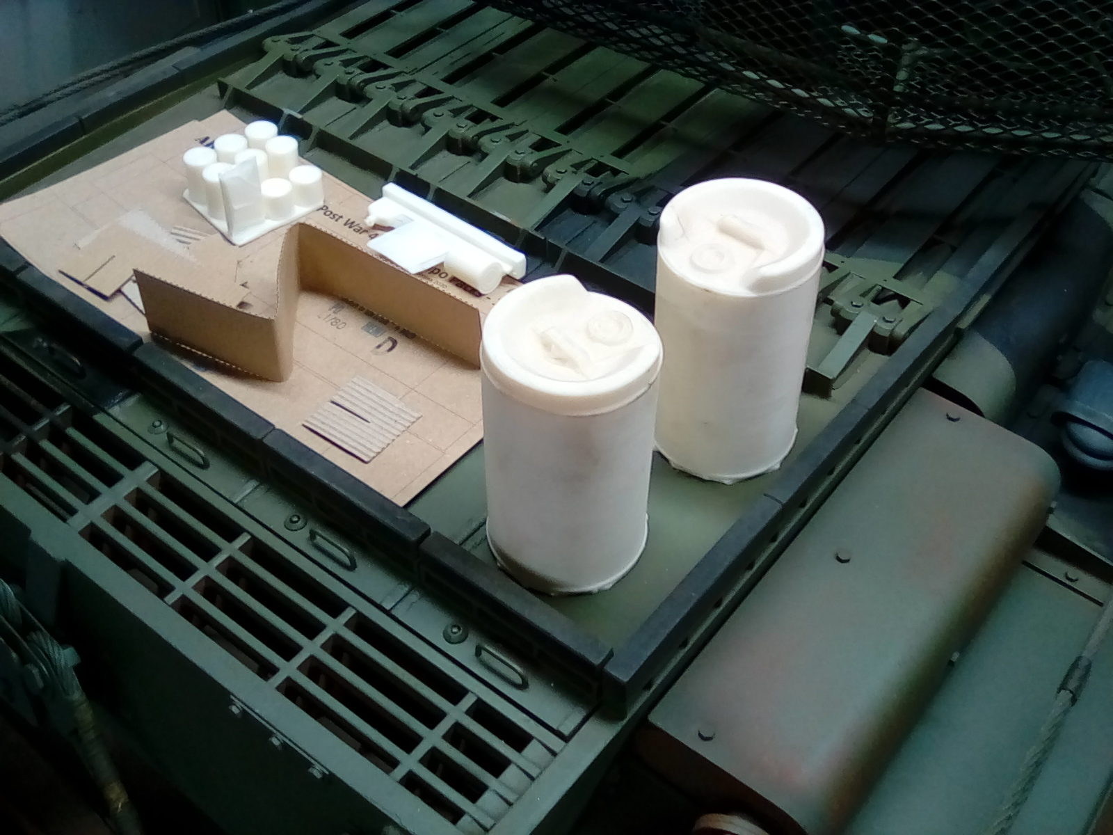

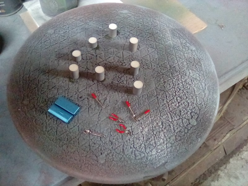

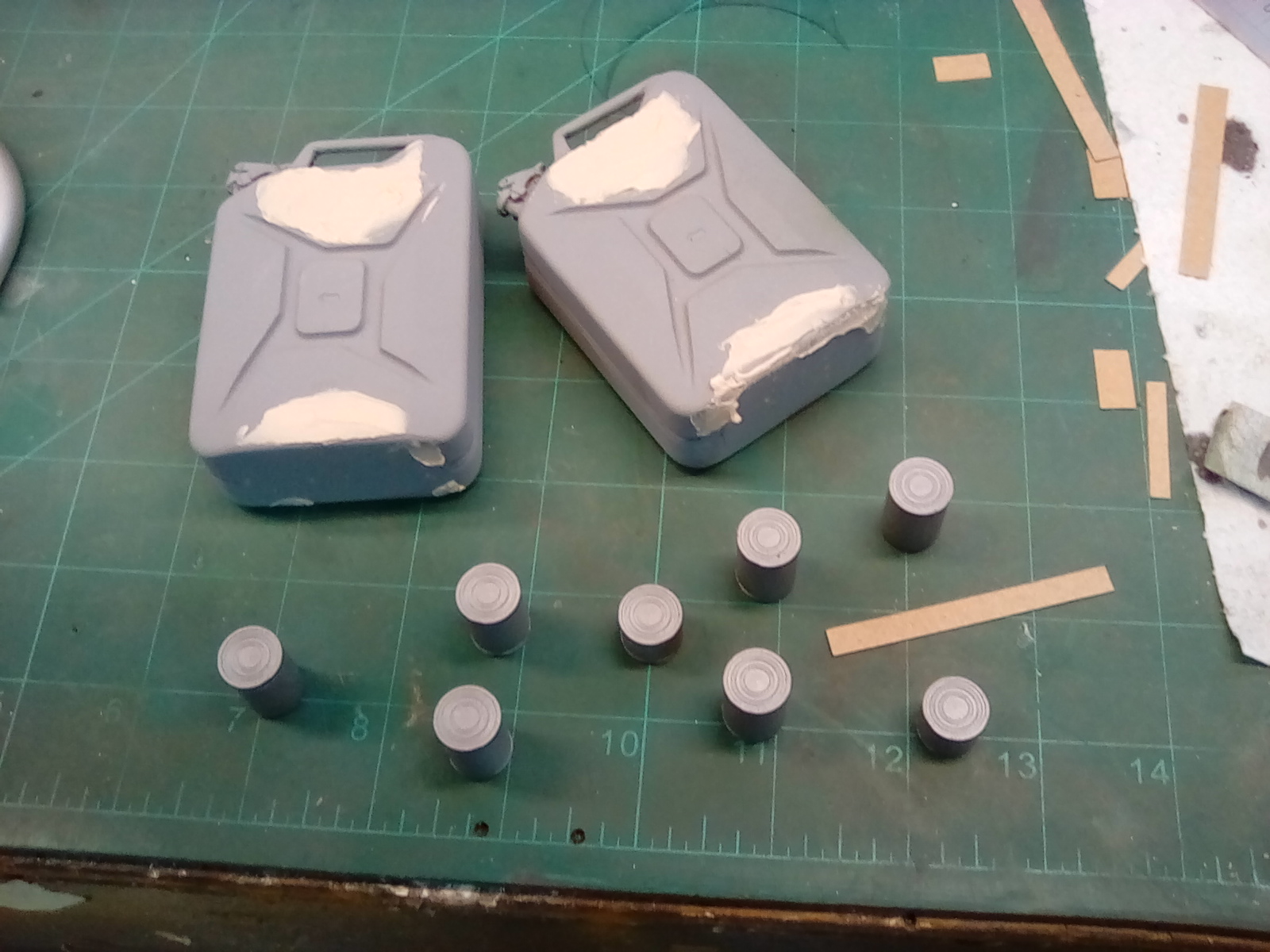

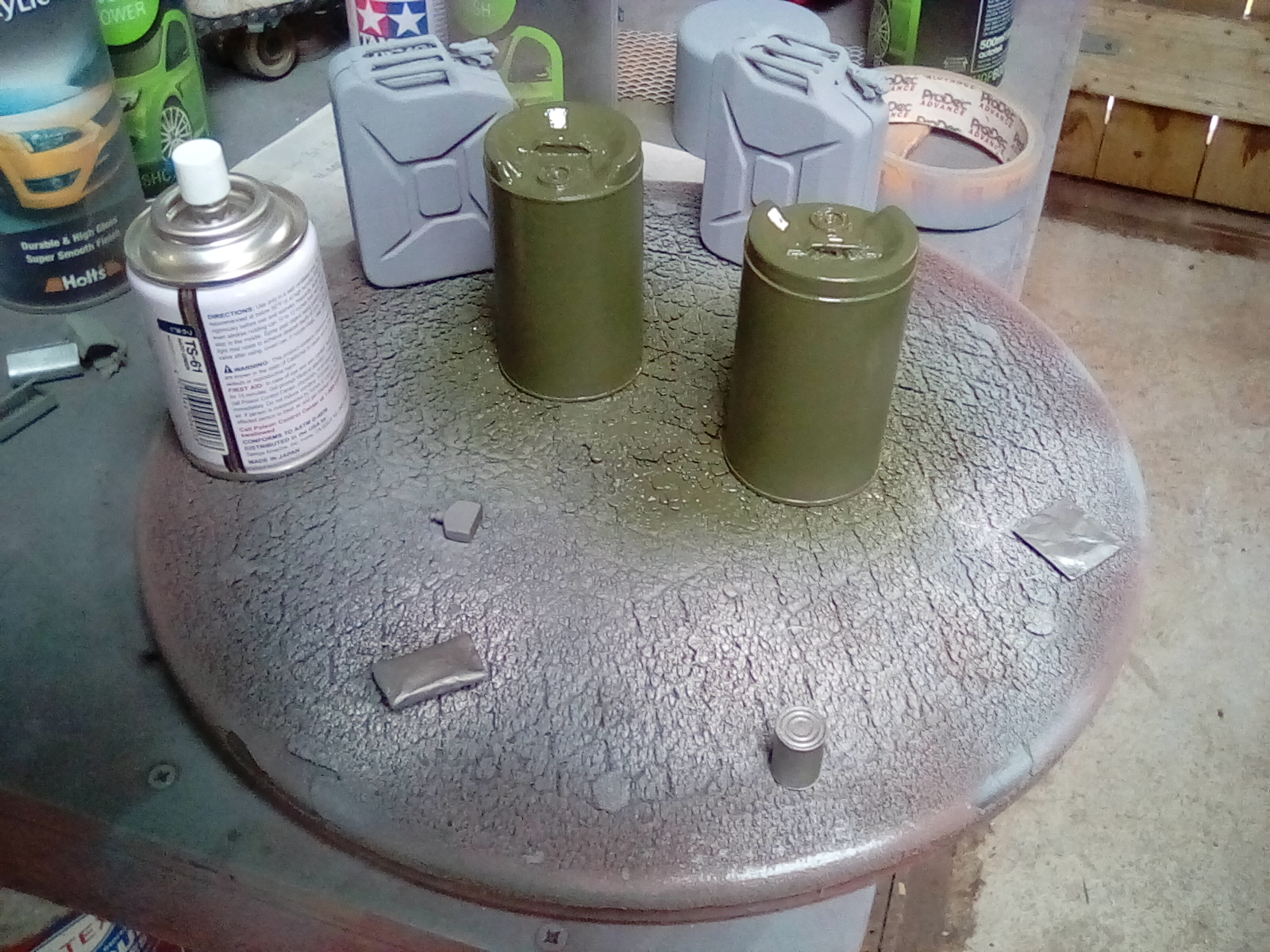

Truing the drums
Truing the drums

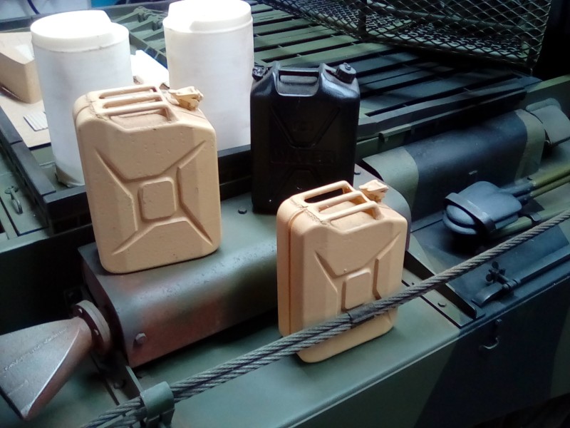

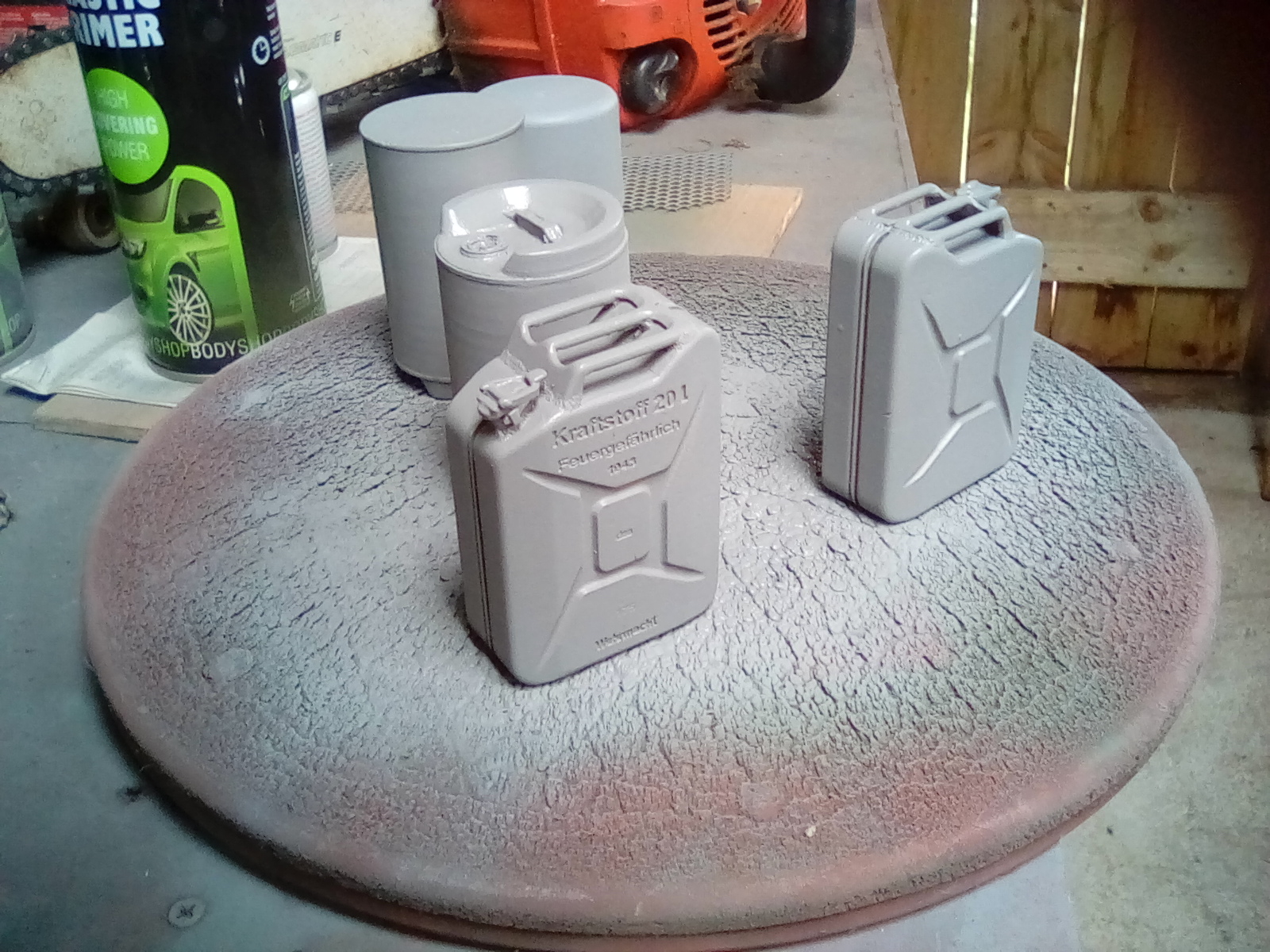

Do you want me to use these Jerry cans boss?

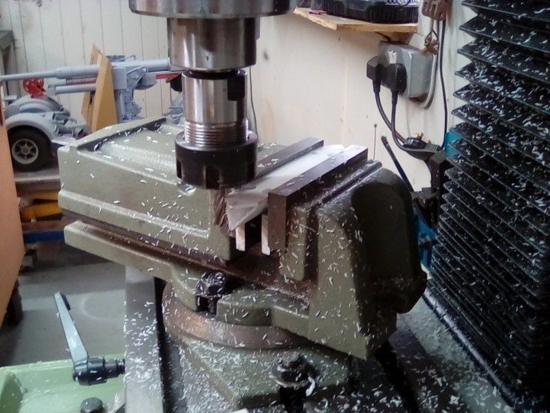

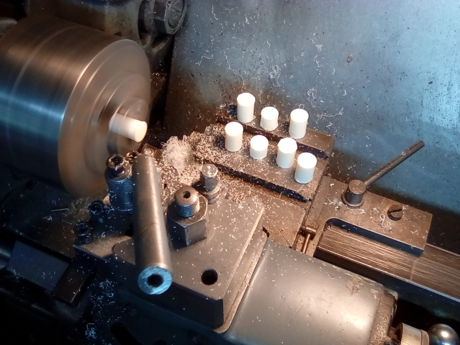

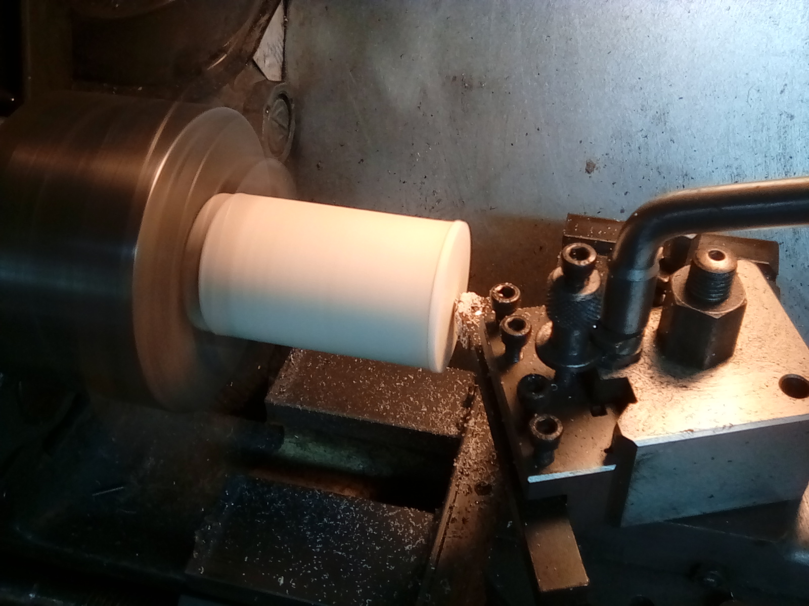

Just as well turn the flashing off in the lathe

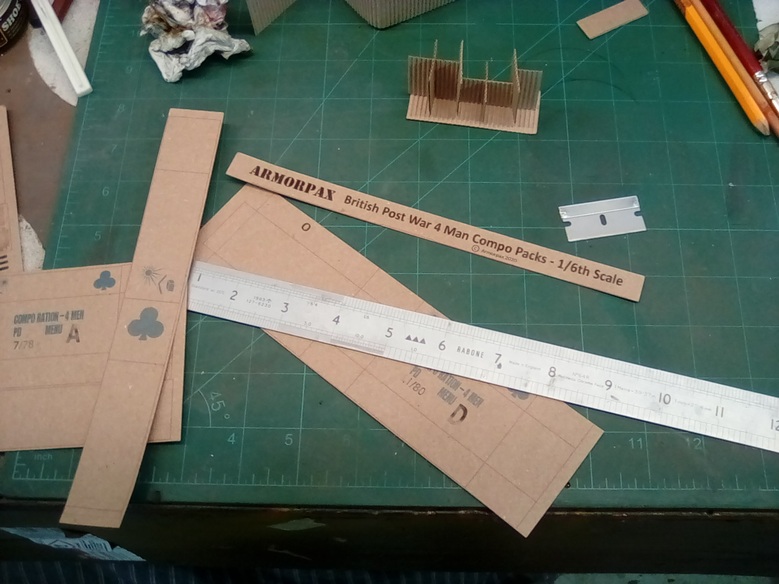

Great addition to your model these from Armorpax

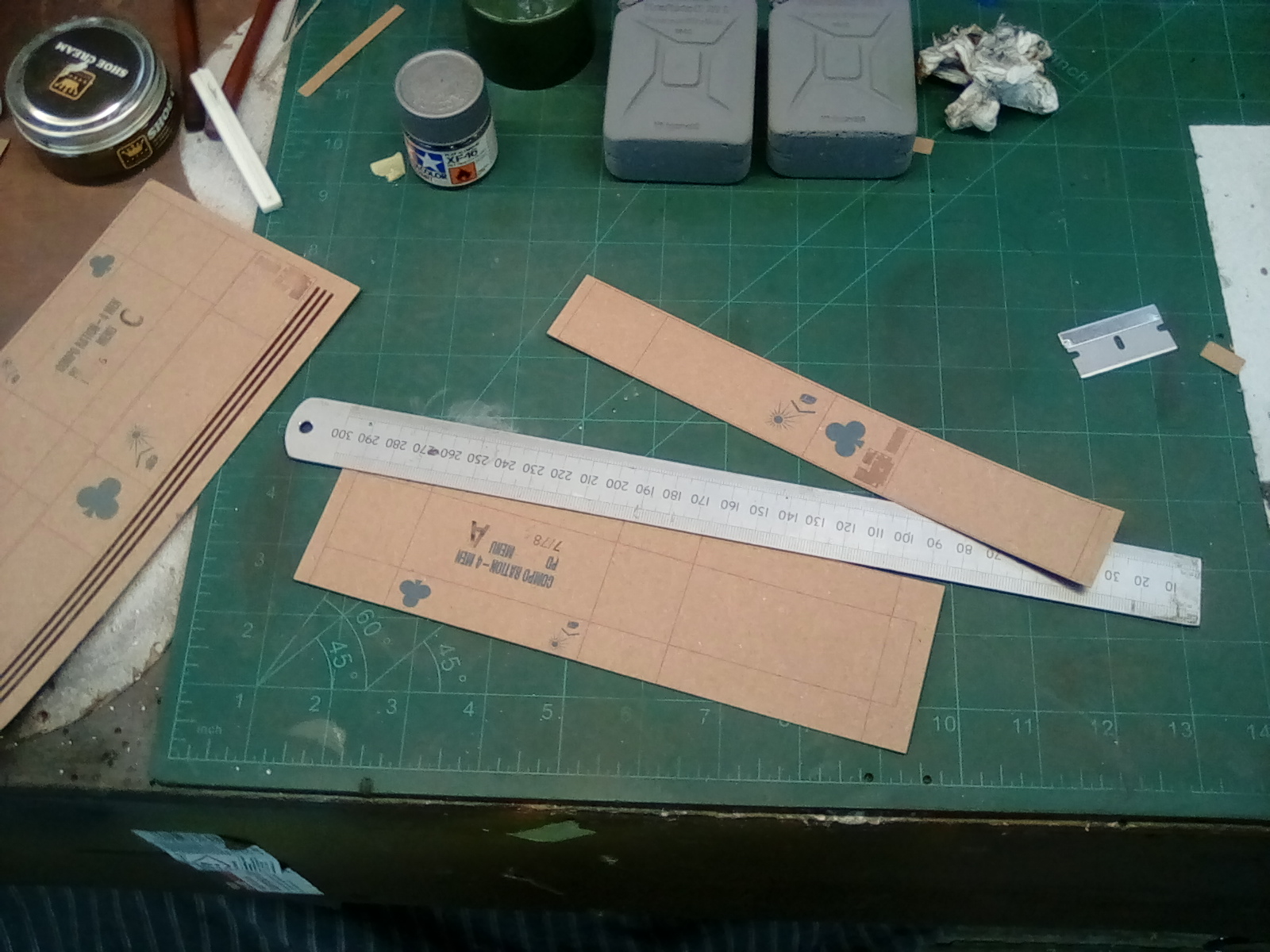

One ration box made up

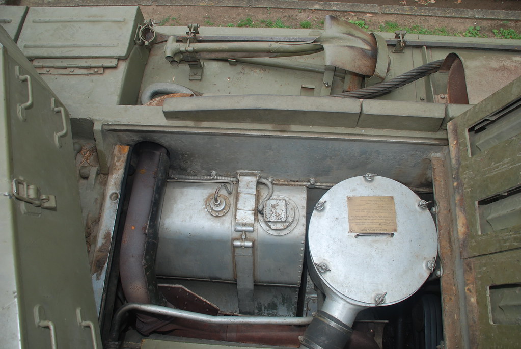

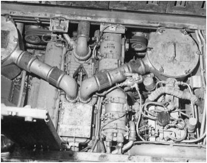

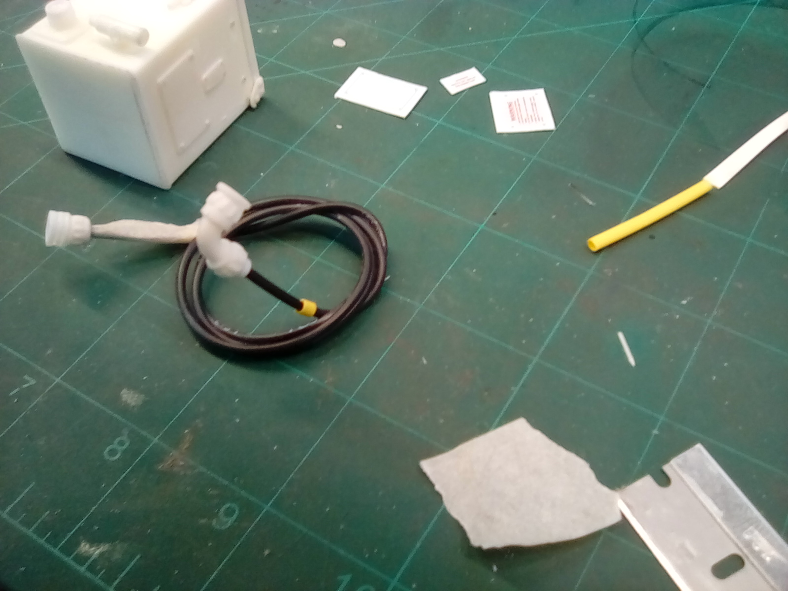

I could really do with an stl file of the <br />fuel tank and air boxes , just a slice though. I wonder if anyone could help please?

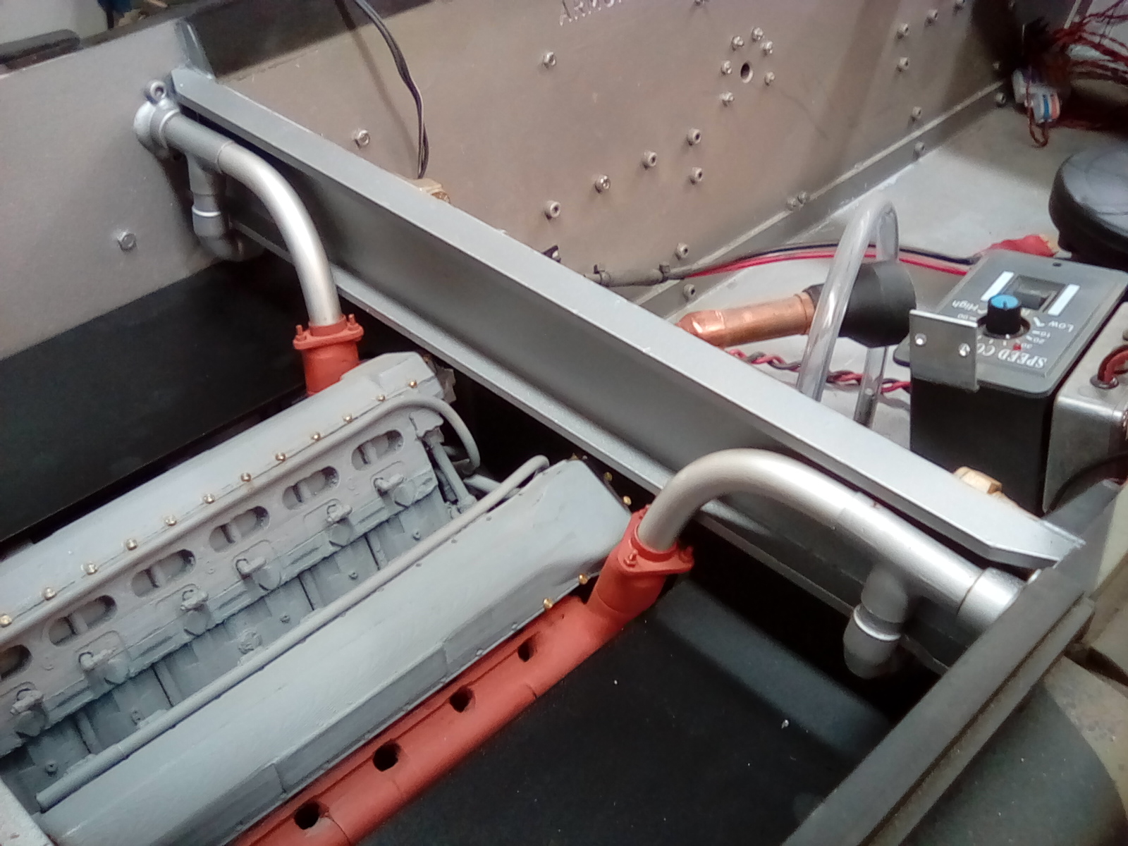

Our engine bay needs to look like this one
R (93).jpeg (39.04 KiB) Viewed 2195 times

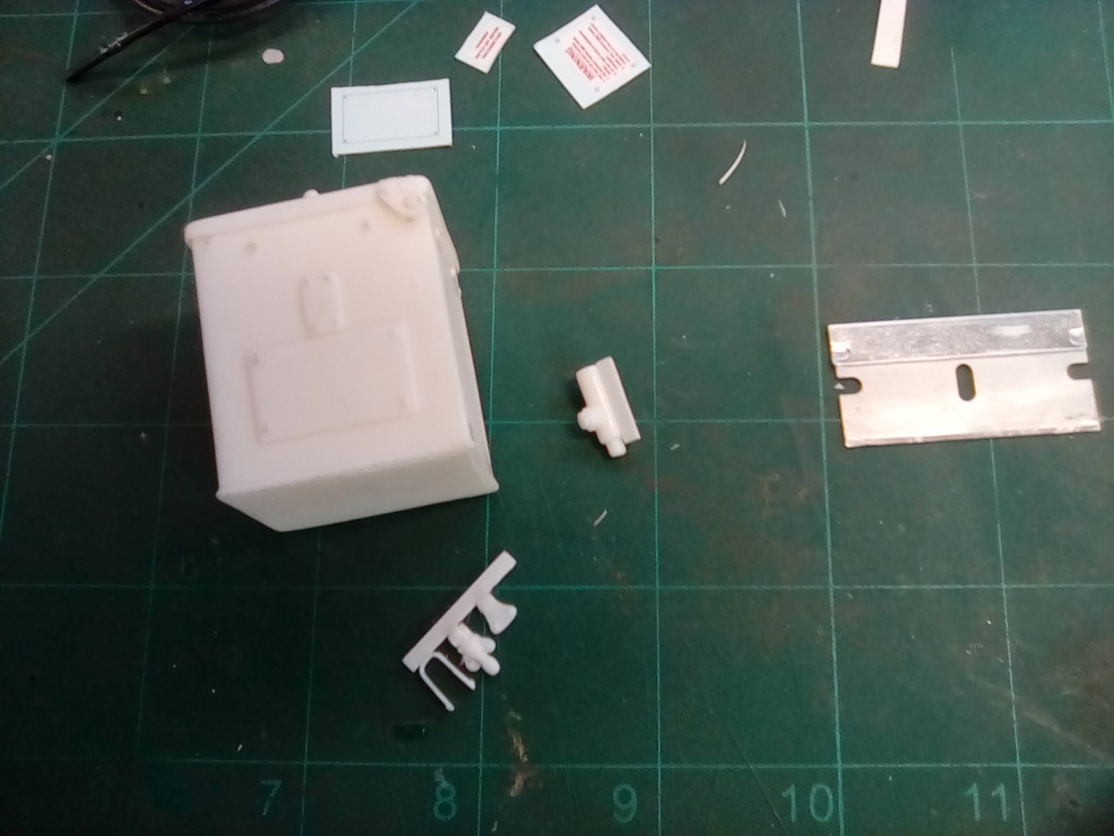

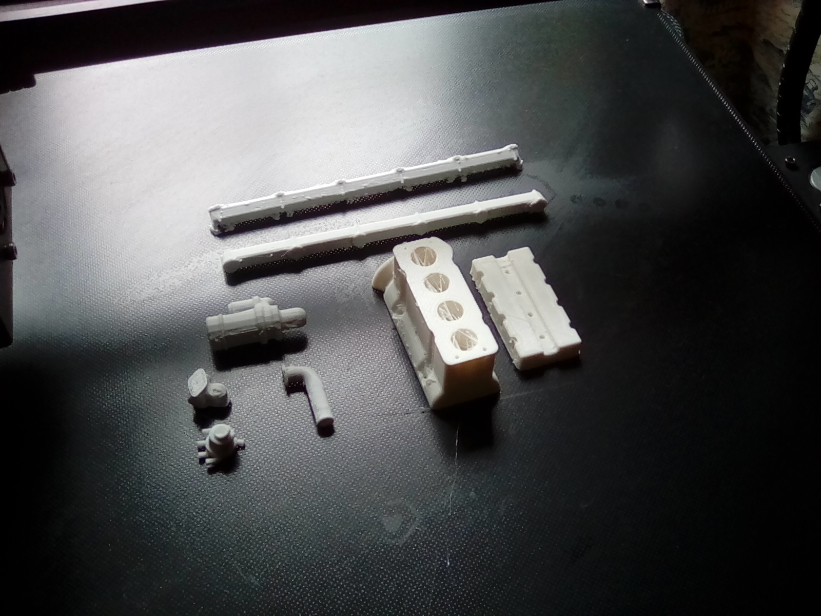

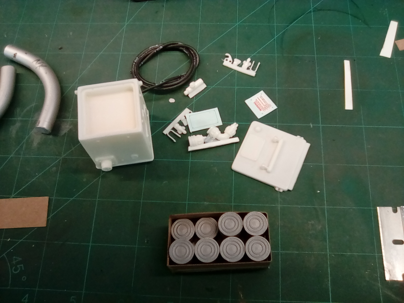

Printing the gue engine parts

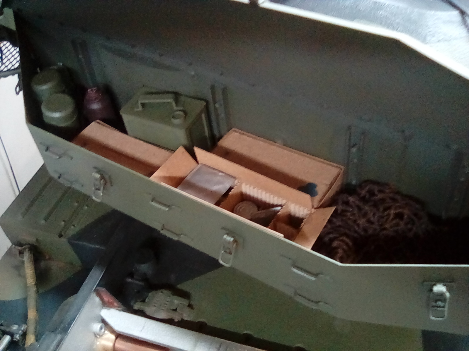

Remaining ration boxes to be made up
I need to work in here very soon
That's the three ration packs made up and stowed
All the tins now turned true and ready for painting
Those gerry cans need to be English

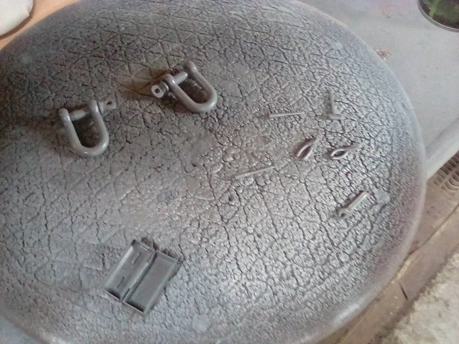

Small parts like shackles and hand tools to add interest to the bins
I better paint this area before it gets to busy in there
The bv will live in one of the bins
Bv ready for the decals

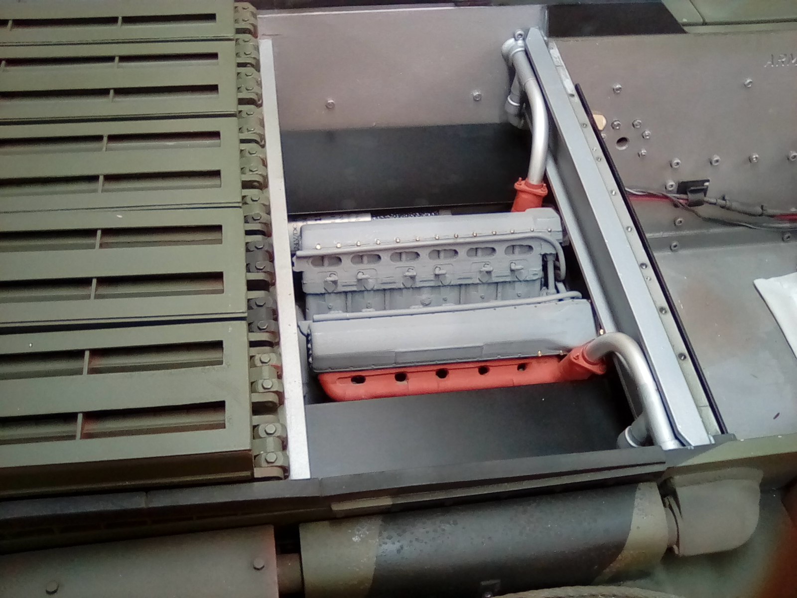

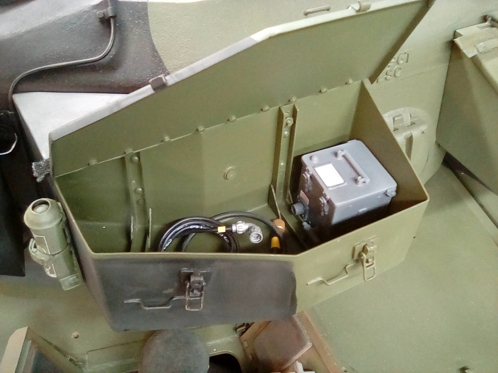

All ready to start on the engine bay once more

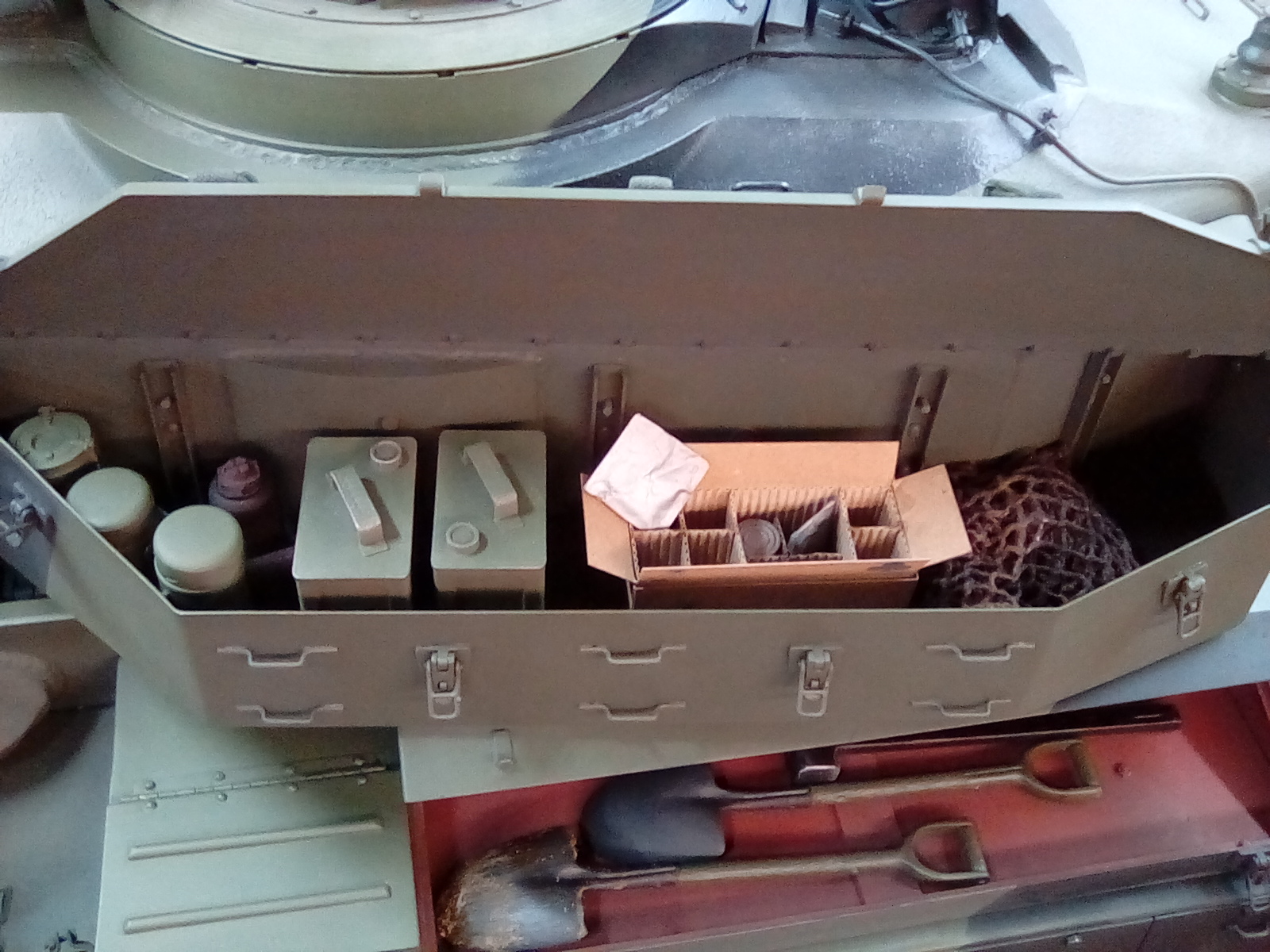

Mr D doesn't want to much in the way of kit and tools in the lockers and bins as visitors fiddle when they should not be fiddling!

Love the camo colors Phil. Incredible details. I just noticed the stowage location for searchlight - amazing work!
Beyond Musuem Quality.

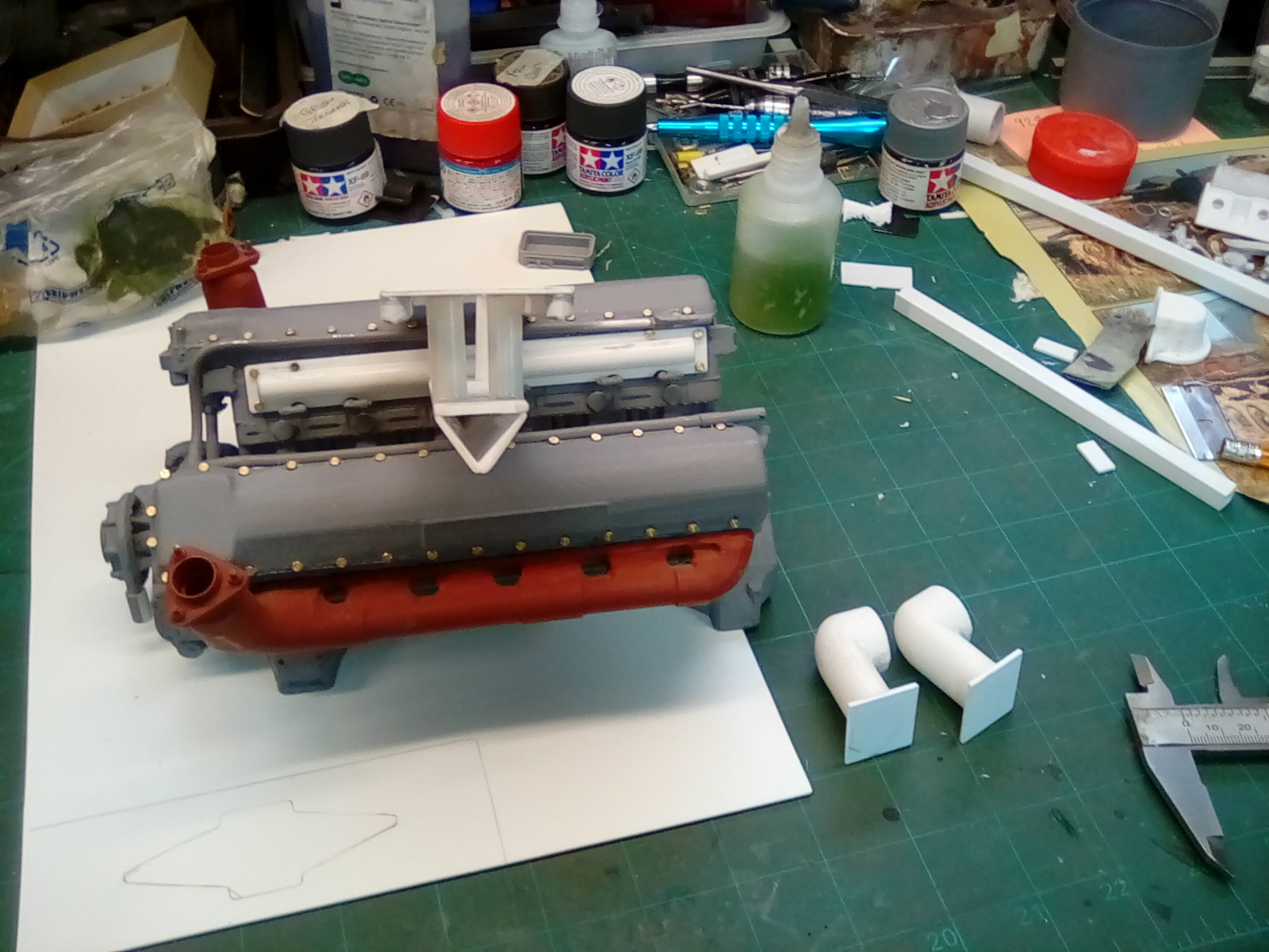

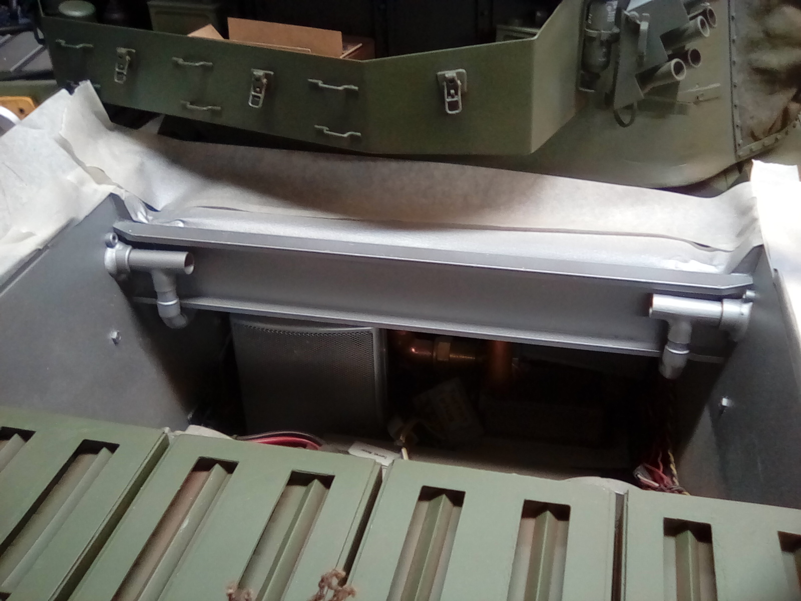

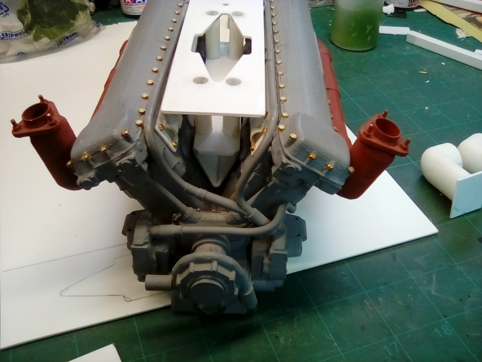

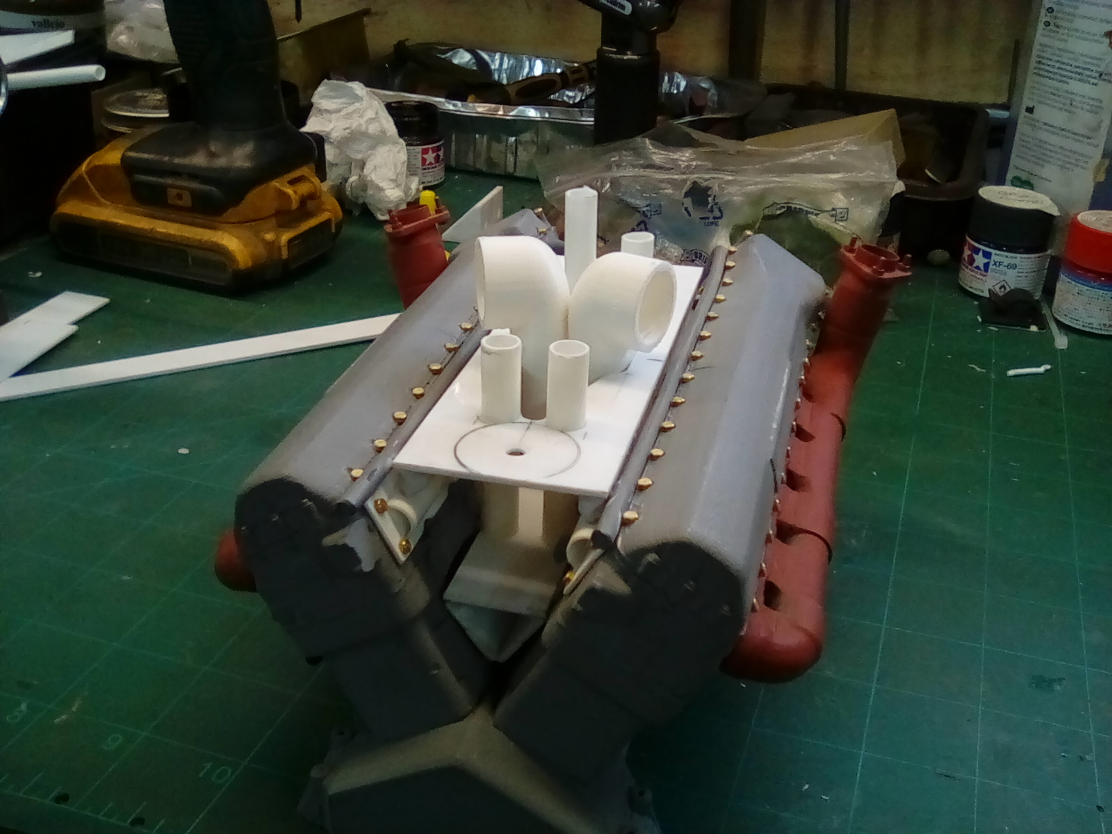

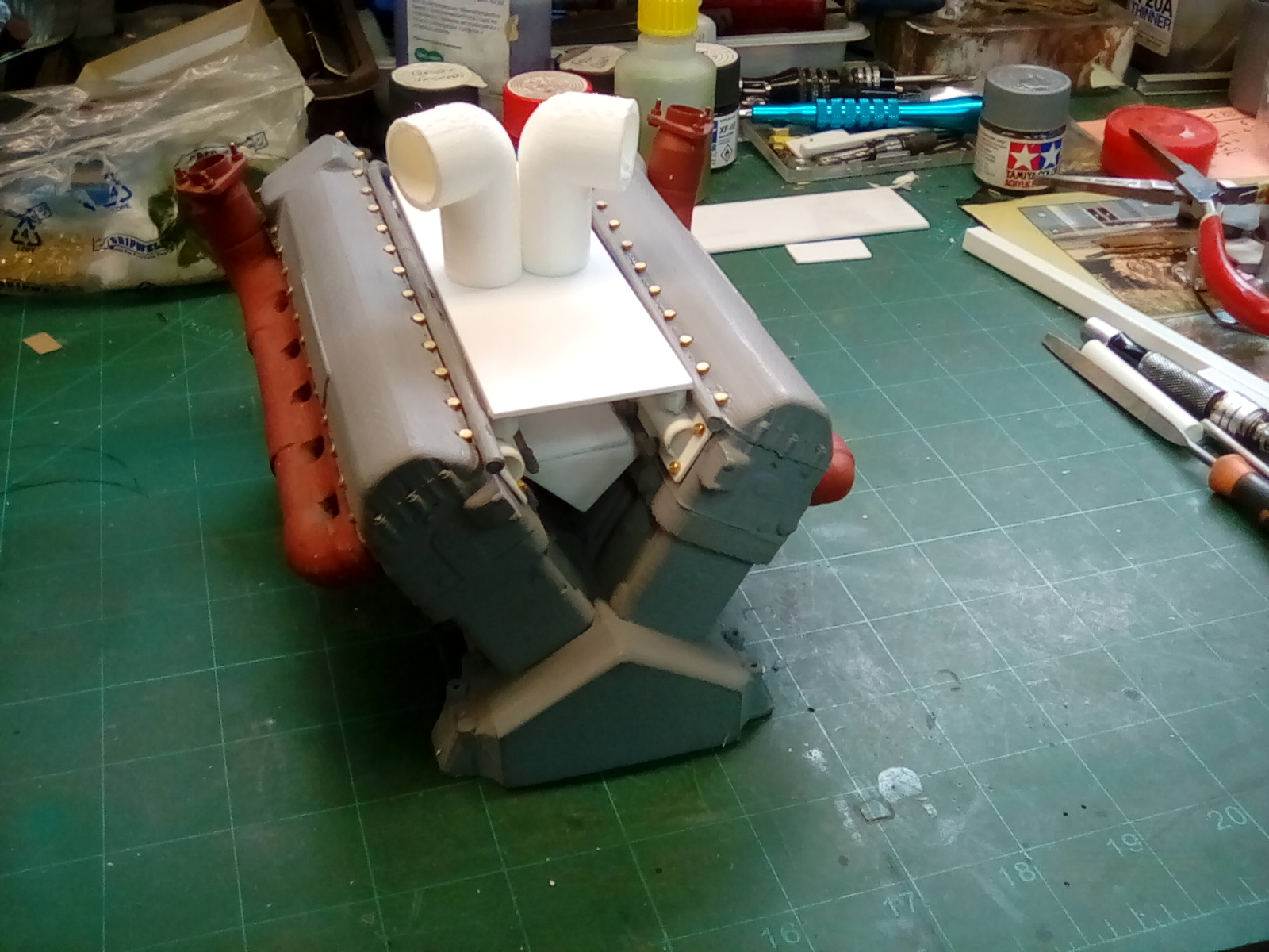

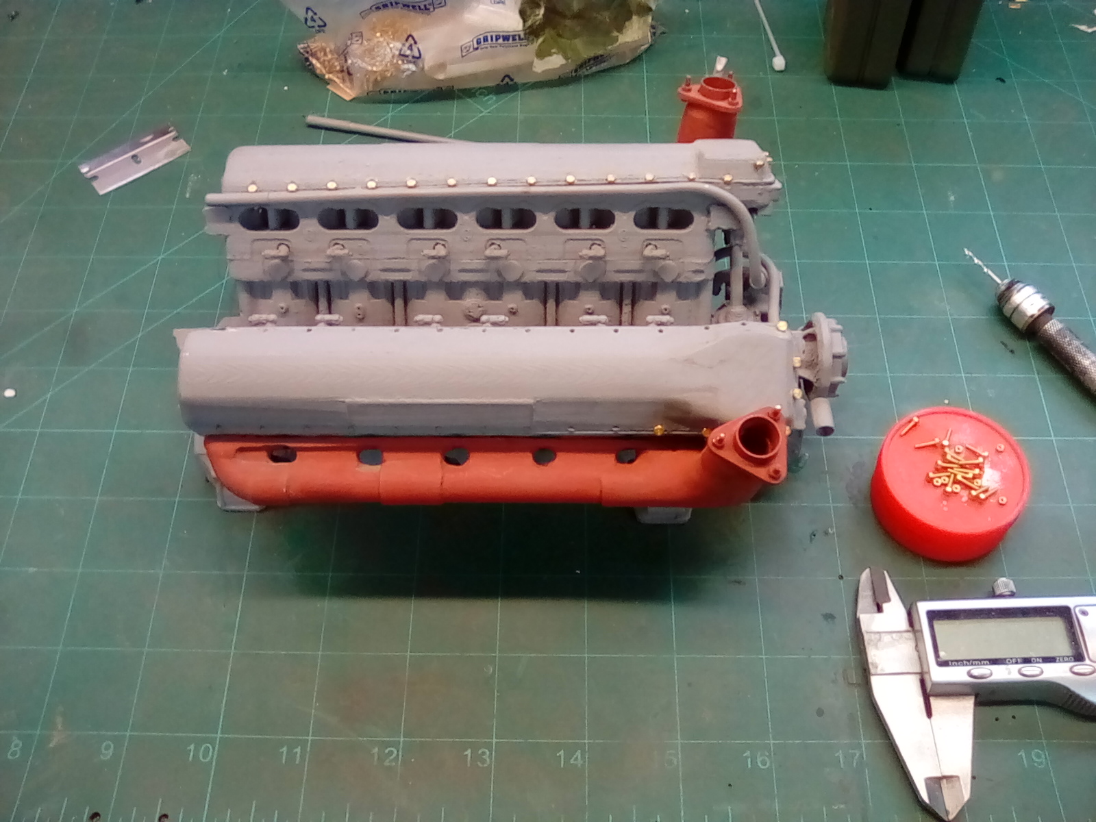

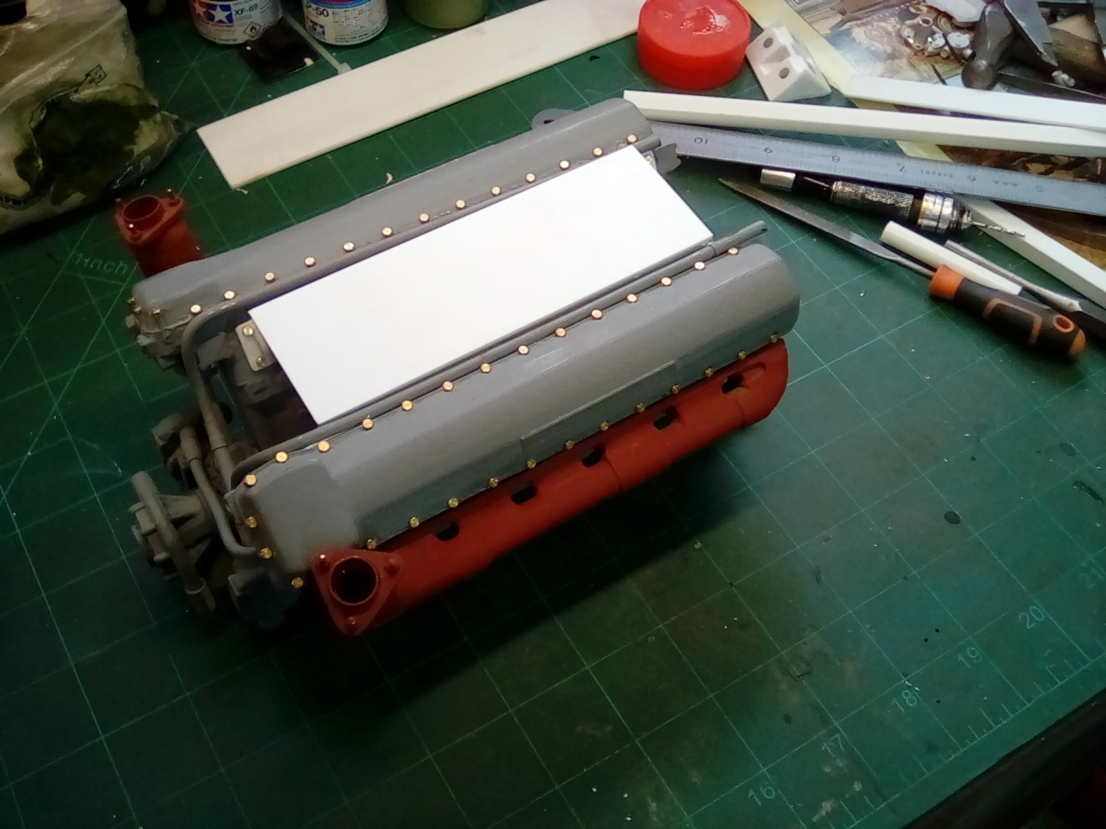

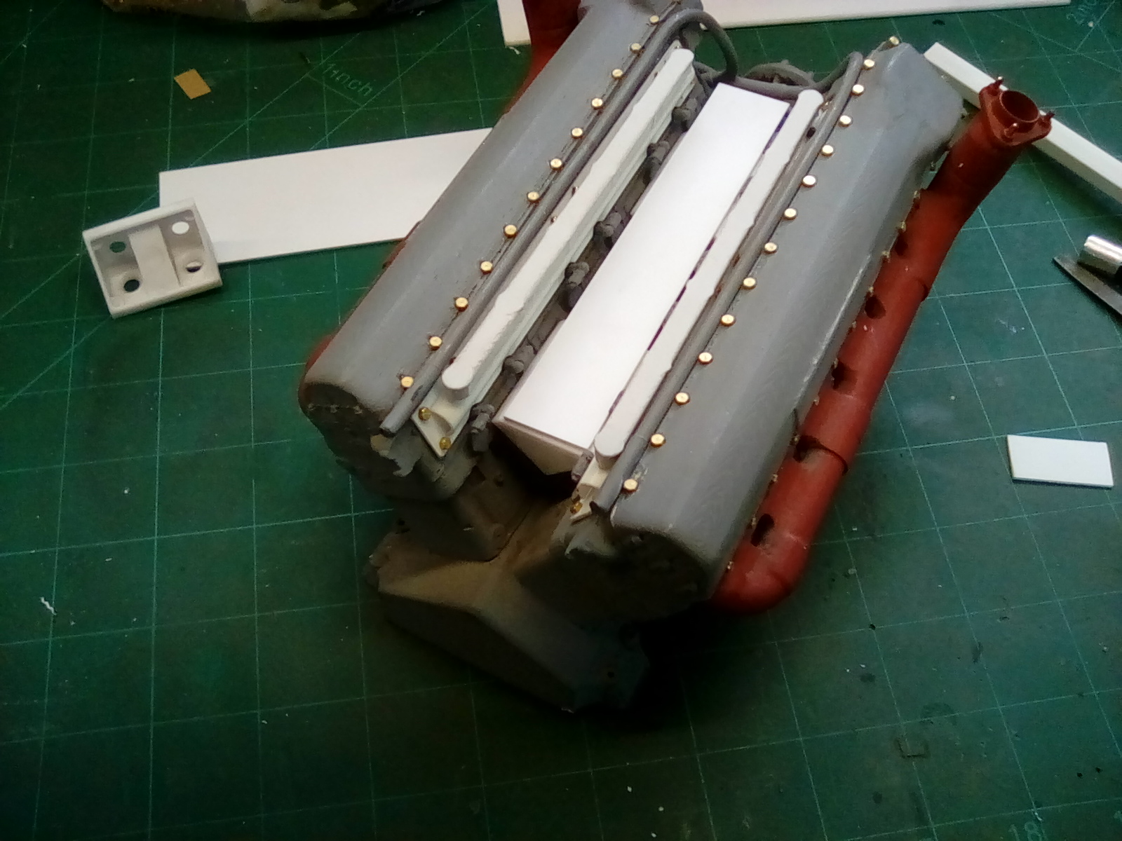

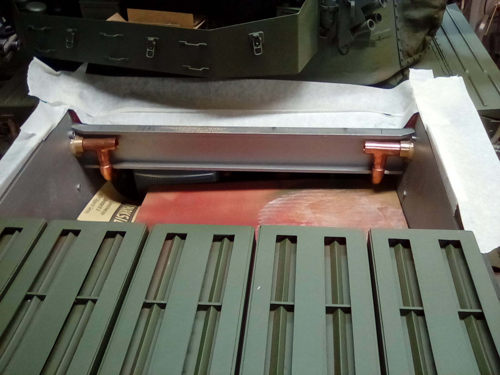

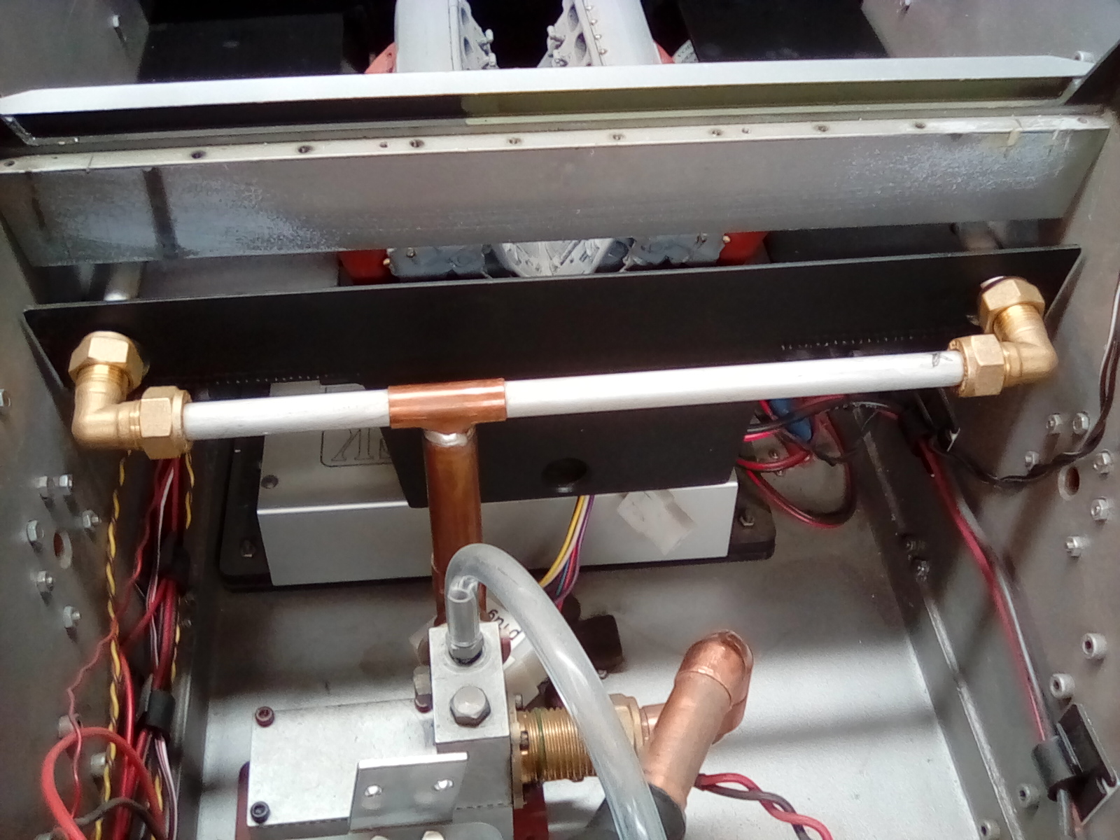

I've used compression couplings where I can

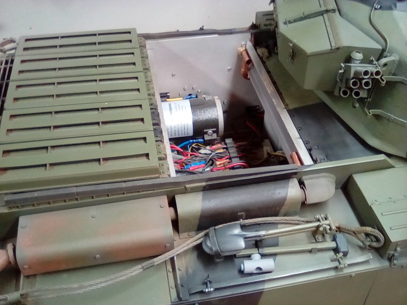

All this must be demountable

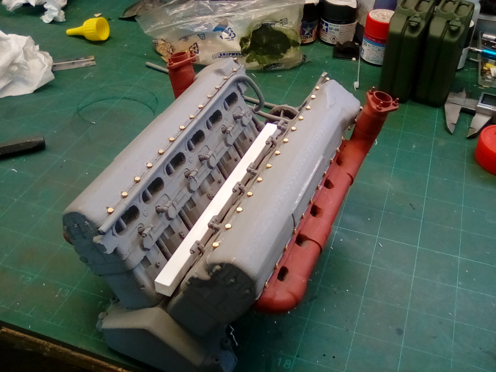

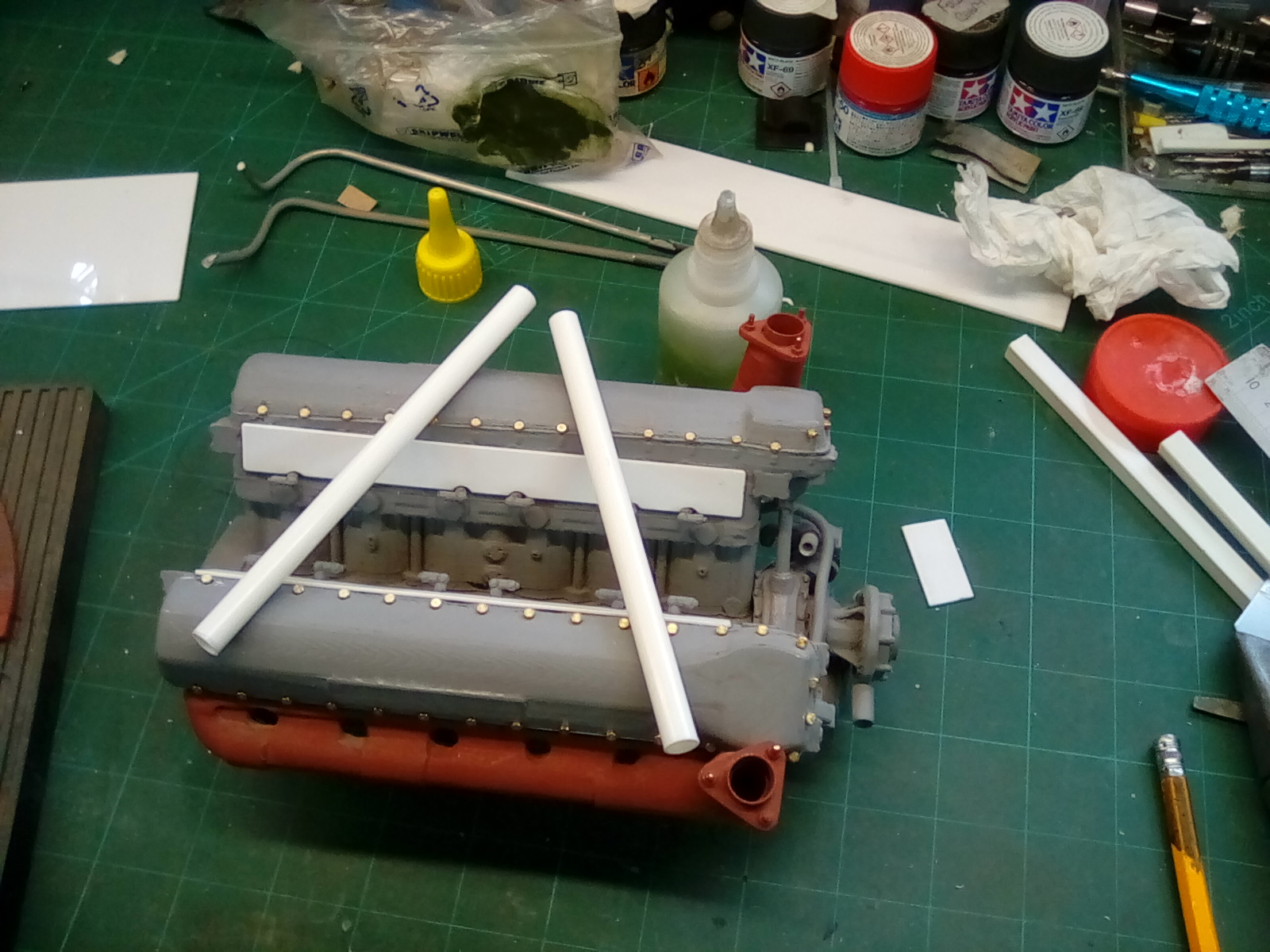

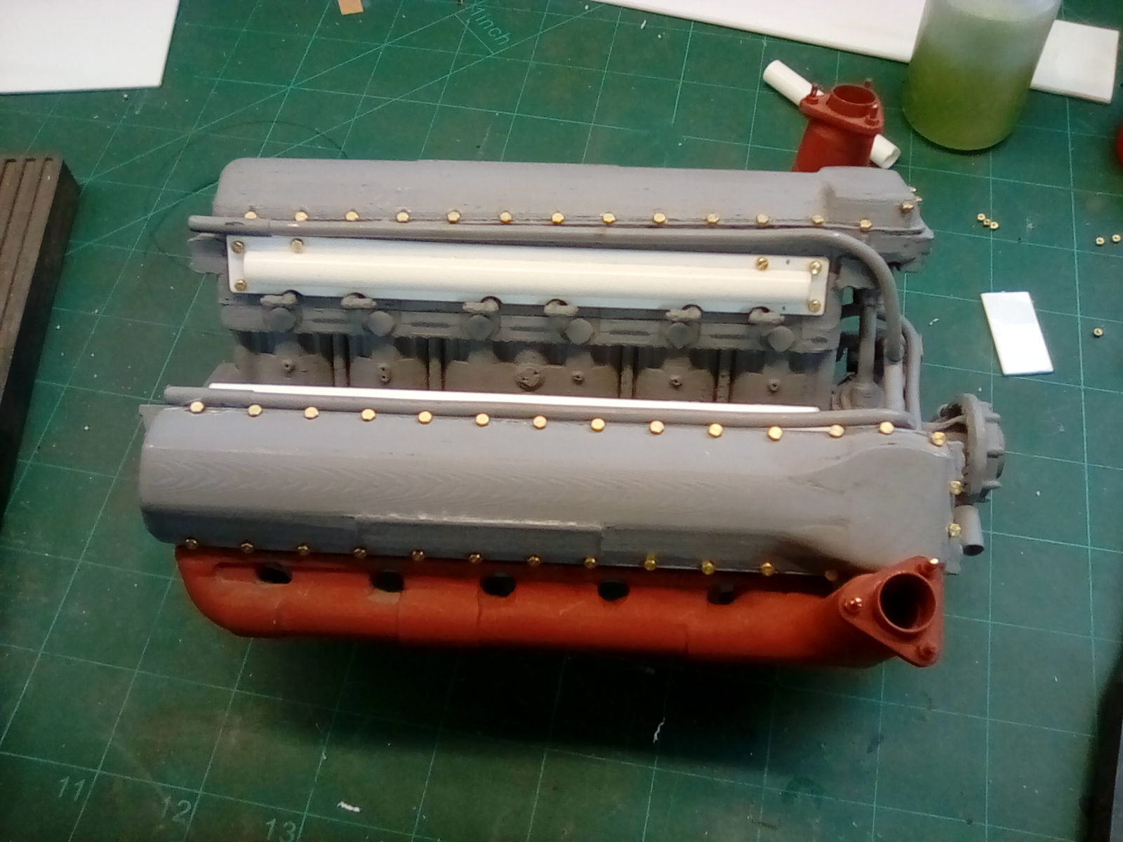

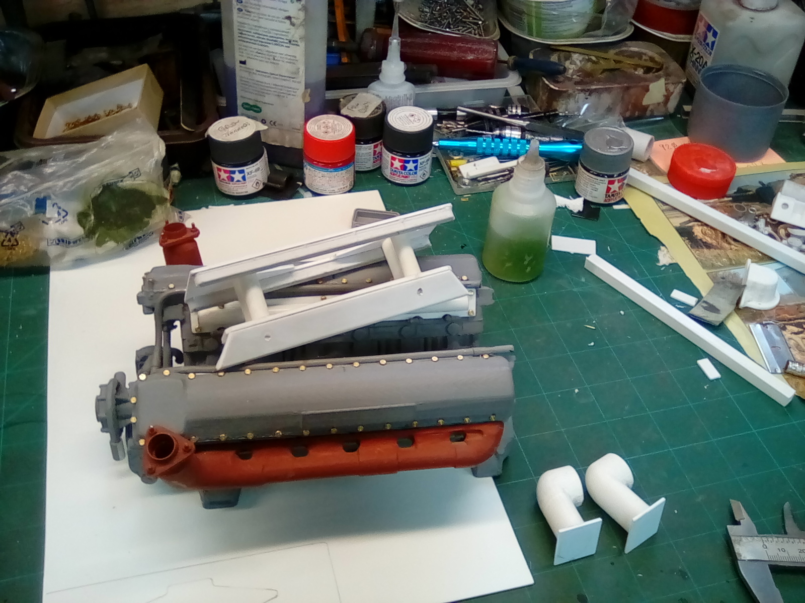

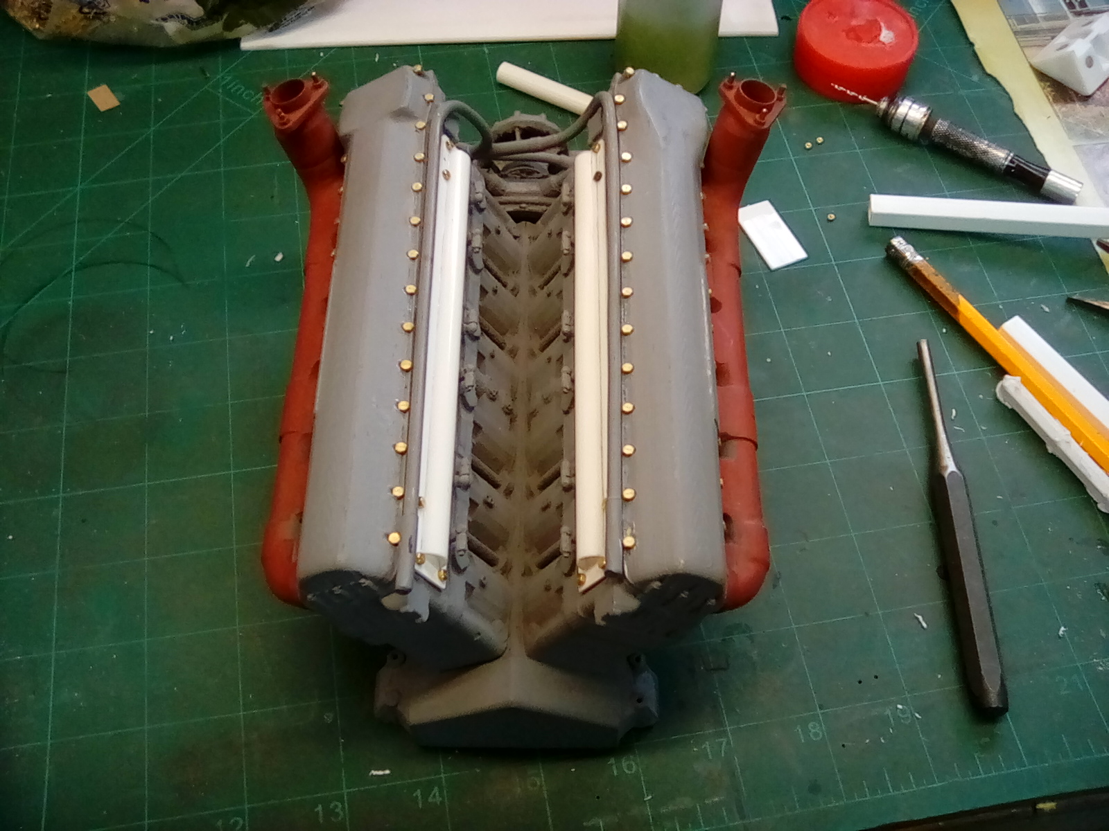

Everything that sits above the rocker covers must be demountable, the same as what I did in the chieftain engine bay

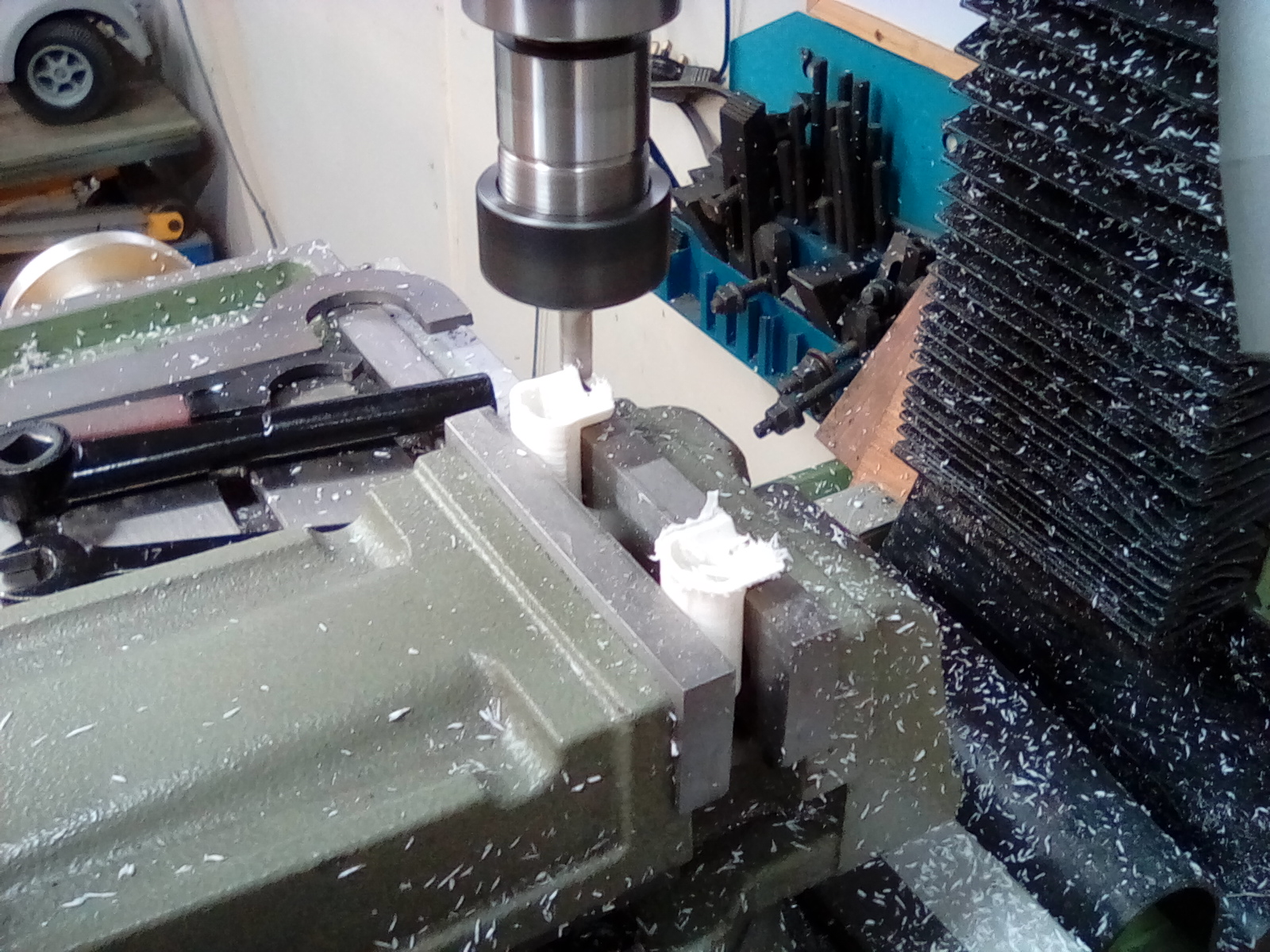

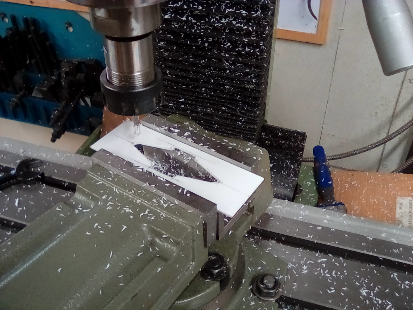

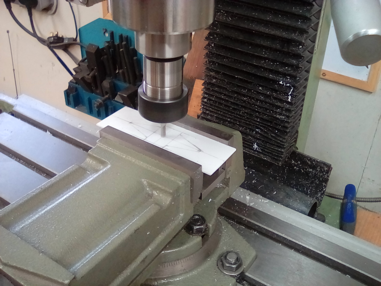

Pin drilling
Pin drilling
All the rocker cover bolts now added

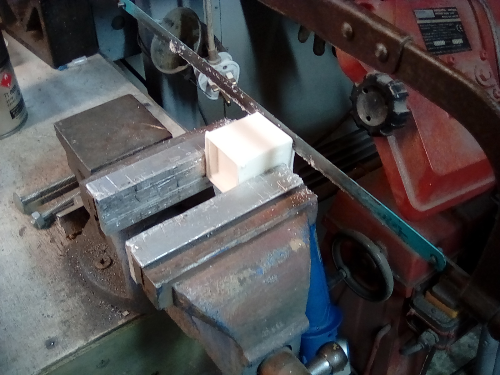

It's just a matter of patience and lots of imagination to create the various parts from scratch

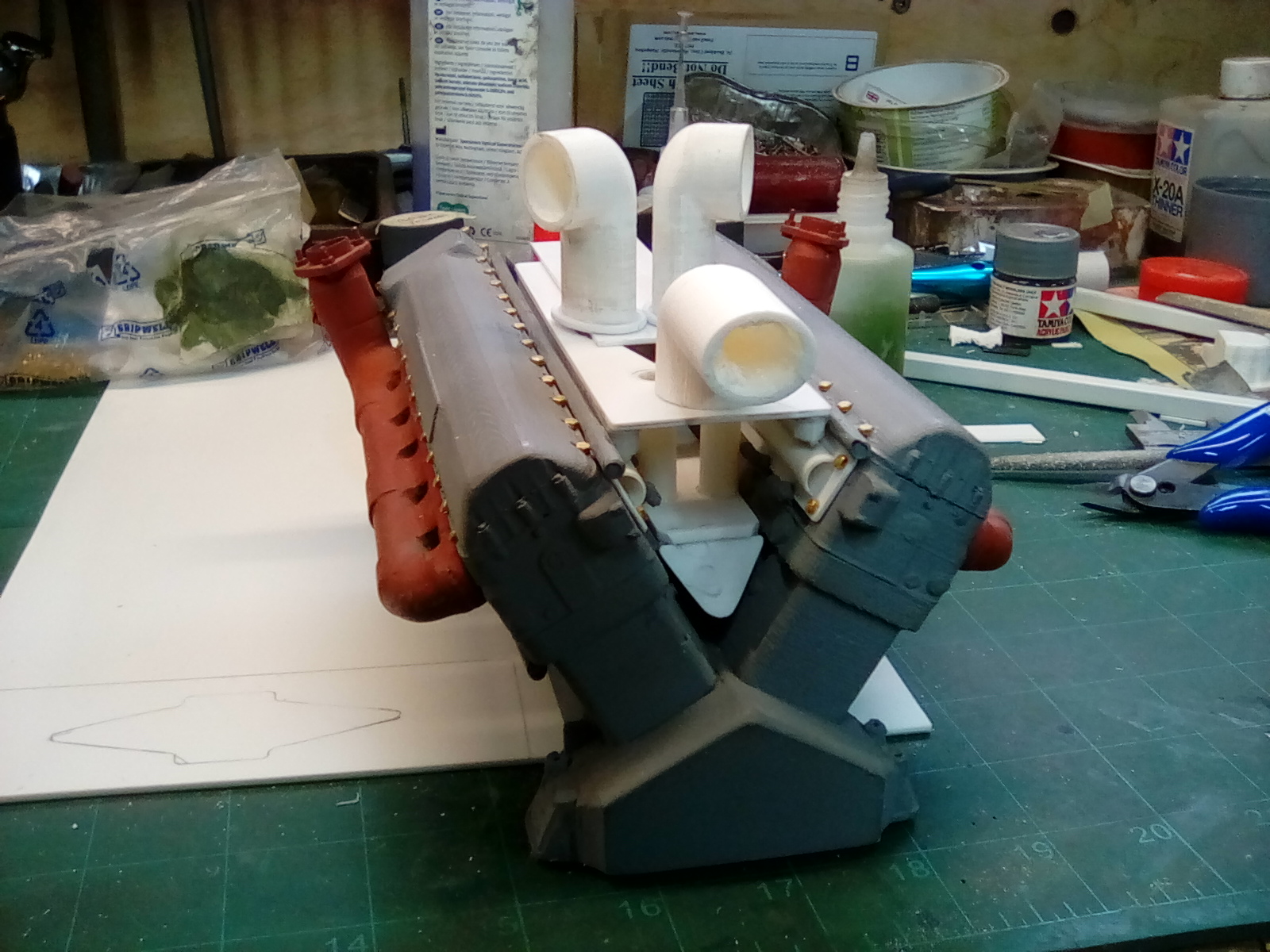

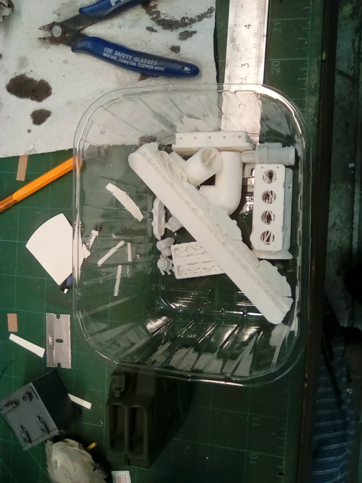

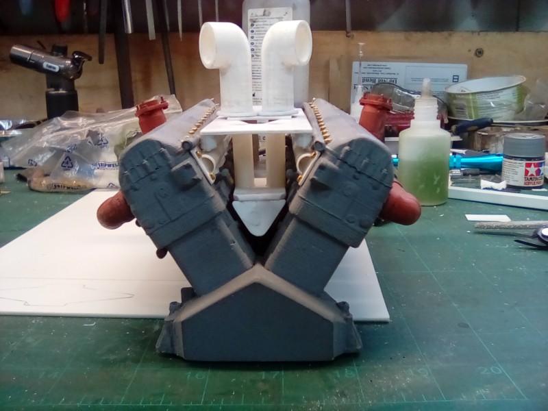

Induction manifolds stating to take shape
Modifying  the 3d printed parts till they fit.
The lower triangular carburetor manifold can just about be seen if you look hard enough, so it needs a reasonable amount of detail.
Checking the fit before I start cutting out, these elbows have been modified in cura to give me the elliptical bases that bolt to the manifold, without that mod they would not have the desired look, I may need to increase that mod a little more.

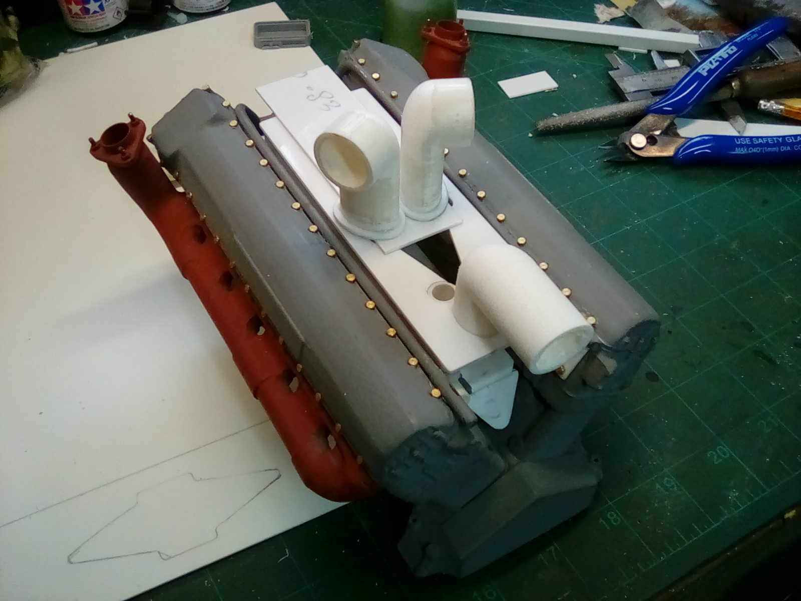

Posts: 4268

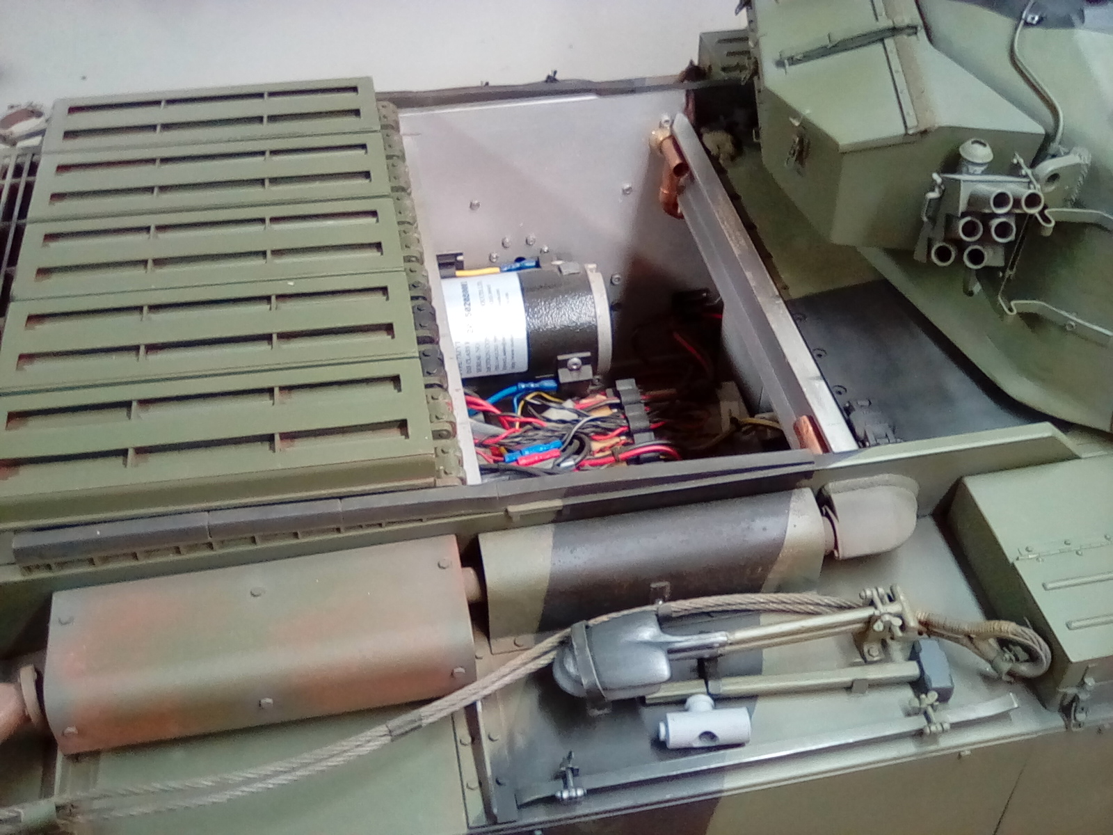

Moving on with the fuel/air inlet side of the engine
Following the lines and numbers, this is just the base I have another two layers on top of this piece

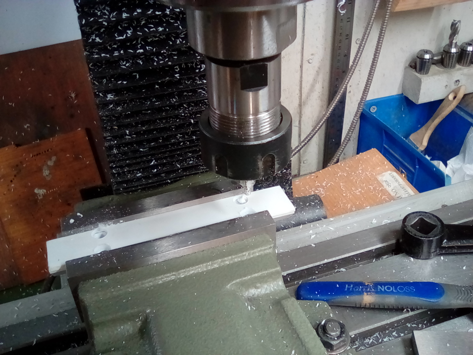

Have mill will use it
Tricky little devil this manifold

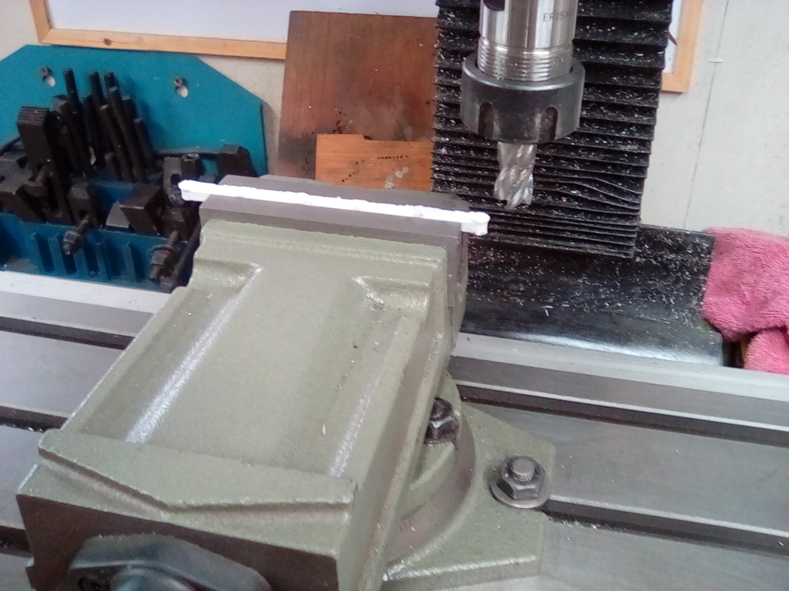

Always milling parts
Now do I make the Carburetors, can they be seen
