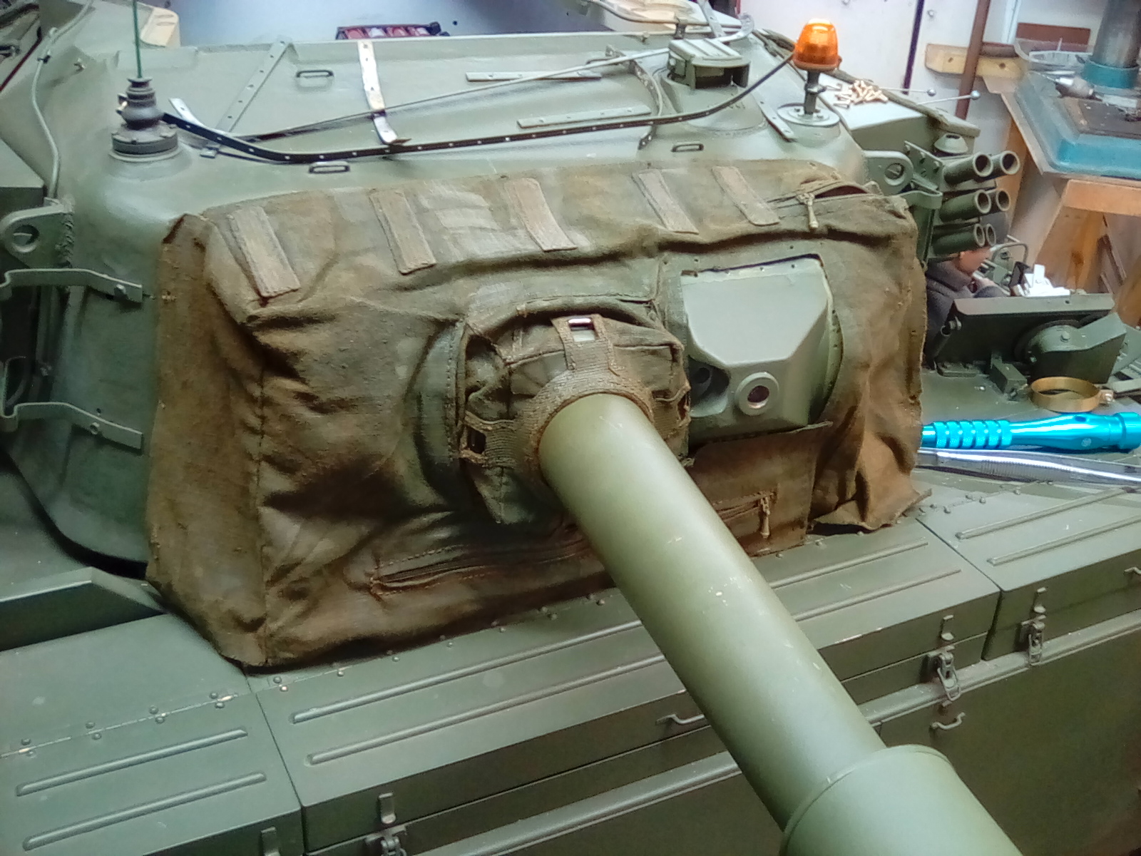

Mr Dawe's Centurion.

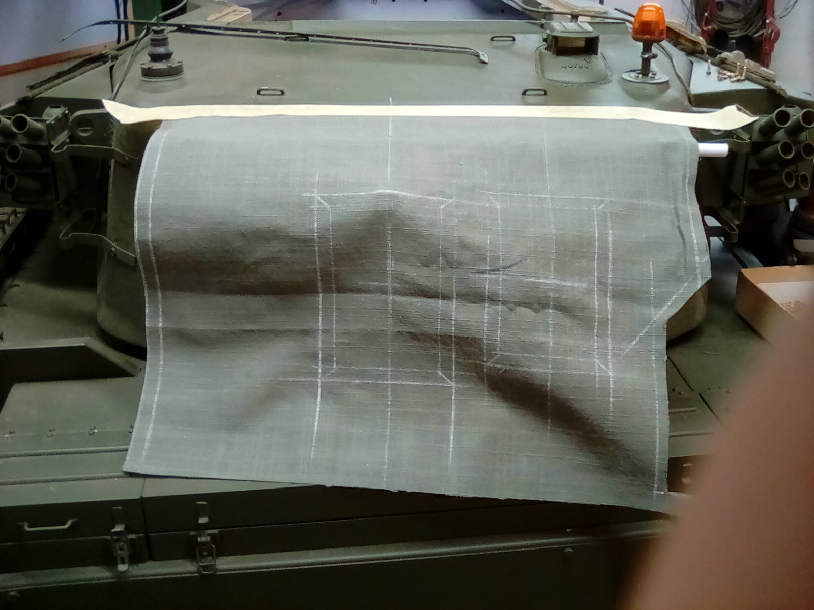

Cheers Simon. Got a fiddly 3 hrs sowing in this morning, this is going to take some head scratching.

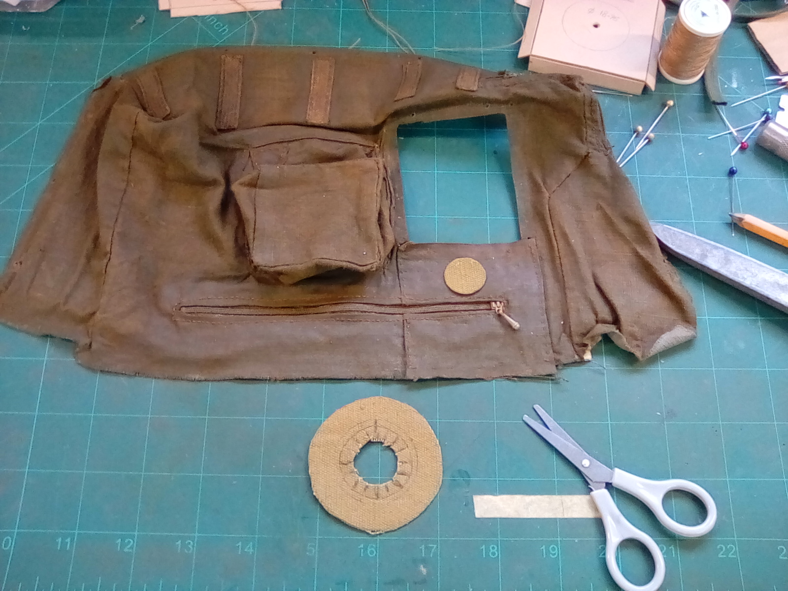

The cutting mat helps with the setting out
I'm not going to cut the openings out until I'm happy with the top, the sides and the bottom fit
I'm using masking tape more than I'm using pins!

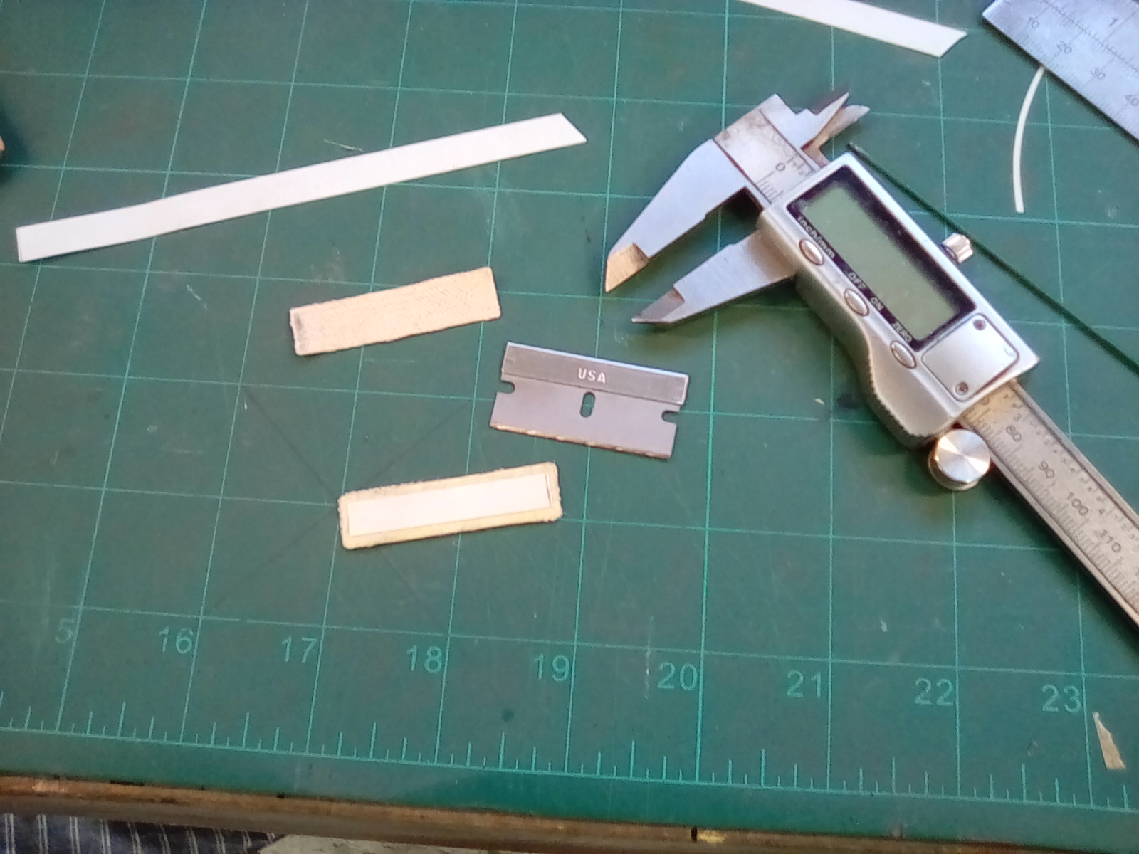

That's 2 mm stitch spacing

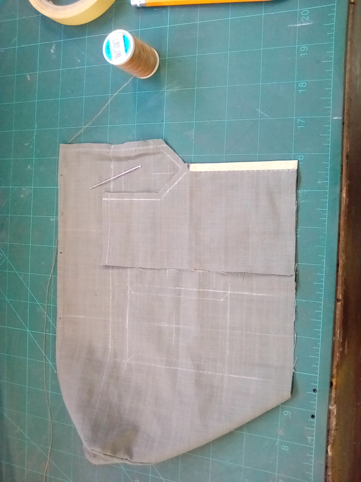

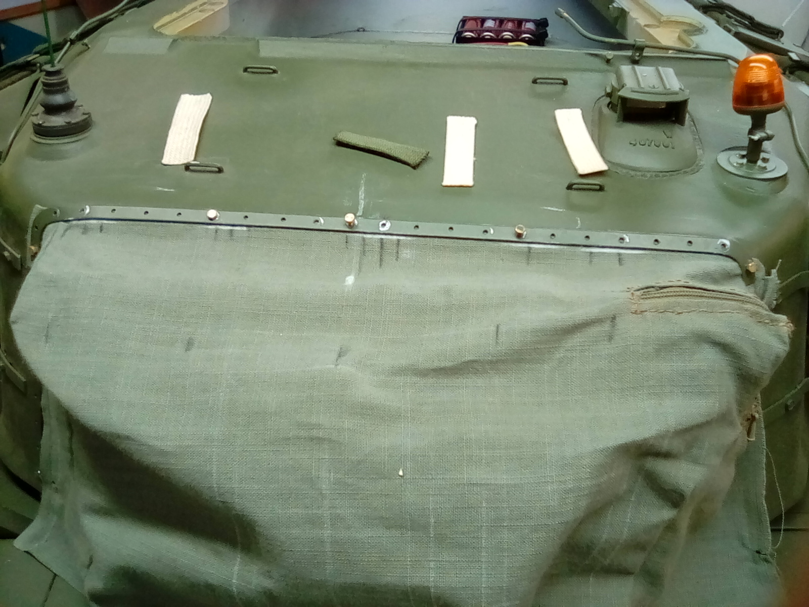

This side piece is going to be tricky

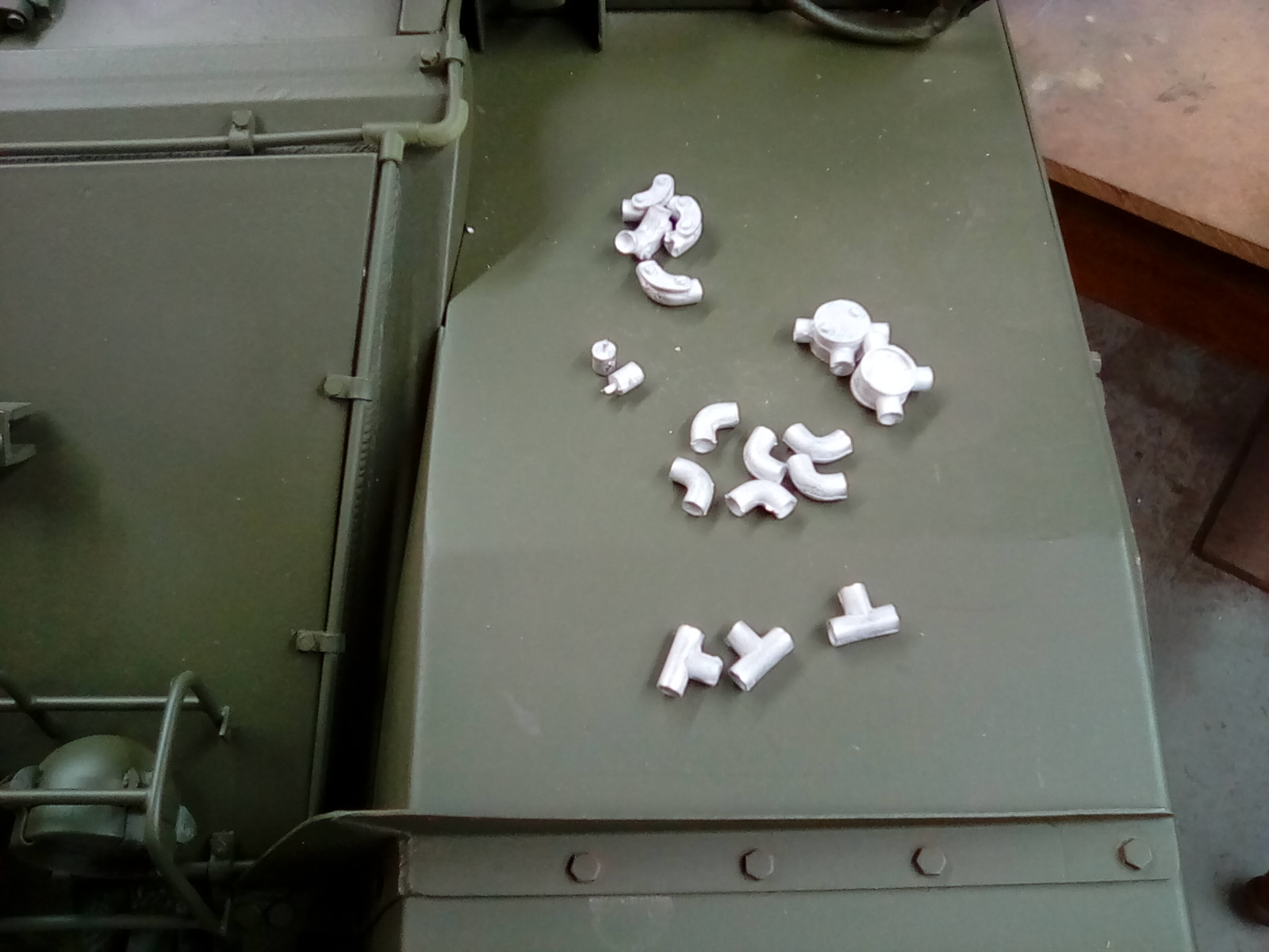

The metal conduit fittings have arrived.

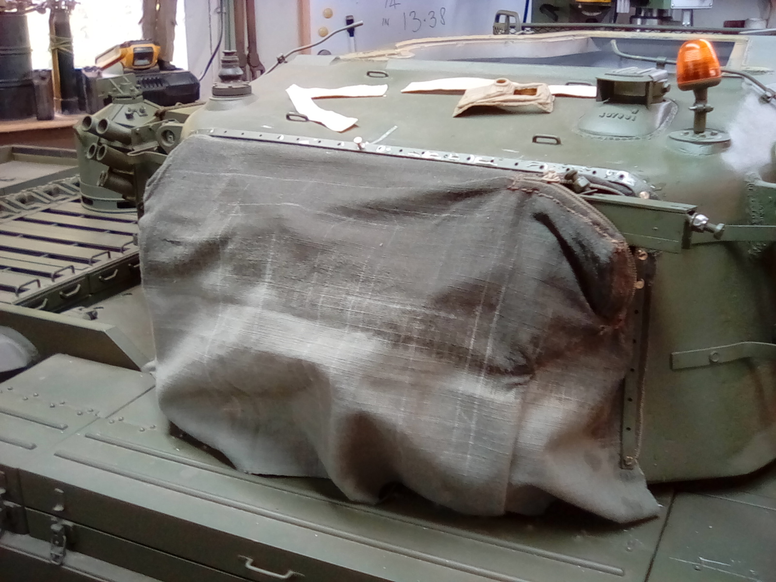

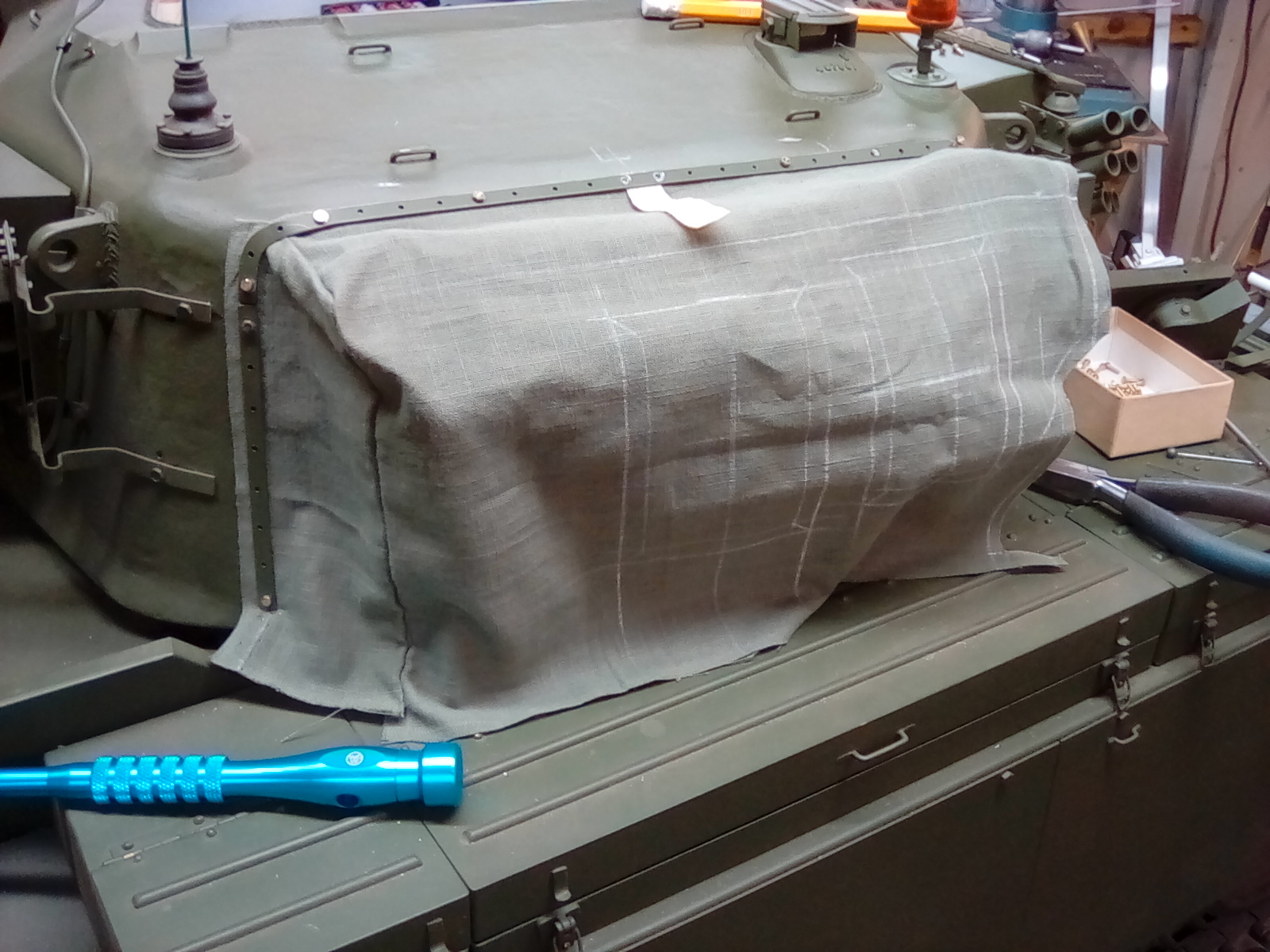

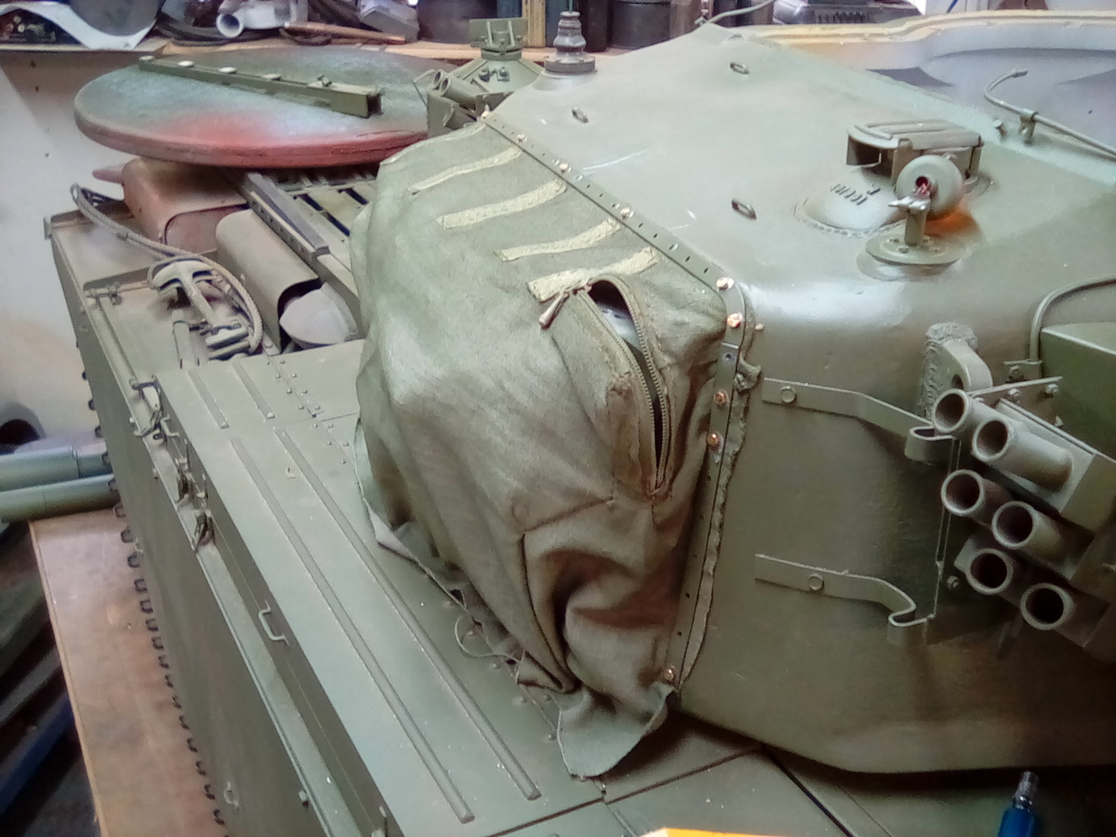

The tricky side is now sewen in , that's the side that has the opening for the searchlight bracket, when I'm feeling brave I will cut the slot.
I'm not sure about it just yet but no doubt it will look ok

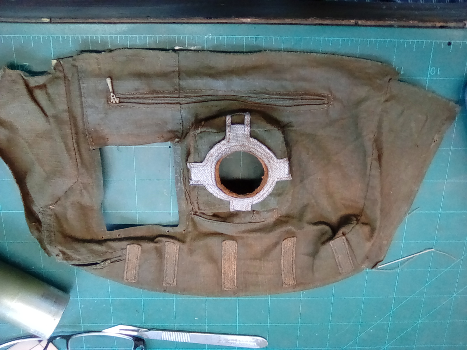

Re: Mr Dawe's Centurion.
Been stitching and don't mind saying it's a difficult job one of the most awkward and complex I've ever made in woven material.
I'm off topping a couple of fields now as it's still cool on this Sunday morning.
A welcome break from stitching  duties

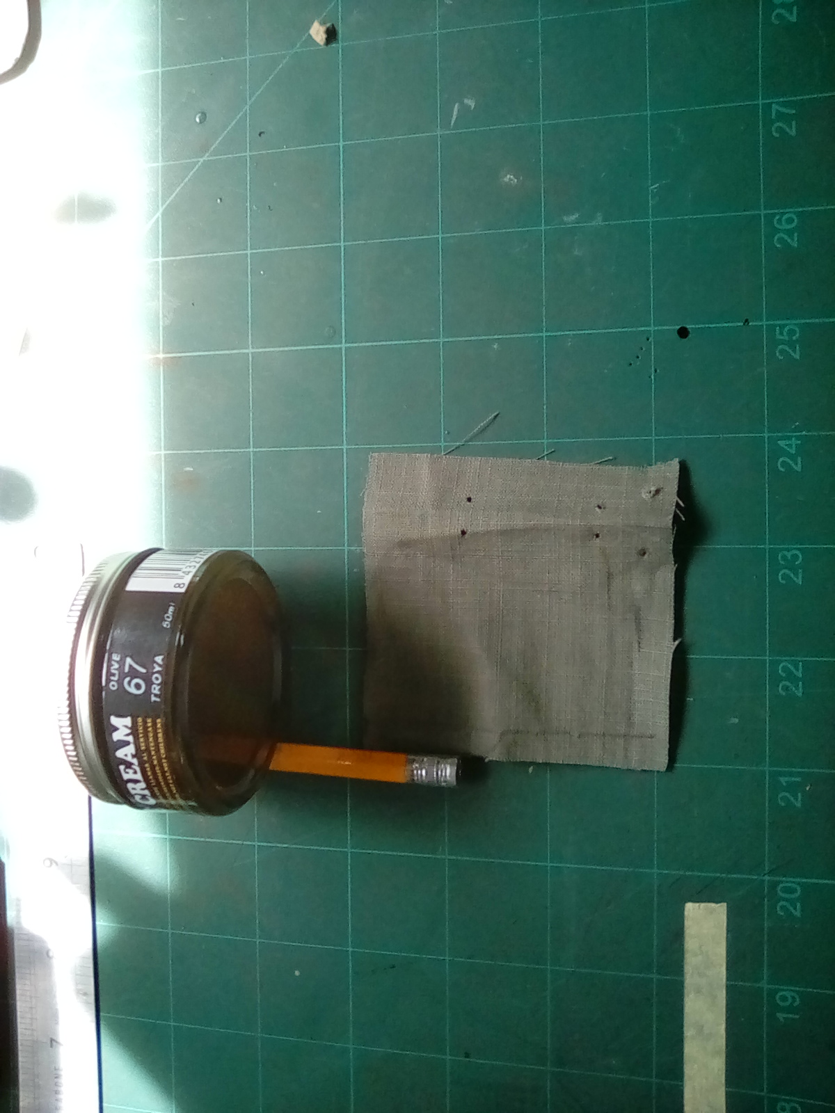

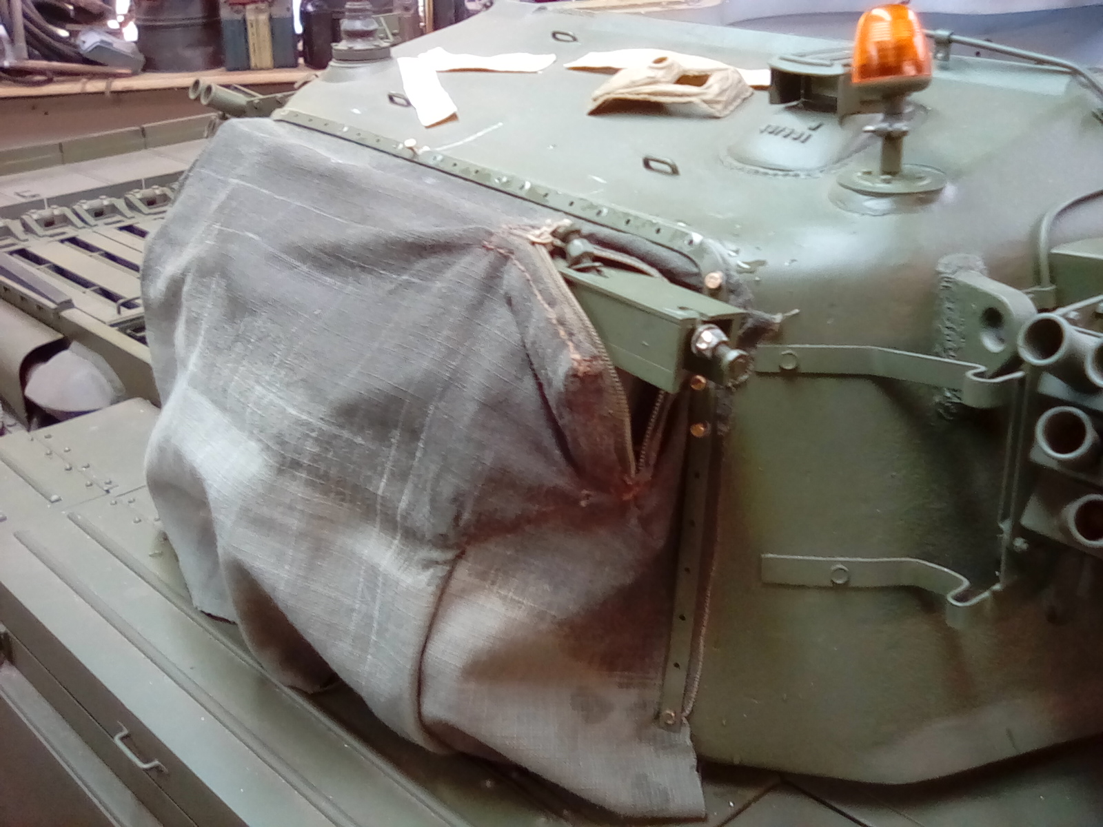

A splash of water softens the material and allows it to sag just like the example I'm using as reference.

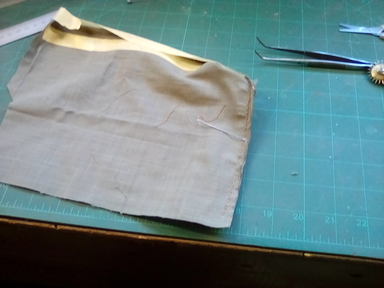

It's a two pairs of specs job , the stiches are as small as I can make them and continuous with no gaps
I'm very aware that the winky pot is at an angle, it's just pushed into place for now, it will need stowing for transportation.
I was very concerned that the zip was totally ( auto correct used the word "tiffany" in stead of totally) functional and it is but once it's all mounted and the searchlight bracket and holding strip are bolted in place the zipper can never open or close fully again.

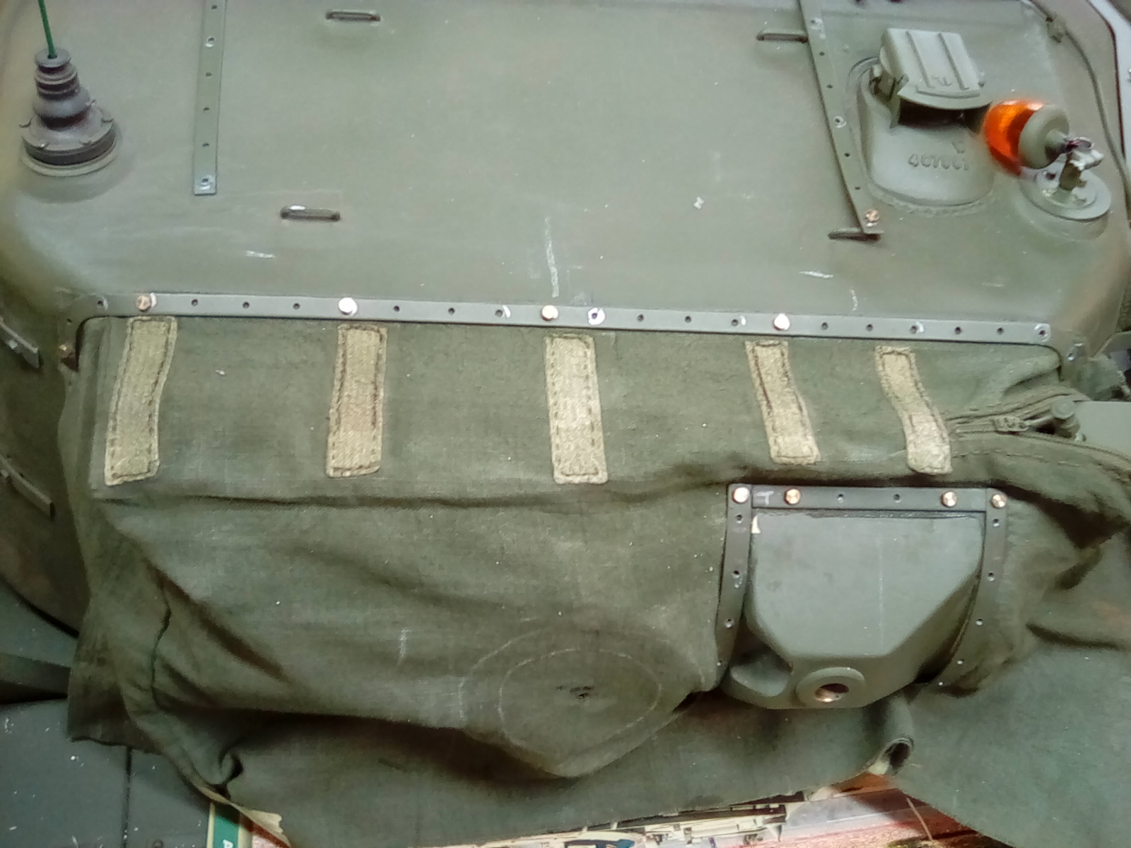

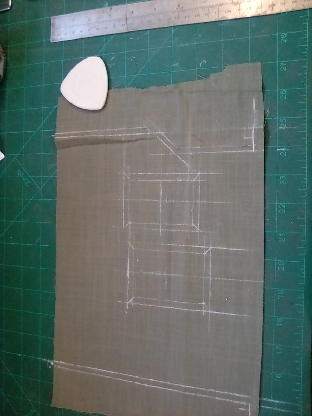

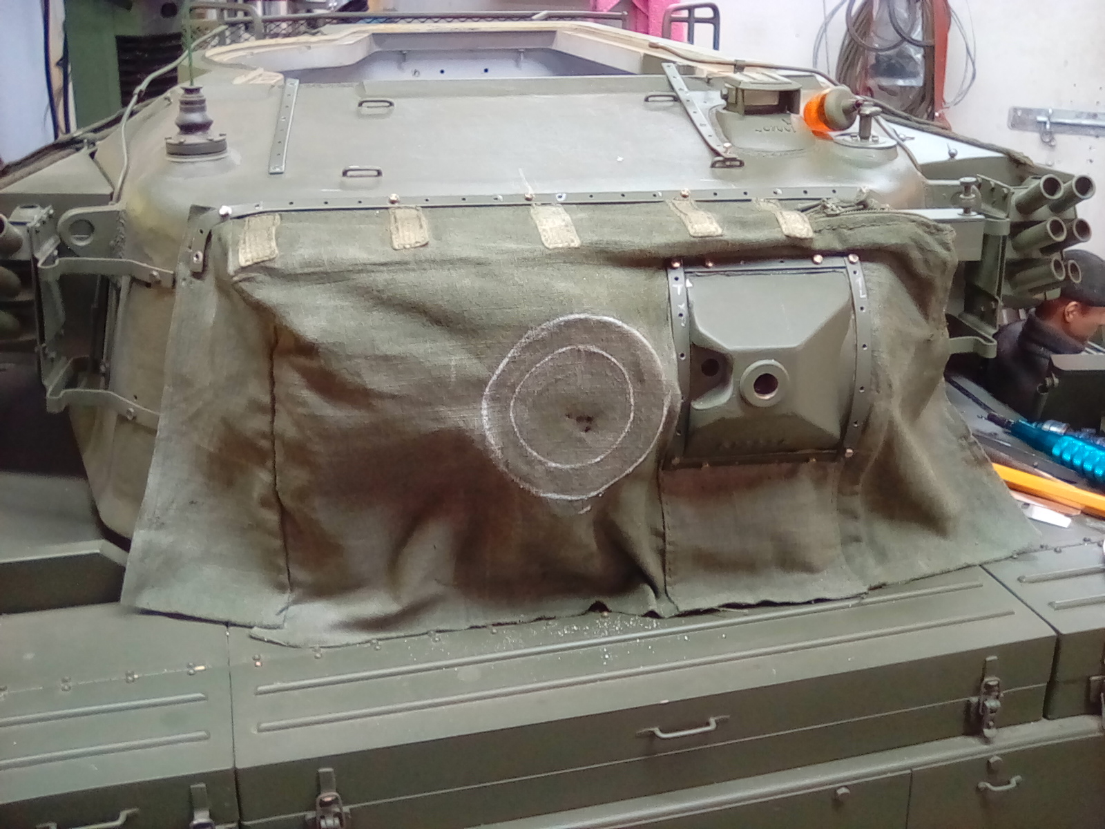

Stitching the top section stiffeners
Marking out
Marking out
Stiffeners sewn in to the underside of the piece, the real thing may have used something like steel.
Tacked in place
Tacked in place

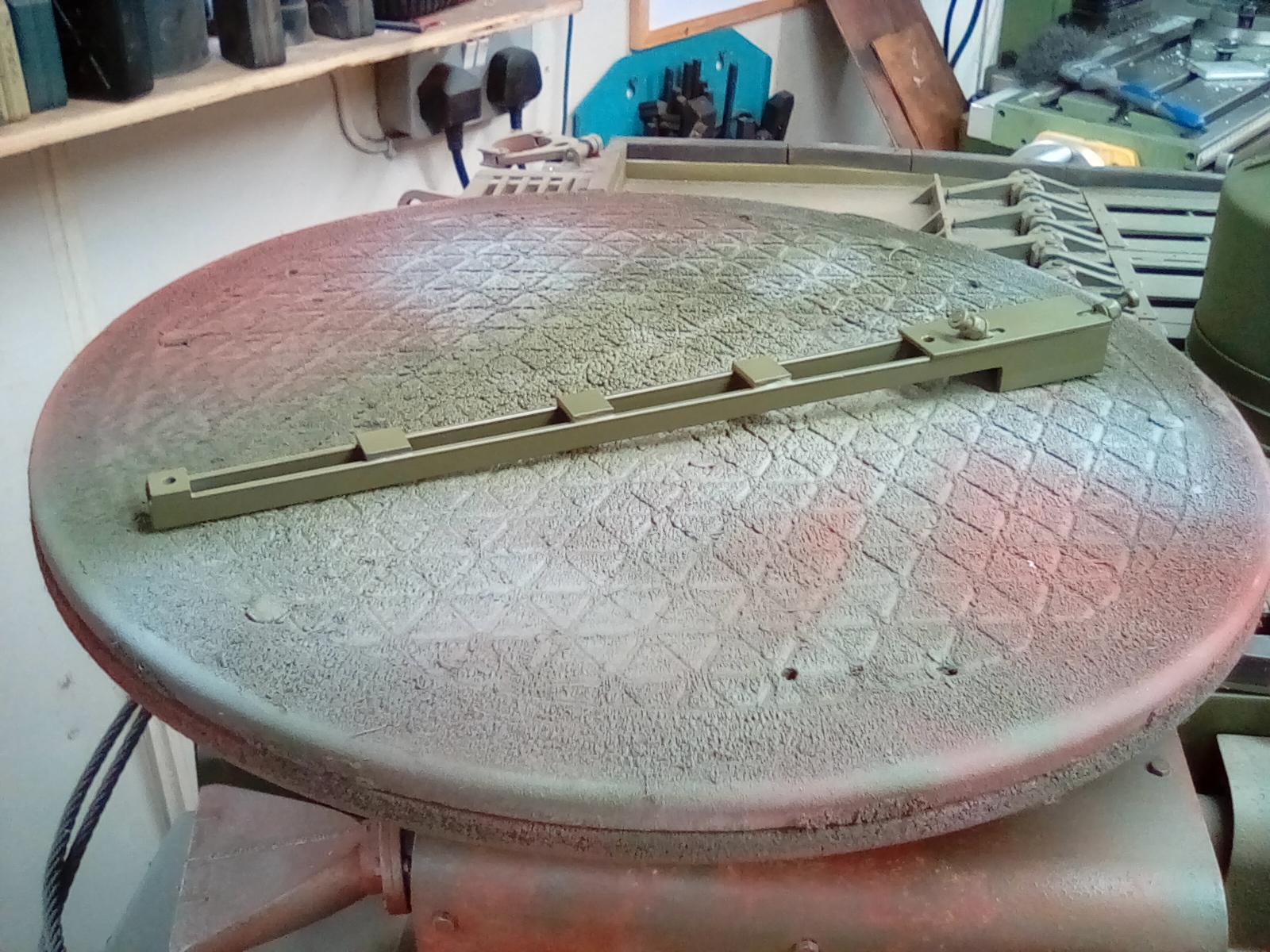

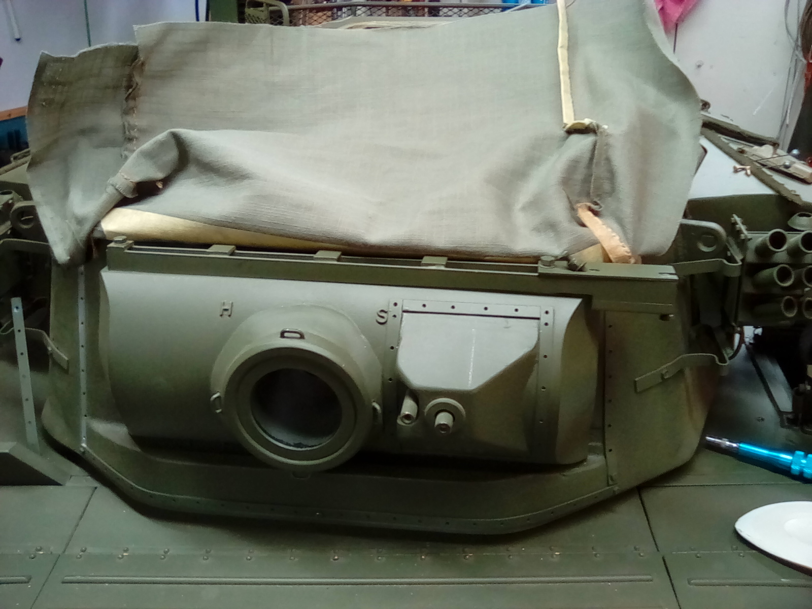

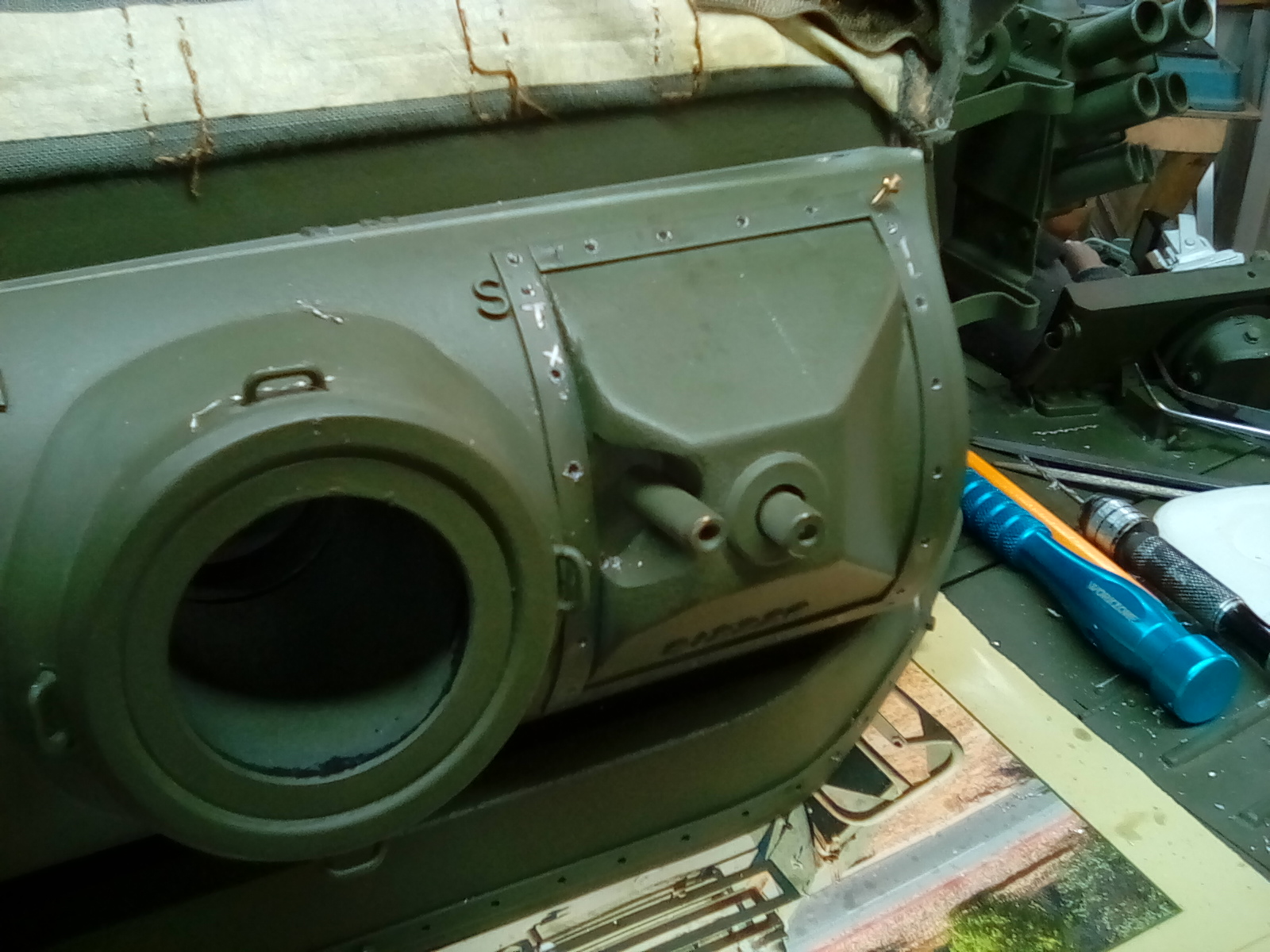

Had to mill a little of the searchlight bracket to lower it down so the mantlet cover would hang correctly

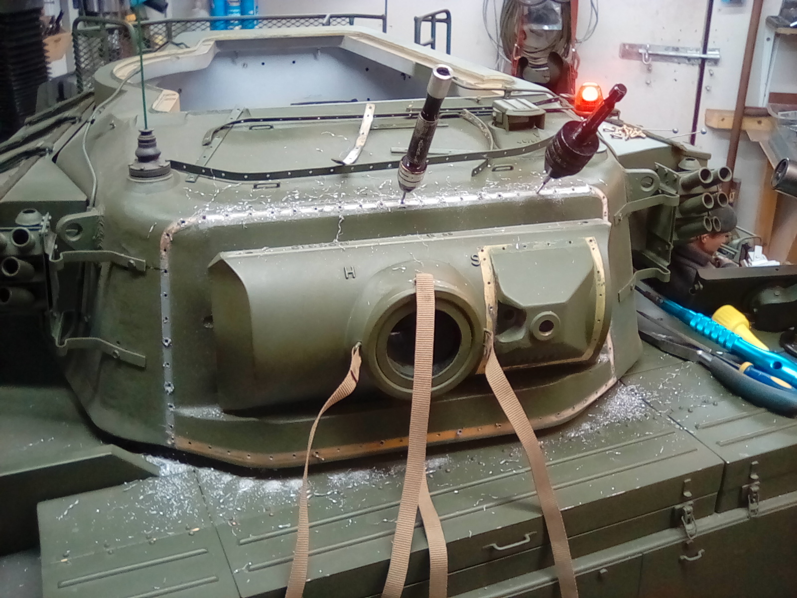

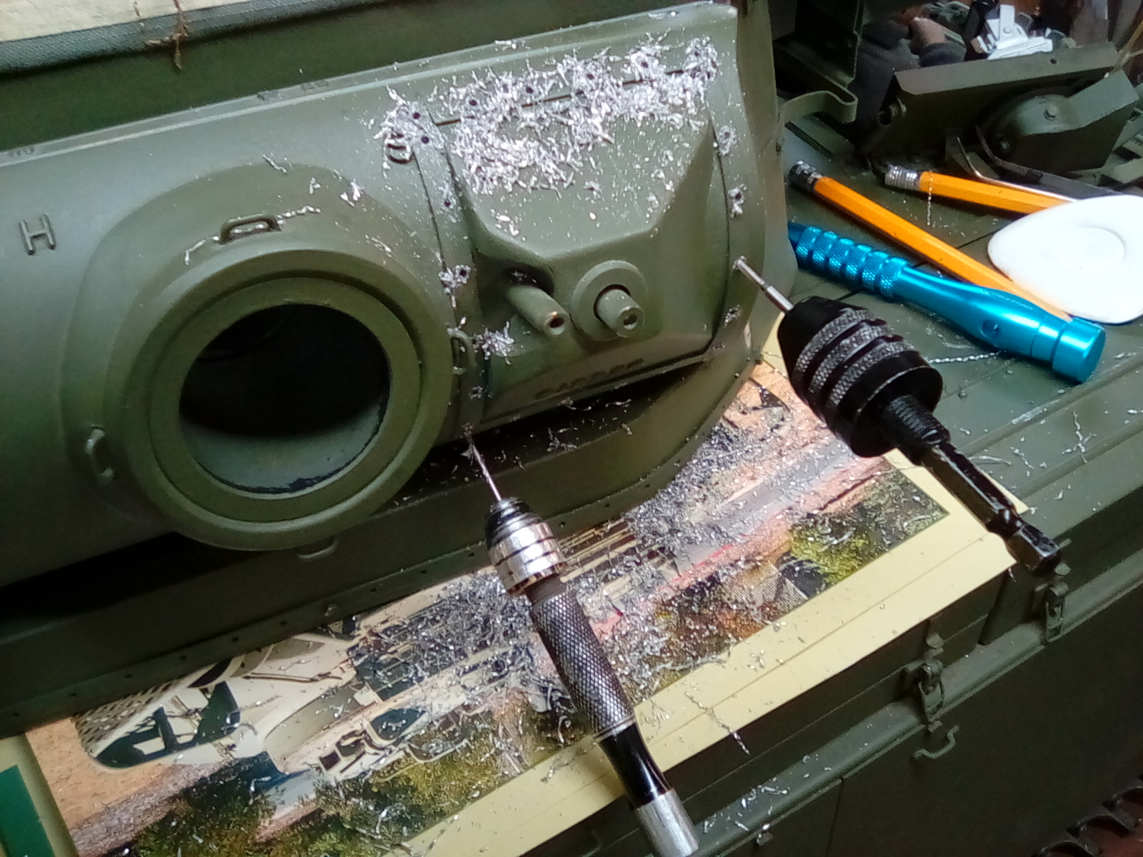

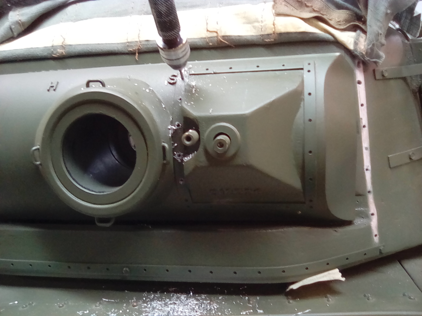

Another hole cut.

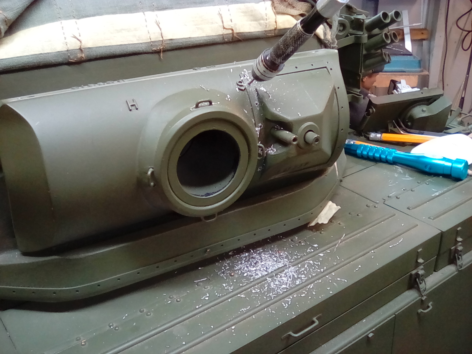

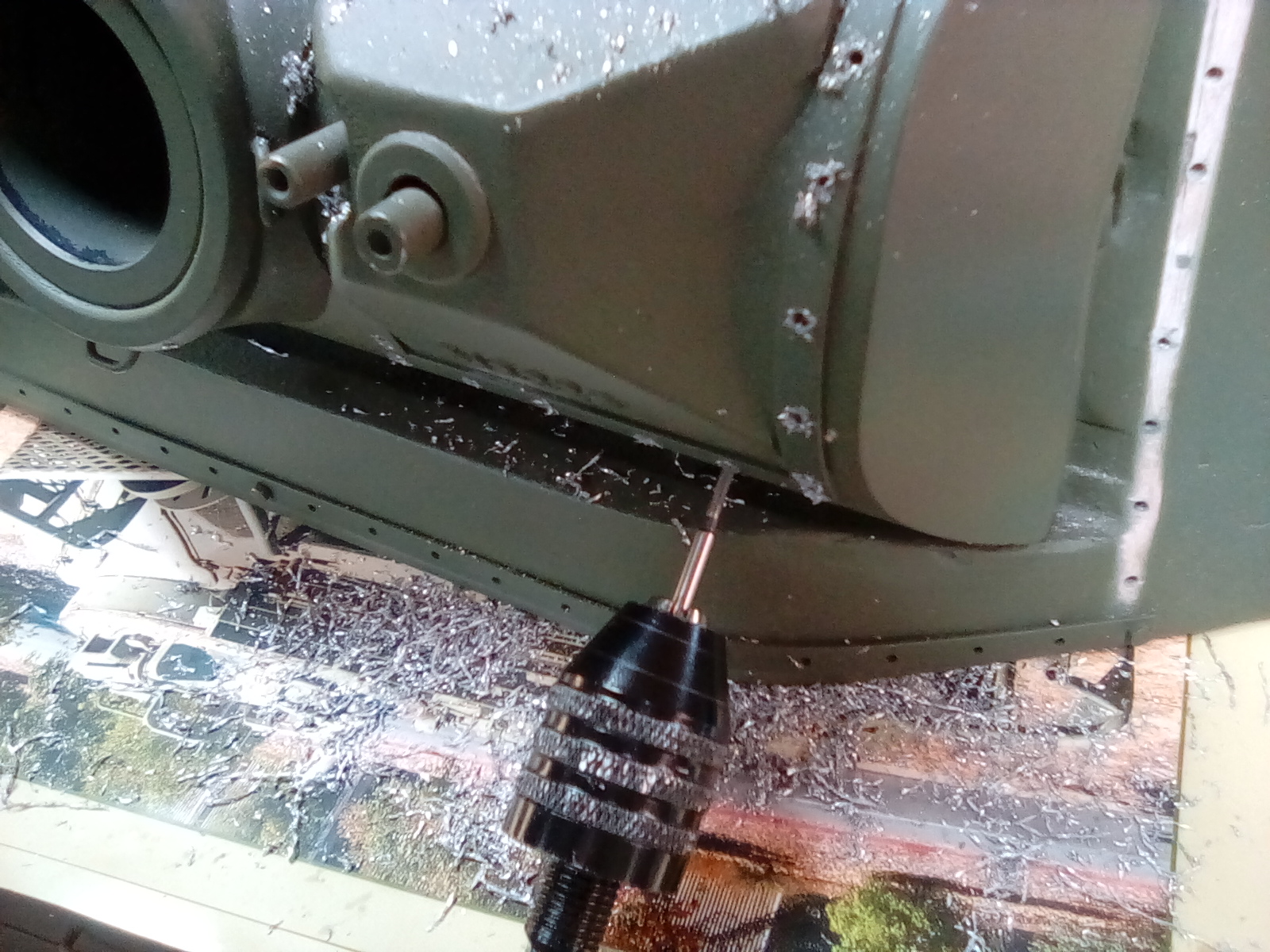

Just have to be very careful drilling this lot out
I've broken two drill bits today but the tap is fine
Really awkward
Really awkward
All drilled and tapped
I nearly cut the mg and the barrel holes out at the same time, that would have been a mistake as mounting the mg fillets really pulled the cloth over

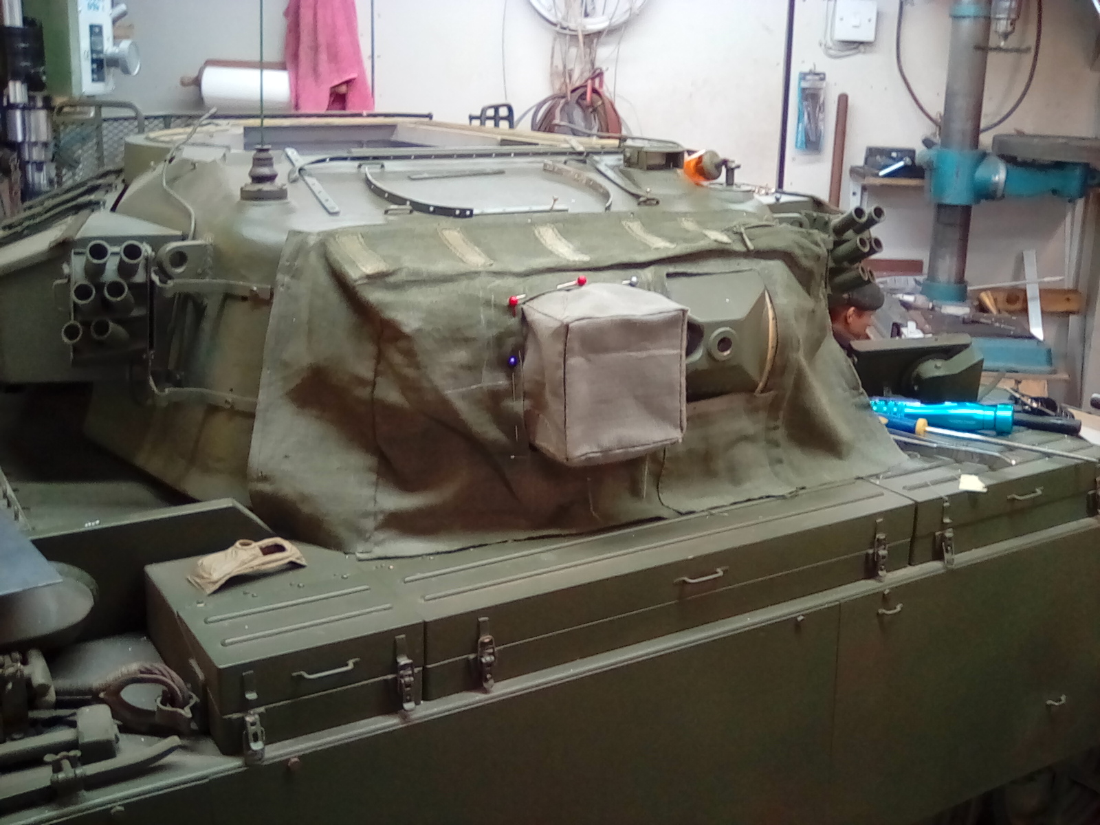

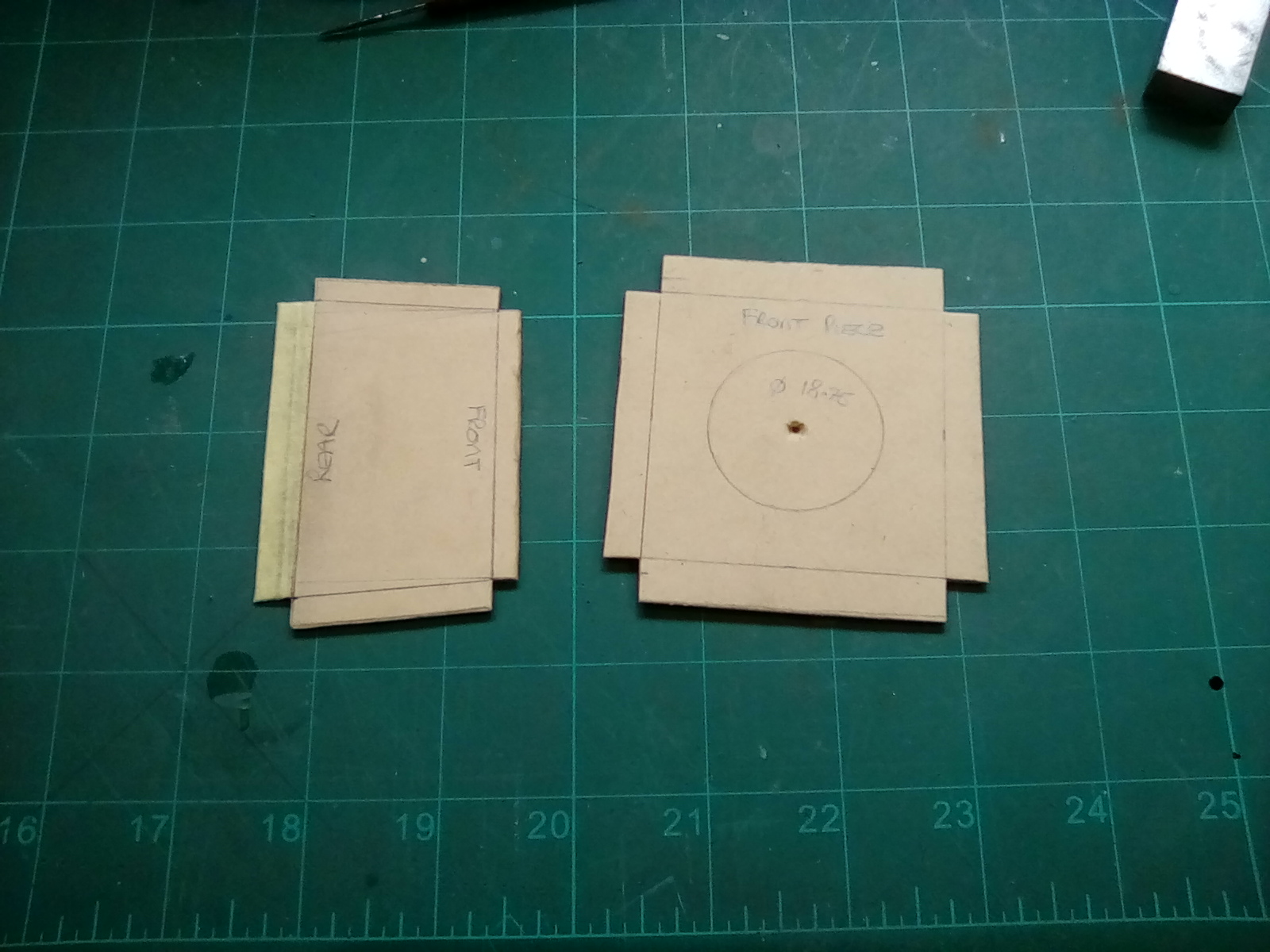

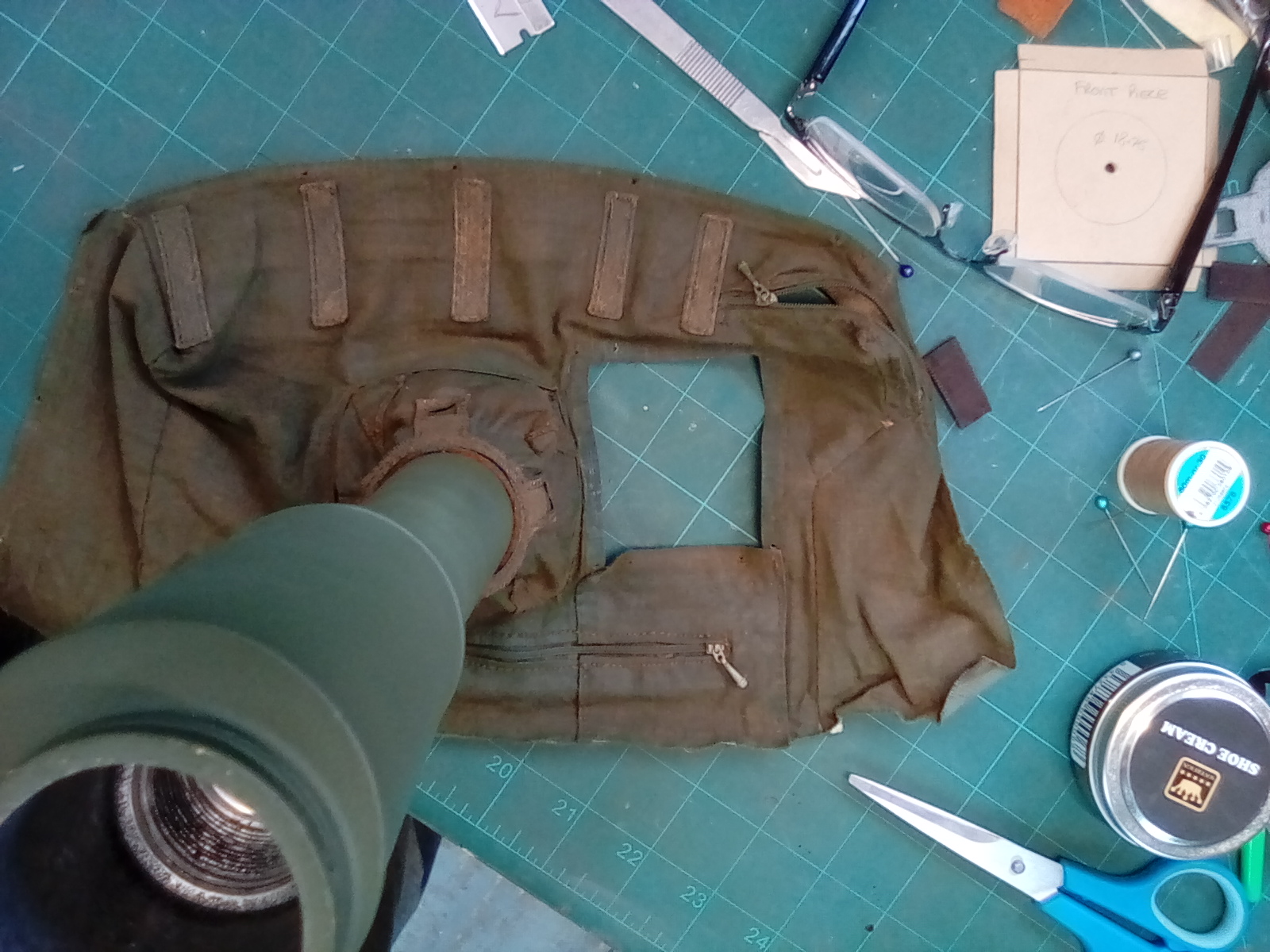

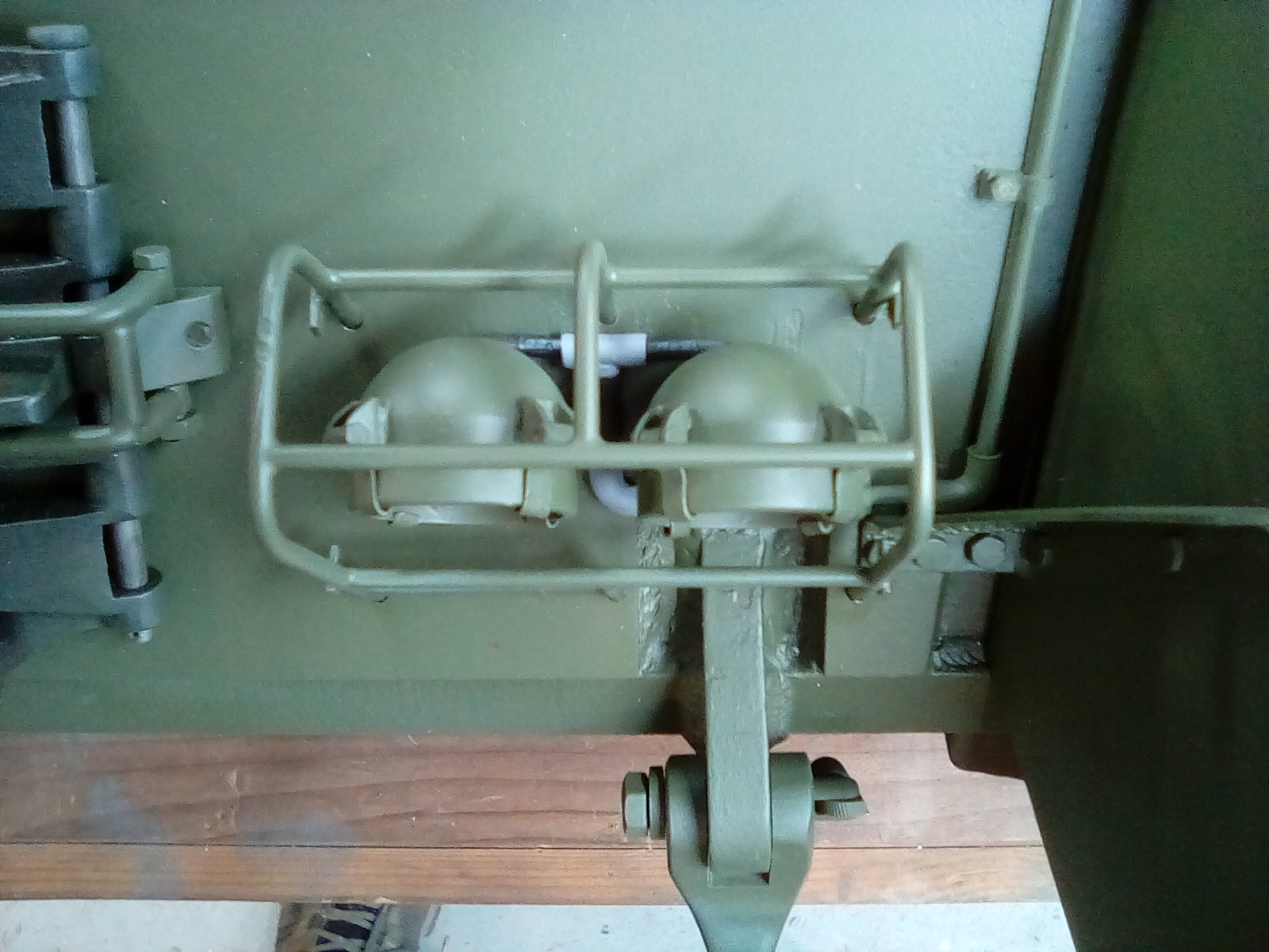

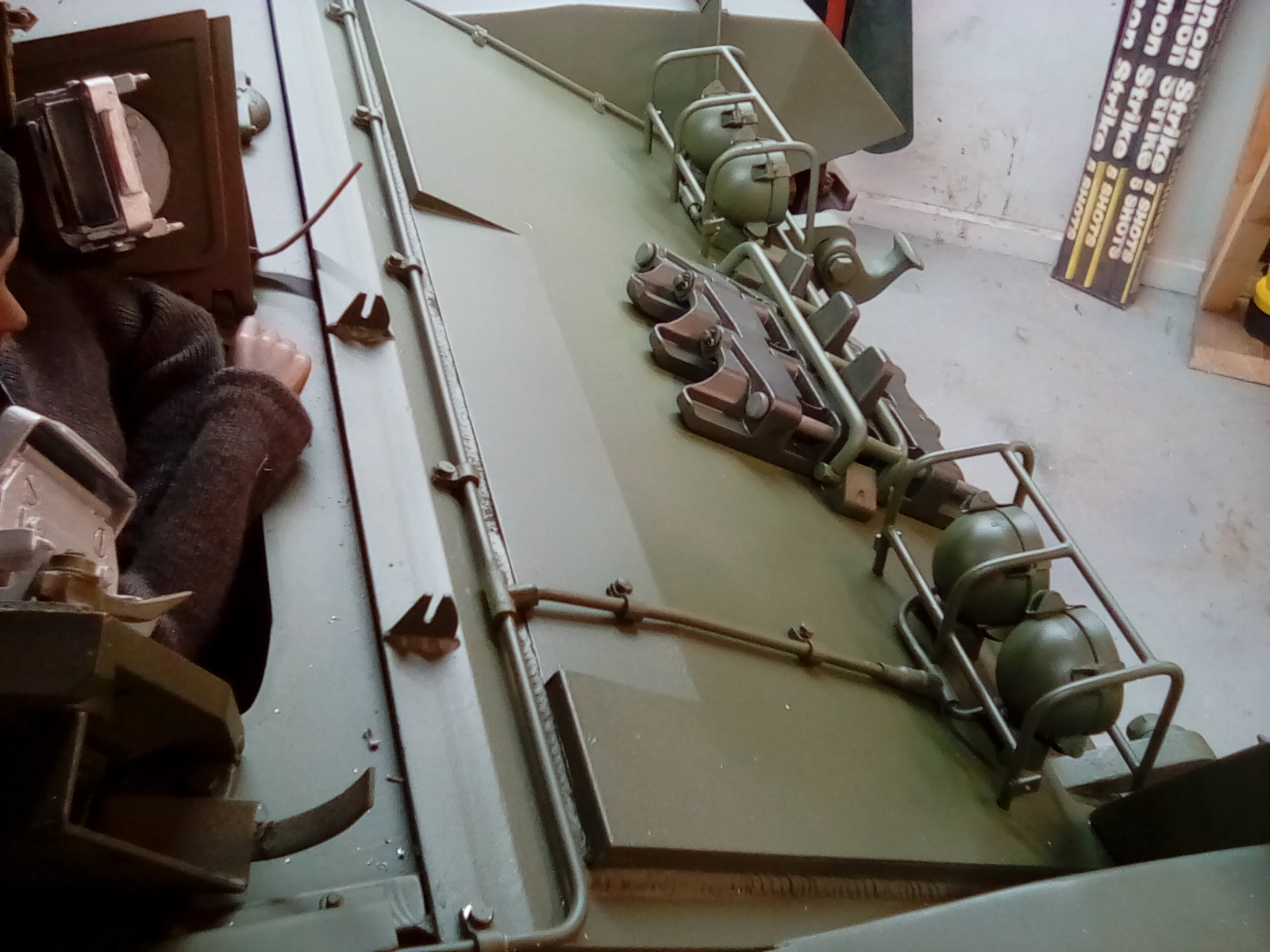

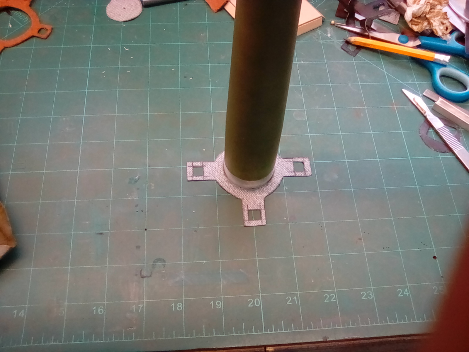

Took some dimensions from the front of the mantlet ( all guess work I hasten to add ) and made the patterns for the square to square to round front piece, also finished up the conduit to the head light bowls.
Difficult to see but all the connections are now fitted, primed and top coated

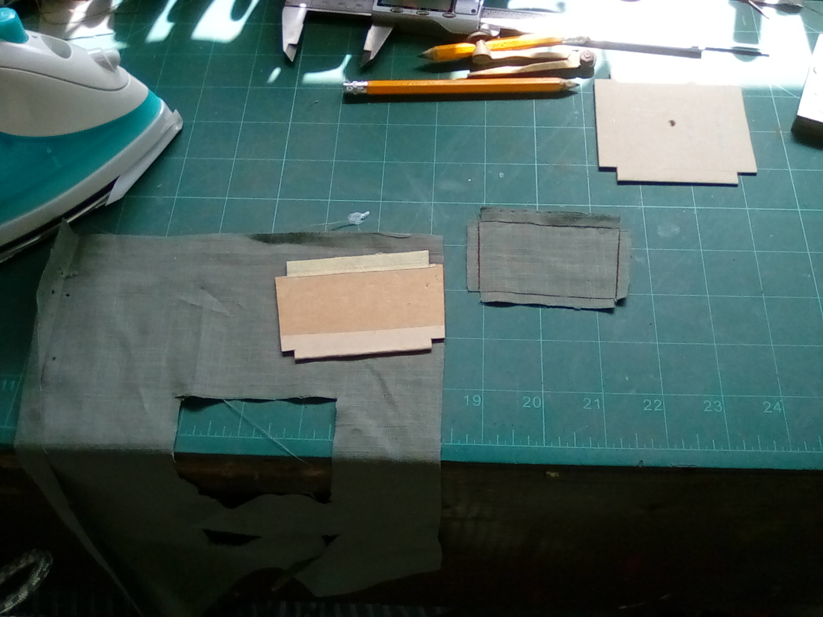

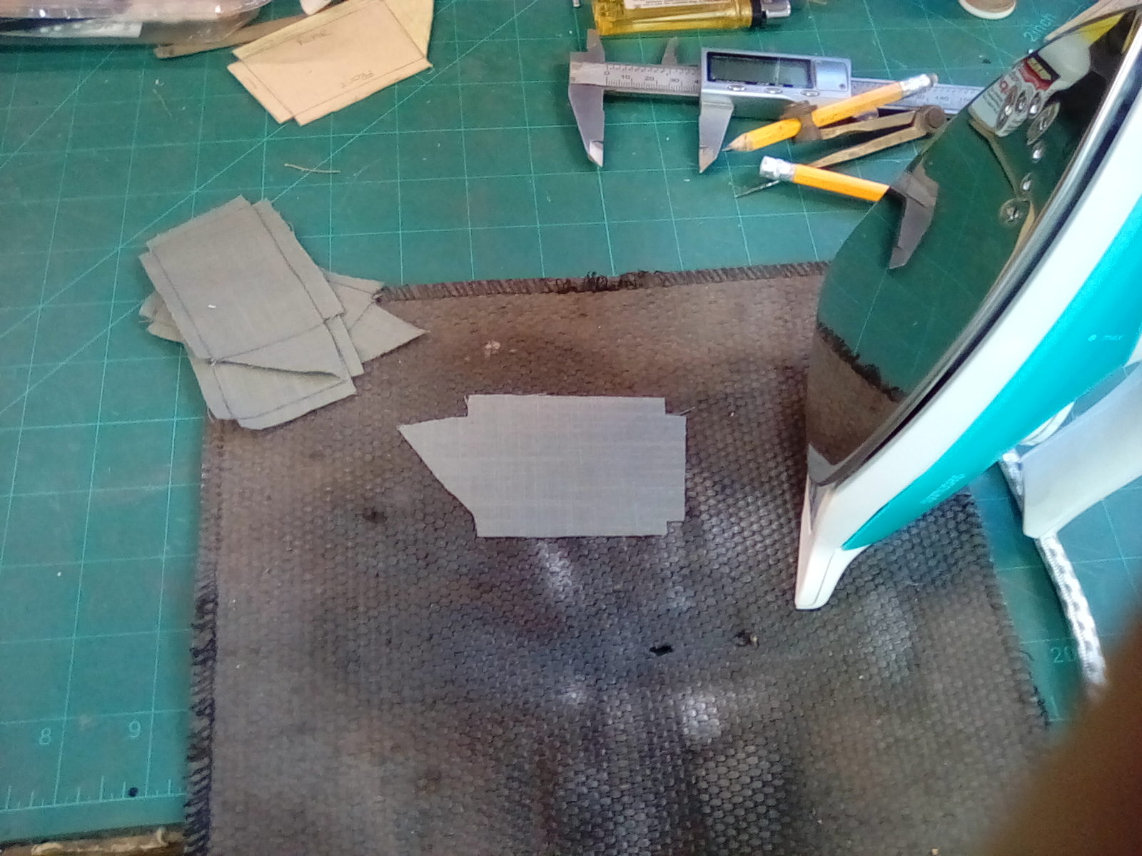

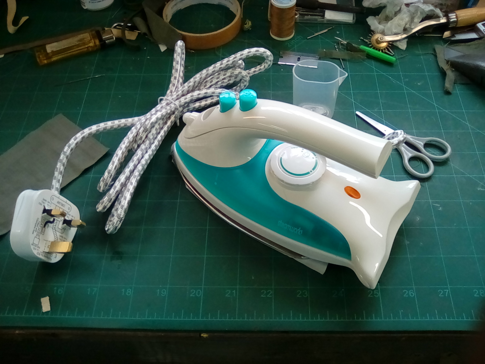

I had to buy a new dinky iron to get a good crease in the tabs prior to stitching, I can now iron the creases out my underpants.

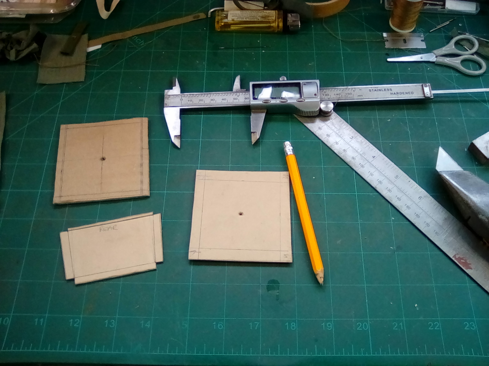

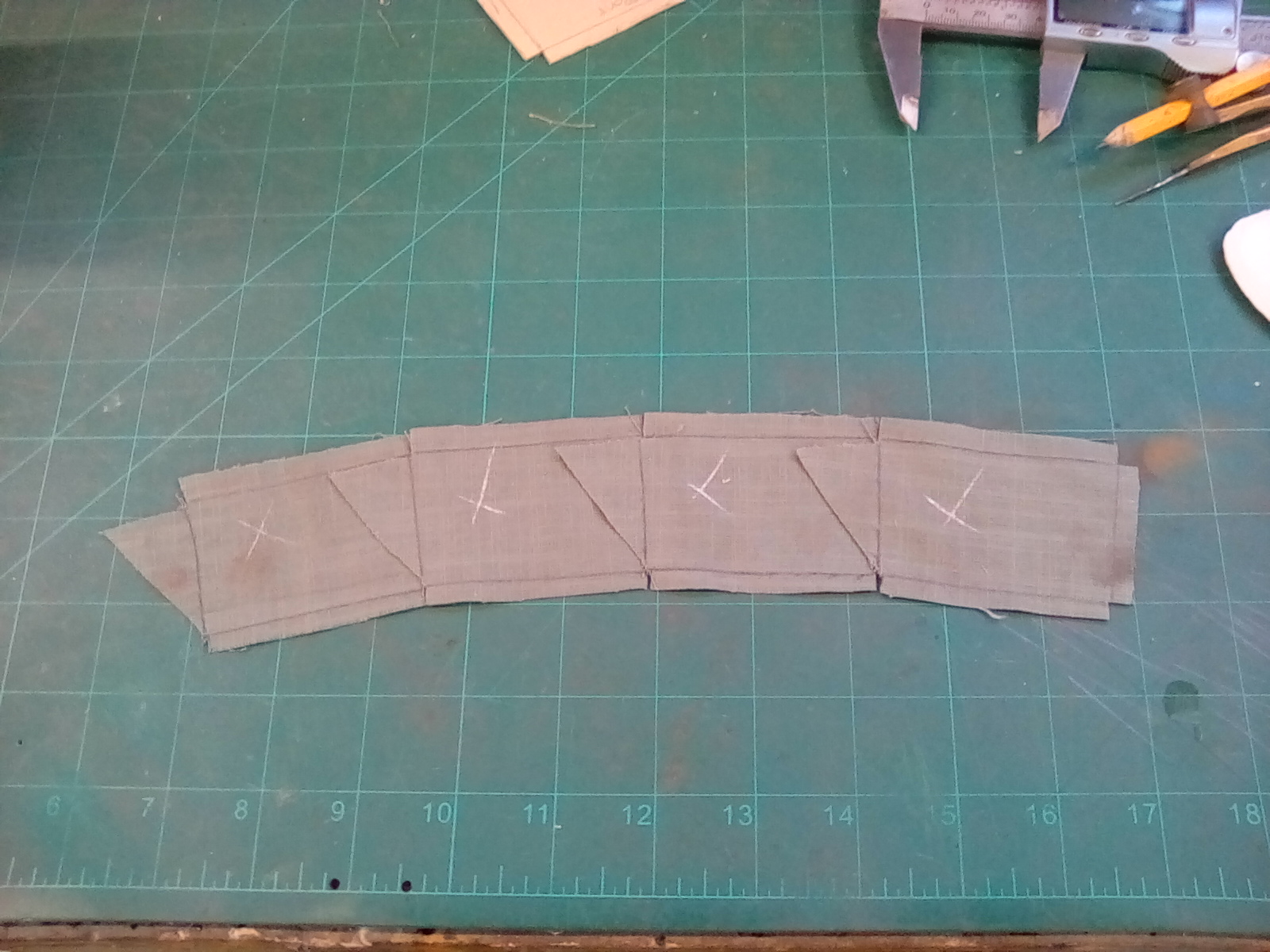

Patterns
Patterns
Three more of these needed

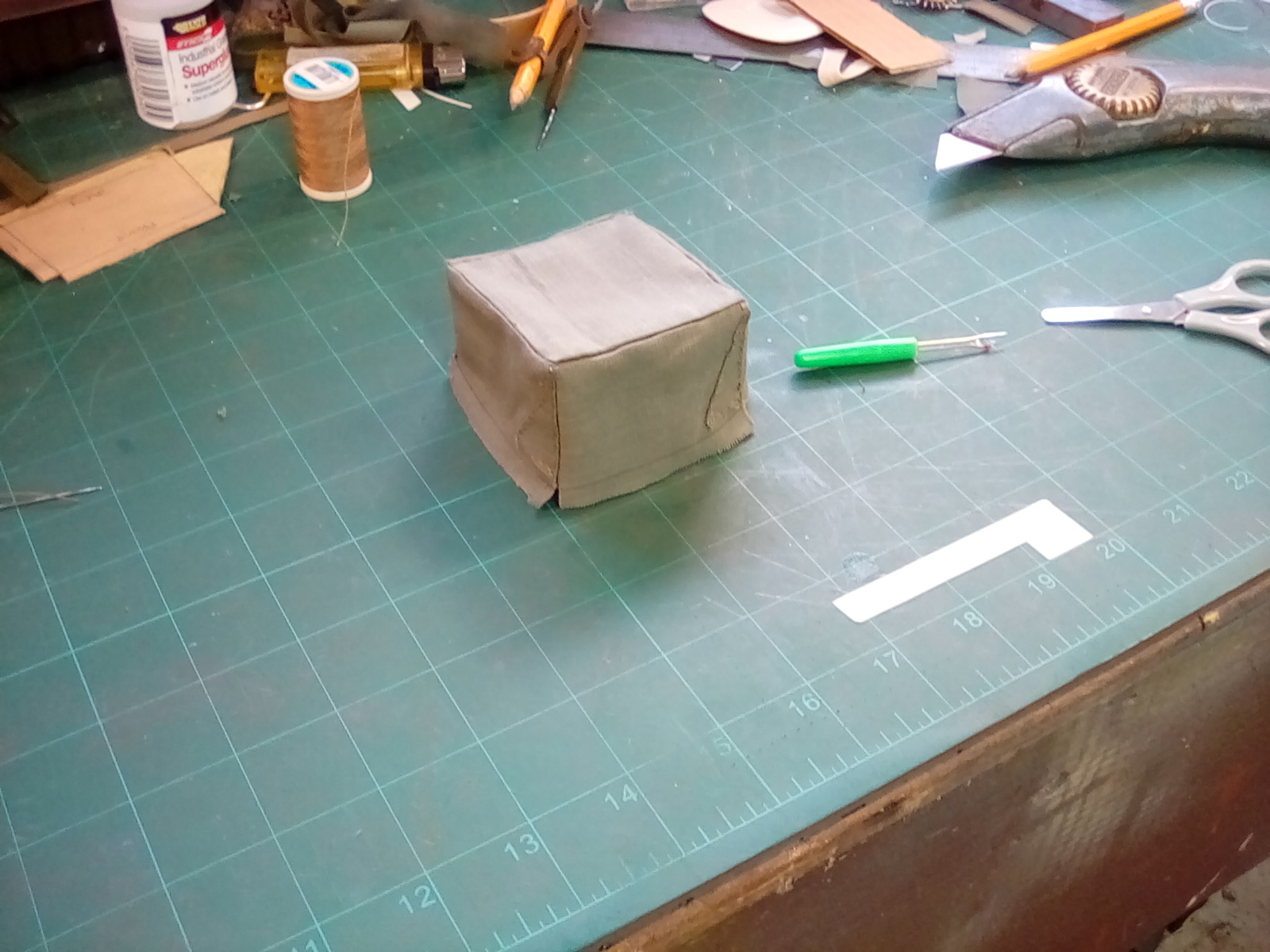

Making a slightly tapered square tube
The new iron is great

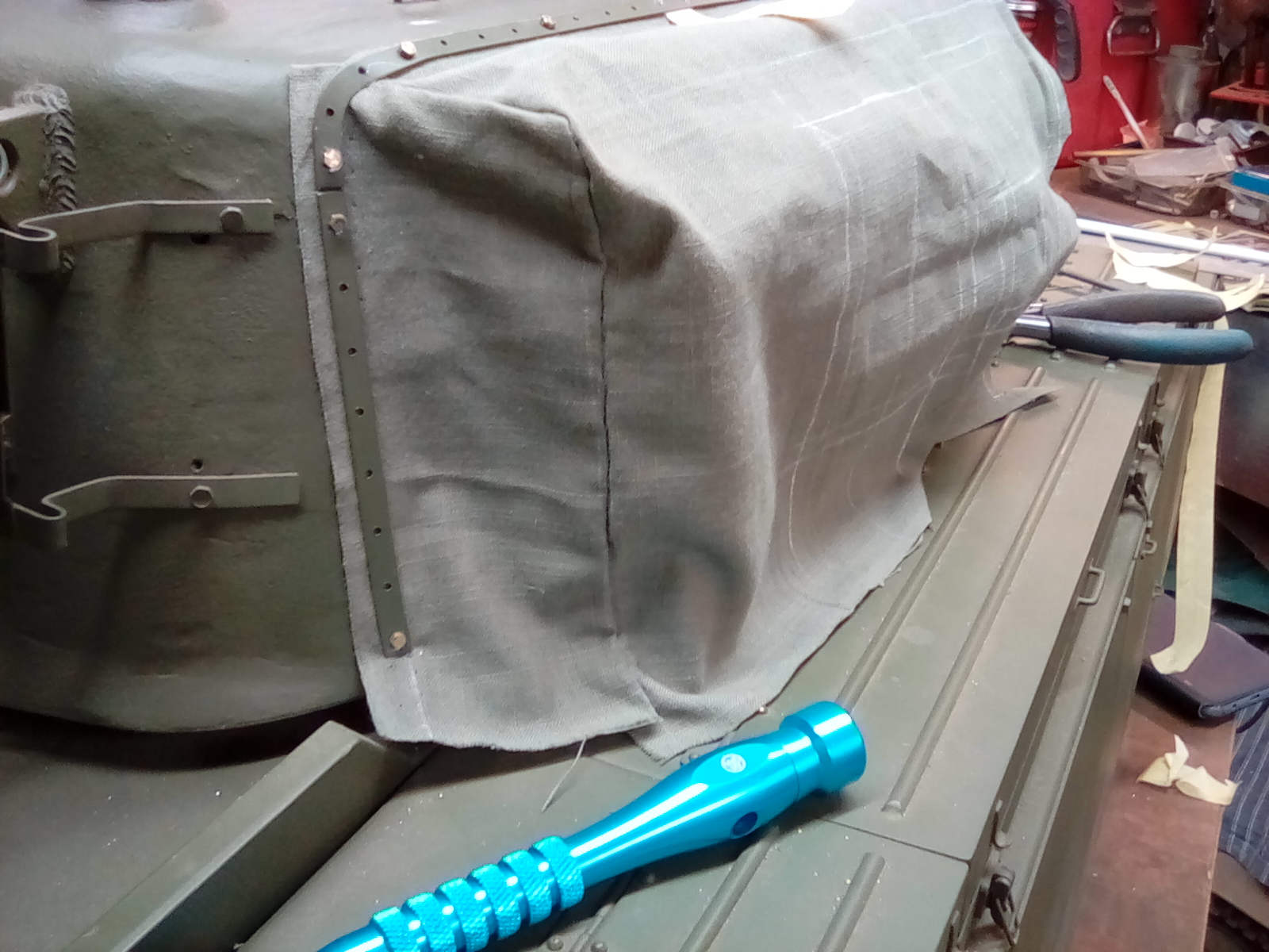

That's a tricky box to sew

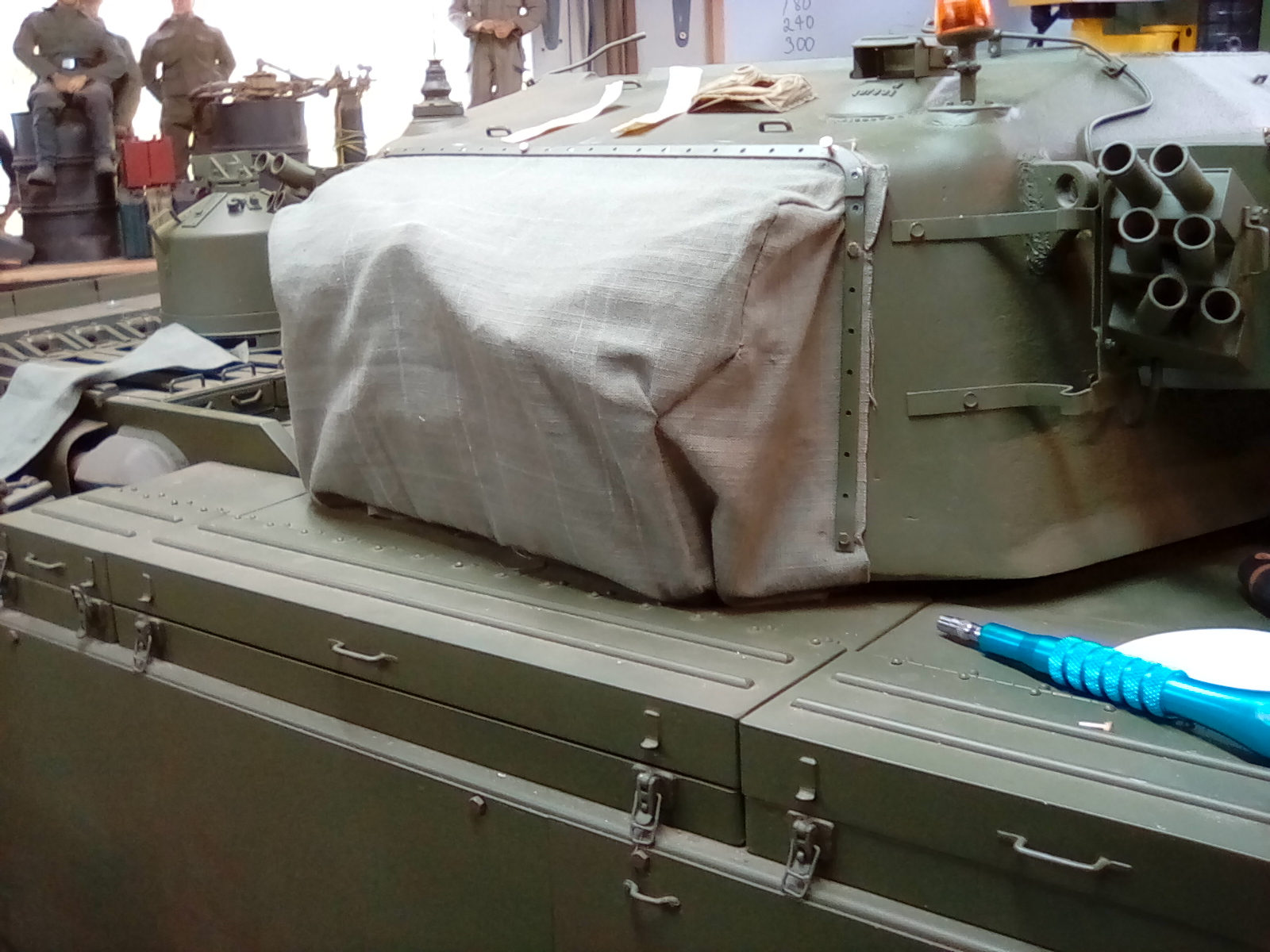

One more check of the fit
Cutting time
Cutting time

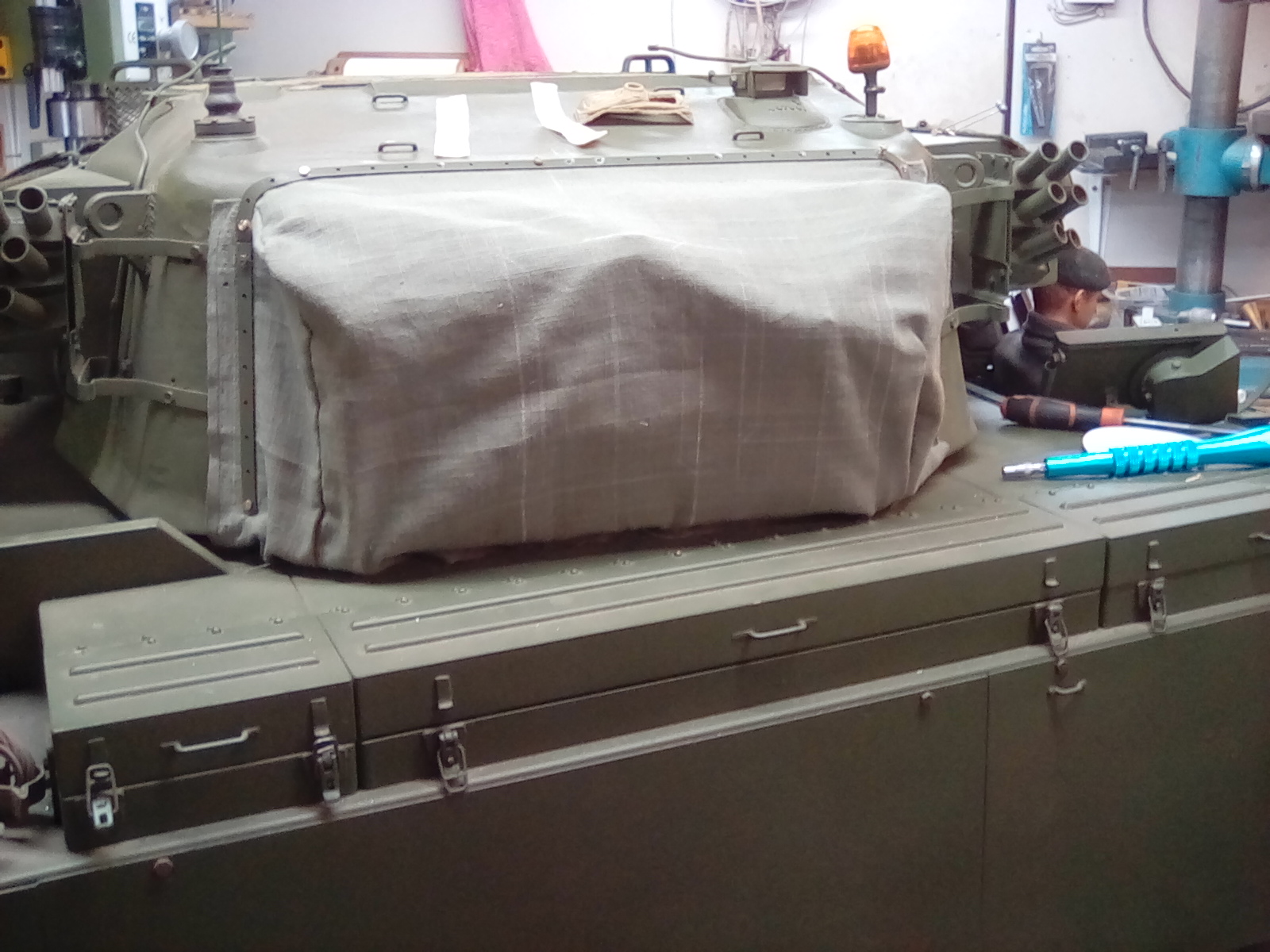

It looks a bit ridiculous right now as it's packed with card to keep it square while I pin and tack it , it will sag nicely once the packing is removed.

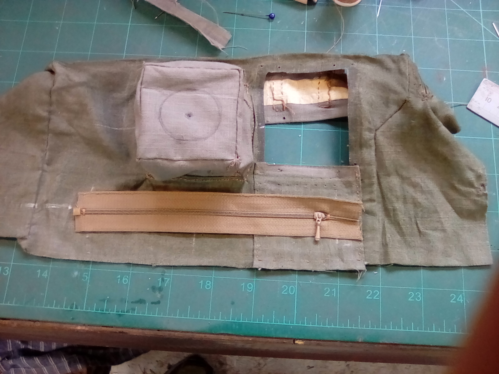

More stitching and prep for the long zip
I think the boss wants the thermal sleeve to

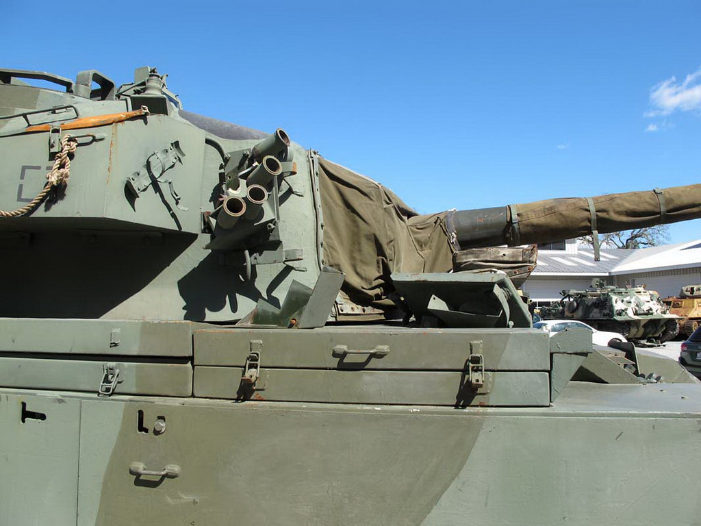

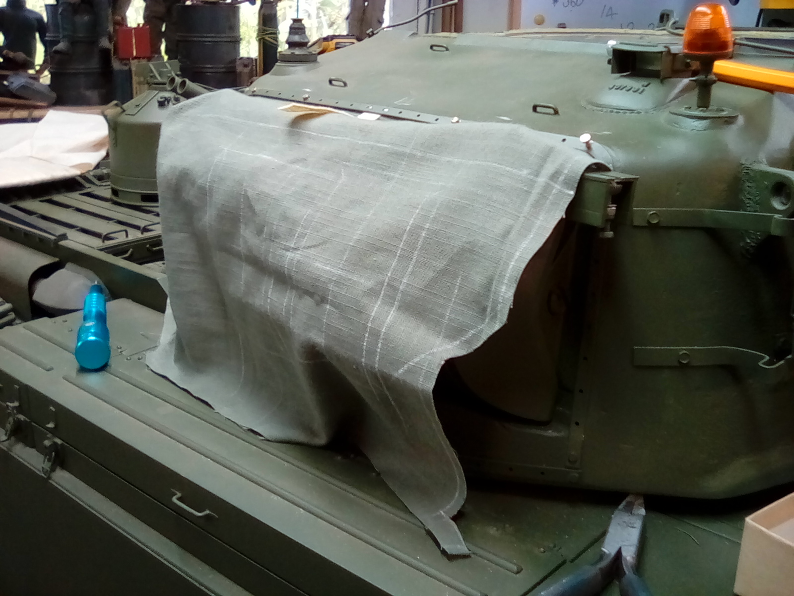

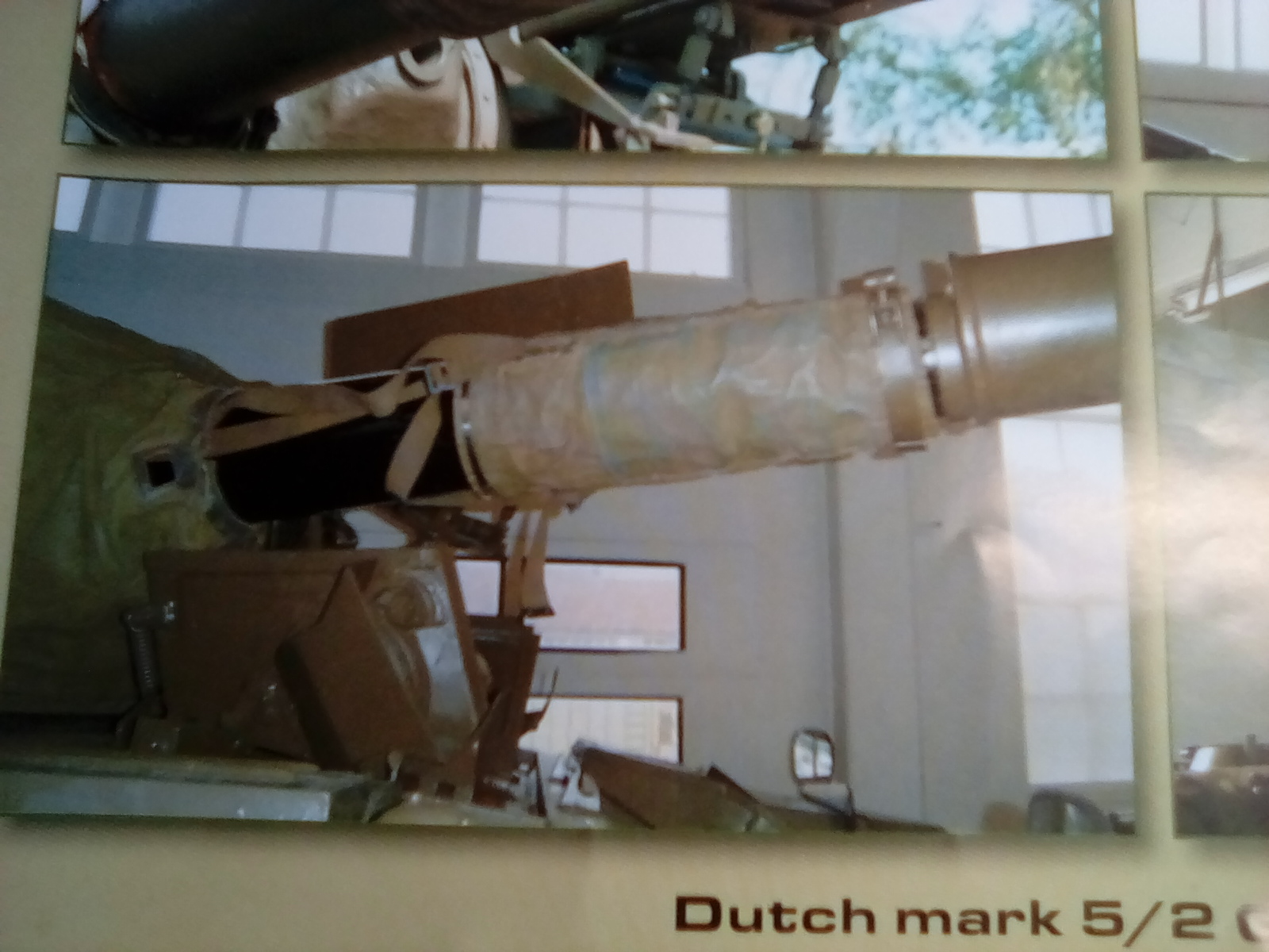

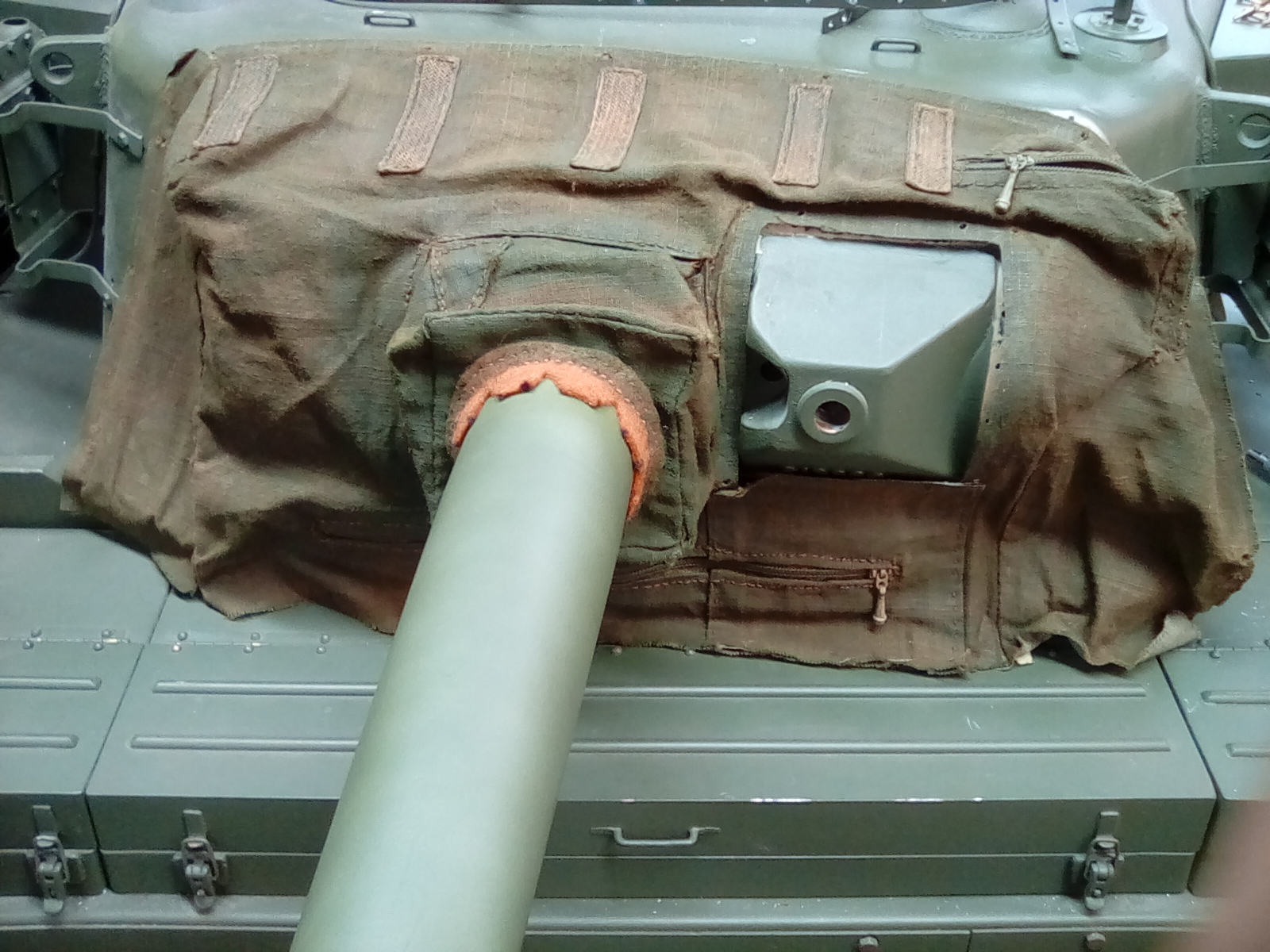

This MK10 mantlet cover is similar but has some subtlety different dimensions

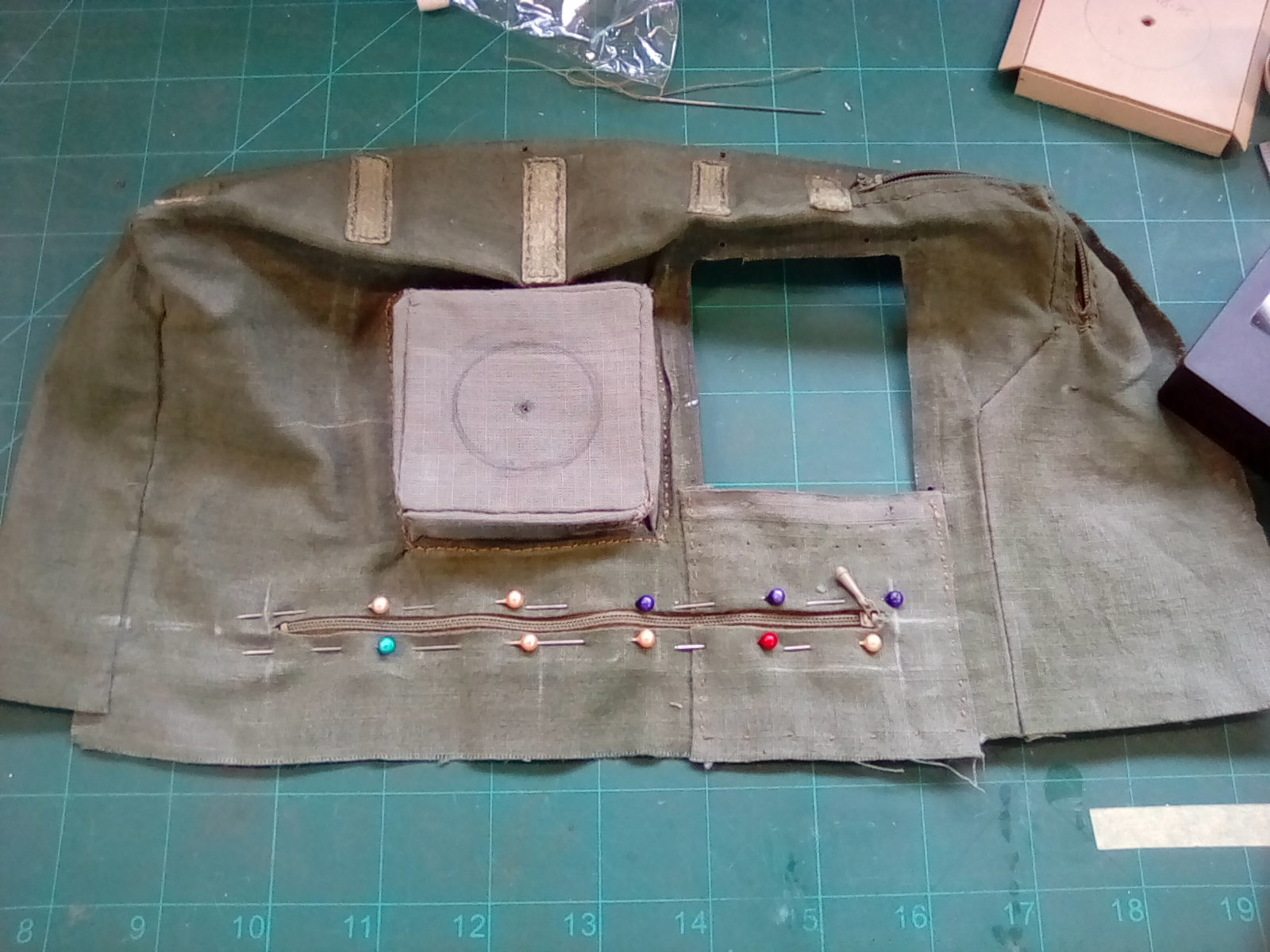

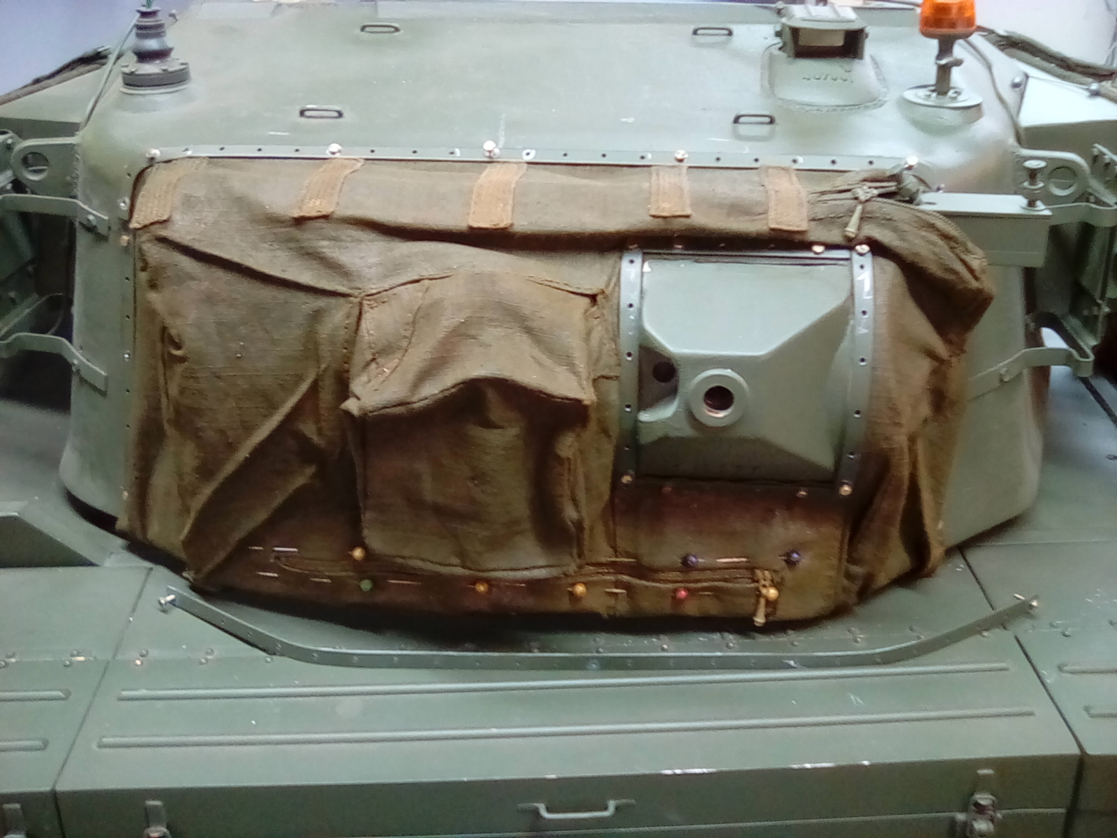

Marking out for the long zip
Lots of spare material but I'm not worrying about that for now, we want plenty and we have plenty.

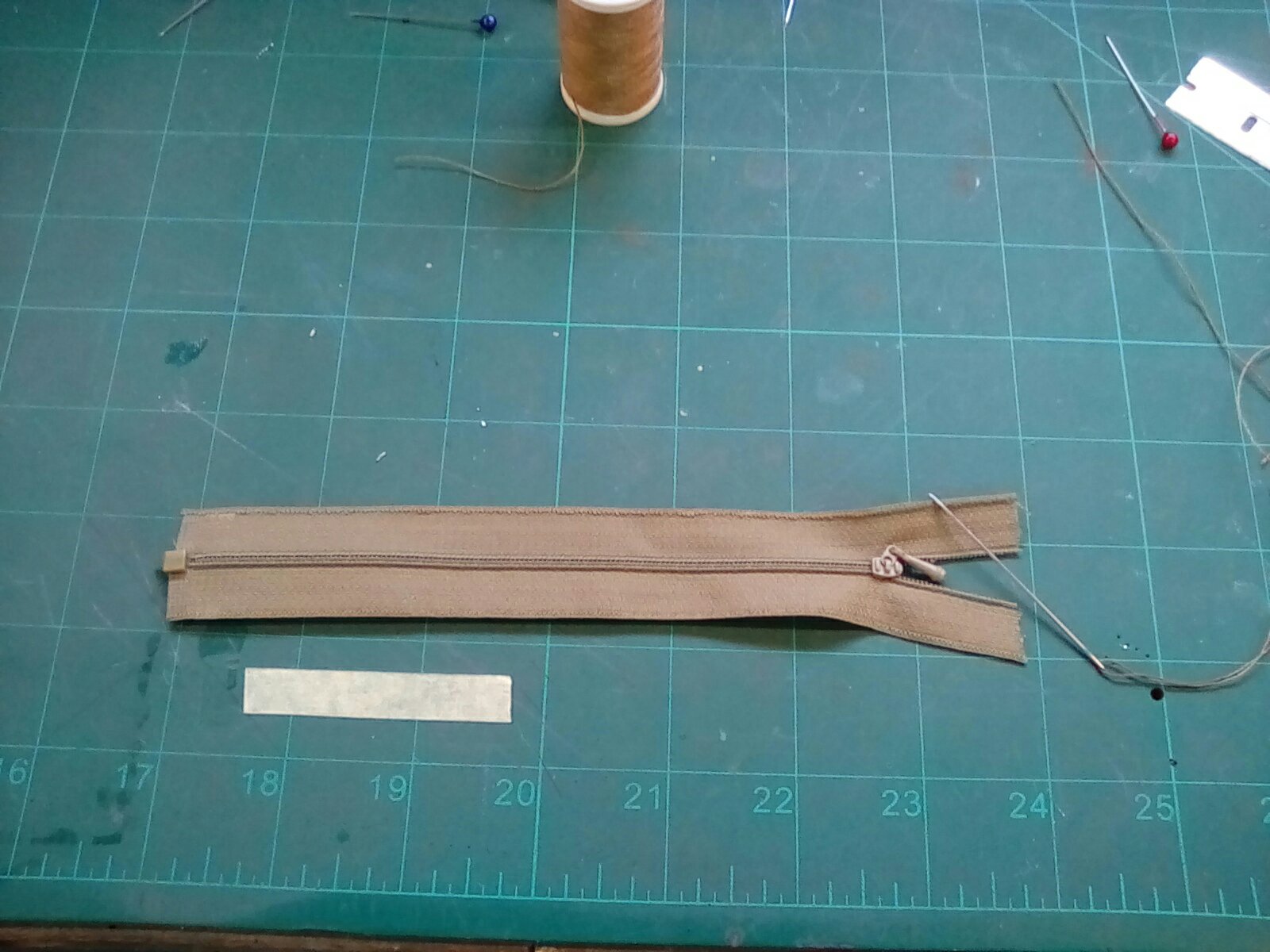

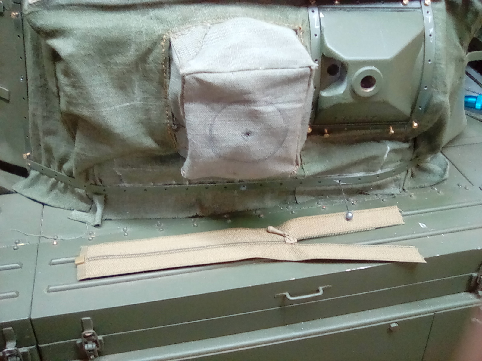

The long zip for the bottom
All ready for stitching up

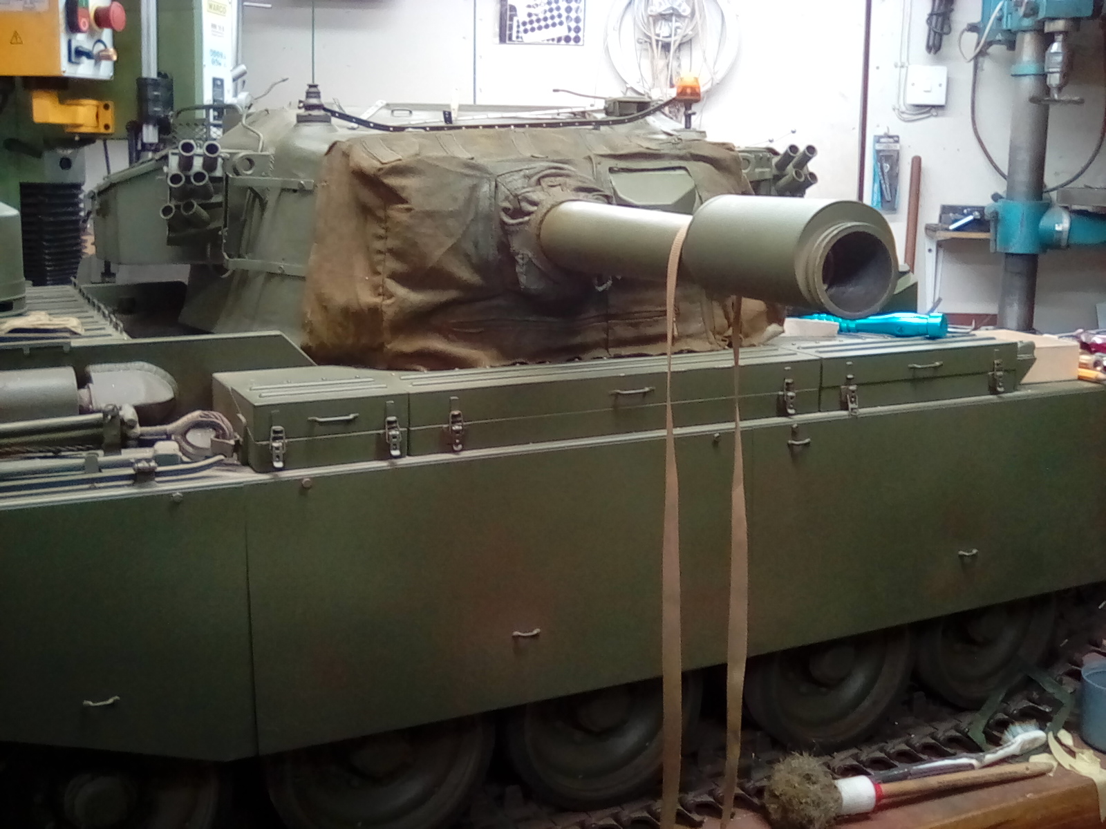

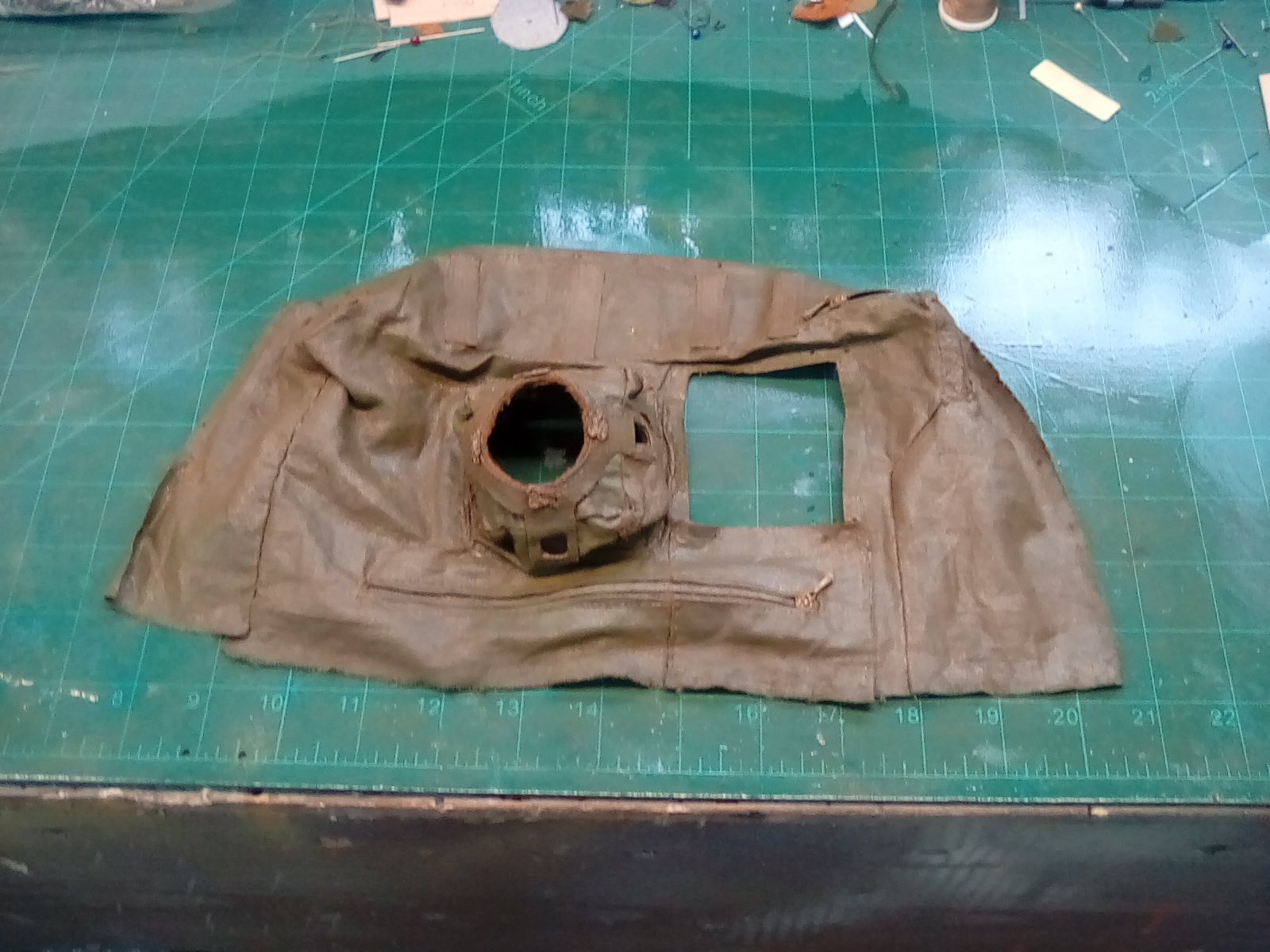

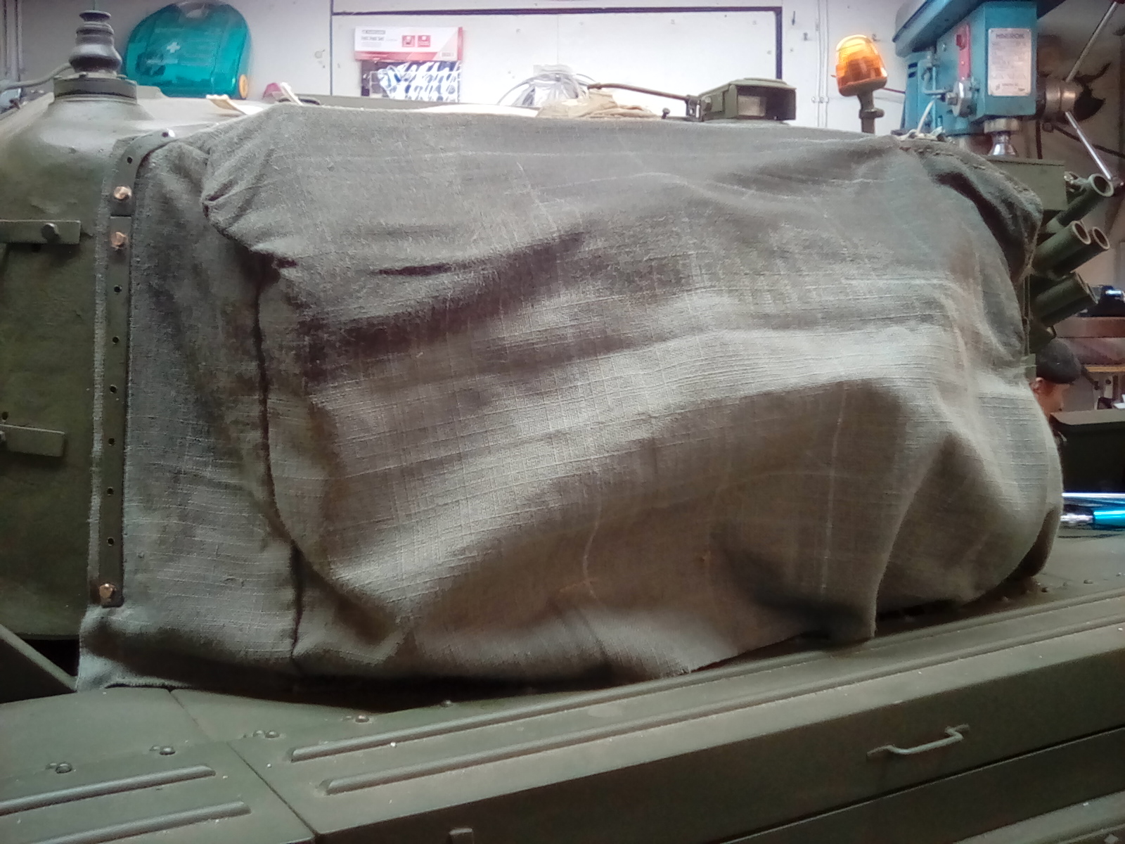

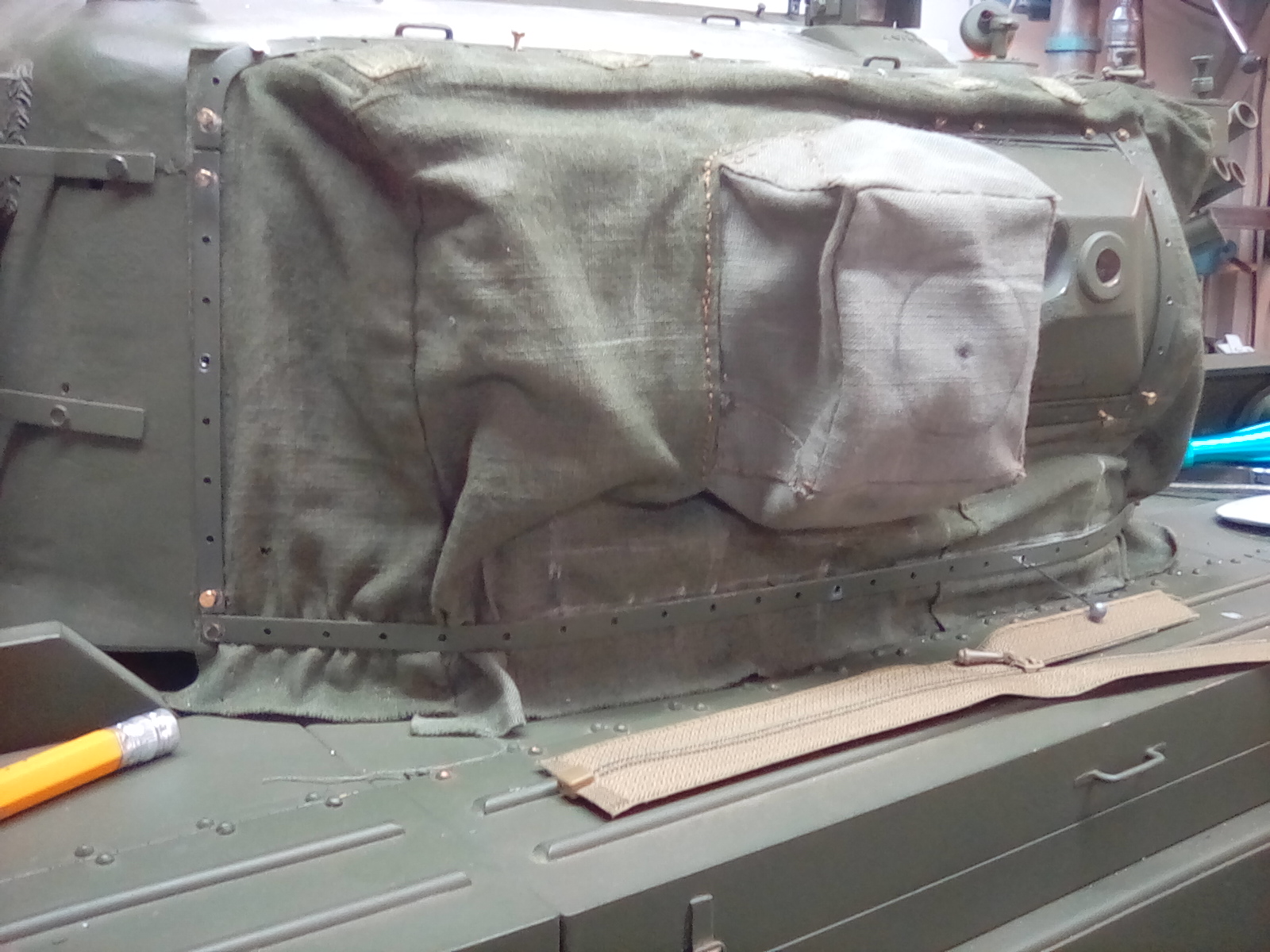

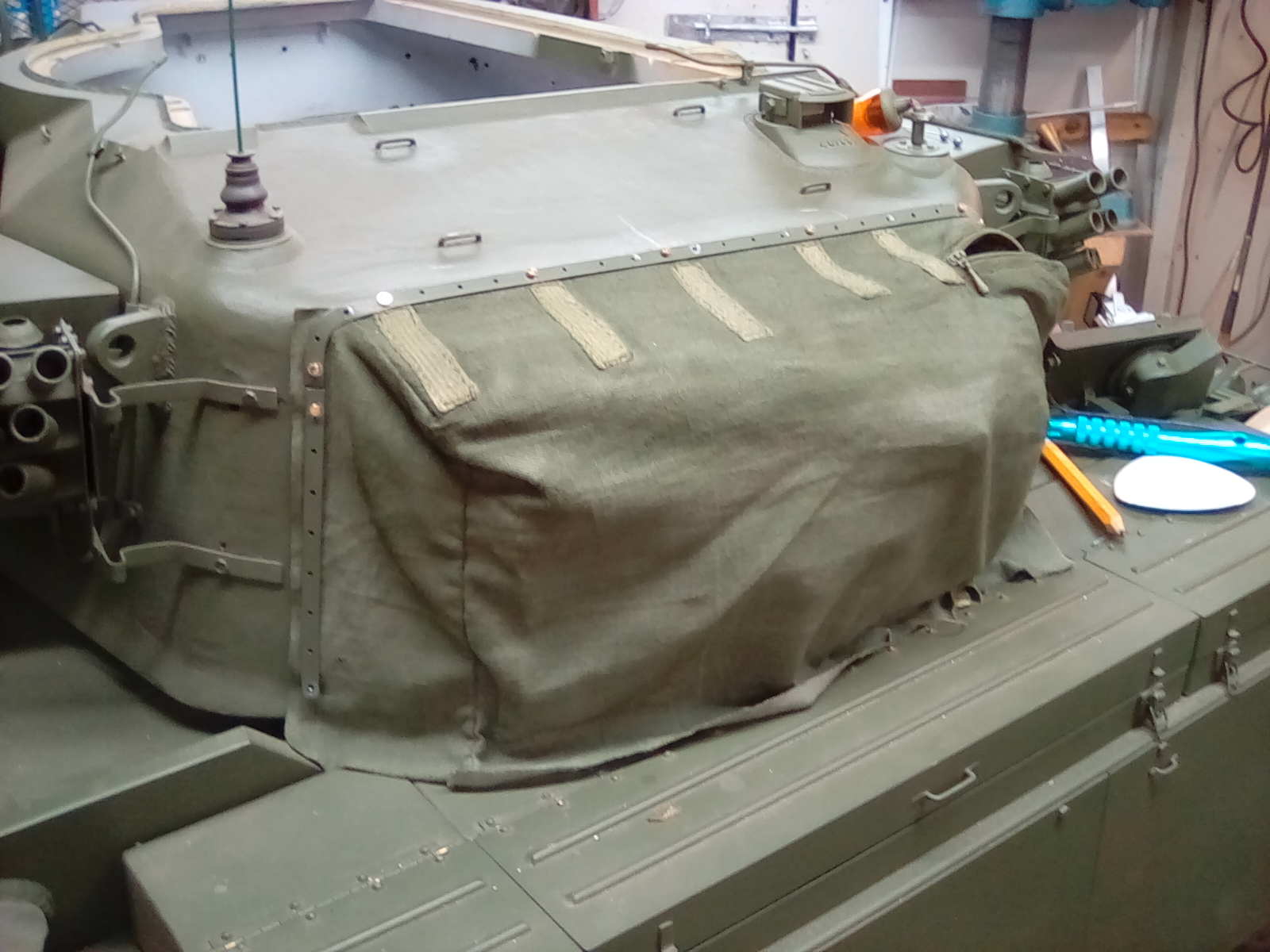

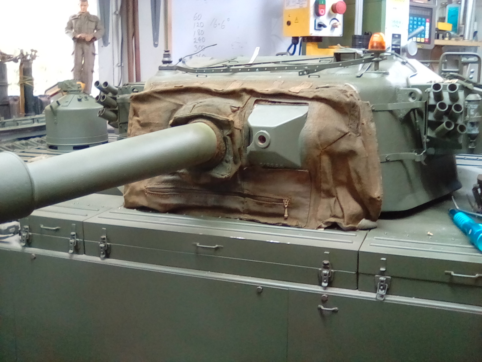

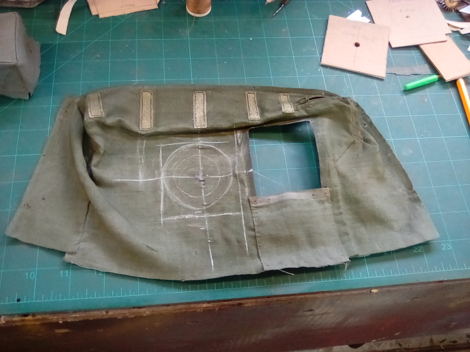

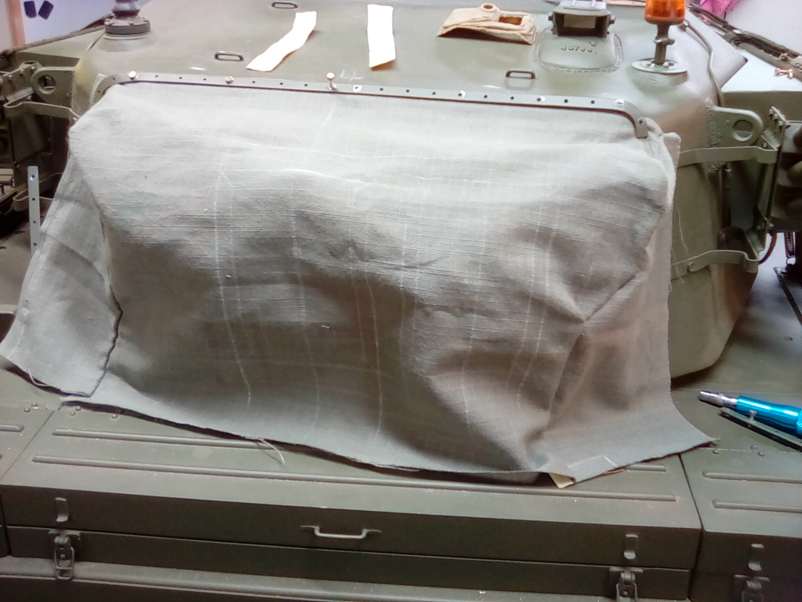

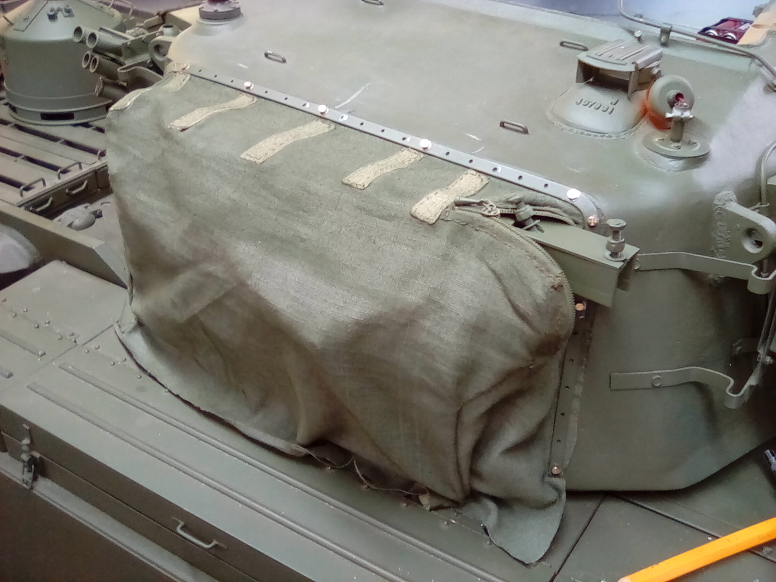

The stain arrived for the canvas so I couldn't resist a quick " look see" . I want lots of saggy creases and I'm getting the beginnings of, just need to keep teasing the fabric until , like a hair style, it stays in place.
The test piece, and after drying with a hot air gun,  little to no shrinkage
The bottom section is not in place, the zip sits a little higher than that creating more creases.

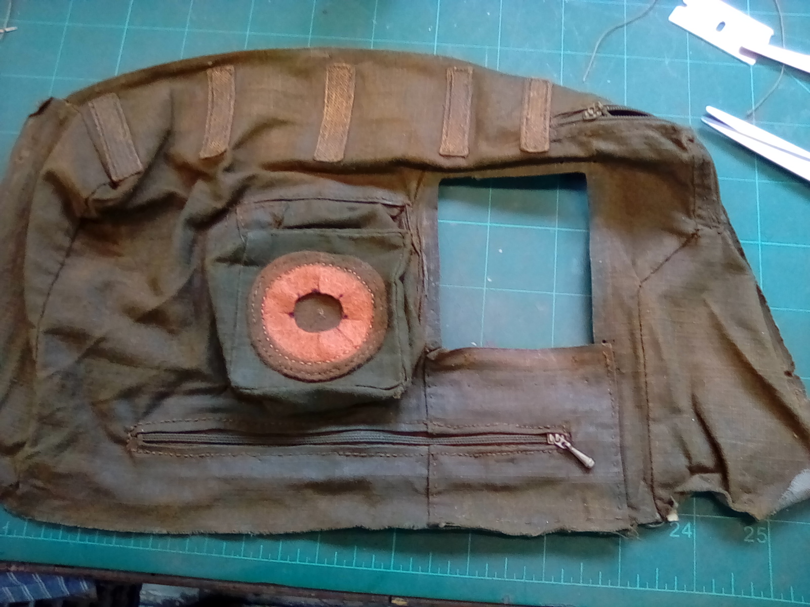

Just a couple of hours done today oh and some shopping for some necessary tools and some fuzzy felt.
The long lower zip is now stitched in place and functional

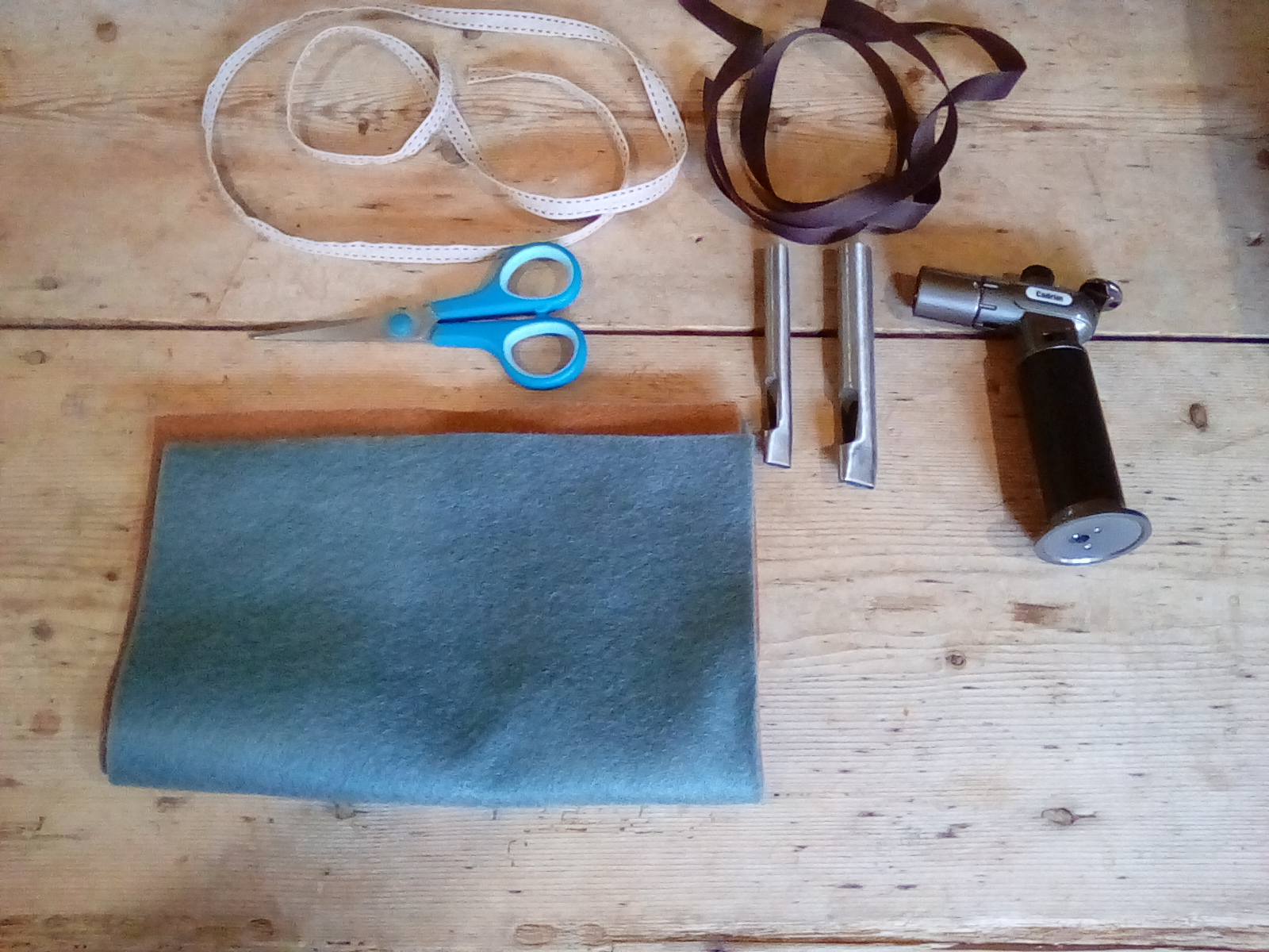

Right approach but wrong material so some felt is required
Edging tape, fuzzy felt, some very sharp dress making scissors, hole punches and a new chefs blow torch.

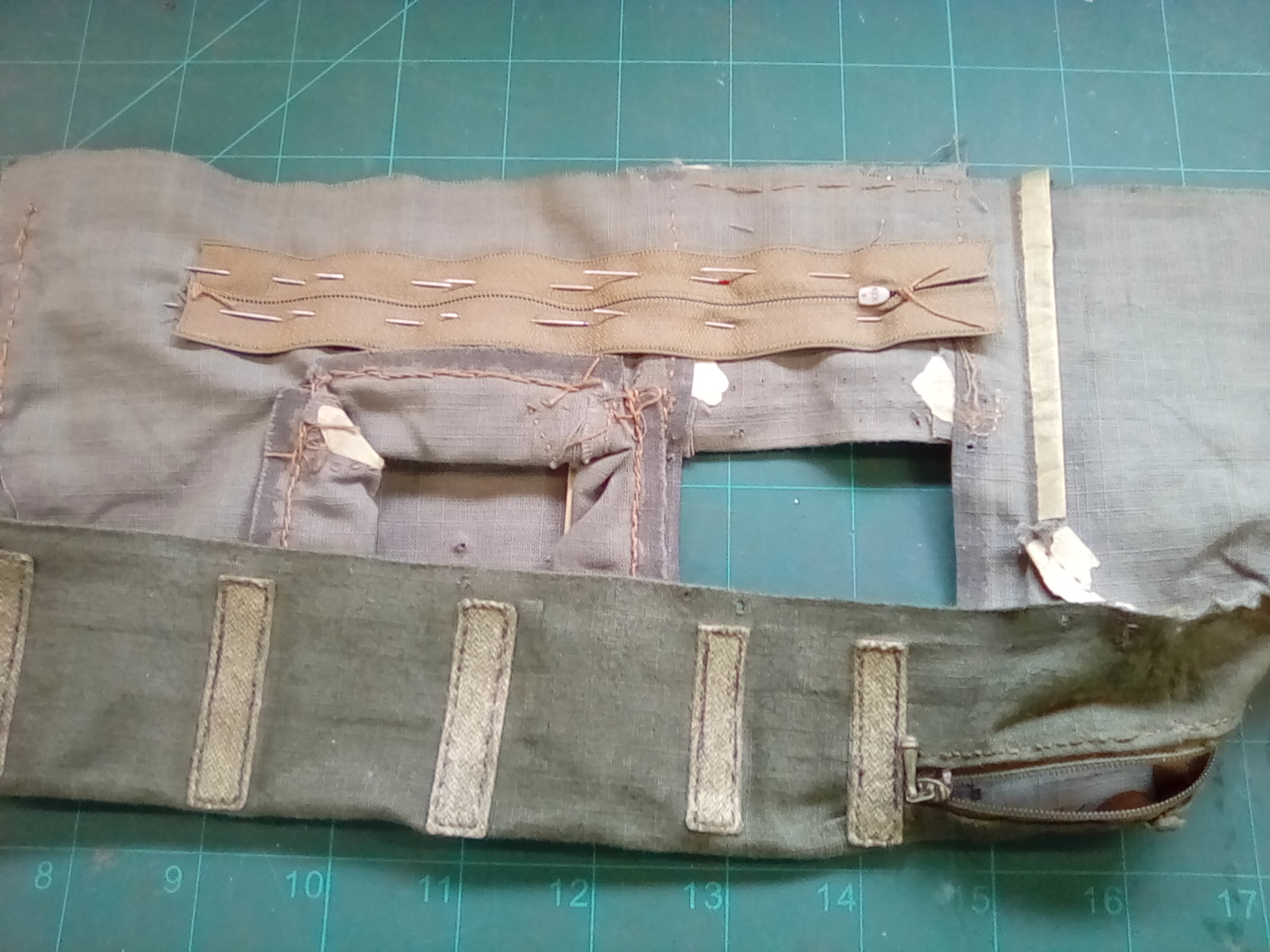

Even more sewing

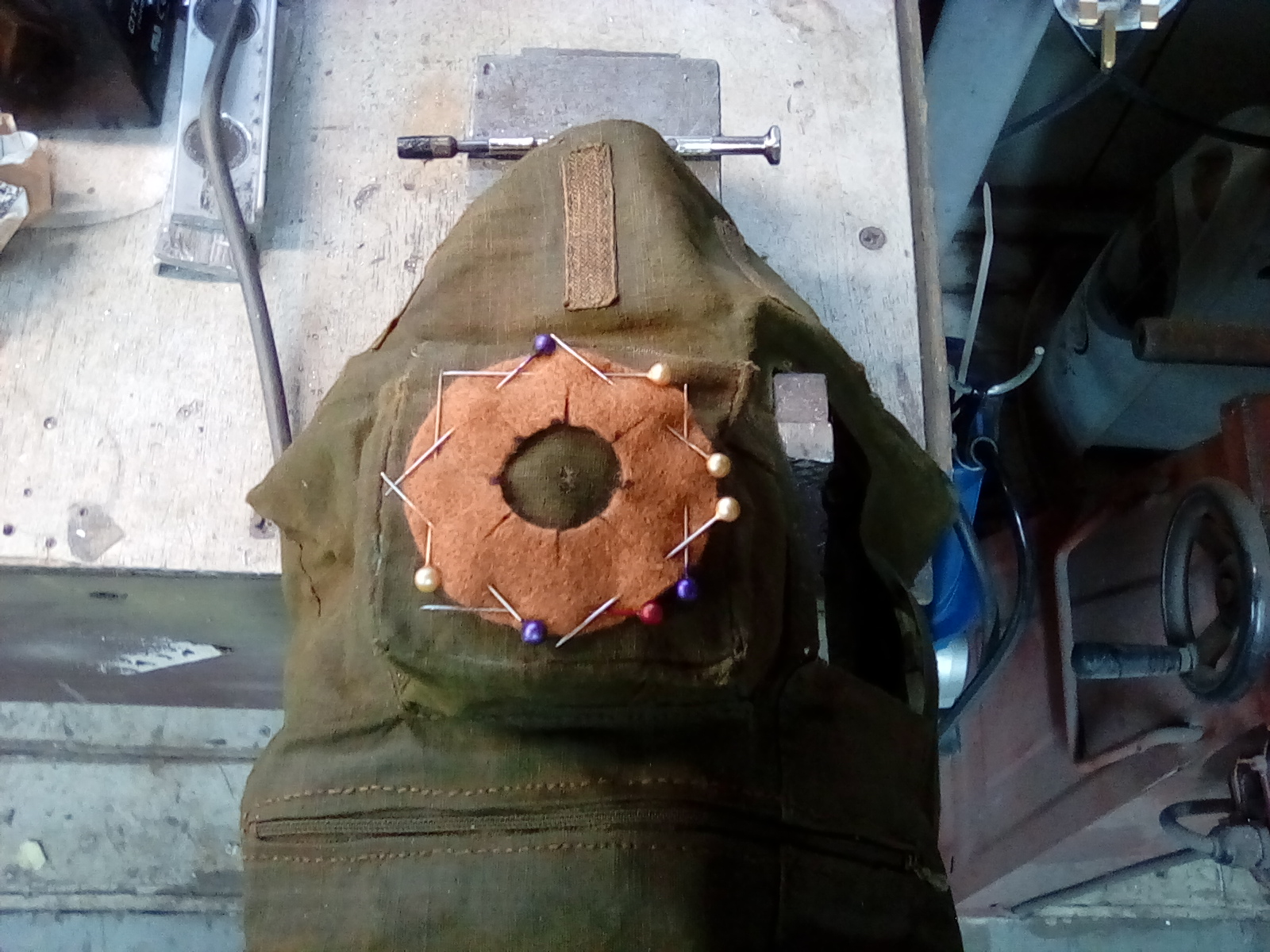

Pining as neatly as I can ready for the first stich
Not happy about cutting the middle section out but it's got to be done
The triangular flaps can now be trimmed back
This piece has the openings for the recoil straps, it's just a test piece to see how it's going to sit but I have a better idea, more on that tomorrow

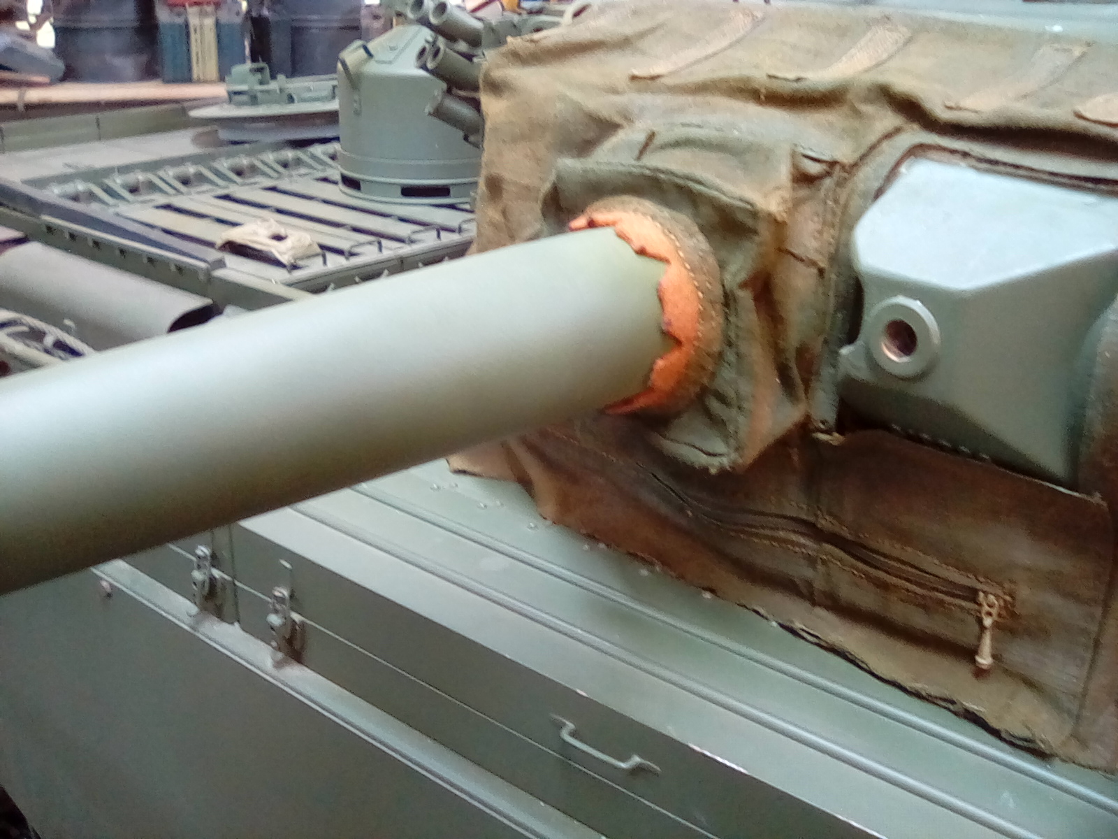

Nice and tight and neat around the barrel

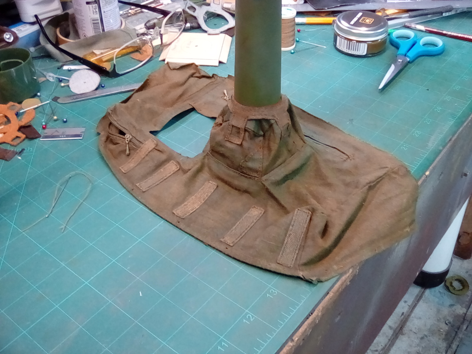

Spent the afternoon cutting and stitching the gusset piece but to no avail as the look didn't pass muster, it will have to be unpicked and another material sourced.

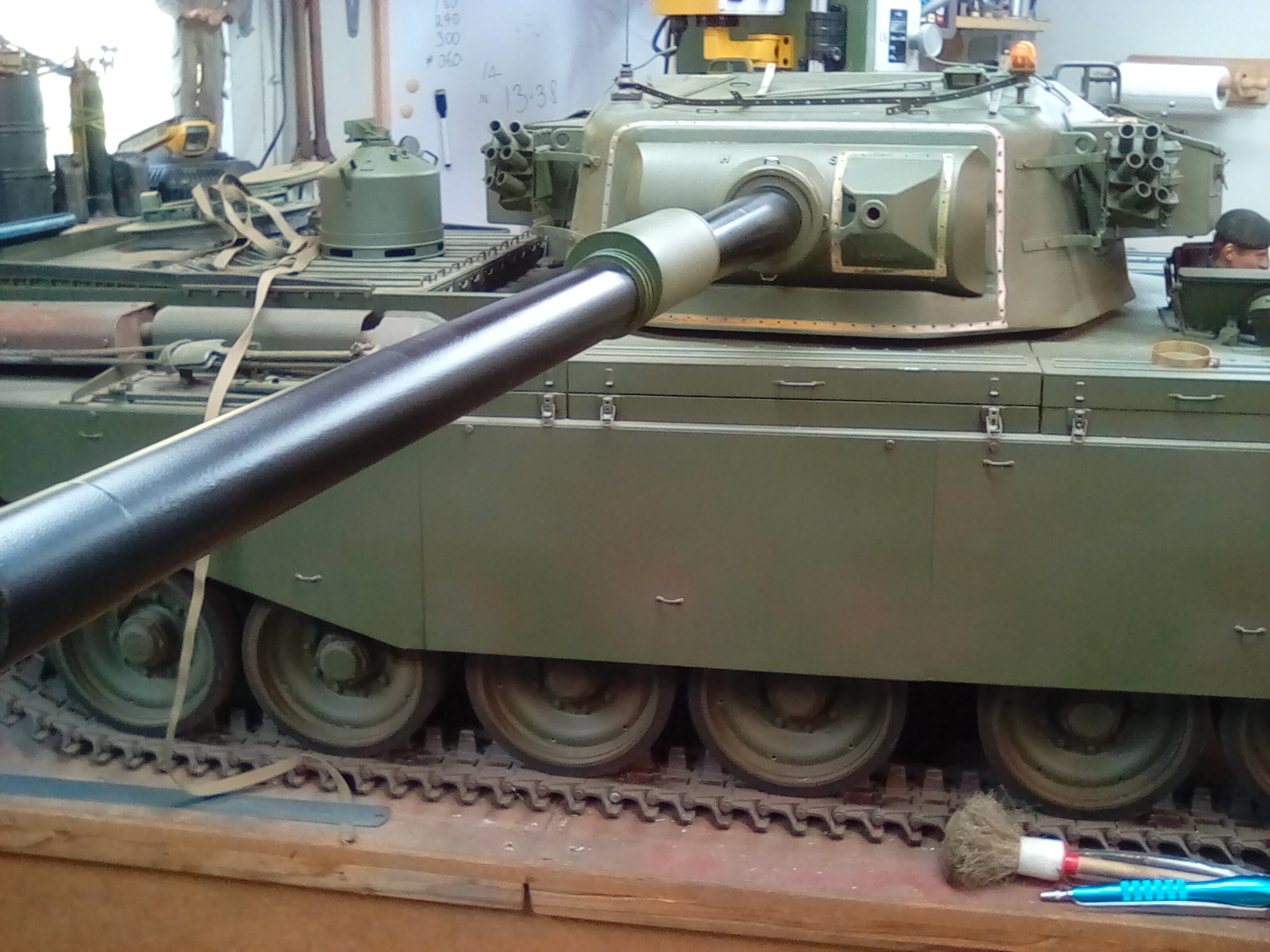

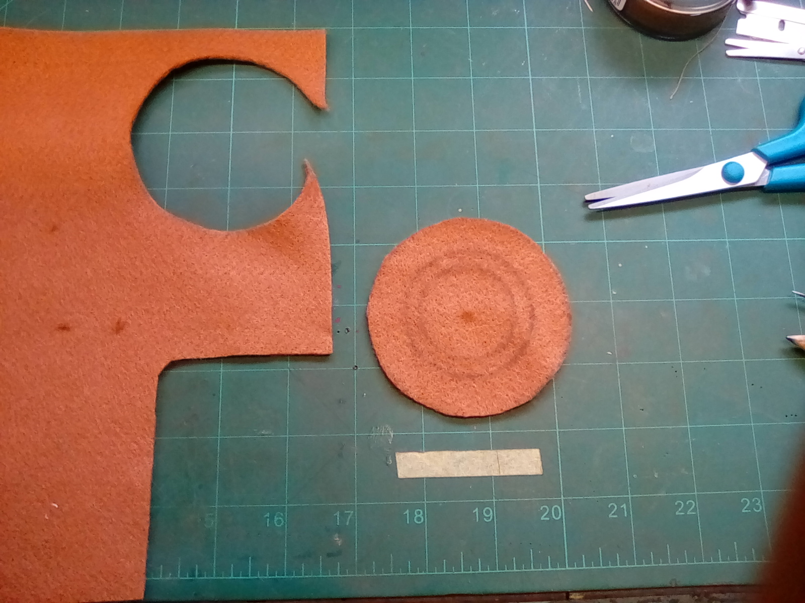

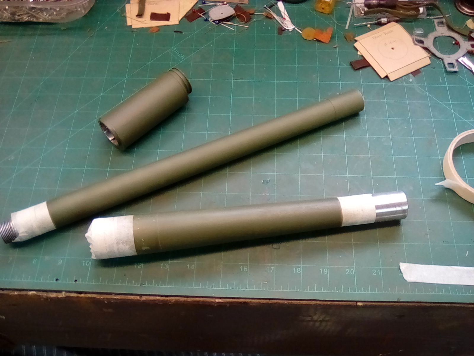

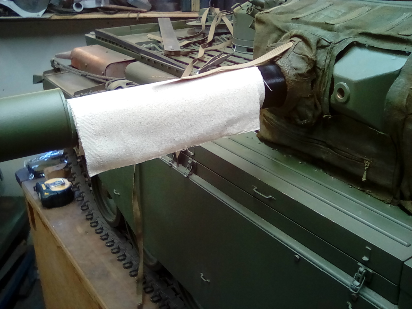

Getting closer to the thermal sleeve

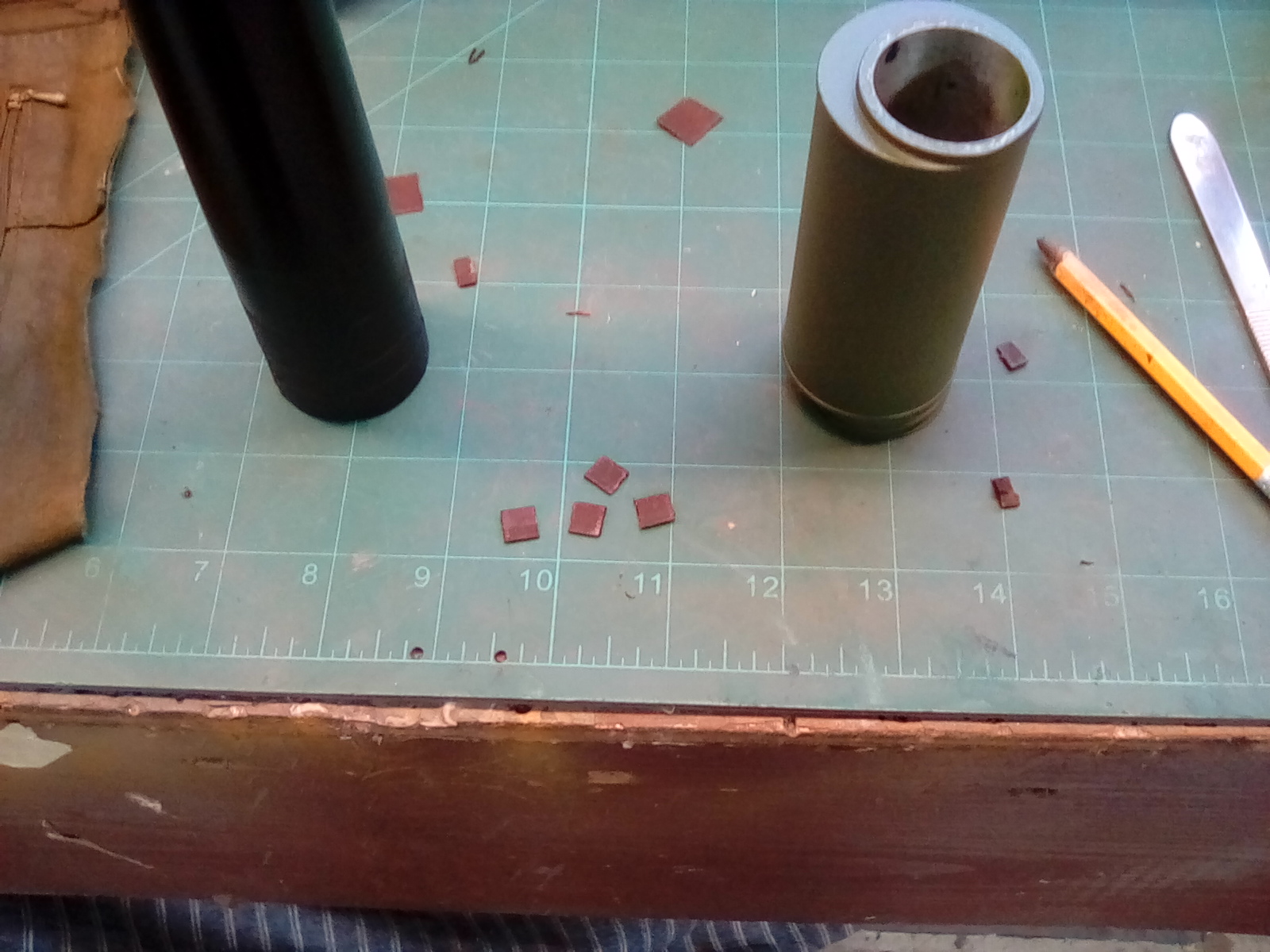

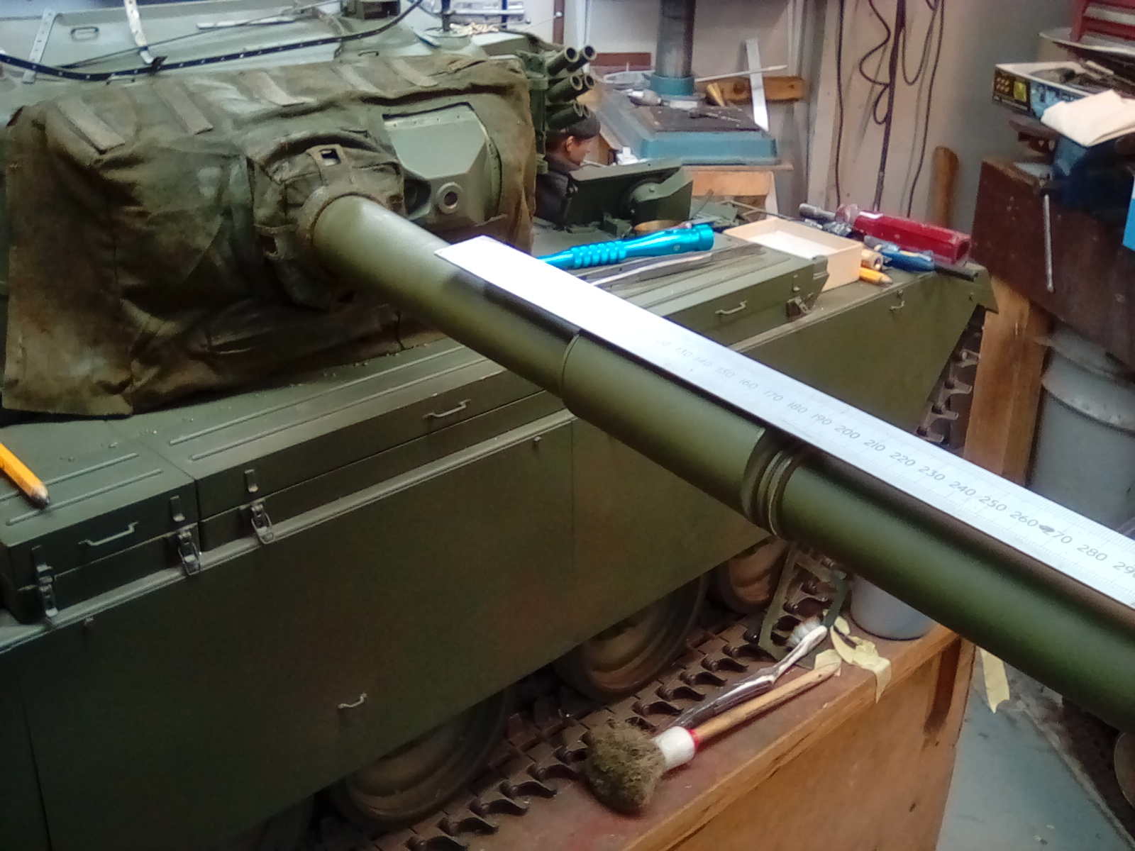

Calculating the barrel furniture distances
Black is required for most of the barrel , well everything that's under the sleeve.
See if you can spot these tiny details in brown
Most seem to have black barrels
I think calico will work nicely here

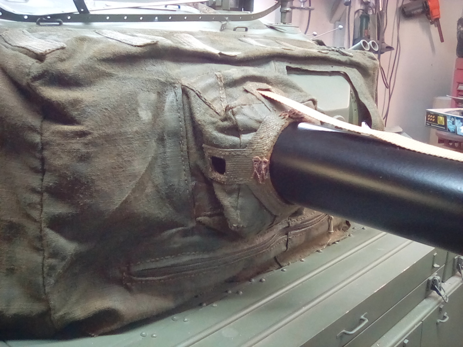

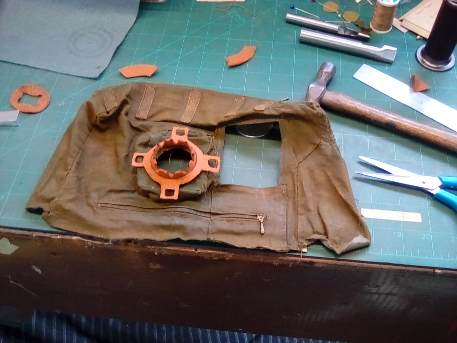

Drilling, tapping and bolting up at last.
Another layer of stain applied

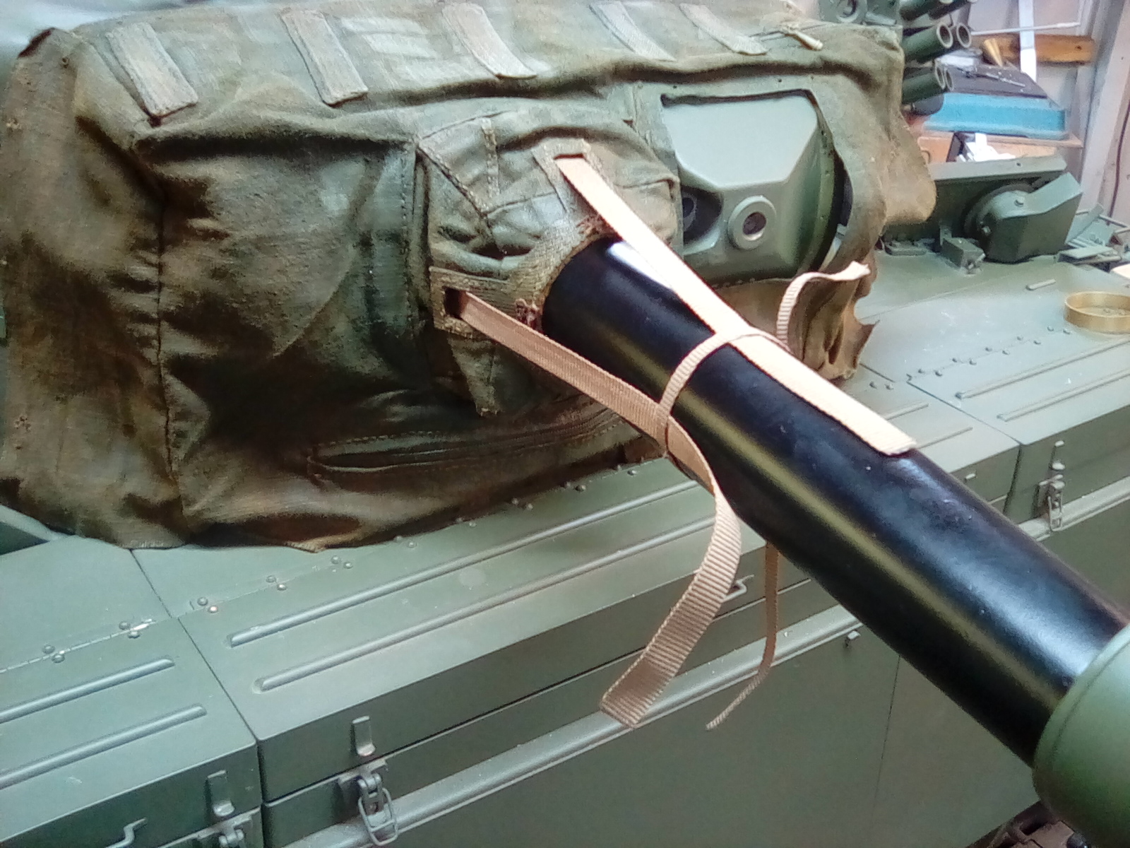

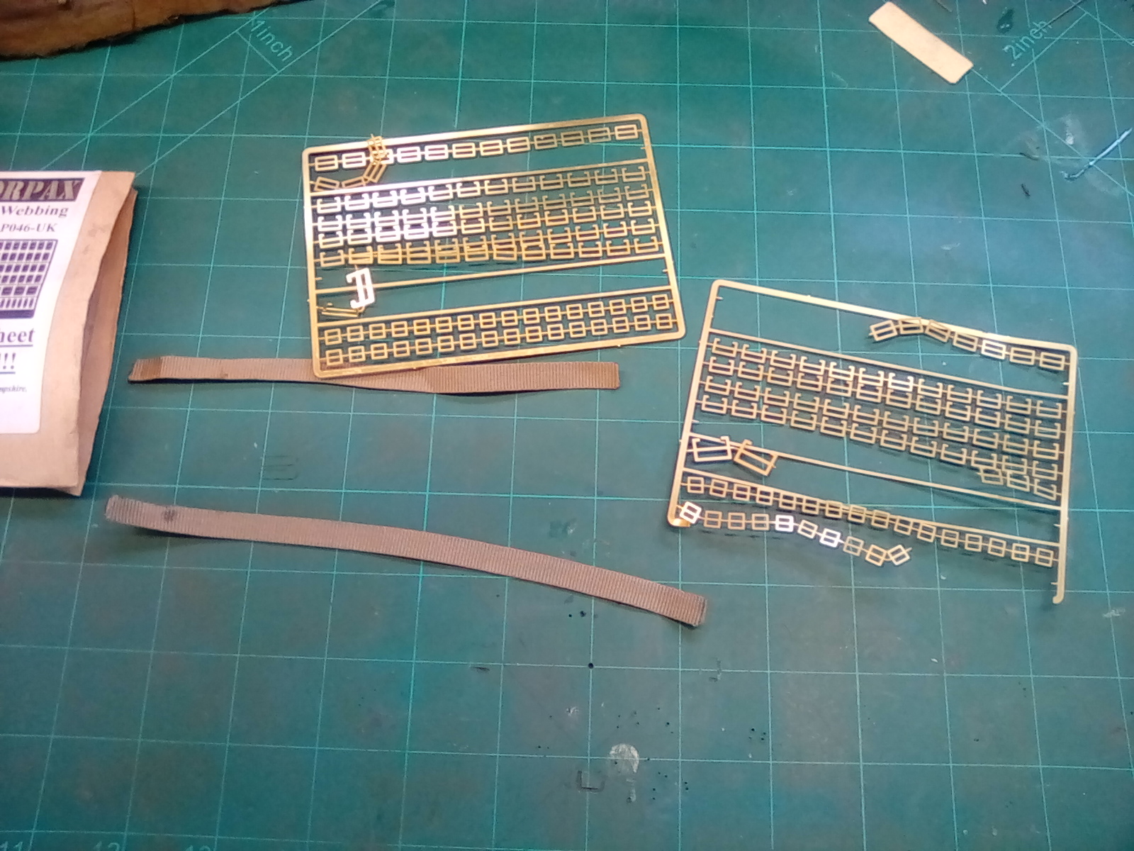

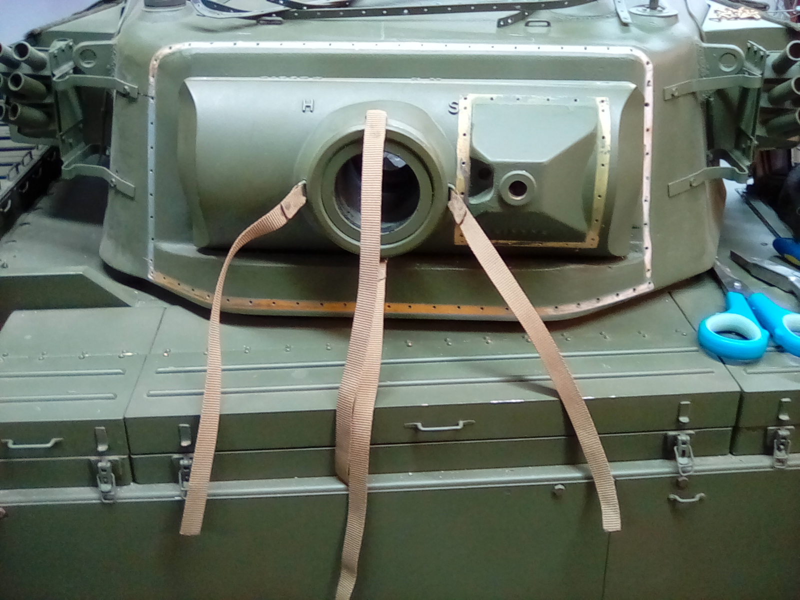

I have every size of strap end and buckle except the ones I need
Best fit the straps now as it will be a bugger once the mantlet cover is fitted
I broke another drill bit and a tap today

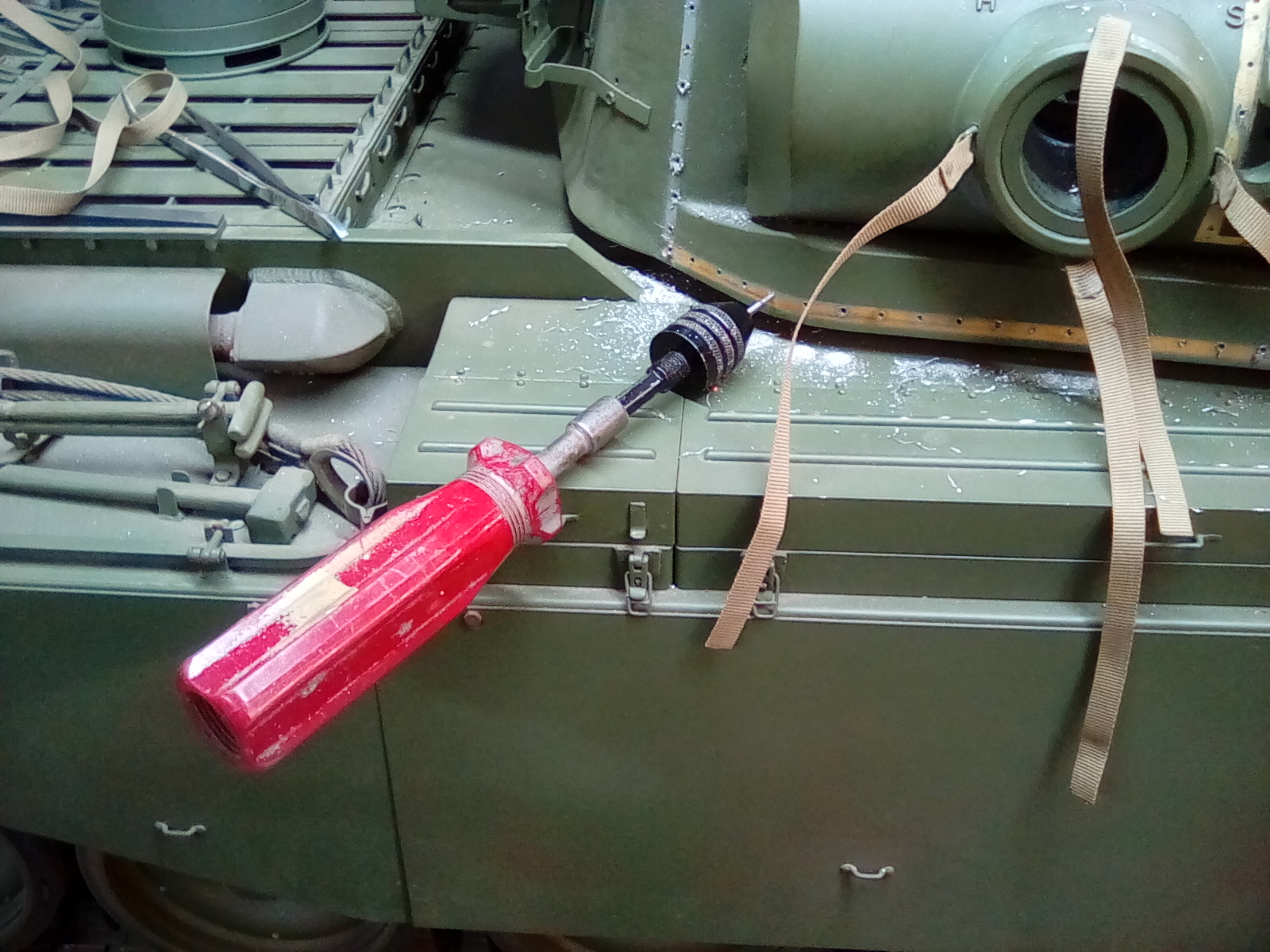

The safest way to tap those smaller threads

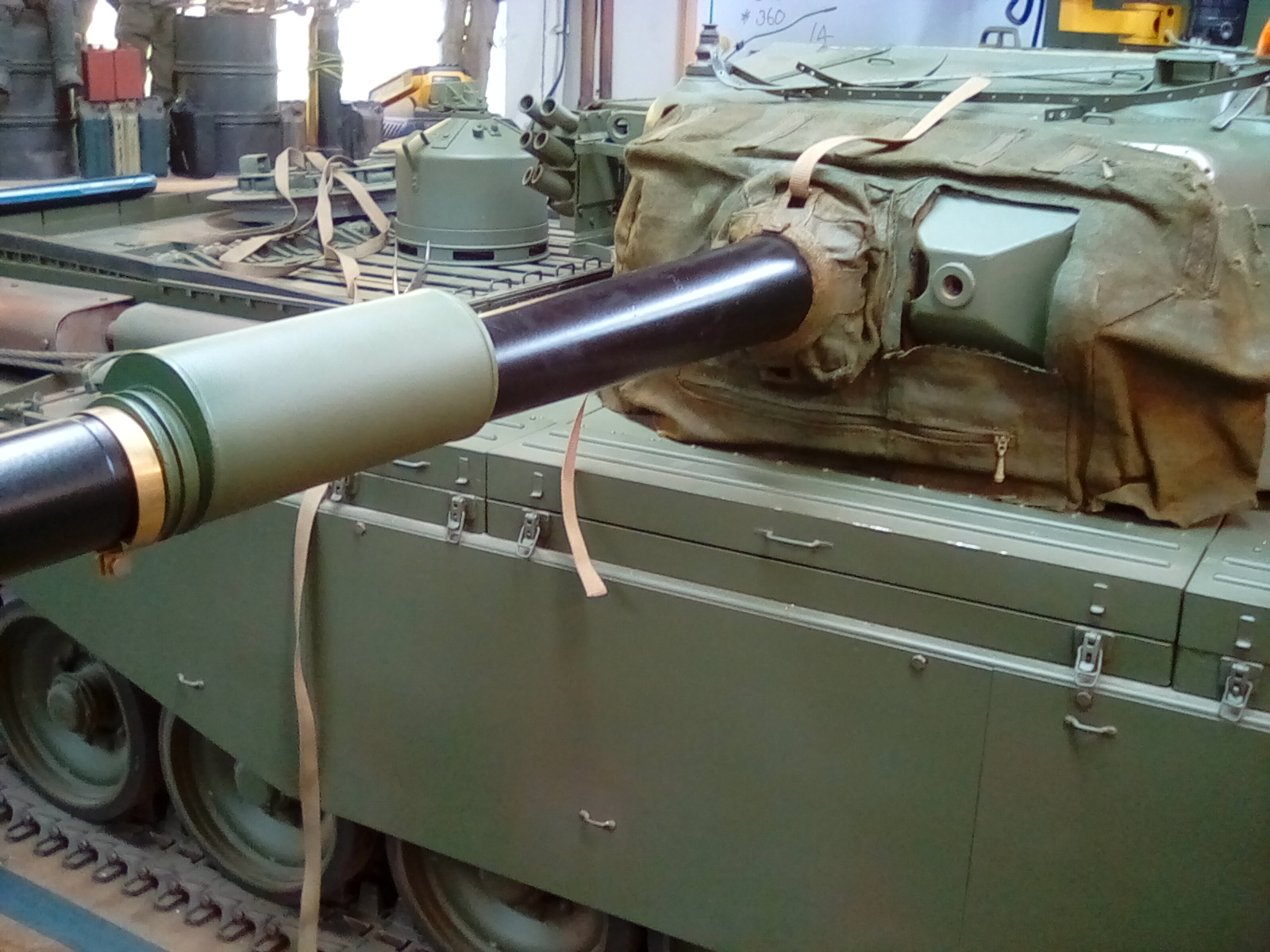

Bolting up for the last time ......I hope
