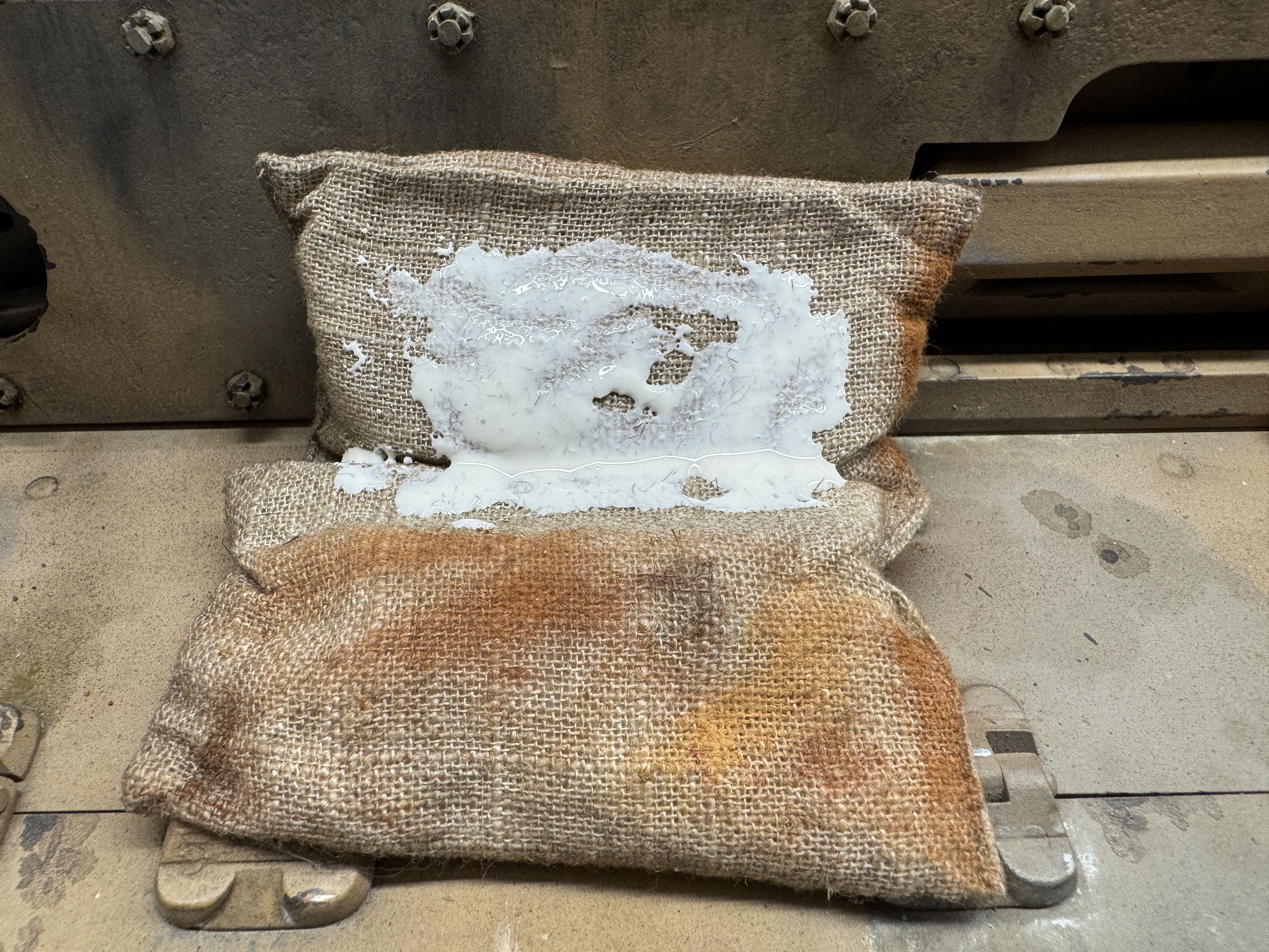

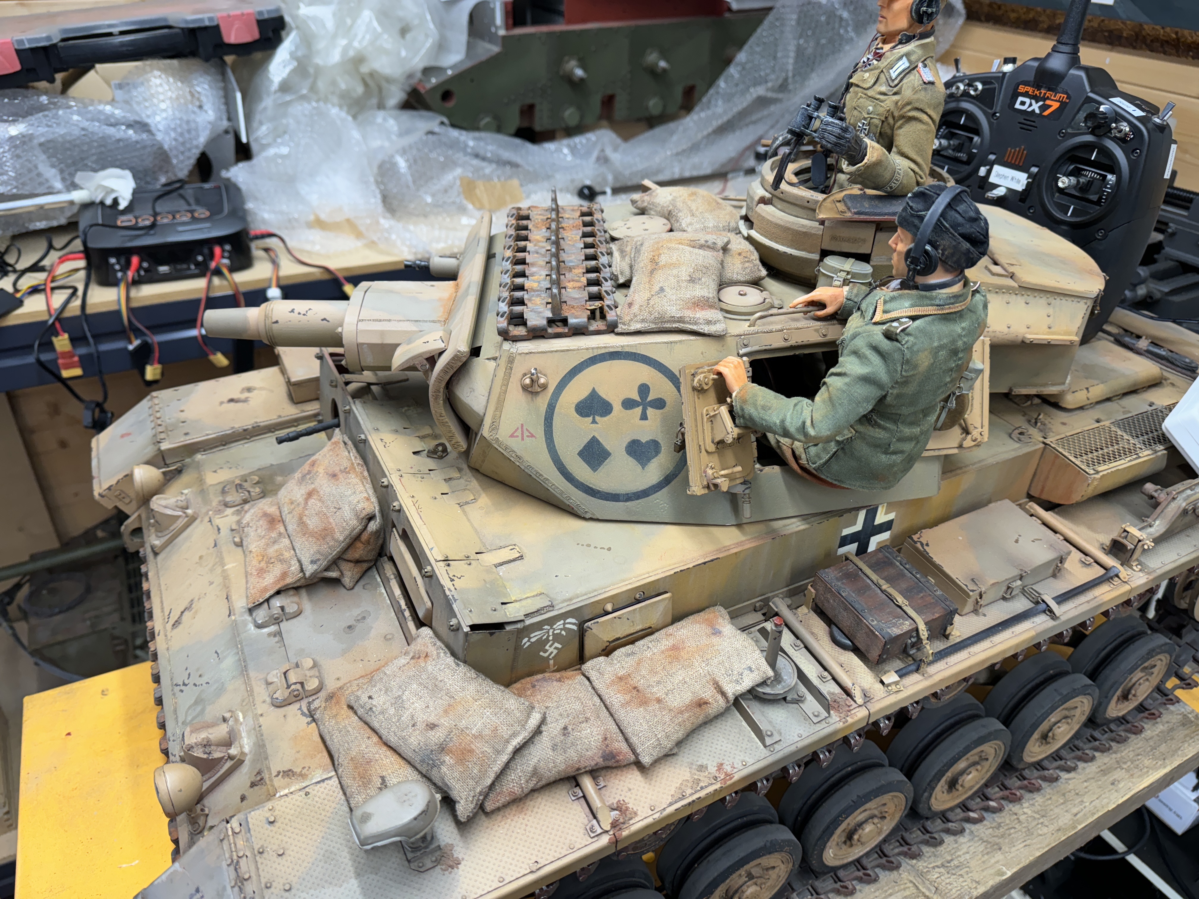

Stotten's Pz iii Ausf N has had an outing to Middle Wallop to celebrate its refurbishment. New figures, new spare tracks and the sandbags which appear on original photos of the tank in Tunisia.
The sandbags are close enough to scale size but sit awkwardly and look too pristine. To fix this, I gave them a generous coat of hair spray, which is the secret to getting any material based object to sit where you put it and to keep its folds and creases. I lined the tank surfaces with plastic bags to protect the underlying paint and weathering. Once they're dry, I stuck them together with PVA - this will help with holding them in position.
As with any weathering, it's about layers. The first set of layers were done with three shades of pigment. It's absorbed by the material so doesn't need fixer. The second layer is an oil based wash in a range of shades. Once they're done, knowing when to stop, the result is still a bit stark and unnatural. The final step is to apply a layer of dust - in this case a light, low pressure dusting by airbrush to bring the colours together and tone them down.
The effects after each stage are quite subtle. I've tried to get the white balance of the pictures sorted so they show under artificial light but I normally switch the lights off after each application to check in natural light .
Job done.

Naked sand bag before hair spray fixer
After a generous application
The hair spray holds the folds and shape
Sandbags fixed together with PVA

Final layer - light dusting by airbrush
End result
End result

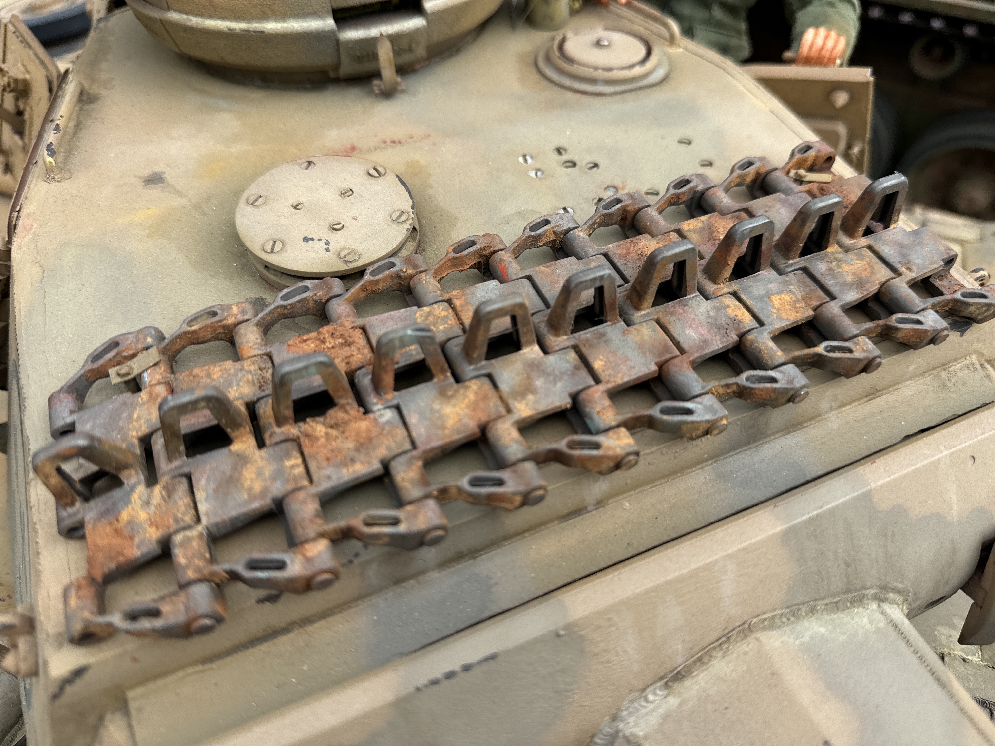

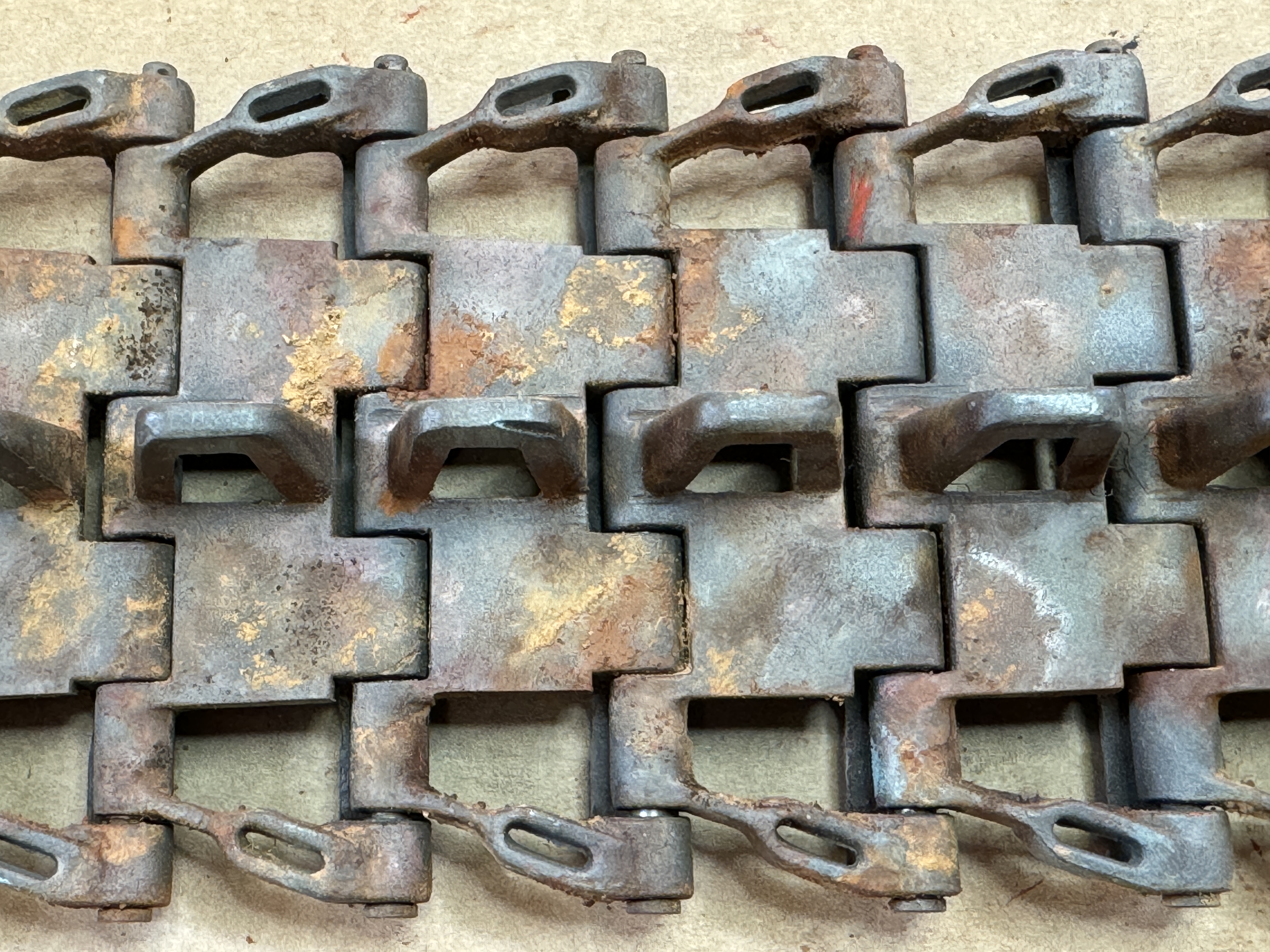

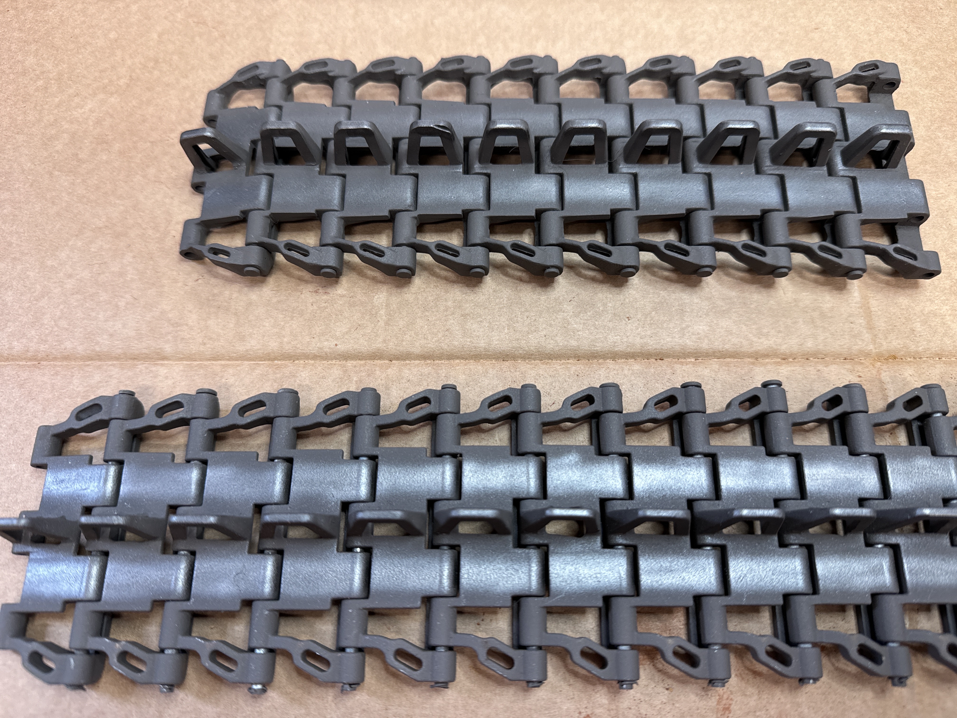

I upgraded the spare tracks on the hull toe plate and the turret top with Liam's outstandingly accurate Pz III steel tracks. This is how I weathered them. It's quite a time consuming process, as with any weathering, to build up layers of colour. The same process works for running tracks too, with the addition of a coat of satin acrylic varnish to seal things. The process stages consist of applying primer/base coat, silvering worn areas, oil paint rendering and pigment colouring to create a patina, application of terrain effects such as mud and, in the case of this Tunisian theatre tank, dust.
Bare steel track
Bare steel track
Red/brown acrylic primer coat
Silvering - looks unrealistic but will tone down with weathering
Oil paint rendering. The cardboard absorbs excess oil and makes the paint thicker so it can be more easily blended in.
Oils blended
Oils blended
Three hues of pigment applied
Pigments after fisxr

Ready to mount on tank

After light overspray of dust
Final look
Final look
