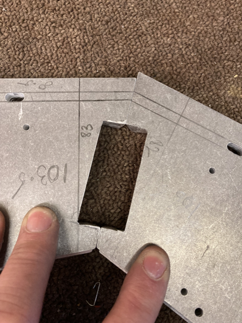

These are parts CK2405 & CK2405M - as you can see they are 3.5mm different in size. It must be wrong on the lower edge as the bolt holes do not line up on the larger part. I have no milling machine or access to one - any ideas?

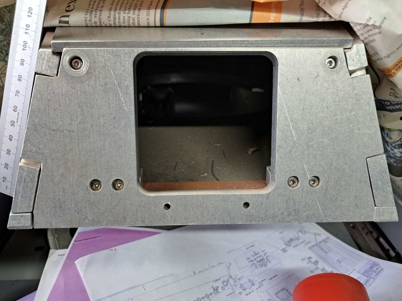

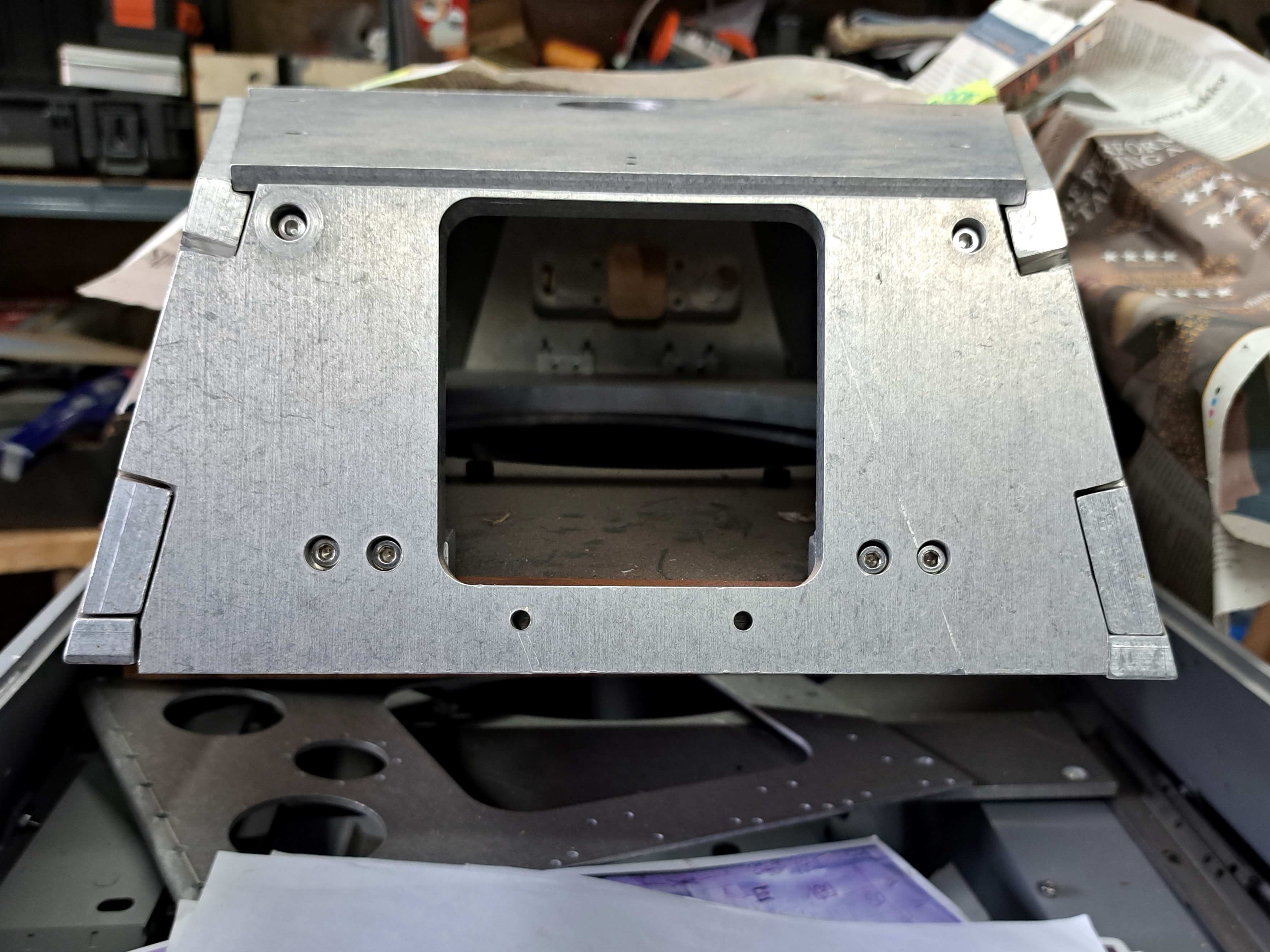

Thanks for the heads up, I have just checked my loosely put together turret, mmmh, interesting
Here is my before:- After adjustment:- I appreciate that there will be some more head scratching to come once I start on the build. I also realise there will be some power file work too.
BTW I used a wooden mallet to adjust things.
Charles
Charles

Hi Charles
Good to hear from you
My rubber headed mallet came in real handy to day but it will need more that to make the right hand side to be the the same size as the left hand size !!!

Charles
Looking at your picture for a while, your right side is much larger than your left side just the same as ours.
Someone must know how to resolve this as chances are all the 2019 KT kits had the same issue.
Mick
Mick

Re: KT 2019 #29
Charles
Looks like you have got yours to bolt together because you have not fixed it to the base plate.
On mine I can’t get it fixed as the bolt holes do not line up by - surprise surprise - 3.5/4 m
