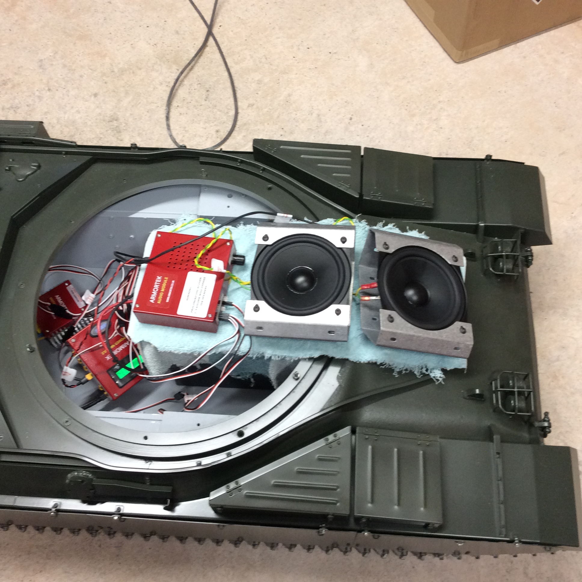

Motion, sound, recoil and smoke option packs arrived today. Test run on the bench and all 100% ok first attempt
Really pleased as I was expecting at least a little fettling!!!
A short video clip of her running in the garage

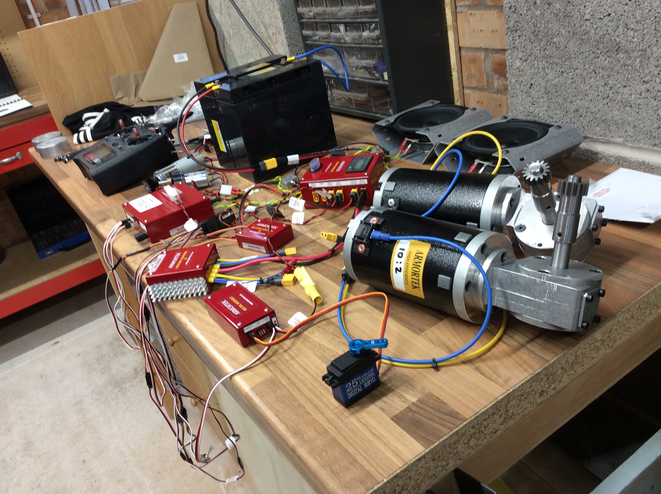

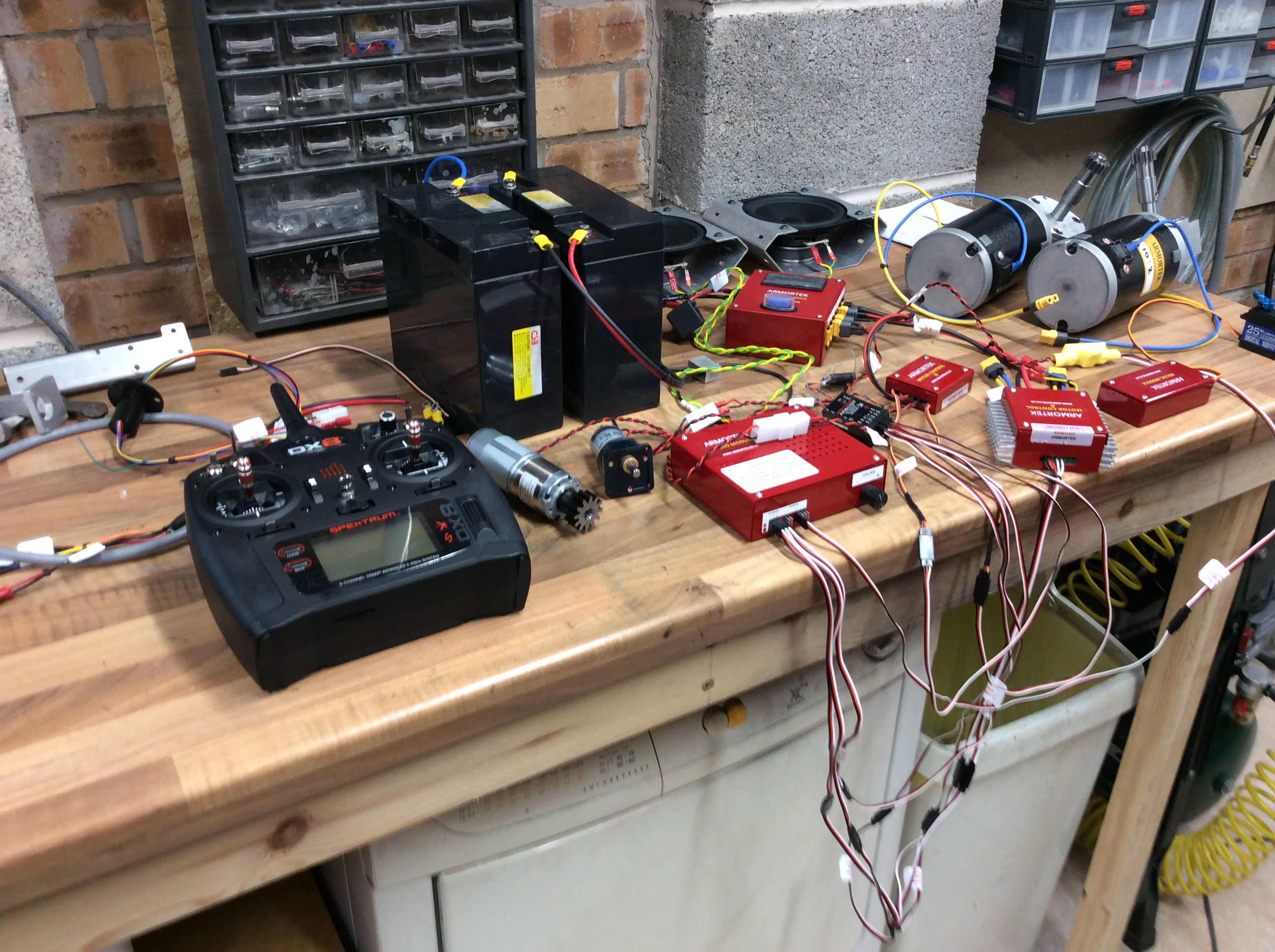

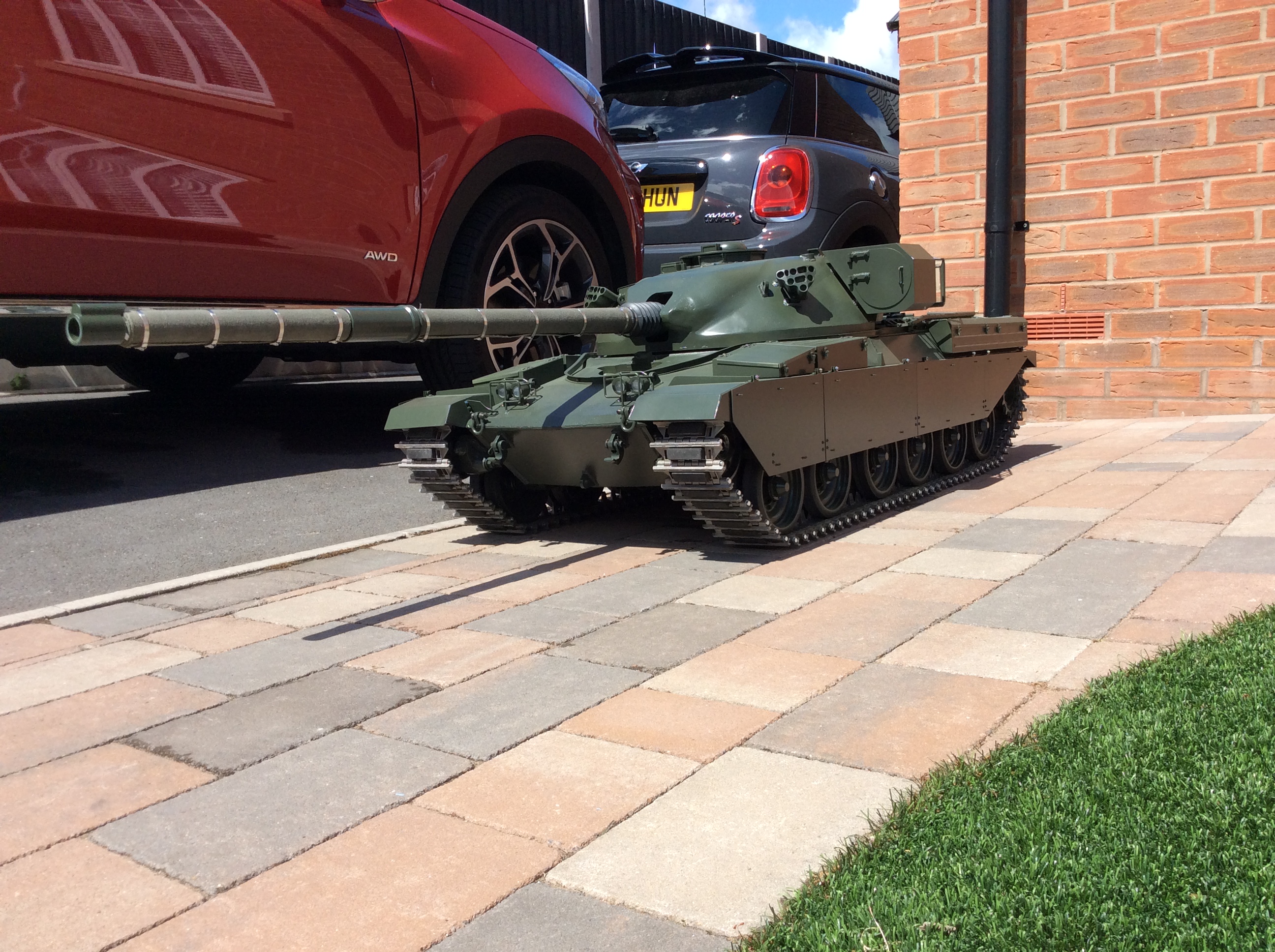

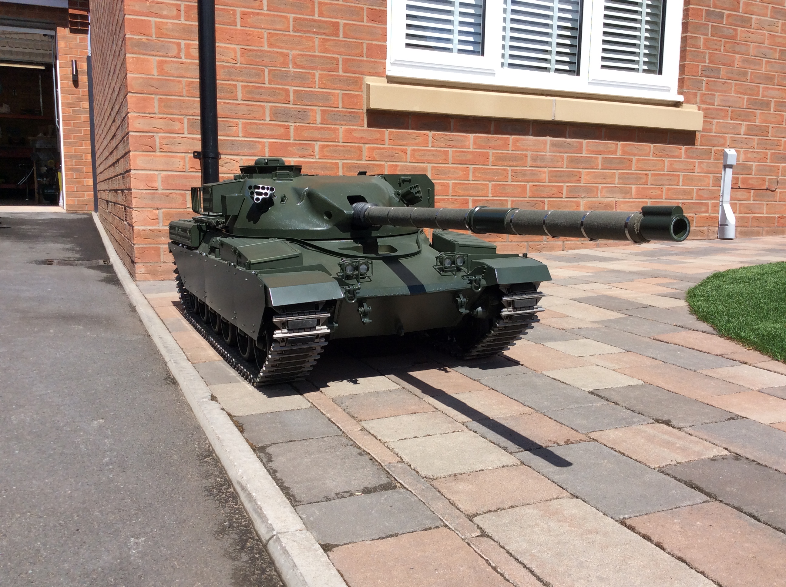

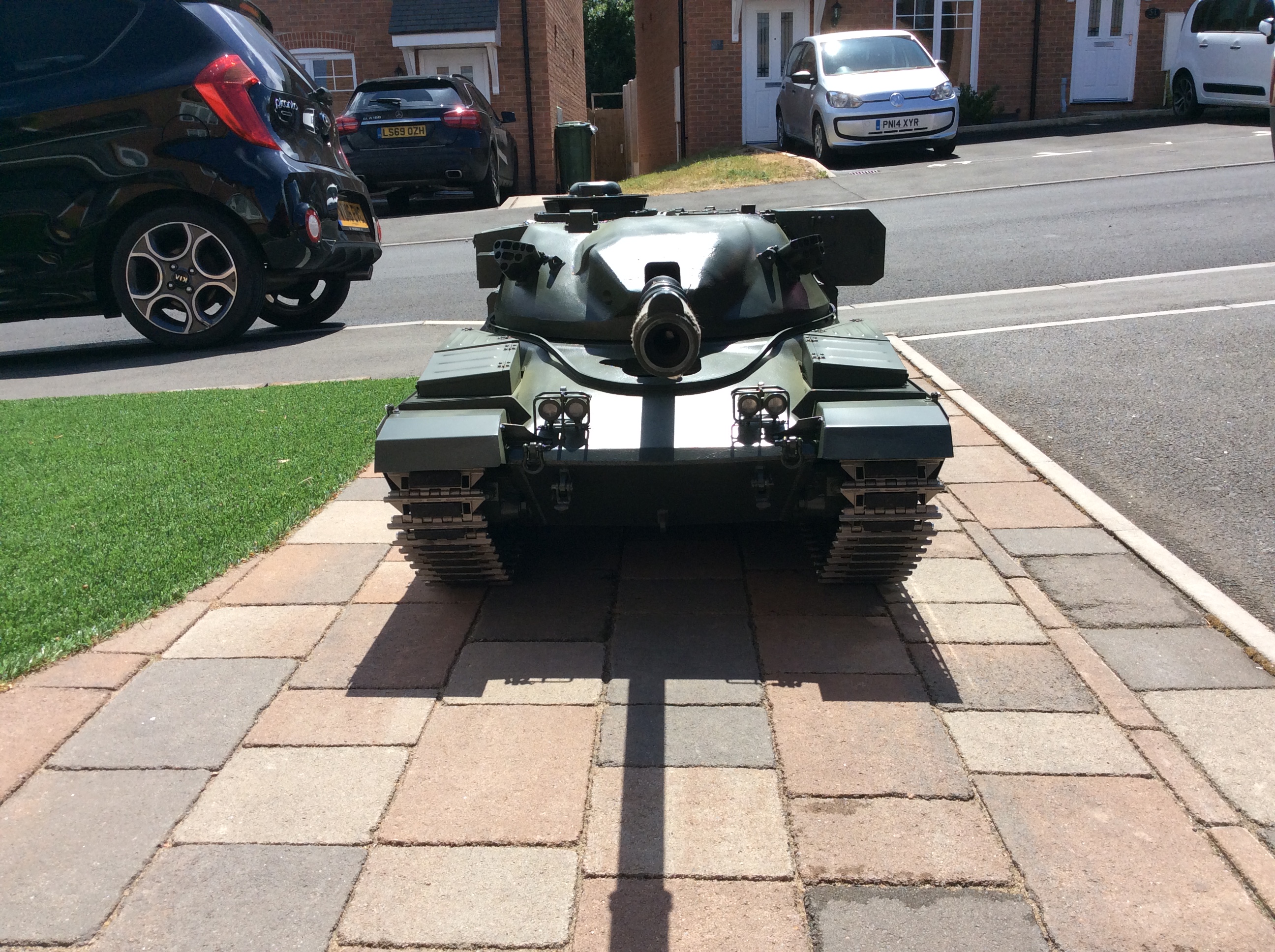

Oh dear I knew it was too good to be true! Had real fun today with the Red modules and the drive motor gearboxes...
Went for a run up the road, managed to get some video clips of the recoil and elevation working but...
The RH side drive motor gearbox started slipping, too much end float by the looks of it, causing the teeth on the bevel gears to skip past each other, will contact Armortek on Monday as this will need replacing.
The recoil works fine, but when connected you loose power to the drive motors. If you disconnect the trigger lead from the sound module to the recoil unit, then you have drive, but no recoil? Any ideas guys? When I tested the recoil on the bench I didn’t try the drive motors after connecting it so it was probably the same fault on the bench. So for some reason the recoil unit when connected to the sound unit, kills the power to the drive motors. You do still have the engine sounds accelerating proportional to stick control. As soon as you disconnect the trigger lead, all is ok in respect to power to the drive motors.
In addition occasionally when the power is turned off ant then back on, I have the turret rotation and gun elevation servos moving on there own out of control. If you turn it off and back on it’s ok? A bit worrying really, again any ideas? I see others have had this issue. Any assistance appreciated?

Thanks Manny. If I remove the 5 volt power supply to the recoil unit then the drive motors operate proportional to the sound but of course the recoil and flash don’t work as no power supply? Anyone else seen this issue?

From your short film in Youtube, I can see one of the motors labelled 10:2. Is the other one labelled the same?
Is this the gear ratio? If yes, I wonder why isn't it shown 10:1? If no, what is it?
