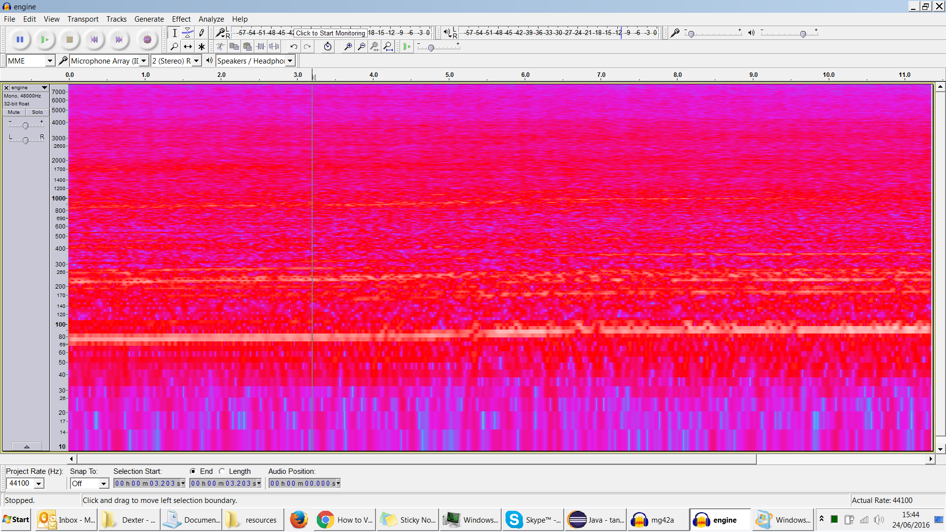

I could be seeing artifacts but the spectrum of 131 engine noise looks like it has a lot of energy at 80 and 200Hz.
131 engine recording spectra, log scale, 8192 window, audacity

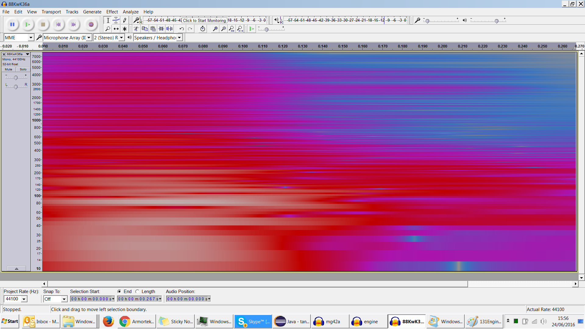

For the flak88 firing a lot of energy is under 100Hz!?
flak 88 firing spectrum
The 100mm diam speakers cut off at about 150Hz.

80Hz for the engine implies 4800RPM!? Could that be roughly right?

Doesn't it depend on the number of cylinders and how many cylinders fire per crankshaft revolution ?
I seriously doubt anyone has revved a Tiger engine to 4800RPM since the fifties :shock:

OK. I'm just digging a deeper hole for myself but... 12 cylinders at 2 revs per bang giving 80Hz comes out at 800RPM? https://en.wikipedia.org/wiki/Maybach_HL230 says max torque was at 2000RPM so maybe 800RPM is roughly right!?

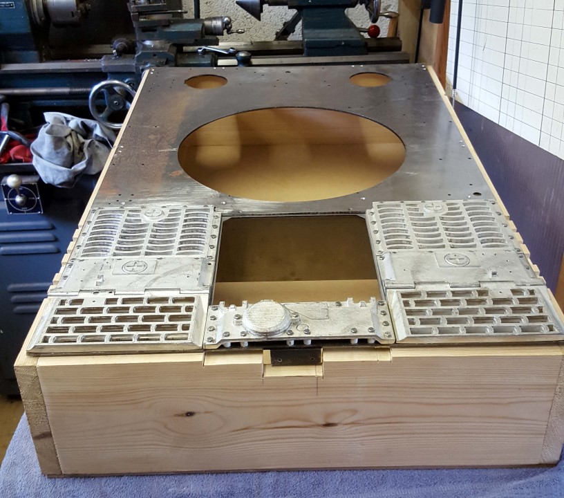

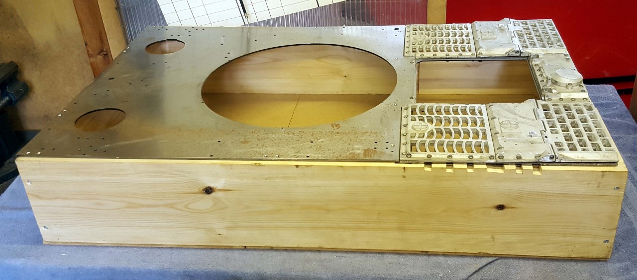

Stage 1 delivered to the South for the electronics expert.
Stage 2 in the North started in a hull mock up.
Don't know how others fix the handles to the engine cover but I decided to braze them in place. Shown before being ground flat.

I think the instructions say to glue the the handles in place, but brazing them in place works even better :wink:

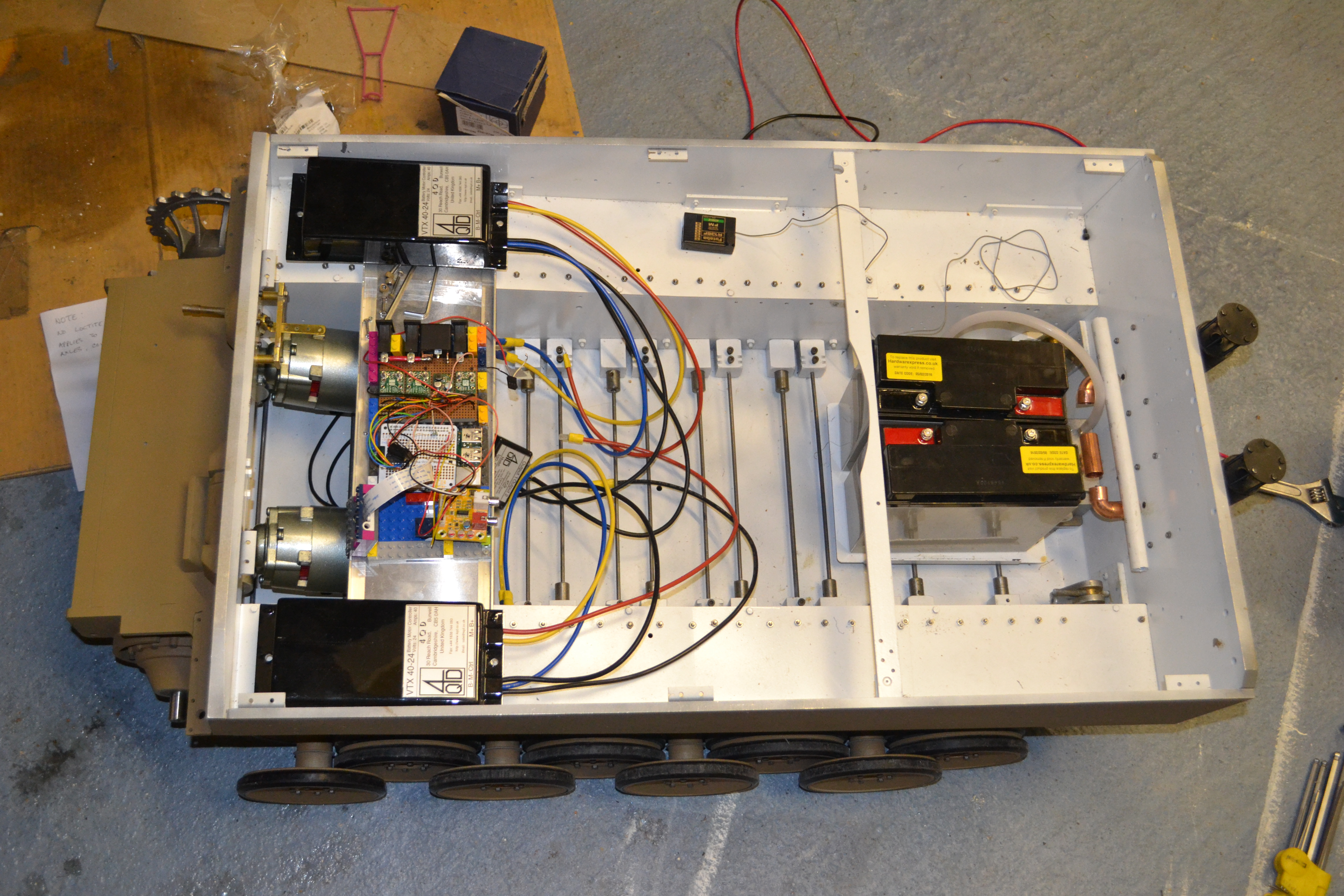

Thinking about another layout now I've seen sense and I'm getting the standard speakers.
Layout V2
Layout V2
Electronics being near the switches (under the front hatch) and camera having short route to front seem good. Downside is longer power lines to fuses and relay? Also not sure what RF the power controllers have.
