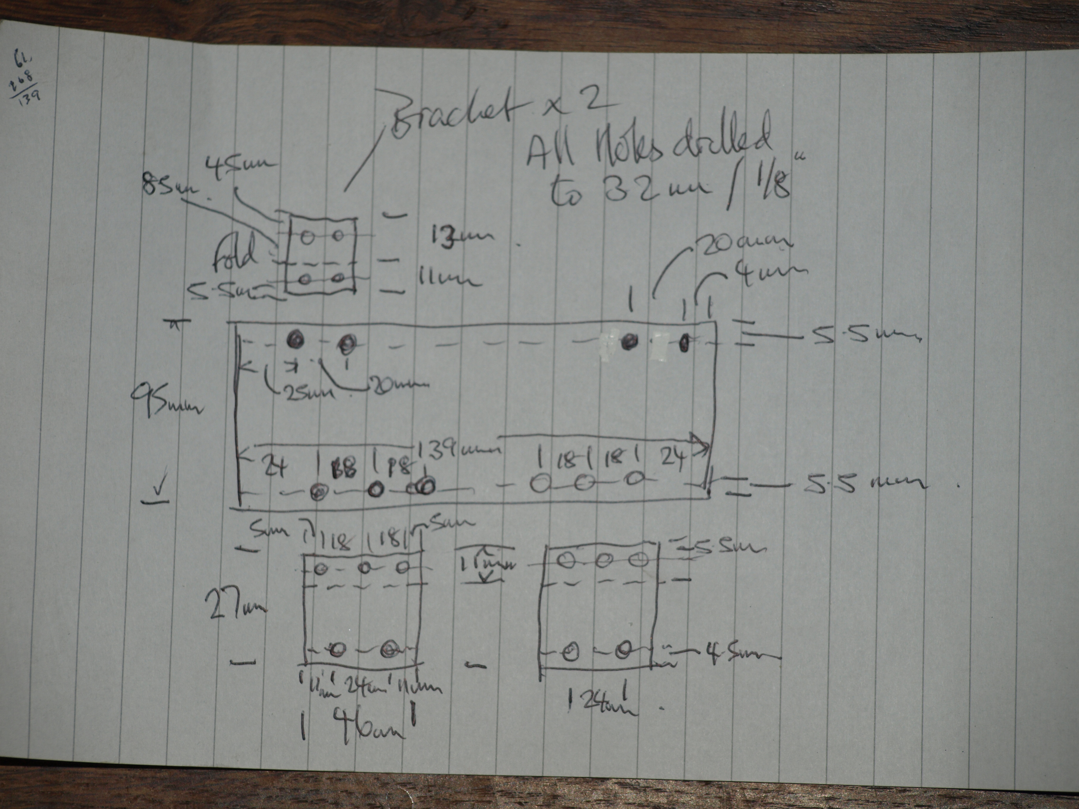

This debate about rear armour is really going places ! The pictures of 'Grit' posted up by Stephen White are also extremely useful.
It would be great if you could provide some drawings of your modifications (both the armour plates and the camouflage frame brackets, unless they're already in the kit). Unfortunately my metalworking skills are non-existent (as they were at school over 40 years ago ) but, fortunately, my brother-in-law is a classic car restorer so I'll pester him for help. I think I have enough knowledge to bend and cut the exhaust pipe appropriately, and to create a hatch in the fuel tank roof ...... we'll see.

A quick email, herewith are two photos of my sketch plans of the armour plates I have made. I would recommend that they are used as guidance for your build as the exact dimensions will depend on how you attach the fuel tank, especially the top armour. I would recommend making it bigger then trimming it to size.
Please let me know if a hard copy is needed and I will post! Steve-

Very generous to post these details Steve. It is just this sort of helpful advice and sharing of research and work that makes this such a great forum. Loving your build and the others on the forum.

Very generous, and very kind ! Now I need to find an expert to figure this out for me .........

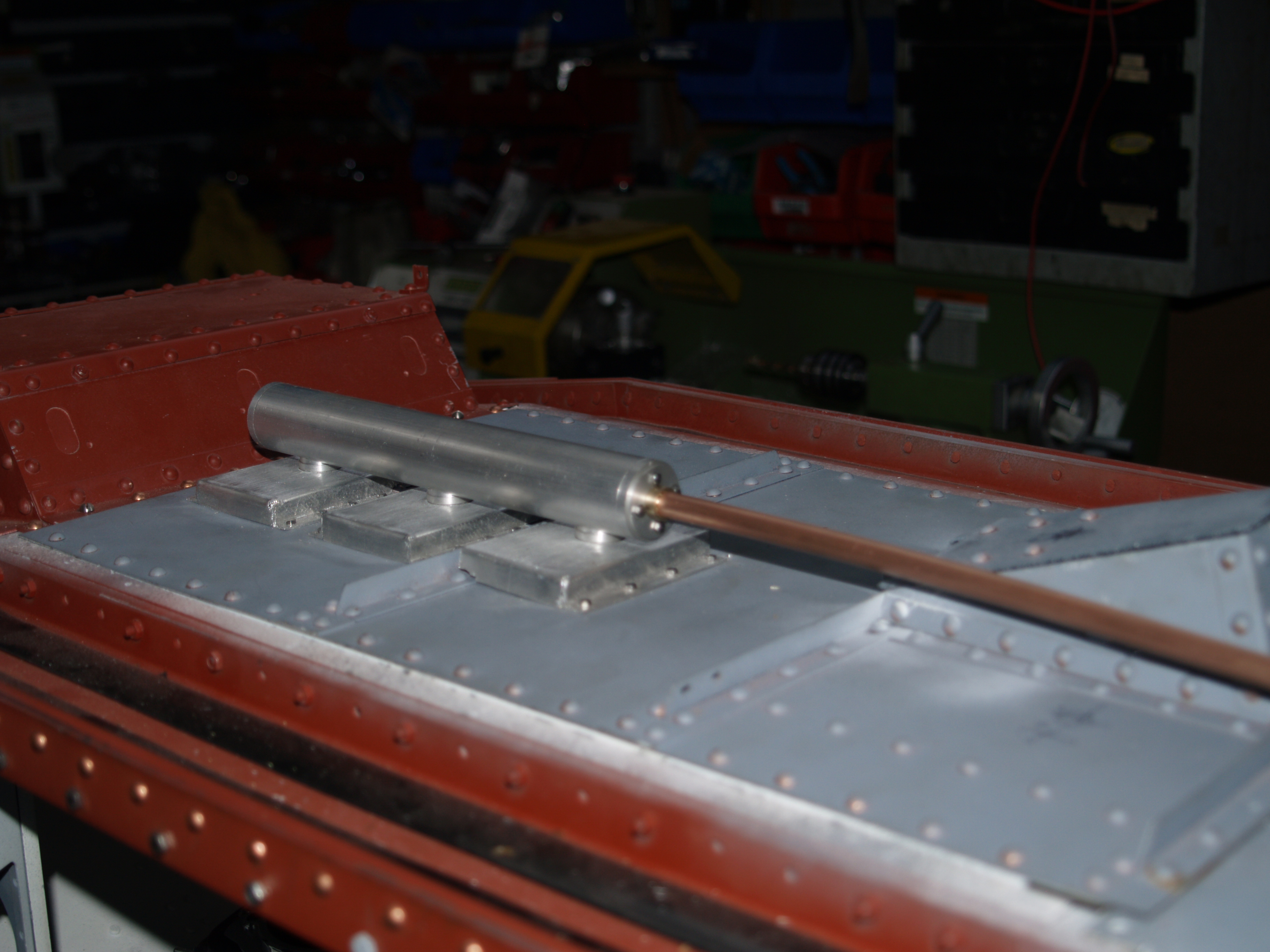

The last few days have been taken up with devising a way of disconnecting the Exhaust Pipe so that the top of the tank can be removed. The pipe is sealed with an 'O' rings in the Exhaust Manifold and the connection box I have installed under the cover in the Spud Box. This is going to need some more tuning. The principle is that the pipe should be able to slide backwards out of the Manifold and then be pulled forward to clear the Connector under the Spud Box Cover.
Having fun! Steve
To make things practical I am going to have to leave out a few supports/brackets for the pipe.Having fun! Steve
