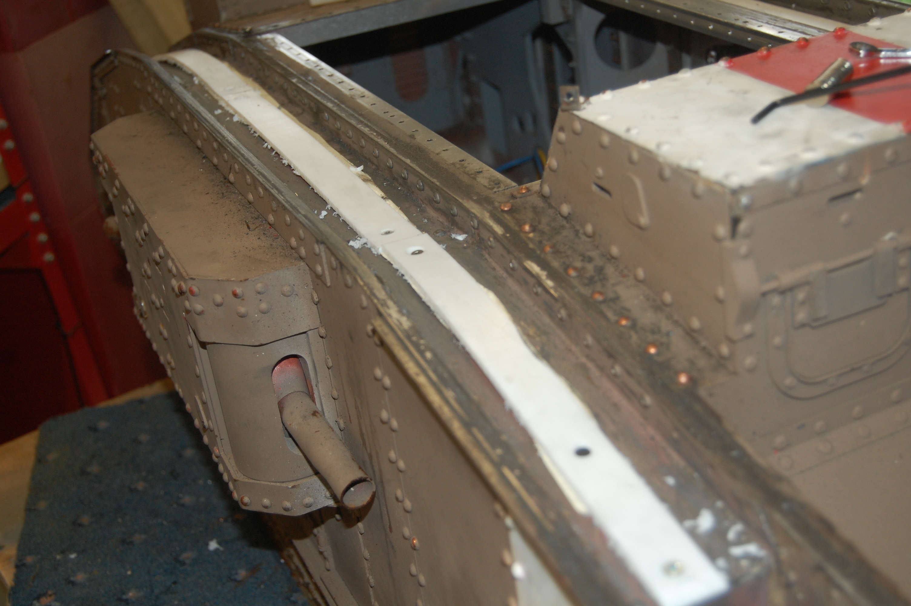

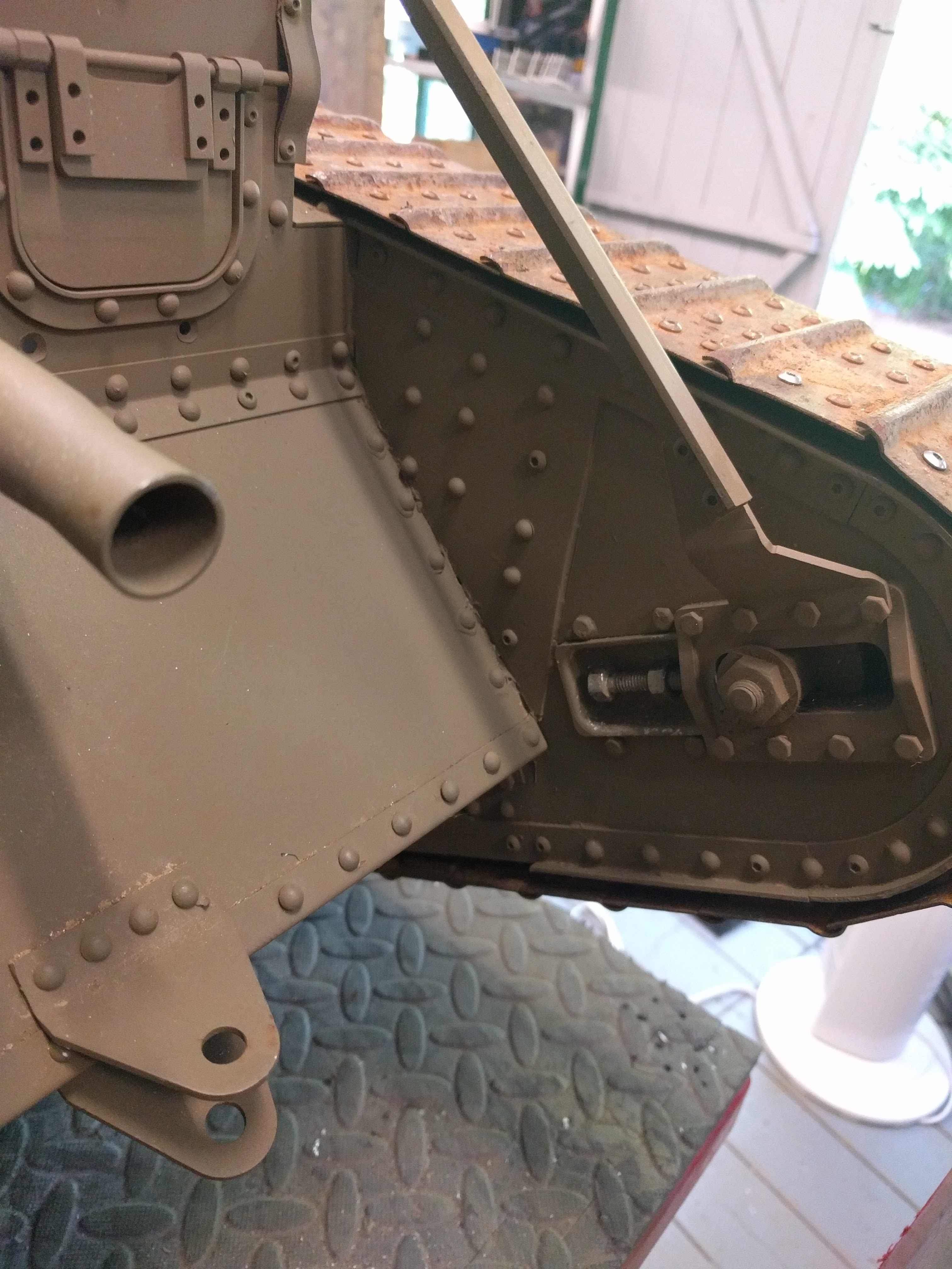

This wear looks about the same as mine. My hope is once the edges are taken f there will be no more appreciable wear on the side plates. However there is noticeable wear on the rollers and on the rubbing strips, both areas that will need a definite eye being kept on.

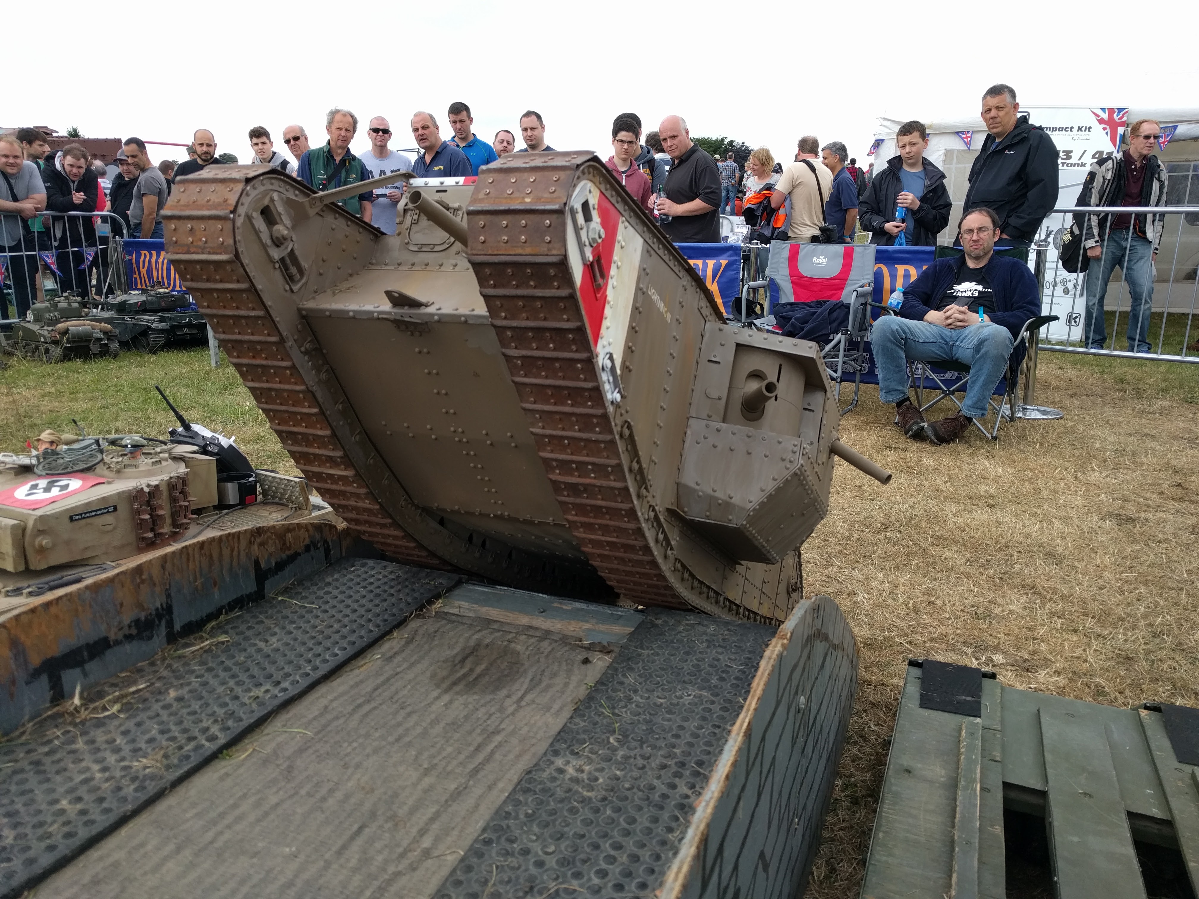

After a successful Tankfest where all the maintenance paid off with an issue free weekend. Turns out the Mark IV is a good climber

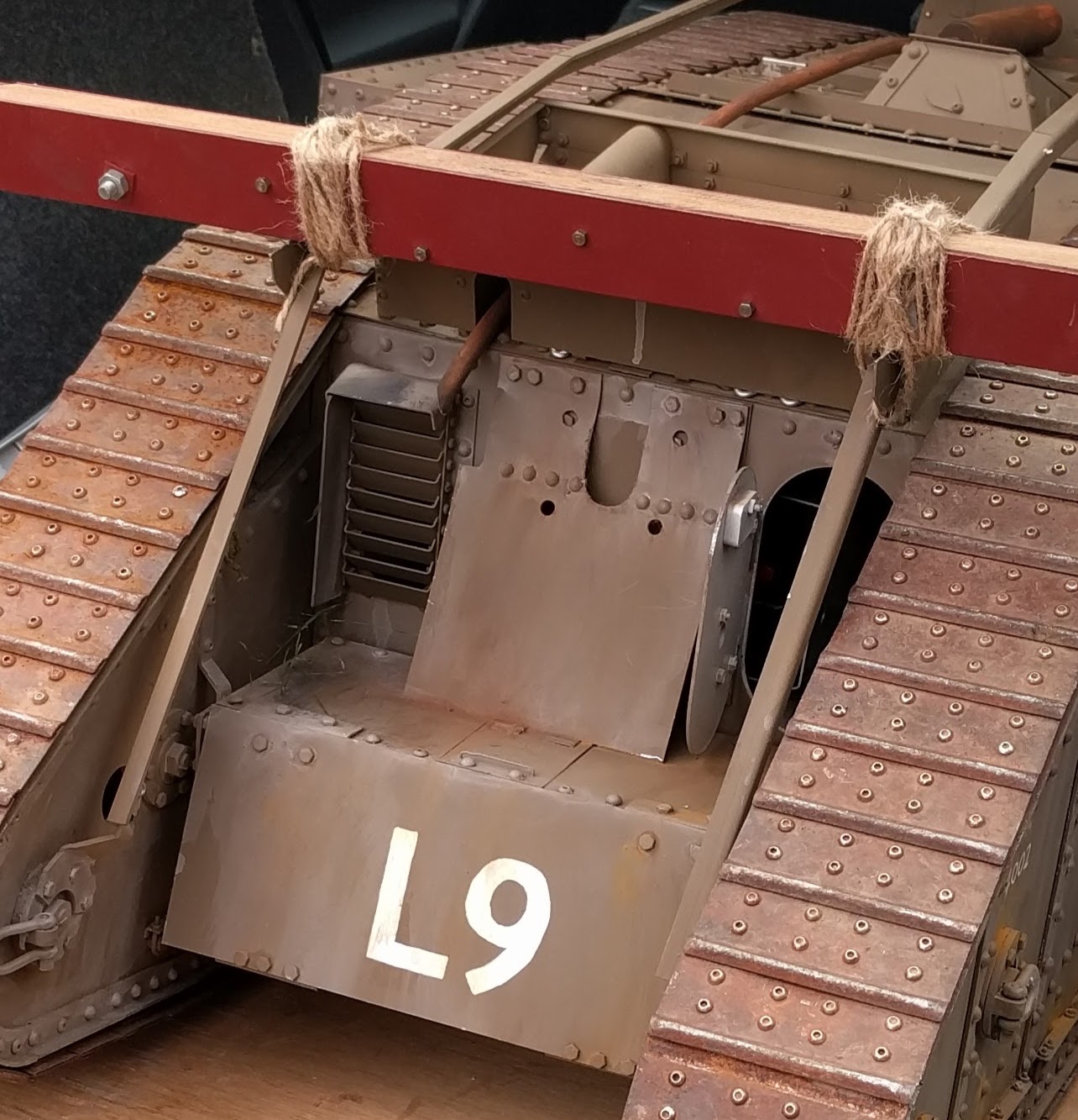

Just to chronicle what I added as opposed to just fixed: The upper rear armour plate went on, as did the guard around the rear vent
At the front I added the extra front horn armour, just got to add the headlight brackets at some point.
I also started weathering to break up the flat brown finish - still bit of a work in progress...

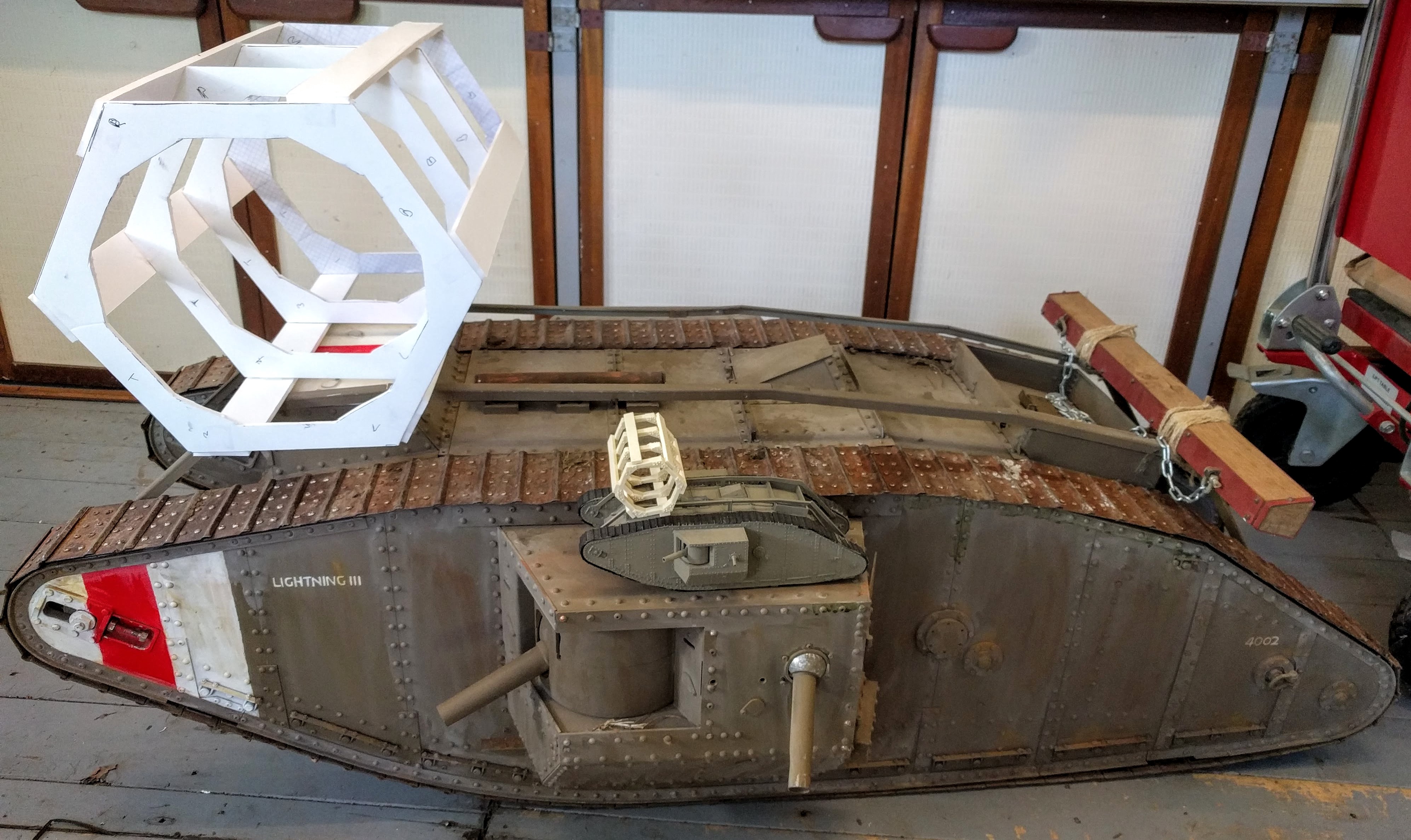

After a winter hibernation 'Lightning III' had a good run at the SW Model Show. Whilst the bulk of my time is going to go towards the Quad once things warm up I have one more addition for my Mark IV. My choice of tank rules out a fascine but I have had an idea to do it's replacement, the Crib. For starters I got a 1/35 version so get an idea of the dimensions then upscaled it to 1/6. With the dimensions sorted out I decided to do a prototype in foam core to get an idea of how it would look on the Mark IV. There are some changes to be made and I still need to figure out how to get the design made up in wood (and what wood to use!) but it's a good first step.
Now if only I had some woodworking skills....

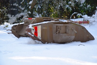

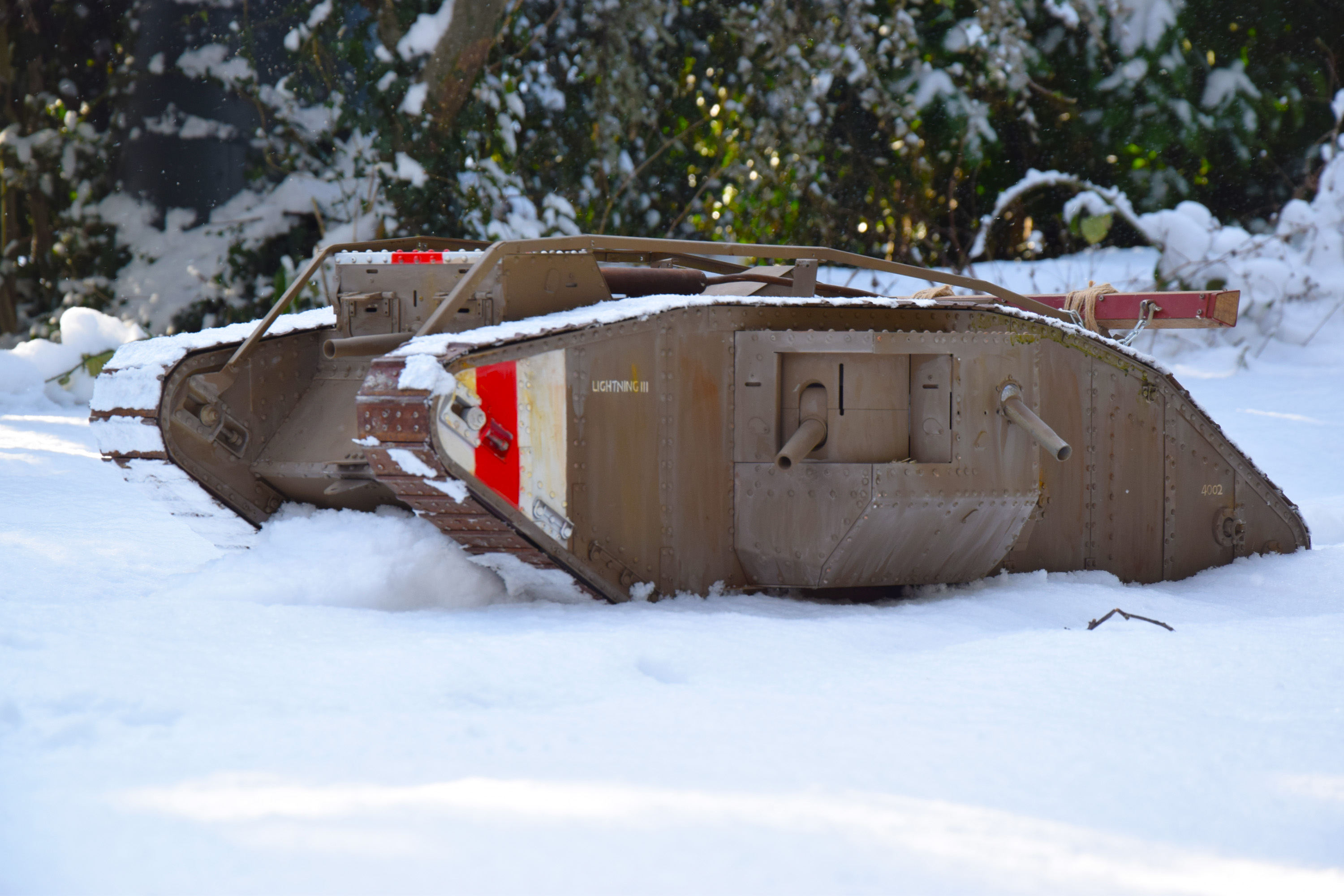

So the 'Beast from the East' gave me an opportunity to test the Mark IV versus snow. Going along was no issue at first but deep snow did finally cause an issue where the lower plate started acting like an inefficient snow plow so I backed off after a photo op.
Also, clean-up takes a lot longer when your tracks go all around the hull!

Re: Mark IV No. 35
It makes you realise how easy it would be for the real Tanks to end up with themselves perched on top of a mound/ridge of mud with the tracks just keeping turning with no grip. So be thankful it is snow, not mud you are removing!

From e-bay I ordered a sheet of 3mm thick PTFE. Im going to bolt some strips of it in place of the rubbing strip. As its a bit thicker than the existing rubbing strip it should lift the track just clear of the top run and clear of the screws and rivets on the top panels that cause jamming.

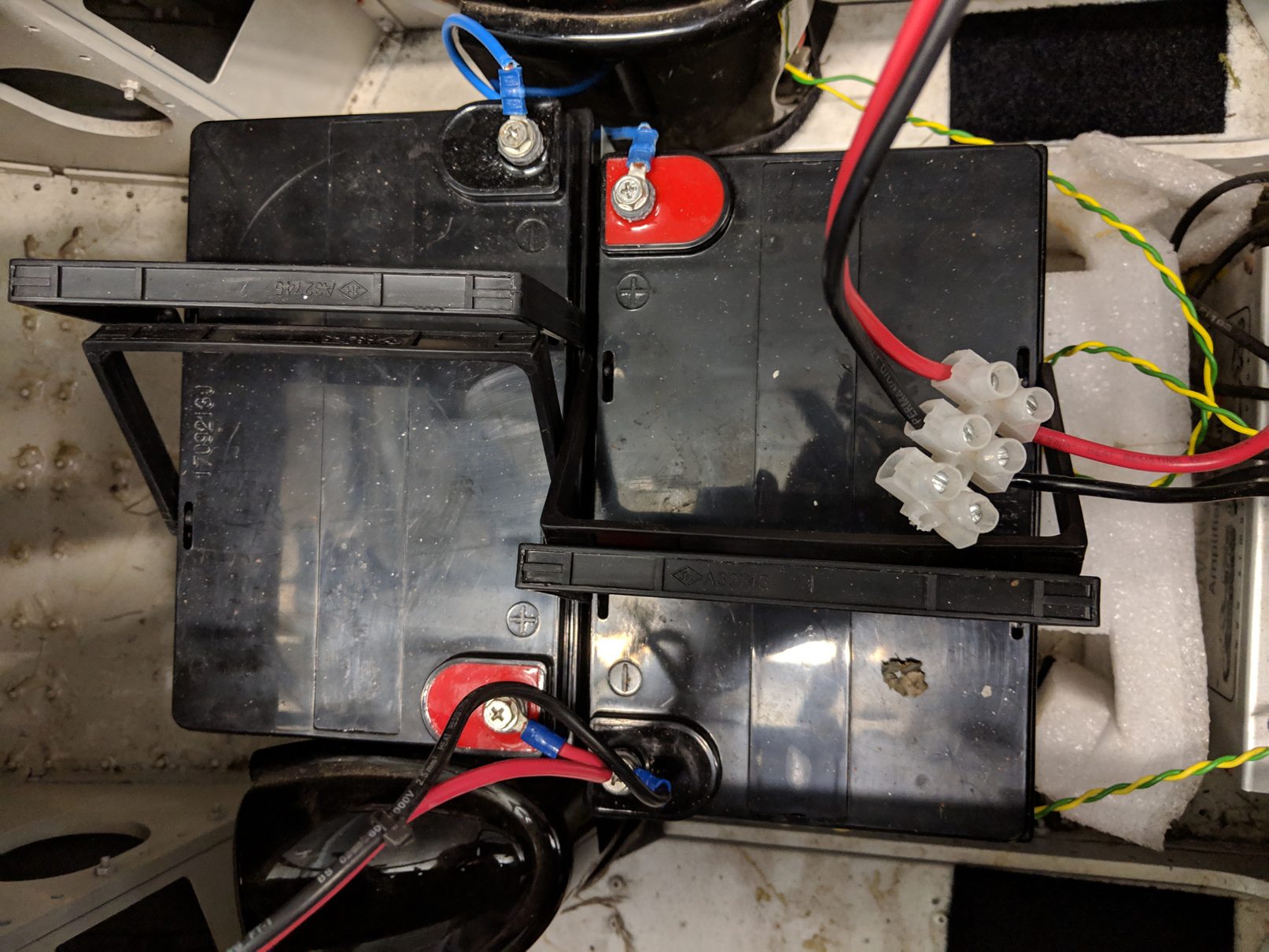

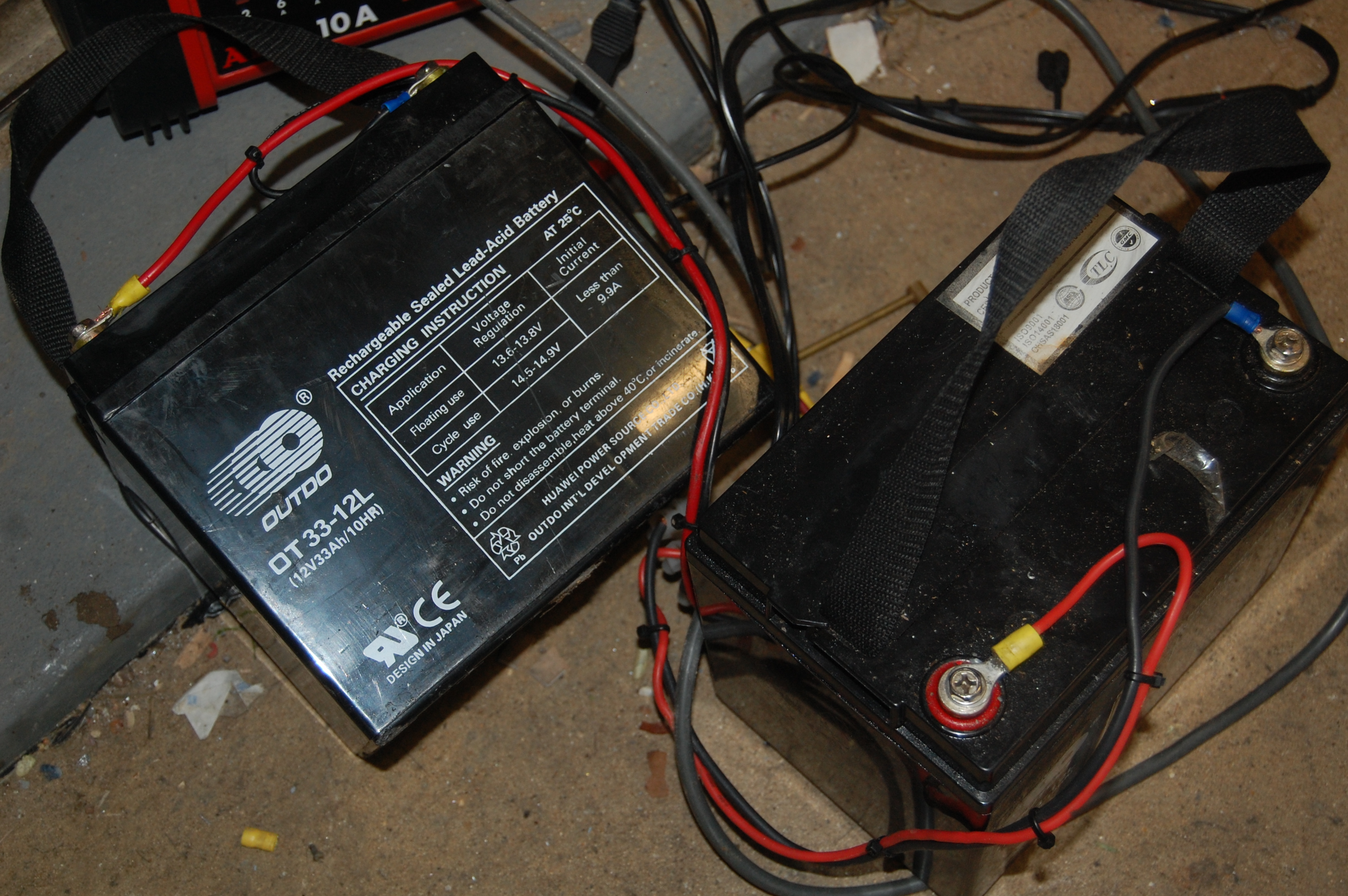

The image is ot the two 'Monster' 12v 33 amp batteries I use. They are for small golf carts or invalid chairs. They give me good service and as they are large have plenty of capacity.
Pete

I currently have two 32Ah batteries as a result of my power consumptiion issues and aslo in frame is the cable to the power module and the patch job where the wires melted together. It's good for now but I can't leave that in as a permanent thing, can anyone make up new wiring?

As I mentione before. The PTFE sheet I bought on E-bay seems to be working .
I cut it into 20mm wide strips and bolted it to the track runs using M3 Countersunk screws. As I hoped it did raise the tracks clear of the hull. So far I have only tried it with the tracks clear of the ground and it seems to work quite well, no rubbing or catching along the top of the hull. It sounds a bit 'clanky' but I think that may be due to no weight on the tracks and wearing in of the front and back edges of the PTFE.

Here is an image of the PTFE Strip in place
