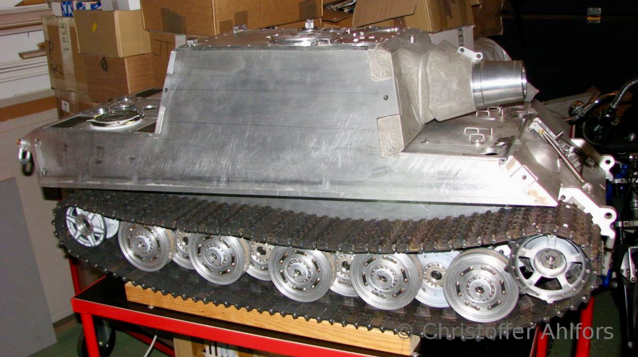

Re: My Jagdtiger by Per Sonnervik
This thread created by late Per Sonnervik (RIP) was too old to show any photos...
Even a later photos website created by Christoffer Ahlfors https://tanks.lindak.se/#collection/ee9 ... b1142f25d2 is no longer available , except a single photo I have saved :
Fortunately I have also saved a website regarding his JT drawings :
https://www.panzerbasics.com/panzer/02_ ... dtiger.htm
regards,
