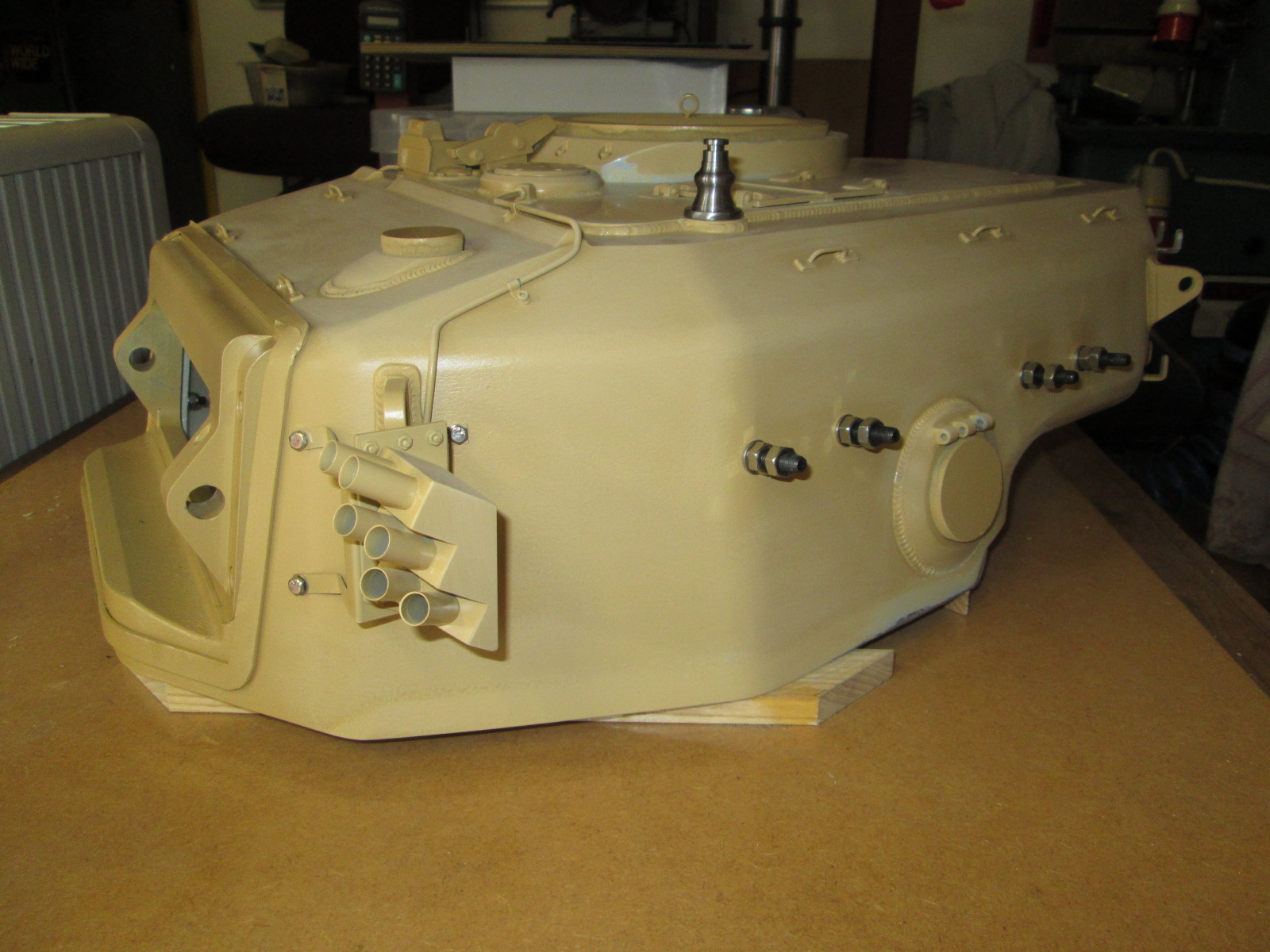

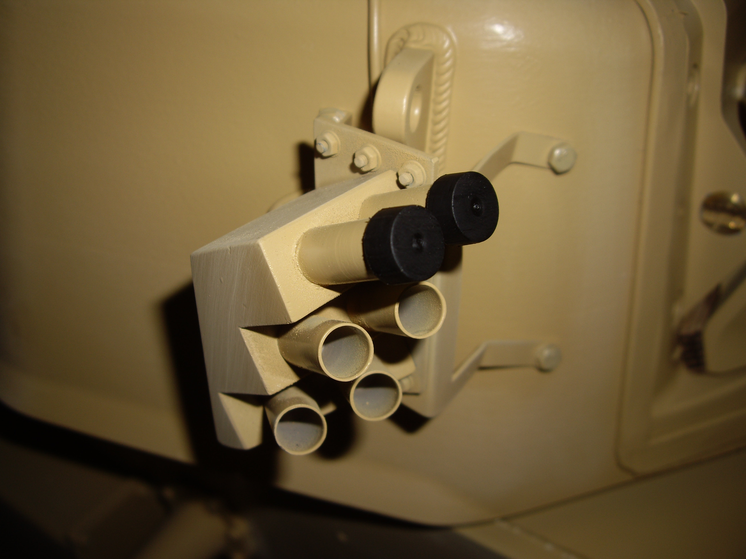

I have been busy making dust cover caps for the smoke launchers today, a bit of a Blue Peter job but they look Ok and I will post a picture when they are done to see if anyone can identify the source.

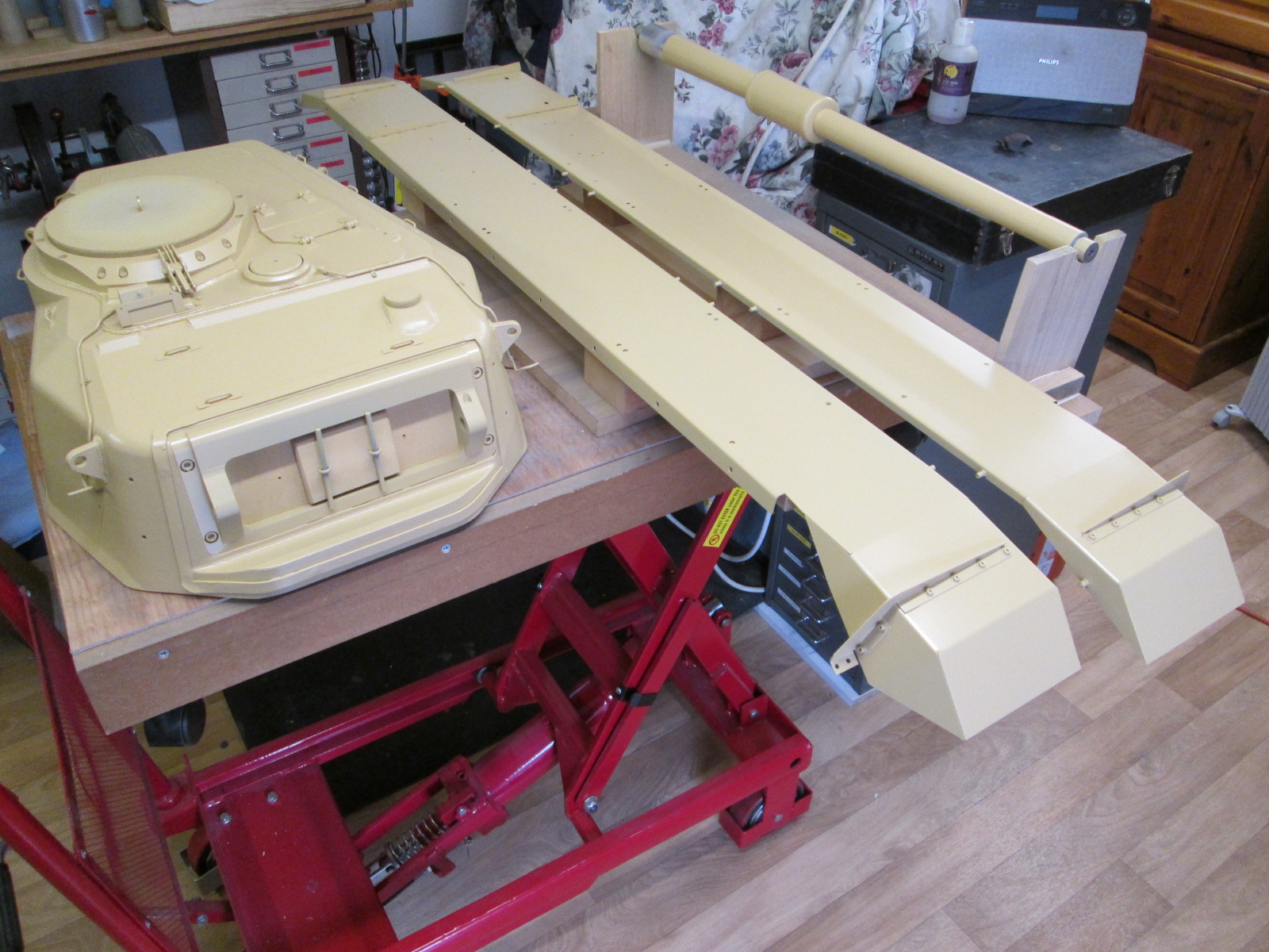

I have cleaned up the paint problem and I'm going to let the whole turret cure thoroughly for a few days before I attempt to paint it again. If it fails again then maybe I will need to strip more paint off. I did chat with the paint spray shop and they suggested using a pure thinner rather than the methanol based one I had used. I will report back when I have some results.
I spent the afternoon modifying my build table to take the hull with the suspension attached as I am going to start building up a little more now.

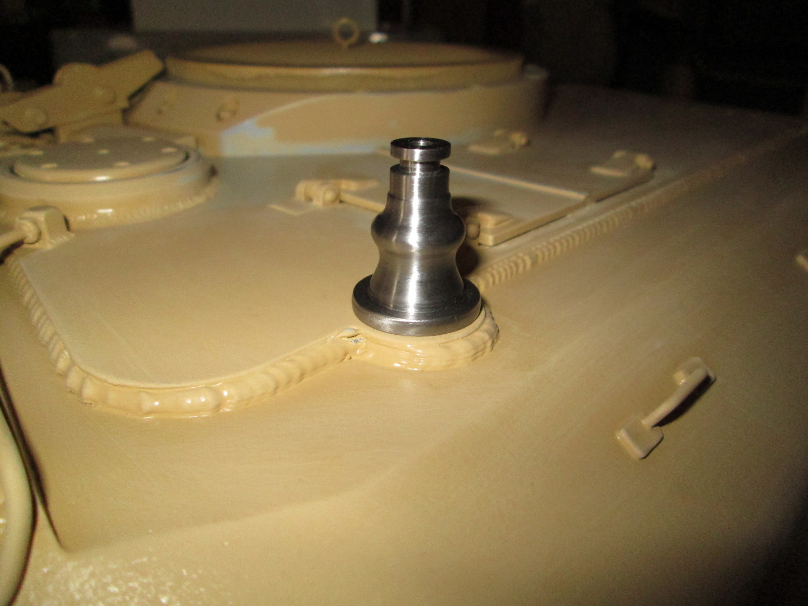

I also made a radio aerial base from steel on the lathe and wonder what you guys think? I have attached an image so let me know if it looks right. I want to make the inverted funnel shaped base too and I am currently working out how I will turn it on the lathe. Need a close up photo to assist though. Work is about to get in the way of my hobby for a few days so I will update you all when I make more progress.

Looking really smart Mick, I'm very impressed with your build to date.
No idea what the tube covers are, they look like small plastic lids although I can't think of anything small enough.

I put the turret together to get an idea of the paint colour and think I am happy with it.
The track guards are well on their way and I have spent a bit of time on the exhaust system, making some new steel pipe fittings so they can rust naturally and look a little more in keeping.
The warm weekend was spent painting engine hatches and other sundry bits and bobs which are now stored away again ready for construction (or as the old Sheffield term for an assembler of items goes; a bit of putter togetherer action)

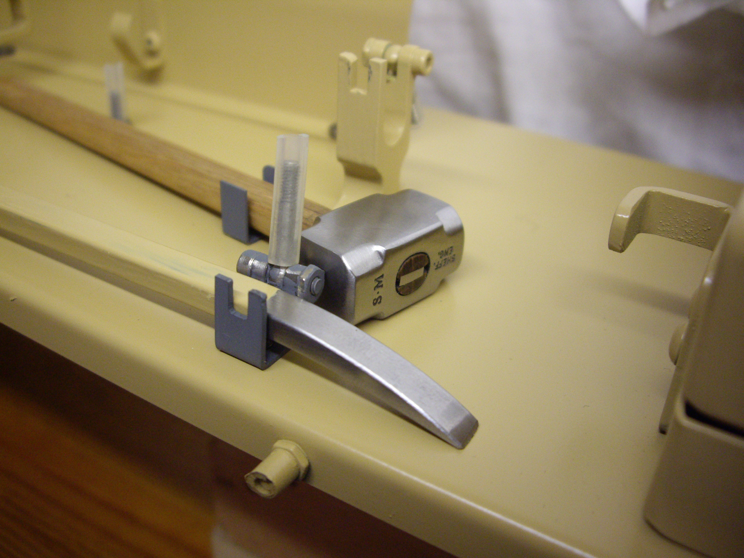

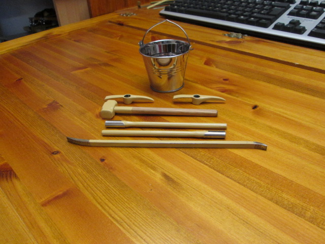

I have been doing a few little bits and bobs and have made a new sledge hammer and pry bar for the tool set from steel (not entirely happy with the cast items which, although good, don't quite do it for me). I am on with the pick heads and shafts now then will do the shovels and maybe an axe.

Continues to look great Mick, and nice to see one not in green.
You never did let on about your smoke discharger covers...,.,...?

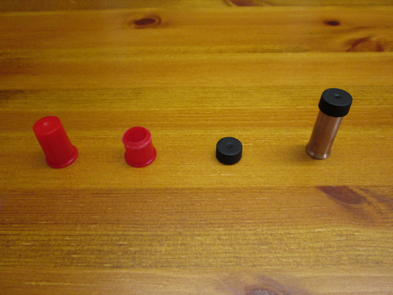

the smoke tube covers was just one of those lucky finds when you see something innocent and spot the potential in model making.
In short whilst injecting a diabetic dog with insulin (No I am not a vet, just a handy son in law who does not mind giving jabs) I noticed that the covers for each syringe were cast plastic and may come in handy for something, sometime. I kept plenty of them and after much tinkering found that they fitted the smoke tubes.
I will post a before and after photo later that shows the transformation process.

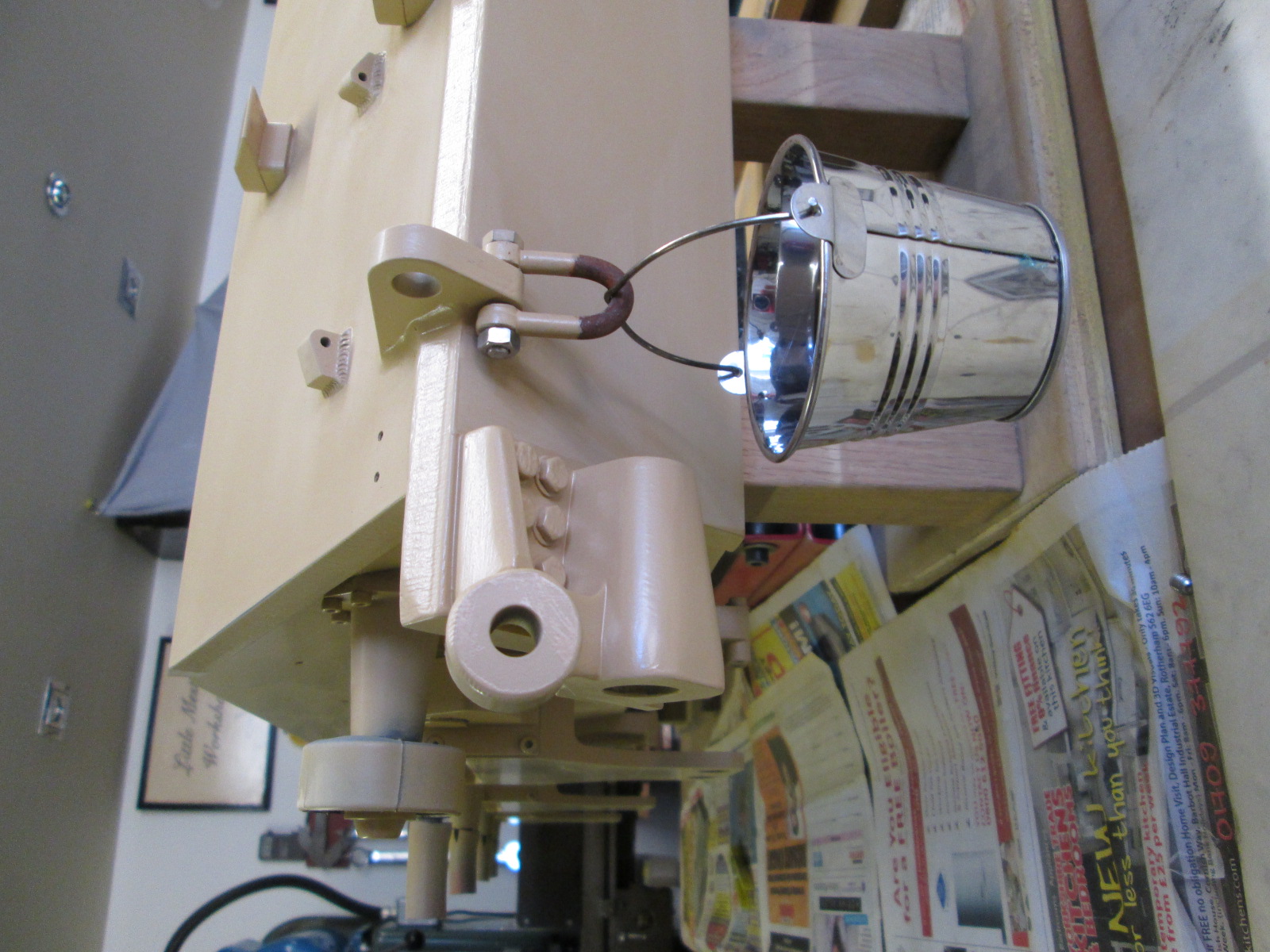

I also found a miniature steel bucket that is not too bad scale wise for the 1/6 tanks at a local cook shop of all places. Could be good for accessorising a model. Again I will snap a good photo and see what folk think.
Tools have been completed now except the shovels, which need a bit more head scratching to sort out the process before I start working on them. I am pleased with the new tool set and it gave me a nice way to pass the hot weather when painting was a no no due to sunbathing neighbours (I know its a desert colour but a sand spray tan was not popular down our way).

Been snapping away and took some images mentioned in my last mail.
Hope they will show the smoke tube covers modification clearly, it was a simple job of making a short mandrel to hold the original cover in the lathe and then "part off" the cap with a sharp knife tool. Bit of a rub with scotchbrite to give a key and then paint matt black. I also took a pic of the tool set as it stands, actually lighter in weight than the cast Armorpax parts, which may or may not be an issue but I think will be of benefit not to be sitting on the trackguards. Note the little bucket, may be a little big but looks Ok for £1.50 That's all for now but more when I progress.

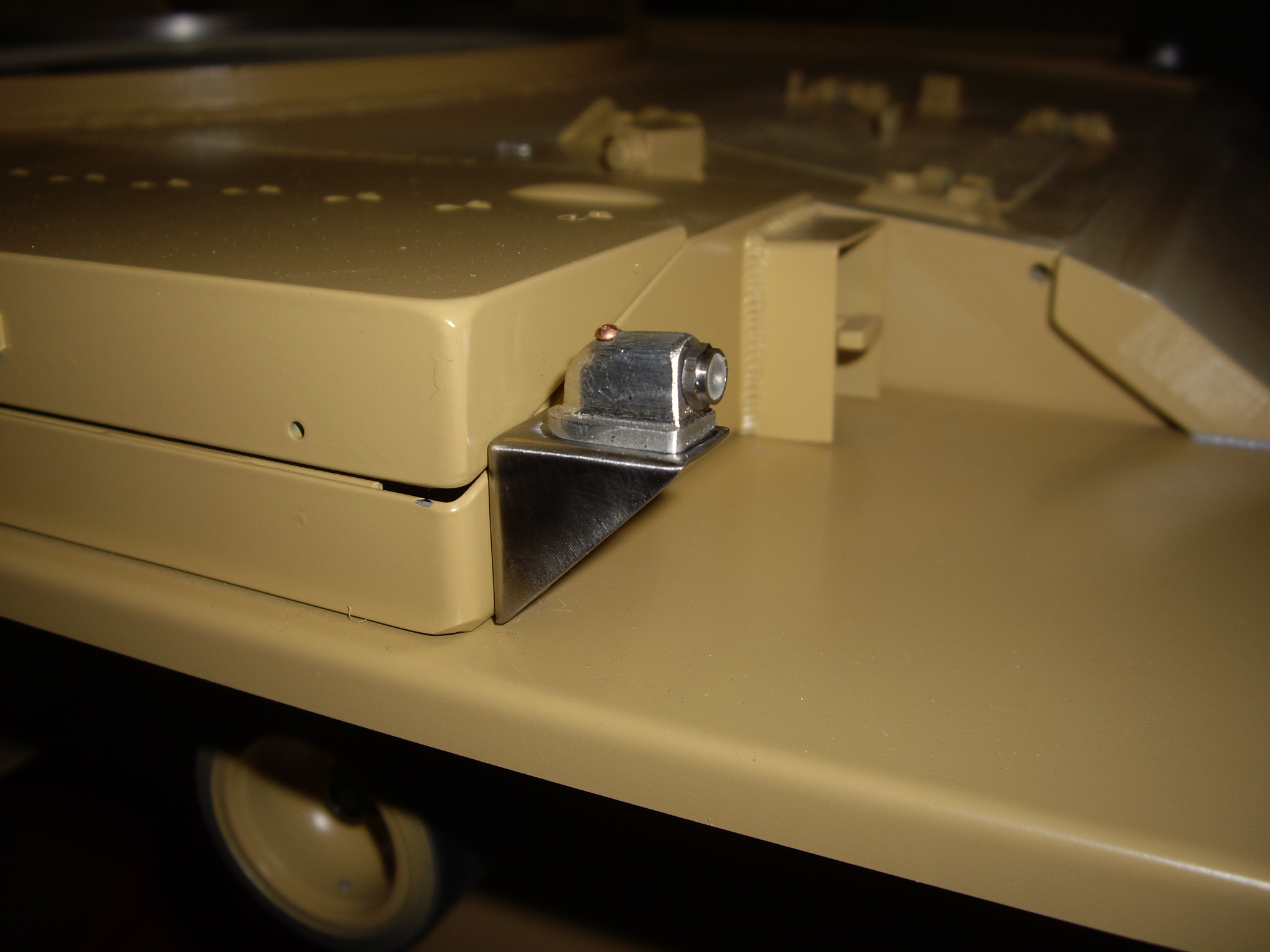

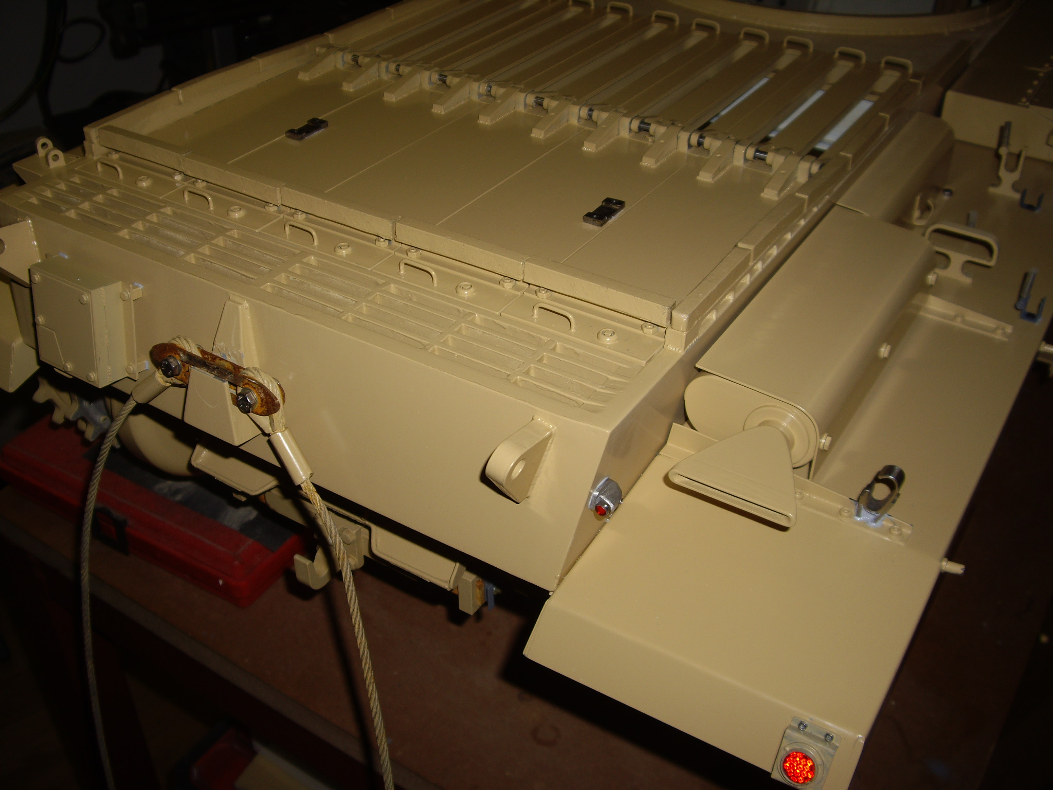

I made up a few parts for the rear, reflectors, rear light units, tow cable brackets and tapped plates on the engine hatches.
Simple fabrication jobs for rainy days really and quite rewarding for a few hours of fiddling about. I also then made front running lights and brackets which look good and will be even better when painted in.

Nice touches Mick. I particularly like the tail and front side lights, did you cast them, or whittle from stock?

the lights are a filing and fabrication job. Aluminium body with steel turned lens bezel and steel mounting brackets for the front ones. The lens is made from the rear reflector from my pedal bike, needed a good match for the colour and transparency. I just glued broken fragments to the end of a thin steel rod and then shaped them into rounds on a belt machine before gluing them into the bezel. Then some really fine abrasive to shape and polish them.
Same thing with the mudguard reflector, a brass collar made in the lathe and then a disc of reflector to suit.
My favourite was the tow cable hooks on the top of the mudguard. Nice bit of fabrication and silver soldering to get them looking right.
