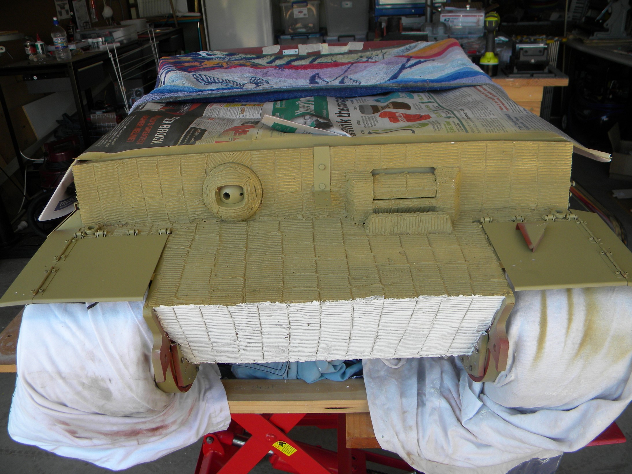

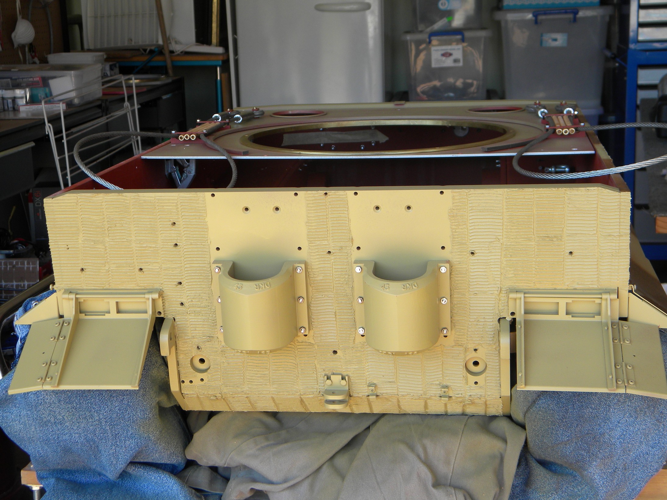

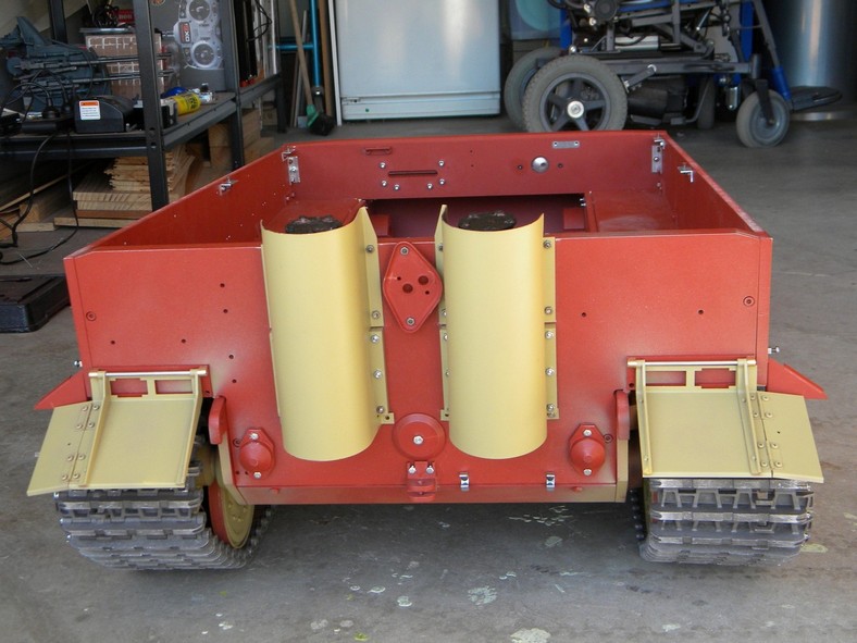

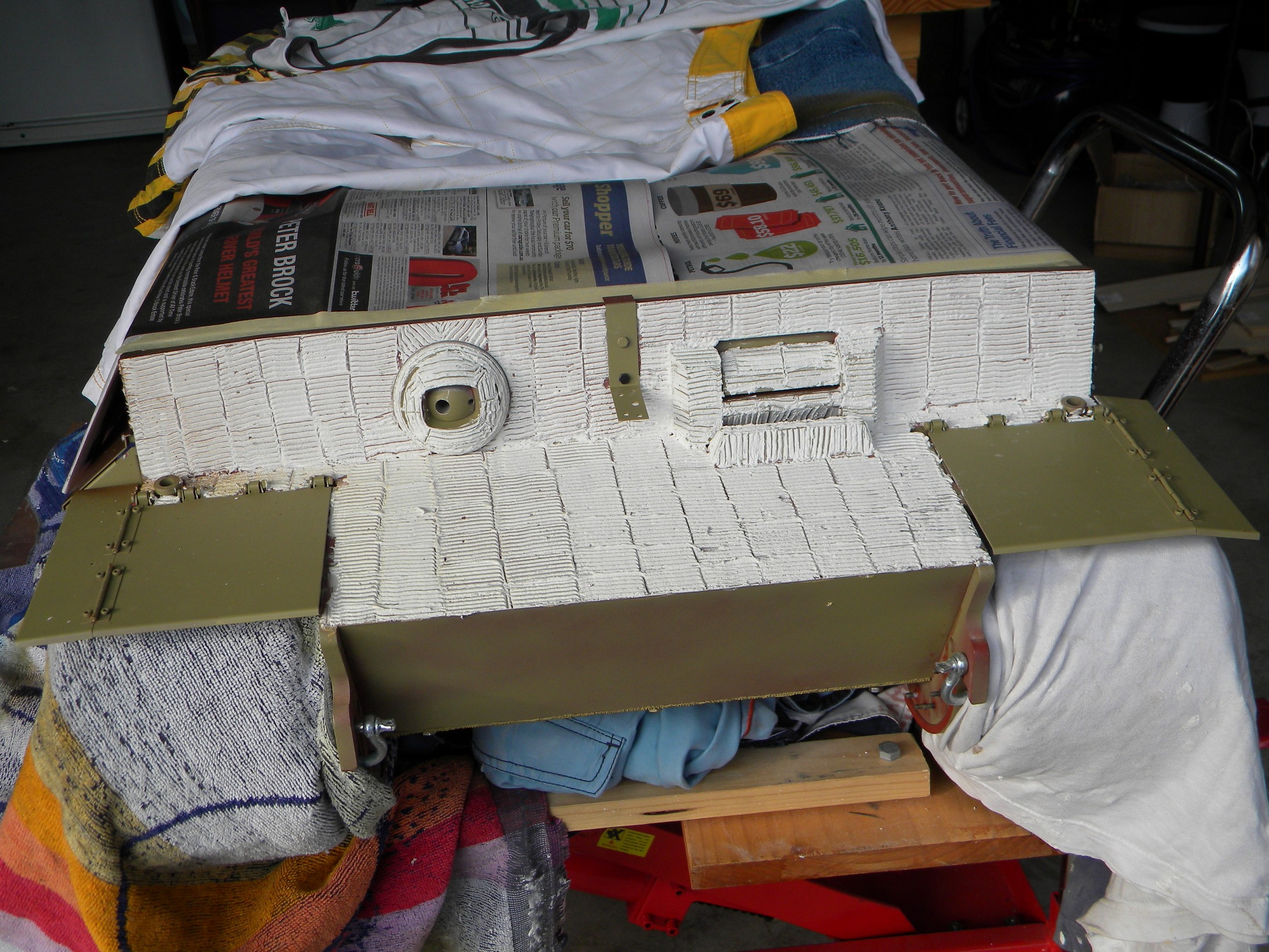

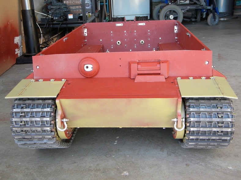

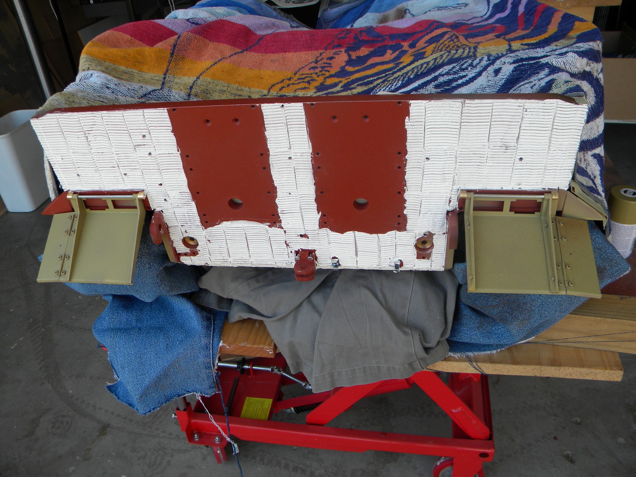

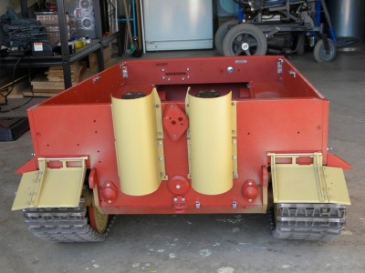

G'day All. Just some update pictures from an amatuer modeller. Building from the box. Building, running, enjoying its purpose.
Ray

G'Day Ray,
Nice work,your Tiger is coming on great,its nice to see the befor
and after pictures,keep em coming.
The Zimmerit looks great.

Hi Ray
The build is looking great so far.
Keep up the good work and cheers for taking the time to post for us.
Just a question on your zimmerit. What compound are you using?
I tried a multi-purpose joint compound which looks similar to what you 'may' have used but I found it dried with a rough texture. Yours looks great in the photos, I'd like to try it out and compare to milliput.
Jason

G'day All. Thanks.
I used a tile adhesive powder & made it into a thick paste so it didn't run & used Mike Stannards zimmeritt tools.
Ray

Looking good Raymond. How long the Zimm take?

Post by Ray Brown »
G'day Bob. It didn't take long. About 1 hour on 1 side. 1/2 hr front. Being a paste it was applied with ice-cream stick and raked with zimm tool quite easily. There are some minor imperfections but overall the results good.
Ray

Jason Richardson
Posts: 23
Joined: Mon Jun 18, 2012 12:21 pm
Location: Geelong, Australia
Been liked: 4 times
Re: new tiger
Post by Jason Richardson »
This tile adhesive sounds interesting.
Did it dry rock hard or can you still mark it if you
were to press into it with your finger nail?
