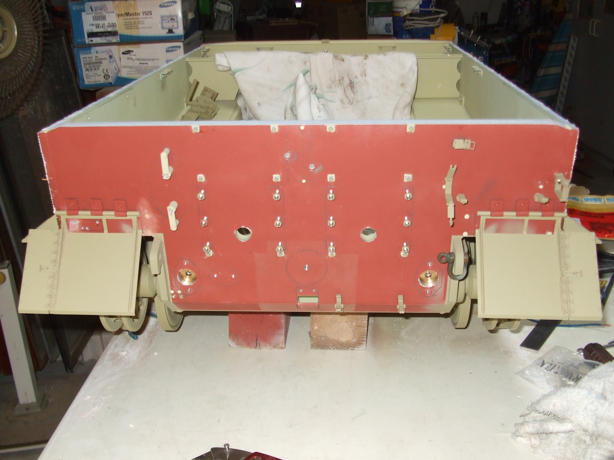

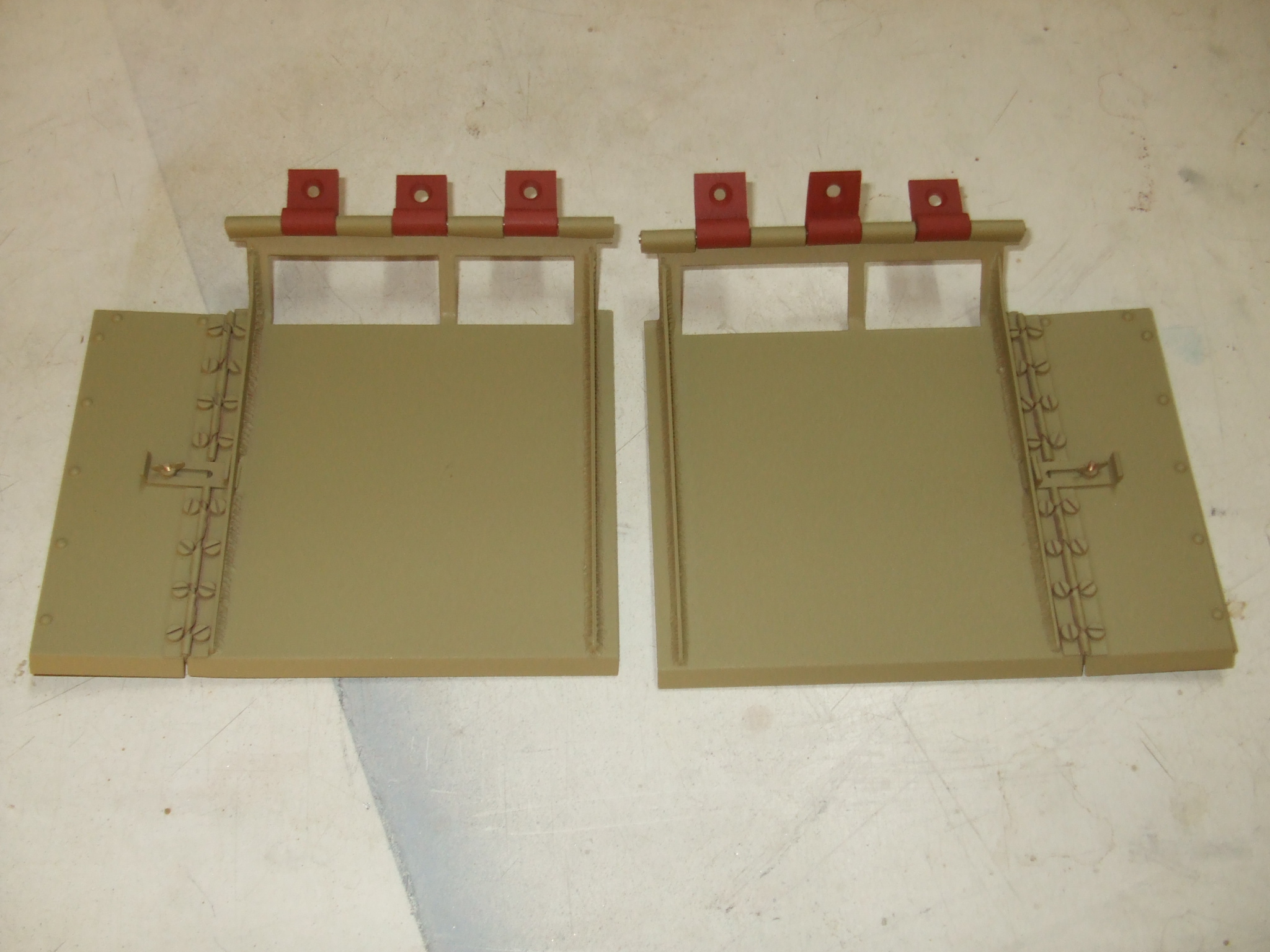

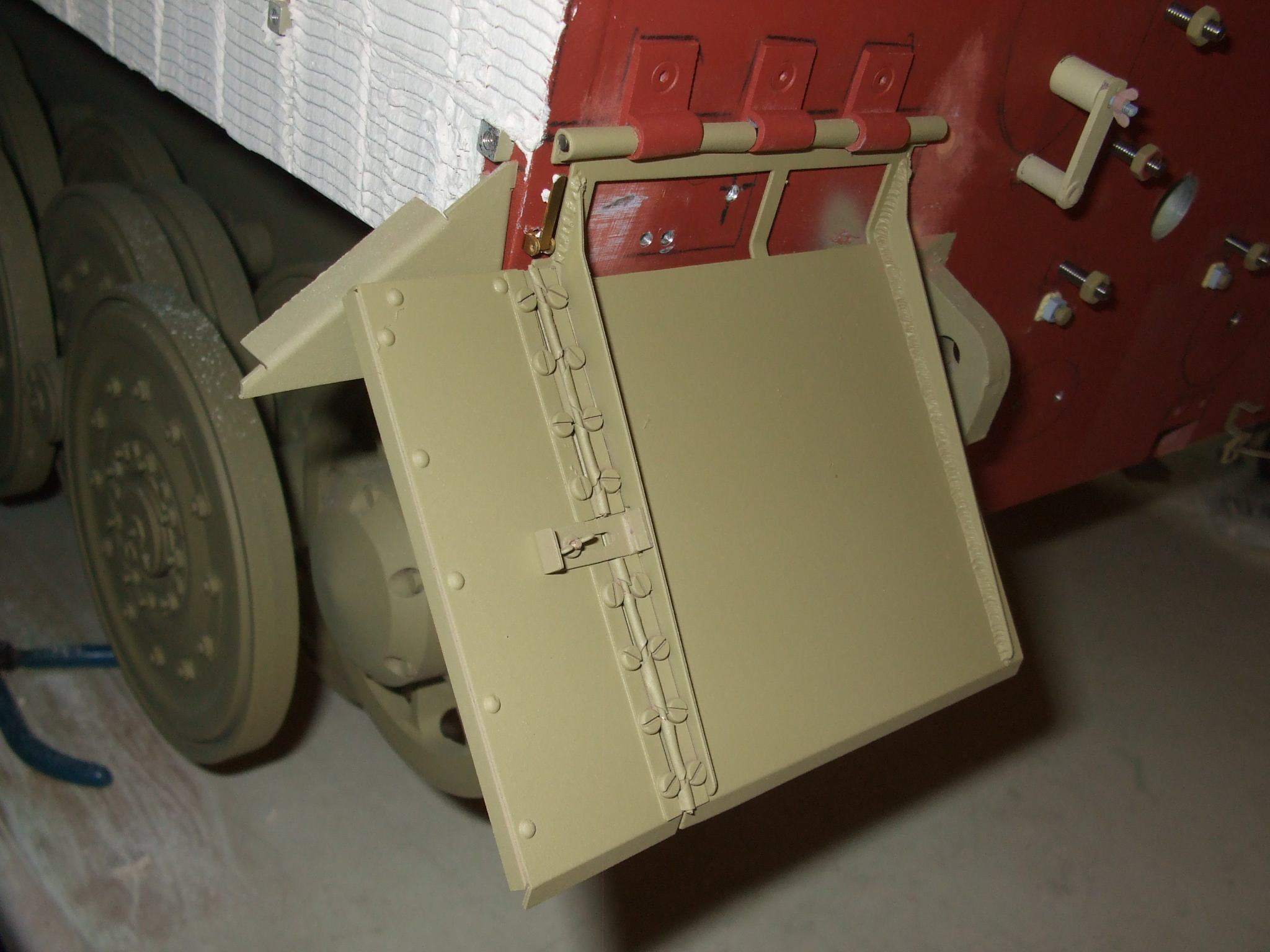

Finished painting the rear mudguards in preparation to applying zimmerit to the rear plate.

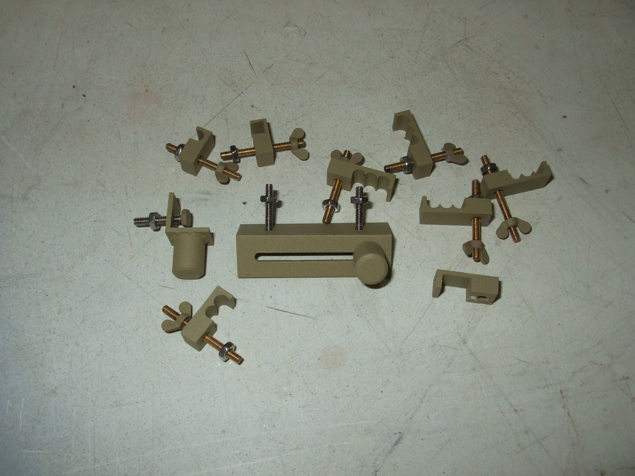

Painted also the home-made track rope clamps.

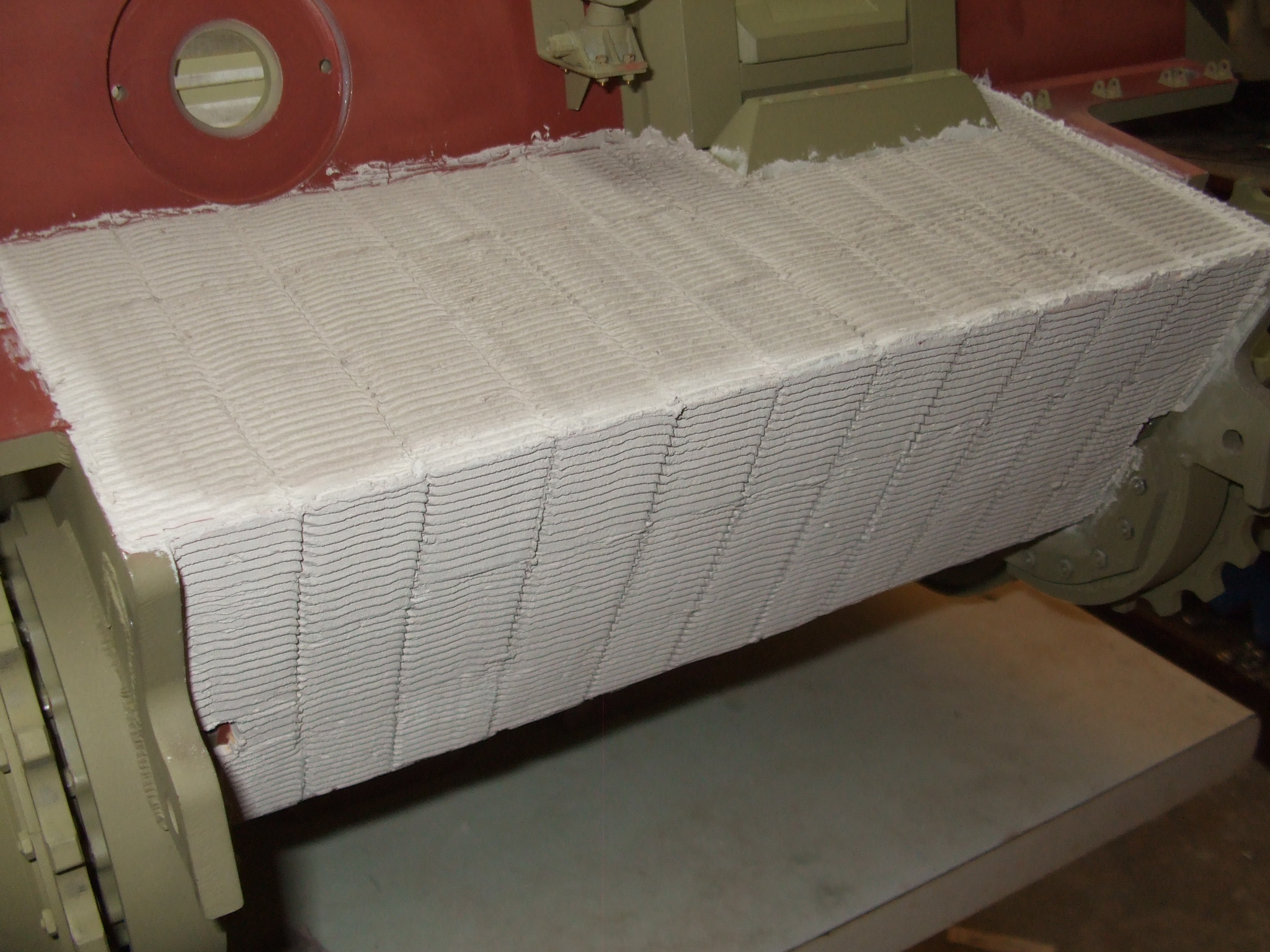

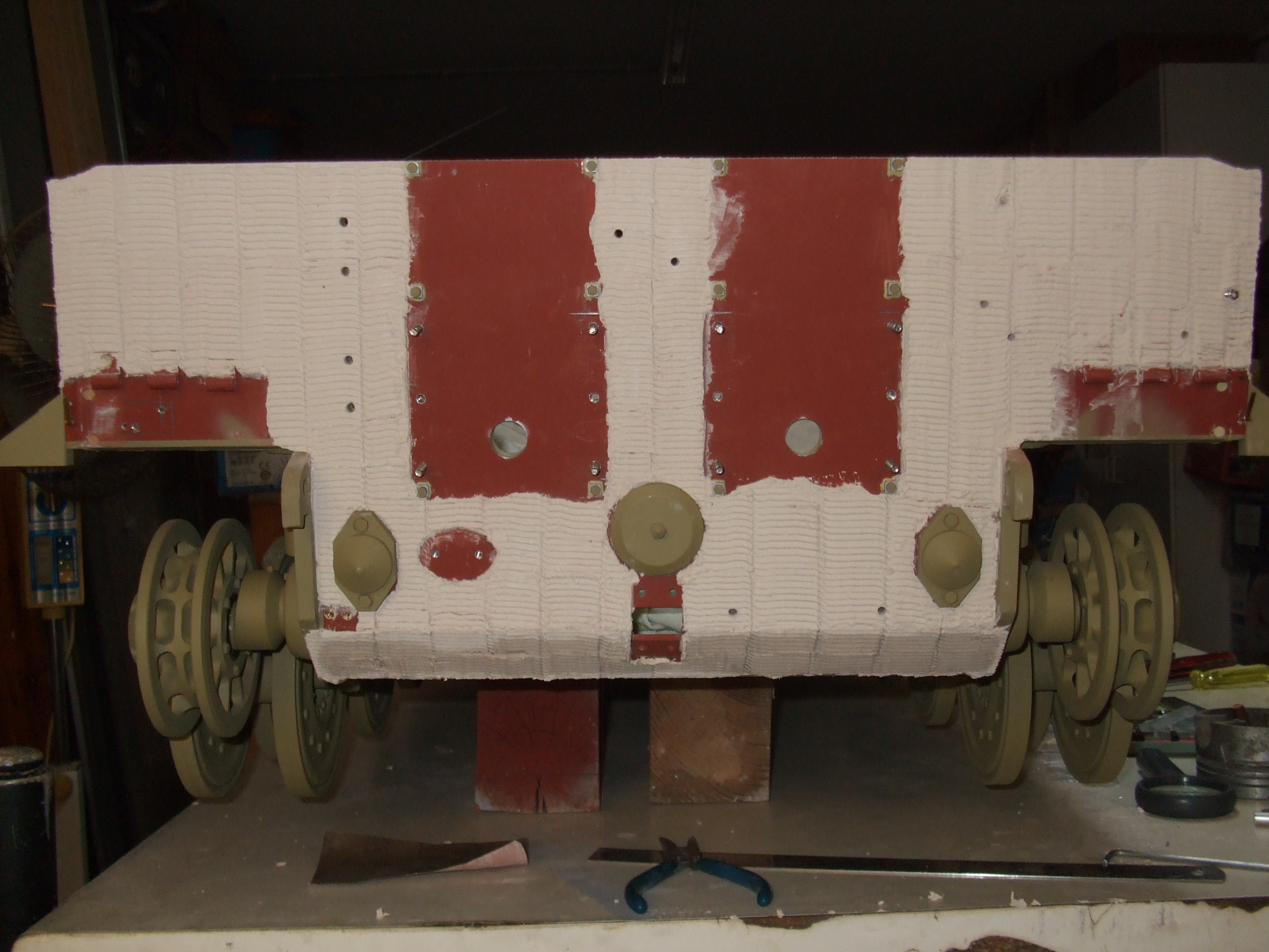

I am also slowly progressing with the application of the zimmerit. I have the left and right sides finished and at the moment working on the front of the tank.
Looking good Vince, ref the rear plate, the real application would have been done around the fittings and would of affected the pattern some what, I would a least loosely bolt the exhaust shields on and the armoured covers for the track tensioners .....Love those rope clamps! Phil.
Has liked: 792 times
Hi Phil and thanks for your thoughts. For the rear plate I have marked the outline of each component with pencil so that I know where to apply the zim. Let's see if this method works.

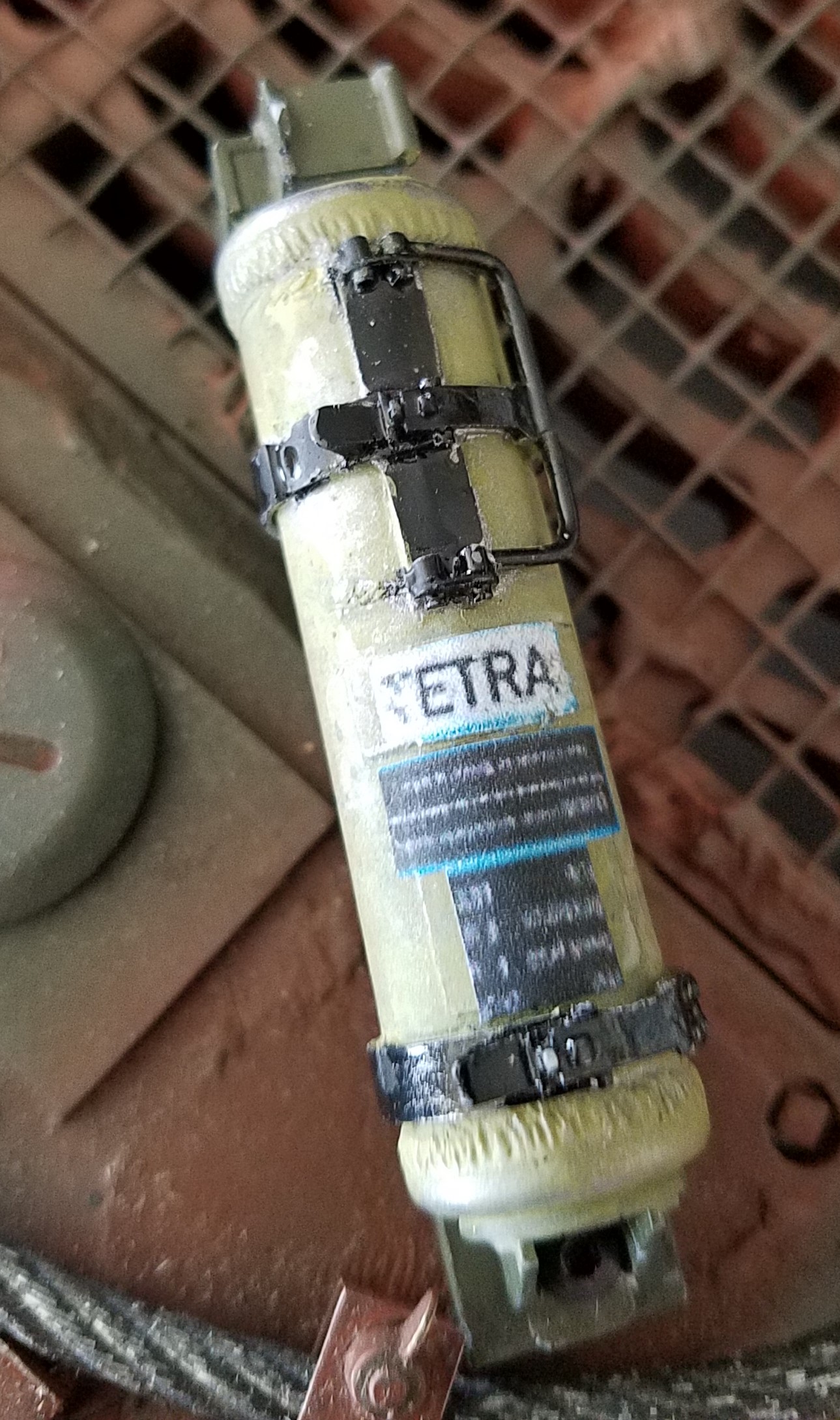

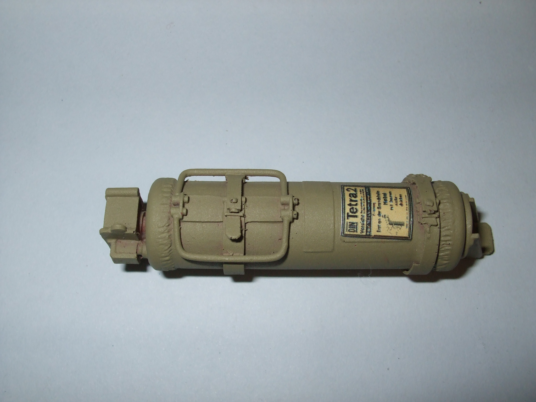

Finally finished the fire extinguisher! I used the label that was made by Lionel (viewtopic.php?f=6&t=3996&p=34350&hilit= ... bel#p34350). After some trial and error managed to re-size it in a word processor. My first attempt was using decal paper. This failed miserably. It just did not want to stick to a painted surface. Second attempt was using "sticker" paper. This at least remained stuck to the fire extinguisher. For how long? Time will tell. If it gets unstuck I can always make another one.

Vince, do you think a light lacquer over the label would hold it on??
cheers...
At the moment with the sticky backed paper it is adhering well to the fire extinguisher. I guess one can use a transparent lacquer to fix it better but I think the whole extinguisher has to be given a coat of the lacquer to make it look uniform.

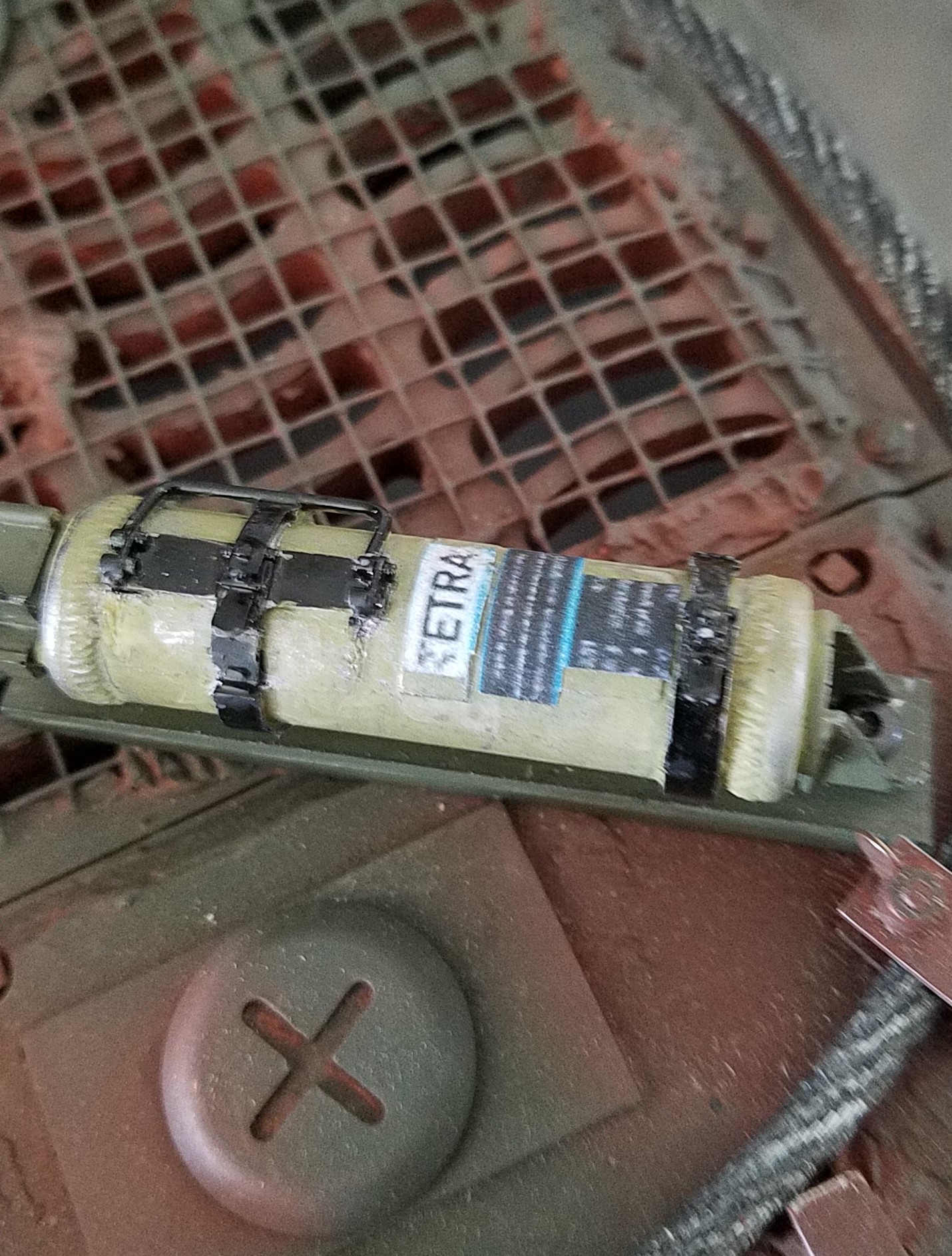

I re-did mine.
I painted it a light green and brushed it with a rag to make it look worn.
Printed a label and soaked it for a few seconds in water-and-white glue, and it seems to have adhered fine.
Has liked: 1038 times
Vince - the trick with decal paper is to give it a couple of coats of clear matt varnish before soaking the backing off. That gives it some strength. Then, once you've positioned it and dried it, give it another spray of varnish to seal it. Should then stick for ever. Much better result than sticky paper or white glue.

Maybe the mistake I made was that instead of varnish I sprayed two coats of transparent plastic paint. Having said that the sticky paper experiment is still looking good.

I think Stephen has the better idea, of using a clear varnish. The varnish should protect it from moisture more so than white glue or other water soluble substance.

Today finished the zimmerit on the rear plate and now I need to mask everything in preparation to painting the zimmerit.
I am not really happy with my zimmerit but I am hoping that it will look better with the paint.

Hey, good Zimmerit. It looks nice.

Your zim looks just fine. I wouldn't do anything with it.
In fact, I think you need not tape and paint it separately. Originally, they applied it to bare metal, or more often, onto a non-corrosive primer.
Ultimately, you're going to paint it, right? If anything, you might consider a primer.
Tom
