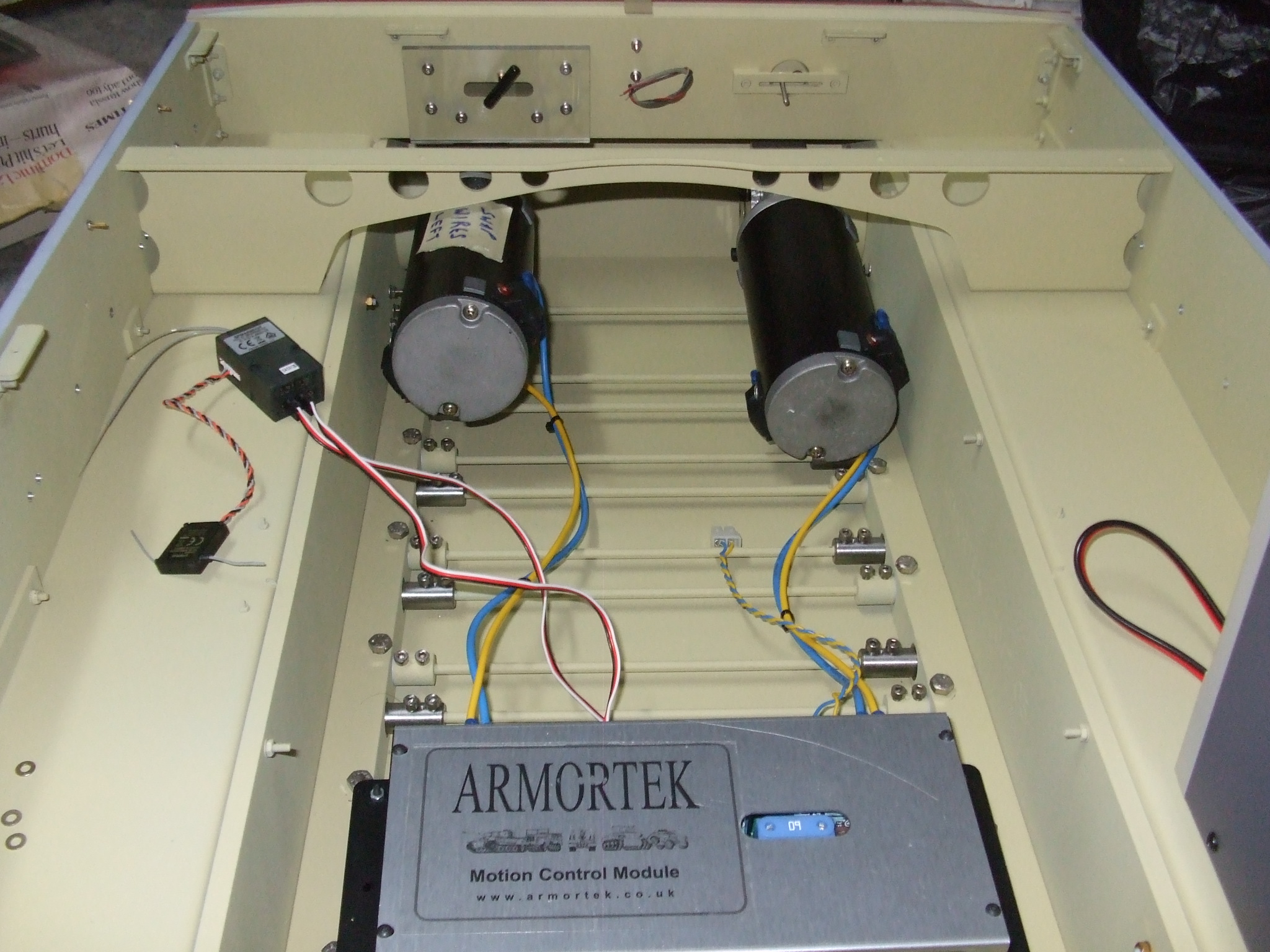

Brian, can you have a look at the following photo. It is showing the motors in the hull. The one on the left (driver side) is sitting at a higher angle than the other one. Is yours the same?

No. Mine look the same angle. How great to get your hull moving!?
- Posts: 2188
- Has liked: 777 times
- Been liked: 1745 times
Re: Vince's Tiger 1 late variant 2017
Thanks Brian. I thought it was strange that both motors are not at the same angle but it seems that it is not affecting operation.

Definitely not right. They are easy to misplace and I even think they can go on backwards?

I have been in communication with Armortek and also sent them photos of how I installed the motor mounts.
Kian said that I installed the mounts correctly but one set of holes in one of the mounts was machined slightly offset. He assured me that it will have no impact on the running of the model or the fit of the parts apart from the motors sitting at different angles. He also offered to send me a new mount.
Great customer service but most importantly put my mind at rest that all is OK.

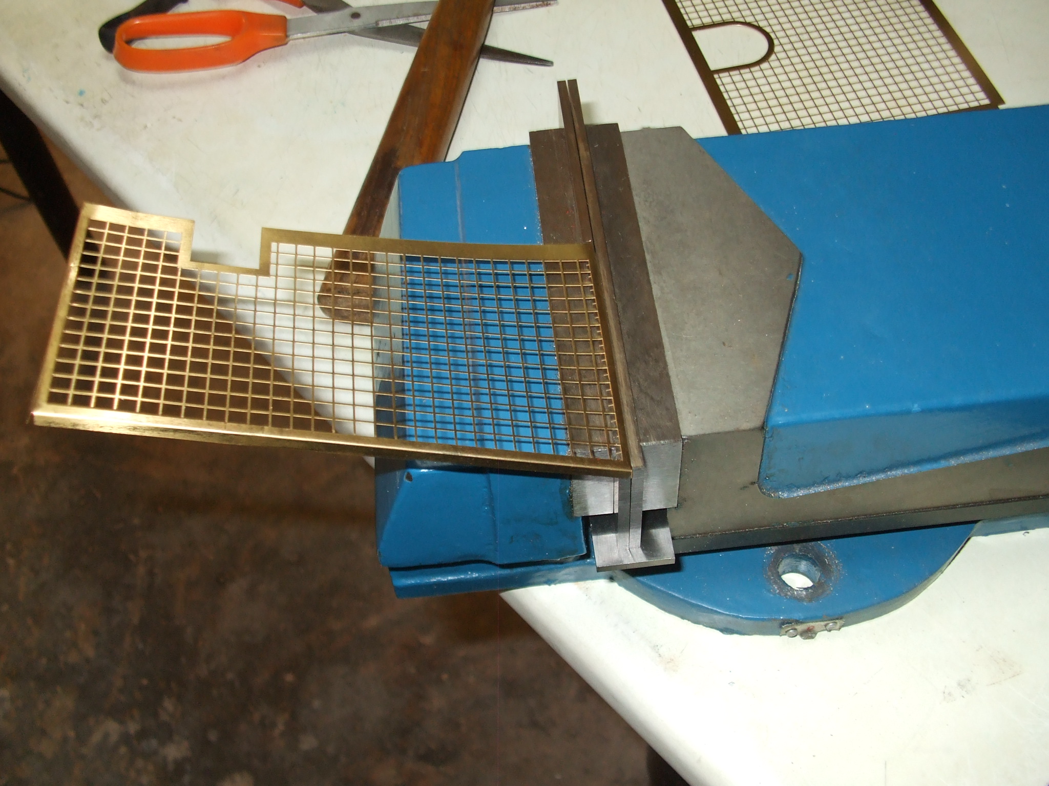

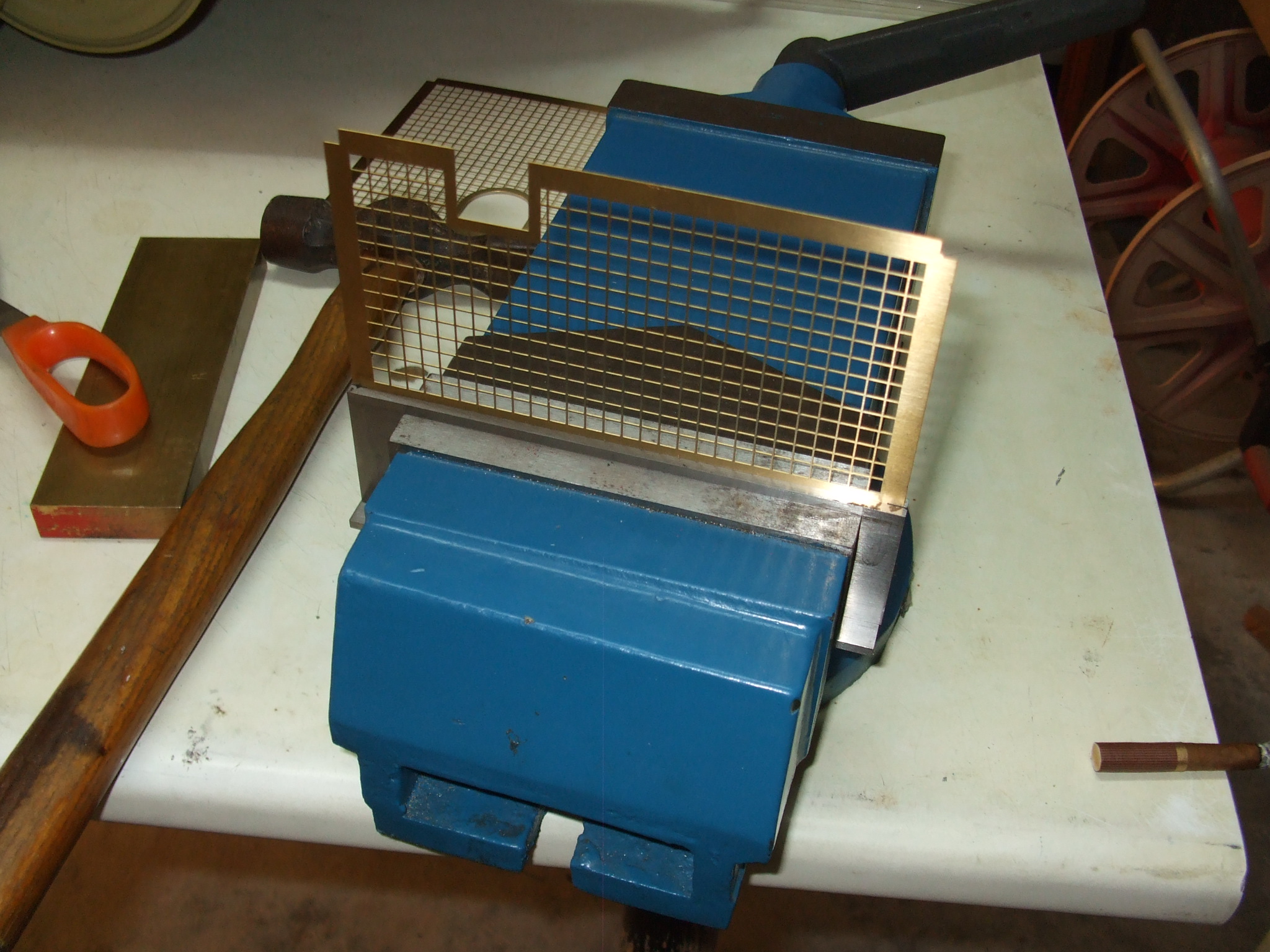

Decided to attempt the bending operation of the photo-etched grille covers. Not having any sheet metal fabrication tools I used my large milling vice and some parallels to hold the photo-etch grilles. Wasn't as easy as I thought it would be but at the end I managed to do them all.
I might modify them a bit. Just waiting for some material to arrive.

I like that piece that isn’t bent do you think it should be trimmed? So it does not cover the hinge or is it better left
- Posts: 2188
In the photos that Kian sent me, the un-bent side was not trimmed so for now I left mine like that. It does not foul the hinge as it is. Having said that, it wouldn't look bad if it was also trimmed.
As it is, I am modifying the photo-etch mesh so I might change my mind again.

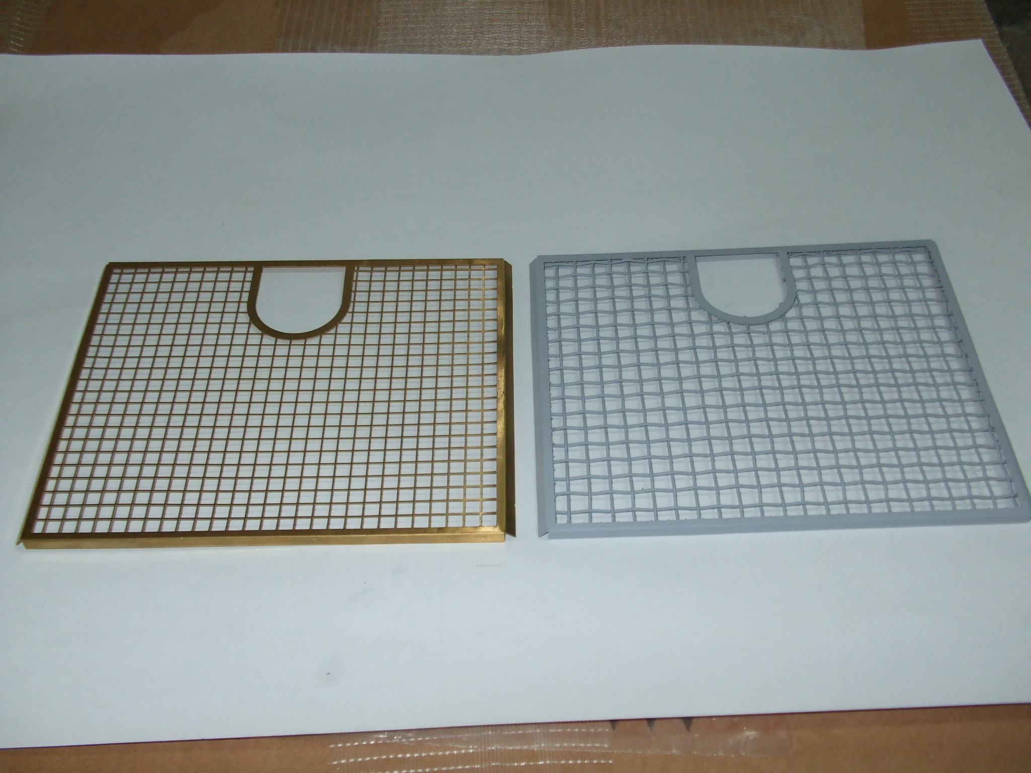

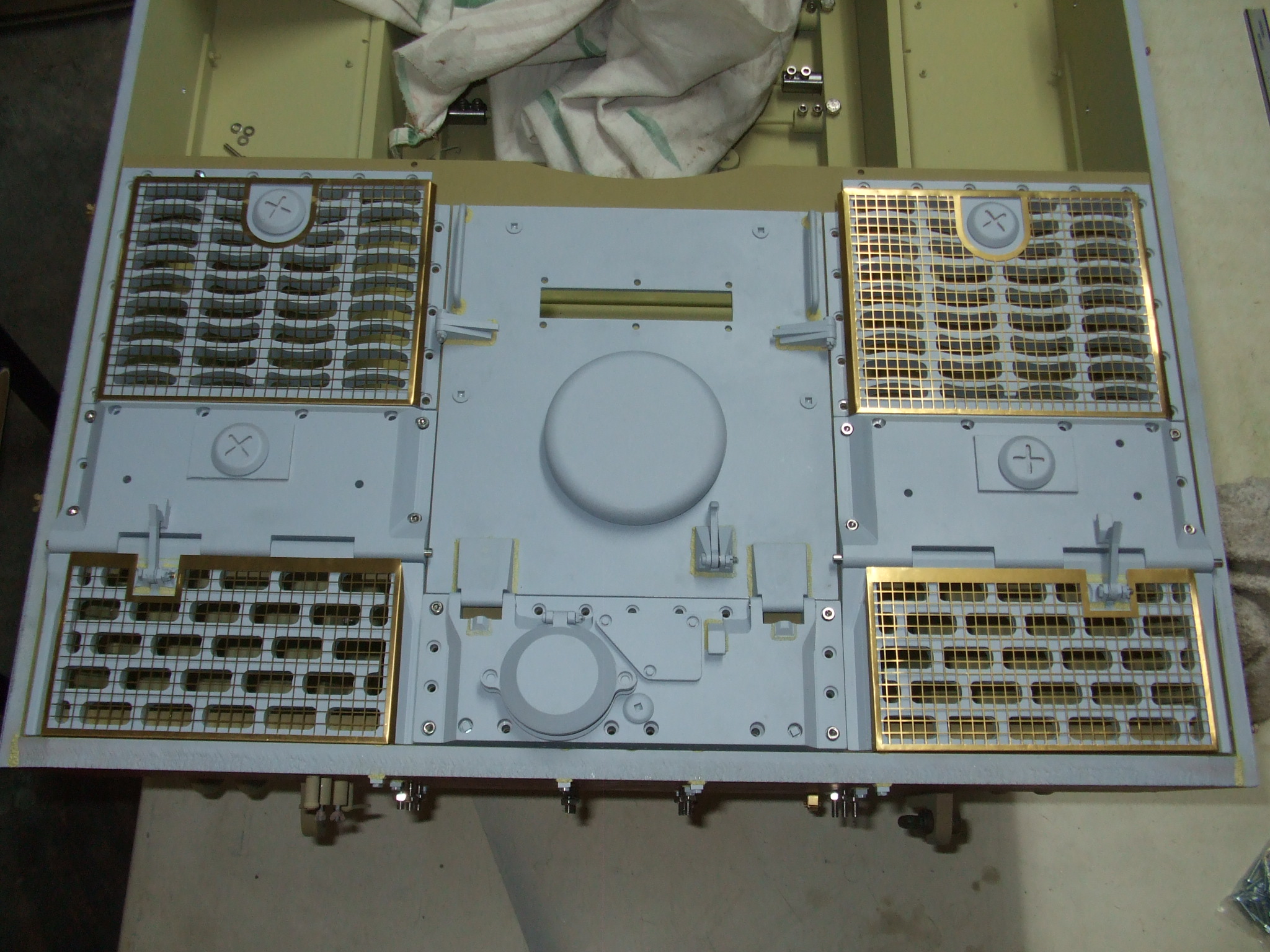

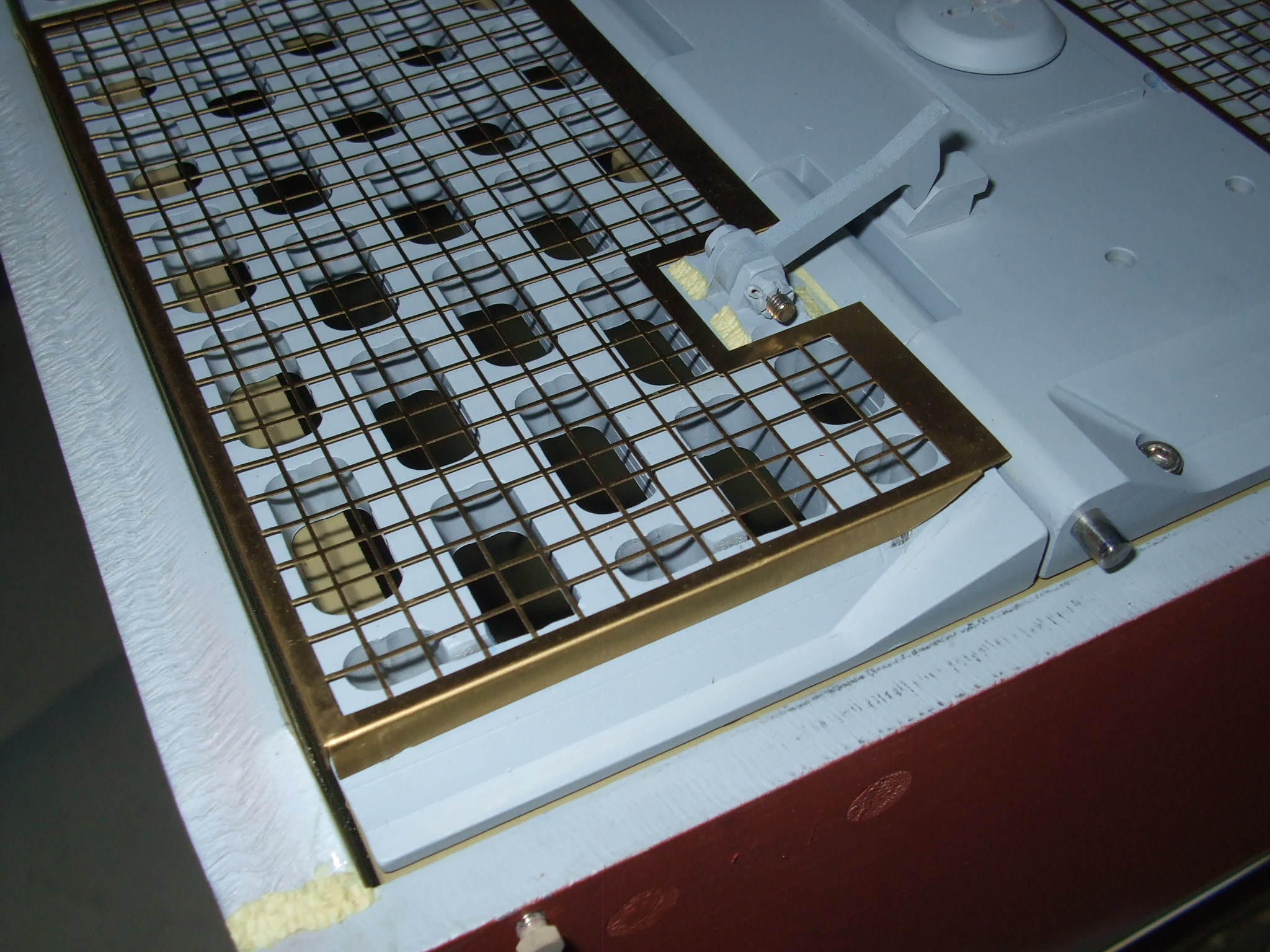

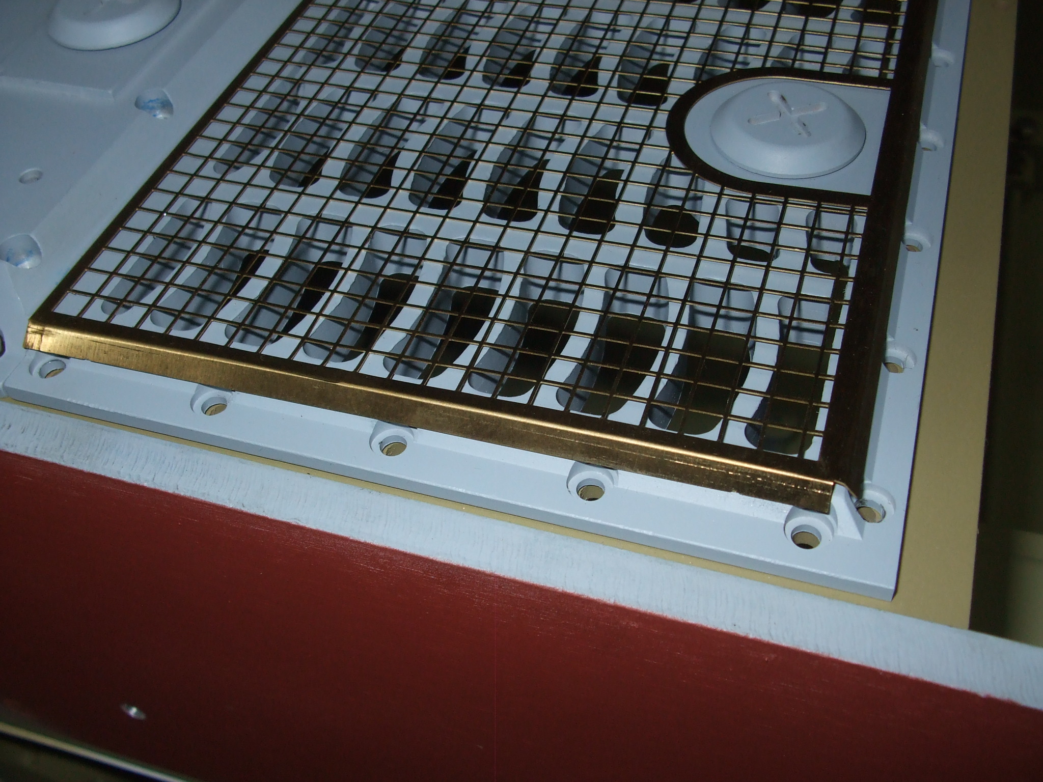

Earlier this year, when I was working on the road wheels and sprockets, I acquired an another photo-etch set from Armortek. This means that I had an extra set of photo-etch grille mesh to play around with. This gave me the courage to experiment with the photo-etch grille covers and see if it's possible to improve them.
Yesterday I received some course and also some fine woven metal mesh and the result of the experiment is shown below.
The mesh I got is made from mild steel. I would have preferred if it was brass but I could not find it. Does anybody know of a source of course brass mesh? I soft soldered the mesh to the bottom of the photo-etch frame and then cut the existing photo-etch mesh. I have only made one for now as I wanted to get some comments (good or bad). Well, what do you think? Is it worth the extra effort to do the other three?
Online
- Brian Ostlind
- Posts: 1466
- Joined: Sat Oct 28, 2017 6:56 am
- Location: Oregon, USA
- Has liked: 971 times
- Been liked: 2066 times
I like it. Why is brass better than steel? Are you going to make upgrade kits for fellow modelers?
