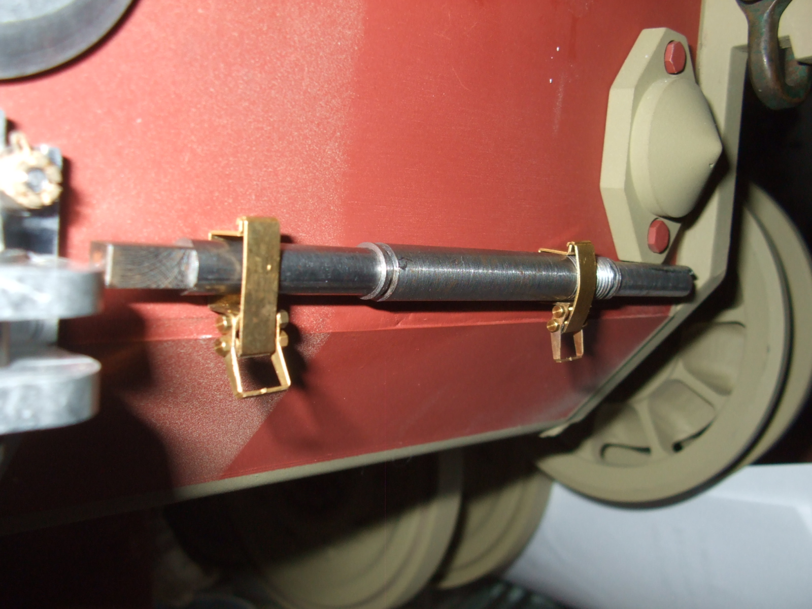

Thanks Bob for your comments. Good to hear that you are interested in my slow progress. Life is coming back to normal and today finally finished fixing the starter shaft to the rear plate.
As Steve's starter shaft is a bit wider than the kit supplied one, I found that the kit supplied clamps were too small. So I got some photo-etched tool clamps from Dave (Armorpax) in the hope that I might find the size that I needed. Assembled some to find the right size. Fiddly little things but really cute. The 1.4mm bolts and nuts are my addition to the clamps.
I soldered a 3.5mm shaft with a 2mm threaded hole to the bottom of the clamps so that I could fix them to the rear plate using the existing holes. A bit over-engineered but if possible I like to make things removeable if needed.
Now I can take the starter shaft off the to-do list.

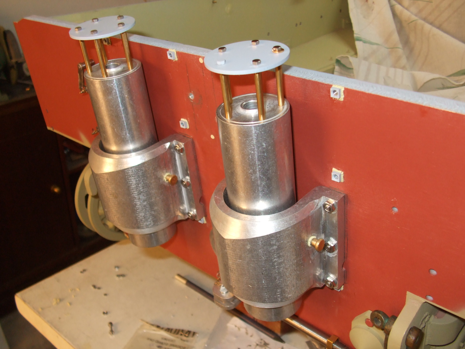

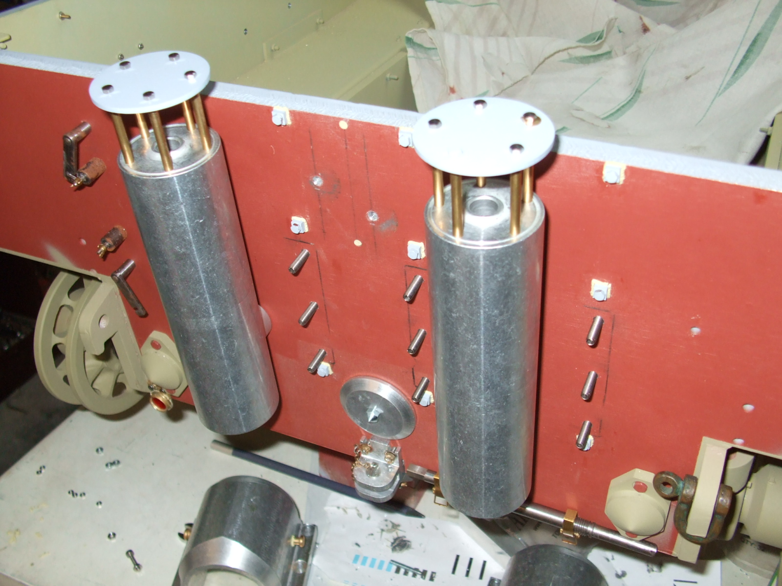

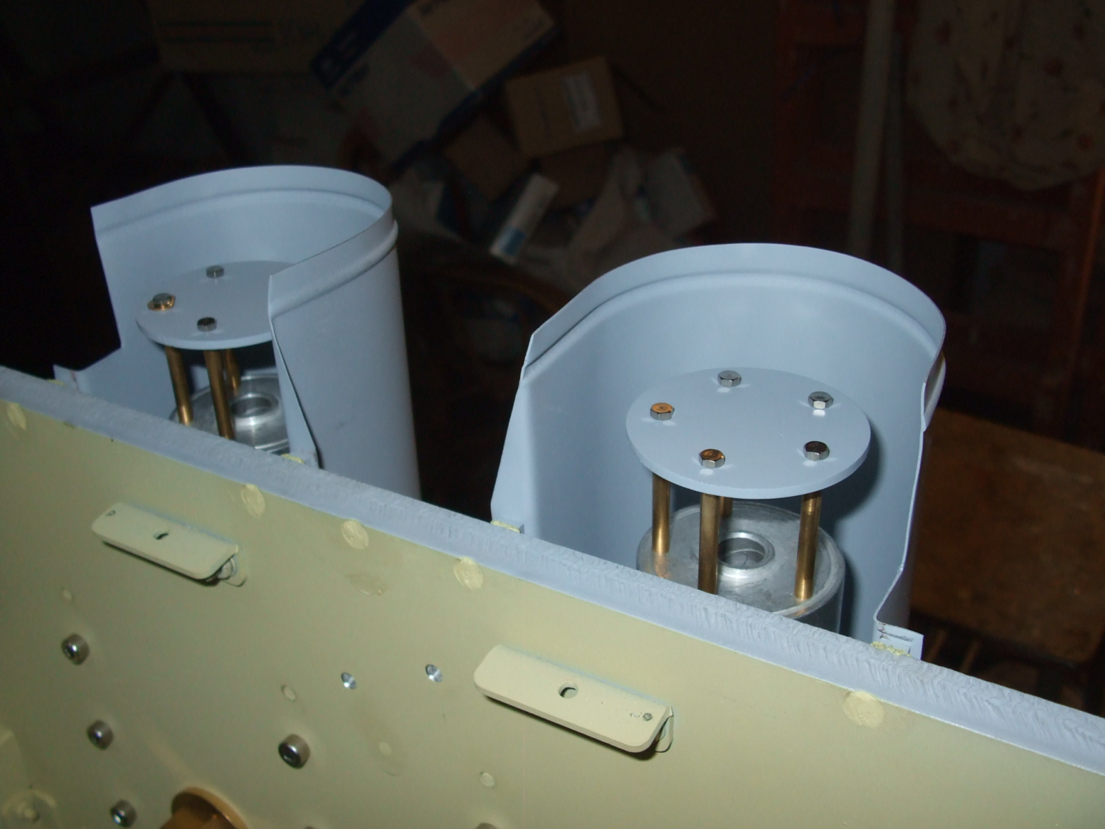

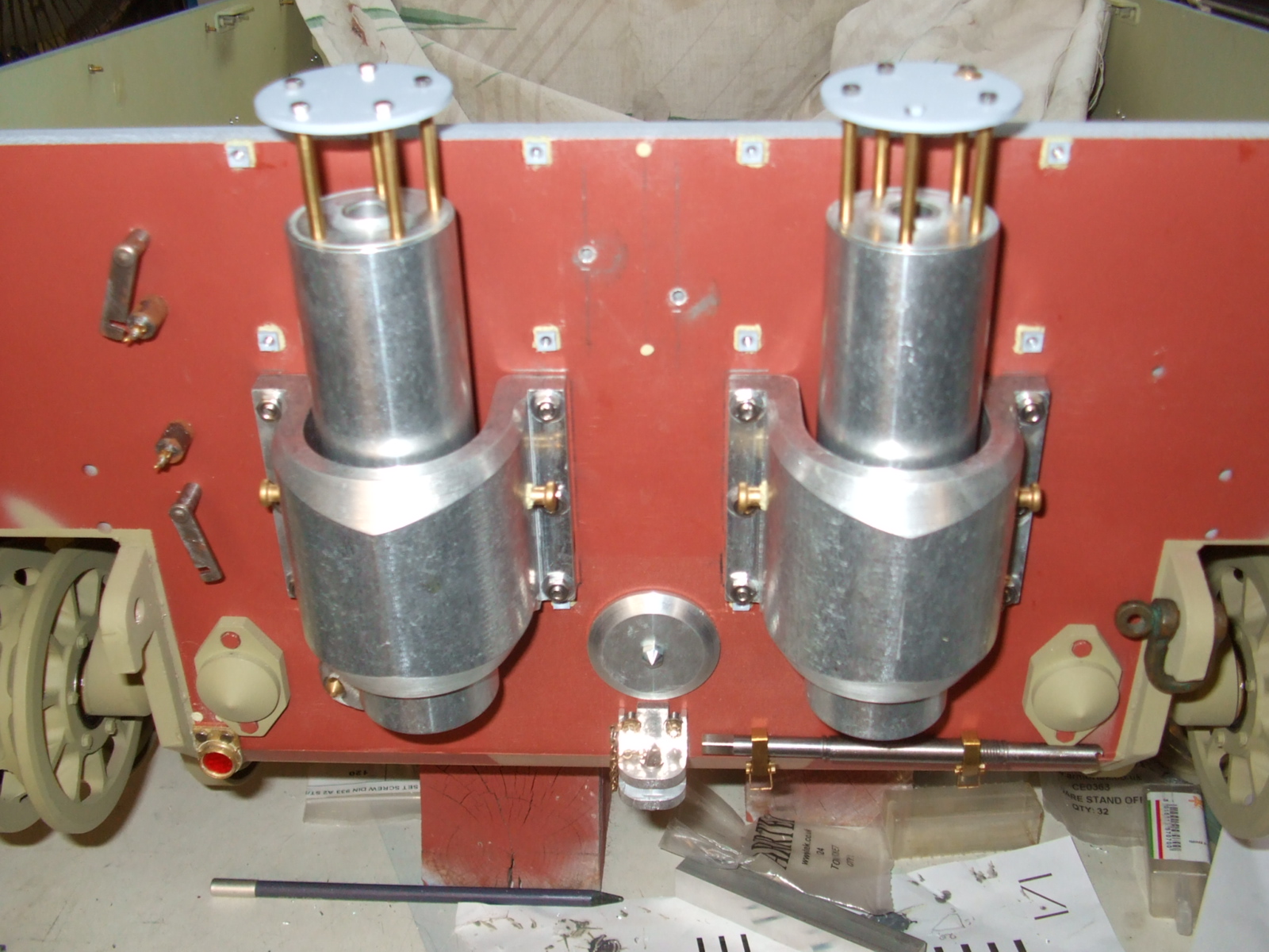

Finished the exhaust components and did a trial fit.
Added the lifting pins and milled the semicircular cutout at the bottom for the drain.

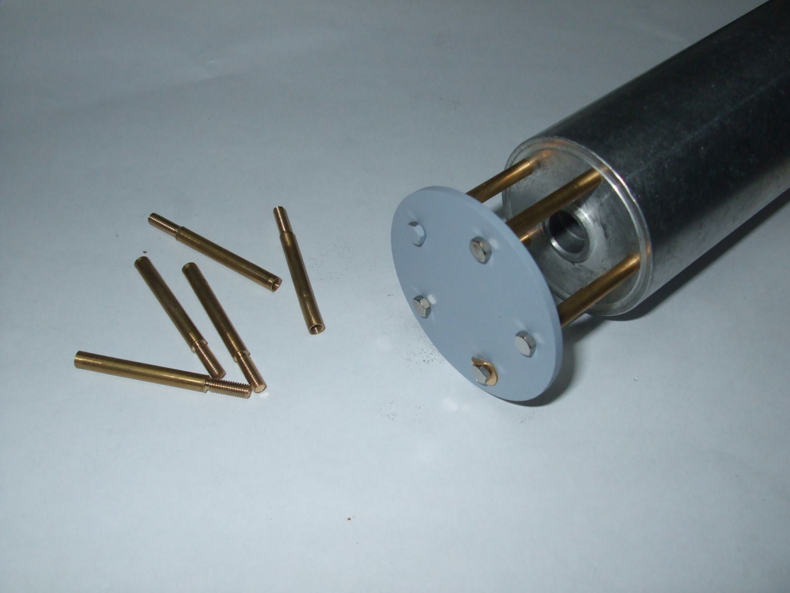

Remade the top cover with a 45mm diameter. Used smaller head bolts and also experimented with the lock washers using brass washers. Remade the supports for the top cover from 3.5mm brass rod. Male thread at the bottom and female thread at the top.
Added square stand-offs for the exhaust heat shields. I used the same square stand-offs which are also used for the side skirts.

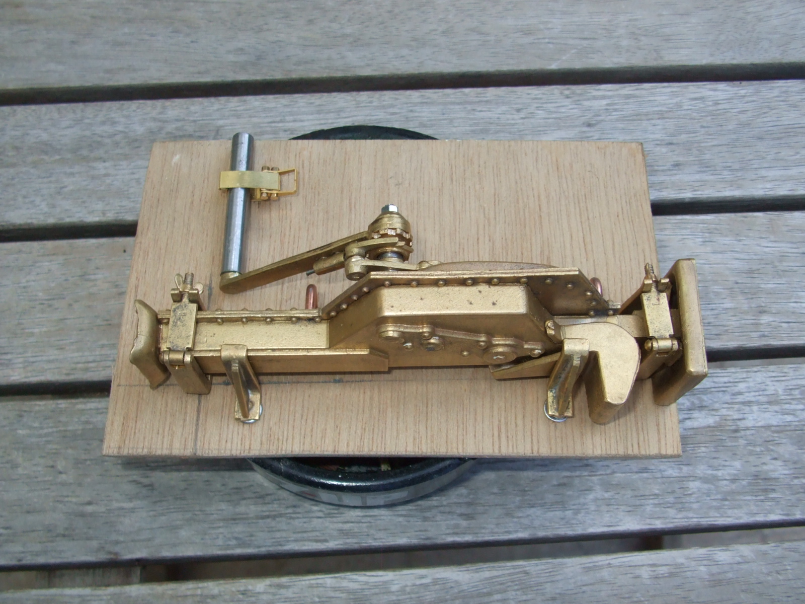

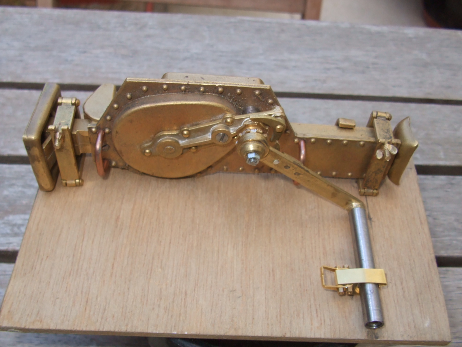

Finally relented and got myself a 20T jack from Steve. Awesome piece of modelling. As new holes need to be drilled for the jack brackets I thought I would make a template for the holes on a piece of ply.
I was going to drill the holes in the rear plate for the brackets but thought it would be prudent to wait until the rear mudflaps are actually fitted, which means that work on the rear plate will have to come to a halt as I still don't have the mudflaps for a late Tiger.

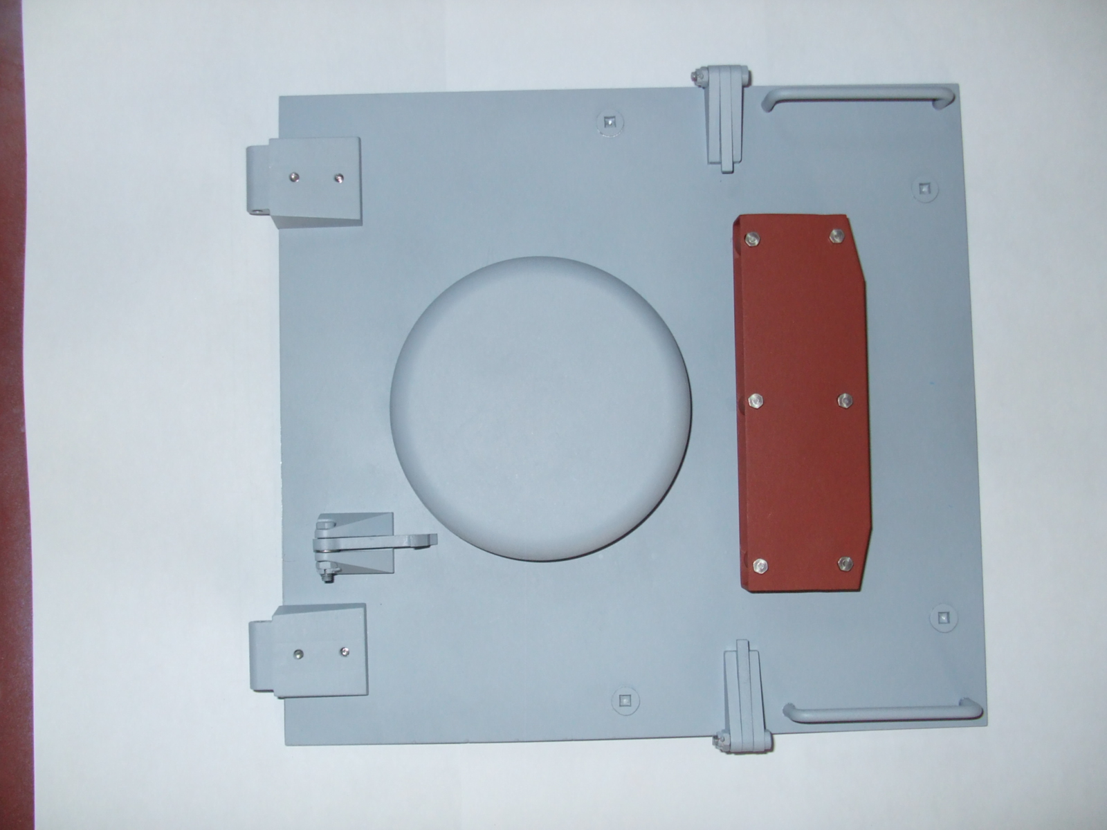

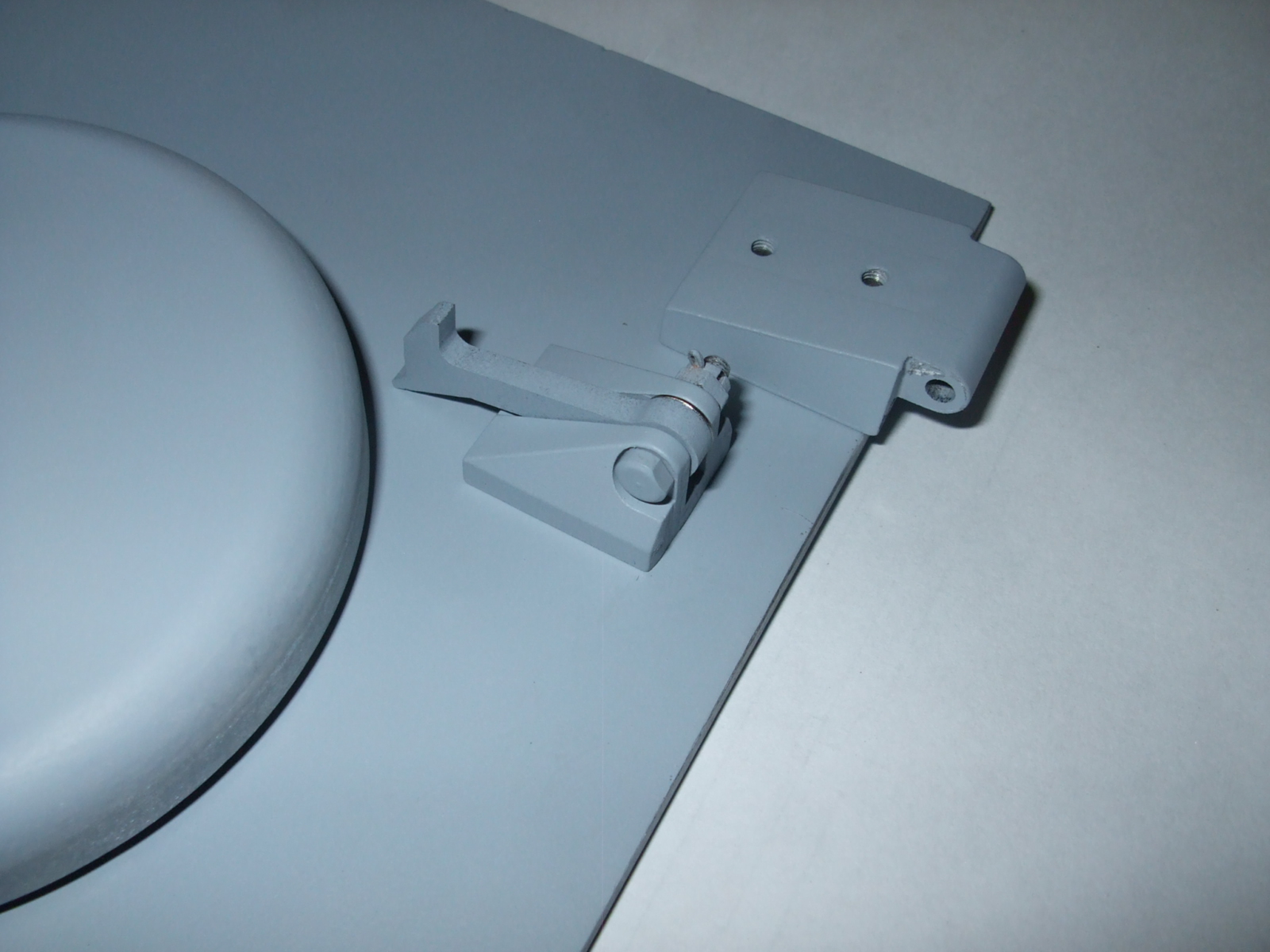

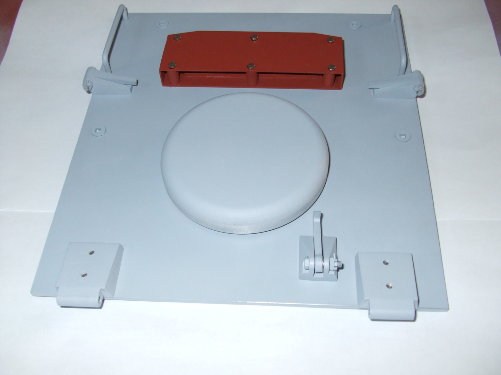

I worked a little on the model to try and distract myself and today finished the engine main access panel.
Although I should have; I did not shift the rectangular air inlet opening forward. I decided that it was too much work for little gain. To compensate I used Steve's air inlet instead of the kit supplied part. I also added the four lock panel fasteners that are typical of a late Tiger. Before anybody asks, I used the head of a Robertson wood screw to simulate the fasteners. Also, for the catch pivots, instead of using the kit supplied dowel pins, I used round headed bolts with two flats and castle nuts.
I still need to add some weld seams and plug some holes but I will do those later.
