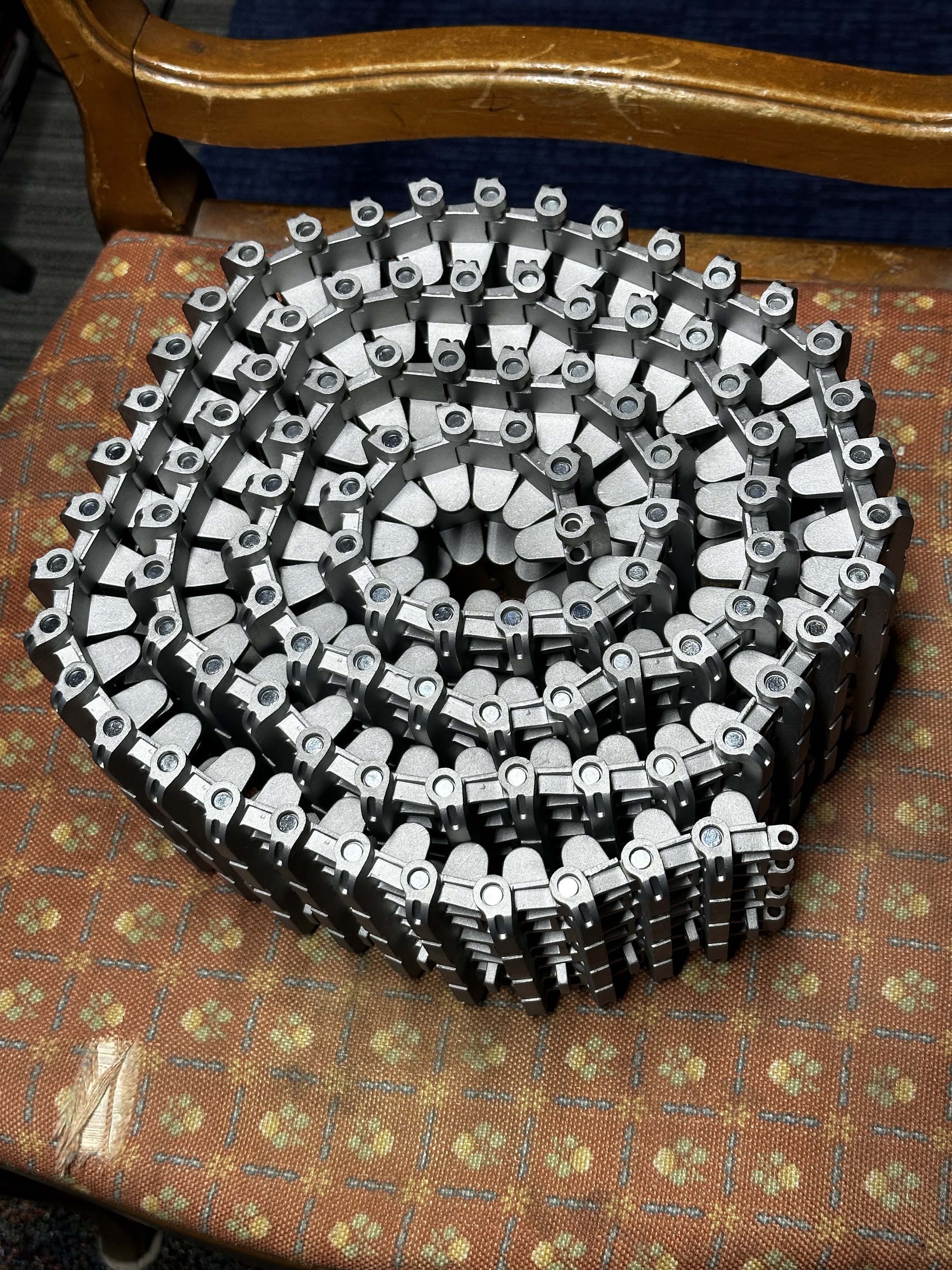

Well, that was a good couple day's effort done. One down, one to go! I left it a couple links short until it comes time to fit it.

Re: Dave's Tiger I (Early) Kit Build Thread
Interesting photo.
Is just the one?
Charles
Is just the one?
Charles
So far, yes, a one-off oddity. More worrying is the number of bent pins I have. I check them as I use them and I'm hoping I have enough to finish the second track without having to wait for replacements. I think I'm OK for now as I can use these bent ones for the spare track links so far. They bind but that won't matter for the spare links.

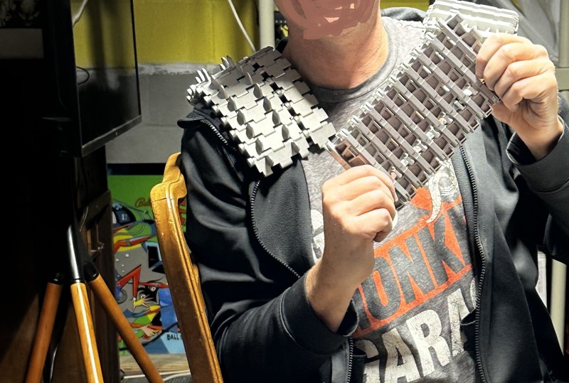

I had a friend over today who wanted to do some building with me, so I put him to work on that second track. He cranked out a good number of them, and was very thorough on checking the pins and links for straightness and freedom of movement. I had him build sets of 10, then I put them together later in the evening. Got about 35 more to go.
Having him work on those allowed me to complete all 8 long axles, put bearings in all 8 of the long hubs as well as 3 of the short hubs and install one tire on my spare wheel, plus mock-up one wheel assembly. That Loctite 480 for the tires is some messy stuff.
All in all, we got a lot done today.
